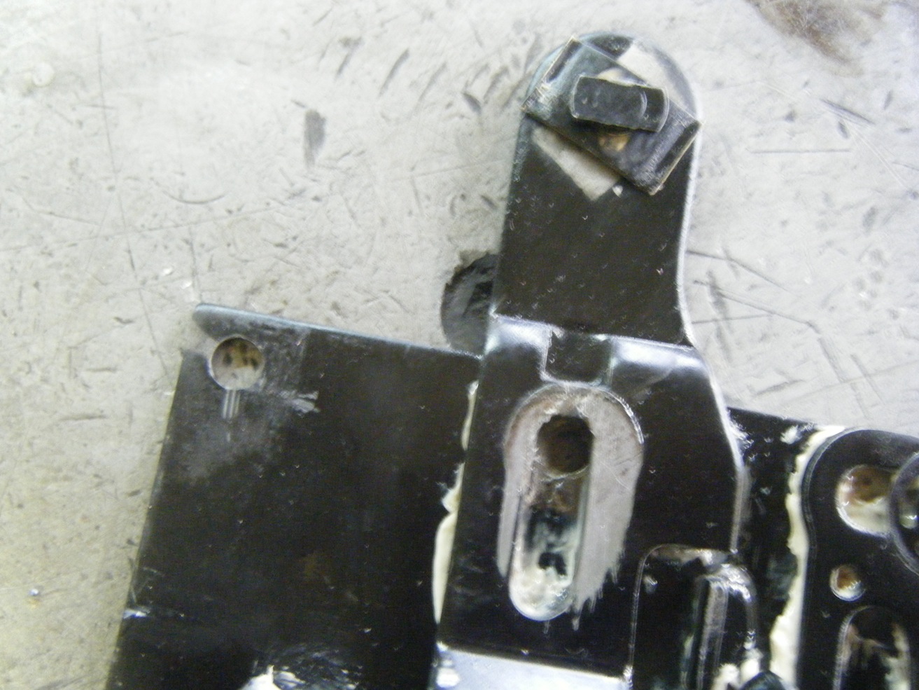

    i needed a break form working with wood so i decided to fix the p***enger latch. the pin that rides in the slot, on the bar that the out side handle operates, was worn. it was allowing the rod to move to the side as tho it was in the locked position, so you couldn't get in. i drilled off the "peen" on the out side and drove the stud out. i then marked the head of it with an arrow pointing towards the flat spot. i then put it back in with the arrow toward the slot cut out. i then welded the "peen" back on. works perfectly now. DSCF3606.JPG DSCF3608.JPG DSCF3605.JPG
    ct1932ford likes this.
