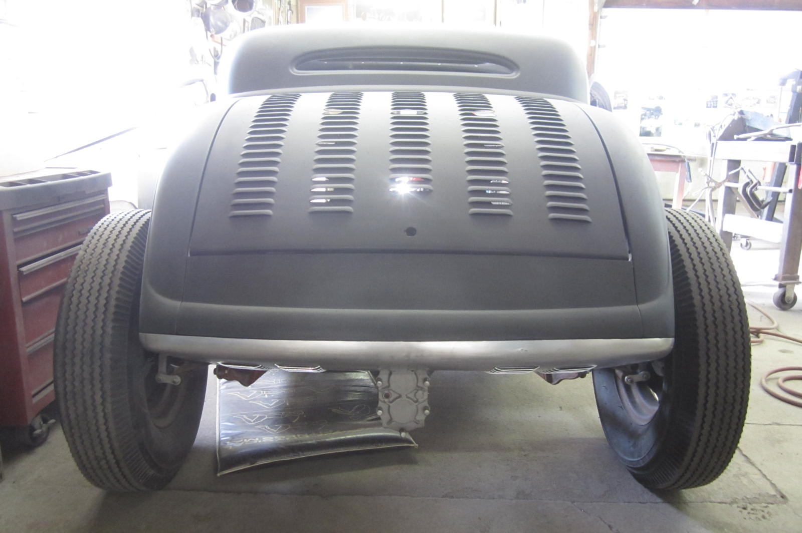

    nailed the top sheet metal down. i replaced some of the nails and added a few for good measure. i also welded the top back up where i had to open it up to expose the frozen t-nuts. DSCF3712.JPG DSCF3711.JPG DSCF3710.JPG

    one of the front header pieces above the windshield had a slight twist to it, and a crack at the mounting bolt so i decided to make a new piece. i will finish the end piece tomorrow like i did for the other side. DSCF3713.JPG
