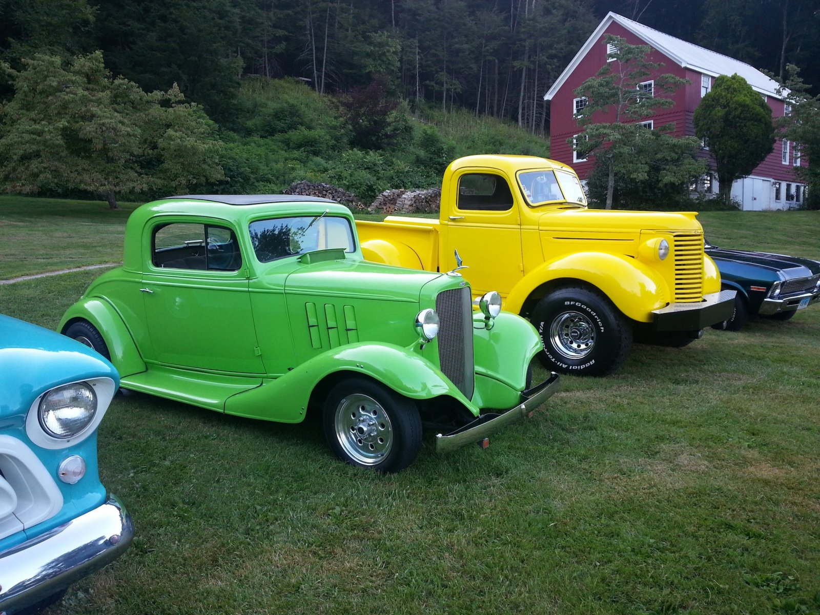

  14. MalloMike
    Joined: Sep 12, 2012
    Posts: 104
    MalloMike
    only car body i have ever seen better than this was Mallomikes '33 master. we only used a cup of filler on the whole car.......maybe mike will post a photo of his amazing chevy? hint hint[/QUOTE]
    POSTED:
    volvobrynk and TFoch like this.

    i may make cushions for the rumble some day....but who would ride back there anyway?
    mallomike and i double dated in my car one time, we fixed him up on a blind date and the four of us went out that night in my coupe.....we were all in the front seats. i drove, my girl was in the middle, mallomike was against the p***enger door and his blind date and now present wife sat on his lap....... love at first sight or the magic of an old chevy coupe? a few years later he found his own '33 chevy.

    POSTED:
    View attachment 2874248 [/QUOTE]
    about time!

    The headers cleaned up real nice.
    That body is just amazingly clean. That **** is just unobtainium today.
    Mallomikes car is pretty damn sweet too.
