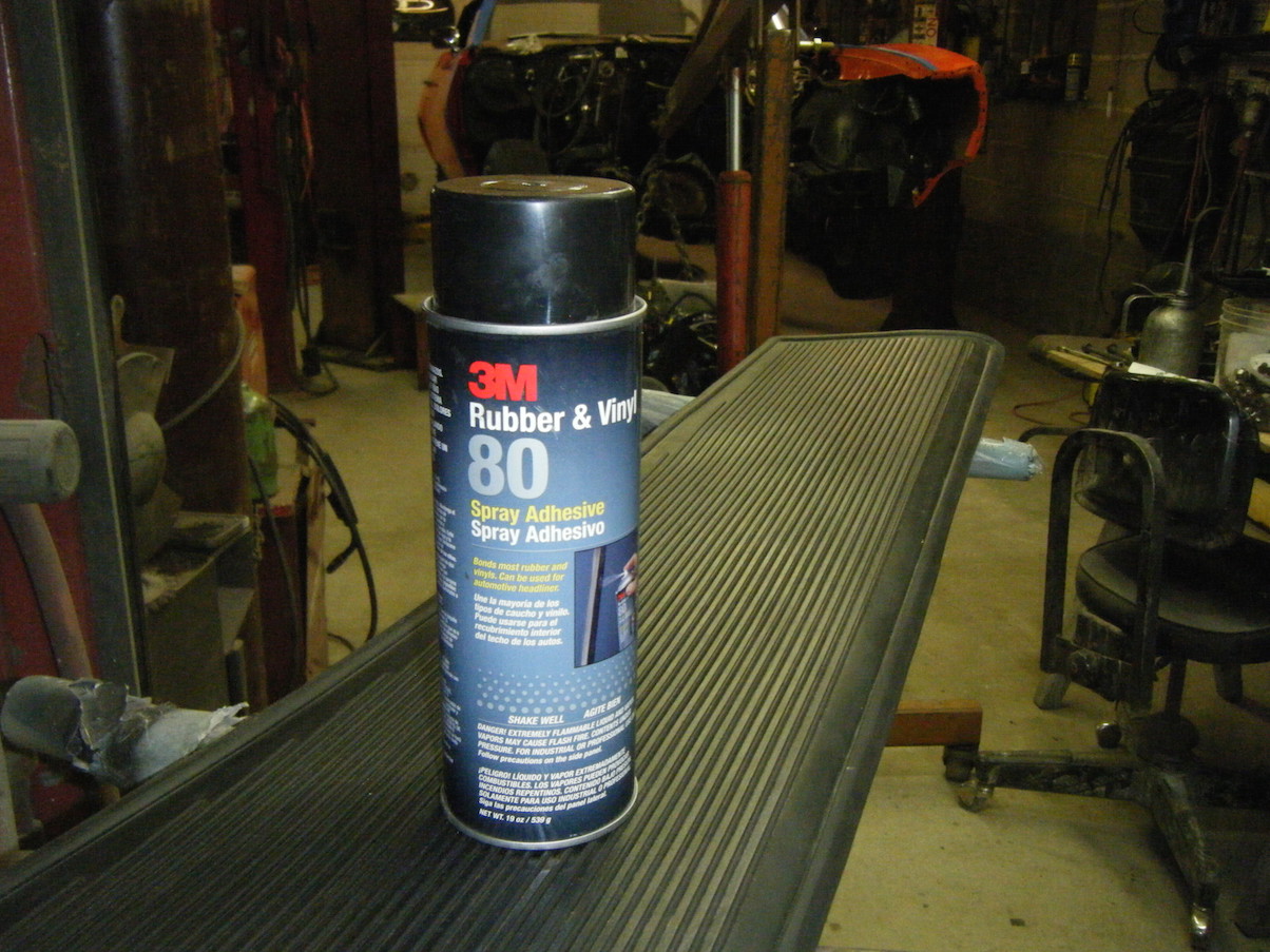

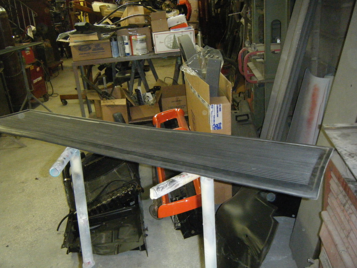

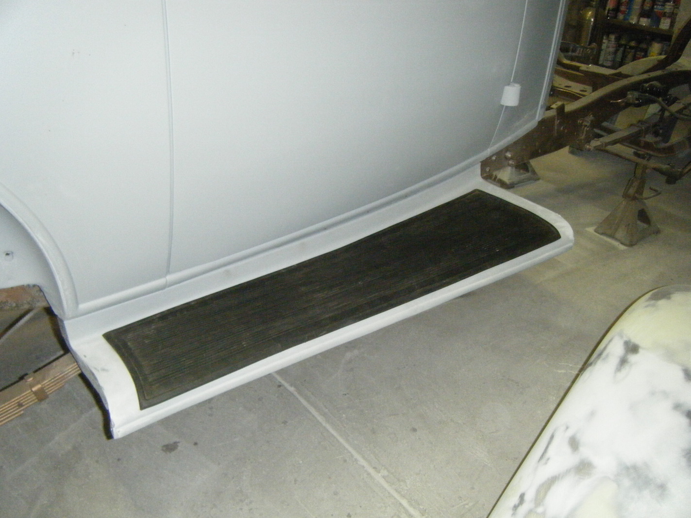

    glued the rubber mats to the backer plates i had made. i scuffed the new paint and mats with scotch brite and cleaned the surfaces with prepsol. i then used 3m contact spray for rubber. once glued i test fitted them again. DSCF3931.JPG DSCF3930.JPG DSCF3932.JPG

    That looks great, I have to do my matts on my 32. How much time did you have to work with them before the glue sets and your screwed?

    the can said to spray each piece and then wait 4 minutes before joining them. i started at one corner and slowly lowered it along the back edge so only a small piece was touching. i did have to pull the edge off to get it straight and it really was stuck. so to answer your question 0 time and it would be easier with two people.
    when i use contact cement for formica, i put "sticks" in between then slowly pull them out. it would work for this too. although an extra set of hands would be a help.

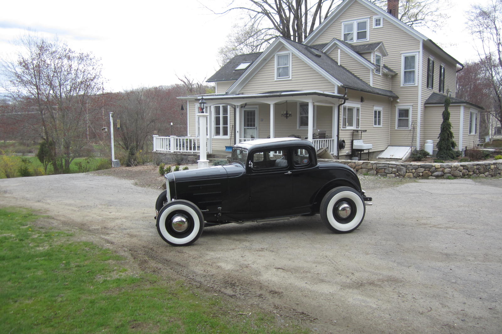

    Stopped by today to check out the progress on the Chevy.:) No one home so I broke into the barn and took a couple of pictures.:eek: Sure looks good! :cool:It is amazing how much better the house looks with my coupe parked in front of it!:p MiMi and Coupe 005.JPG MiMi and Coupe 004.JPG MiMi and Coupe 008.JPG

  21. clem
    Joined: Dec 20, 2006
    Posts: 4,677
    clem
    That house looks good without your old car in front of it !

    tb33anda3rd
    thanks, i knew a someone with a ford stopped by.......i saw the oil drip in the driveway:eek::D MiMi and Coupe 008.JPG
