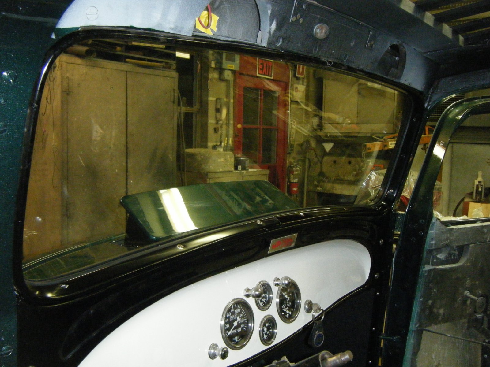

    thanks, and just to stay focused, despite having to mow a few acres tonight, i was put the windshield in. DSCF4054.JPG

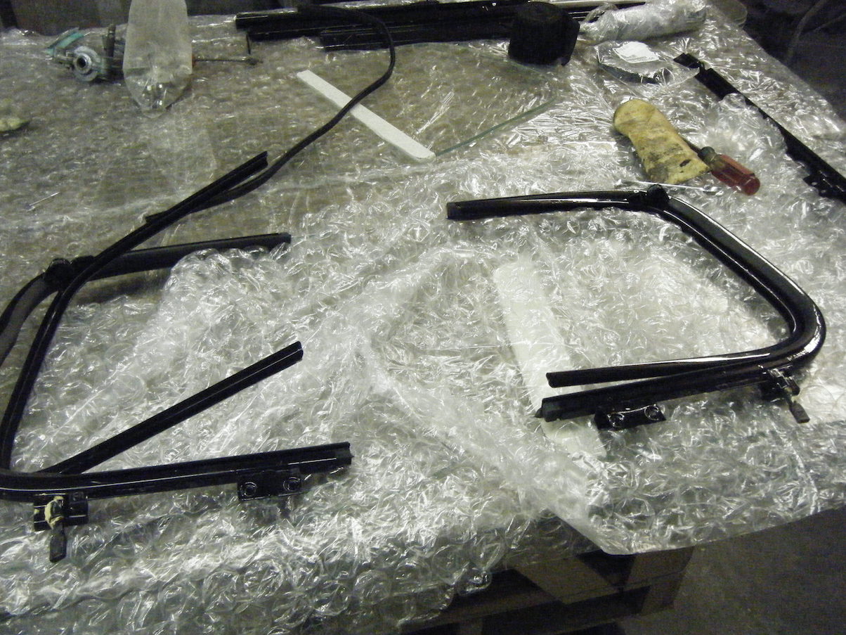

    put the vent windows together with the new rubber seals from steele. and painted the oil filter canister. DSCF4056.JPG DSCF4057.JPG DSCF4058.JPG

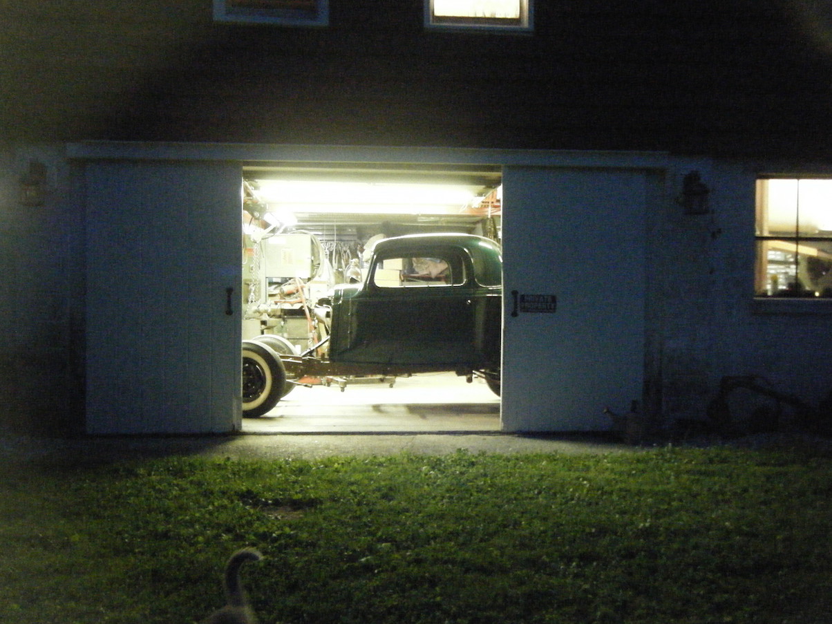

  11. tb33anda3rd
    Joined: Oct 8, 2010
    Posts: 17,584
    tb33anda3rd

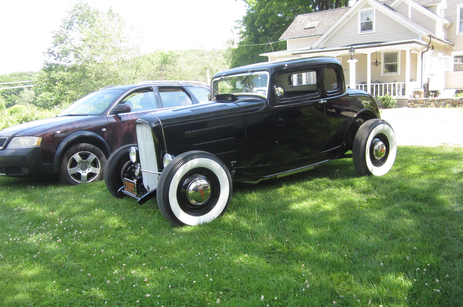

    Cool Change.......
  12. HOTRODPRIMER
    Joined: Jan 3, 2003
    Posts: 64,777
    HOTRODPRIMER
    I know you guys have a long history together...
    This is such a great photo..Who knows how many of us have admired our handy work at a similar vantage point,,I also noticed the cat could care less. :D HRP
    Runnin shine likes this.

  14. tb33anda3rd
    Joined: Oct 8, 2010
    Posts: 17,584
    tb33anda3rd
    thanks, i like how "alive" the inside looks on a dark night.

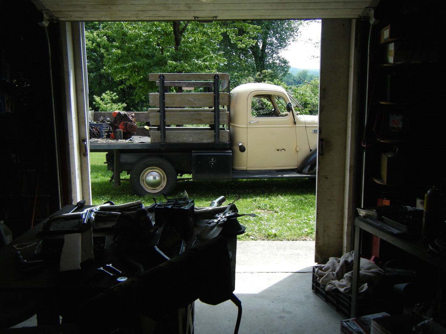

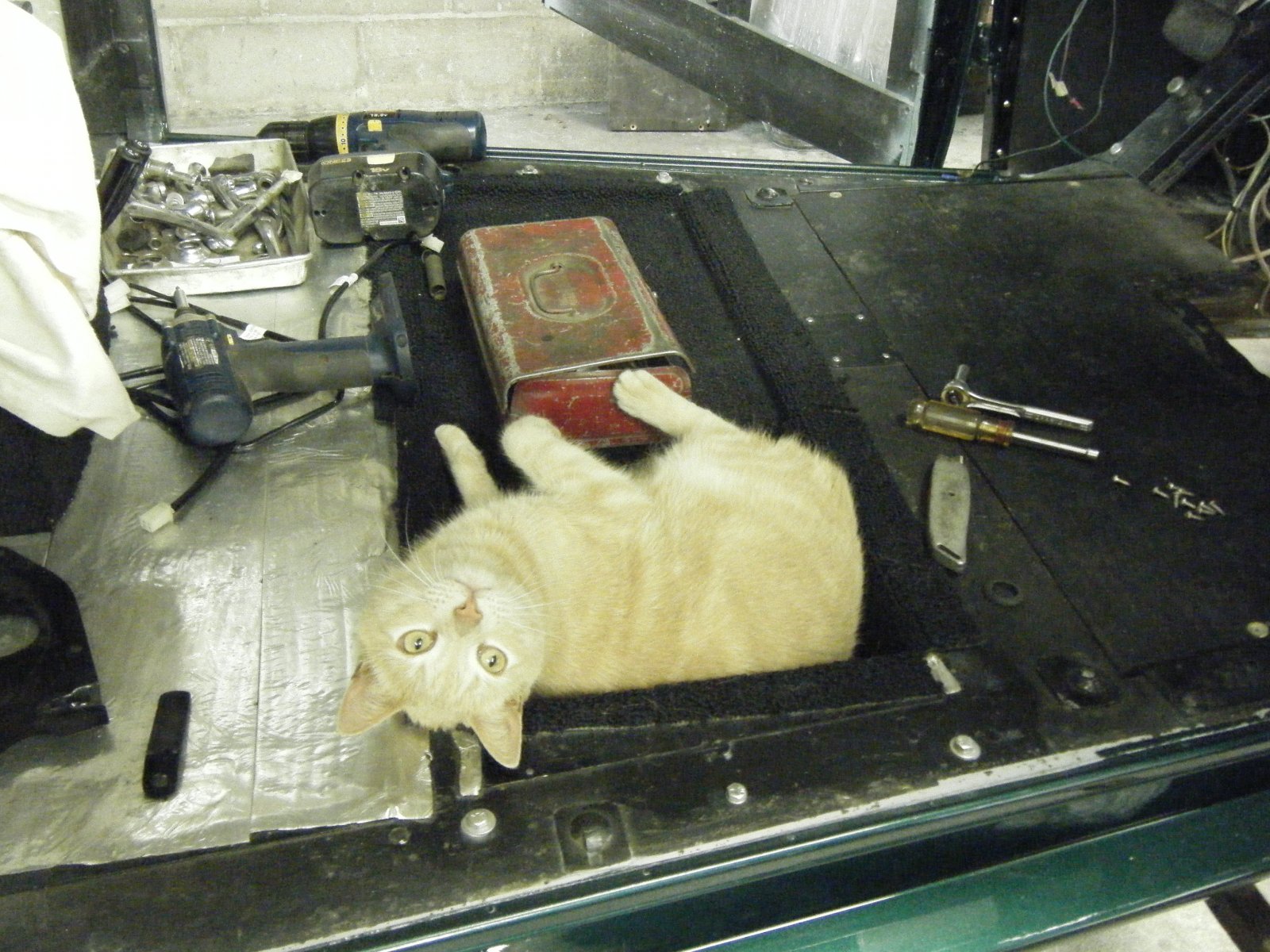

    the cat is my shadow and has been involved with the whole project. DSCF4051.JPG

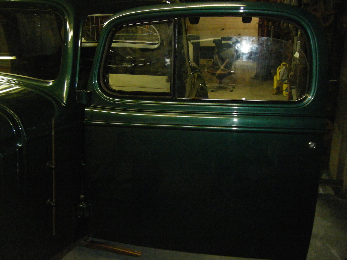

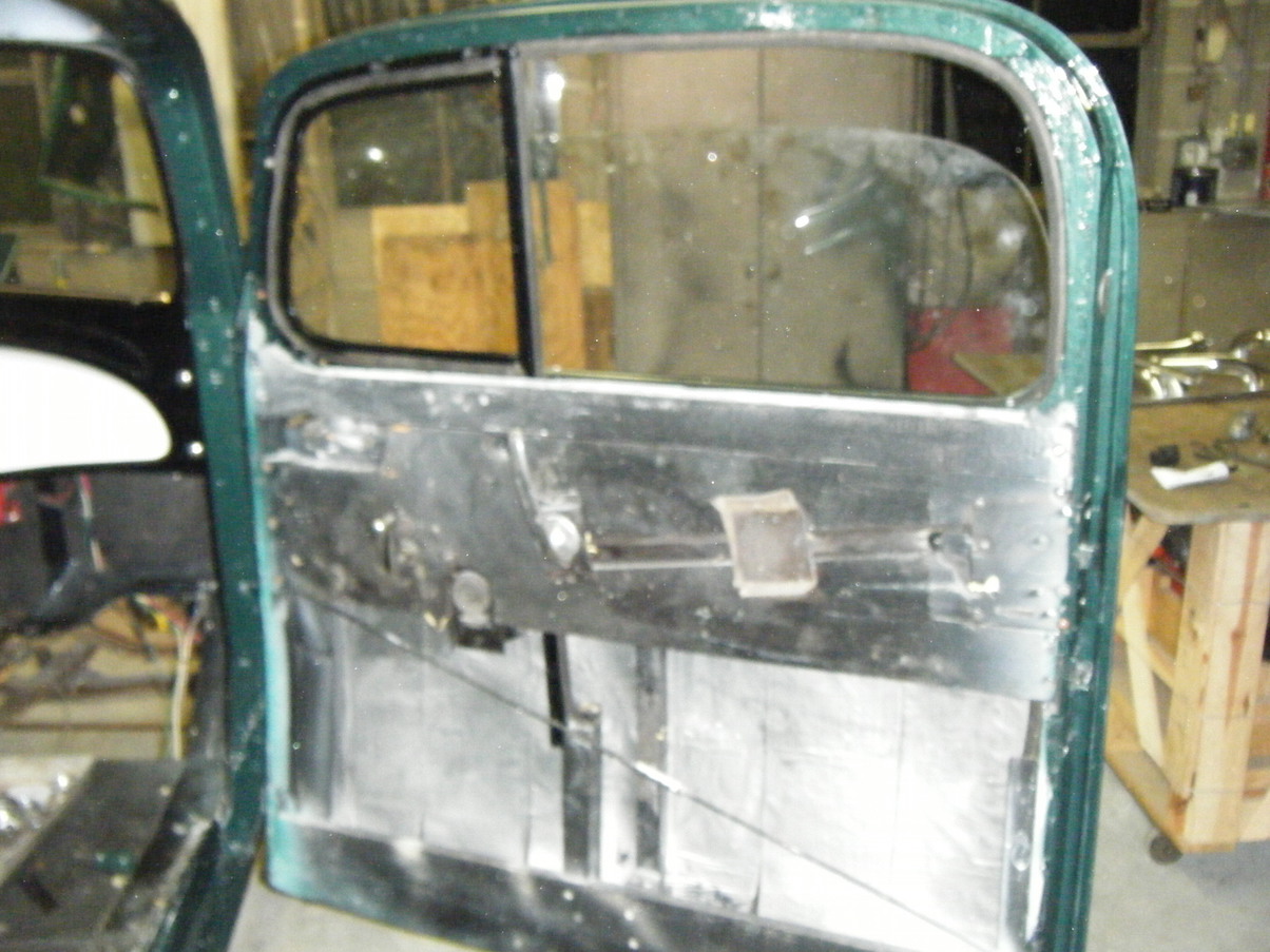

    was able to get the door windows and doors back together; DSCF4067.JPG DSCF4070.JPG

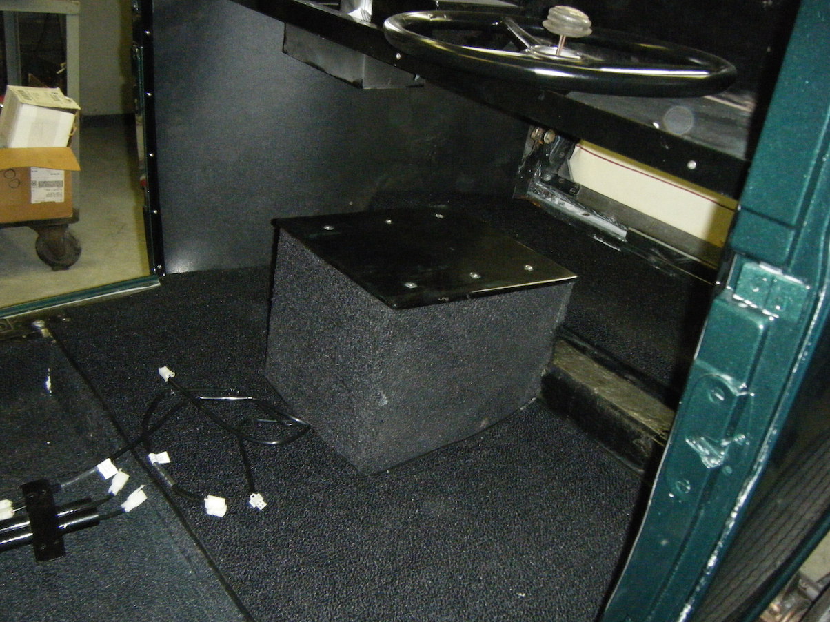

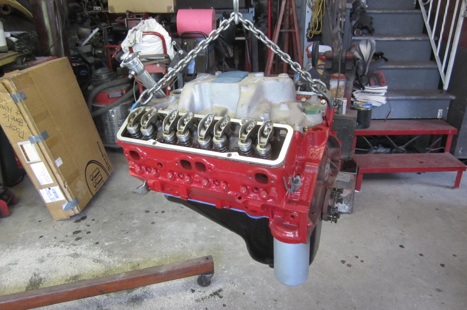

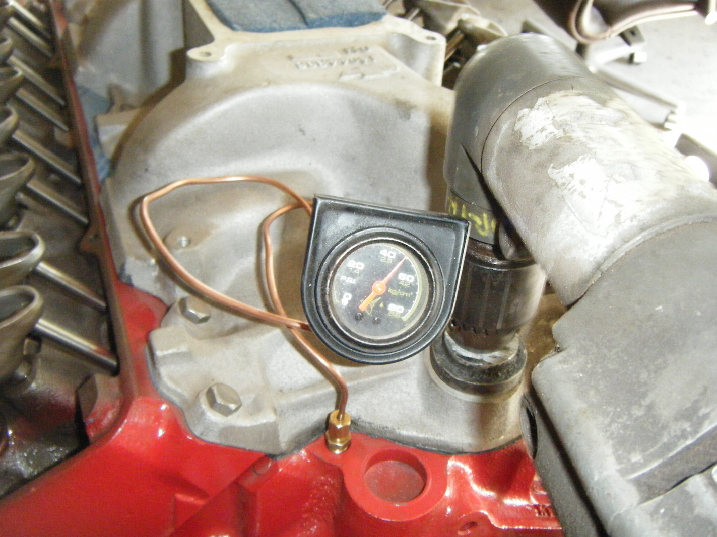

    today i started with putting the oil in the motor and priming the engine with a cut down distributor.
    i had a leak at the oil filter and realized i had the wrong base for the filter. i had switched back from a spin on conversion but needed another piece. folkswaggon had given me a 283 and it was at his house, in the driveway, on a hand truck, so i went over and picked it up. it had the correct parts i needed. DSCF4072.JPG
    HOTRODPRIMER likes this.
  18. tb33anda3rd
    Joined: Oct 8, 2010
    Posts: 17,584
    tb33anda3rd

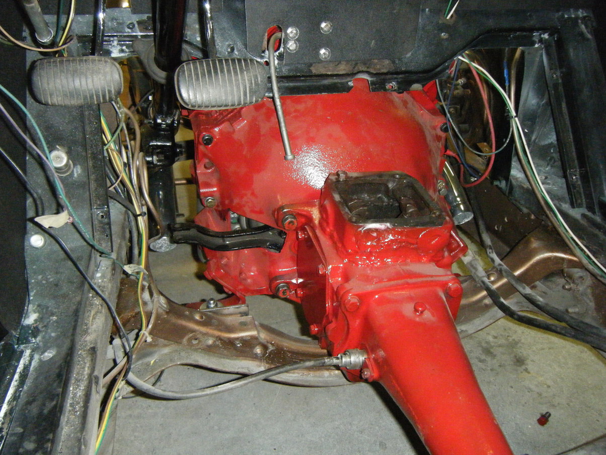

    then a few guys stopped by, big Steve, and Mark [ct1932ford], test the clutch parts while little Steve and bradley [BP32] look on; DSCF4073.JPG

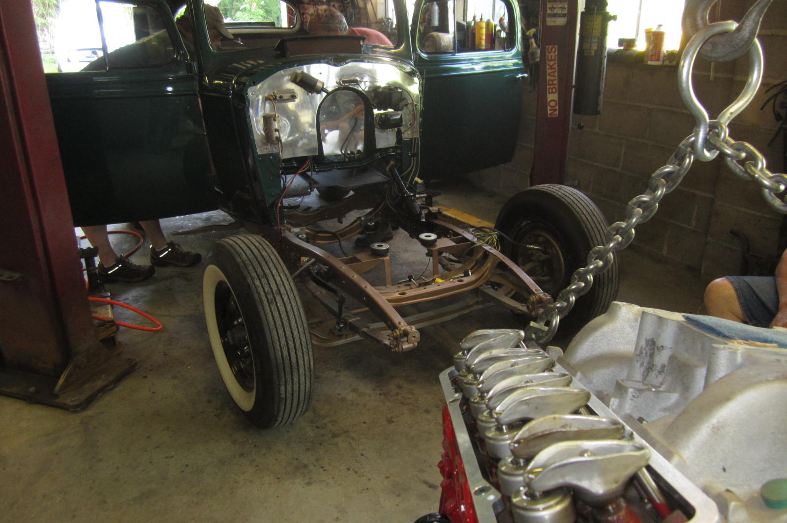

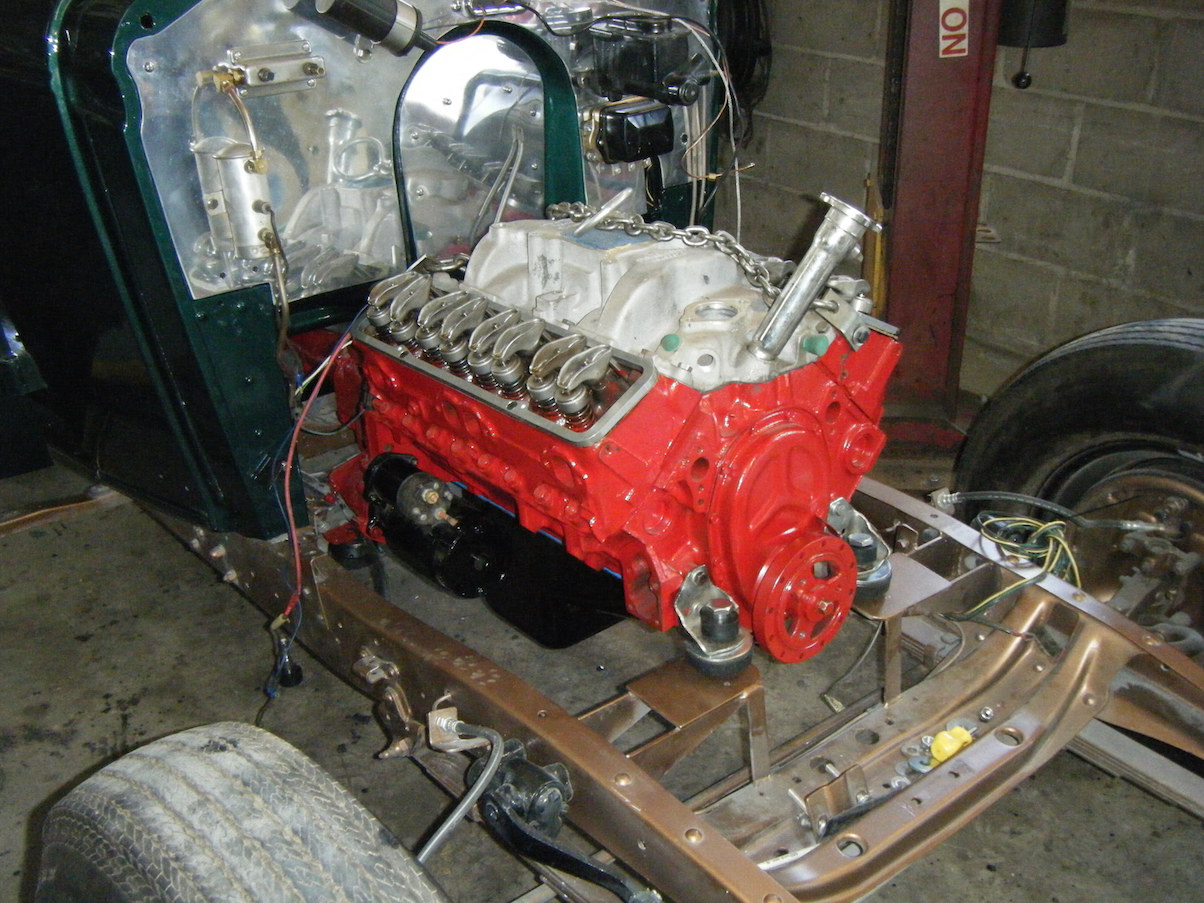

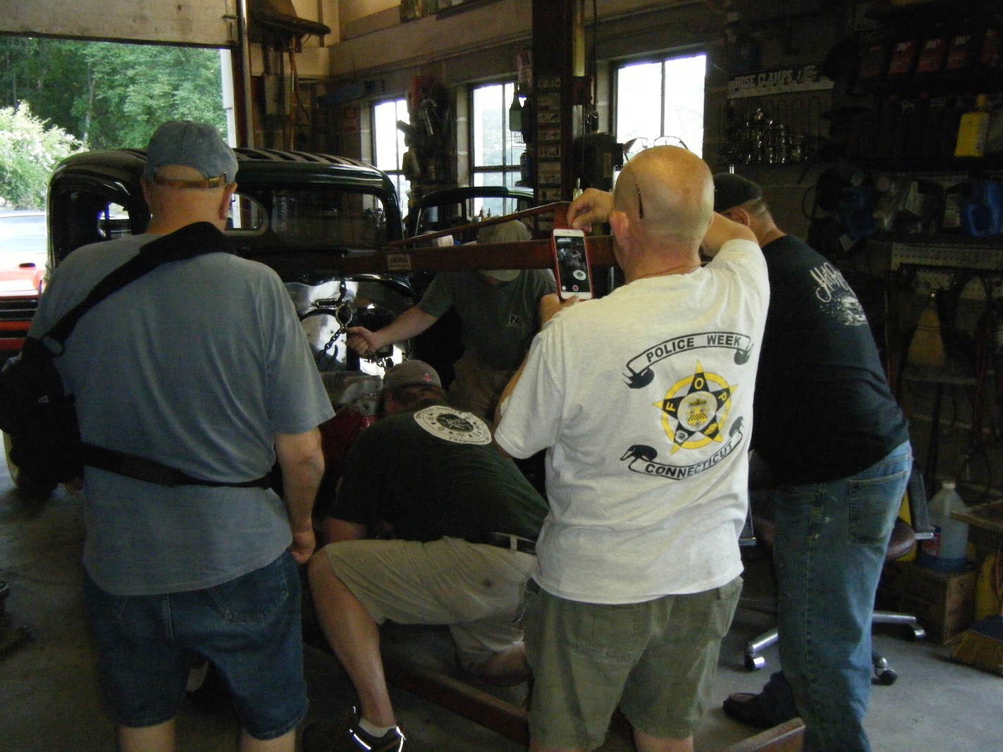

    dad, two days after shoulder replacement surgery, leads the installation of the motor. Big Steve, Mark, Bruce, Mike, and Lenny get the motor into place...........................makes me wonder.............................where were all these guys when i was sanding? DSCF4074.JPG

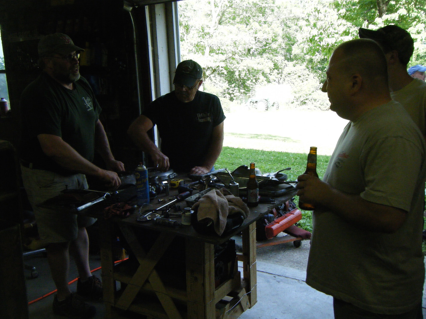

    burgers and dogs came off the grill, and the mob heads for the cooler, leaving a clear shot of their work; DSCF4075.JPG

  29. tb33anda3rd
    Joined: Oct 8, 2010
    Posts: 17,584
    tb33anda3rd

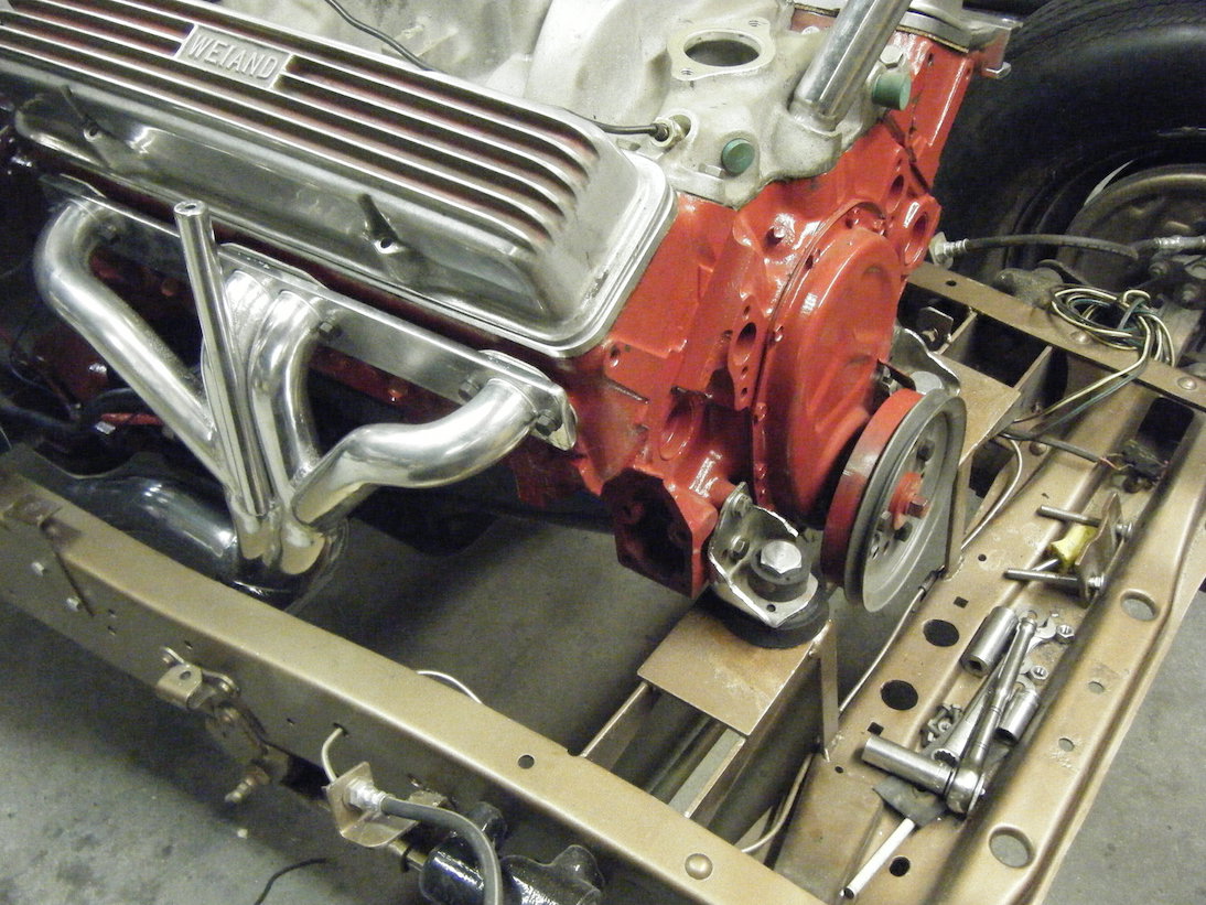

    i also bolted the engine down using the new mounts. i originally thought i could use the large washers under the mount but it set the motor too high. so i added to the brackets and shaped them DSCF4076.JPG DSCF4080.JPG to the rubber mounts. engine sits perfect now.

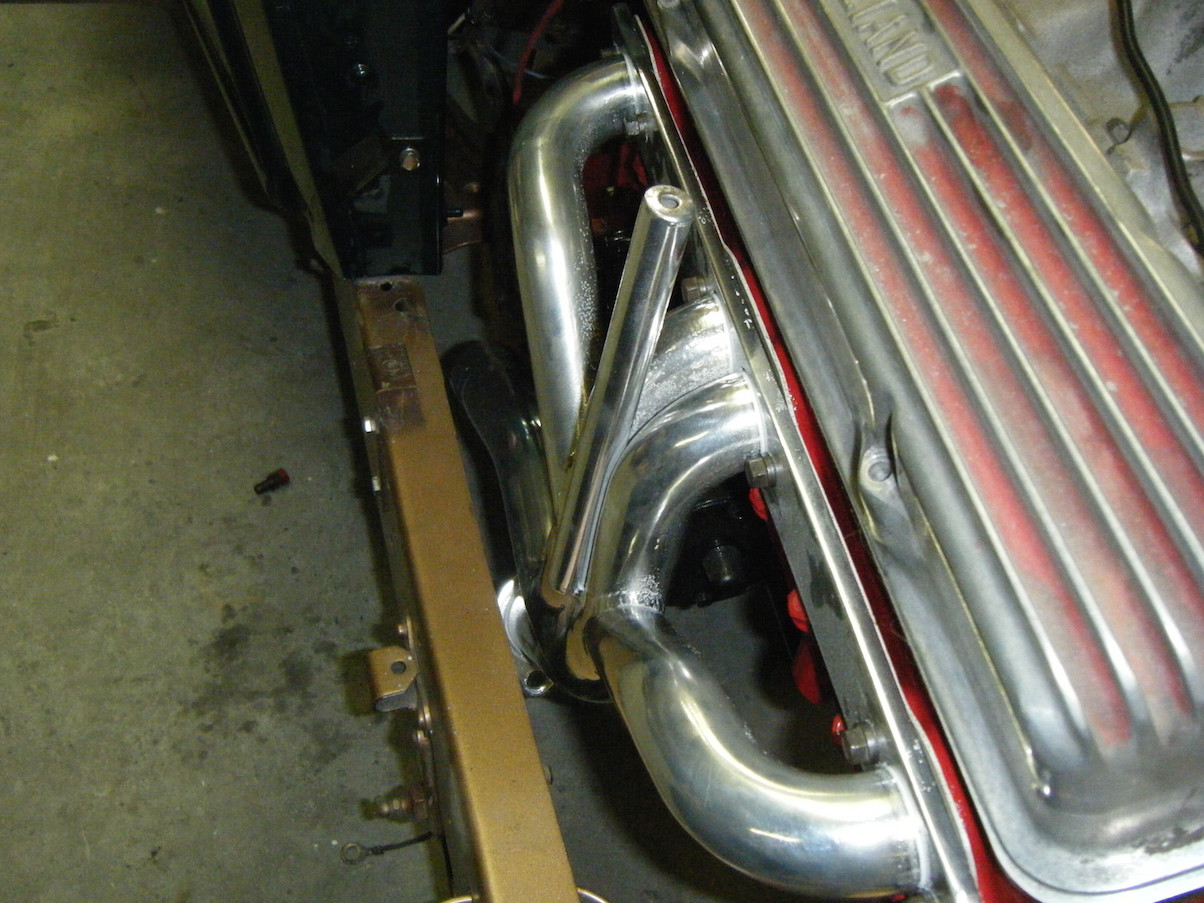

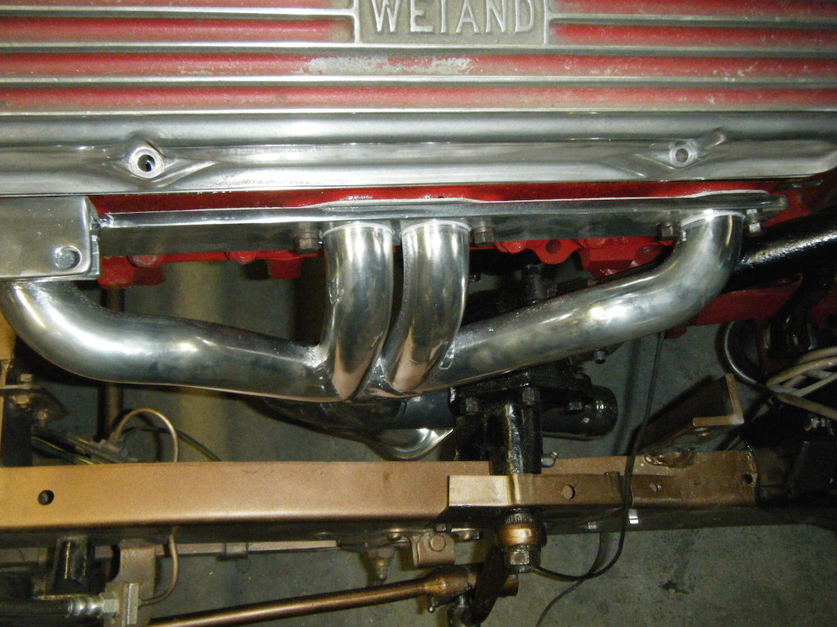

    i also installed the headers. they have no relief for the side plugs in the head so i needed to grind the plugs flush. the headers snake perfectly through and around the frame, steering box, starter and clutch linkage. DSCF4077.JPG DSCF4078.JPG DSCF4079.JPG
