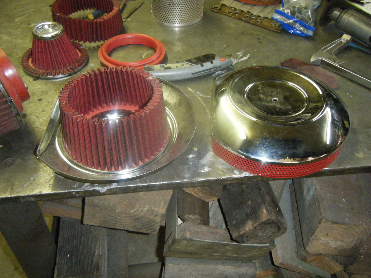

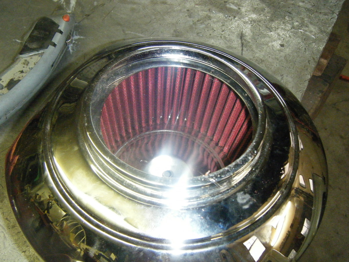

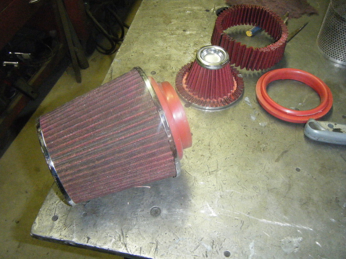

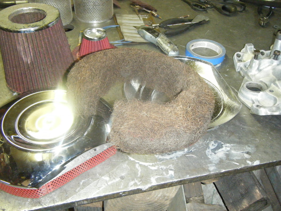

    worked on the air filters. i had them chromed but did not want to put them back together with the horse hair filter. i picked up a couple k&n air filters to cut down to fit. i removed the rubber gasket from the new filter, and opened up the inner flange. i then took the chrome air cleaner apart and removed the inner mesh. DSCF4180.JPG DSCF4174.JPG

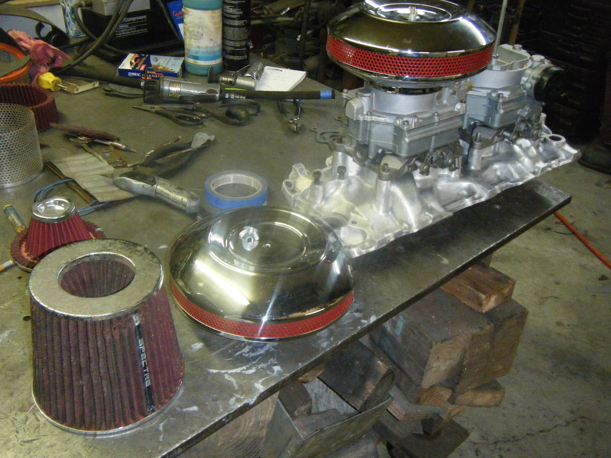

    i then cut the filter down to size, 3 1/4" and then to seal it, i made a rubber gasket for the top and bottom. i think this should work out fine. DSCF4175.JPG DSCF4177.JPG

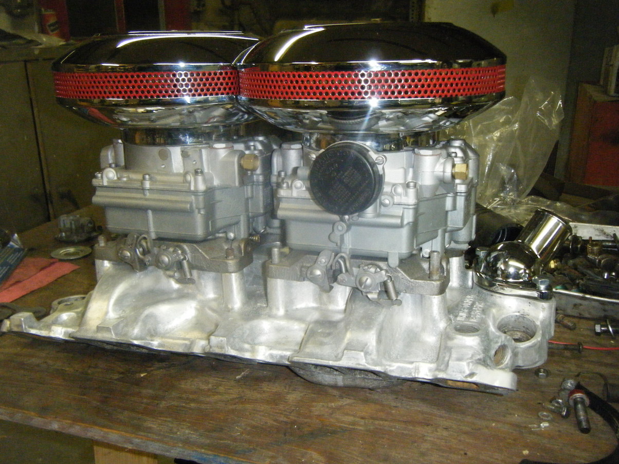

    ***embled, and now i just need to do the other one. DSCF4176.JPG DSCF4179.JPG

    Just tuning in for tonight's installment of 'Somebody's getting something done around here'. Sweet air cleaners. What I like about your photos is you leave all the tools and **** laying around.

    It sorta looks like your work bench is only held up by a rough old stack of timber blocks, don't go working away on it too hard!

    yes it does look like it is on the pile of wood. but there are six legs on that table with 6 big casters. i have actually set cars on that table and rolled them out from under the lift.

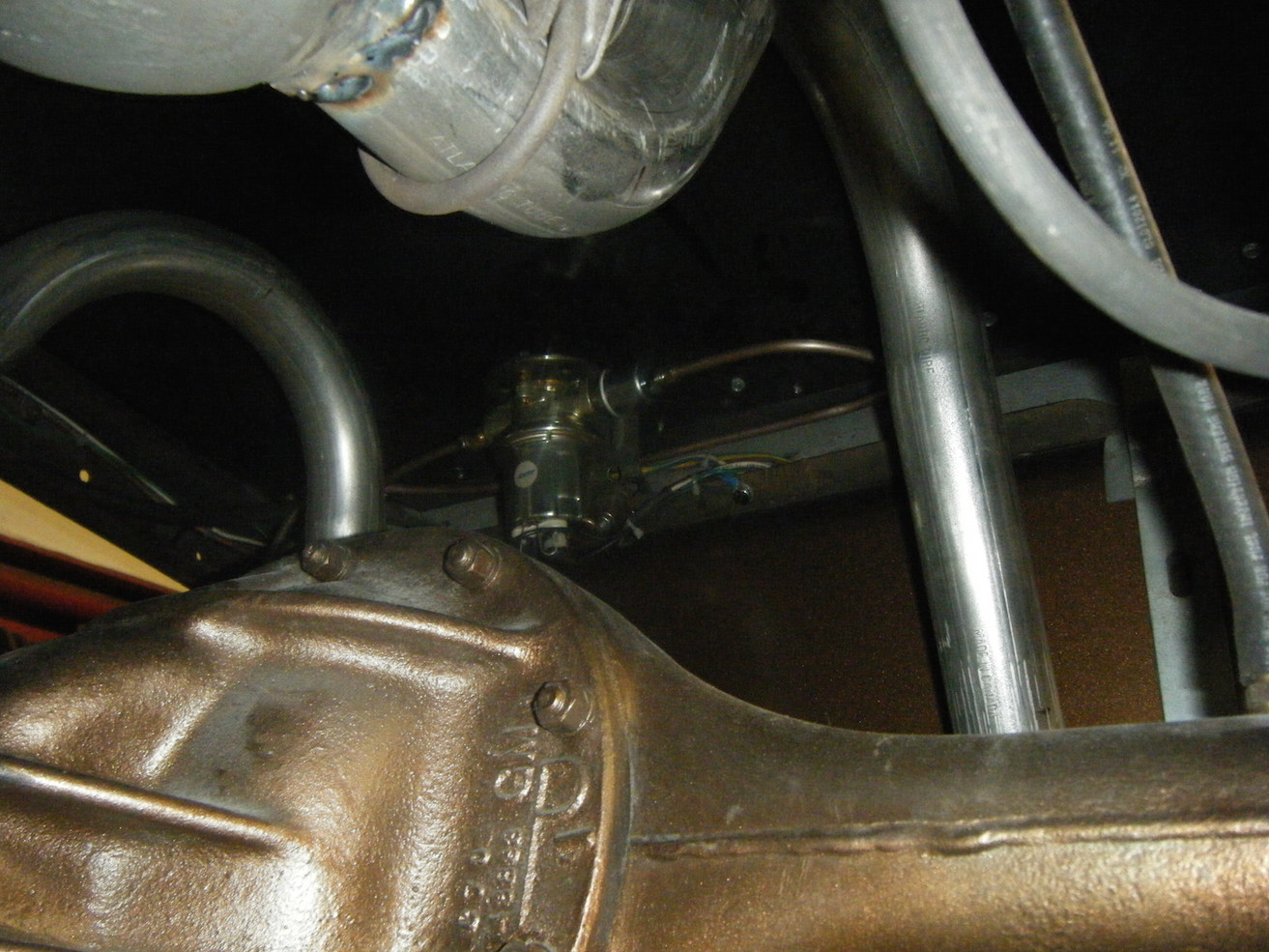

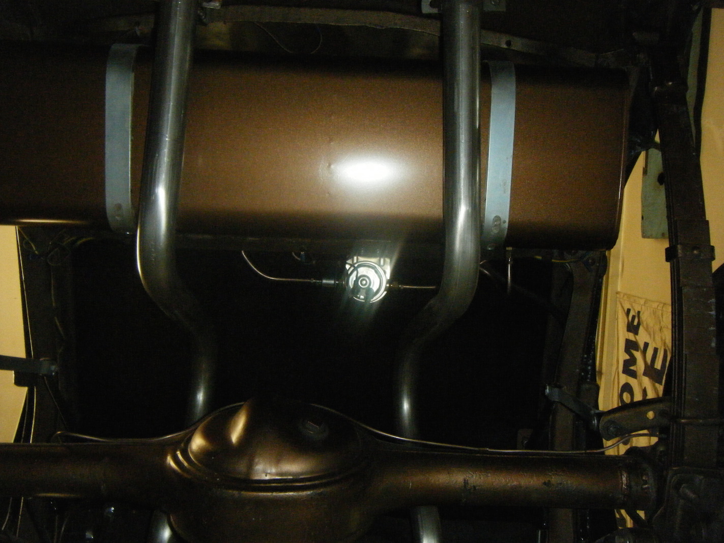

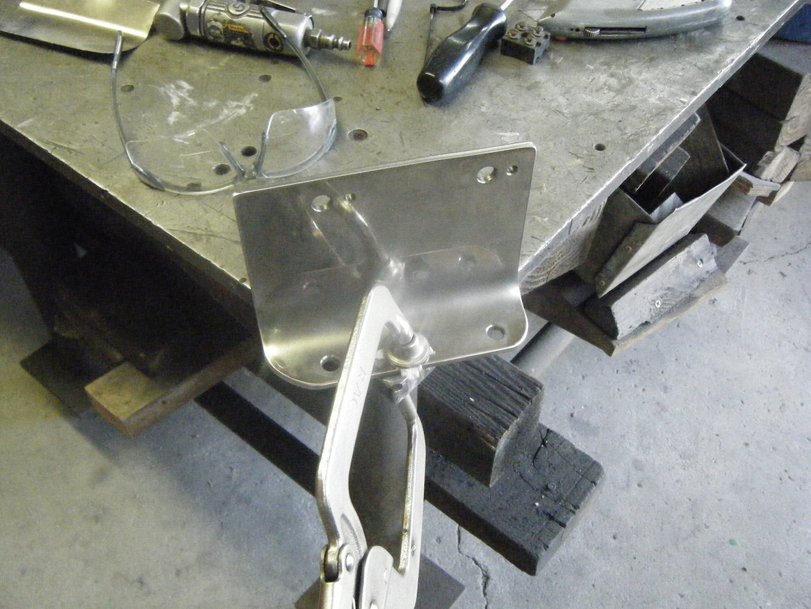

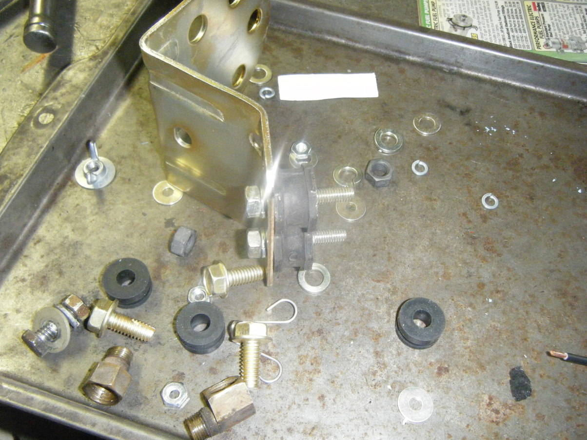

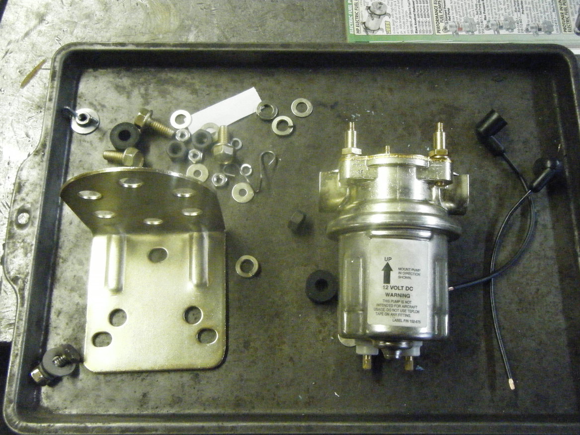

    fuel pump arrived. i went with a carter marine pump, it was the only pump that said it would work with ethanol fuels. i decided to mount it on some rubber mounts i had, to quiet it down, now i just need get a new filter. i was happy to see it was made in the u.s.a.

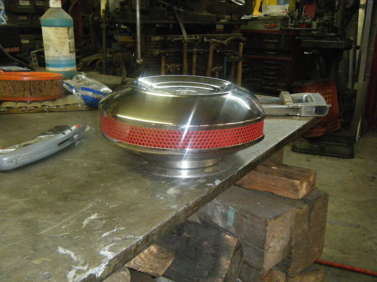

    also finished cutting down the second air filter and washing them both out. when they dry i will oil them and install them. DSCF4185.JPG

    Red air filter screens look fine, should help quiet the red wheel requests. Bob

    put the fuel filter on tonight and it is running and idling better.:)
    if i find someone to help me put the seat in tomorrow i will back it out of the barn.:):) DSCF4186.JPG DSCF4187.JPG

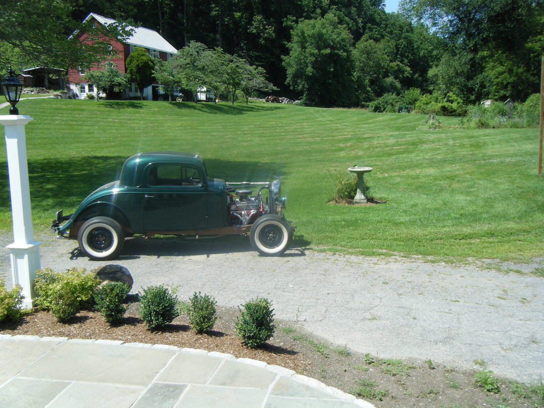

    my neighbor helped me put the seat in early saturday morning. DSCF4193.JPG DSCF4196.JPG

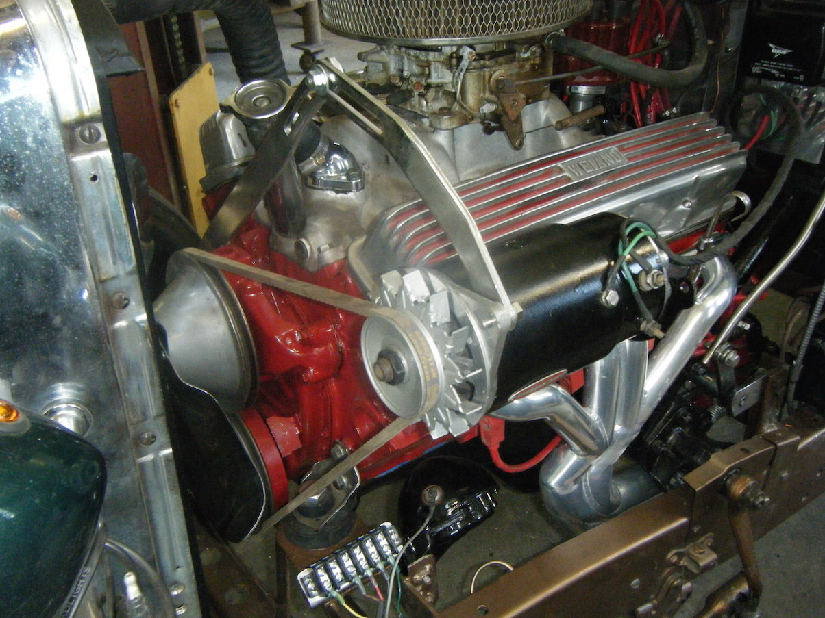

    pulled off the bracket and mounted the generator on the header directly, with the help of another bracket i had, so i could take the valve cover off easier to adjust the valves. while the bracket was off i contoured the corners to match the bracket my dad had made. DSCF4197.JPG DSCF4194.JPG DSCF4195.JPG
