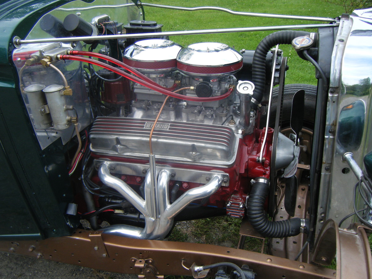

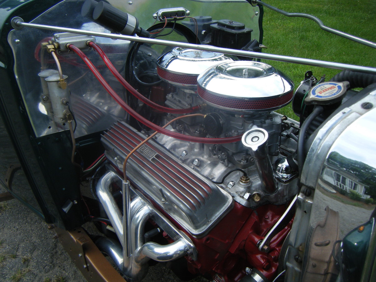

    i timed the motor, changed a fitting that was dripping on the oil gage and wired in a junction block for the front lights. i was happy with the way it ran so today i swopped out the intakes, installed the carbs and made the linkage. new thermostat housing and stat, fuel lines like my dad had and new fittings.
    runs good but doesn't have the "snap" that the single four had, but i am going to keep "tweaking" it.

    Wow looks great with the two 4's!

    Ya know with the red air filter screens, red fuel lines, and red block, the wheel area between the hub caps and tire might just look OK in Red as well. Look how nice the rocker covers look with the Red highlights. Bob

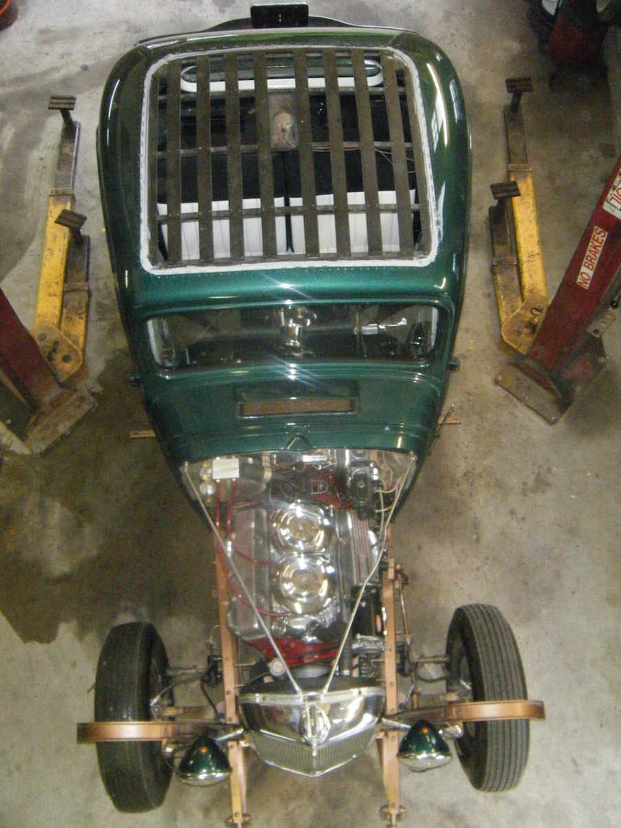

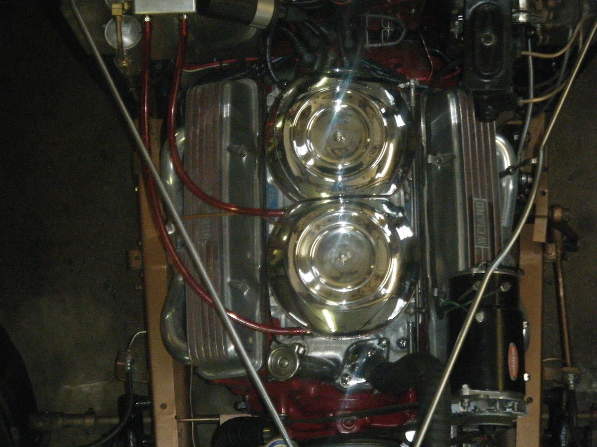

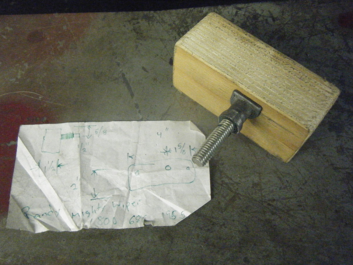

    i am looking at buying a mighty wiper, brand wiper motor.
    any one use them?
    i took the measurements off the net and "built" one out of wood to make sure it would fit and to help get the correct shaft length. i will keep this model to use in future projects if the motors are worth it. DSCF4207.JPG

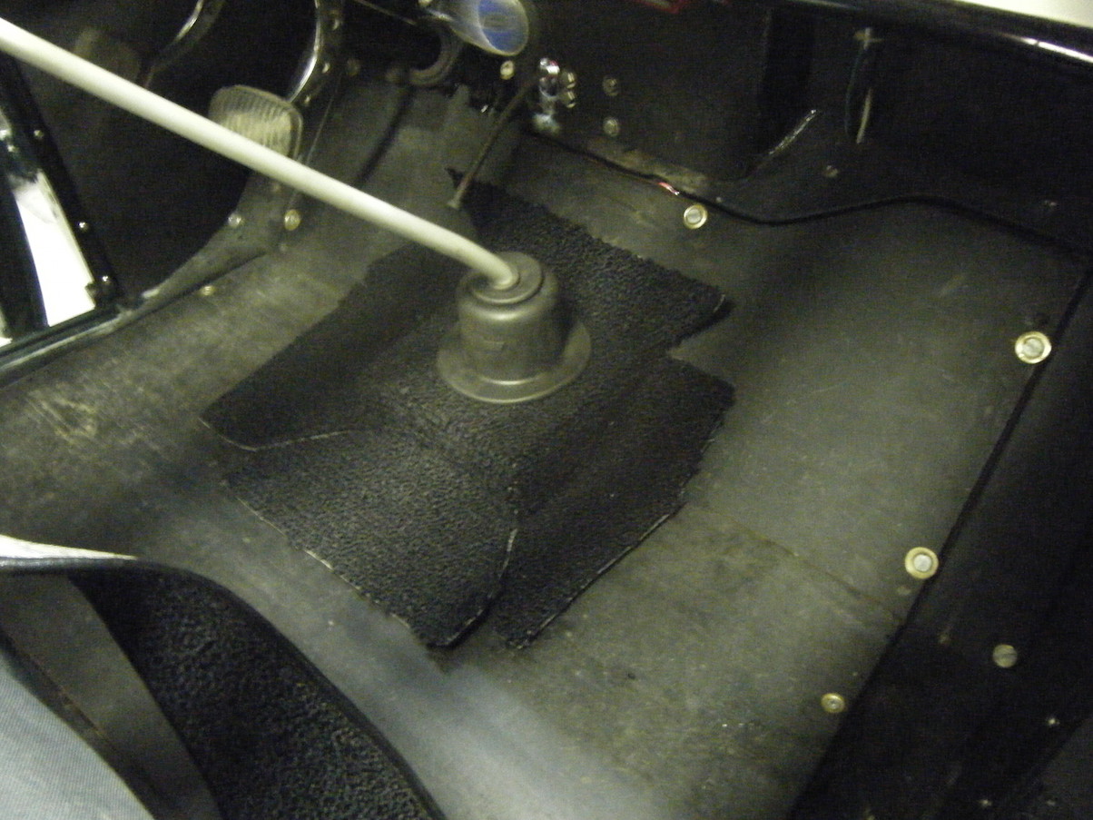

    made a bracket for the throttle return spring, and worked on the carb adjustment. Dad stopped by and pulled the car out of the garage for the first time in 30 plus years with the 2 fours. big smile!
    worked on screwing the floor boards down and putting the ****** cover in. i cut and glued carpeting to the cover but not the floors. i want to be able to pull up the carpet, unscrew the cover and floorboards without a lot of work. DSCF4208.JPG

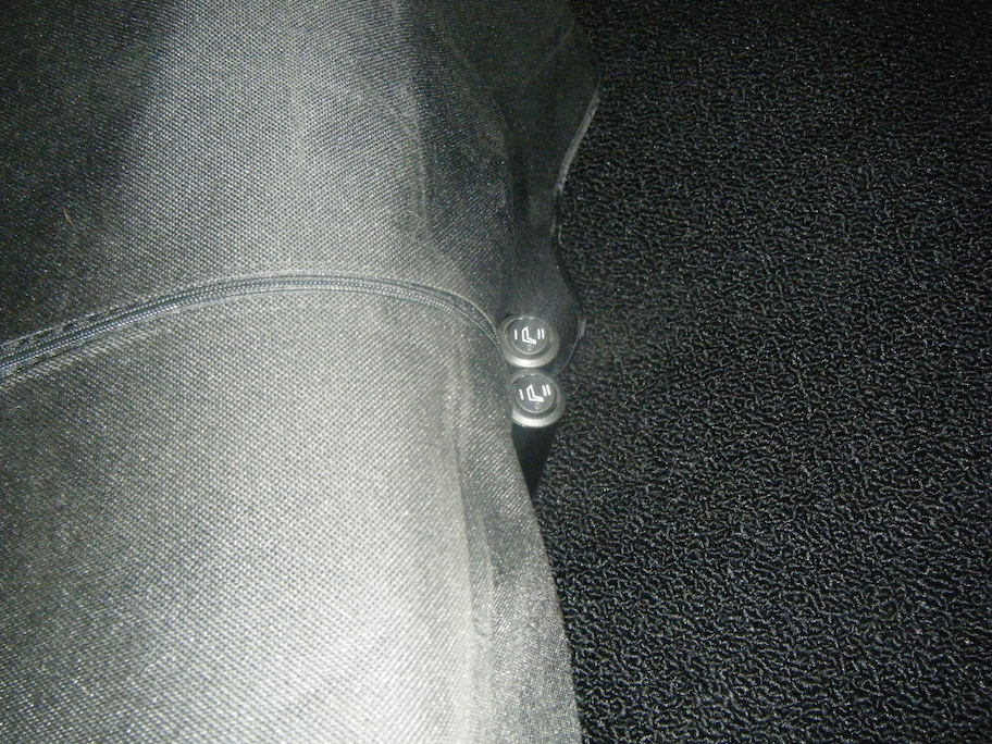

    non hamb friendly heated seat switches..............
  26. kidcampbell71
    Joined: Sep 17, 2012
    Posts: 4,756
    kidcampbell71
    You get cold up there ... duly noted. They make a "big ***" difference. ;) Truly.
