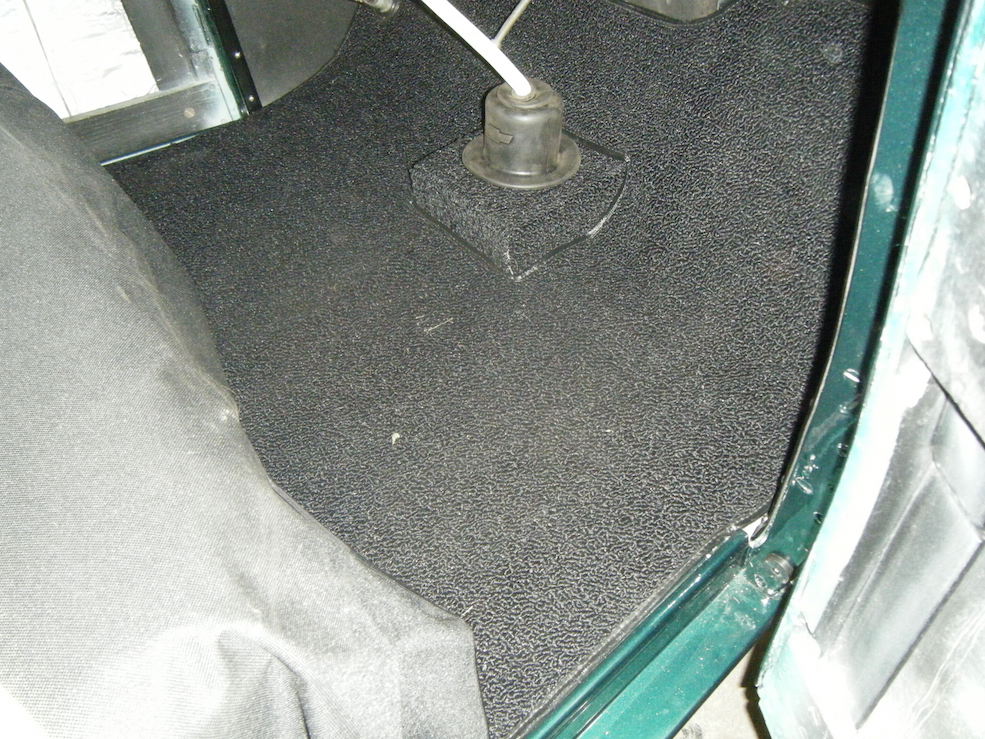

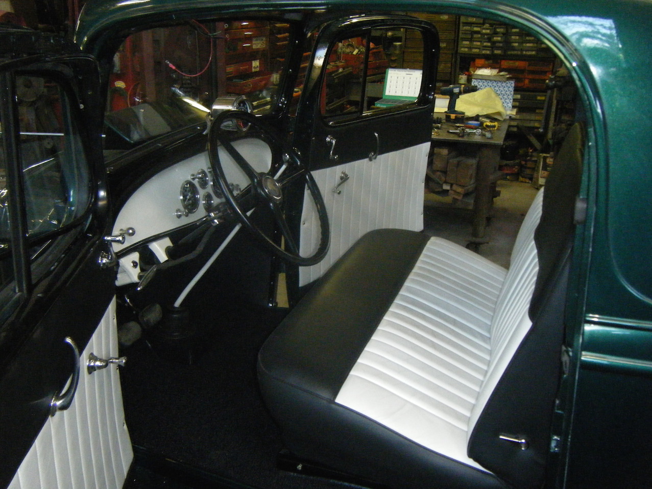

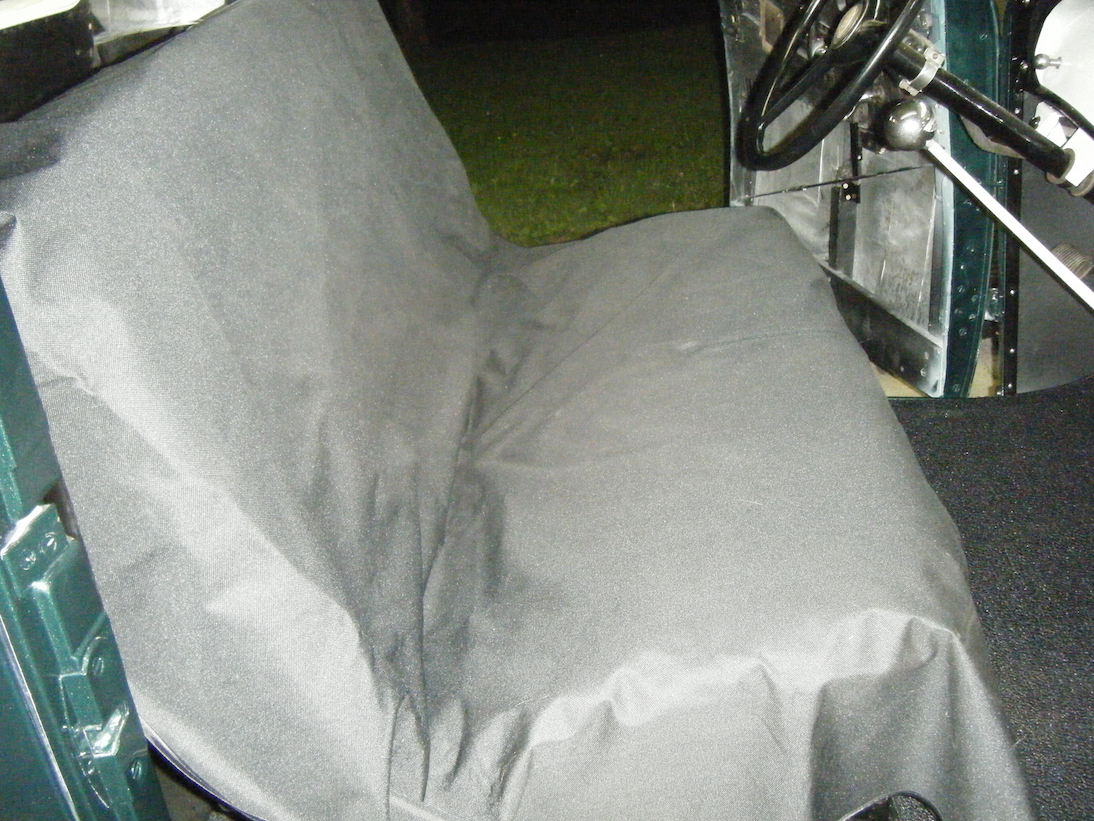

    DSCF4214.JPG here is the picture of the carpet in place. i had the upholsterer bind the edges.

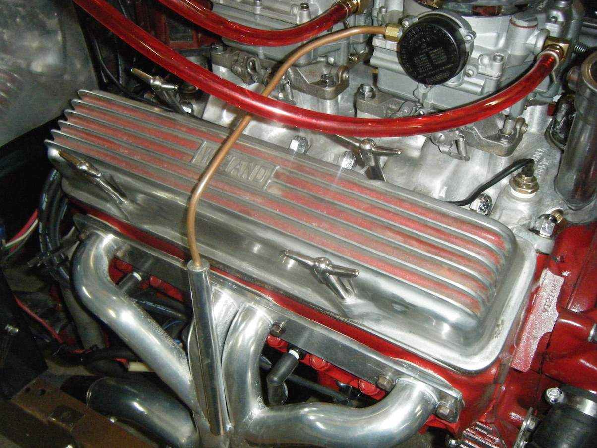

    yesterday i went to a friends machine shop and used his lathe to turn down the new wing bolts for the valve covers. the new bolts were made for valve covers with a 3/8" or smaller flange but the ones on this motor are a couple inches. the threaded portion of the bolts did not unscrew from the handle so i could not put a longer threaded rod and even if i could they would have stuck up too high. he had a lathe with a collet [?] chuck so i could pull the wing off and slid the shafts in without damage. i swopped out the washers supplied with ss and trimmed the threads to length.
    i was also going to repaint inside the fins but these were last painted when my dad built the car and they look fine with their patina DSCF4212.JPG

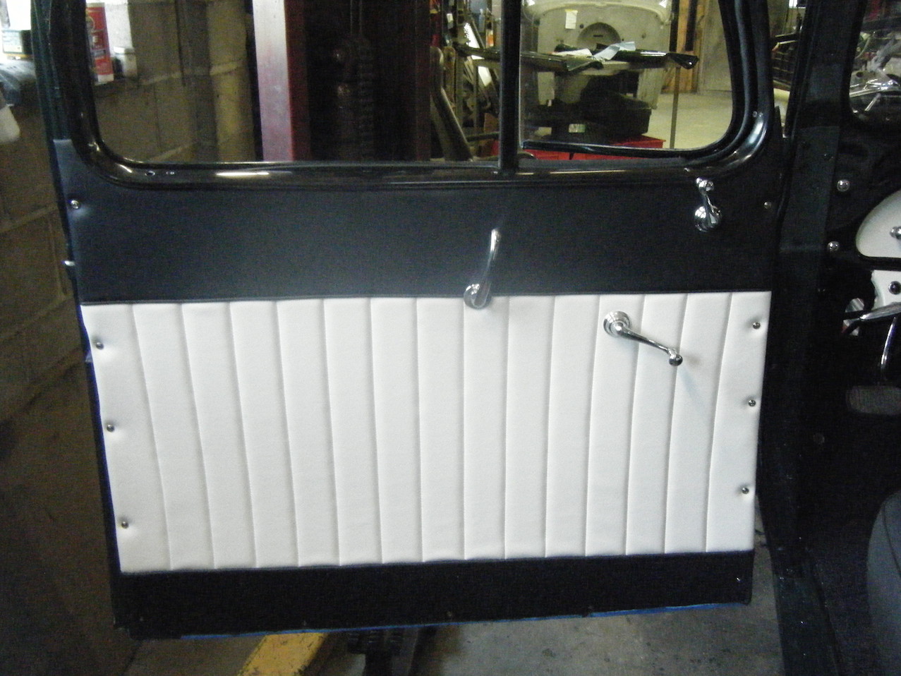

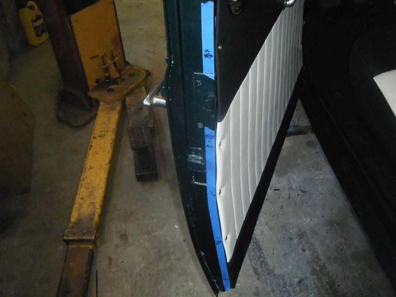

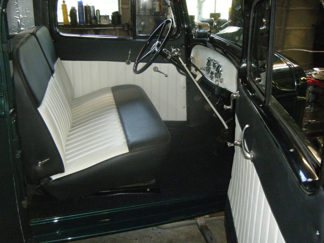

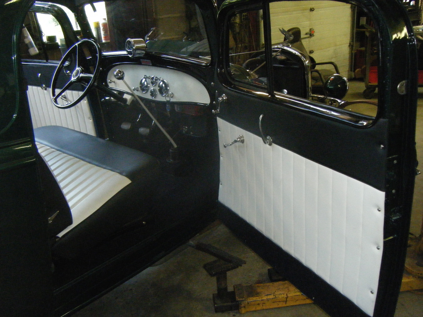

    i then put the door panels on. i used a piece of tape to mark out the spacing. the screws had to be placed evenly, without hitting a nail tab, door screw or open space. i then moved the tape to the other door so they matched. DSCF4217.JPG DSCF4218.JPG DSCF4220.JPG DSCF4221.JPG DSCF4217.JPG DSCF4218.JPG DSCF4220.JPG DSCF4221.JPG DSCF4219.JPG

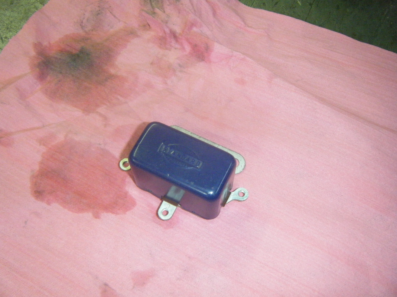

    i also found, in my stash, a brand new standard horn relay. so i wired it to the the horn ****on in the center of the wheel. my dad had a ****on under the dash because the wire was no good in the column. this is the first time this horn ****on has worked since at least 1957. DSCF4216.JPG

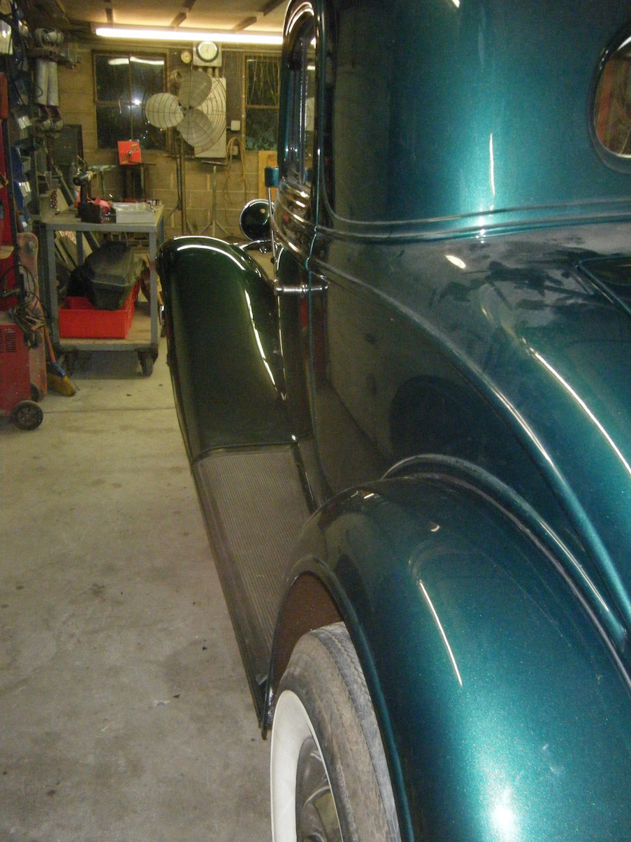

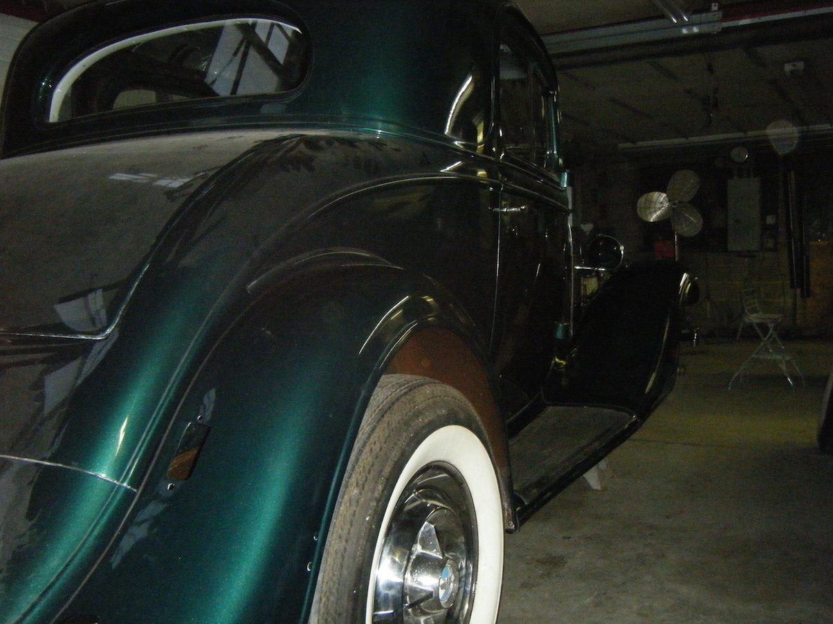

    i also had time to hang the rear fenders and running boards. all the bolts are in, i just need to cut the welting and tighten them up. DSCF4222.JPG

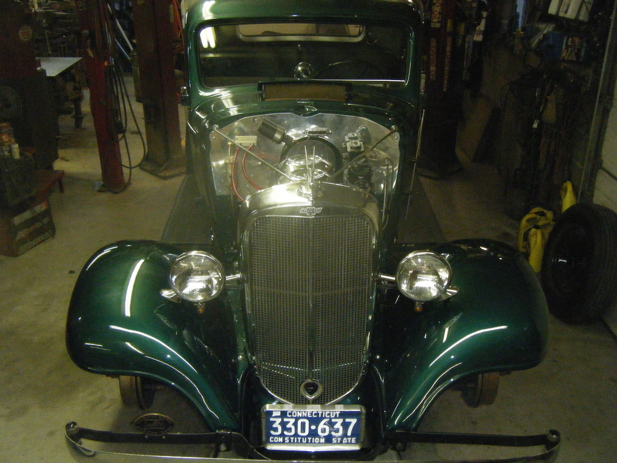

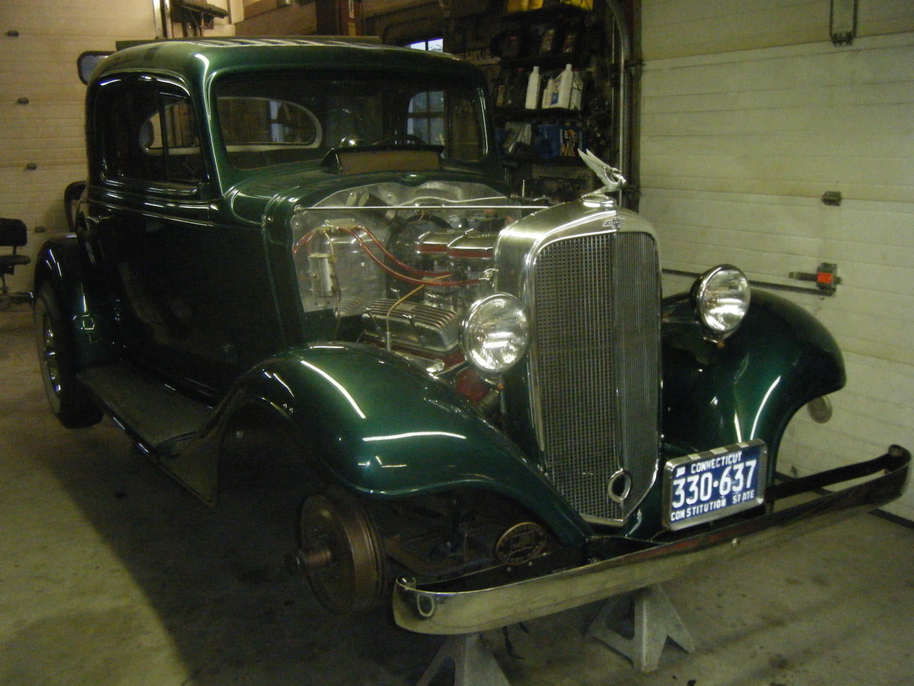

    DSCF4224.JPG running boards, rear fenders, front fenders, front splash pan, and grill all on.........spare bedrooms empty..........hoses on and radiator full. next step tighten the front bumper and running board mats. DSCF4225.JPG DSCF4226.JPG DSCF4227.JPG
