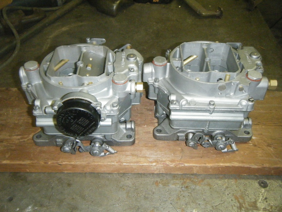

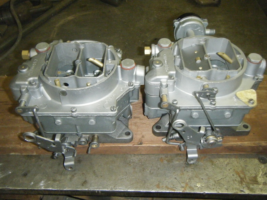

    i plan to put the two fours back on the car when i change the motor, i had saved the manifold and air cleaners, but can't remember where the carbs ended up.
    last year at hershey i found two wcfb's, single carbs. one was a '56 and the other was a 57 for $100 each, they had a few issues and some missing and broken parts. i had "carbs are us" in thomaston rebuild them.

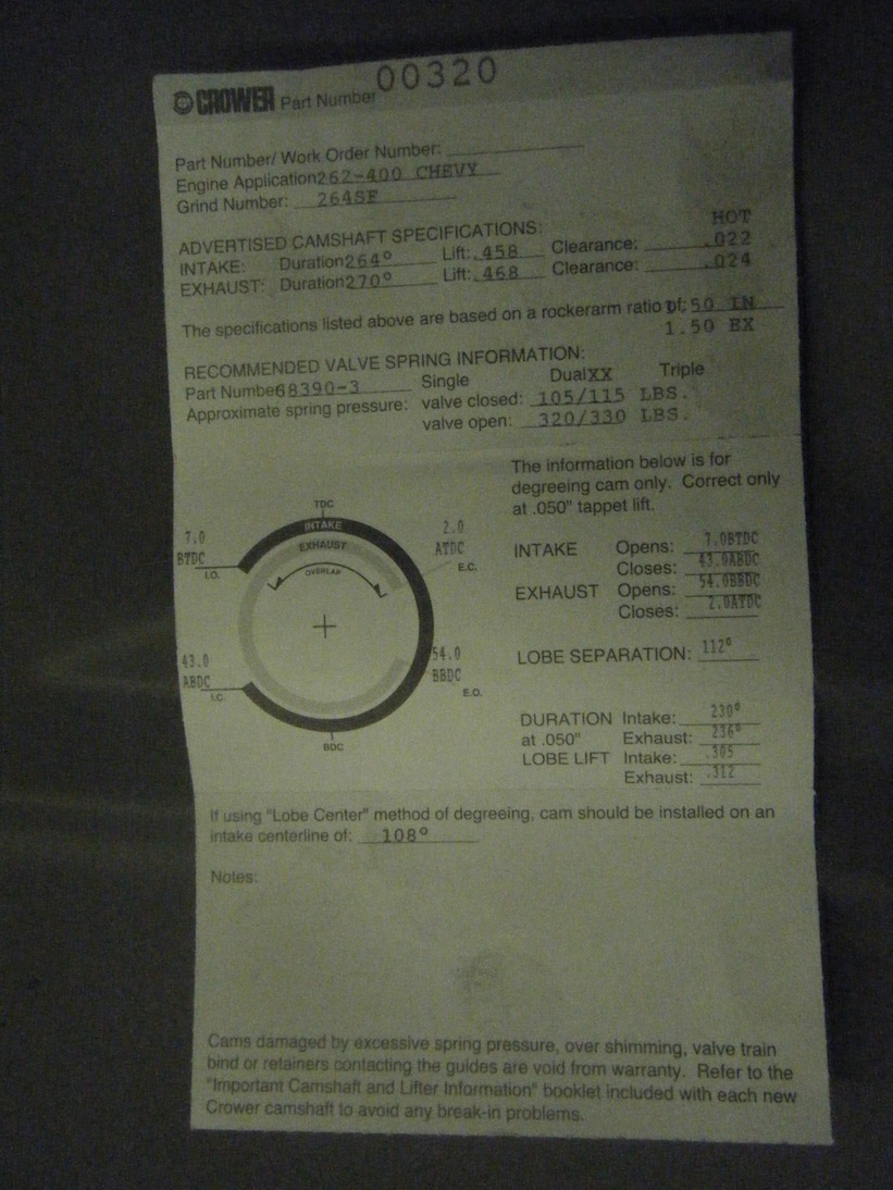

    pulled the motor out of storage, that i had built....so long ago that i can't remember when. it is a small journal 327 with a 283 crank bored 10 over. the motor was built by Dave lewis, the writer of "the small block chevy interchange manual". when we first built it, it we put a hydraulic lifter cam in it. i am going to put a solid lifter cam in.

    this is the cam Dave told me to get;
