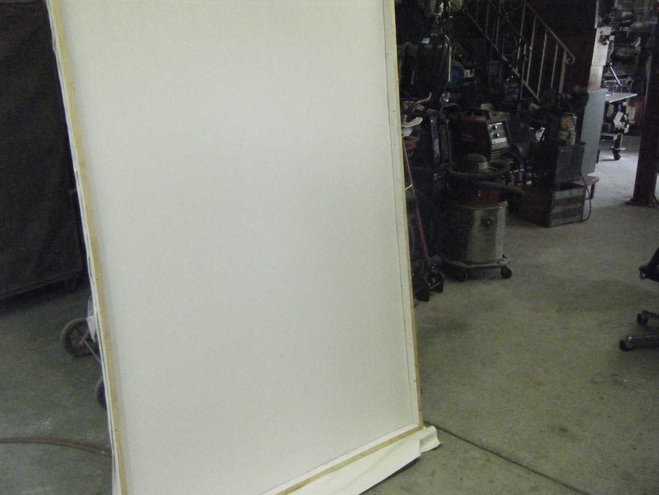

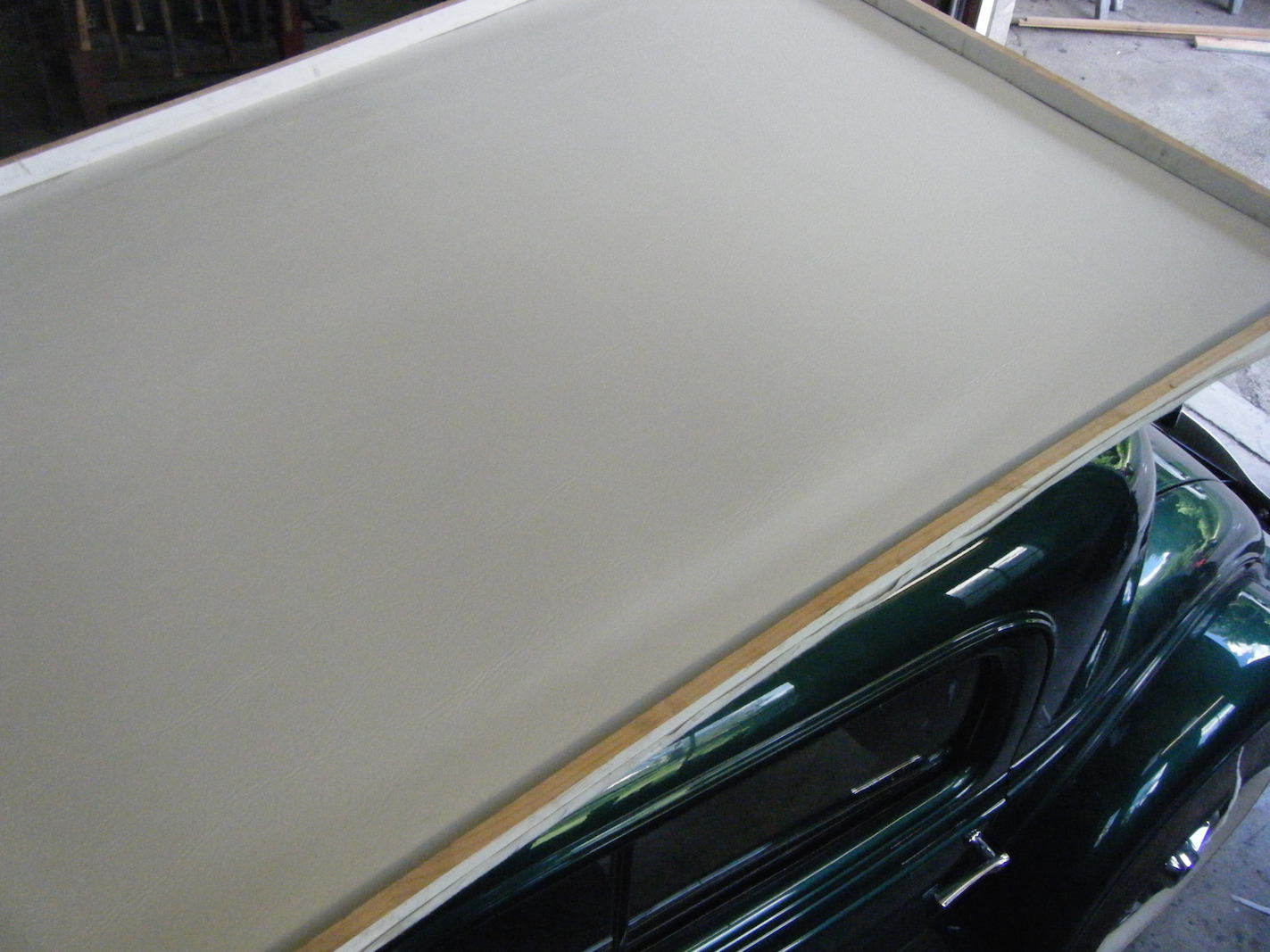

    i trimmed the foam that i had glued on, then i built a "stretcher" from some s**** wood. after leaving the top material out in the sun for an hour i stretched it over the frame. i started in the middle of each side and pulled and stapled it as i went. once done i set it on the roof. DSCF4237.JPG DSCF4236.JPG DSCF4238.JPG

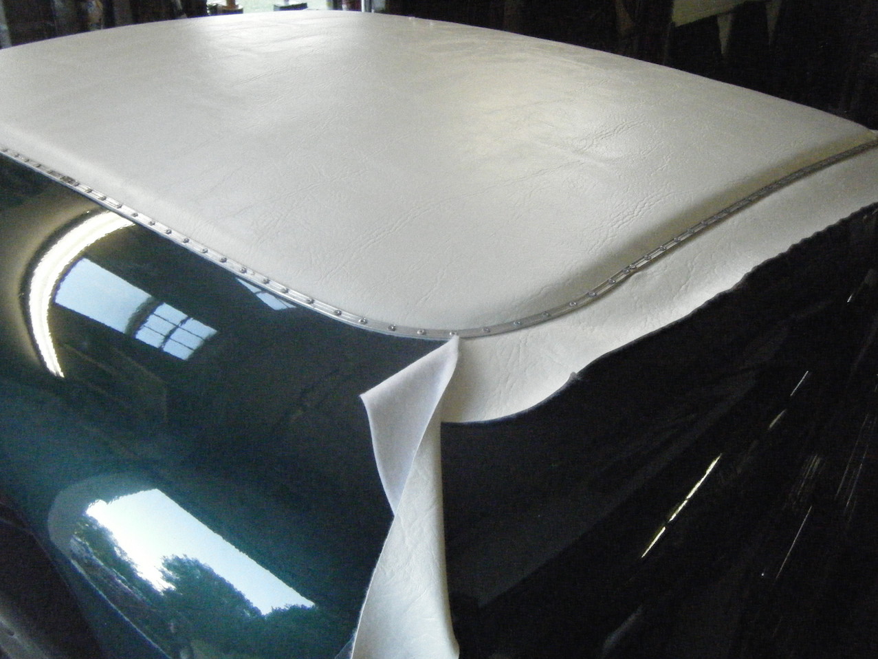

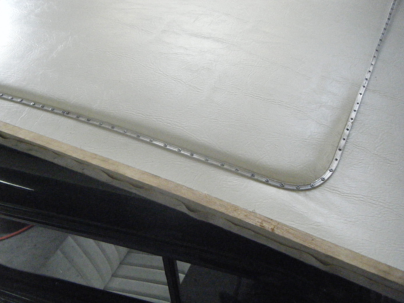

    on this style top the next step would have been bending the aluminum track and drilling all the holes to mount it but since i had installed this 30+ years ago that step was done.
    on to the monotonous step; find the hole through the track and material, insert pop rivet, "pop", repeat............ a hole/rivet every inch........and there are a lot of inches. DSCF4240.JPG

    DSCF4242.JPG DSCF4241.JPG once all the rivets were in i trimmed it "big" to get the frame out of the way, then went around with a razor blade and trimmed it "tight".

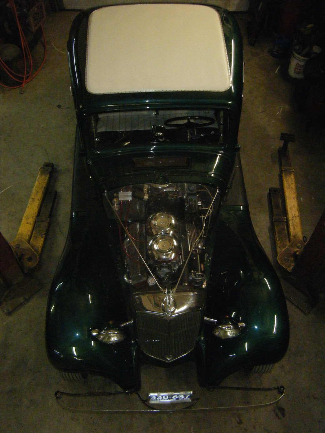

    Joined: Oct 8, 2010
    Posts: 17,583
    tb33anda3rd
    did i do it right?
    thanks, i like the lighting of that shot.
    thanks!

  12. TFoch
    Joined: Mar 31, 2010
    Posts: 2,389
    TFoch
    Great shot from up above. Nice work!

  15. Runnin shine
    Joined: Apr 12, 2013
    Posts: 3,383
    Runnin shine
    The cool thing about a well built hot rod is... You don't need a professional photographer, just a little consideration on your part and the car will do the rest.
