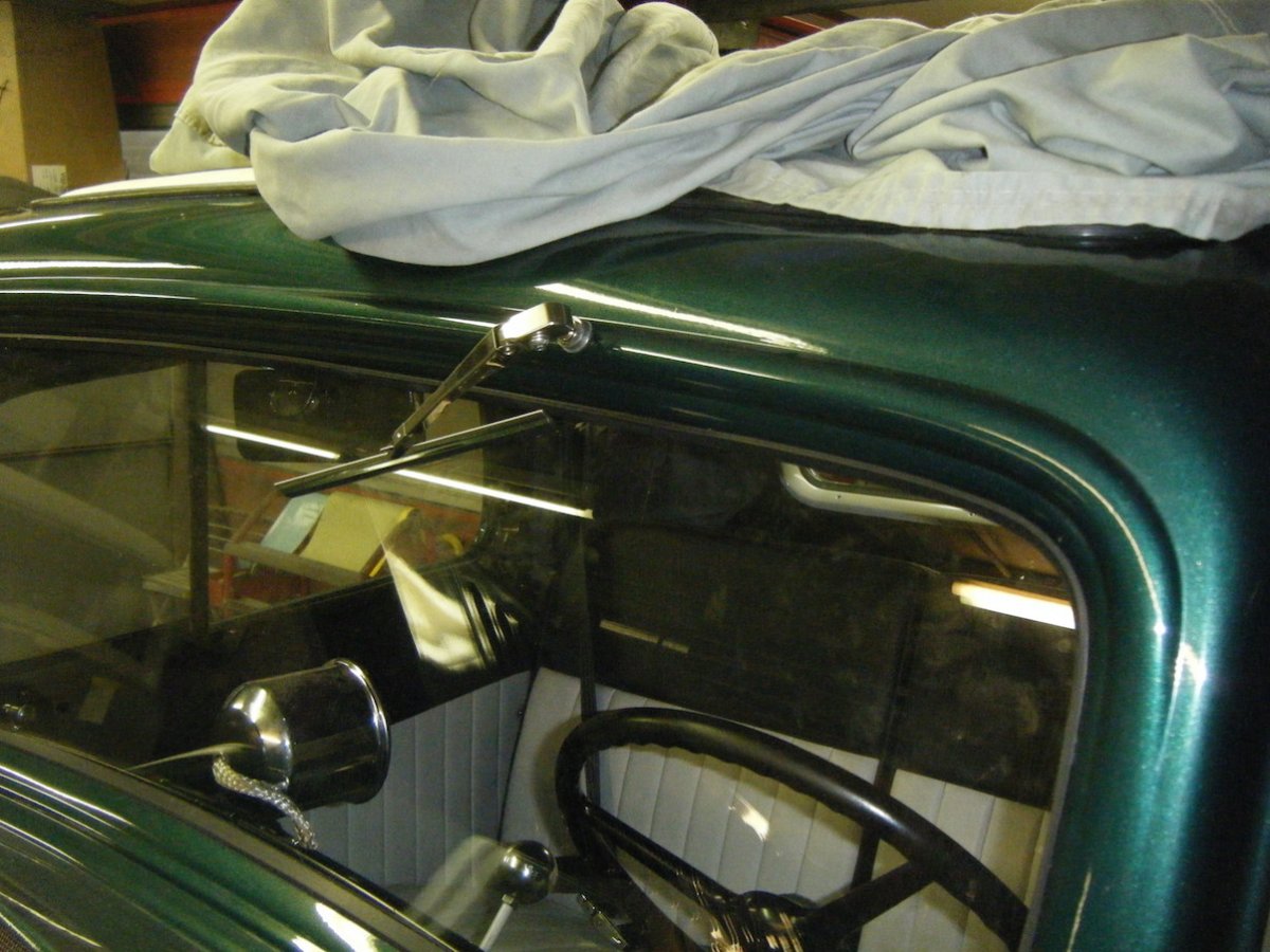

    put the wiper motor and arm on......let it rain!

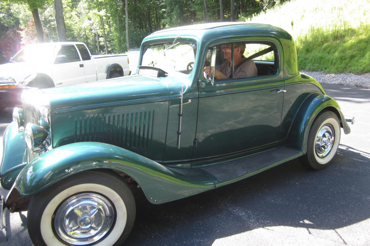

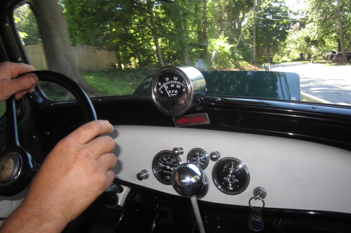

    Well today I got to ride in this awesome 1933 Chevy for the first time in 54 years:cool: Ted's Dad gave me a ride when I was 14 and I never forgot it. Today young Ted gave me a ride and it was cool. I think at 14 I was more impressionable. Not that today was not great, it was! But I must say at 14 I was high for days after that ride.:p Also I think todays ride would have been better if the rims were red.:eek: Sorry I just had to. :D Thanks Ted I needed that!:cool:
    Do you think he is enjoying this?:rolleyes:

    It always looked great but it looks even better going down the road. Oh by the way, if you have a smile on you face for more than 4 hours you should consult with your doctor.

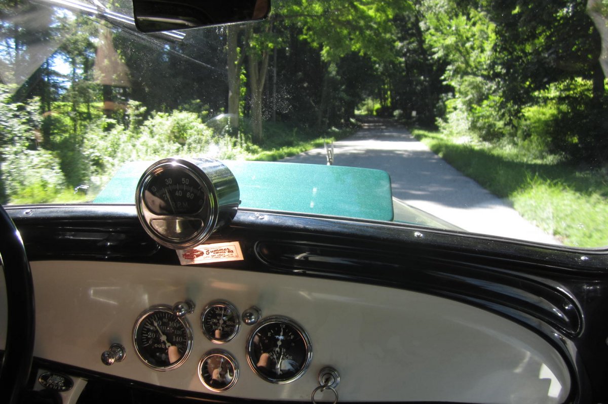

    wing windows wide open, cowl vent, open side and rear window rolled down.......motor running at 200 degrees............temperature in the 90's............cool!

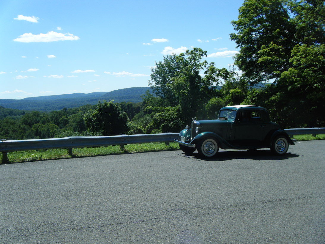

    then stopped at the lake for a swim.......but i wanted to just keep driving....... DSCF4277.JPG

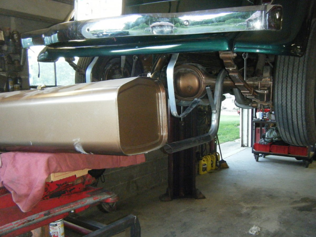

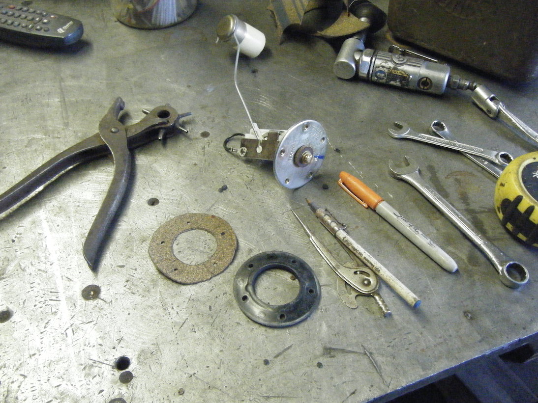

    heard something "ticking" from the back of the car when i parked it, sounded sort of like a muffler cooling off, but more metallic. the noise was coming from the fuel tank and got louder when i took the cap off. i looked inside with a flash light and there was the float and rod bobbing up and down, tapping on the tank. so i dropped the exhaust and pulled the tank and sender. i fished the float out using a flexible grippy finger tool. the new float arm had fallen out of the sender. i must not have installed it correctly.
    what i also found was the new gasket had swollen from the fuel and it had started to leak. why do they sell anything for fuel that is not compatible with todays blends?so i made a new one from cork gasket material and put it back together.

    you can see how swollen the rubber gasket was. DSCF4282.JPG DSCF4283.JPG DSCF4284.JPG DSCF4285.JPG
