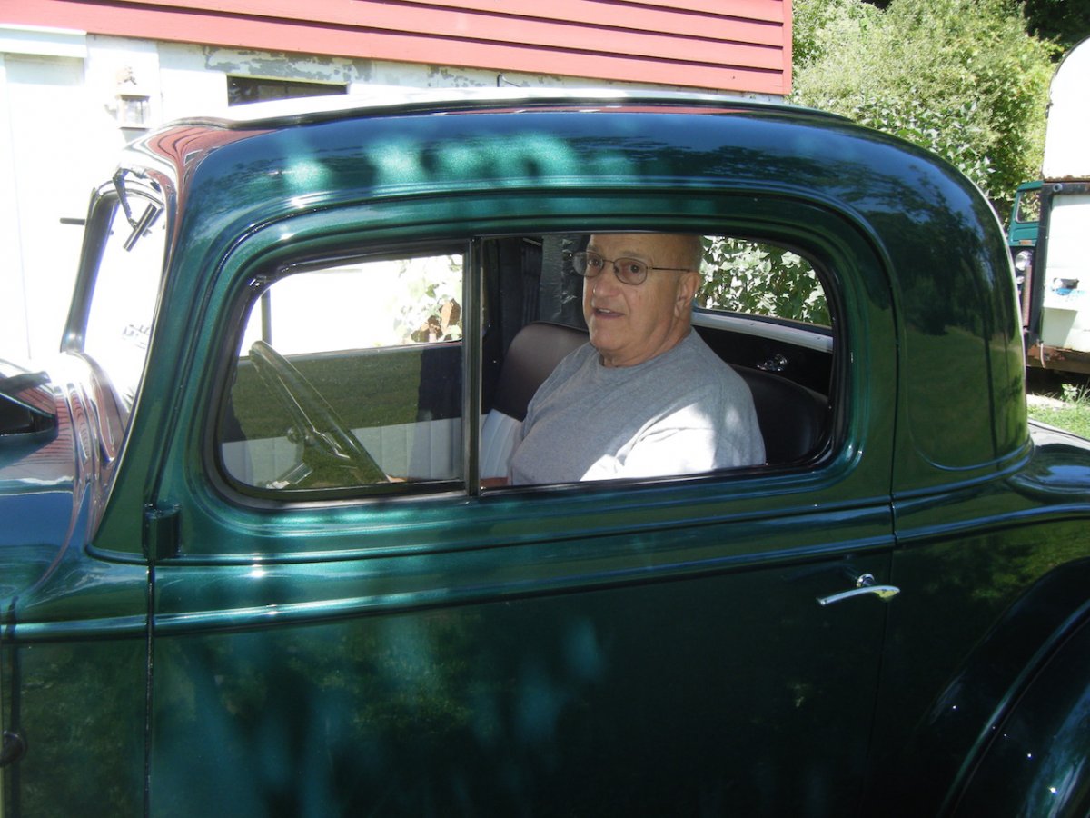

    check this teenager out!...........felt just like he remembered it. DSCF4289.JPG DSCF4288.JPG

    That picture is priceless, what a neat deal for your Dad to once again feel the joy of sitting behind the wheel of such s cool hot rod :cool:

    Dad looks like he approves! Great he gets to take it for a spin after all this time. Always brings a smile to my Dad when I bring him for a ride in mine.

    he worked hard helping to getting it to this point.
    of course it was a ghost town around there when the sanding started:D:cool:

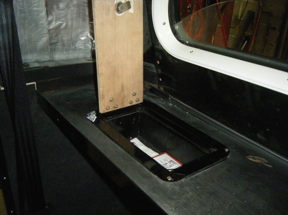

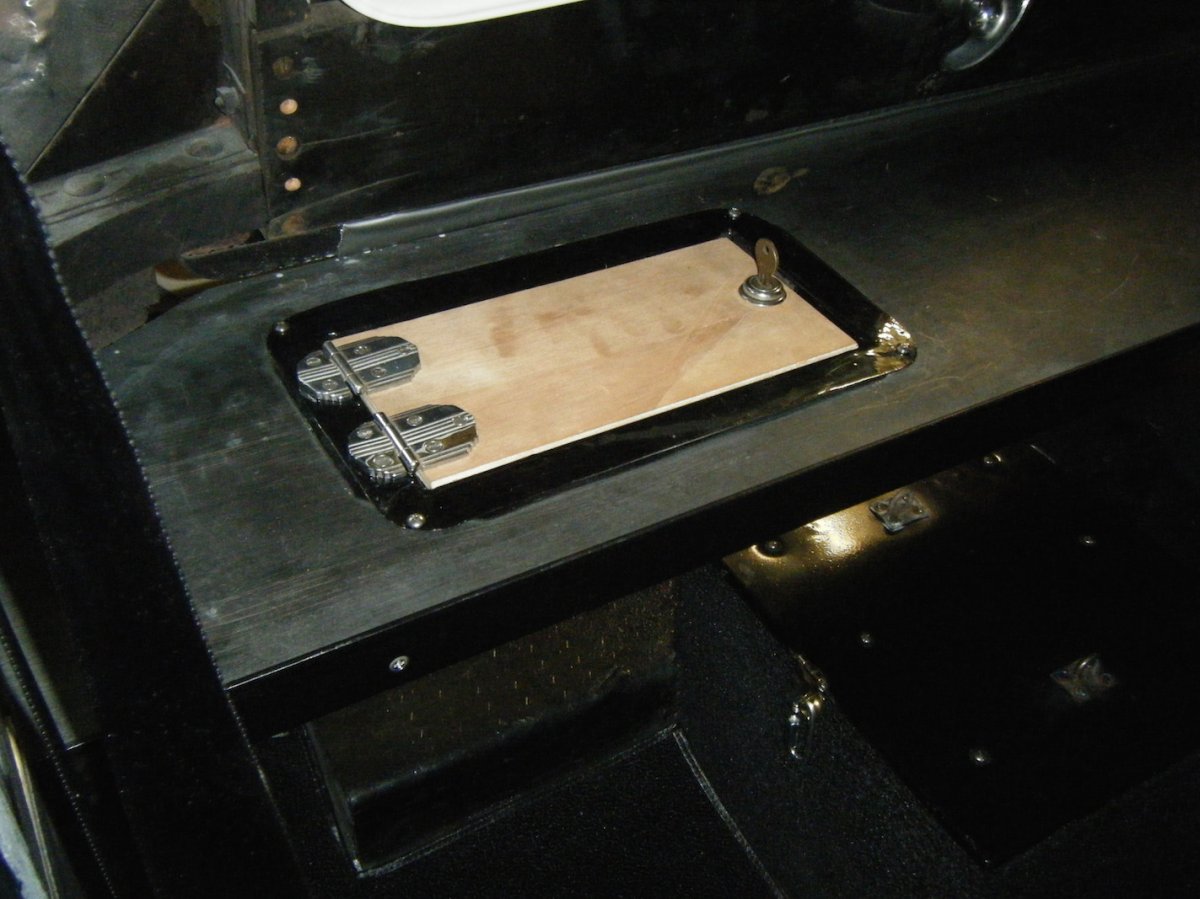

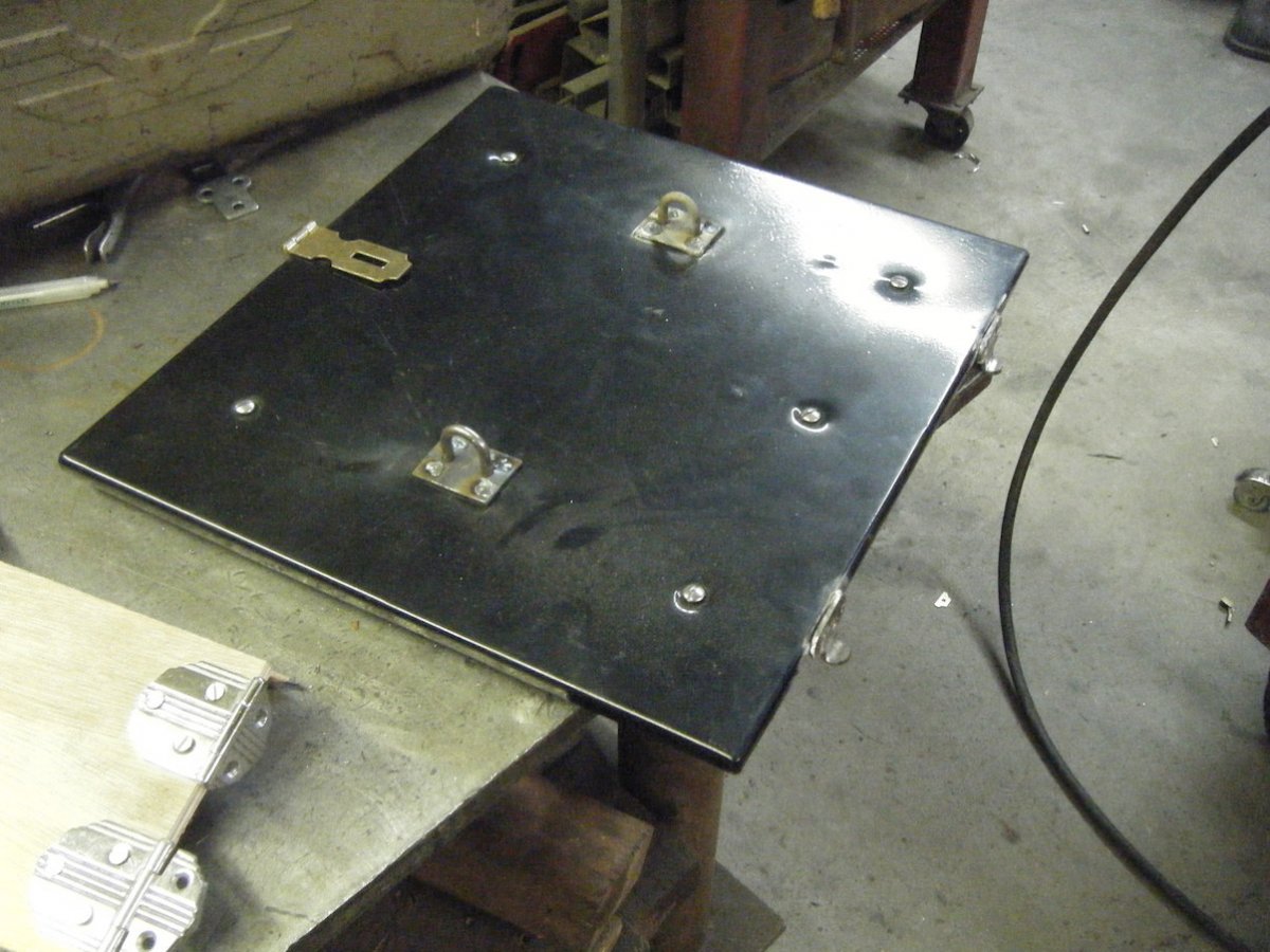

    worked on a few little details tonight. made a door for the "glove box" in the package tray. took a piece of 3/8 plywood and drilled and filed a hole for a lock cylinder, i did not need to have this lock but it is a nice clean "knob" that when the key is removed will allow for a flat tray. i used some art deco cabinet hinges i saved. the door and the package tray will be covered in the same vinyl as the seats.

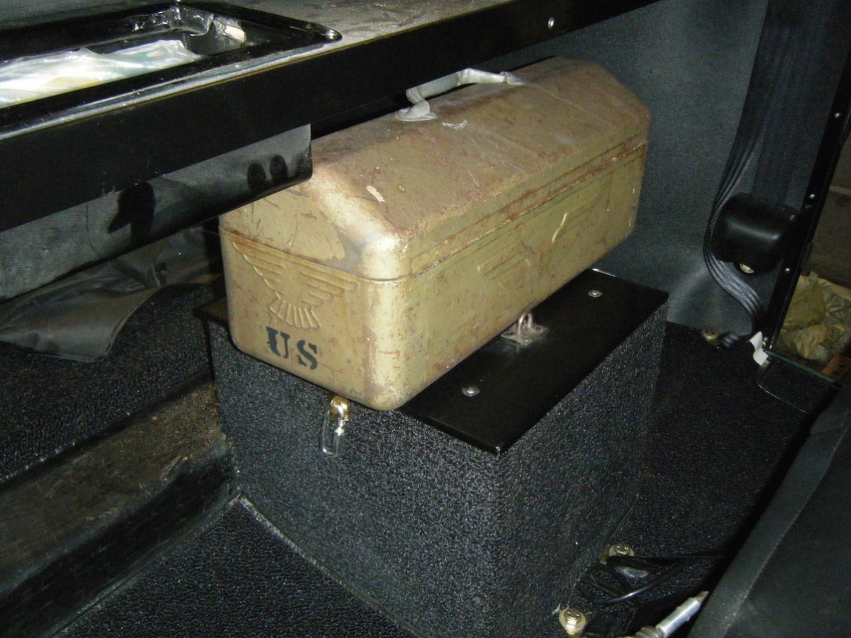

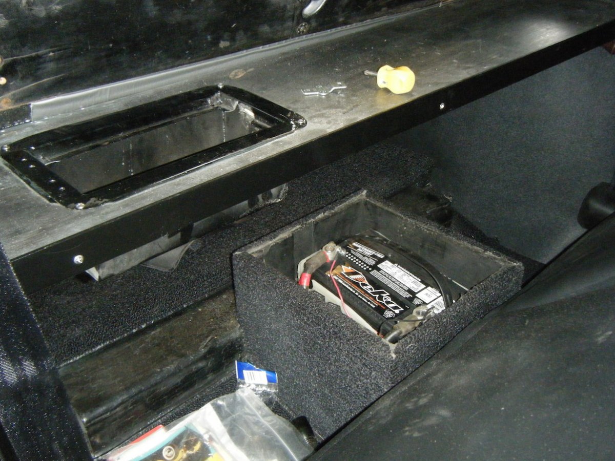

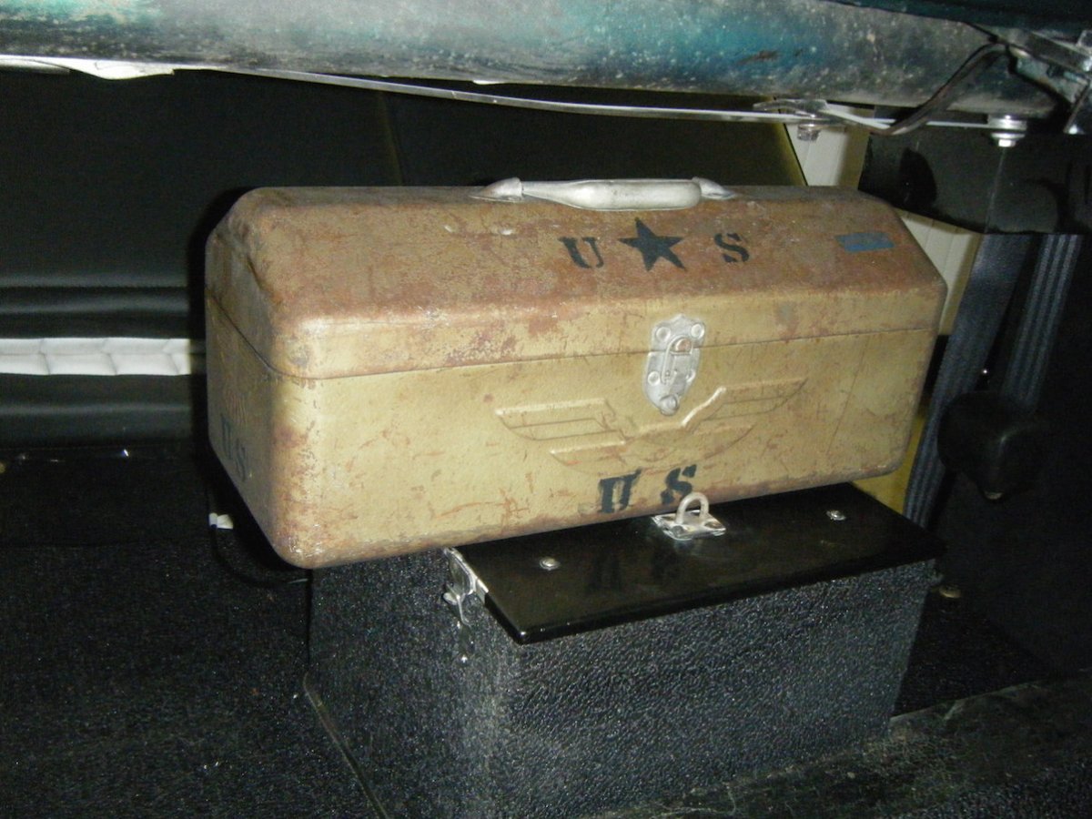

    i also put some latches to hold the battery cover down. i wanted the cover to be able to be removed so one side uses the old style storm window hooks and brackets. the lid hooks get inserted into the latches at an angle, then the lid is closed. on the "loose" side i put a lock clasp and will use a spring clip to keep it closed.
    i also wanted to be able to secure my toolbox to the top of the battery box. this gives me the most room left for storage........ i will use some belting through the loops to hold it in place. DSCF4290.JPG DSCF4292.JPG DSCF4293.JPG
    bct and volvobrynk like this.
  13. volvobrynk
    Joined: Jan 30, 2011
    Posts: 3,587
    volvobrynk
    from Denmark
    That's one cl***y toolbox, for an nice ride.
    What's the story behind that?
  14. tb33anda3rd
    Joined: Oct 8, 2010
    Posts: 17,588
    tb33anda3rd
    found it at a "garage" cleanup we did. i cleaned it up and used a flat clear varnish to protect the patina. i also varnished it to keep the surface rust from transferring to the upholstery, carpet or my clothes.
    the u s was added but i liked it and left it on, it fits the look with the "wing" embossing.
    volvobrynk likes this.

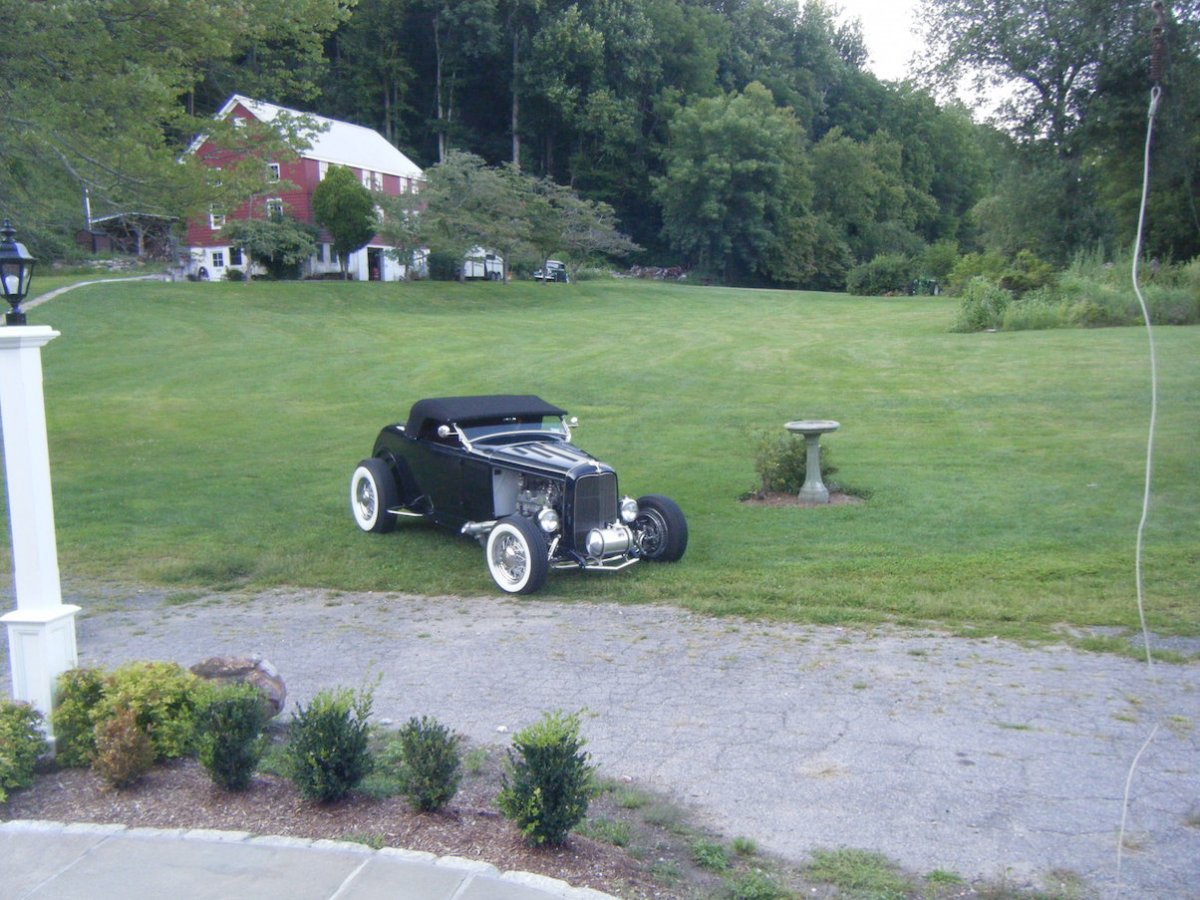

  15. tb33anda3rd
    Joined: Oct 8, 2010
    Posts: 17,588
    tb33anda3rd
    kidcampbell71 and ct1932ford like this.
  16. Runnin shine
    Joined: Apr 12, 2013
    Posts: 3,383
    Runnin shine
    This photo spot is becoming HAMB haloed ground, I don't know when I can get my car or truck there but it's on the list. You should charge admission.
    volvobrynk and tb33anda3rd like this.

  18. Road Duster
    Joined: Aug 4, 2011
    Posts: 37
    Road Duster
    Thanks Ted, I"ll drive the other car over next time. Had a good day and your car looks great.
    tb33anda3rd likes this.
  19. ct1932ford
    Joined: Dec 3, 2010
    Posts: 13,286
    ct1932ford
    He took my spot!:eek:
  20. tb33anda3rd
    Joined: Oct 8, 2010
    Posts: 17,588
    tb33anda3rd
    no charge. come on up!
    it's a buick motor......no leaks.
    thanks Frank. yeah we can snap another shot.
    plenty of room!

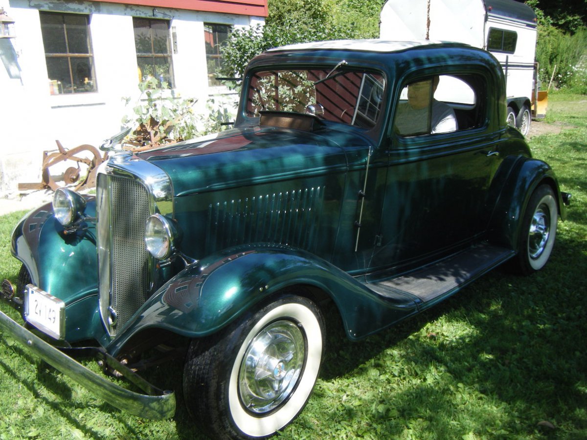

  22. tb33anda3rd
    Joined: Oct 8, 2010
    Posts: 17,588
    tb33anda3rd

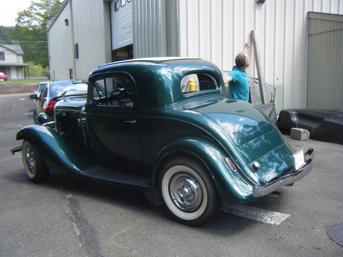

    dropped car off to finish the headliner and the white running board covers.

  23. Dick Stevens
    Joined: Aug 7, 2012
    Posts: 4,139
    Dick Stevens
    I like it better every time I see another picture of it! It is just so cool :cool::):D

    So, you are pointing at Superman? The car looks better every time I see it.
  28. tb33anda3rd
    Joined: Oct 8, 2010
    Posts: 17,588
    tb33anda3rd
    that's Brian, the owner/craftsman at the upholstery shop. i think he was either pointing to a spot on the roof where he had room to park it or explaining the height of the bill when it is done.:eek::D

    Ya, what it will cost. Very funny!
