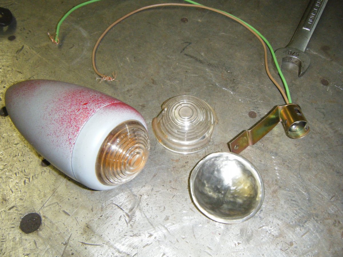

    DSCF4669.JPG DSCF4670.JPG i bought three of these lights at the fall out. parking lights for a 40 chevy pickup. i am thinking of mounting them to the inside of the fenders to be used for parking and turn signals. a little more traditional than the led i am using now.

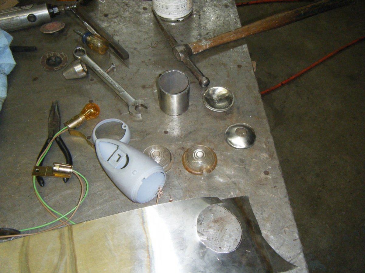

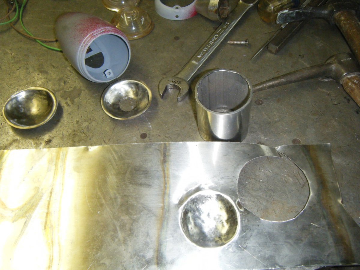

    i started by sand blasting them and welding up the little holes, then primed them. the original rims were rotten but i found a couple good ones in my stash. i couldn't use the original sockets and reflectors because the 1157na bulbs wouldn't fit, so i pounded a set of reflectors from a sheet of s.s., then trimmed them to fit. DSCF4674.JPG DSCF4673.JPG DSCF4671.JPG
