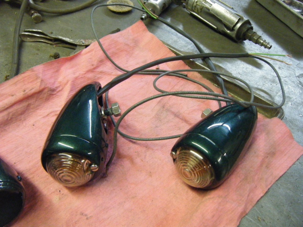

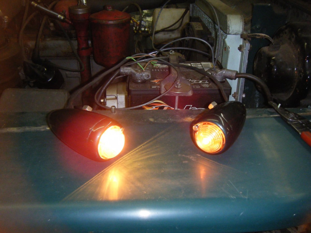

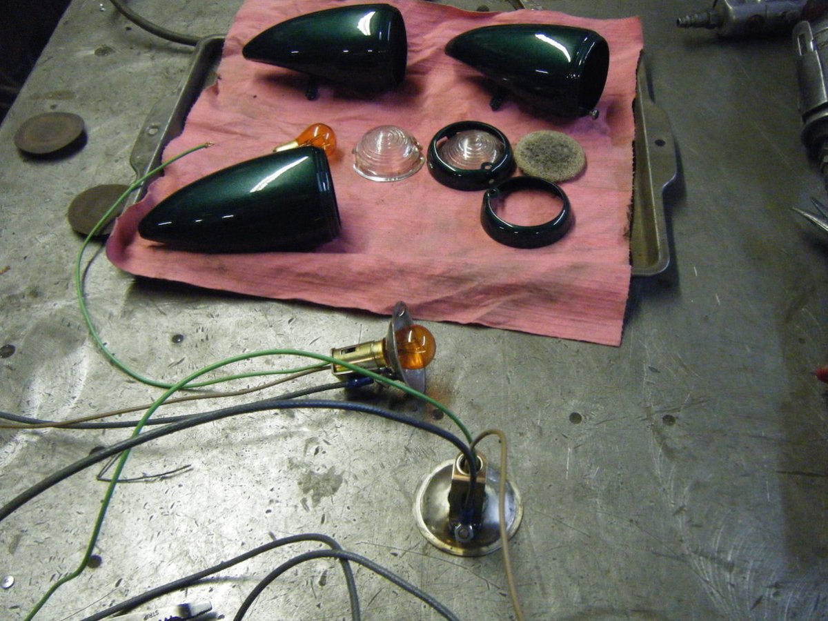

    finished the lights tonight. finished making the reflectors and welded a socket to the back of them. added a small machine screw to hold a ground wire. slid a piece of shrink tube around them and hit them with the heat gun. i used "dum-dum as a gasket and ***embled them. new s.s. nuts and washers. DSCF4687.JPG DSCF4688.JPG DSCF4689.JPG DSCF4690.JPG one on "turn" signal, one on "park"

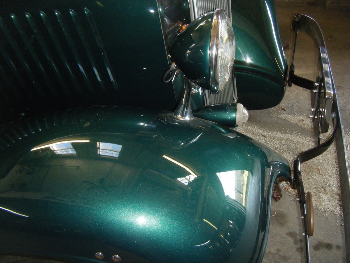

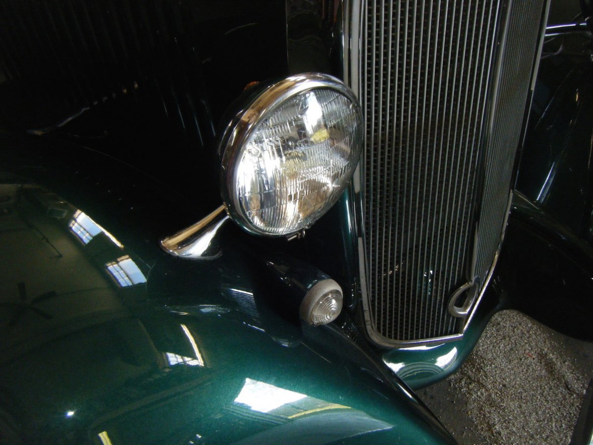

    turn signals placement?
    centered under headlight, tucked back under light. DSCF4706.JPG DSCF4707.JPG

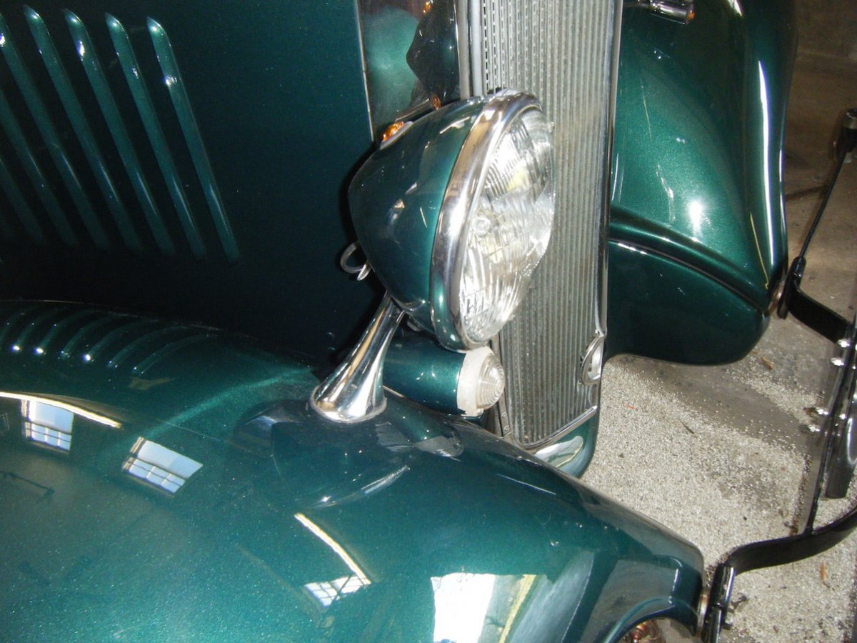

    tb33anda3rd

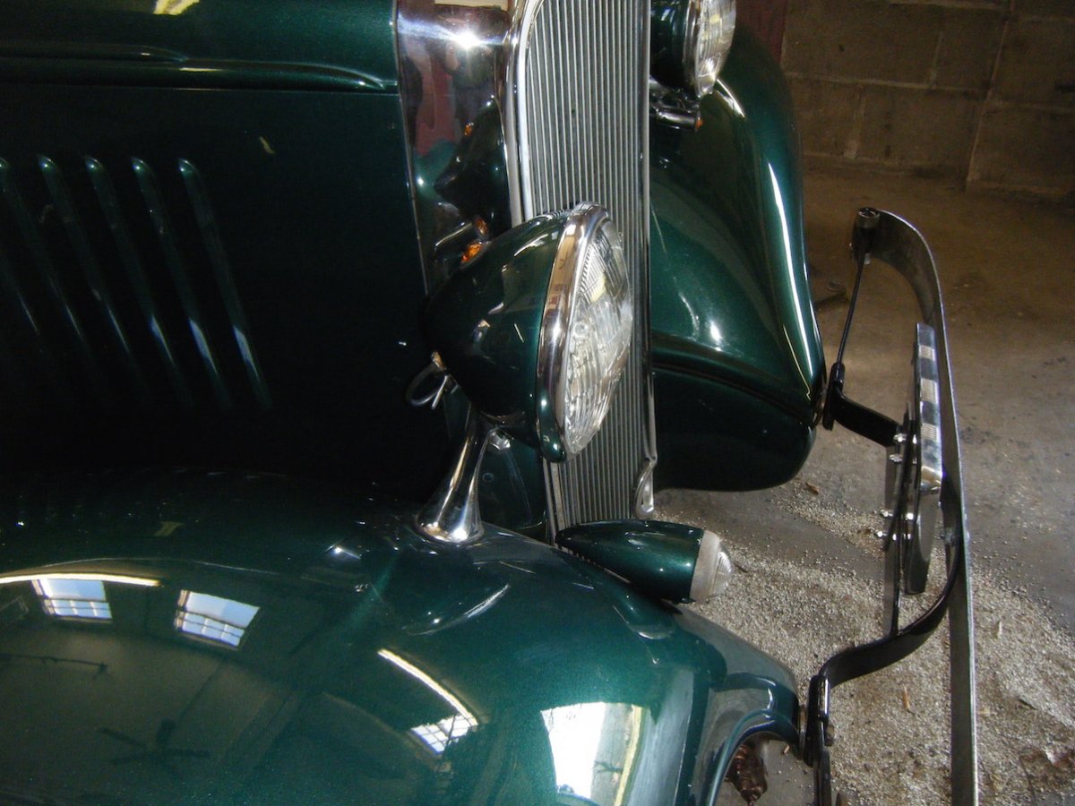

    DSCF4708.JPG DSCF4710.JPG DSCF4711.JPG DSCF4712.JPG and a few other positions and angles. moved forward on the fender

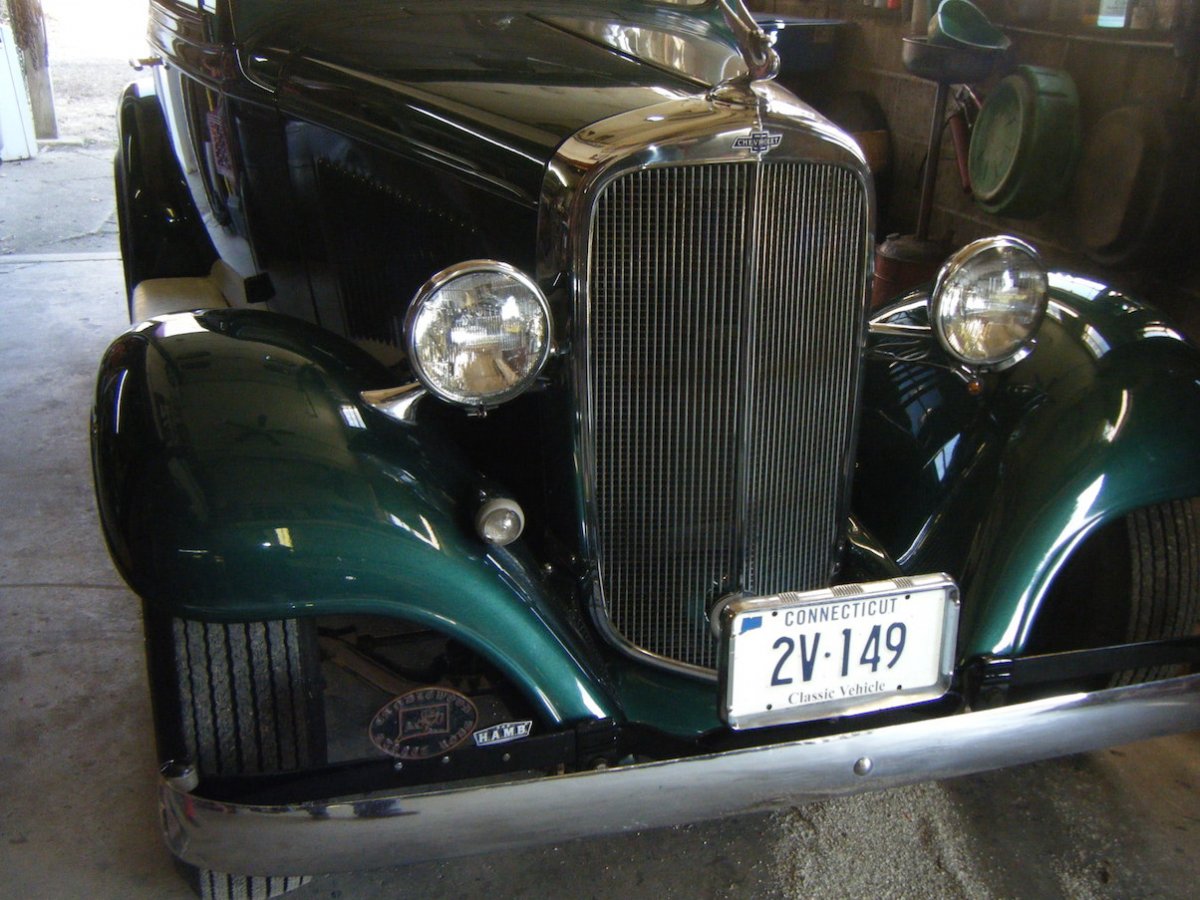

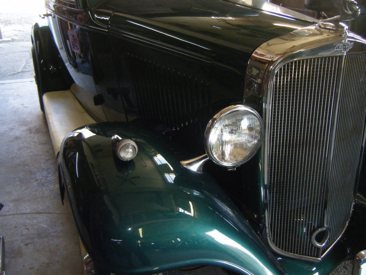

    top of fender?
    bolted under head light?

    You can always do like those beer hats, with one over each ear. :) Whatever you do, they're bound to look good. Aesthetics versus safety ..... yikes !! Not easy to figure ... obviously. Good luck and always nice work !!

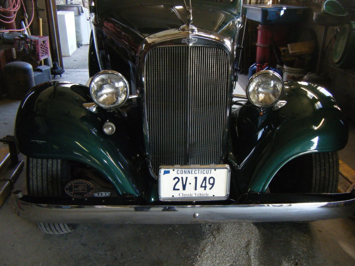

    thanks, thats the problem. these lights are more traditional than the led lights i have on there now.
    my choices are; led, not traditional but kinda disappear, or traditional lights that look "out of place". i don't mind drilling holes or filling them and repainting.

    Top of fender- NO. Under headlight-NO. Low on the inner fender - PERFECT. Backup light - OK.

    Your traditional lights certainly don't look out of place. To my eye they look good on the fender just below and centered under the headlights as in your first pic.....but they'll look "best" wherever you decide to put them. Great car.

    when the light is centered under the headlight, and right below, it is at an off set angle, i could shim the gasket i make and it will be fine. the problem with low on the fender is they become too close together and can not be seen from a side angle.
    funny...... they actually look right on top of the fender......but not for a hot rod.
    thanks, i think i like them centered with the head light but pushed forward.....kinda reminds me of the original trumpet horn look.
