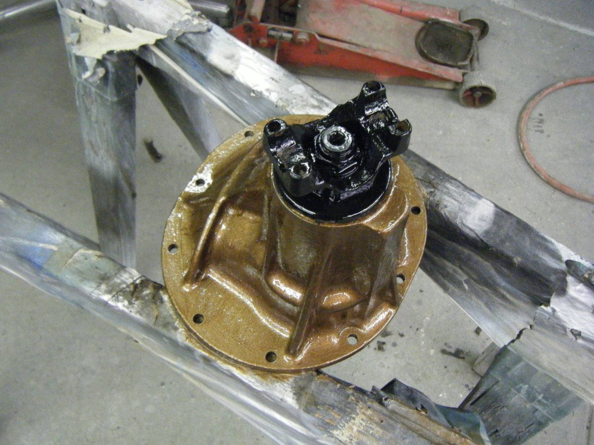

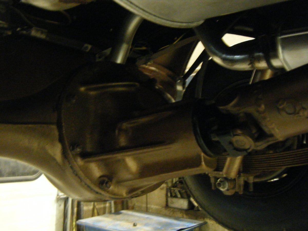

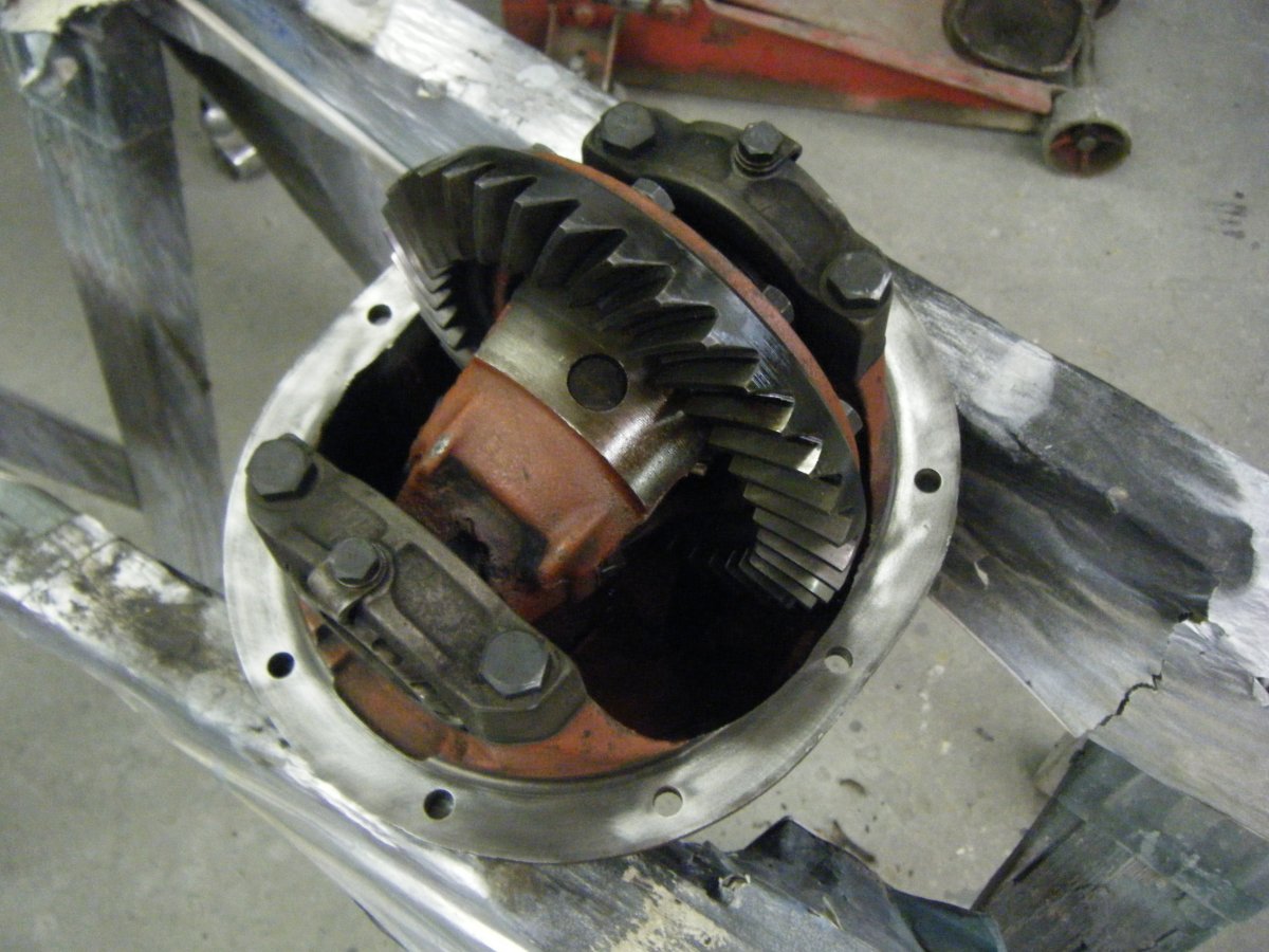

    cleaned the gasket surface, cup brushed the out side and gave it a coat of the gold/copper paint. DSCF5712.JPG DSCF5713.JPG

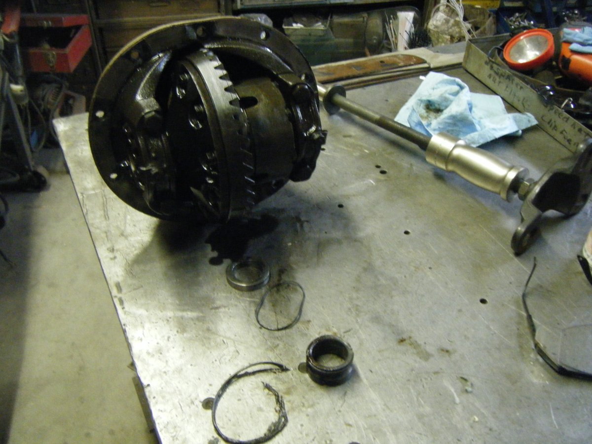

    swopped the gears this afternoon and changed an axle seal and bearing i found was seeping. did not have the right gear oil so i couldn't test drive it. DSCF5716.JPG DSCF5717.JPG

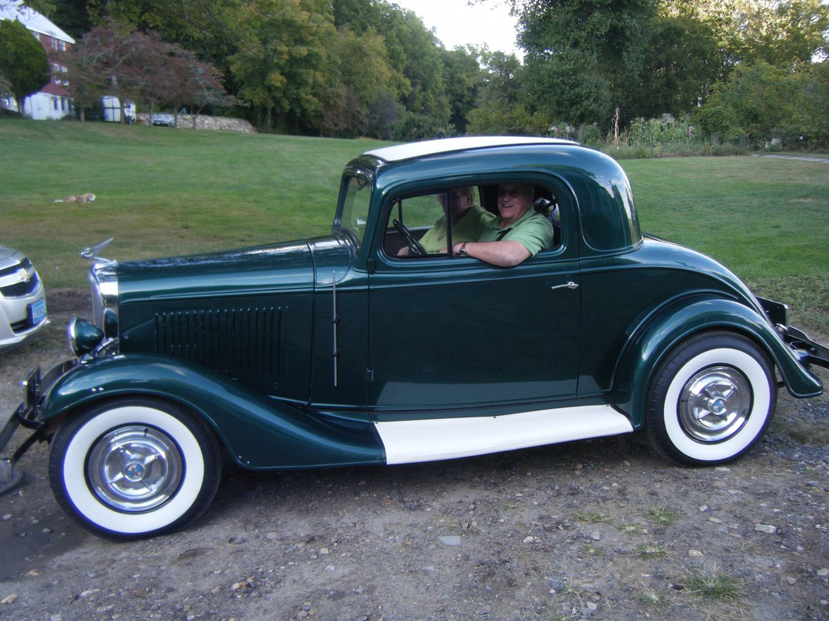

    dad called and asked that the car be gassed and cleaned so he could take it to a cruise..........haha
    the kids heading out!

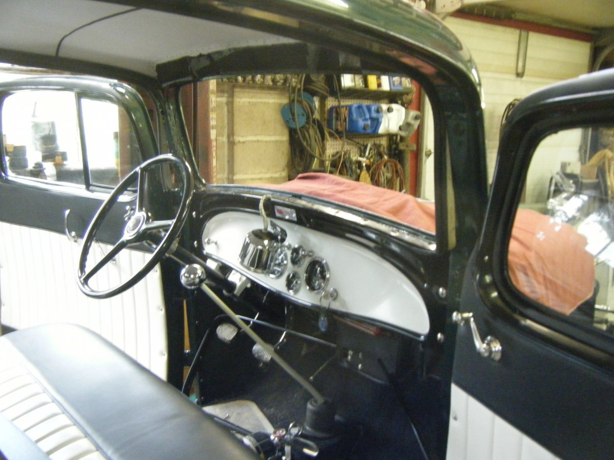

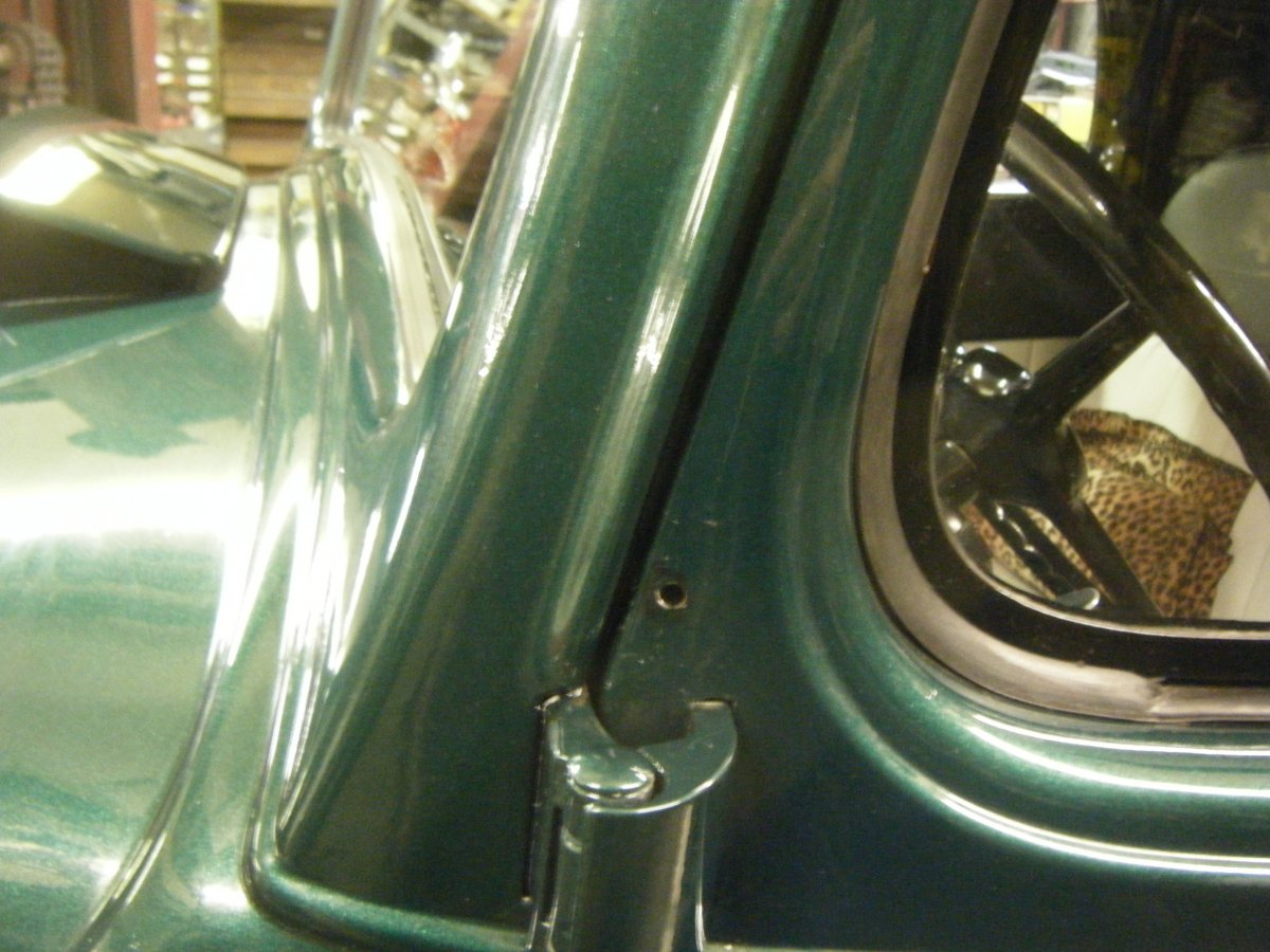

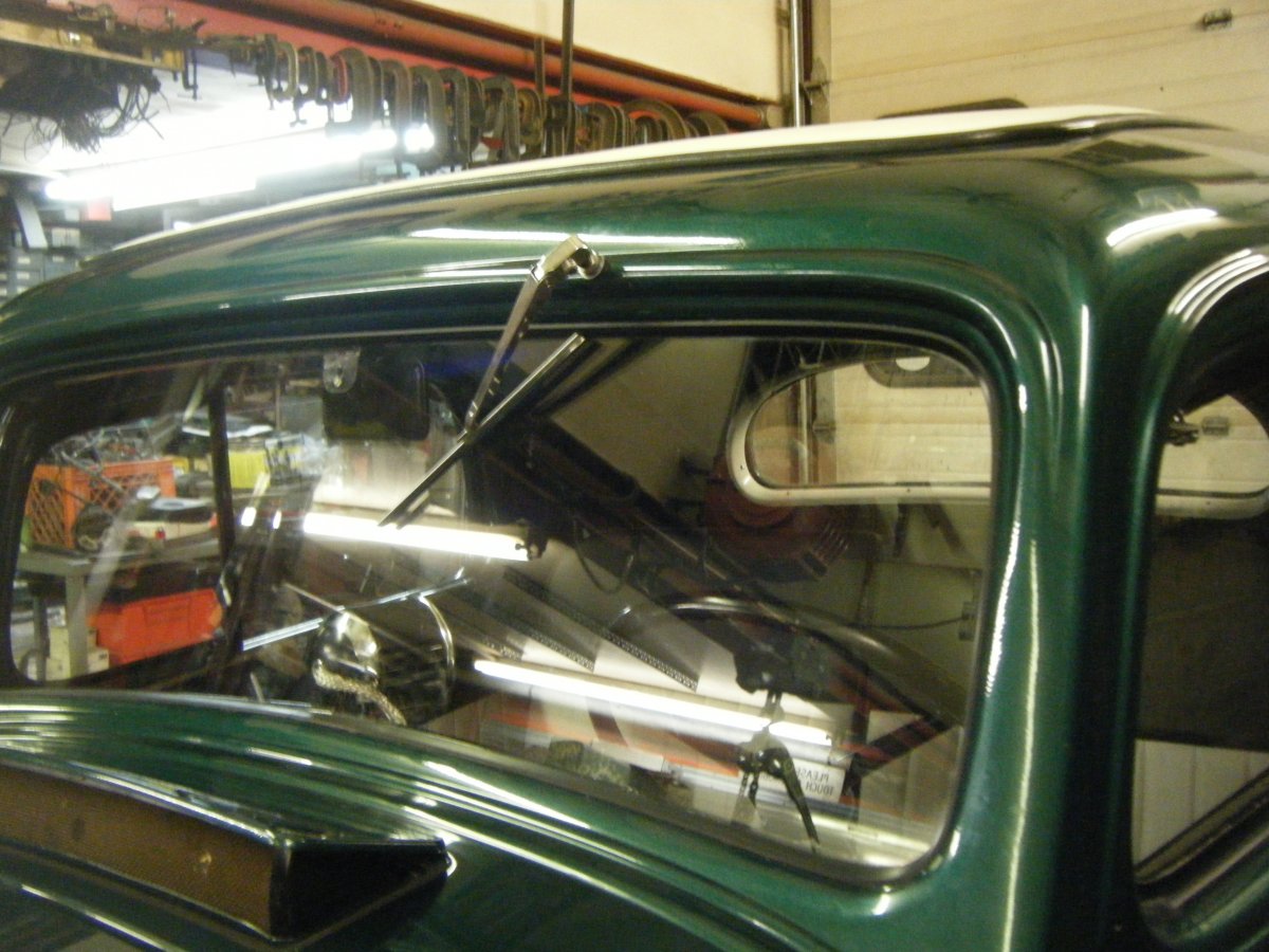

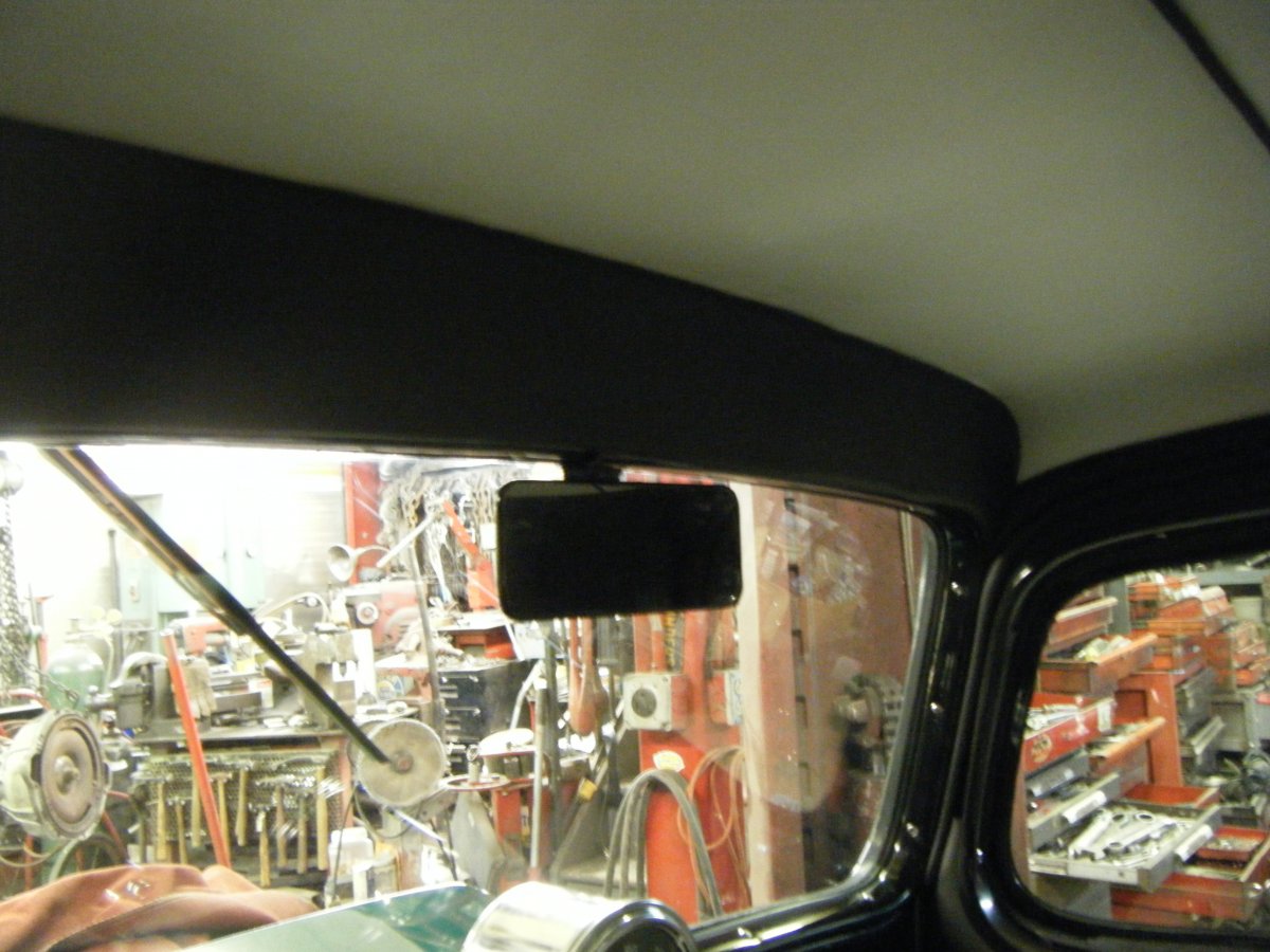

    DSCF5833.JPG DSCF5836.JPG i took the car to the jalopy showdown. about an hour and half run on a mix of back roads, hills, in town and high way. the gears are perfect. i did run through some rain and the windshield leaked. i installed it without any sealer and i had a feeling it might. i took it out today and sealed it up. while i was at it i lowered the rear view mirror. now that the seat is raised i wasn't able to look clearly out the rear window.

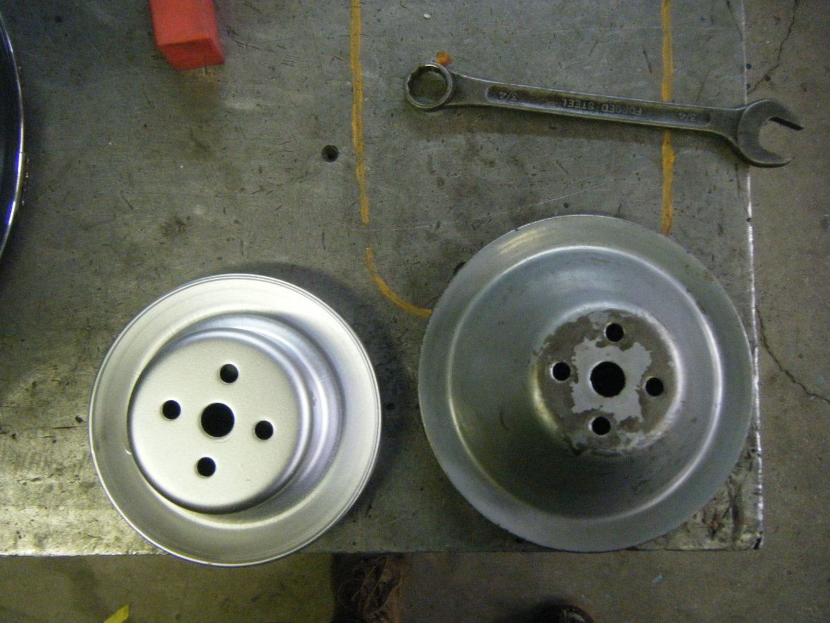

    i also changed the water pump pulley to a smaller size [thanks Pete for the suggestion] this will speed up the fan and pump. i noticed when i was in traffic the temps rose but if i gave it a little rpm's the temps dropped DSCF5832.JPG

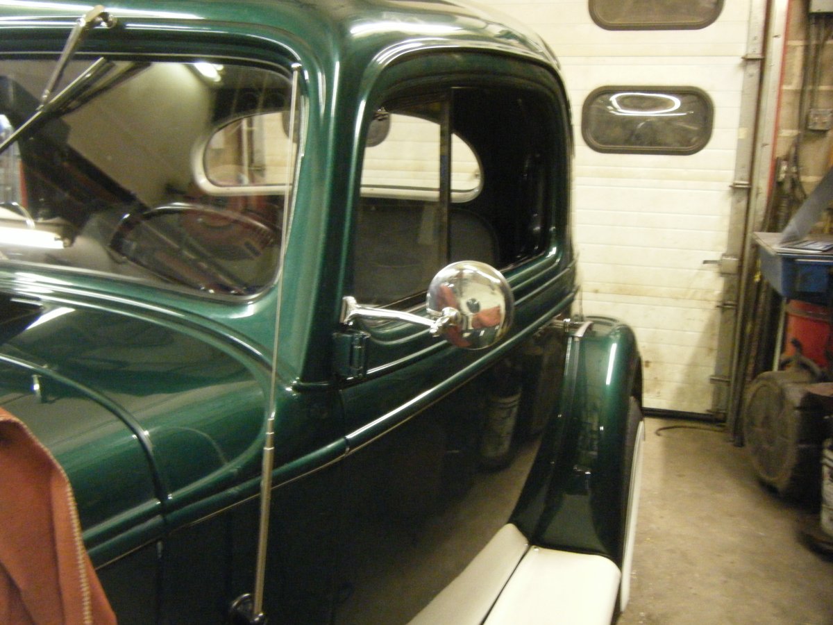

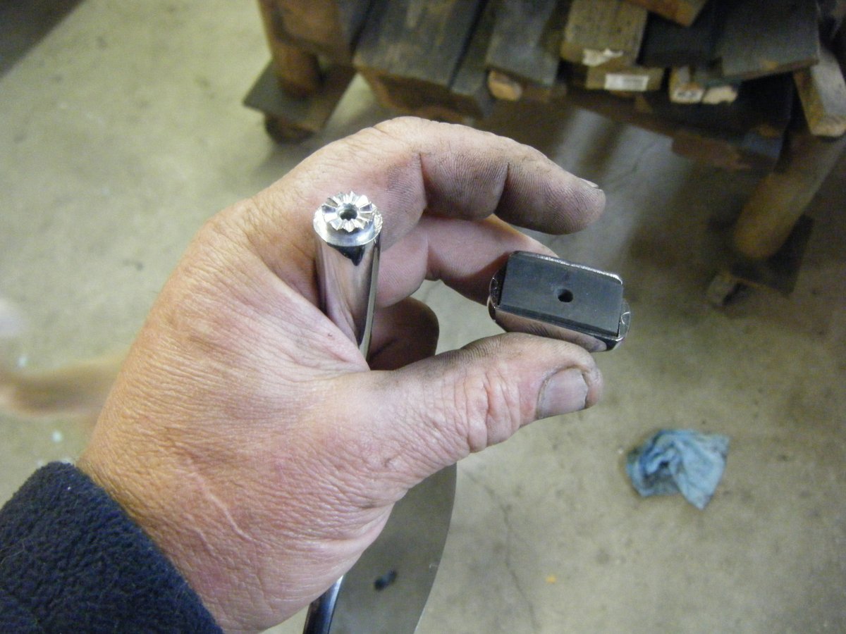

    my dad never had a side view mirror on the car, i added a clamp on "peep" mirror but it sucked [looks and function] i decided to put one on. i had a few in my stash and this one worked out the best. none of them would clamp on, so i cut the clamp "return" off, drilled a countersunk hole in the door and screwed it on. the mirror gives a great view, is tinted, and i can still open the vent window up completely. DSCF5834.JPG DSCF5835.JPG DSCF5838.JPG

    I've always had good luck with a pulley change in the past , glad it helped you out Ted.

    i took it for a ride today. i can hear the fan now when i accelerate. i was running a 160 thermostat and the car stayed at 160. it was cool this morning but not cooler than last spring, the choke would not come off, so i think the added fan and pump speed are cooling it better. i swopped out the thermostat this evening and will give it a good run tomorrow.

    i have a 600+ mile trip coming up with the car and have been going over the car. checked all fluids and bolts, for tightness. i found a loose battery cable to the starter, rear u-bolts needed to be tightened, brake adjust, greased and oiled everything. this evening i started applying the first coat of wax since i painted it.
    the rear view mirror is good now, it looks right out the back and the side view mirror works perfect. makes driving it easier in traffic.
