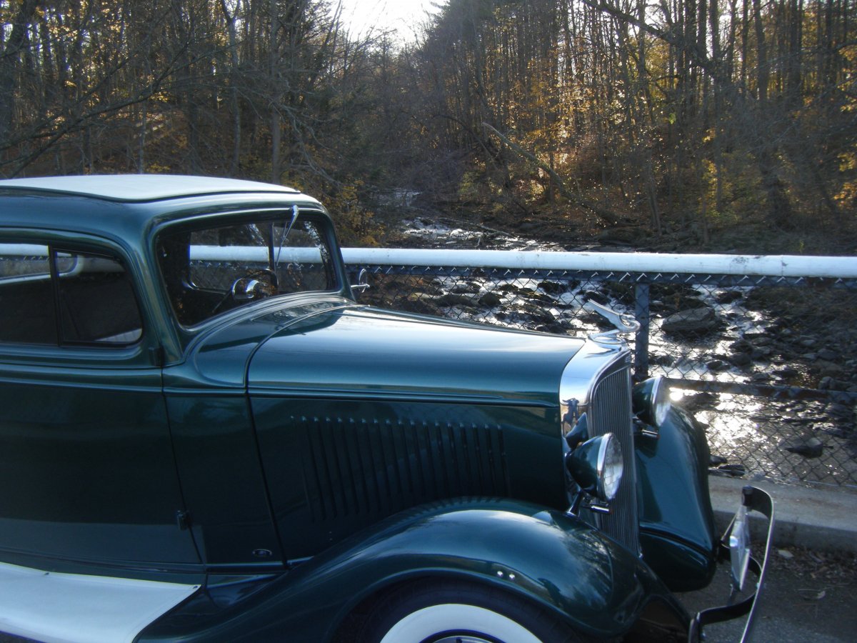

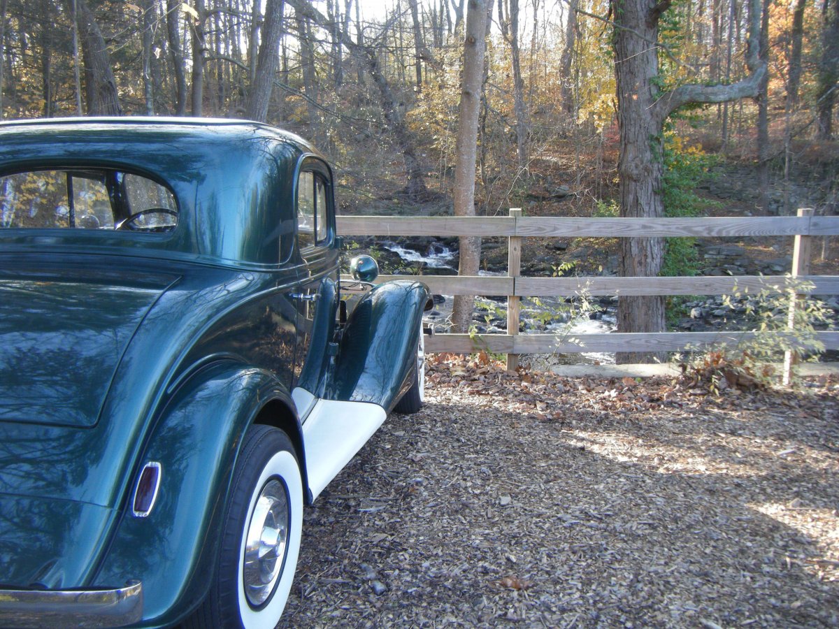

    thanks guys!
    took it to the last show of the season yesterday and "got lost" on the ride home. sunny and cool DSCF0038.JPG DSCF0043.JPG

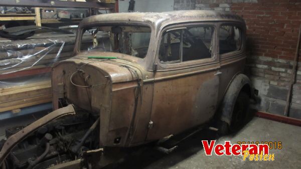

    Yes ted, I do. [emoji41] Happy new year to you too.
    It's for sale with this message;
    1934 Chevy Standard barnfind, non runner, no title.
    Old project, there is more parts then shown in the picture, it might be to far gone to an original resto, so parts or hotrod.
    1633.33usd
    [​IMG][​IMG][​IMG][​IMG]
    I've asked if he got grill, radiator, front springs and and glass.
    And shots of interior.
    I was planning on using it as frame diner for my 29, but might end up that my project give axles to this.
    I got a 1958 Chevy truck axle (I plan to drop), Nissan hardbody rear, 235 and 35/36 gearbox with pedals, 1956 three speed out of a pick up and 36 artillery wheels that might end up on this.

    that is screaming to be saved........as a hot rod! those axles would be perfect.

    Thank you, you know your stuff and in glad that you agree with me.
    Is it beyond doubt that's it's a 34? When I can't see the hood or dash it could be 33?
    It looks like a nice start for a project, I'm a little worried about glass and wood.
    But time will tell.

    the 33 cowl is shorter. that is either a 34 or 35. i think they are the same except one of the years the cowl vent opens towards the windshield and the other opens forward. i think 35 opens forward but i might have them confused.
    the wood can be done with some basic tools, or replaced with your welding skills, in metal.

    I hope you don't mind me interjecting a few important differences, but there is often confusion with these mid-decade Chevrolets and with the '35 models especially. A '34 Master DOES NOT become the standard in '35. In 1935, the Master was a totally new, rounded design called "Turret Top," which style is probably better known as "fat fender." The 1935 Standard sedan was basically a '34 Standard body with one significant difference. The '34 Standard had a separate gas tank apron that bolted to the body, while the gas tank apron on the '35 Standard sedan was an integral part of the body. In the one pic above which gives a hint of the back of the body, it's too dark for me to see the gas tank apron and determine if it is a '34 or '35 Standard. Another significant difference between the two standards, which cannot be readily seen, is the frame. The '34 Standard frame is basically a "ladder" frame, while the '35 Standard has a sturdier, "K" frame. Just looking at a '34 Master and a '34 Standard, it is hard to tell the difference as they are very similar in design. The main difference being the wheelbase. The '34 Master wheelbase is 112" and the '34 Standard, as well as '35 Standard, wheelbase is 107". Another difference between the '34 Master and the '34/'35 Standard is the dashboard. In the Master, the gauges are in front of the driver and there is a glove compartment in front of the passenger. The dashboard in both of the Standards has the gauges in the center of the dash and there is no glove compartment. The interesting thing is that the Master dash will also fit the Standards, too. It's about the only thing from the Master that will interchange with them.

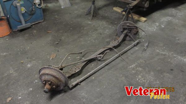

    1932-36 Gearbox is a lot shorter.
    So i hoped it would equal it self out.
    [​IMG][​IMG]
    But I have no measurements at this time, I struck the deal on both engine+trans and rearend, but haven't picked either up.
    But that is in the plan for January.

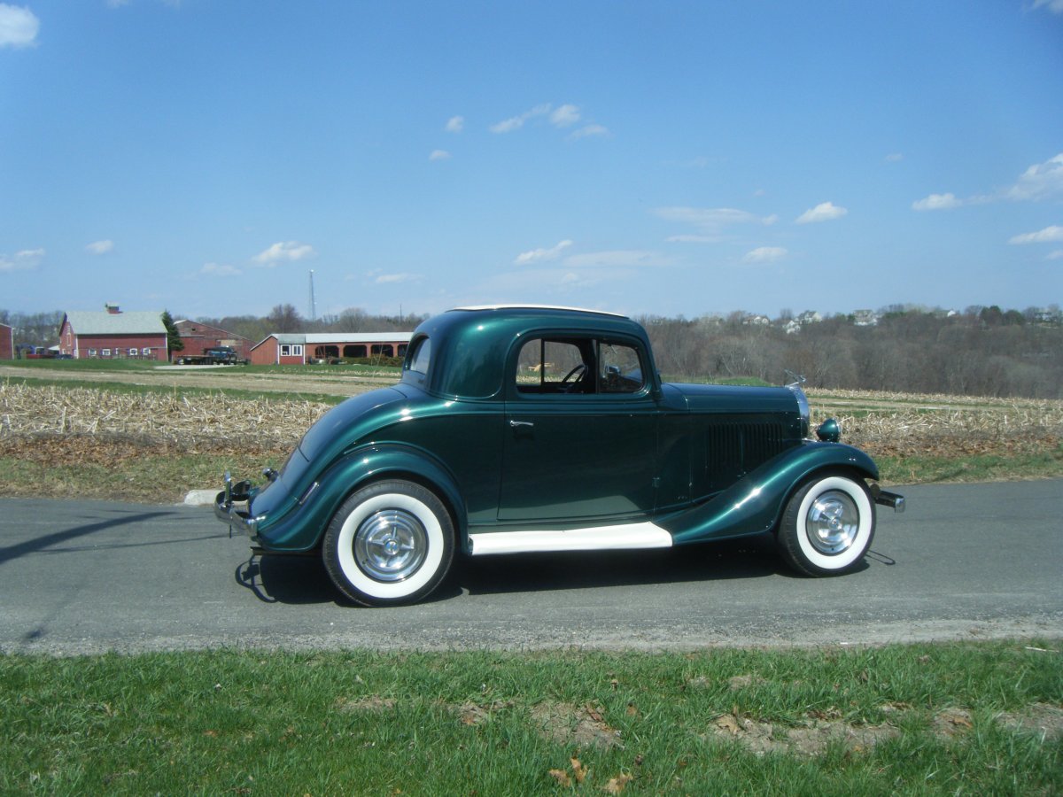

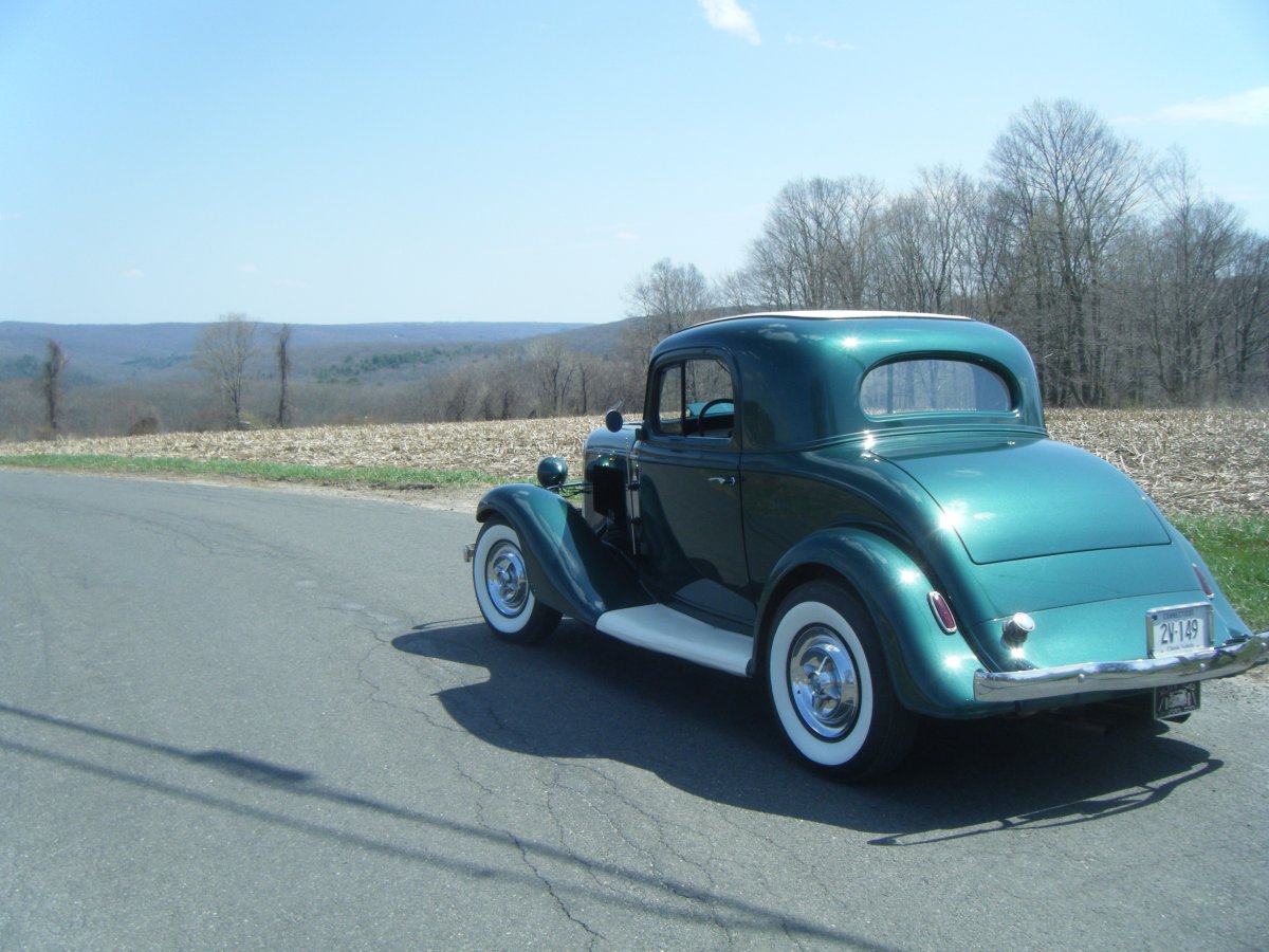

    Doesn't look like there was much dust on it :p
