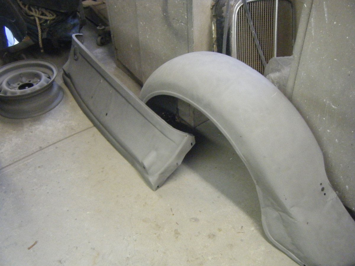

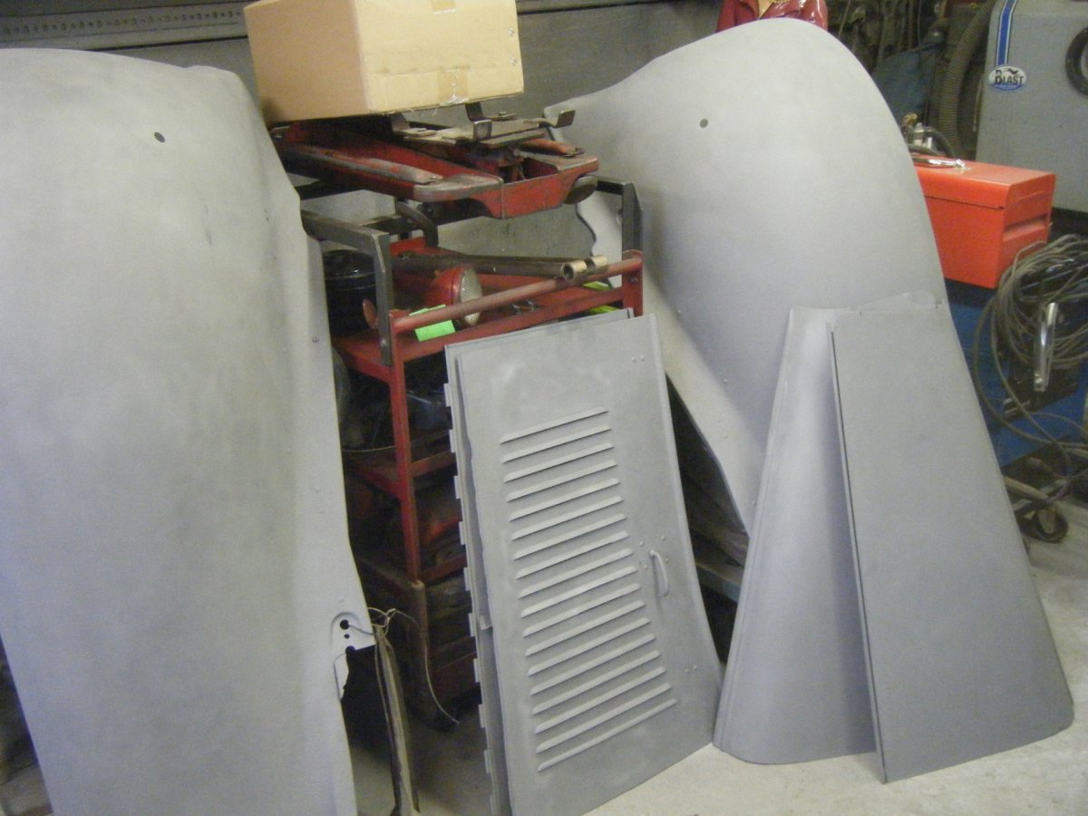

    @MalloMike picked up our stuff from the sand blasters. no warpage on my [backup/alternate] hood. next step is bodywork. Mikey's fenders look good. DSCF0005.JPG DSCF0006.JPG

    Bob, this whole pile of stuff, Mike's four fenders, front and back splash aprons, my hood and a wheel for Eugene were under a G. they did what i think is an amazing job on the hood. it was/is heavily pitted and they did not warp it.

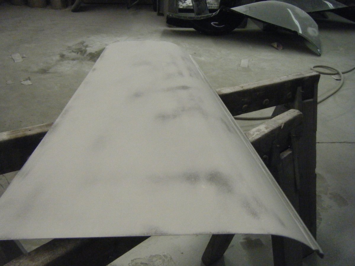

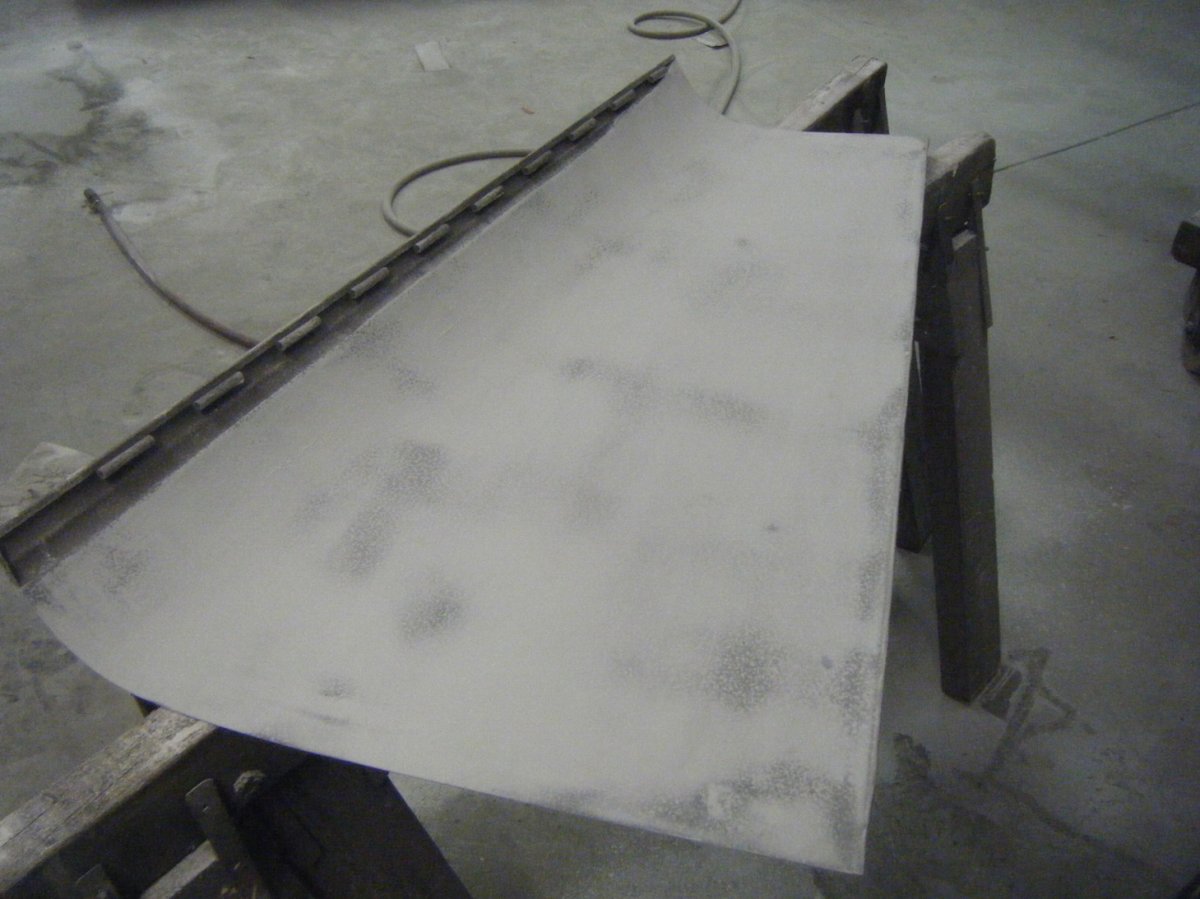

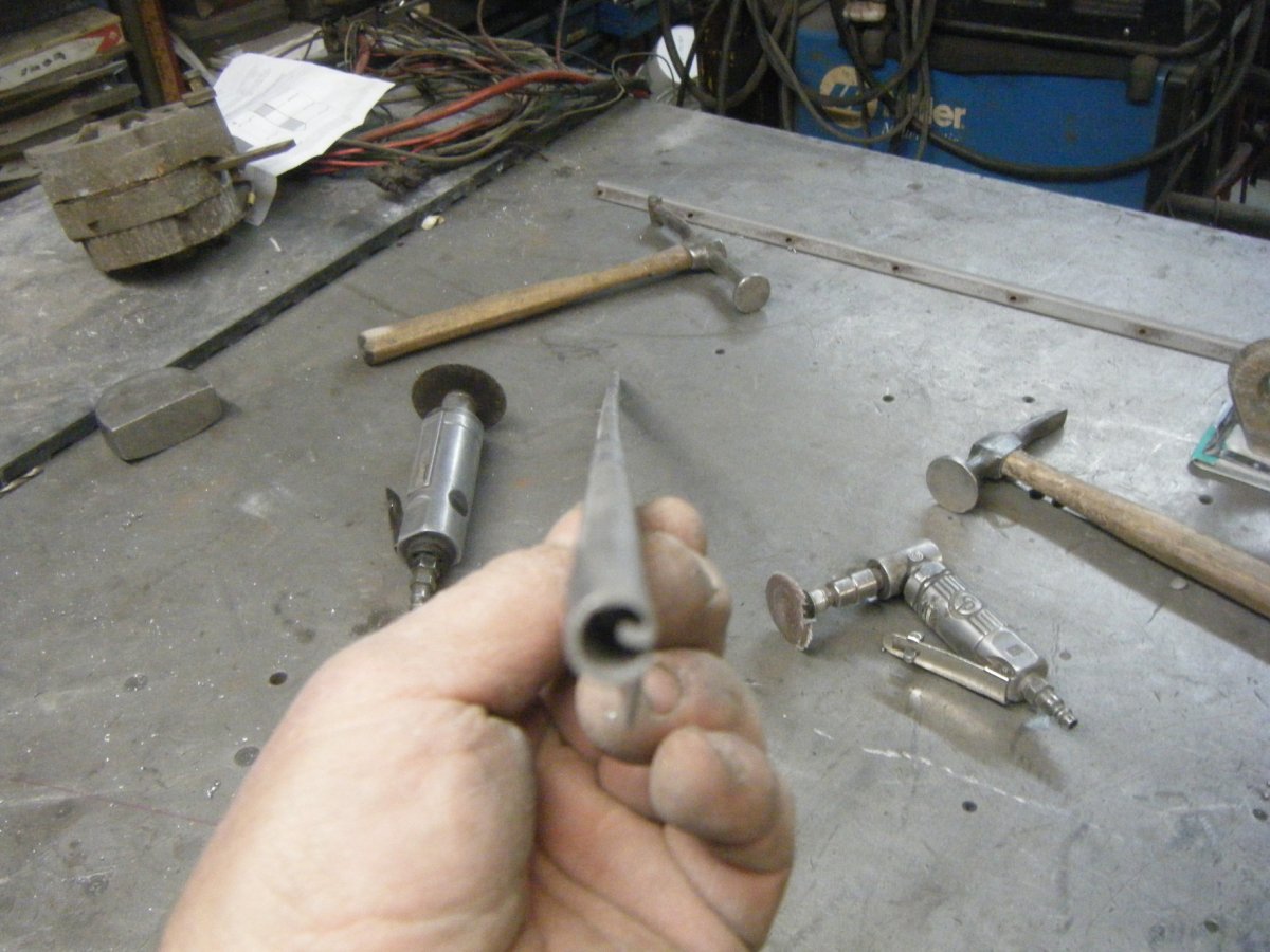

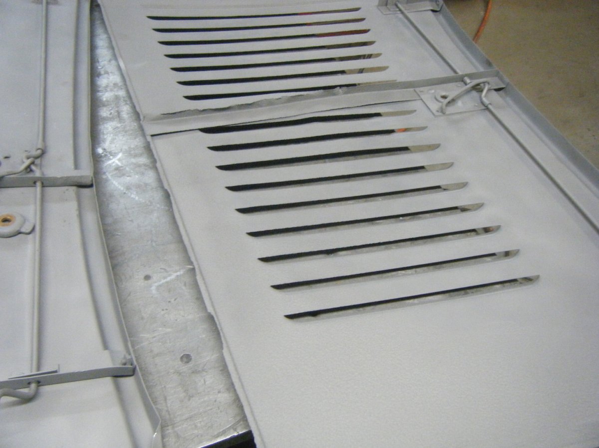

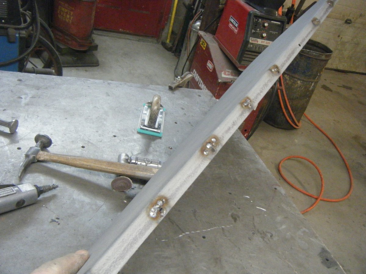

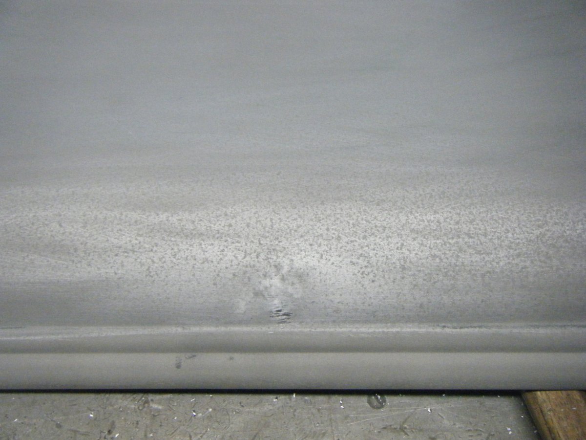

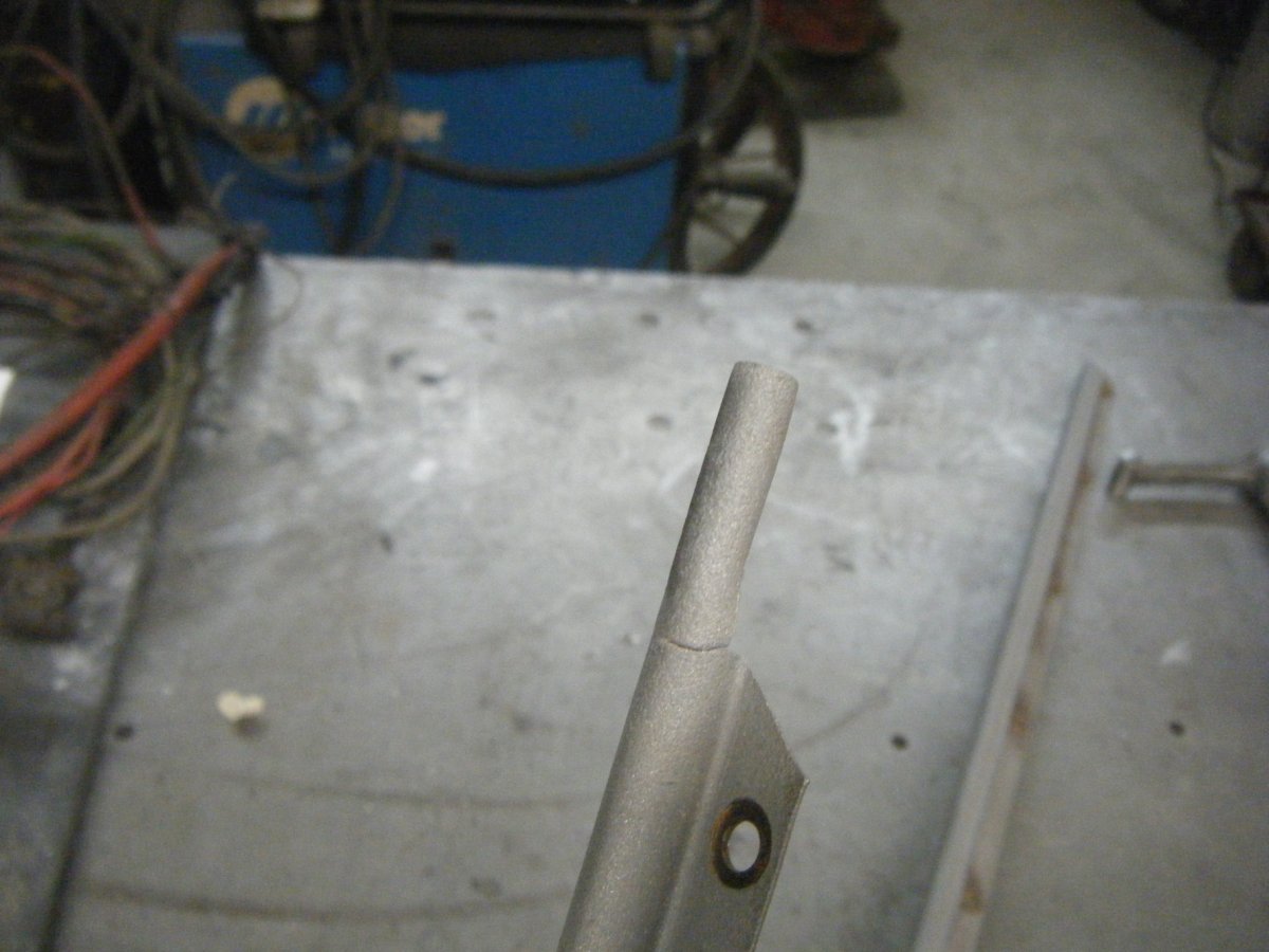

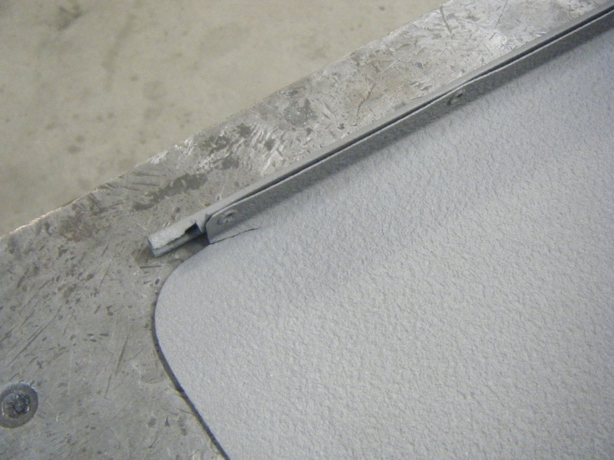

    started prepping the hood top for paint. one side of the hood top was pretty pitted, and had a crack at one end. i removed the hood hinges, then banged out a few dents. the hinge had a crack and also had a slight bow. DSCF0003.JPG DSCF0004.JPG DSCF0005.JPG DSCF0006.JPG DSCF0007.JPG DSCF0009.JPG

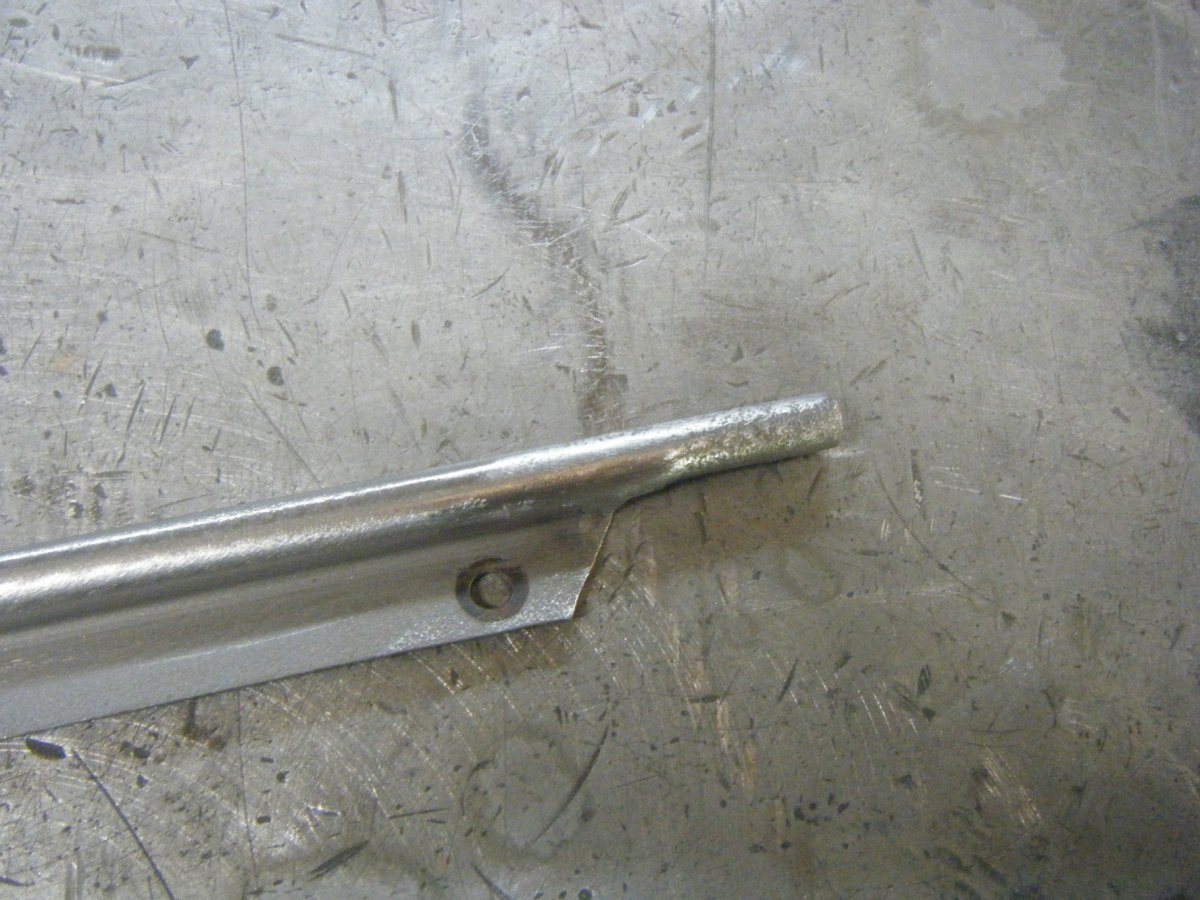

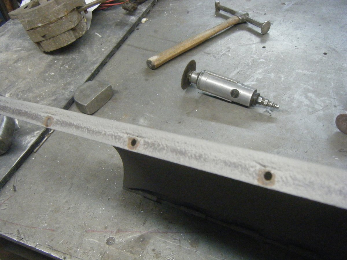

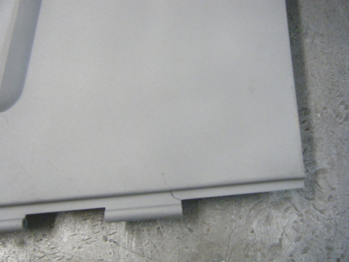

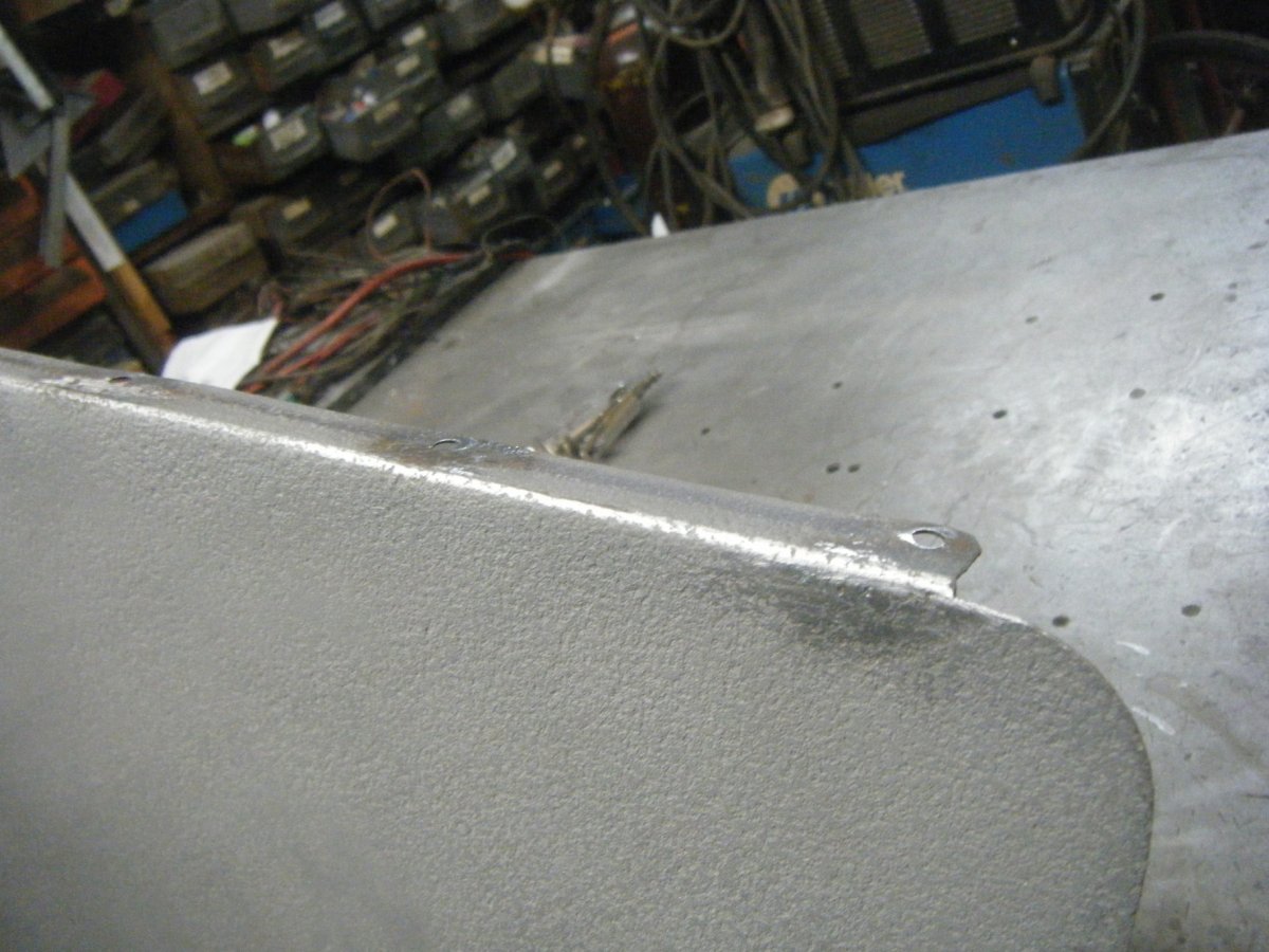

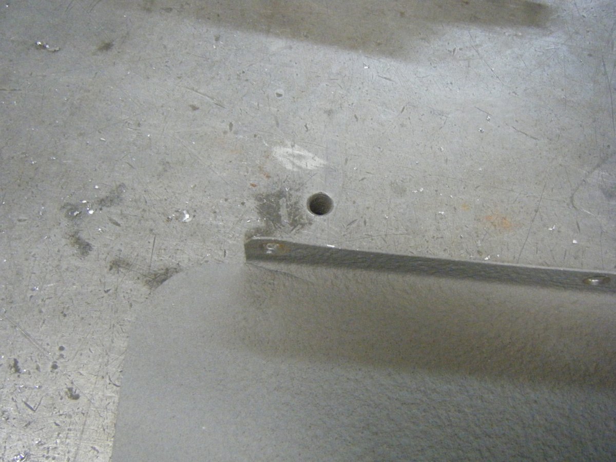

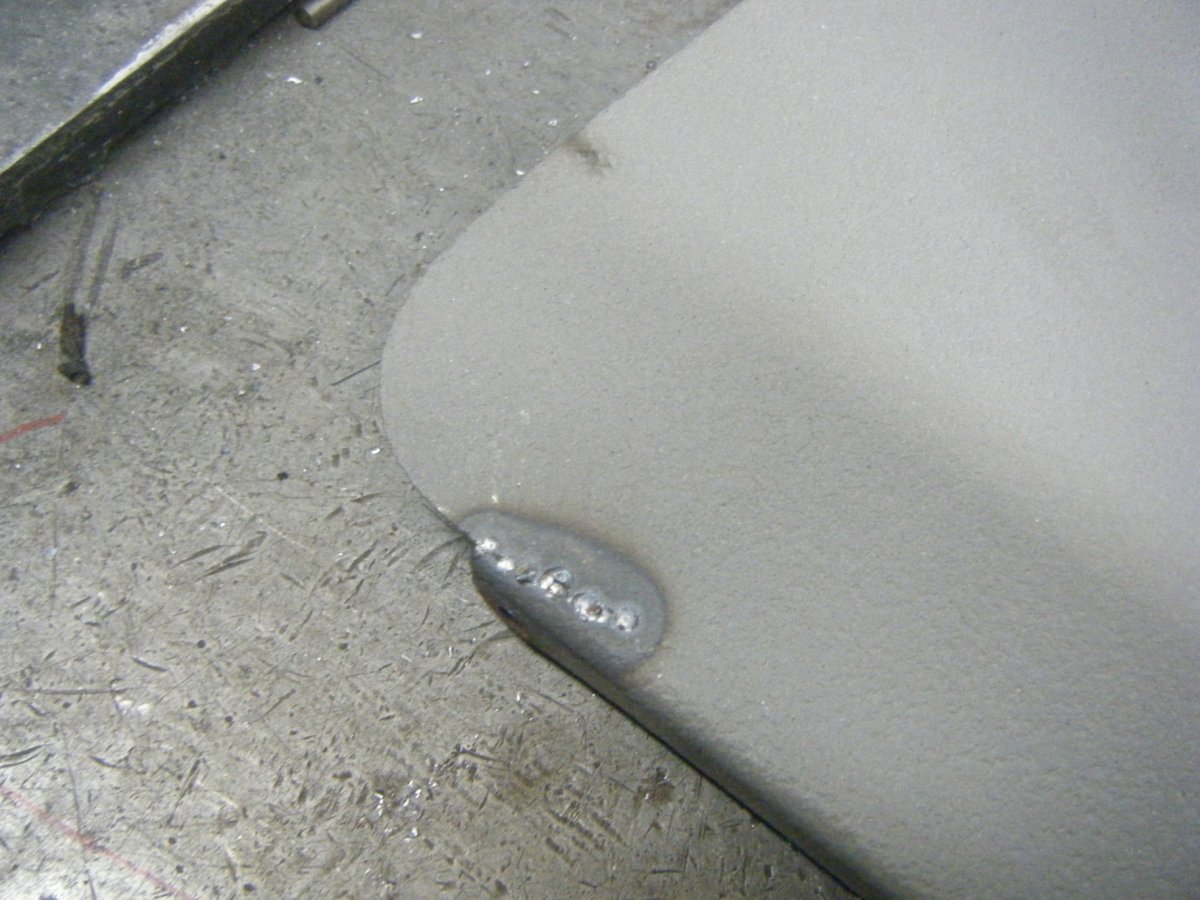

    i welded the hinge and used the shrinker to get it straight. when i took the hinges off, i noticed a few cracks in the hood side at the rivets . i welded these and hood crack up. then blasted the spots of rust that was between the hinges and the hood. ready for a skim coat to fill the pits and some primer.... DSCF0008.JPG DSCF0010.JPG DSCF0011.JPG DSCF0012.JPG DSCF0013.JPG DSCF0014.JPG DSCF0015.JPG

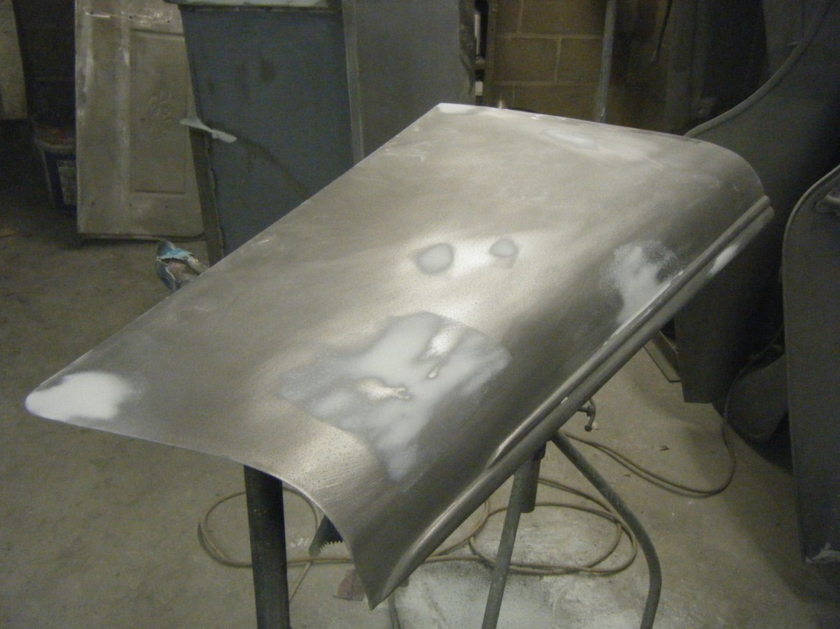

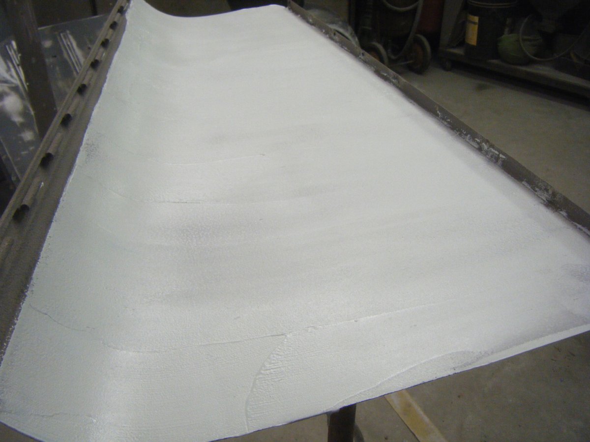

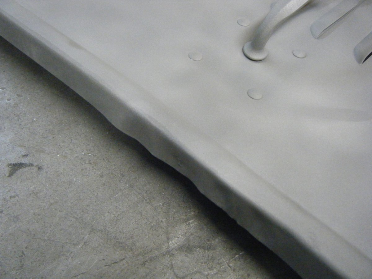

    i worked the dings out pretty well and primer would have probably filled them and the rust pits, but i would rather just fill them with plastic filler and get it done. filler cheaper than primer. the one hood top was pretty smooth but had the dings. the other side had no dings but was probably the most pitted hood i have ever fixed. i skimmed it with filler and will run the da over it. DSCF0001.JPG DSCF0002.JPG DSCF0003.JPG DSCF0004.JPG

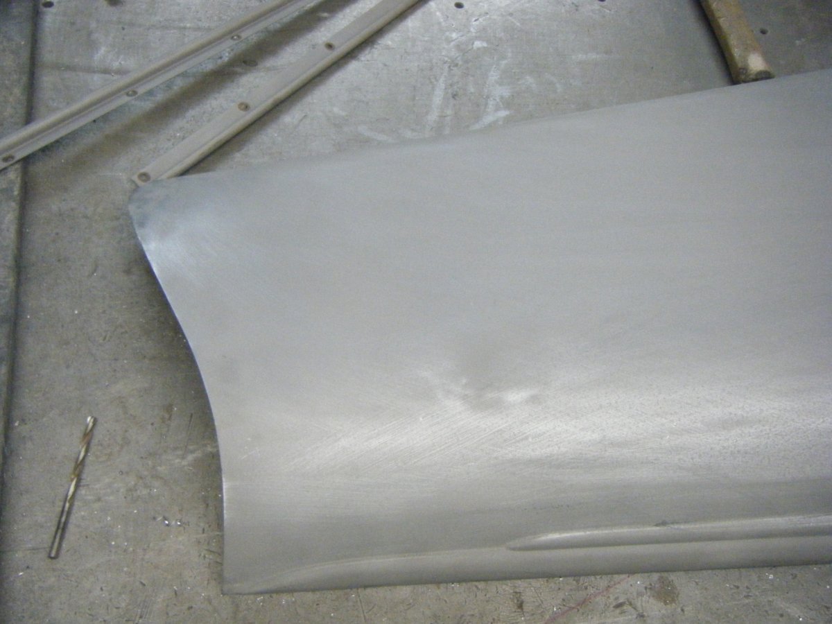

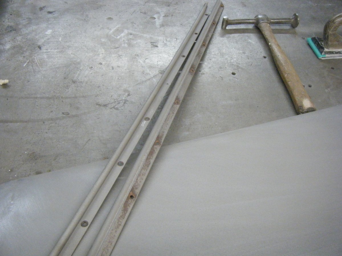

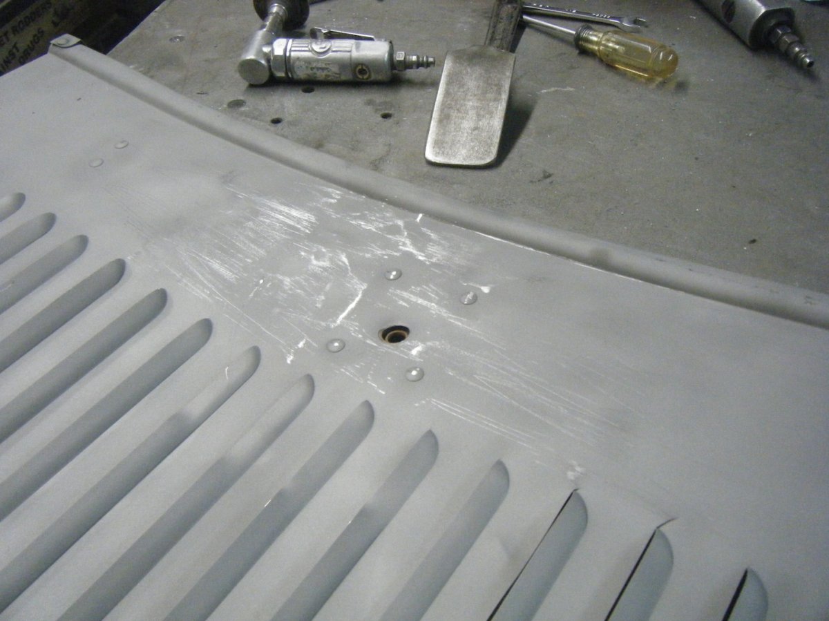

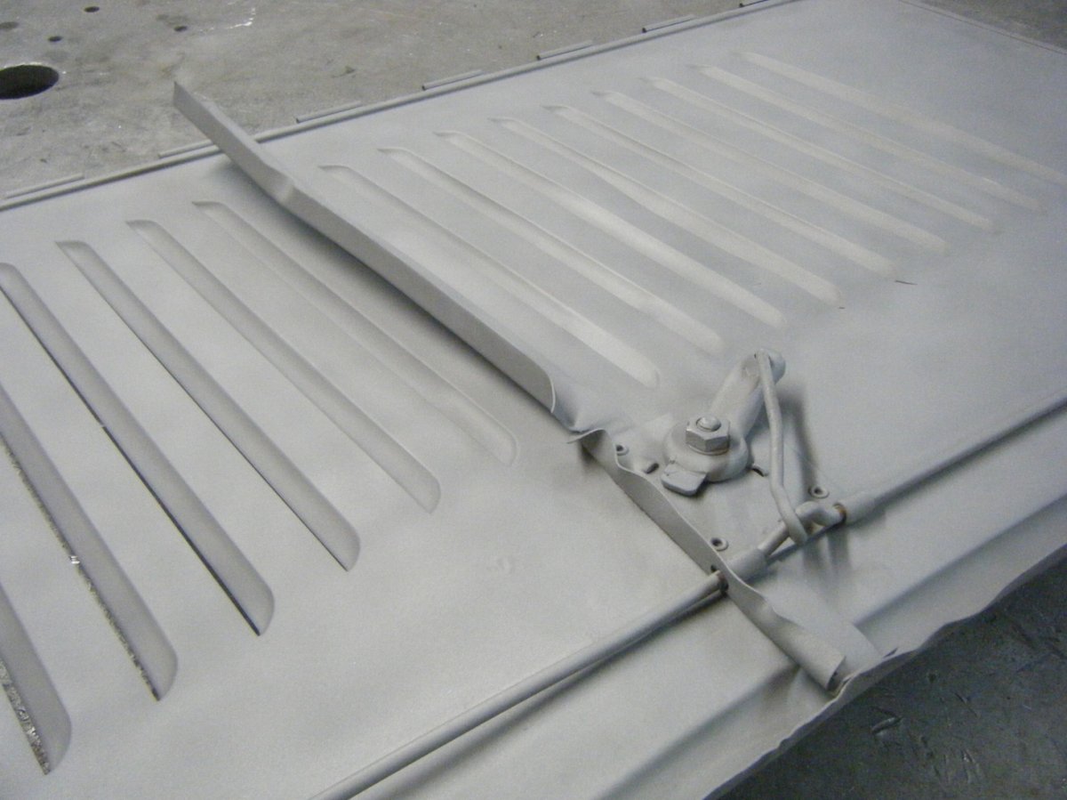

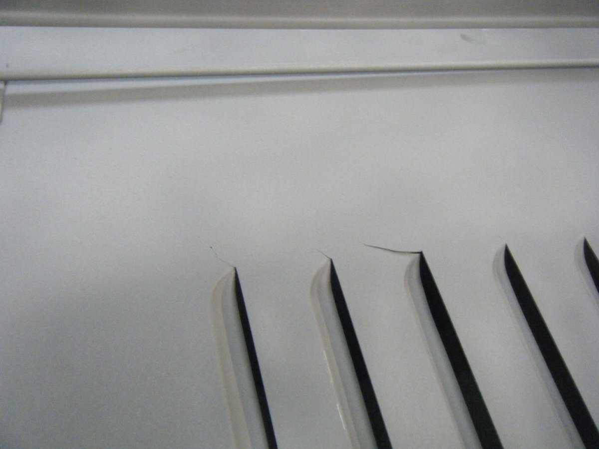

    while the filler was drying i took a look at the hood sides. the left side has a bunch of cracks and the center support was twisted. i straightened the brace. to get the bottom of it straight i will take the rivets out of the latch ***embly to get it out of the way. i ran the file over the panel to highlight the dents. DSCF0009.JPG

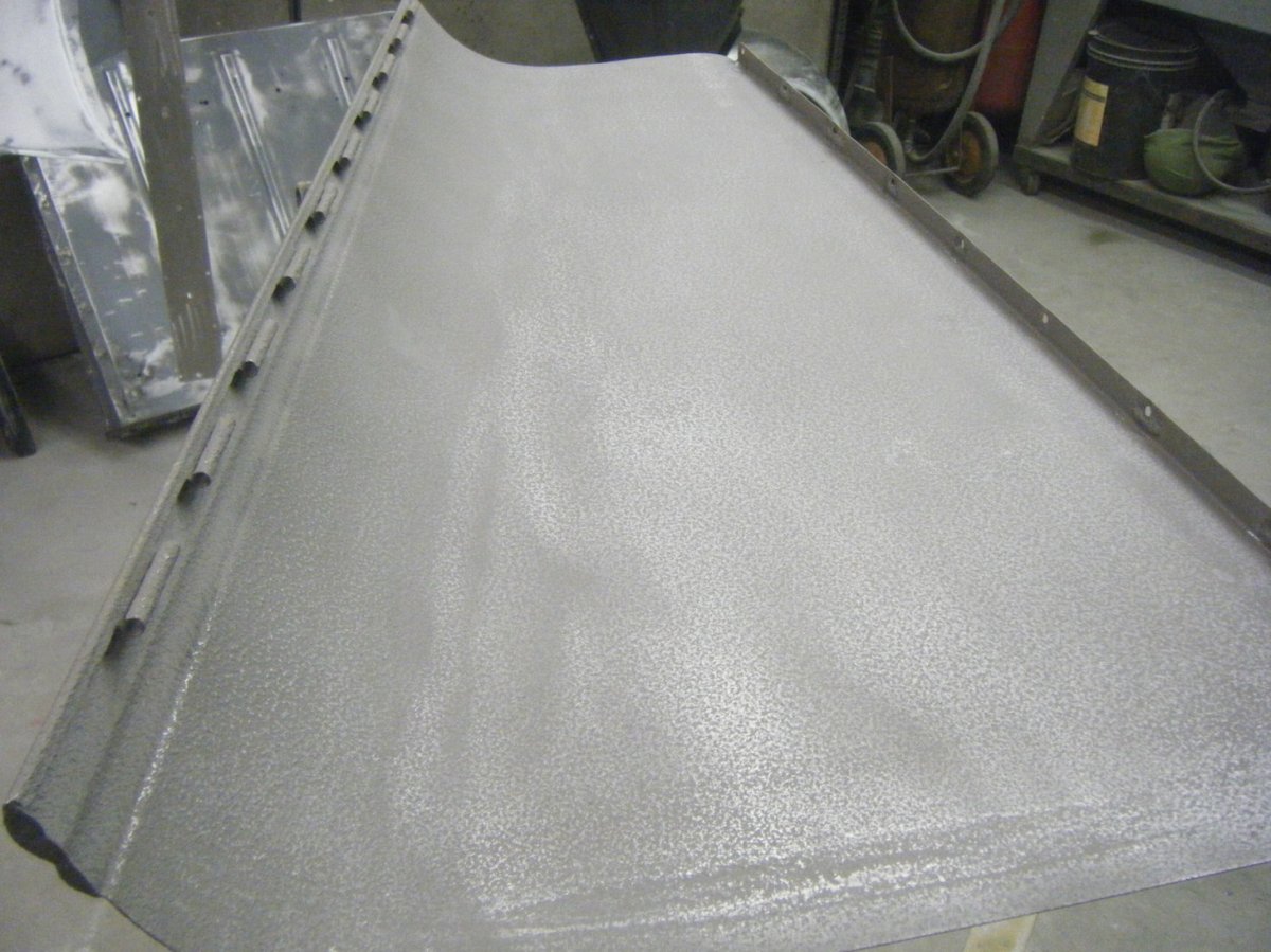

  25. nunattax
    Joined: Jan 10, 2011
    Posts: 3,389
    nunattax
    the hood side centre brace looks a bit lightweight.could you beef that area up by mounting another back to back..chevy used a more substantial brace on the 38 pu.locking linkage looks very similar
  26. nunattax
    Posts: 3,389
    nunattax
    my inner wings had similar cracking around the louvres.I drilled a small hole at the end of the crack before getting them welded back up.this made it much easier to close the crack before welding.
  27. tb33anda3rd
    Joined: Oct 8, 2010
    Posts: 17,583
    tb33anda3rd
    hah, i will use a black epoxy, over the filler, then a gray filler primer......this way if it ever gets scratched it will match the interior.:D
    i never thought about drilling and if i have a problem lining them up i will do that, thanks.

    i ate a box of purple peeps, sanded this in about 15 minutes.:D DSCF0008.JPG DSCF0009.JPG
