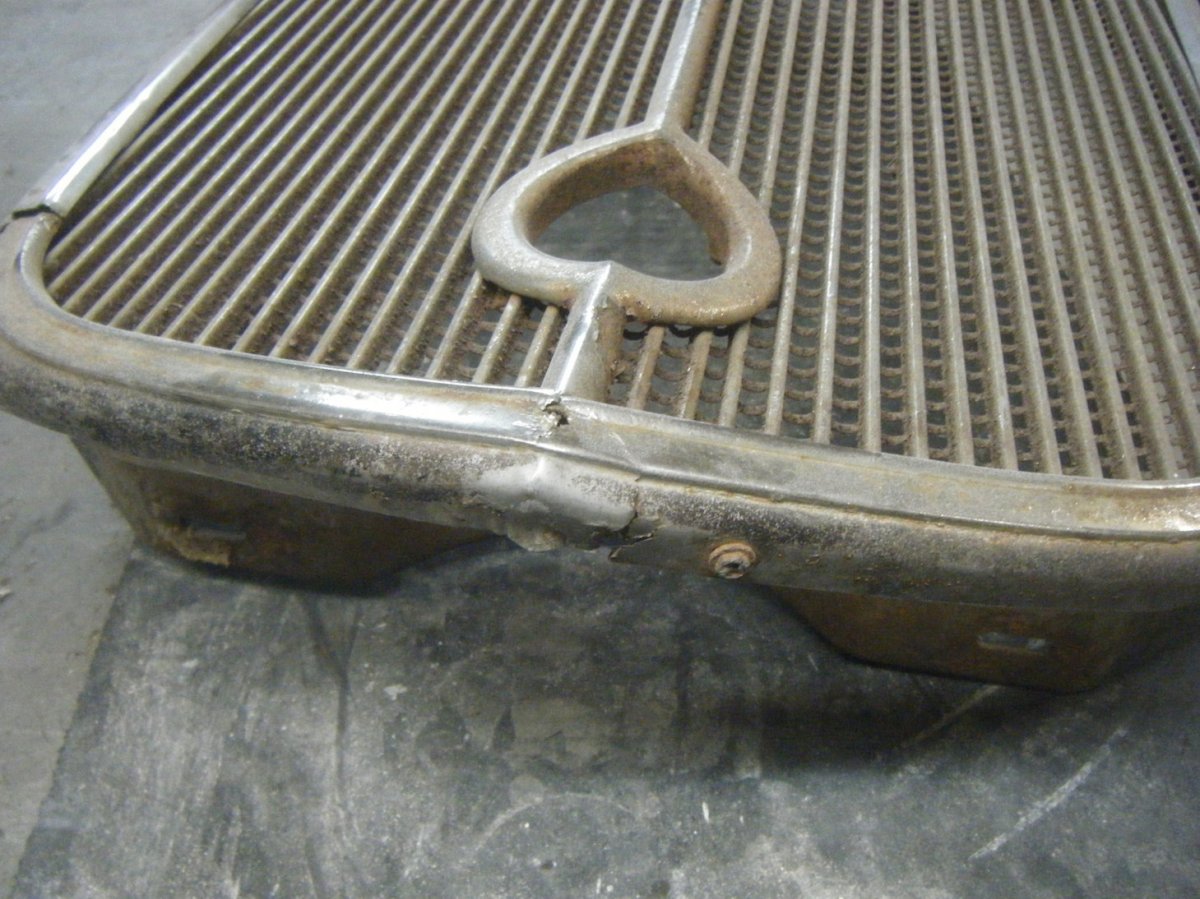

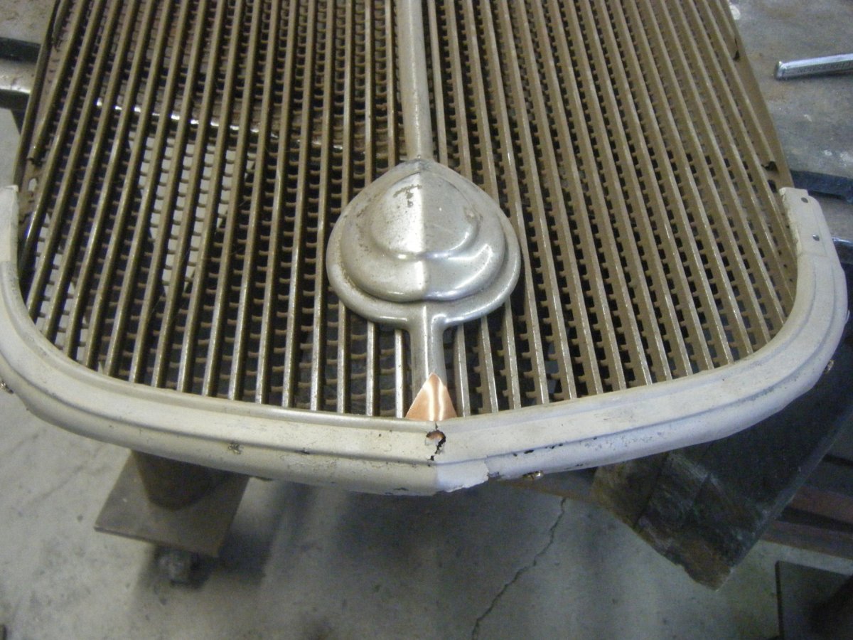

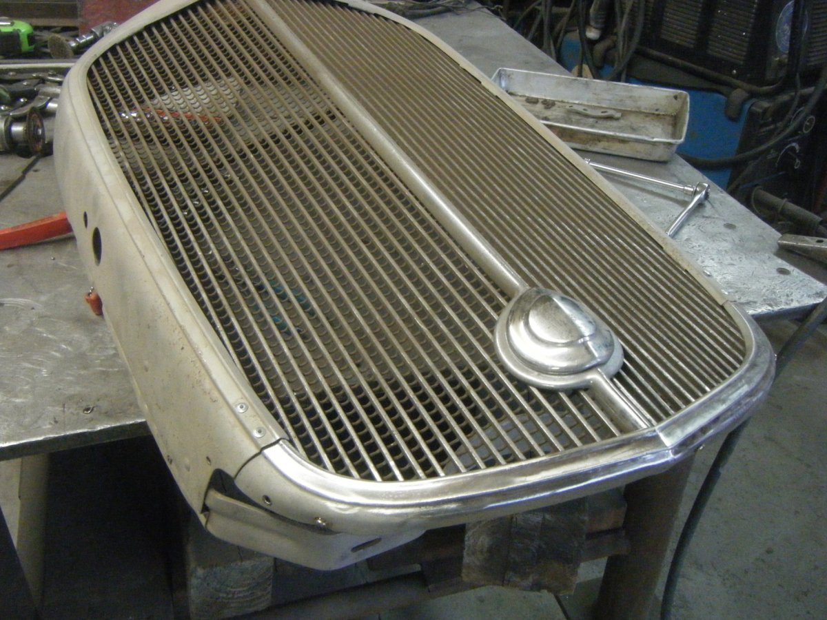

    decided to get the grill shell ready to chrome. chrome is not going to get any cheaper so i will invest the money now. to hell with the kids college fund. :D;):cool:
    i was able to get all the nuts and bolts out except one without breaking it. this hole is small but i was able to drill it out and get the 6-32 tap to clean out the threads. DSCF0003.JPG DSCF0004.JPG DSCF0005.JPG DSCF0006.JPG

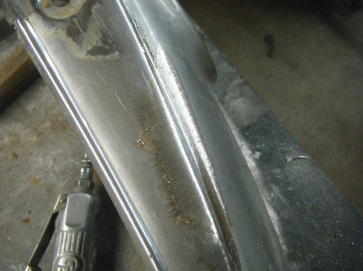

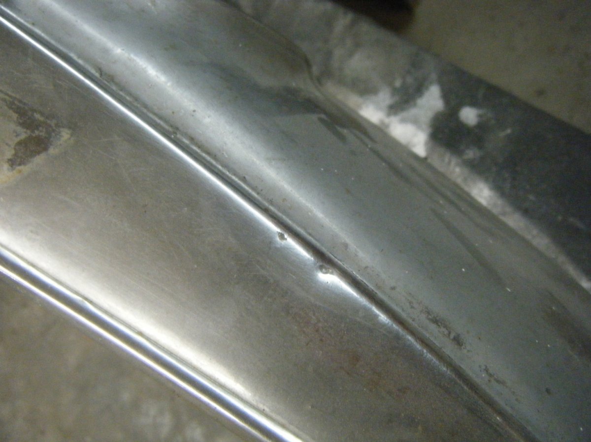

    there was also a couple little dings in the shell, right where it gets chromed. i tapped out the dents and polished it up. next step will be sand blasting and fixing that bottom "chin" piece. DSCF0007.JPG

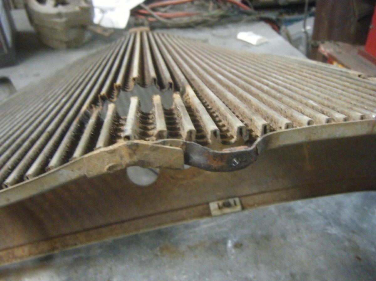

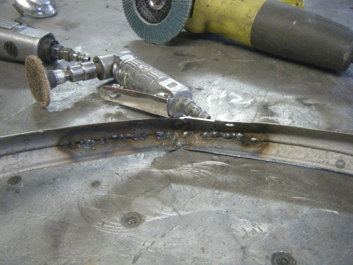

    after blasting the lower piece was pretty rotted, had a bunch of holes. welded them up with it screwed to the other grill insert i had that was nice and straight. then took it off to "polish" it up. not perfect but with the right chrome plater it will look fine. DSCF0006.JPG DSCF0001.JPG

    here's the back side DSCF0002.JPG DSCF0003.JPG and also a photo of it fitted back together.

    Nice work! The more you do the less the bill will be from the plater.

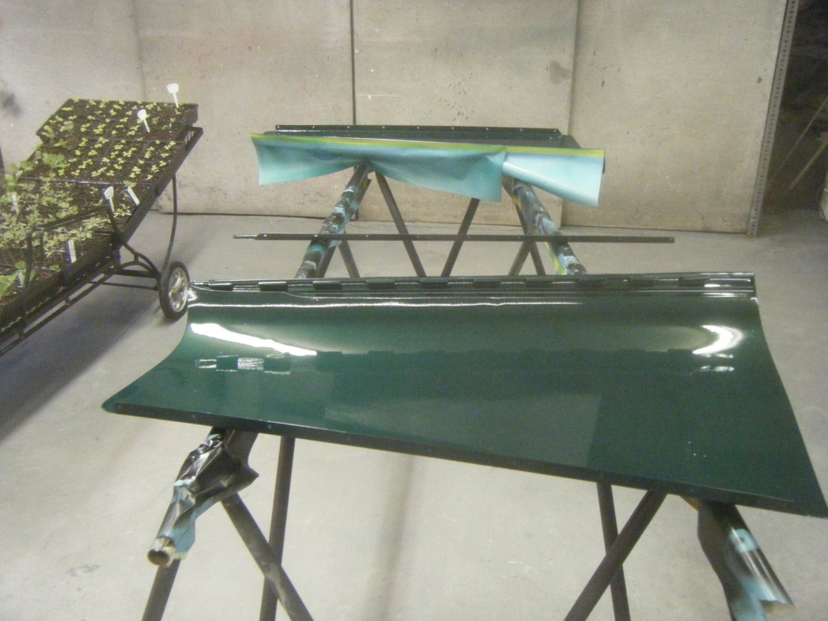

    sanded, prepped and sealed the hood. then i painted the under side. DSCF0002.JPG

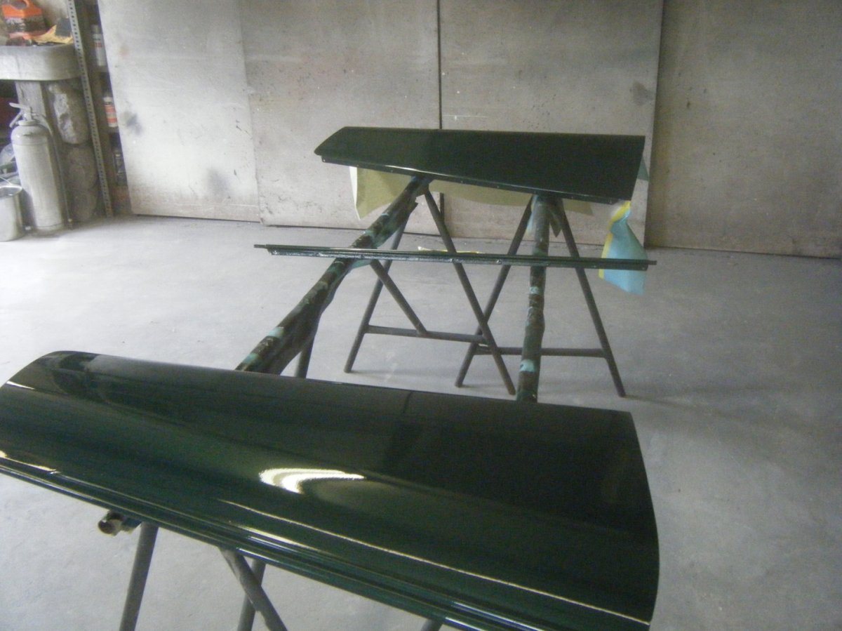

    hood is painted!
    Frank, this is what i got done while we were on the phone.:);) DSCF0001.JPG
