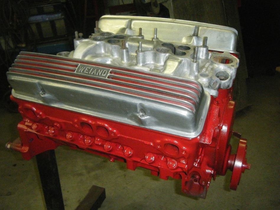

    i wish i could use these valve covers but they are for the staggered bolt hole heads.

    I agree those valve covers are nice! Like the red:cool: It will match the rims:rolleyes:

    i guess if i make a spacer plate with countersunk lower screws to hold it to the head and studs sticking up to hold down the covers. has anyone done this?

    There are adapters to use early valve covers on late heads but I don't know who has them...

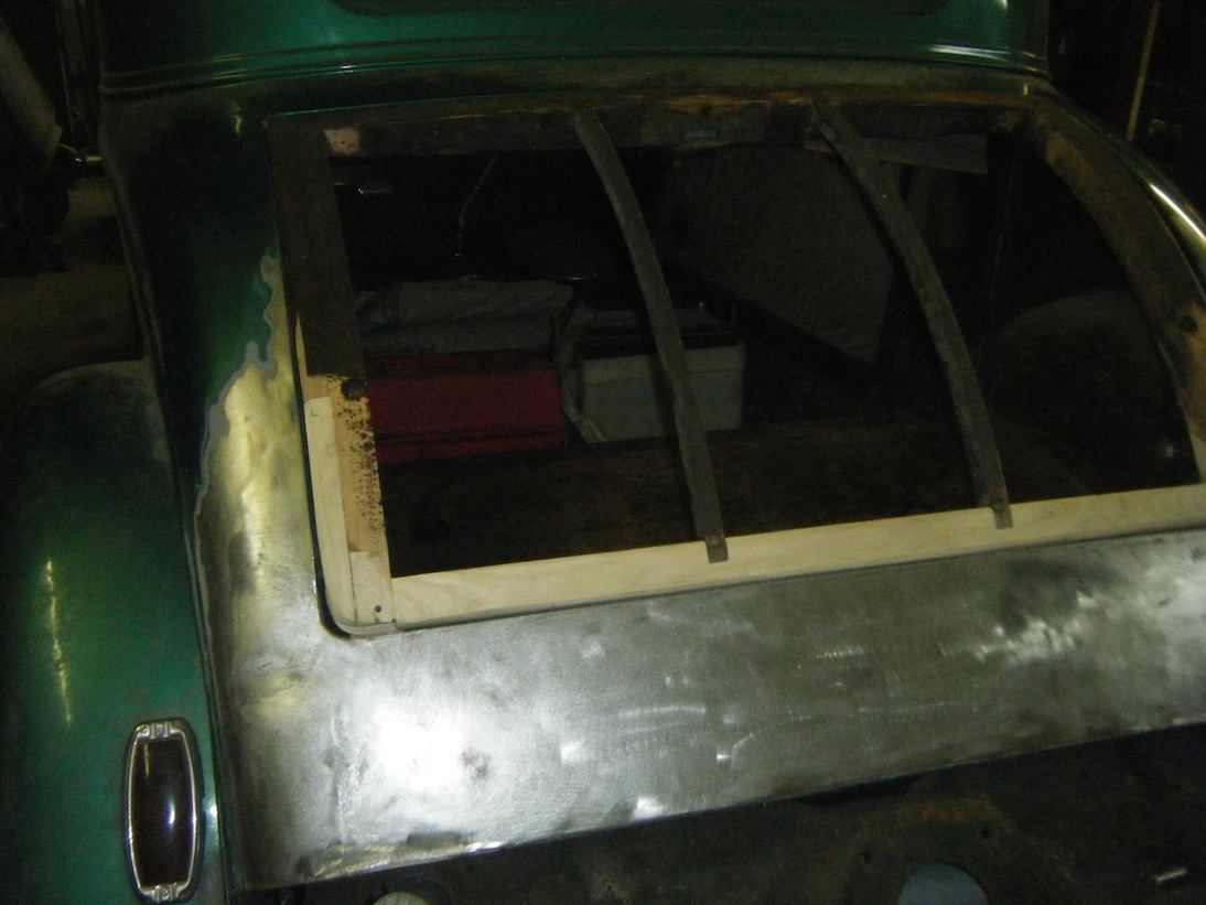

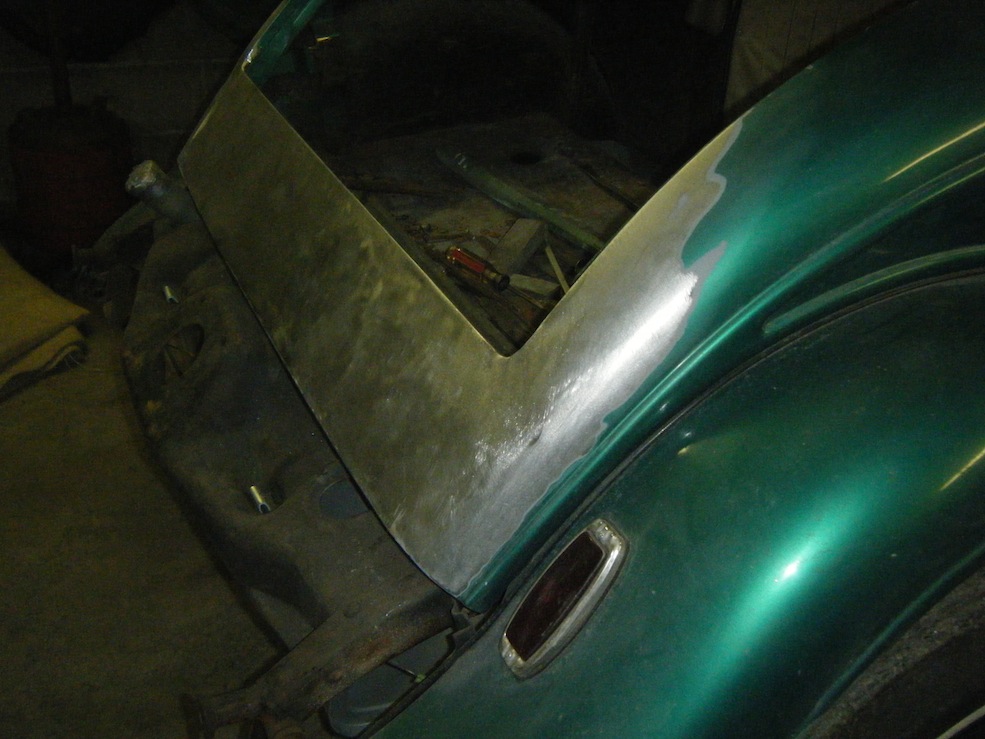

  24. tb33anda3rd
    Joined: Oct 8, 2010
    Posts: 17,584
    tb33anda3rd

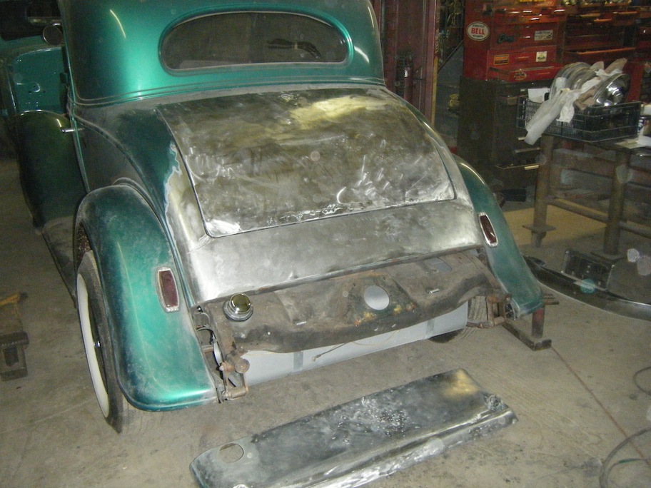

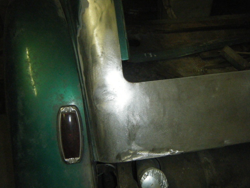

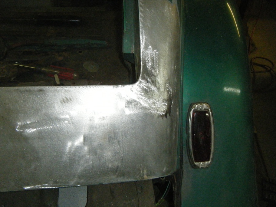

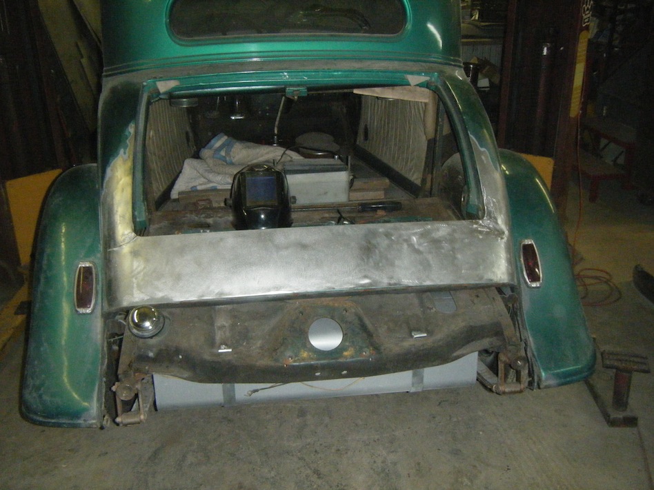

    stripped the rumble lid and back of the car to repair some dents, cracks, and adjust the fit on the lid. both sides of the opening had cracks that needed to be welded. i had had these welded when i had the car painted, then they cracked again, i had them welded again but they still split. with the rumble lid off i realized there was a broken support along the panel below the opening and after i removed it, i found that both rear body bolts were missing:eek:. i could pry the body off the frame. so i checked the rest of the body bolts....out of the ten that should be there i found four:eek::confused: the two on the sill at the middle of the door and the two at the firewall. my dad nor i have any idea where they went or how long they have been missing. the two rear ones were tarred over so they were not there when my dad built it. i think this extra stress is what cracked the metal.
    ct1932ford and volvobrynk like this.
  25. tb33anda3rd
    Joined: Oct 8, 2010
    Posts: 17,584
    tb33anda3rd

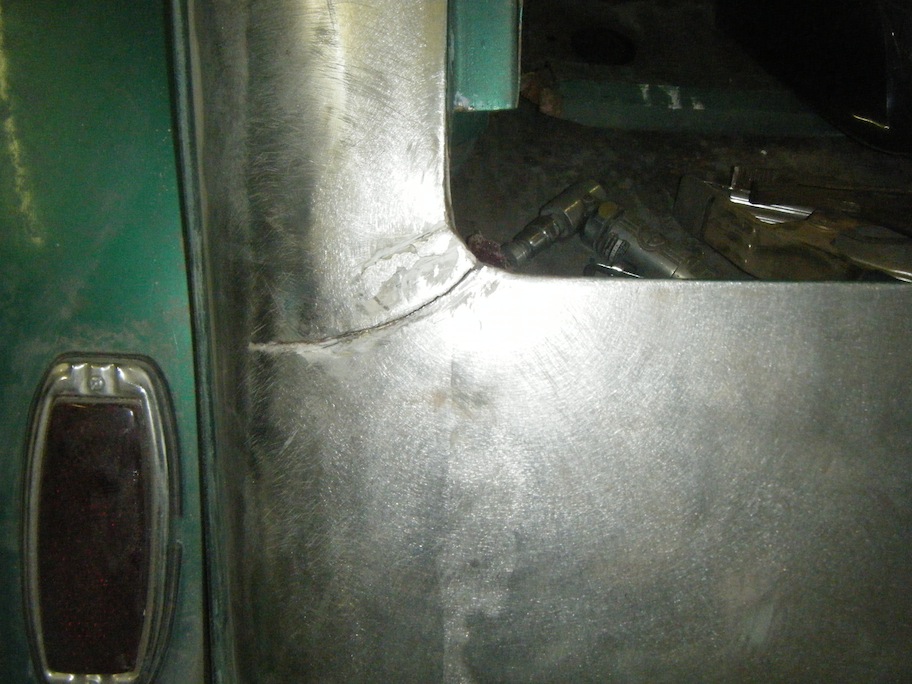

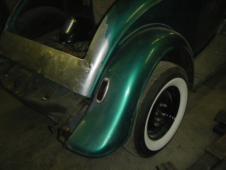

    i did not have the camera before i fixed the p***enger side so i only have an after shot of that side. driver side before and after.
    ct1932ford, scott27 and volvobrynk like this.

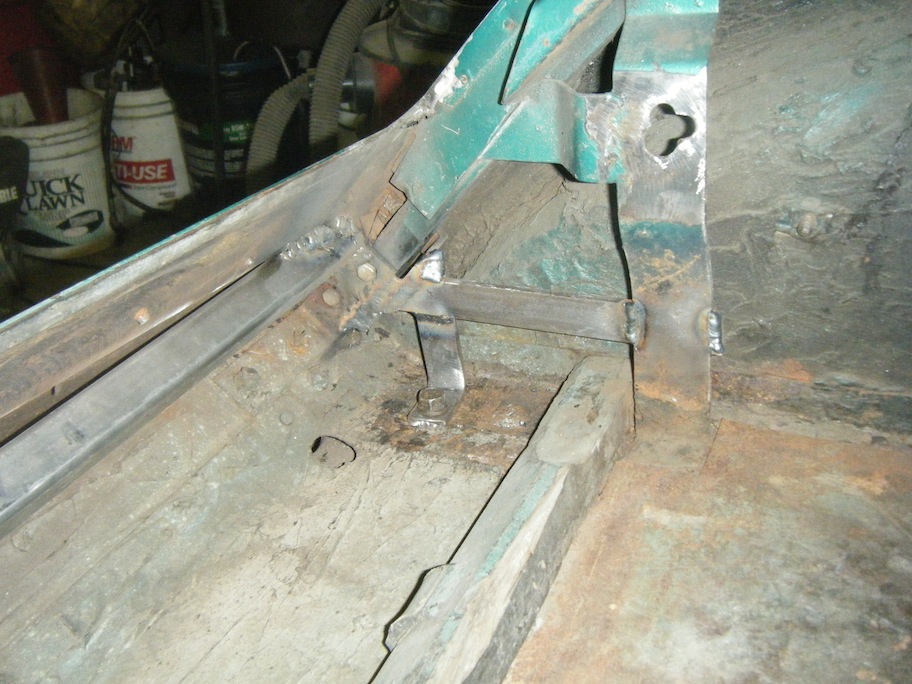

  26. tb33anda3rd
    Joined: Oct 8, 2010
    Posts: 17,584
    tb33anda3rd

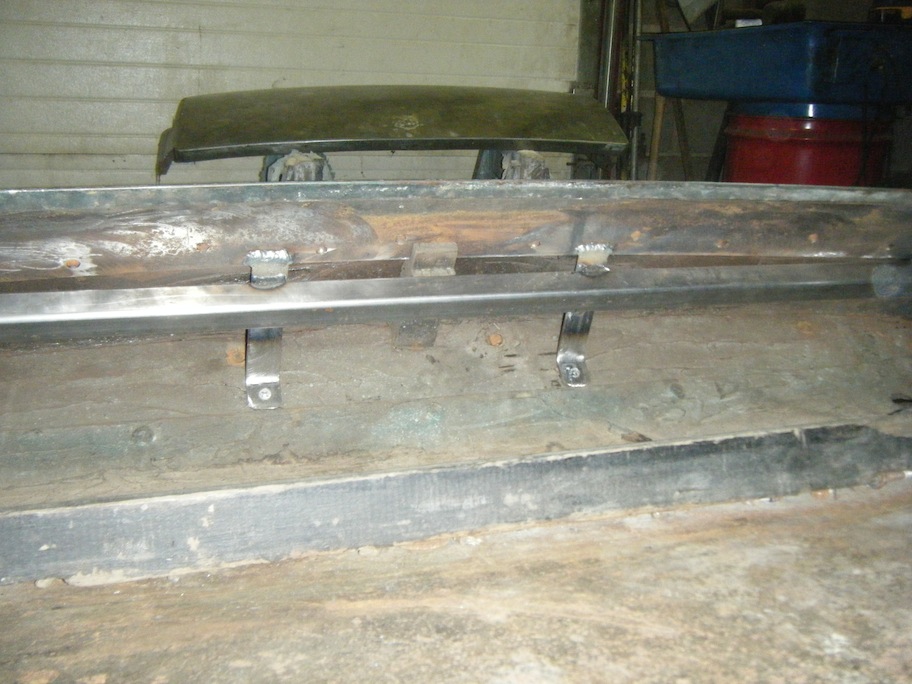

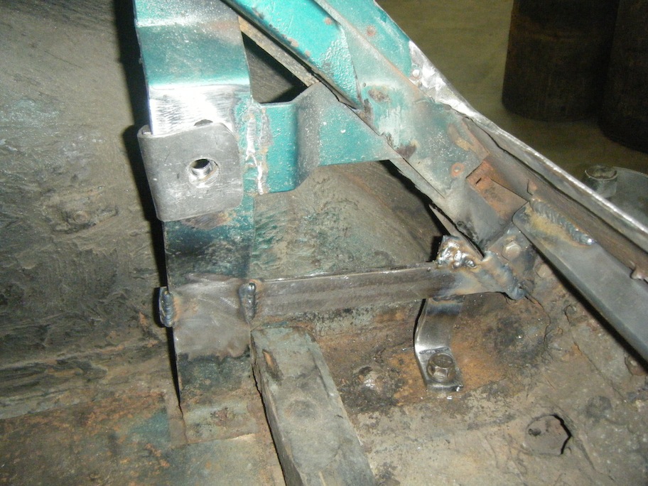

    i decided to replace the broken, wood, cross brace, that ran below the deck lid. it supported the panel and held the shape of the back of the car. when chevy built it they started with the wood cross brace then screwed a sheet metal panel to it, then they wrapped the outer panel around that along the top edge and welded it to the quarter panels. the wood broke into lots of pieces and i was left with the inner panel with screws sticking out. i cut the screw off and ground them flat.
    since i would have to cut the back of the car apart to fasten a replica piece of wood in, it was better to use a piece of steel tubing. this would allow me tie the metal hinge braces, the steel angles that connect the quarter panel and the body mount together.
  27. tb33anda3rd
    Joined: Oct 8, 2010
    Posts: 17,584
    tb33anda3rd

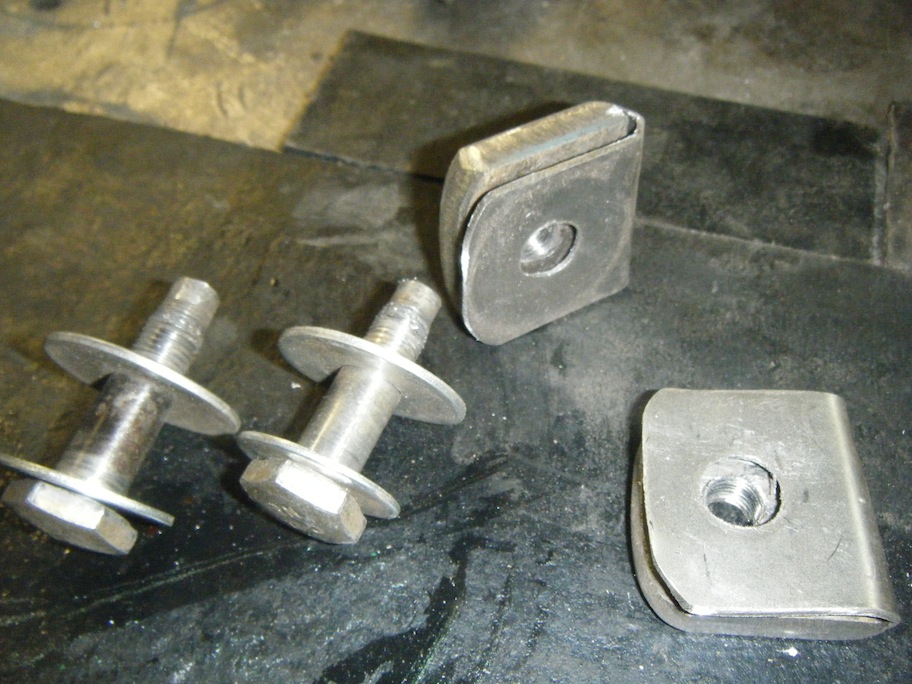

    i then made a set of "fender nuts" to attach the deck lid. the square trap nuts had broke a long time ago and was part of the reason the deck lid never fit or worked right. these allowed me to make adjustments but lock tight. i installed just the wood rumble lid frame using the shoulder bolts and it opens and closes nicely. now i just have to refit the skin and do a final adjustment

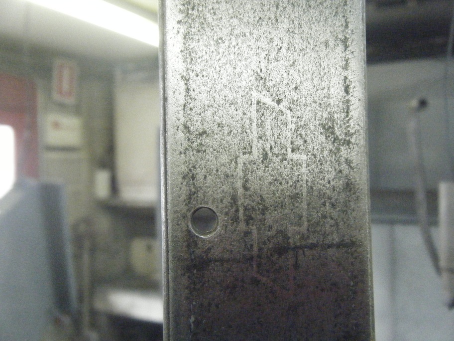

    we also pulled off the bumpers and took them apart to paint the brackets. i have worked on a bunch of chevies but never noticed the bow ties embossed into the bumper braces. probably because normally i sand blast them but these i just sanded.
