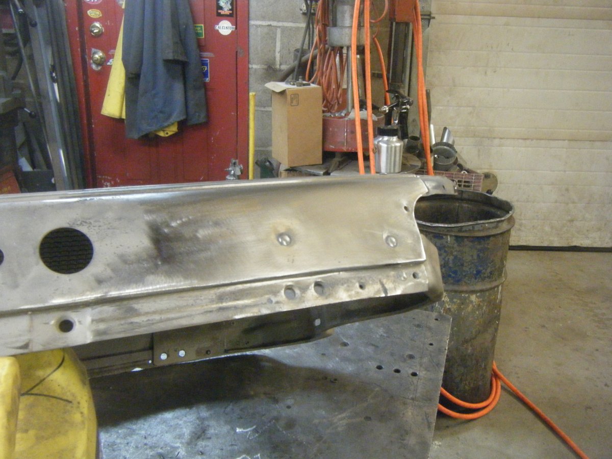

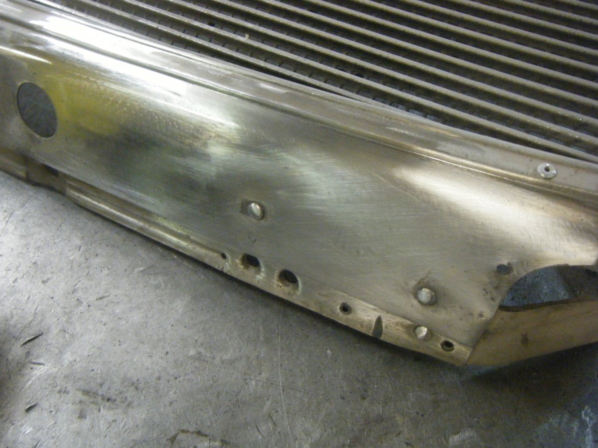

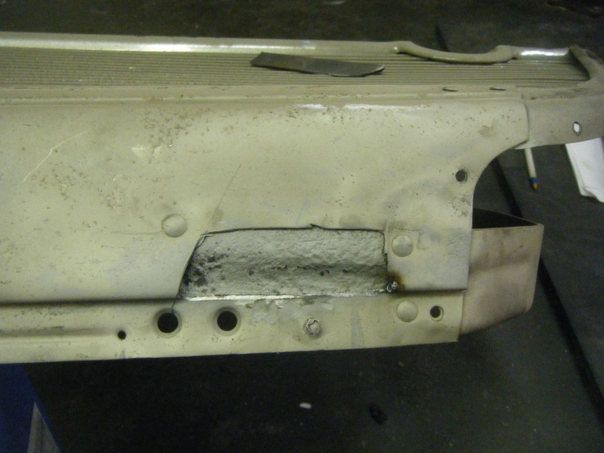

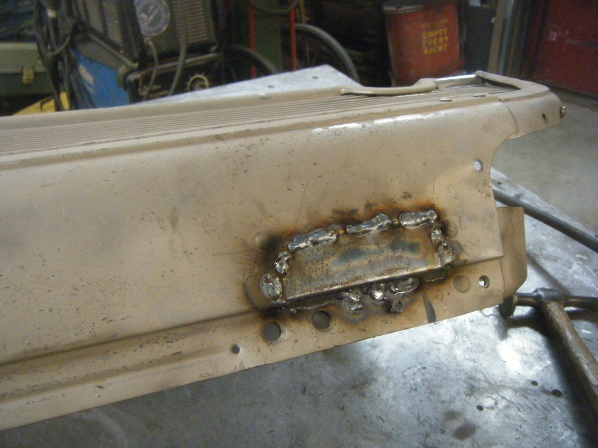

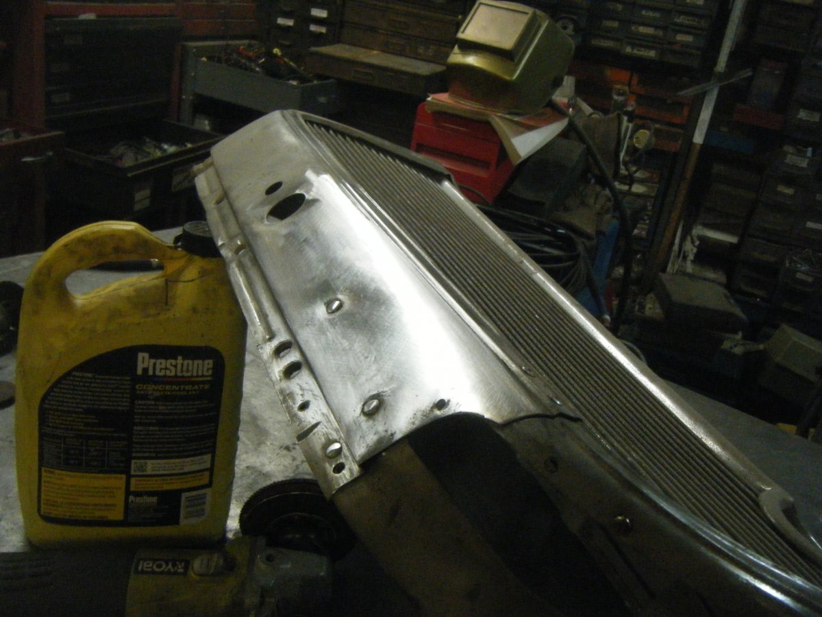

    i have been picking away at getting the grill shell ready for chrome plating. i saw a small pin hole in the lower corner and opened it up. i kept cutting till the rot on the back side was gone. i then made a patch, welded it in and polished it smooth. DSCF0005.JPG DSCF0001.JPG DSCF0002.JPG DSCF0003.JPG DSCF0004.JPG
  4. Nice work!
    Stogy and tb33anda3rd like this.
  5. TFoch
    Joined: Mar 31, 2010
    Posts: 2,389
    TFoch
    Looks great, just like it disappeared!

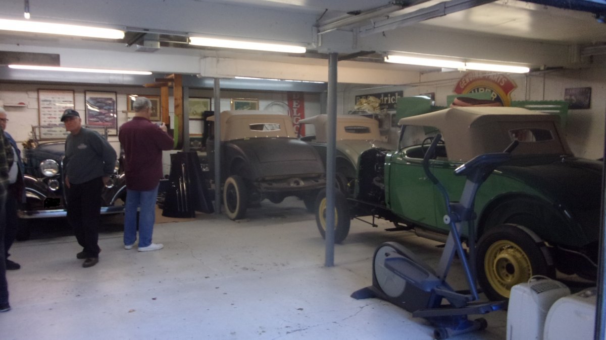

    Hey Ted, I just now missed a phone call from the guy who owns all those 33-34 Chevy roadsters/conv. He is hosting all the 33/34 guys from Cal and Washington again as part of their annual Hershey get-together. Anyways, he called to see if I would let the whole tribe come look at my cars around OCT 5/6..
    playing phone tag this moment, but I will get you two 33 Chevy freaks hooked up by phone before Hershey. You just got to get up to his place at some point. I can't tell you what I felt as I saw these roadsters lined up in that big place. Nice guy, too.

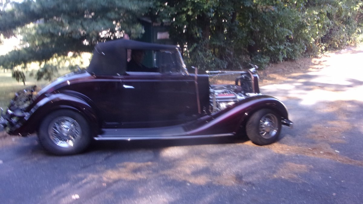

    a screen shot from an old video of the car racing at dover drag strip. Screen Shot 2018-12-07 at 9.53.51 PM.png

    Love the white walls!
