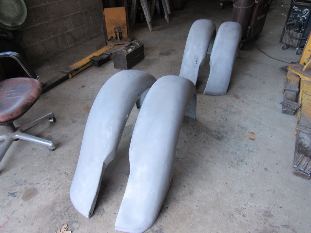

    all four fenders back from blasting. Wayne's fenders need a couple small spots welded that the sand blasting revealed. IMG_9827.JPG

    I remember buying cars for what it cost to get fenders blasted today.
    Bob
  19. tb33anda3rd
    Joined: Oct 8, 2010
    Posts: 17,583
    tb33anda3rd
    me too, these were $78 each and they charged $50 to pick up and deliver.
