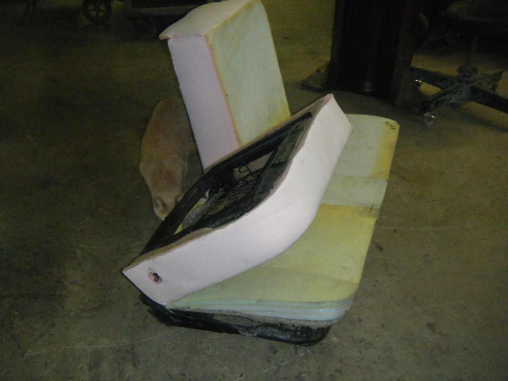

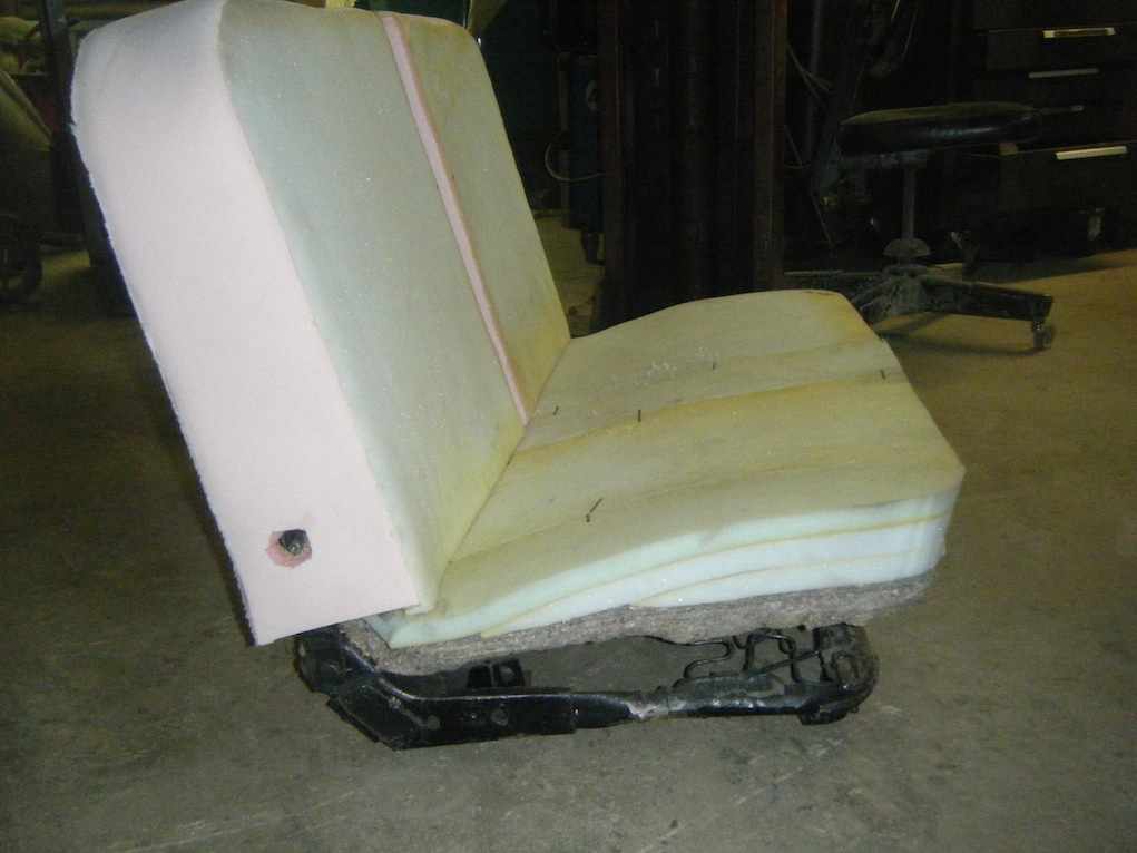

    been working on little things, just have not posted. got the seat back from the upholsters [cl***ic upholstery in danbury] he made up the foam padding for me to fit. i tested the seat out and it is comfortable, i just need to put it in the car to make the mounting brackets. i asked him to make the front higher so he layered the foam. i think it looks a lot like the austin seats but they fold forward:D

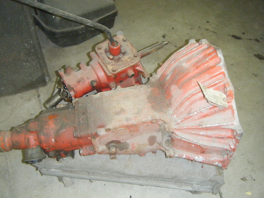

    we have also been measuring up for the ****** conversion. the ****** that my dad and uncle put together is a non syncro 3 speed with a 37 chevy truck shifter welded to it to make a top shifter. he remembers cutting the top off with a hack saw, taking turns when they tired. then my uncle torch welded it together.
    we are planning to do the same thing using a full syncro '63 chevy 3 speed/od that i picked up many years ago at a swop meet. i found a '37 truck ****** to cut the shifter off of.

    another picture of the two ******s

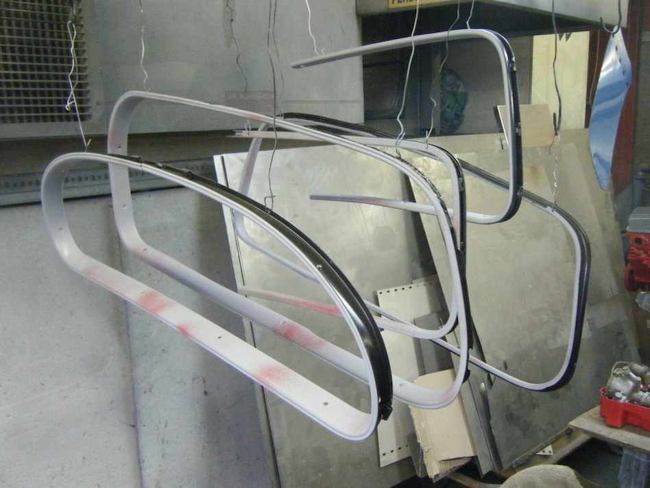

    we have been working on a bunch of little stuff; sandblasted and primed the garnish moldings. took the bumpers apart and painted the braces. we also removed the floorboards, put all new body mounts in and replaced all the missing bolts. we took out the braces holding the front door hinge posts, toe board supports and floor fillers and sand blasted them, then primed and painted them. put them back in, replaced all the screws and tightened it all up.

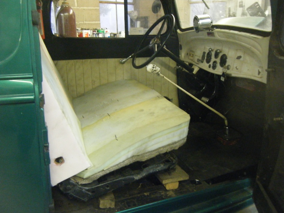

    now that the body is bolted down tight, i put the seat in and blocked it up. i bolted a couple seat sliders on so it will move forward and back but it won't raise or lower. my dad and i are the same size so i put it where it is comfortable for me and he will check it out in the morning. once i get the measurements i will make the risers.

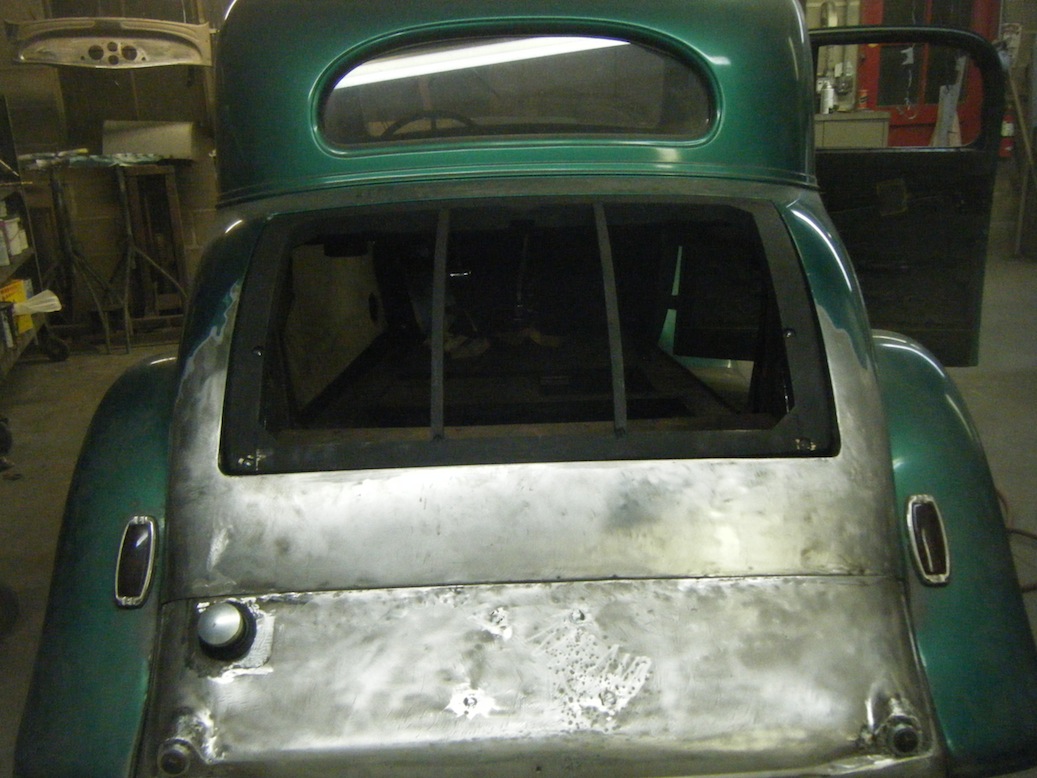

    wood for the deck lid is all sanded, painted and put back on. i also did the final fitting of the rear panel. when i fixed the rear body mount it raised the tail of the car, so the fuel filler hole needed to be welded back up and moved down:( now that it fits and the body lines are good i will take it back off and finish the bodywork and paint the underside.
