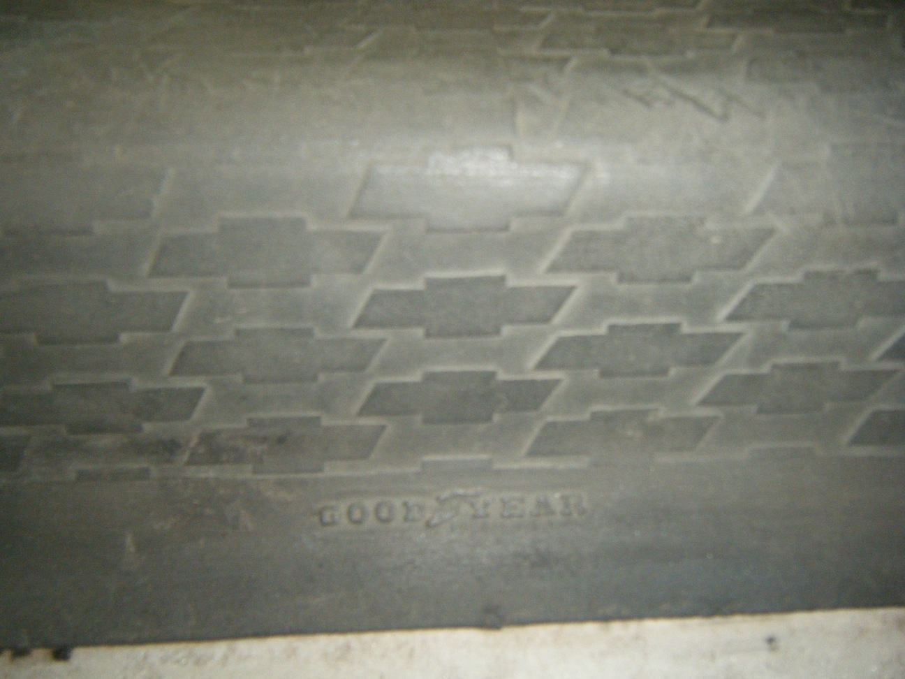

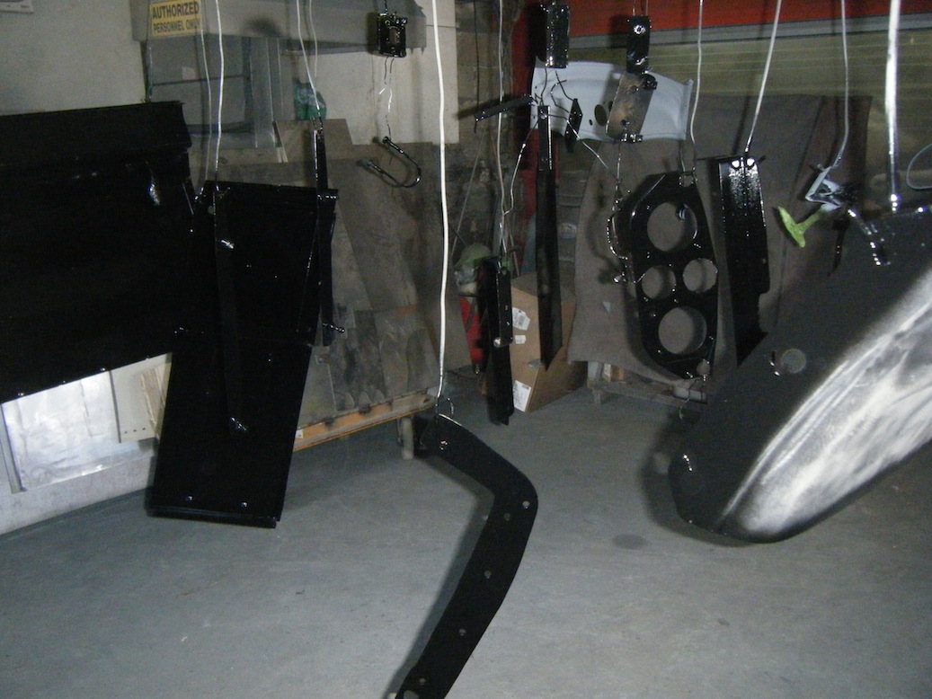

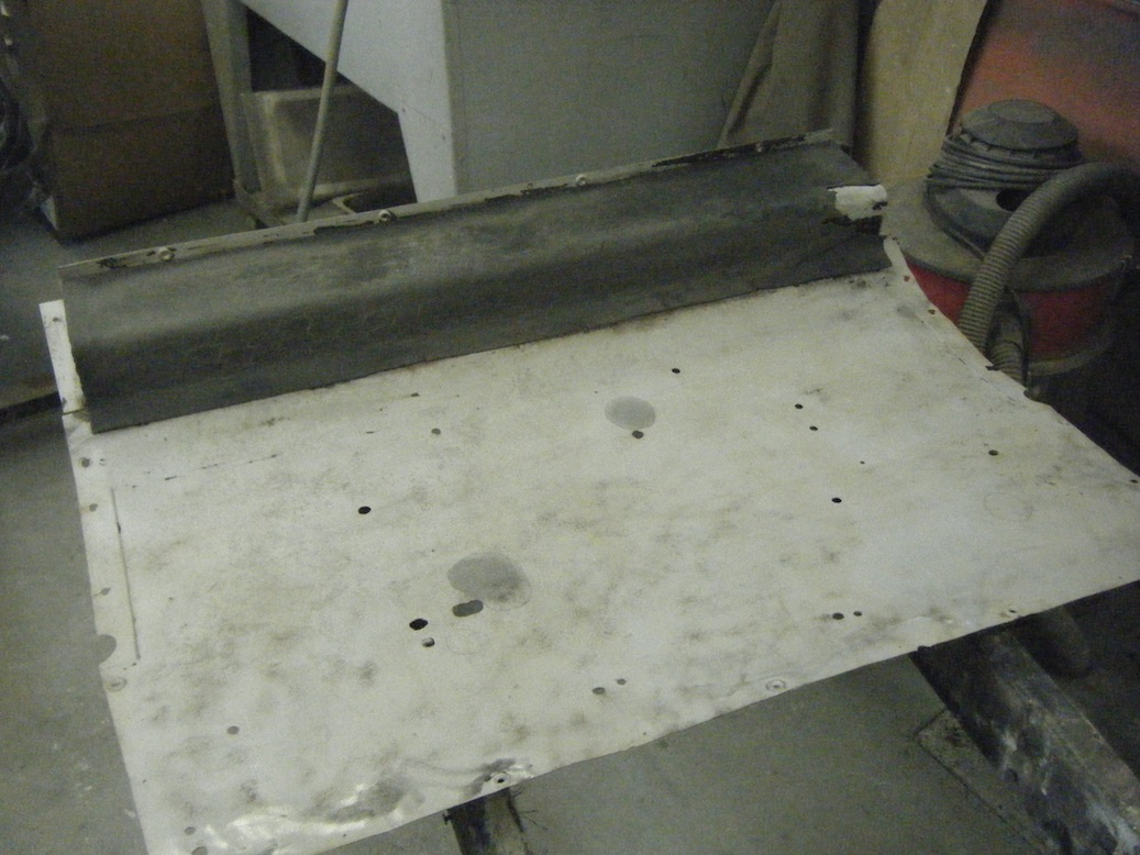

    while i was doing that dad was removing the metal floorpan that extends from under the front seat to the rumble footwell. the panel had a few extra holes from previous seat mounts , seat belts and the battery box and cables. i sand blasted it and will weld it up tomorrow.

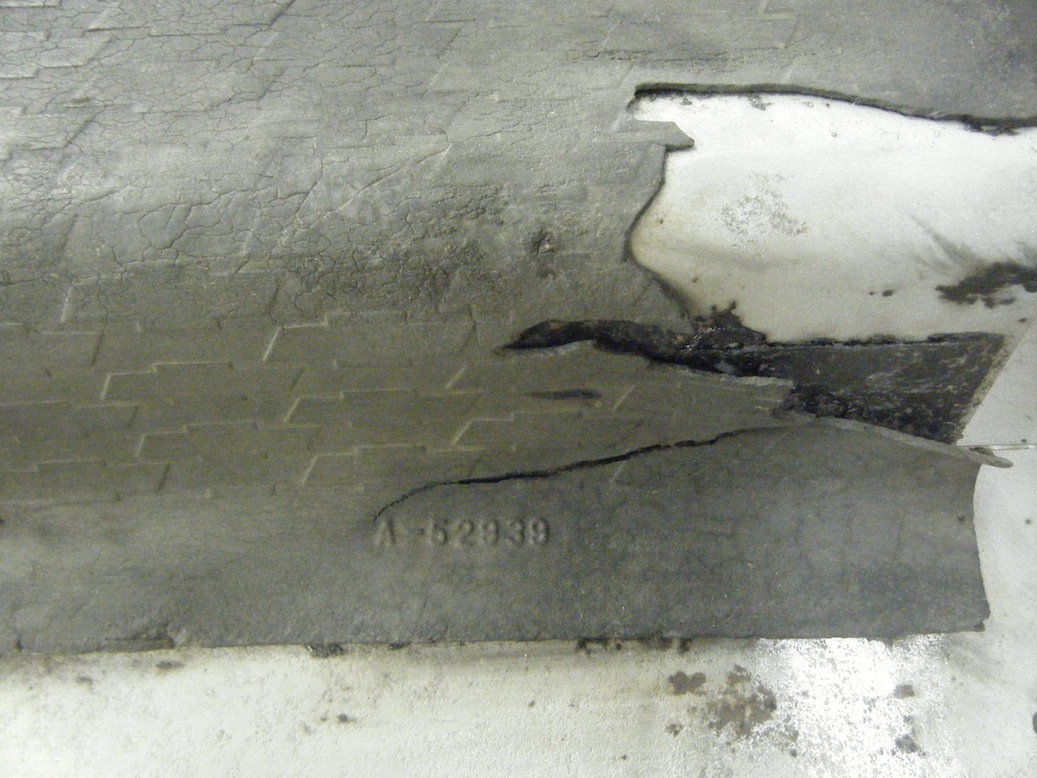

    i wanted to keep the cool rubber mat that the factory glued over the hump. check out the bowties:)

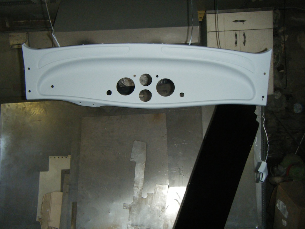

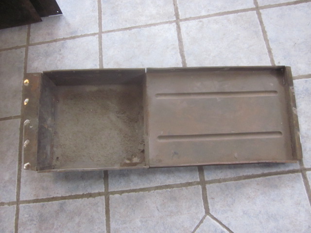

    dash board is out and blasted. my plan is to swop the original amp gauge to a volt gauge and install a 12v fuel gauge where the original one is.
    i built the seat risers using some recycled 2" angle iron from a movie theatre that was being updated.

  3. TFoch
    Joined: Mar 31, 2010
    Posts: 2,389
    TFoch
    Nice work! Didn't have the floors when I got mine. Love the Goodyear Floor Mat
  4. tb33anda3rd
    Joined: Oct 8, 2010
    Posts: 17,583
    tb33anda3rd
    thanks.
    the floor mat is one of those things that needs to stay, despite it's flaws. i blasted around it and cleaned under the edges. i just can't decide to paint over the mat or tape it off. i think the paint would help preserve it. any thoughts?

  10. TFoch
    Posts: 2,389
    TFoch
    I think any way you can preserve it would be best. I like seeing original stuff like that on the car even if it has some flaws.

  13. tb33anda3rd
    Joined: Oct 8, 2010
    Posts: 17,583
    tb33anda3rd

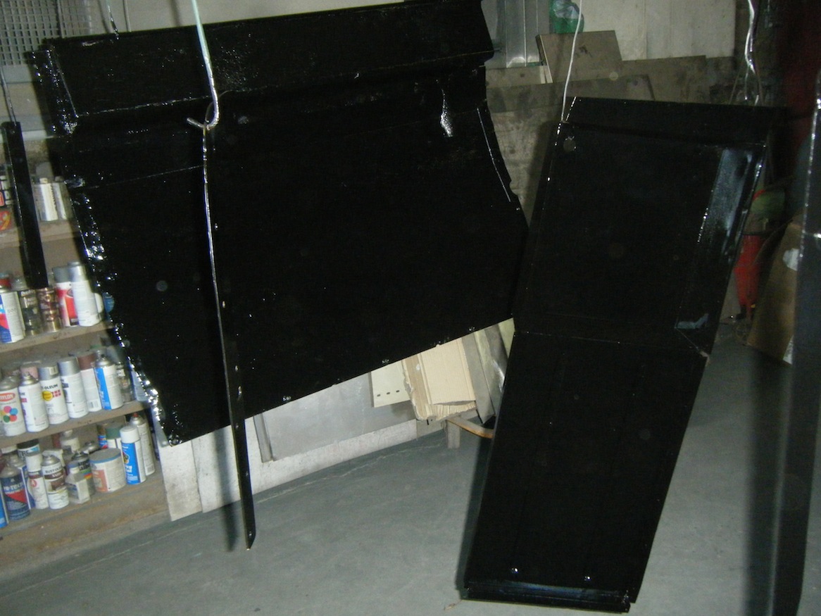

    i ended up epoxy priming and painting it with polyurethane black...should hold up:rolleyes:
    ct1932ford and volvobrynk like this.

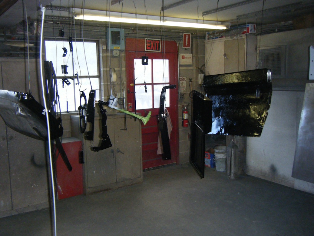

    you ask for pictures, you get pictures.

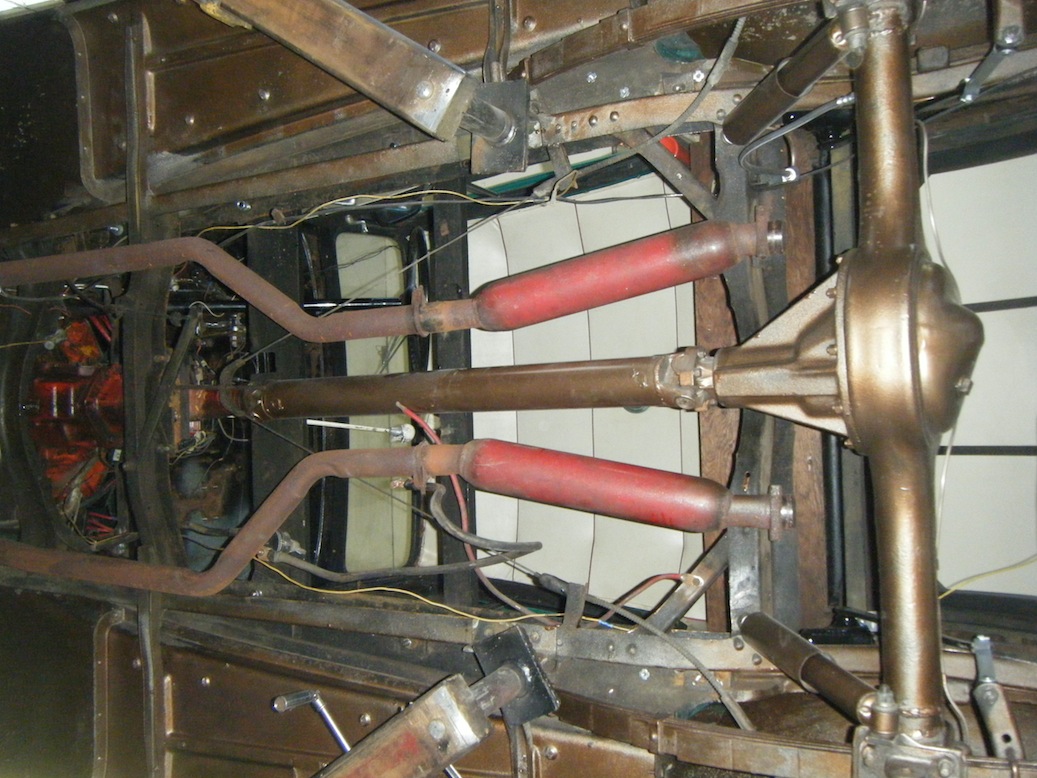

    thanks, i always liked the underside this color, all the cars i restore get black under carriages that look good, but the gold/copper color is something different.
    i know this build is sort of bouncing around but i am trying to keep the car mobile as i fit it into the schedule/ space constraints.
    making the wood pieces is easy, repairing the metal is easy, it is the joining of the two that makes it a pain in the adz:cool:

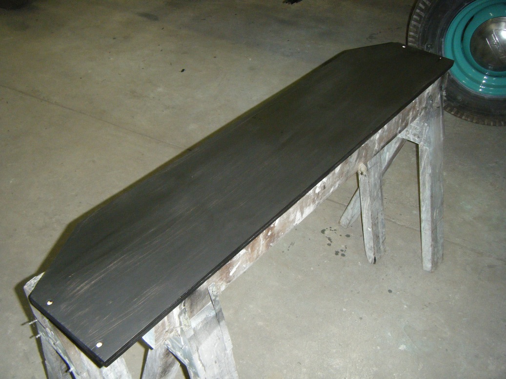

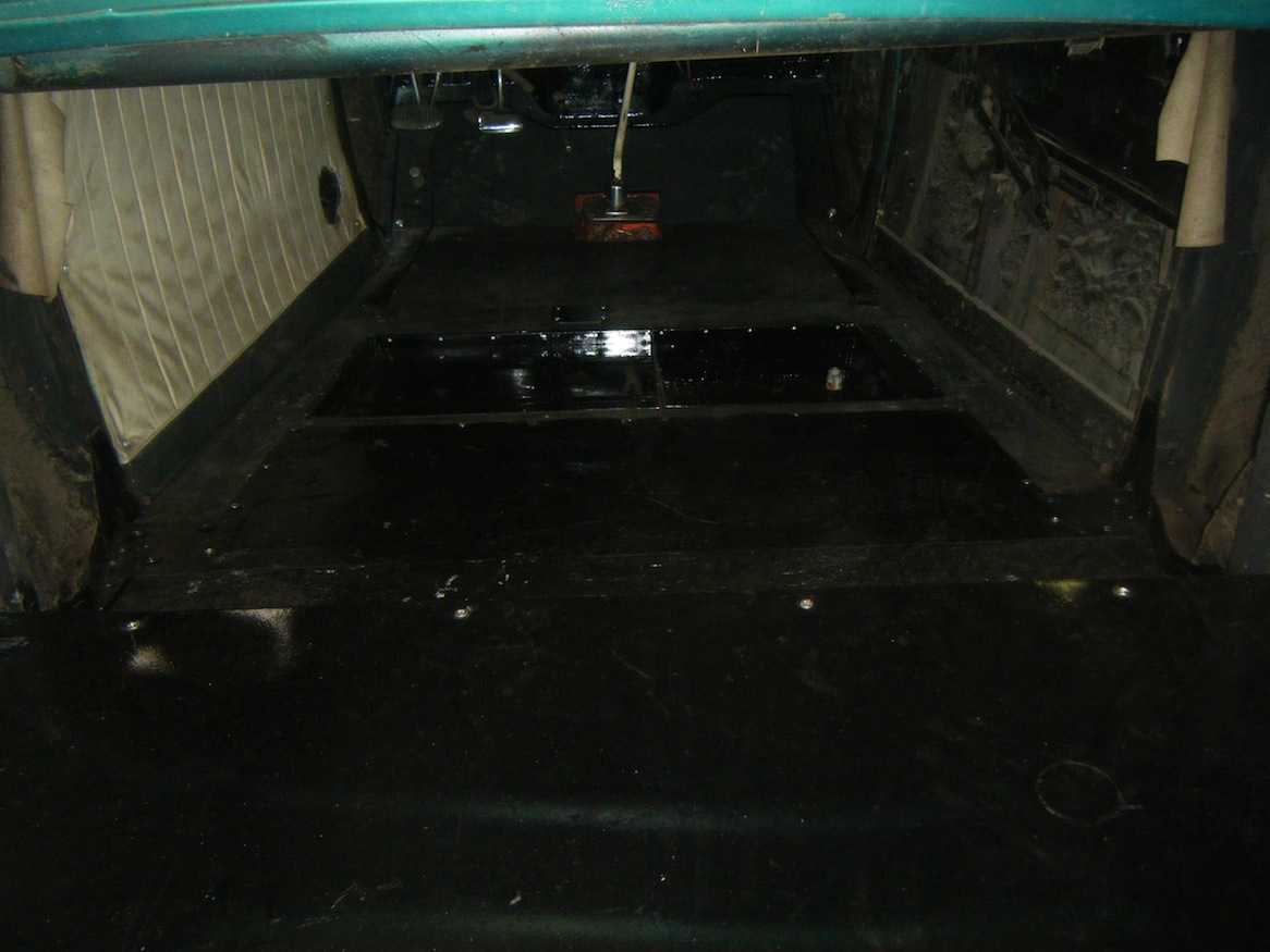

    we have been putting the floor panels and braces back in, i went to take some photos, but the batteries had just enough power to take one photo.
    a picture of the new package tray my dad cut out. the old one had a sag in the middle, a couple holes for speakers and lots of tacks and staples.
    ct1932ford likes this.

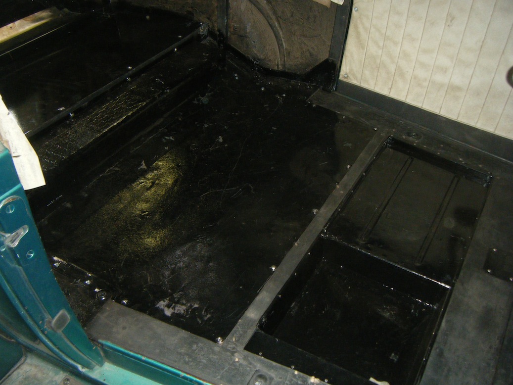

  25. tb33anda3rd
    Joined: Oct 8, 2010
    Posts: 17,583
    tb33anda3rd

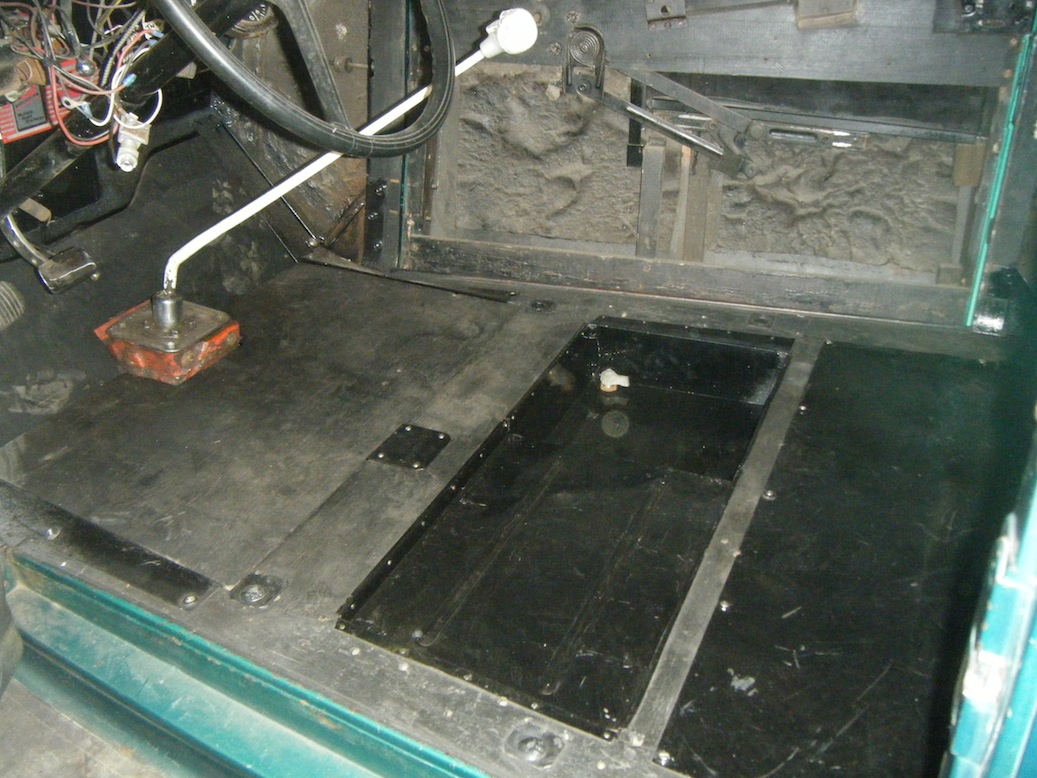

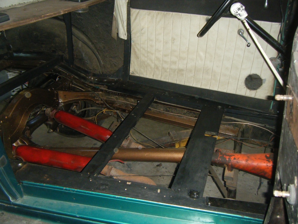

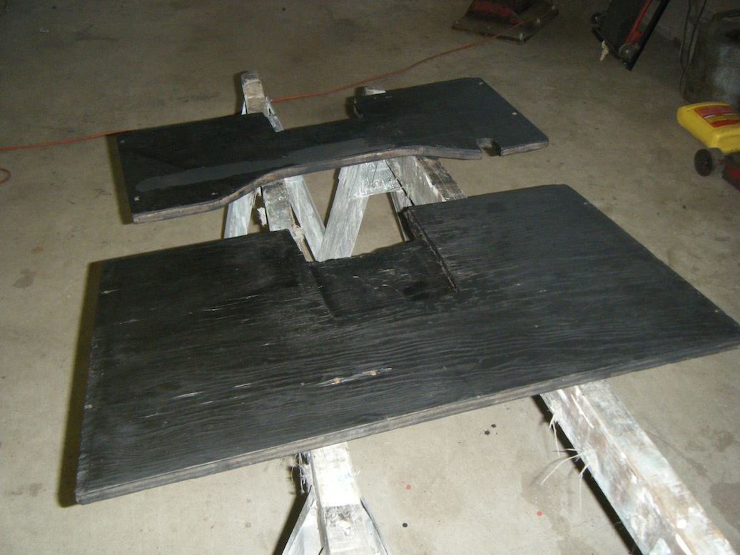

    body mounts changed, body bolts installed, all the braces in, floorboards installed after being sanded, and painted, metal floorboards installed after sandblasting, priming and painting.

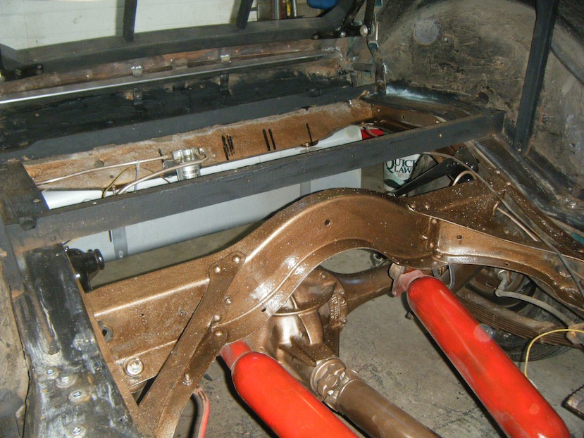

  26. tb33anda3rd
    Joined: Oct 8, 2010
    Posts: 17,583
    tb33anda3rd

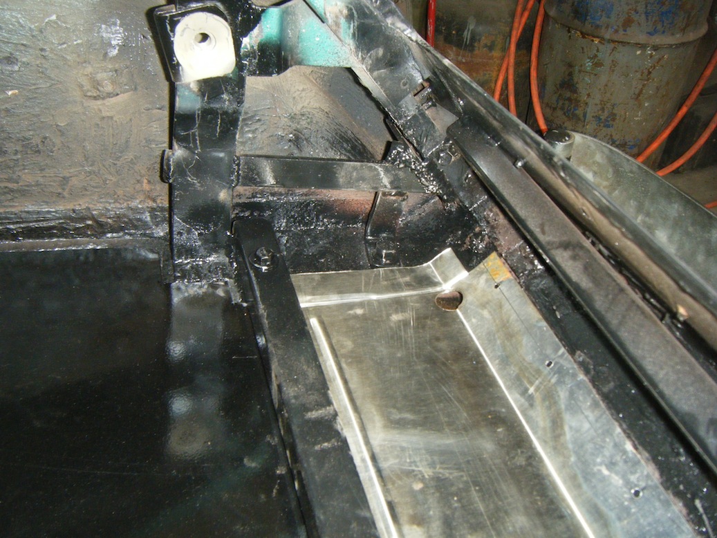

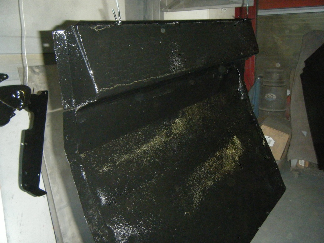

    I decided to replace the rear piece of rumble floor. i started by replacing the wood cross member with a piece of tubing which i welded to the hinge supports and sills. the panel acts as a gutter to catch all the water that runs down the back of the rumble lid so i fabricated it out of stainless steel and i will screw it down with ss screws.

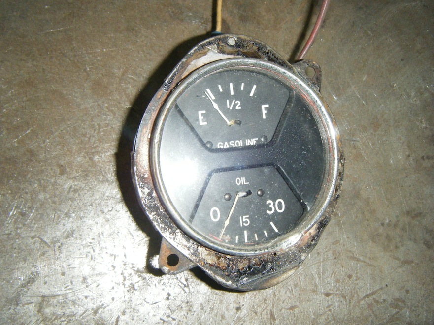

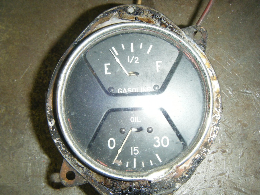

  29. tb33anda3rd
    Joined: Oct 8, 2010
    Posts: 17,583
    tb33anda3rd

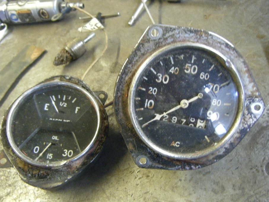

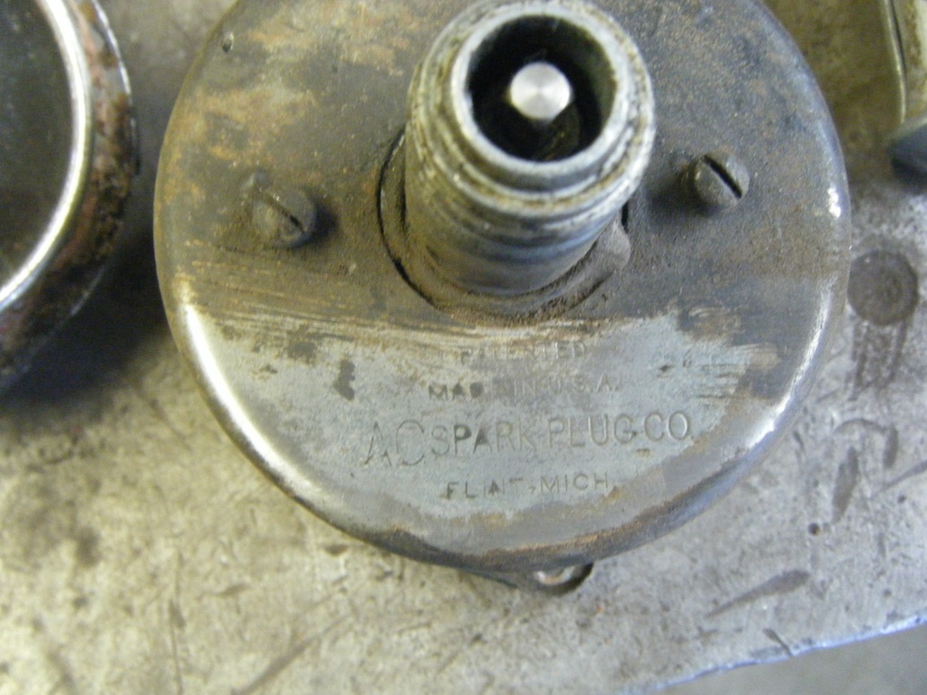

    some pictures of the original gauges. oil pressure needs to be able to read higher pressure. fuel gage never worked; the speedo works but like the combo gauge it needs the bezel straightened and chromed. my dad had replaced the original amp and temp gauge with sw but they are not back lit like the originals, so driving in the dark....is driving in the dark.
    what to do?
  30. ct1932ford
    Joined: Dec 3, 2010
    Posts: 13,262
    ct1932ford
    Sounds like your mind is made up:rolleyes: Just get something vintage looking.:cool:
