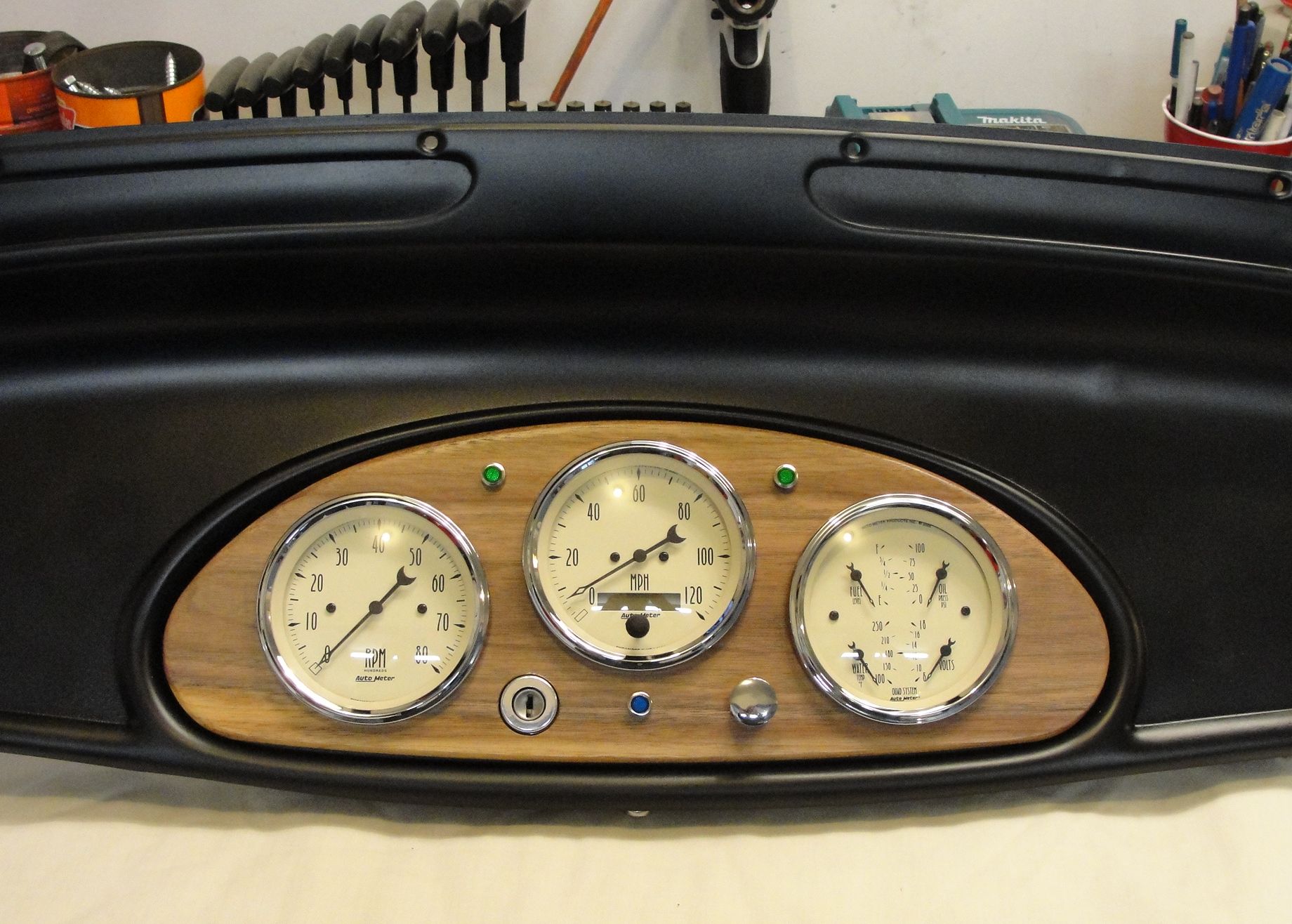

    I used Auto Meter gauges in my 33 Chevy but mine is a master so the layout is different. I used some black walnut from a tree we cut down to put up my garage for the panel behind the gauges.

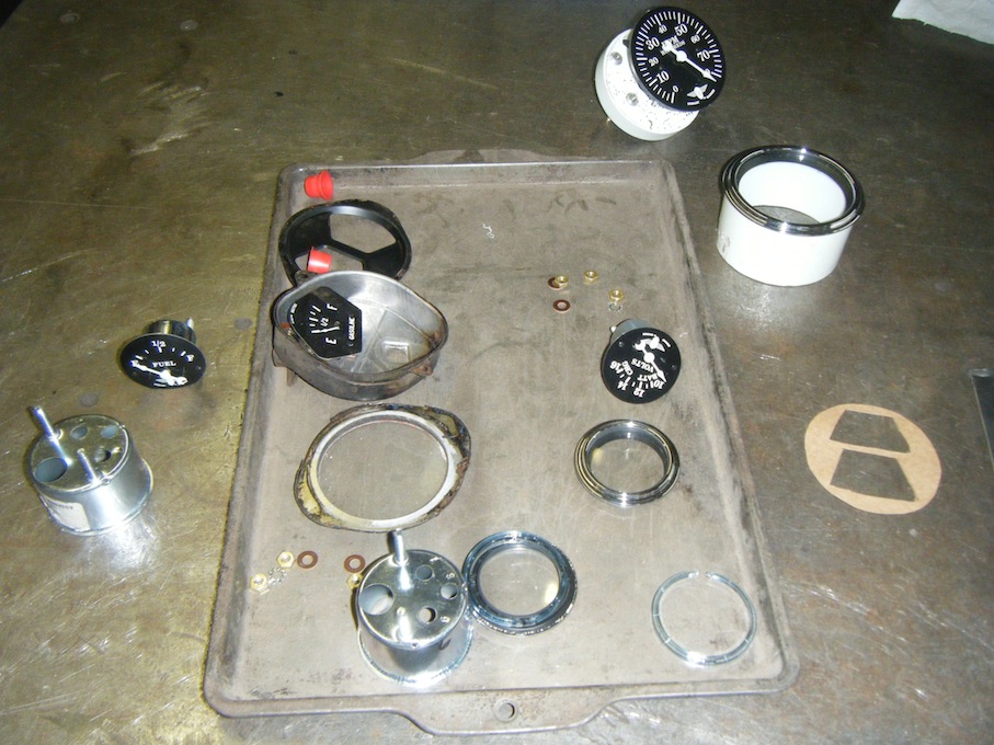

    i bought a six gauge sw wing gauge set from speedy bill; black faces/white letters, looks a lot like the originals. the temp and oil will be put into the two small holes to replace the temp and amp my dad had put in. the speedo will replace the original.
    now i just need to cut open the new tach housing [to use the matching bezel], try to rob the divider out of the original, then cut the new gauges apart [volt and fuel] and install the guts into the former tach housing. problem is one will be upside down so a new face will have to be made and the needle will swing right to left.

    started with all new gauges, and started cutting, prying and unscrewing to get a pile of this;:eek:

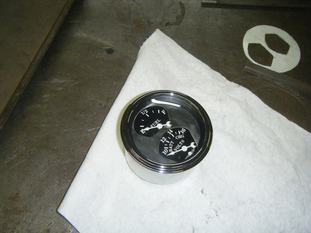

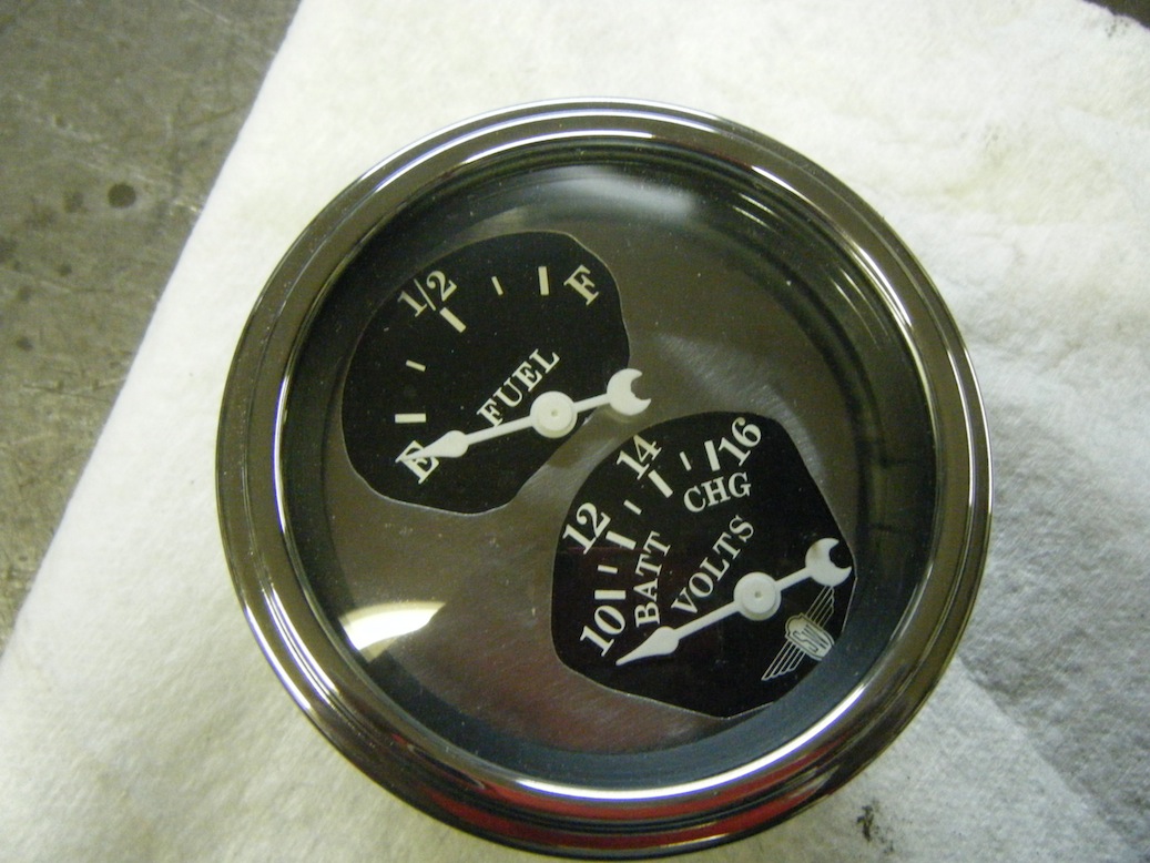

  9. tb33anda3rd
    Joined: Oct 8, 2010
    Posts: 17,582
    tb33anda3rd

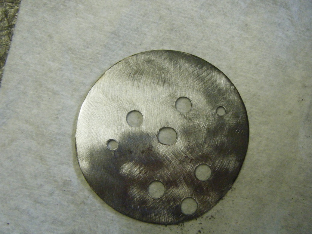

    the guts of the volt and fuel gauges will fit the tach housing, both in the up right position. i made a plate that will hold the two together with the faces overlapping but the swing of the needles clear of each other.
    ct1932ford likes this.

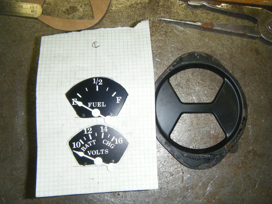

  10. tb33anda3rd
    Joined: Oct 8, 2010
    Posts: 17,582
    tb33anda3rd

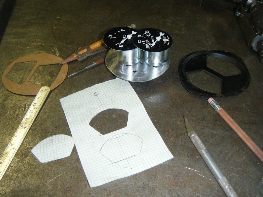

    i then used some paper/cardboard to make a couple template for the new "filler panel". it is like the original but not exact. i like it!
    next i will make a permanent one from thin sheet metal.

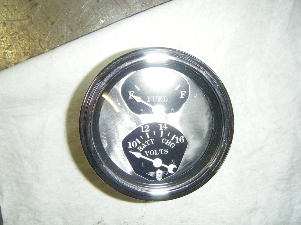

  14. tb33anda3rd
    Joined: Oct 8, 2010
    Posts: 17,582
    tb33anda3rd
    not finished yet but here is the progress so far; cut and trimmed to fit, the "filler panel". i did this by marking out the metal using the paper template, then drilling a hole in the center of the openings with a hole saw. i then filed the opening to the marks. i kept t******* it till i liked it. i test fitted it all together then took it apart to paint. here is also a picture of the plate that holds the gauges together
    ct1932ford and volvobrynk like this.

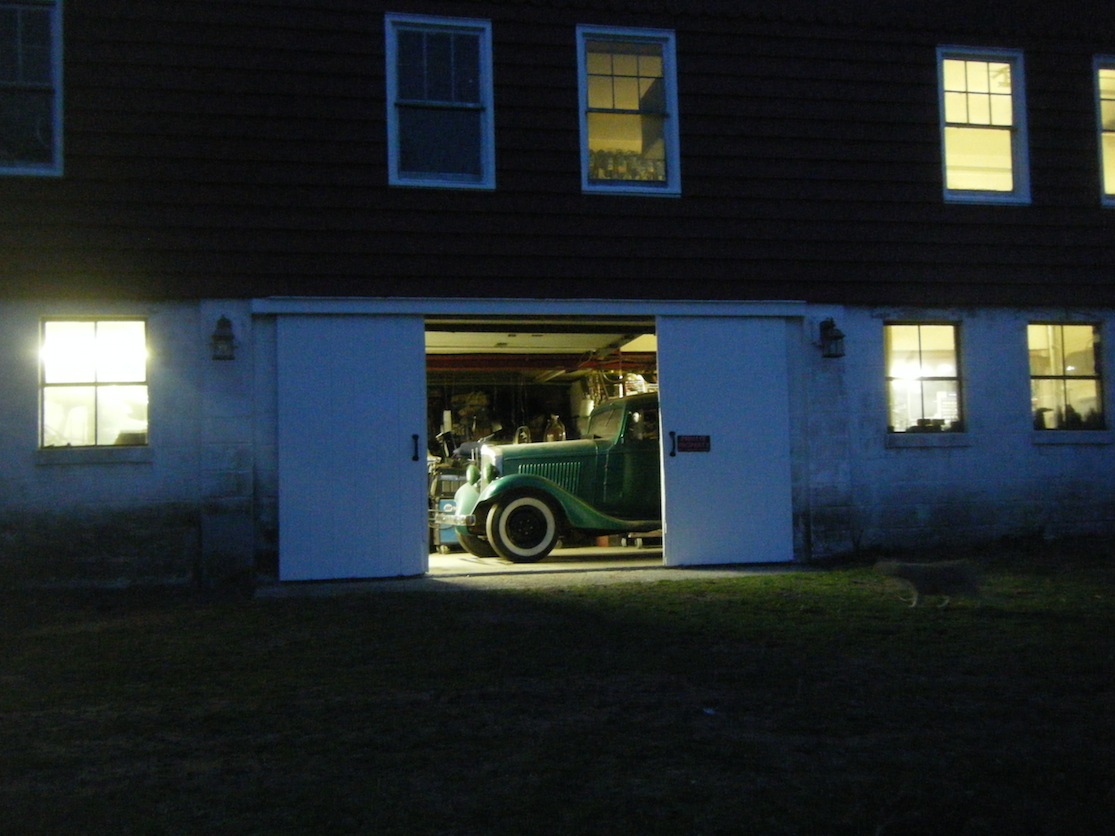

  29. The37Kid
    Joined: Apr 30, 2004
    Posts: 32,464
    The37Kid
    We too, this is what the Bobcat and Bear get to see when the sun goes down. Bob
  30. tb33anda3rd
    Joined: Oct 8, 2010
    Posts: 17,582
    tb33anda3rd
    i was walking up from the garden and couldn't resist getting the camera and taking the picture.
    hipster likes this.
