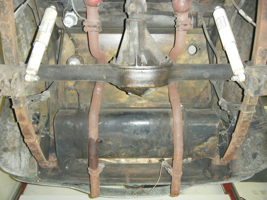

    Do you have a picture of the tank you took out?
  12. tb33anda3rd
    Joined: Oct 8, 2010
    Posts: 17,588
    tb33anda3rd
    here is a shot of it installed. the filler neck was moved and cut down, it was originally hot rodded the tank was rotated so the filler pointed forward, and a hose went to a filler neck in the rumble seat floor. years ago i rotated it back and blended a filler into the back panel and connected it with a short hose.
    i want to put it back to the way it was from chevy.

    found out the earlier tank works if the filler neck gets cut and extended with a 2" piece of hose. $270 tank,straps, grommet, $30 shipping.

    I have used the earlier tank from tanks on a 27 chevy sedan and a 28. it worked great and it looks like your 33 tank from the pictures. I like it because it' steel. Anything can be made to fit. well almost anything.
