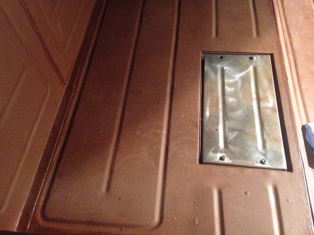

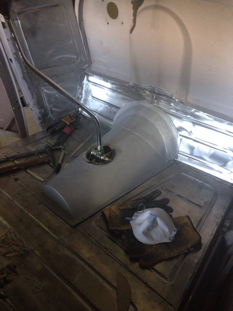

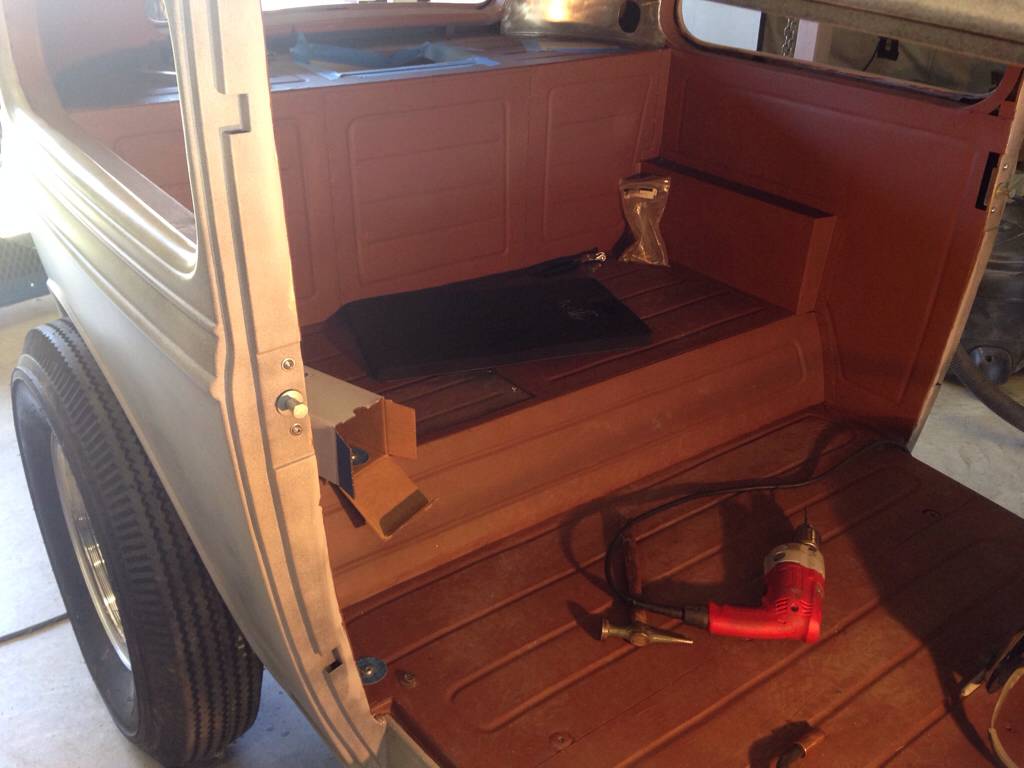

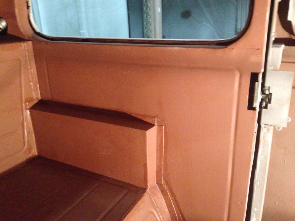

    I put the body back on and started laying out the floor. I really wanted to roll some beads in the floor panels so I bought an EL CHEAPO and beefed it up, added a motor and foot pedal worked great. Also got trans tunnel cover fabbed up. ImageUploadedByH.A.M.B.1410436557.125973.jpg ImageUploadedByH.A.M.B.1410436593.509715.jpg ImageUploadedByH.A.M.B.1410436628.459273.jpg ImageUploadedByH.A.M.B.1410436664.691992.jpg ImageUploadedByH.A.M.B.1410436709.526293.jpg ImageUploadedByH.A.M.B.1410436738.942745.jpg . You can see Baxter is helping. The wooden structure was a shelf for the gl***, rubber and retainer to sit on. So I had to recreate that using my Shrinker/stretcher

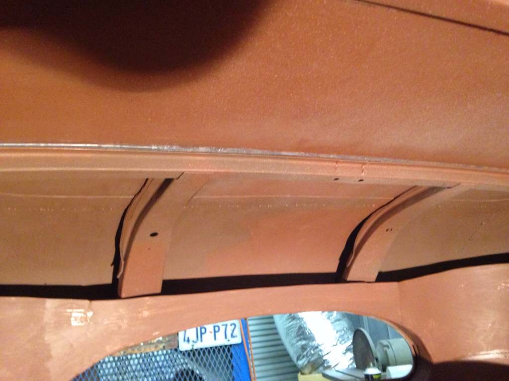

    Here's some pics of the roof ribs ImageUploadedByH.A.M.B.1410438275.848215.jpg ImageUploadedByH.A.M.B.1410438291.497998.jpg ImageUploadedByH.A.M.B.1410438305.464642.jpg ImageUploadedByH.A.M.B.1410438319.547959.jpg ImageUploadedByH.A.M.B.1410438336.198025.jpg

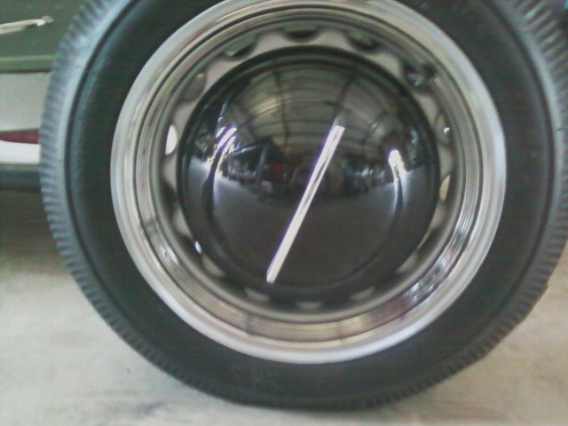

    Anyone like this set up as much as I do? I have a fascination with flipper style hub caps. So I adapted that style to an original hub cap. I cut out the old stainless centers and hung'em on the wall of junk ****, and welded In the new ones ImageUploadedByH.A.M.B.1410463257.267174.jpg ImageUploadedByH.A.M.B.1410463513.049948.jpg and the wall art is much rougher than it looks that's after I knocked the dents out. I found the 4 hubcaps 4 $ 20 and put a twist on'em

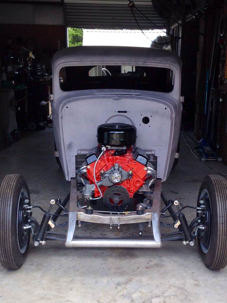

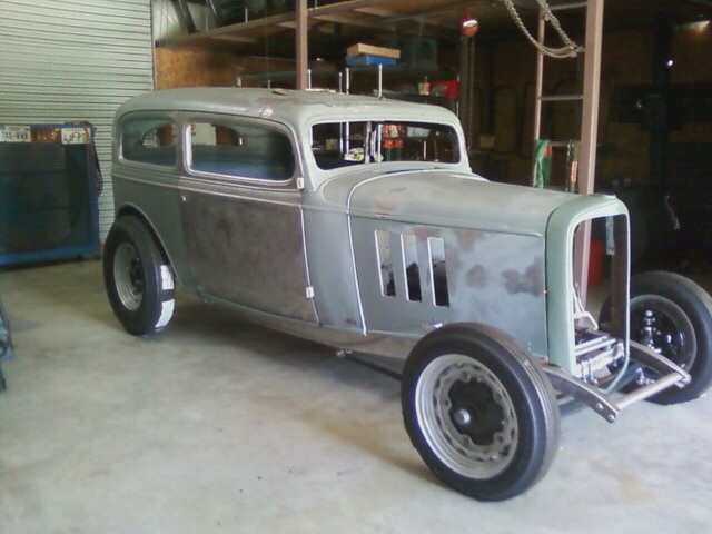

    We'll this is about where I left off. Mocked up the hood and grill. I fixed about 25 bullet holes or bulges in the hood. ImageUploadedByH.A.M.B.1410472330.686783.jpg ImageUploadedByH.A.M.B.1410472350.203434.jpg . Can't wait to get back on it!

    Nice work! I've always loved the hood doors on these cars. Looks good on the '32 frame, prettier than a stock Chevy one.

    I second that motion my Bowtie Brother. I bought a roof section from a 48 suburban from Kenneth Neel. He sets up at all the big swap meets in the DFW area. I was buying parts from him for the AD truck builds. There's 6 cross supports total and the rear has 2 smaller lengths tying the new rear window support together. And the middle support has the interior light mount. It was well worth $250 ImageUploadedByH.A.M.B.1410713713.088879.jpg ImageUploadedByH.A.M.B.1410713741.855363.jpg ImageUploadedByH.A.M.B.1410713760.304836.jpg hope to see some pics from yours and other Chevy builds

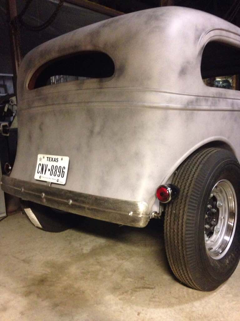

    Terry I hope your taking pictures, would love to see it in a build thread....I've been toying around with the rear bumper and tail lights. The bumper is from a late 30's chevy car that I took about 10 inches out of. The ends curl around the corners just right. Since the original tank and cover panel aren't being used it needed something to complete the look. I just couldn't wrap my head around the idea of mounting the tail lights in the rear body panel... Instead pushed them out to the corners ImageUploadedByH.A.M.B.1419596341.989143.jpg ImageUploadedByH.A.M.B.1419596358.820647.jpg KidCambell are you working on a project?

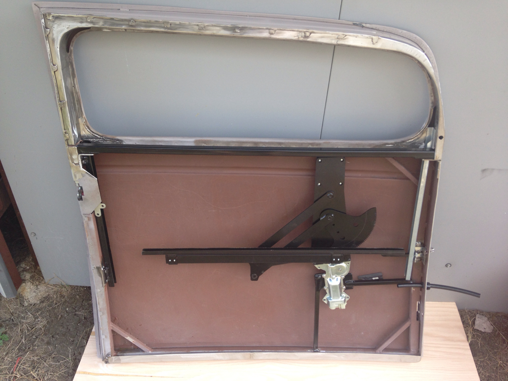

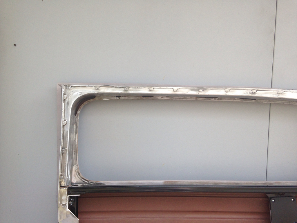

    Yessir- I've been working on the doors. The wood, vent window, all windows and mechanics of the door were gone. All I had to work with were the skins and what little support pieces that attached to wood. So I had braced the doors awhile back and now decided it was going to be easier to install power windows than try and salvage original pieces. Then started reading here and found good things about New Relics window regulators. They make one for the 33 minus the vent window ImageUploadedByH.A.M.B.1427842758.152139.jpg ImageUploadedByH.A.M.B.1427842785.351801.jpg ImageUploadedByH.A.M.B.1427842817.901361.jpg ImageUploadedByH.A.M.B.1427842859.604407.jpg . And added support on top of the door where there was wood. Still need felt channel and gl***.
