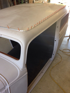

  9. bigheadbaxter
    Joined: Feb 18, 2007
    Posts: 228
    bigheadbaxter

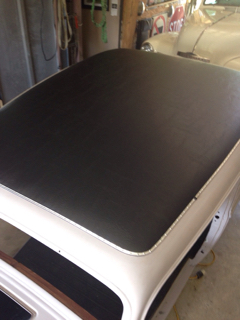

    Getting closer to paint, I finished sanding the body. And got the vinyl top installed.
    The front of the vinyl is 2 inches closer to the windshield. The side is 5 inches wider in the front and 11 inches wider in the rear beyond the original opening. With more uniformed covering it doesn't look as Mohawk like.
    ImageUploadedByH.A.M.B.1469397733.177361.jpg ImageUploadedByH.A.M.B.1469397748.510558.jpg ImageUploadedByH.A.M.B.1469397761.877409.jpg ImageUploadedByH.A.M.B.1469397775.710114.jpg ImageUploadedByH.A.M.B.1469397786.359010.jpg ImageUploadedByH.A.M.B.1469397798.277157.jpg

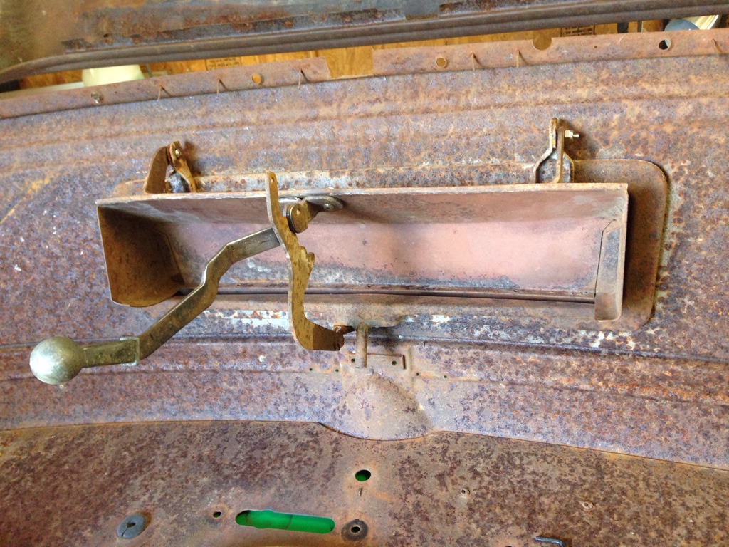

    Can any one tell me what's missing here? I'm ***uming a spring and retainer that allows the position bar to pull tight [​IMG]
    Please send a picture if you can
  15. nailhead terry
    Joined: Mar 23, 2008
    Posts: 1,460
    nailhead terry
    Wow looks good you have screws in your back and you work on your car I have lead in my *** and I have been waiting on it to cool off ! Hope your doing better the chevy looks great
    bigheadbaxter likes this.
  16. Yes, just a spring from the curved piece up to the dash rail framing is all.
  17. tb33anda3rd
    Joined: Oct 8, 2010
    Posts: 17,587
    tb33anda3rd
    yes the spring, a small bracket for it on the cowl and the vent gets a piece of mesh across the front.

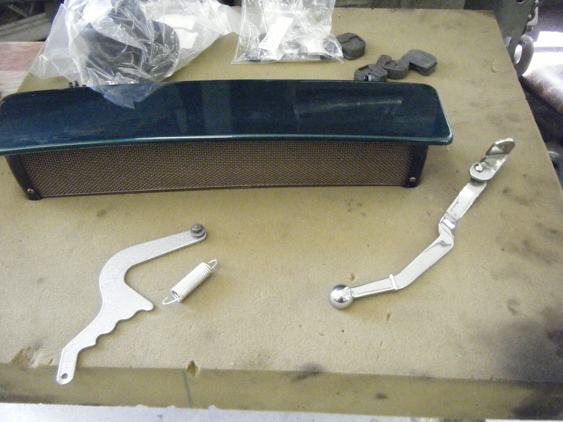

  19. bigheadbaxter
    Posts: 228
    bigheadbaxter
    Luckily I have this extra cowl section to mock up. Between both cars I had everything I need except the spring and the piece that attached it the wooden structure. The screen I have is mangled. Any suggestions or ideas on the screen? A stainless piece would be cool, but I wonder how much I'd have too buy for such a small piece?

  21. tb33anda3rd
    Joined: Oct 8, 2010
    Posts: 17,587
    tb33anda3rd
    check the hardware/lumber store they do have some neat stuff sometimes. also check the soffit vent or gutter isles. the gutter guards have a nice fine mesh.

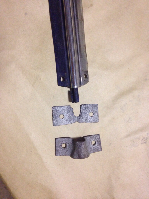

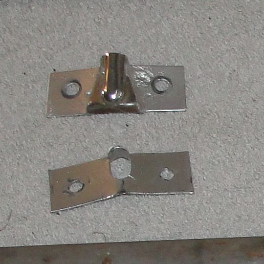

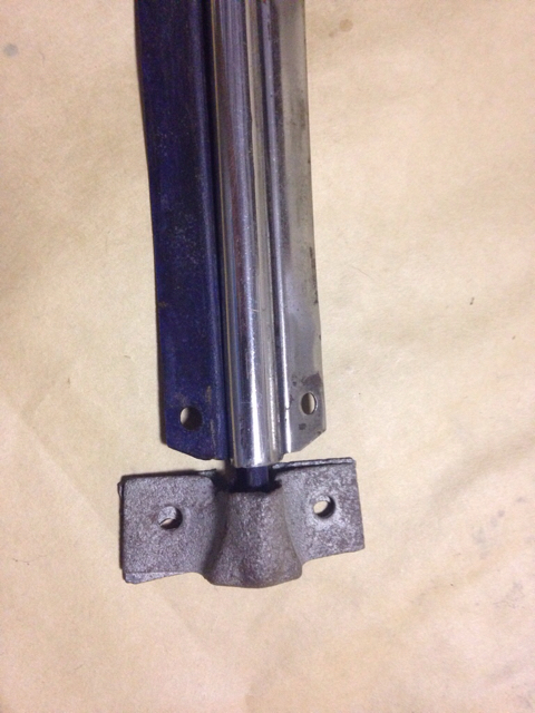

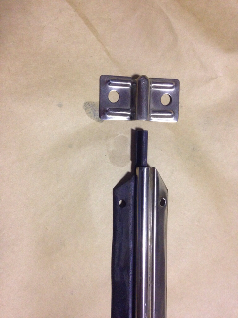

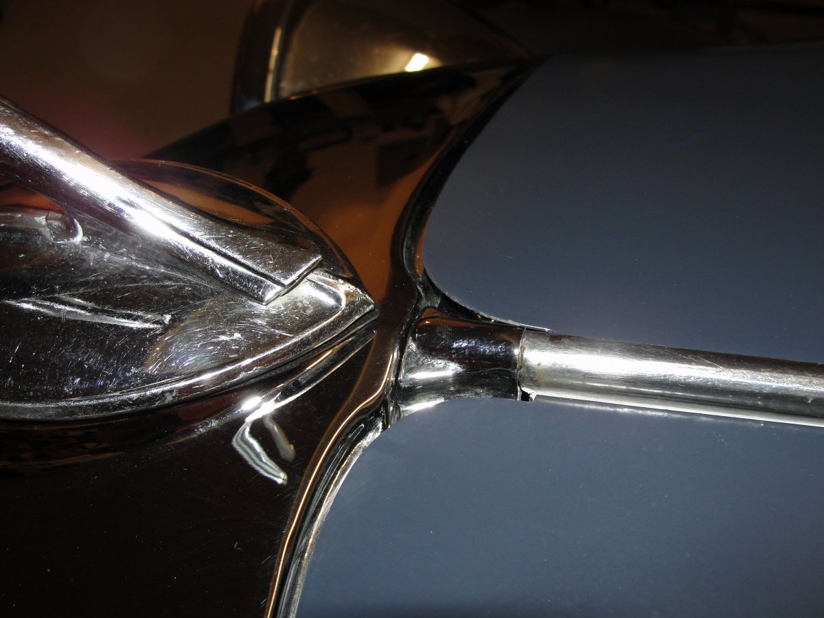

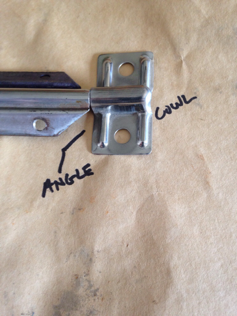

    More help needed gentlemen. This first pic is the grill end of the hood hinge. With the new retainer piece that I got from I&l if I remember correctly [​IMG]
    The next are the cowl end. The retainer is worn but I think will work, but I need to make another spacer. It's worn out
    [​IMG][​IMG]
    And was told there's not a new retainer for the cowl end available? So is there any kind of isolator on the hinge ends? plastic, rubber or Bakelite ? Or just metal to metal?
  25. bigheadbaxter
    Posts: 228
    bigheadbaxter
  26. tb33anda3rd
    Joined: Oct 8, 2010
    Posts: 17,587
    tb33anda3rd
    i will check tomorrow if my car has a spacer in the front, i think it does.
    on the hood hinge the angled end goes toward the cowl to clear the "scoop".
    i have never seen anything but "metal on metal" although on the '37 chevy pickup, i am working on now, i slipped a piece of shrink tube over the end. the shrink tube is a very heavy/tough stuff i found but i have no idea how long it will hold up. just playing around and it can't hurt.

  27. TFoch
    Joined: Mar 31, 2010
    Posts: 2,391
    TFoch
    You have it backwards. The top picture is for the cowl. I got the same piece from I&I for mine. The bottom picture is for the grille. I'll try to get some installed pictures tonight. Mine is metal to metal but I'd like to see if anyone used something between them. tb33anda3rd shrink tube is a good idea.
  28. bigheadbaxter
    Posts: 228
    bigheadbaxter
    Thanks so much guys. Pain medication has taken a toll on my memory. I like the heat shrink idea. Looking forward to your responses. Also one side of this hinge is stainless, it was painted. I ***ume it should be polished since it's the side up and showing?

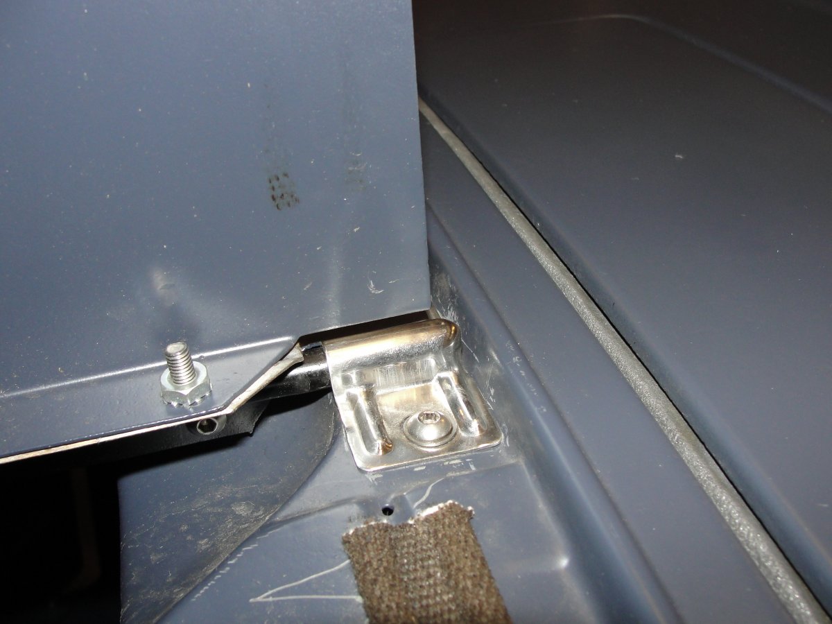

  30. TFoch
    Posts: 2,391
    TFoch
    Here's a few pics. The first three are the pivot on the grille shell. The last one is the cowl pivot. Hope this helps.
