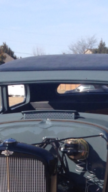

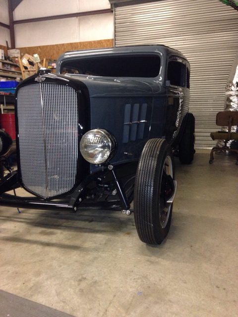

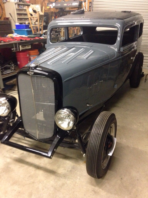

    Put the hood up to check alignment and snap some pics. Then took it right back off. [​IMG][​IMG][​IMG][​IMG]

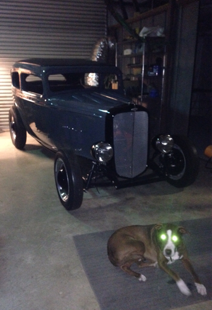

  7. tb33anda3rd
    Joined: Oct 8, 2010
    Posts: 17,583
    tb33anda3rd

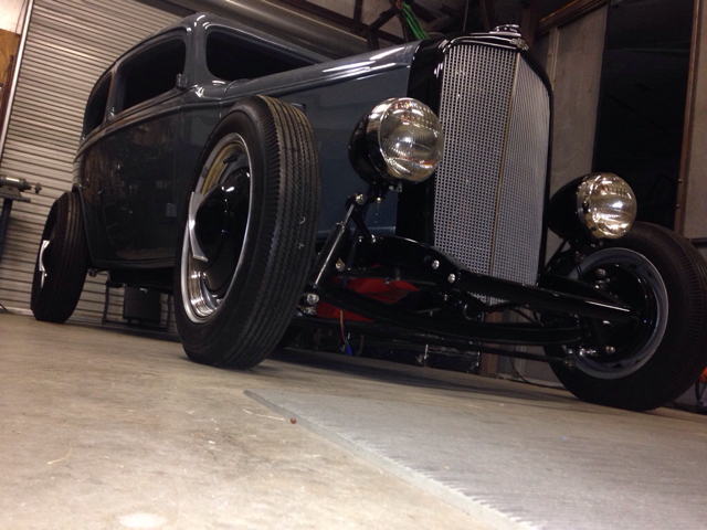

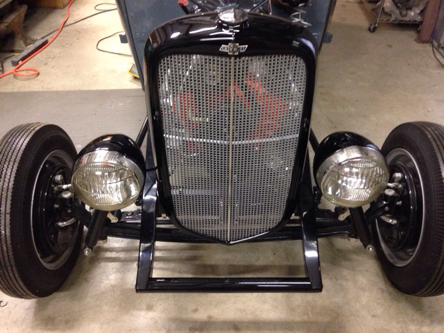

    Thanks guys. Hated to take the hood off, it's tedious working around paint and headlights. Once the grill was secured I was able to snake in the radiator. Need to stretch out the wiring harness and start that fun process [​IMG] this is Space Alien Pete
    TFoch and tb33anda3rd like this.
  10. Reminds me of my crazy hound...

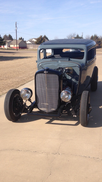

    Got the wiring done. Along with some odds and ends and went for a cruise today.
    Got it up to 55 without a windshield, that was about all I could handle[​IMG][​IMG]

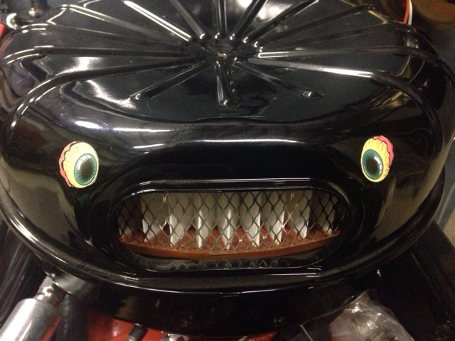

    I'm a scavenger by nature. One mans junk is another mans treasure. So true with me. I found this perforated pre-filter screen from a cooling tower.
    Cut and fit and a portion found a new home. [​IMG]
    And for something a little goofy- the filter looked like teeth to me [​IMG]

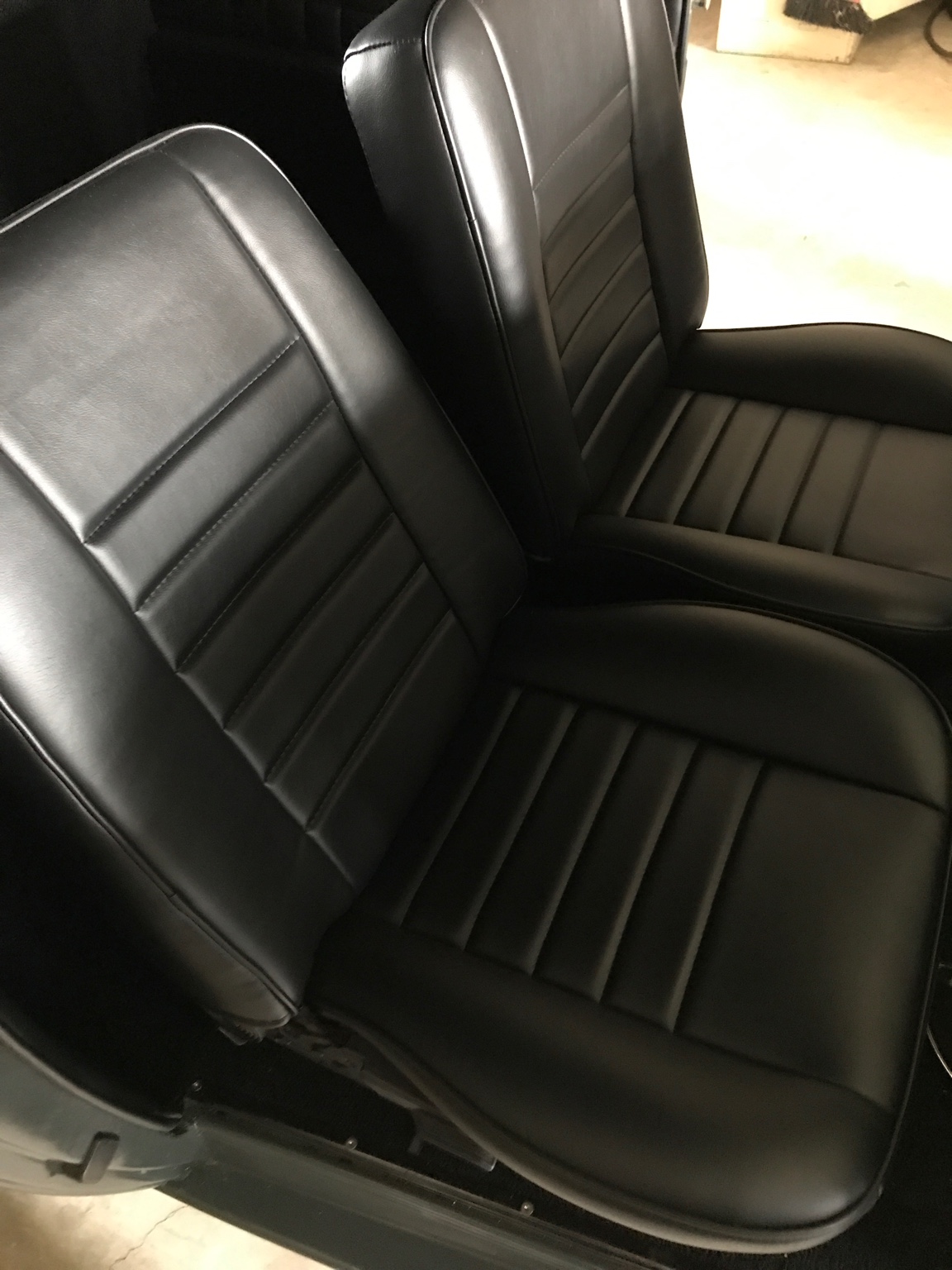

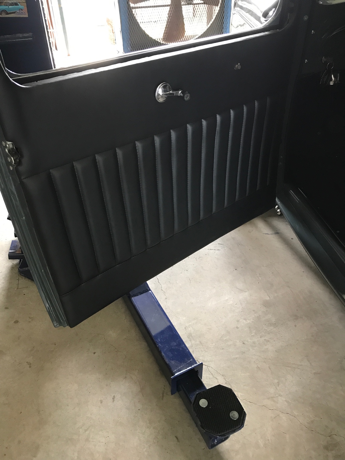

    Well 4 months later I got it back from the upholstery shop. Making templates for the gl*** now[​IMG][​IMG][​IMG][​IMG]

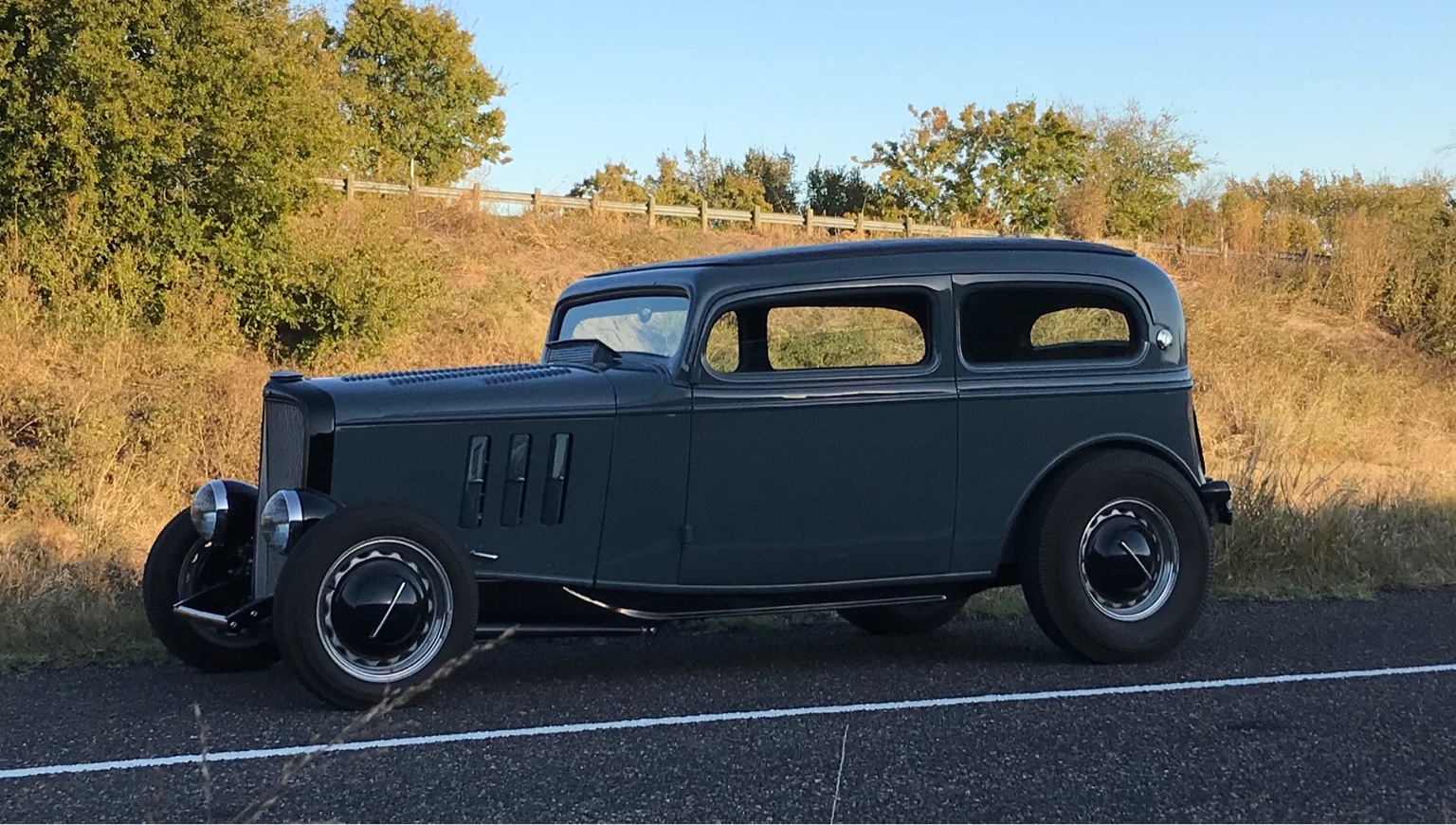

    My list is definitely getting smaller. Gl*** is all in. It all went in well but the windshield, got it on the third try. Ended up removing an extra leaf that was originally added to the rear spring pack. It’s so much better now and fun to drive.
    But I’m having hell with the starter getting to hot. I’ve wrapped the header and pipe Just added the wrap heat barrier around the starter, and still can’t start until it cools. Any suggestions?[​IMG][​IMG]

    I looked through the pics but didn't see any pics of how close your headers are to the starter. I'm using a stock style starter and I don't have any issues with mine. I don't have anything wrapped.

    I can slide my hand between the starter and pipe. From the info I found here it sounds like a mini starter may be the way to go?

    Nice looking car!! Check the ignition timing for your cranking problem. It might be to far advanced.

    Check your battery ground too. A bad ground will cause that.
