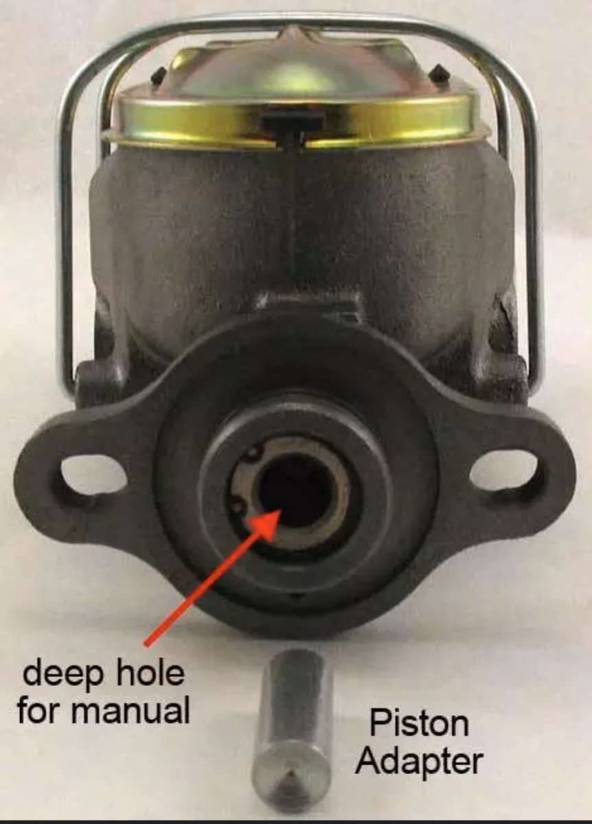

    Brake line Help! Please?
    So right now the 33’ Doll has 40 Ford brakes with 48 hubs,
    since I’m coming into some money now I decided to change things up a bit.
    I want to buy the new Bendix Lincoln brakes from speedway and the aluminum buick style drums.
    And run a 1967 drum drum manual dual master cylinder from a mustang.
    Currently everything is quarter inch line and fittings, except for the mustang rear end that has 3/16 at the junction block.
    Should I just keep the existing system, and just plum it for dual lines at the master cylinder, or run all new lines and go to 3/16? I was just thinking, wont it be harder to push the brakes, with a smaller line? Also with Bendix brakes in the front now, it’s probably going to lock up really easy, so do I need a proportioning valve? And while I’m at it put in a residual valve? I heard 10 pound for drums?
    I really don’t wanna go over the top crazy, (AN Stainless all that)
    but I want it to be nice also?
    I was thinking just replacing the quarter inch tubing and just keep the existing set up, just plum it for a dual right at the master cylinder.
    also on a dual master, where do you put the pressure switch?
    Thanks
    Rick

    My mustang drum master has the residual valves in it.
    Brakes work on displaced volume not pressure, 3/16" lines will work fine. Just make sure you get the right size master cylinder bore.
    I ran my brake light switch on the rear lines, because if the stupid thing decides to leak it won't make as much difference in stopping power. (Front brakes do 70% of the work)
    Some say you need a bias valve some say you don't. I am running the front and rear brakes from a 55 F100. I skipped the valve. If I need it it is easy to add later.
    loudbang and 33Doll like this.

    The bias valve(proportioning valve) is more a safety issue. The "dual" master cylinder is really a single with two chambers. The front portion relies on pressure building in the rear chamber to seal up. Both must seal to give brakes. The valve has a slider in side to close off the system (front or rear) that has a leak/failure and give you at least partial brakes. I always run the same valve as came in the donor vehicle. In your case I would run the 67 Mustang valve along with the drum/drum master.

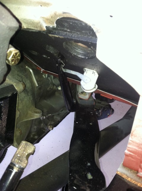

  13. RICH B
    Joined: Feb 7, 2007
    Posts: 6,144
    RICH B
    Here's a picture of a Chevy brake light switch screwed to the floor board as referred to above.
    I have a different take on brake line size tho; I'd run 1/4" from the master to the rear junction block, 3/16" as it is on the axle, and 1/4" to the front due to the large bore wheel cylinders on those repop Lincoln's (tho 3/16" would probably be OK)
    Maybe address that routing of that line and hose(why?) set-up going from the master to the right side.

  15. 33Doll
    Joined: Sep 27, 2019
    Posts: 1,599
    33Doll
    Is that switch spring loaded?
    Just resting on the pedal arm?
    And Im a little confused as to what’s wrong with a line pressure switch? It always worked before.
    If the brakes go out?.. well at that point i don’t really care if the brake lights work? Unless it serves another purpose
    Im not aware of?
    Just wondering.
    Thanks
    Rick

  17. RICH B
    Joined: Feb 7, 2007
    Posts: 6,144
    RICH B
    The arm on the GM switch is spring loaded, as it is released it turns on. They are made in both left and right hand arrangements; and it is easy to find quality old stock switches instead of low quality import switches.
    Hydraulic brake switches used to work fine; but it seems the quality is lacking in the currently produced switches. It is has been stated here and on other forums that they are more prone to leak, that the pressure to activate the lights is too high (don't work on light pedal applications), and the contacts are no longer robust and arc out and fail from the current (that's the reason for some people using relays on the brake lights now).
    Still hyd switches are easy to fit and your old switch may work just fine for you; also easy to change if the need arises.

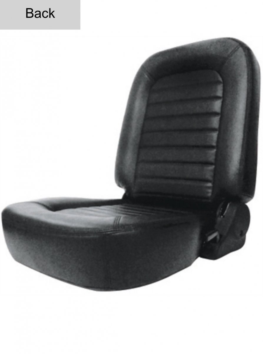

    Solved my rear seat problem!
    A jeep Yj rear baja seat to go with China Bill’s Mustang Buckets ! And still give me that 60’s look I”m going for!
    Plus its smaller so maybe I can hide the battery back there, and tools.
    Get it out of the floor hole!
    Also way cheaper then glide, and wise guys! (Also looks cheaper, but hey it was the 60”s!) I don’t want a modern street rod look any how!
    Trust me it will still look cool!
    And once I get the car done I will find an old-school Mexican tuck and roll upholstery shop And make it all blend!
    Cool.... Holmes! [emoji41]

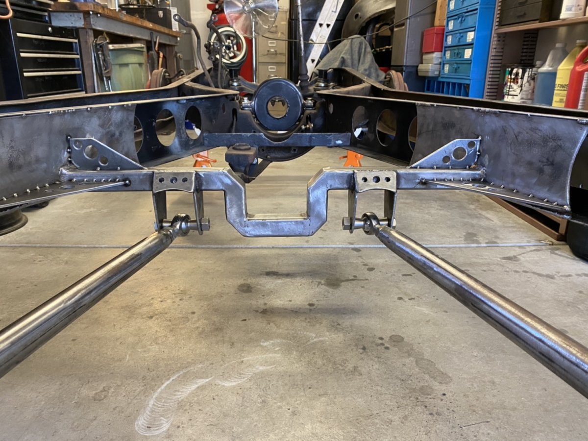

    Posts: 1,599
    33Doll

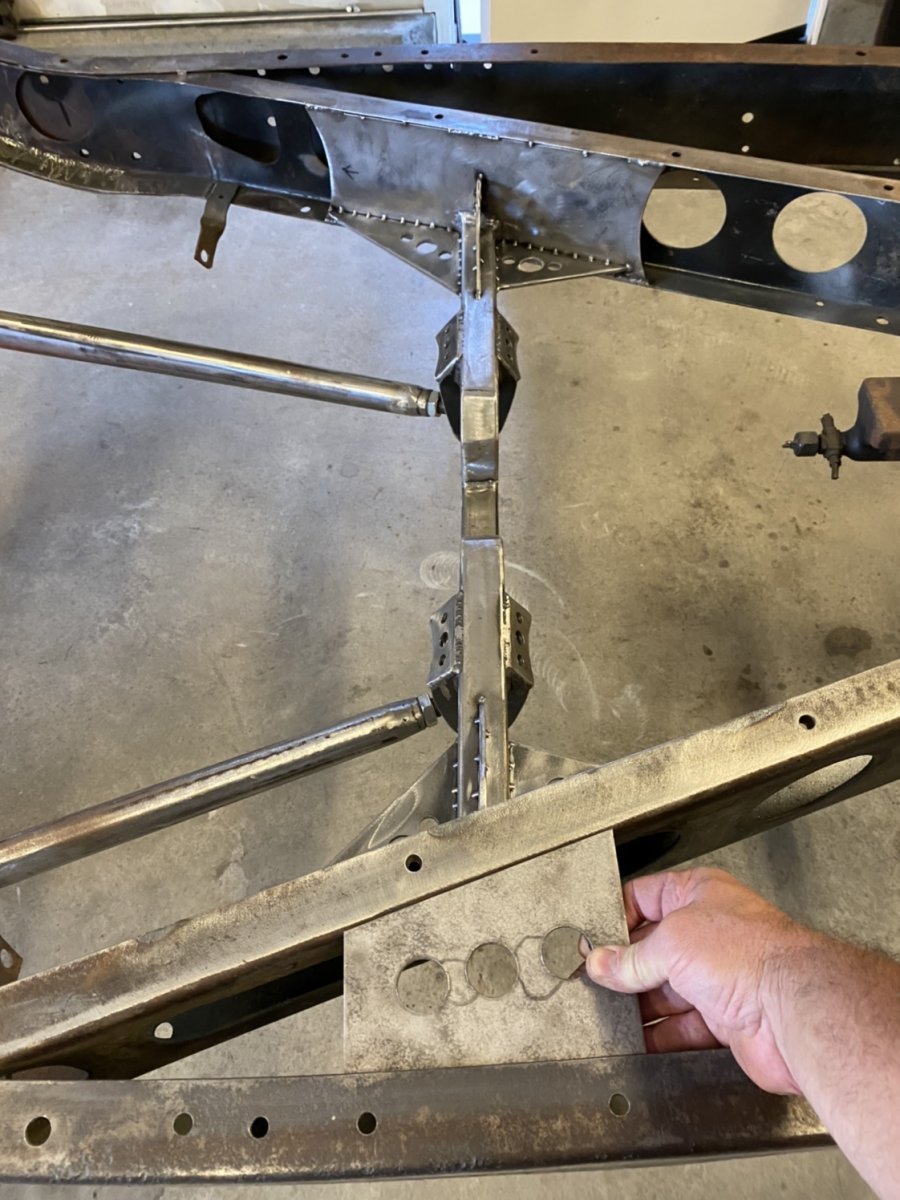

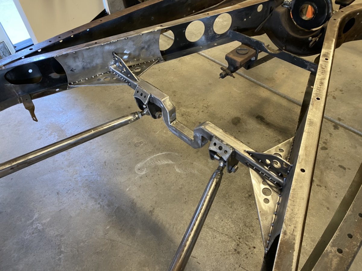

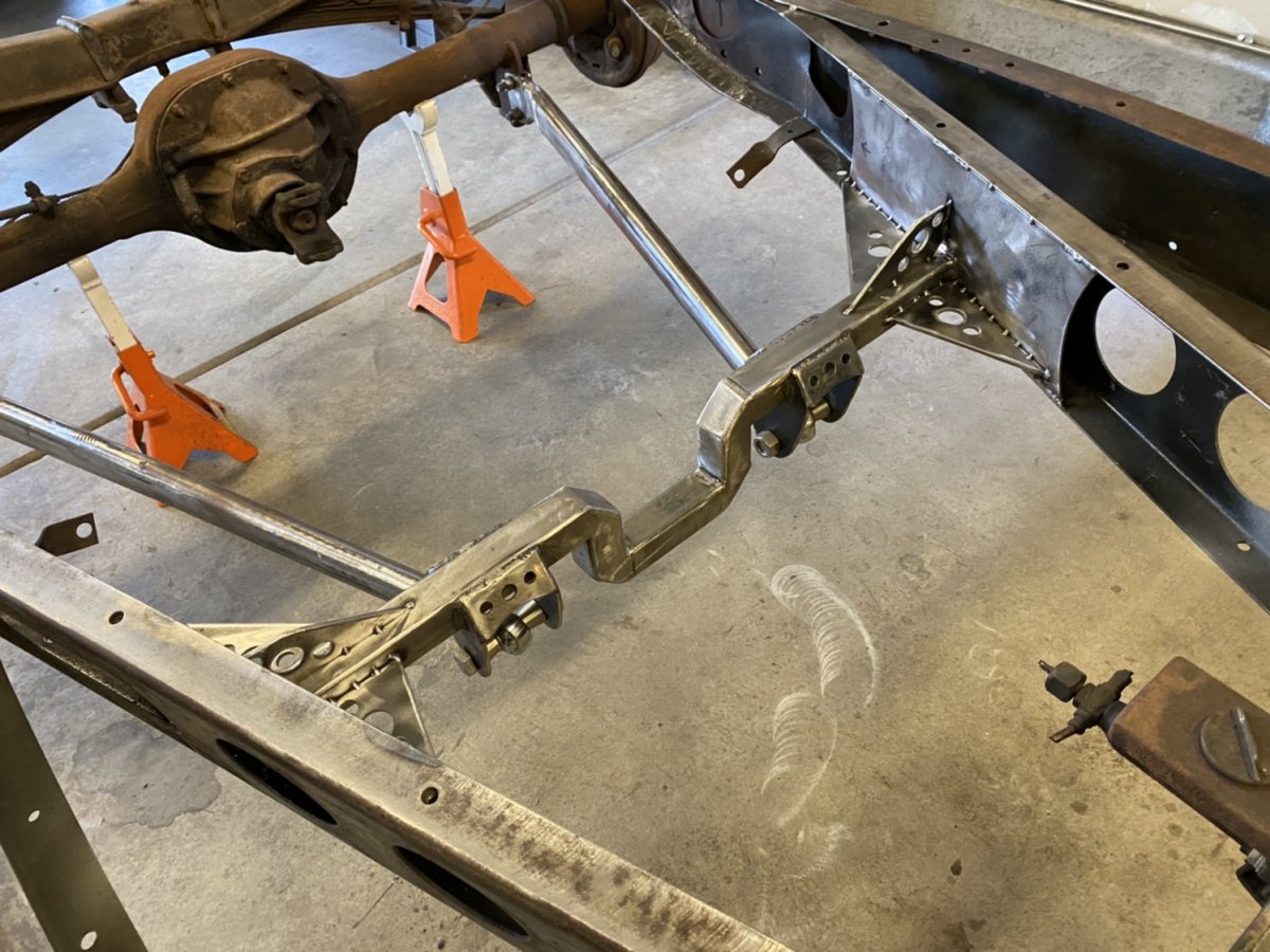

    Cool! Got most of the crossmember welded in and it looks pretty *****in!little artsy but hey!
    The wife says what are the little holes for? And I said “it’s art!”
    I don’t really think I need the outer braces now? What do you think is it overkill?
    I have four of them two for the top and two for the bottom
    IMG_0250.JPG IMG_0258.JPG IMG_0253.JPG IMG_0262.JPG IMG_0266.JPG IMG_0265.JPG IMG_0273.JPG IMG_0275.JPG IMG_0276.JPG IMG_0277.JPG IMG_0279.JPG IMG_0280.JPG IMG_0281.JPG IMG_0282.JPG

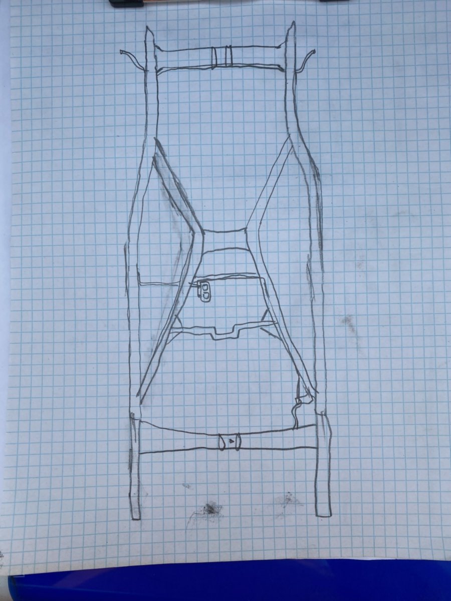

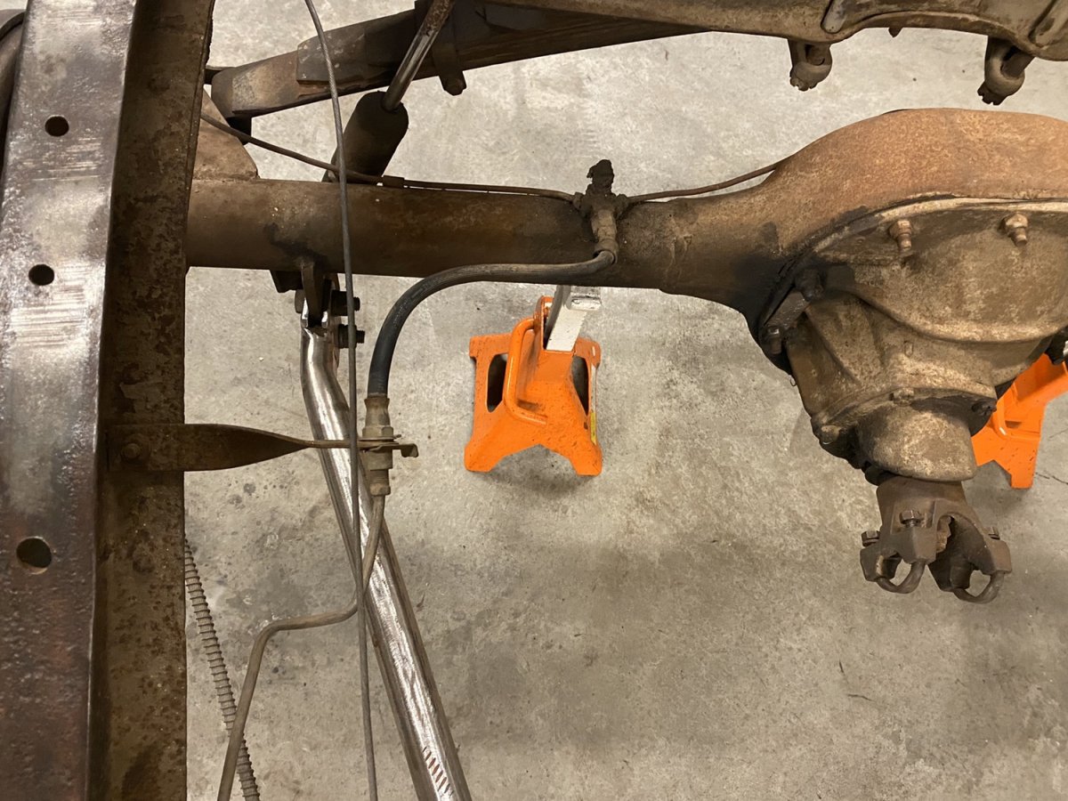

  29. 33Doll
    Posts: 1,599
    33Doll

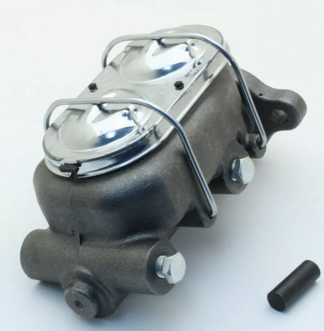

    I Have a Brake plan.... not as nice drawing as some, but I understand it!
    -Corvette Style universal Dual Res.
    With ports on both sides!
    -2 10lb residual valves
    -br*** Tee for pressure switch
    -All 1/4 line... (except rearend)
    Rear:
    -67-70 8”
    -1967 Mustang 3/16 pre-bent lines
    -1967-72 F-100 breather Junction block and hose
    Front:
    -40’s Style Speedway 12” Lincoln brakes
    With aluminum Buick style finned drums
  30. RodStRace
    Joined: Dec 7, 2007
    Posts: 9,807
    RodStRace
    That looks like someone has been down that road before and has chosen to 'map' the route this time, great work!
    Don't forget part #s once you buy the stuff, so you can replace on down the road.
    chryslerfan55, brEad and loudbang like this.
