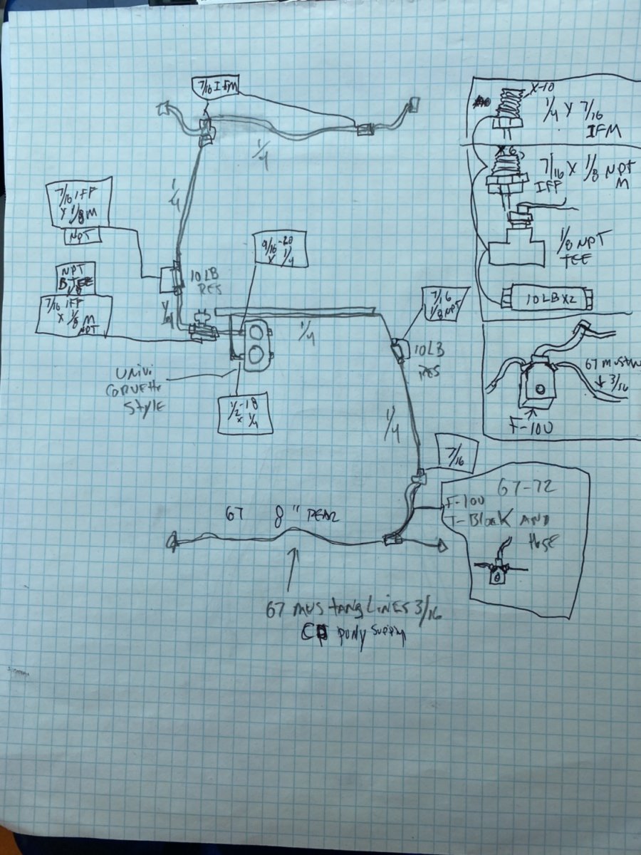

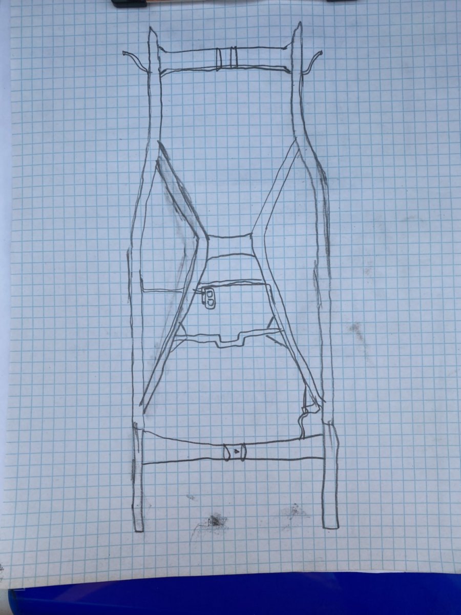

    Brake system schematic is a good idea to be sure you have everything on hand. Just wondering if the pre-bent Mustang lines will play nice with the F-100 hose block.

  3. 33Doll
    Joined: Sep 27, 2019
    Posts: 1,676
    33Doll
    Thanks!
    Especially the different adapters, and fittings. Thats my main reason for drawing it up.
    As far as the F100 block, I’m pretty sure thats whats on there now. (Could be T-bird or even Mopar)
    But the F-100 should be fine.
    The mustang block has a bracket, and rectangular block. I have confirmed it is a mustang 8” which appears to have the stock lines, just tweaked a little on the ends? Unless my dad bent up his own 3/16 line? Which I doubt. He always uses 1/4. Of course he can’t remember. He just says..

  4. 33Doll
    Posts: 1,676
    33Doll
    I see what happened, drew the junction block wrong, the ports are angled the other way

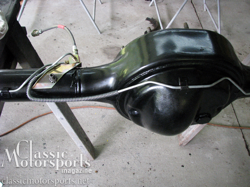

    Mentioned the hose as I remembered (from long ago) that Mustang axle hoses were odd and the lines were run different; found a pic on line.

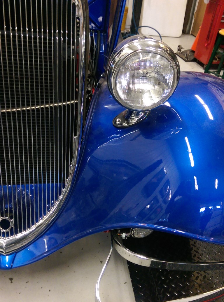

  13. RICH B
    Joined: Feb 7, 2007
    Posts: 6,301
    RICH B

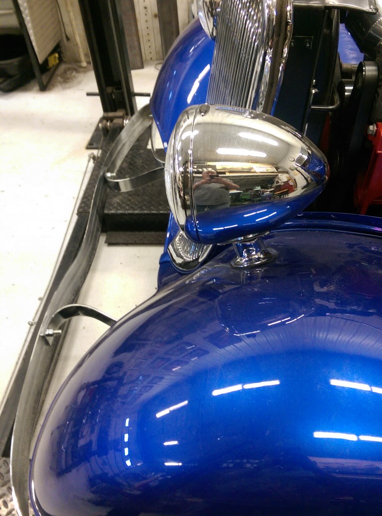

    My friend bought a set of the BLC repops from Summit (free shipping) and after thinking about painted shells vs chrome he sent the shells out to the chrome shop. They look pretty good on his '33; neither too big or too small.
    loudbang and 33Doll like this.

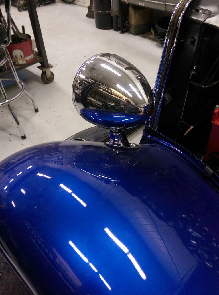

    Here are the BLC lights I mentioned earlier; phone died and I lost the pictures I took Monday. Returned to the shop today and got these.

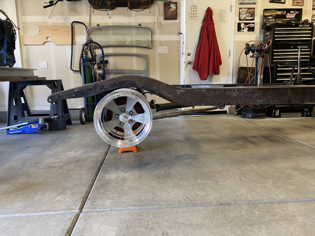

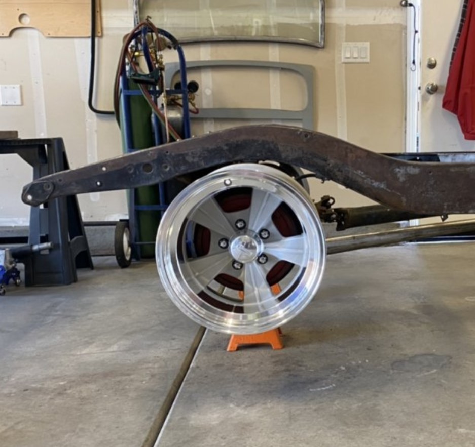

    I just couldn’t wait for the tires!
    I had to make sure they were going to clear anyway! Just picture Buick finned drums instead of 40 Ford drums!
    That 5” backspace in the rear is gonna bring the wheels in just enough to stick out far enough, but not look stupid !
