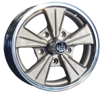

    I don’t know, but the quality seems real nice! Even if there from China Bill!

    4.5 and 10”
    560- and 60- 15” (275/60)
    Maicobreako and loudbang like this.

    I think they are actually nicer looking then the real Radirs
