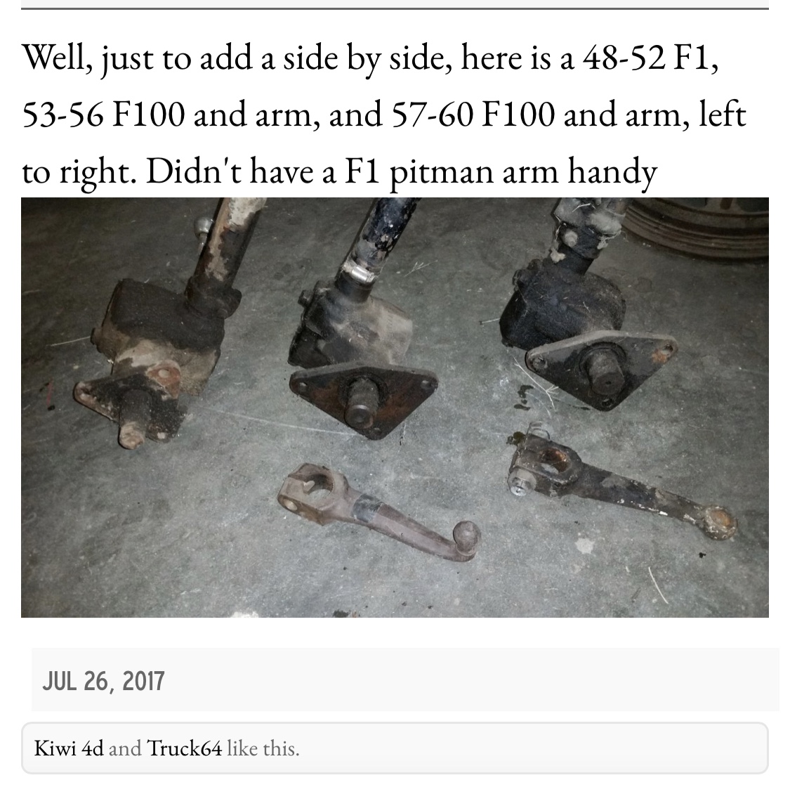

    Personally, I'd rather cut the junk off that box and install one single U joint. You can weld it to the shaft just as easily as your dad did. Then you wouldn't have a welded joint (that was meant to be a clamped joint) bolted to a rag joint that is missing the rubber.
    And, you have an F-1 steering box, not an F-100.

    I was thinking about it, but it would be more money, and I would have to graft a short section of shaft to make up the difference. It works fine, once the car is back together you’ll never see it. Its a focal point right now. Also, i was told that is a 53-56 box, which is an f100.
    f-1 48-52

    I found this...
    Doesn’t really matter what it is, it works good, no slop, and easy to steer for manual steering (yes I agree the joint is ugly.) but its staying... for now [emoji6]

    On second thought, I think your box IS an F-100. But it looks like someone welded a stub of the old sector to the end of the F-100 sector. Can you see a weld? A stock F-100 box would have a pinch bolt holding the pitman arm on instead of the large nut like you have.
    I'd really be looking that modification over well before using it again.

    Yup! Its grafted, I just need to find out if my Pops did it, because I know he would do it correctly, being a welder at E**on and a machinist at Mare island
    In the 60’s if someone else?.... dunno.

    Well I pulled off the steering box, and got a closer look, cleaned it up better. it looks like the Graft was done really good other than the weld clean up,but I put a straight edge on it and there’s no run out, so I’m pretty sure that it’s probably stubbed and drilled. Not bad for not using a Lathe, but I don’t think you would be able to unless you had a big one, cause of the teeth on the end of the sector shaft. I’m not to worried about it. IMG_0822.JPG IMG_0823.JPG
