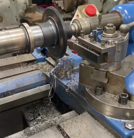

  3. RICH B
    Joined: Feb 7, 2007
    Posts: 6,299
    RICH B
    Really should use an arbor to hold the hub if you face it on your lathe, sorta like this picture a friend had sent me. Otherwise we face hubs on a brake lathe; pretty easy to do; the cones hold it true to the centerline. If the flange was bent from pounding; maybe be worthwhile to have it magged for cracks.

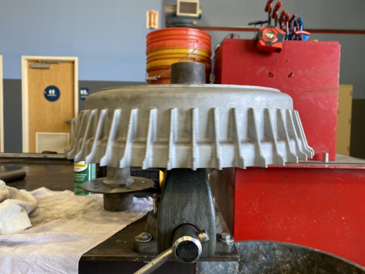

    Made a temporary spindle-out of a socket, spacer and the factory bearing in the vice. Works great. Just hope the replacement drum is straight as my remaining drum![​IMG] IMG_0855.JPG

    Welp! Tried both hubs with the remaining good drum on the spindle, with the bearings and nut, and it is darn near perfect now!
    (Considering its a cast drum!)
    Hopefully China Billwill send a good one to go with this one!
    We’ll see! Fingers crossed!
    Sure a lot straighter than those 40 Ford drums!
