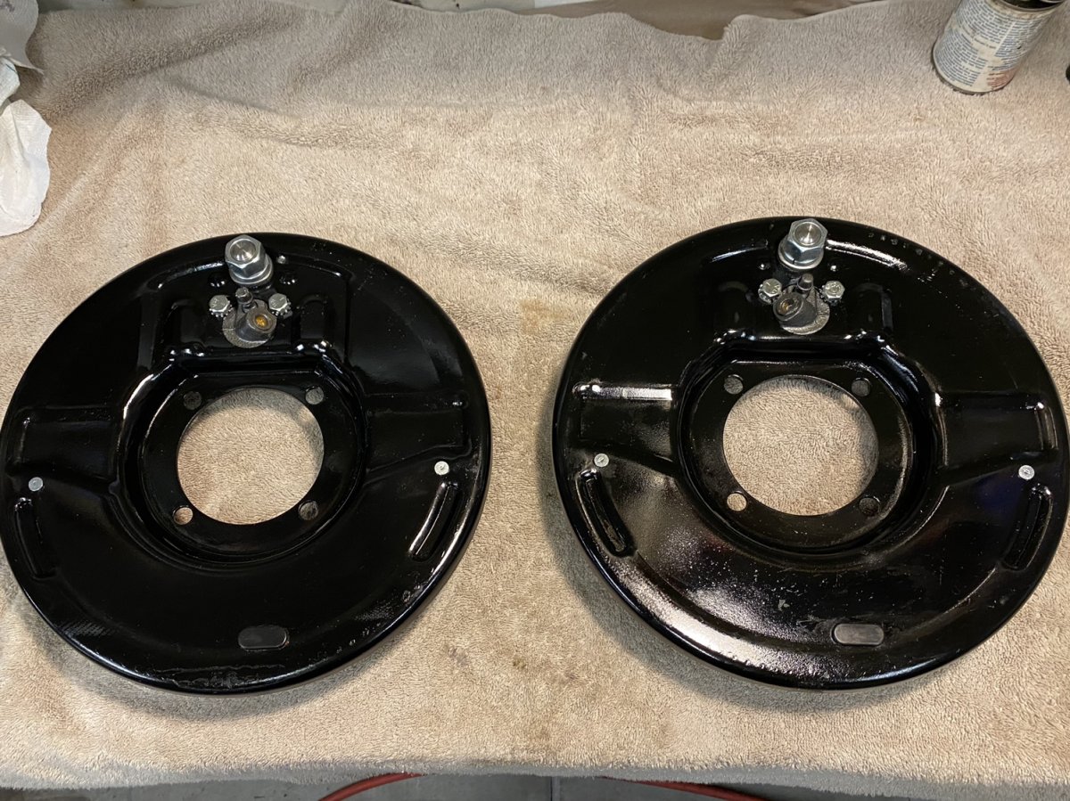

    Can't help you on the washer/anchor pin question, but the adjuster 'teeth' need to be accessed thru the window in the backing plate, which is offset in your picture.

    Front brakes all done, and painted!
    Short shoe to the front... Wheel cylinder ports to the back!
    Moving on to the Tiny Mustang rears!

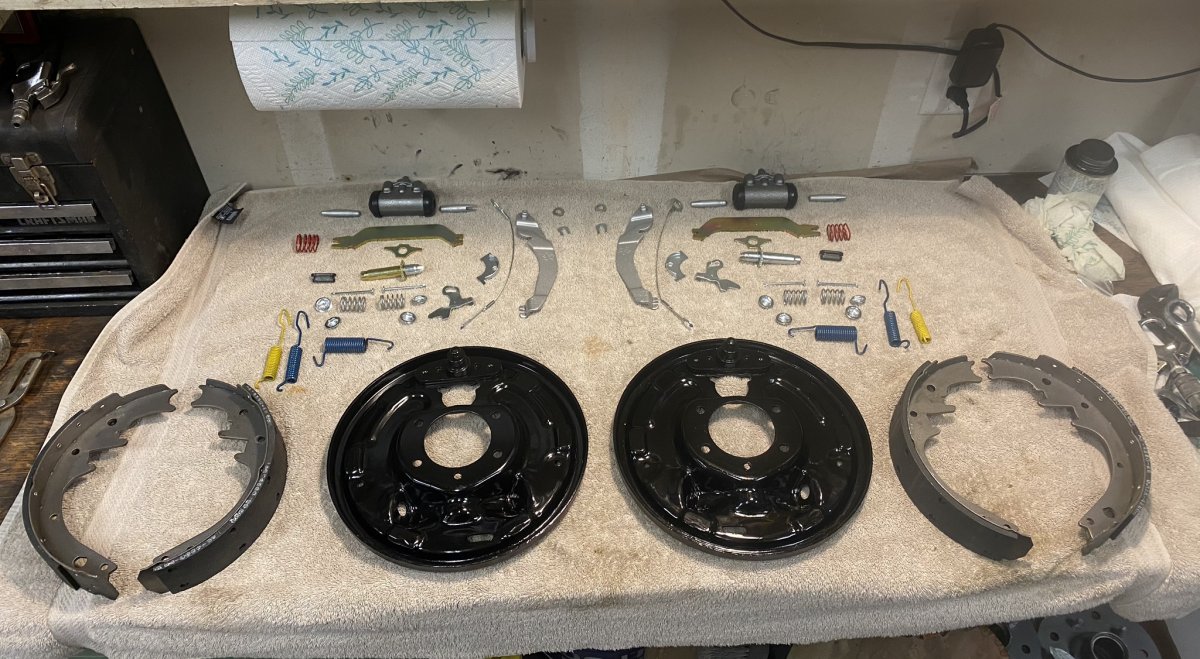

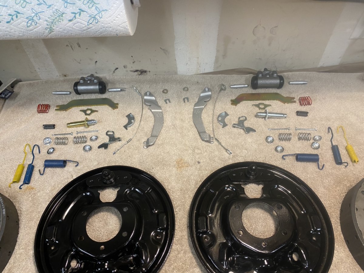

    laid everything out for the rear brakes next I’ve done enough for today!
    Thanks

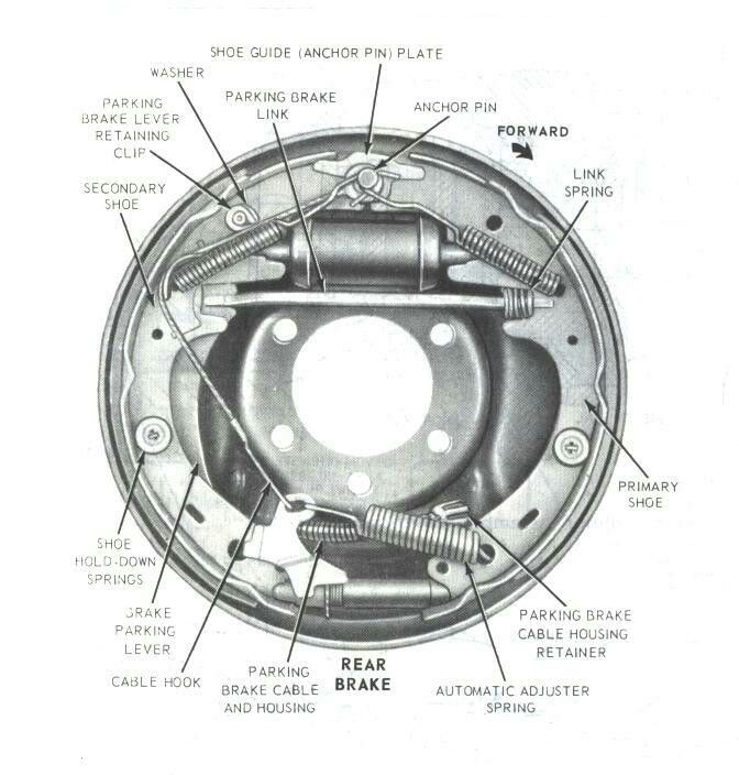

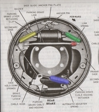

    This picture helps alot also
    loudbang and Stogy like this.

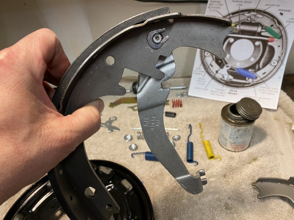

    Just finished the 8” Mustang Rear brakes but should work for 9” too!

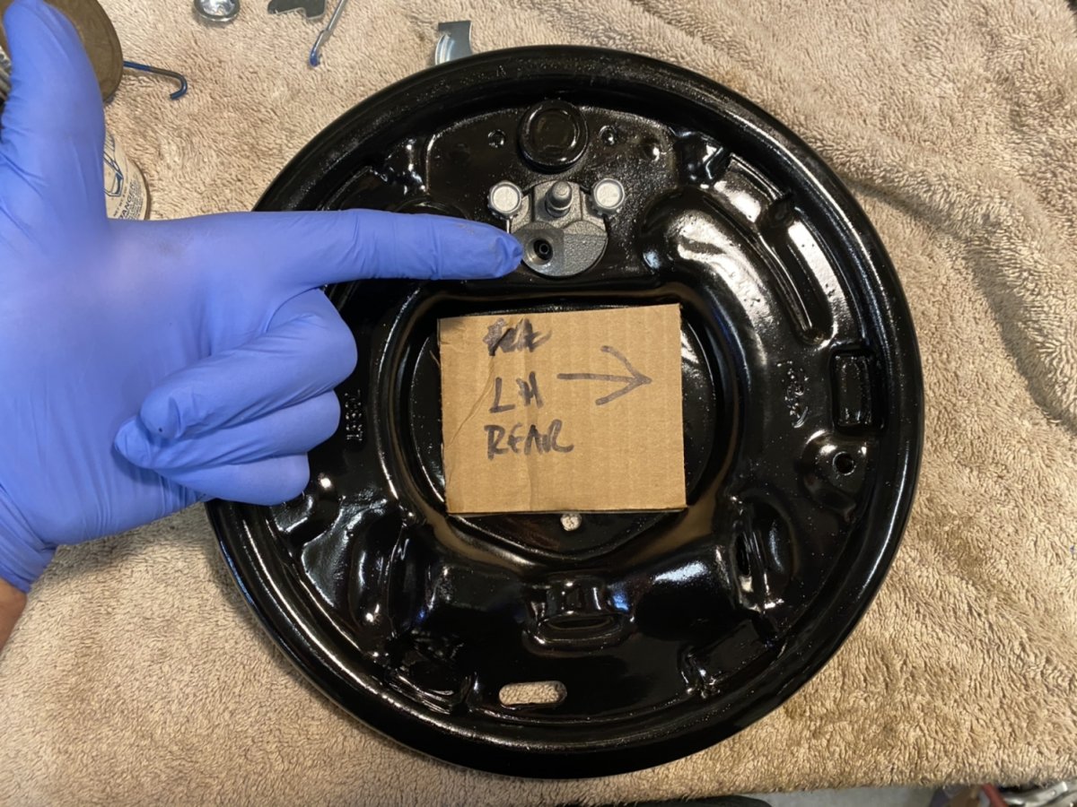

    A few pointers for those who might be intimidated with the rear brakes, because of lots of little parts.
    Like I said before, if you lay it out right and left, if you have the self adjusters, like a little map it makes it a lot easier.

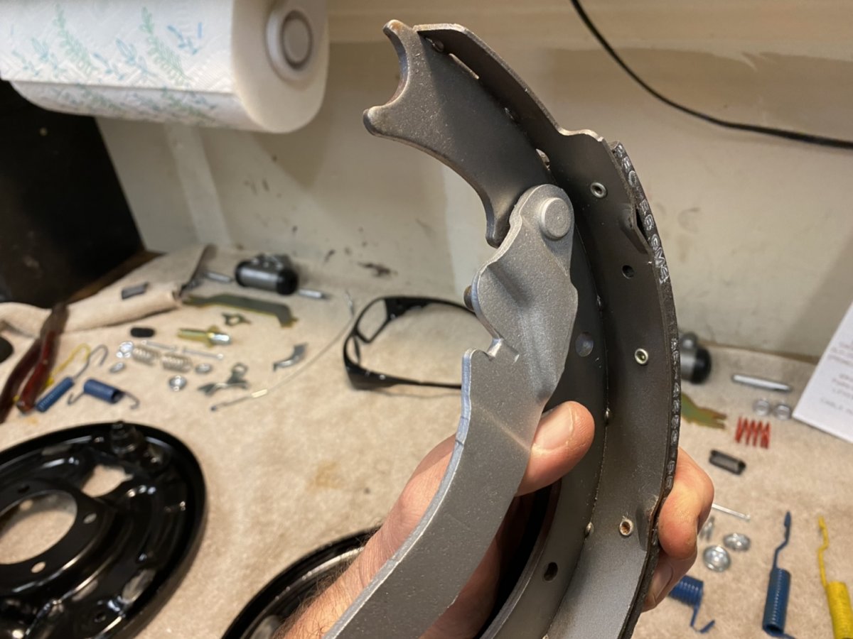

    So I started with the long shoe,
    and put the emergency brake arm on there first. That way you have a starting point so you don’t get all mixed up!
    just remember that the hole for the cable is on the opposite side.
    View attachment 4966292 View attachment 4966293
    8 inch, and 9” rearend, I believe, are the same. the brake line runs across the top back of rearend, so the wheel cylinder ports face the rear!
    For some reason I couldn’t use the shoe pin alignment washer, even shaved paper thin! Not enough meat where the springs go!
    It will be fine, it can’t go anywhere once the drums are anyway.

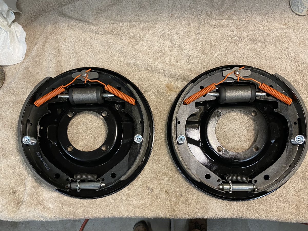

    Pointers:
    - attached wheel cylinders
    -Put shoe retainer springs on first, so the shoes, don’t go flying when you attach the top springs.

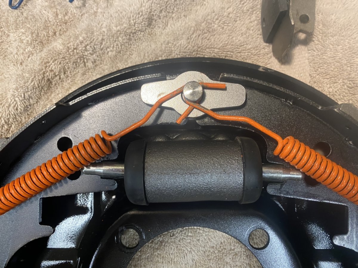

    -pins, e-brake cross bar
    -cable eye
    -put top springs on next
    -attached lower spring, to adjuster arm, cable around the 90’ and hooked on the cable hook...then pulled the little ***embly down to the hole, it locked in...alot easier! If that makes sense?
    Then trying the hook pliers!
    It’s hard to explain it all, but tried different ways of attaching things, and this way worked the easiest!
    Thanks!
    All built and safe on the wall, from getting jacked up until I build the ch***is!
    .....on to welding holes in the frame!
