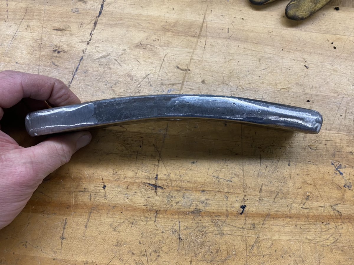

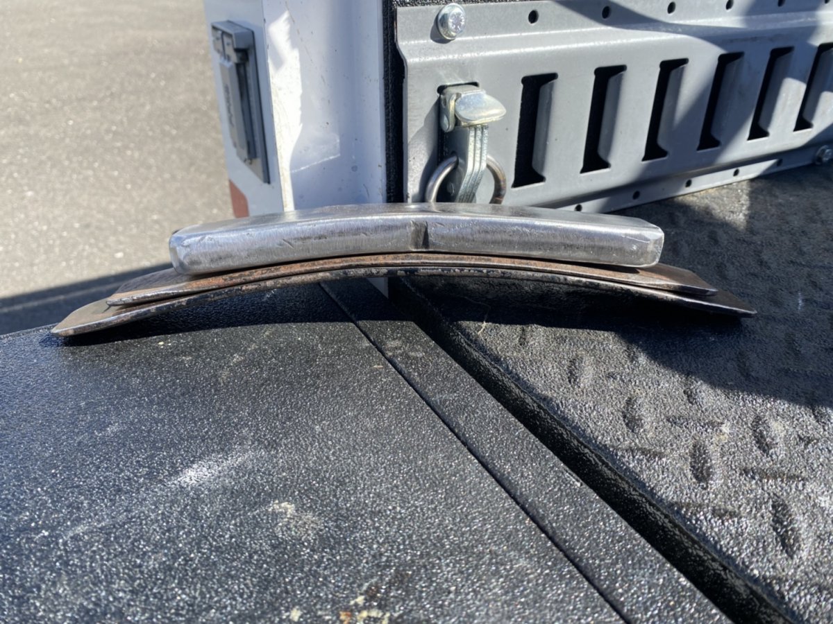

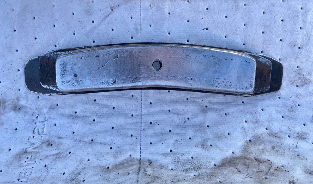

    Made a 3/4 thick spacer to add to the top of the rear Con-caved-double arched spring! To gain tire to fender clearance for My deep dish wheels!
    Actually went a little more curved then needed! I’ll tweak it tomorrow!

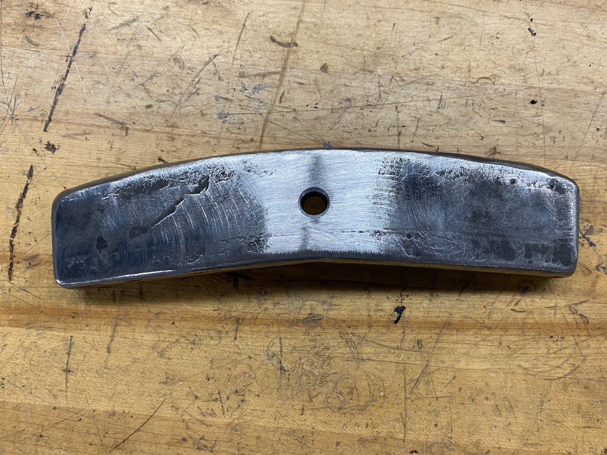

    I’m gonna bolt it to the spring pack, like its just an extra
    Thick short leaf and square the head of the bolt like the stock bolt to fit in the square hole, in the crossmember, but I have to flatten the spacer a little, I arched it a little to much. Hope
    that makes sense?

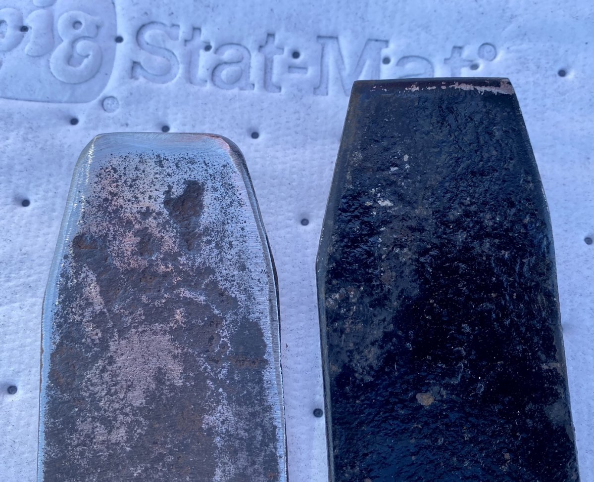

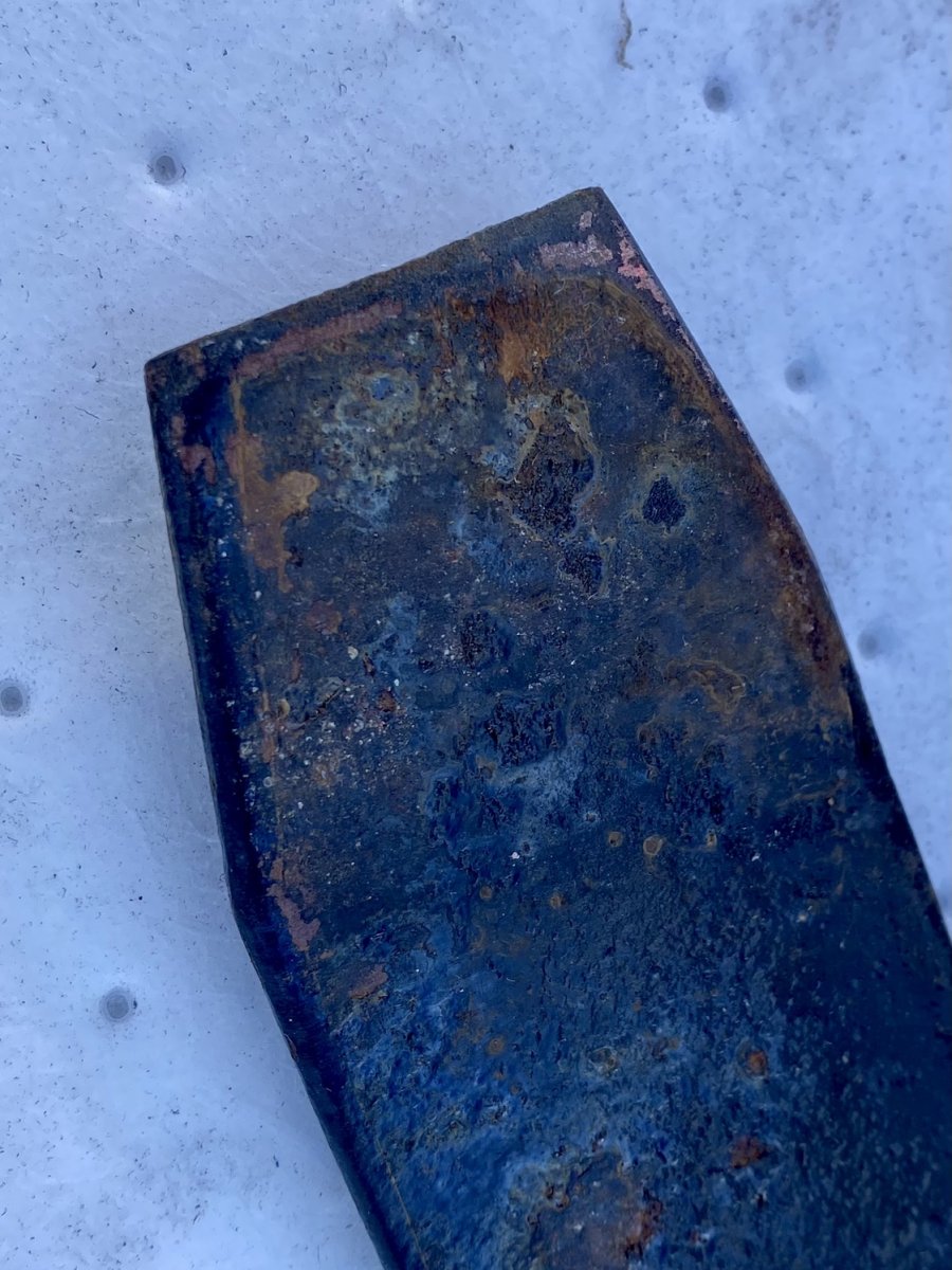

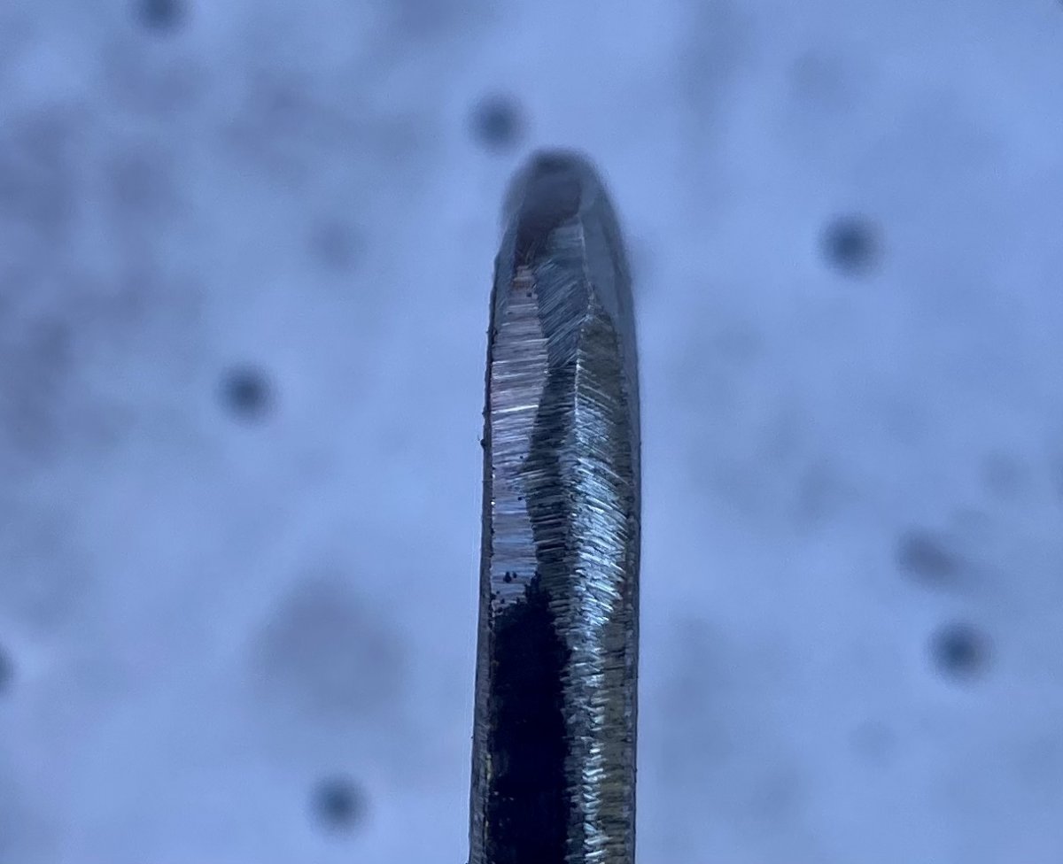

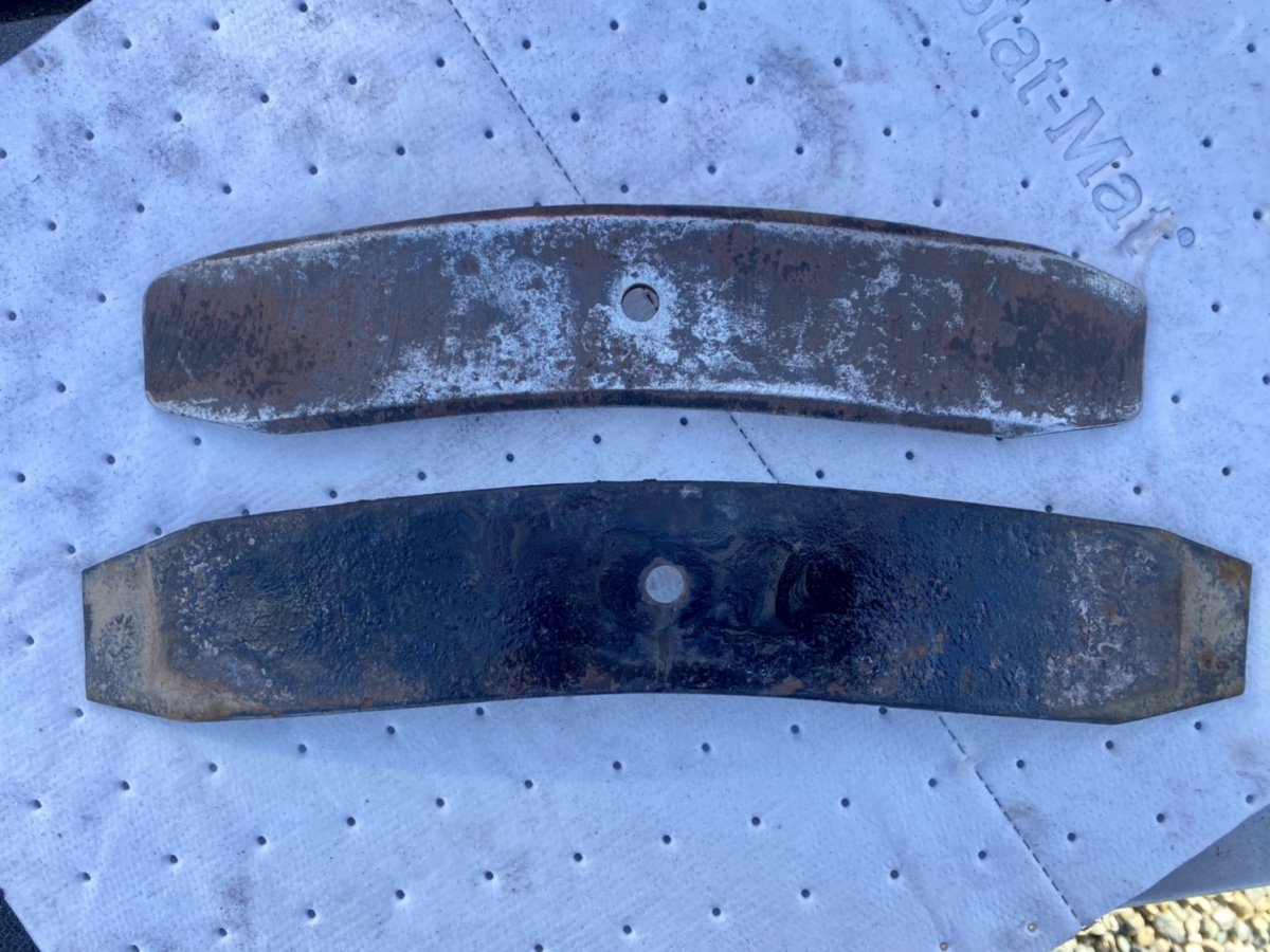

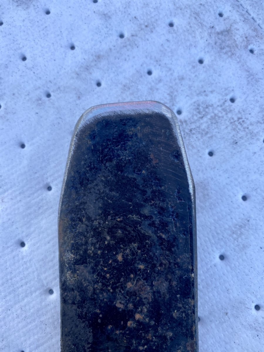

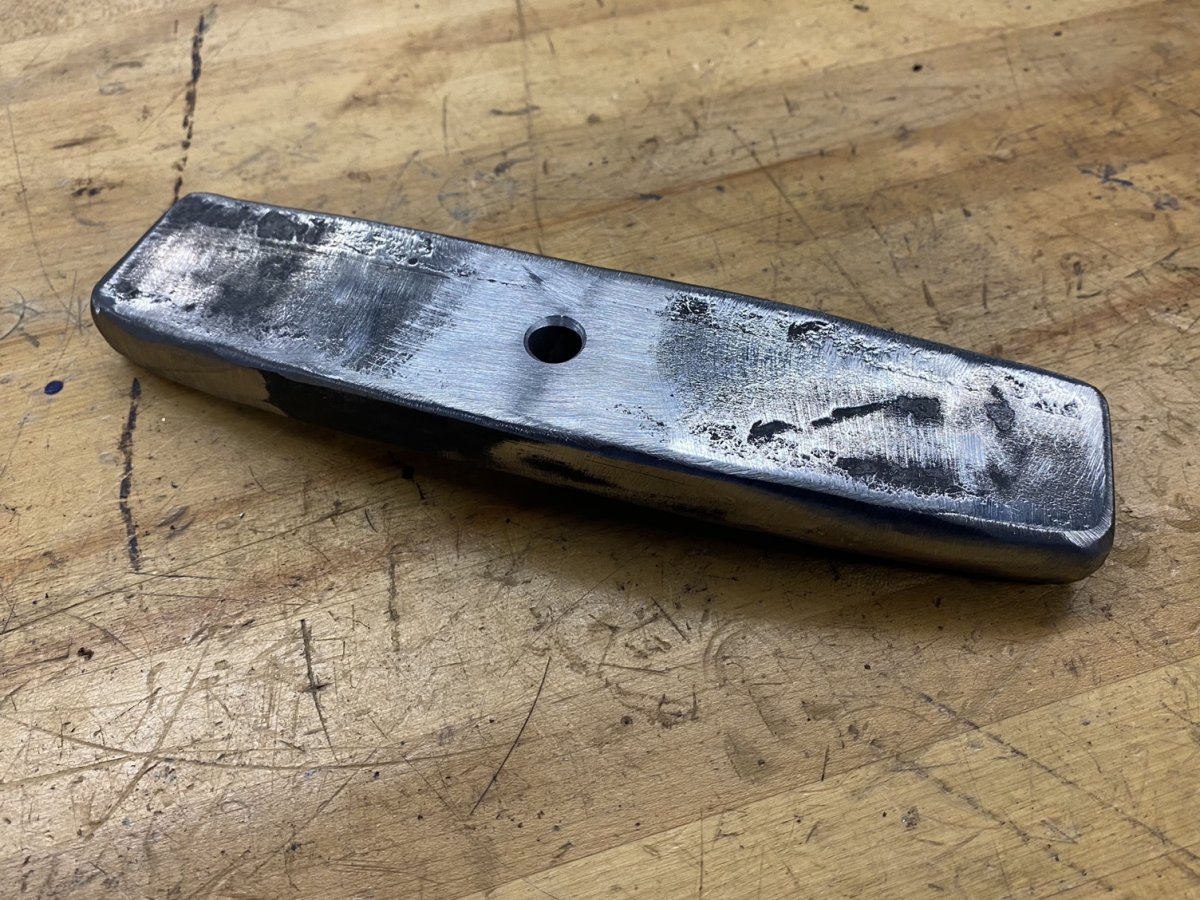

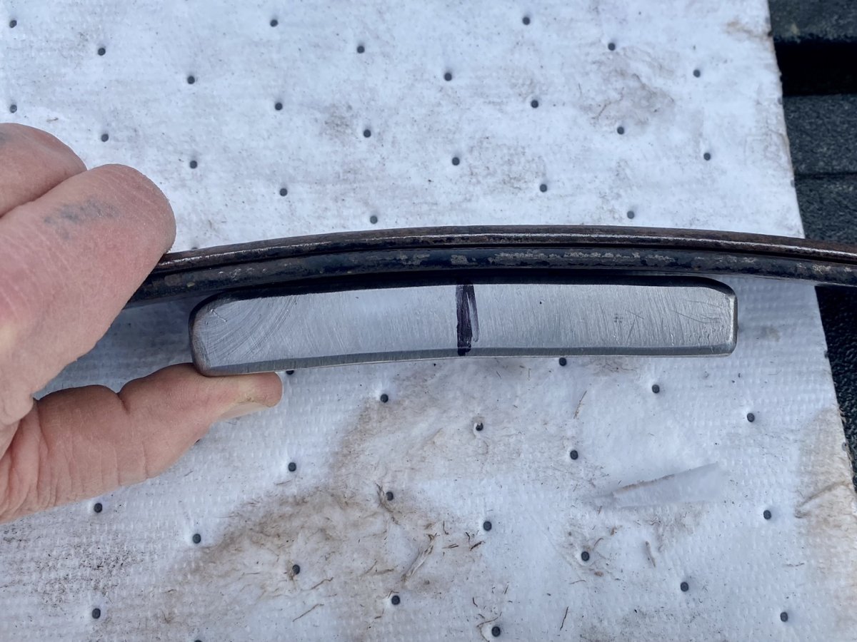

    So.....Heres what I did to a few of the leaves to show you all how I radiused the edges and took off the burrs on the leaves. I didn’t go as radical as I did the front spring years ago, for a couple reasons, I don’t want to heat up the metal too much to lose the tension, and if you take too much off it might make it sag, or chip off the ends....So just enough to chamfer the edges to smooth it out, then I’m gonna paint the leaves and put new poly-ethylene black liner between the leaves, and may be a little bit of grease. I’ve done that in the past, and the spring moves so well, that the car actually sits lower sometimes, because it’s not binding at all!
    I also made 3/4 inch spacer to fit on top of the rear spring. To lift the rear of the car 3/4 of an inch, and I then made a 3/4 inch spacer to go on the bottom of the front Spring pack to lower the front 3/4 of an inch, after I take off the 3 thin spacers that are currently on top of the spring pack.
    Picture example:
    And for the model a guy...I don’t know what pin he’s talking about, but I am using the stock center hole on the spring, to bolt everything together just like a normal spring pack, including the spacers.
    It’ll all make sense, once it’s put together!!
    IMG_1511.JPG IMG_1513.JPG IMG_1517.JPG IMG_1516.JPG IMG_1518.JPG IMG_1524.JPG IMG_1521.JPG

    Good that you beveled the ends of that block. Learned the hard way flat straight block on an OT vehicle with no bevel it had like 2-3 inches from the flat edge of the block before the spring started to curve but still the Main leave in contact with the block BROKE exactly at the edge of the block after maybe 6 months of use. :mad:

    Yes! that is exactly why I did that.
    Plus if you look closer, I put a slight arch in it also.
    The block on the front spring, is just basically a filler so the The U-bolt
    clamp/plate doesn’t bottom out on the cross member, from having to many leaves/ spacers out.
    You probably already knew that.
    Gotta Love Metal!!! (Both Kinds)

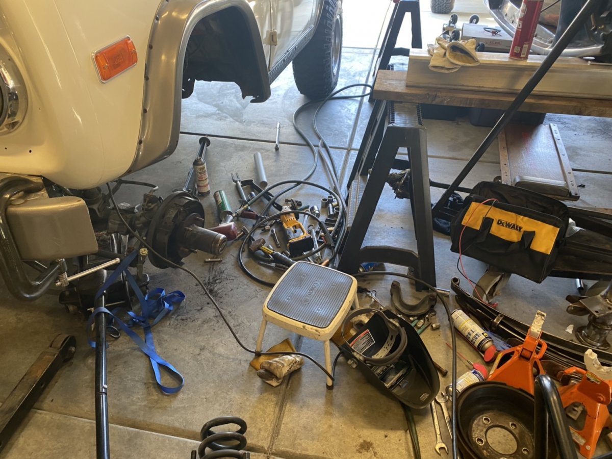

    Well, how do I get myself into these predicaments? I opened Pandora’s box!
    (The 33‘s in the picture so don’t say nothing!)

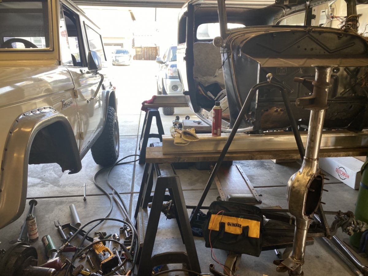

  20. gbones32coupe
    Joined: Jan 1, 2007
    Posts: 733
    gbones32coupe
    Your garage looks like my garage right now hahaha funny how many tool you can have out when you are working in little space Image%20(10).jpeg
    Sent from my LM-Q720 using The H.A.M.B. mobile app

    Yeah I was saying that myself how in the heck can I get every tool I own practically in one space in 20 minutes or more!

    Horry Cow! I might as well have emptied rollaway drawers right in the middle of the Garage!

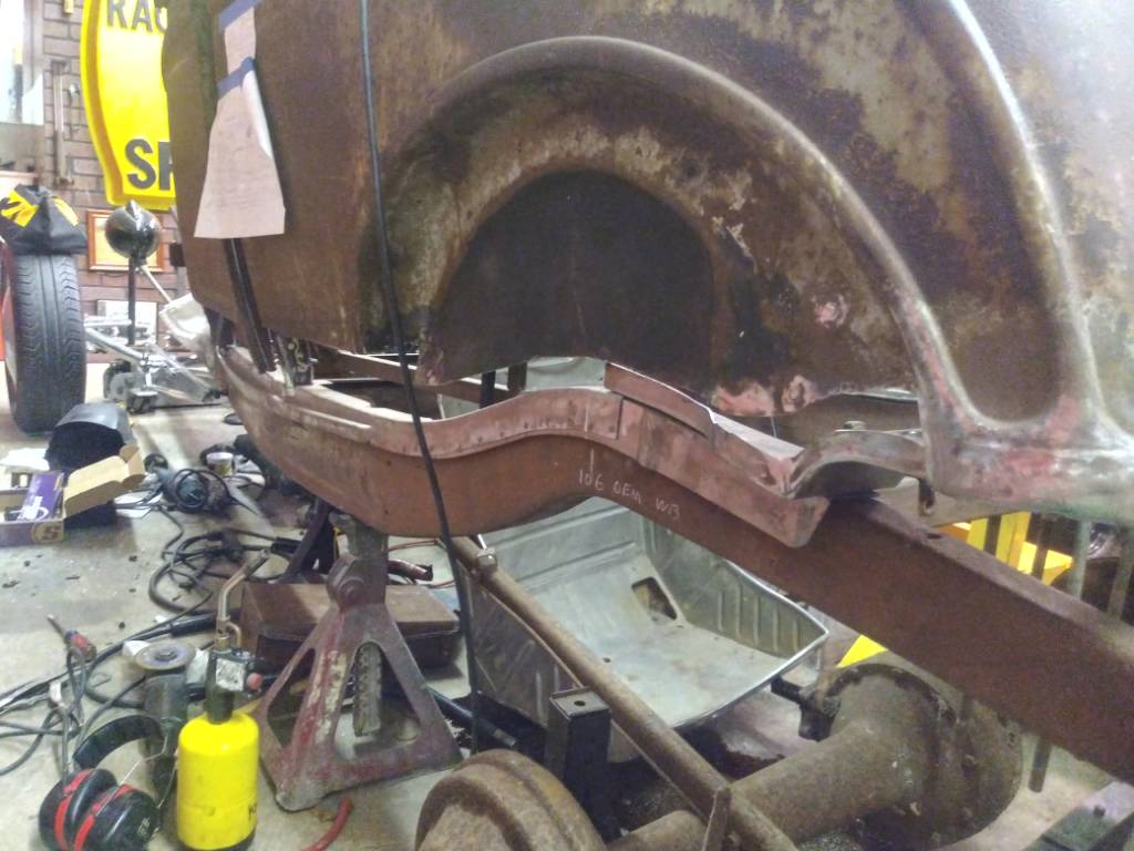

    All bushings changed, drop bracket welded!
