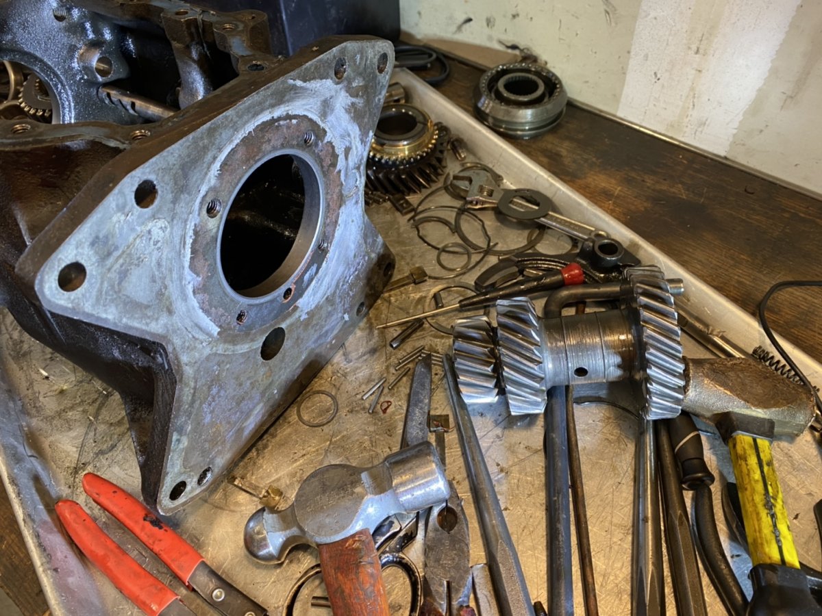

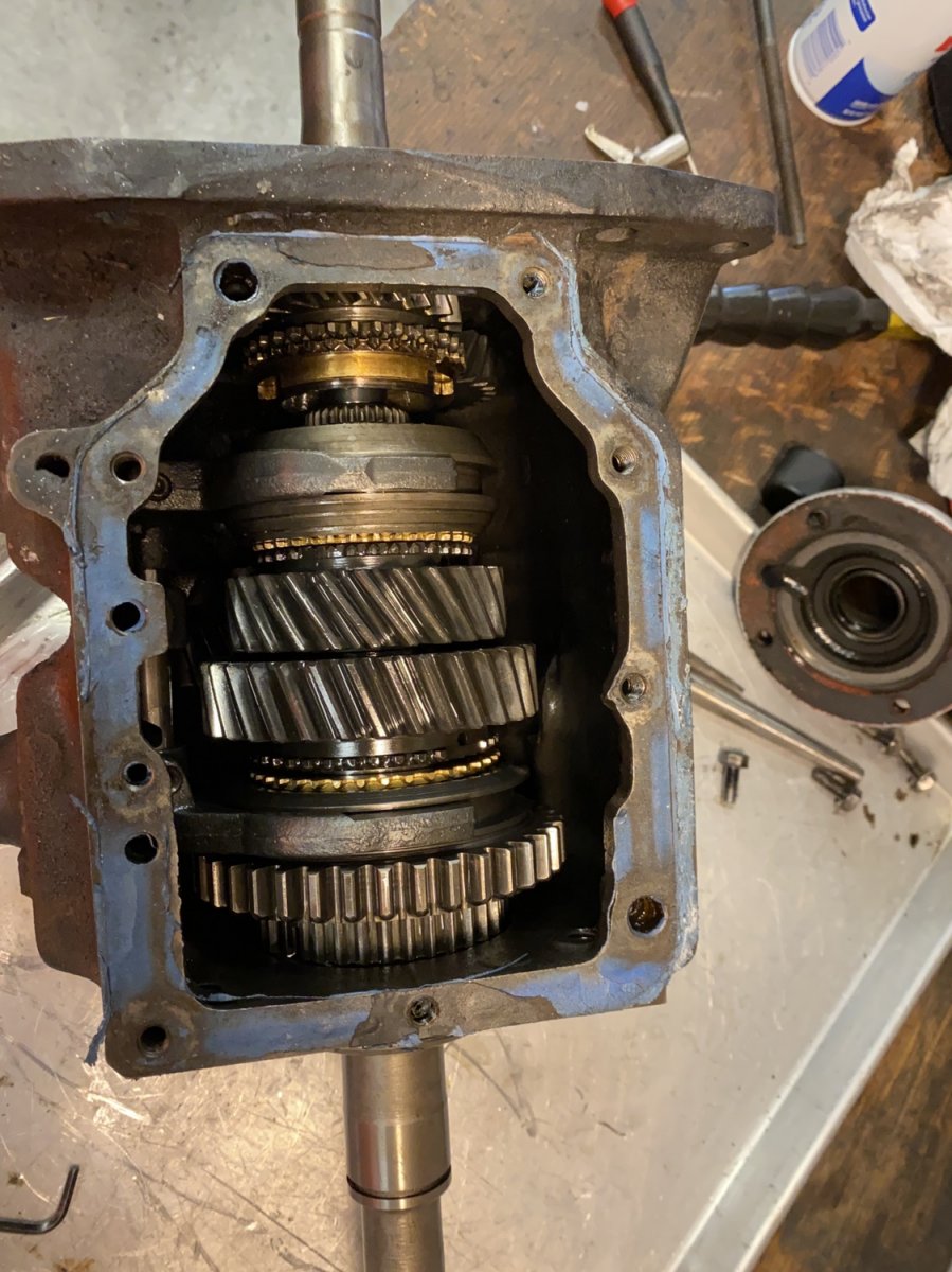

    F$&&&kkk!!!!!
    Damn! Needle Bearings Fell out Trying ti put the ****** Back in the B$&@@co!
    Now I have to rebuild the whole damn thing, had to cut off the bearing on the back get it apart!!!!!
    Oh well there’s a few broken clips and things anyway!!!!! IMG_1867.JPG IMG_1871.JPG IMG_1870.JPG IMG_1872.JPG IMG_1861.JPG

    It was a good thing though, the snap ring broke on the inside shaft were the synchro rides, and it was forcing the cone into the inside getting it really hot you can see the bluing.

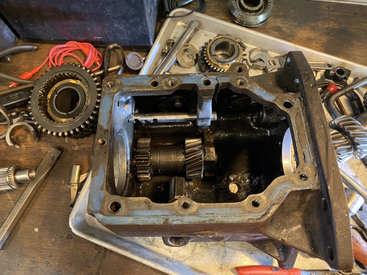

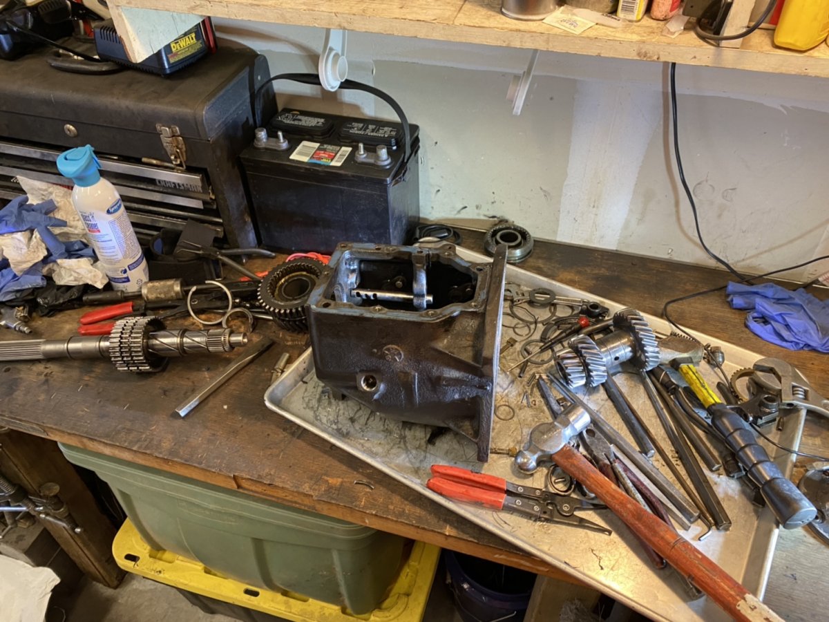

    I’ve been learning Stuff!
    Now I can do a C-4, early Ford, 3 speed, and a later Ford 3 speed!
    I made a dummy shaft for the cluster shaft, made life a lot easier, plus the needle bearing kit I got they are slightly tight on purpose, so they can’t fall out, even without
    The Grease. Put some in anyway.
    (The Zip ties are so the shaft can not pop out on me again, while putting it in!)

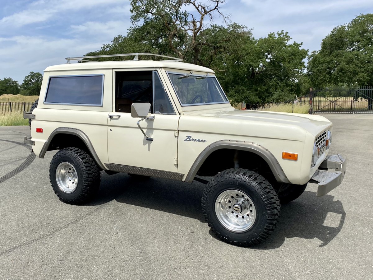

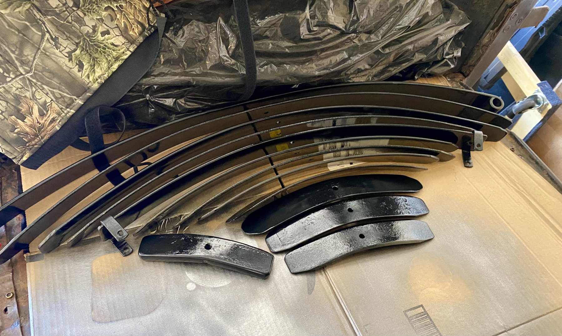

    BRONCO is Sold!
    Gone!
    Back to the Doll!
    (After Some backed up honey-dos!
    Might be another month or so)
    She’s worth it! She was very patient while I was doing this for the last three or four months!!!
    Plus she’s getting a new Mac computer from my pay cut!
    Put the doll in there with this pic so I don’t get in trouble!!!
