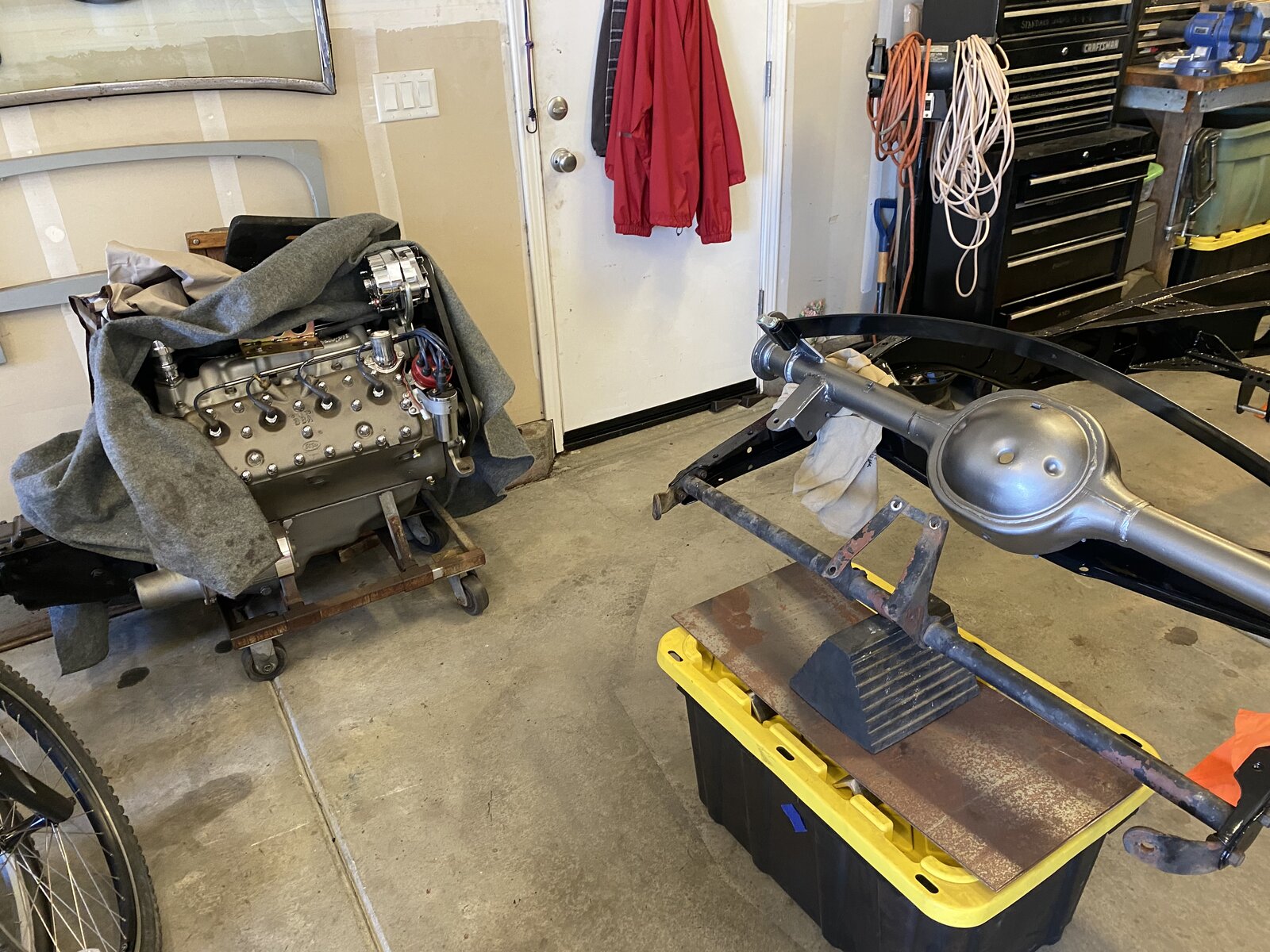

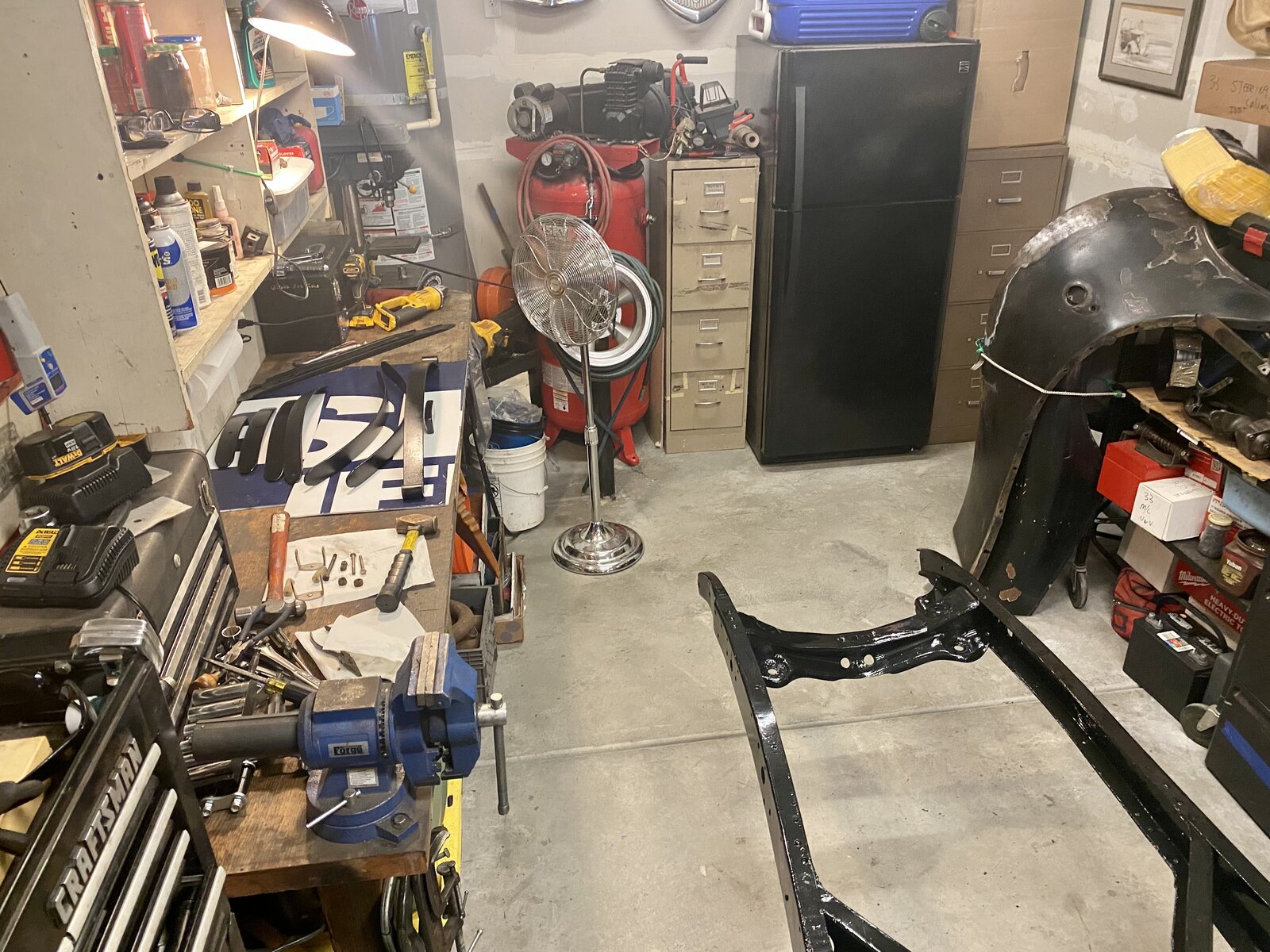

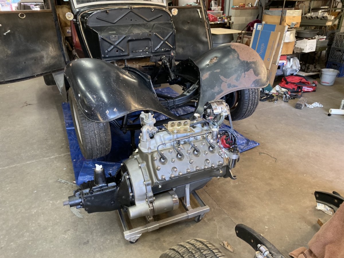

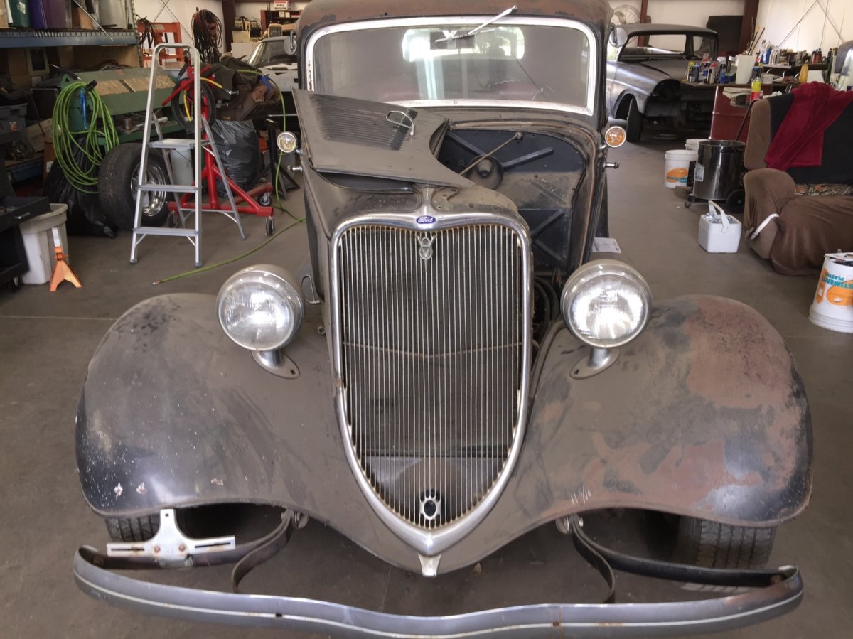

    Few Random Pics of the Doll
    That make me Smile!

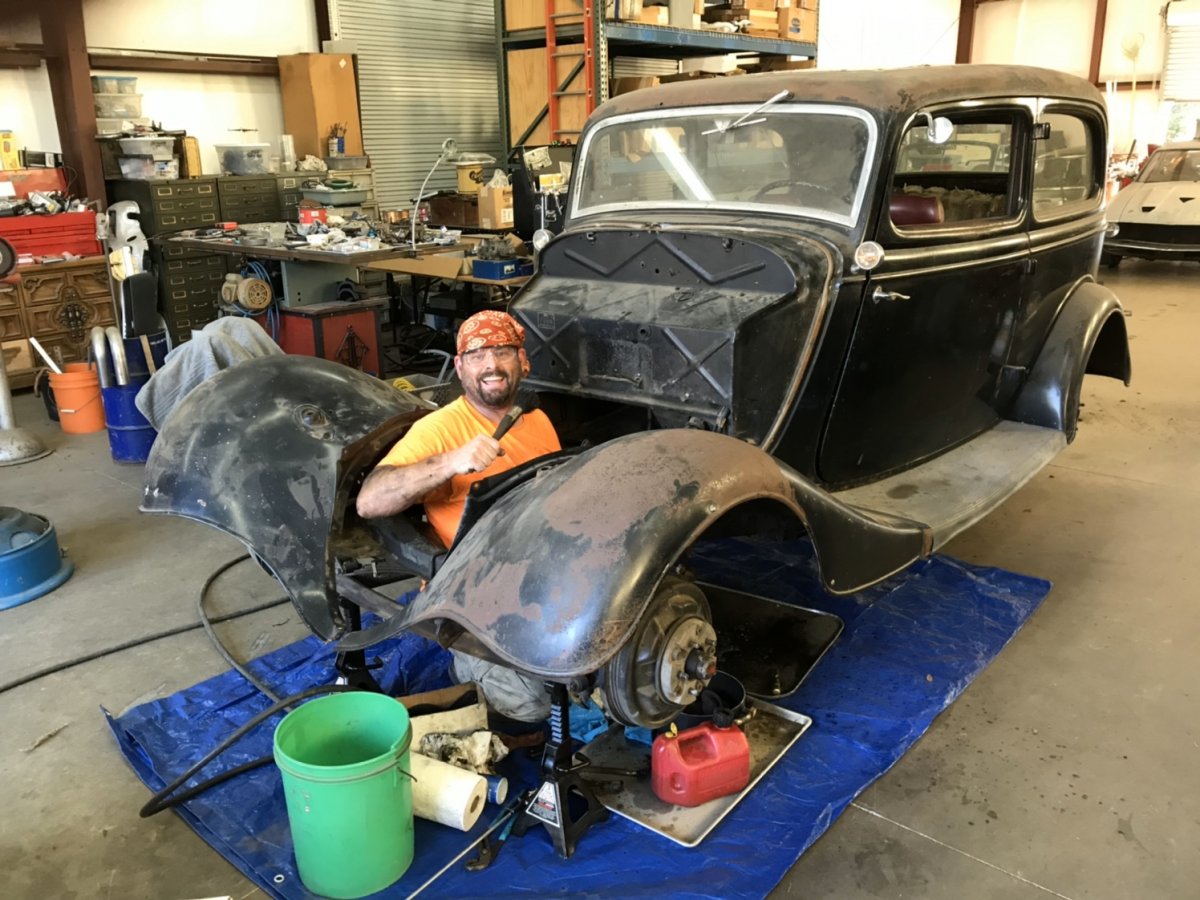

    How did you get Jack Nicholson to sit in the engine bay ?
  3. 33Doll
    Joined: Sep 27, 2019
    Posts: 1,602
    33Doll
    “Heres….RICKY!”
    Yeah that’s my cheesy baseball star grin!

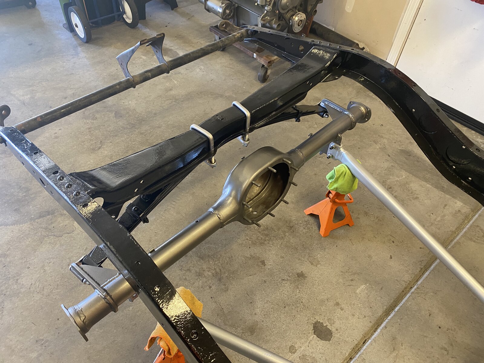

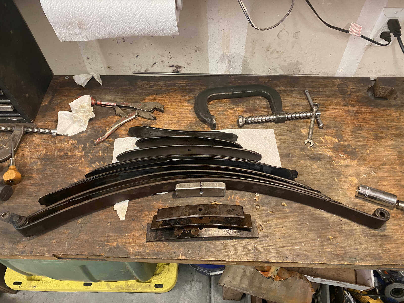

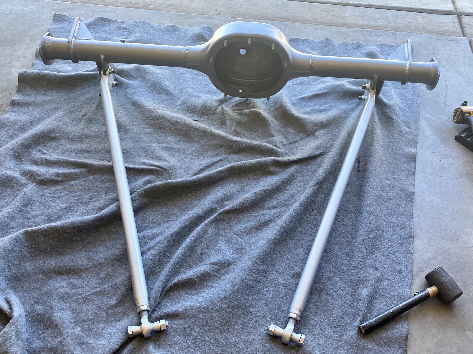

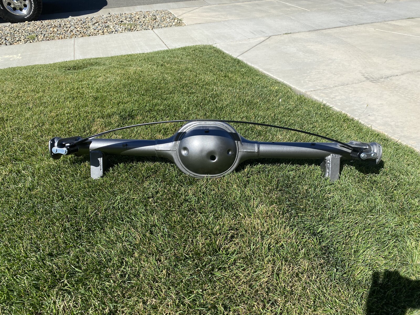

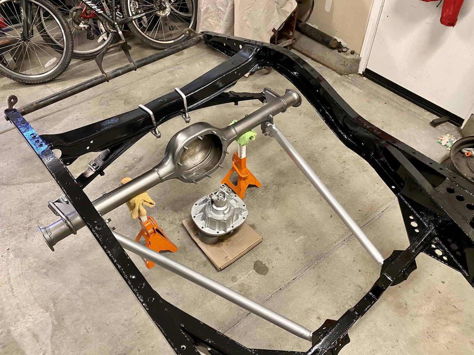

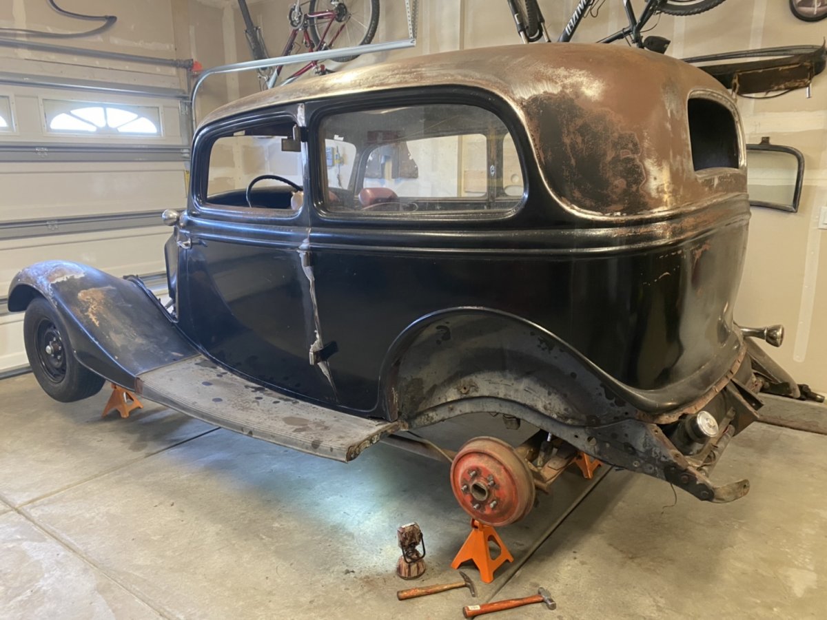

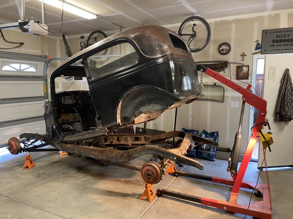

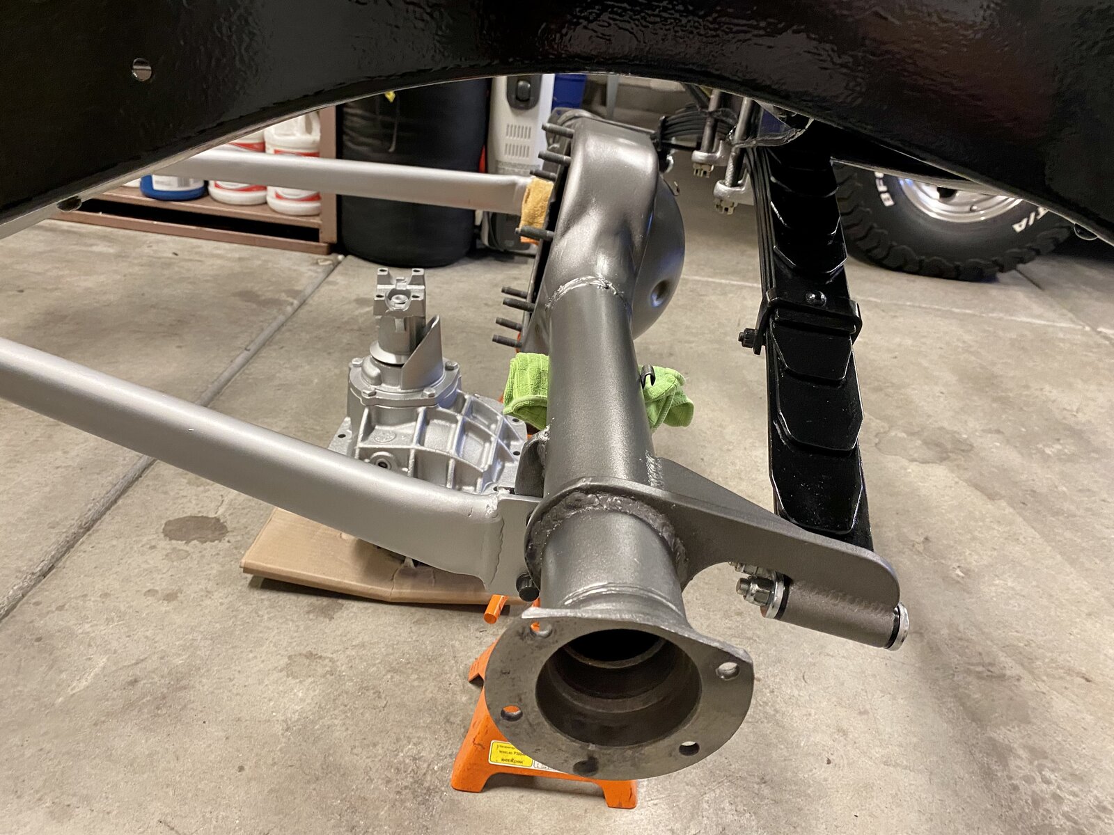

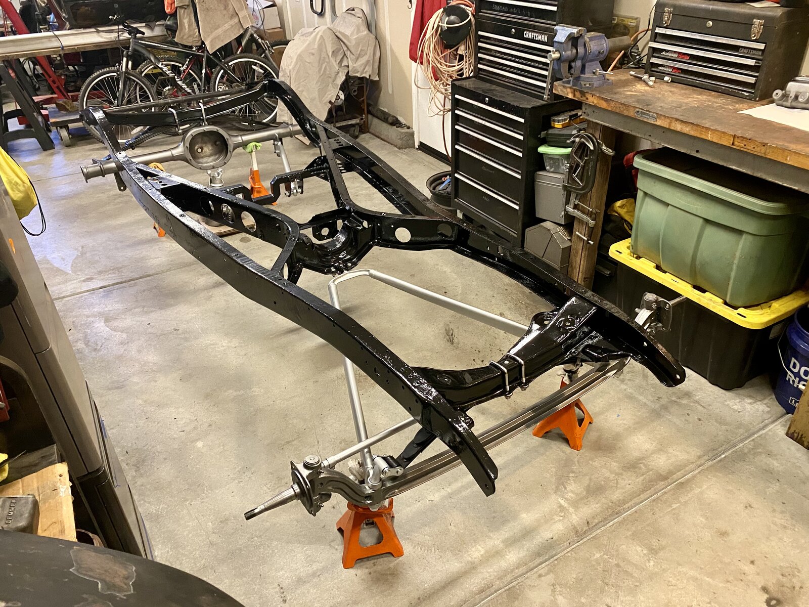

    Got some more done today!

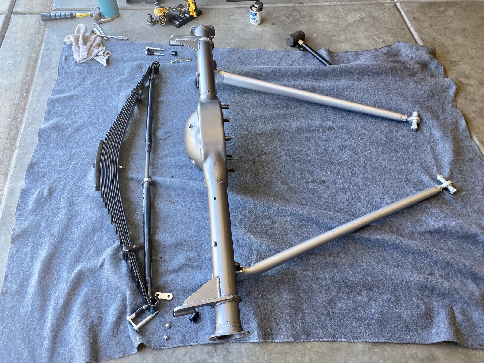

    Had to order some 7/8x 3/4 split sleeves to fit in my stock main leave in order to use Speedy Bills “universal “ Shackles!
    Also I am gonna have to build a spring spreader. Even getting the single leaf on there temporarily, was hard. And thats with the loose bushings.
    All thread, pipe, nuts, flat stock, ought to do it!
    I think I am going to paint the 3rd member, and the wish bones cast aluminum, black drive shaft. Ought to go with the graphite and cast iron paint on the engine! AEABF3C3-8E18-4791-AAB0-5E73967868A4.jpeg

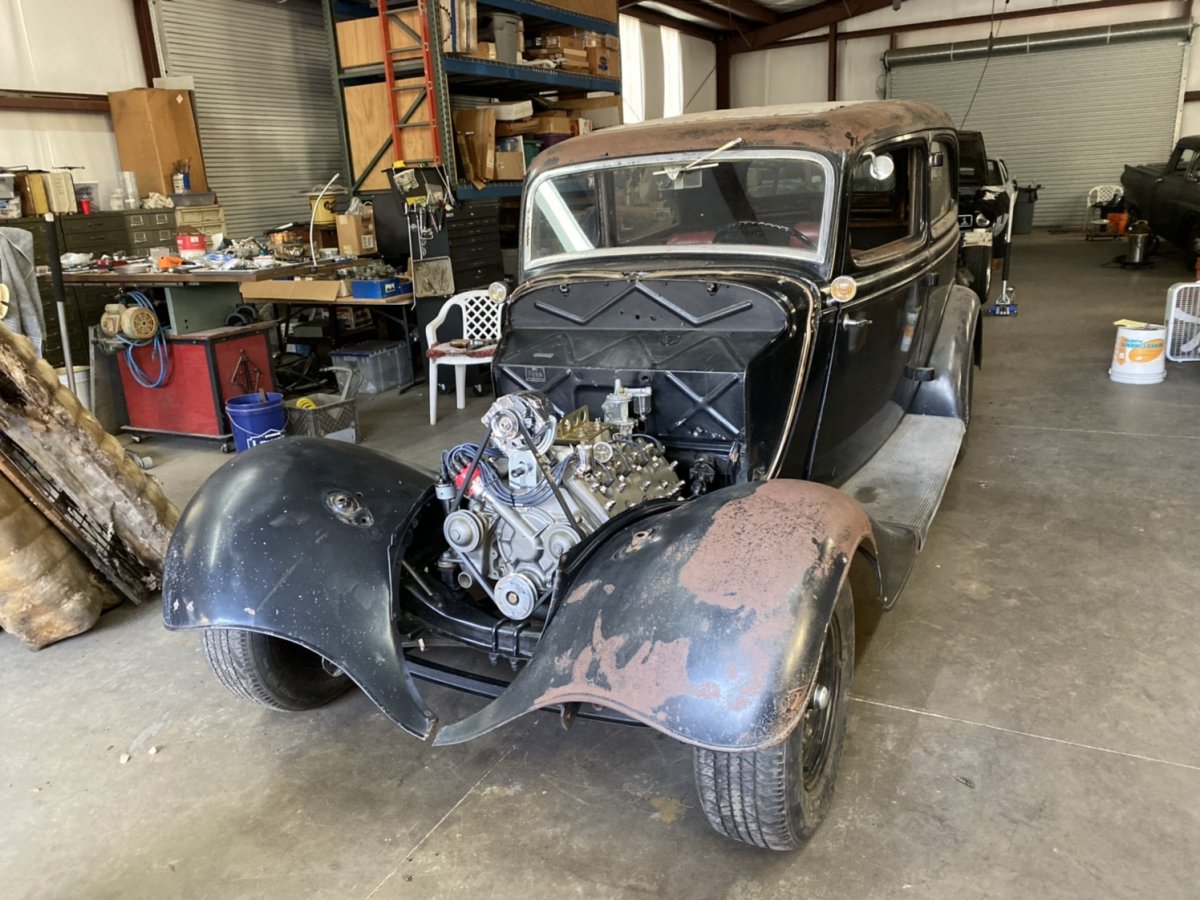

  7. 33Doll
    Posts: 1,602
    33Doll

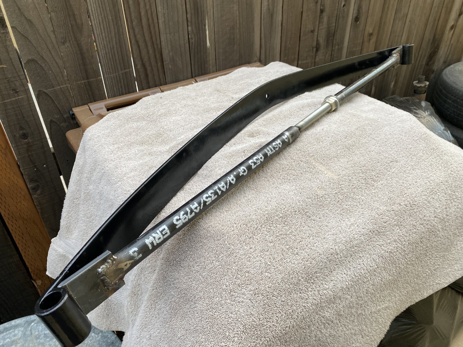

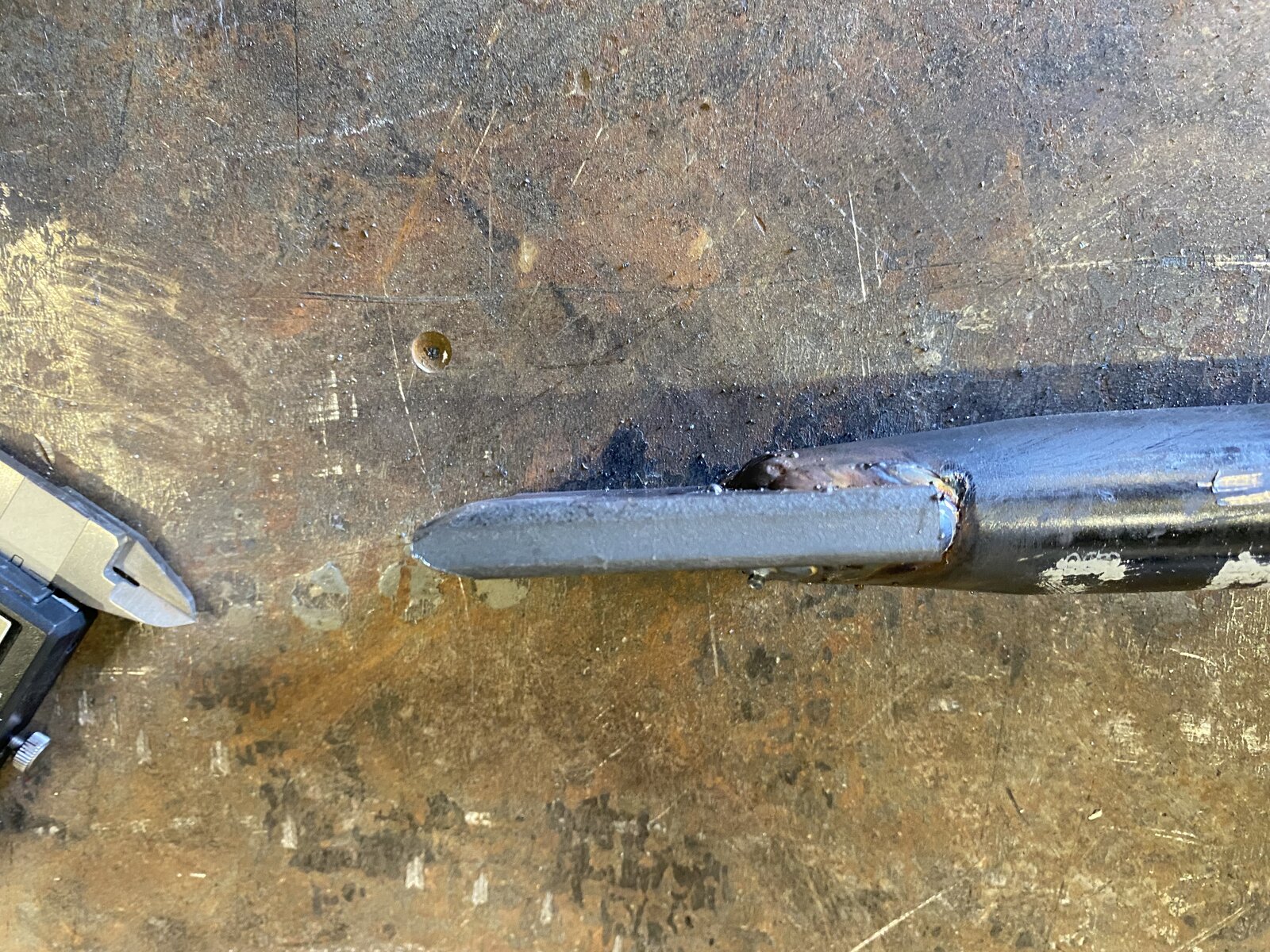

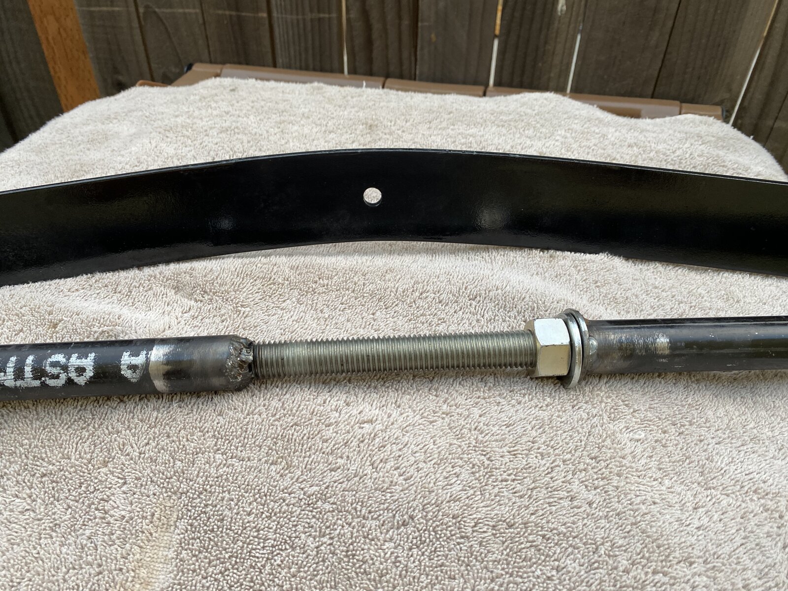

    Made a Spring Spreader real quick, ill have to fine tune it later when I get home.
    Sharpened them a little bit more, and maybe tape them up, for less scratching.
    I included some close-ups,if somebody’s interested, they can make something similar, (however it won’t work on a reversed
    eye-Spring) DB6C1DE1-7702-41FB-9160-E57437C02932.jpeg B443160D-EC8D-4724-9FE7-7C47ED859A32.jpeg 6CA7CCEE-DF60-444D-9A8D-67A1CFFDDD70.jpeg BC7E0B56-3A13-4FCD-8938-461A66D0DFBA.jpeg DB6C1DE1-7702-41FB-9160-E57437C02932.jpeg B443160D-EC8D-4724-9FE7-7C47ED859A32.jpeg 6CA7CCEE-DF60-444D-9A8D-67A1CFFDDD70.jpeg BC7E0B56-3A13-4FCD-8938-461A66D0DFBA.jpeg
    loudbang, brEad and Jim Bouchard like this.

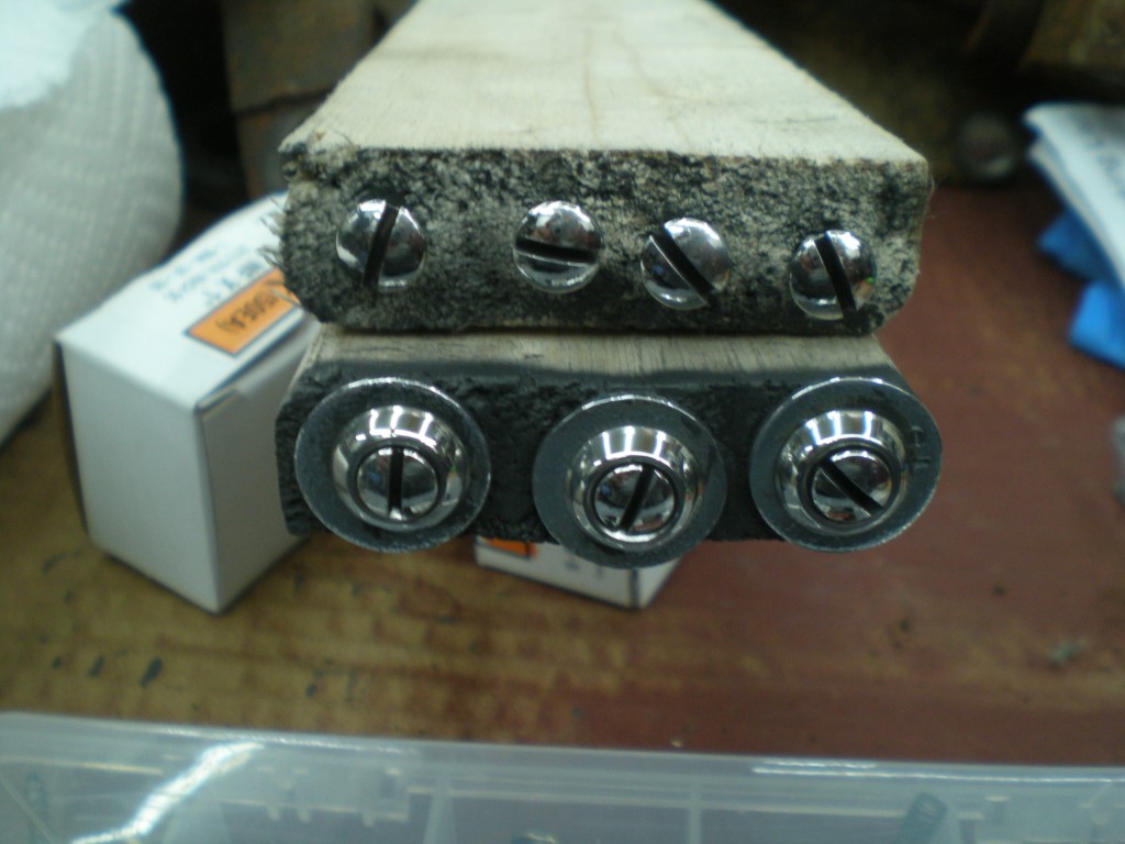

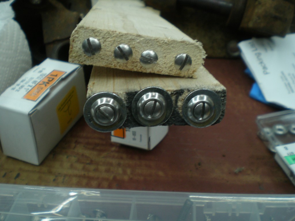

    When I was putting the header panel in my coupe; I discovered that the plated finishing washers at the hardware store were no longer shiny. Picked up the dull stainless version as I had to polish the screws anyway. Used my go-to method of holding them in a chunk of wood to keep the buffer from flinging them off into some never-to-be-found-again corner. Thought if it worked for sheet metal screws; I could drill undersize holes and thread the machine screws in for polishing too. Lot quicker and easier than doing them one at a time in the rod coupler I used before.

  9. 33Doll
    Posts: 1,602
    33Doll
    That’s a slick idea they’re Rich!

    Looks like it will work.
    Just a little fine tuning.

    Heres a better view!
    It works killer!
    I still think I am gonna attach the wish bones and build the spring in place. There is alot of pressure with the whole spring together.

  12. rusty valley
    Joined: Oct 25, 2014
    Posts: 4,428
    rusty valley
    You will be cursing on the next step, those curved springs do not want to play nice and just stack up. Instead, due to the curve, the stack wants to tip over. Not just a matter of a chunk of threaded rod and they all sit still, you will get very creative with lots of clamps...best wishes
    33Doll and loudbang like this.

    Oops, I got that on the wrong thread; I think I was going to say something about your spring spreader and got distracted. Sorry to get into your story.
  14. RodStRace
    Joined: Dec 7, 2007
    Posts: 9,866
    RodStRace
    maybe glue a thin piece of leather on each end to avoid scratching...
    I haven't done this job, but springs under tension make me flinch.
    Could you add tabs at each end so the wedge can't slip out, and maybe a 'cage' so the additional leafs are held straight?
    Like this, but on both sides.

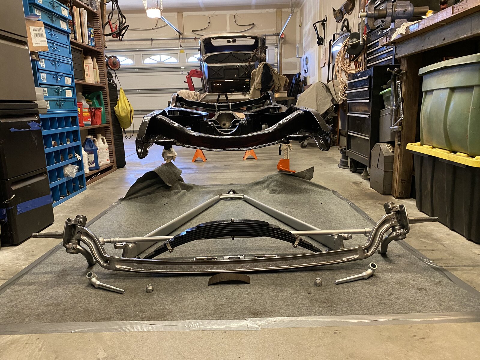

  15. 33Doll
    Posts: 1,602
    33Doll
    Thanks, gave me an idea.
    Not worried about the wedges they are solid.
    But stacking the sideways curved leaves could be a problem. So I am going drill 4 holes in my work bench and put 4 rods to hold the spring standing up, and cradle it as I build it.
    And an extra long threaded rod as I screw it down
    Just keeping the liner in there might be a problem because it’s straight and not curved sideways.
    loudbang and RodStRace like this.

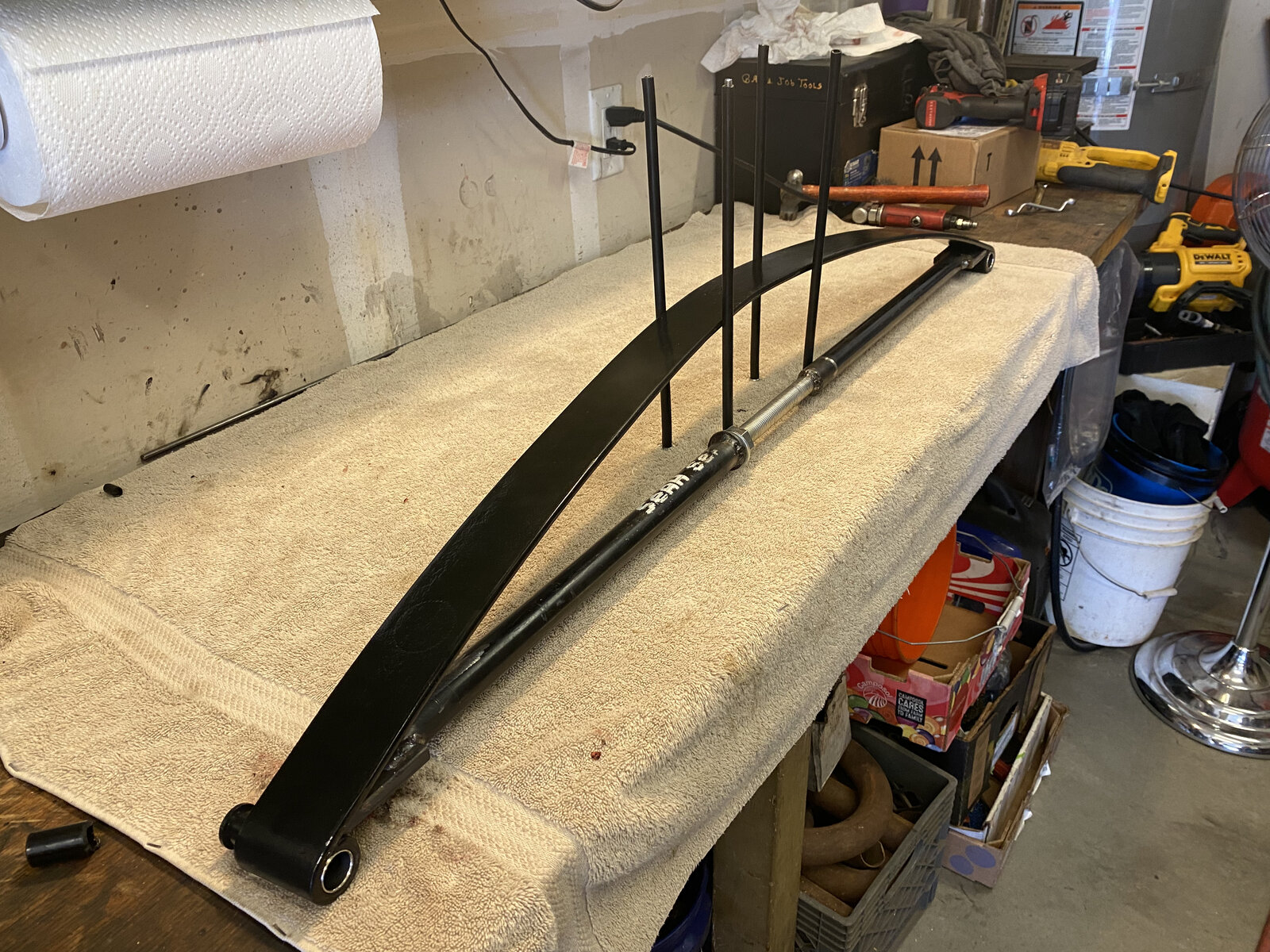

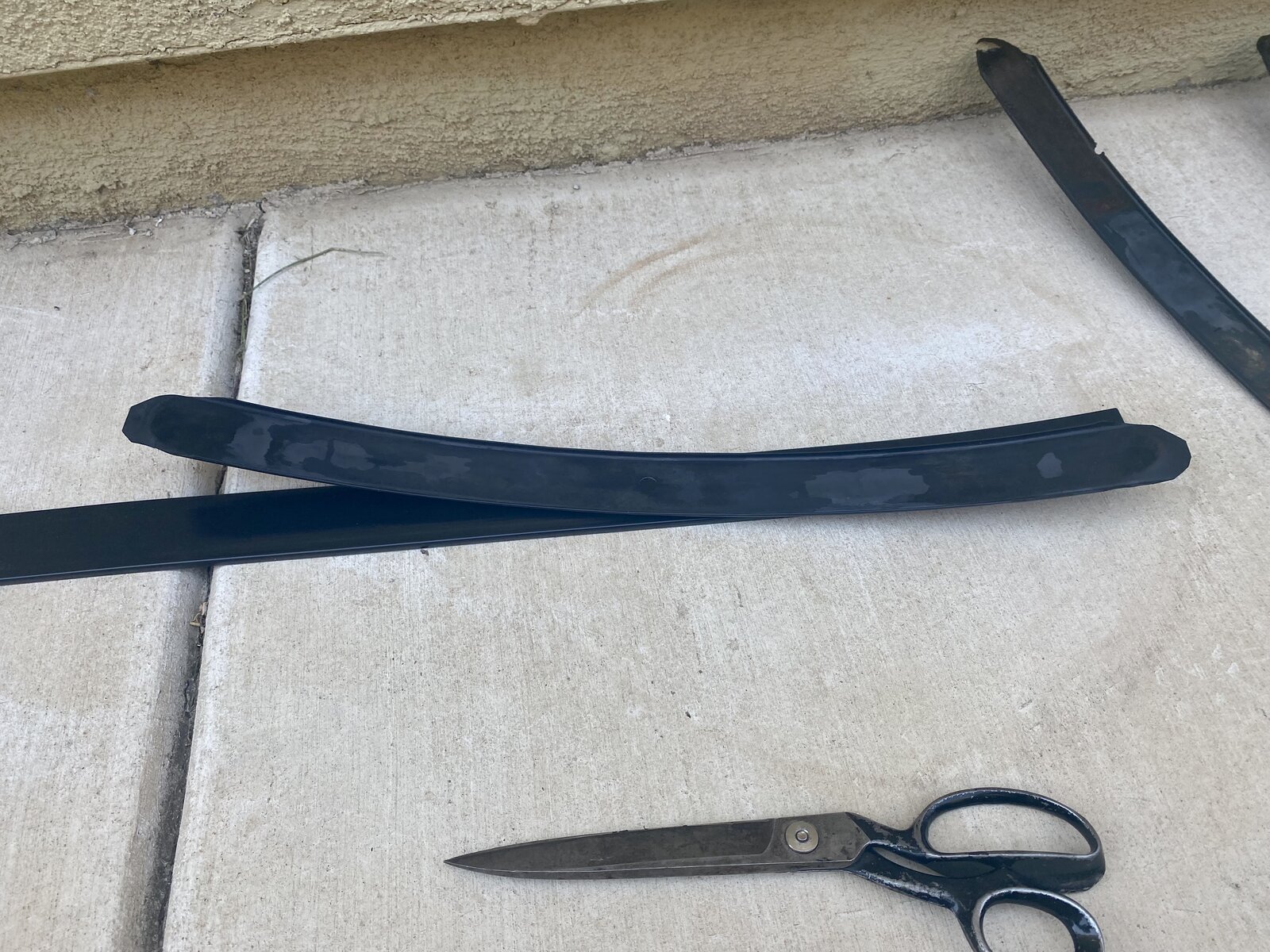

  16. 33Doll
    Posts: 1,602
    33Doll
    I got it now! I got a whole bunch of quarter inch threaded rod and some nylon tubing to slip over the rods so they don’t scratch the spring, and it’ll hold it in place on the workbench in an upright position.
    And a 3/8 Rod to tighten down spring stack.
    I also borrowed a heat gun. I’m going to hand form each piece of poly liner for each leaf.
    To keep them mostly in place. You cant
    Glue them down because they are supposed to slide!
    But I think that’ll do the trick!
    Now I see why shops like SoCal use 40 Ford rear Springs! No concave compound curve, just straight.
    Jim Bouchard and loudbang like this.

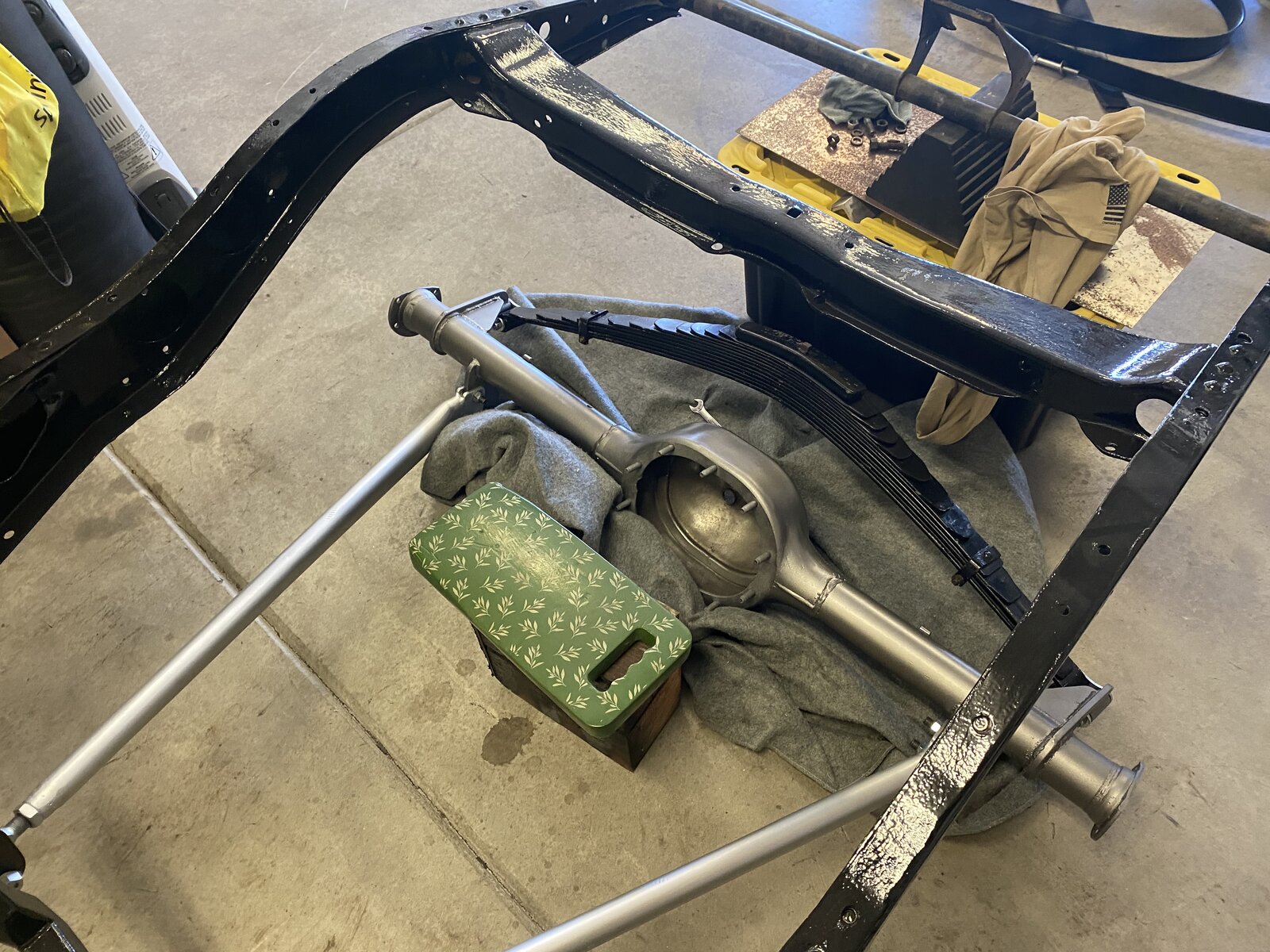

  17. 33Doll
    Posts: 1,602
    33Doll
    What a *****!!

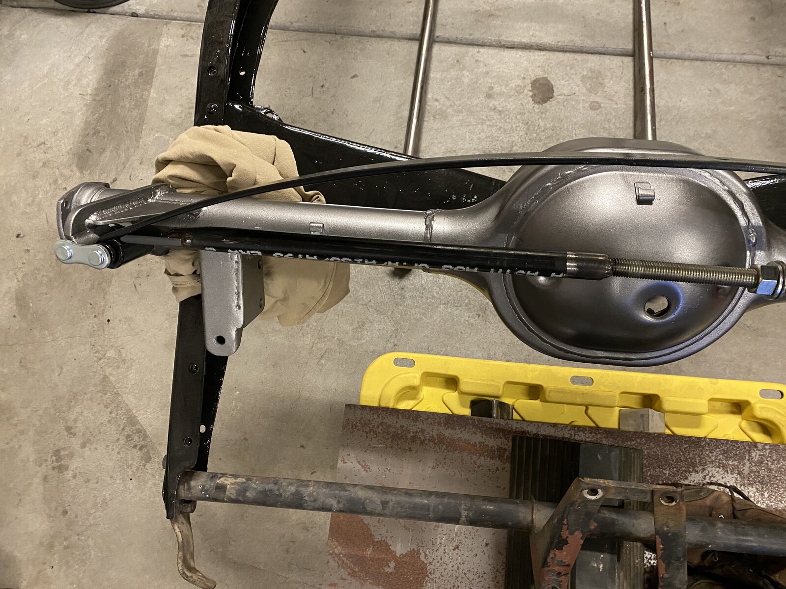

    My fixture did not work.
    Had to lay the spring on the floor with several clamps.
    Put the side bolts in and then tighten the center bolt! Liner says NO! bunched up! And wont go in no matter what!
    The ends are are tapered now, and I greased each leave so or should be fine.
    Oh well done!!!!
    23EAB199-513D-4F35-B9FB-FB02074A862B.jpeg 29396952-36F2-4750-8BE2-BA9986C3B07D.jpeg 23AC66DC-C8F5-40FE-B622-1252A41DDDA4.jpeg 27F9B413-8602-4CA9-91C9-C441BEBC71EC.jpeg E22E9A8E-3AD7-4967-AD7F-8FB15B6BEA2C.jpeg 9C48FFFE-52F3-4FE0-B57B-B03A4D37AA0D.jpeg 6AD2A371-8A46-44CF-A638-A288D5B470AD.jpeg 2F7C310D-626E-4214-8CF0-D8FE841F3143.jpeg 44CA9C76-B164-4DEB-9D29-878B81130F57.jpeg 08B3E8CD-5CEB-4C4B-B927-1A8B7B930F6D.jpeg 13B0D05C-8306-448A-B139-2E4F8A7C3FD7.jpeg
  18. 33Doll
    Posts: 1,602
    33Doll
    Yup!!! You were Spot on!! Damn double curved spring ****s!!!!!
    But its in!!! Have a little touch up to do and no liner!!!

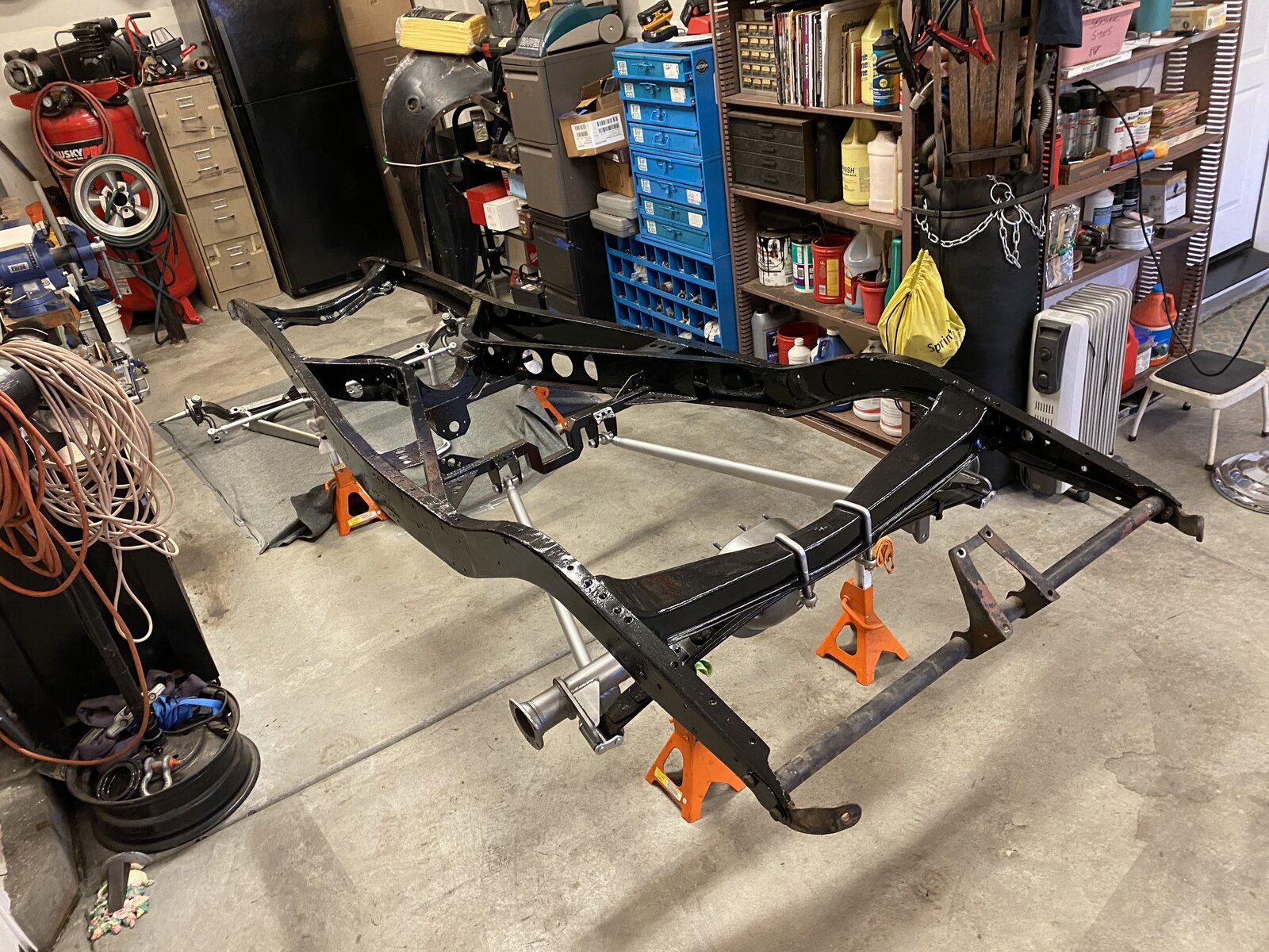

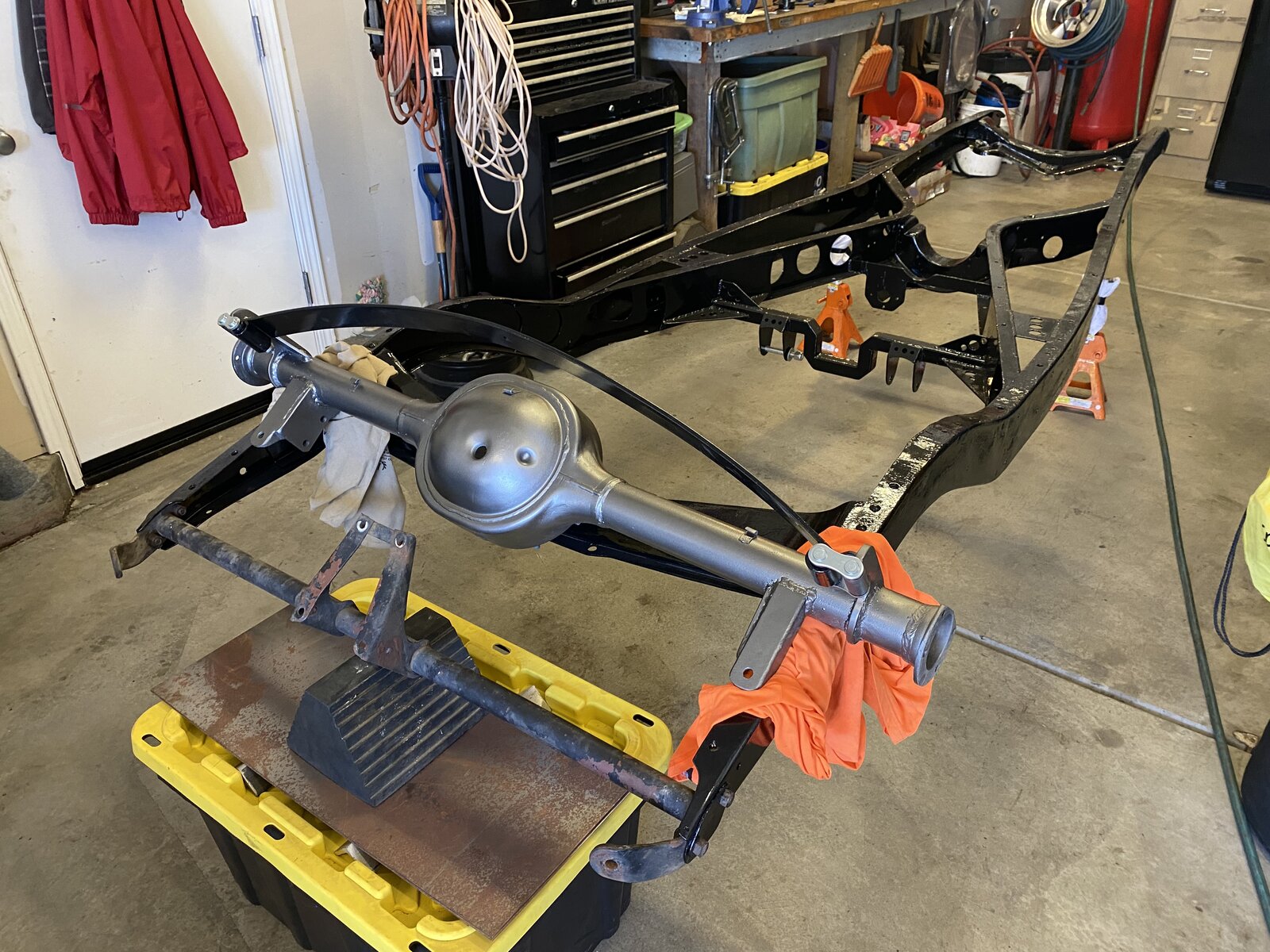

  19. 33Doll
    Posts: 1,602
    33Doll

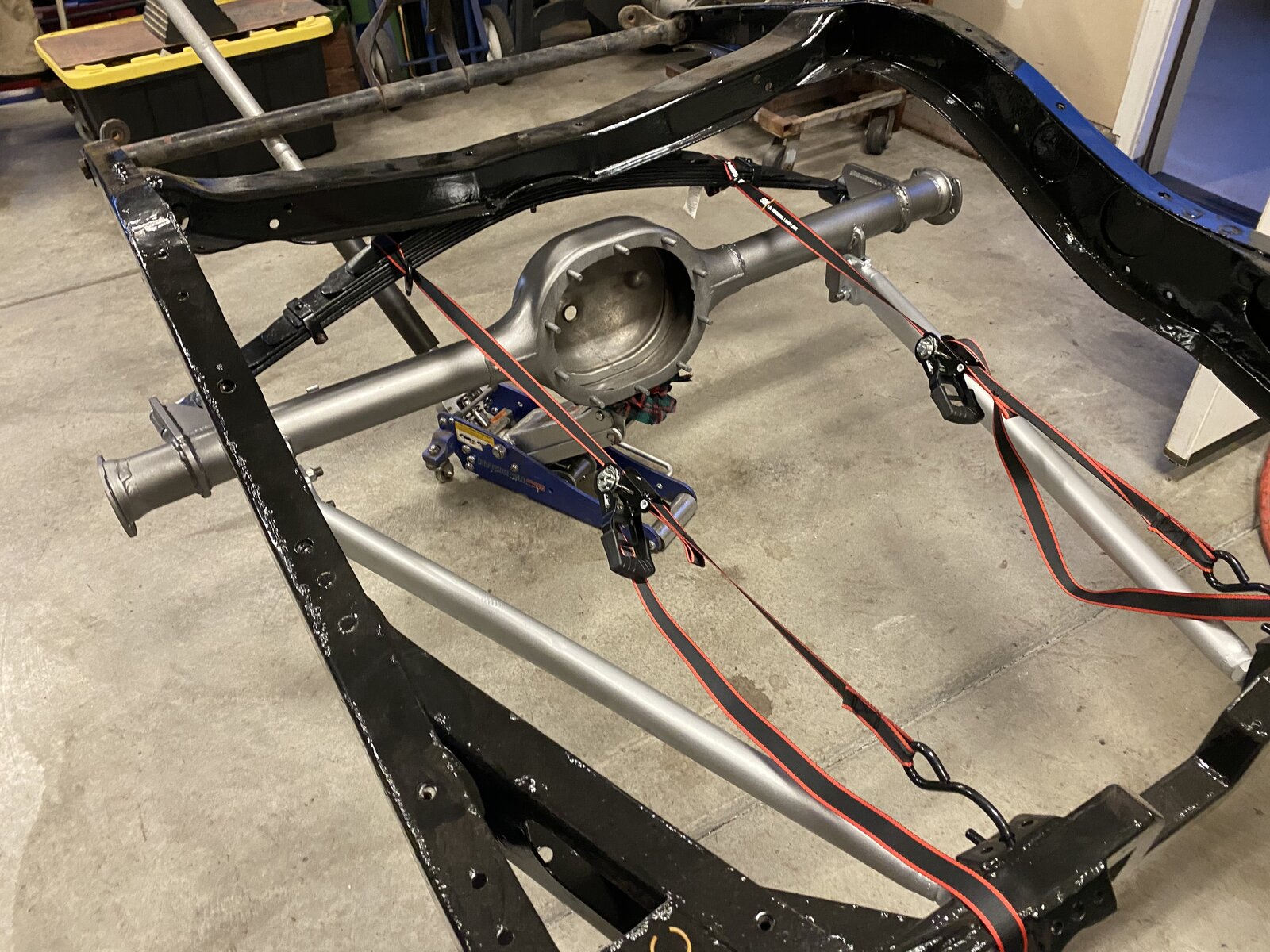

    1E5684E8-CC12-459C-8881-F7448B7429B7.jpeg Got the rear mocked-in!
    Had to see before hitting the hay for the night!
    EF319084-E58C-450D-A6CF-F045E0A9D460.jpeg 202E2509-917C-4E7E-95D3-1956858EAE79.jpeg
    Jim Bouchard, Jrs50, brEad and 2 others like this.

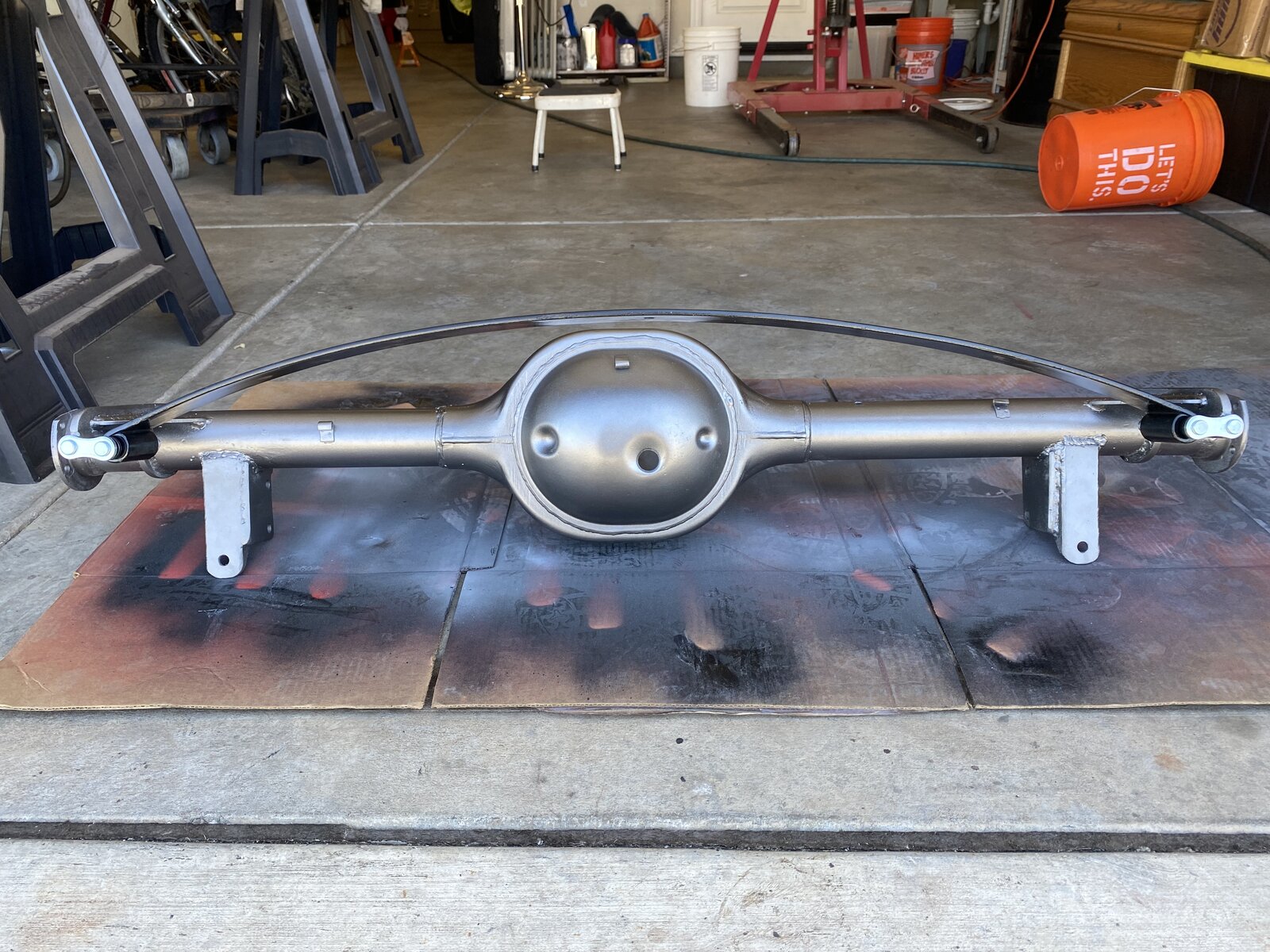

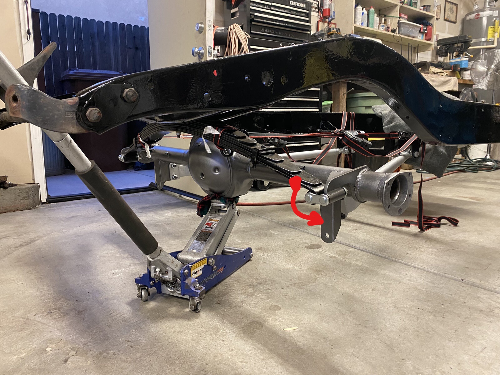

  20. loudbang
    Posts: 40,349
    Pardon my ignorance on these but when you put weight on it and the spring goes downward will this spring end and or shackle bump that shock bracket or what ever that bracket is?
    brady1929 likes this.

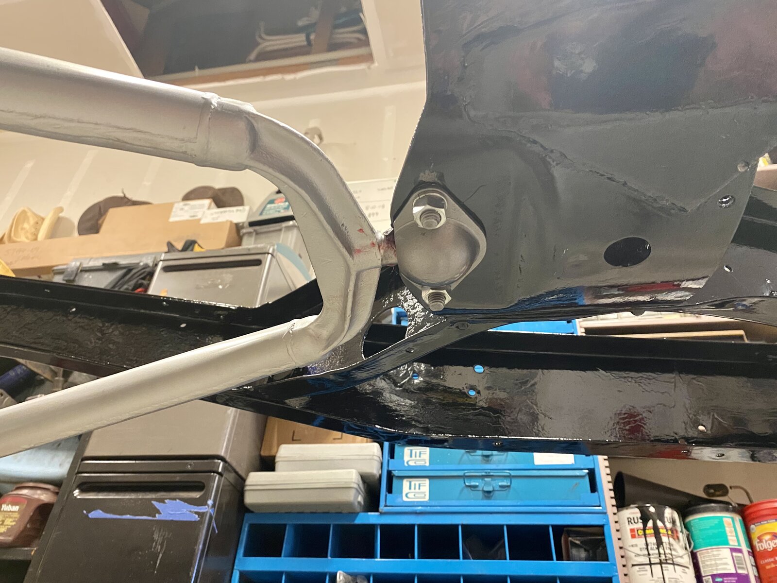

  22. 33Doll
    Posts: 1,602
    33Doll

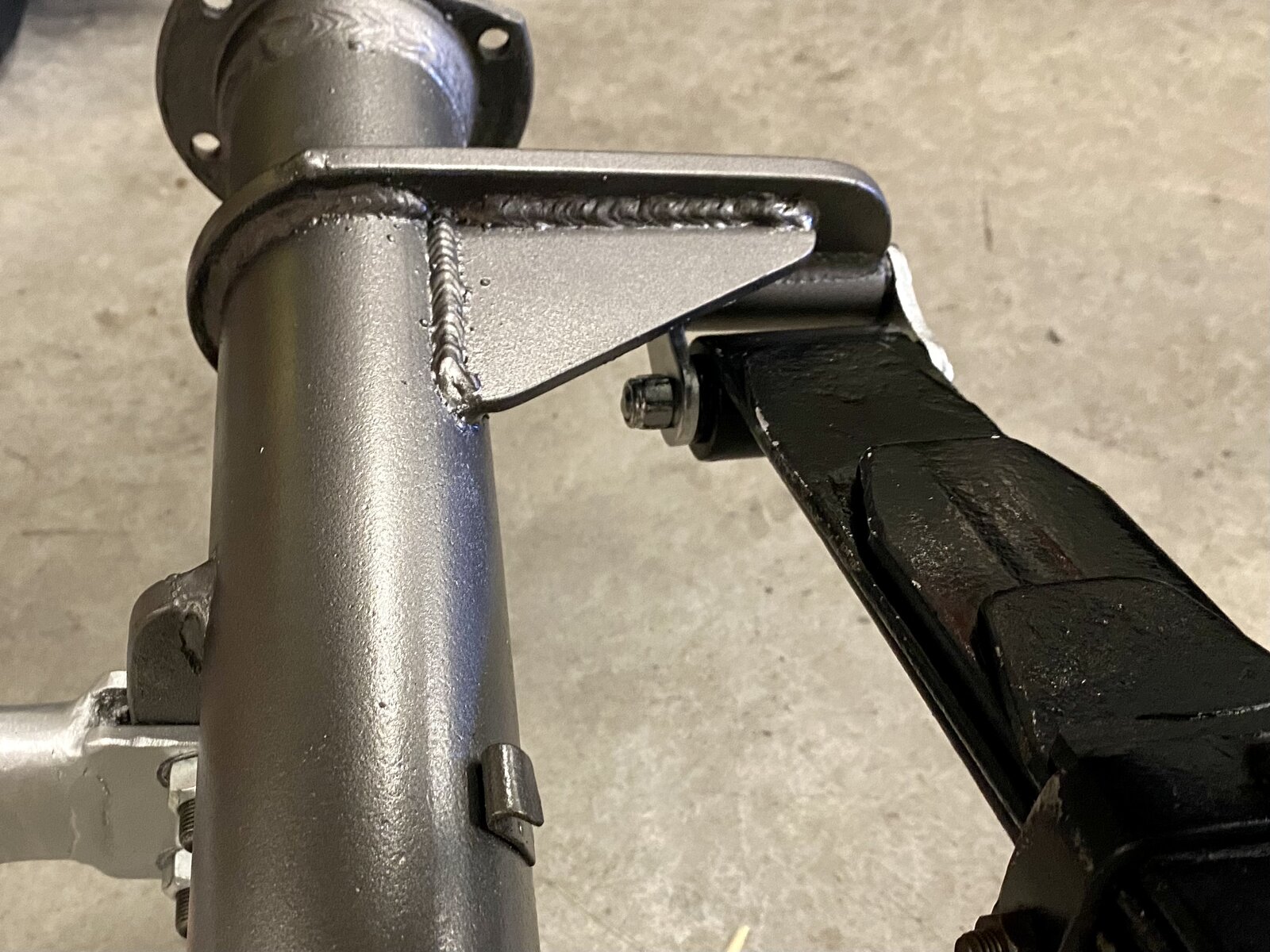

    B13EDAEC-0E18-4F8C-A4CF-B6DE54DC9BD2.jpeg 266D8B67-0BE9-49B3-9626-EEBB72EB5504.jpeg B3B9D541-D181-4298-B00E-B32CB96C09B6.jpeg Nope.
    its behind the shock mounts, and when the weight is on the car, the shackles are at a 45*
    Angle. So they pivot in a downward arch when they move so they wont hit the gussets either. If that makes sense?
    It is a tight fit between the spring and the axle with the shock body, so I’m hoping my new speedway stainless shocks will fit because the body is a little bit bigger in diameter.
    Heres so better angles of where the shock goes.
    And how far the hanger is away from the lower mount.
    Jim Bouchard, brEad and loudbang like this.
  23. rusty valley
    Posts: 4,428
    rusty valley
    Whew ! I was in agreement with loudbang, but we can see now it was "trick' photography ! looks good
    loudbang and 33Doll like this.
  24. 33Doll
    Posts: 1,602
    33Doll
    Yeah it’s an illusion!
    Yeah and I really hate that freaking double curve spring!!!!
    Don’t buy the poly urethane with the edges on it for those types of springs!
    You have to use the clear wide stuff, and then cut it at the same curve I think, but I’m not gonna worry about it !
    Ford didn’t worry about it. Plus they’re tapered and beveled now so they ought to move a lot better than factory!

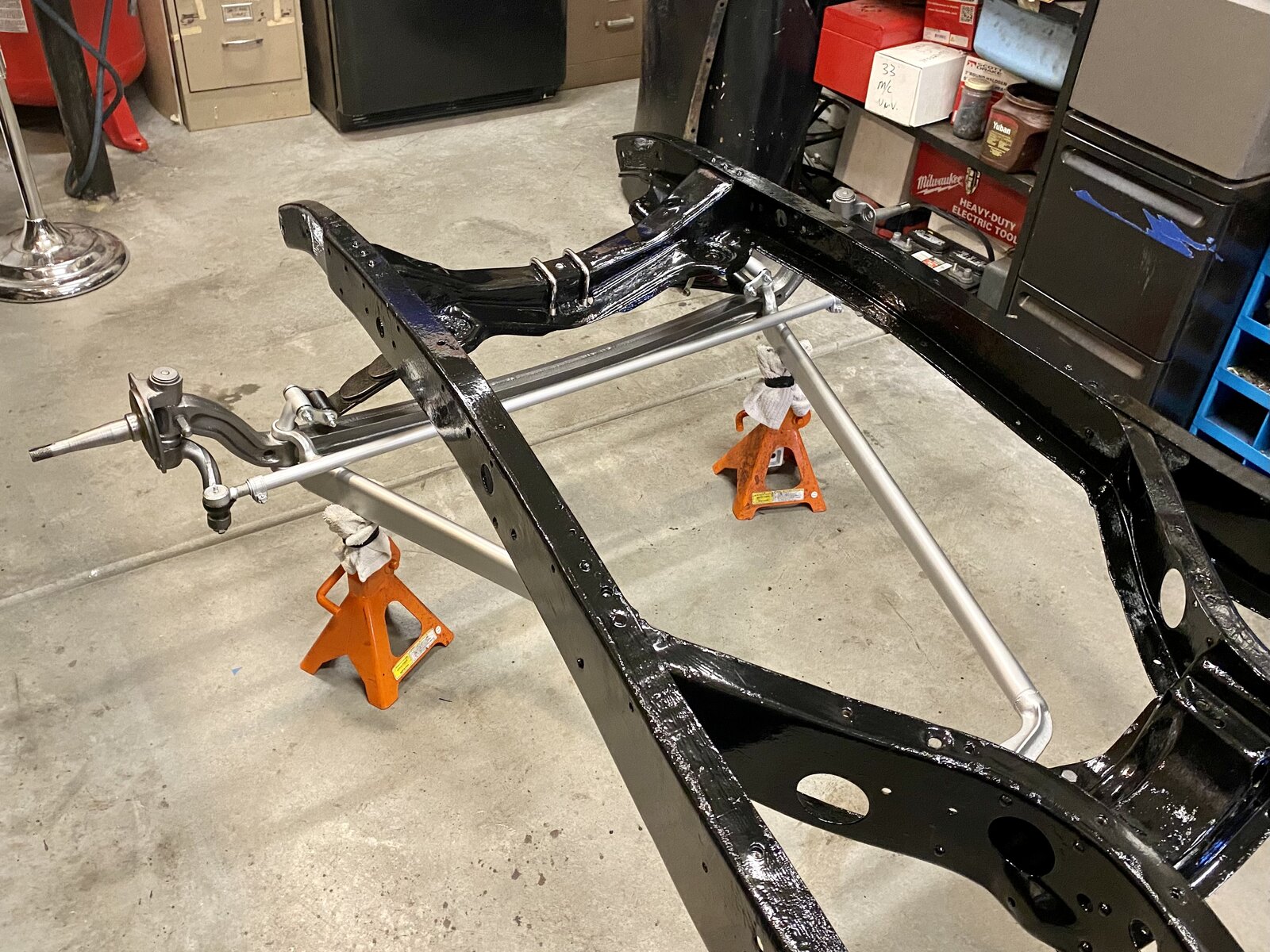

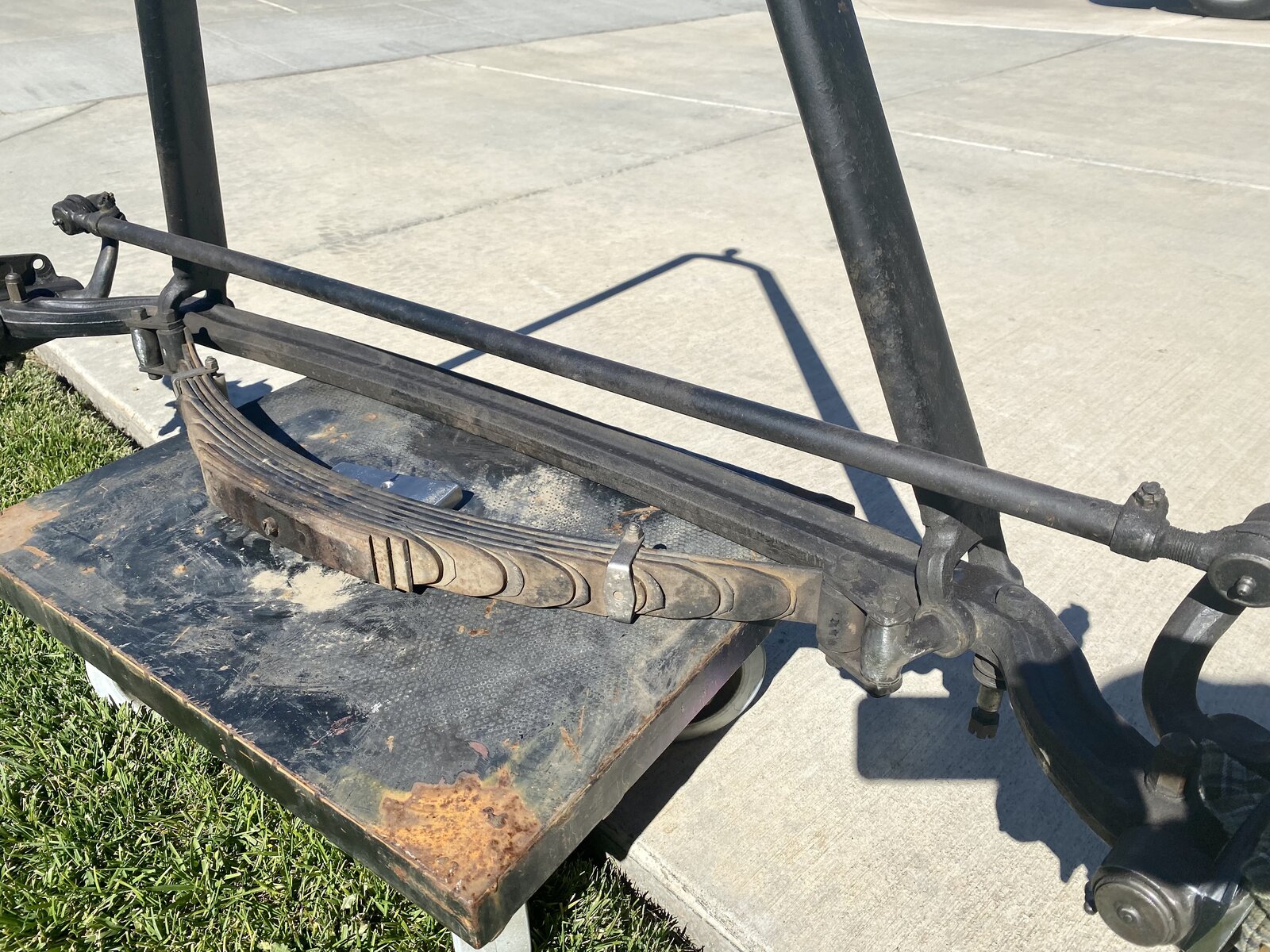

  27. 33Doll
    Posts: 1,602
    33Doll

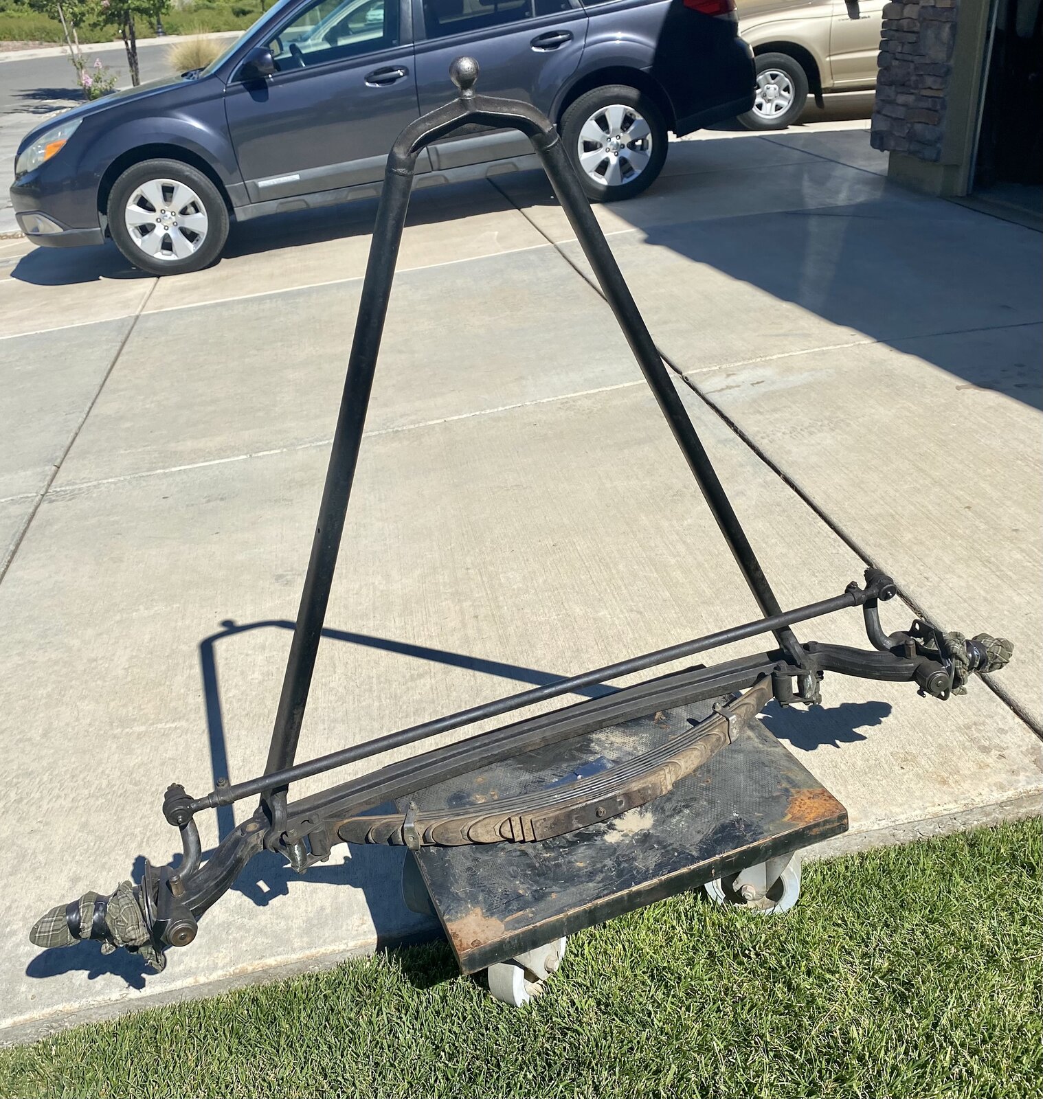

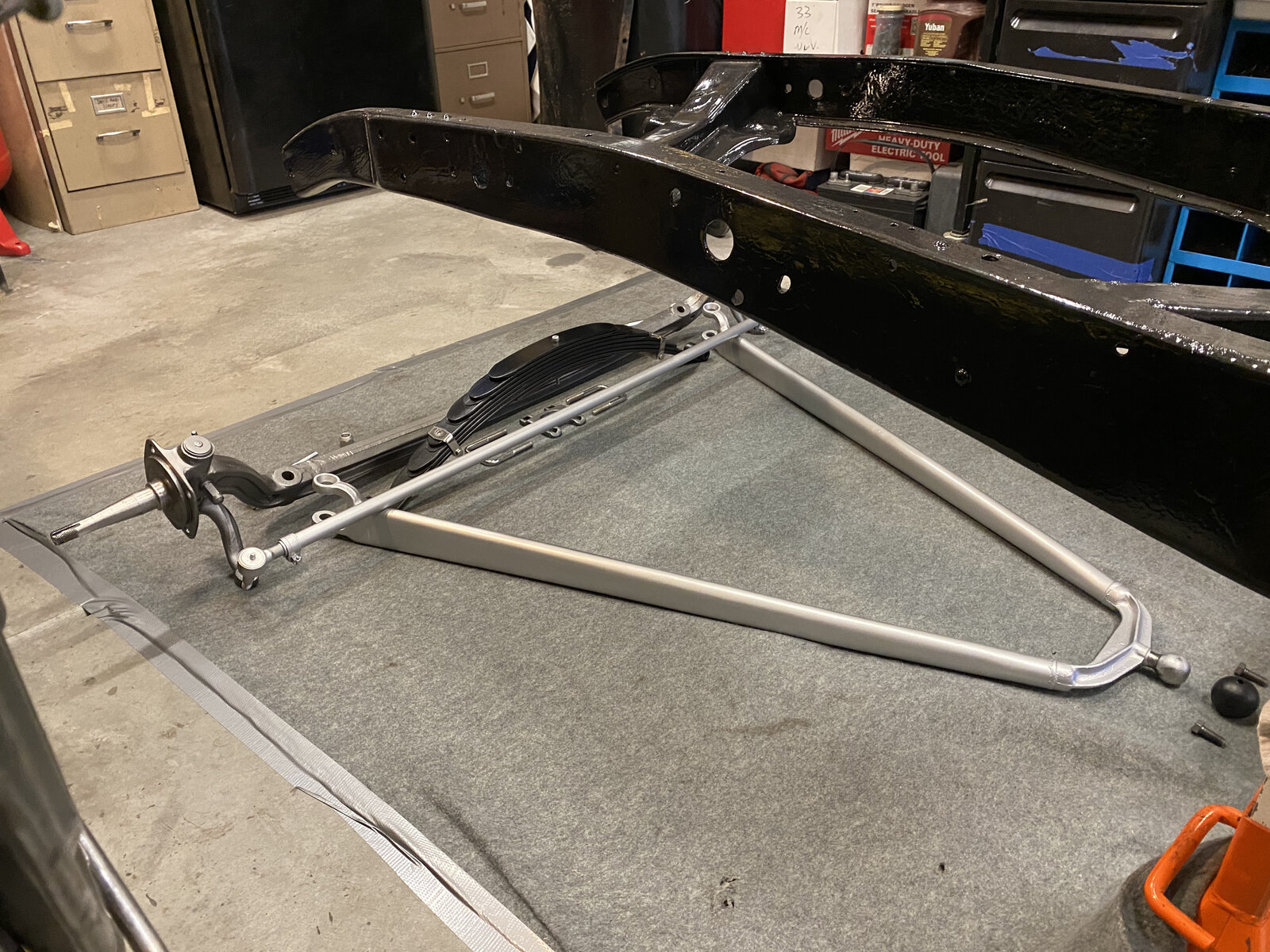

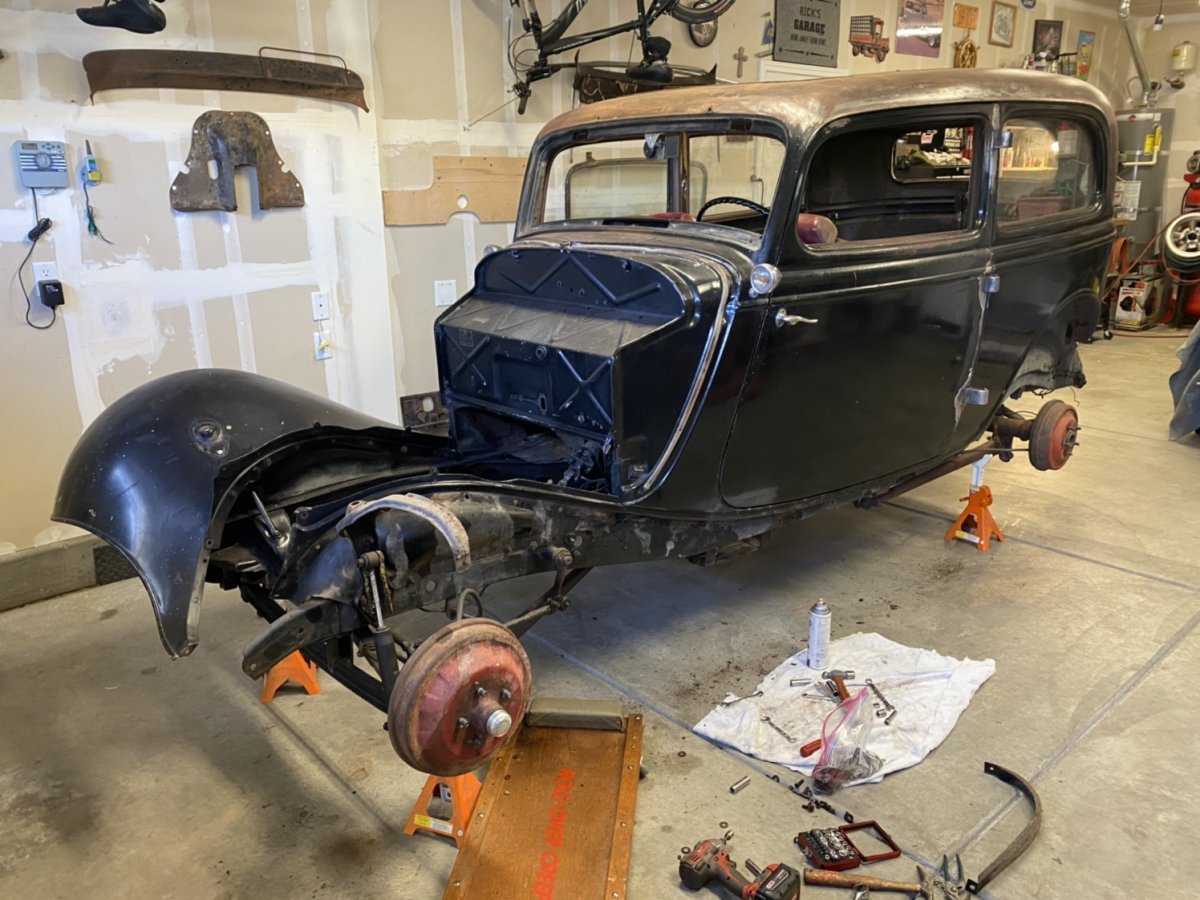

    Well couldn’t help myself! I took the front end part anyway! I started with knocking one of the shackles out just to see if there was tension on the front spring like the rear and the shackle came right out so no big whoop!
    So then I soaked it overnight with some WD-40, put two spring clamps on there backed off the center bolt then backed after C clamp and there’s absolutely no tension!
    You would think because of the engine it would have a lot of tension on the front spring.
    But I guess it gets the tension when the weight of the engines on it and the unsprung weight relieves it in the front.
    Where the rear has tension all the time!
    So the front end is so simple I’m just gonna take it apart except for the spindles.
    Since I want to paint the wishbone silver and the axle charcoal.
    We’ll see if the spring perch bolts come out if not then I’ll have to paint around those.
    stay tuned folks!
    happy Father’s Day to those fathers!!!
    9DD637AC-7520-4F1A-8651-F20E3EC7B996.jpeg 05C131DB-C191-4A08-AB36-0F9C4E6B47F3.jpeg
    Stogy, brEad, loudbang and 2 others like this.

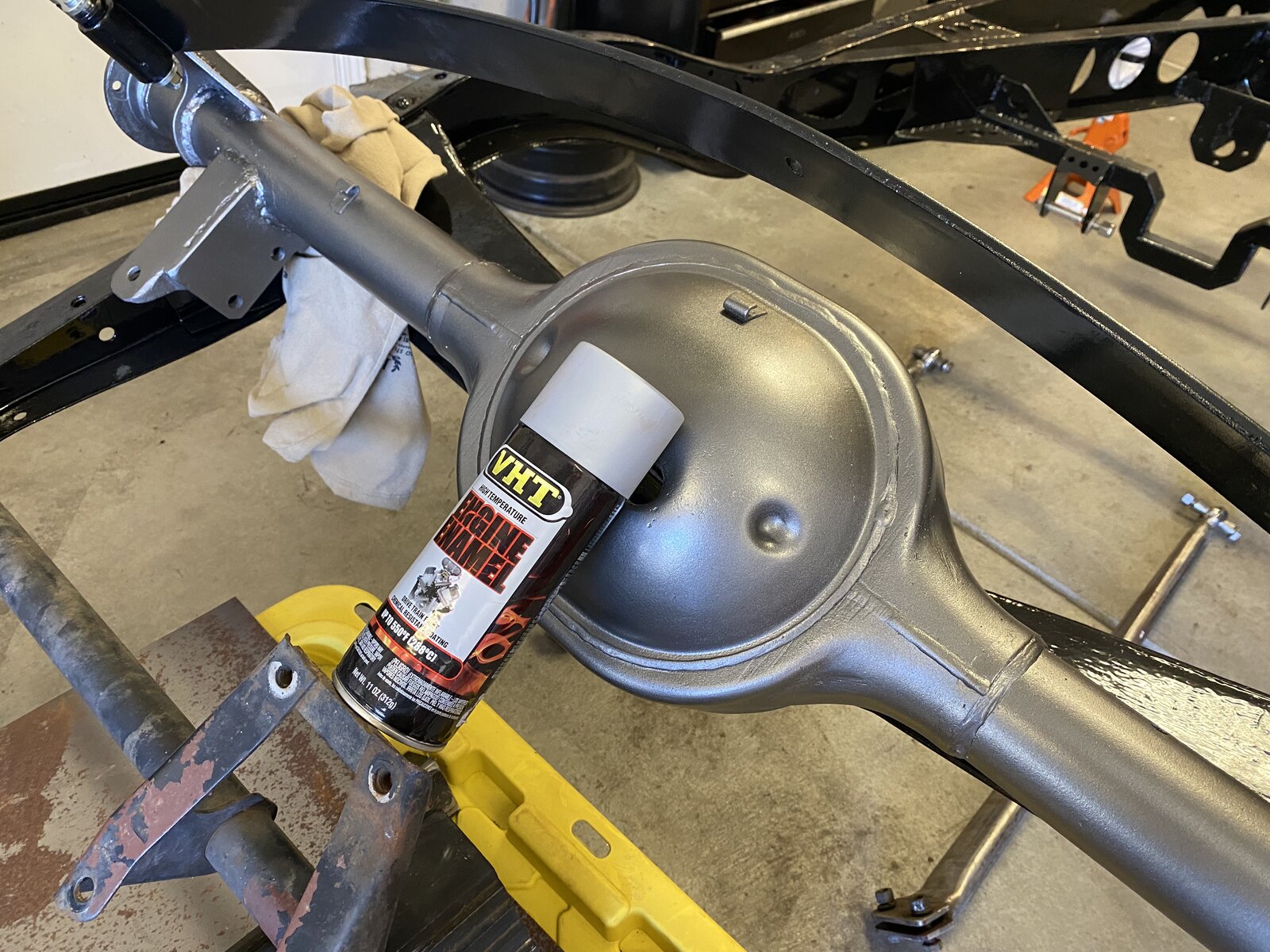

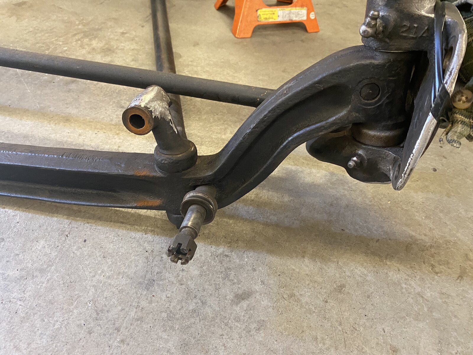

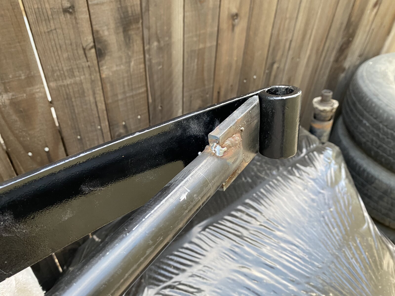

  28. 33Doll
    Posts: 1,602
    33Doll
    EDDB2357-D26E-480C-BE5F-5F5BD553E7DE.jpeg Little more done,
    Only 2.5 hours today, plus its 102 here In
    Nor-cal!
    I’m glad I had extra spring perches! I completely destroyed the old ones getting them out!
    So now I can paint the axle,wishbone, and tie rod separately since I’m doing two-tone!
    57D2F7E8-36E9-42C5-8399-E424D1F071CF.jpeg C43EA78A-05E6-4D88-B52B-D80EE6E4E810.jpeg C5BF5260-3C23-428F-A102-B74CED5E0B86.jpeg A5415650-9A2F-4512-9EE3-88CBE77F1005.jpeg

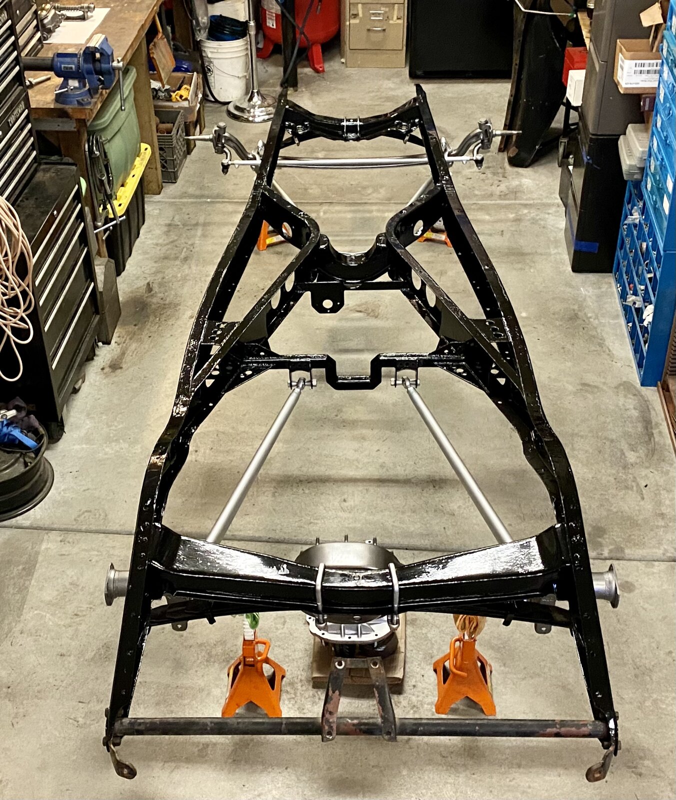

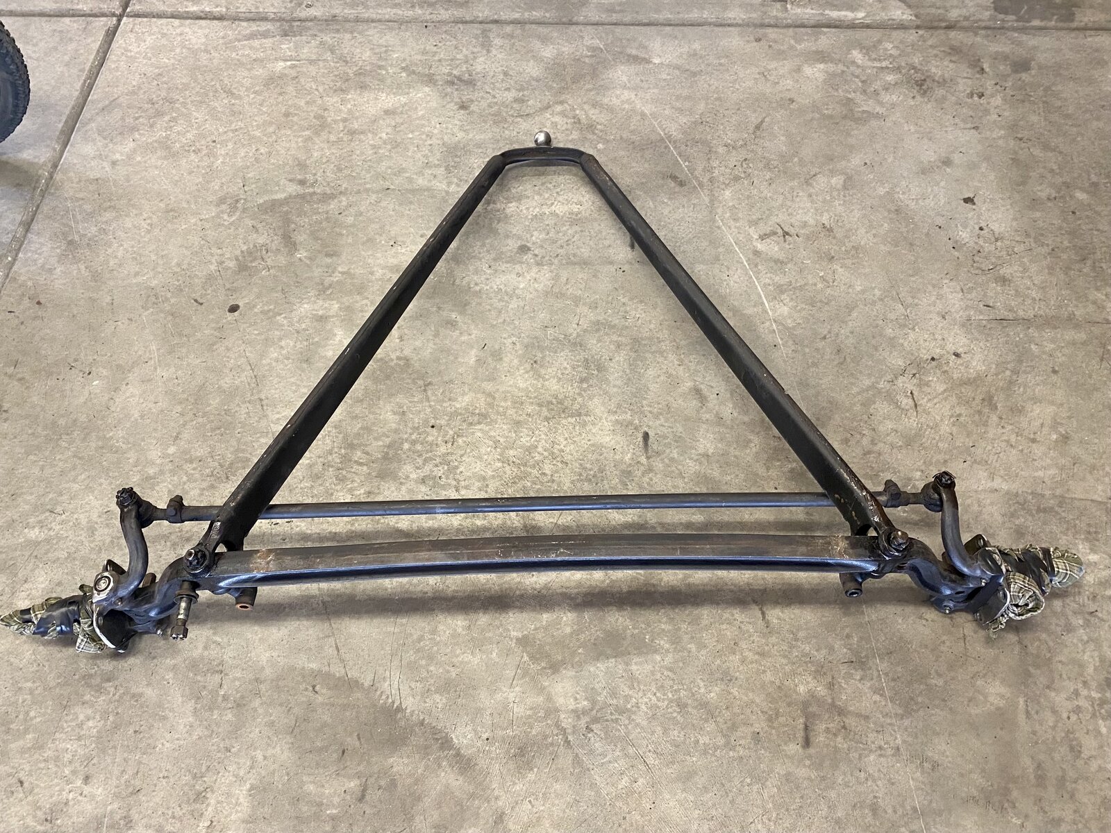

  30. 33Doll
    Posts: 1,602
    33Doll
    C00BC43E-0820-4AB3-9FBF-12CFEFB263FF.jpeg 0B82BA85-37BC-412A-ACE3-8DCD218B874E.jpeg C08835F3-58B2-466B-AA0D-009542F4C00A.jpeg D12EA8CC-7EEC-4AC6-BB2E-3127E4E01473.jpeg B9D58E42-33BE-44A6-BEE9-6FDF0ADC7DA1.jpeg 4FE6EF9A-3E1B-498A-9231-D3AA4A7E495C.jpeg 57D898C3-5980-4C4D-89D0-4A734DC401B9.jpeg 57D898C3-5980-4C4D-89D0-4A734DC401B9.jpeg 31DF4E93-7772-422E-A096-176F79D4C785.jpeg 3F2715E6-FB0F-4836-86F3-DBBAEEAE5C6A.jpeg 5FED561B-8CE6-4DCA-93D5-2FF2306D9B11.jpeg Really Kicking **** now!
    Have to replace the tie rods though!
    I got the bright idea to put one of those torque converter type lock nuts on there, instead of the castle nuts to avoid cotter pins, and tje ****er locked up, and spun the tie rod so I tried to cut the nut off and accidentally cut into the threads. So leaving it for now, and gonna continue building the ch***is, and the n Ill worry about it. Would have had the 3rd member in also if I wasn’t ****ing with that for an hour!
    Overall, The thing is coming along nicely!
    And looking *****in’!
    What do y’all think of the 3 colors?
    Black, Aluminum! And Graphite.
    It will go great with the Engine. I think.
    And still look old school Hotrod?
    neilswheels, Jacksmith, CC-Mo and 7 others like this.
