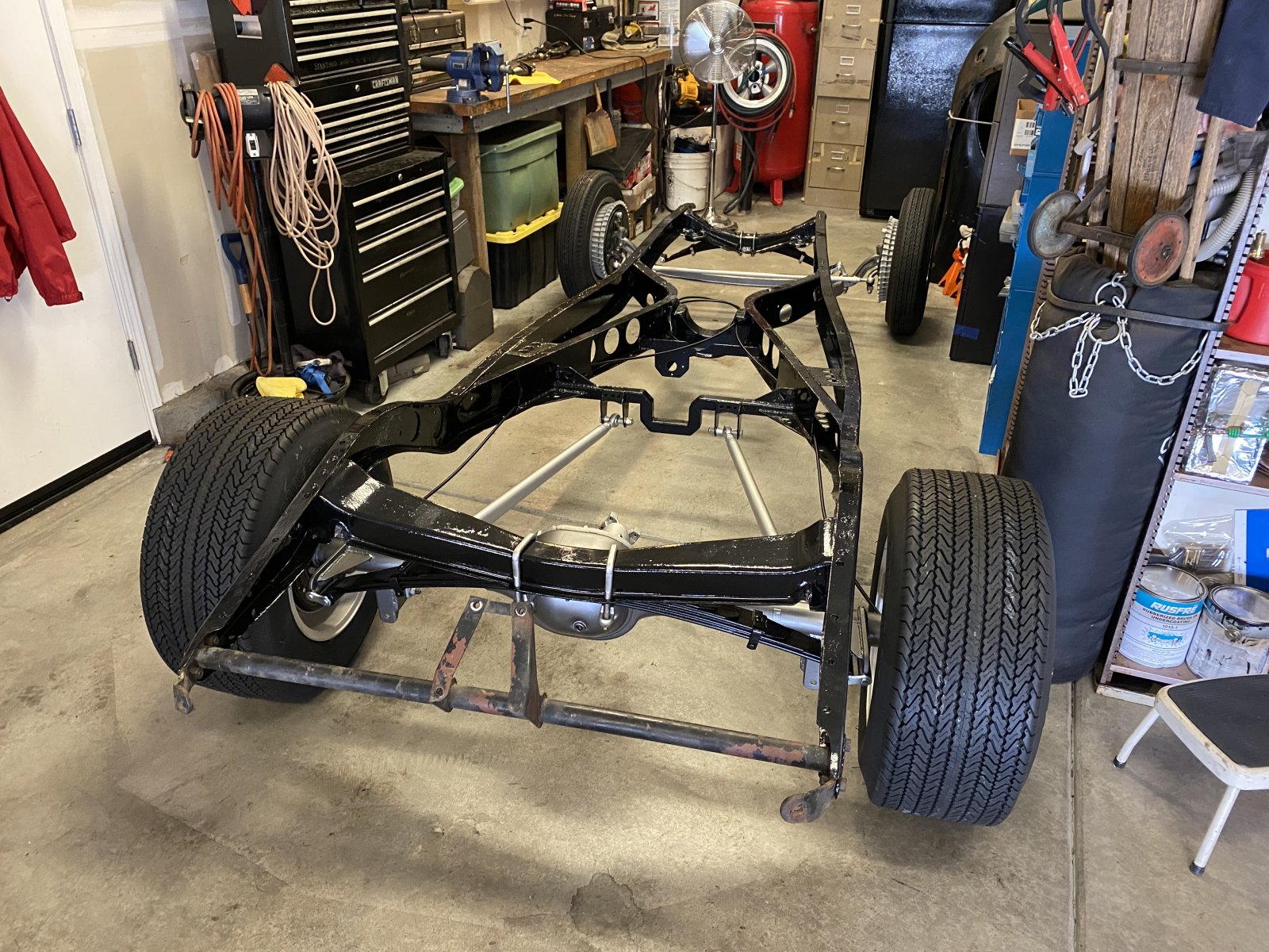

  3. 33Doll
    Joined: Sep 27, 2019
    Posts: 1,602
    33Doll
    Thanks! Im on a roll!!!
    95226F28-A9CF-4AF5-8B0C-3306652BBE74.jpeg 95AE269E-6D2B-418E-9BBA-4D682D84A284.jpeg 593FDFBB-12A6-47CC-9BBF-35C3B5345CC4.jpeg 1A2704EA-10FA-424C-9303-5771B2E658AC.jpeg E6ABBEC6-139A-47D3-8251-0961A4D744D5.jpeg E35726E9-5246-46DD-9F76-ACDB9C771BFB.jpeg

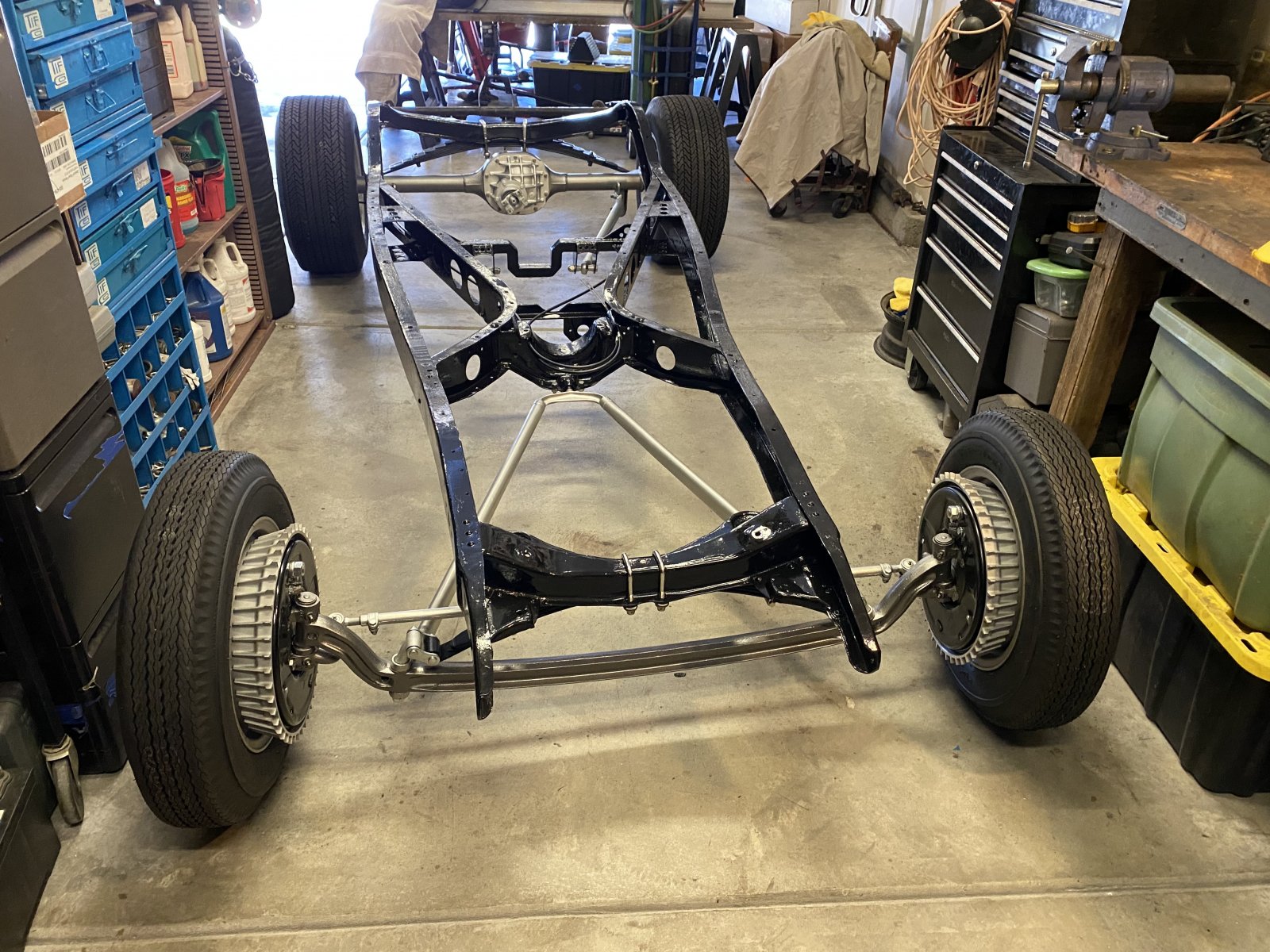

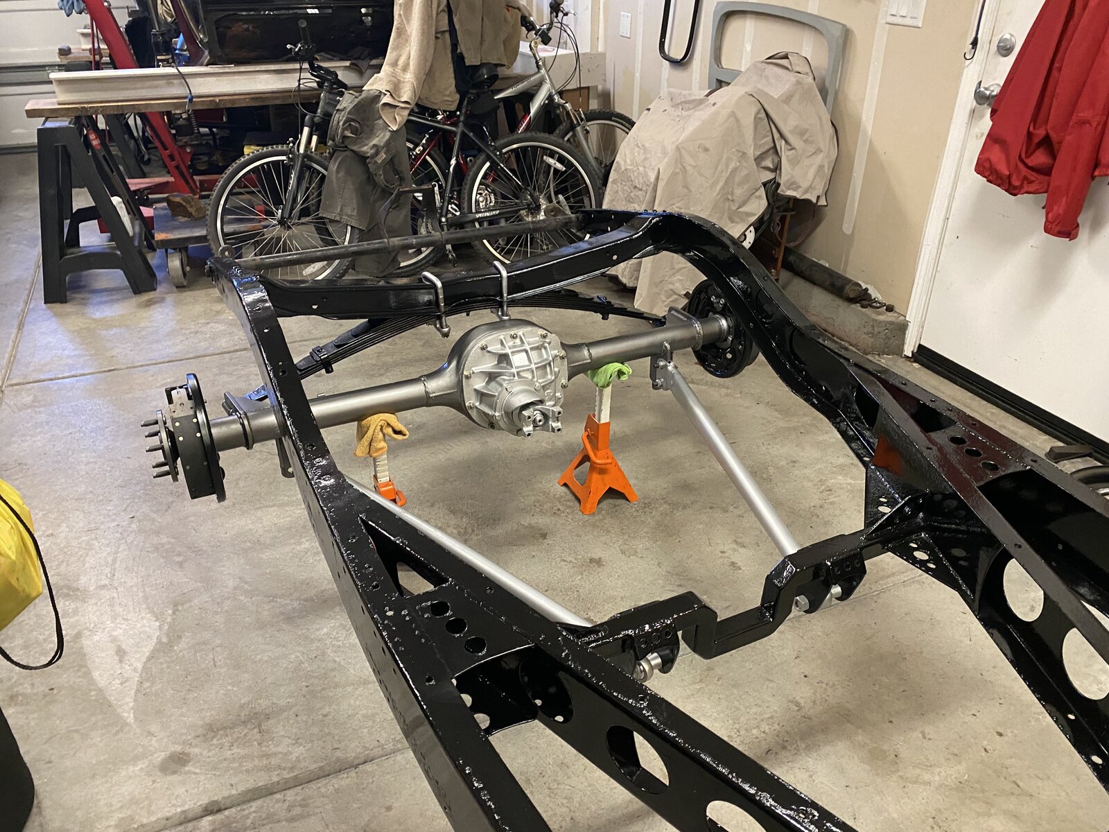

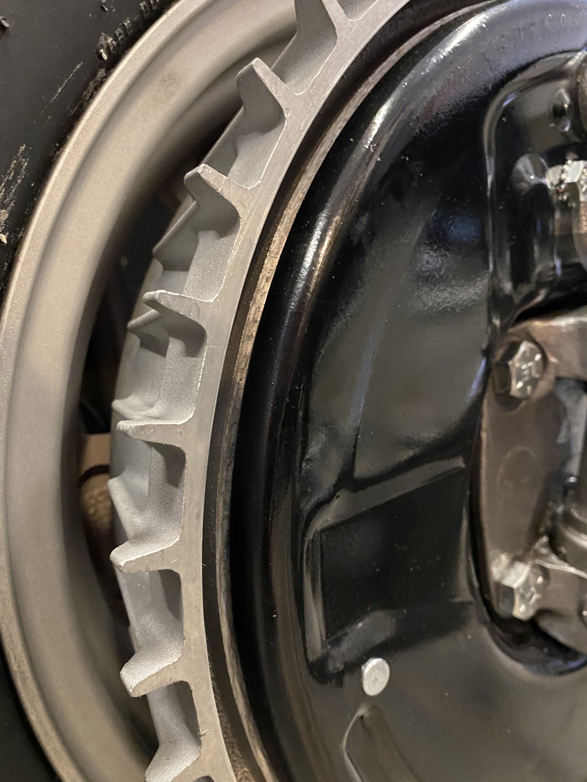

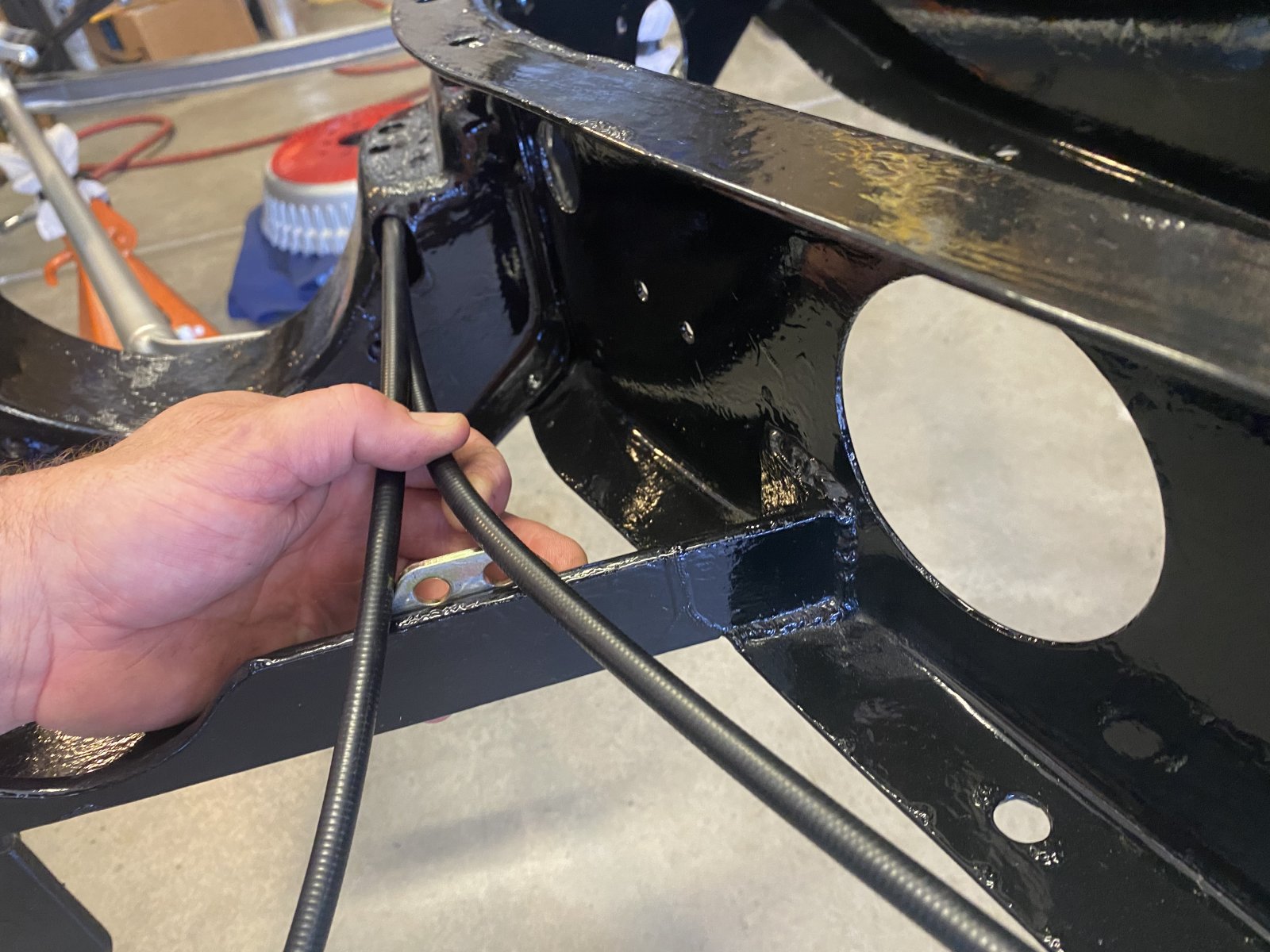

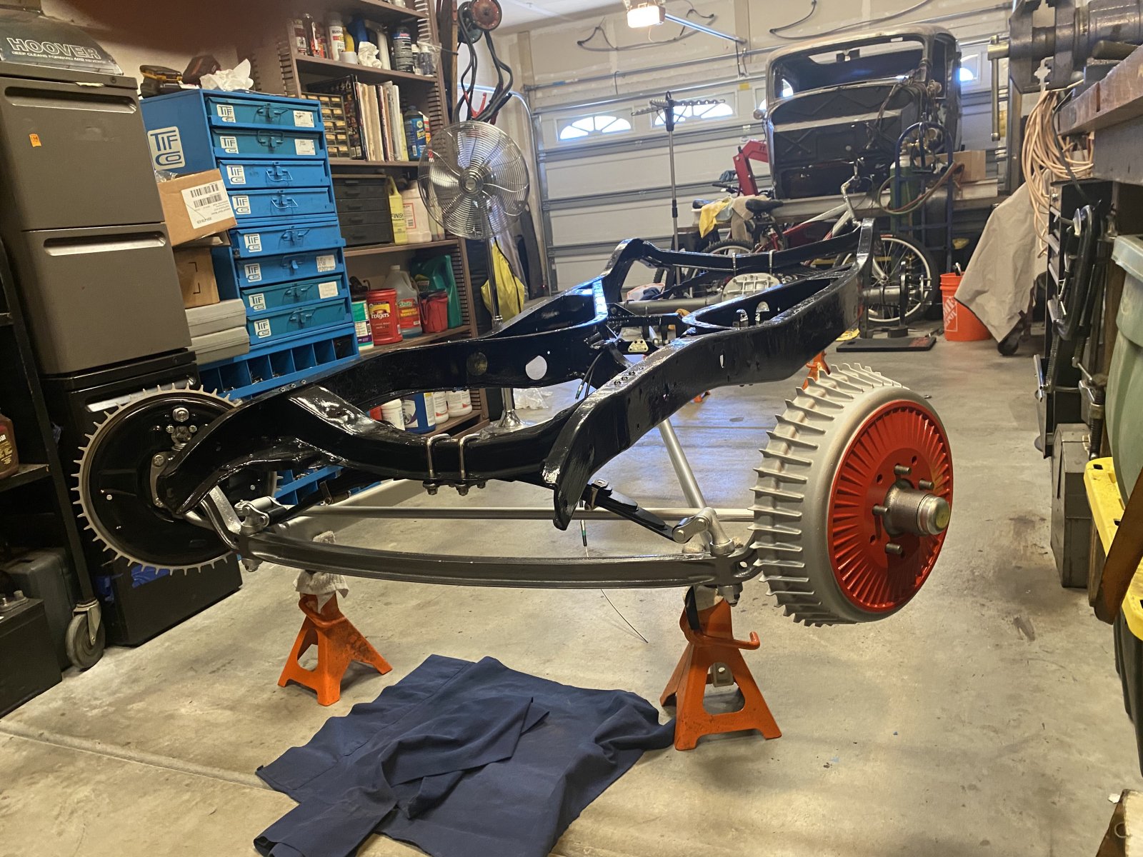

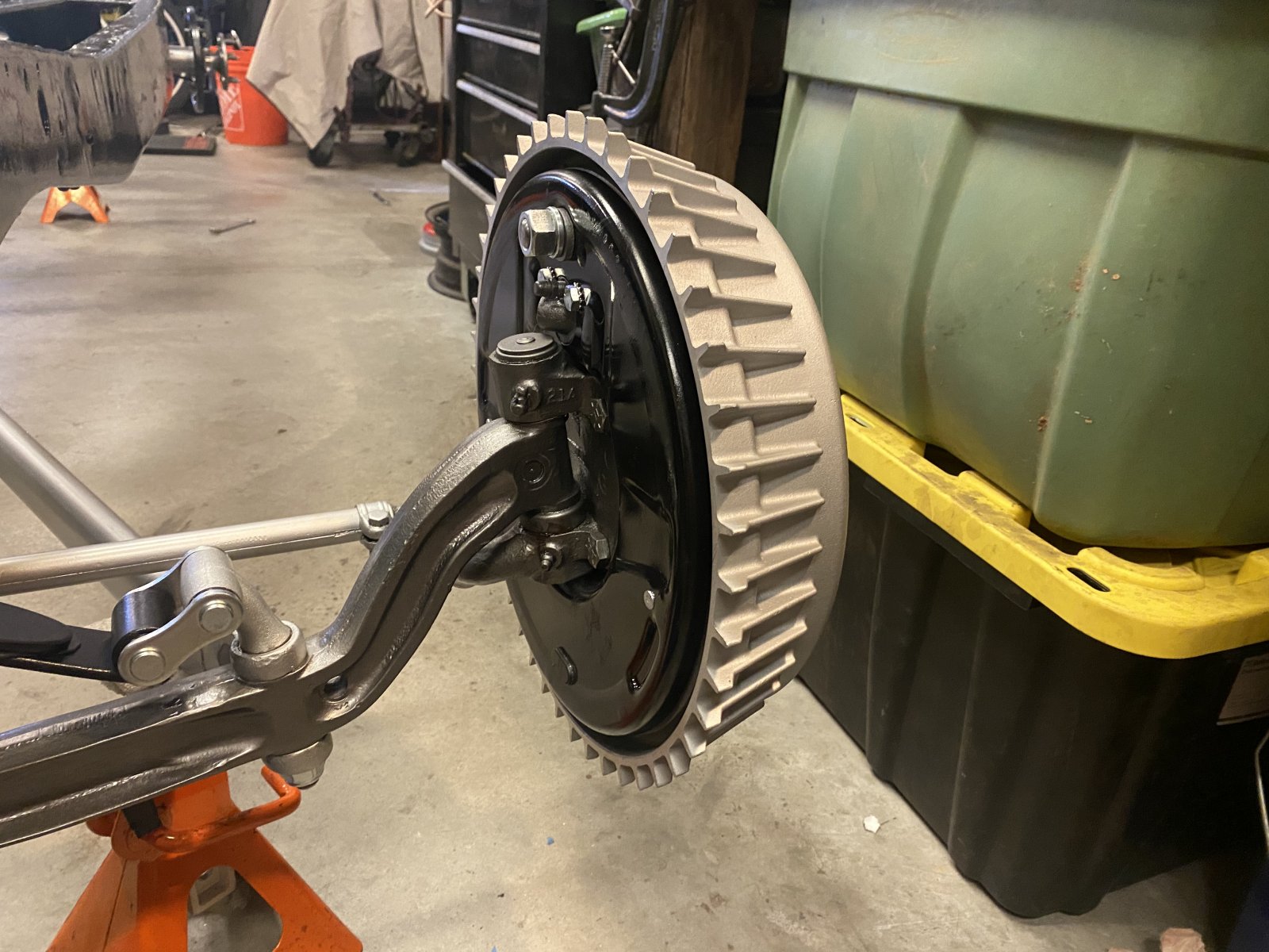

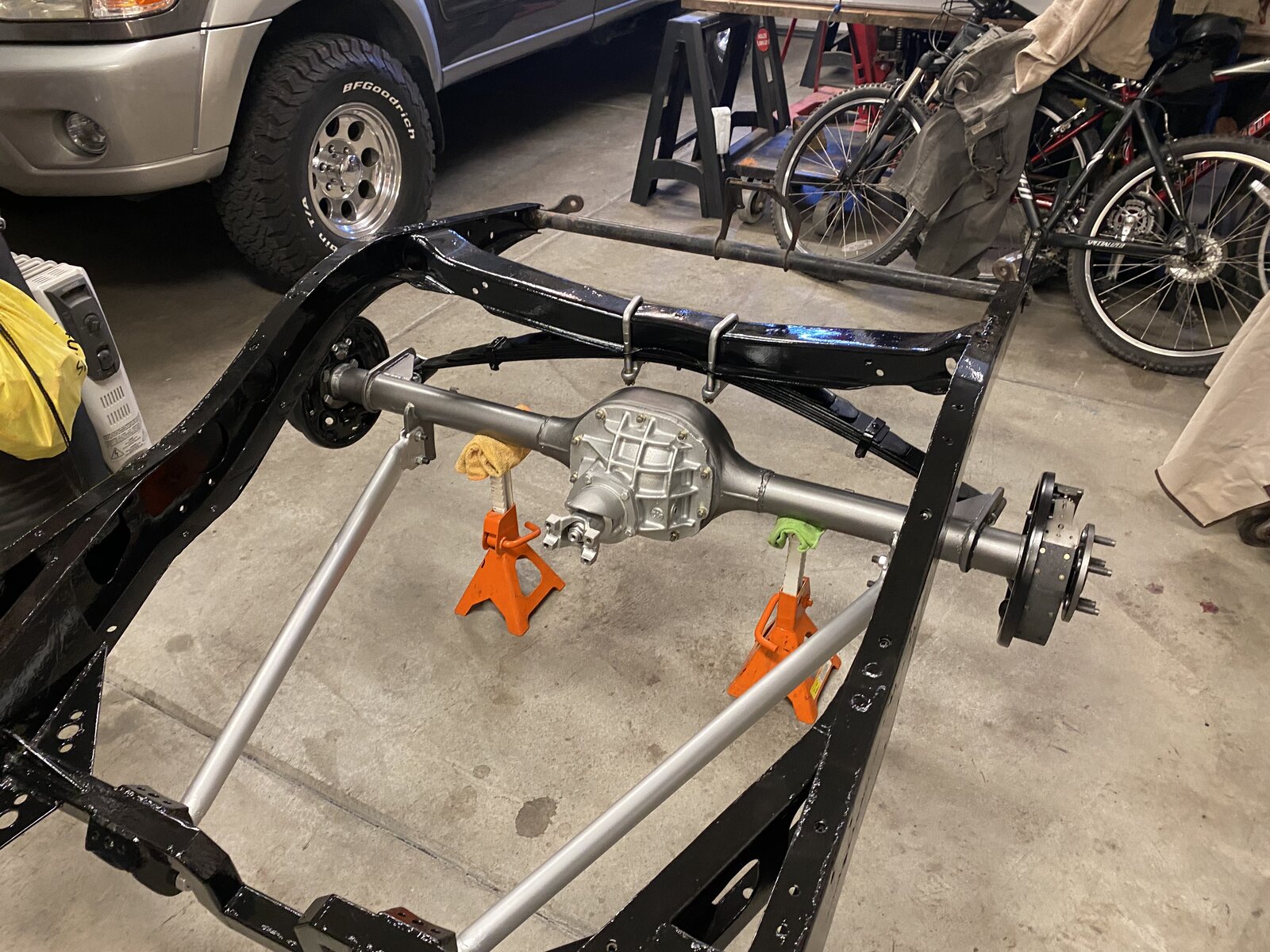

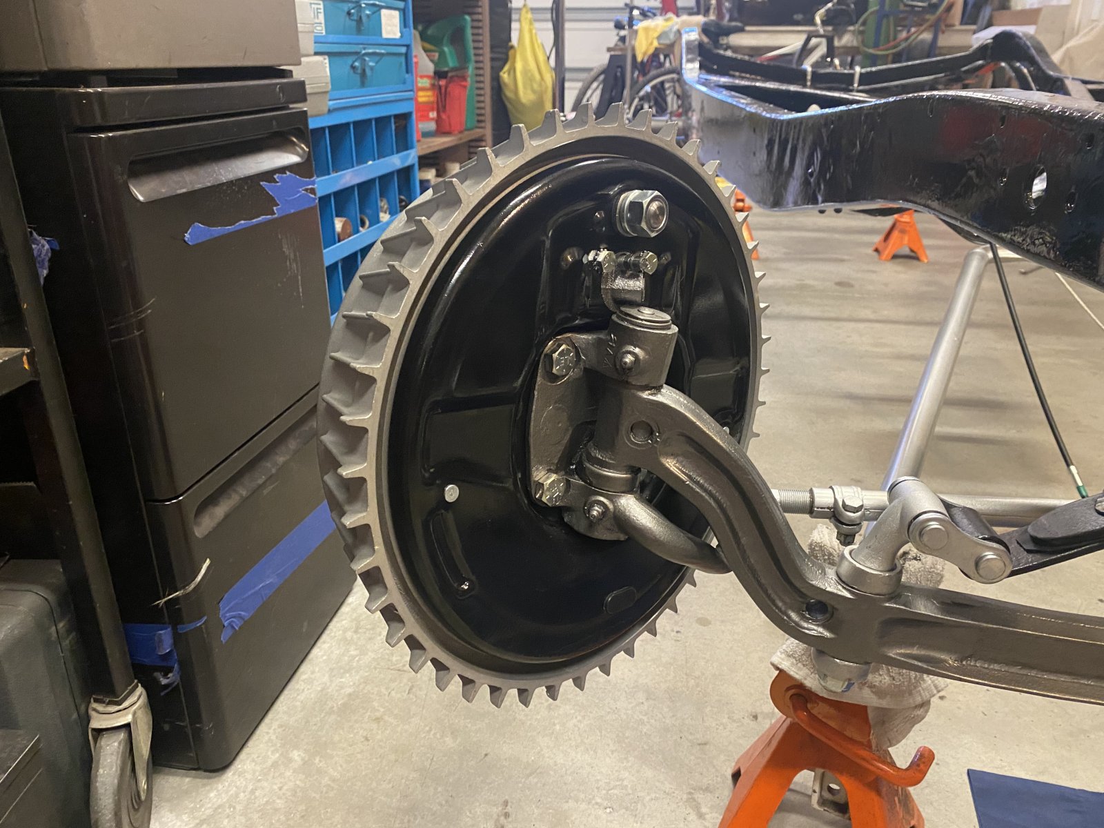

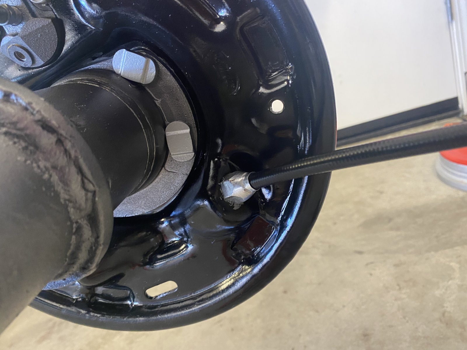

    475DA525-069E-45F7-B602-289B852A3361.jpeg 14355E5D-D27B-40C3-B123-E4C3B150C99D.jpeg E5B01034-AA1C-411F-8CBB-5998109BA270.jpeg D2309FB4-097D-44D0-BF89-4D120940E283.jpeg E5B01034-AA1C-411F-8CBB-5998109BA270.jpeg AE0BD286-9C20-46D6-A97C-D0A41498857B.jpeg E6C2B332-9F25-4DB0-A09E-247D4D39B9F9.jpeg B4EBAEC6-1BA6-4CA3-8CE8-8126478092C2.jpeg Running the e brake cables to see how it will hook up to the stock handle. Loving these bicycle type brake cables! Just feed it where you want mount a bulkhead, trim the cables, t-block, some clevis and all thread.
    Hope I don’t have to shave the back of the drums, since I trued the hubs, i lost some clearance. Will see when I mount the wheels here in a bit
    Waiting for my 1.75 rear shoes 2.0 was to wide
    Apparently Mustangs have 3-4 different width shoes

    1F95C754-4082-40DA-9896-875CBCBB5746.jpeg D5D1600B-1B7B-467D-9E30-CBDE9AE1AC3B.jpeg C66C4637-EF61-457D-99A3-392A4363A8C7.jpeg Yep huge difference in the brakes they just showed up!!!

    @33Doll are those narrower shoes going on the front?
    I had the Hotrod in for a brake inspection and was told there was a lip on the shoe that caused adjustment issues...perhaps there's 2" in there...I have Buick drums up front...
    You're making great progress there...;)
    What year Mustang are the 1.75" shoes for?

    The rear brakes are 10“ x 1 75 mustang
    My dad gave me 2 inch shoes.
    So I ordered some 1.75 from CJ pony parts it’s all good now!
    The front 12 x 2 Lincoln brakes, I need to shave the back of the Buick drums a little bit because they’re rubbing on the backing plate from me turning down the hubs a little bit to true them up. Not a big deal least I have it on wheels now I’ll take some pictures when I get back if I can get it out in the sun.

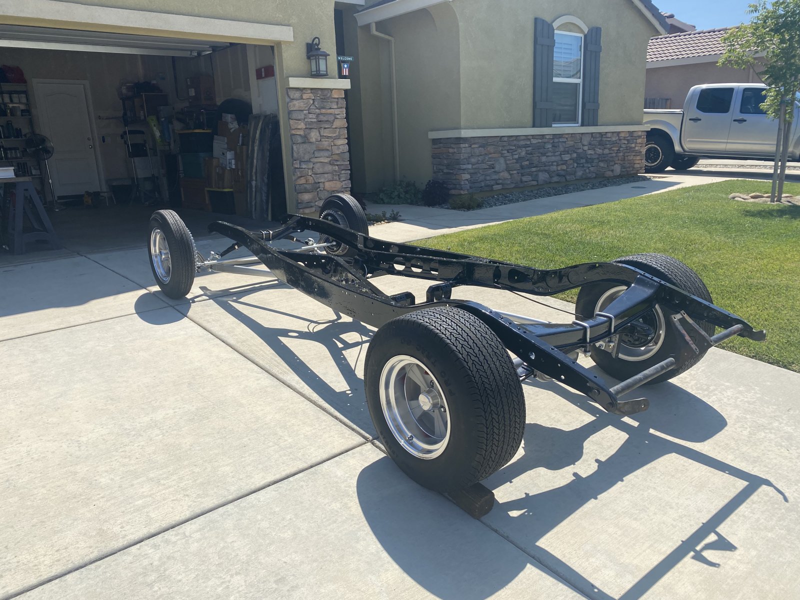

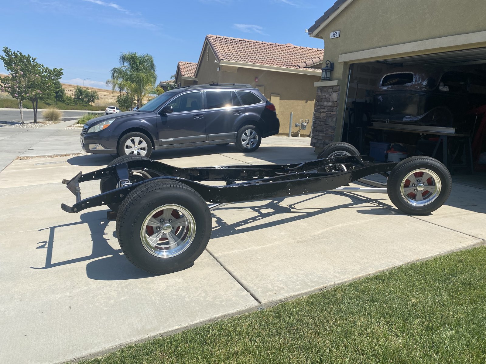

    Outside DAMN!!!
    Looks Killer!

    Before and after:
    491F55B0-5894-4E67-BB38-BAA4ED359550.jpeg 03771E55-4DD6-4E40-87F9-66FEE9FB0453.jpeg D6E14CA8-C3F5-4311-B4C3-EF55C0620BAB.jpeg 5214F630-CFAC-46D0-A0B7-896AB8247C5E.jpeg

    Well I took my drums to work and shave the lip on the back now they clear excellent brakes are all adjusted front and rear ready to go!
    Planning my next move!
    Going to finish hooking up the emergency brake so at least I have a handbrake while I get ready to plumb the hydraulic lines.

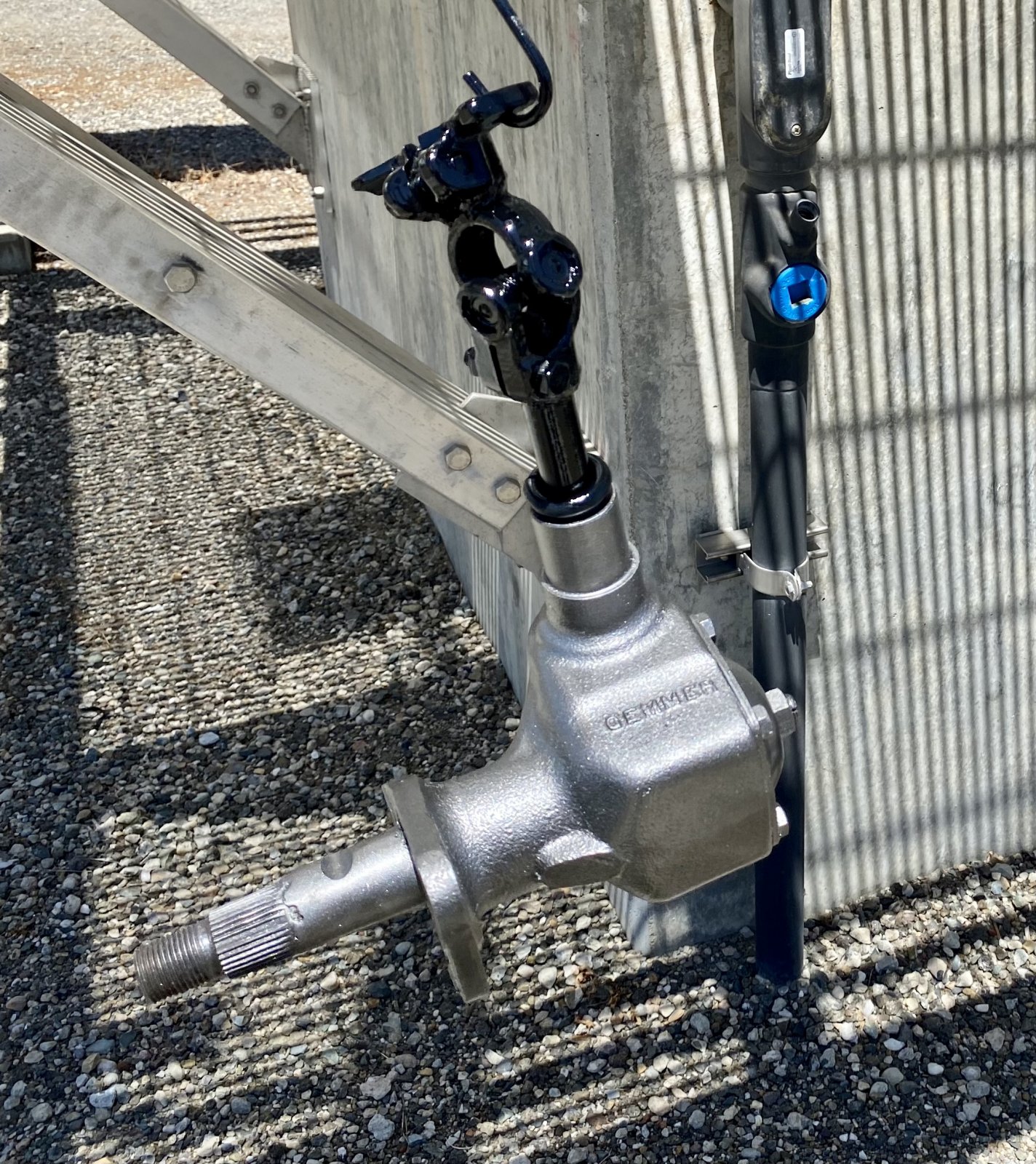

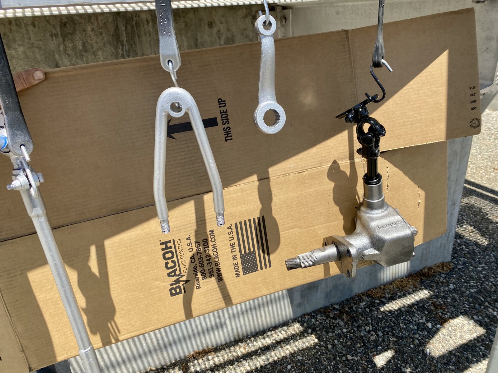

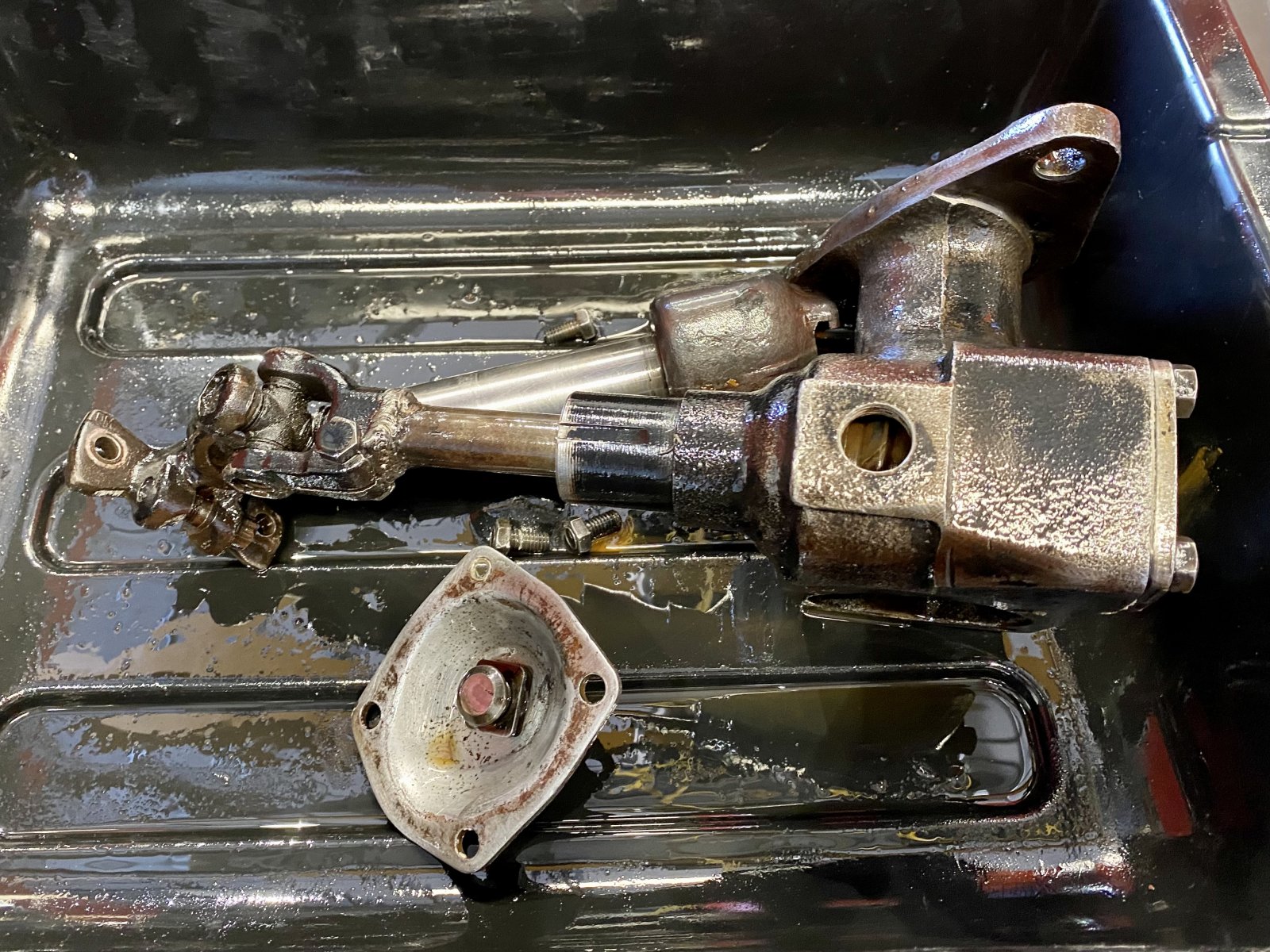

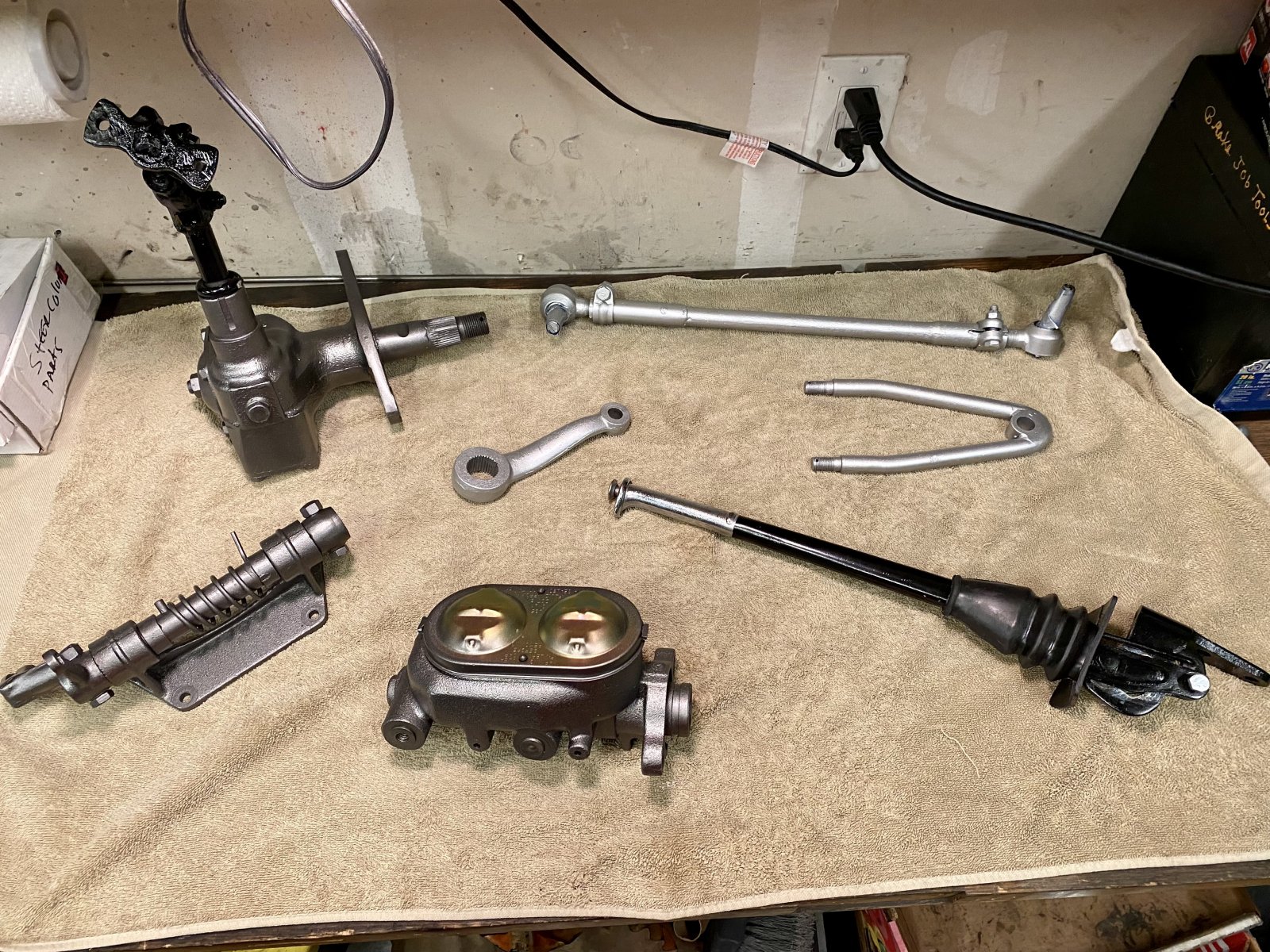

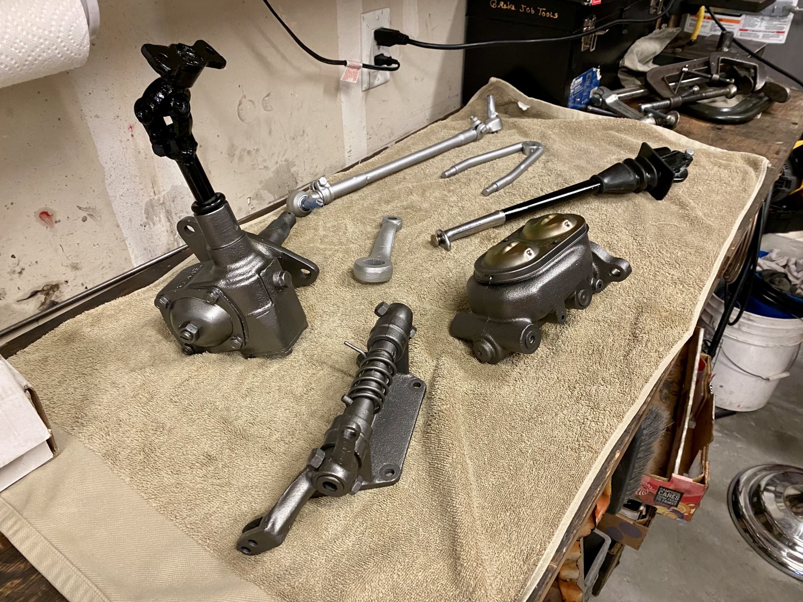

    Went through the Steering Box, cleaned, degrease, new 00 Grease, replaced the seal. I hope it is still in sync? It only would engage one way, and my punch marks seem the same? We will see??
    53-56 f100 box 5.5 Turns if I did it Right.
    (Yes the shaft is stubbed, and grafted to fit the 33’)

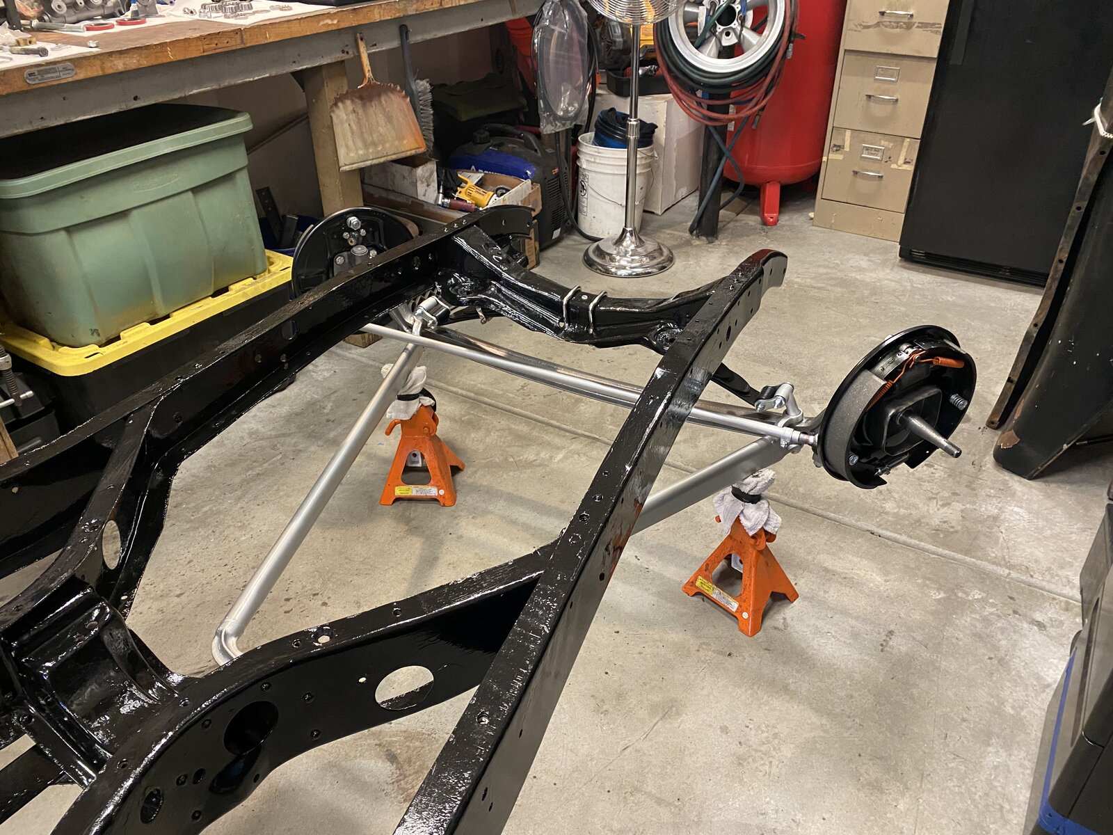

    More Done!
    Just got to adjust, modify, and
    Setup the linkage, and E-Brake!
