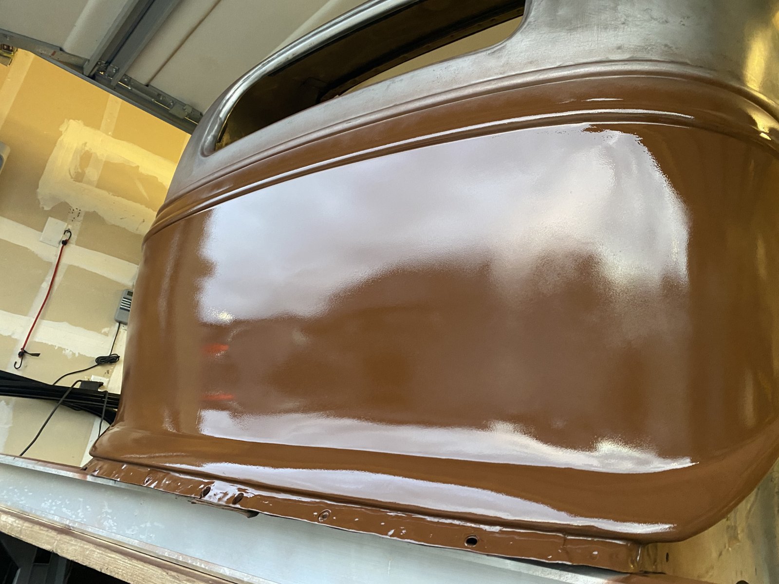

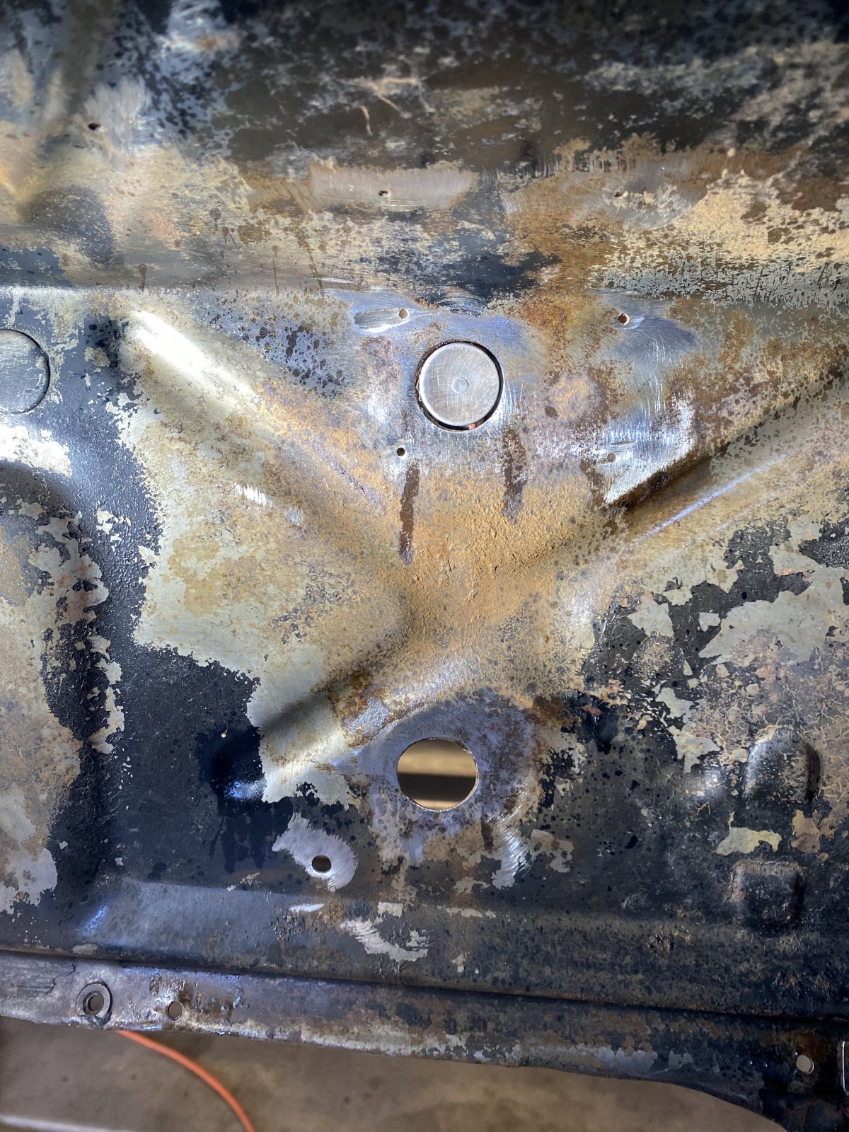

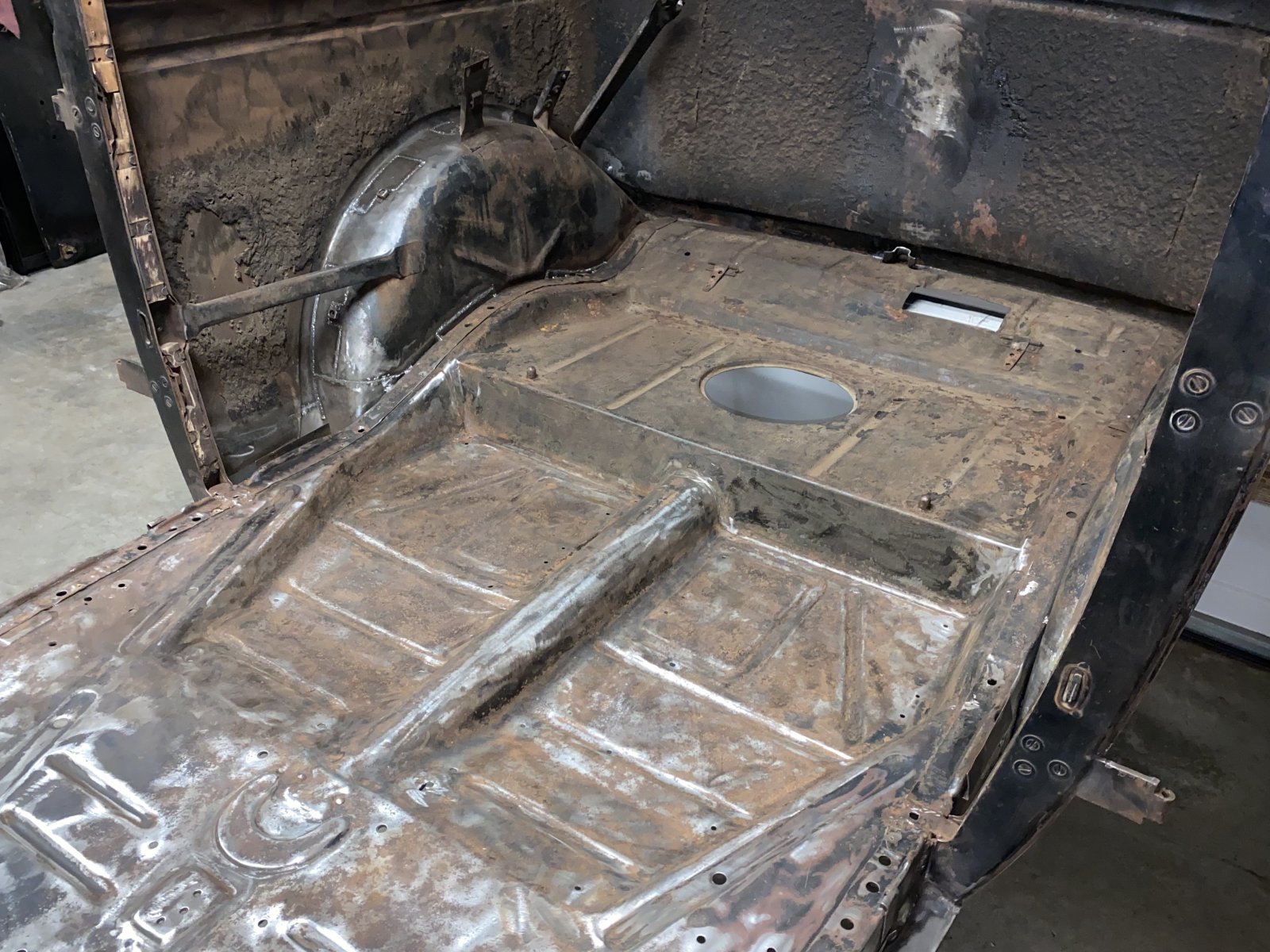

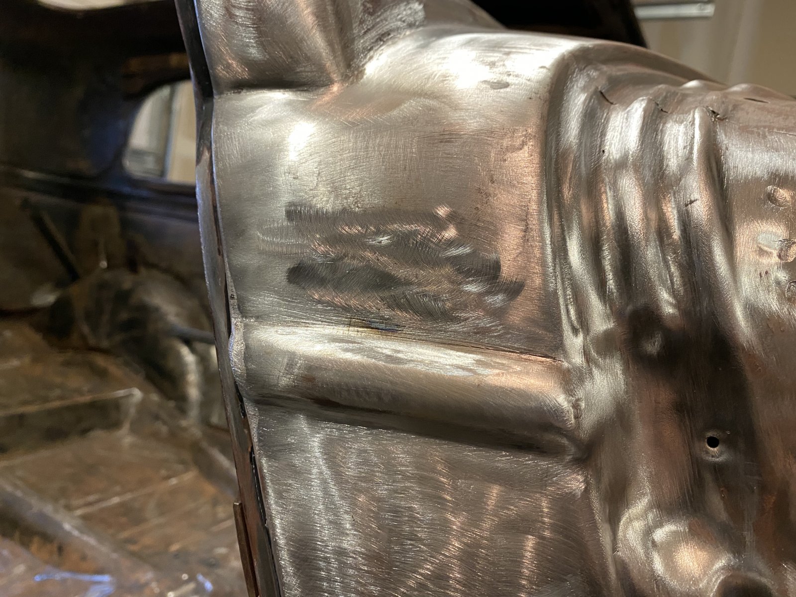

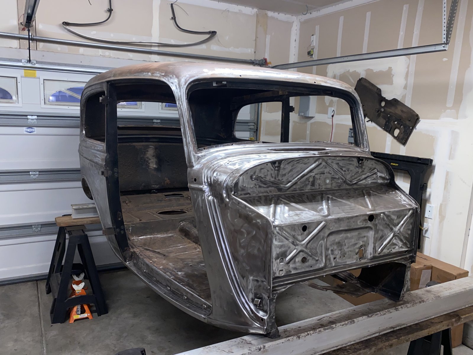

    Just a little more touchup on the inside.
    Then I got a fill about 5 million holes somebody drilled in the floorboards and firewall.
    Well I’m glad my dad primed and painted the underside years ago it saved it.
    It’s just that the car leaked so bad in the rain that the inside floorboard started to rust.
    that’s why there’s so many holes! my Pops drilled a bunch of drain holes LOL!!!!
    So in essence….he did save it from rusting out… but…now I’m gonna spend a lot of time filling! Man it’s a lot of work stripping a body by hand!!!
    I think I’m gonna cave-in, and have the doors and fenders soda blasted!!!
    I can put those in the back of my truck so that’s not a problem.

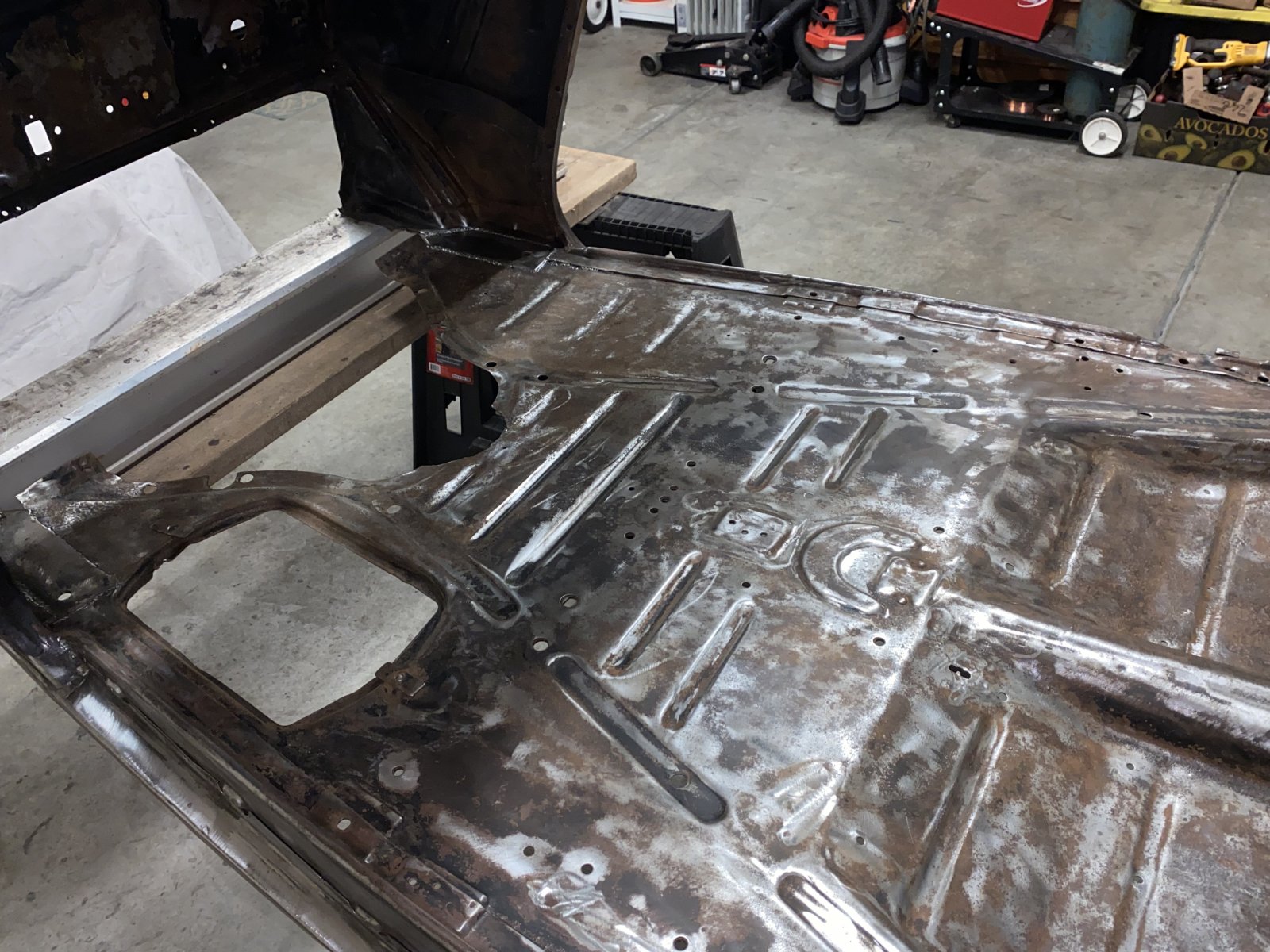

  7. 33Doll
    Joined: Sep 27, 2019
    Posts: 1,600
    33Doll

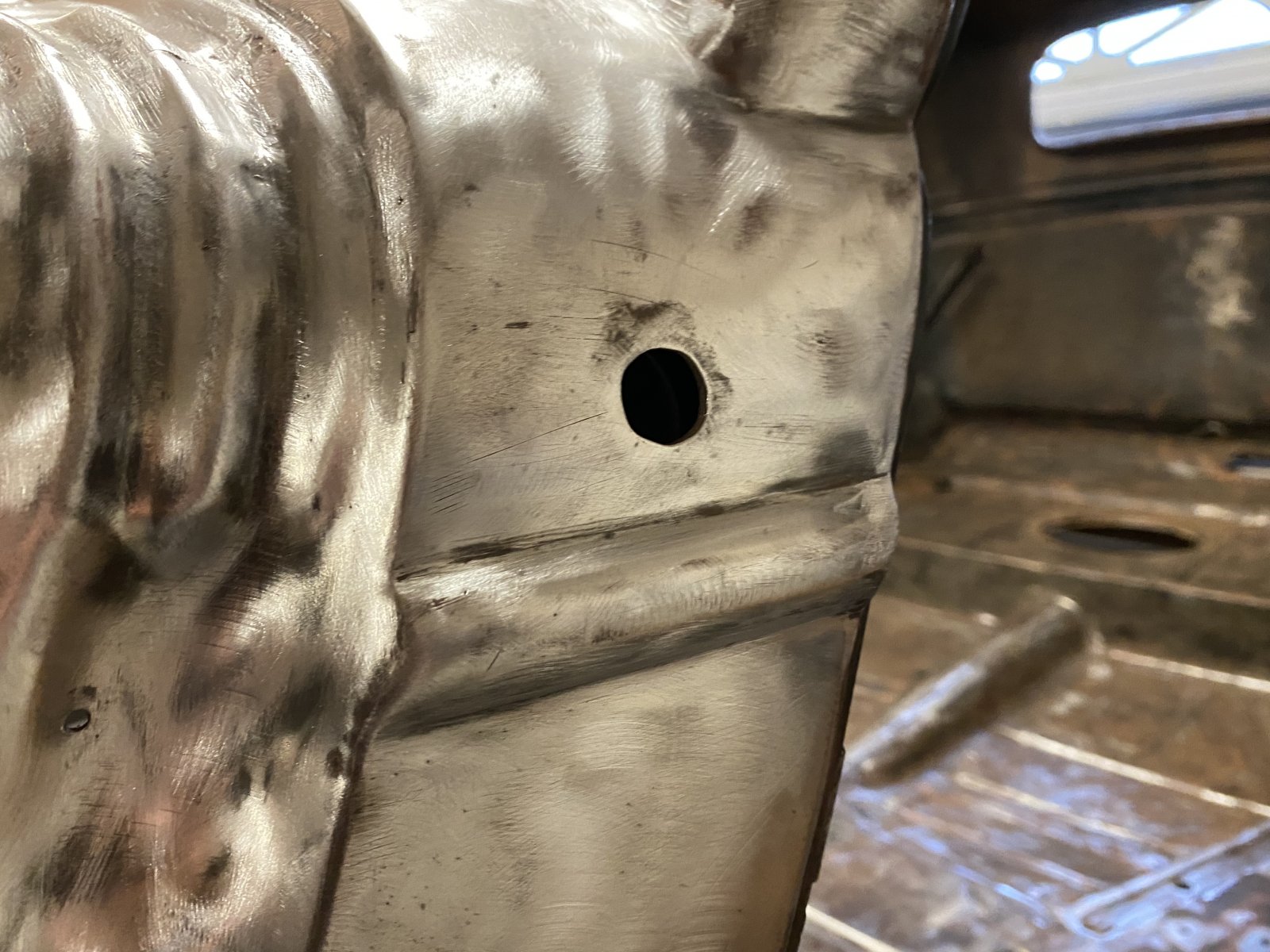

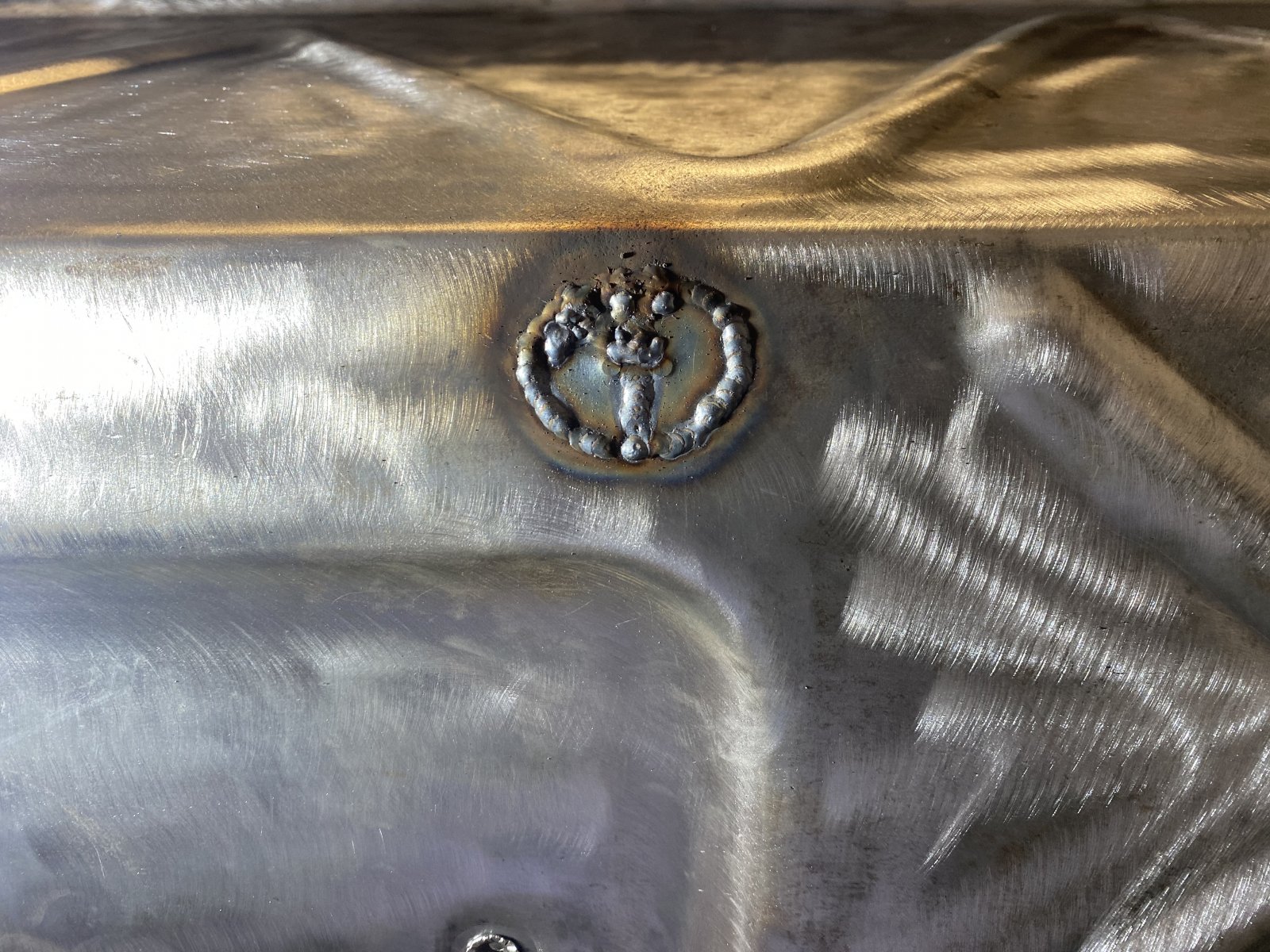

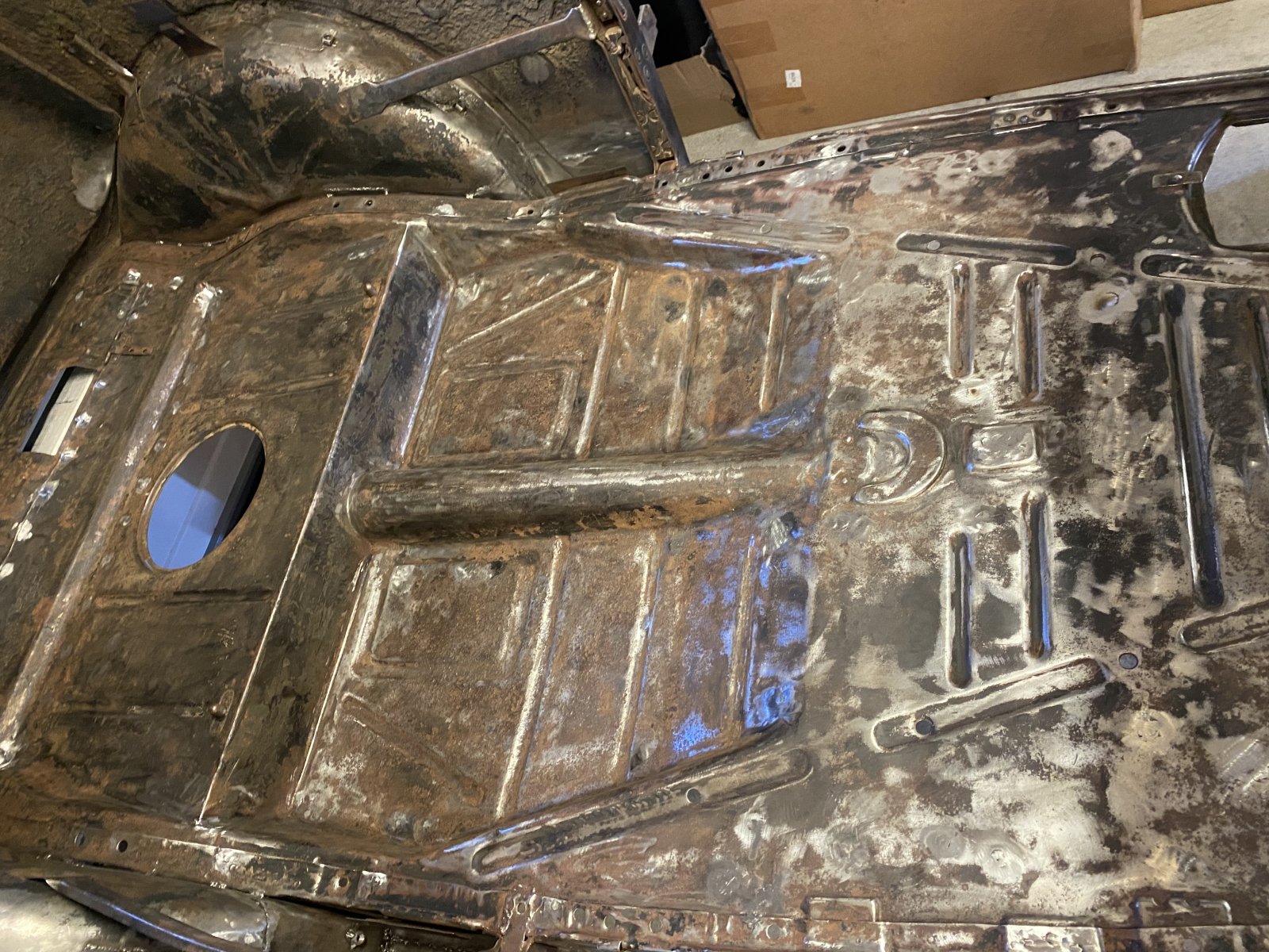

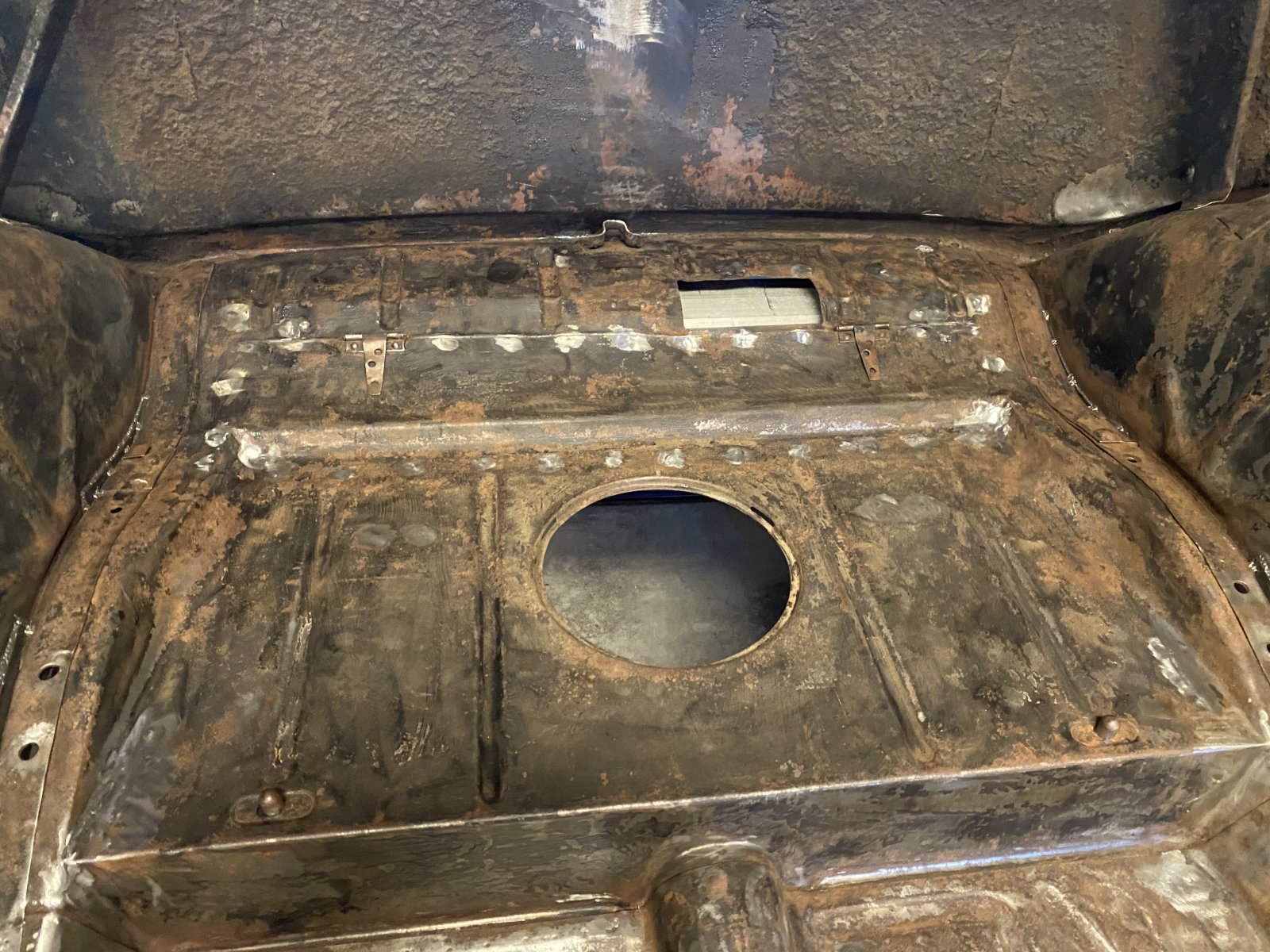

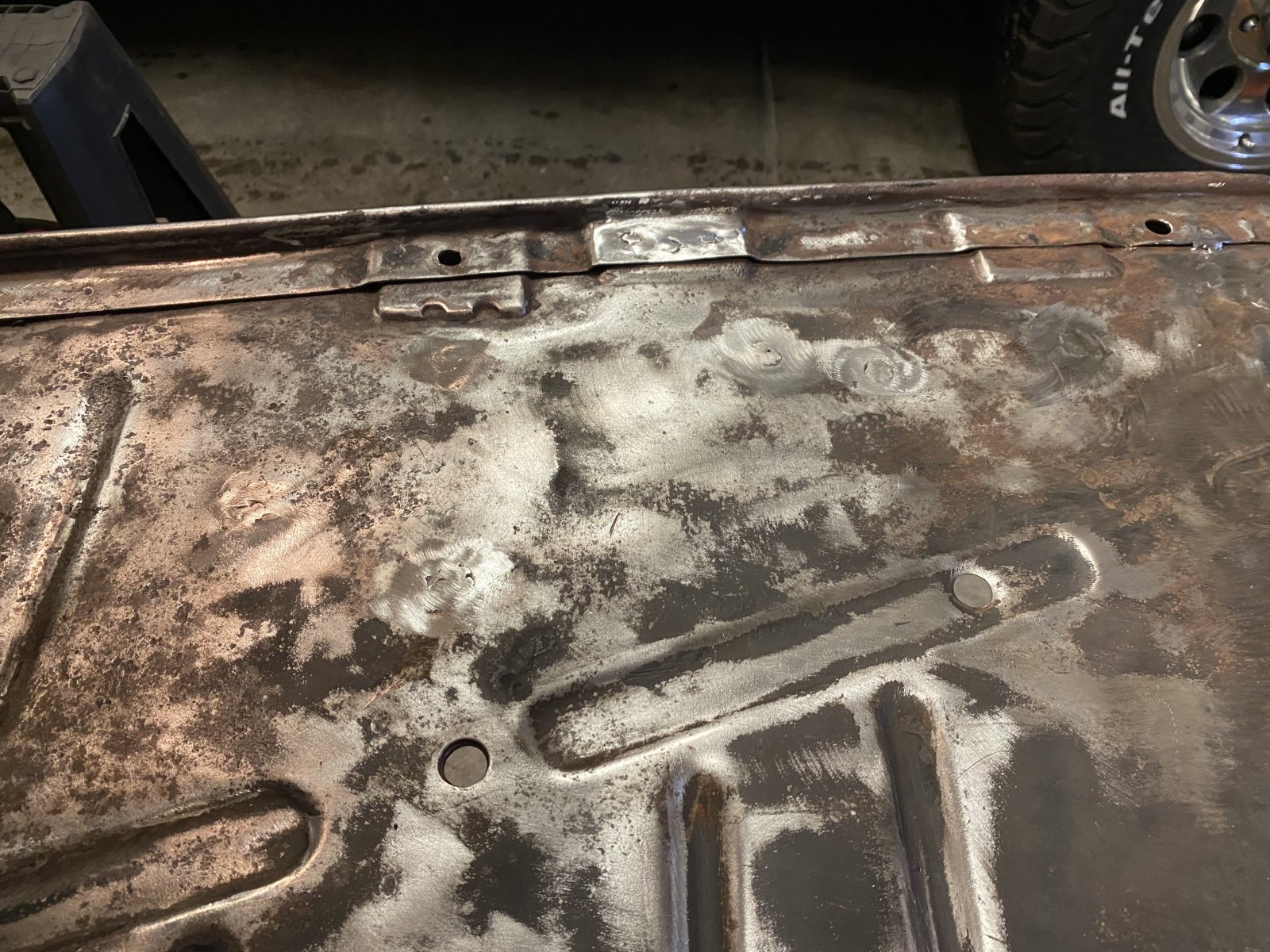

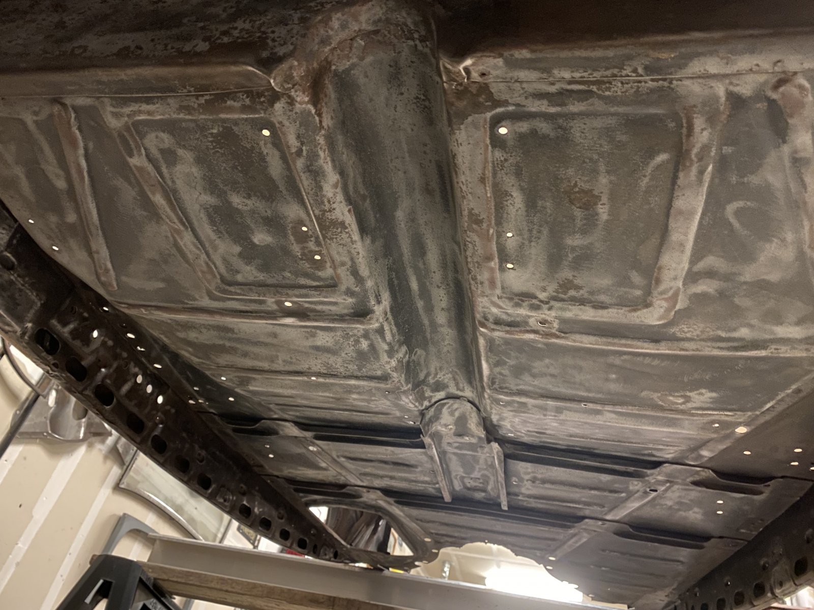

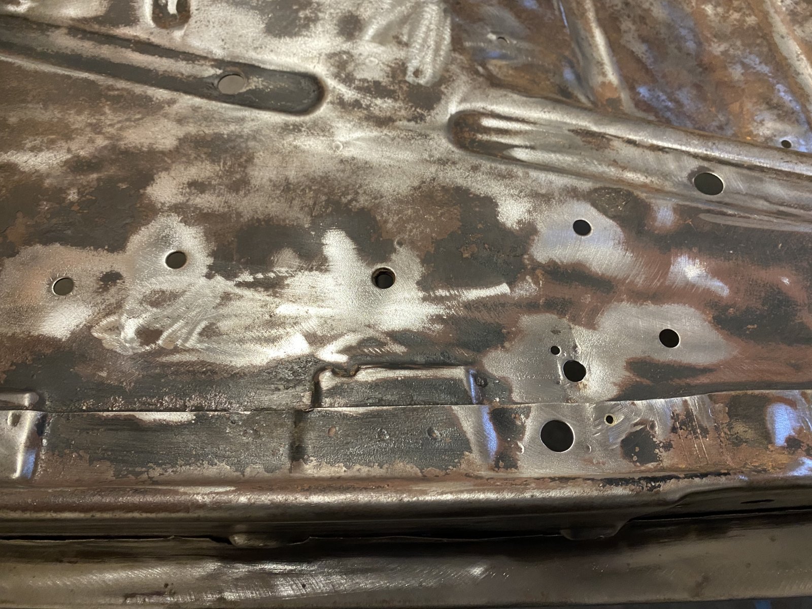

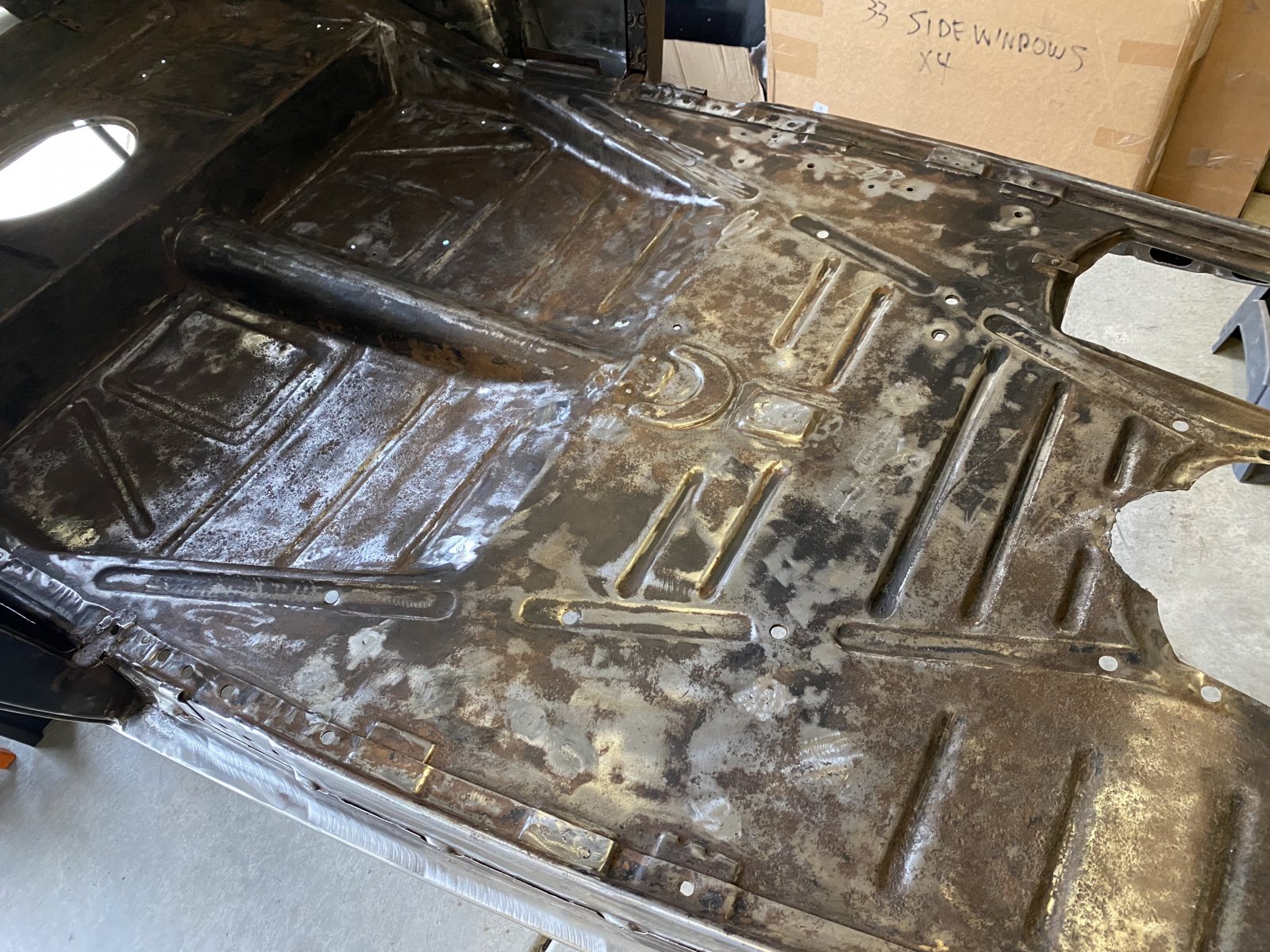

    165+ holes welded up!
    40 more on the firewall!
    Can’t believe how much stuff was screwed or bolted to the floor boards over the years!
    They were all small 3/16—-9/16-ish
    Firewall pretty much has just standard stock holes I’m just filling all of them because I’m not using them.
    And I’ll re-drill the heater holes where I decide to locate it
    1E482F28-B381-4718-95E7-D7A156CF7EC4.jpeg E8893B40-63A2-4ABA-B656-CDE904504431.jpeg C9530F53-2CFA-4FBF-A38D-59A91377831A.jpeg

    A floor in that good of shape needs to be sandblasted and a coat of epoxy put on it,you will never have to worry about it again.Same for the outside of the body,it is really hard to get the little bits of rust out of any pitting areas,i would go the extra mile and then it would not come back to haunt you.I have the same car,but it is not in near as nice shape as yours.im jealous of it.:D Good Luck
    kidcampbell71 likes this.

    @37 caddy i completly disagree about sand blasting. It warps the metal and as one resto shop owner said "sand blasters are good at selling patch panels"
    Chemical treatment of rust is a lot less damaging.

    It depends on how you do it. Use low pressure (50-60psi) and don't work on one area too long. You won't warp it and its a lot better surface prep than chemical stripping. That's my two cents. There is truth in sandblasting!

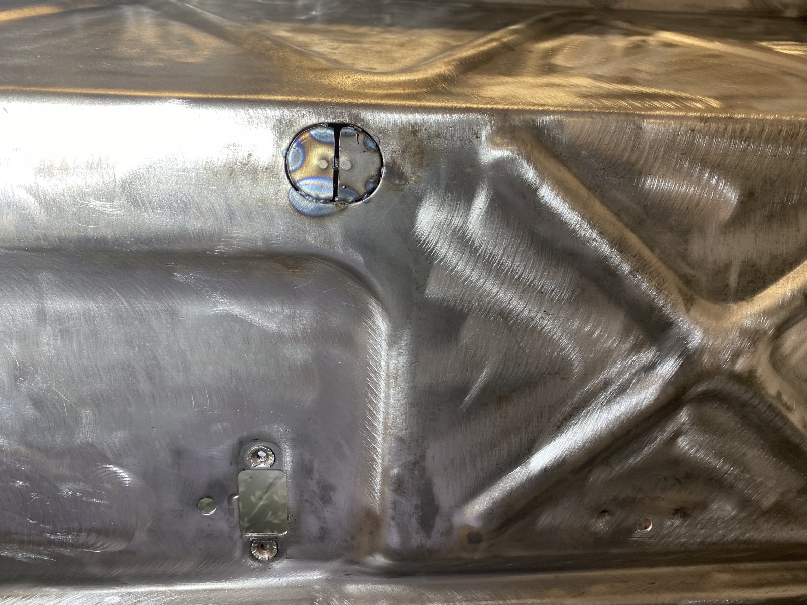

  12. 33Doll
    Posts: 1,600
    33Doll

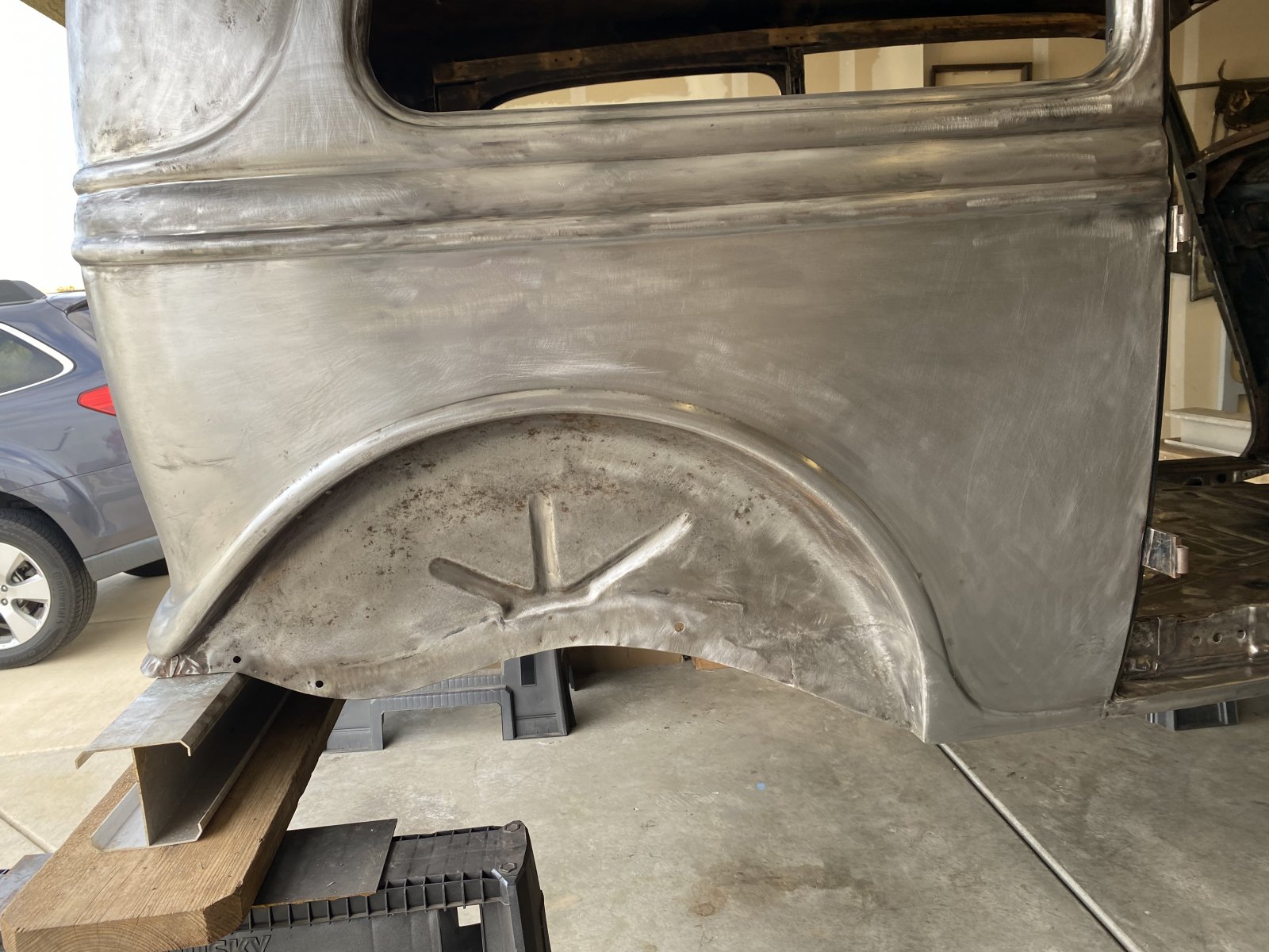

    4946B298-8262-4FFD-9AC8-1E050D98CABF.jpeg CF1D710B-F008-447F-A64E-8DF132E90A92.jpeg A67B1545-5074-4010-B116-8BE69629C2E8.jpeg 45BD52F6-162B-4349-A328-D5B6F479C78E.jpeg 522FA8D7-2B01-448D-B55C-F889A47BB909.jpeg 2CC04582-7E64-4330-93A0-01277D5B7A94.jpeg 5B7B5C43-03F2-417E-8388-7C474DD4E7DA.jpeg B80CA867-929F-4803-84BA-2BC4C5C9397E.jpeg Holes are all done!
    Lost count after 197!!!
    Gonna start on the dings and bruises.
    Get the sanding and Filler out of the way!
    Then por 15 the patches, and neutralize the pores. And industrial paint the inside and underneath. Then under coat it. It will be a wash out floorboard like my Bronco was!
    This car is gonna be driven! No fluff here.
    The interior is going to be exposed wood and Top bows painted black, and black canvas instead of the white to hide the chicken wire.

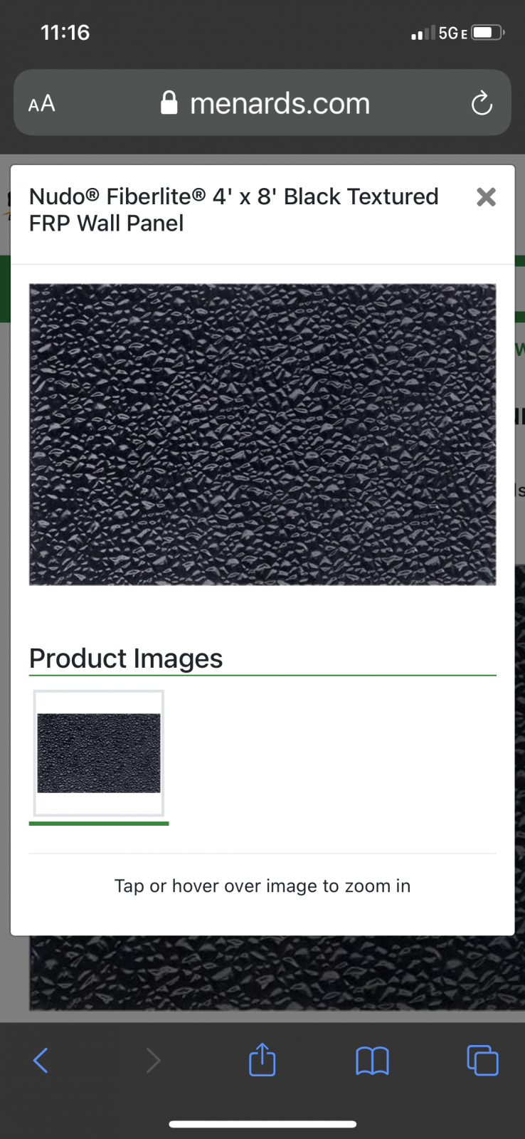

    Cool! Good old Google search! Came up with different colored textured plastic panels awesome don’t have to paint it!!!!

    I like the idea of a he hose out interior. I would make up some carpet floor mats that you can take out and pressure wash, just to help keep the noise down.

    Meh' .. being a bartender for years .. I've been around that textured panel a bunch. It's very "tinny" in sound quality.
    While I myself wouldn't install it in a car .. I guess if one is inclined, you'd really need some sort of binding, stick on sound deadening stuck to its backside.
    If one were to do all that, I'd then question why one wouldn't just do a fiber panel, & upholstery, but altogether .. not my car.
    PeckerHead's ride is an RPU. Not the quietest of rides, as is. An apples to oranges comparison.

    Looks to be only .090 thick so some kind of dampener on the back side would be a great idea.

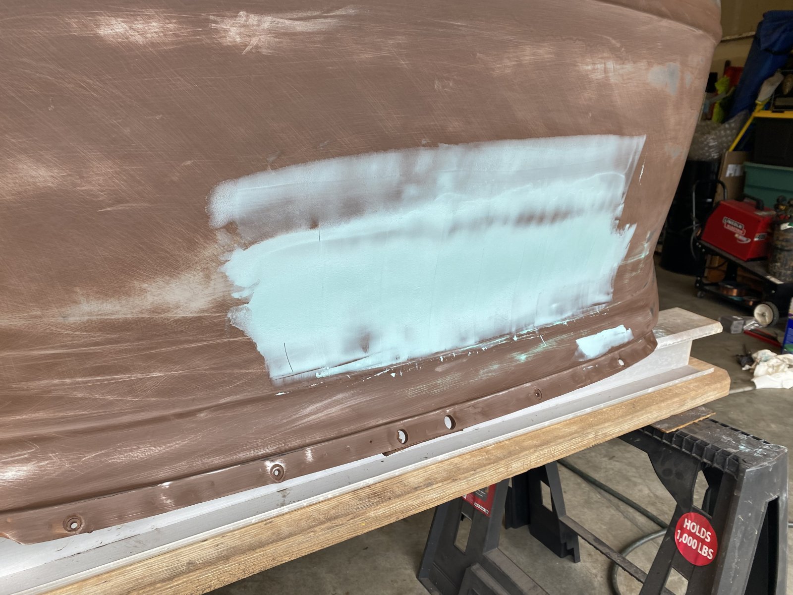

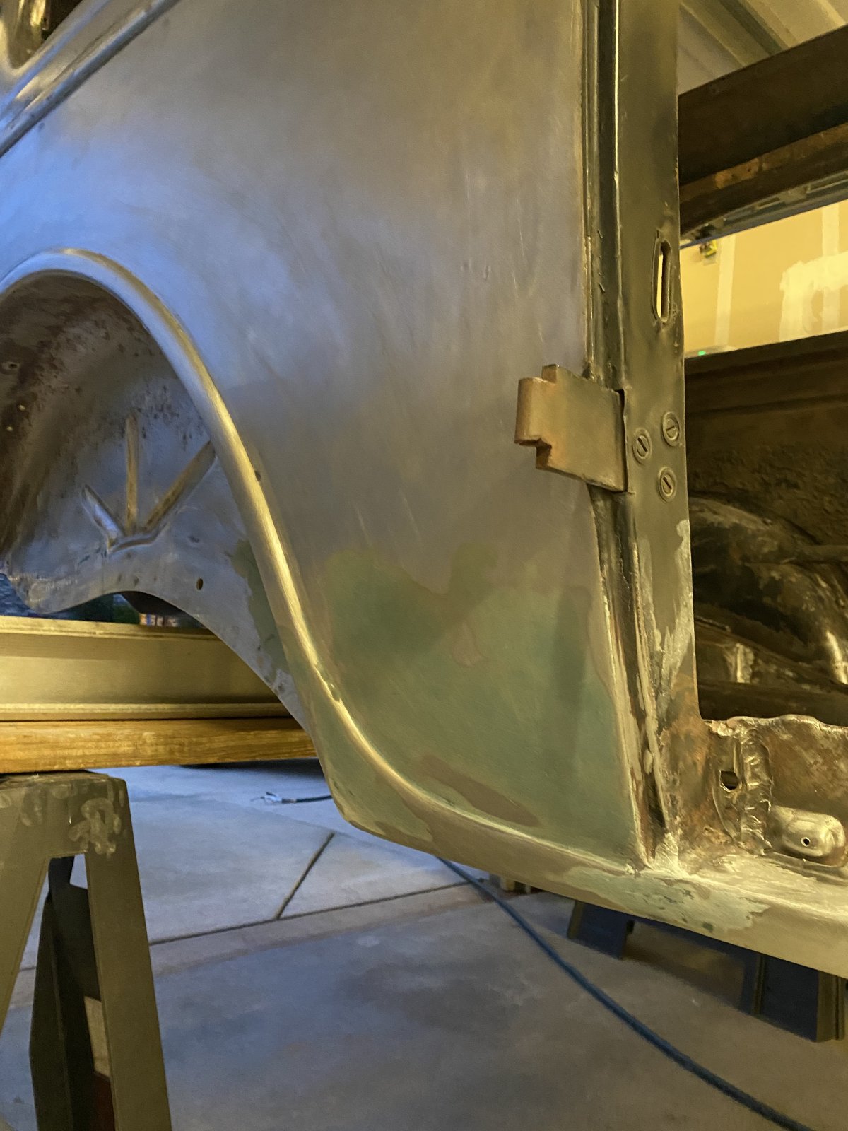

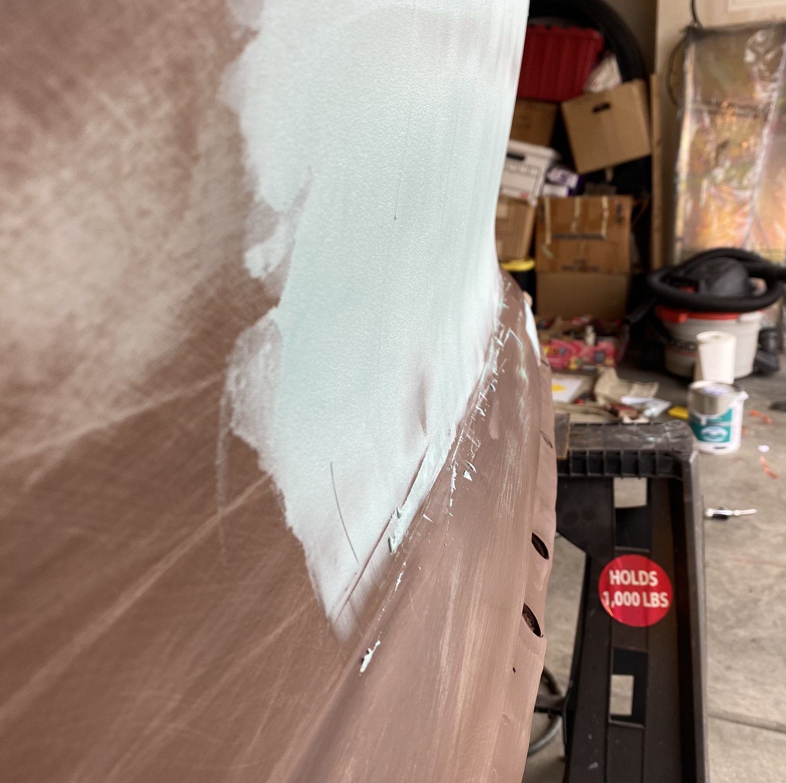

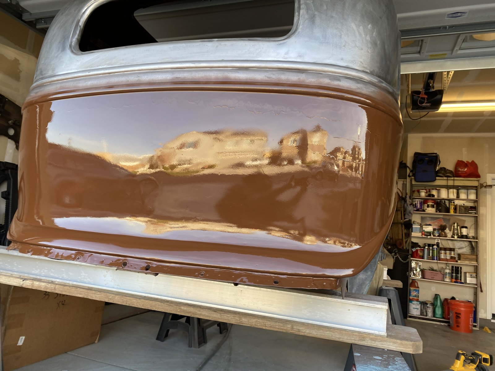

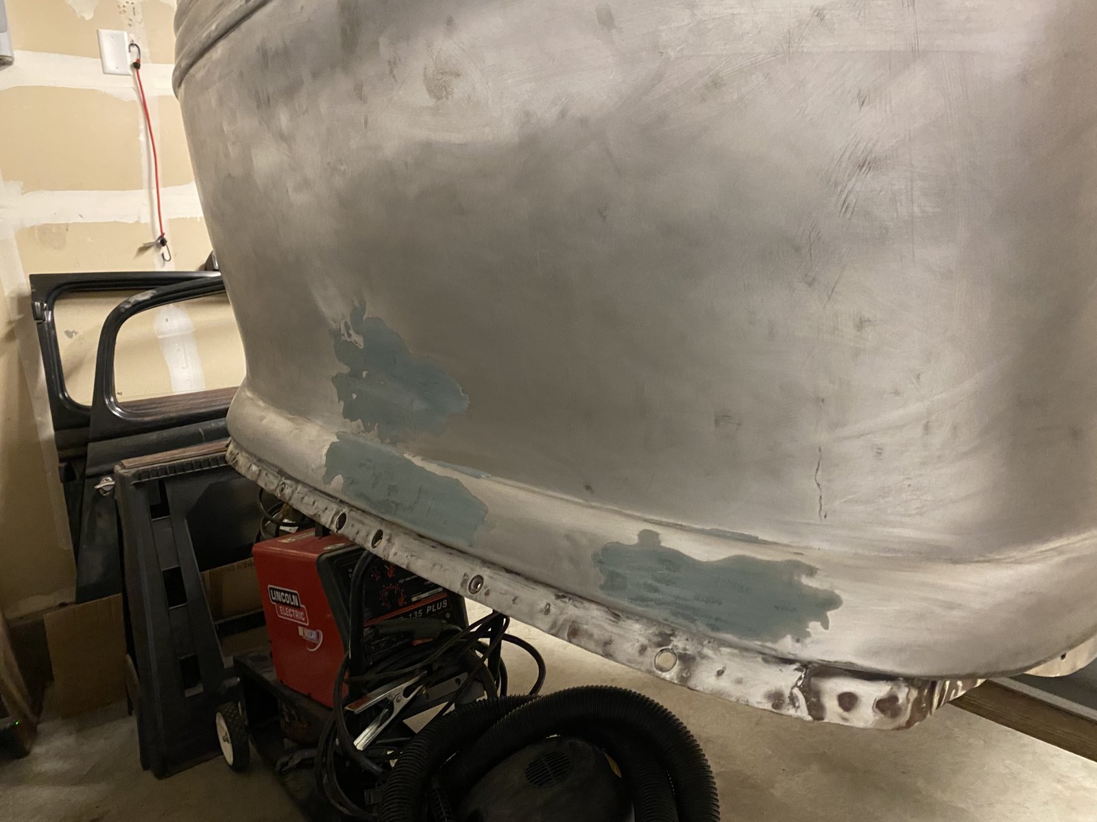

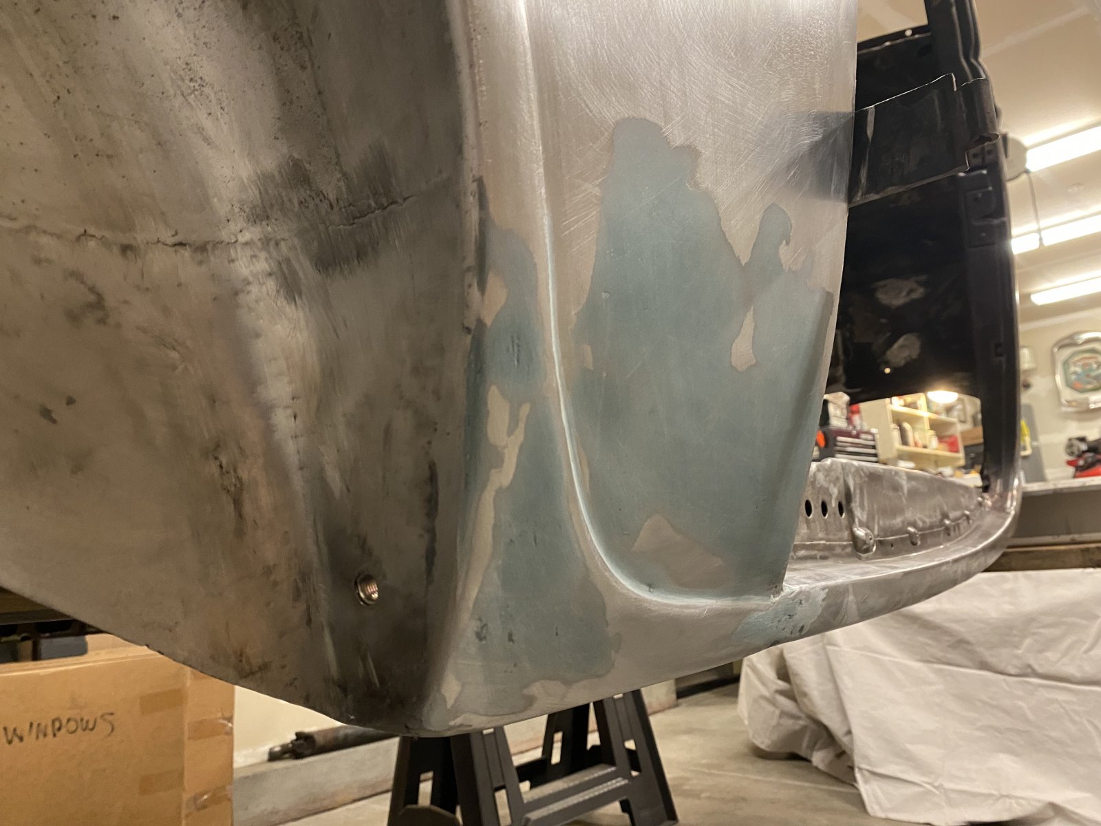

    Tried out some of that fibergl*** based, Duraglas Bondo! Holy Mackerel that stuffs hard! If you don’t cheese grade it within 15 minutes, it just slides right across it!
    But after about an hour of sanding it, one p*** did pretty good so I got a couple more to do and then I’m gonna skim coat it with 3M putty, I think it will be pretty easy!
    I freaking hate bodywork! But I am kind of good at it,
    I think. A88ACBFB-1452-48D2-B86A-CAC767AF9329.jpeg E305F69F-7E9C-4615-8A0D-60F72D928F38.jpeg C406E194-791C-4803-BED5-3CF5E62CCE0C.jpeg 5DE83B88-00D6-4434-AA89-0158AFB09739.jpeg 28AC4A81-BB69-4F1C-ACDA-2B3CD3824F81.jpeg 04E0765A-37A7-42E0-97EB-DE78CC783D68.jpeg 1F4CC793-2C52-454E-AA0D-A97C8C9ED49C.jpeg 1A330582-9507-4B1B-BE8A-68874F44B70E.jpeg 16F99B39-9333-4504-A9C6-F31808FB0025.jpeg FF89E3A8-6F95-4731-8BBB-F53AB6C7528C.jpeg A5C9565A-9510-47F1-9FC1-8CC1B8DCAE77.jpeg 81115CD5-DBFA-42AF-A539-52CDA40C1E19.jpeg

    Ah the infamous "Green monkey ****"
    I hate the stuff but it's good at sealing tiny pin holes and it's water proof. Tiny skim coats are your friend or you have to grind it off with 36 grit.
    Cars looking awesome!

    Never let that stuff dry before you sand it,i always "File" it the second it is ready,then you shape it with a board and some 36 grit.The same for your fill,sand or file it as soon as it is ready,saves a lot of elbow grease and is very easy to shape too.It will clog the paper easy,just have a blow gun ready to keep blowing out the pores on the paper,and dont be scared to use fresh paper,it will cut better and save time in the long run.Also blow out the "pinholes" on any fill before you recoat it,it is unbelievable how many little craters you will see in the new filler. harvey

    36 grit is your friend with that stuff, it meant more as a base than a top coat so you'll be putting a skim coat to cover anyways and the 36 grit scratches give the top coat something to bite in to. Look into Evercoat Polyester Glazing Putty for the skim coat, it's 2 part and sands like ****er. 30 years with this product with zero issues.

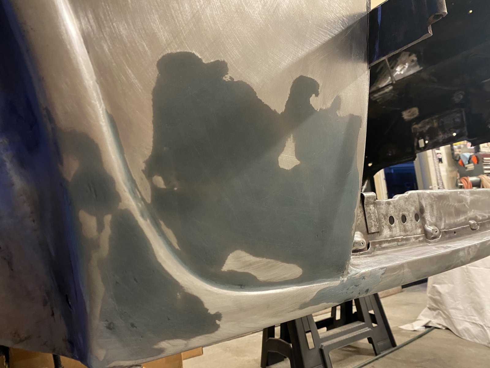

  22. 33Doll
    Posts: 1,600
    33Doll
    You guys probably already know that I have pretty low patience!!
    But I absolutely hate bodywork!!!
    Give me metal all day long! But sanding and Filling, Freaking ****s!
    Plus my rotator cuff’s shot anyway

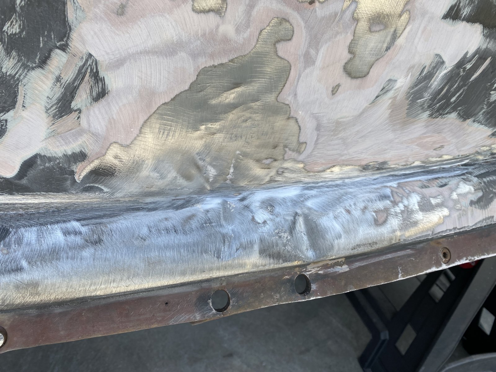

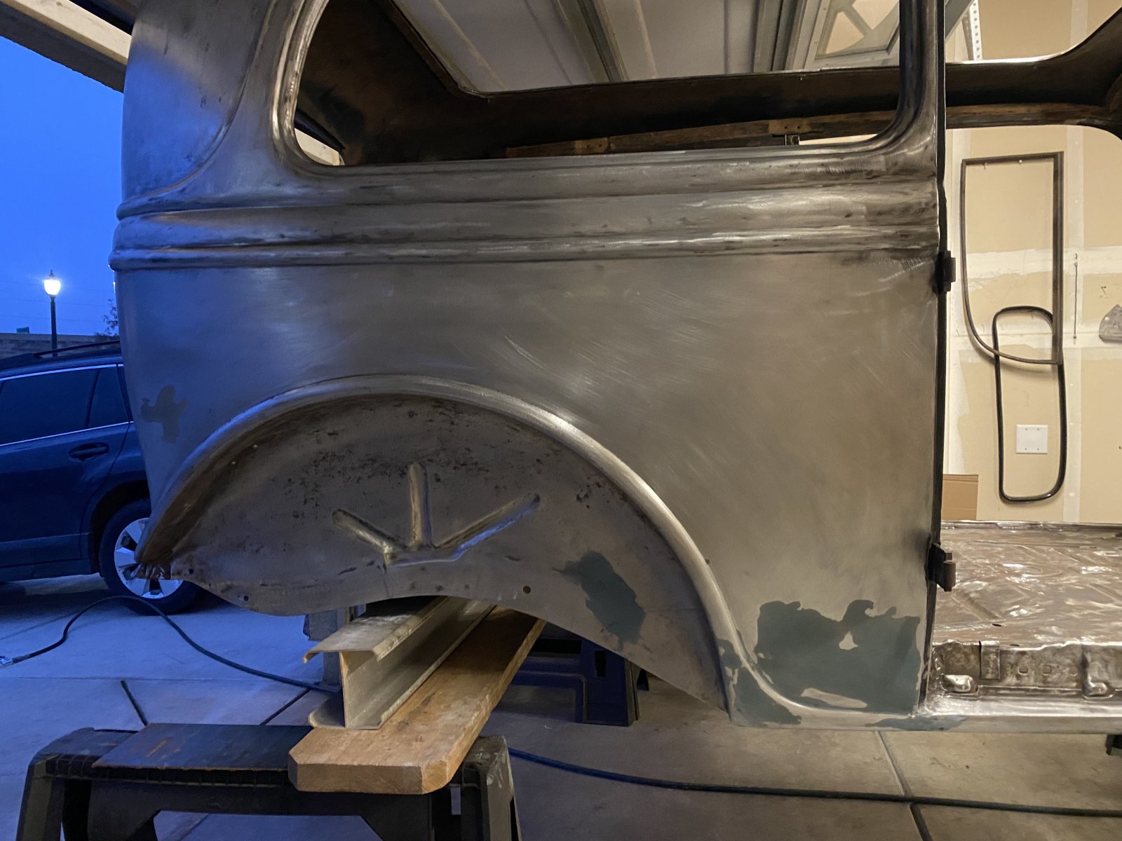

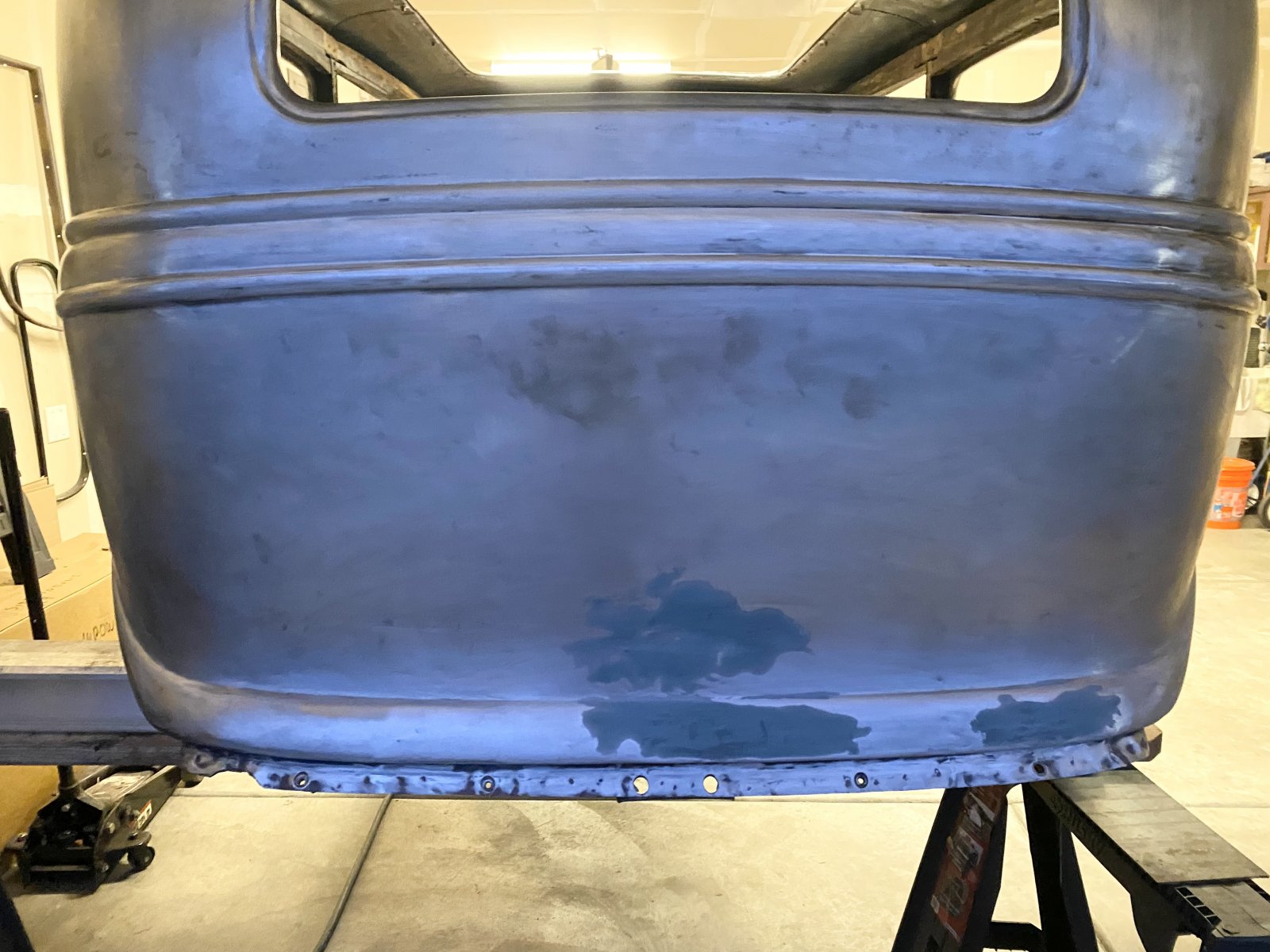

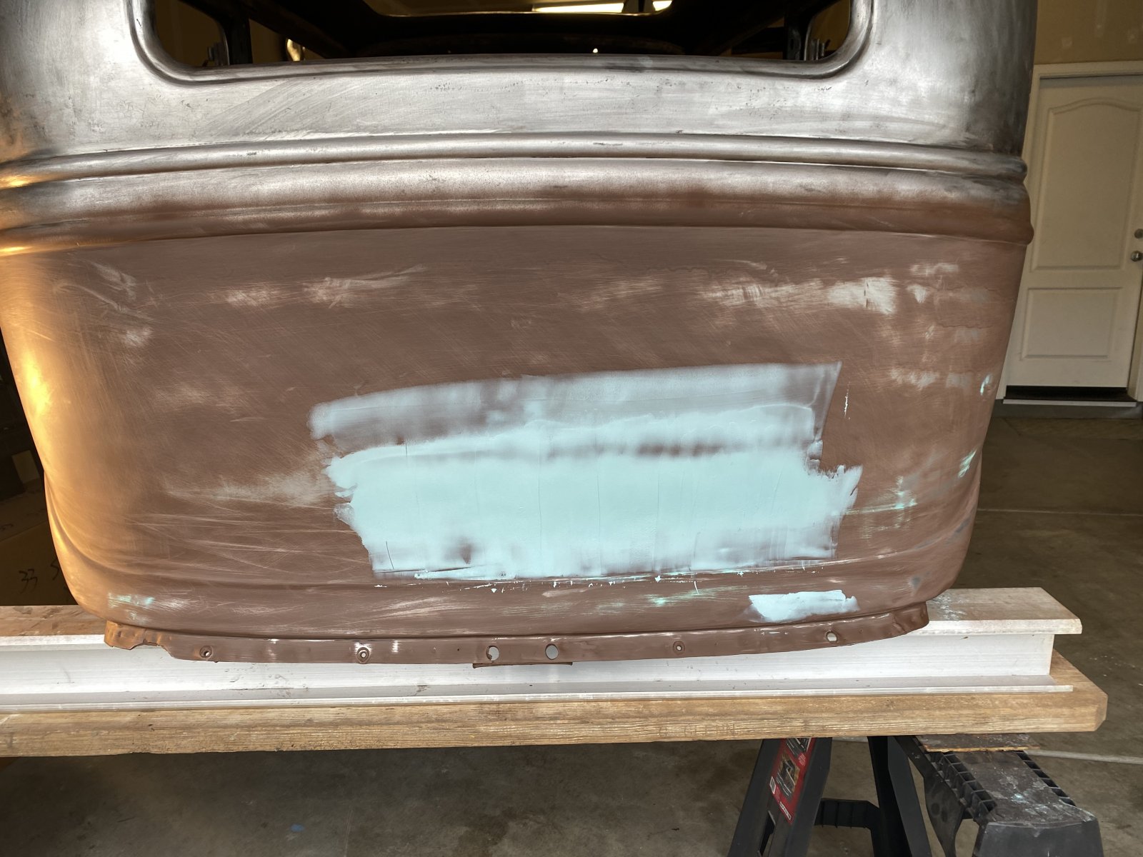

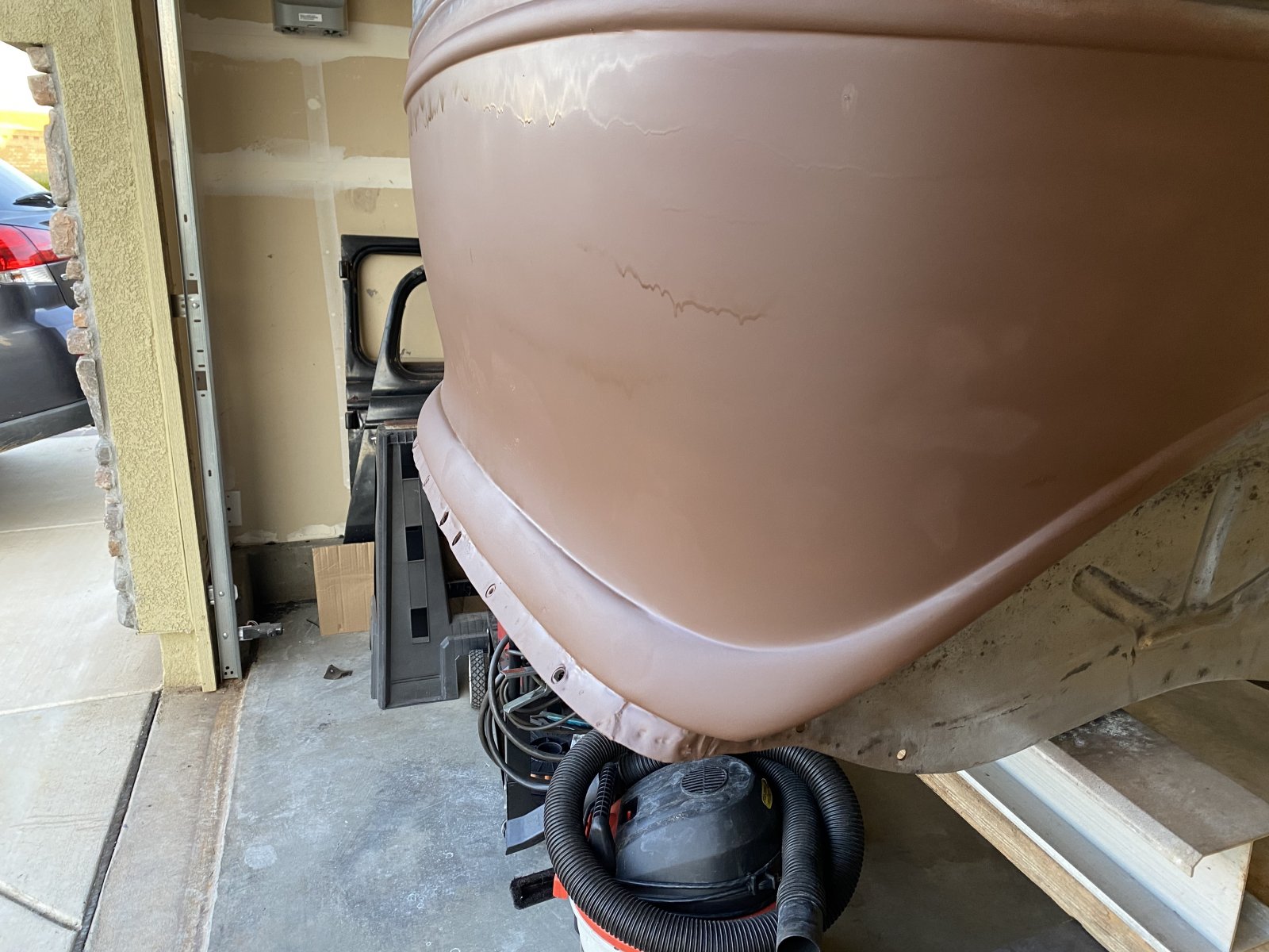

    I’ve been spending two weeks on this dent on the back of the body and I roughed it out as best as I am willing to spend on it! I’m just gonna have the bodywork done later after the car is running and driving. I don’t wanna **** with it spending a year on a couple of dents!! It’s gonna be semi flat-Black for now anyway. Wanna Drive it before Newsom outlaws Gas Motors!
    Looks a hell of alot then before!
    upload_2021-11-27_15-45-31.jpeg upload_2021-11-27_15-45-31.jpeg upload_2021-11-27_15-45-31.jpeg upload_2021-11-27_15-45-31.jpeg upload_2021-11-27_15-45-31.jpeg upload_2021-11-27_15-45-31.jpeg

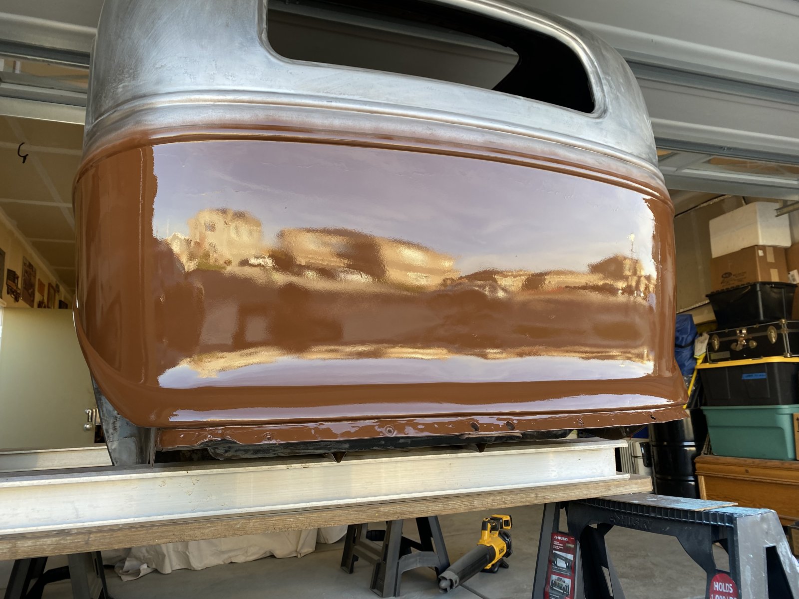

  23. 33Doll
    Posts: 1,600
    33Doll
    72D46074-ACBC-4D50-B489-BE593492680D.jpeg 735AC770-2519-4506-A7C3-2E3D702814A9.jpeg 3751A38C-FF02-4DE1-9986-08B171F77E93.jpeg Looks better Dry! Sand, coat, sand

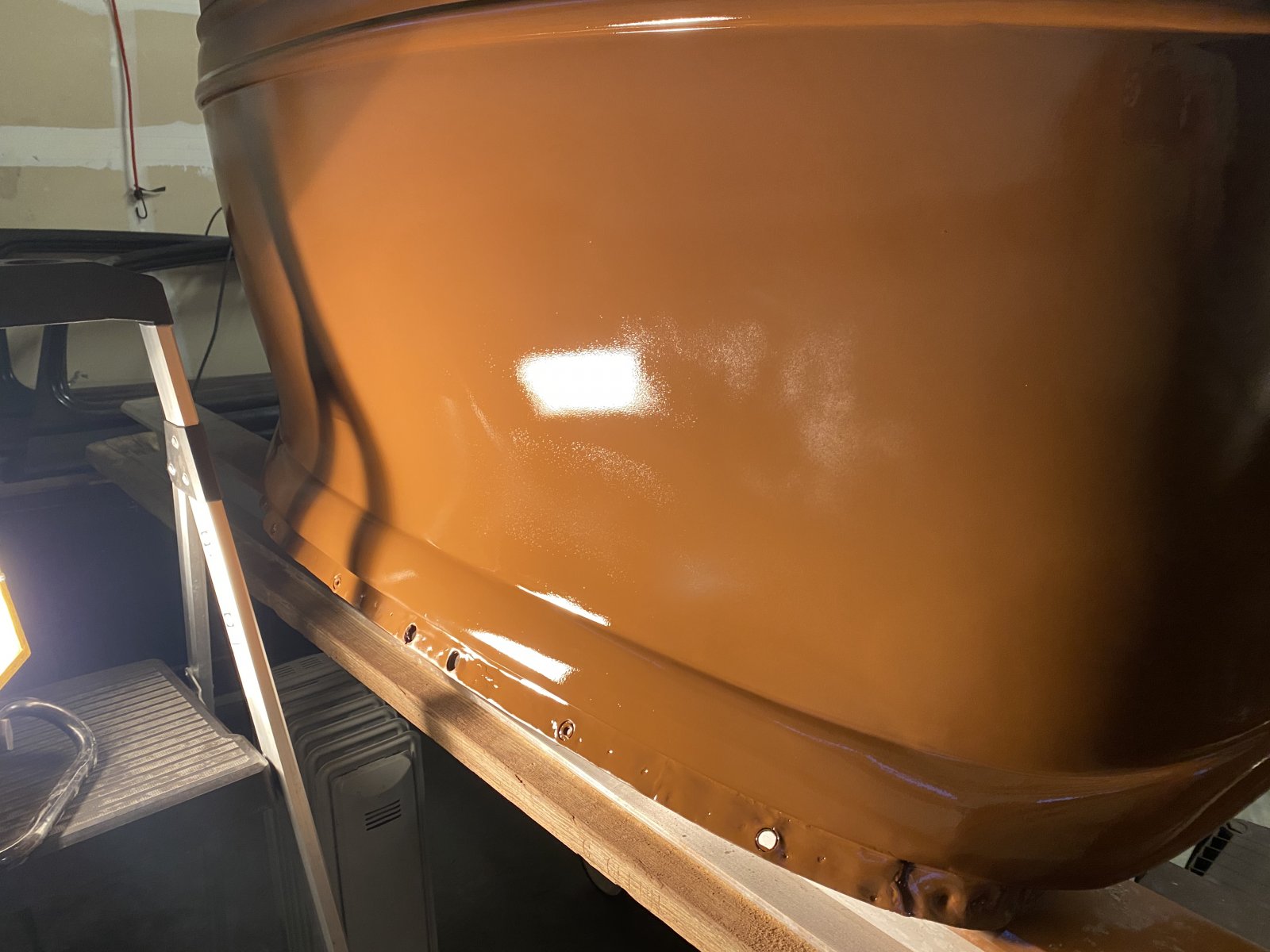

    Paint black… sand, paint, sand polish red neck 101!

    It a good thing you have low patience and hate bodywork so hopefully you won't be fixing dents and adding new ones...:D...I have a fluctuating patience level that I really try to leave locked within as acting out many times comes back to haunt and you know tossing the wrench and it bounces back and deflects off your head eh!!!:eek:
    33, you definitely have to give yourself a big pat on the back as you are doing stand up job here...you had me going...I was thinking you painted it Pooh Brown...but al-***...it's only primer...:p
    You must admit walking a mile in other tradespeoples shoes can be eye opening...

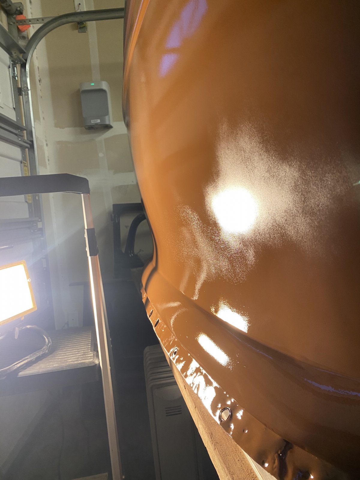

  27. 33Doll
    Posts: 1,600
    33Doll

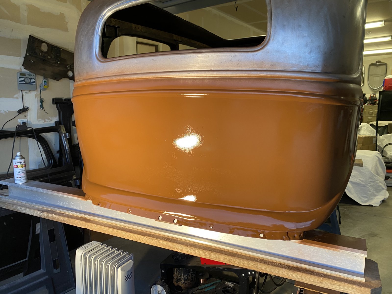

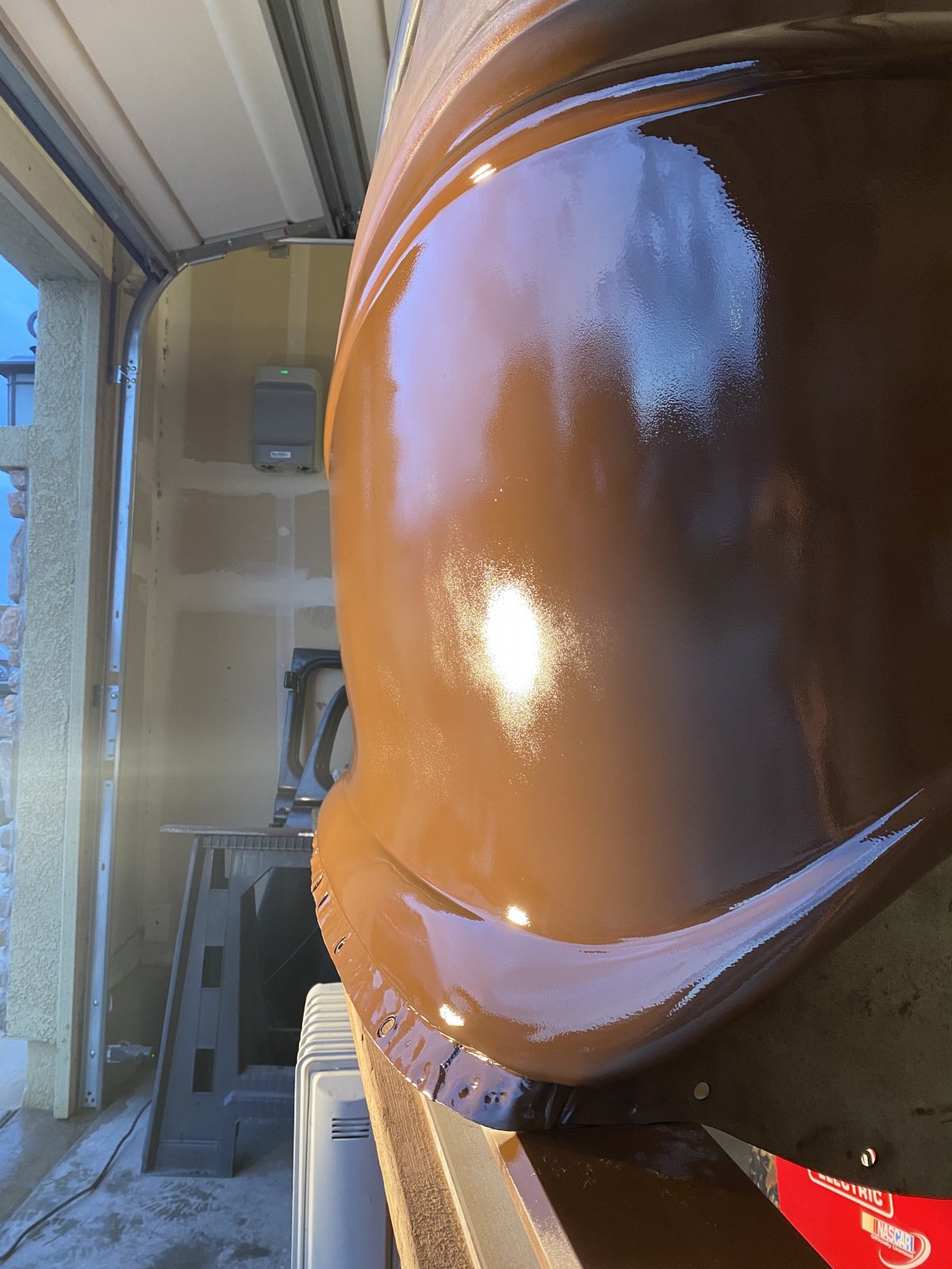

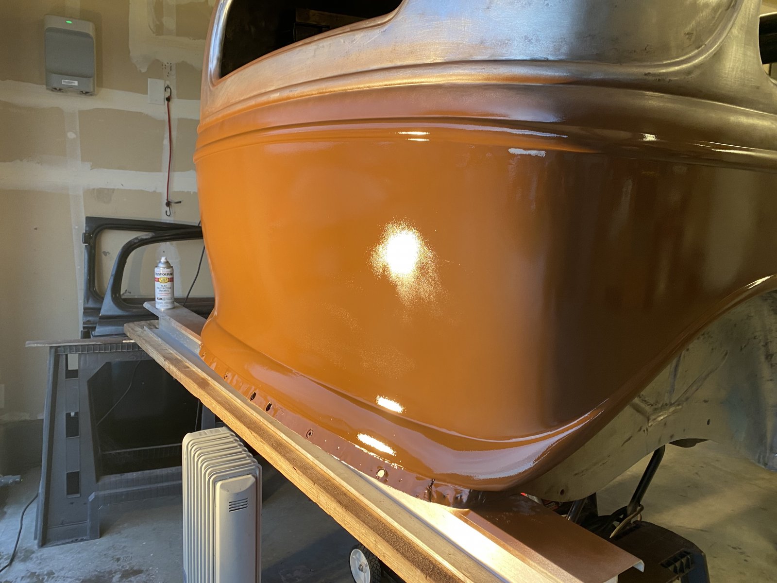

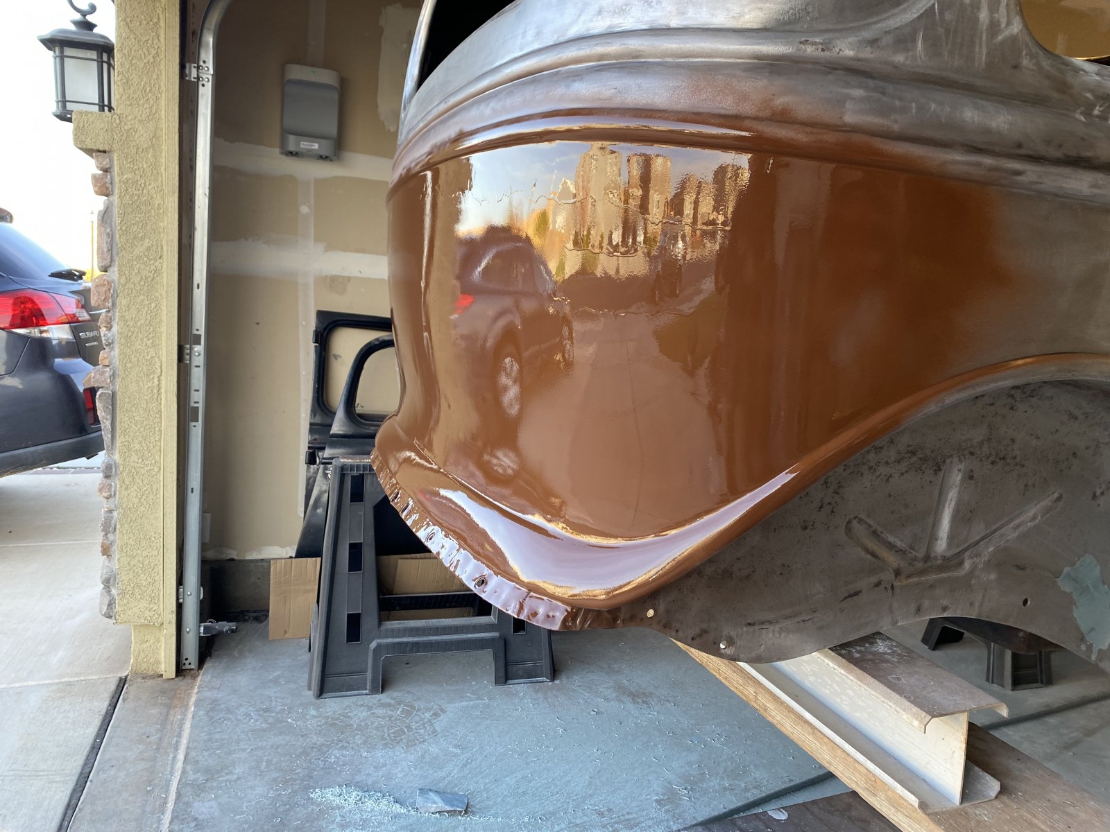

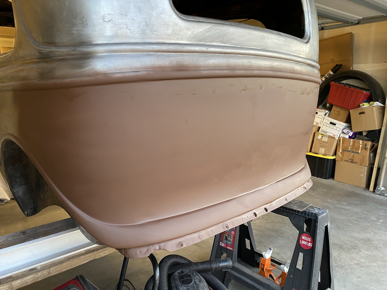

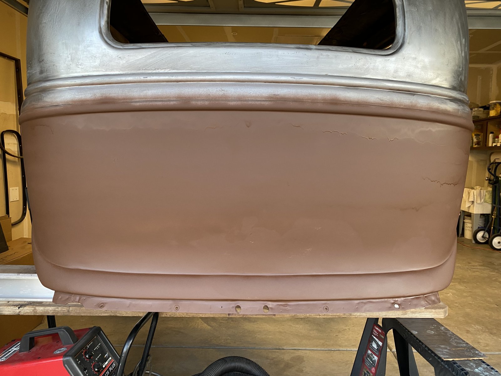

    Well I got some way easier to use Bondo!
    That fibergl*** stuff was killing me although it’s strong as hell!!!
    Probably use it on the thin areas of metal underneath or something or on the rockers.
    But for regular bodywork….hell no!!
    We’ll see how this ever coat sands it’s supposed to be easy sand!
    Merry Christmas folks!!!

    Dry Now! Just some 3M putty to fill in the pinholes, and ED1BACBD-43E0-4E81-A629-9901ADCA3CA9.jpeg FC09E3F3-F837-4894-90A0-04B98E379DC9.jpeg a couple more coats some wet sanding!
