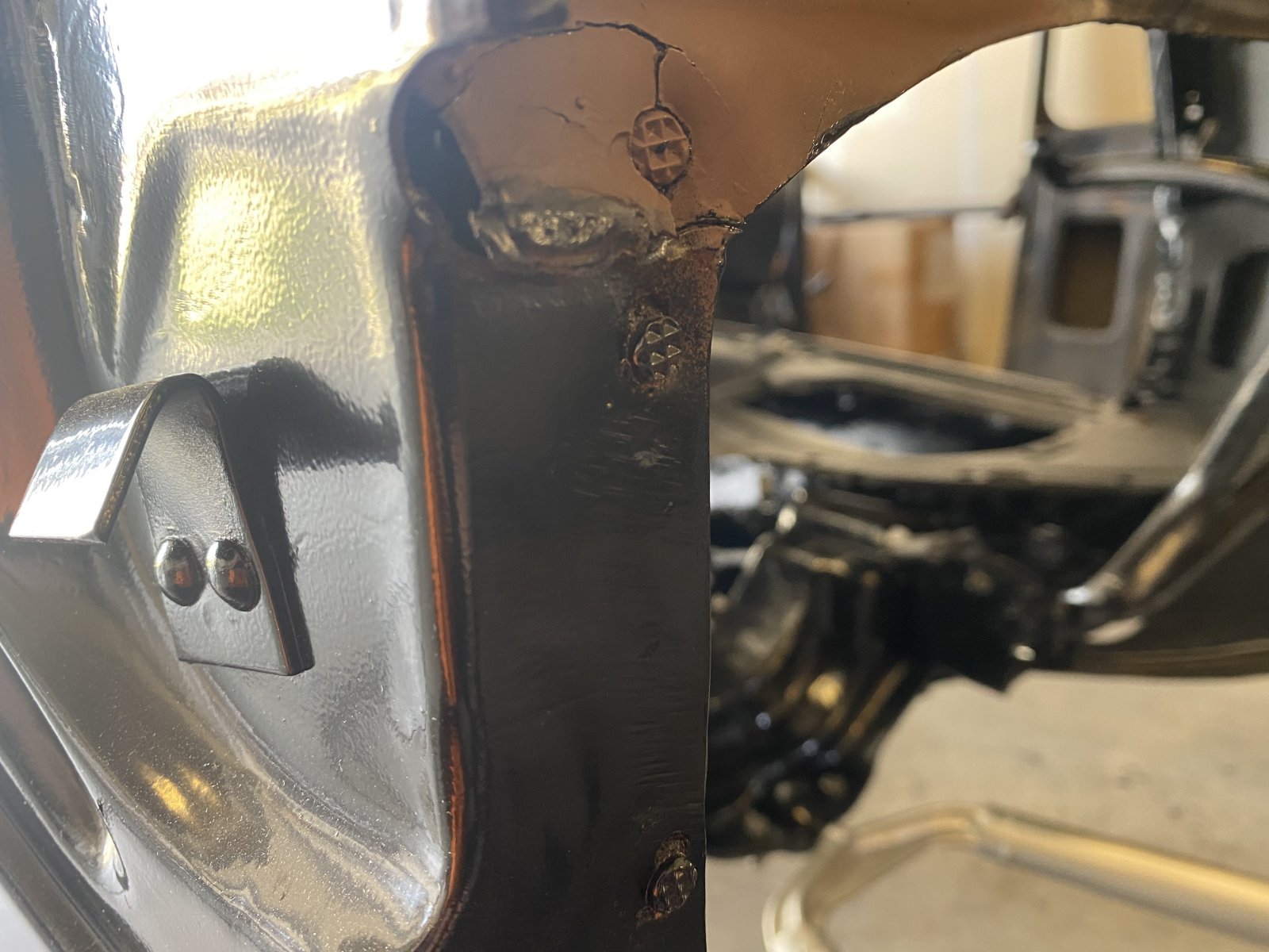

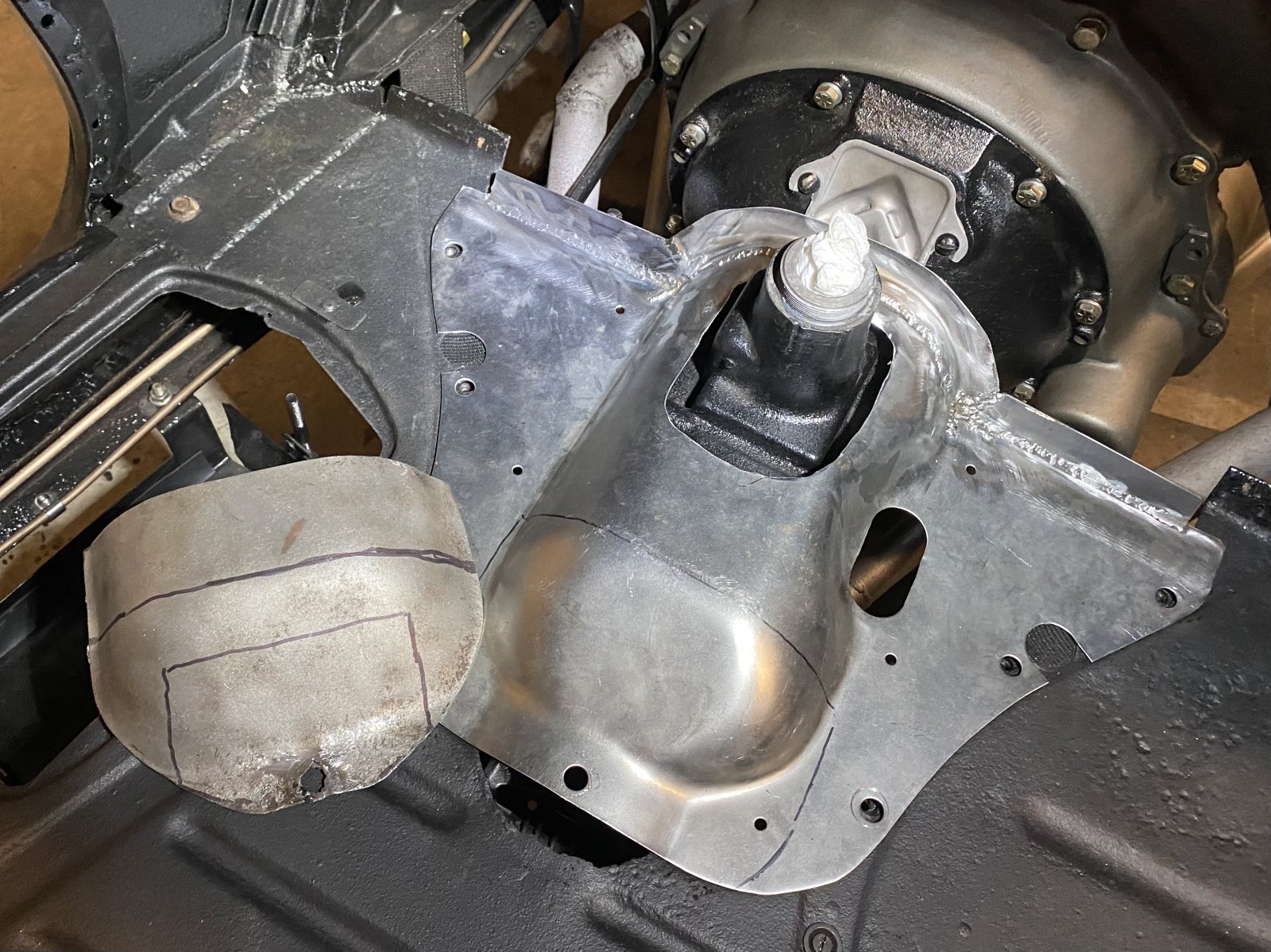

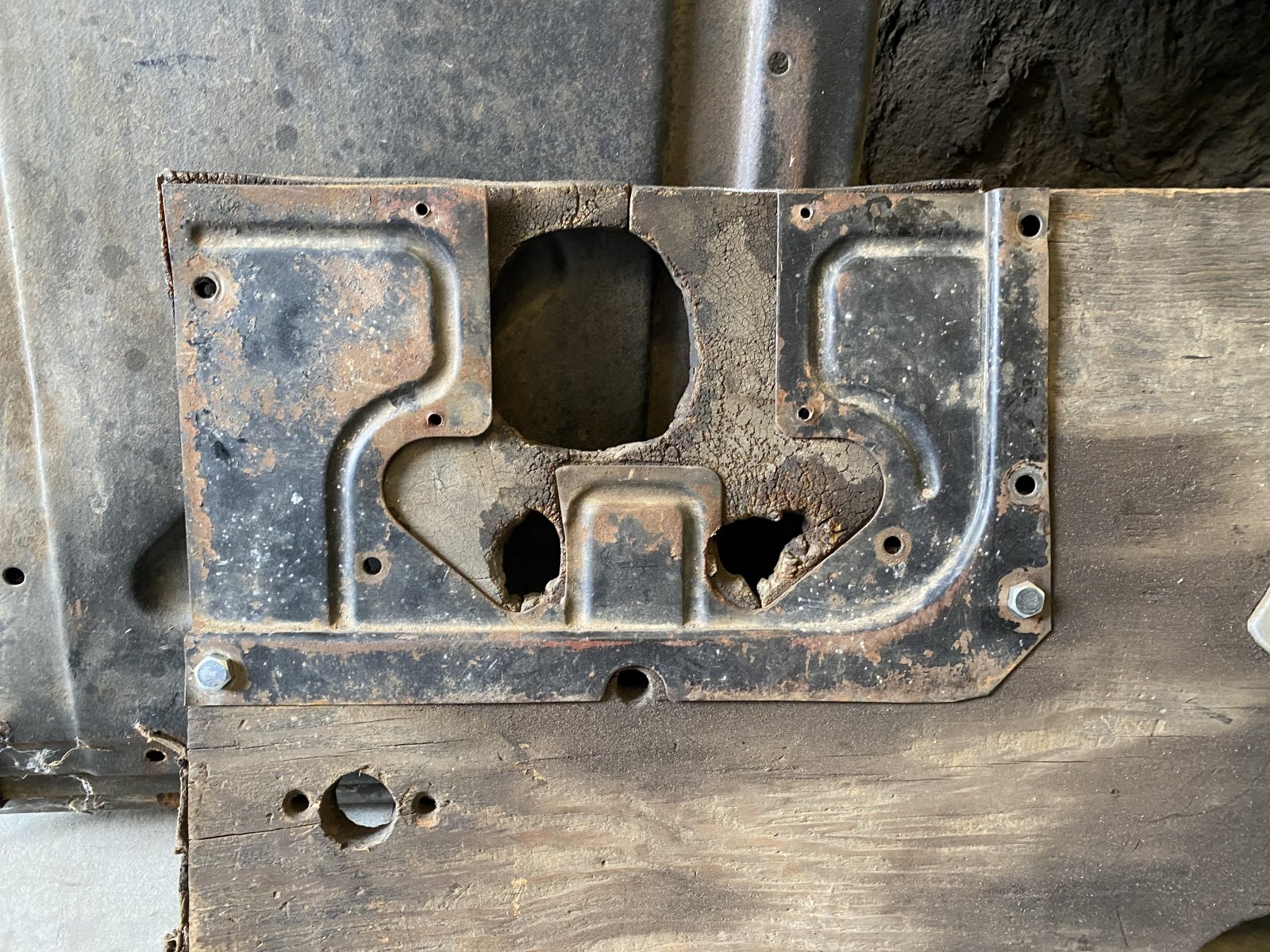

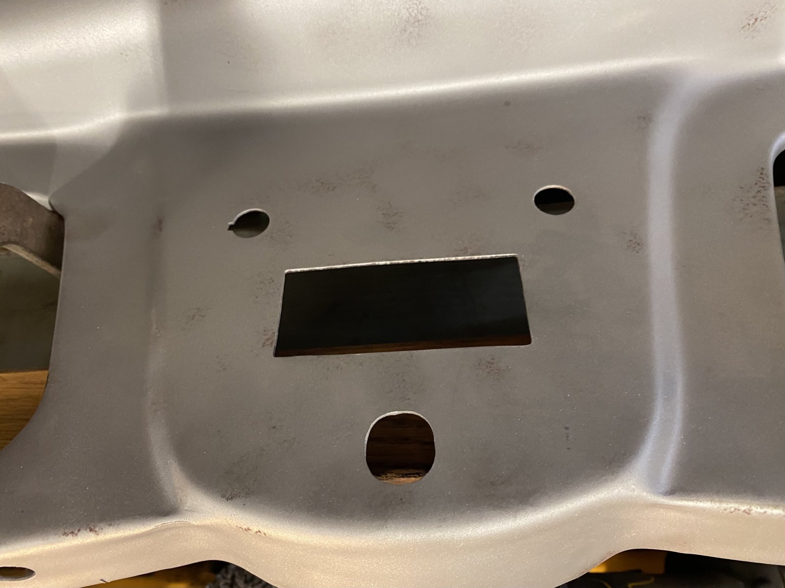

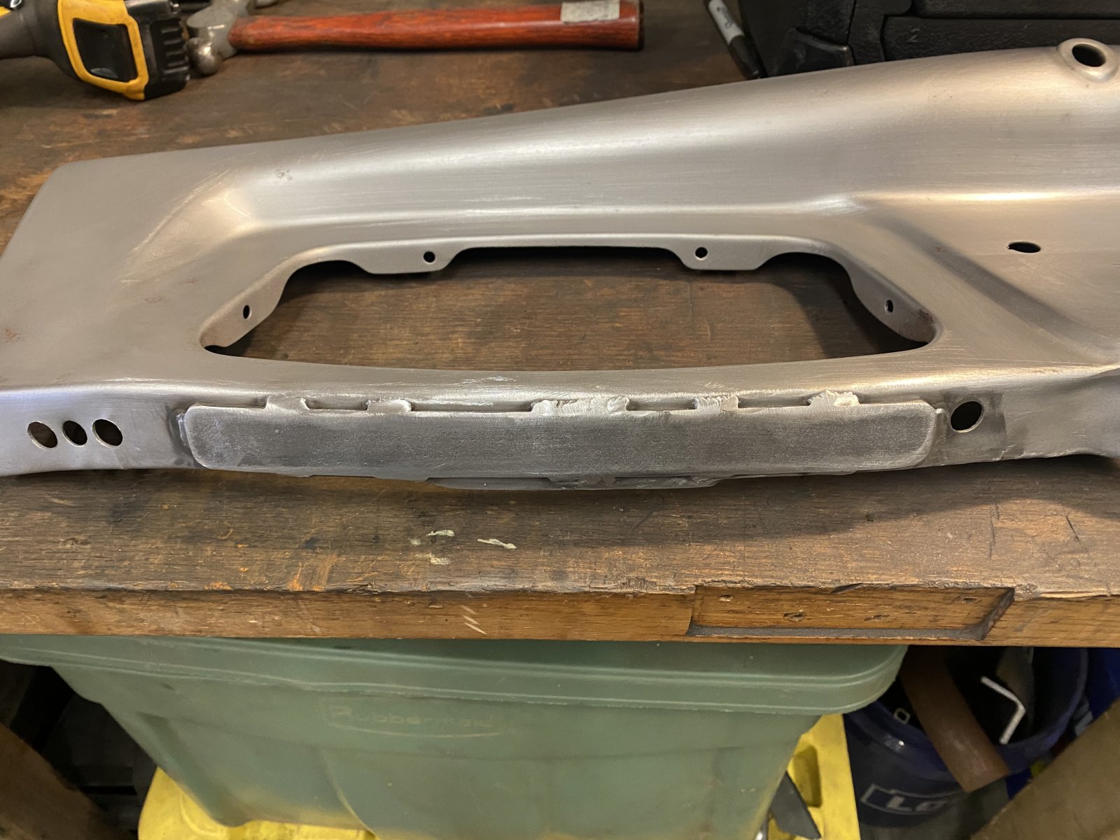

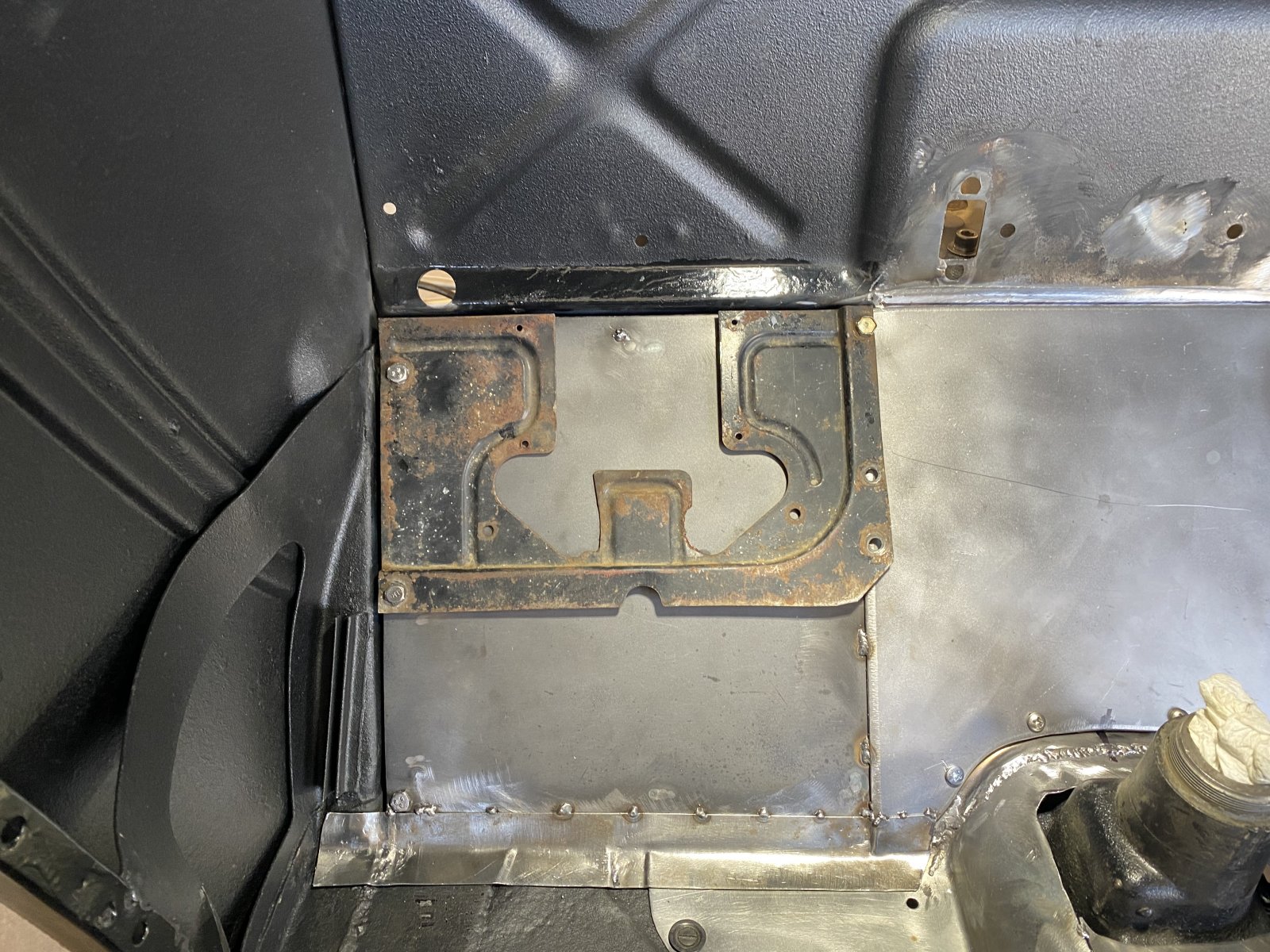

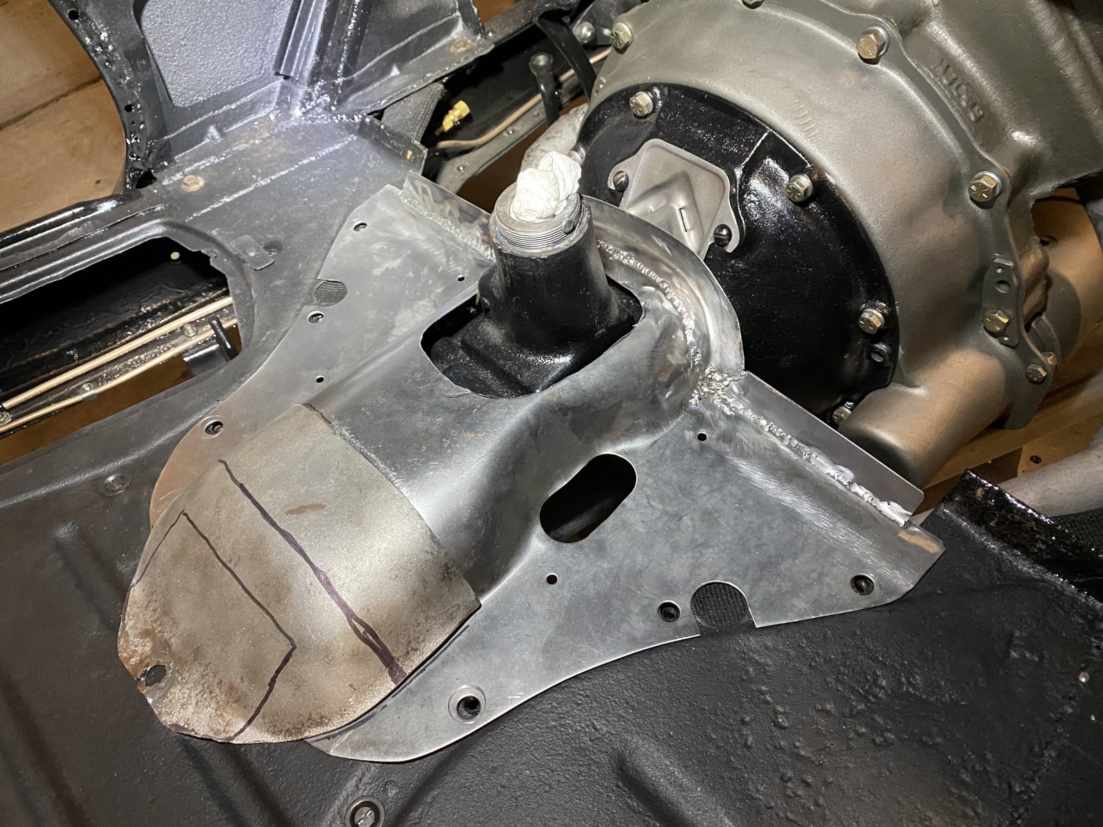

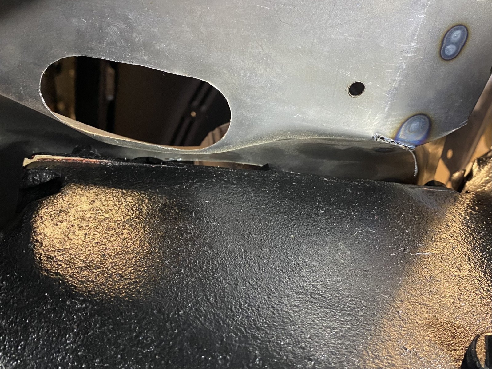

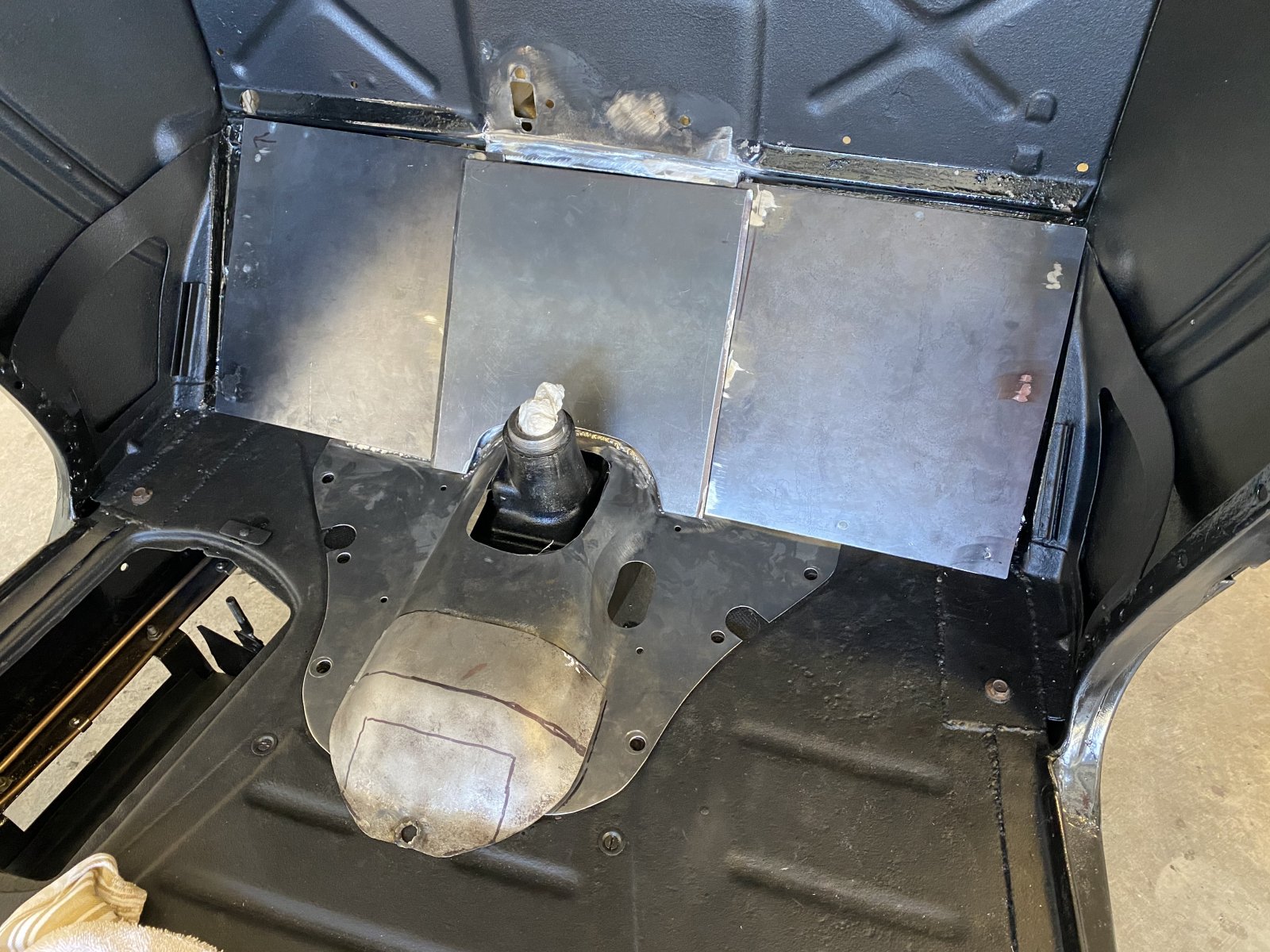

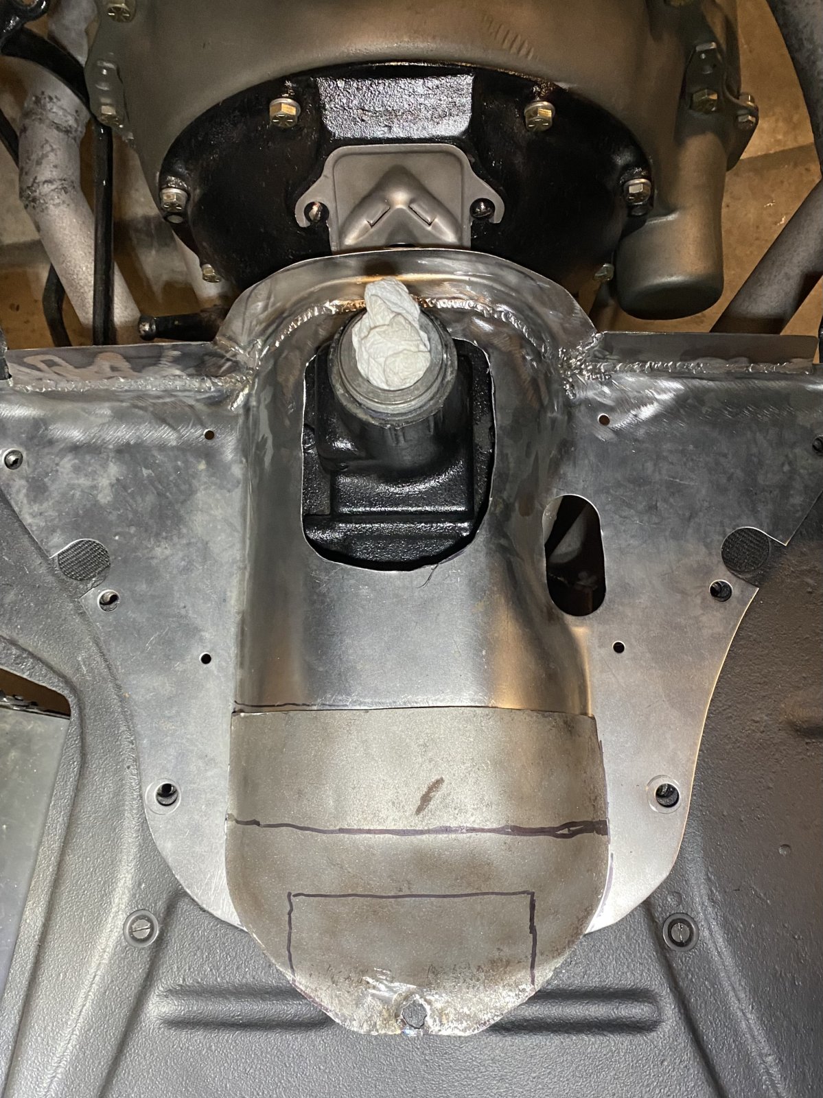

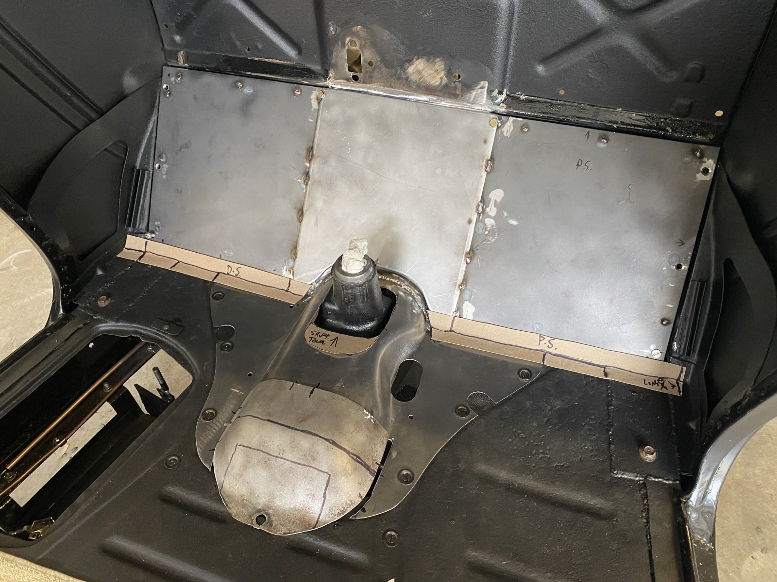

    FA4123F3-A578-41E0-9D6F-2D22F1DF8930.jpeg Got the ****** cover pretty much Dialed in and started the 1/2 tube frame to make up the thickness of the old wood flooring.
    I also cut, an Re welded the lip, further back and up!
    ALOT more clearance! And strength!
    Just need to cut and weld on the extension to cover that opening for the driveline/ ****** D4CA1726-DDE9-4E78-829F-4D3FBABD43CF.jpeg 44734905-2810-44B1-B6AB-D27491664933.jpeg CA932012-9C3D-48C1-8500-5F170AB2347B.jpeg DD62D01F-6862-4F2B-99C9-F96919076D78.jpeg FC3F234C-DC7E-4BE5-BAA3-286333326607.jpeg 5FF75728-D3DE-473F-B7D1-88E449AAB75D.jpeg C245D0CB-D4F3-4429-8296-D844165A03BD.jpeg ED31633B-0E2C-4301-A6F0-C3FAAF9E6D41.jpeg

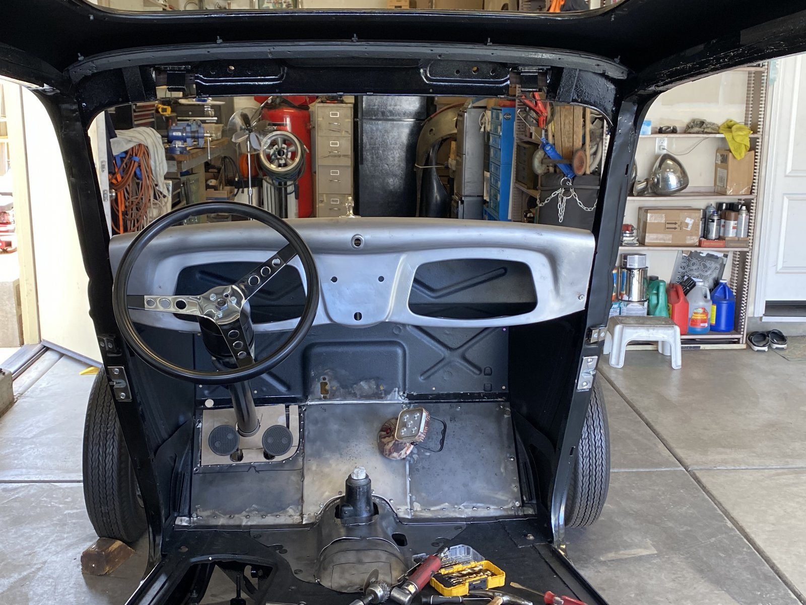

  4. 33Doll
    Joined: Sep 27, 2019
    Posts: 1,590

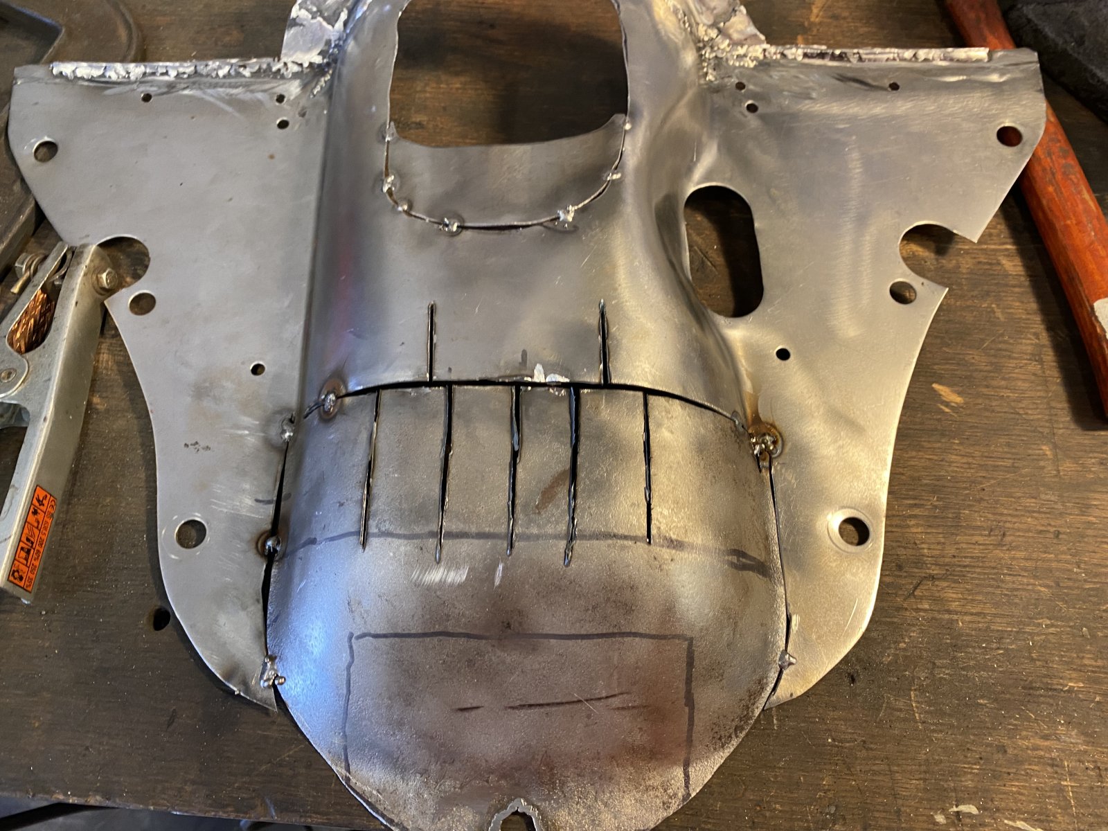

    33Doll

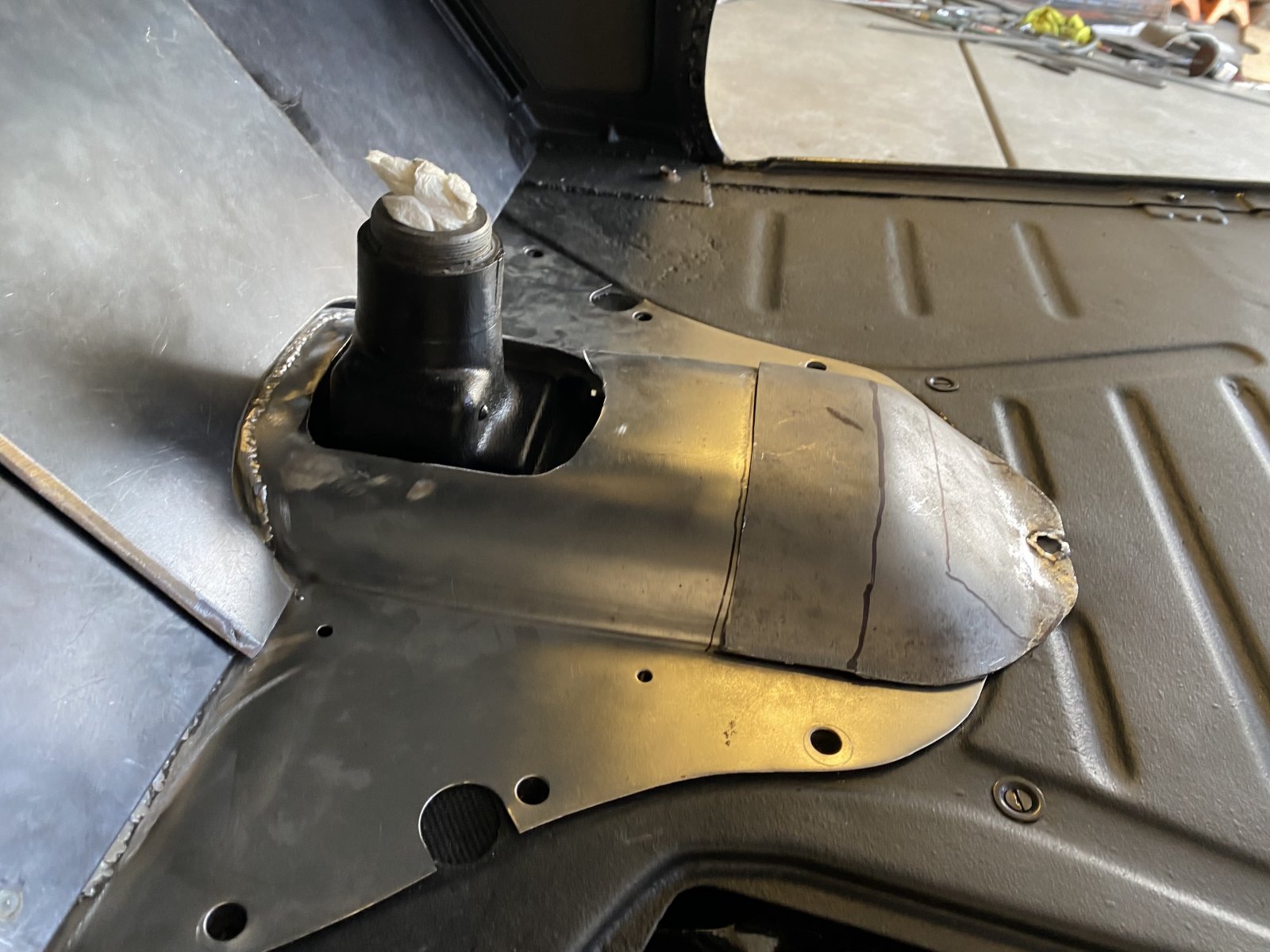

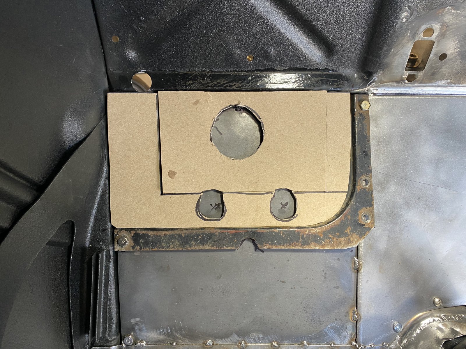

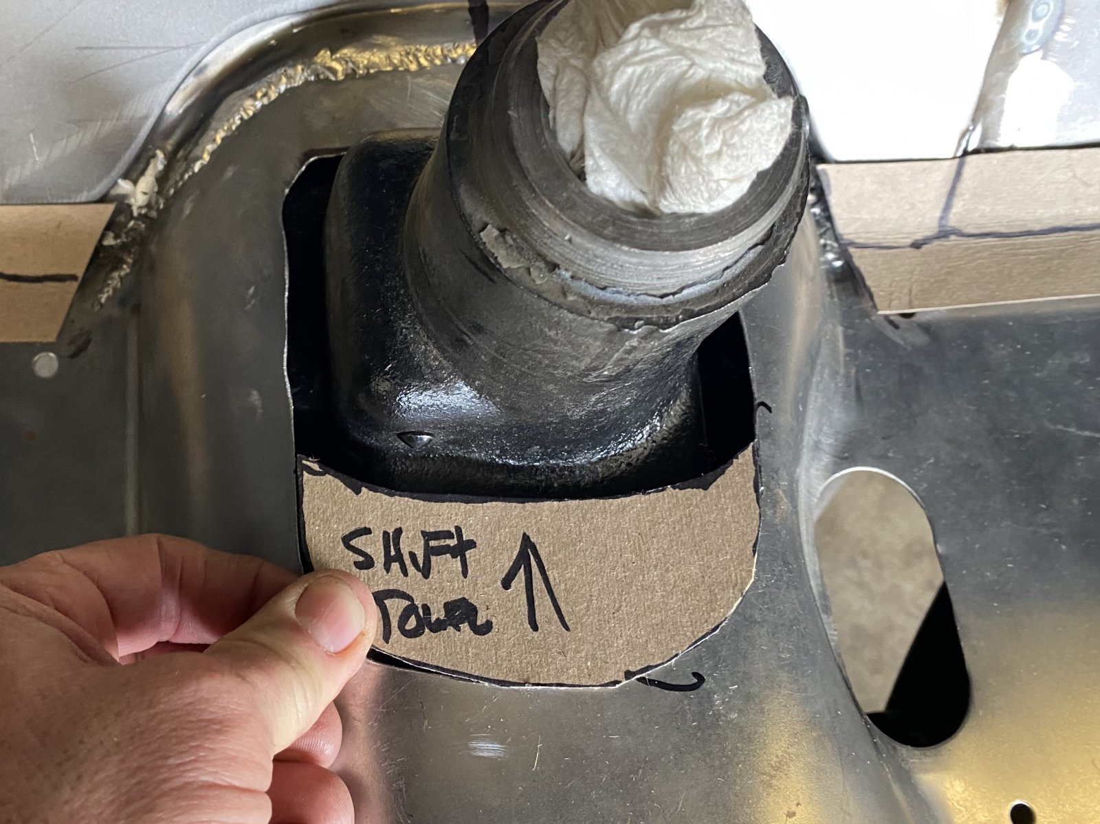

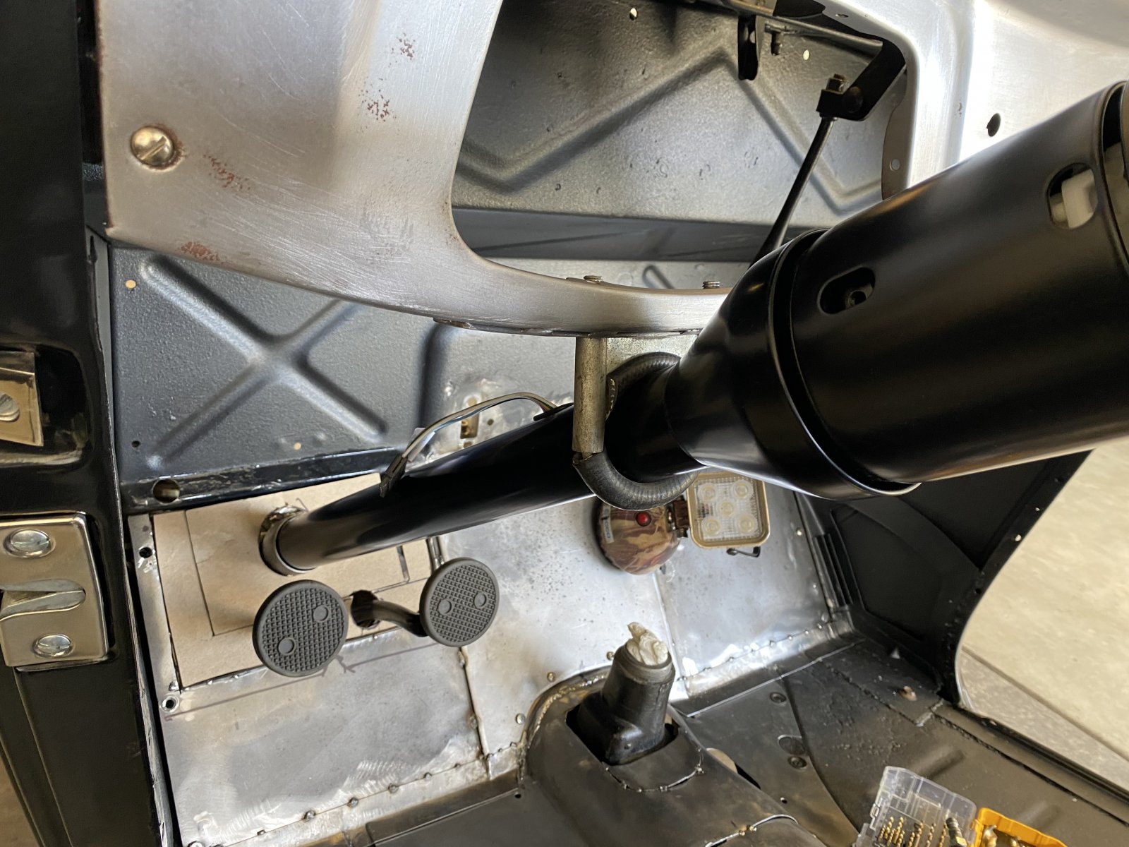

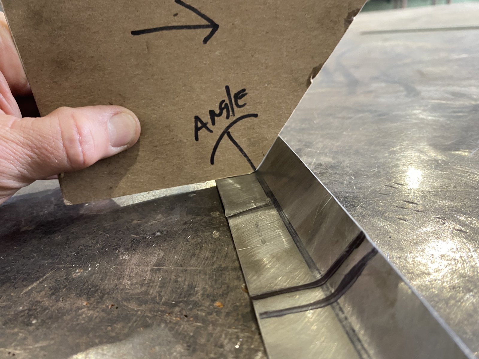

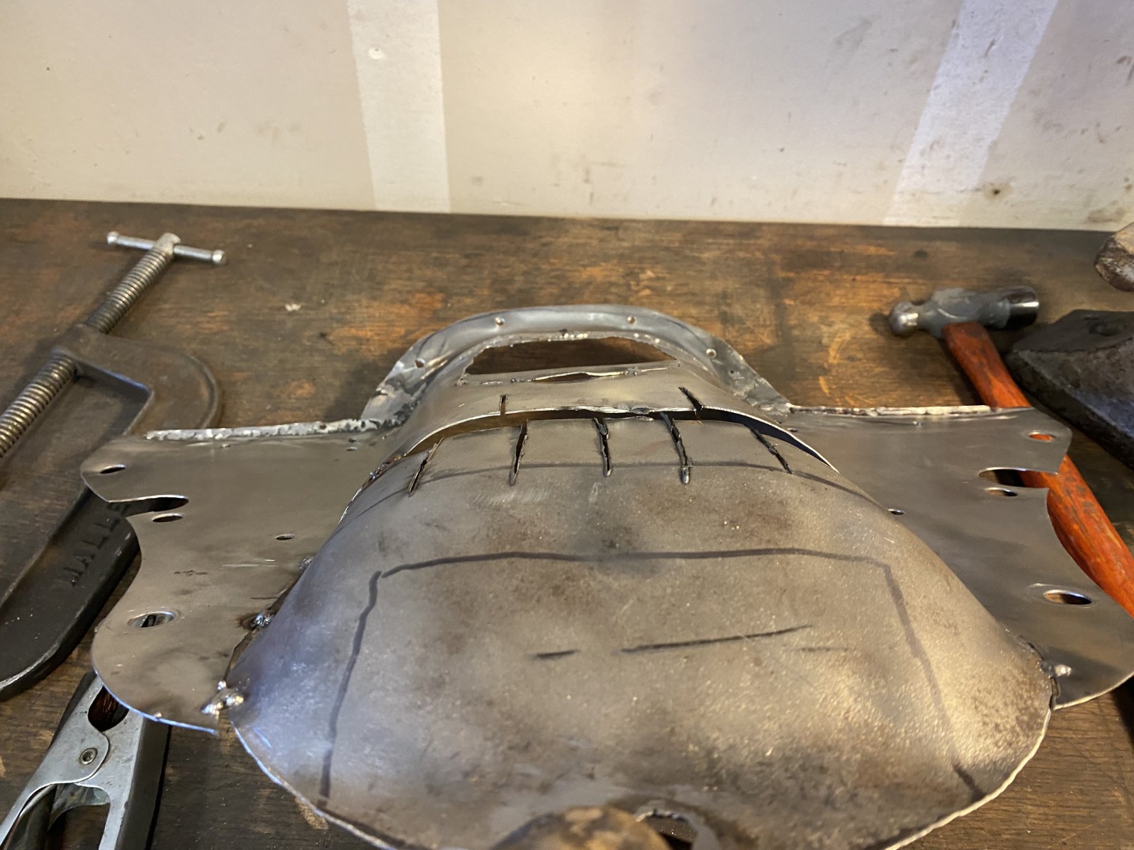

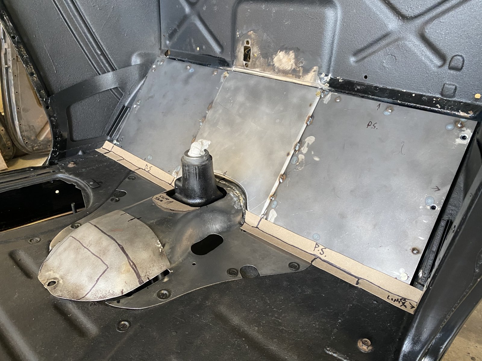

    02DFA861-5CD2-4564-BF7A-53ECB7041F86.jpeg AEF2656F-F907-476B-8DFD-0DCA6DB2553E.jpeg 6FC01E9F-FBD9-43BF-8DBB-087491E42650.jpeg 640F4768-856E-4198-9DDA-BE63C35D42BB.jpeg 9DF473C7-112A-4BD8-9064-0832D744F83A.jpeg 39302BAE-9CE5-470C-B9F4-996FD3699BE2.jpeg 505BDEC0-E41A-4AE4-8252-FA73AA1C3D13.jpeg E80D92A0-4BA8-49FD-BE97-98F8FA4335F6.jpeg ACA0FEFC-B72D-4367-BD8E-0BD1060F77F8.jpeg 760E898B-7ADE-43A5-9090-46D9BF82101C.jpeg 2D77788A-8C8A-4B56-BC2E-A034EBEE06BA.jpeg More Floor Done.

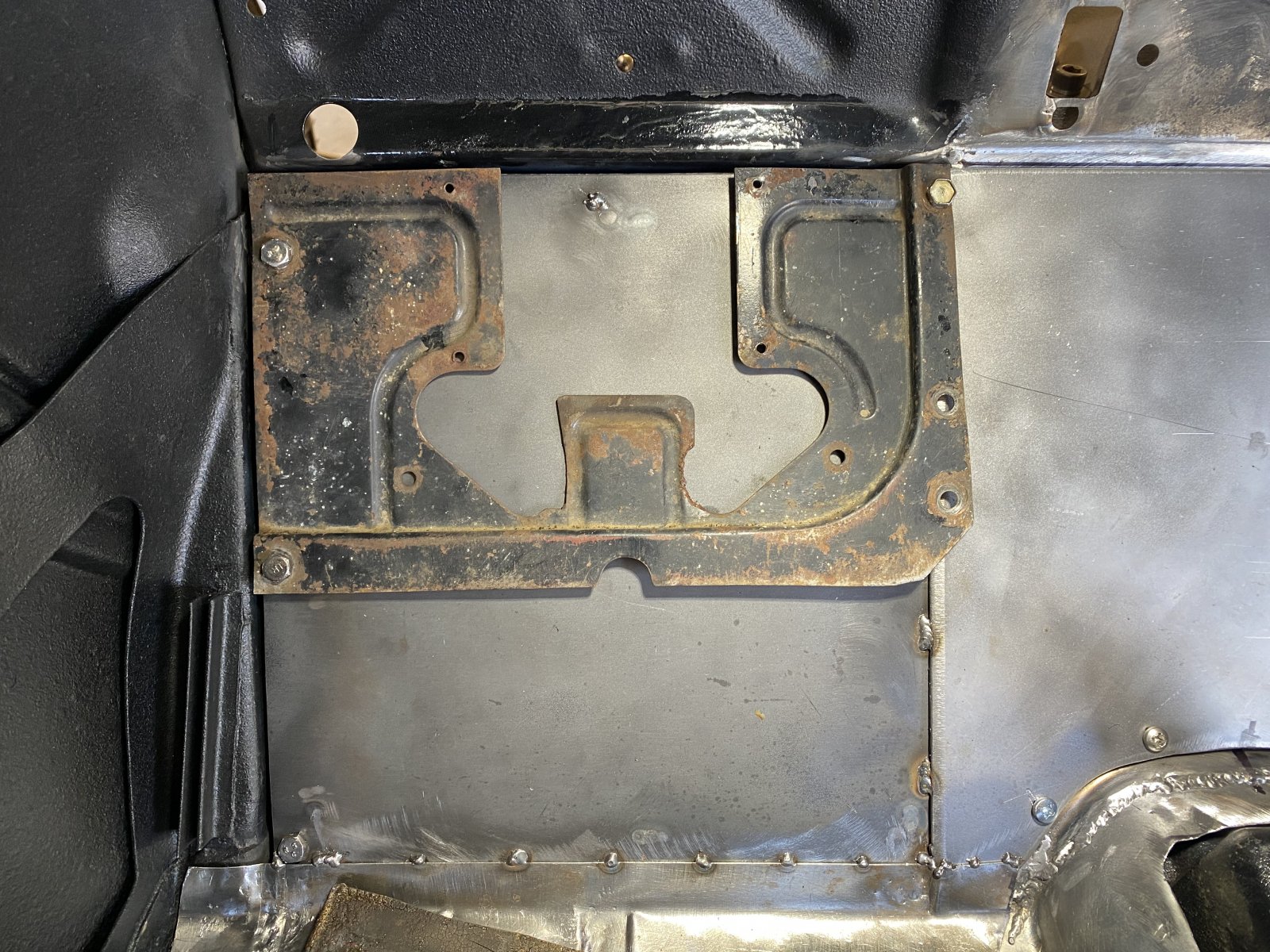

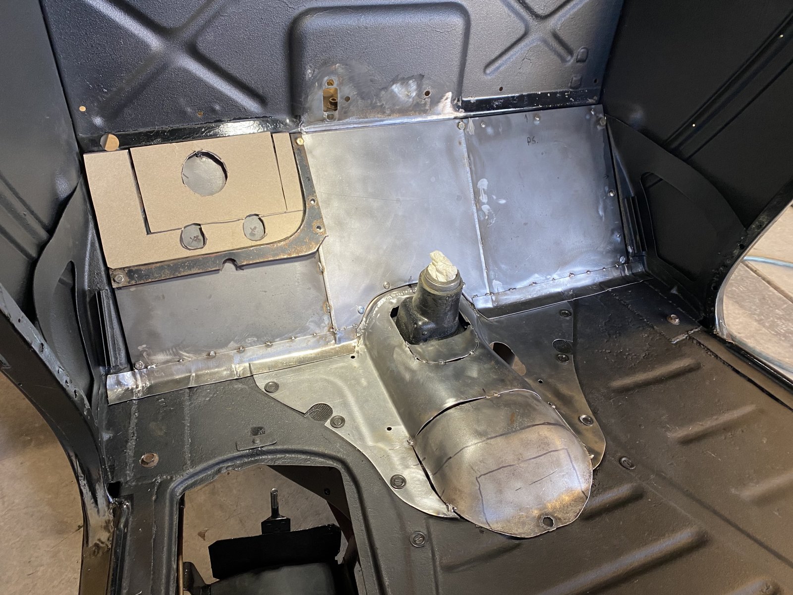

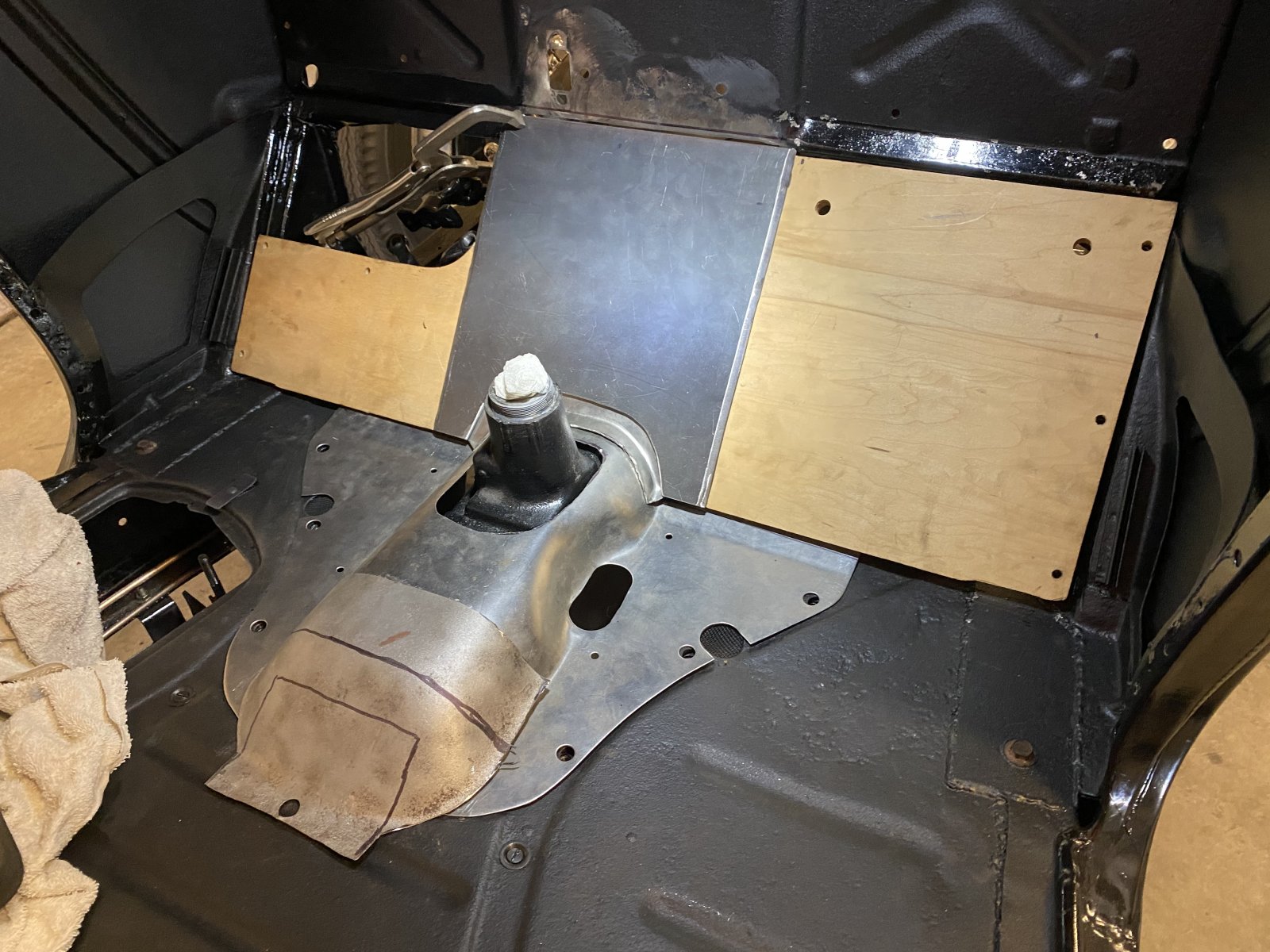

    All the angles and math on the floor is killing me!!!

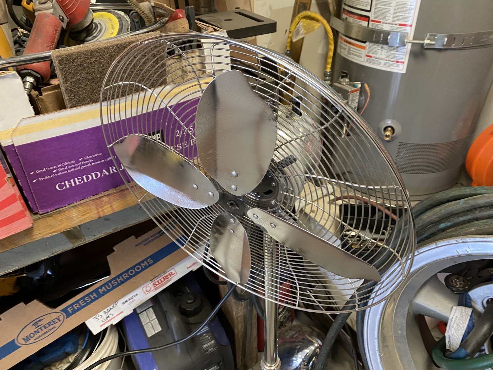

    I think I got it figured out now, I have to make some support pieces to beef up the bottom where your feet go on the edges and also seals it up from the wind!

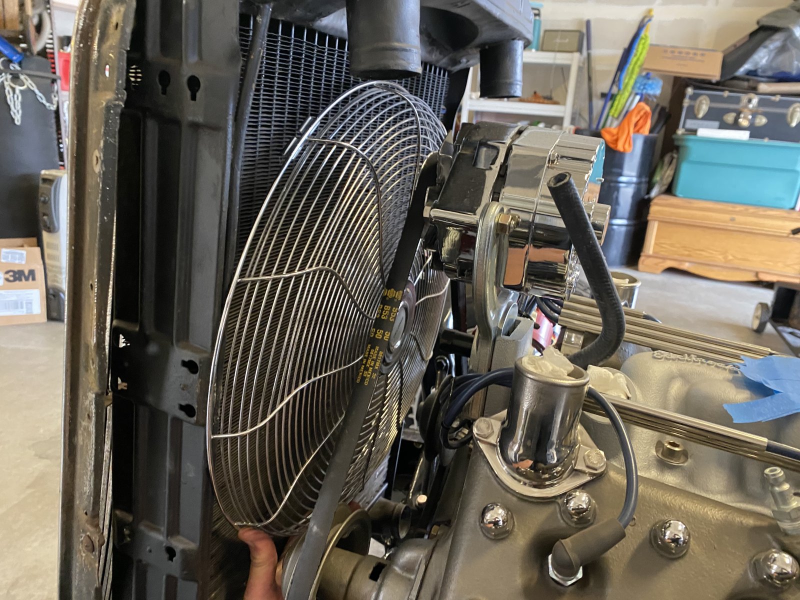

    And I took apart my garage fan to use as a visual aid to what size fan I can use this one's a 17 and doesn't fit so I think I can use a 15 maybe a real small 16 but it has to be ultra thin!!!!
    Also Debating just making a new section for the pedals, and Steering column… or cleaning up, and adding new top pieces to the original recessed piece. And grafting it in to my new metal floor?
    (The cover pieces have to be split horizontally to go around the pedals.)
    And sit down flush in the recess.
    I think I will do that.
    Dunno… we shall see.
    Stogy and Jim Bouchard like this.

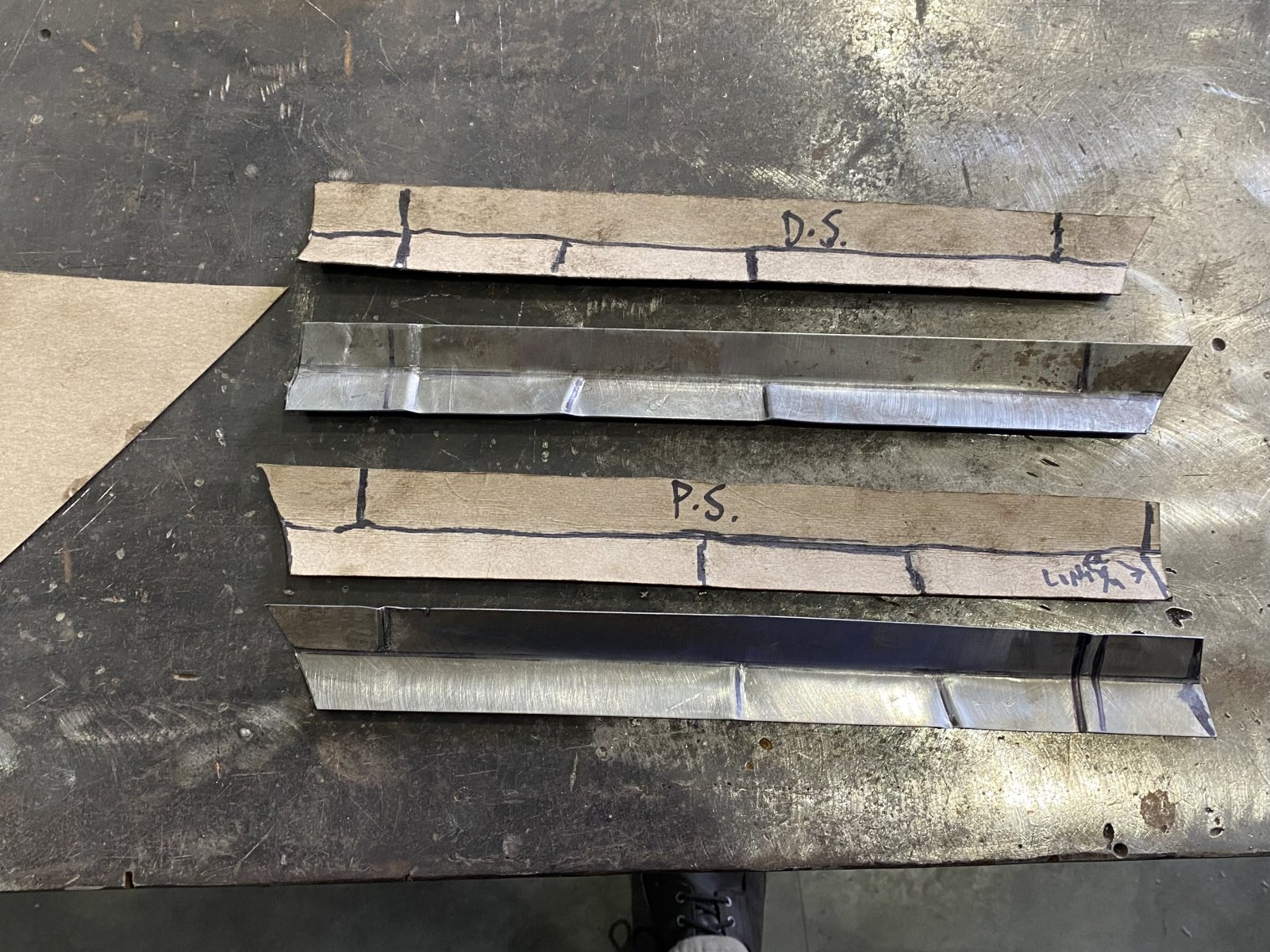

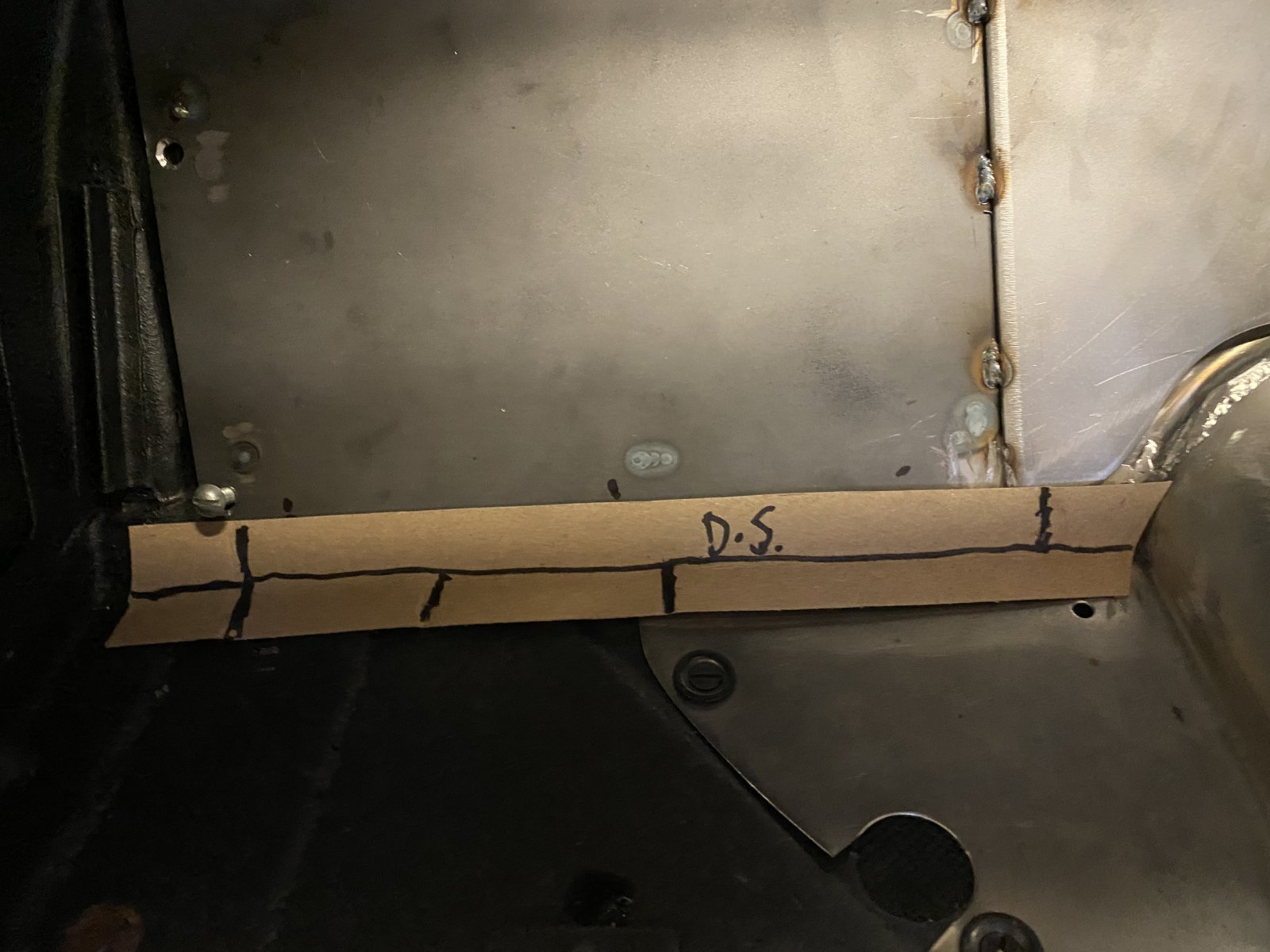

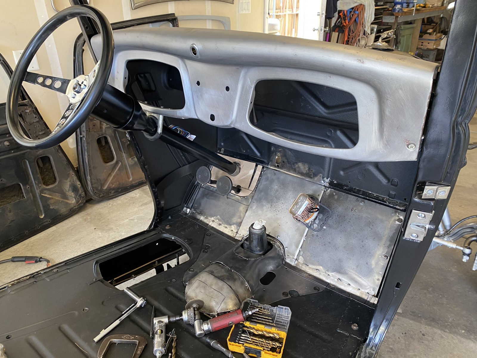

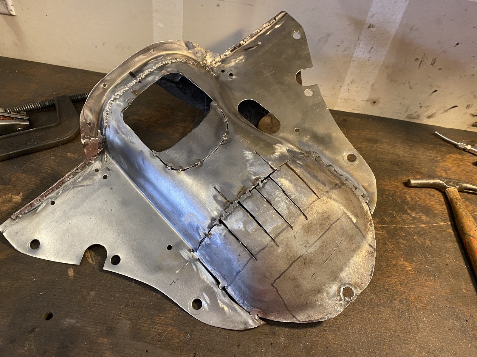

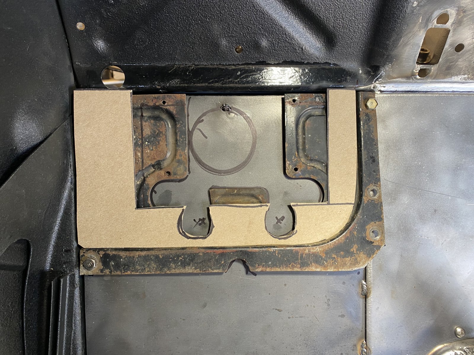

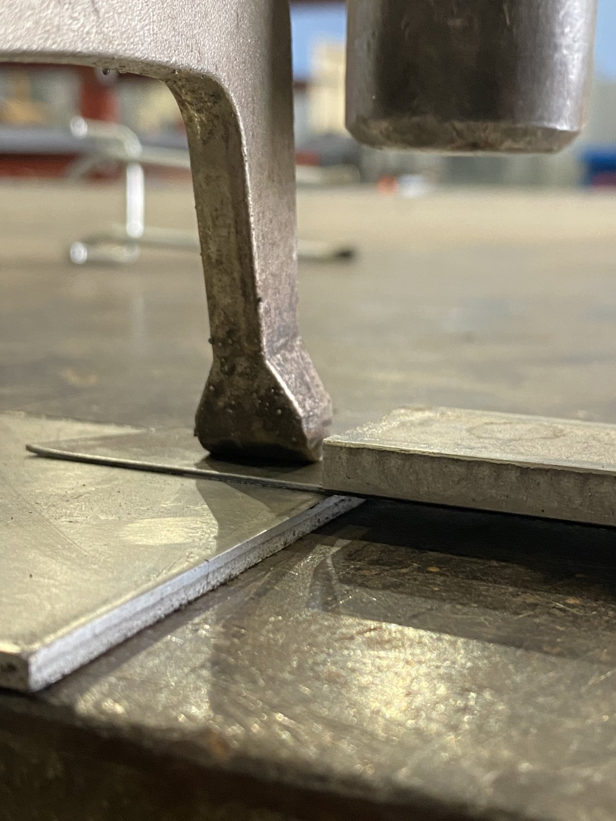

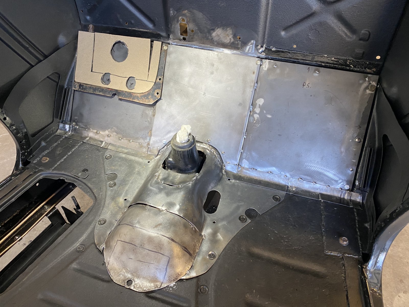

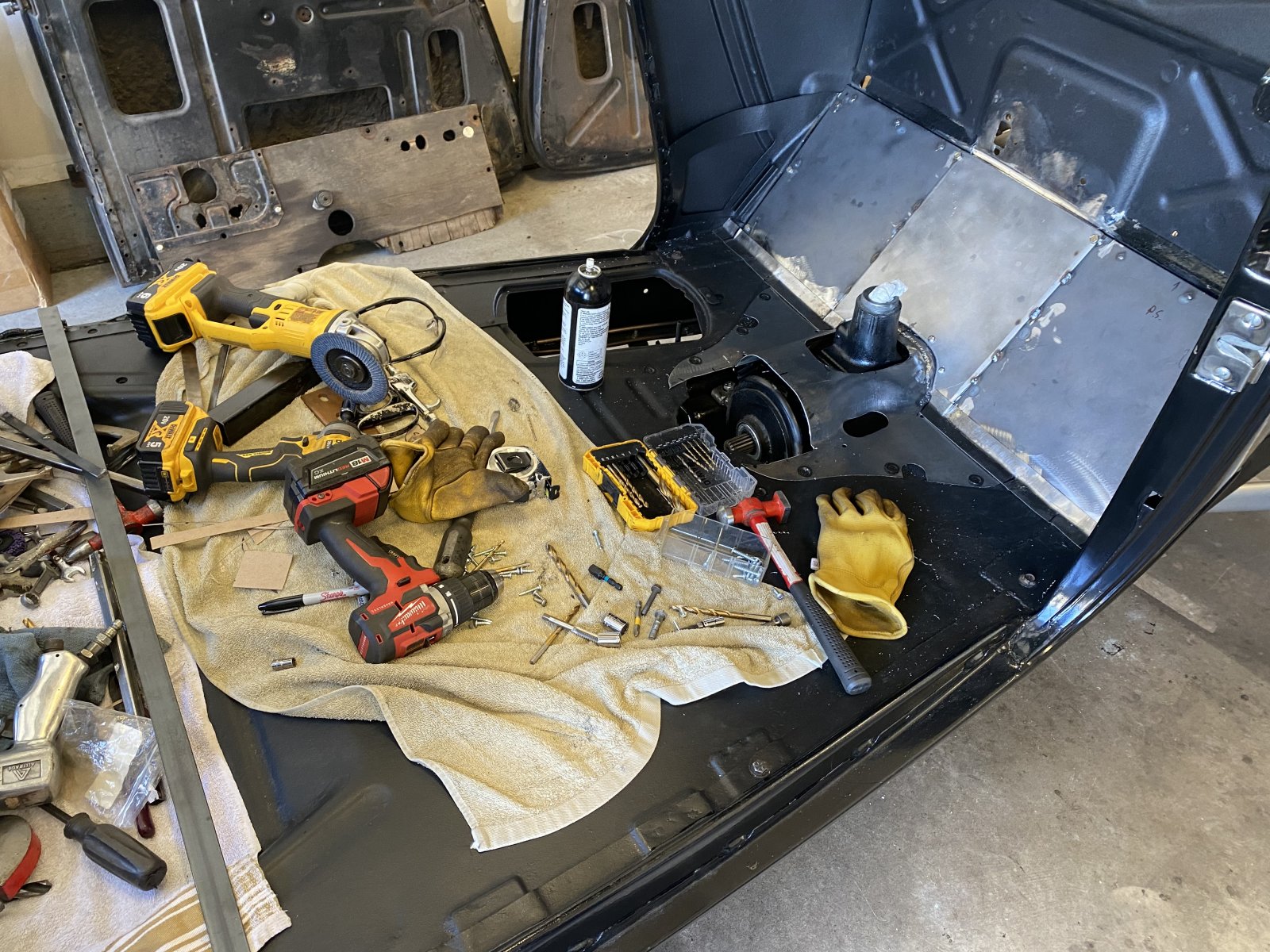

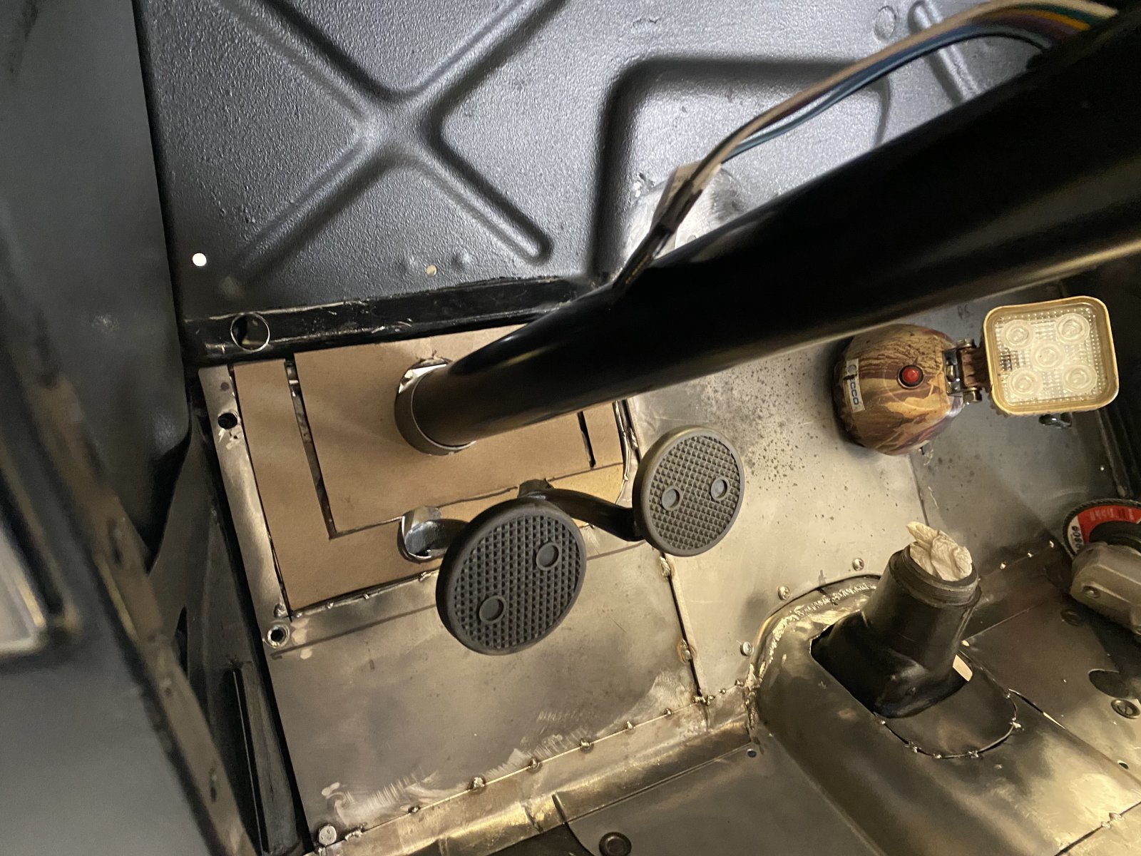

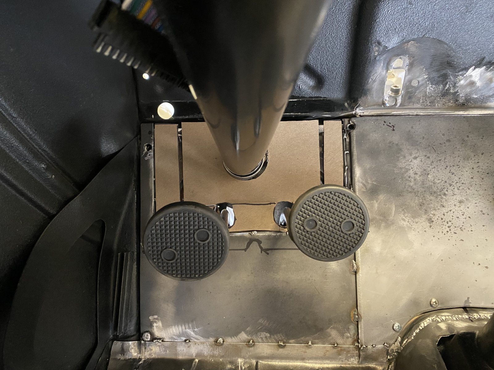

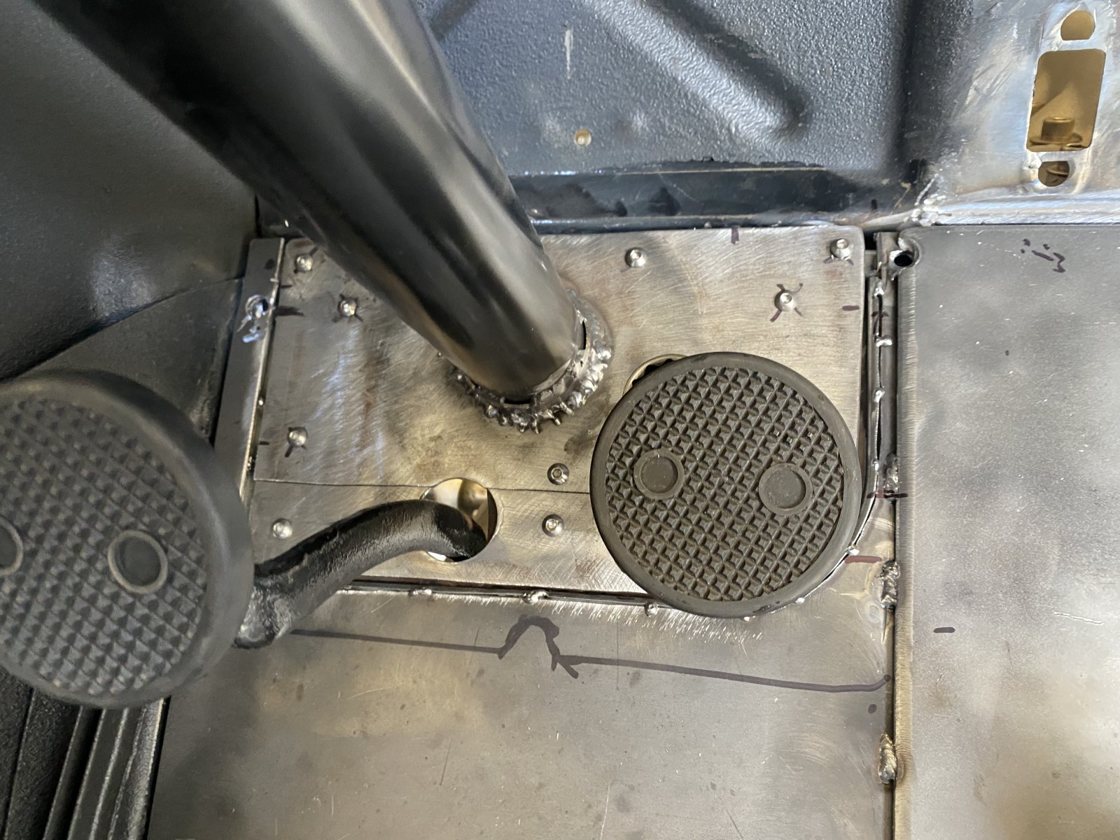

    C4C18FF7-D2CF-4146-9B20-1A8745B9BABC.jpeg No Bead roller…. No Problem!
    Some s**** metal… vice grips… and a Hammer….
    My own mini stamping press.
    Gonna use some nut-serts and Tie in the floor… to the toe board.
    I could weld all the stuff but I want the Floor to be removable like the original wood floor makes it a lot easier to get to the back of the ******, the starter and all that stuff!
    I probably will seal it with some kind of rubber/foam seal and, seal it with some black marine stuff once I’m done and getting it running and all that.
    I can always cut it with a razor blade and reseal it if I need to get to the engine on the back.

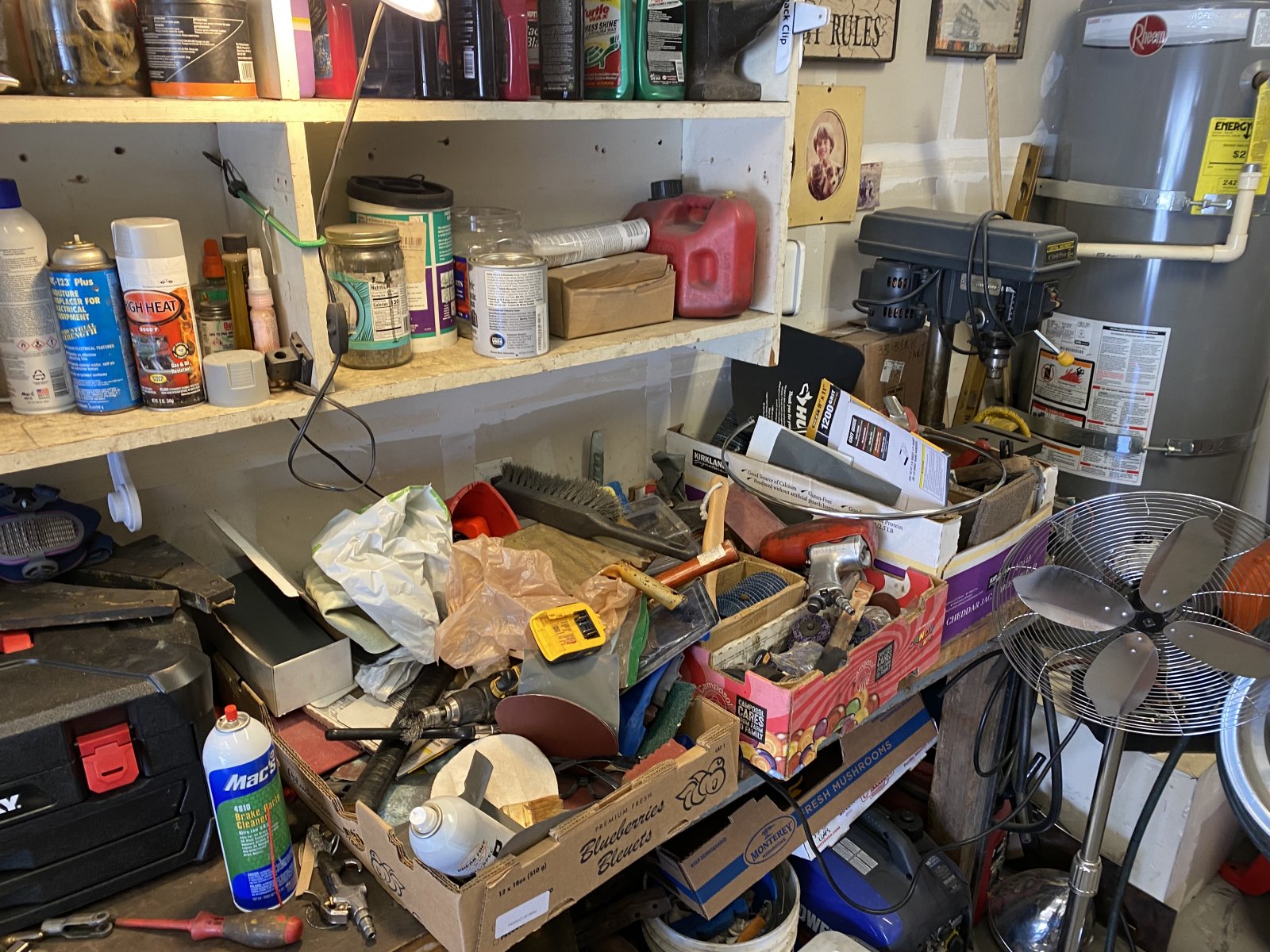

  6. 33Doll
    Posts: 1,590
    33Doll

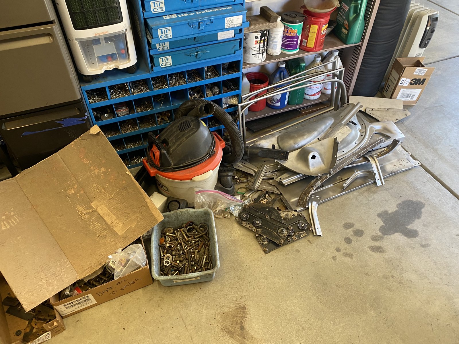

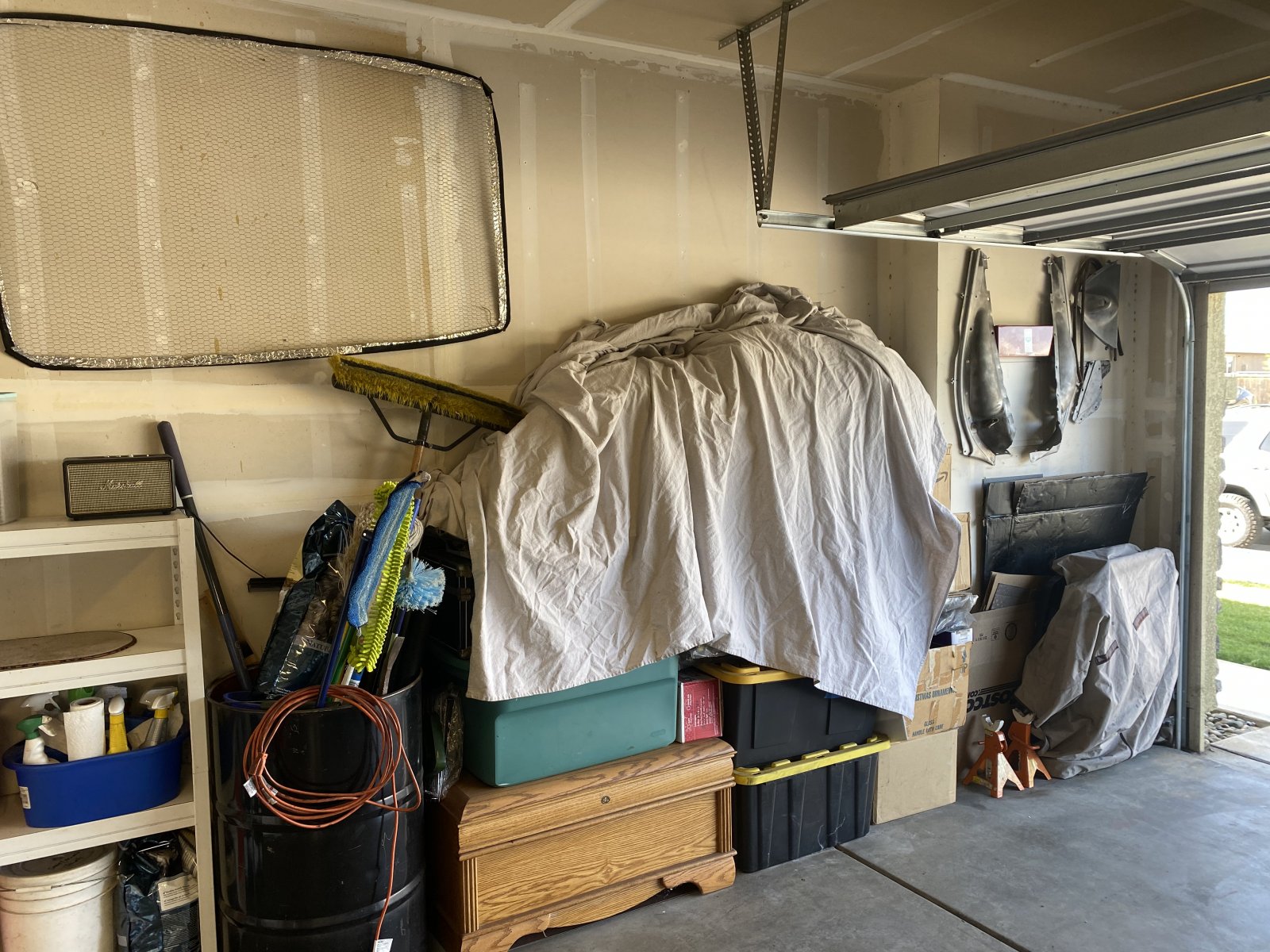

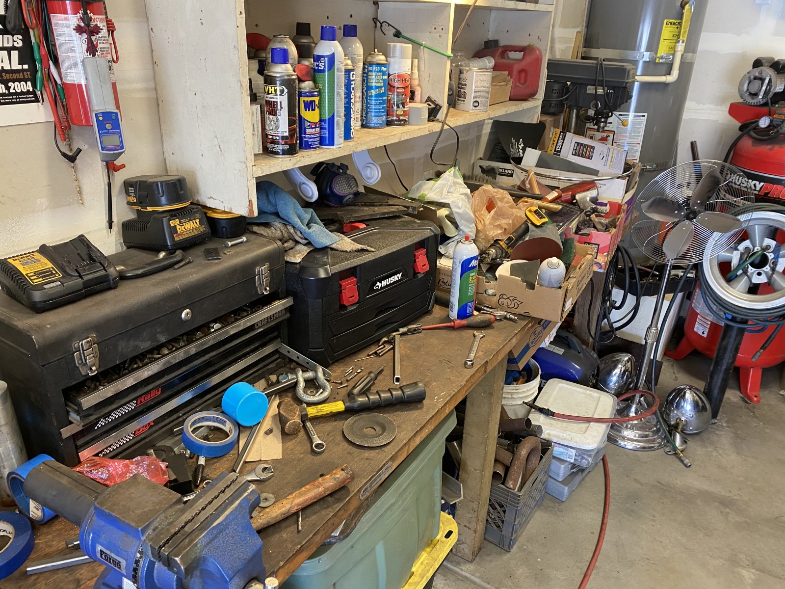

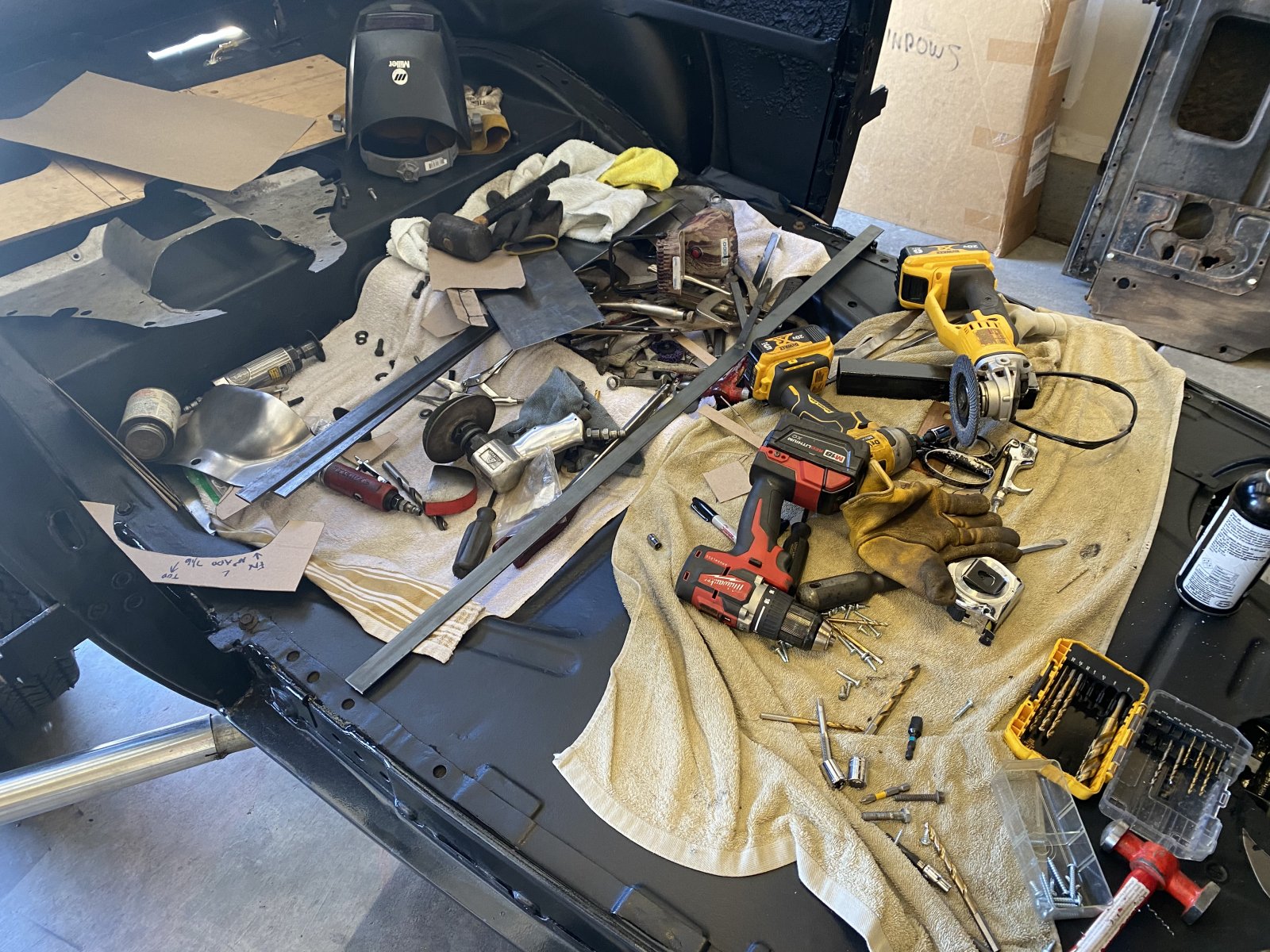

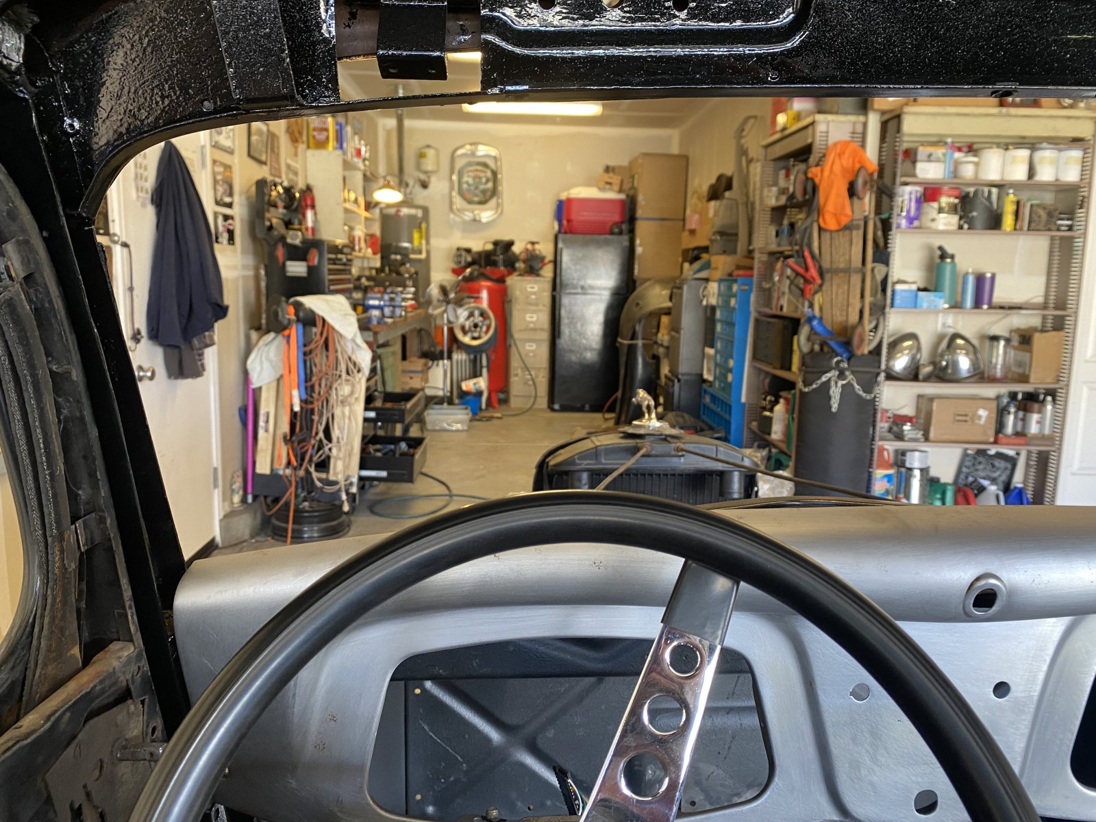

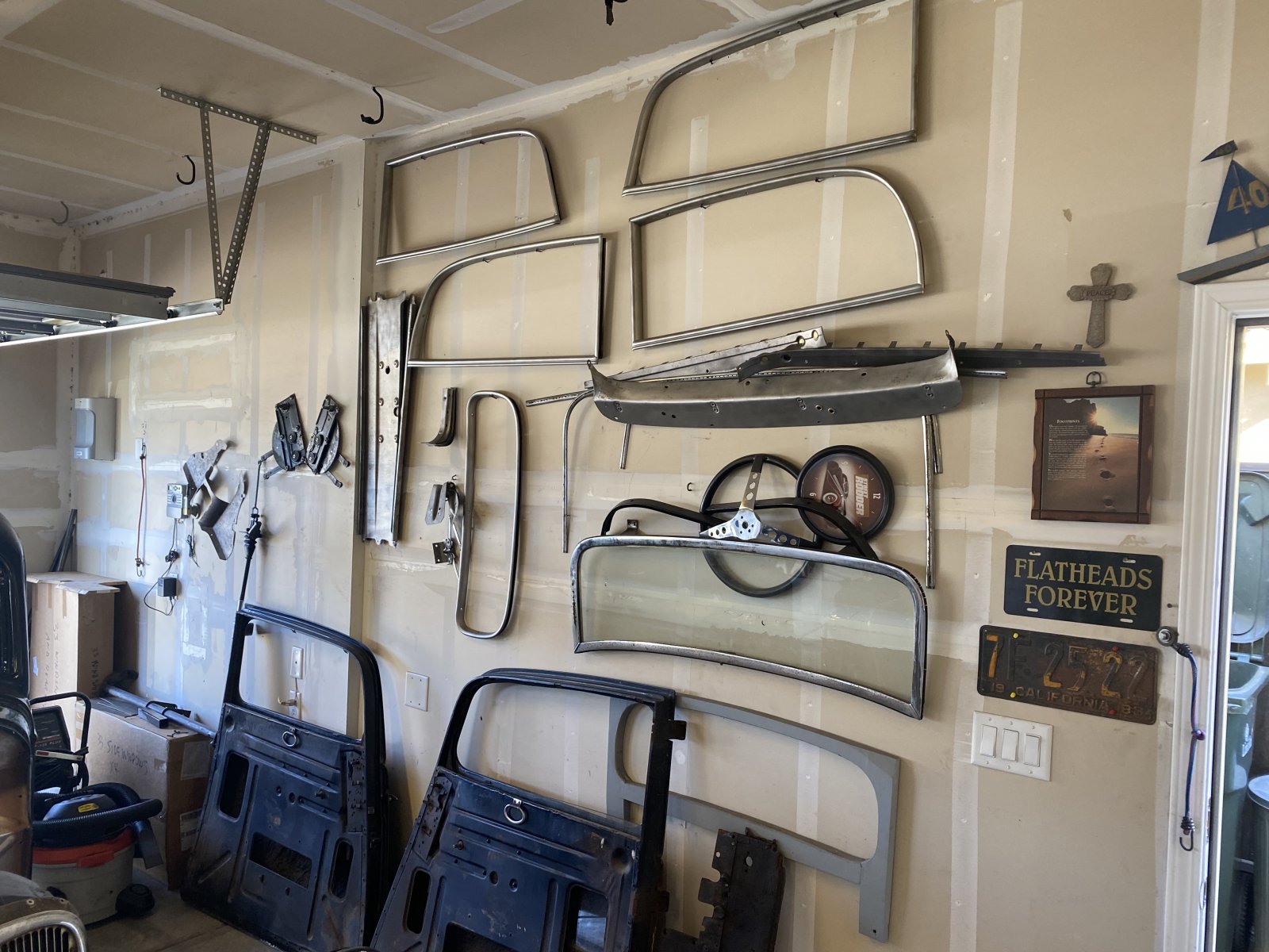

    482168E2-4183-4D20-96FA-B87EBB05C7CC.jpeg 7AC3FCB1-EA87-4F92-9C36-7CB94F3C398E.jpeg 19AC3C85-DEB4-4737-A144-8E5B954077D8.jpeg 88997E6F-D615-4A7A-8897-58AC5C5CD0E4.jpeg 53784AD8-49EF-421B-ACD6-06D12A0CEAF2.jpeg Floor is fitting good!
    But how does this happen so fast I swear just piles up without me even knowing it the whole garage ends up inside the car!!!
    And I can’t get to my workbench!!!
    Geez I hate stopping to clean!!!
    But now I can’t find ****!!!

    I still haven't bounced back from my last garage Thrash...I hear you...Every time I try to organize all hell brakes loose...I think I need something from ACME...the box with a T Handle...:D
    The floor looks awesome...

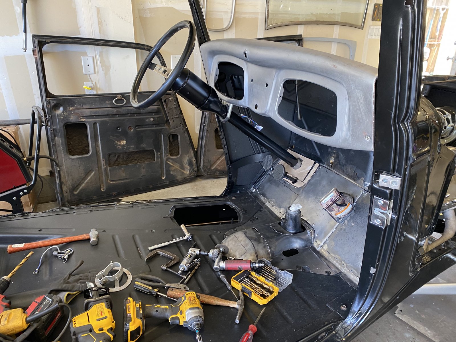

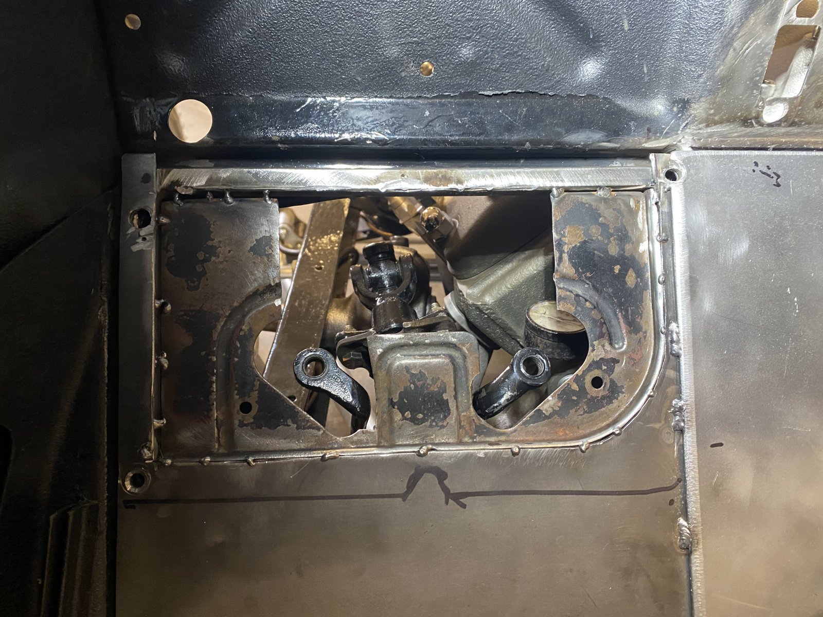

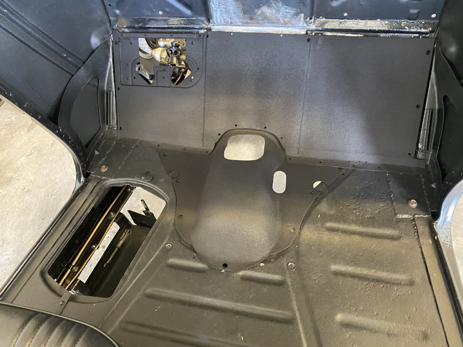

    10257220-7041-4F6E-82FE-A41F97531E74.jpeg B1AEAF2A-9E98-48CB-ABFA-B28C16D381CB.jpeg CB708AAF-222F-4809-A8FC-40E1B5402639.jpeg 65ECEC50-6E50-42D7-A4EC-C2781093FD9A.jpeg 5EB2AAB0-7615-49DE-B329-FC16A01268AA.jpeg FBEF7C0A-1FCE-49DF-982E-174C2C0AA82A.jpeg 70D97F36-0E27-4600-A8D8-277D07D1C96D.jpeg DB244AD9-72E4-45D1-8A19-822CB536FDB5.jpeg
    Thanks!

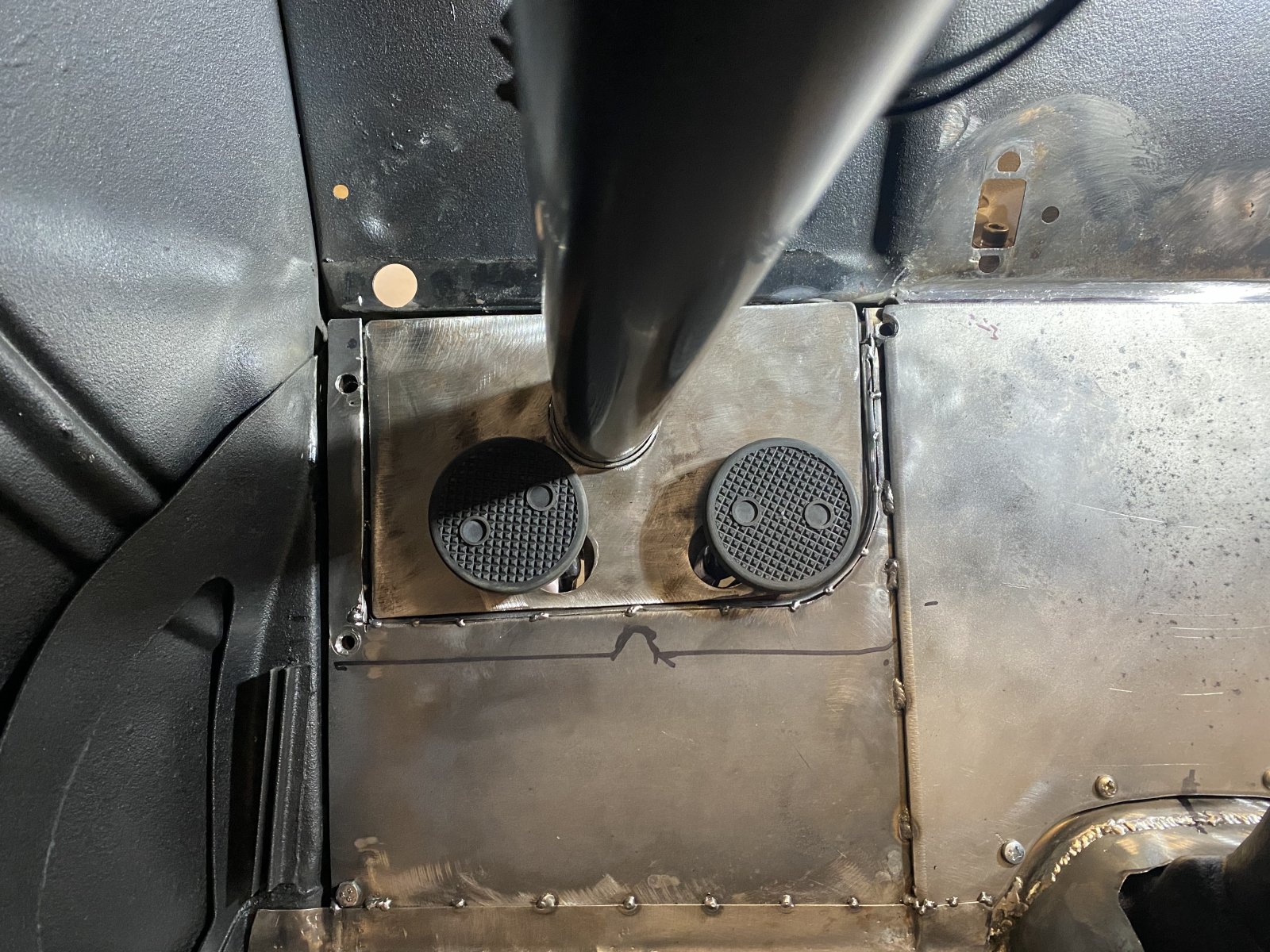

    Plugging away! Got the car cleaned out…the garage…. Not so much!

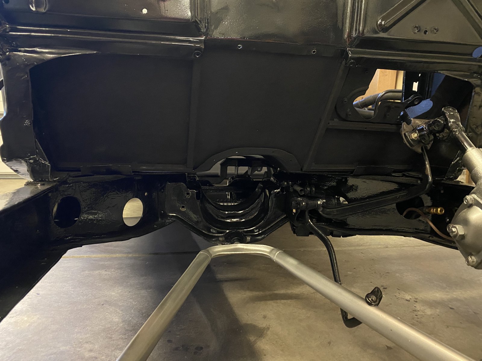

    Floor will be done soon! Everything is fabbed and tacked! Just need to trim the original Pedal piece, and graft it flush in the new metal…. Then the card board templates is the filler, and column mount , I will be temporarily installing My IDidit column for fitting.
    Getting Excited!!!

    That's one of those areas where sealing is difficult, pedals through the floor...I'm surprised no one has made a rubber bellow/boot over the felt or brush that's standard in those applications...one advantage hanging pedals have over Henry's early 30s finest...

    Yeah…
    I am going to seal it up good!
    Put some dense foam around the pedal arms, like the 40 up Furds

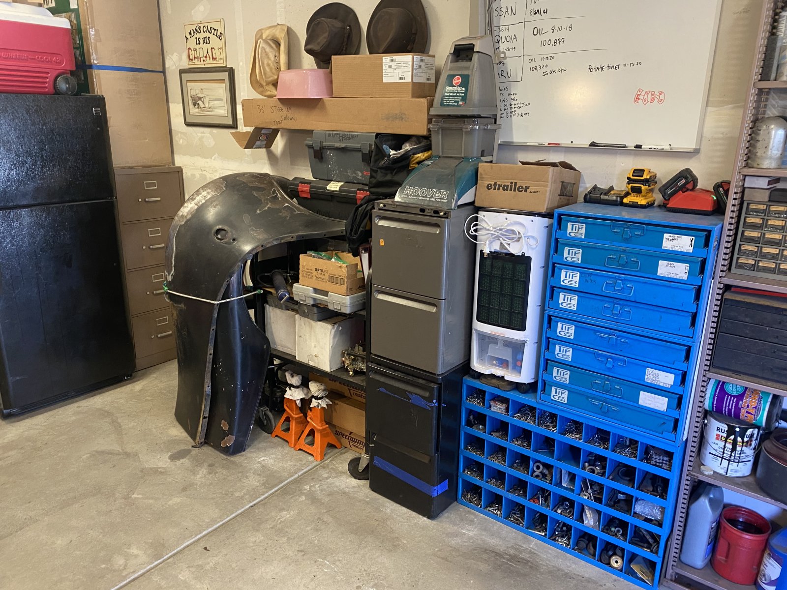

  11. 33Doll
    Posts: 1,590
    33Doll

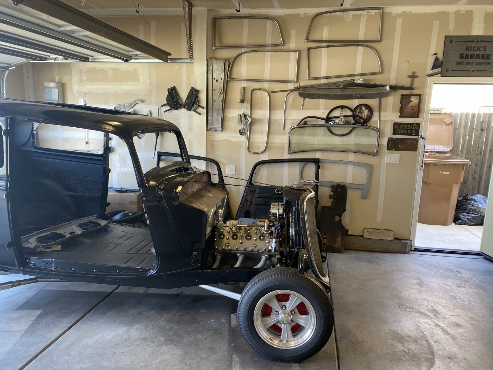

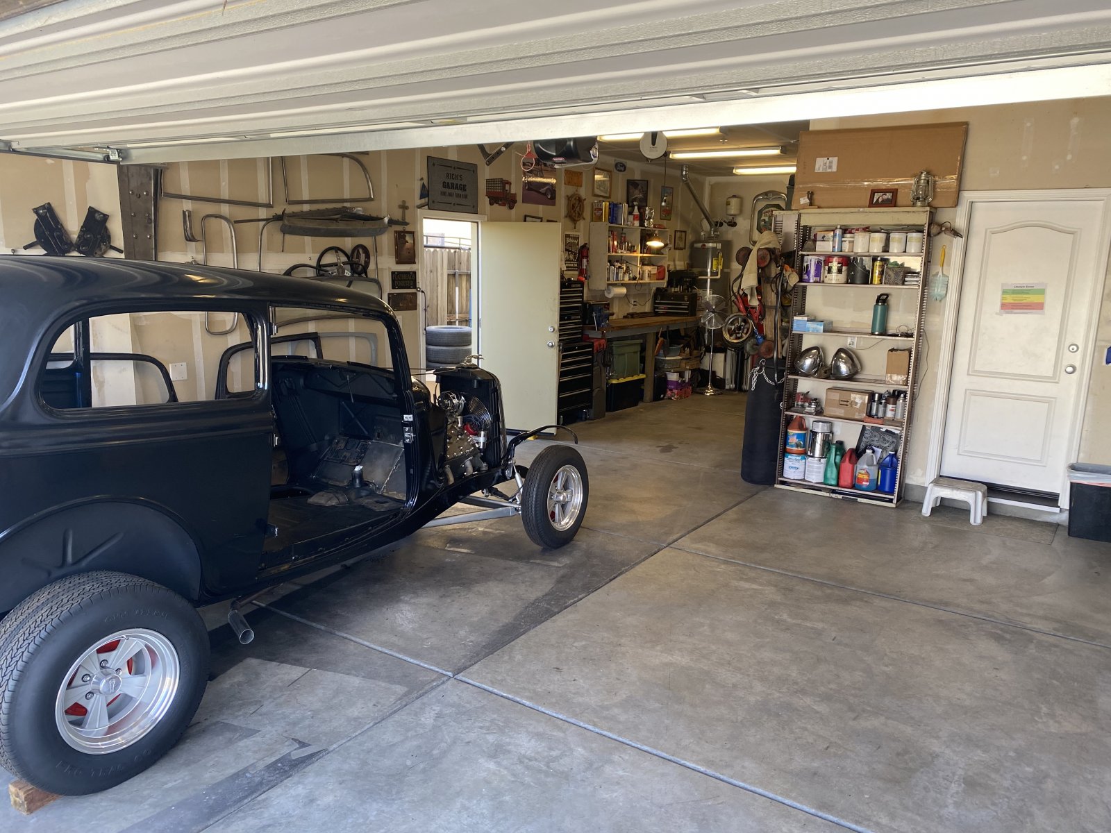

    9559FF2A-61EA-4618-B944-B80AF2E78027.jpeg 464FDE3C-90B5-4AA0-B0BF-935C34E3A8DF.jpeg 6A5D30F6-191A-40B7-83D5-57C042B7B140.jpeg 754B1252-39DD-4594-A9B9-88DECAE03CCA.jpeg 5CC66E4F-1CD6-4BCA-9AC8-5CE9DC7D467B.jpeg 1A4B04FC-8FE5-4498-92F8-723AB6D5BD07.jpeg
    Well… No work done on the 33 this weekend but I got the garage cleaned and organized for the next round of business!!!

    After working full time and still playing with cars my work area shrunk. After retiring I decided to "clean" the shop up. That resulted in a five year project (57 Ranchero) because I found a 351 C tucked away. It needed a new home so the Ranchero project was born.....

    My shop looks like the "before" pics! Wish the weather would clear up long enough to roll out my '32 project and clean up in the shop.
    Yours looks really nice now.

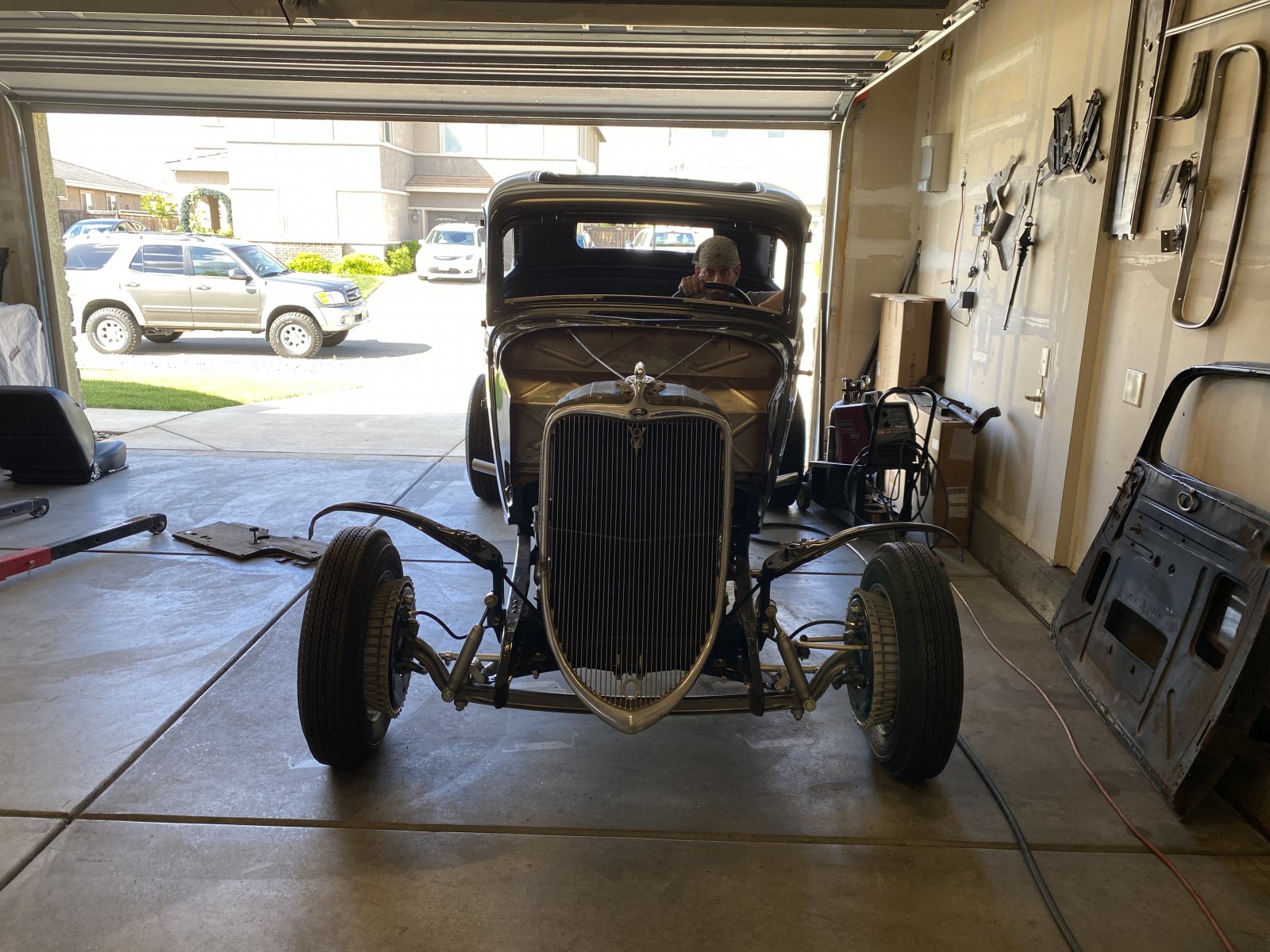

    Getting Somewhere Now!!
    Frankenstein Is Slowly S***ching His Creation Together!
    8D70C2A8-0BFB-4535-9FC4-359379CFAD28.jpeg F87E050D-90F4-4852-B2F6-43B7616E0F34.jpeg 61C3A638-044D-4ED2-8197-7846D01668D9.jpeg BFA3F7DB-904C-4F2D-9267-3AEF66EE5189.jpeg 0C2A6E67-A64D-4BE2-ABB1-B55A6B7EC6E4.jpeg A8583269-8EAF-4A46-86ED-4FCC1E54B1E6.jpeg 01CCD9DC-523B-40C0-B05A-ED561164511B.jpeg D826C9DE-6BB3-45E7-B097-7C8924A4FBBF.jpeg 42A63EE2-4812-471E-9884-0D37A7E55CA7.jpeg EDB8E41B-F998-464E-B66F-CA4FB942D7C0.jpeg 5E7D6F40-2D35-42C8-A17D-B3300B7E3258.jpeg 8A53CC21-5C1D-42C6-ACF4-E7137A78BE87.jpeg F481C313-EBC8-411F-B6DF-FABD939CAF52.jpeg

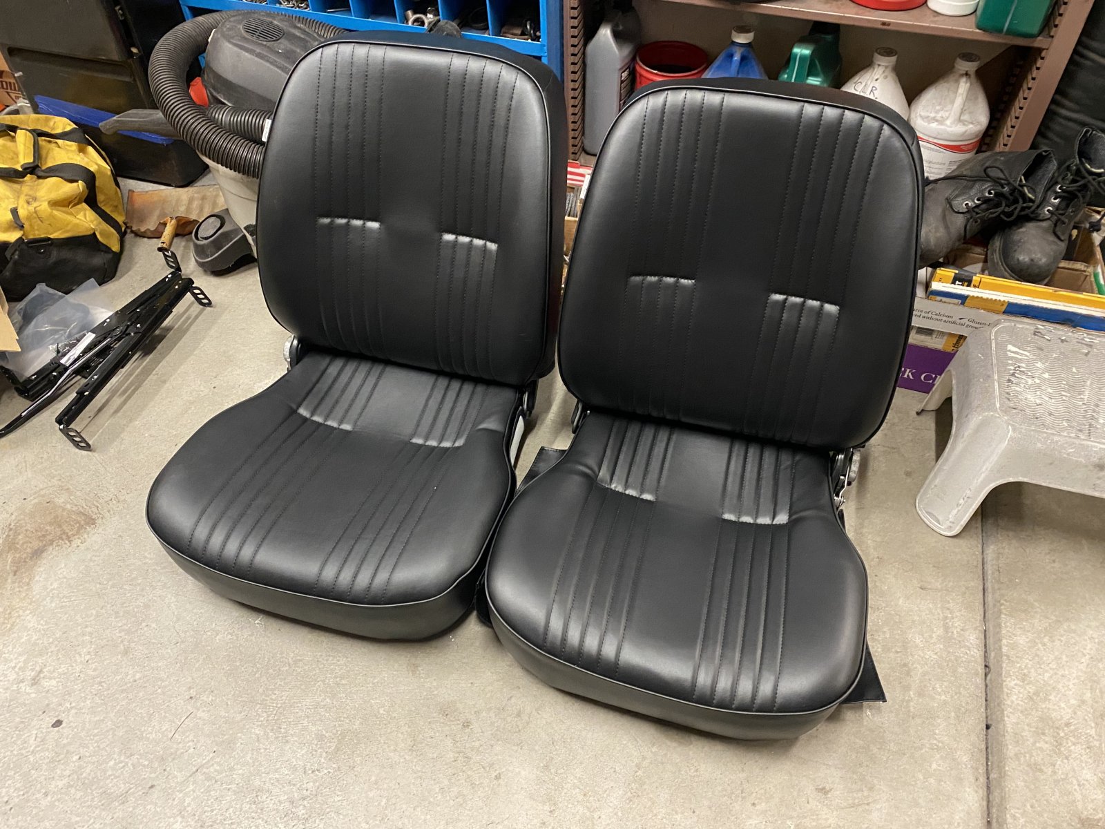

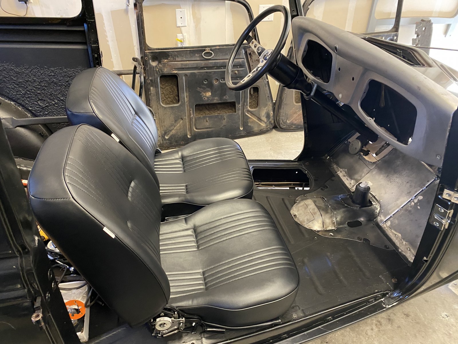

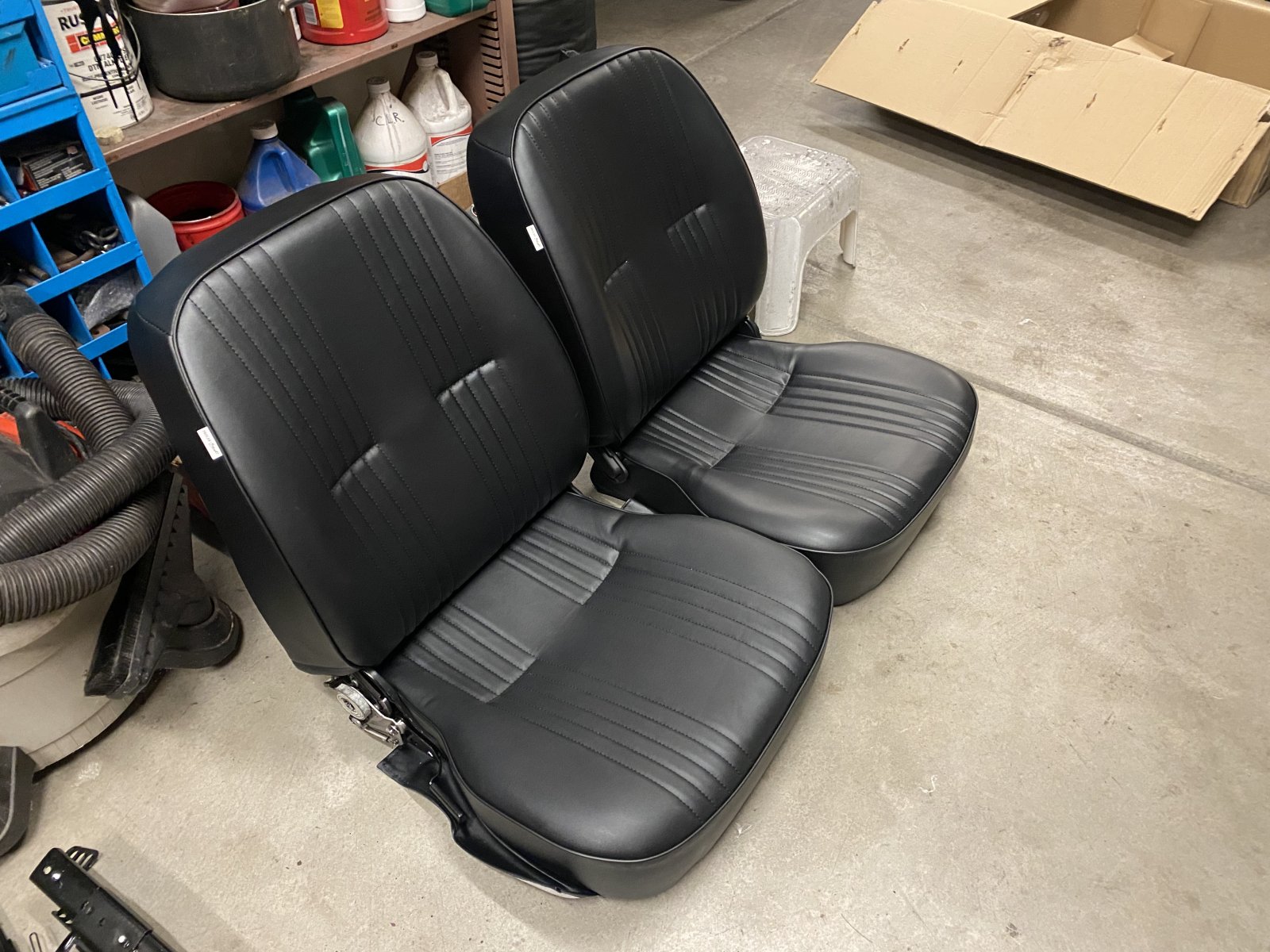

    4B0BDA36-5CBC-4EB1-9F5C-30FFD38BC5BF.jpeg 11B2FE3D-08C5-4B18-93D7-51D2AD7DFD1B.jpeg Seats showed up yay!
    Jeff34, Jim Bouchard, brEad and 3 others like this.

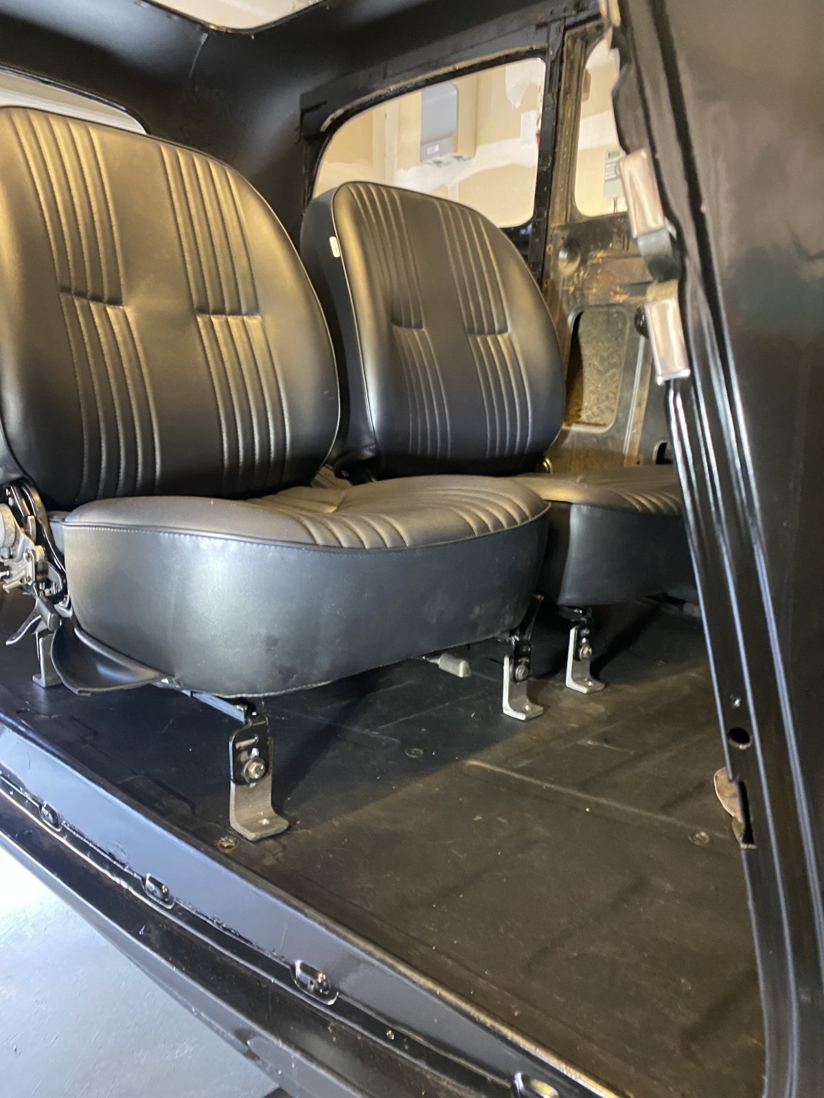

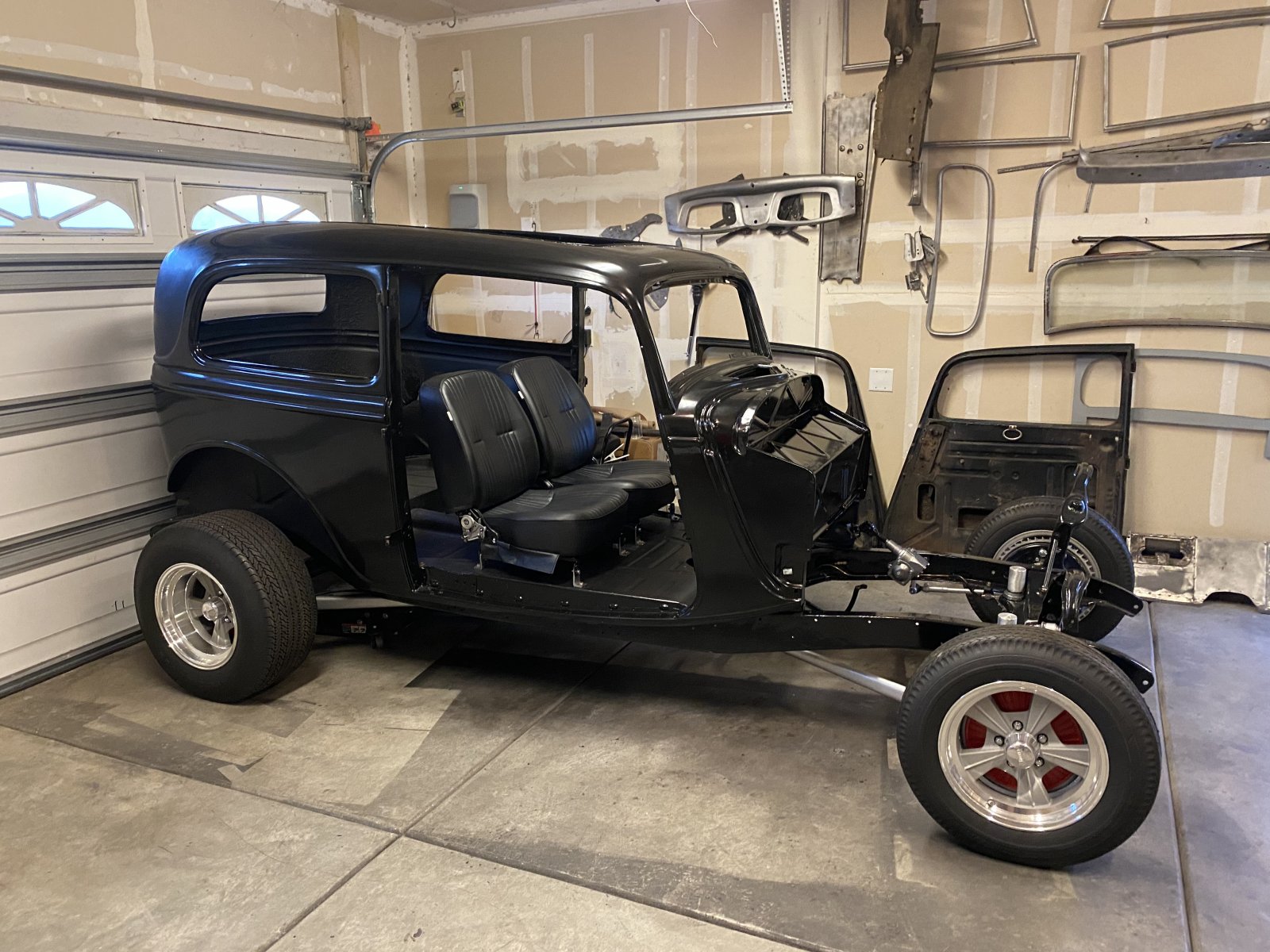

  17. 33Doll
    Posts: 1,590
    33Doll

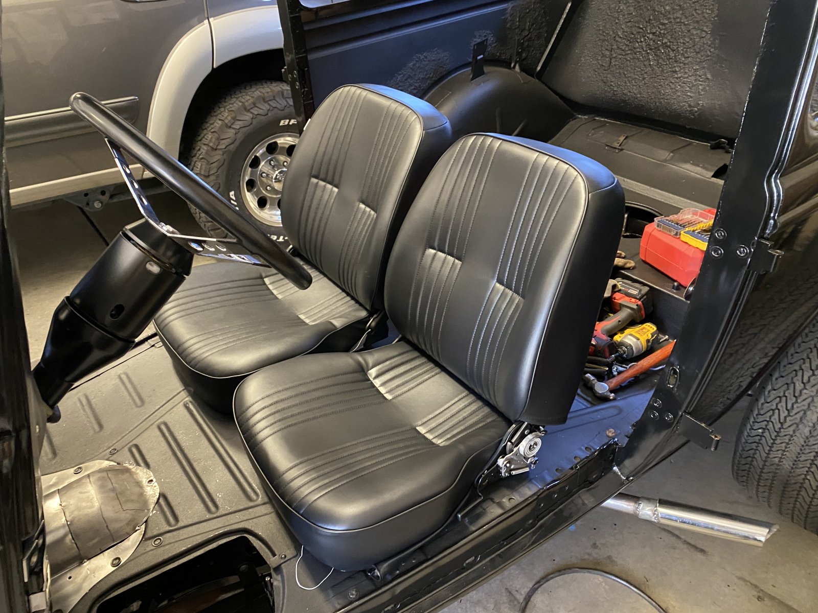

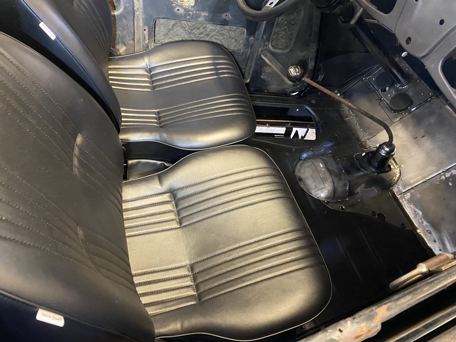

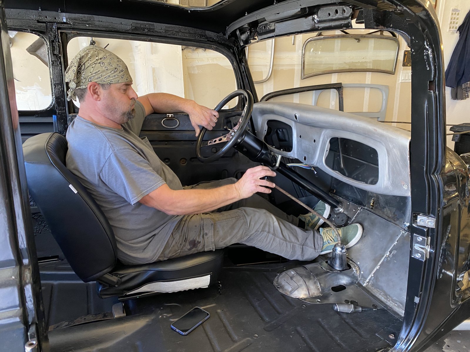

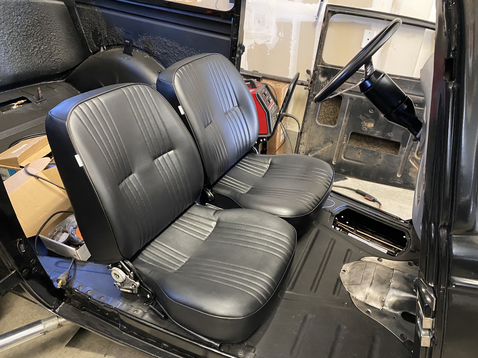

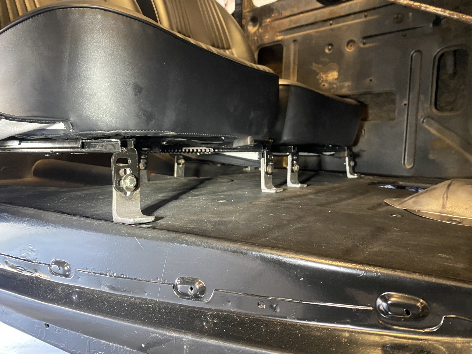

    D283FDFD-8FB7-48F4-9A1C-20AA4C6B473D.jpeg D82548A4-0D8E-4EBF-A074-E002F721A271.jpeg ADDBF66A-1C05-470B-B500-E489E7C7D0F1.jpeg 5F3E648C-422E-449C-9BA8-F6EC2AEF0A33.jpeg Had to set them in there and see what they look like!

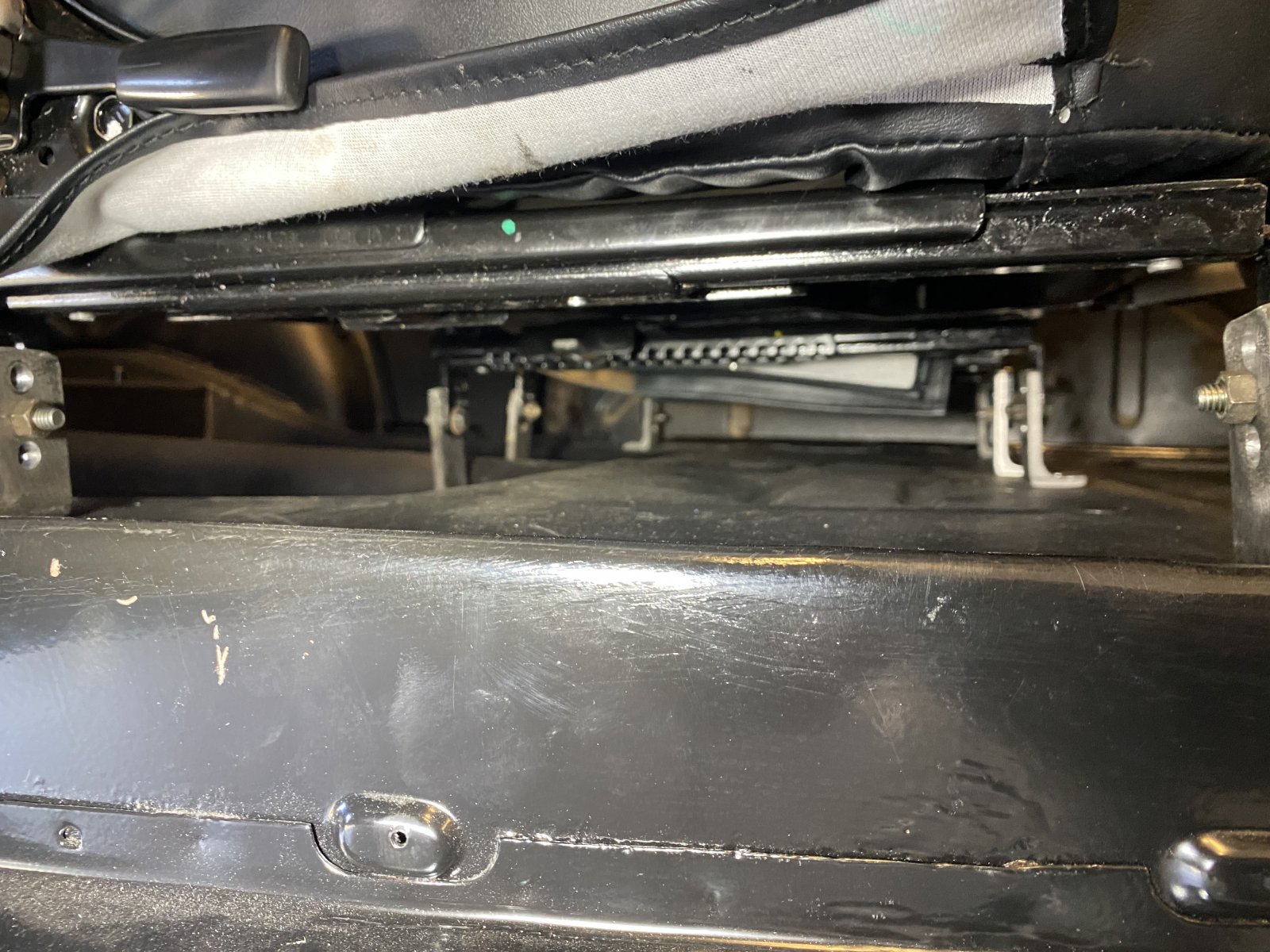

    I don’t fit no problem just need to fabricate brackets to elevate them.

    AD6D3840-B9BB-42FF-BBF6-06D8081E78B3.jpeg E0C8AA4E-46AD-4366-AF28-50FD18BBB1D8.jpeg 1ED33183-7D27-47A9-82AC-9823A0754B1B.jpeg 3F67BF3D-057D-4FAF-8558-D1300727EEDD.jpeg FED3177F-53BB-41BC-B0DC-9F5E22727B34.jpeg AEA3EF51-1320-4298-8FC4-DC39FA23FA3D.jpeg 5B3BA00B-2DD7-4744-B9ED-423BEBC0BE93.jpeg AB3A5185-BE53-4751-8EF7-E8998894201A.jpeg 8D3D710D-9C79-4FD5-9955-961CF91EC35C.jpeg Getting there!
    Mas Done Mang!

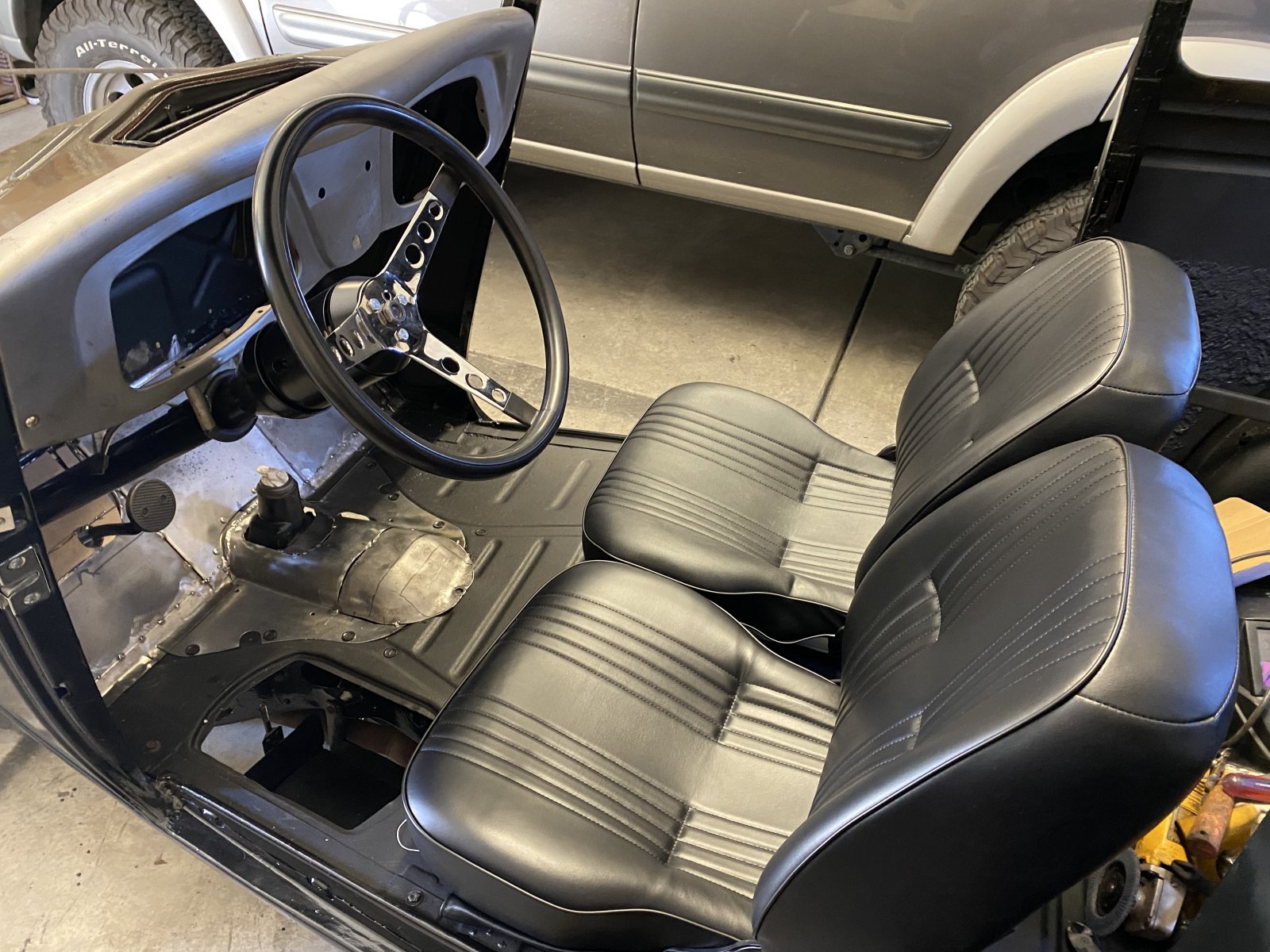

    :rolleyes:...Oodles of Headroom...you could add up adjustment too...to make for more ergonomic options...they were a big improvement over the Model A's and Sedans allow for more wiggle room...:)...better more than less...and seeing traffic lights is good too...;)

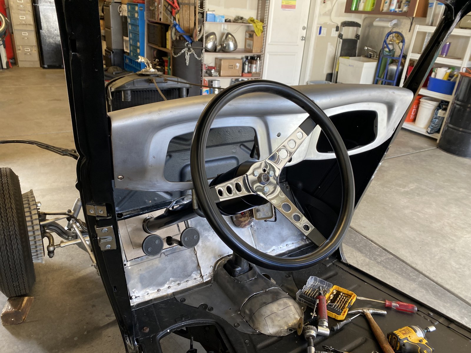

  20. 33Doll
    Posts: 1,590
    33Doll

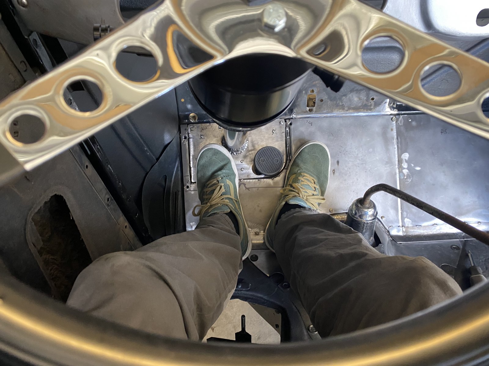

    ADEF30DC-DDE9-4917-87A1-C397DF0B1EC2.jpeg CAD8599C-995B-4506-8C62-43B48E4AAFF7.jpeg 13A8EF8F-964F-4D5B-8B7F-86349D0E637C.jpeg Yup! I cut some Angle Iron for legs.
    Up about 2” I think, Everything else is good, Gonna modify the the clutch pad and offset it a bit too.

    "In my humble opinion sir, the ergonomic projection of ones elbow to the window edge is critical"
    I agree the seats look like they need to come up quite a bit. I put a felt pen line or tape on the middle of the windshield and have my wife or daughter line up to my eye level from 20' feet in front of me.
    It takes me longer to get the seats in the "just right" spot than it does to build the engine....

  22. 33Doll
    Posts: 1,590
    33Doll

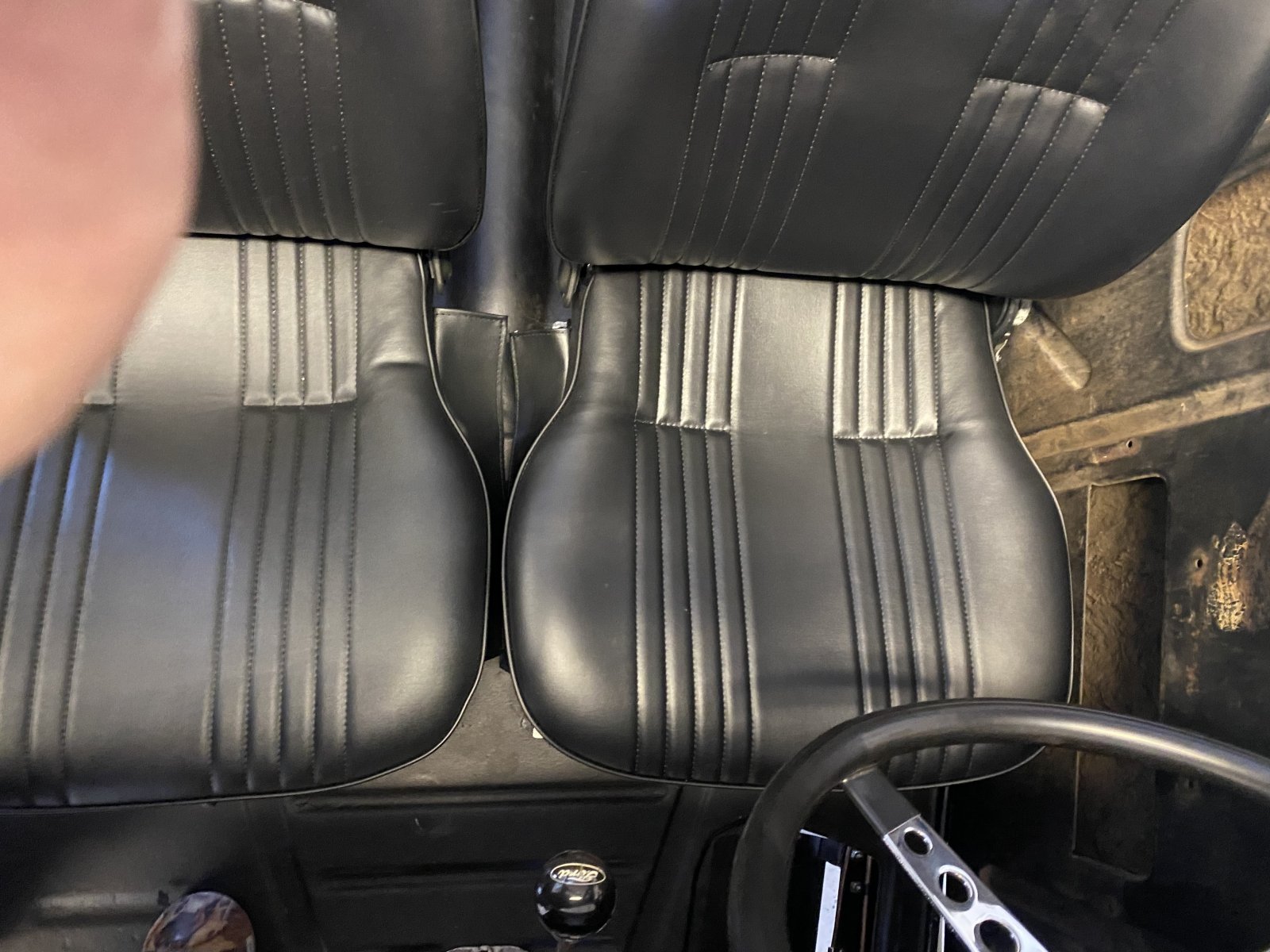

    A14A94C4-0124-462F-B13D-40B82A579389.jpeg 235FB838-E9A2-4538-BCDB-03B838BAF2BD.jpeg 4C28C398-C632-45C6-BE49-76CF4FB4B7C4.jpeg E3988443-7618-4E8E-B721-F4D68C337737.jpeg EA6FFC2F-E8D2-4B3F-A30F-B9B2E4EBB8FE.jpeg I got it now!
    Just need to line up perfect and drill the holes! Elbow is positioned properly! And my vision is right in the center of the windshield!!!

    My test for seat placement was to grab a smoke (not any more), a couple of beers and sit in the car. If you can sit there comfortably for 30 - 40 minutes without squirming around you've got it.

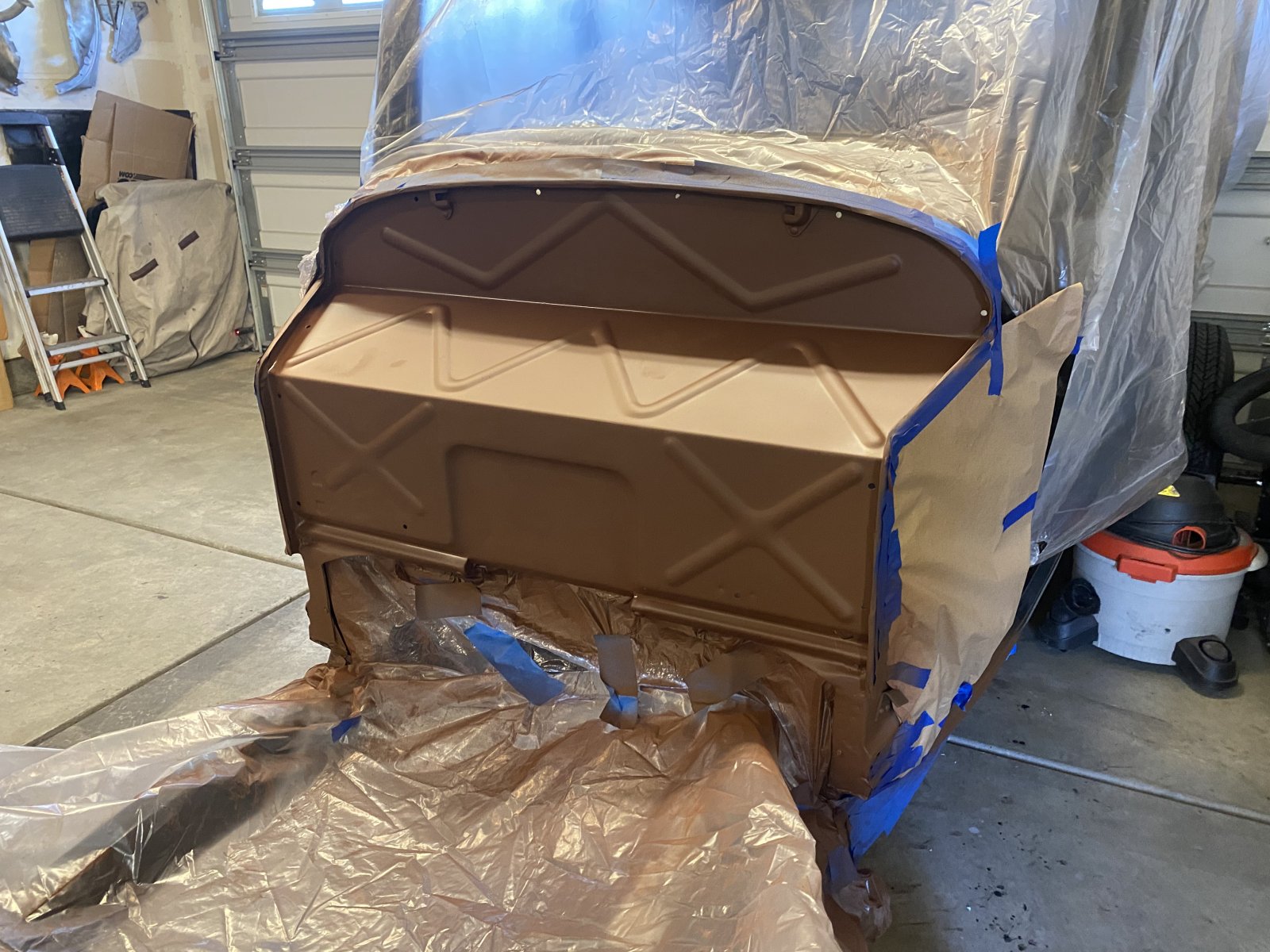

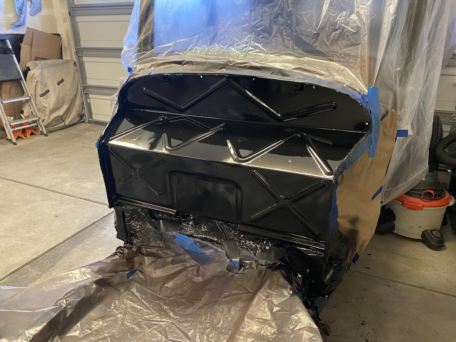

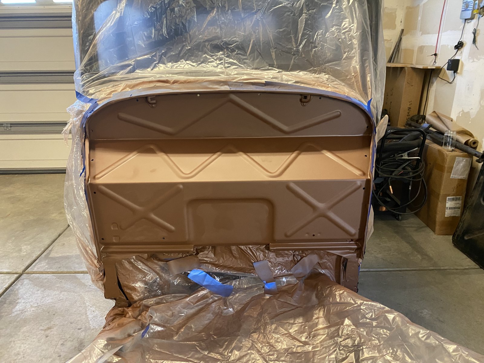

    8F8CFE26-3CEA-4997-8925-DFDA828A7C44.jpeg 8BAA6F49-50C7-4891-AA20-D49FF59BBF15.jpeg 1C34C8CA-232D-4F35-95F6-779FE83D6F61.jpeg 755DC10F-3263-4523-9374-2DCD2CBB7361.jpeg Welp! The wife and I finally got the Covid! After 2 years 2 months!!!!

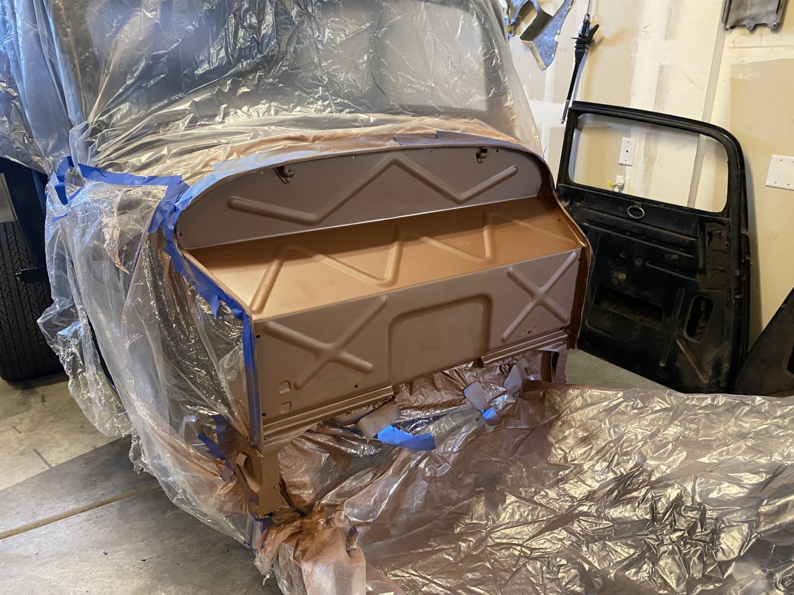

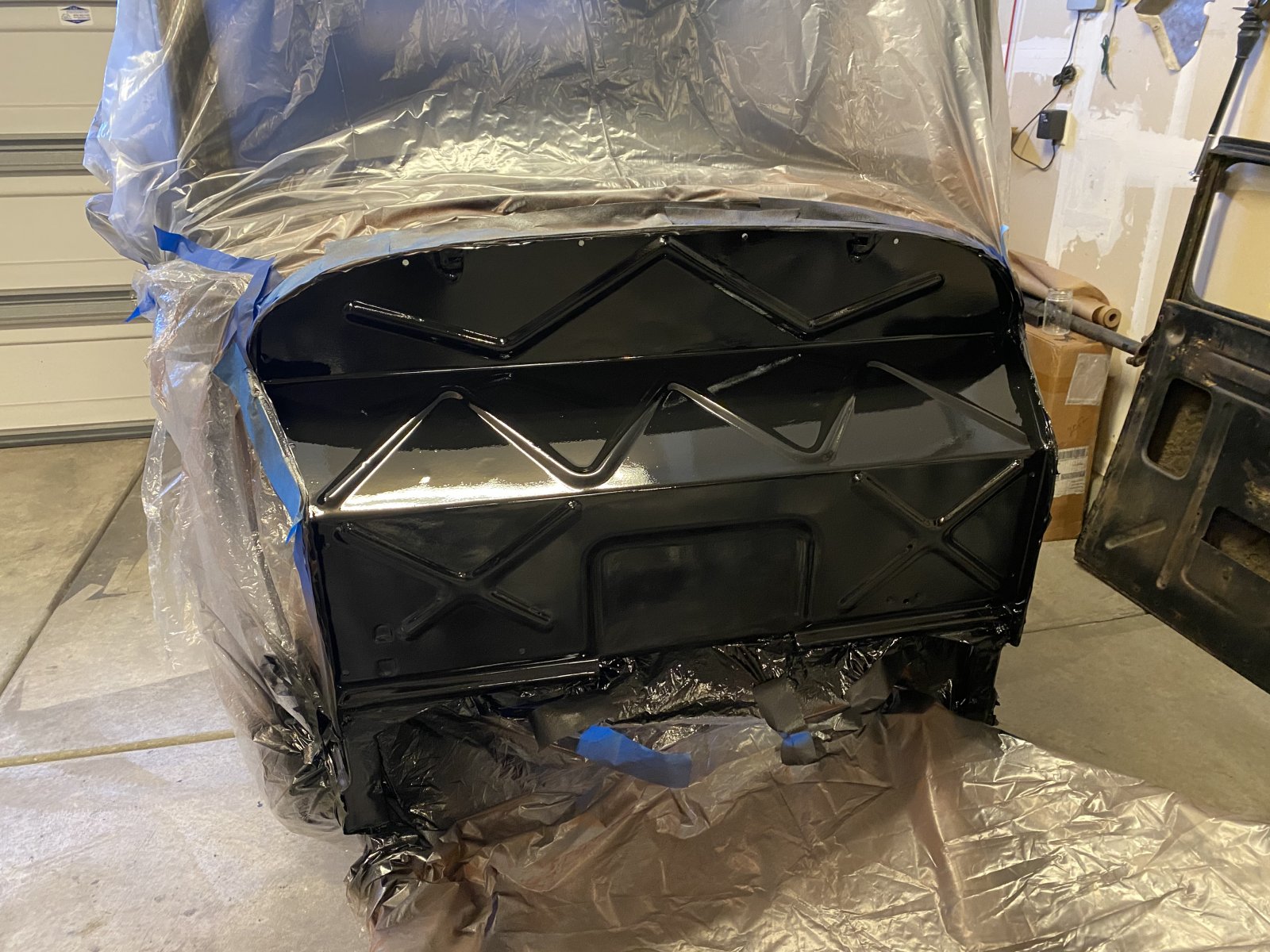

    So not much done on the 33’
    Finally felt good today after 5 days.
    Slept for 4!!!

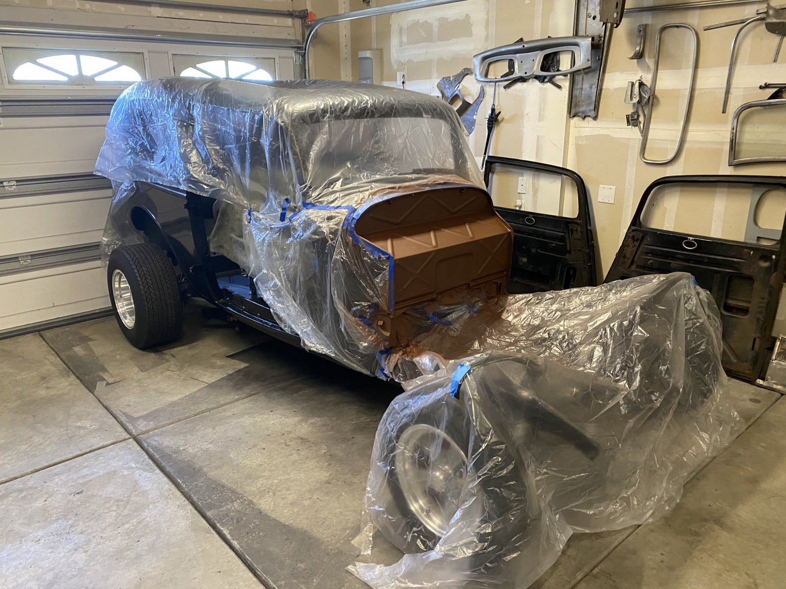

    Painted the fire wall! In between dis-infecting and cleaning the post Covid Cooties!!!

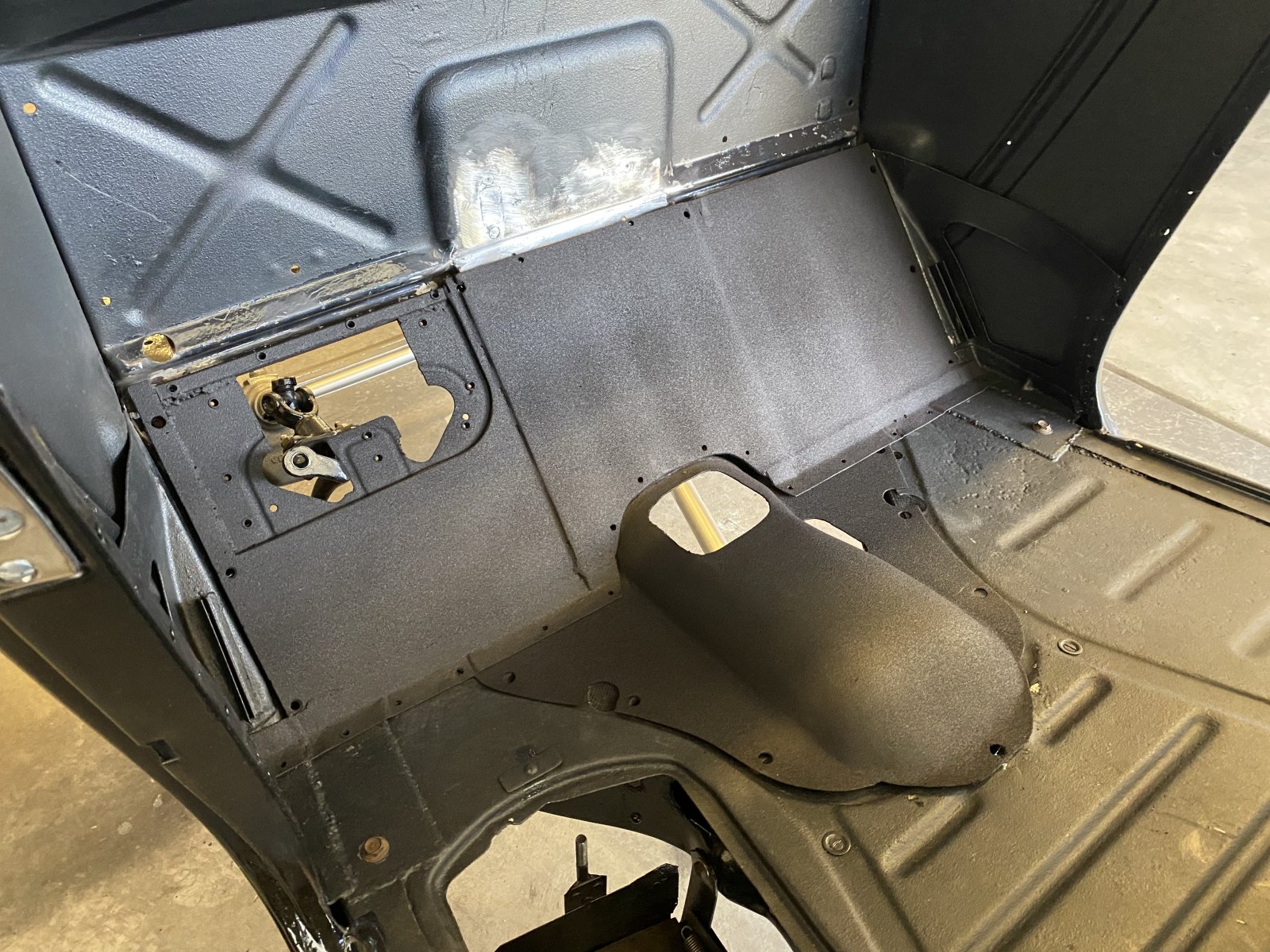

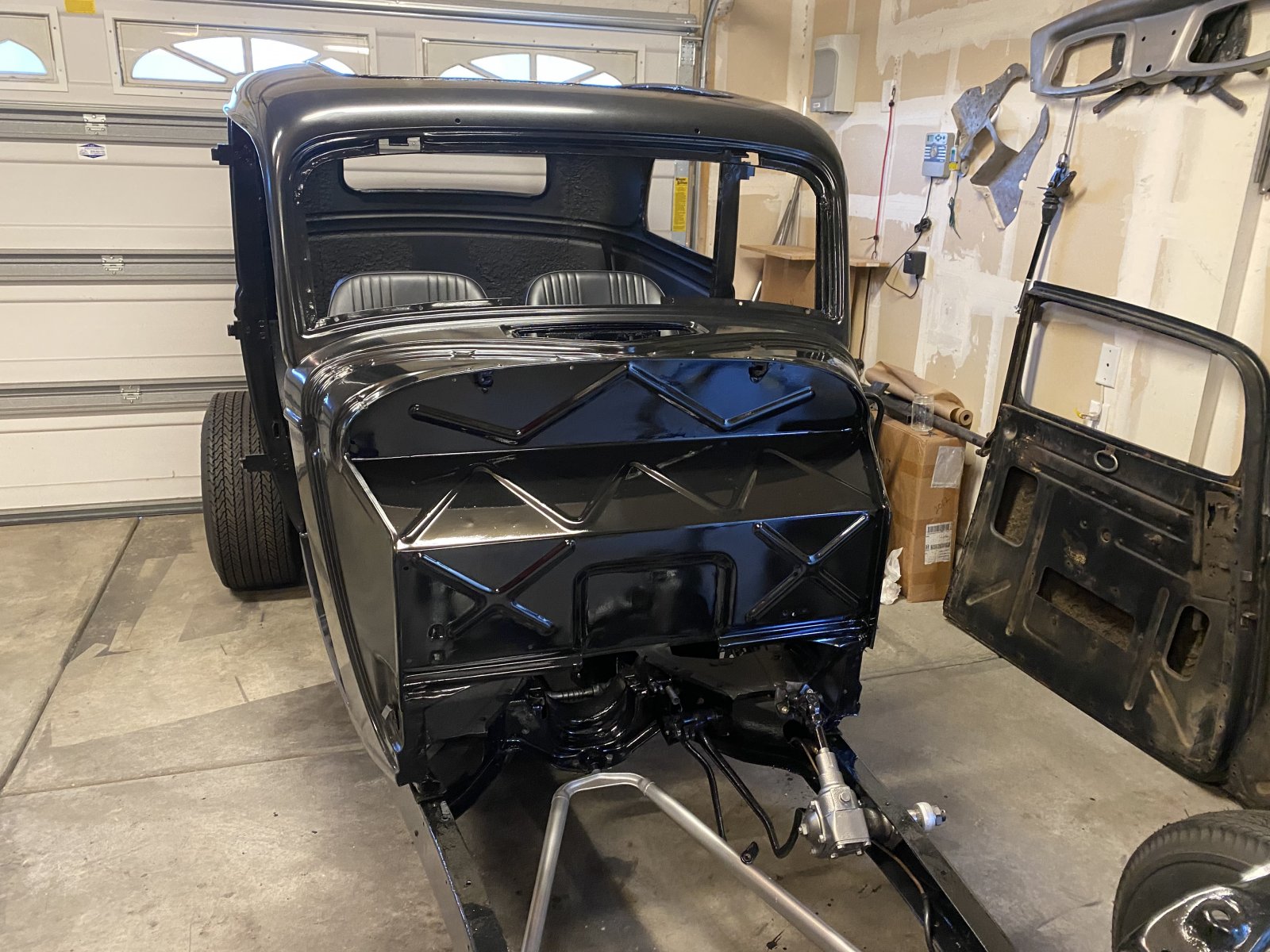

    832D134B-50A9-450F-B3D2-EED5D86AE698.jpeg CB713079-3F19-4240-BC35-1A90447ABCB0.jpeg 053407D1-53CB-43AB-8DEC-550514567E17.jpeg C445C43C-8C85-4D13-A043-1A497F0D2435.jpeg BBBC4662-2D0B-4A0F-AAB4-C86F6F0CA609.jpeg The Mad-Rattler does it again!
    Stogy, dumprat, dwollam and 2 others like this.

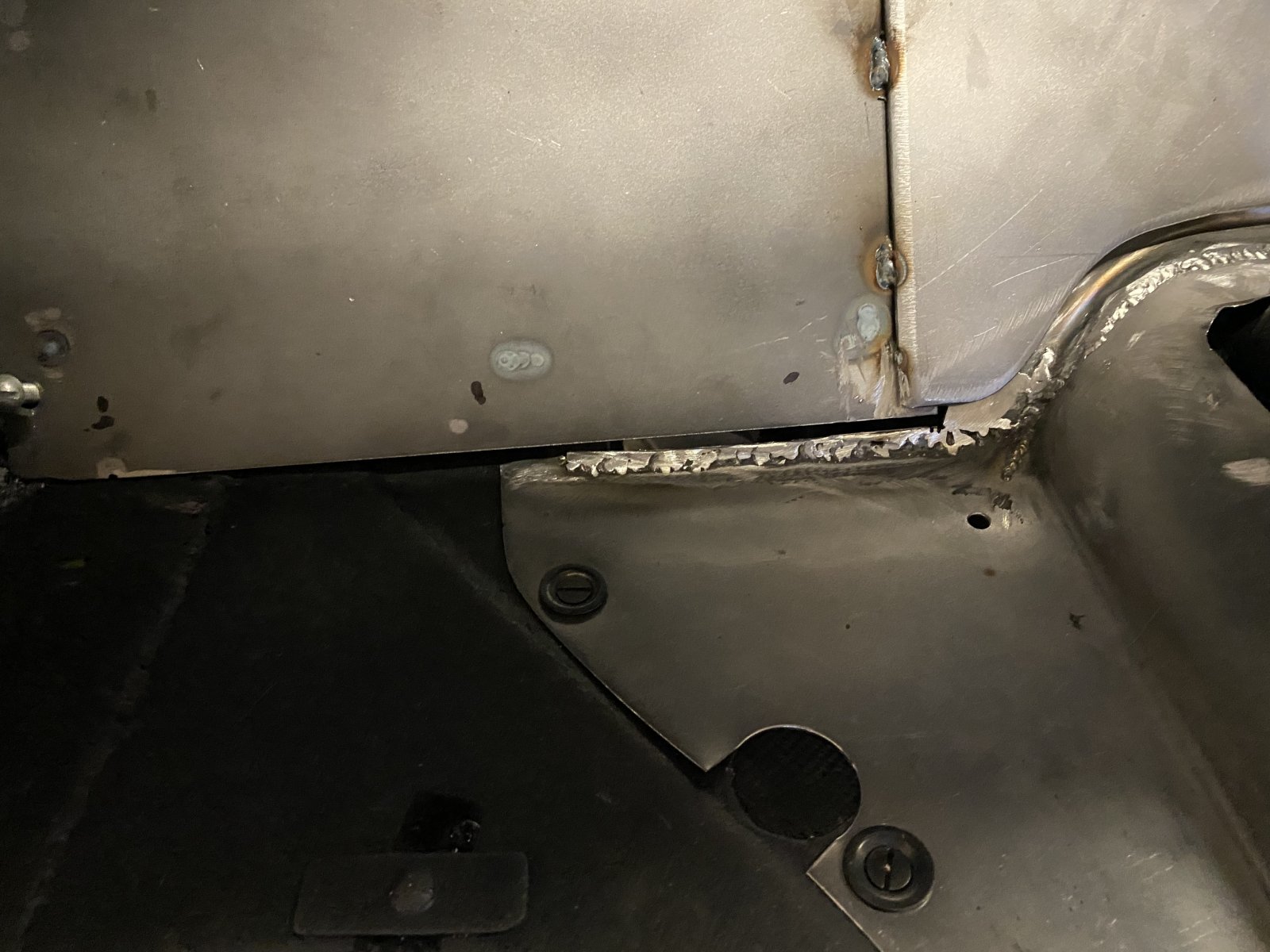

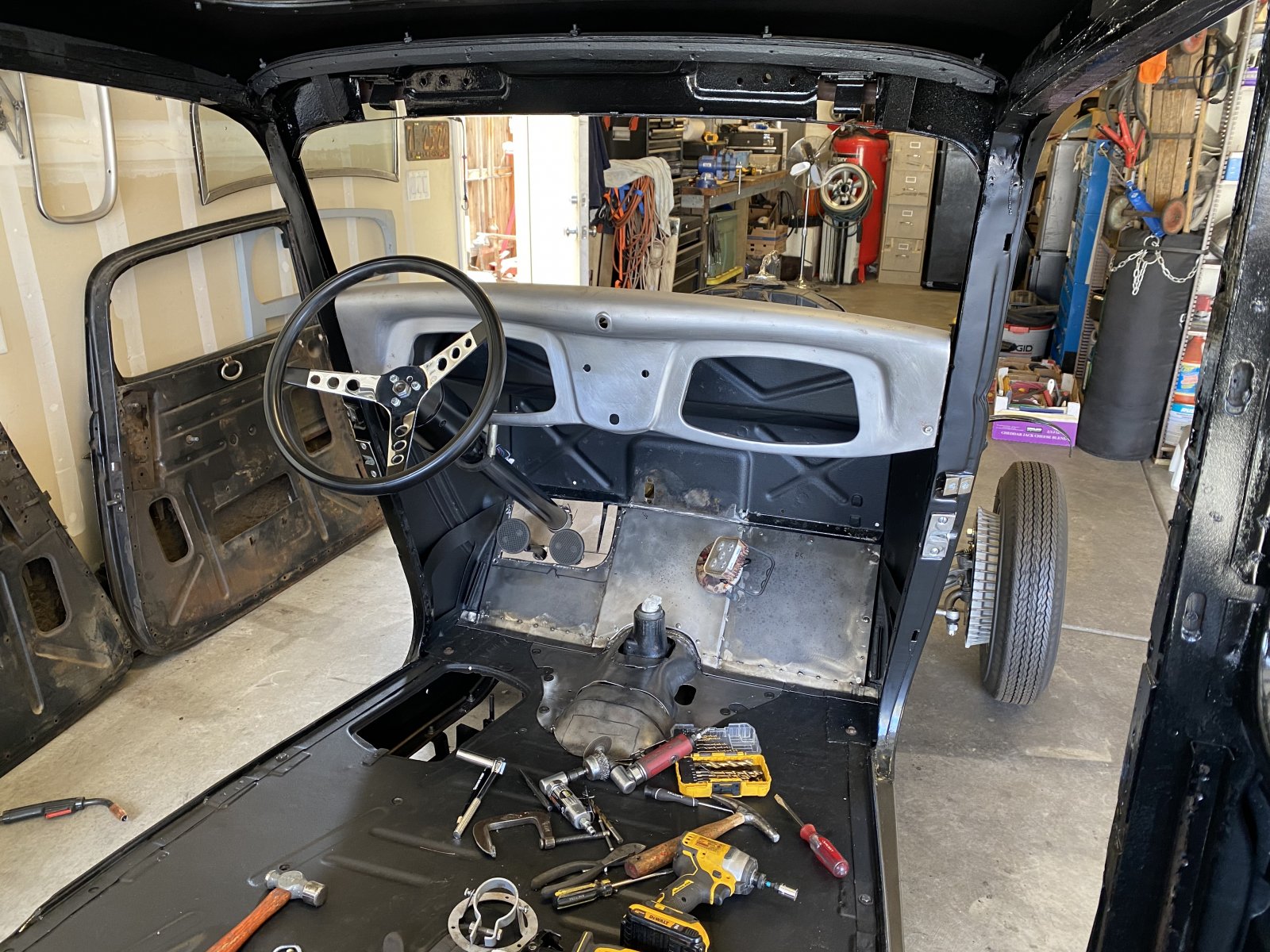

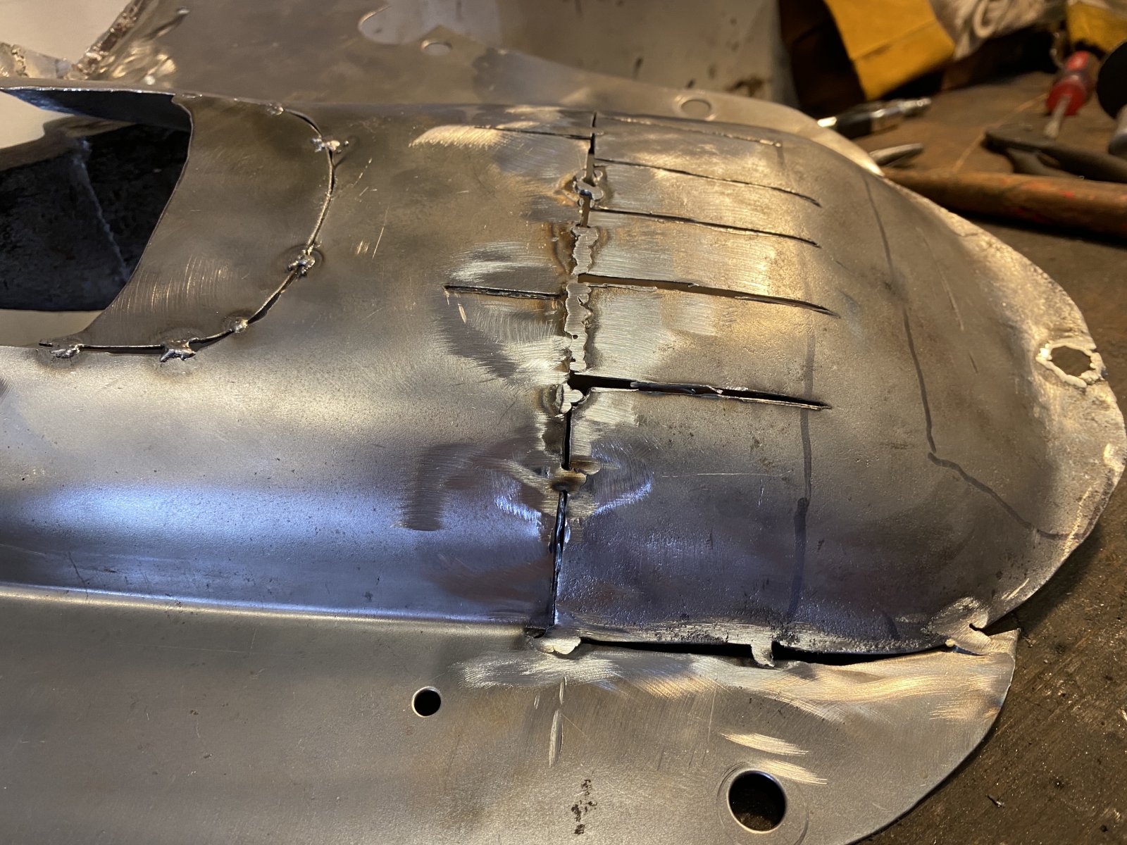

  28. 33Doll
    Posts: 1,590
    33Doll

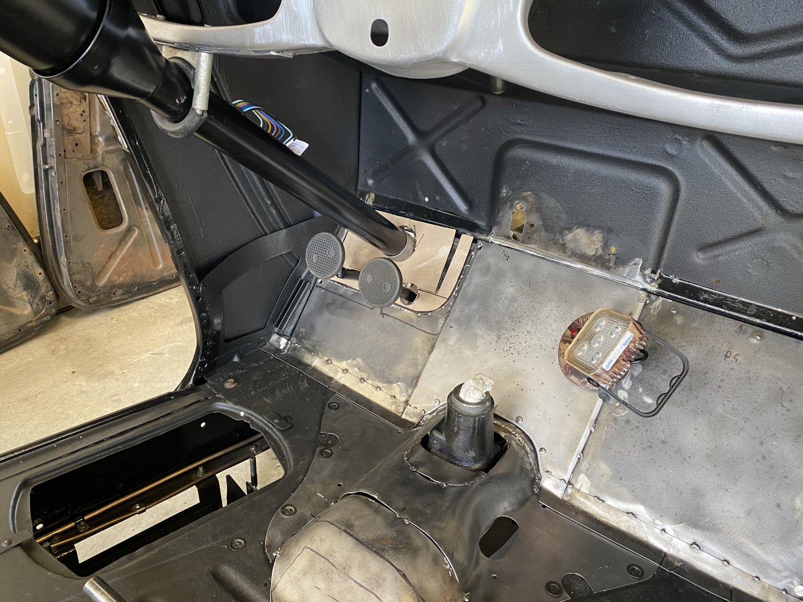

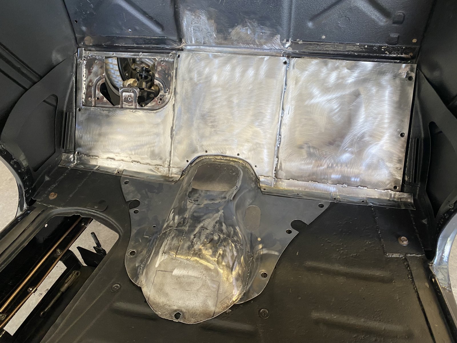

    A94187A9-1675-485D-9C8D-12FDAE3AEFD2.jpeg 9167D94E-C5F6-4D8E-93C9-B59553D7D676.jpeg B69C7C0D-9E80-4790-A188-9F0BBF1CBC07.jpeg 15D883BA-F284-4B79-BB25-93D62456D32F.jpeg 47135FD4-9181-4F4D-A0C6-4AD9F63167C2.jpeg 9E57D01E-6111-4DA6-9C23-701D6F443850.jpeg Boy! Im glad I didn’t chop the top!

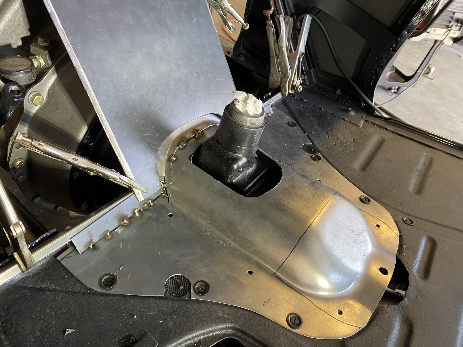

    With how much this small ****** tunnel gave me such trouble! Moving warping Slice an dice!!! Finally got it looks like ****! I’m gonna cover it with all that dura gl*** fibergl*** filler and then undercoat it black rubber under coding and insulate the backside of the toe board and the bottom of the tunnel.
    Ignore the ugly gorilla welds I was tired they will be covered!!!

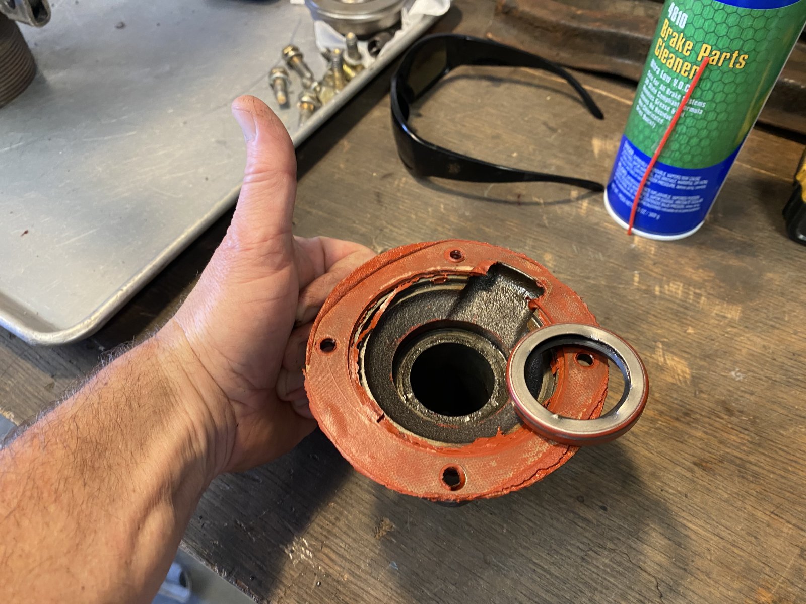

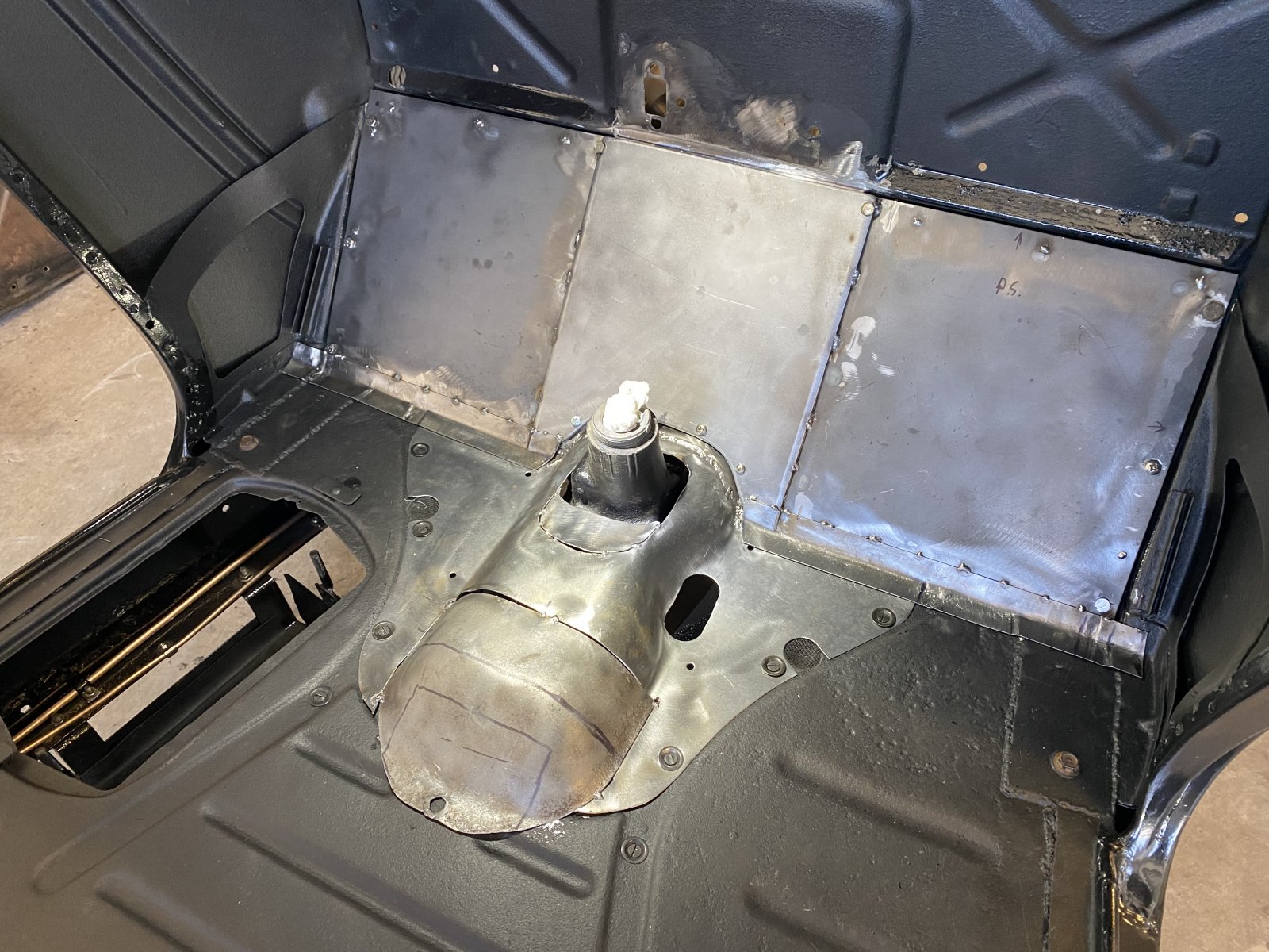

  29. 33Doll
    Posts: 1,590
    33Doll

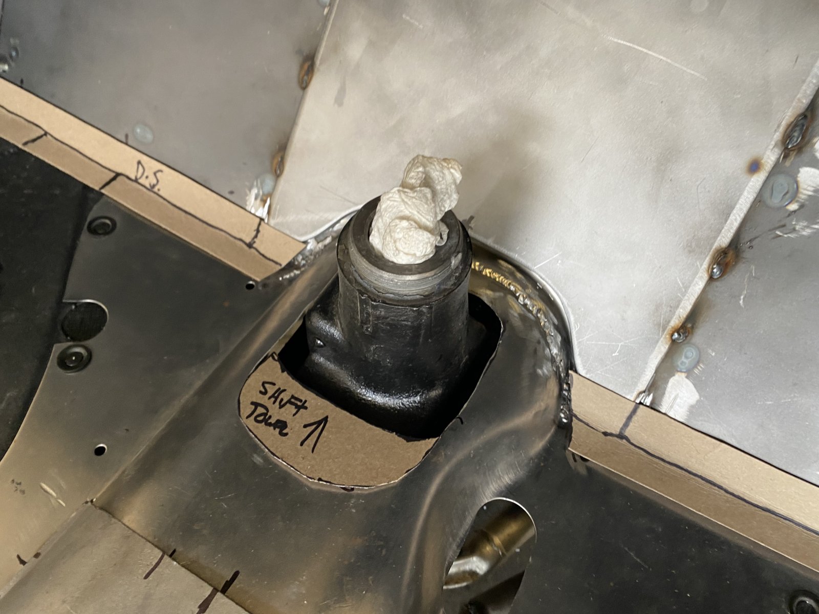

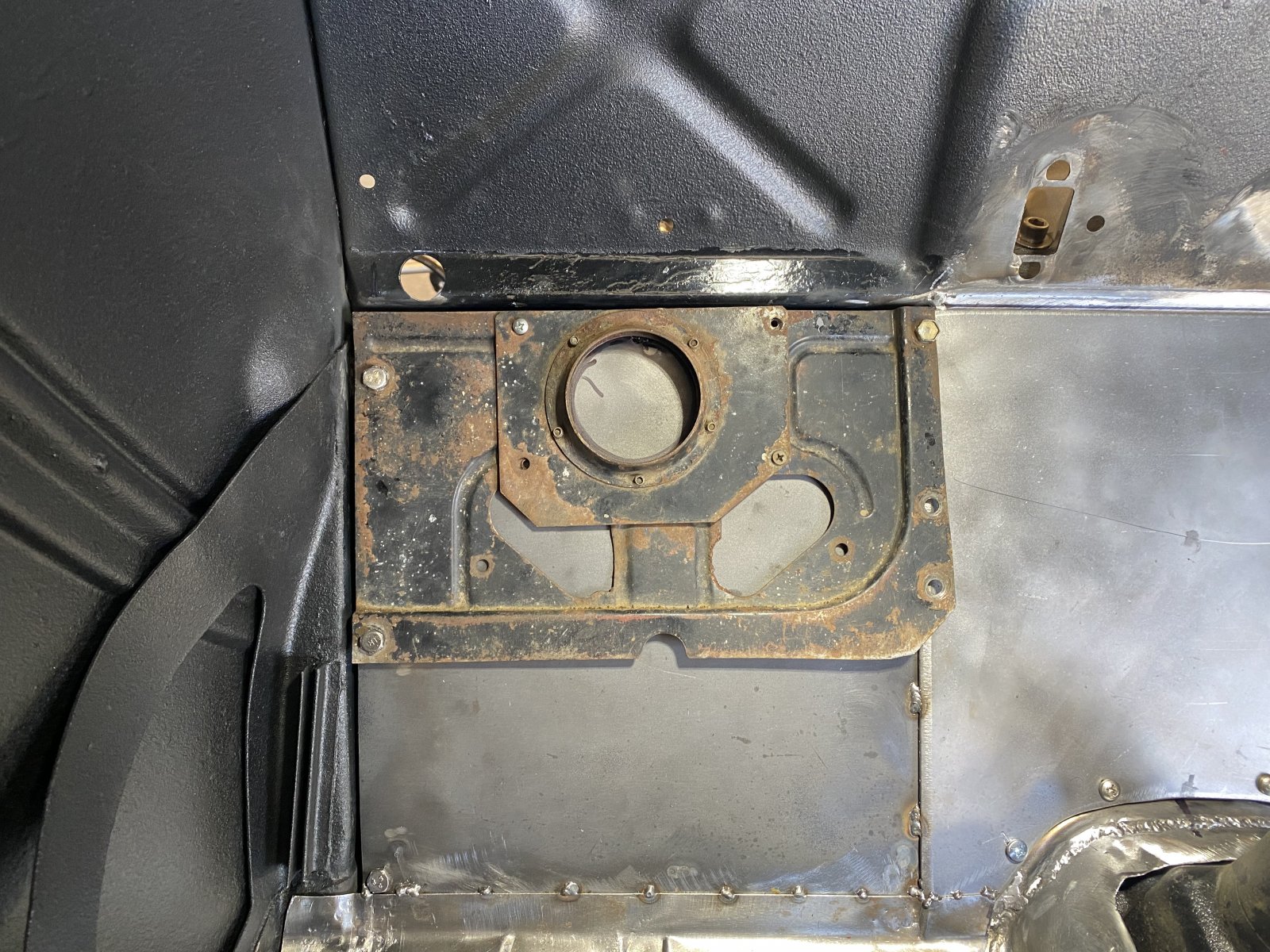

    FC0F3246-303F-4260-AB7B-A8578AC4CF78.jpeg F7563C28-08E7-42D4-9ADC-986752F97137.jpeg F5CA19FD-C4BD-4748-BC79-D19D32B0FAF4.jpeg CFC3E069-5C49-47C2-B948-D4AE4B0E86A3.jpeg 4D5C731D-DD3E-4BDE-B1A8-ABA8A54EAF0E.jpeg 54114F3F-8B2B-4470-9E8F-5F07B2AC1053.jpeg 90028D7E-A83C-43BD-860F-4DDCE782776E.jpeg F02D8F62-5776-43E6-B522-57121161FF18.jpeg A1800292-BB0C-4B29-916A-701B430DD421.jpeg FC0F3246-303F-4260-AB7B-A8578AC4CF78.jpeg F7563C28-08E7-42D4-9ADC-986752F97137.jpeg F5CA19FD-C4BD-4748-BC79-D19D32B0FAF4.jpeg CFC3E069-5C49-47C2-B948-D4AE4B0E86A3.jpeg 4D5C731D-DD3E-4BDE-B1A8-ABA8A54EAF0E.jpeg 54114F3F-8B2B-4470-9E8F-5F07B2AC1053.jpeg 90028D7E-A83C-43BD-860F-4DDCE782776E.jpeg F02D8F62-5776-43E6-B522-57121161FF18.jpeg Well that Duraglas did the job! It hid all them gorilla welds!! (of course I did grind a whole bunch off too!)

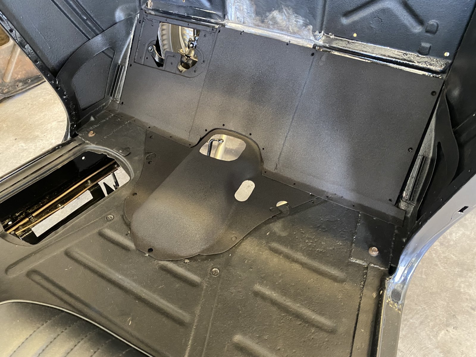

    Floorboards are done!!!

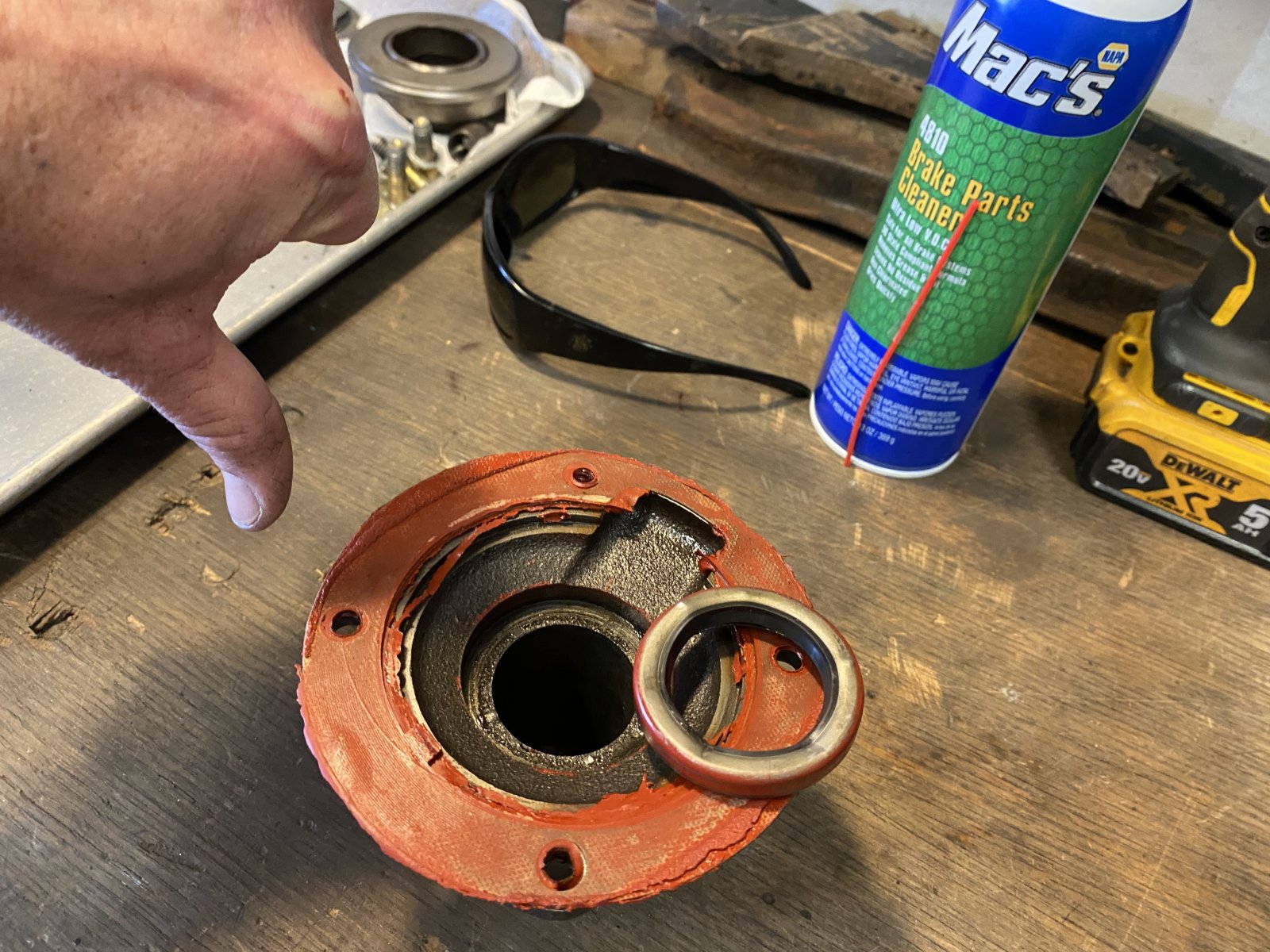

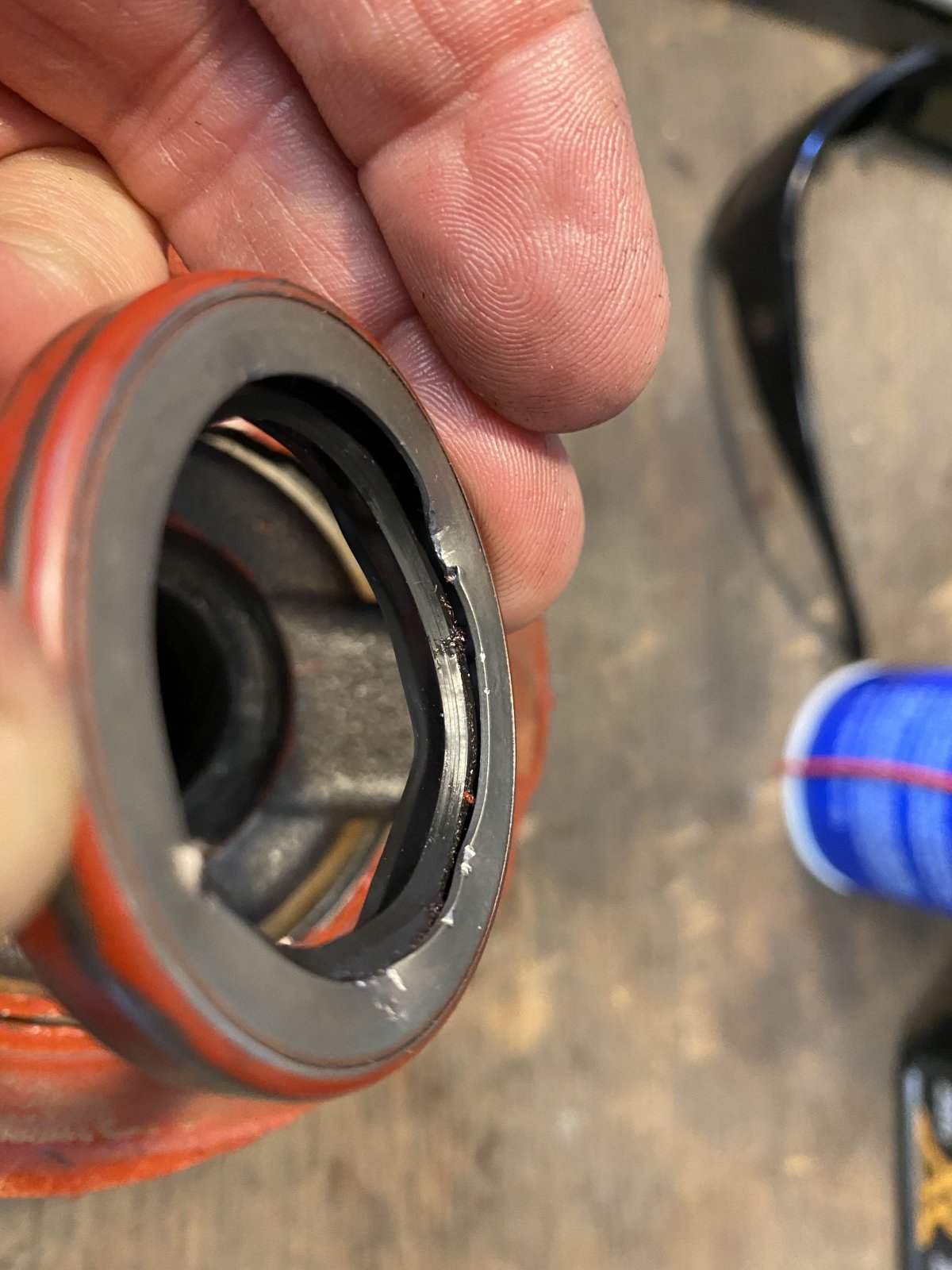

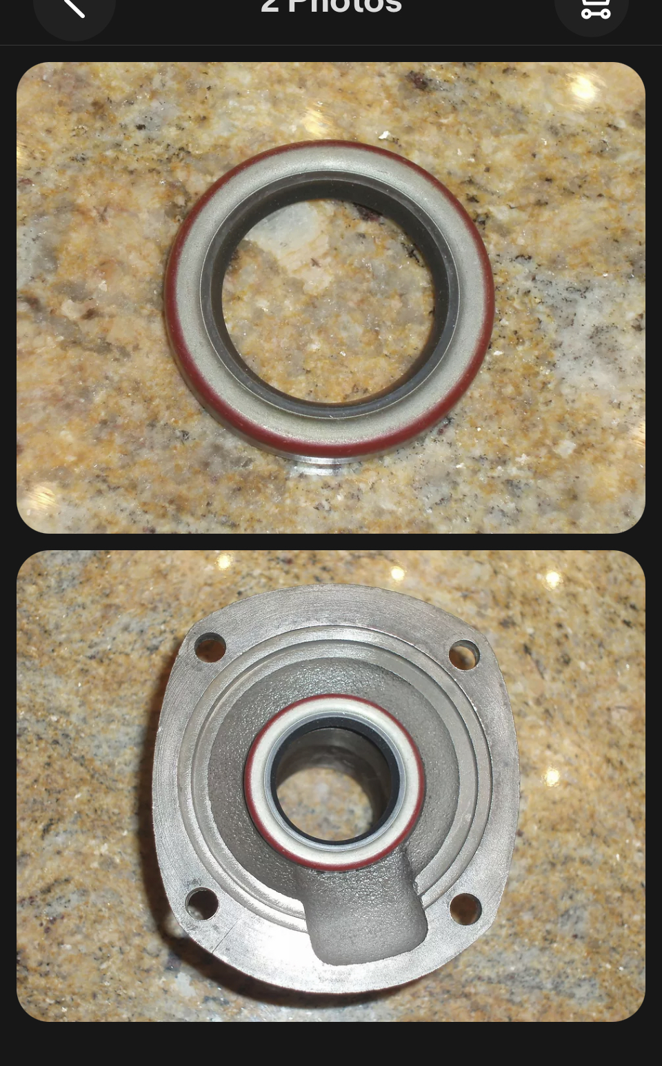

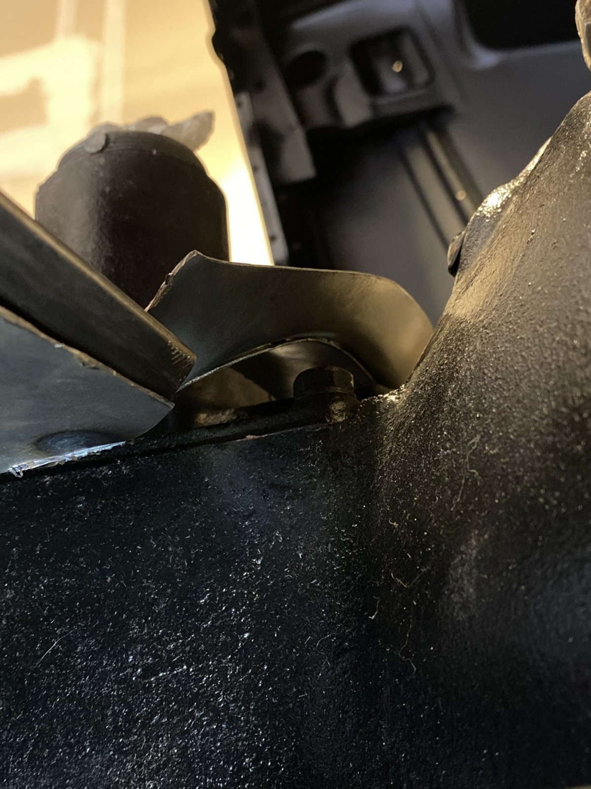

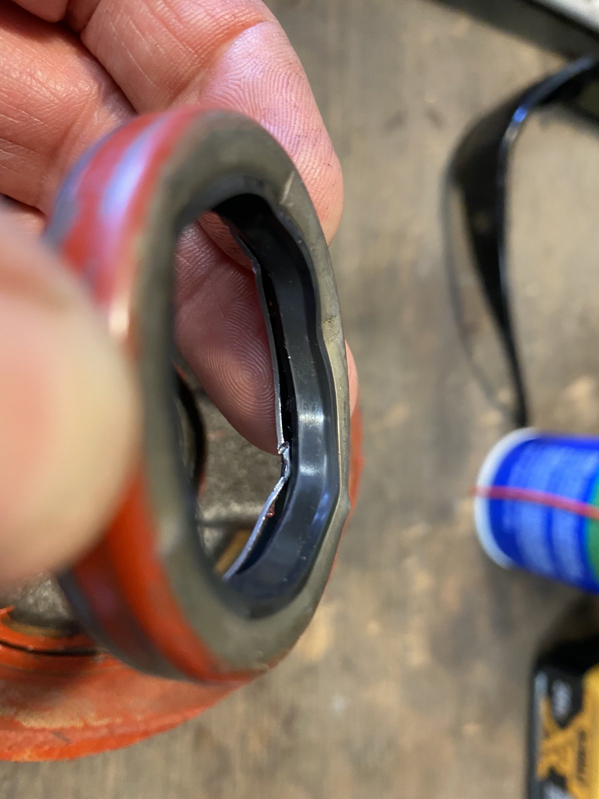

    just trying to figure out the ****** seal I think I put it in backwards last time the pressure side should be on the inside I’m thinking???
    this picture I found on the Internet I think is wrong like I had it???
    Basically the correct way would be the spring facing the inside of the transmission case correct like a normal oil seal? The front snout throws you off.
