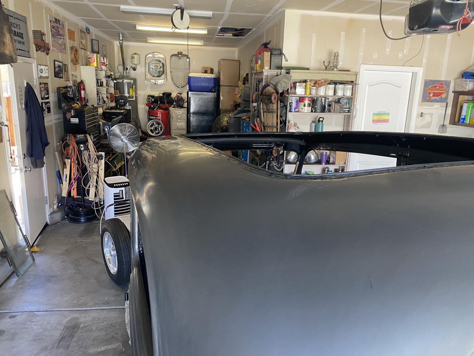

    A couple things. . . My shop looks EXACTLY like yours when I'm in the middle of something! Secondly, you nailed the seat-column-comfort, which is very important. Next is you are making serious progress on the 'doll', good on you
    Stogy and 33Doll like this.

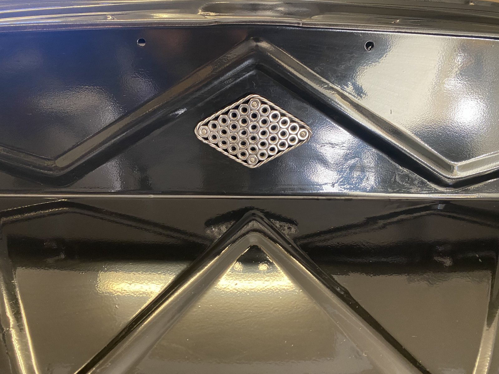

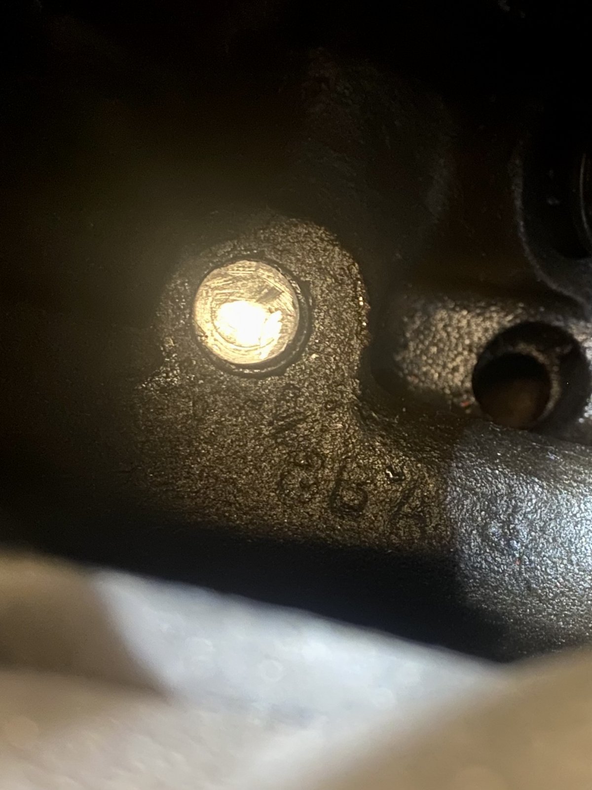

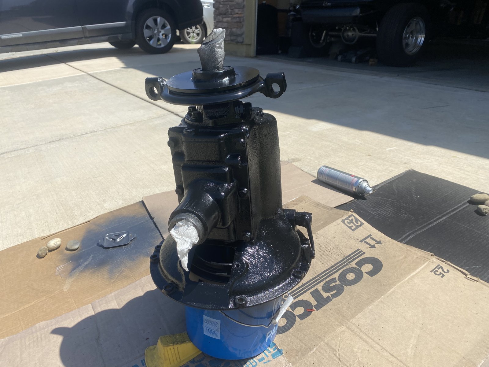

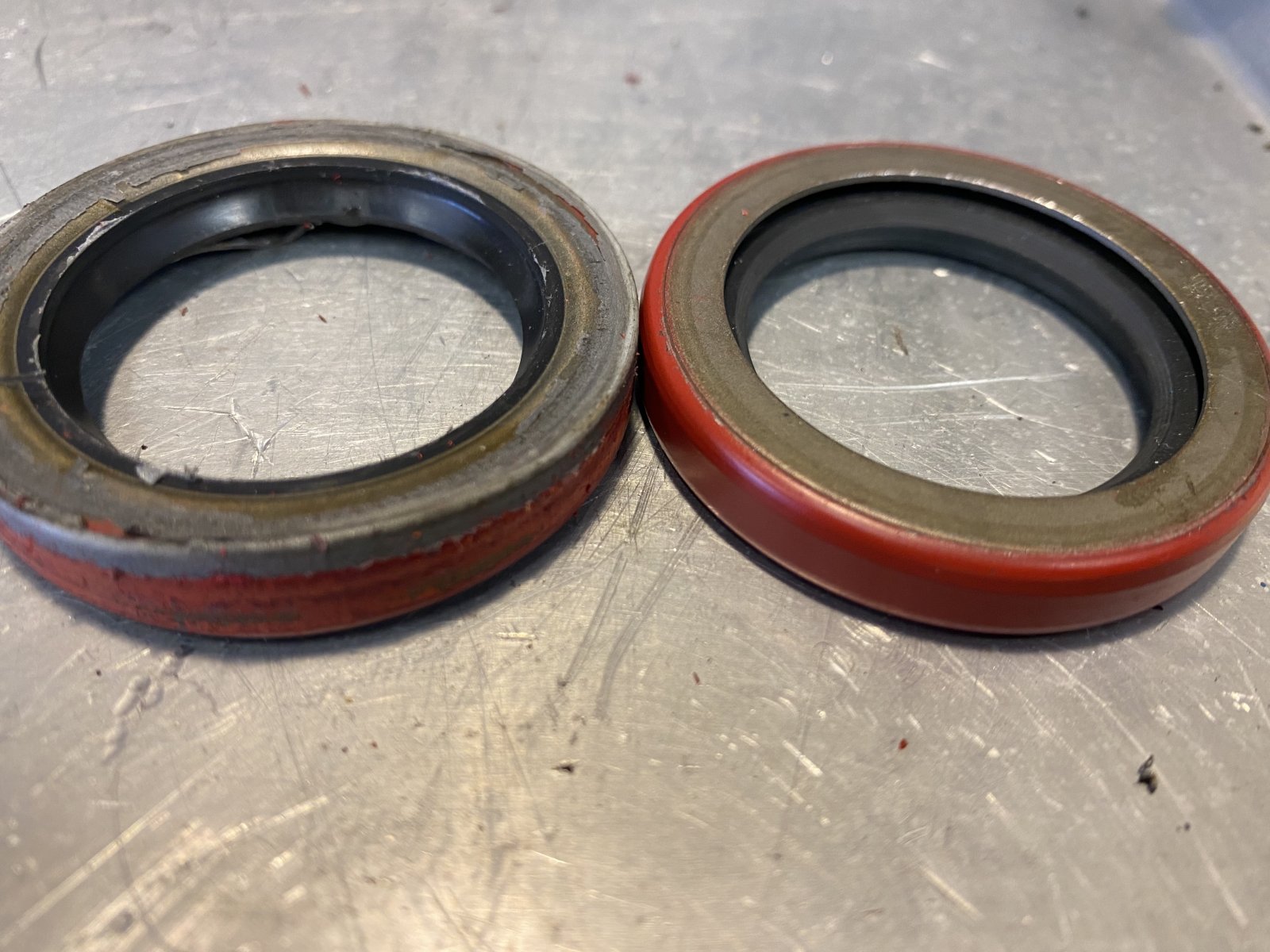

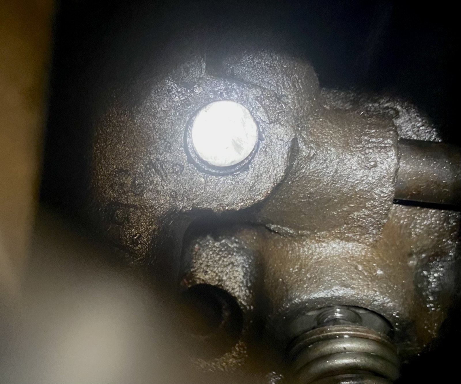

  3. 33Doll
    Joined: Sep 27, 2019
    Posts: 1,676
    33Doll

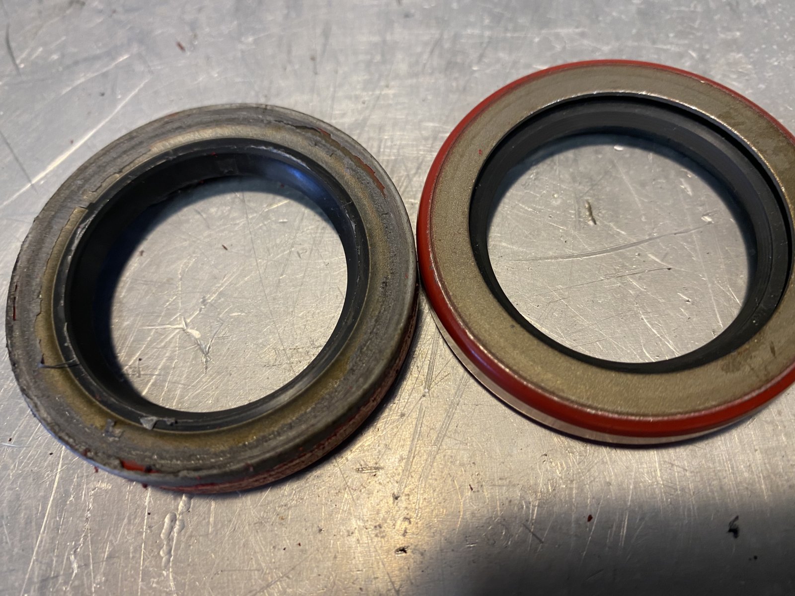

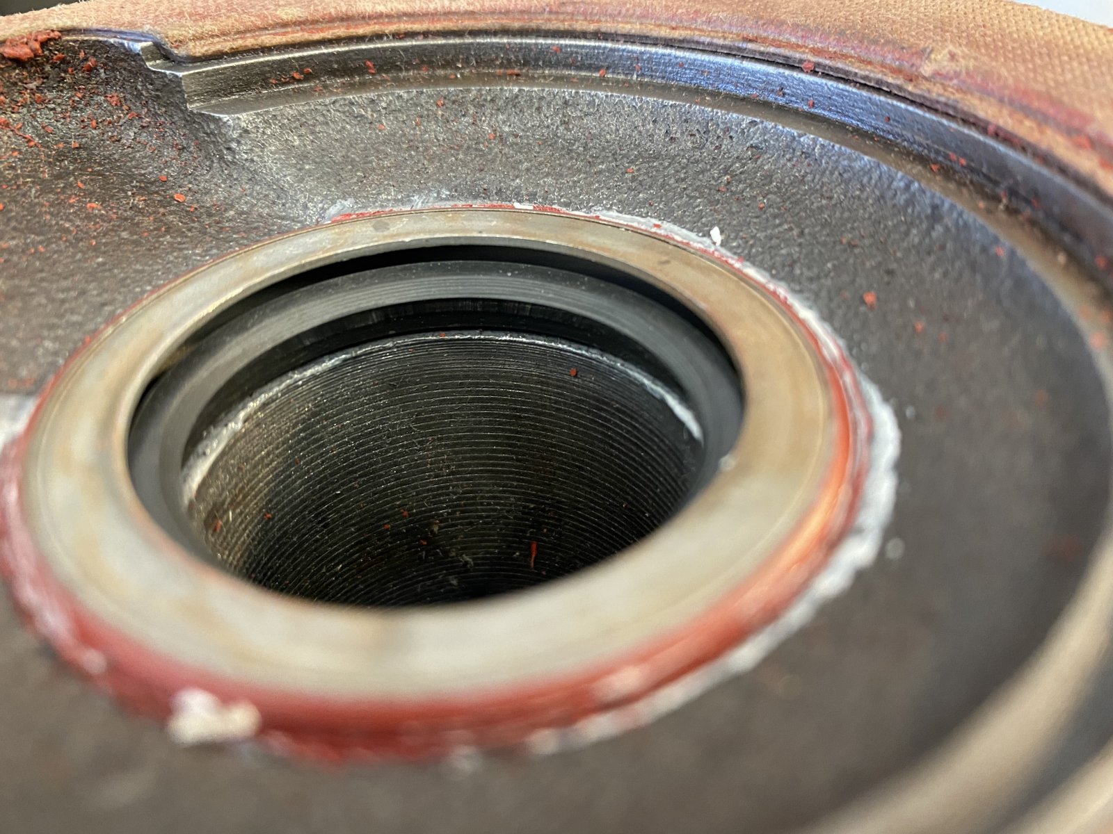

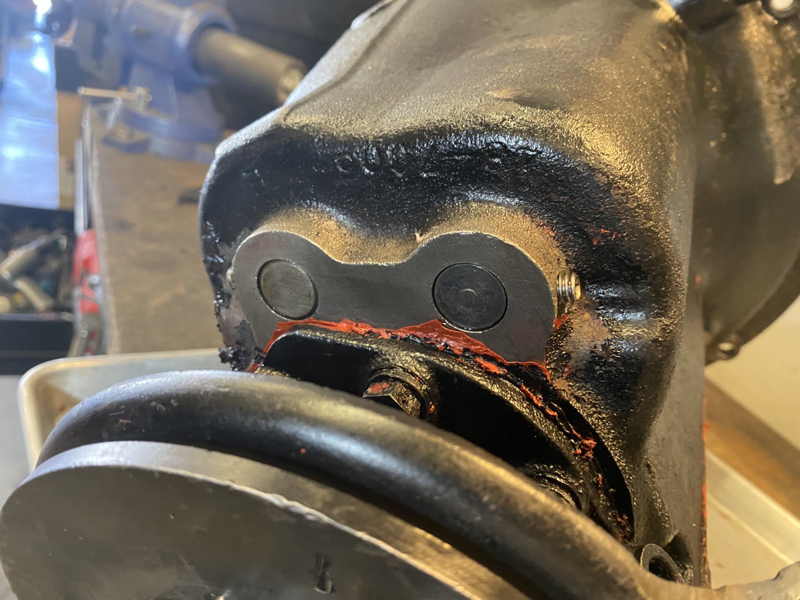

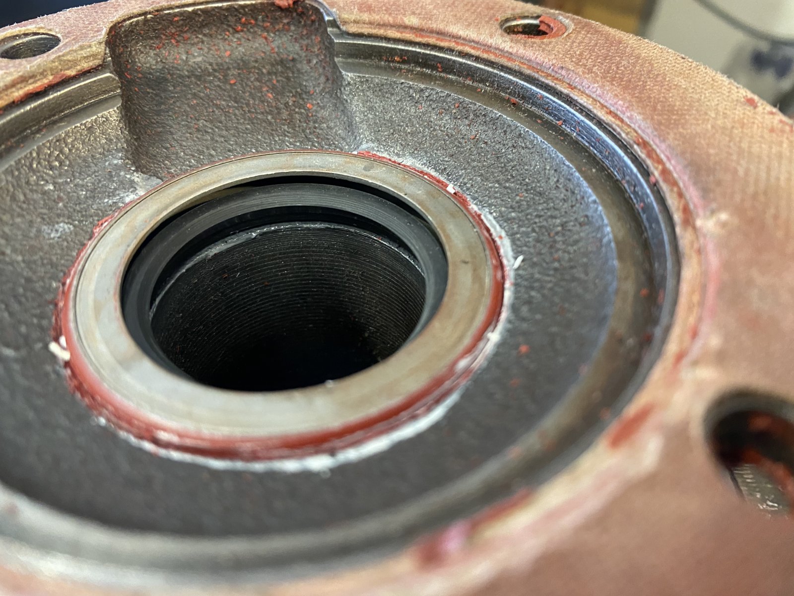

    When I put the ****** together the first time couldn't really figure out which way the seal went, at least it was questionable….well when I took apart the front of the ******, to locate the leak, I decided to take it apart and get a new seal anyway since it was like six dollars, I bought a couple extra ones, which is good, because I screwed one up! So now it's the right direction and it was leaking, where that front shaft is on the bottom in the picture. I didn't see it before. I only saw the back 2
    The new seal I got, you can tell that it's like a double lip, sort of, the back is kind of open just a little bit but it's covered so it fools you.
    so after I work on the rear pin section with set screws like Fair lane 500 34’ trans, and more silicone on the back shaft I don't think this thing is gonna leak at all! B7348D8E-A964-4EBA-8492-AB3A5CB62193.jpeg CDE3B277-6930-418C-89E0-F10EB4113AB4.jpeg 5E6F24F5-F7A7-4FA3-A438-D26139F21708.jpeg 0EB29F1A-1B08-4ACB-B286-3A29E7E9AAA9.jpeg 709FB25D-54BB-4ED8-954B-97D52894D633.jpeg hopefully!!!!!

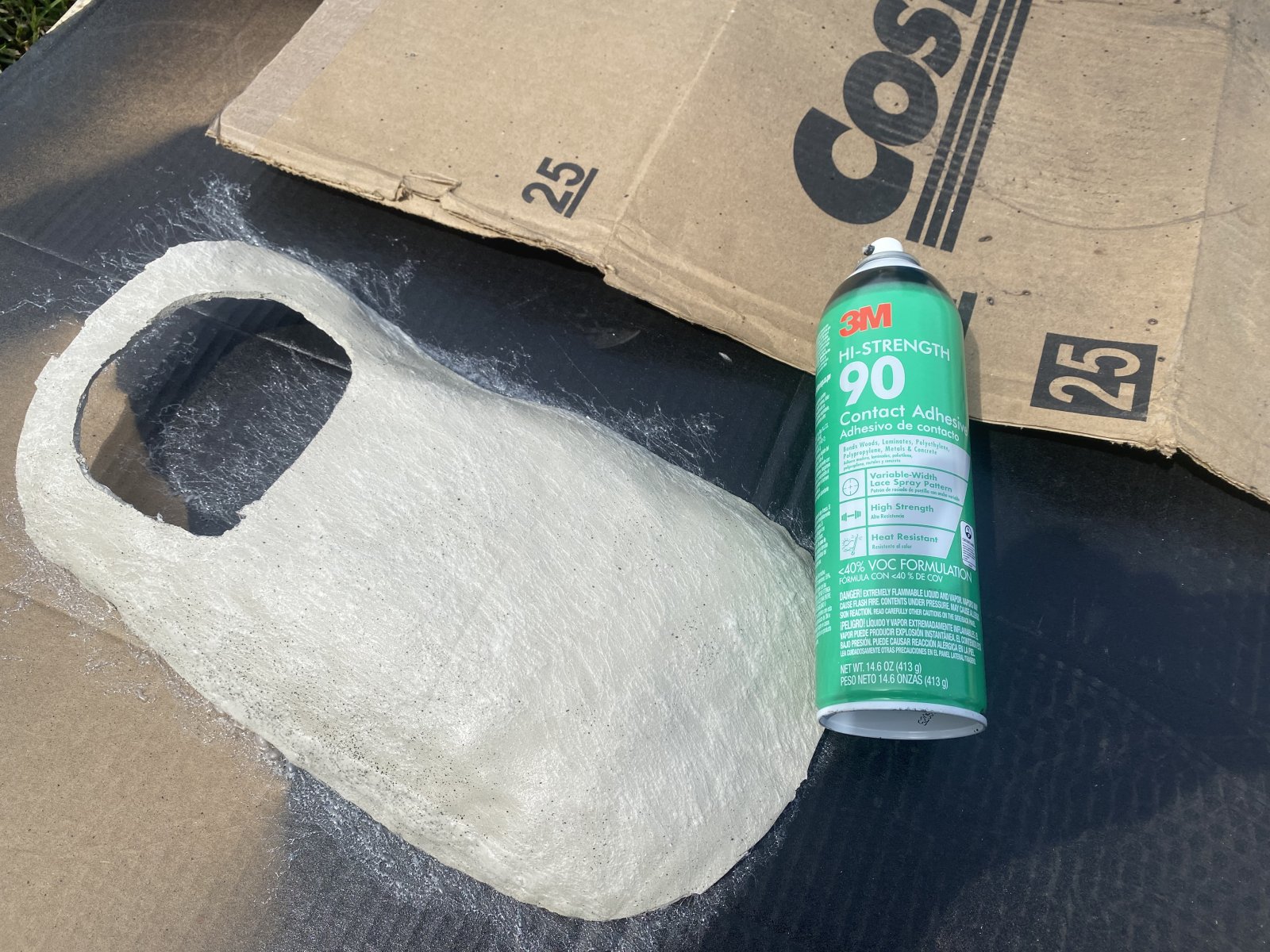

  4. 33Doll
    Posts: 1,676
    33Doll

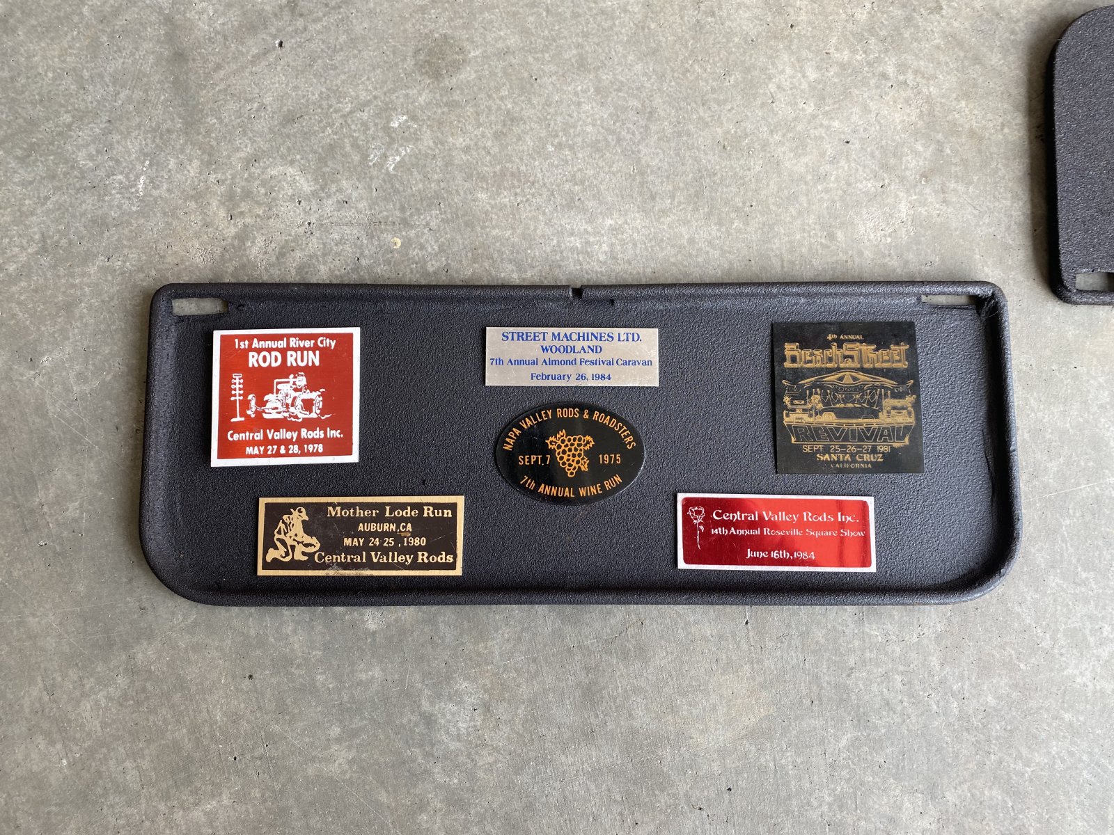

    96B92639-BFB6-4A17-A803-C8E173AF28B1.jpeg 636695C7-15DE-42D9-9BA6-06798A0E66D0.jpeg 358D665A-C224-484C-94A4-E4E96069494D.jpeg

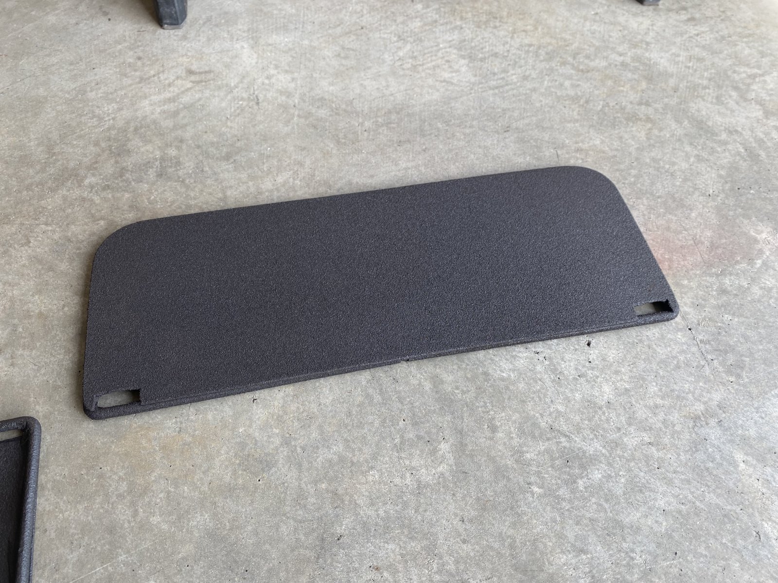

    So here’s my finished sunvisors.
    Kind of textured bed liner industrial like. I was thinking of putting the old 70s and early 80s Dash Plaques on the backside, so when you fold down the visor you’ll see them, and when you flip it up they’ll be hidden. what do you think does it look too trashy?

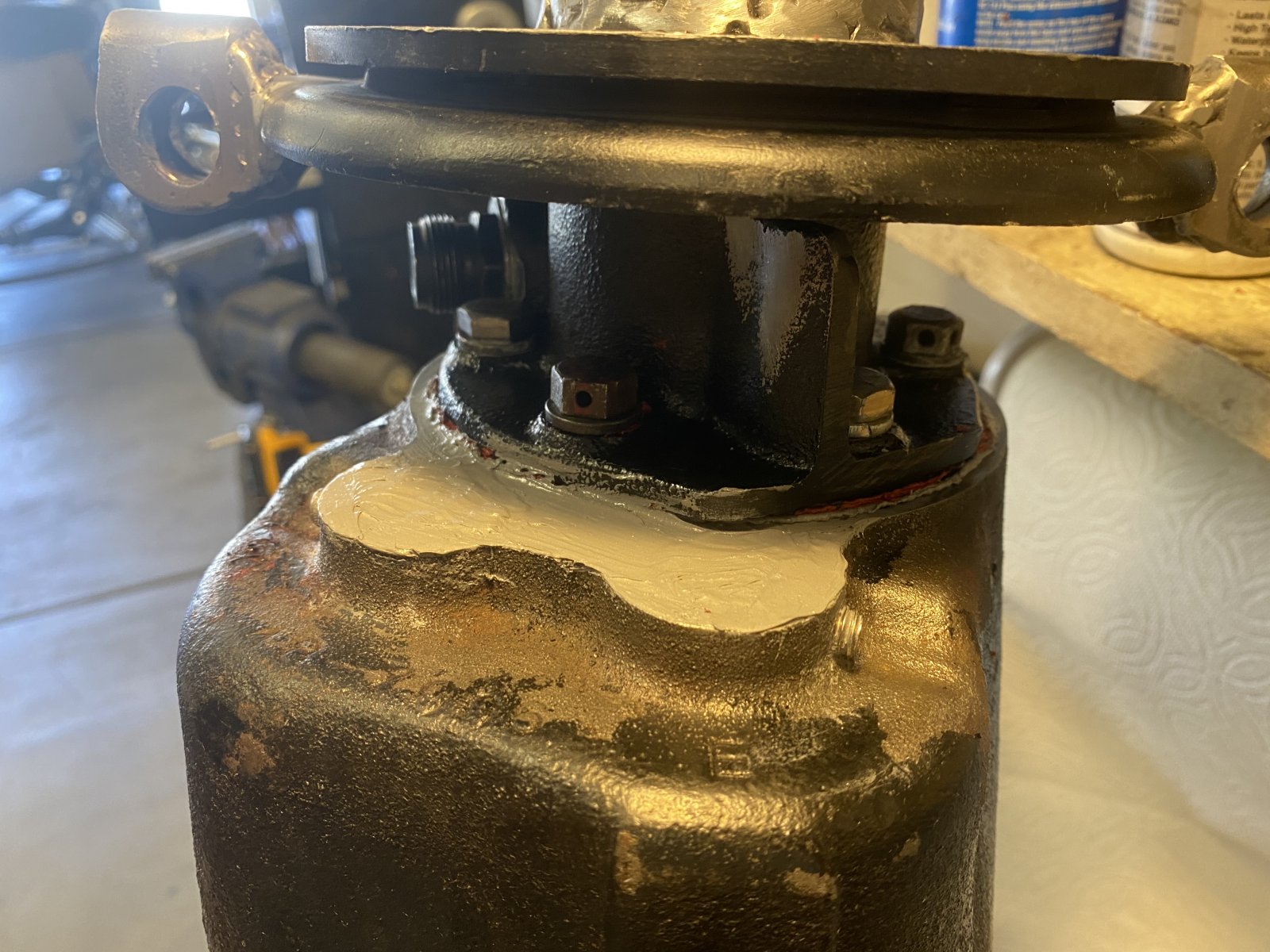

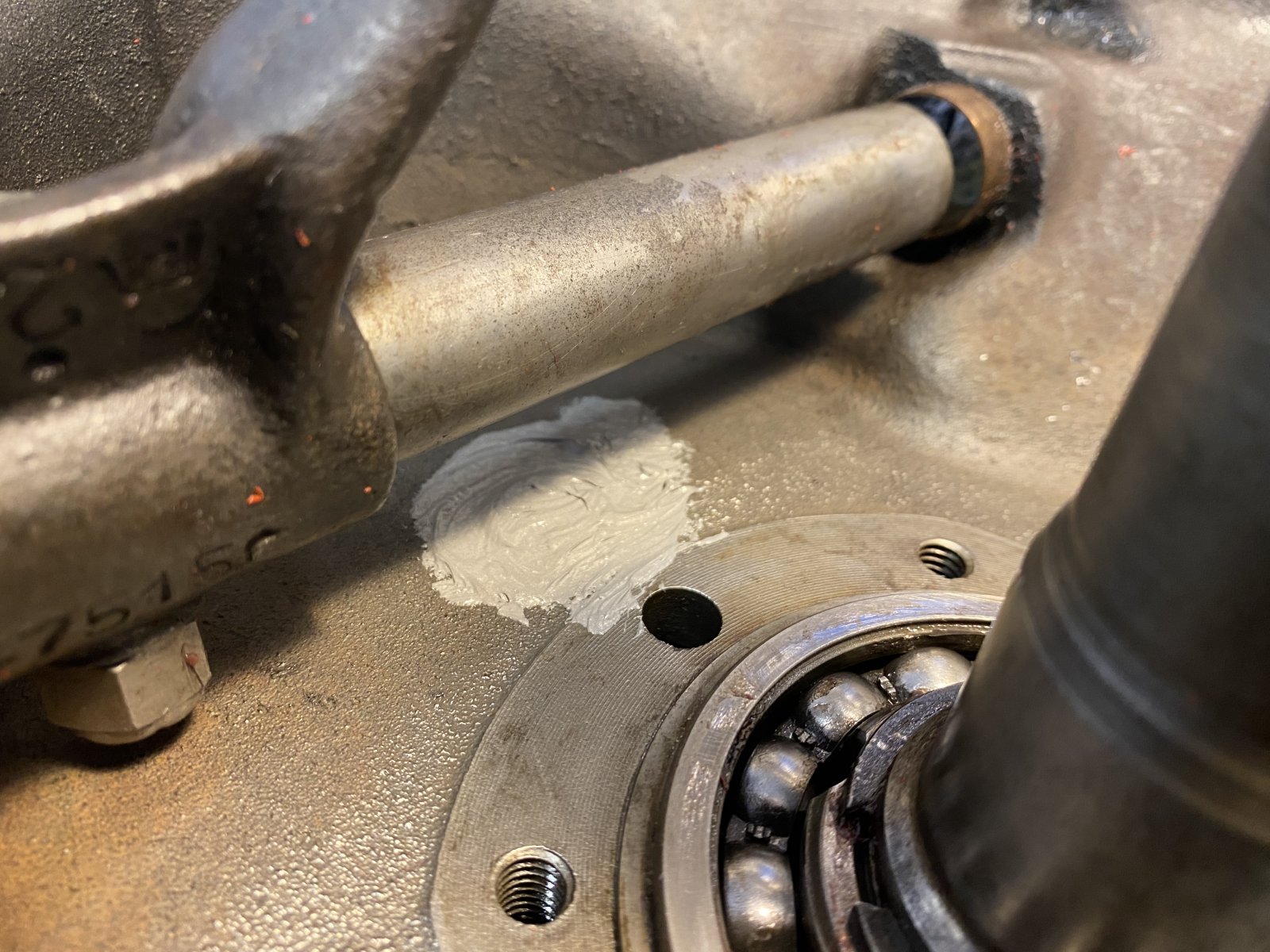

    D526D132-C625-46DB-B422-F1494436A491.jpeg F317D559-401E-427D-A56D-57266ACED383.jpeg E587FD95-8161-4E50-8BE8-713CAE53E57F.jpeg 2C6FBDB0-B37B-49CB-930B-452A8167D3B1.jpeg

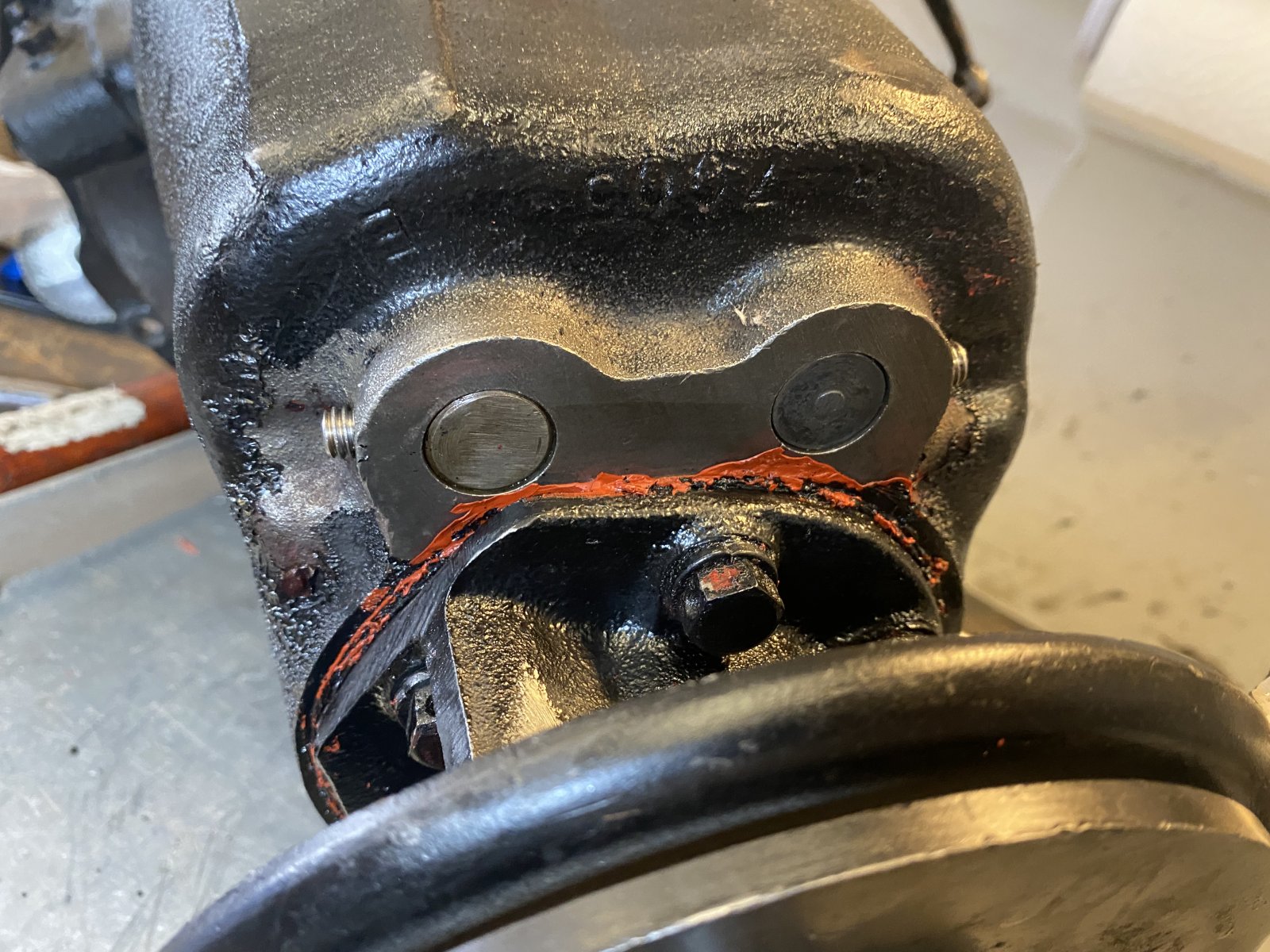

    Here's that trick Fairlane 500 showed me who has a 34 down on the south island. NZ …been In his family since it was new, ?? right? Also RH hand drive.
    I need to seal the set screws and the ends. Should never leak again I hope!!!

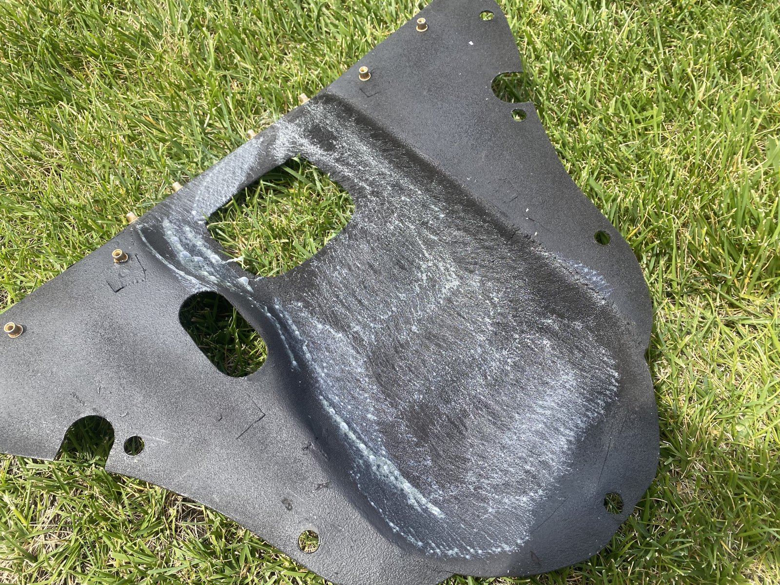

  7. 33Doll
    Posts: 1,676
    33Doll
    8E6CFE74-72B2-4682-918A-267E351AC29F.jpeg 1BEB3068-14F7-4EE2-AAA9-0A085F21F4A6.jpeg F25E3CD5-317C-4972-BE85-A7AD6779CC0E.jpeg Man I’m just full of creative ideas this week!!!!

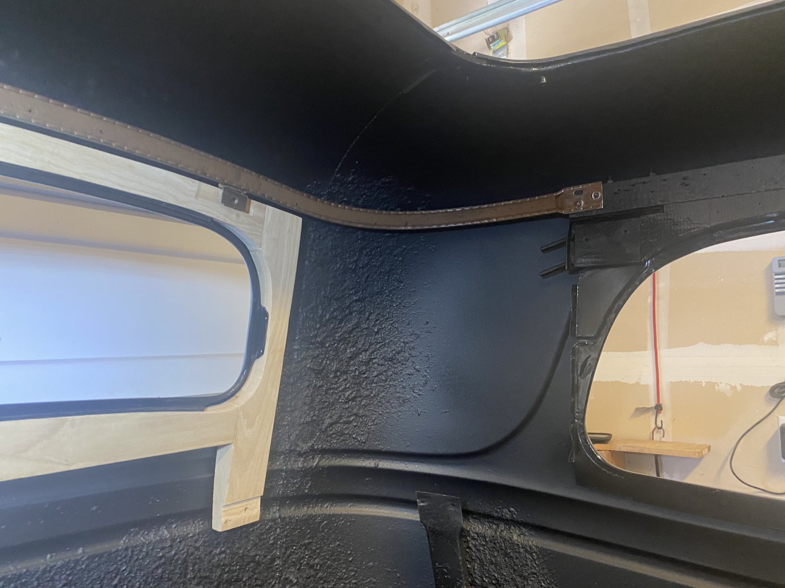

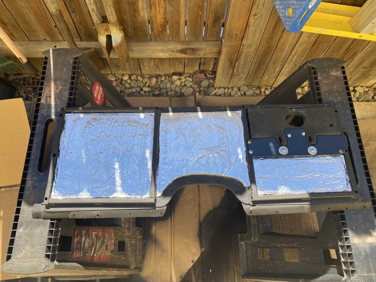

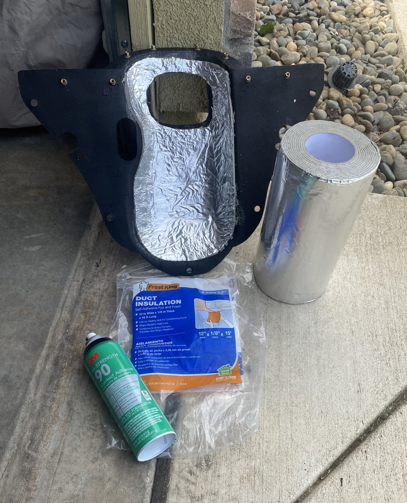

    Testing my Home Depot supplies to save money on expensive dynamat from hot rod places!
    Stogy, Jim Bouchard and AHotRod like this.

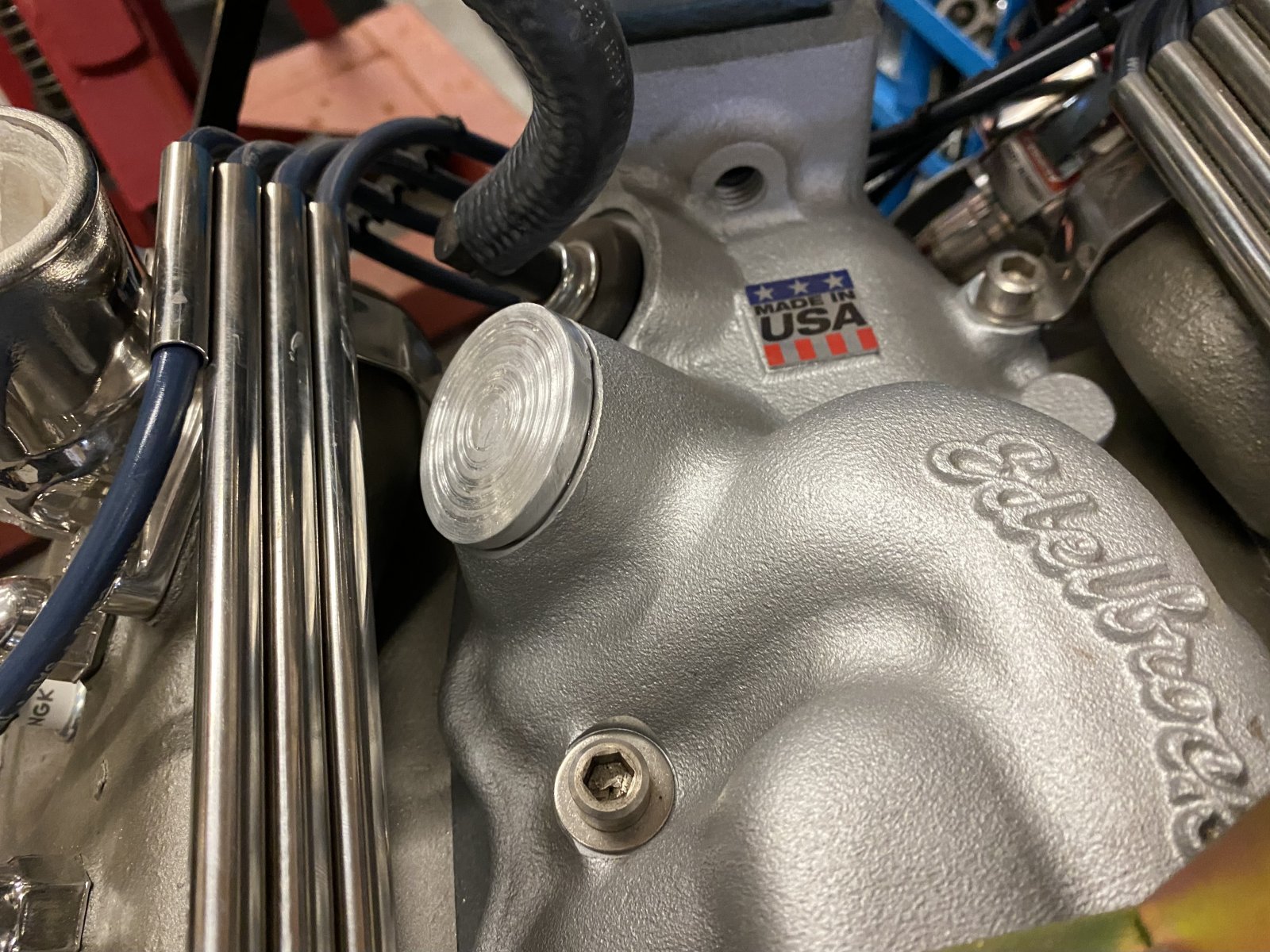

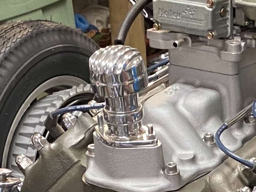

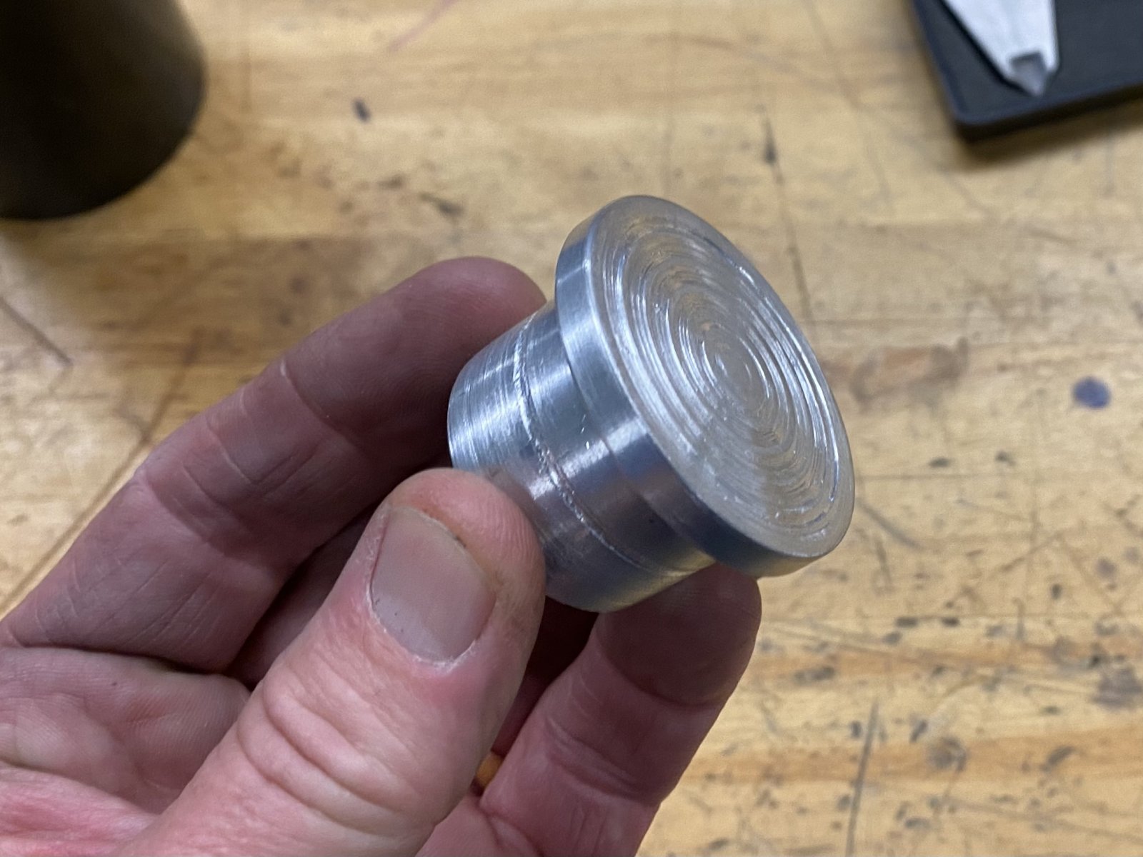

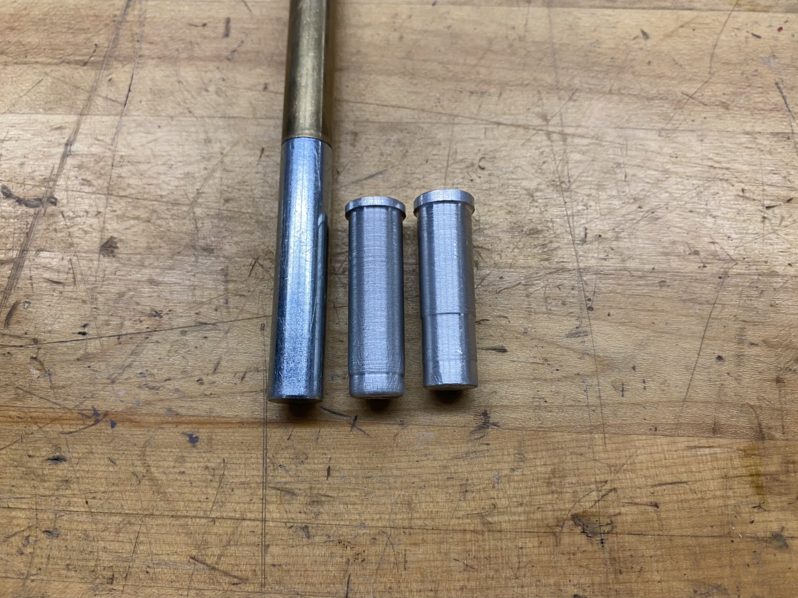

  8. 33Doll
    Posts: 1,676
    33Doll

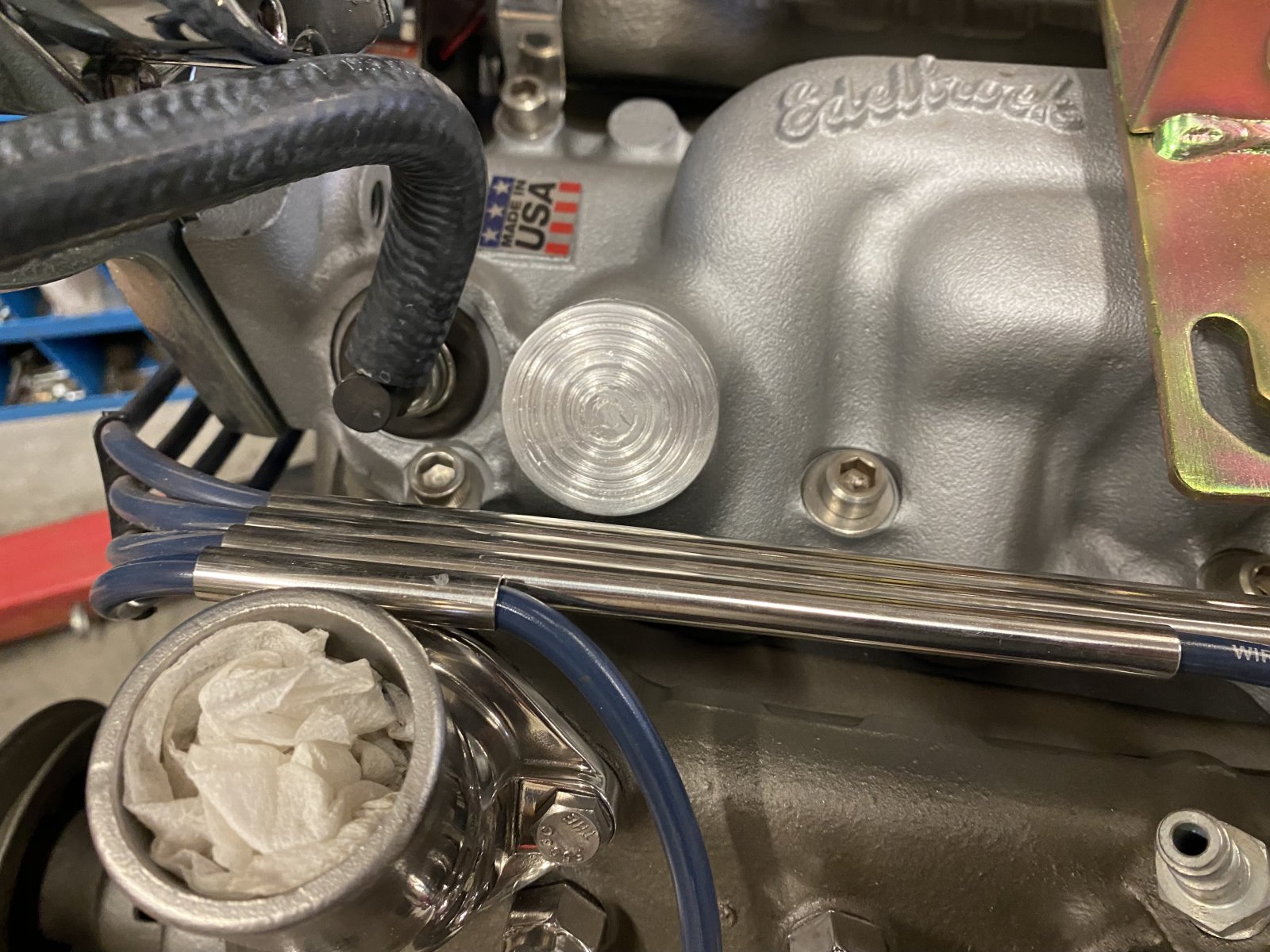

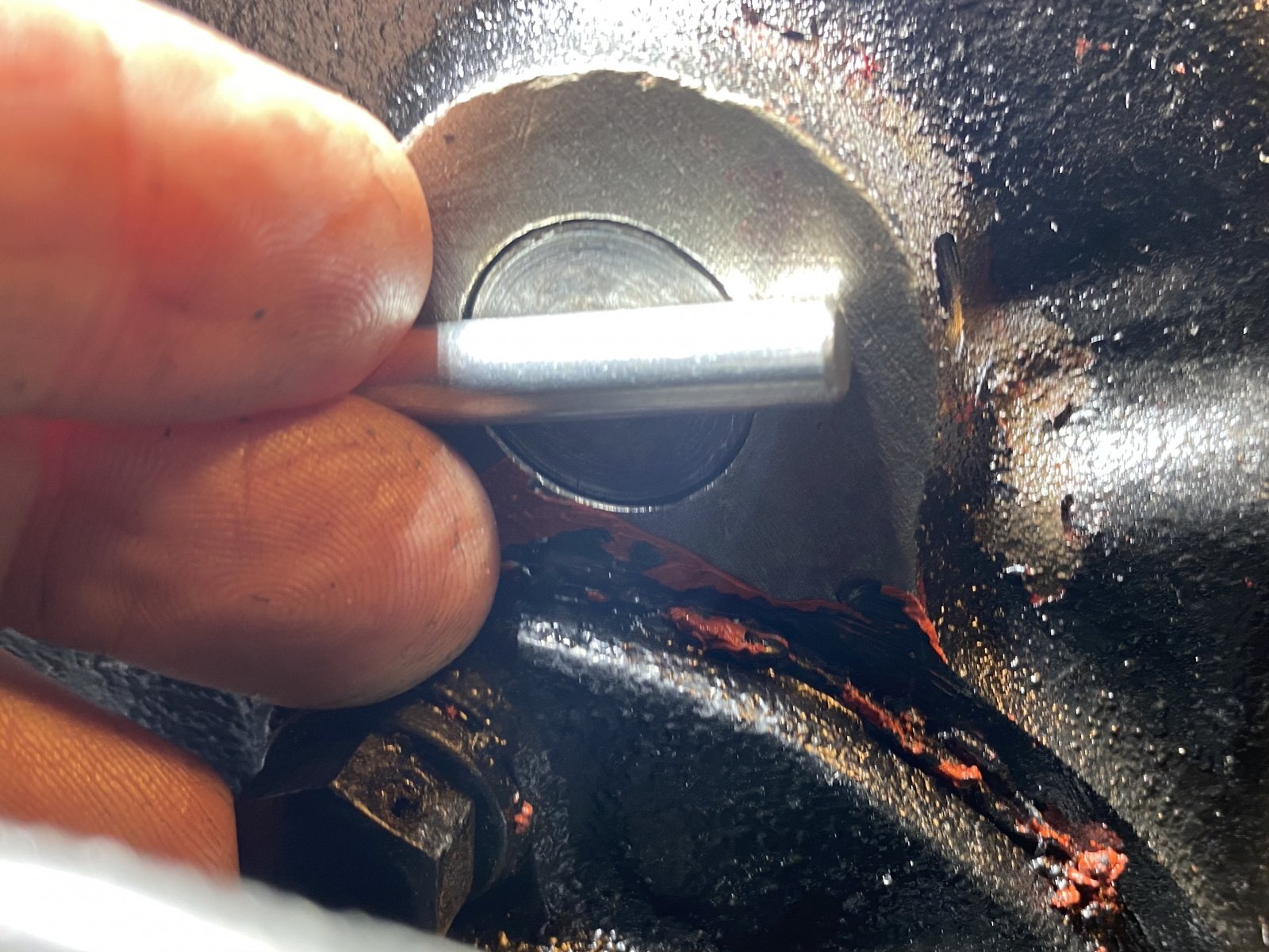

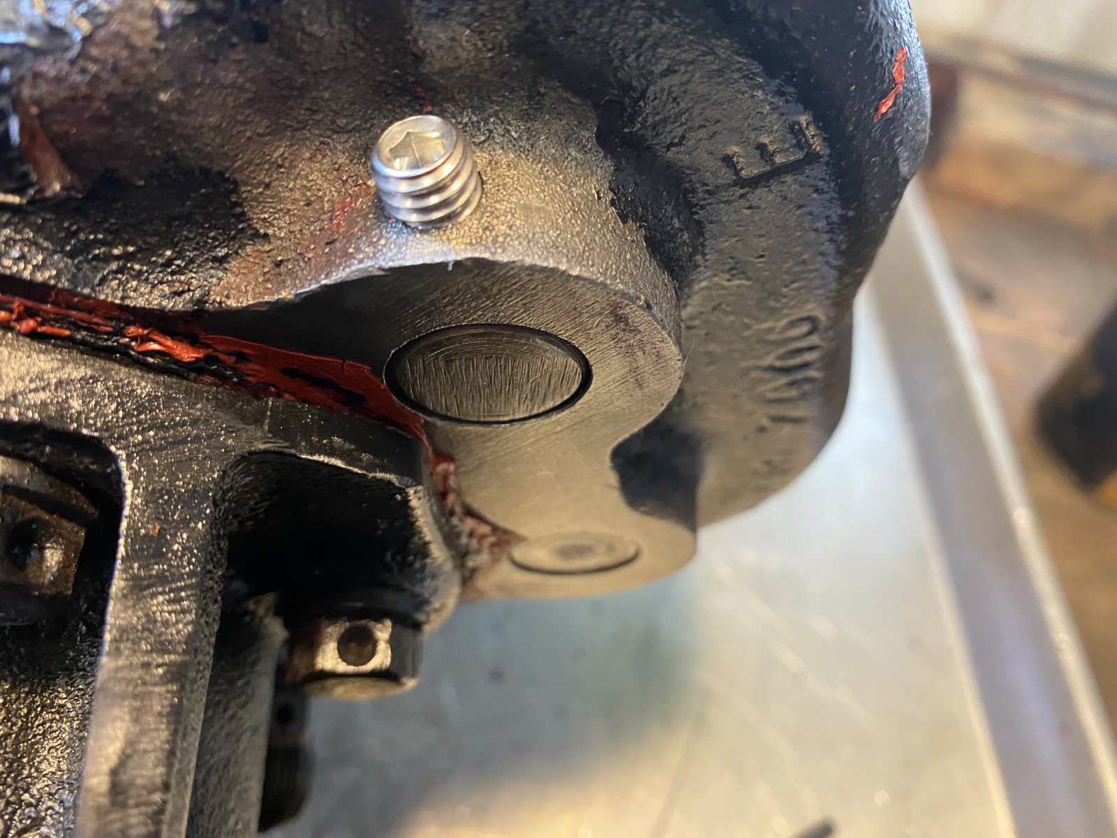

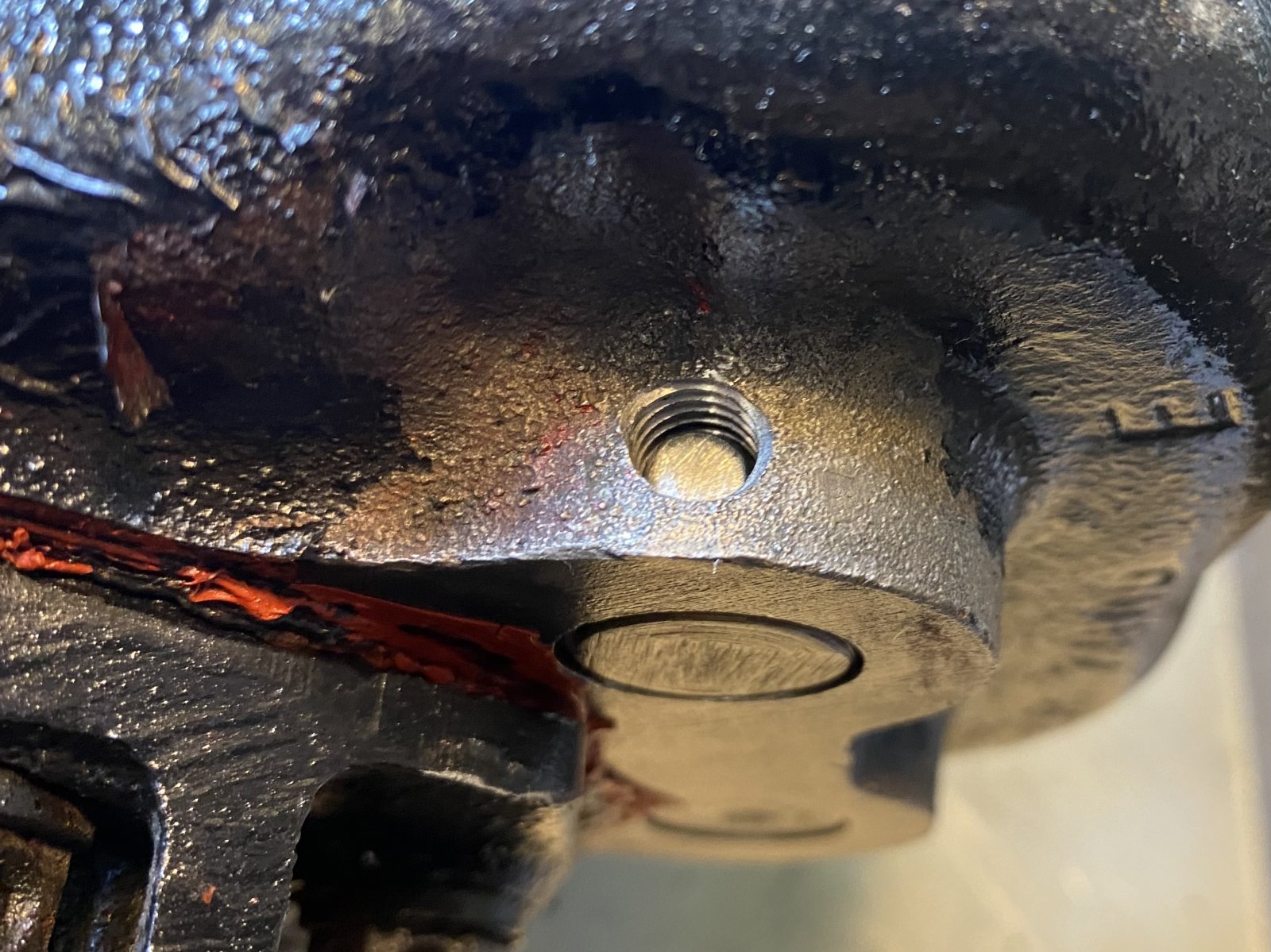

    8FE514C0-2A41-4809-A21B-AEC52A3D0653.jpeg Boy! I can’t believe how much disagreement there is about this stupid fuel pump Rod on all these forums!
    Jalopy journal Ford, Hamb, F-100,
    No it won’t lose pressure! yes it will lose pressure! no it won’t squirt out the Hole! It was to be early Flathead ,no it was late flathead! Well…****!

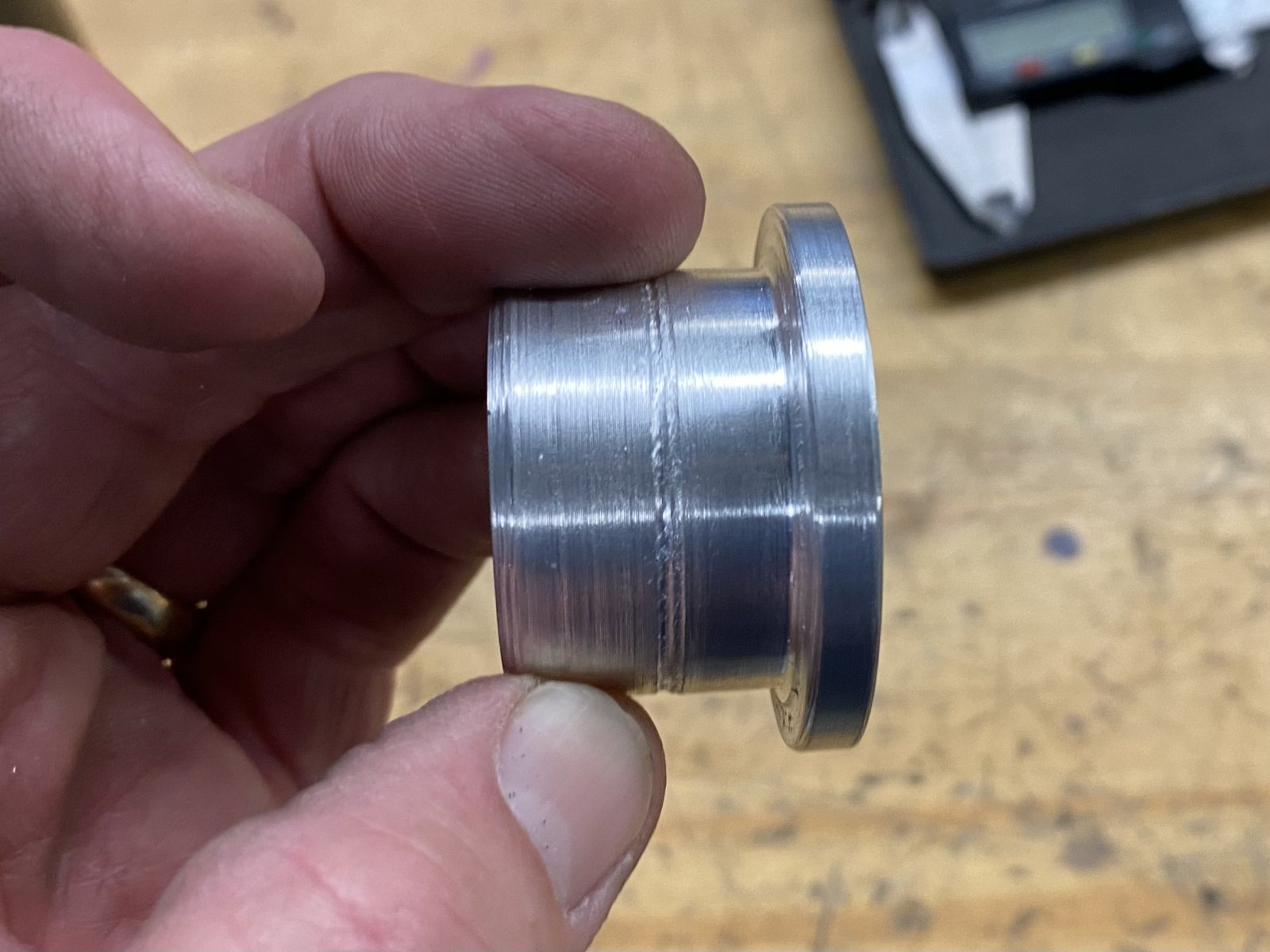

    here’s my solution, since Flat Head Jack is not around anymore!
    I made a plug out of aluminum tapered A little at a time smaller than the rod at bottom, and bigger at the top. ( since you can’t really measure the I.D. Of the bushing with the engine together)
    Pound it in with some blue Loc***e, and call it good! Yes??? No???
  9. 33Doll
    Posts: 1,676
    33Doll
    F6C08124-A836-4BD5-B496-3449E3283FC7.jpeg F6F0BD6B-4970-427C-B47A-77ABA7AE4066.jpeg Didn’t need any Loc***e! Aluminum fit perfect! kind of has A grip in the hole!
    Ain’t going anywhere!
    Stogy likes this.
  10. dumprat
    Joined: Dec 27, 2006
    Posts: 3,573
    dumprat
    from b.c.
    Yes completely fine. It's only got to hold back 60 psi.
  11. 33Doll
    Posts: 1,676
    33Doll

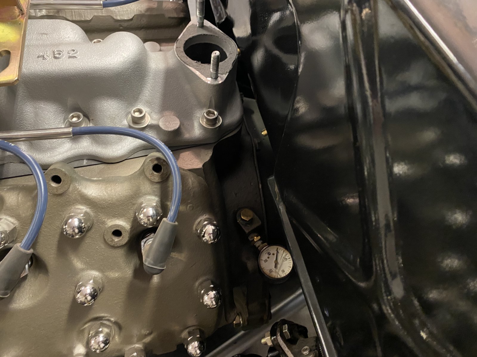

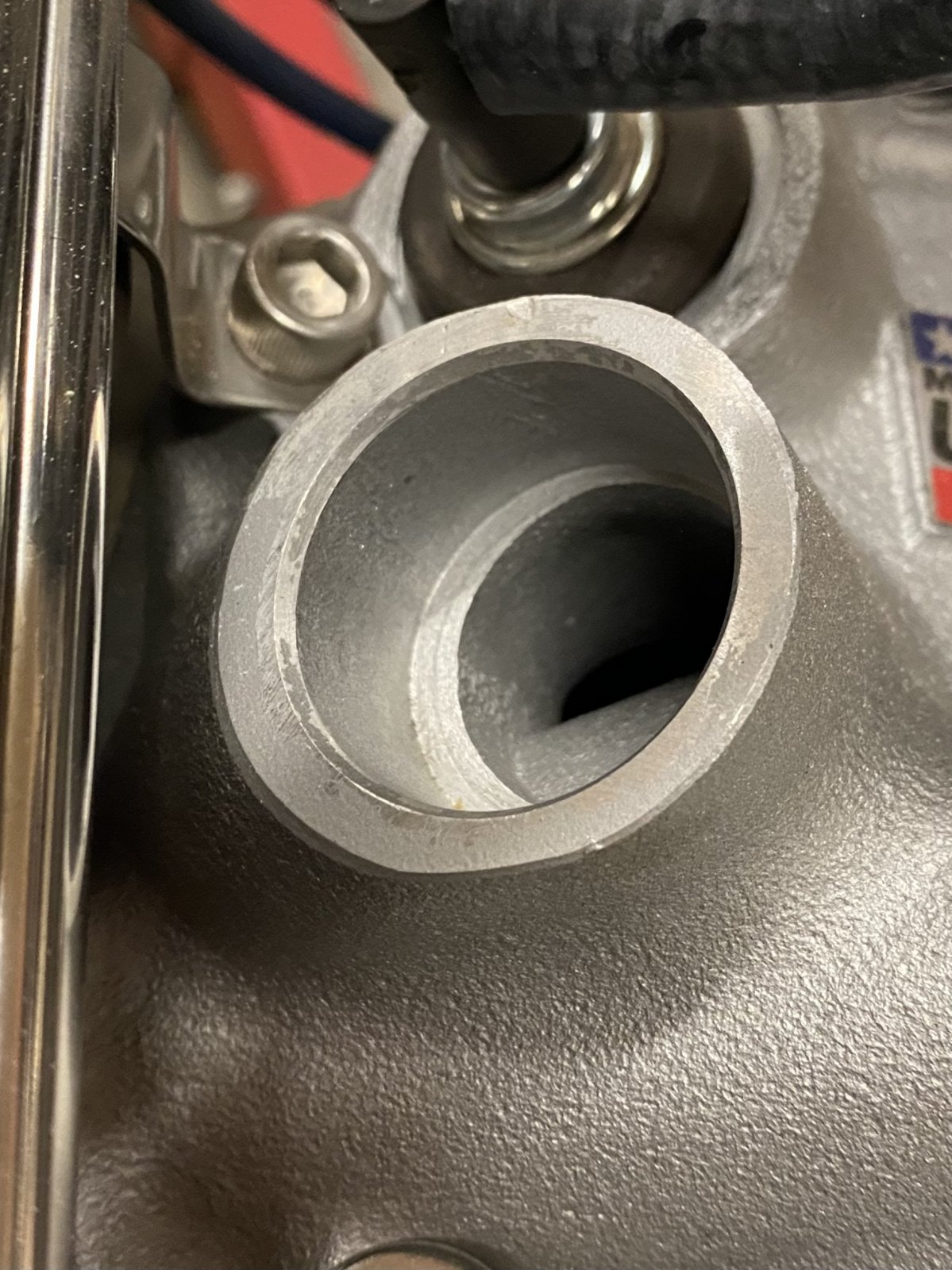

    8658E20B-4D5C-46D1-AABA-49687FA9B59A.jpeg 78889124-C708-48DF-A4B8-42F21D77AD22.jpeg Next up: need to make a aluminum plug to plug the front oil fill, since I’m using the rear one now, where is the mechanical fuel pump was, It has bigger water necks on it now, the old fill tube/breather won’t clear anyway. I have a nice OTB finned one to replace the Mechanical Fuel
    Pump, on the rear.
    guthriesmith, Stogy and Jim Bouchard like this.

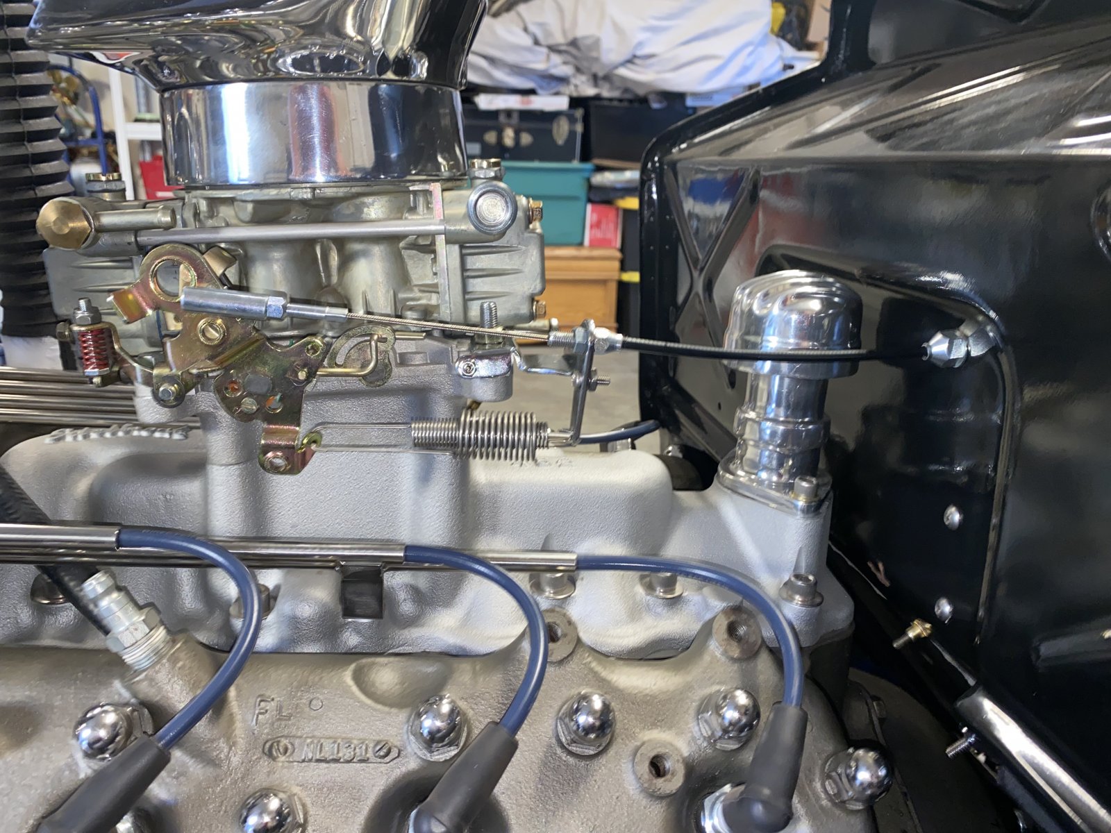

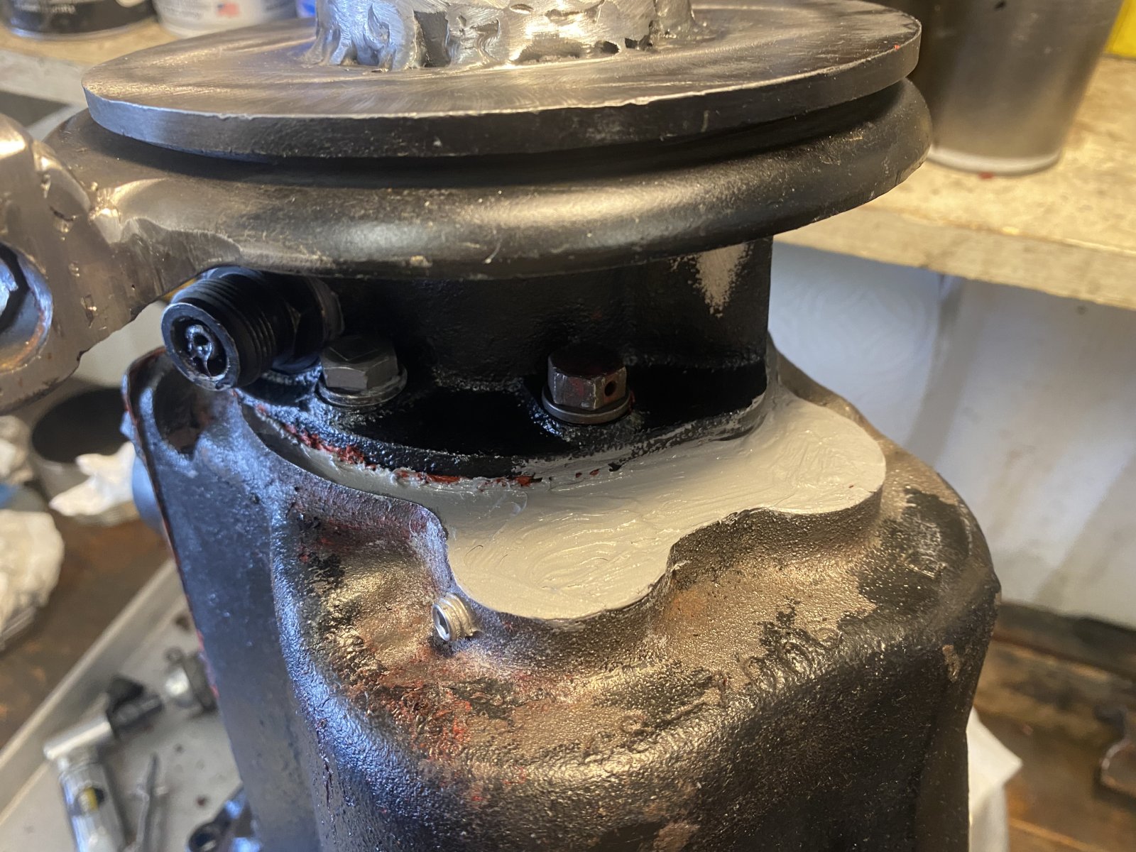

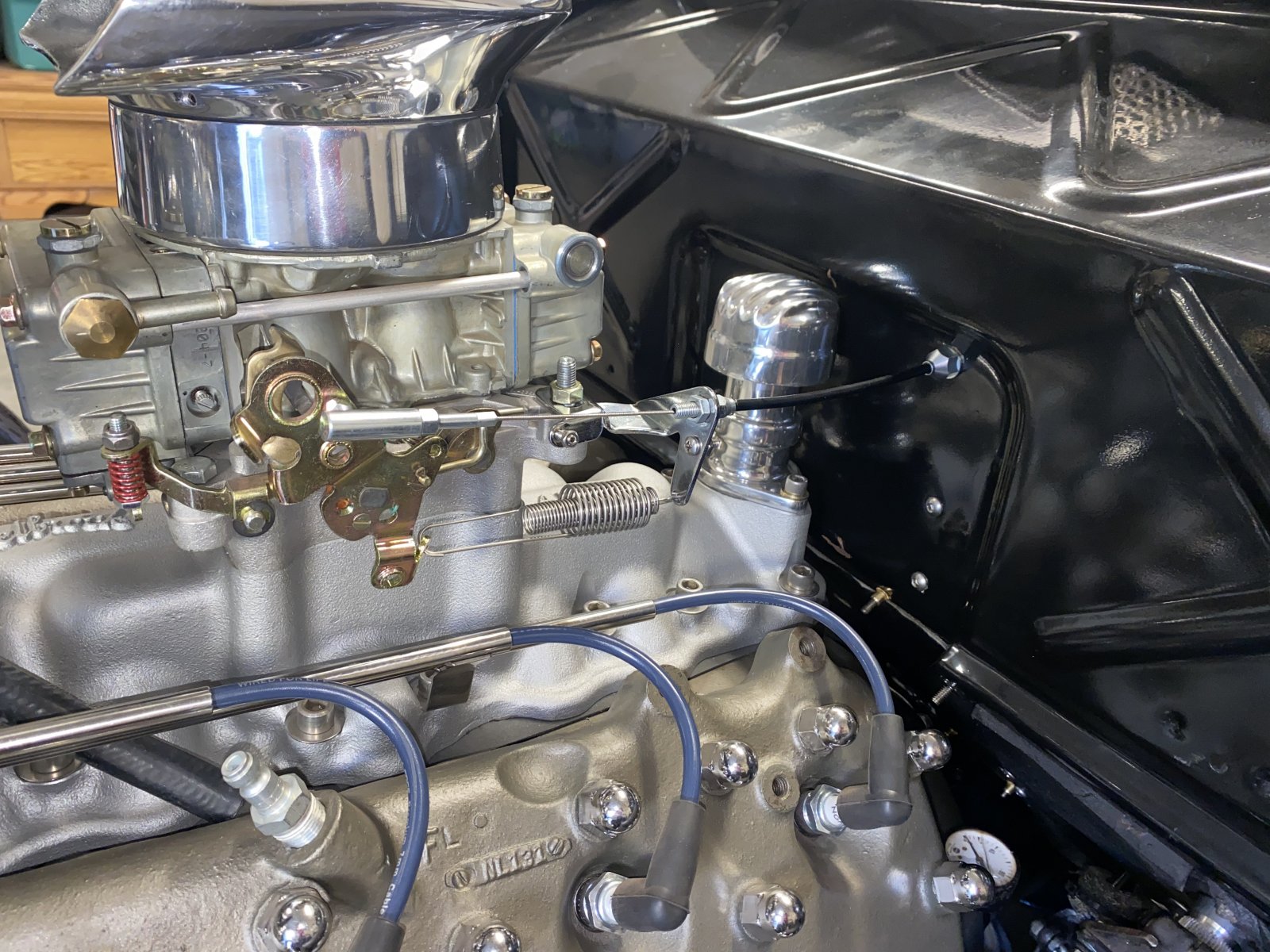

  12. 33Doll
    Posts: 1,676
    33Doll

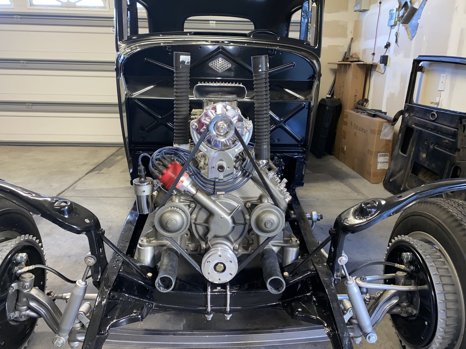

    F0ADC15C-E73D-4A82-B50F-1F6B5A8F87C4.jpeg 55ACBB09-1368-4C7D-9107-C283E6BD96A8.jpeg 127813AD-DD77-486A-B559-6B825DC9442A.jpeg 6E77F0AF-795C-4DB5-BF08-82A6A386AC58.jpeg Made a Plug for the front oil tube, out of 2" round stock
    Tapered it also.

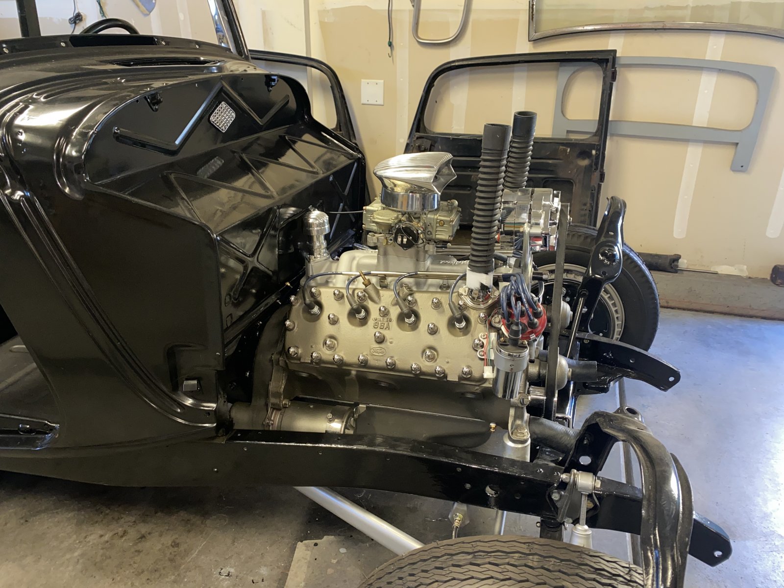

  13. 33Doll
    Posts: 1,676
    33Doll
    0872C09E-44C6-4E21-8092-AD1EA6AACE31.jpeg 760720C3-5CB6-493B-9925-9F3E947449C0.jpeg 7CDD9CBF-F341-4AB8-96CE-C9B9DE25B816.jpeg A little loose Sealed it up!
    With my favorite Ultra Gray Permatex.
    If I need the front fill some day easy to take it out.

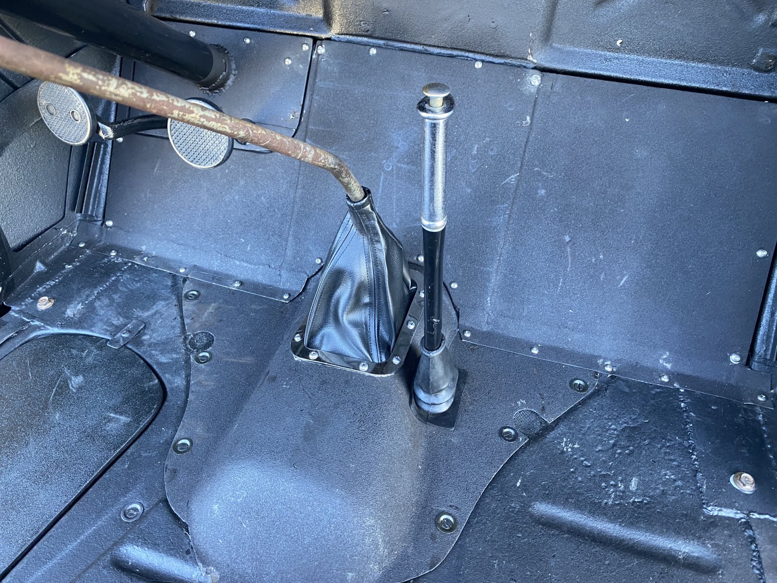

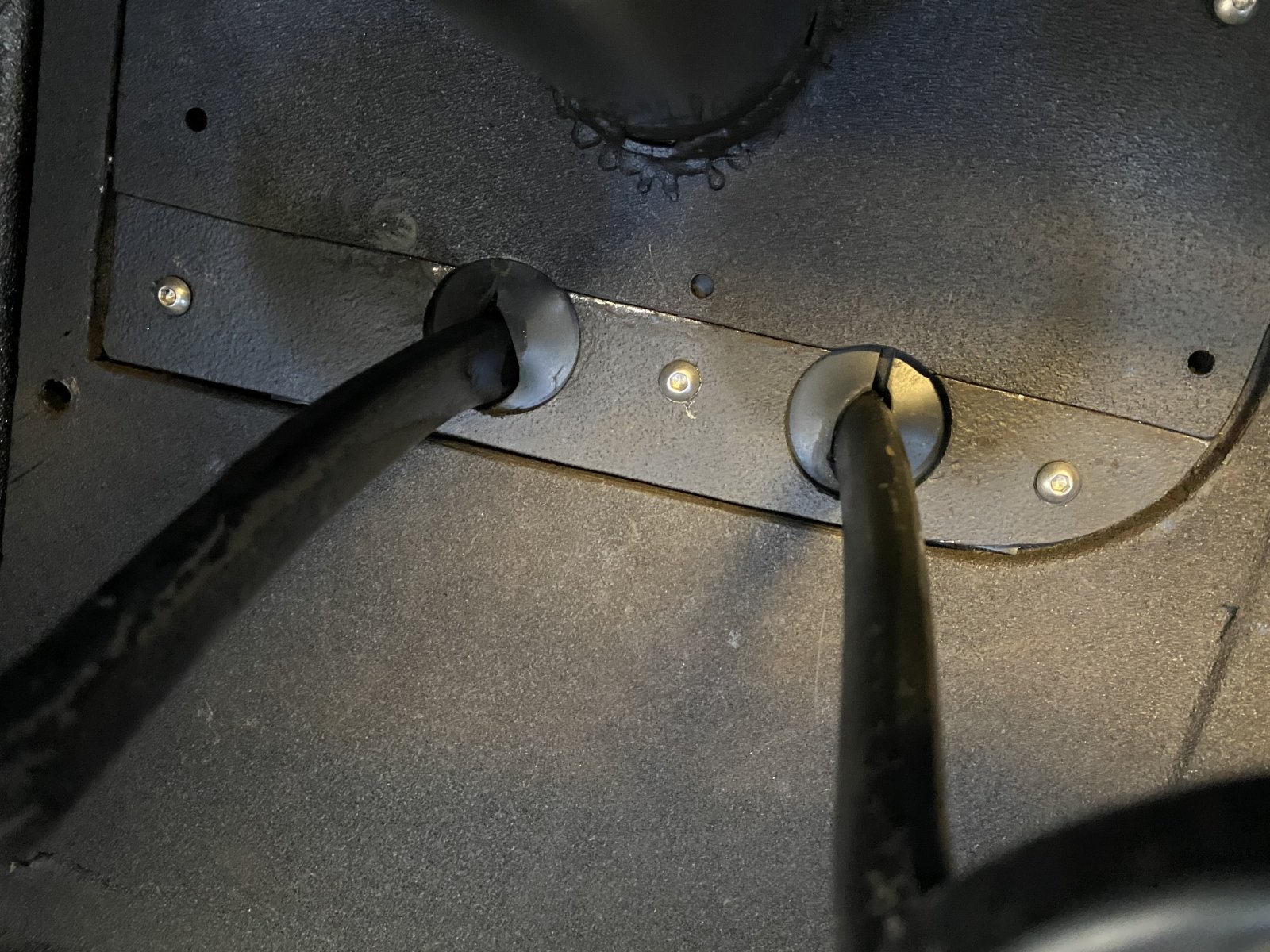

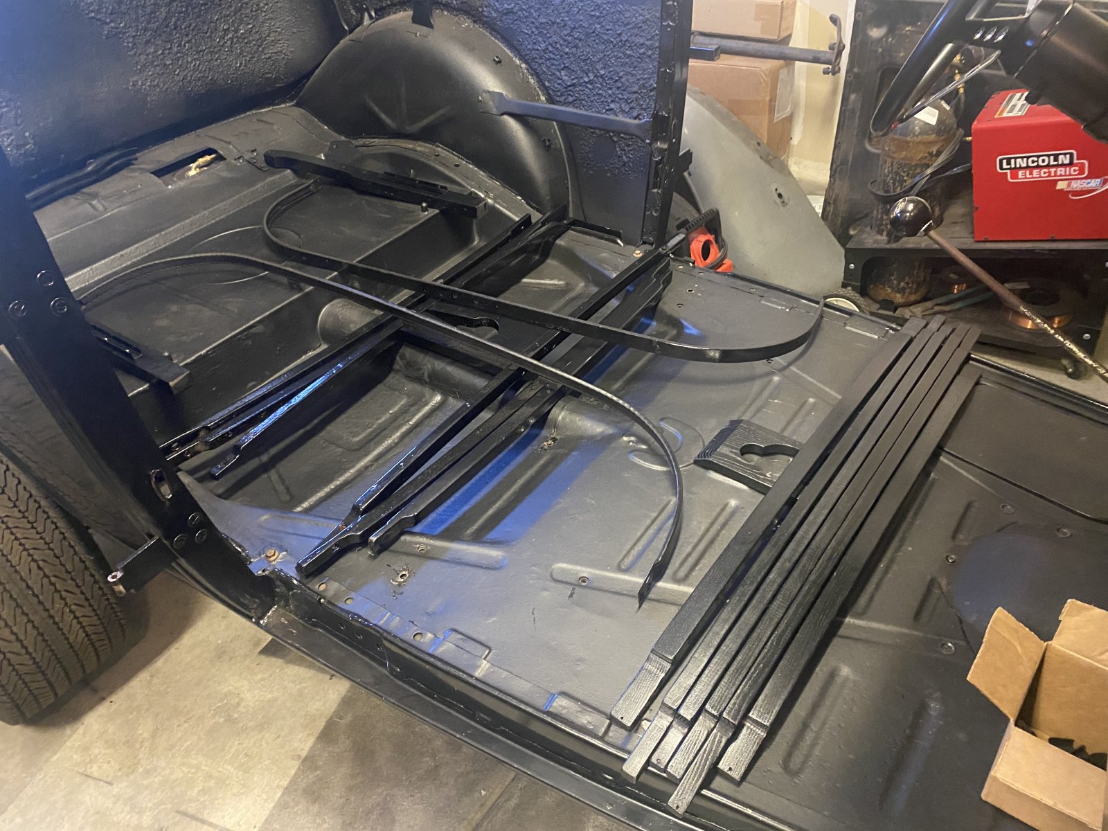

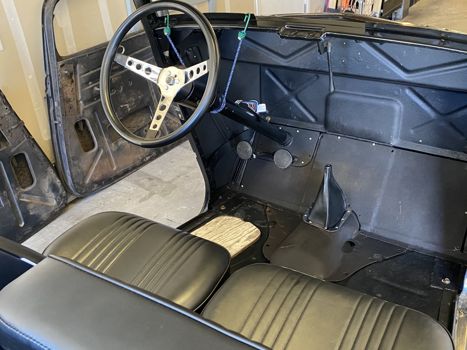

  14. 33Doll
    Posts: 1,676
    33Doll

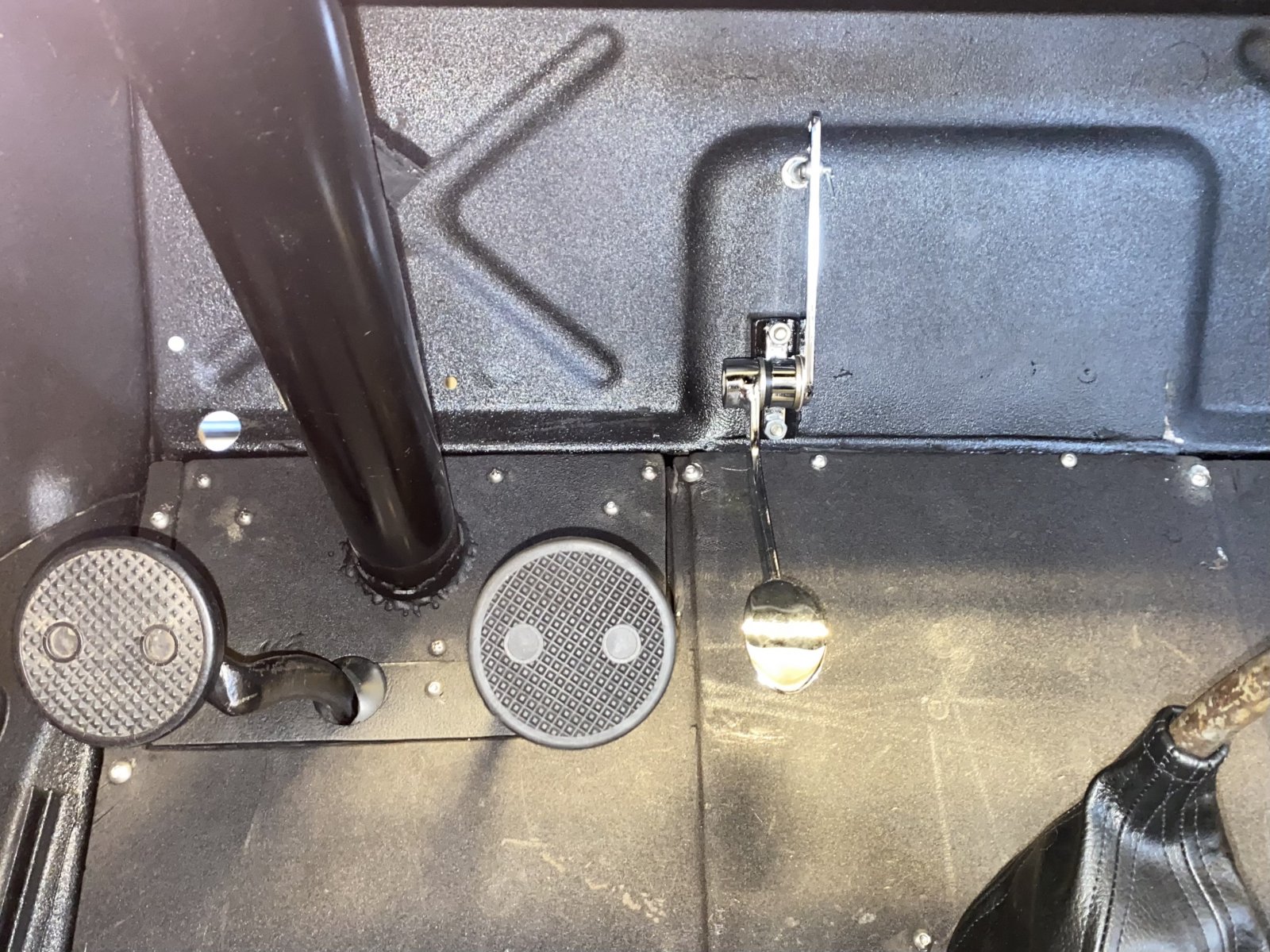

    1DB8AC8C-57AE-41C5-9F6F-EEDFC334CA55.jpeg 9AD76266-3DA8-485C-AF3C-18A8EC514784.jpeg E71577A3-B9C5-40E9-8065-733D164563AB.jpeg 14140428-D5AA-4418-AA4B-9424A7ED5011.jpeg B8311195-16E0-40A4-9246-E784F804BF40.jpeg 64A1435F-A562-44B9-9A03-CF2D58B75959.jpeg Got A lot of small tedious stuff done!

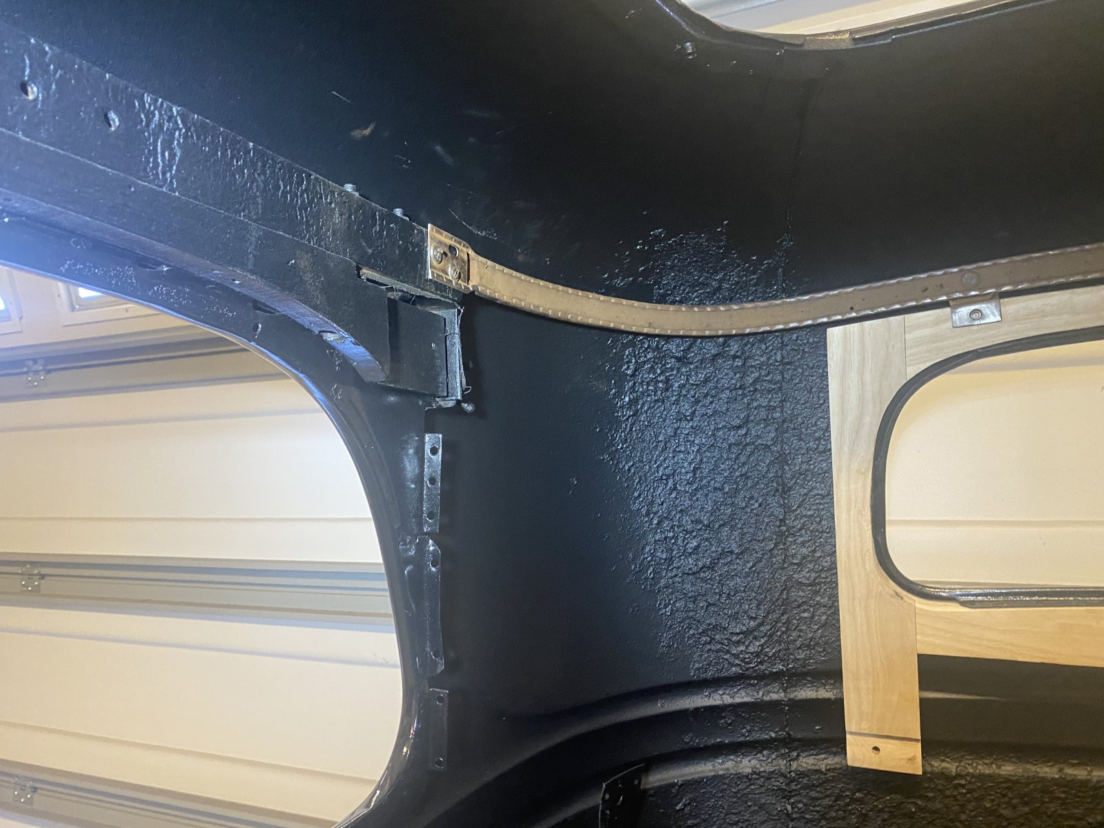

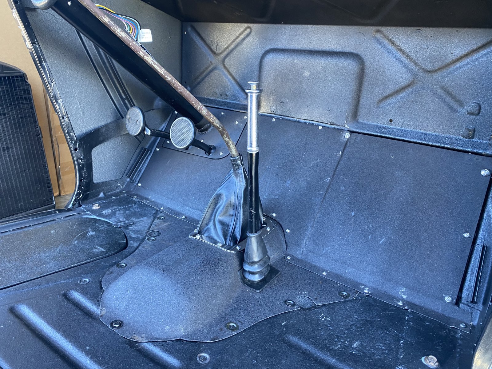

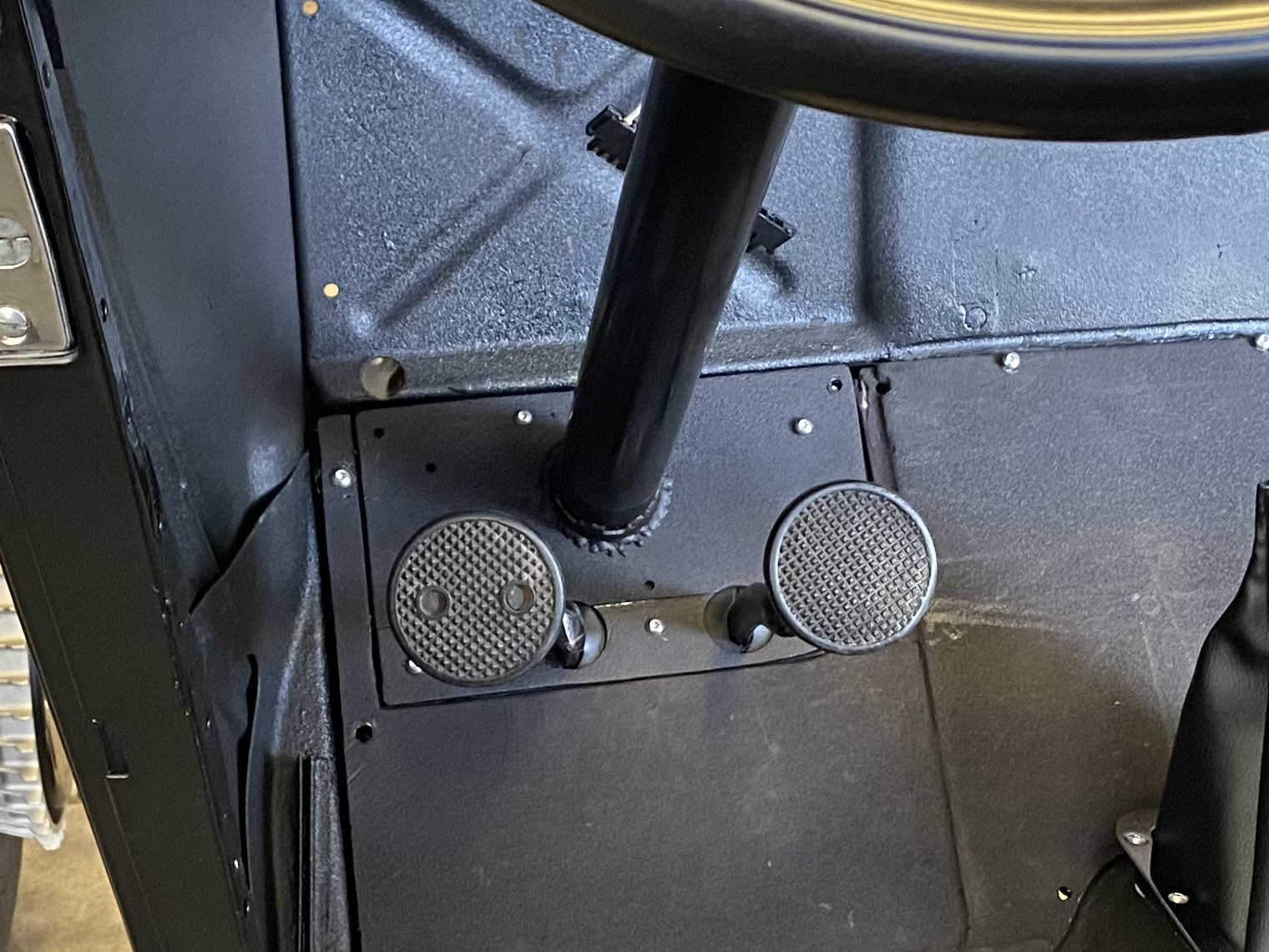

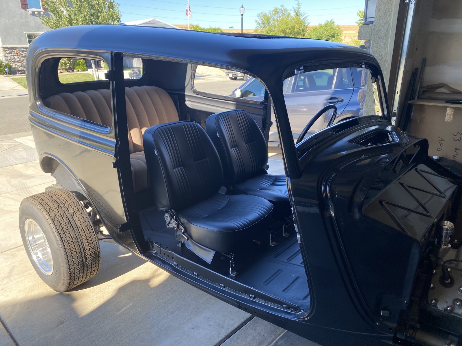

    Finally! These floor boards and pedals were killing me! But I finally got it!
    So… original insert grafted into metal floor… sandwiched original pedal Foam between, heavy duty plates traced off the original thin stuff…used 35-40 rubber bumpers… used 1/2 pipe insulation around the pedal arms… and…. Thin rubber on top under plates inside!!! Whewww!

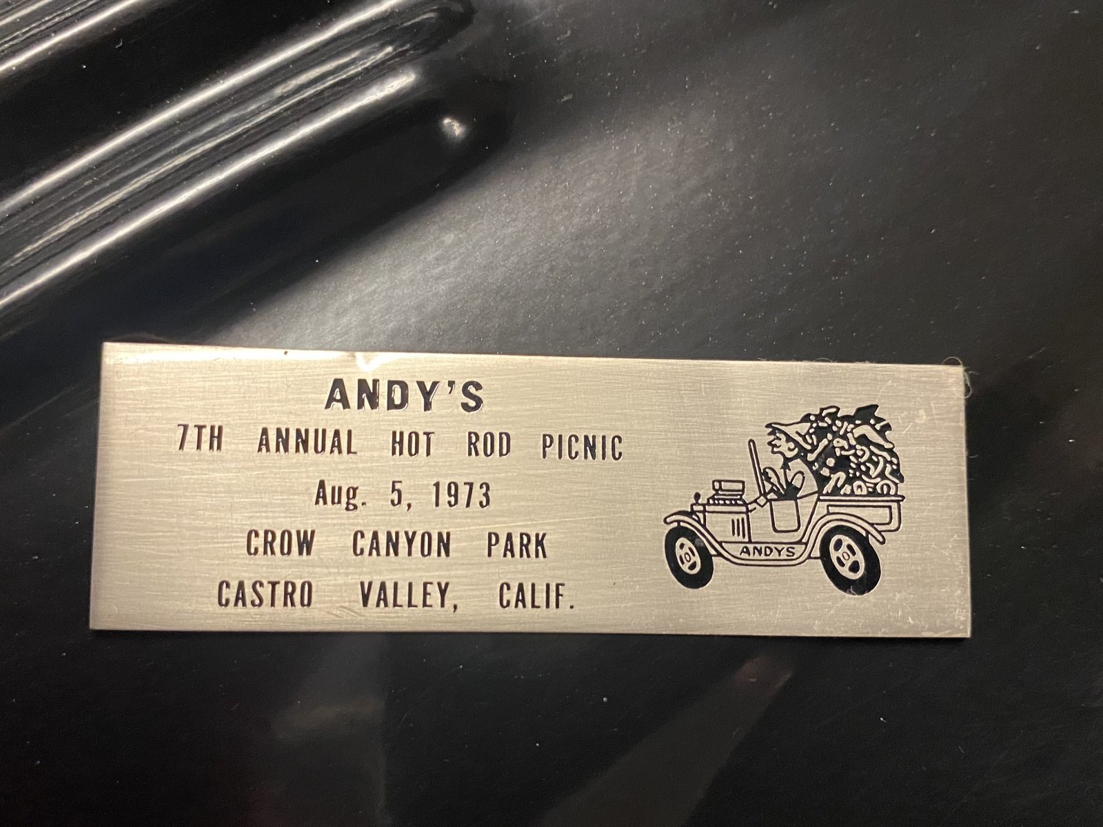

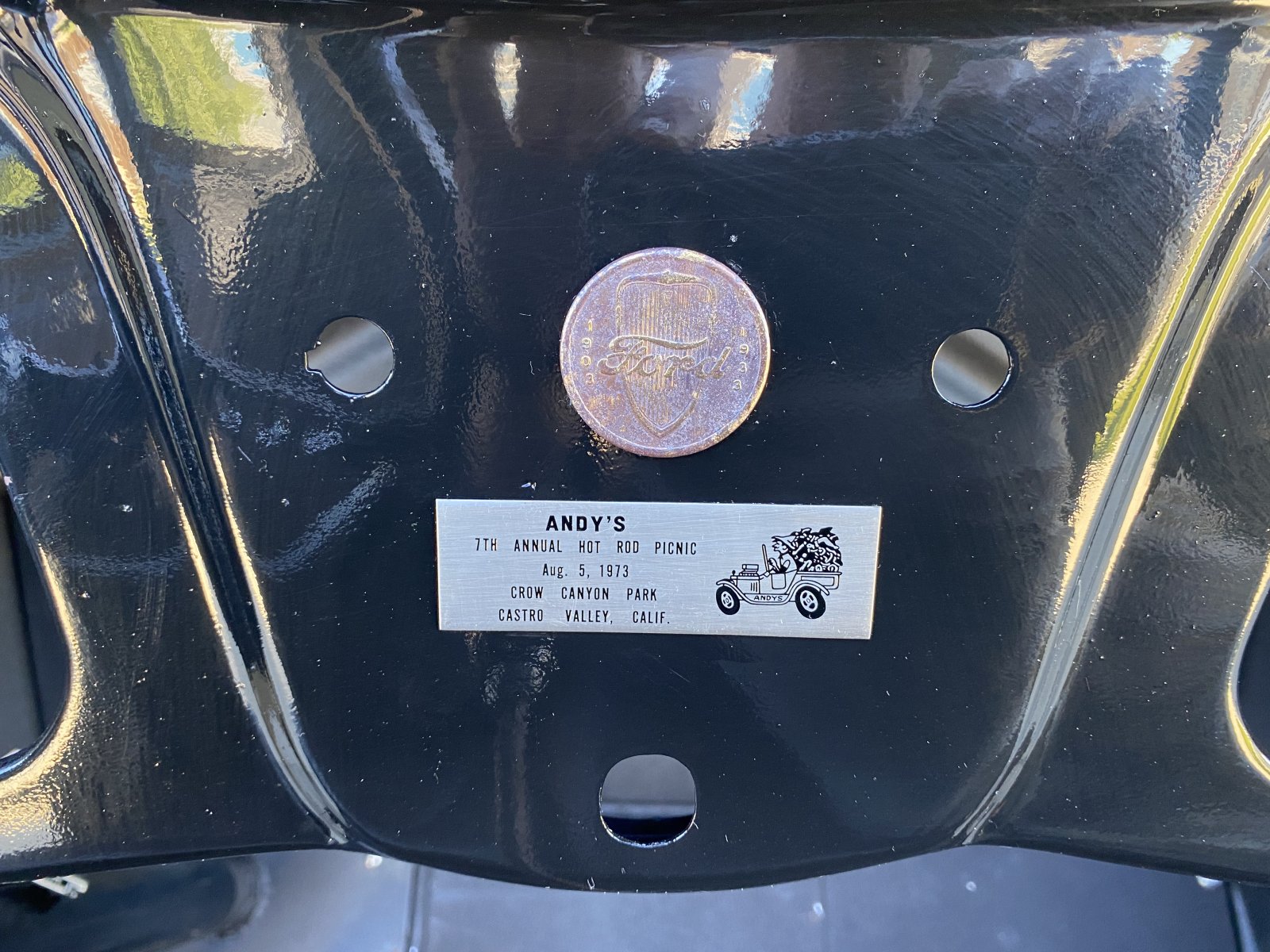

  16. 33Doll
    Posts: 1,676
    33Doll
    4F46A80E-E7BD-492C-9799-DD8E56392AA6.jpeg 86EAF80B-06E0-4D86-B8AE-D95359DF00C3.jpeg DE9279A1-A6C9-4D1E-91E9-C9E8775C566E.jpeg 8D7AFE01-2523-4AA2-95B8-37DDBDA3773B.jpeg 343CBCDA-C6EC-4BDC-8C54-749DB4C34C14.jpeg 286E300C-0362-4250-979B-1AC7C31CB371.jpeg 04CE5899-DCD6-4558-8EEE-10887B621B23.jpeg Also With History on the “33’ Doll”

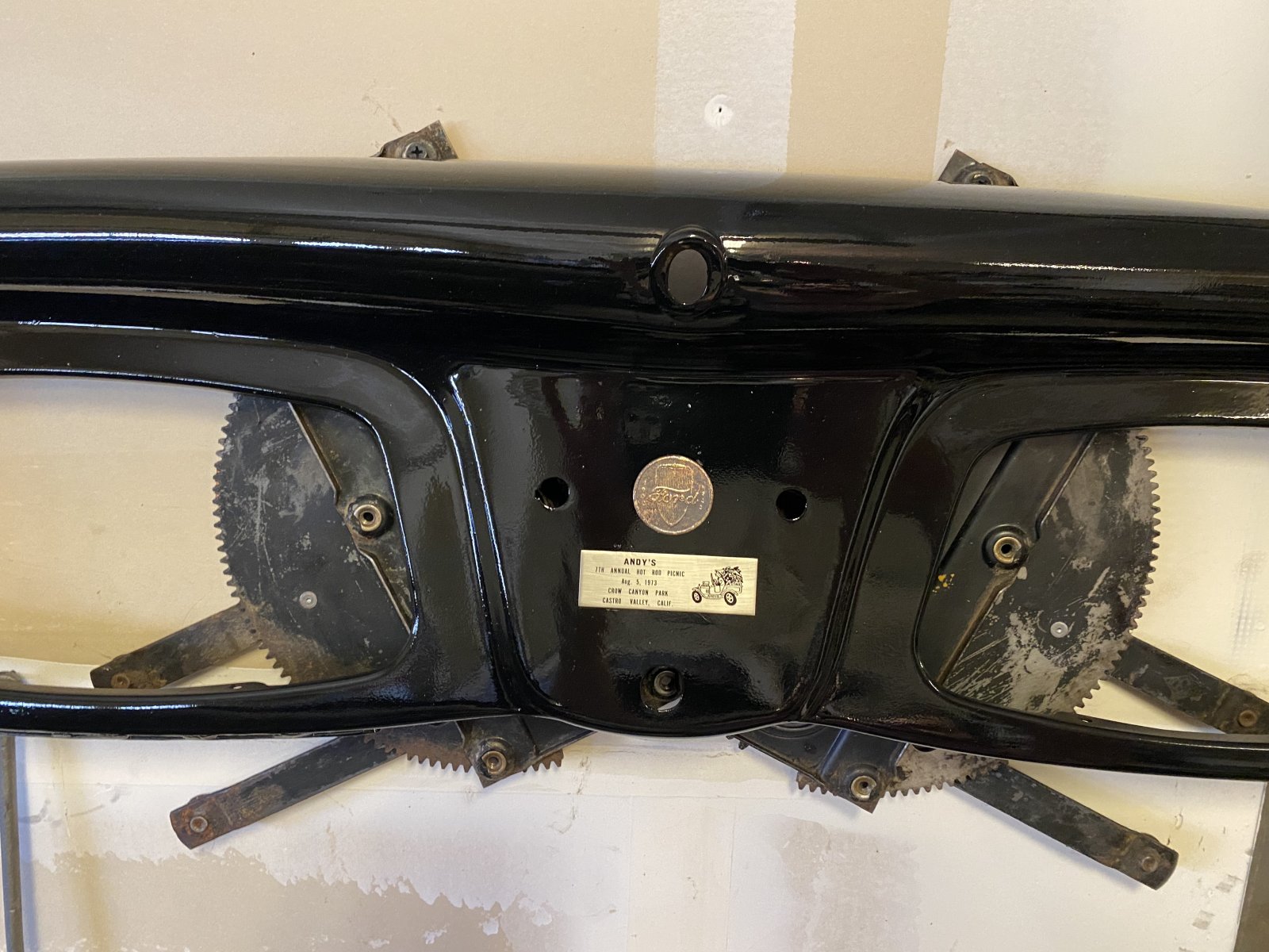

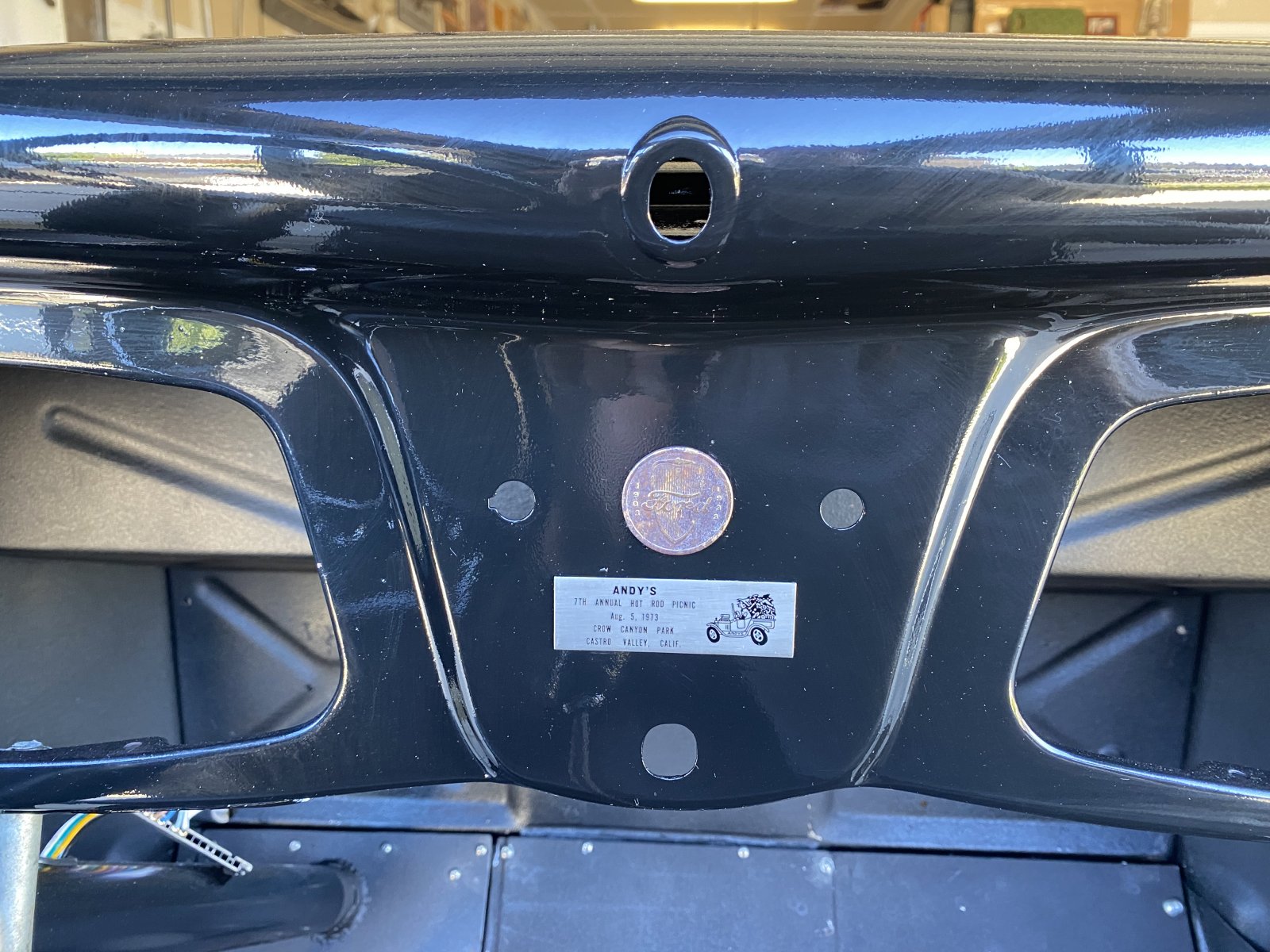

    And honoring my dad my uncle and my aunt Dolly I put things in the car here and there for their legacy. My dad and uncle are still alive, but Dolly p***ed probably five years ago?
    So the Crowes Canyon 73 picture goes with the plaque, the rear fenders are going to be my uncles 34 where I have a picture of me as a kid, and he made these belt buckles for me back in the 70s that I decided to try and figure out what to do with. Just little things

    I have that same Andy's Picnic dash plaque.

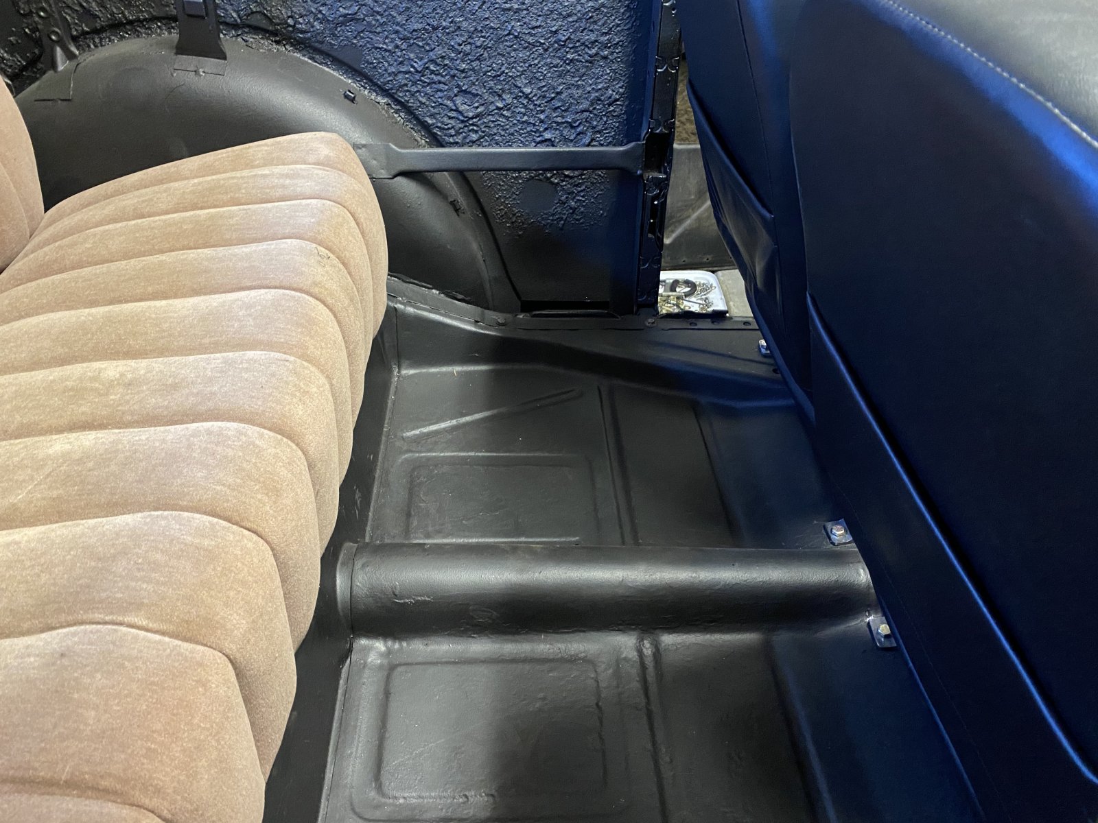

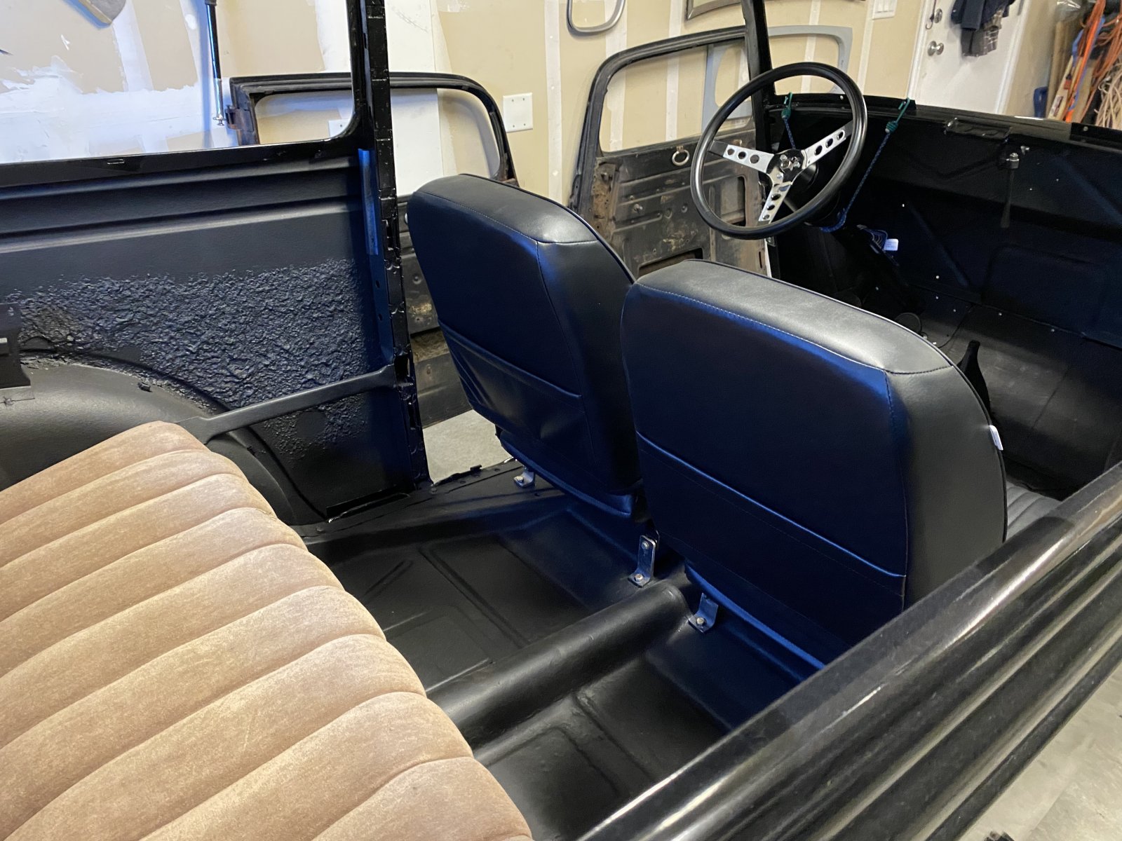

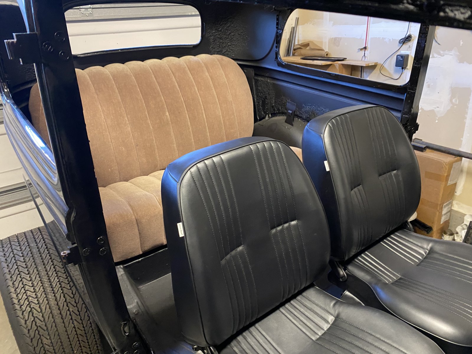

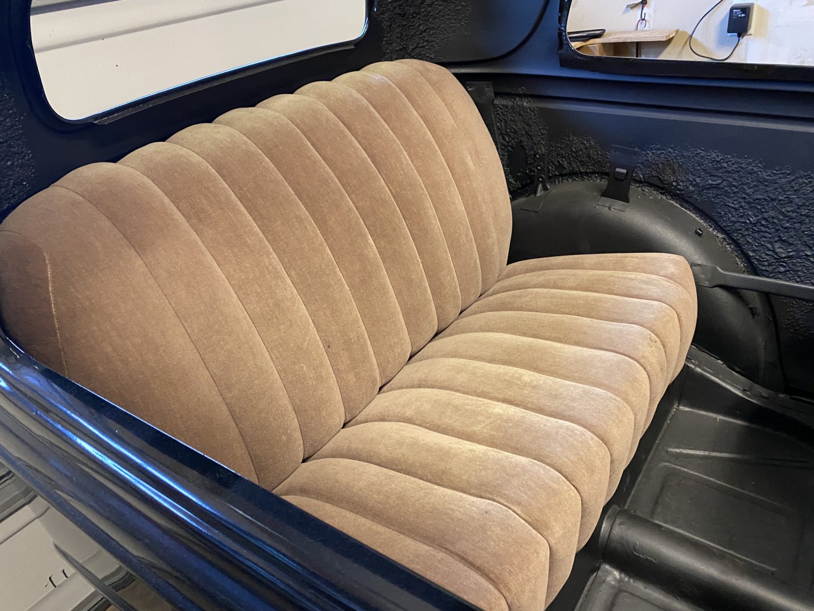

    Opinion:
    should I dye the back seat Black?
    Or just leave it?
    Does it clash with my theme to much?
    I love the original sea because that’s what I remember growing up and all that leg room. Which was originally
    Tan. I watched a lot of videos on YouTube how to dye a black with RIT
    Dye. Doesn’t look too hard.
    Thanks
  19. Ford blue blood
    Joined: Jan 4, 2009
    Posts: 801
    Ford blue blood
    I would dye it, the fronts are different from years ago. Your efforts to keep it as it was are commendable.
    Stogy and tr_rodder like this.

    I'd leave the back seat alone. Just because.

    Change the fronts to match the rear.

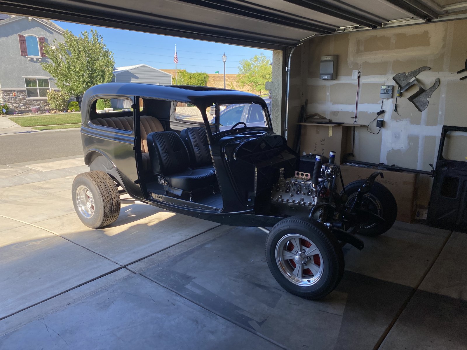

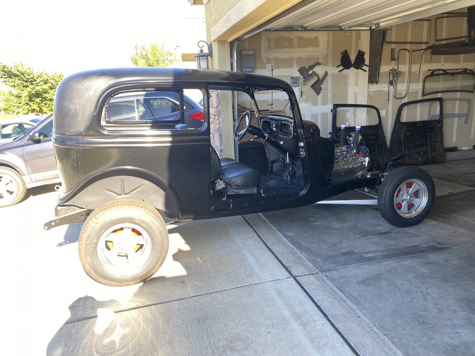

  23. 33Doll
    Posts: 1,676
    33Doll

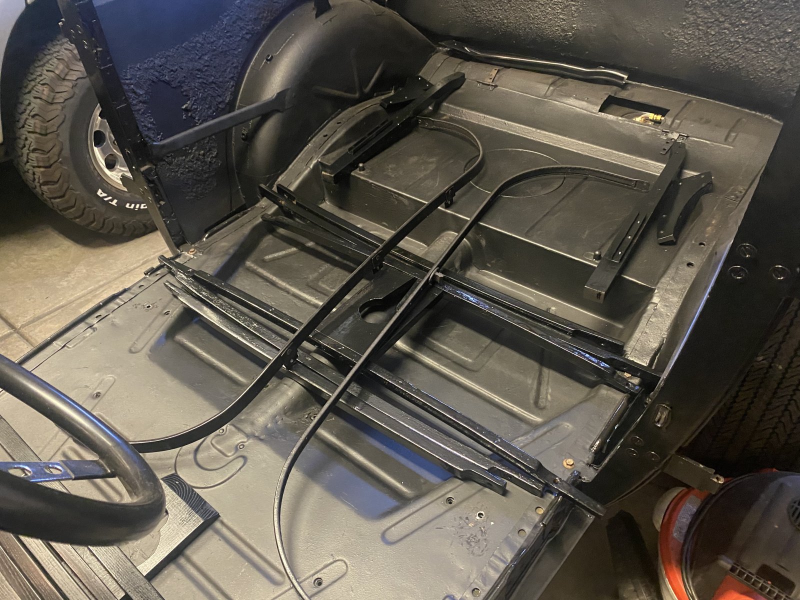

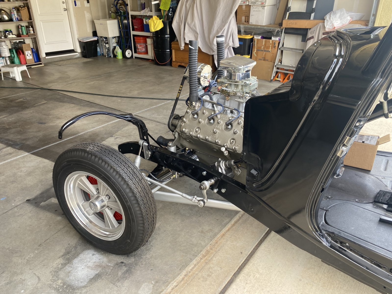

    32201793-B0EF-46CD-99D9-A1FAEAF1C16E.jpeg DC44E115-86C0-4DD3-B590-57B51059753A.jpeg 1EFB974B-8E9A-441D-8208-4A48D31B7F0E.jpeg E8E76BF4-C264-4EC9-9912-39CEC6979F50.jpeg 44402F94-7DF0-461E-8AE0-8981B19F48D5.jpeg 92CD2404-6FF3-47FF-810B-CF1C766839DF.jpeg EE9AF15A-494D-41CD-9B25-FF47ECCD3928.jpeg BF539DF1-5662-4D04-BC78-041587392903.jpeg B6ADC6B4-8F16-4A67-9B38-0273DBCB120A.jpeg 4F4ED261-1087-4EE2-9AFD-E3FE08829377.jpeg 38CCC58E-D934-4621-A8BA-8136E58093A8.jpeg 4EC8DCE5-0193-4728-B932-F2DAB3ADE219.jpeg Got a lot done today!

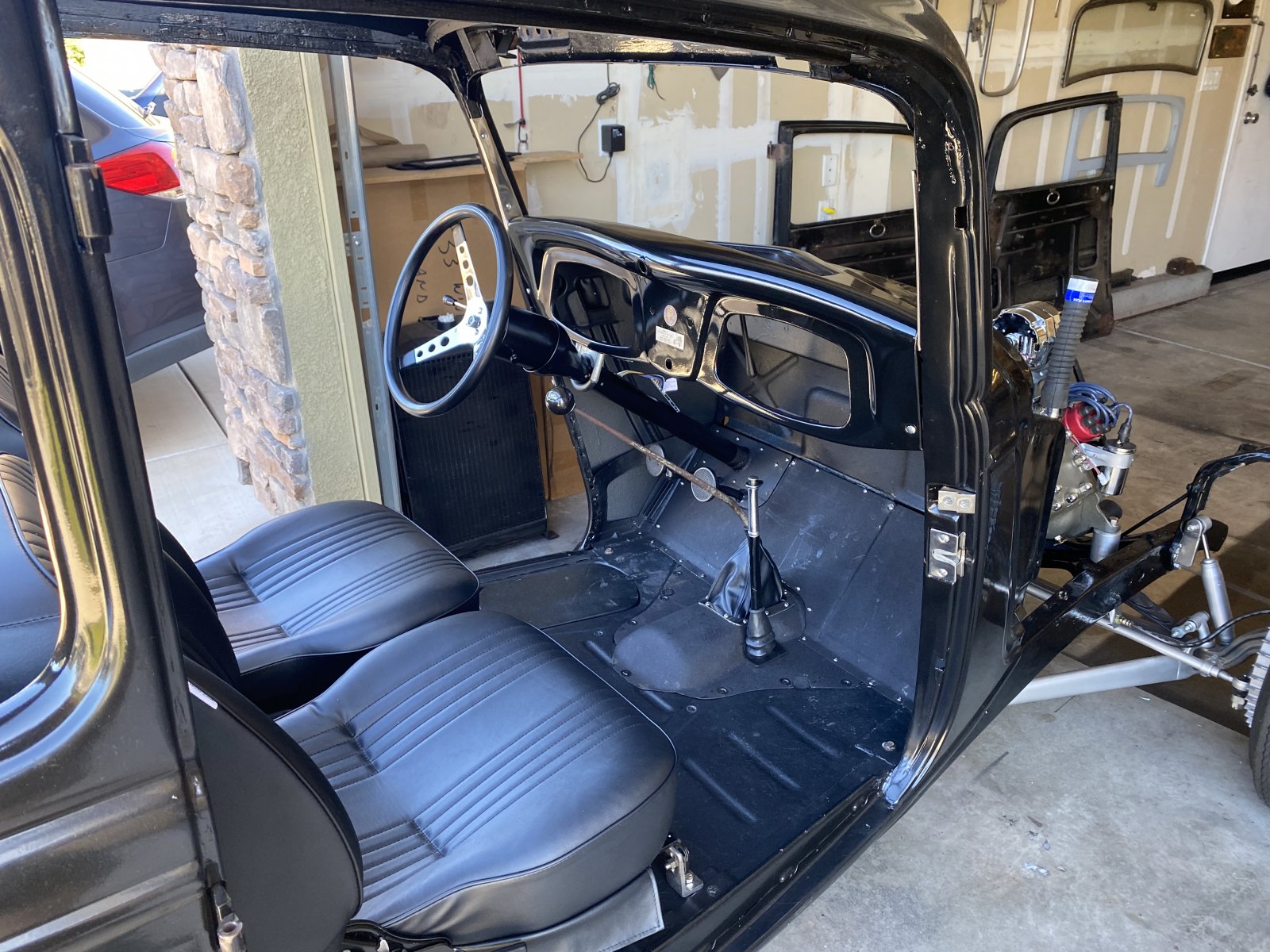

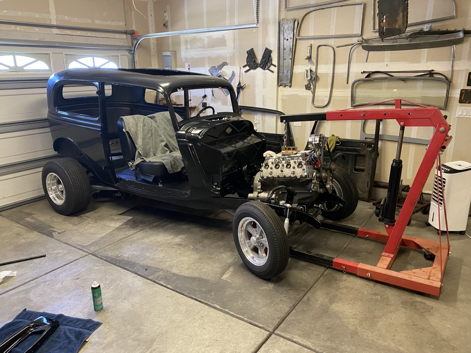

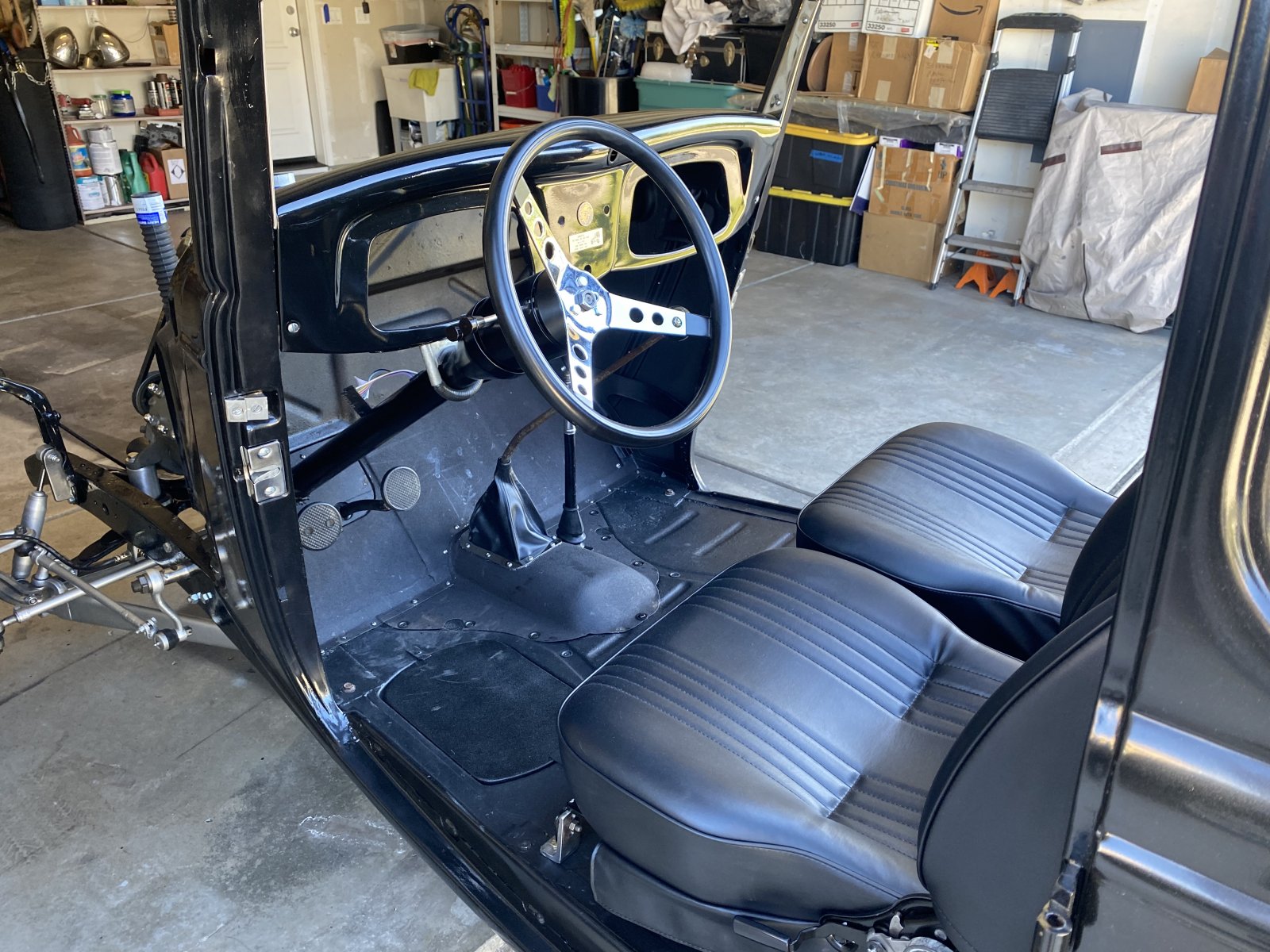

    I think I’ll have this girl going by winter or early spring!
    Clutch adjusted, brakes are working. floors are done dash is, in steering is done!
    Yaay-Yeah!!

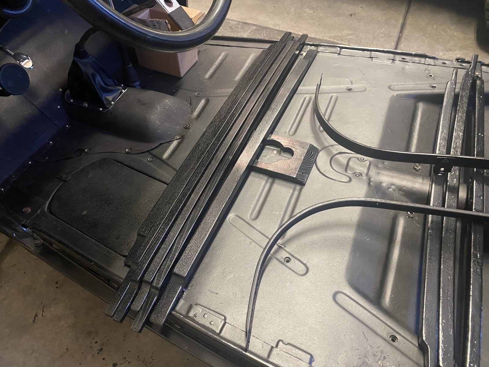

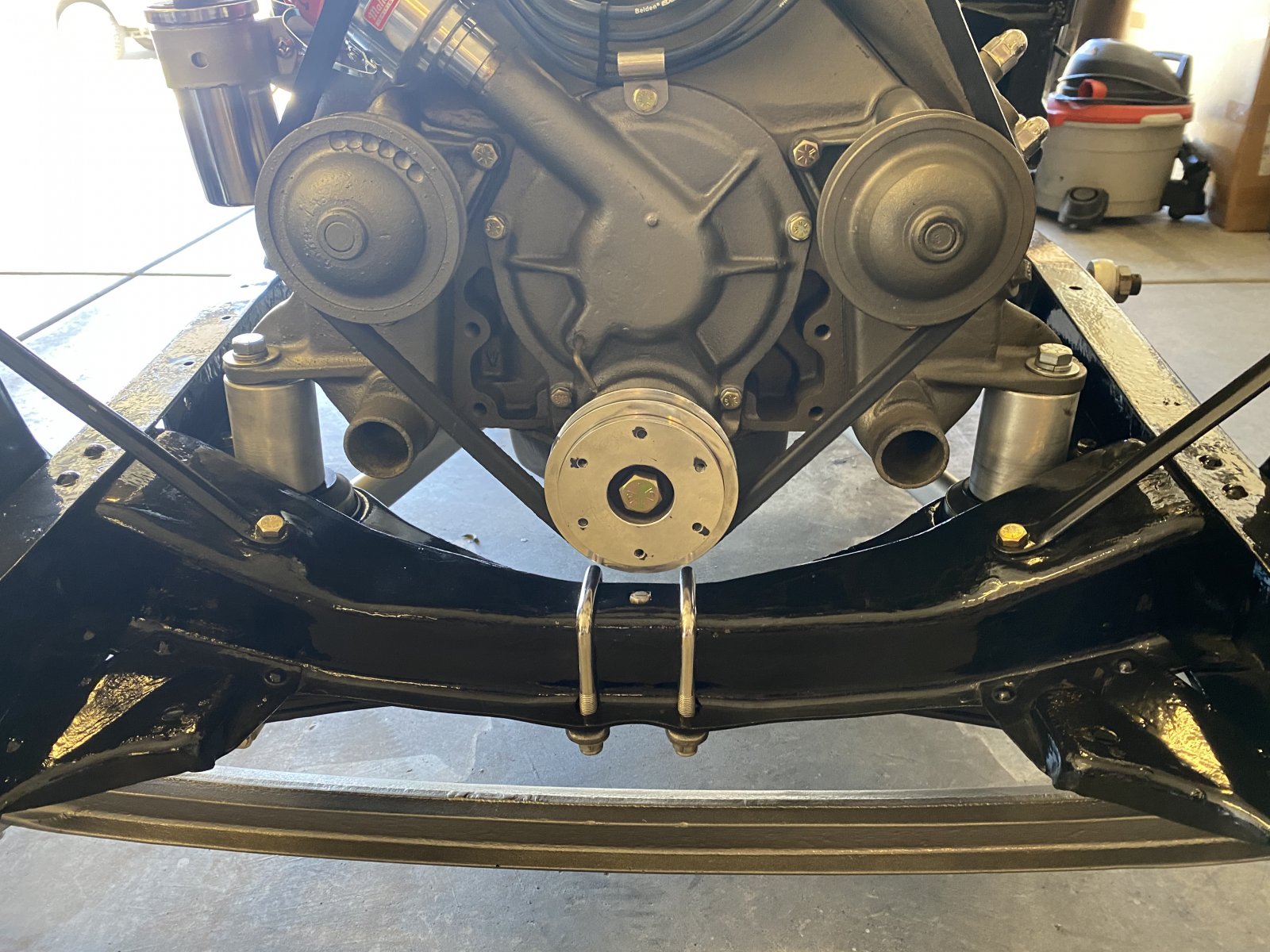

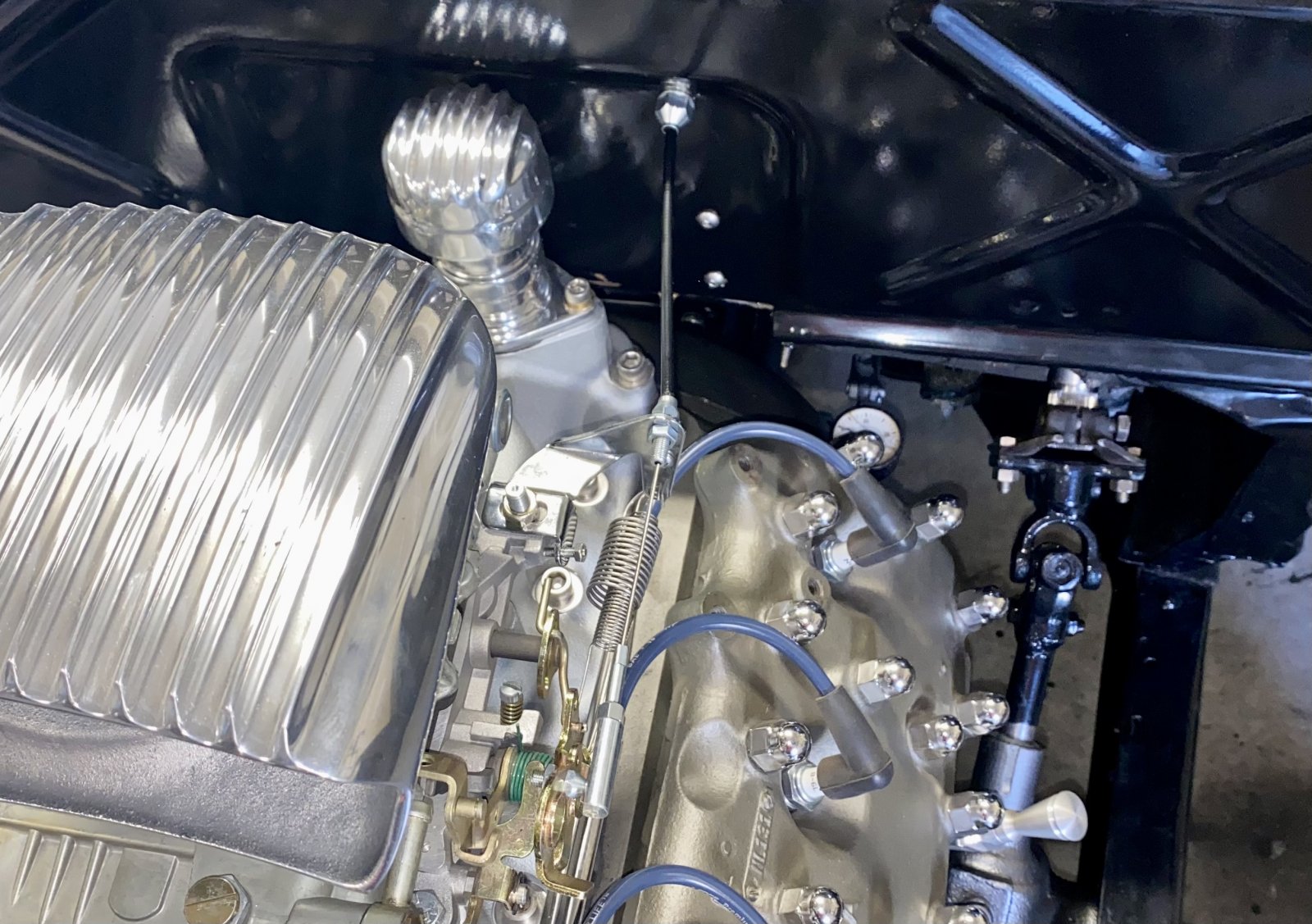

  24. 33Doll
    Posts: 1,676
    33Doll

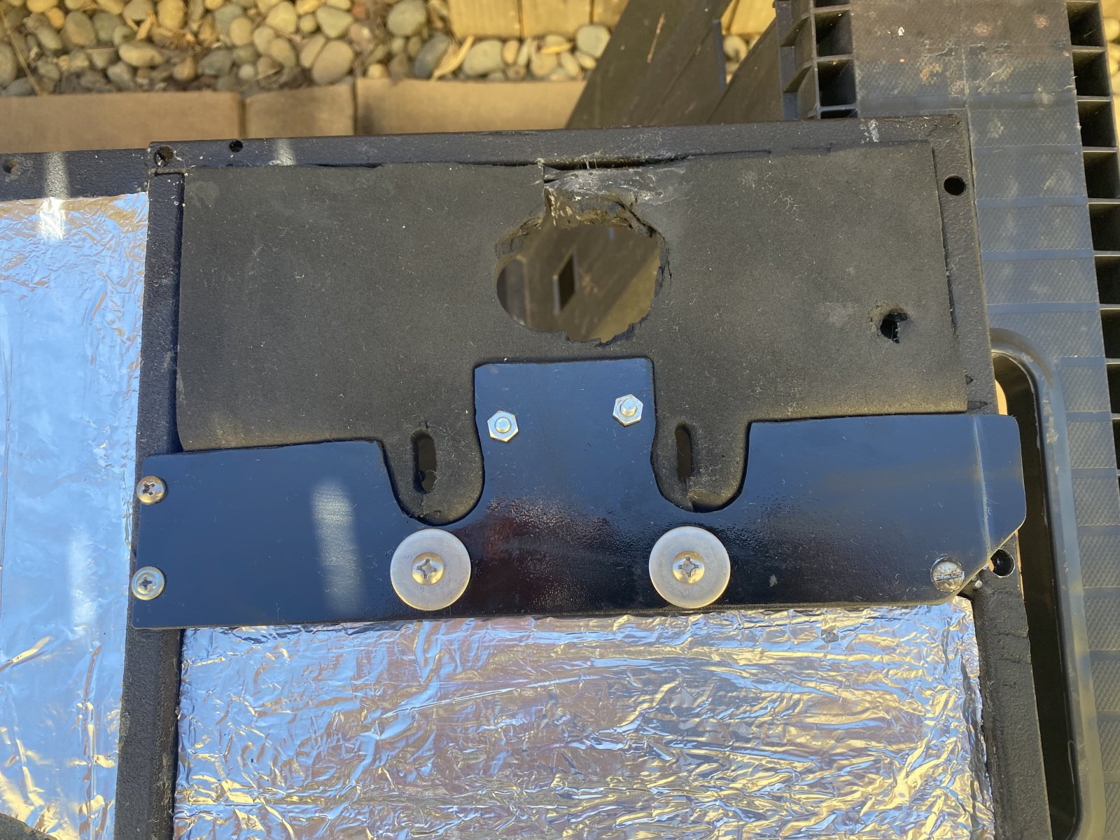

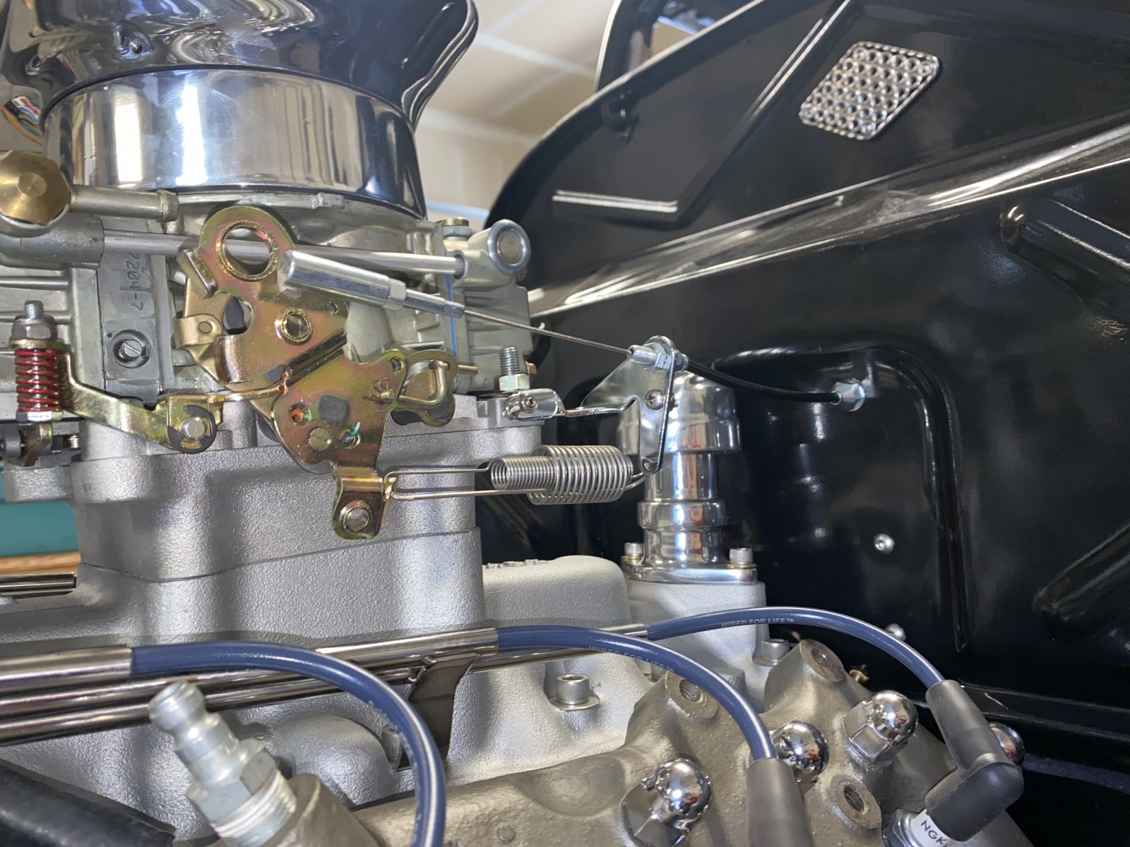

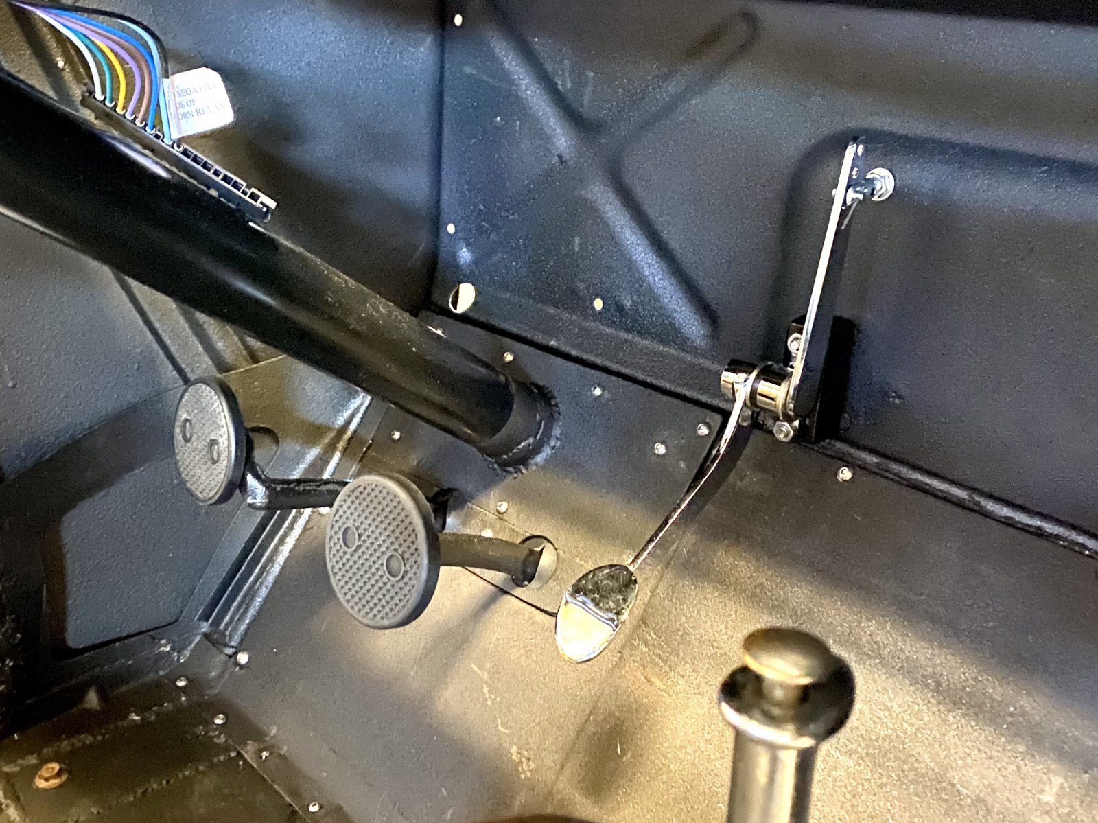

    5F4B59BC-C8F5-47C1-A6B6-D0A3762067F6.jpeg 2AC75E72-511E-4DE6-A52F-AEC16B187CA7.jpeg C11863E8-E83B-4D52-995A-0B432D072F96.jpeg 0F989727-DBCA-4AA6-9324-8BF2310A57FD.jpeg 295A4652-3FFF-4132-B2C4-AEA4AADDCF05.jpeg 93437BF9-871C-4469-BB22-24E71B364340.jpeg F9562C85-CC18-4521-9184-2D5EE1361220.jpeg 9B32A48D-04D2-4874-A7BC-B93C855ED878.jpeg AA5E476E-95E8-45B5-84F2-7282D01AE9D1.jpeg 1687EECC-C3E9-4C40-9DA2-2BE8FADCBCDF.jpeg Carb on. Throttle set-up, working good!

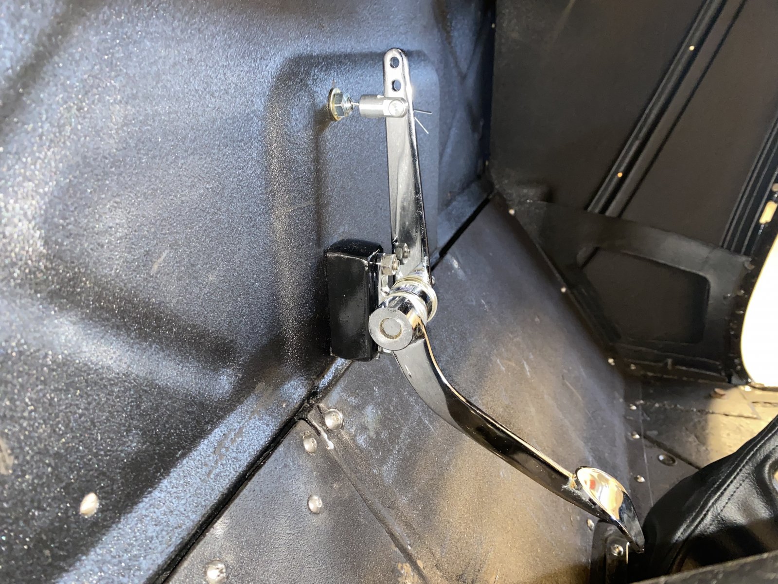

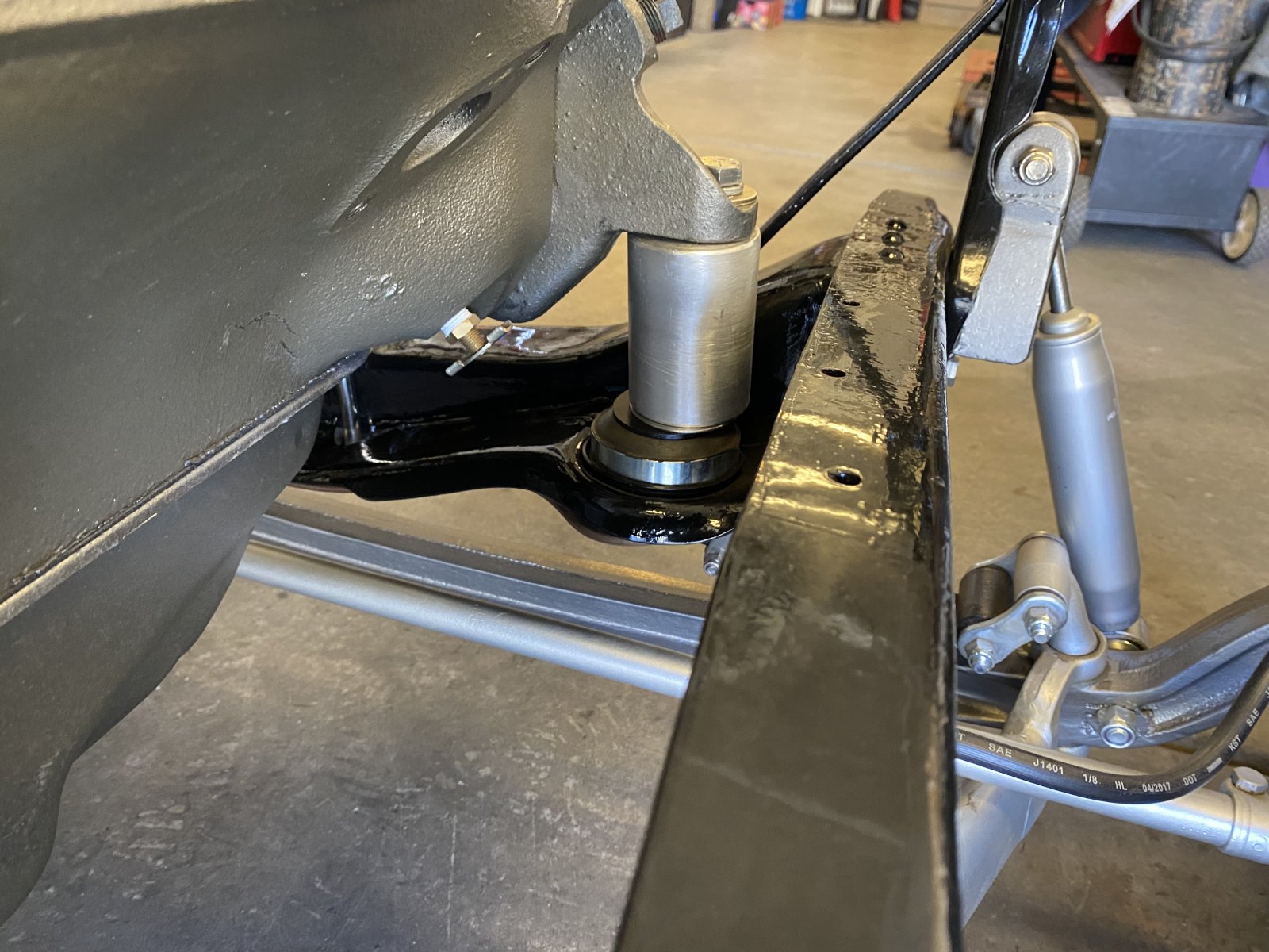

    Had to make a 1 inch spacer to give it more swinging clearance
    Had a few issues with it! (Cheap Chinese stuff these days!)
    first the aluminum bulkhead broke on the throttle bracket… so I had to drill and thread it! Then the pedal is supposed to be reversible but the slot for the set screws off center, so it was really sloppy, so then I put some washers on it tried to squeeze it, and I broke the urethane bushing, but I ended up fixing it! I will probably make some Teflon/ UHMw bushings later for it.
    So now that the steering, clutch, brake gas pedal, and everything set up.
    I’m gonna take the seats out, and start putting the interior together, the windows and all that…and probably the top. We’ll see?
    Stogy, guthriesmith, dwollam and 2 others like this.

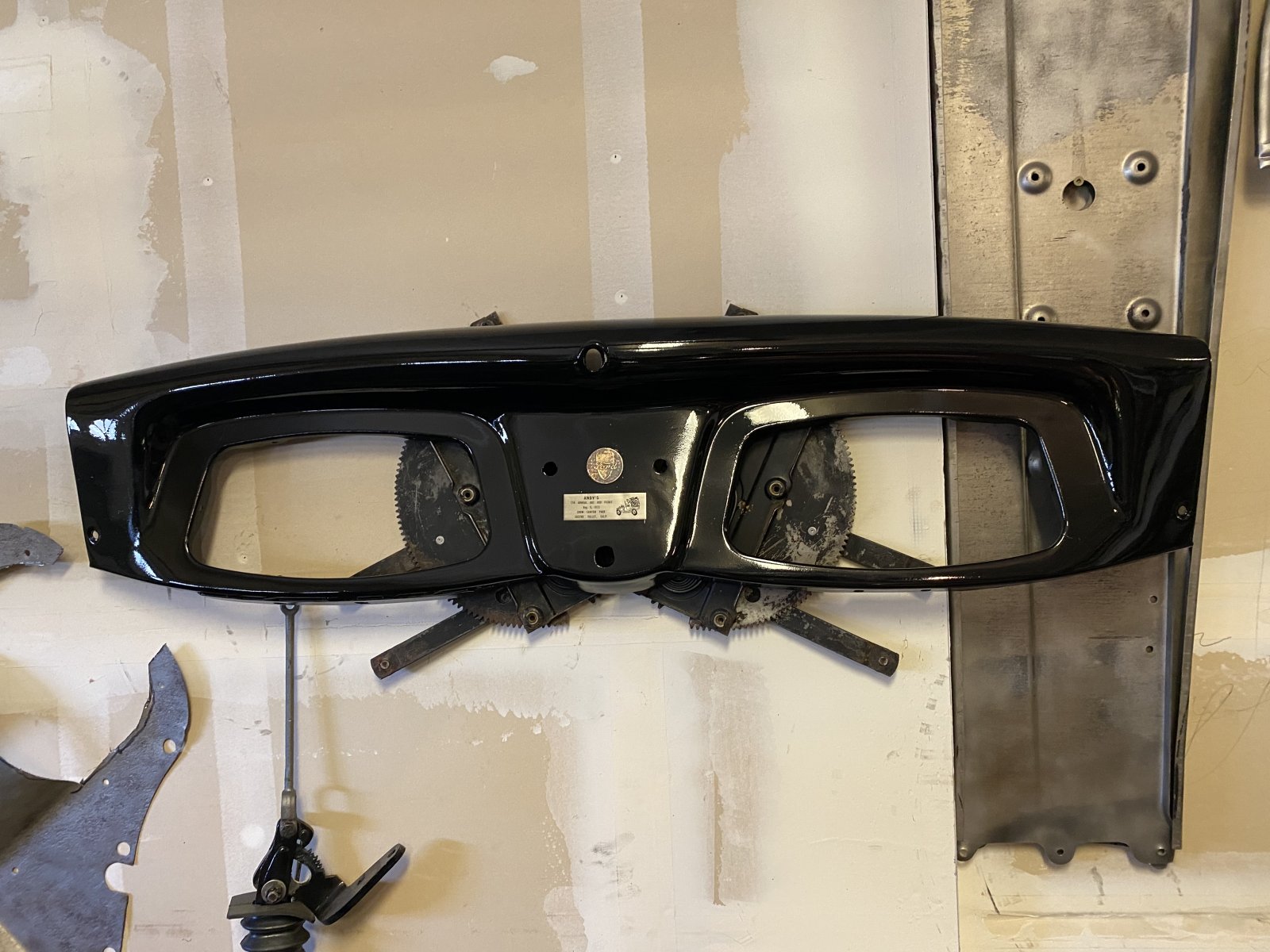

  25. 33Doll
    Posts: 1,676
    33Doll

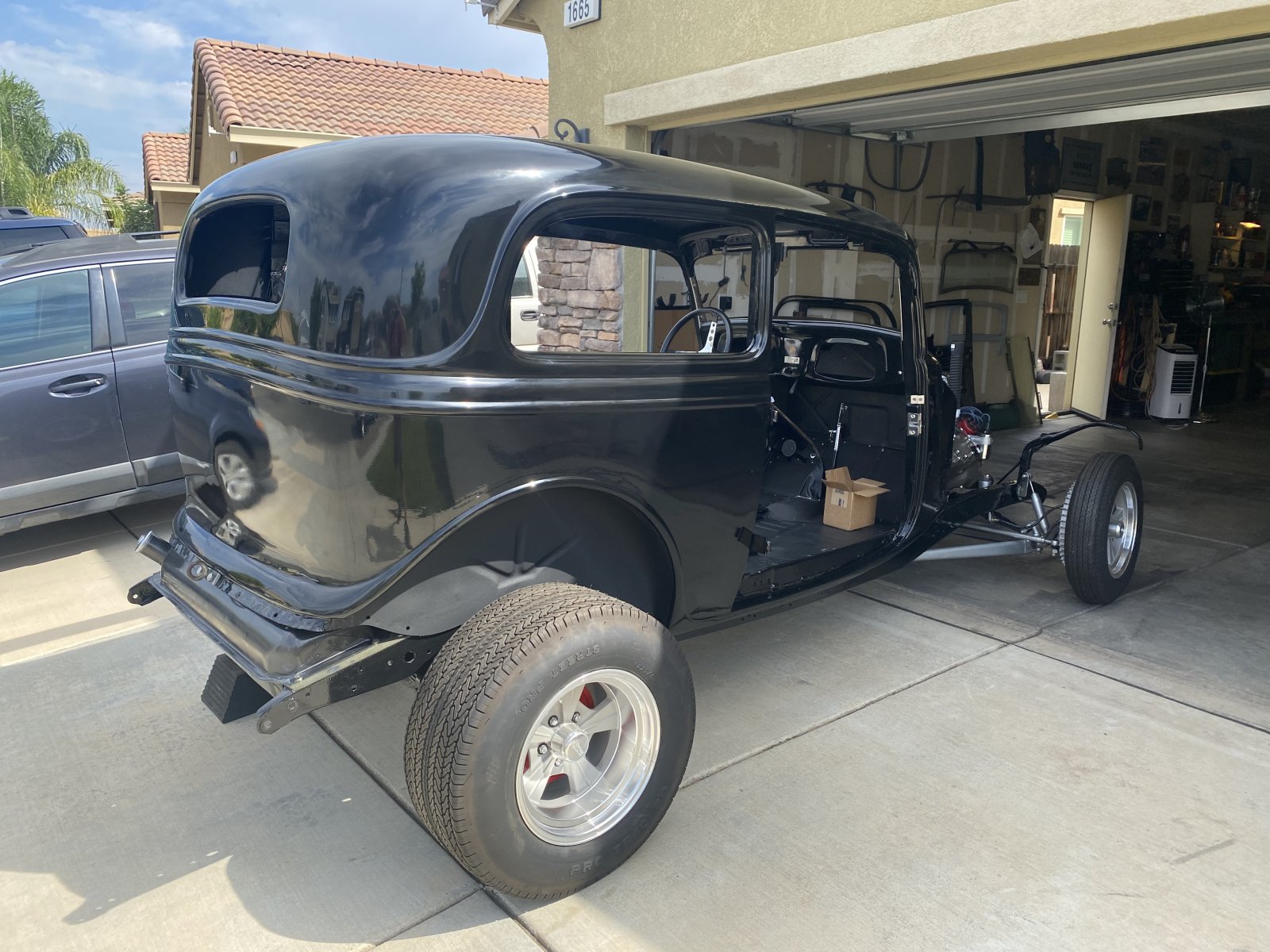

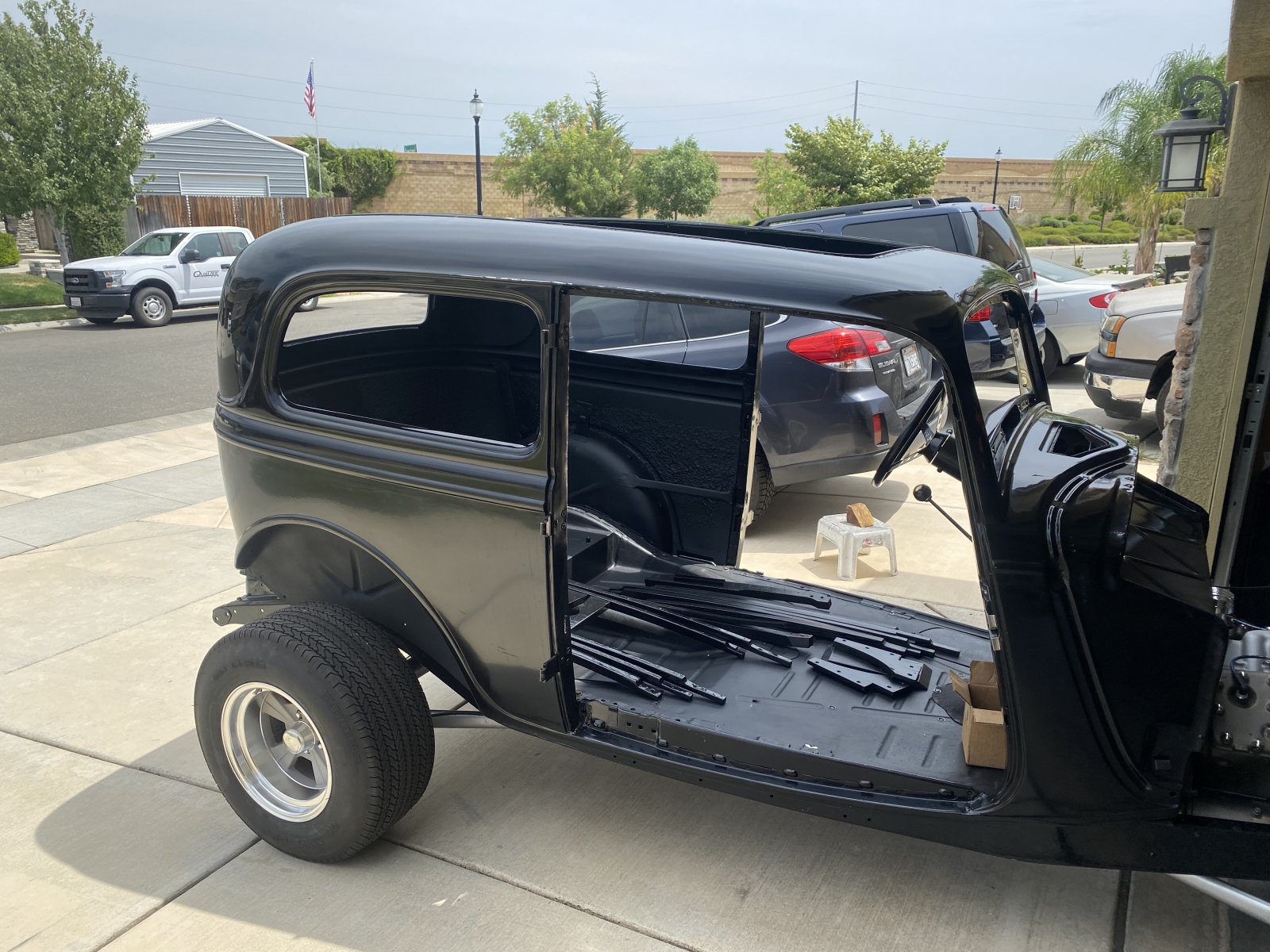

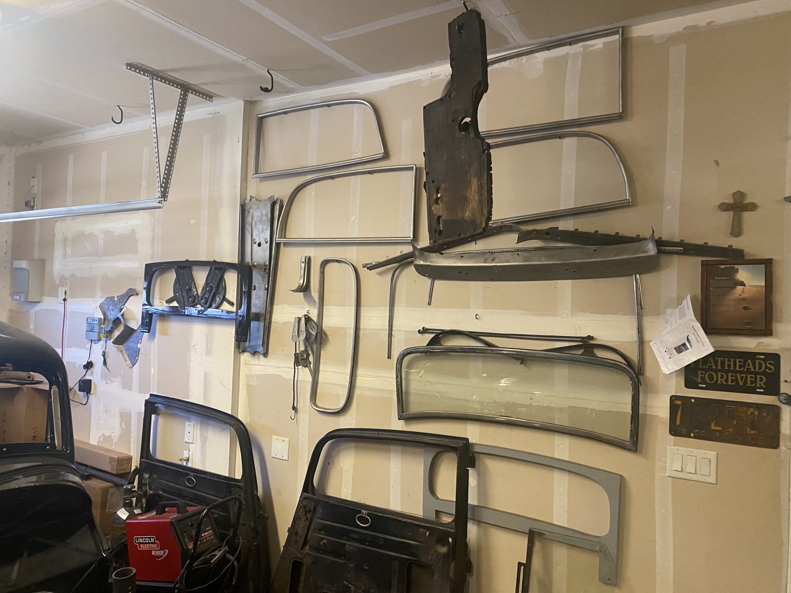

    E3FF9AF3-0E12-4141-828C-2B807459EFA4.jpeg 5755E82A-E91A-447F-ADB1-ADC30224EADE.jpeg C23C4EFB-0466-4442-B49F-B85CFF62B044.jpeg 205BD067-923A-48D0-891B-4848992766BB.jpeg 1120DD32-1B31-4880-8F54-0AA738F6970A.jpeg 90A827D1-B2E7-4FD3-A668-FAF3200D1D14.jpeg B57D2660-DA22-446F-A15B-589EEF50BD3B.jpeg A4AC65F6-4038-4F8A-AE07-D729937D5FB4.jpeg Well I got The interior structure parts all pretty much fitted, painted and done. It’s a shame Not to reuse the old top Bows I restored….
    but the new ones are so much nicer!!!
    I’m gonna work my way from the back to the front or at least, to the B-pillars for now, and then….put the top on, once the side windows and
    the rear windows are in.
    In case I need to stand up!! Getting old and crotchety you know!!!
    I still got a paint all those parts hanging on the wall!!! But I’m glad they’re bead blasted!!!
    Stogy, guthriesmith, dwollam and 3 others like this.

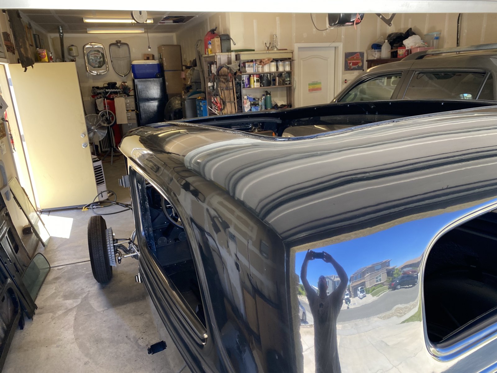

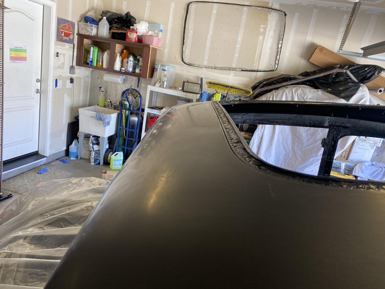

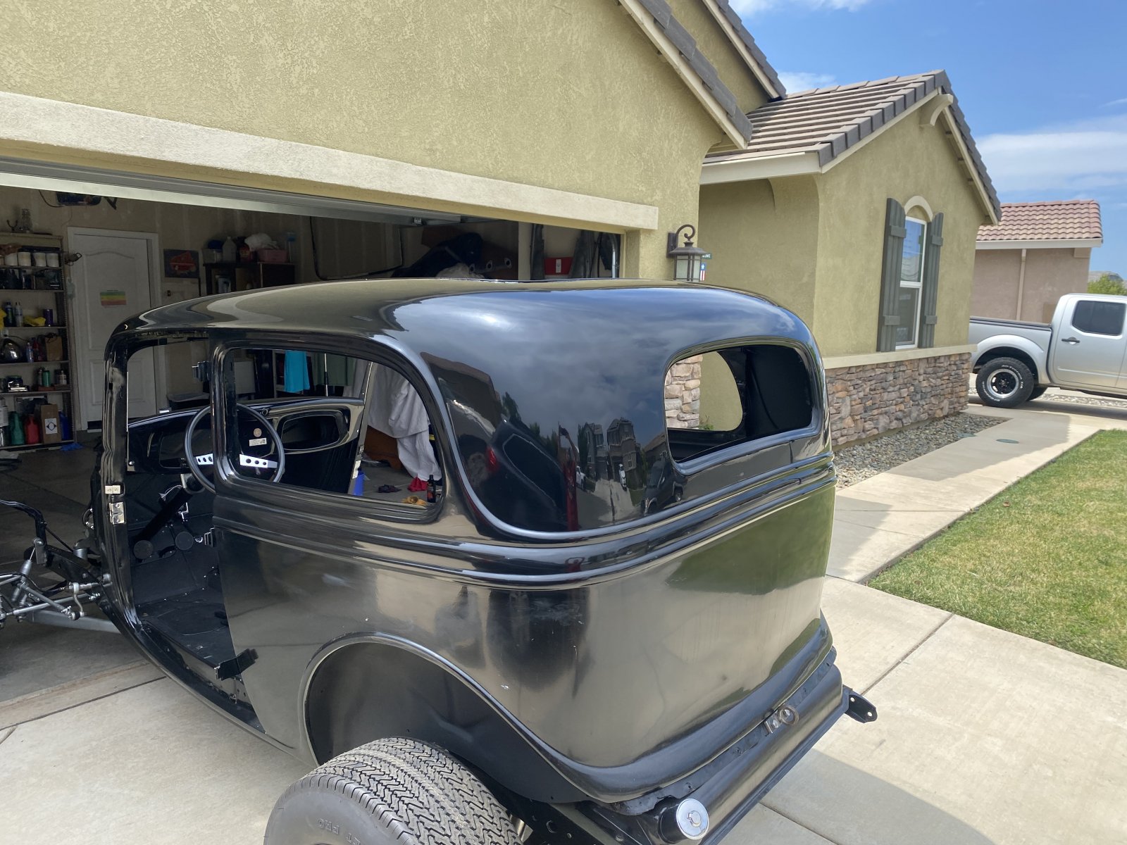

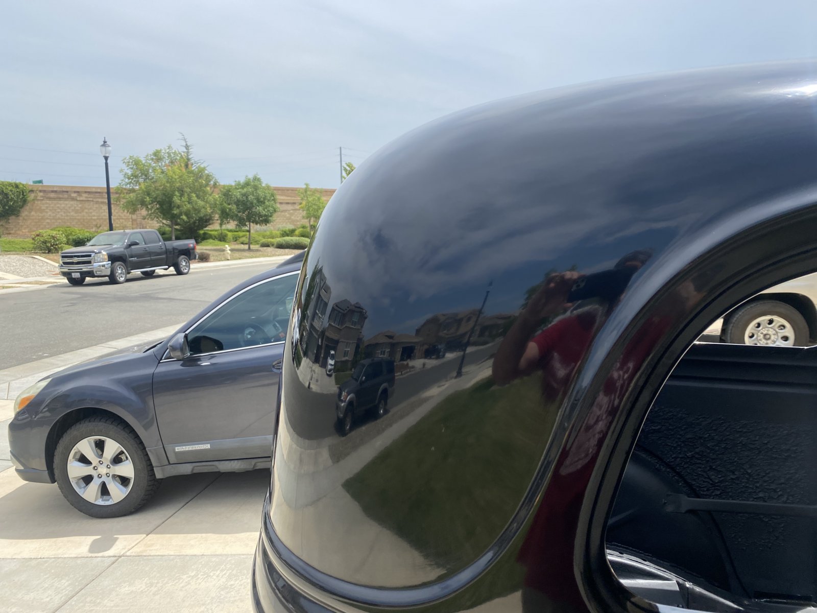

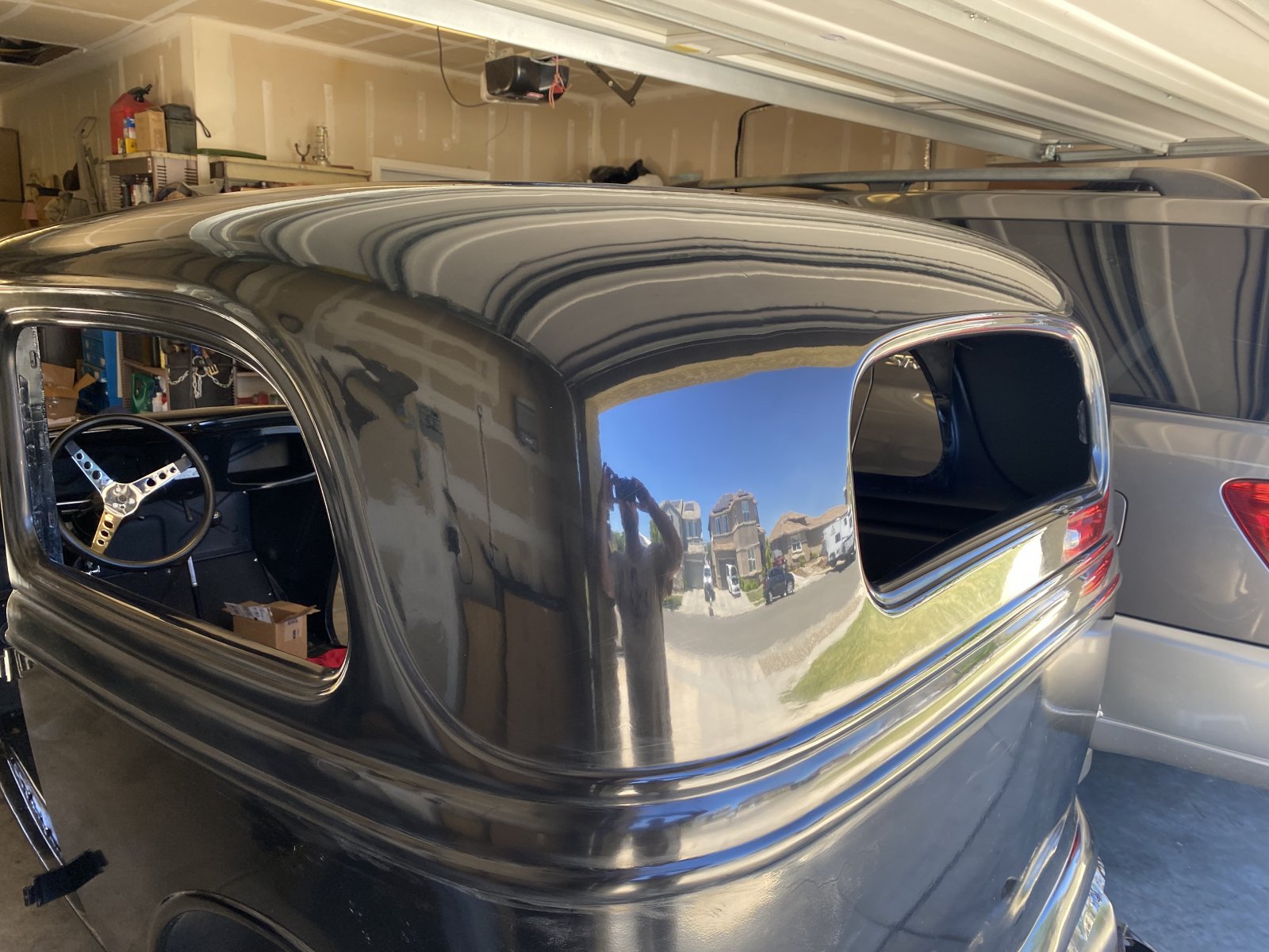

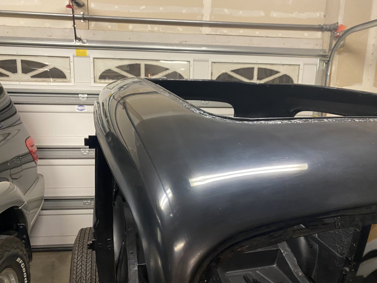

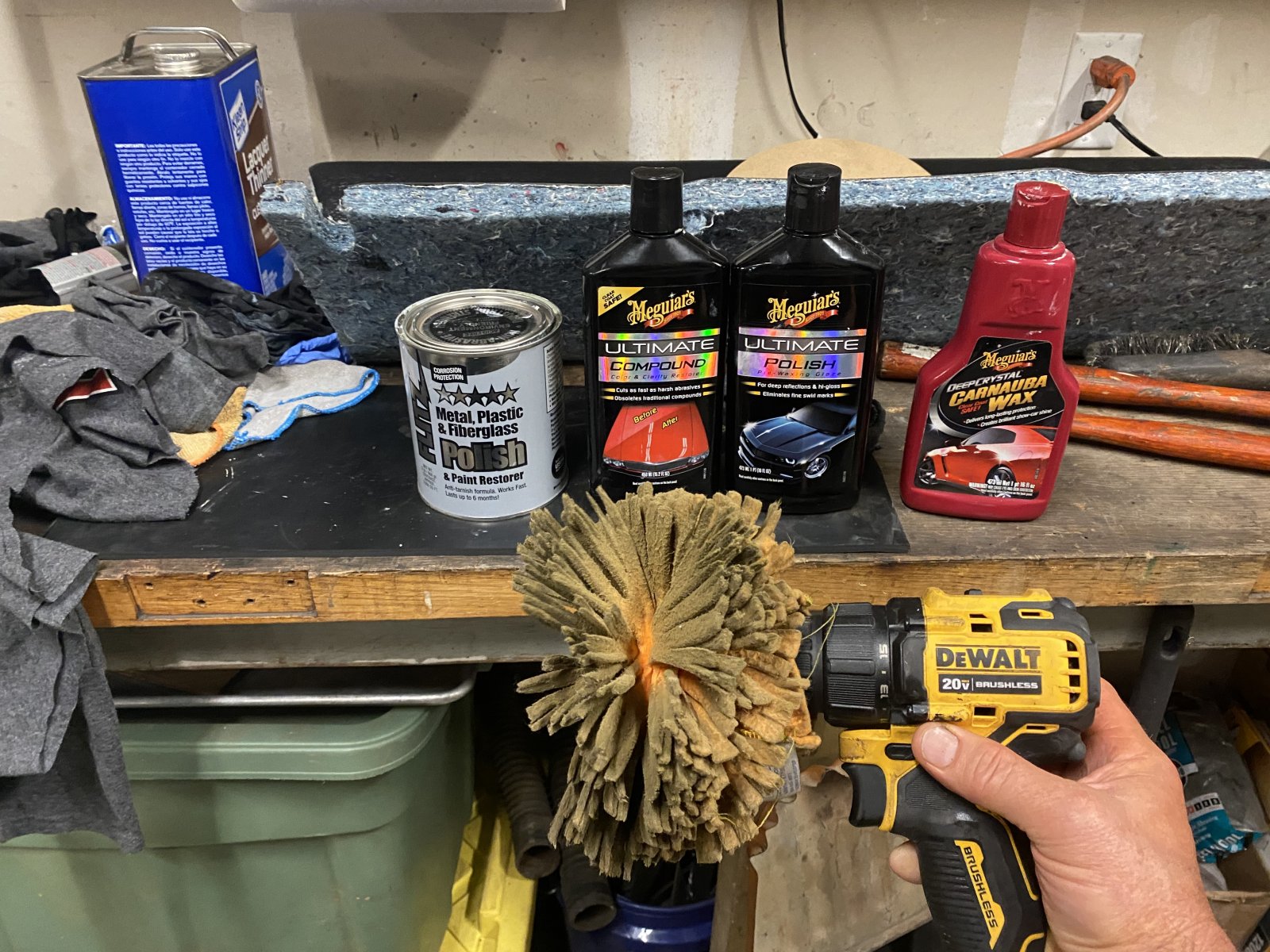

  26. 33Doll
    Posts: 1,676
    33Doll

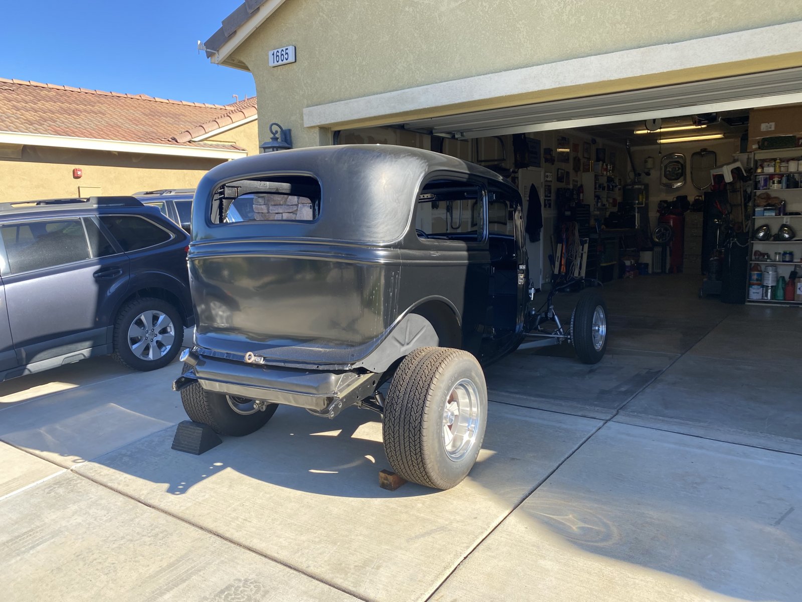

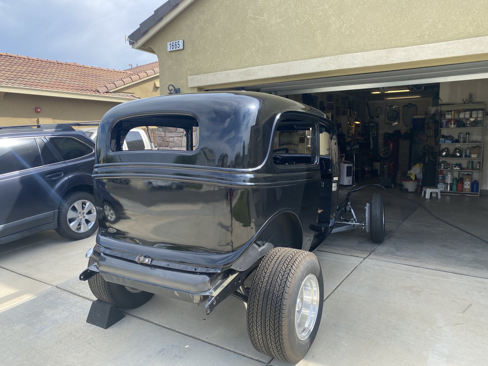

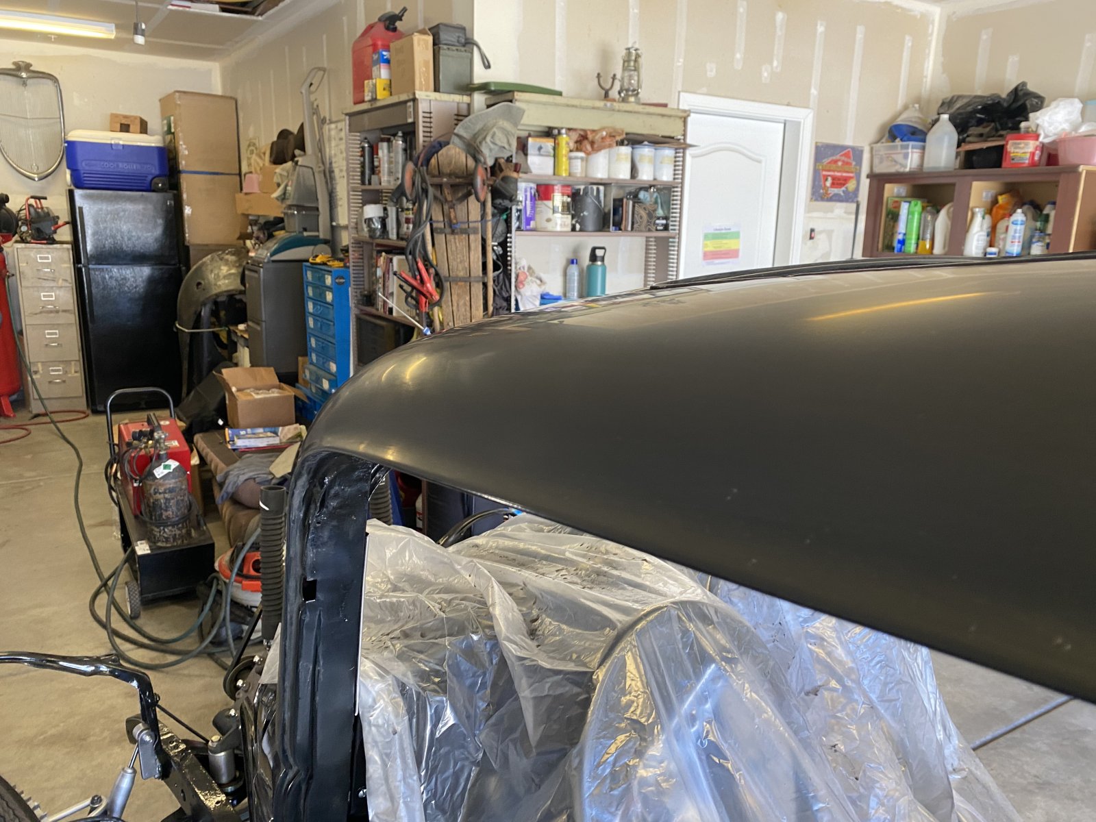

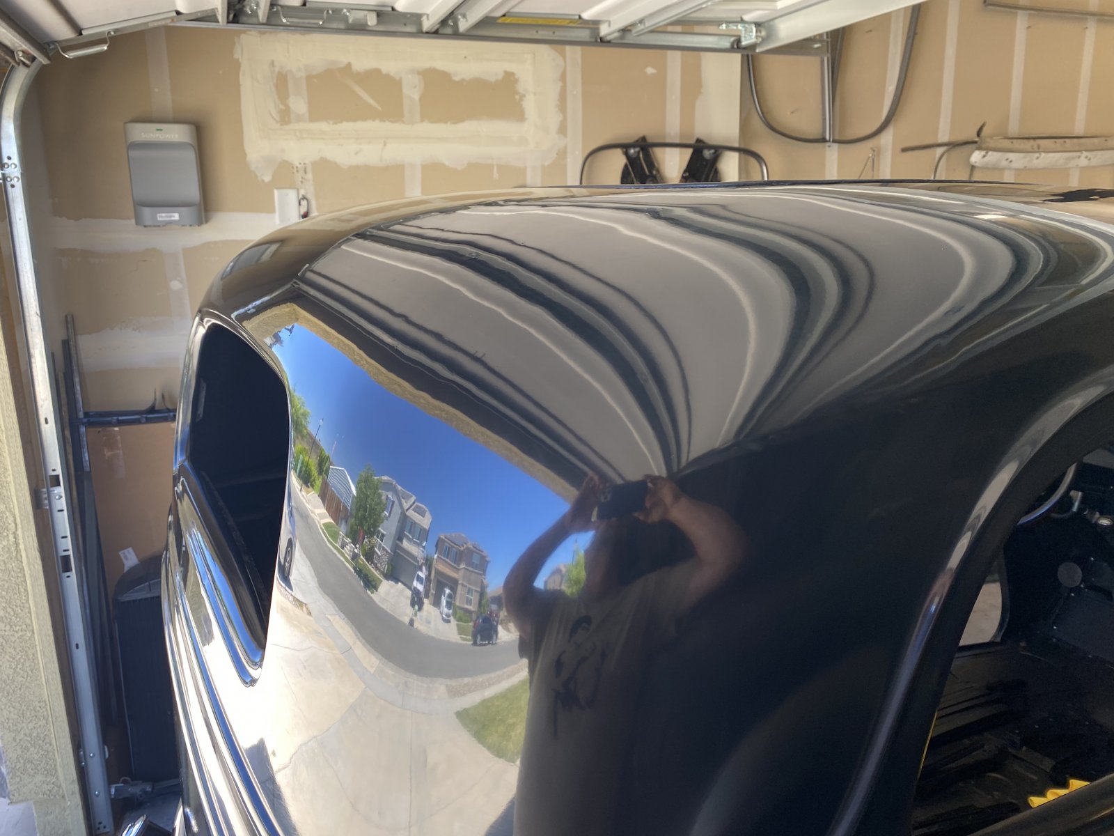

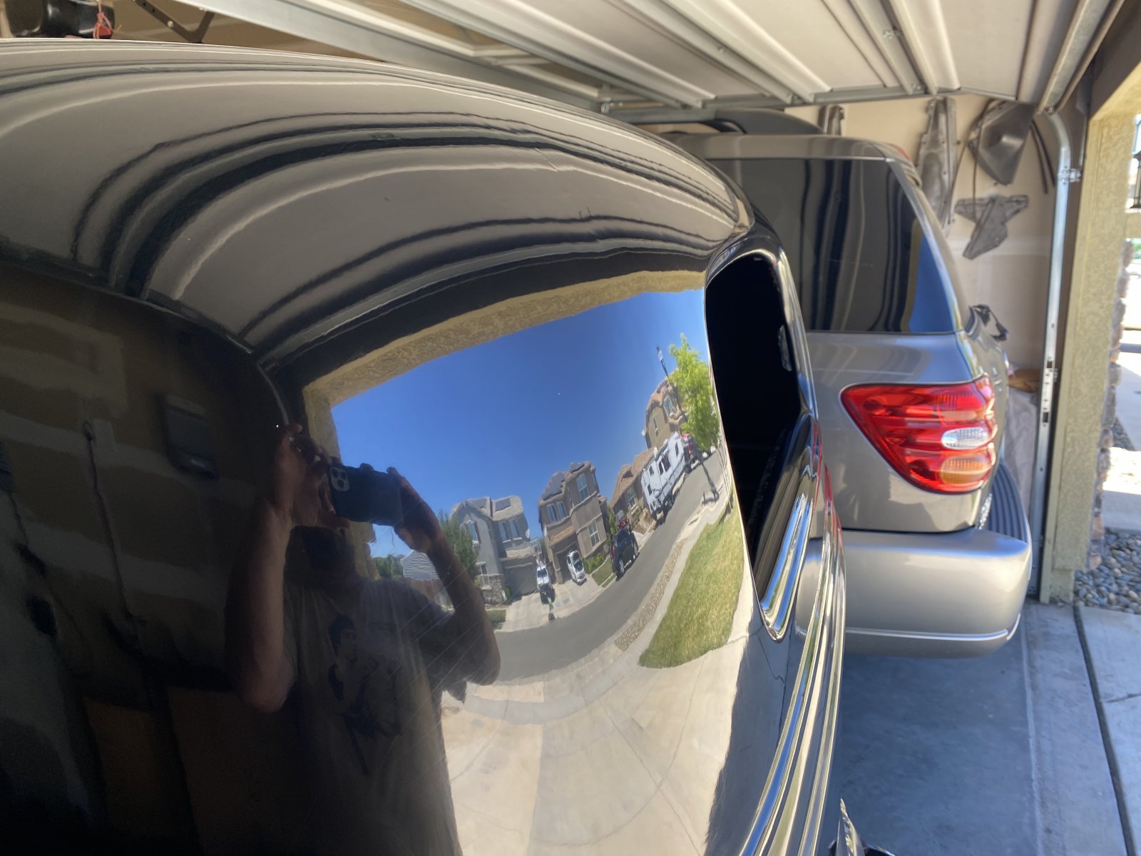

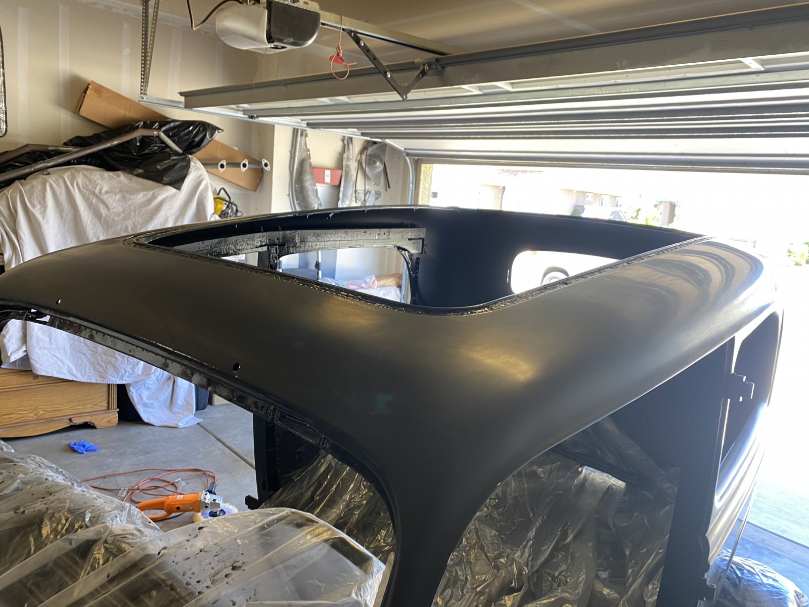

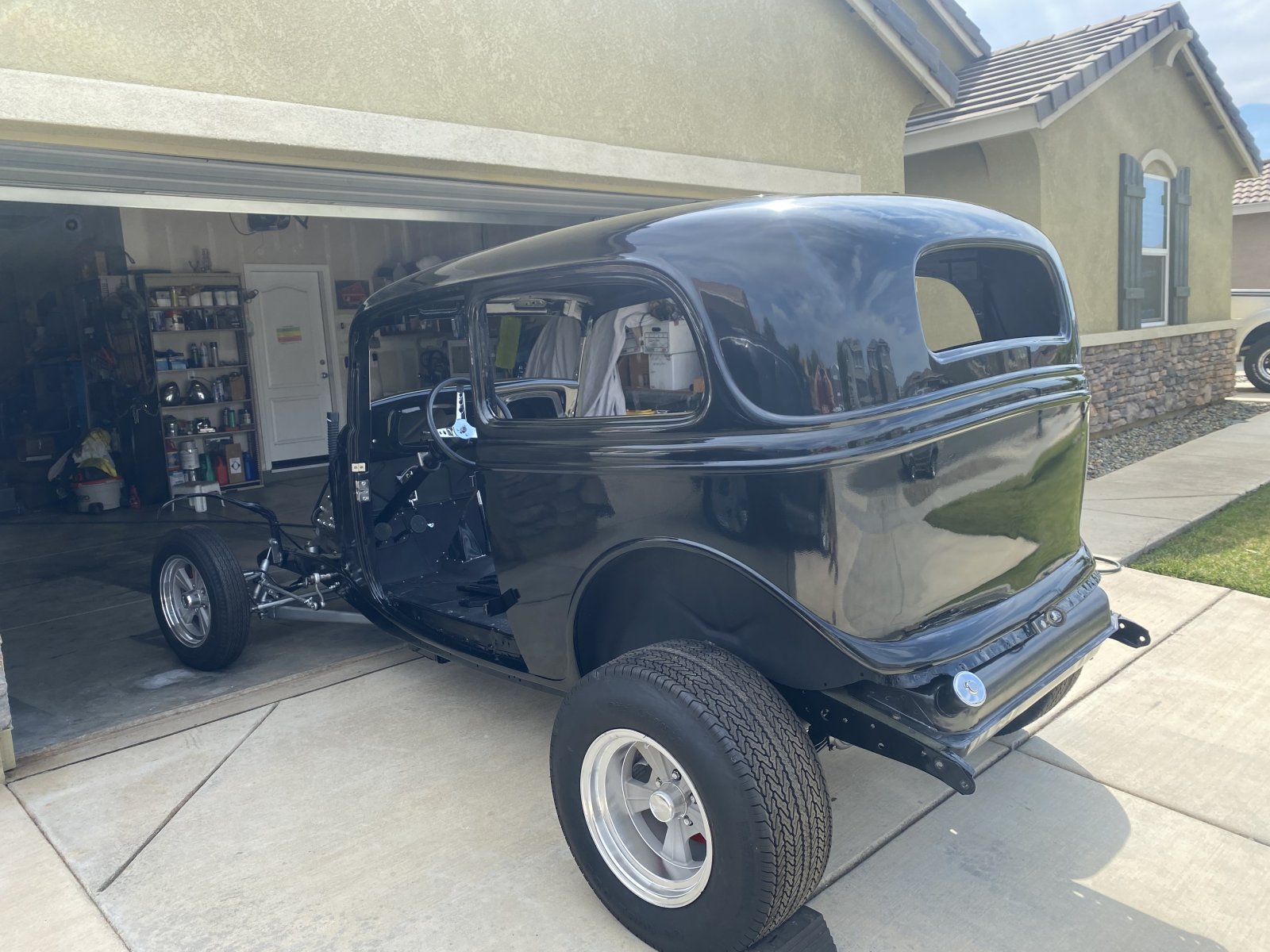

    87716C4D-B01D-445D-9317-E353C1DC3B1D.jpeg 5698E636-6EEC-4CDD-BD4F-DB2938372EAC.jpeg 2CADDBCF-B04B-4B47-B7D7-68732C34B62F.jpeg 749EDF0B-46B9-4A84-A03F-185749D314D9.jpeg DBBF1C89-422F-495A-B0C5-560A06539FFC.jpeg 719CEEB9-DA6F-47FD-8953-D541688DE57E.jpeg 4F70F32B-8AFF-45B2-845C-735AFD2AB3C2.jpeg 6447C106-8BF9-4054-8CD9-C31BF249E5BE.jpeg B6CAF0D4-9D3A-419C-9301-0891FCEE8FED.jpeg 765CC6E6-2F7F-4887-938D-9874A24302E5.jpeg C288C053-FF1D-496A-BE2D-8651C7DCD059.jpeg Wet sanded with 600-1200 and 2000

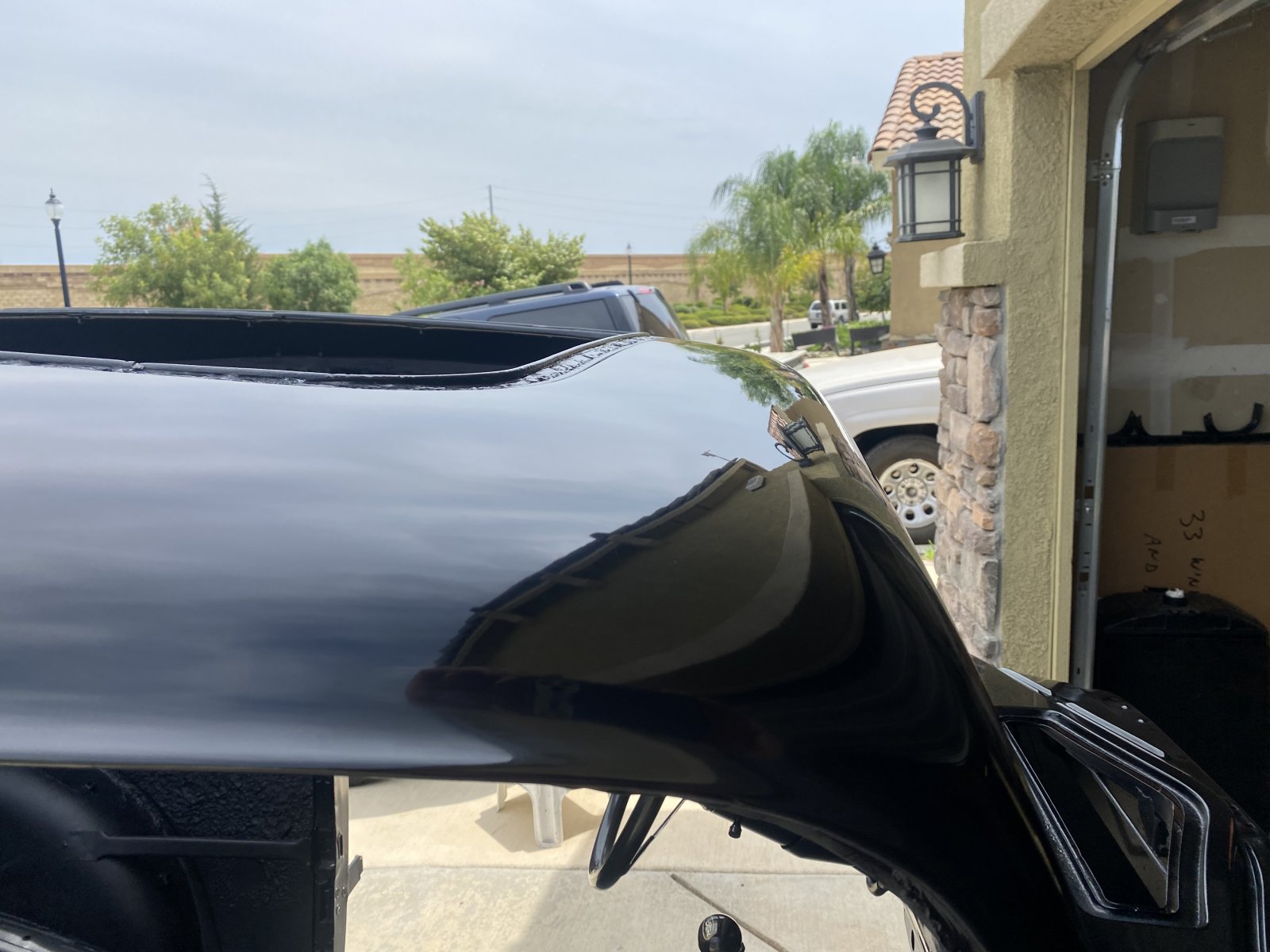

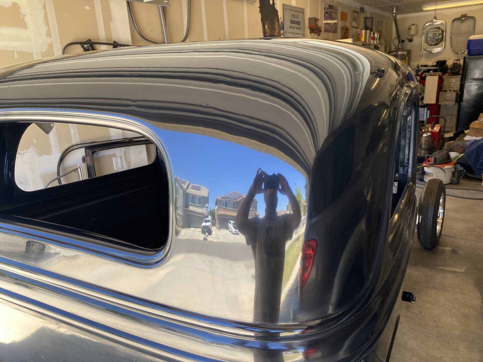

    Then I polished with three stages working my way down the car as I build it since I wanna do the top and the windows I did to the beltline
    My rustoleum spray paint methods are unorthodox but I am determined to make them work!!
    Few things I’ve learned so far.
    Make sure you can see real good so you can get all the scratches out before you get down to the 2000 grit. Because they show up after you buff it!
    And also a regular buffer even on slow speed burns it… The trick is DeWalt drill on high with the mothers orange polish ball. Use a rag to do about a 2 foot area to apply polish compound and then buff it out and small little sections
    -Brent-, 53 effie, Stogy and 2 others like this.

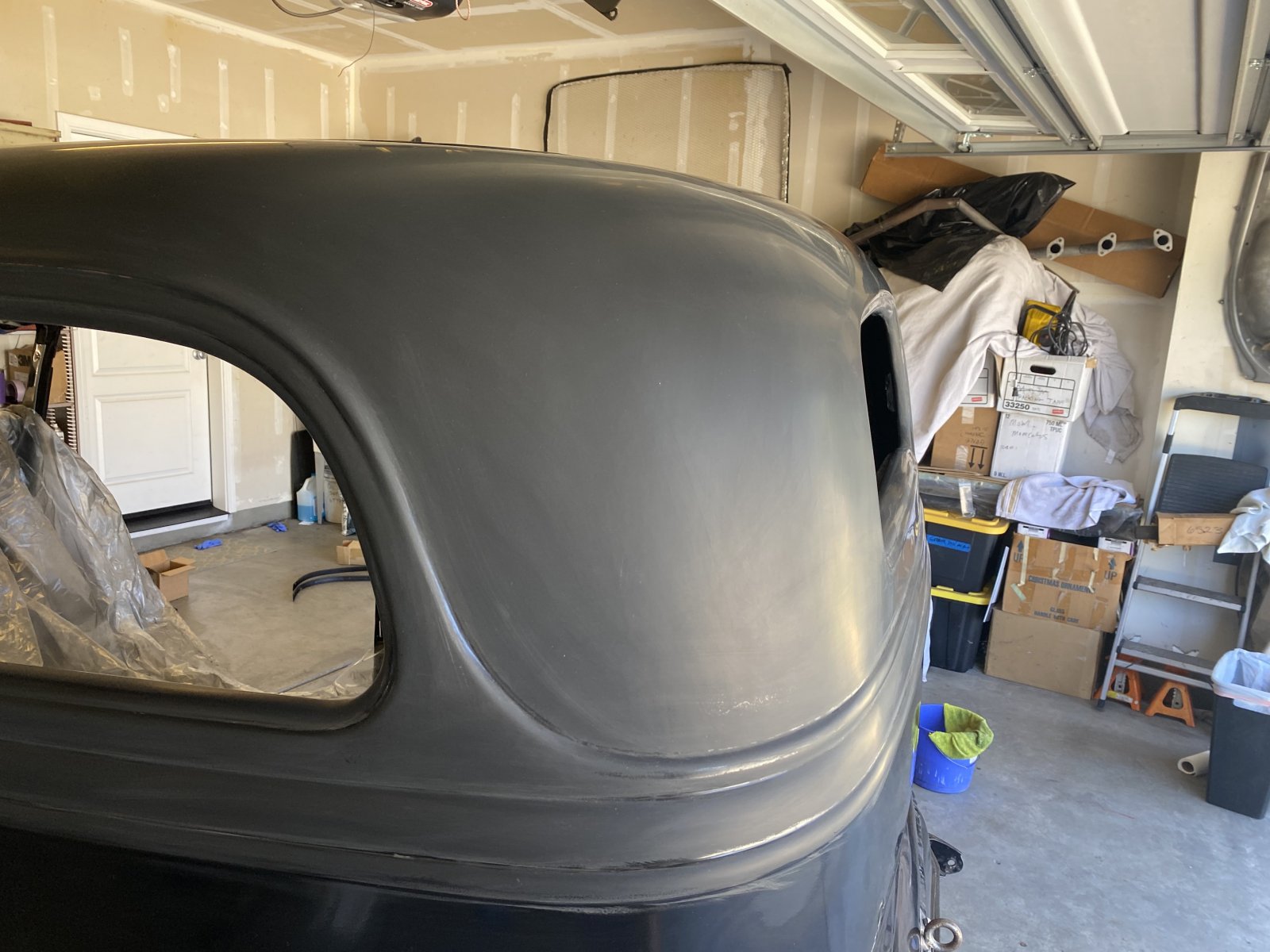

  27. 33Doll
    Posts: 1,676
    33Doll
  28. 33Doll
    Posts: 1,676
    33Doll
    0923D9AD-DDFC-49EE-9A0E-3B0E51A512A4.jpeg CC709D52-D01F-478D-BE80-D698728523B0.jpeg E42C1075-9913-4053-AF96-D9922B65C97D.jpeg 28EA8461-7AC5-4E0B-A9A2-87541FEC7C43.jpeg 3CFD7680-C1FA-49C6-AAA9-F614A5667219.jpeg 1C7E55CE-5090-463E-B336-D3B3CAEB99E6.jpeg 3290A878-414E-4B8C-A2CC-927DB1BAEFB2.jpeg 4541BC07-6B6E-4771-B07B-8C1B0FC0D3B9.jpeg C6091AF6-5070-454C-A38F-A2517FB34BD4.jpeg 75653F43-AD43-465B-9633-2A1BD5756227.jpeg BFE37BED-014C-452F-8192-7287E7DB132A.jpeg CDD79988-742D-40D0-9120-64F279EE61D1.jpeg Flitz…. It’s magical!!!!
    Had to get a new Flitz buff ball,
    To use with the Flitz polish.
    It ended up working better by hand rubbing in with a worn in rag, and then buffing with a clean rag in little sections. Pain in the ****,And my arms hurt!
    but the top is done!!!!
    neilswheels, Stogy, -Brent- and 4 others like this.

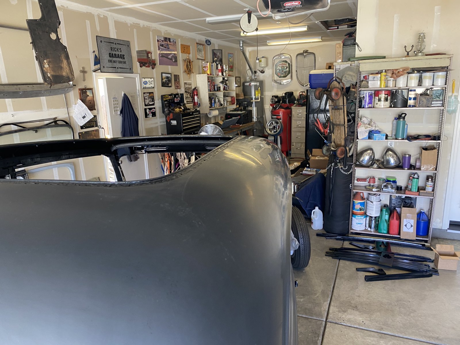

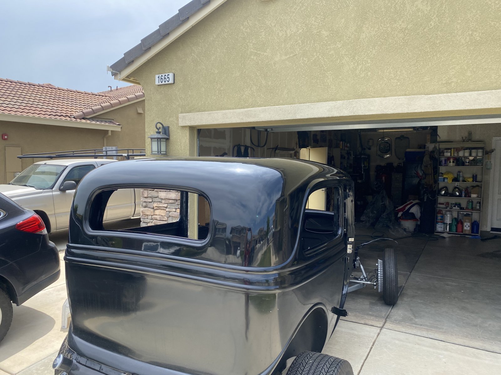

  30. 33Doll
    Posts: 1,676

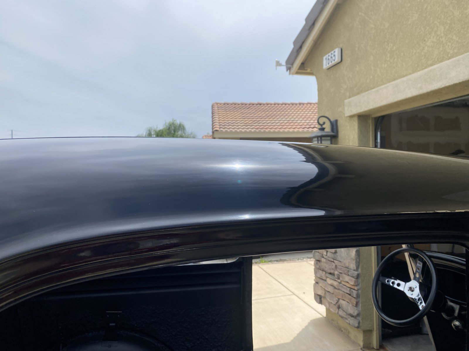

    33Doll
    Well I had to at least polish the lower section for now until I get ready to wet sand and buffet so at least it’s shiny!!
    I think I’m gonna work on the windows next and then maybe finish
    Wet sanding and buffing it
    I’m kind of tired that for now!
    “Who says you can’t buffing polish enamel spray paint!!” F9DEA20B-8194-437F-B22F-1C6A74B013D3.jpeg 38760325-BF90-423A-BEF0-FC7BACF51CB2.jpeg 27E555E1-C959-4C83-8622-305FBC6E0272.jpeg 336DE55E-0FED-428C-9B6F-18B739CB654A.jpeg
