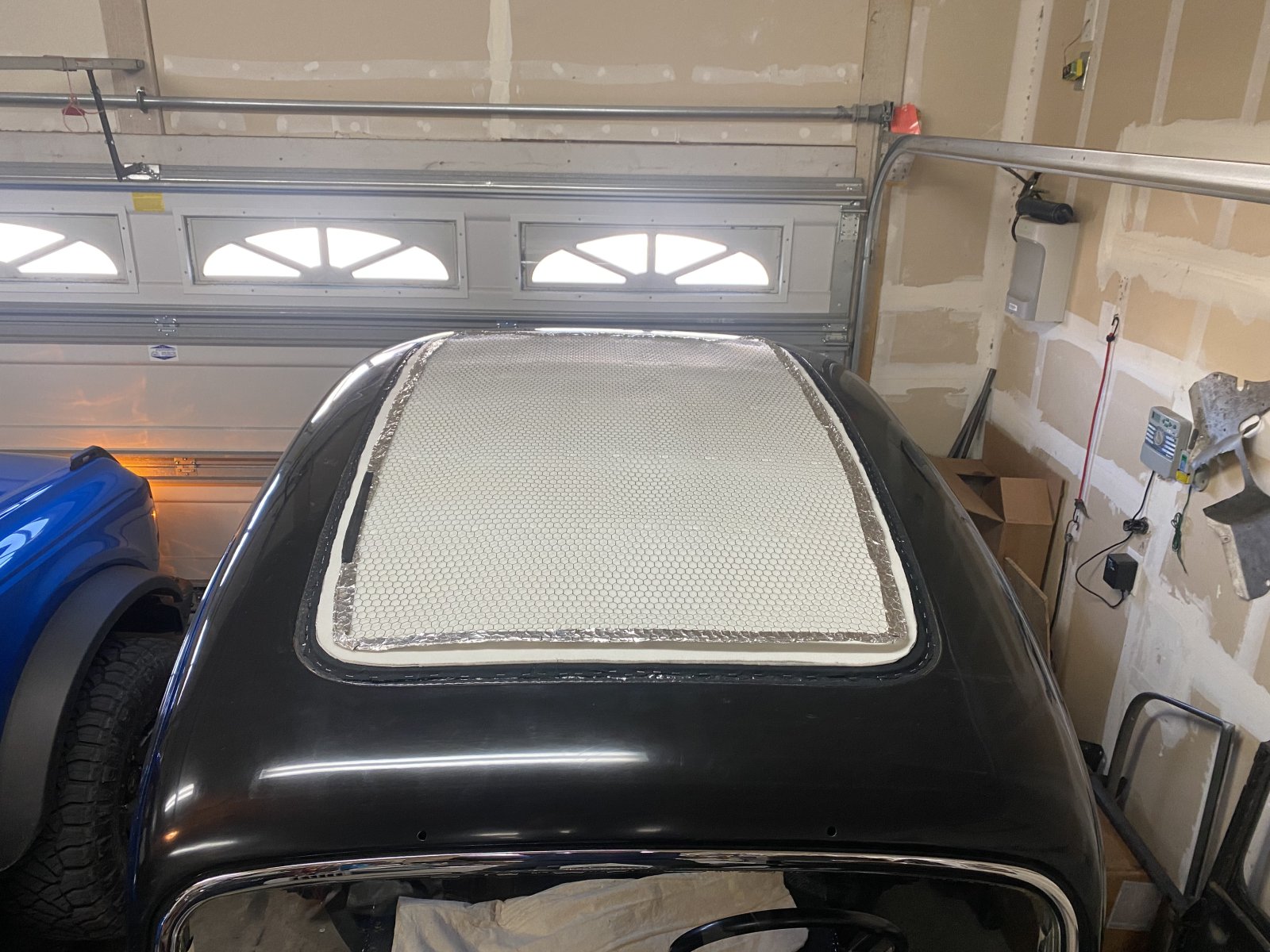

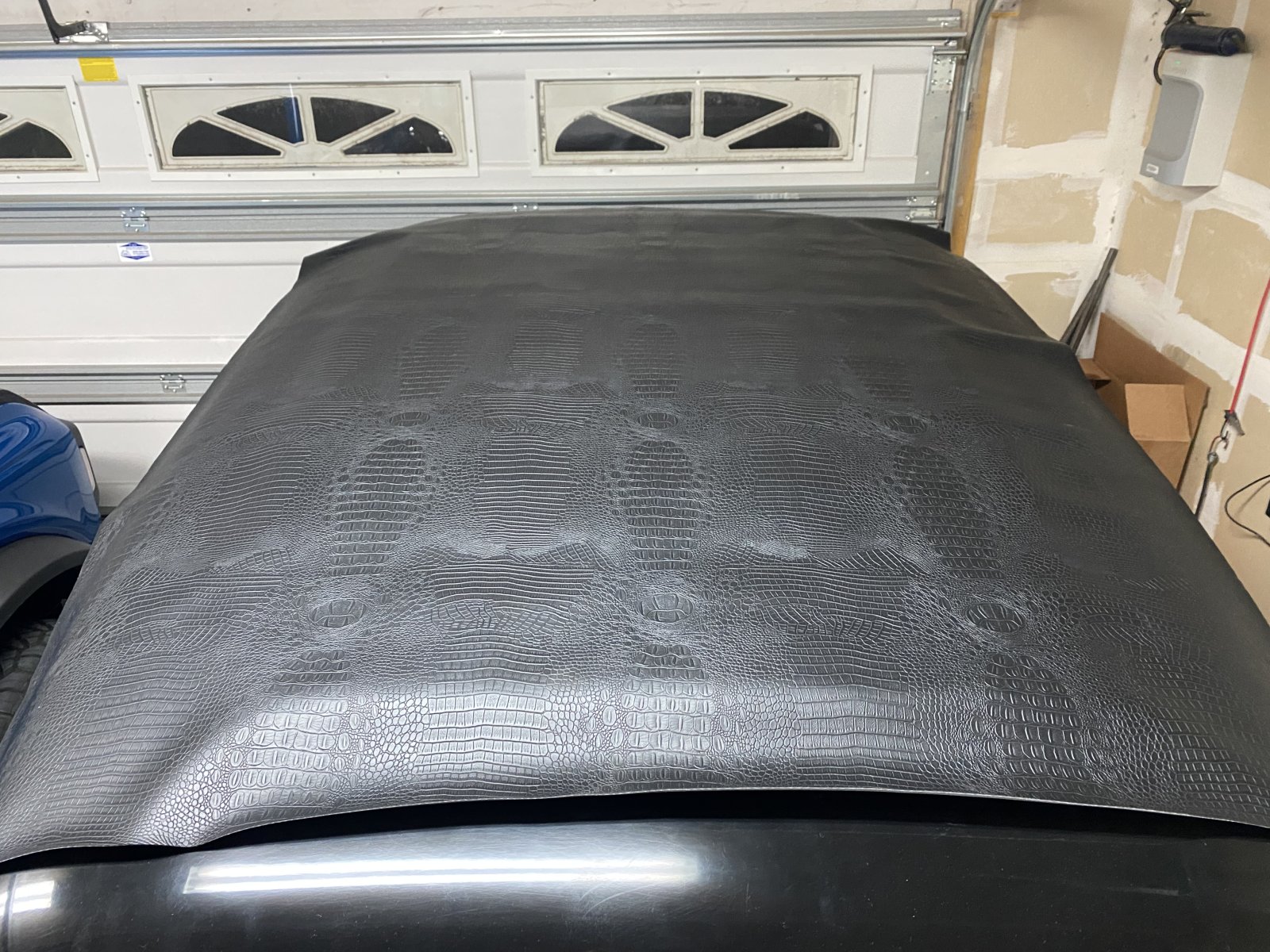

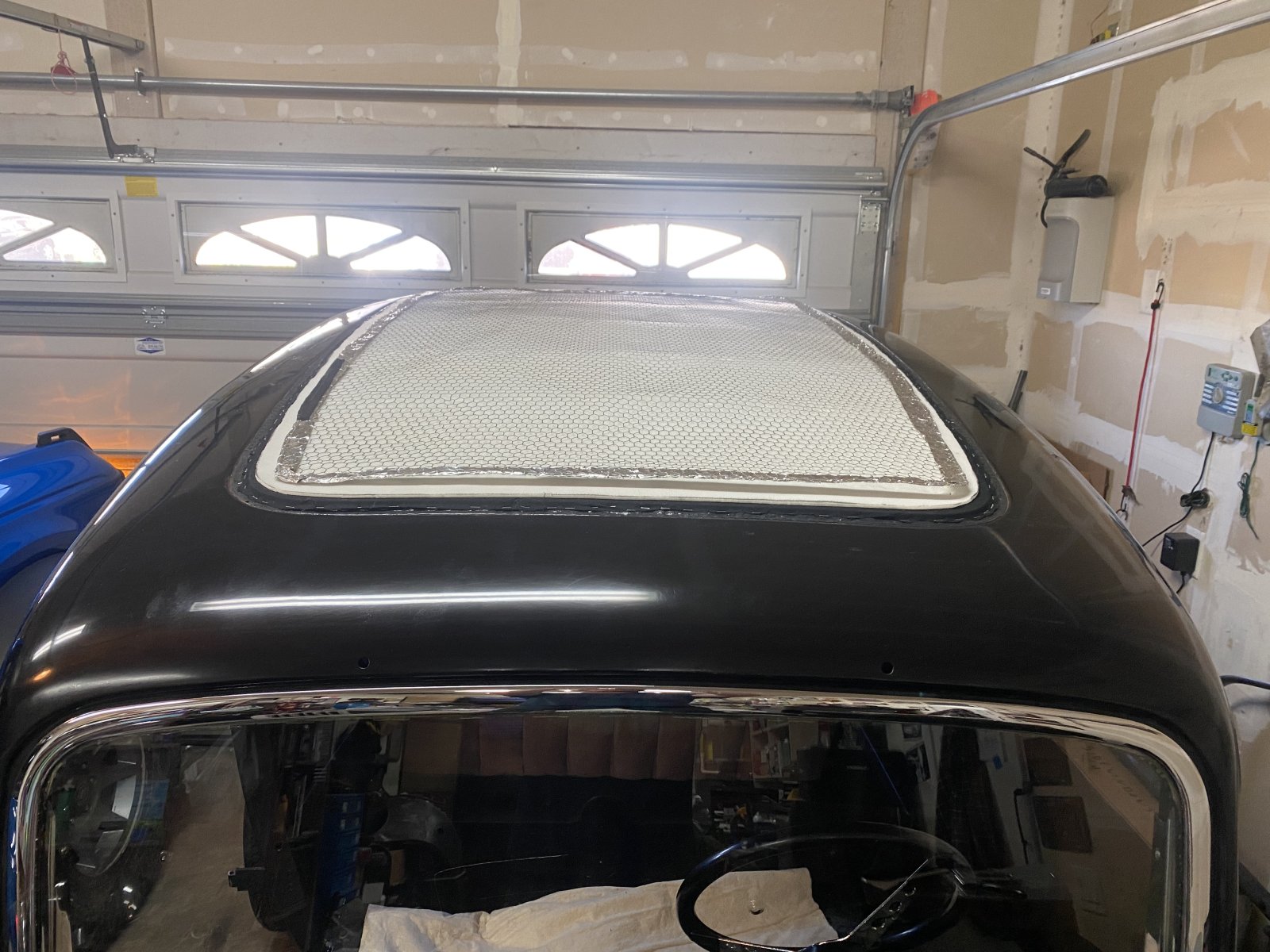

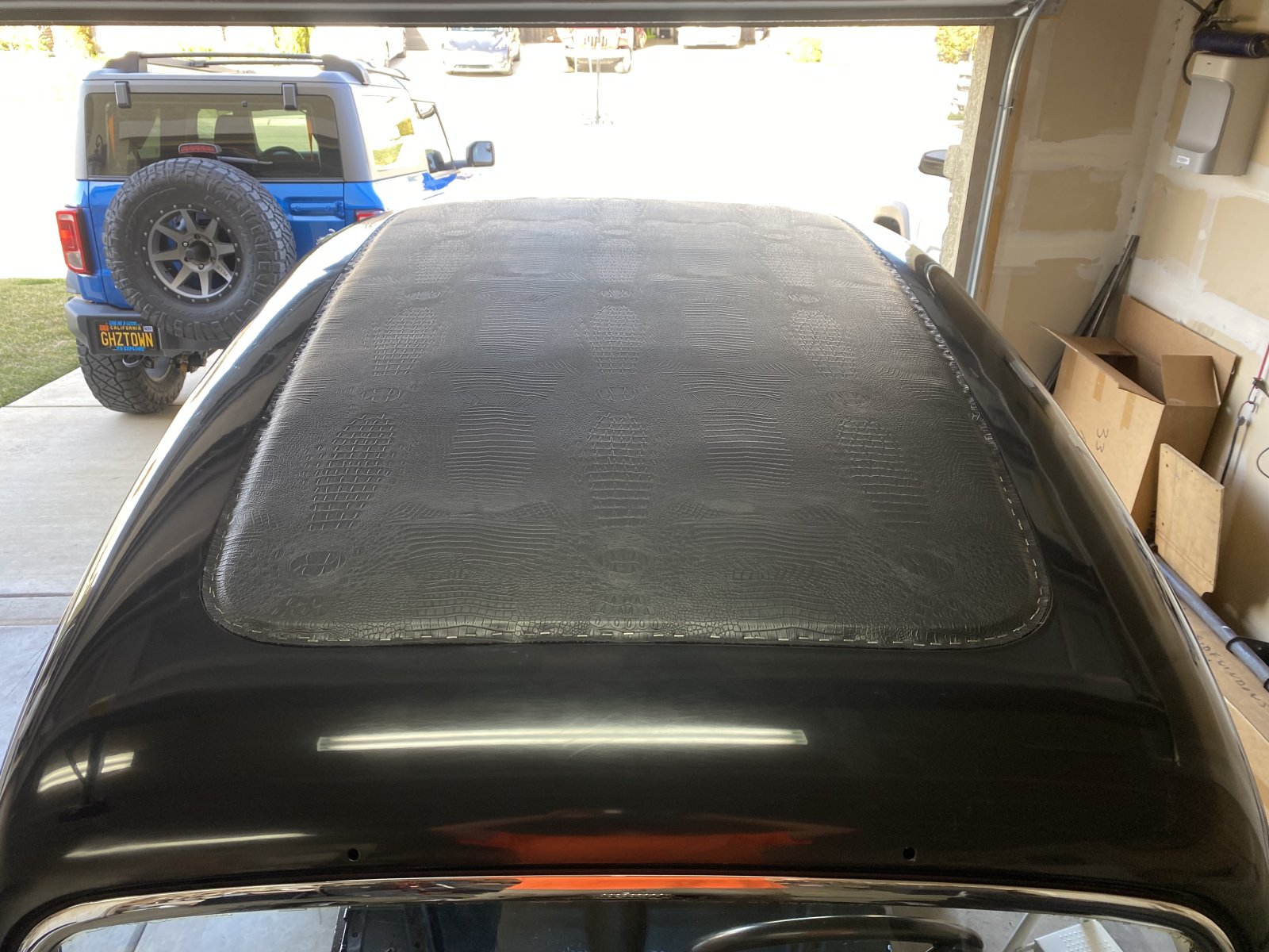

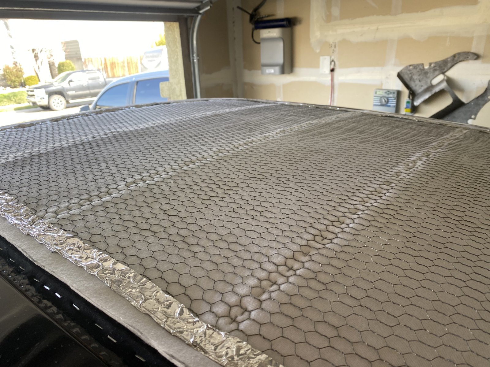

    5E5B0612-4743-46D4-A53F-92BFA7F30A0C.jpeg 1AC43FD5-359E-4531-8E06-74040875404A.jpeg E43DD318-BB28-499F-948B-91EC3324B8D8.jpeg E8E23191-3E7F-4615-A74D-B657B1DFB81A.jpeg 638F5CF7-7774-4B37-8F1E-EF4170BF3357.jpeg Got 2 more layers on today.

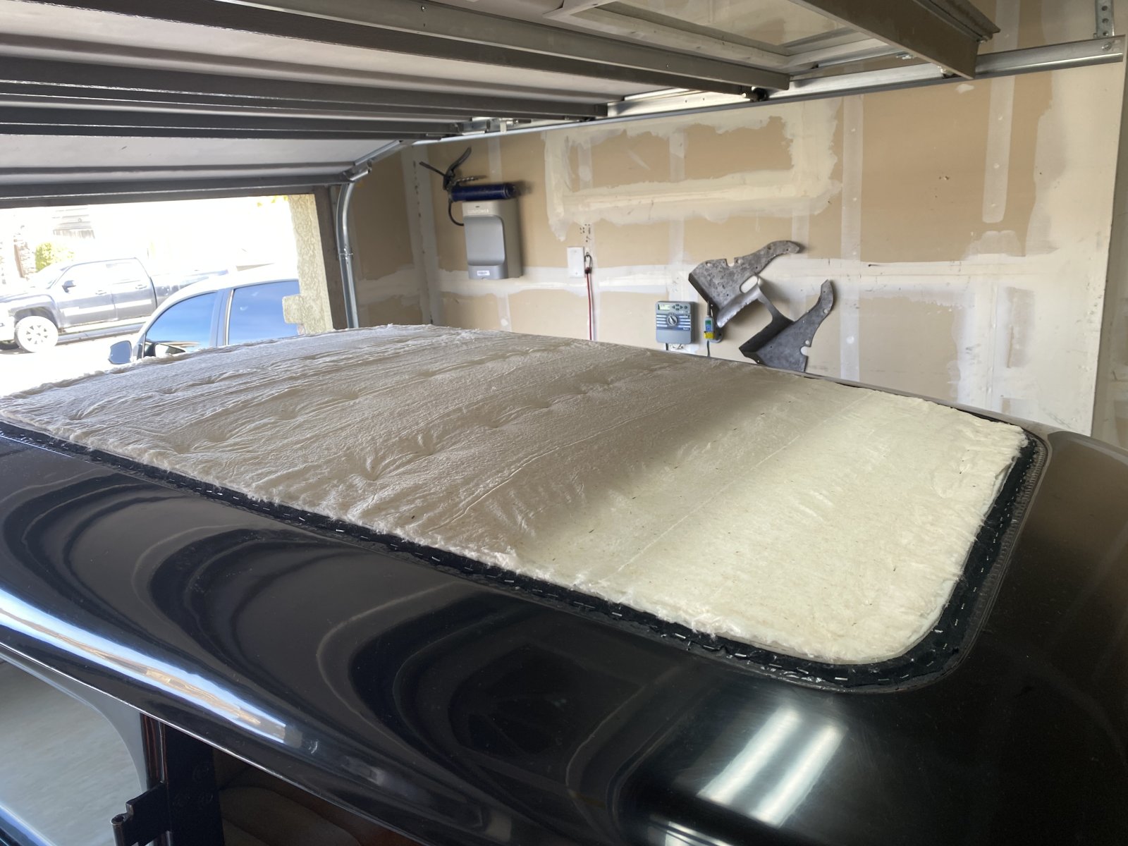

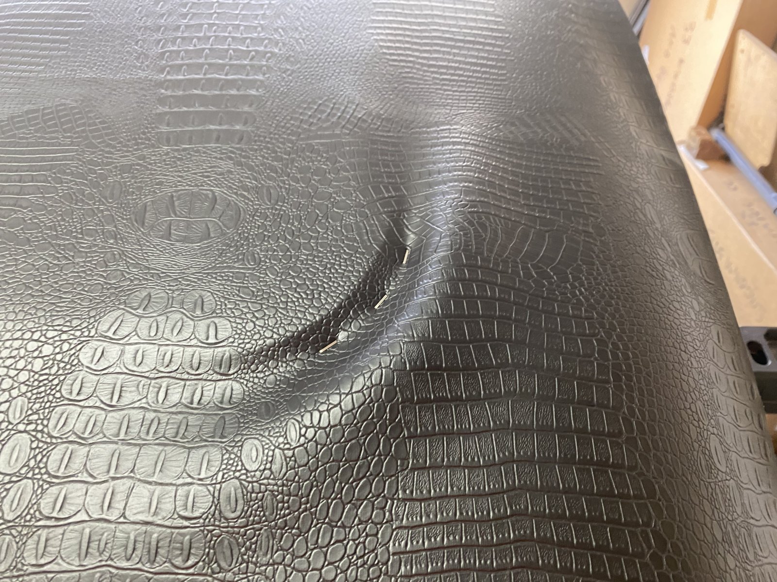

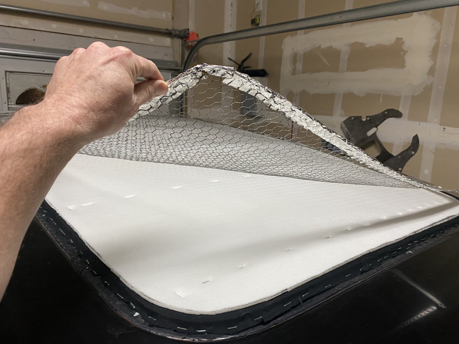

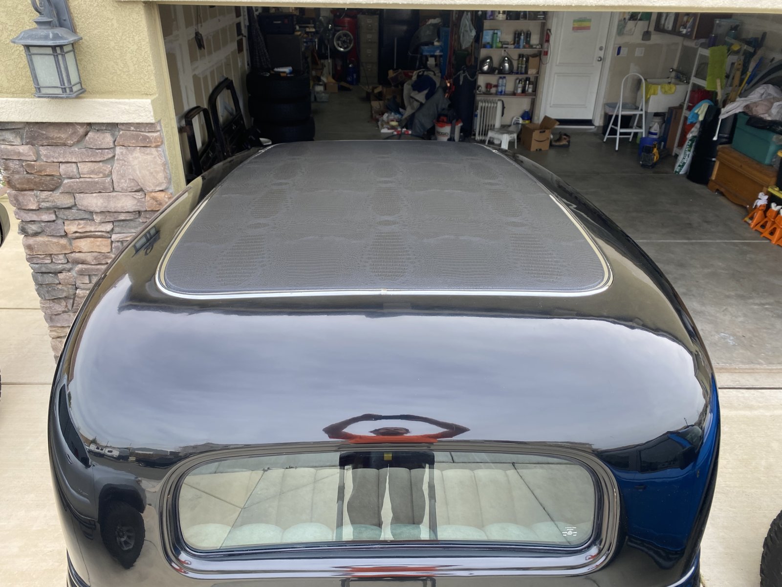

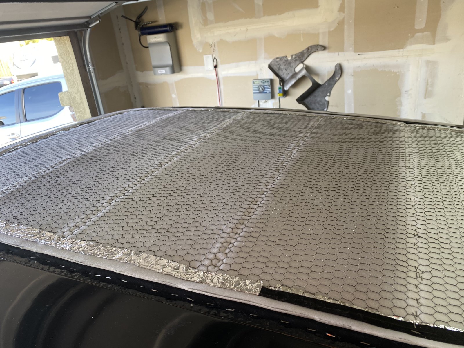

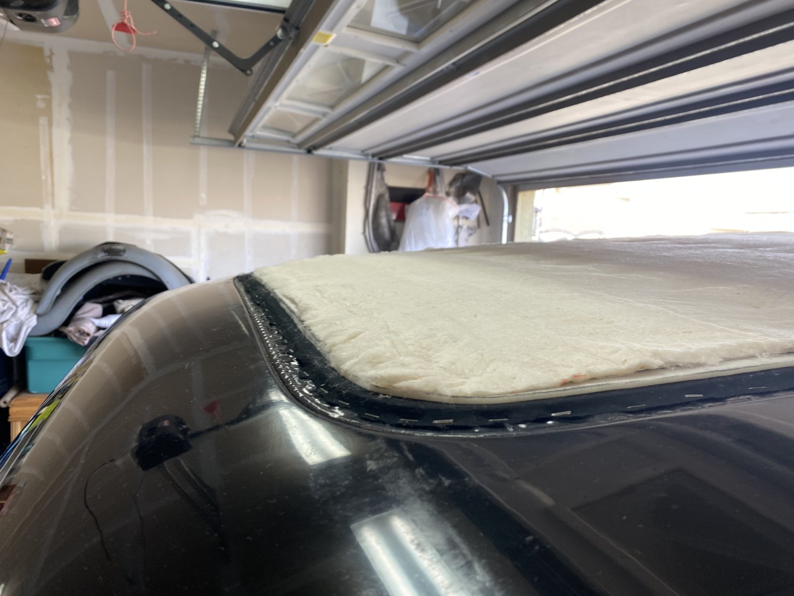

    Except Im not sure about the chicken wire again though. It is a little wavy
    So I will try a few staples to see if I can pull it tight. I didn’t want to use it became Im not using it for an antenna like original… Will just throw a nice blue tooth Speaker in the back when I want Some Music…but…
    I was thinking if ever a rock or pine cone or something fell on the roof it wouldn’t go through and hit me in the coconut!
    Cotton layer will go on top of it.
    Then the vinyl.
    Black Canvas- quilt foam- chicken wire
    Cotton- vinyl

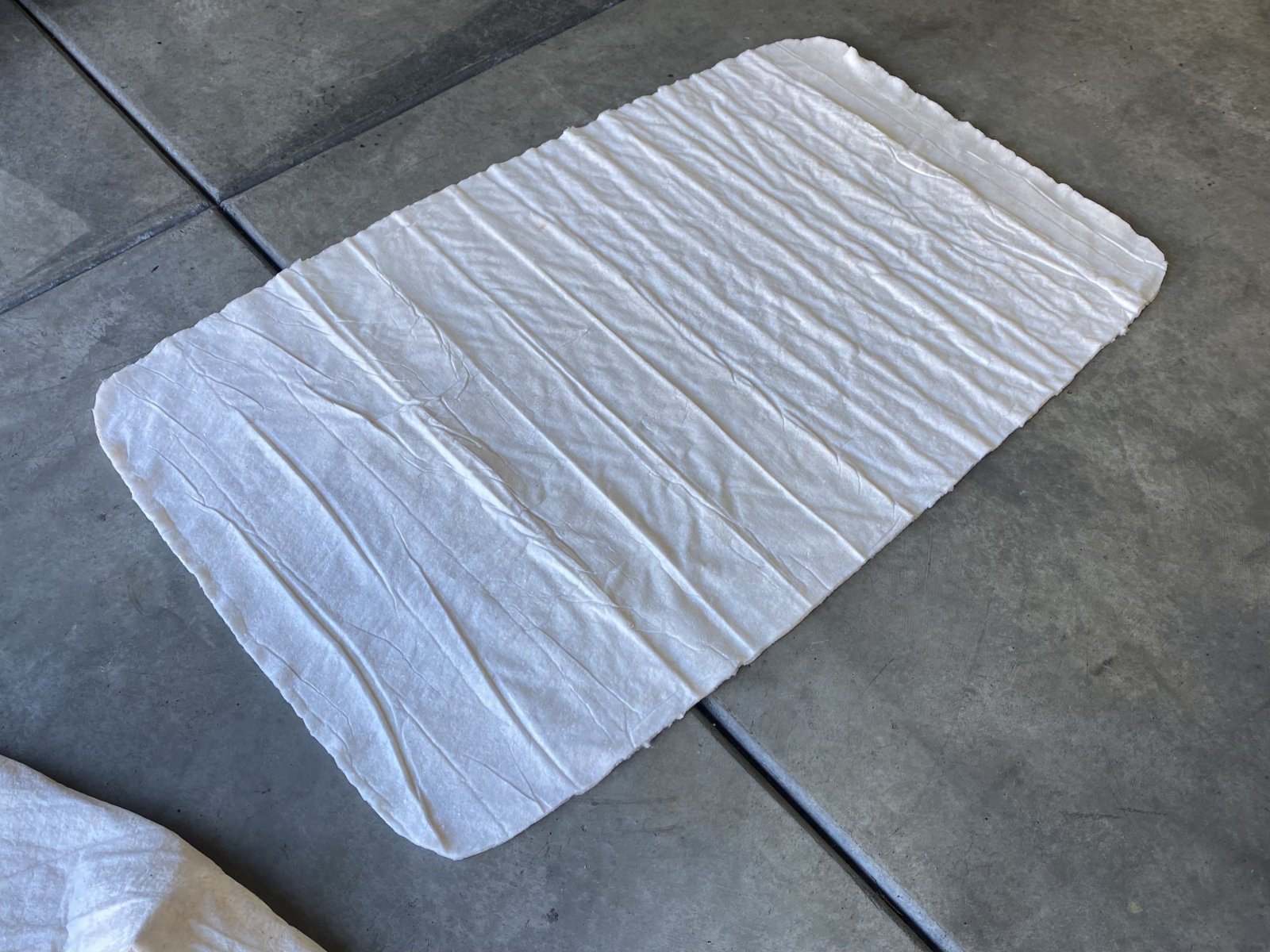

  2. 33Doll
    Joined: Sep 27, 2019
    Posts: 1,591
    33Doll

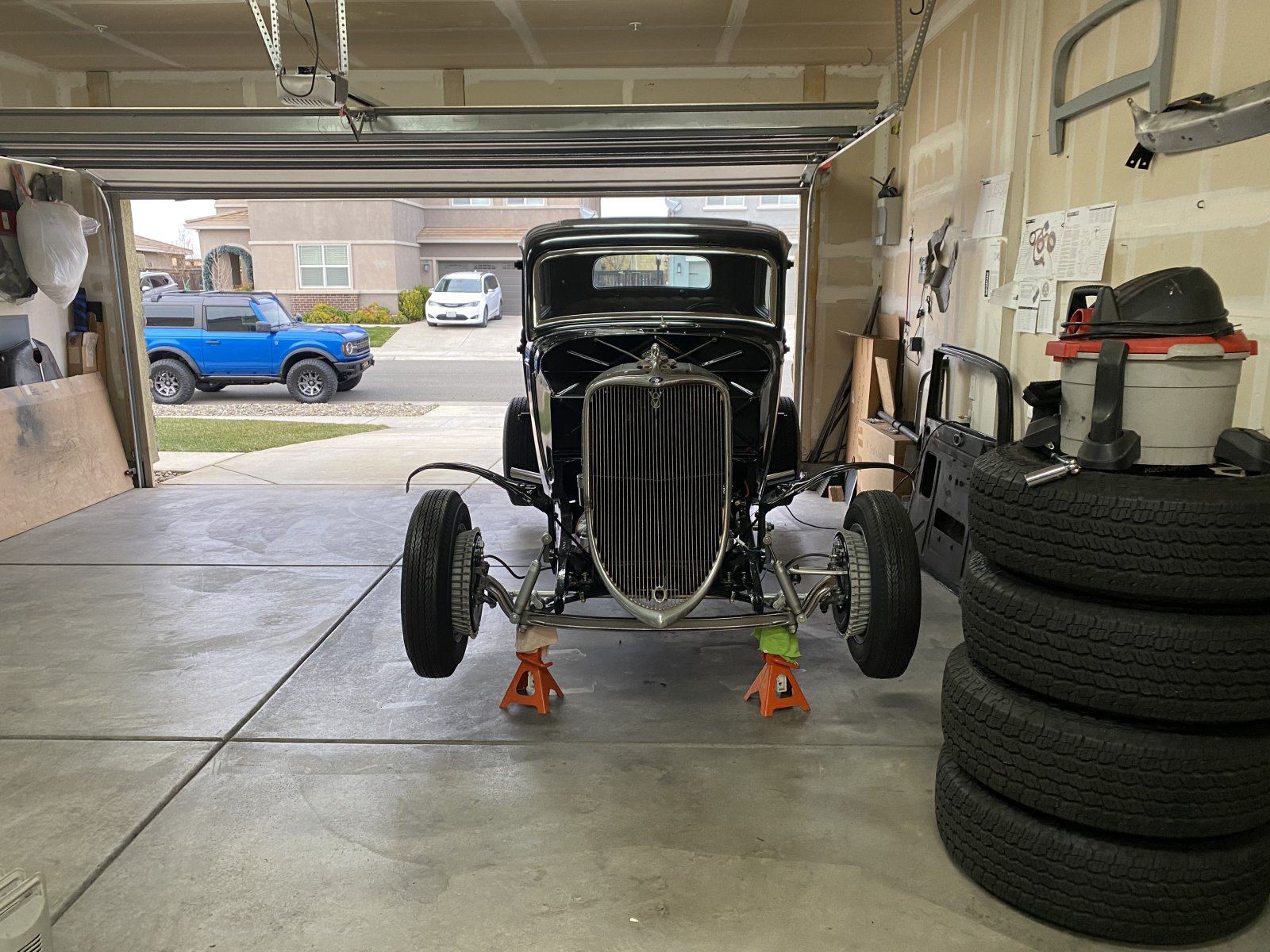

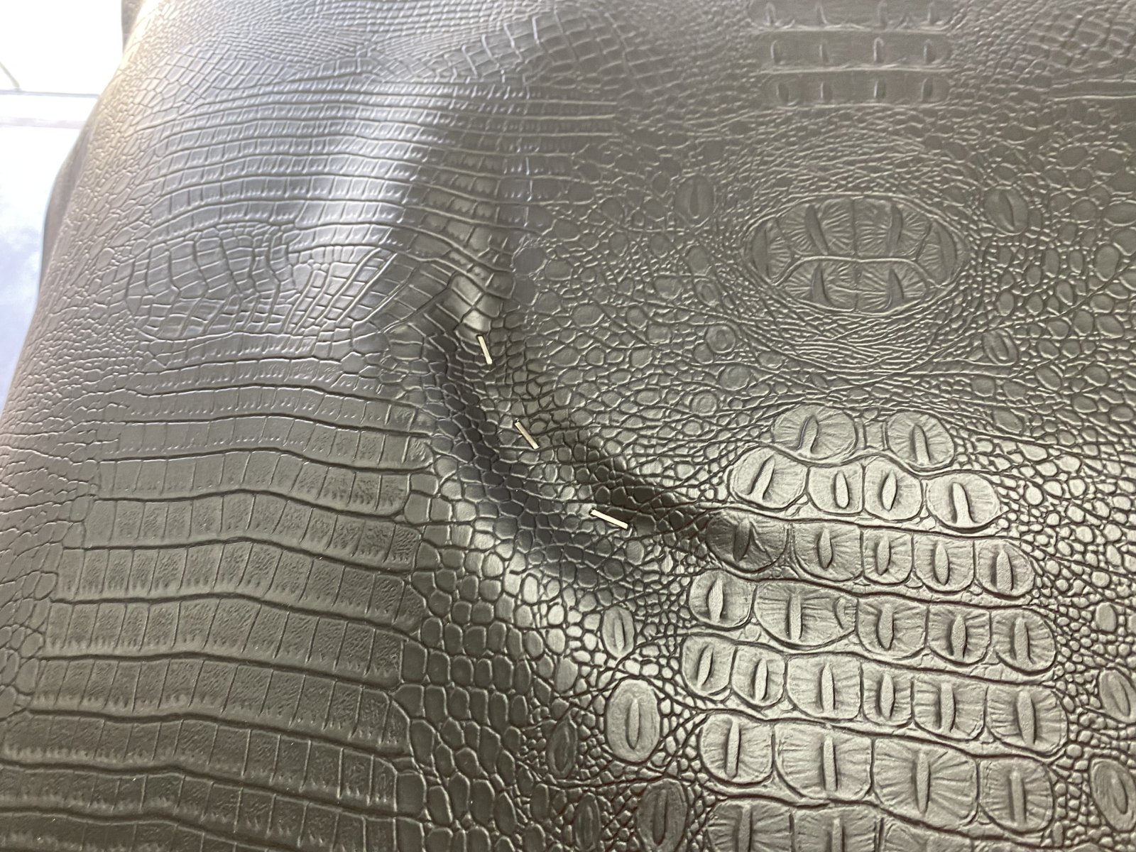

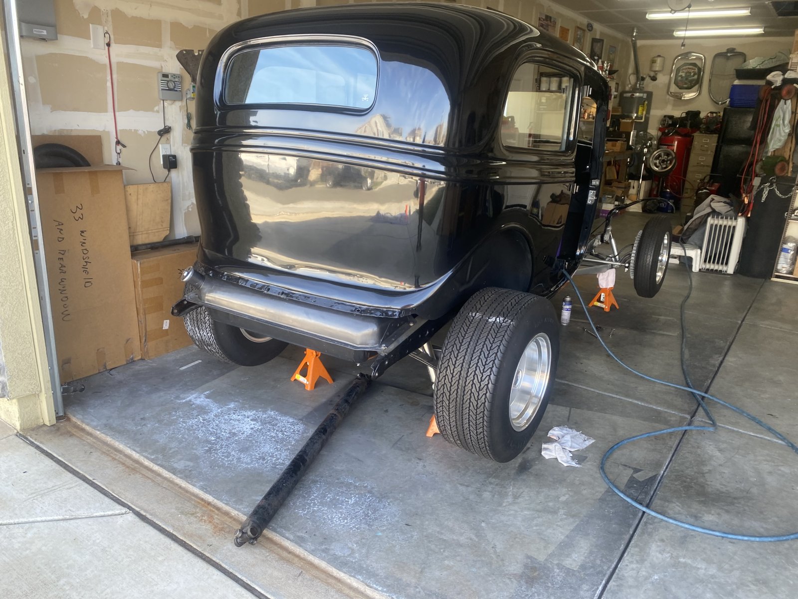

    466B7835-D22D-47B2-9ADE-C03A66F16197.jpeg 4C017D86-16DF-415E-B22F-20C56FBFC377.jpeg Think the wire will be fine

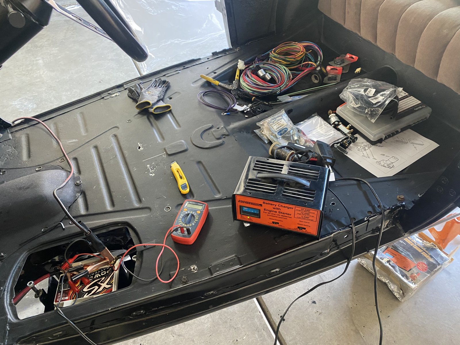

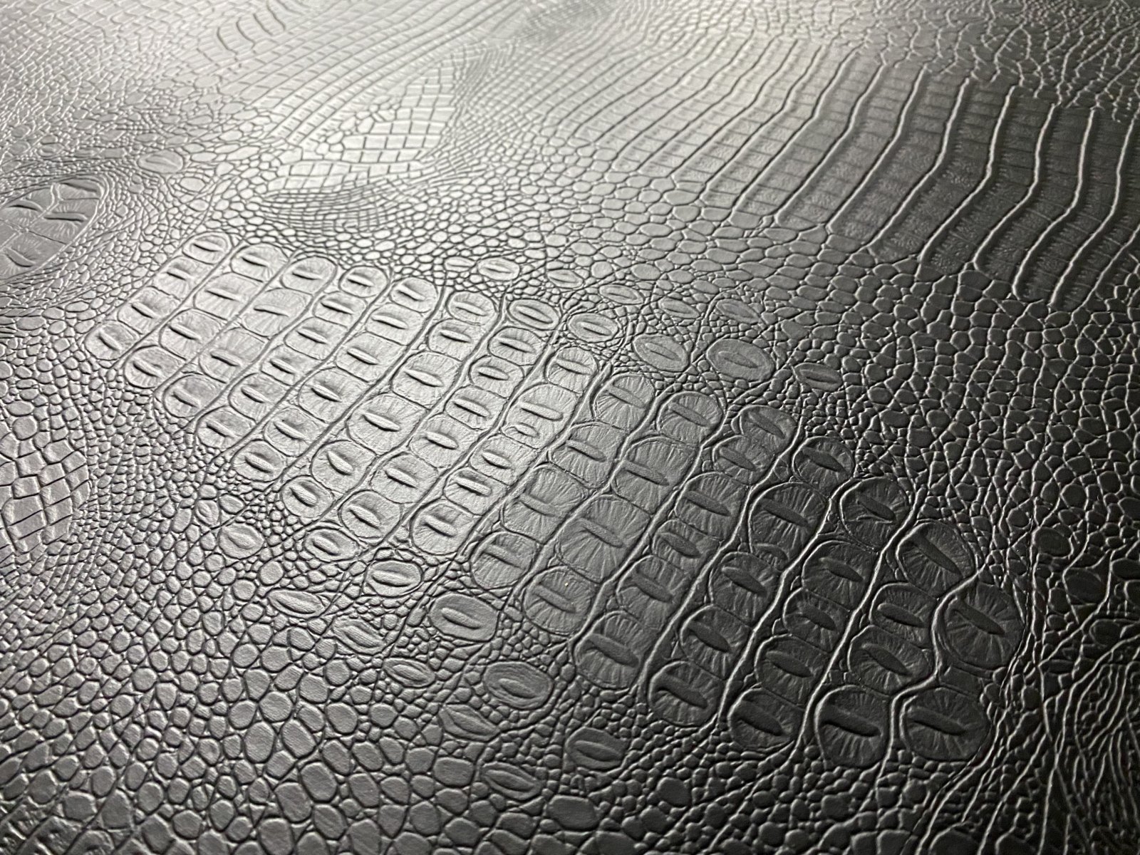

    4B5B3FB2-C3C9-41C9-86D5-239E0C68BBD3.jpeg B85D36BE-9433-4CC4-B1B6-14DE317CABED.jpeg F53CAD9B-A60D-4EA4-B5E4-A30F3C5F781D.jpeg A6C6FAB6-A9A3-4CB0-88B1-9AB71D2203F4.jpeg Things are getting real!

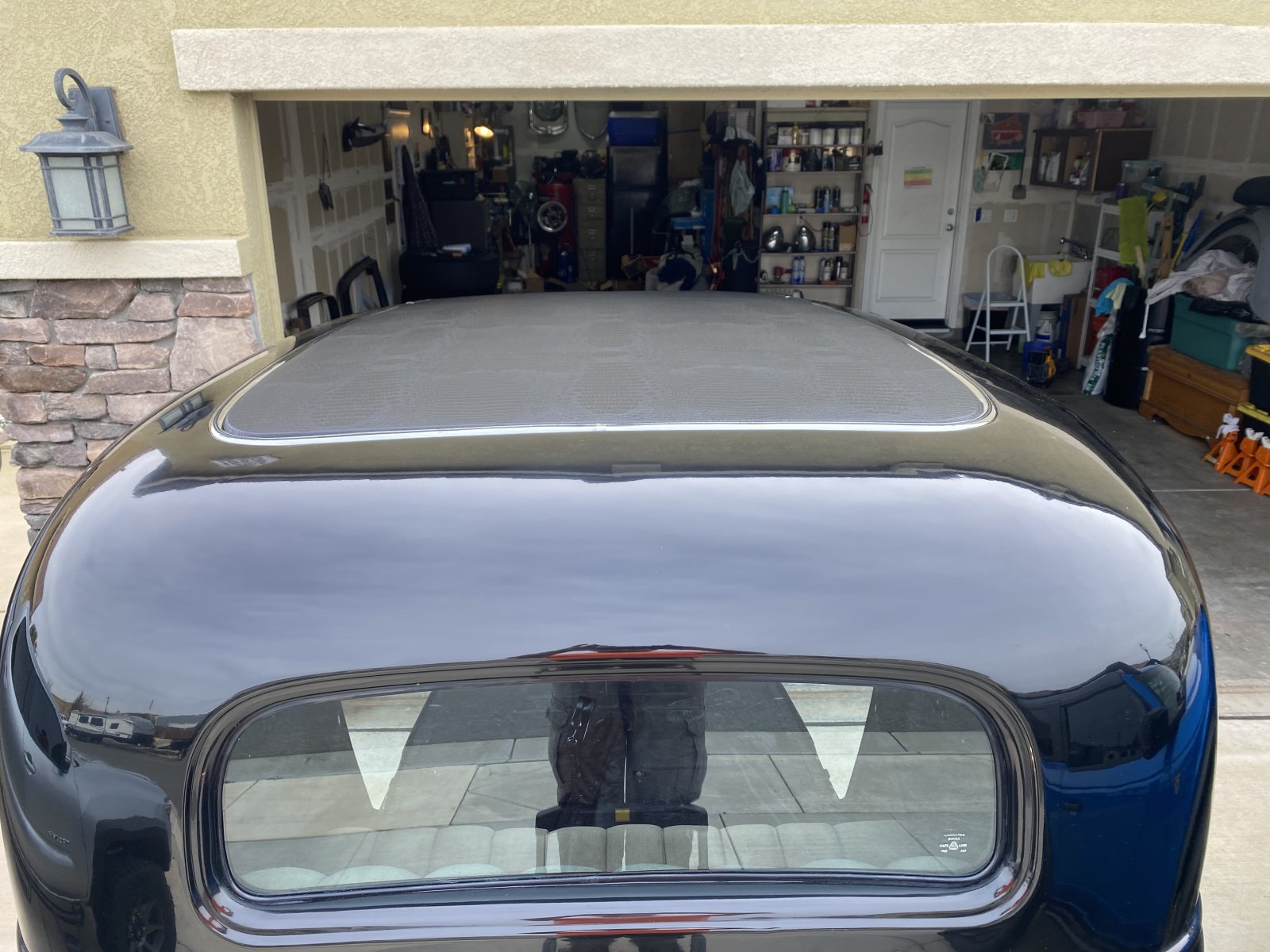

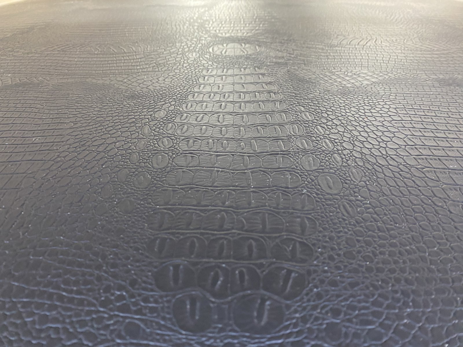

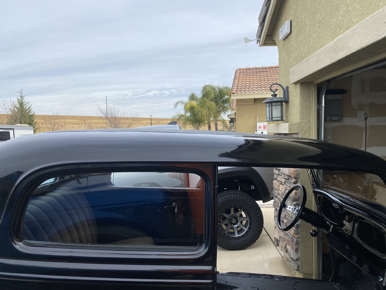

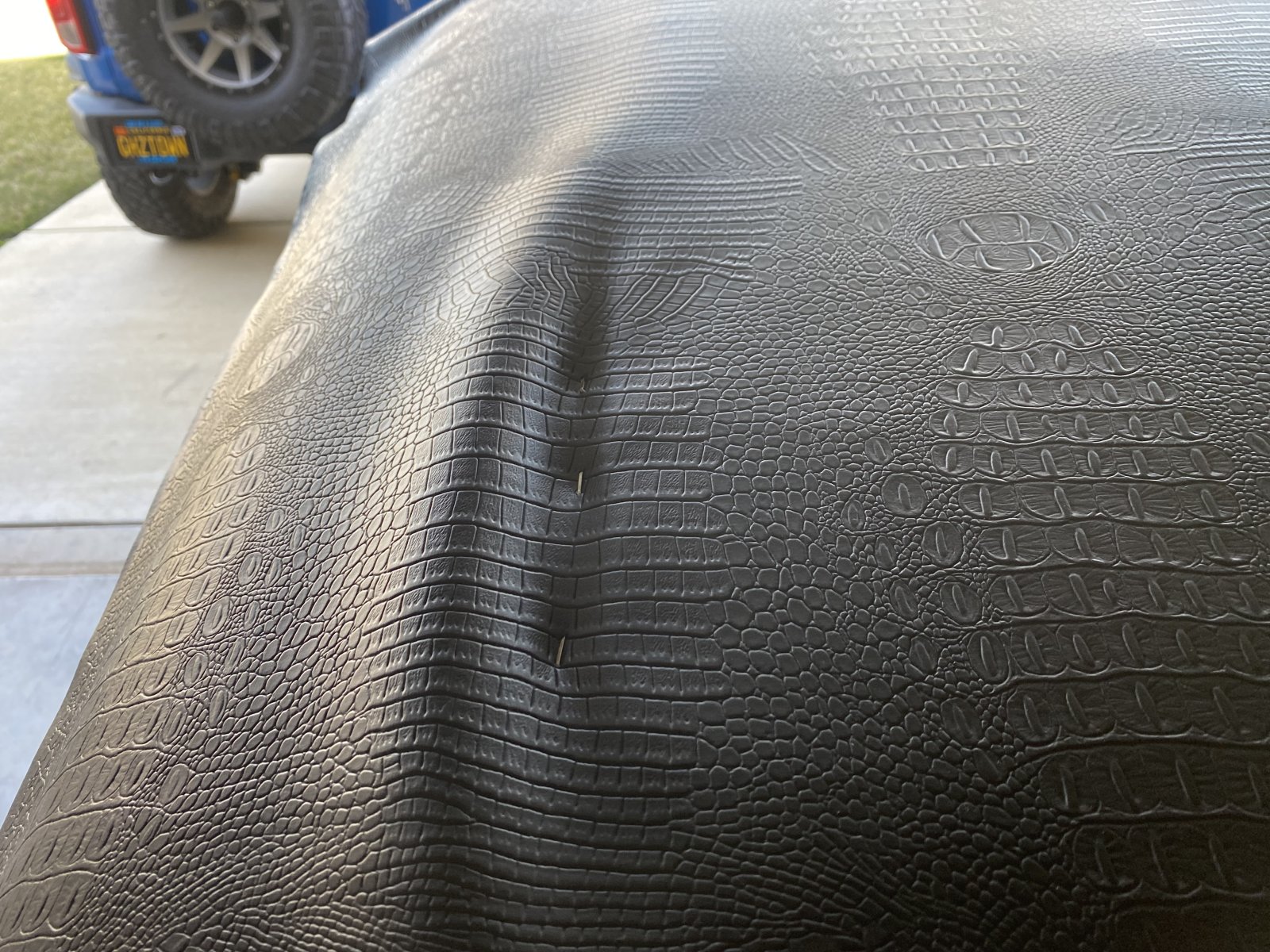

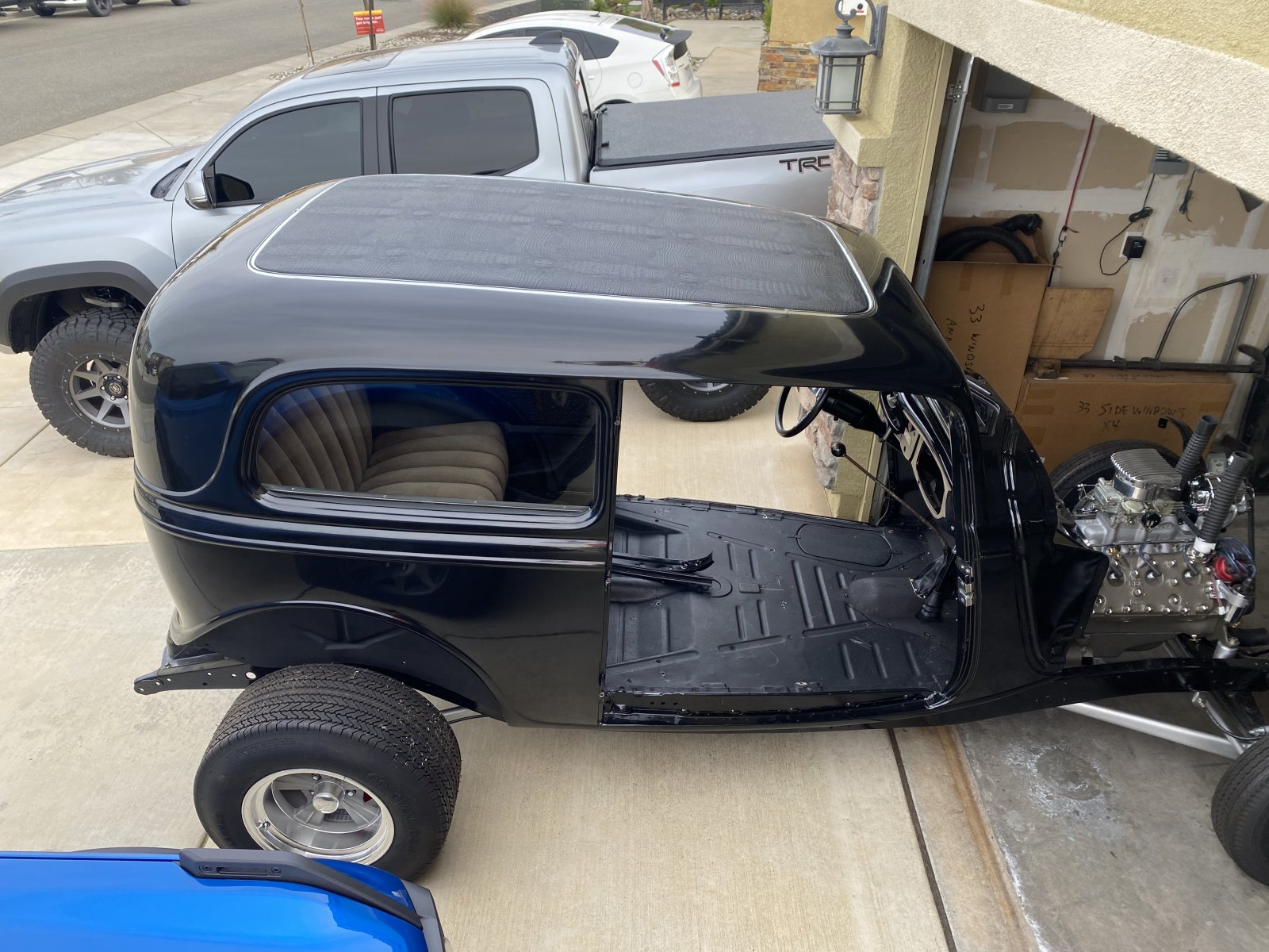

    Got my Gator Print!
    The ‘33 is getting “Rick-a-Fied”!
    No longer Pops Style at all!
    But still Cool! (Better…shhhh..)

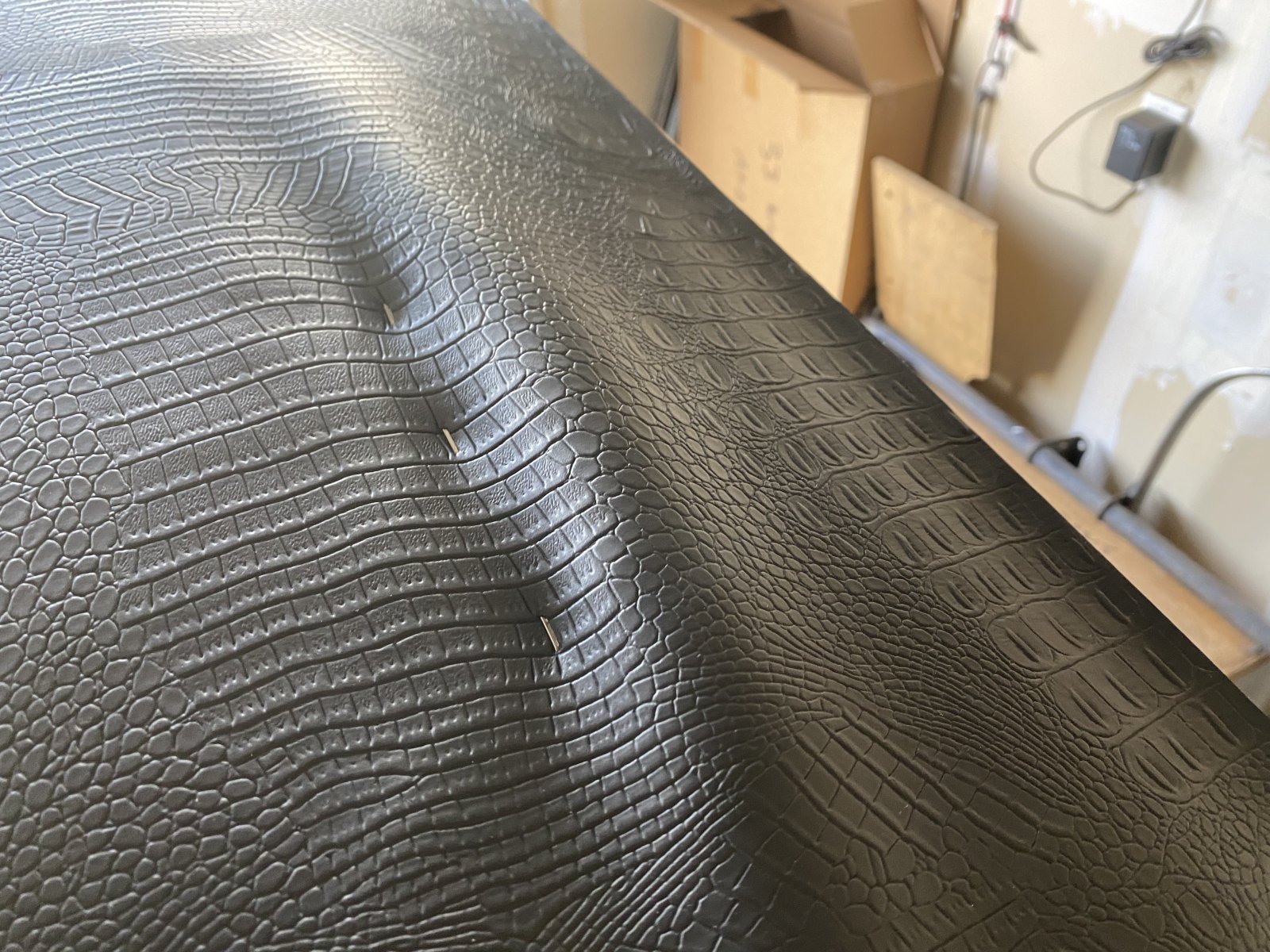

  4. 33Doll
    Posts: 1,591
    33Doll

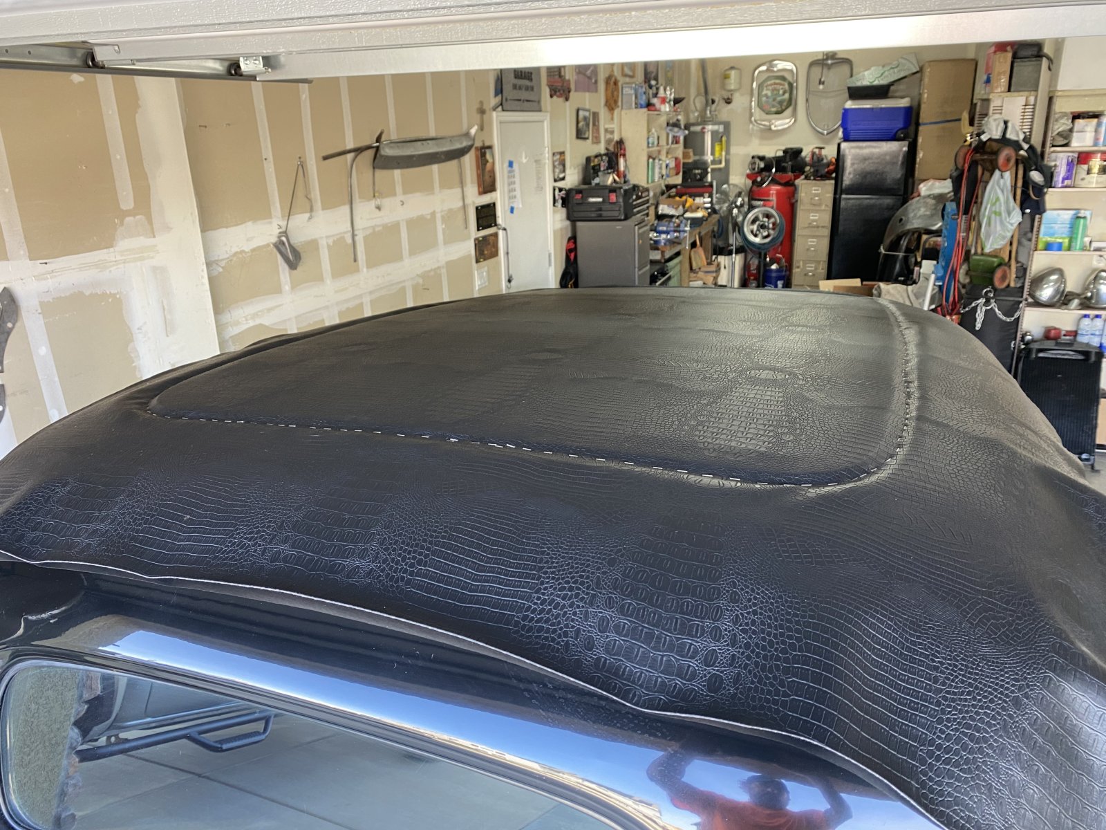

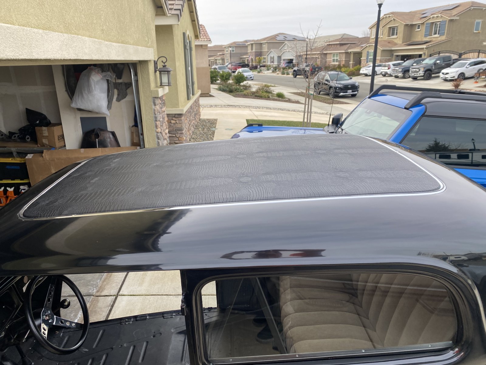

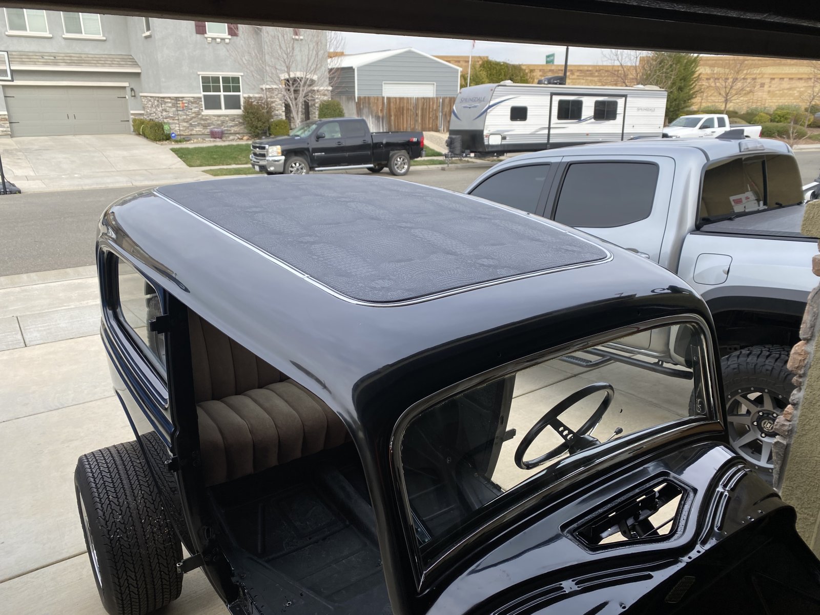

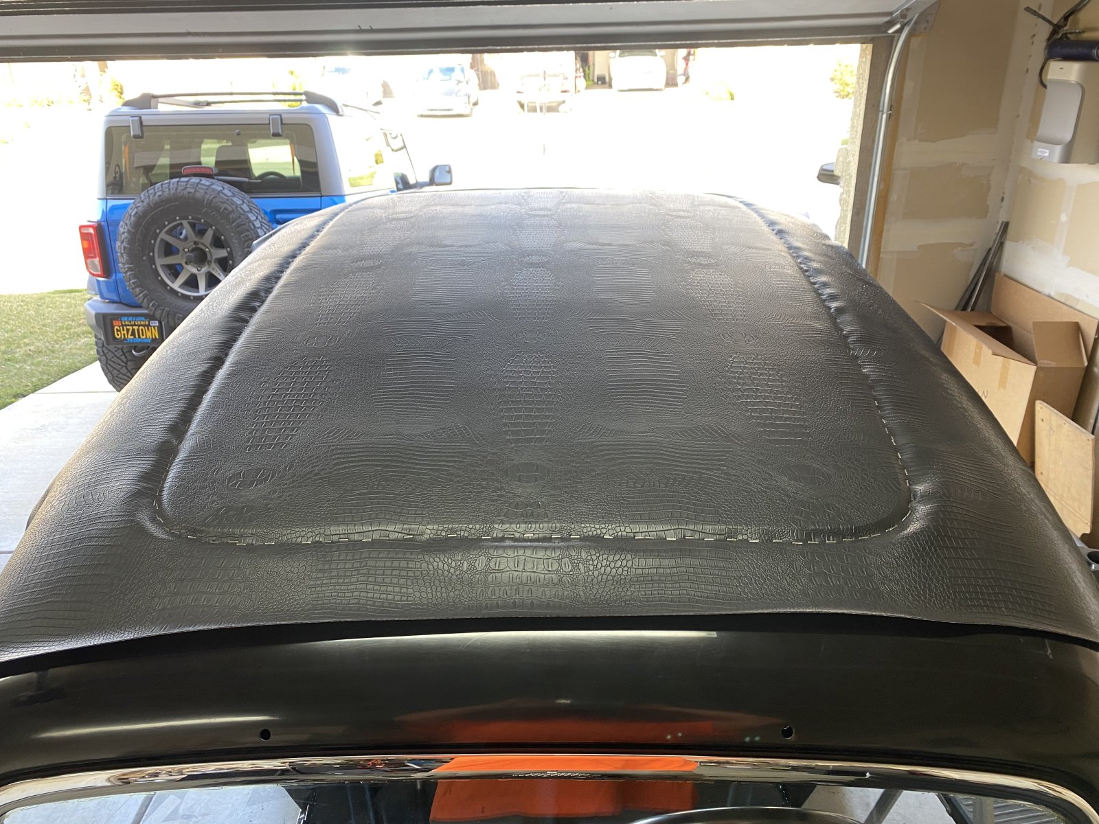

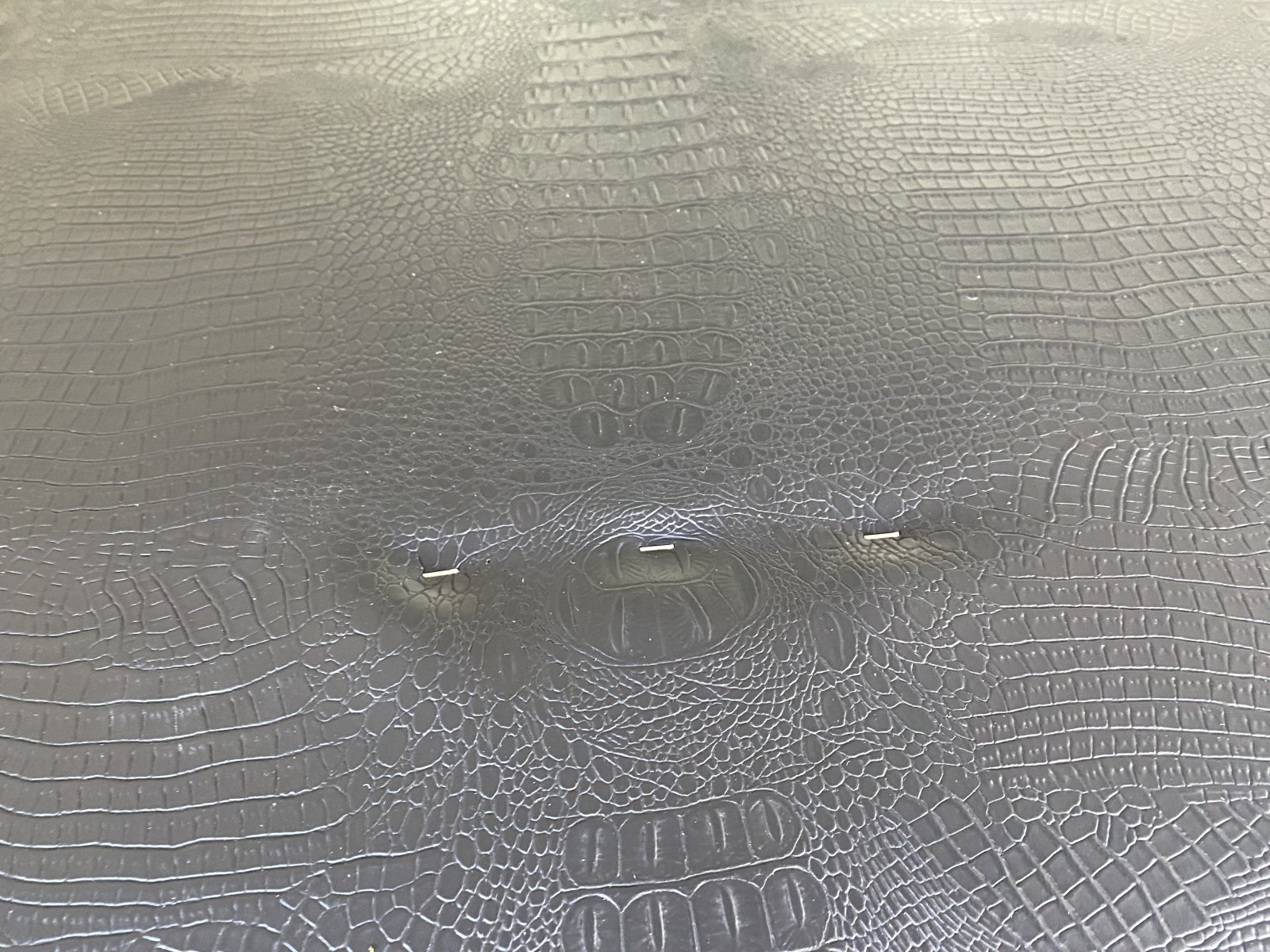

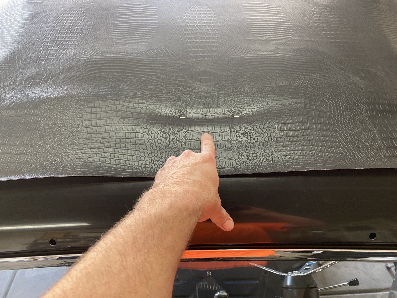

    38EC1936-C536-4714-8691-E242C59DE1EA.jpeg 9F0F591D-76C0-4369-901D-A069BA7D217A.jpeg EDFC1EEB-D90C-47B3-BC99-650D610E034C.jpeg 78186F4C-4E7A-4CA7-90F7-0EE067DBF0C7.jpeg D88EC141-D17D-4A4C-AB44-30E233747BC4.jpeg E4D9252C-49D9-4EFD-B572-1853B0255613.jpeg 24176BDD-96F3-4115-9B0A-D2E2D31E9BCF.jpeg 95414DAB-C291-4706-9723-37261789B6EA.jpeg ED86E3B4-99C9-4E4C-94F1-2618BF63634C.jpeg B4F4833C-B940-492C-AD77-BEFF1FAD392A.jpeg 122C3F2F-FB82-4742-BDD4-16D961861C04.jpeg BBB440FF-113A-4708-B467-855C7A5D0F57.jpeg 522CE727-3E06-4DA5-A256-3F606E4B17F6.jpeg 4635BAC3-DB2C-4D1A-AF94-57A56C9E9921.jpeg 730D4AE1-EC80-435F-948B-C286BE8769B1.jpeg 63E6EE3A-2003-4EF8-B934-95C27BBEBF89.jpeg 213B52AA-27B1-48C3-BC67-CD882D15C1F9.jpeg 8B3F423D-A5E7-471B-B879-F9999CC488F3.jpeg 8236F223-2FF3-486F-93EC-1B7294F87D47.jpeg B3A014D7-E916-4CE7-AADD-6329428ADCFC.jpeg E48F8693-53D5-4055-997C-D66AD37B5C3C.jpeg I am flying now!

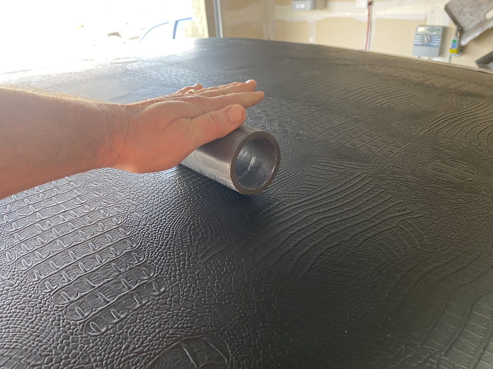

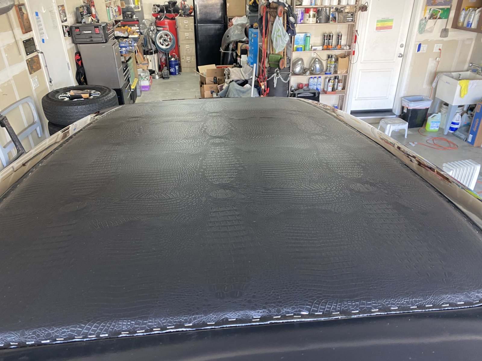

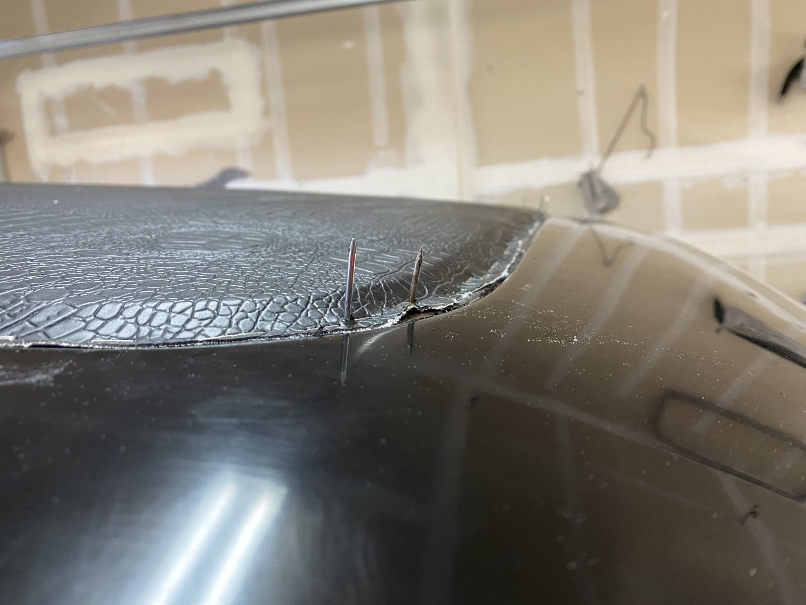

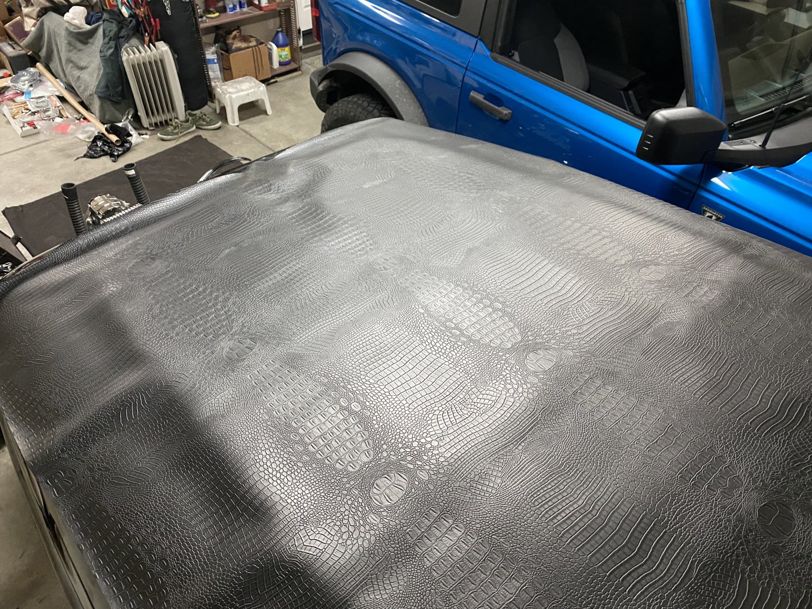

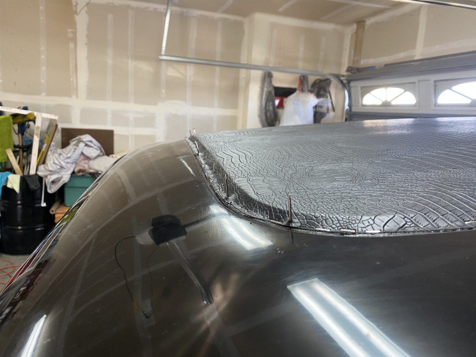

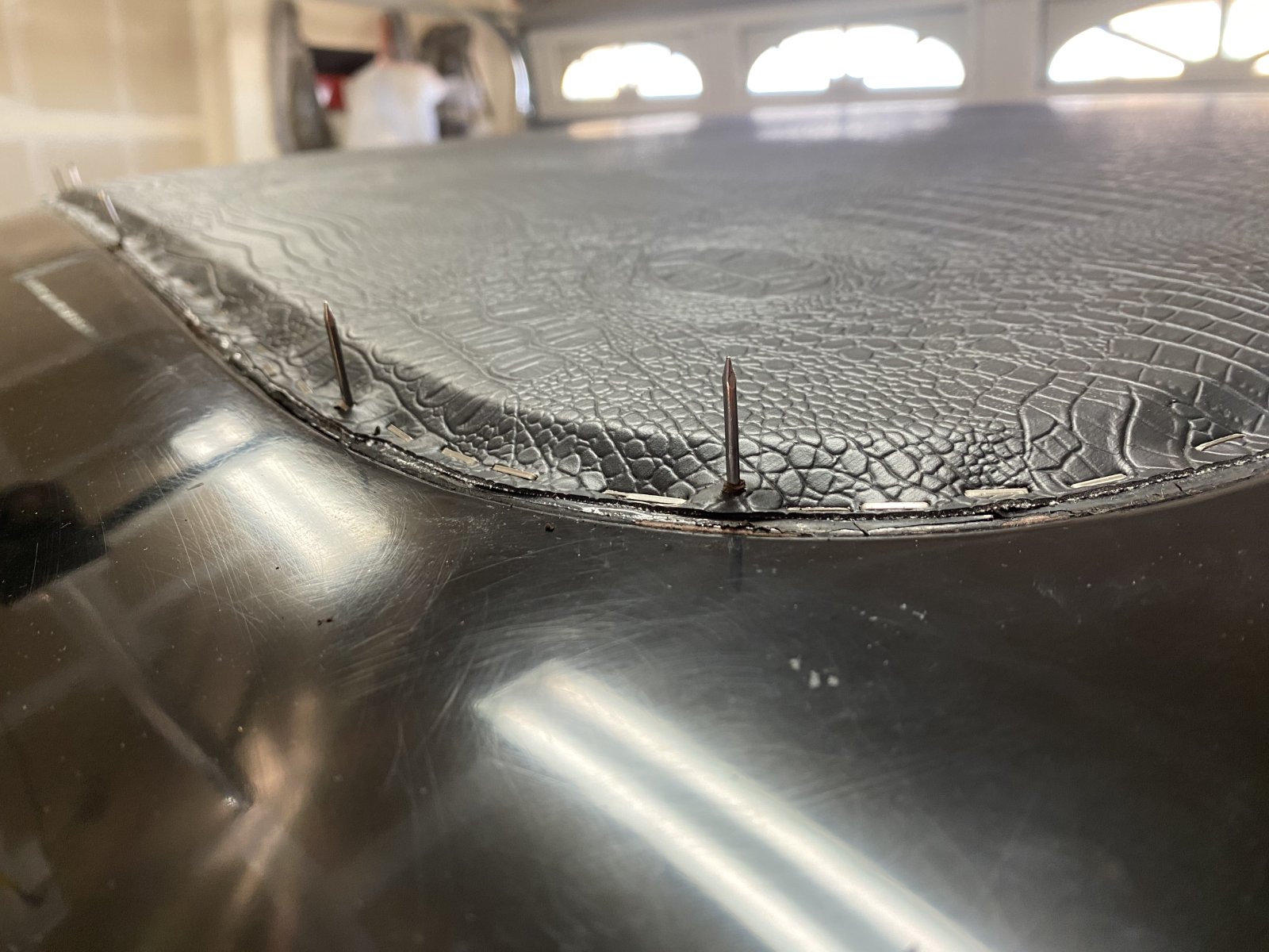

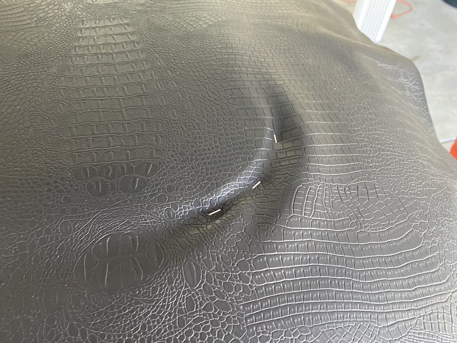

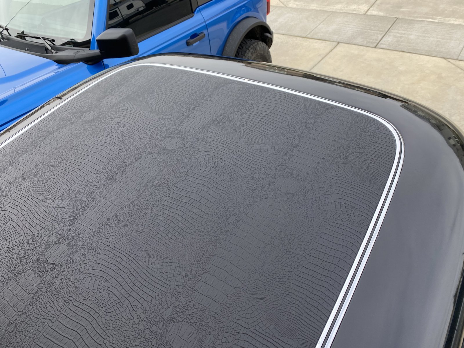

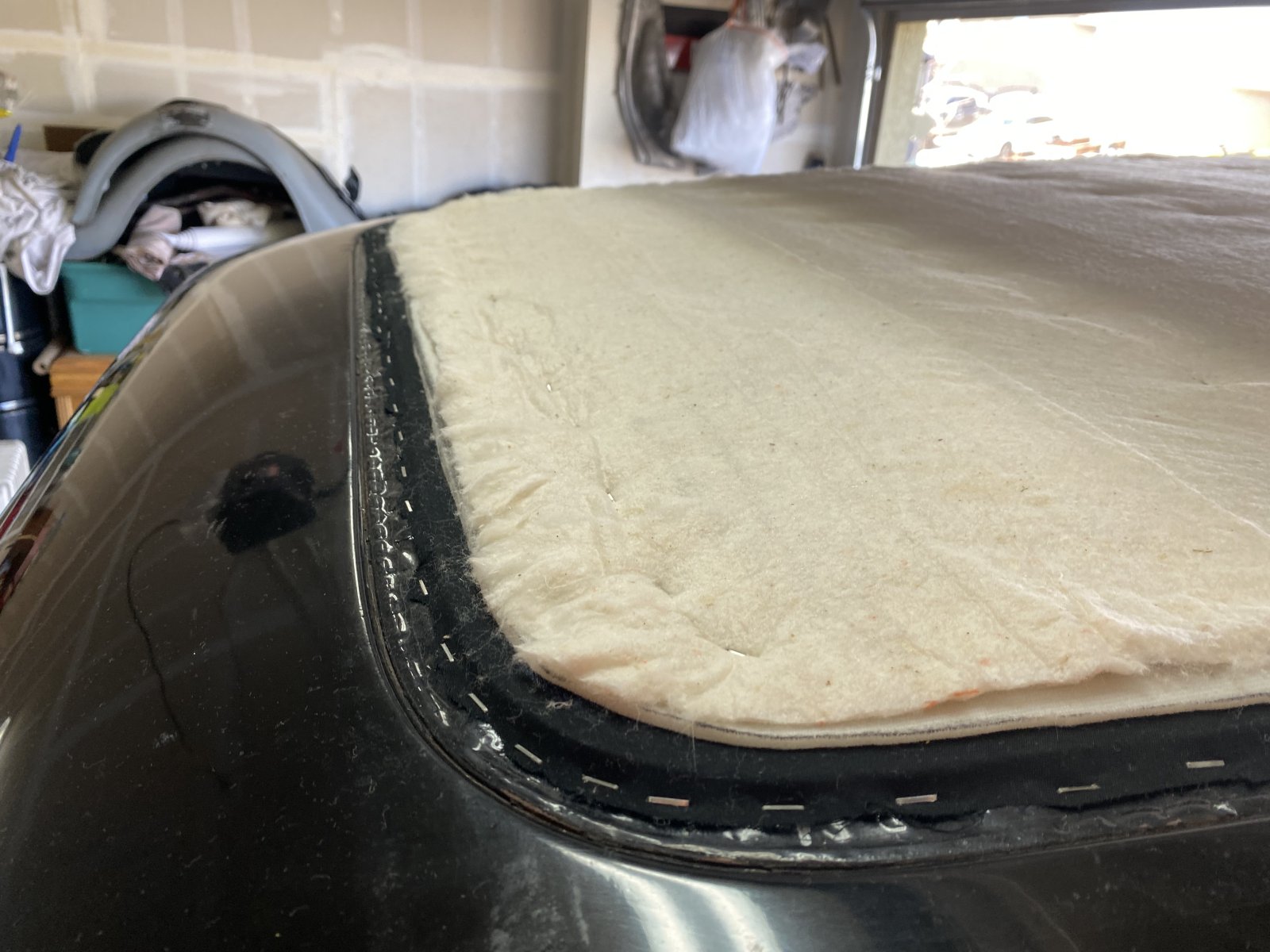

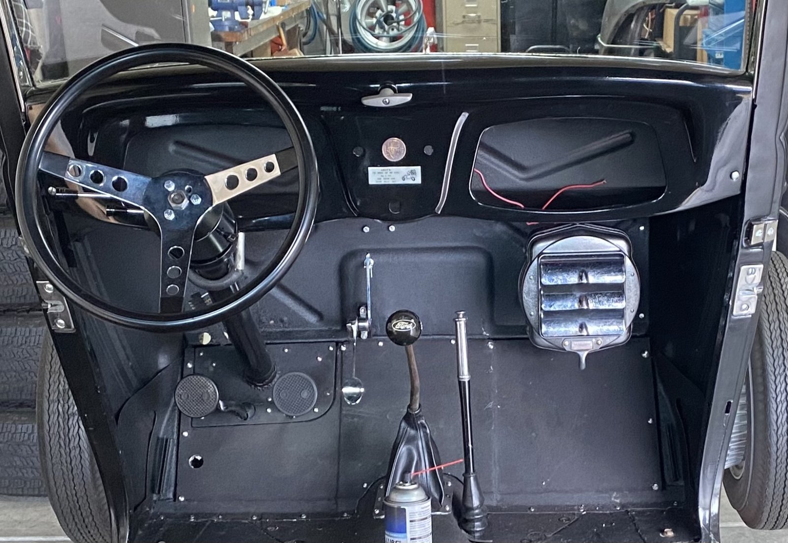

    I "Rick-a-fied it"!
    I went with the 64-68 theme I have going and Gatored The Top!
    I'm gonna use the same stuff on the interior, door panels and kick panels in such !
    Pulled the edges of the cotton to blend better with the edges
    Rolled the bows and edged to flatten the padding across the bows better!
    Awesome!

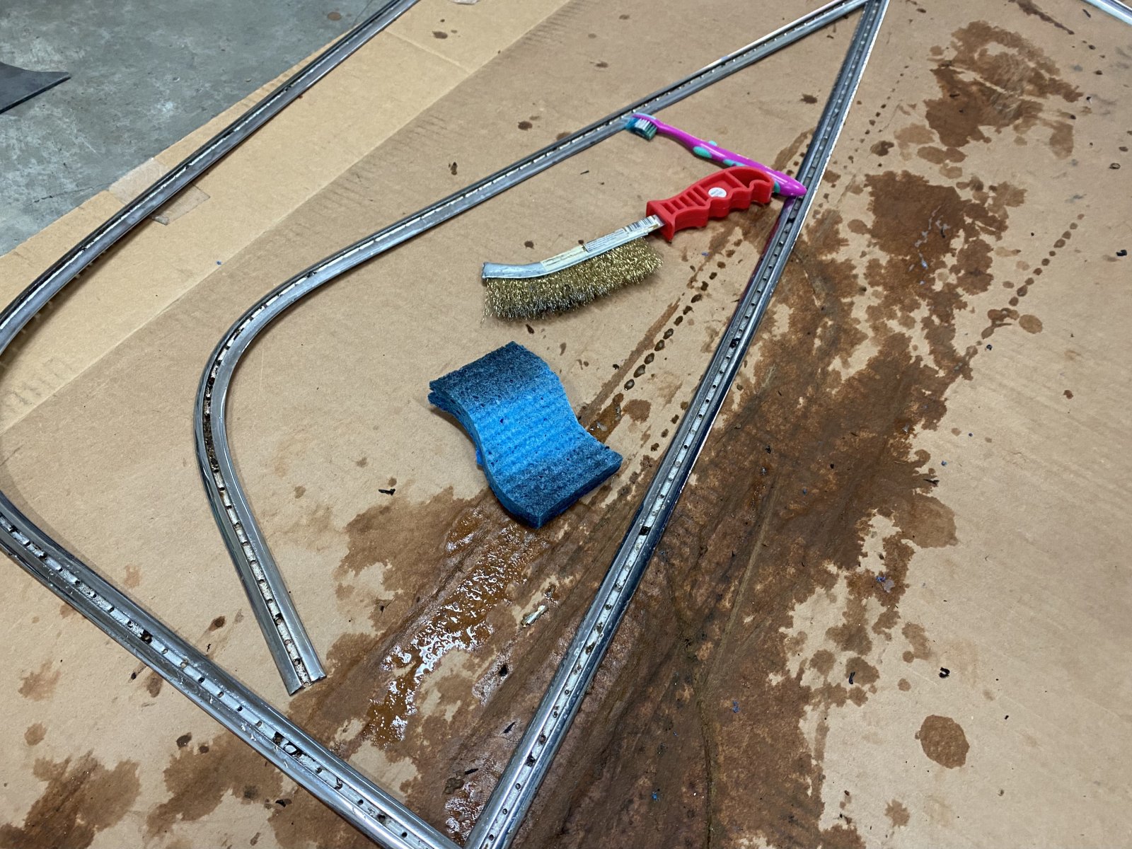

    I just need to use that Maguires wire wheel stuff on the top-trim, and then polish it then I can mount that !
    Don't wanna wait too long in case the Staples decide to loosen up !
    Of course I put a **** load of them in! there stainless 5/16
    Note:
    For those of you that are interested, I started in the back middle of the top…put three staples, when around to the front, stretched it, put three staples in, then went to each side in the middle and pulled it, with three more staples, and then I went to the corners like I’m pointing and then just worked my way around from there, pulling and stretching the whole time! In case you guys want to do your own top???
    It’s a learning experience, but I think it’s turning out good !!
  5. dumprat
    Joined: Dec 27, 2006
    Posts: 3,572
    dumprat
    from b.c.
    That gator stuff looks great on there!
    33Doll likes this.
  6. 33Doll
    Posts: 1,591
    33Doll
    Thanks!
    I wasn’t sure at first when I ordered it because it’s slightly thinner than the stock vinyl, but it’s a lot more pliable so I got it really tight didn’t even use glue. And it’s supposed to be marine grade auto grade, etc….?
    Jim Bouchard and chryslerfan55 like this.

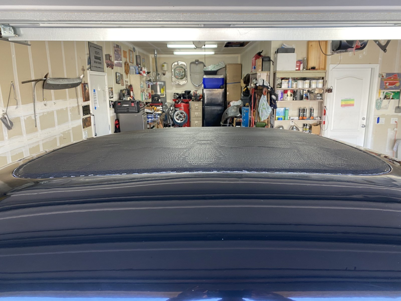

  7. 33Doll
    Posts: 1,591
    33Doll

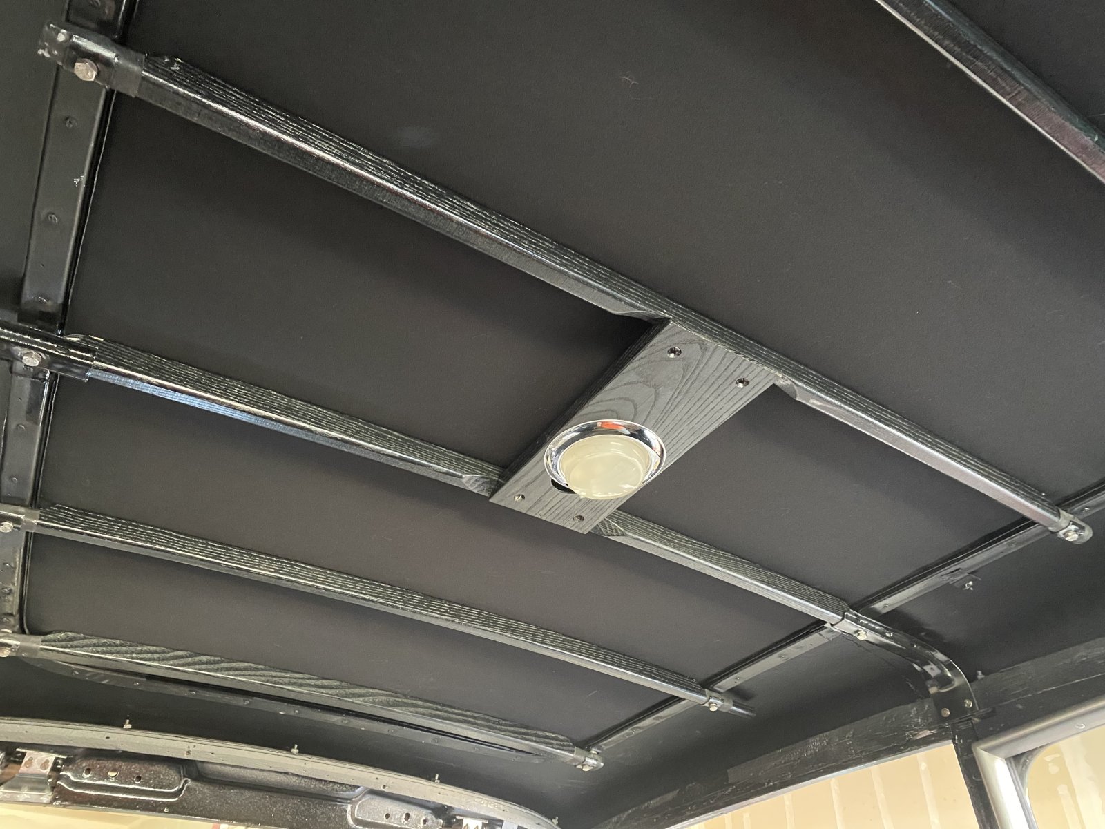

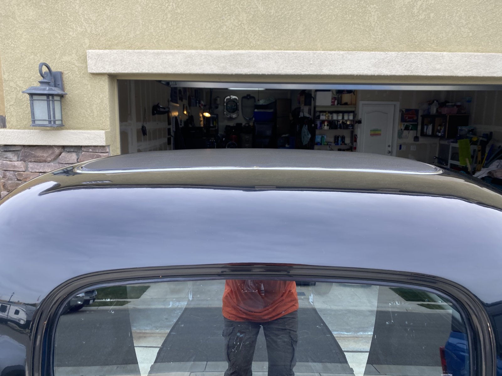

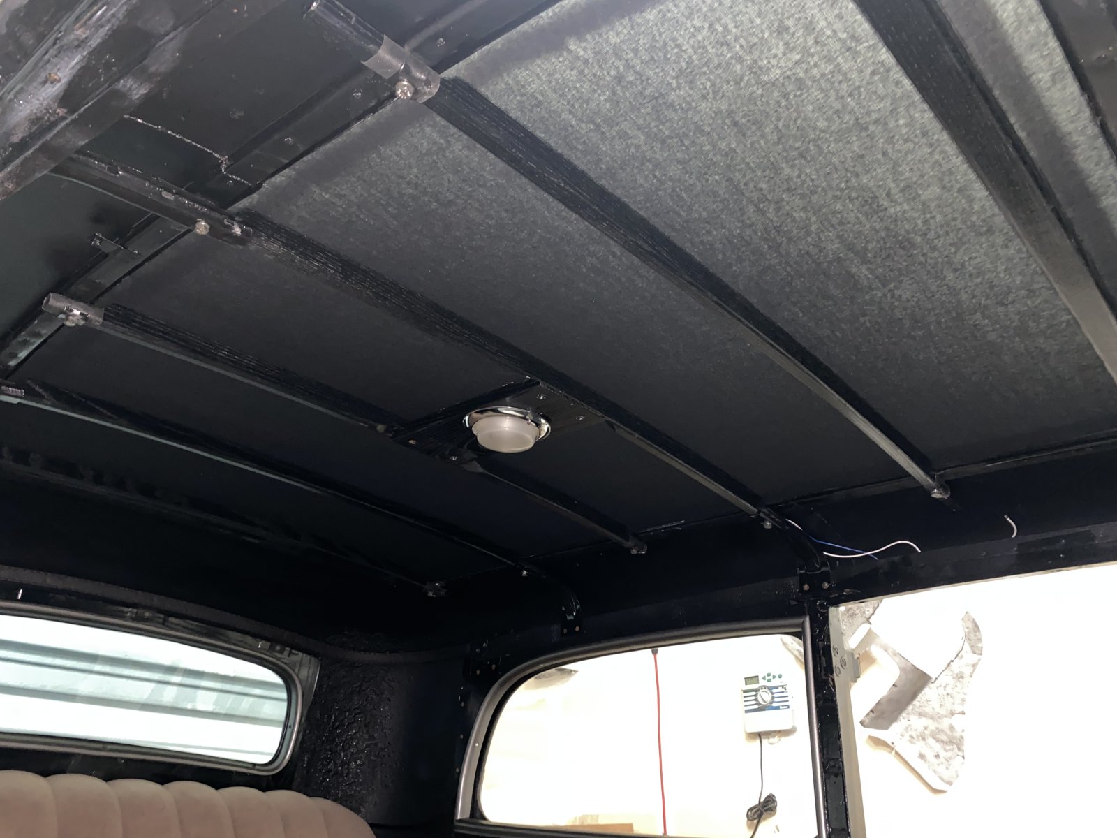

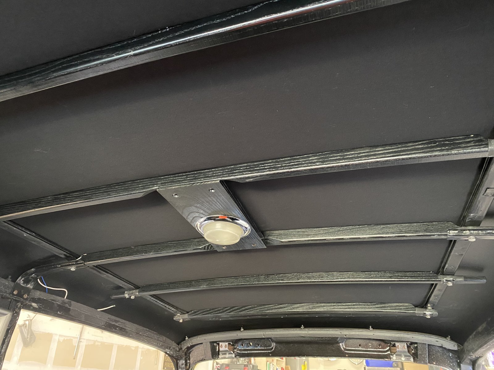

    Here’s what the exposed inside looks like now without light shining through, it looks pretty awesome! It turned out better than I thought it would!
    I’m going to work on the chrome trim that goes around the edge today, tie it down and finish it up hopefully!!
    7A7136EB-3E7D-4967-B81B-4C4556DD1AE6.jpeg BE97DCF2-97FE-4B82-A6F6-42CD4C91C431.jpeg

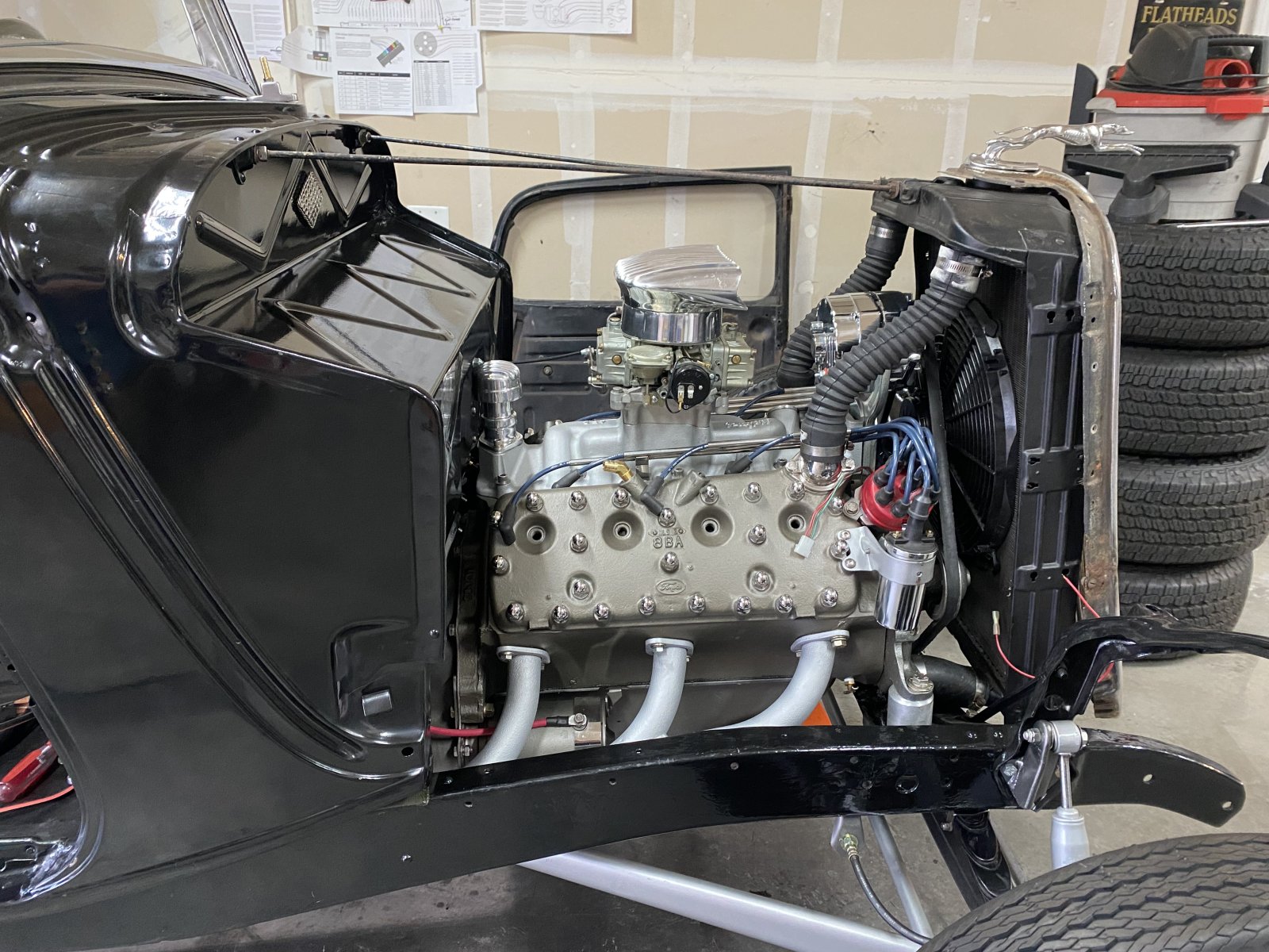

  8. 33Doll
    Posts: 1,591
    33Doll

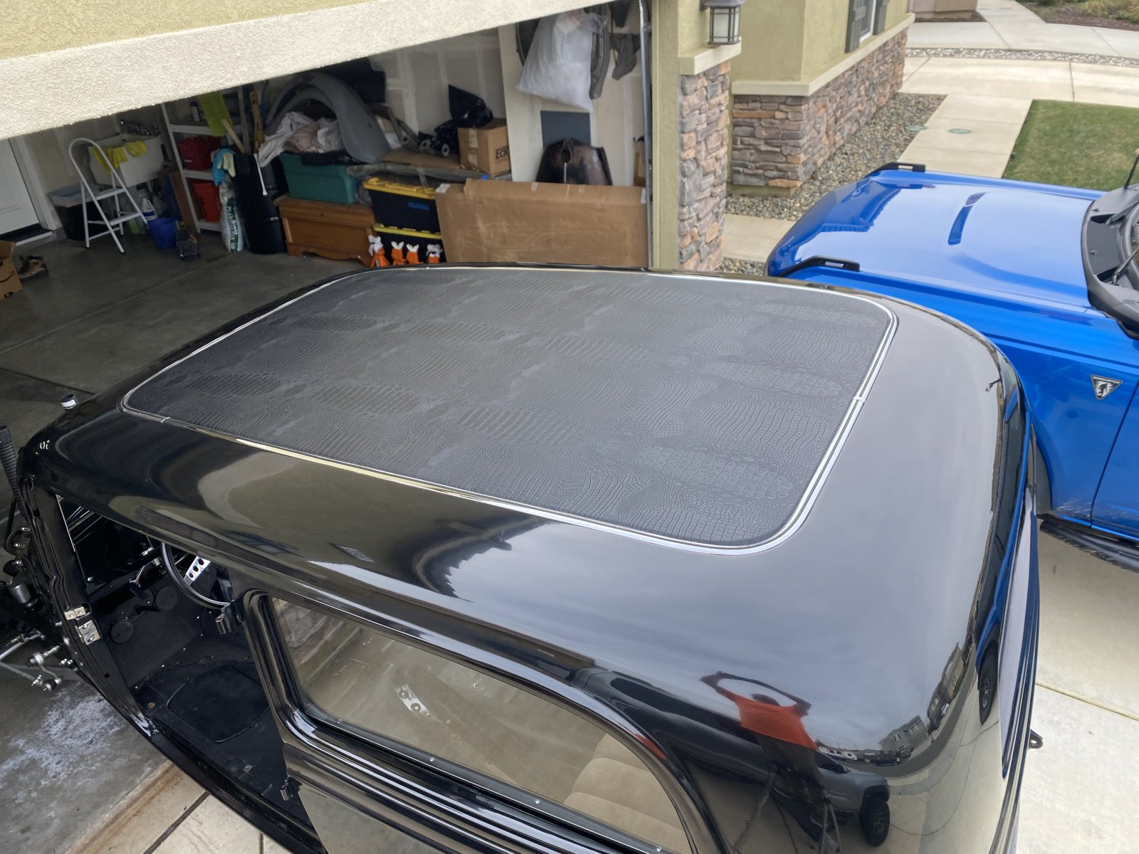

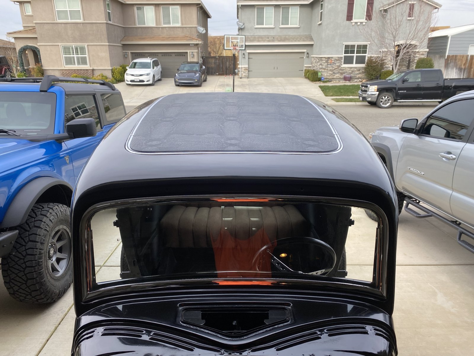

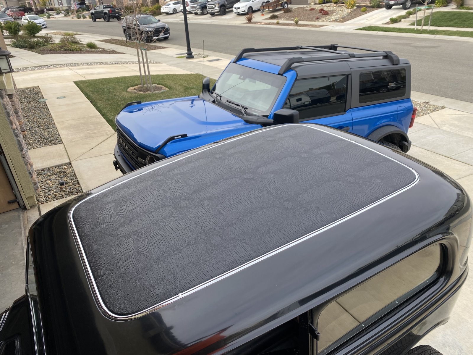

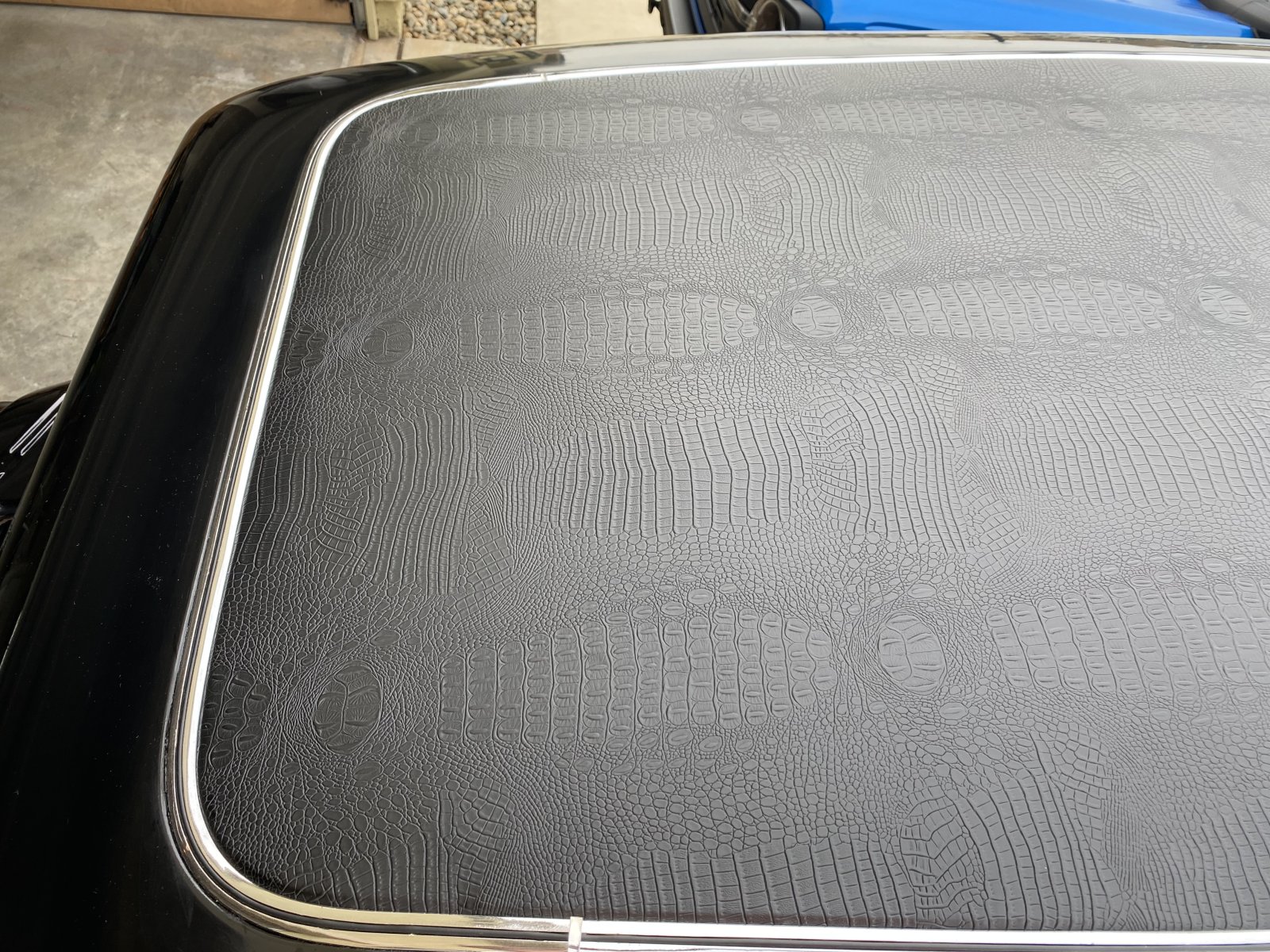

    TOP IS DONE!!!
    another mile stone!!
    I think the motor circuit is gonna be next, so I have to weld up my exhaust, start hooking up the engine, plumbing and wiring
    and run it before I put the rest of it together!
    Inspiration too!!
    Yuy-Yeah!!!

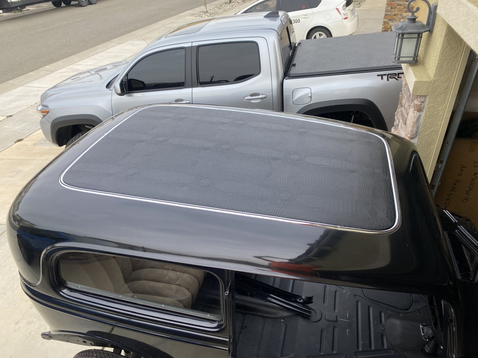

    CC851F4A-0541-4168-8476-3486C8C920CC.jpeg 1215E7A3-AA00-4941-B524-C0A3E5760337.jpeg 97DCD9DF-FCA0-44E5-A317-DC5FA9B6E1A4.jpeg F7E4718A-7146-4DA9-943D-8E66427F2522.jpeg 1A4BB479-55BD-49A3-A3DC-9617077239B9.jpeg 3D74013E-9E8D-48D2-BD15-9C54041A141E.jpeg 0E775AED-AD8B-4296-ACD8-7197DF4DF8DF.jpeg 10C46404-0696-49D9-AD1C-DEC72E2D6A6C.jpeg 1A8A2FDD-90EC-41A4-9F2A-A54A8BBD3C8E.jpeg 89E0B4B3-7017-4AC9-8FBA-FADE1CE71418.jpeg 1BF82B8F-8F7F-4A2D-A0F5-8F31808194FE.jpeg 26C06B3B-A0A0-4951-B661-2BDC305419BB.jpeg F3D49916-CF97-4FF7-935C-3F7250DB007E.jpeg ABC0BEB0-8F10-4240-BC95-602973FFC91A.jpeg B4504EAF-9716-43AE-8443-2CAC5CFEF9DF.jpeg A94825BA-113B-4189-952E-D1F56FE03950.jpeg 08CDA32F-877E-4556-A036-AD9F8A40B3C2.jpeg 46299189-902D-4F6D-B099-F8962D8A5B41.jpeg A38F3502-F8A8-4301-ACC3-E46C5647DEE1.jpeg 7EE8C230-739D-4396-9F18-0049DC096659.jpeg 811B3B76-A94C-475A-896D-1203AD0BC11A.jpeg
    RICH B, guthriesmith, CC-Mo and 10 others like this.
  9. 33Doll
    Posts: 1,591
    33Doll

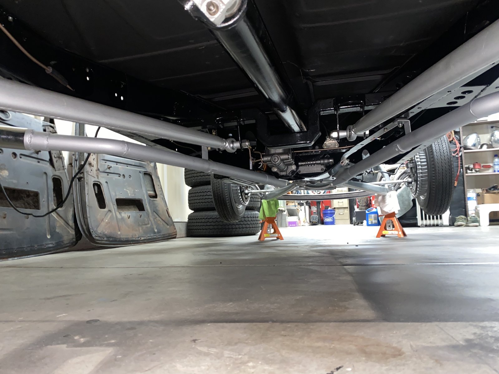

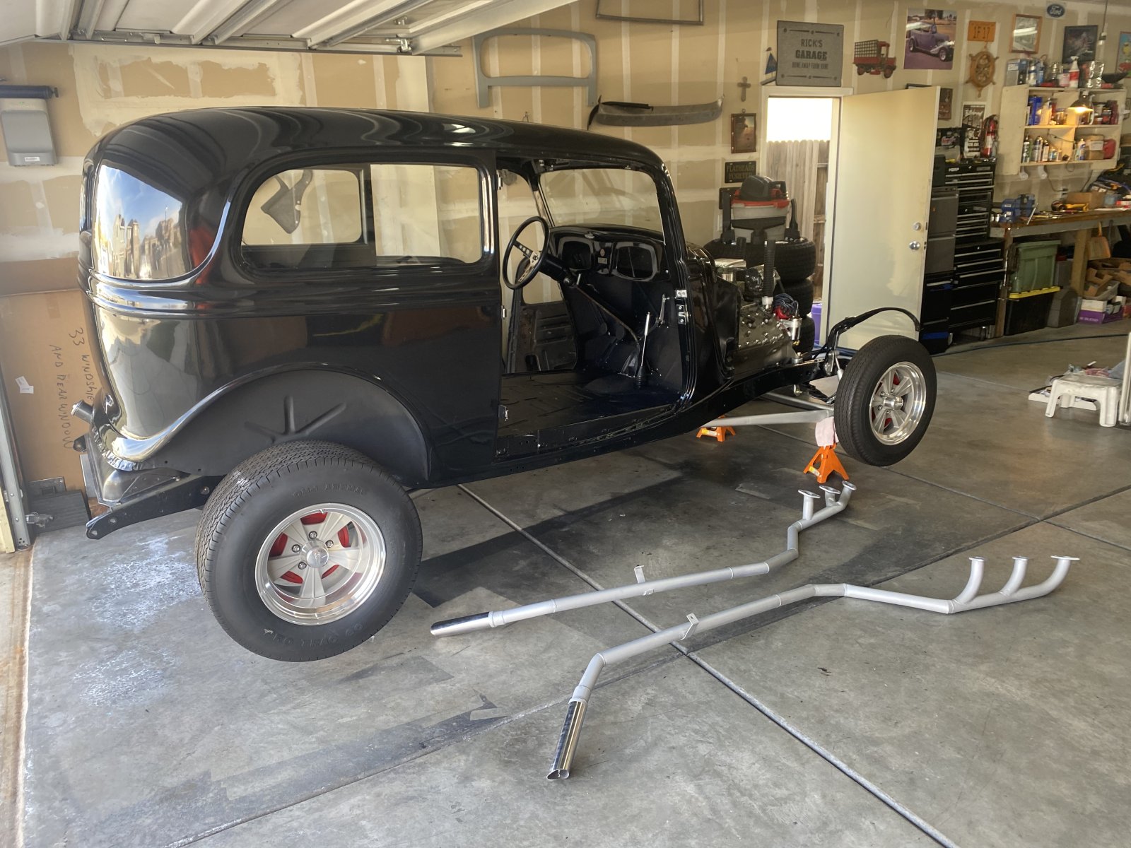

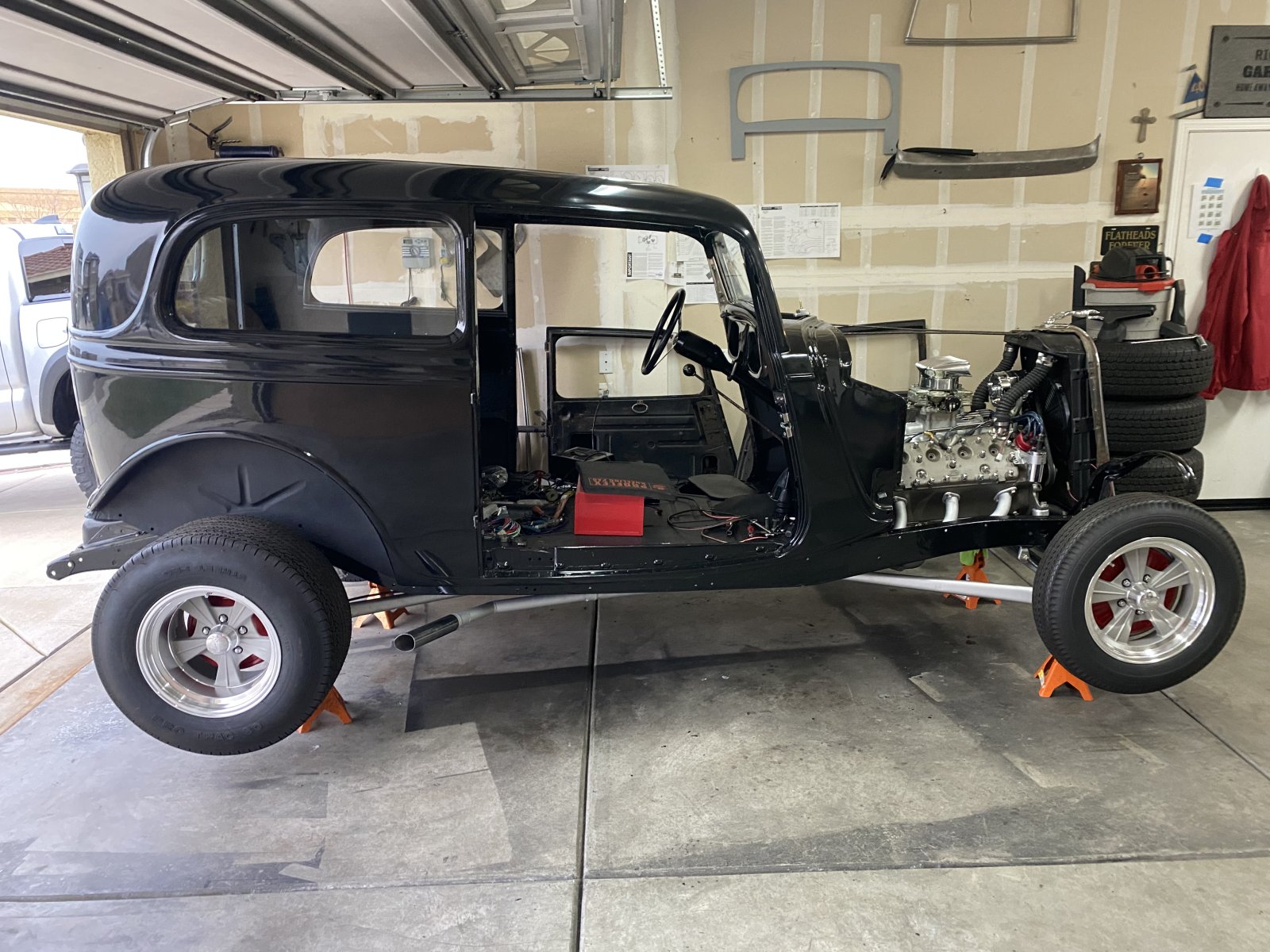

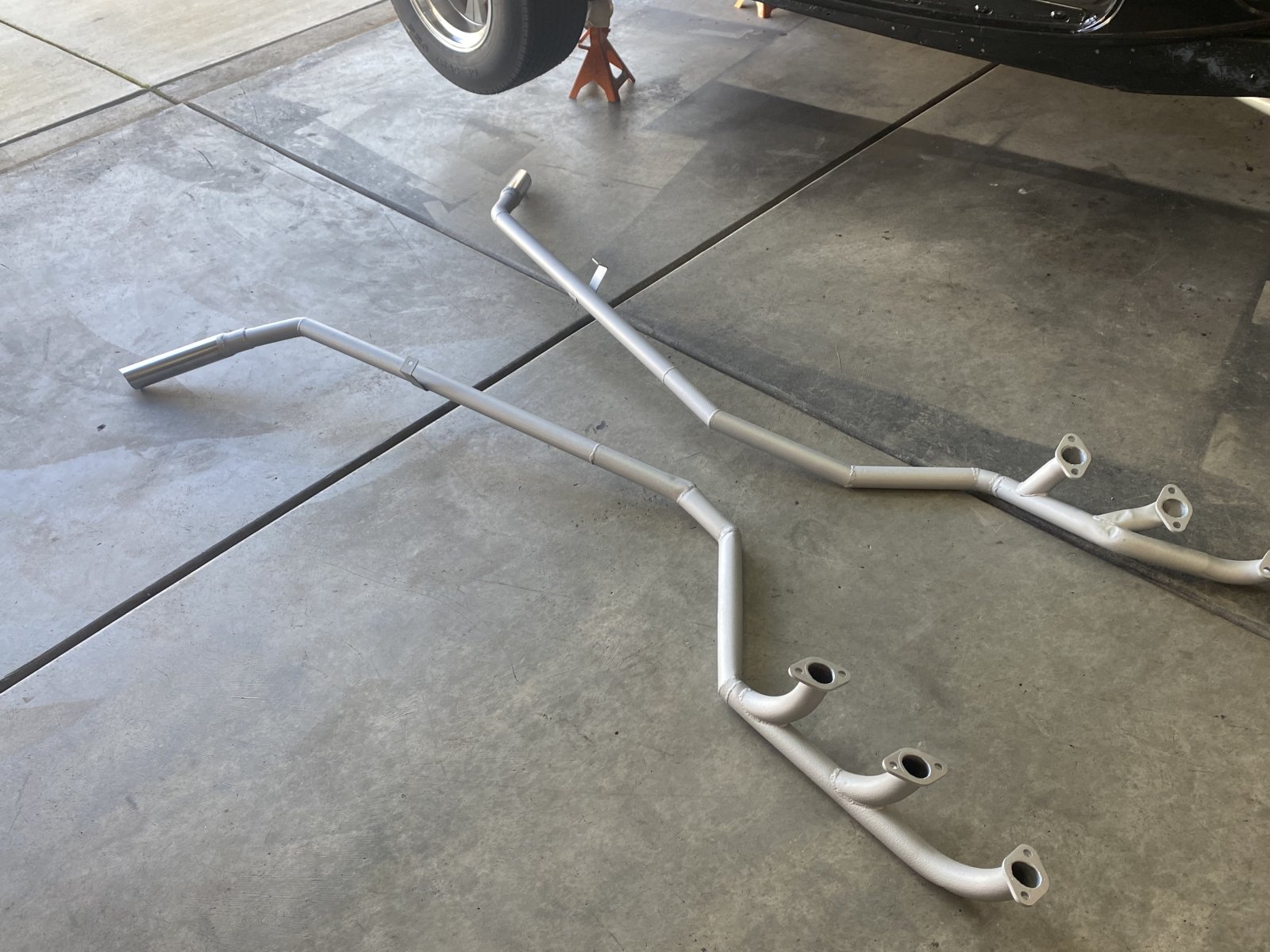

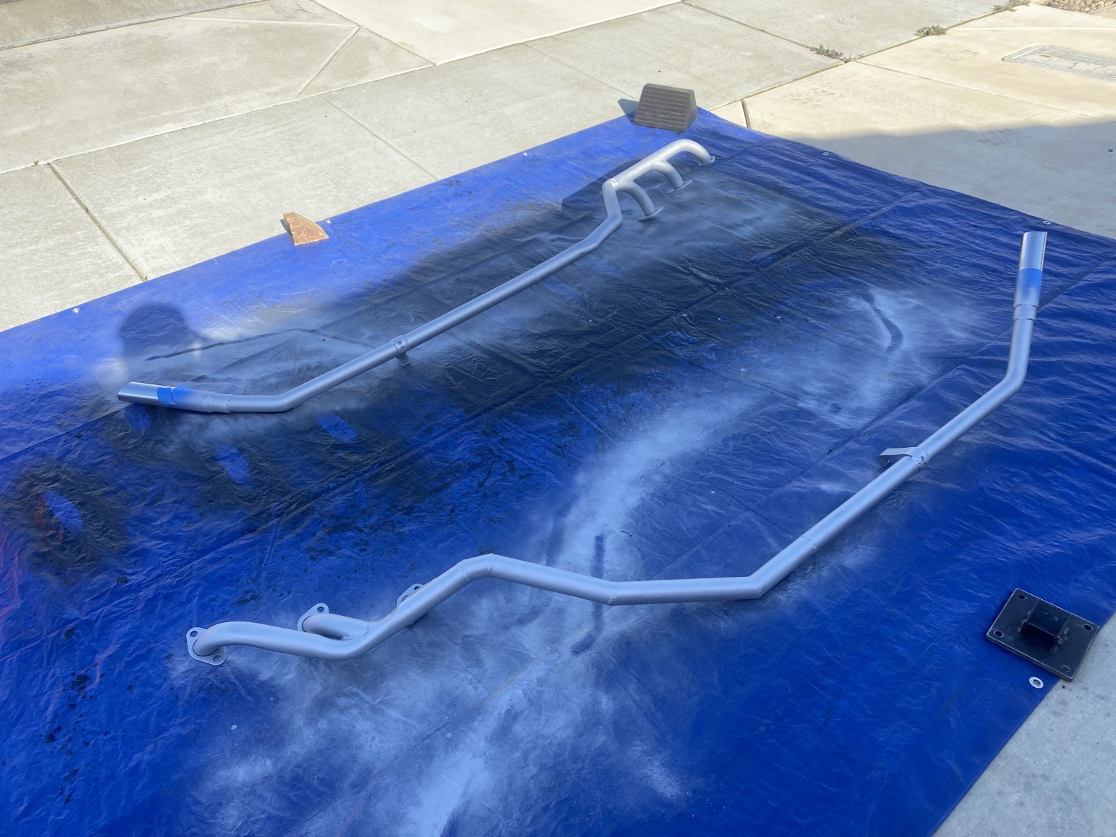

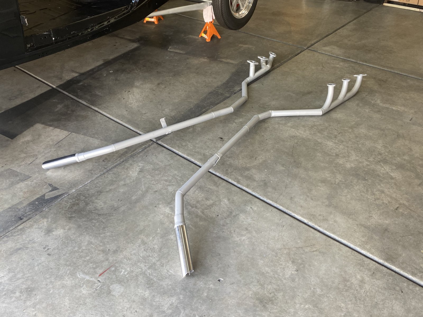

    Exhaust is done!
    It’s starting to look like a life-size Revell model!!!
    Working on the 33 and listening to the best surf music ever!!!

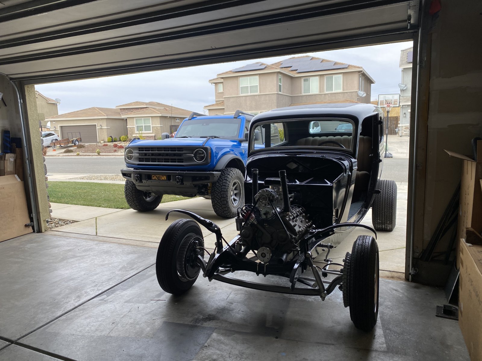

    2CDB16BB-5E47-4D0A-99D6-08887BBB8877.jpeg 7959FAB3-3F94-495C-811C-02B51987745E.jpeg 42141A18-E4D3-43CD-9236-BA9A067649DC.jpeg D7AE2E4A-1D9F-402D-A08D-312B716B0FC8.jpeg BB8BE73B-C711-46E5-BFDC-29054AFFAF63.jpeg 88F7BD3E-FBF9-48E1-BEB9-447D40E644CA.jpeg

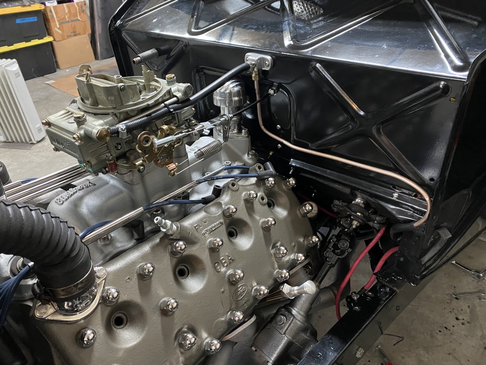

  10. 33Doll
    Posts: 1,591
    33Doll

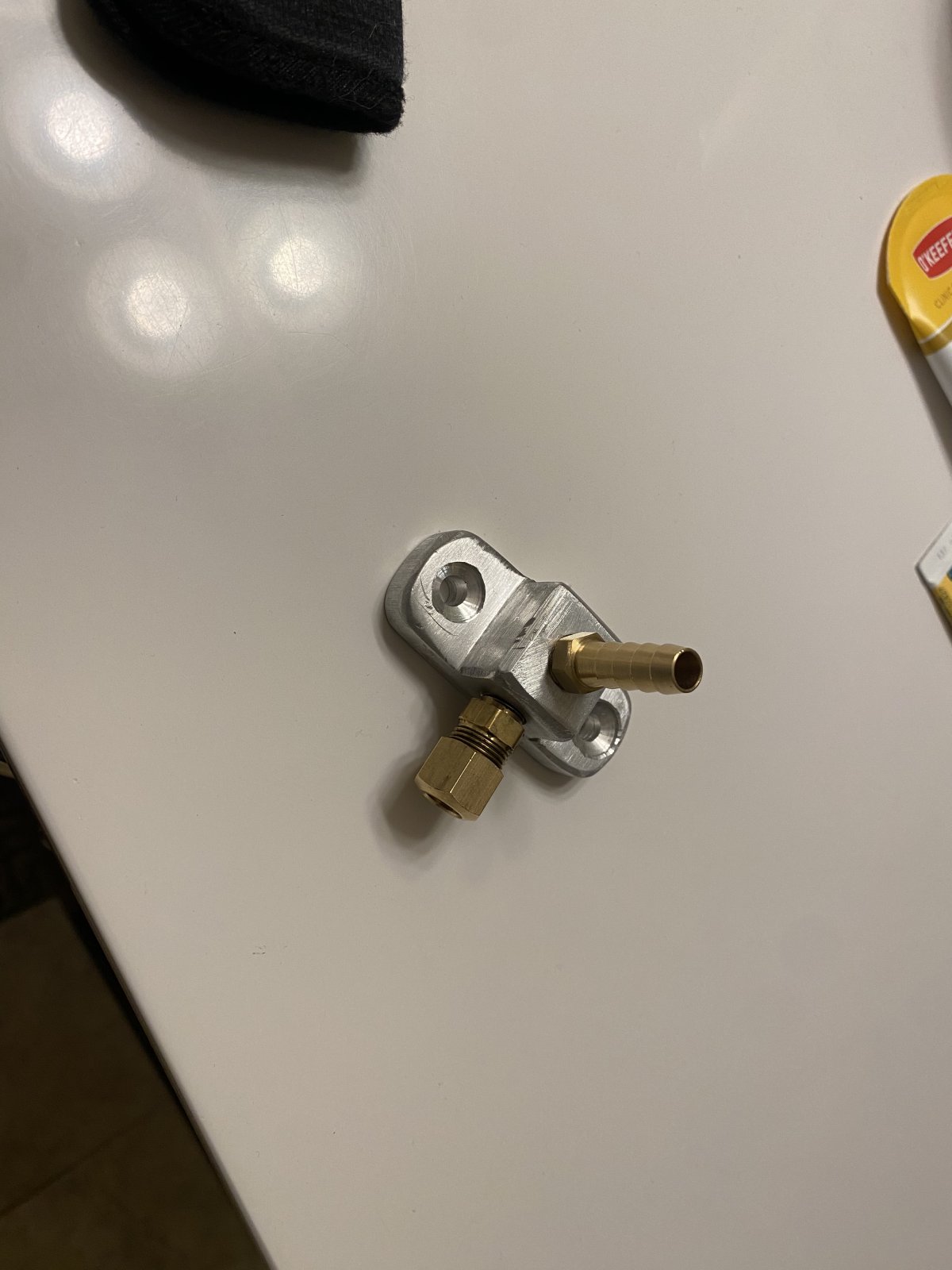

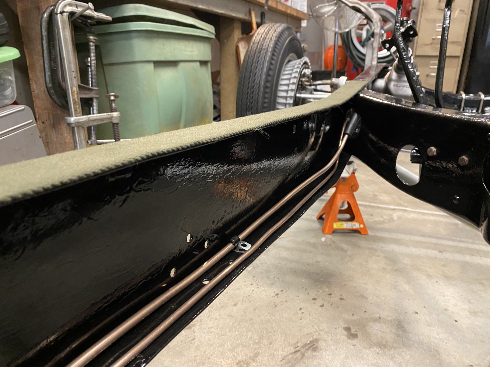

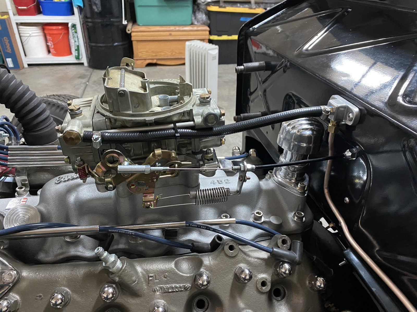

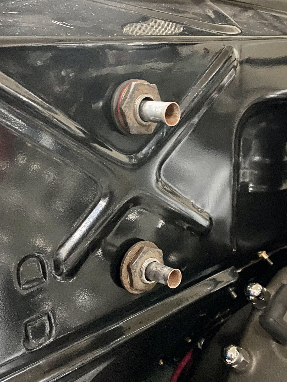

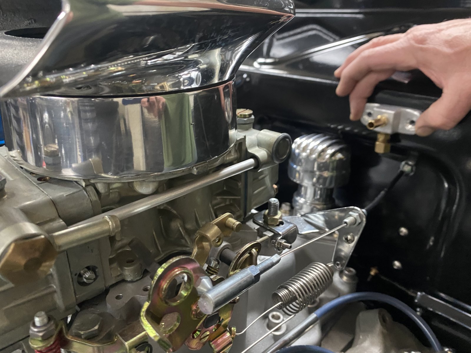

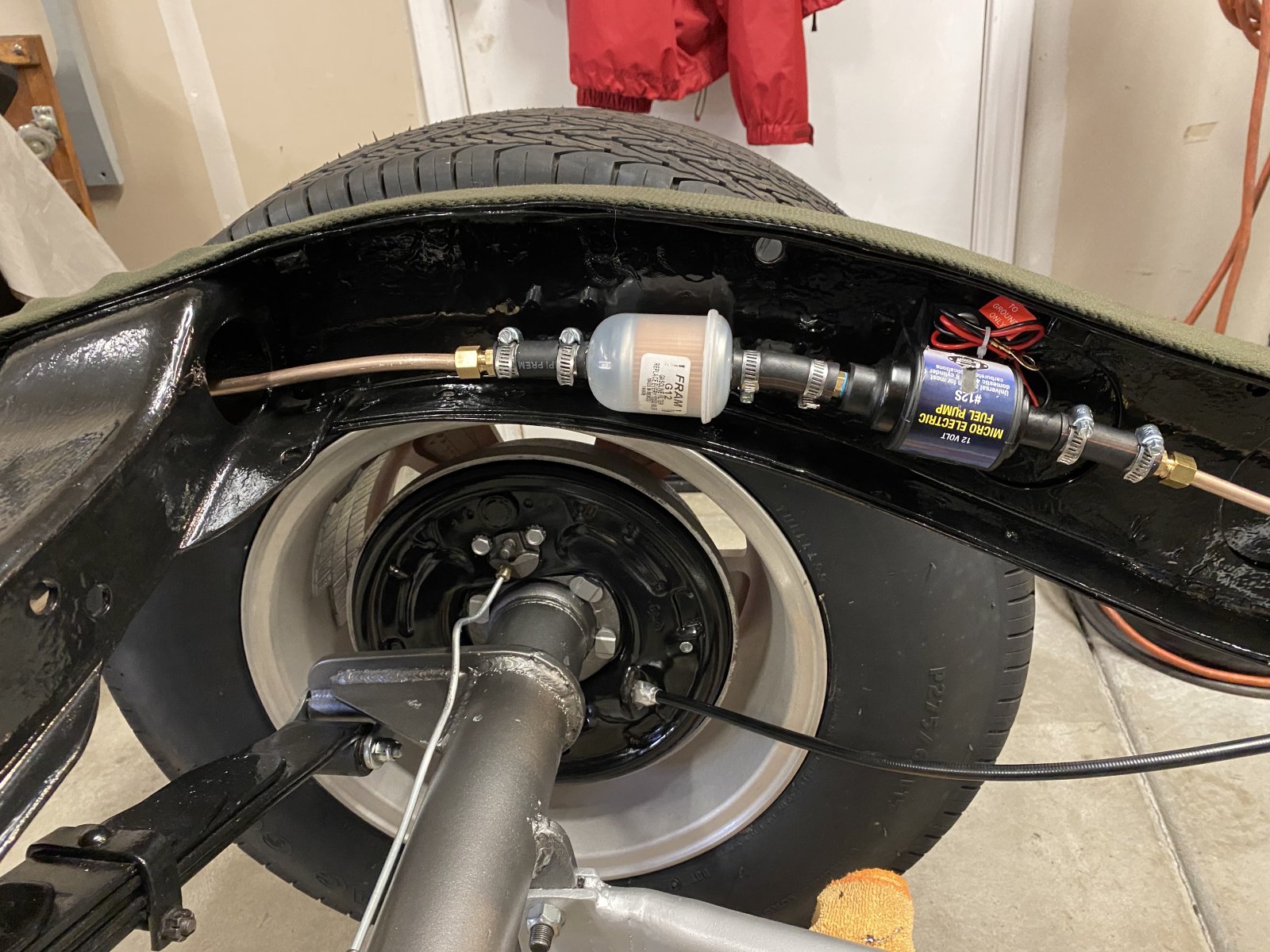

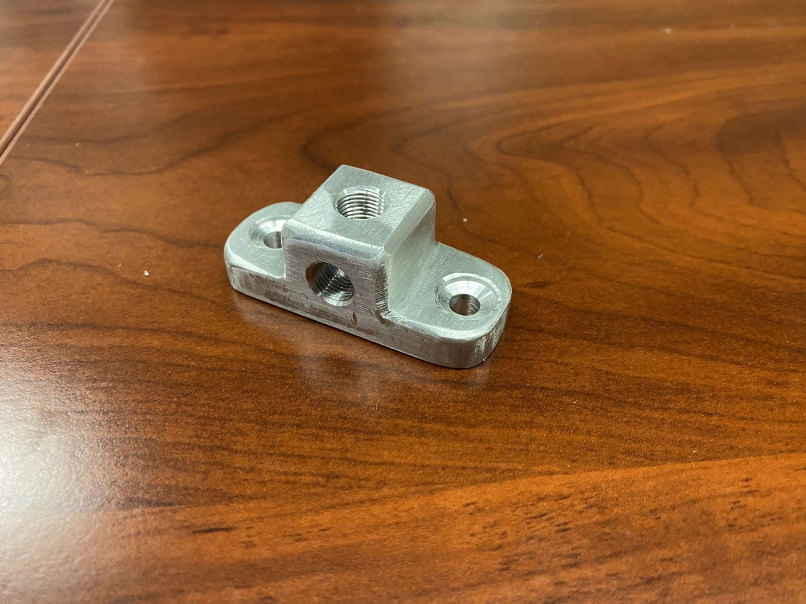

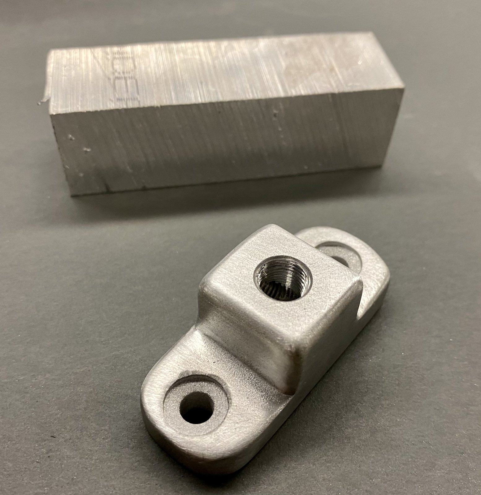

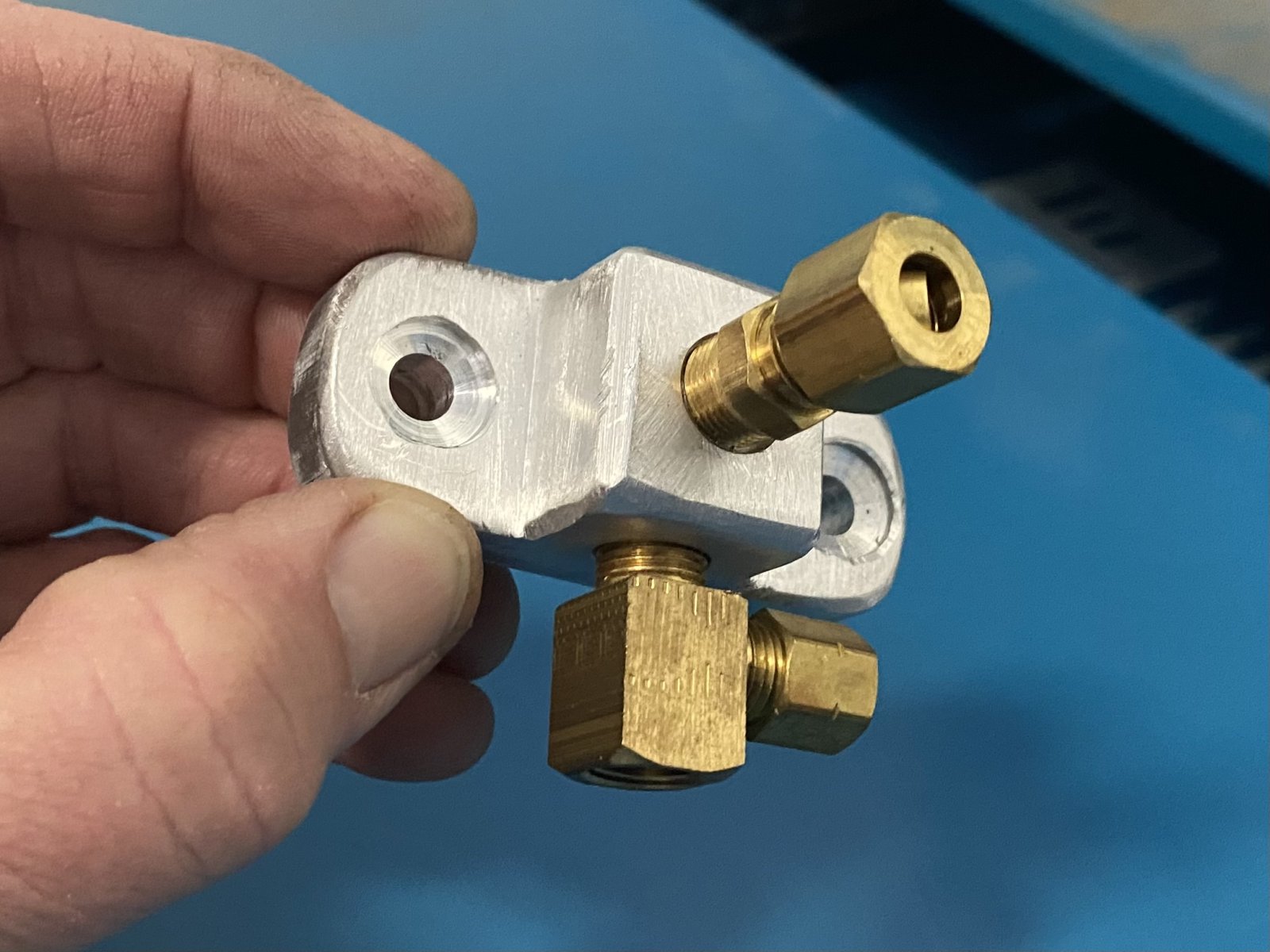

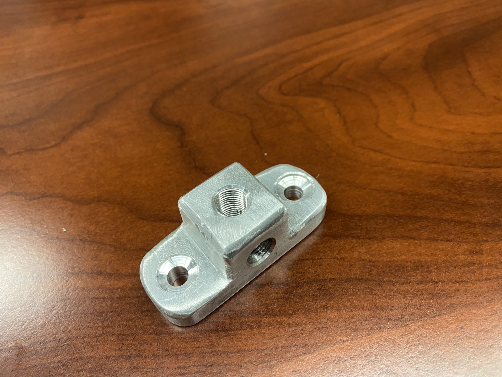

    B6A58B1D-6367-4C4C-A38A-1CD9709938DD.jpeg 78A1F42B-9667-4DAA-98F0-55A7D639109E.jpeg 3983F810-85DA-4A9D-9DC3-7CBB5F515F74.jpeg 6F6BE0AC-EB5F-4A1F-9EB1-A5AD68102CC2.jpeg 1E73FC05-F431-4306-BFD4-072795F69DB9.jpeg 2B374E9D-4AC6-424B-9A46-18CDEDF4B633.jpeg 046B680B-52FE-49BD-AAB5-86EC46978E15.jpeg 2BBD1177-E62F-4EB9-ADF9-E117D8C73CA8.jpeg 645510EF-06B8-4306-8C79-3877C35FE80A.jpeg So… I didn’t like any of the aftermarket fuel blocks that mount to your firewall for hot rods. They all require two or three carburetors, etc. and in my opinion look pretty ugly.

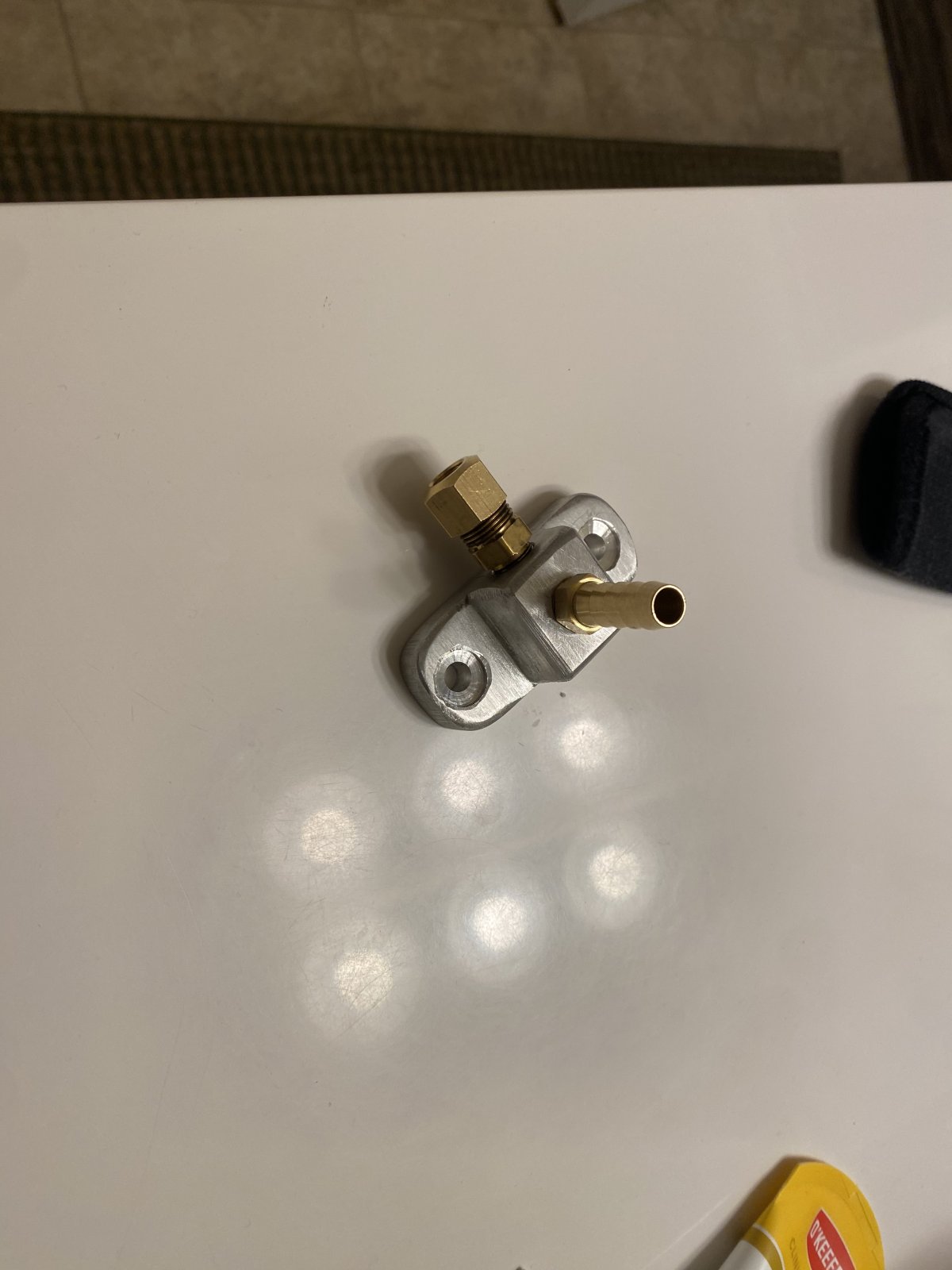

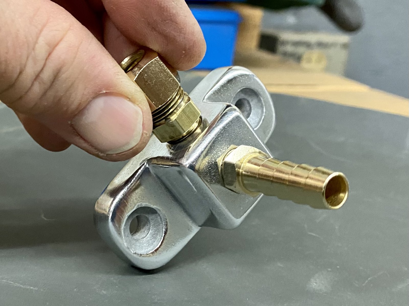

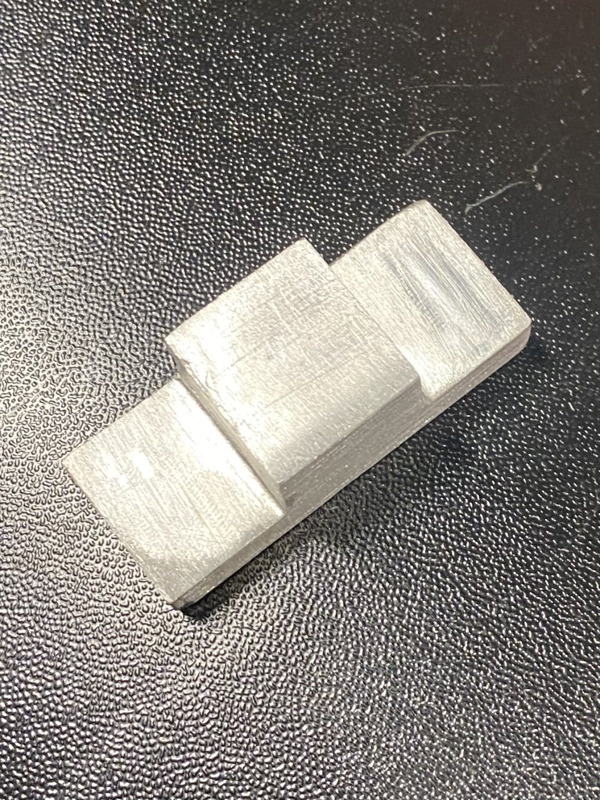

    So… I made one!
    Have an exactly figured the fitting placement yet, either barbed or hard lined, or a combo. Those fittings are just in there for reference.
    I hardlined most of the fuel line all the way back to the tank, except for in between the fuel filter and fuel pump.
  11. 33 cdan man
    Joined: Sep 15, 2016
    Posts: 195
    33 cdan man
    Love the pic your pops sent for your birthday. That's exactly as I remember driving around the streets of Vallejo with Dolly behind the wheel. You are doing a great job with her.
    33Doll likes this.
  12. dumprat
    Posts: 3,572
    dumprat
    from b.c.
    If you sand blast that block with really co**** sand they can look like cast aluminum.
    -Brent- and 33Doll like this.
  13. 33Doll
    Posts: 1,591
    33Doll

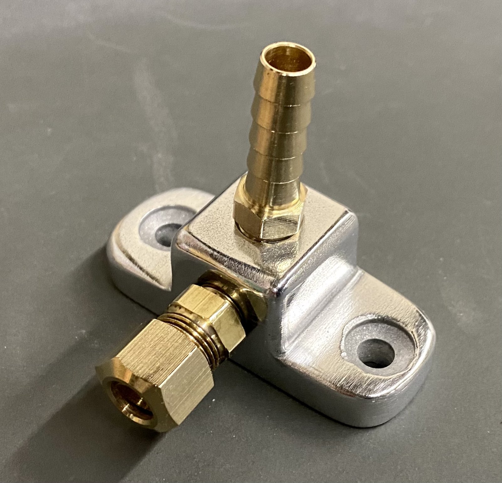

    678550ED-1DC5-436A-BA23-7328655537D7.jpeg E5138178-A339-4318-B30F-3CCAC554915E.jpeg 689681A9-BA0E-46C3-8972-9394EE8605F2.jpeg 2B70A305-CA1C-47E5-ADD6-5DB79D485F4C.jpeg

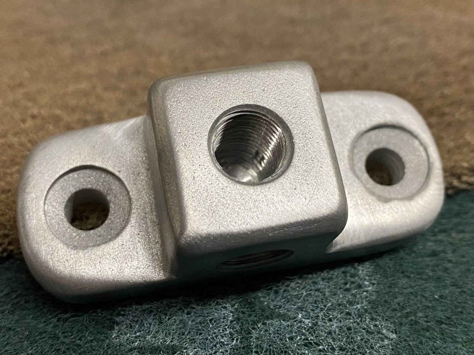

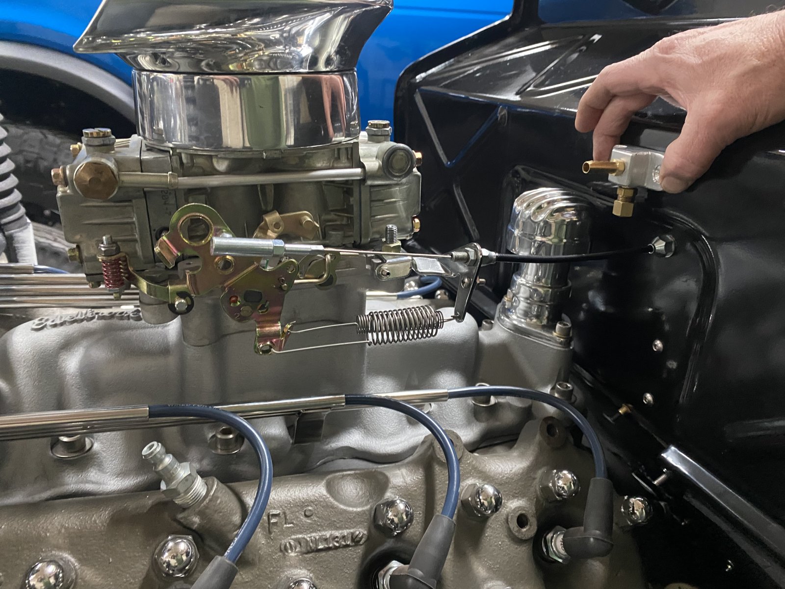

    That’s funny you said that cause I was thinking about it we got some black anthracite we use for heavy stuff at work. But I think I might polish it to match the air cleaner and the breather.
    Here I got a picture now if what I’m doing I think I’m just gonna run a hose from the barb fitting over to the carb. It’s only like 10 or 12 inches. I don’t think it’ll be worth it to hardline it from there and then a little short, 3 inch piece or whatever.?

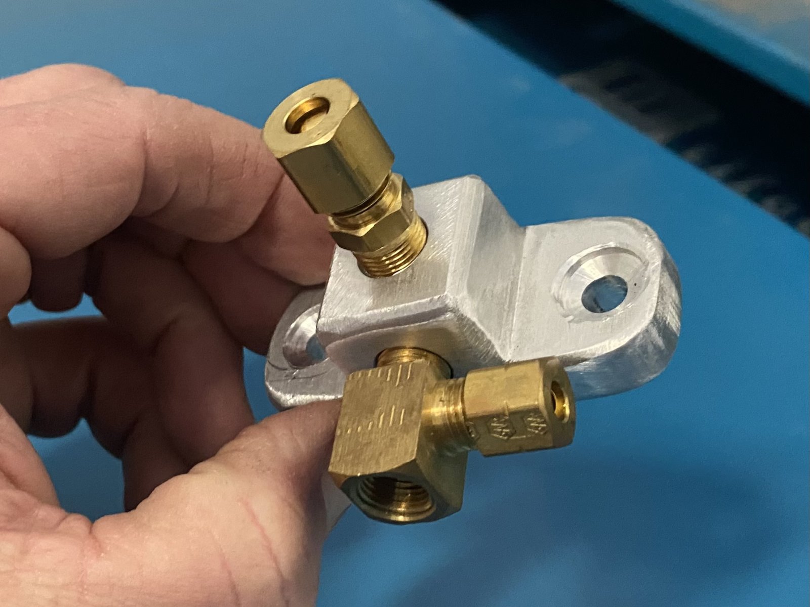

  14. 57tailgater
    Joined: Nov 22, 2008
    Posts: 912
    57tailgater
    from Georgia

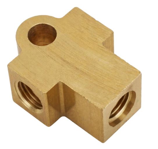

    When I saw your fitting, which is pretty cool, I immediately thought of this fitting. fitting.JPG
  15. 33Doll
    Posts: 1,591
    33Doll
    Dang! That would save me a lot of work. I don’t know I think mines cool looking though?
  16. 33Doll
    Posts: 1,591
    33Doll
    05D07D4D-5AB0-4B4D-8FE5-BC1C05F16224.jpeg D8FC1C01-777F-461F-8F26-2E76748E3498.jpeg 8BAA677A-7022-4127-9418-E9662BB390B0.jpeg 06B10107-4FF6-4B5D-8052-385AB2E76B94.jpeg B2691F33-C9FC-4476-97AC-63C15C5A419A.jpeg So… Is it sacrilege to put billet aluminum on a vintage traditional car?
    Not the way I do it!!!
    So I took dump rats, idea of blasting it for that cast look. I used the black anthracite hard-core stuff. I just put plugs in the hole so it wouldn’t screw it up, then I sanded it, 220-red
    3M- Green 3M—and polished it up with my favorite wonderful product “Flitz” (love that stuff!)
    So, I could have kept sanding it lighter and lighter, and made it perfectly smooth, but I wanted it to have that little bit of cast look. And shiny Thanks
    Dump Rat! for the idea.!
  17. dumprat
    Posts: 3,572
    dumprat
    from b.c.
    Your welcome!
    I used black braided nylon hose from my hard line to carb. It is a little safer than 12" of rubber hose. Just a thought.
    Jim Bouchard and 33Doll like this.

    My dad thinks I shouldn’t of used compression fittings on the hard lines, but I’ve never had any leaks and I do it all day long at work for way higher pressure stuff, airlines, 90 pound water supply. I would never use it on hydraulic or brake stuff but, fuel,
    water air…when there’s what? 4-8 pounds of pressure.? Maybe 10 if it was dead headed?
    I bought some of that heavy duty marine hose for now, but I might do a braided line later from the firewall to the carb.

    Nothing wrong with compression fittings, the trouble usually comes from copper lines.

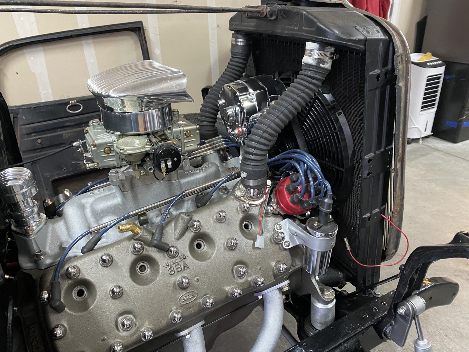

  20. 33Doll
    Posts: 1,591
    33Doll
  21. dumprat
    Posts: 3,572
    dumprat
    from b.c.
    Starter sounds like it could use some lube or something! 40lbs of oil pressure at cranking is huge I would think.
    Get er fired up!
    33Doll likes this.

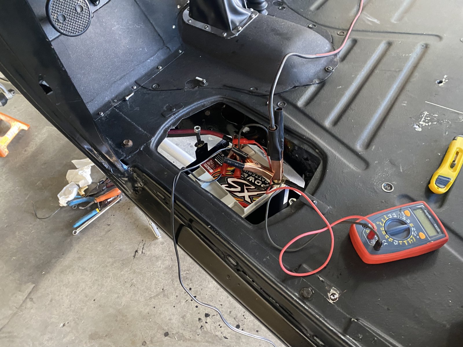

  22. 33Doll
    Posts: 1,591
    33Doll
    Another week or so!
    Wire up ignition, finish fuel line
    And PCV line. Hook up Fan and radiator, fuel pump, bolt on exhaust
    BAM! And now I finally figured out how to upload a video!
    Jim Bouchard likes this.
  23. 33Doll
    Posts: 1,591
    33Doll

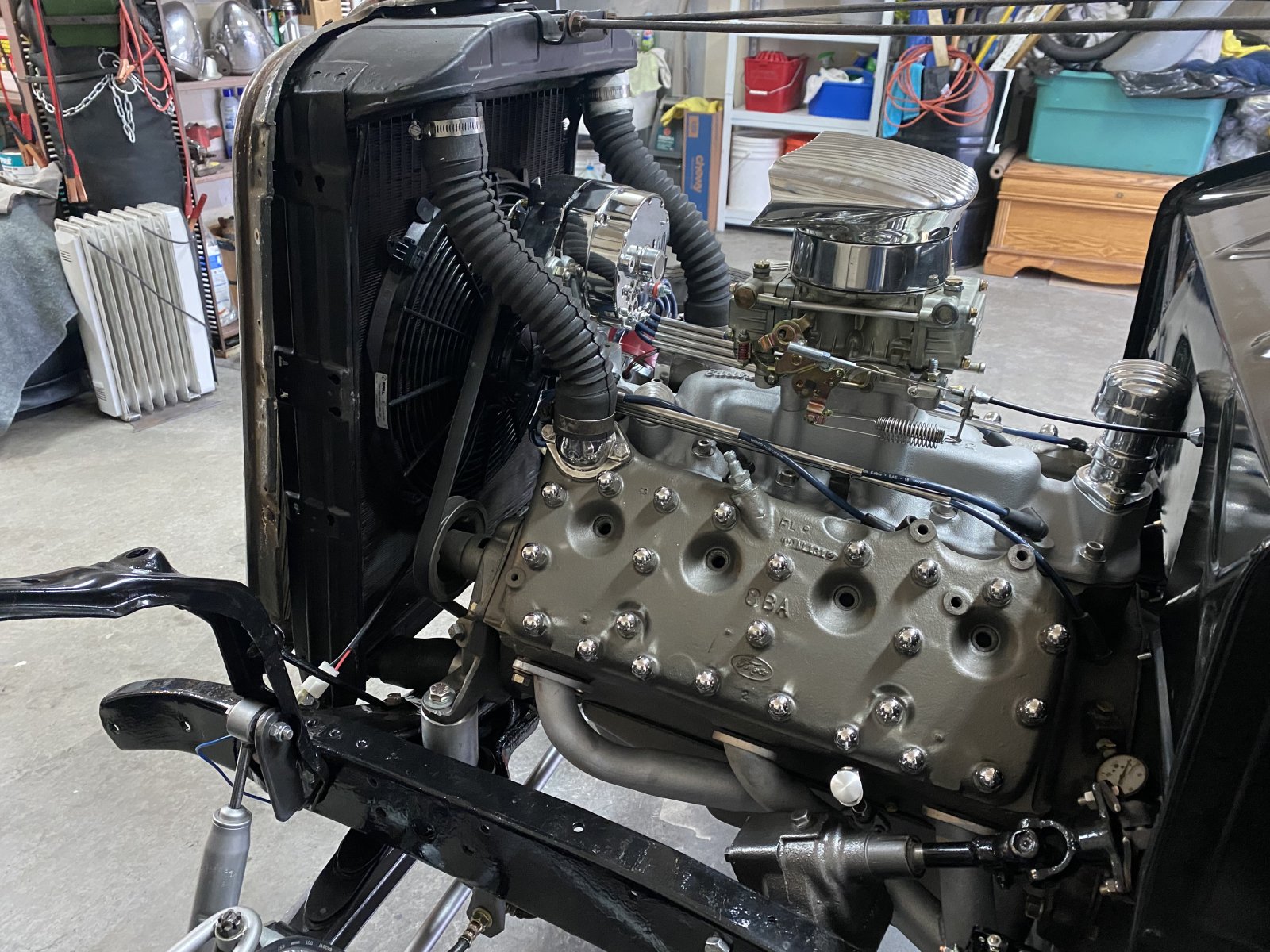

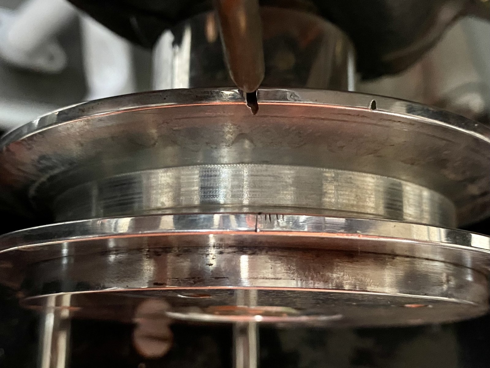

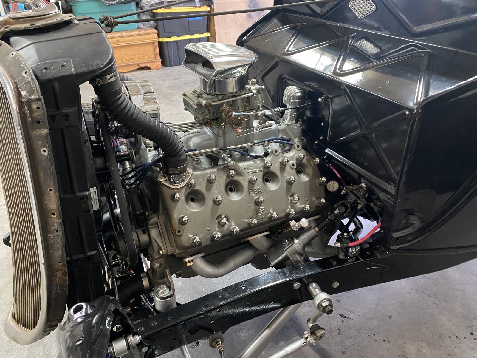

    So I found the miniature tiny marks my Pops put on there. what is a flathead timing set at? Imagine those lines look like 2-4-6-8?
  24. 33Doll
    Posts: 1,591
    33Doll

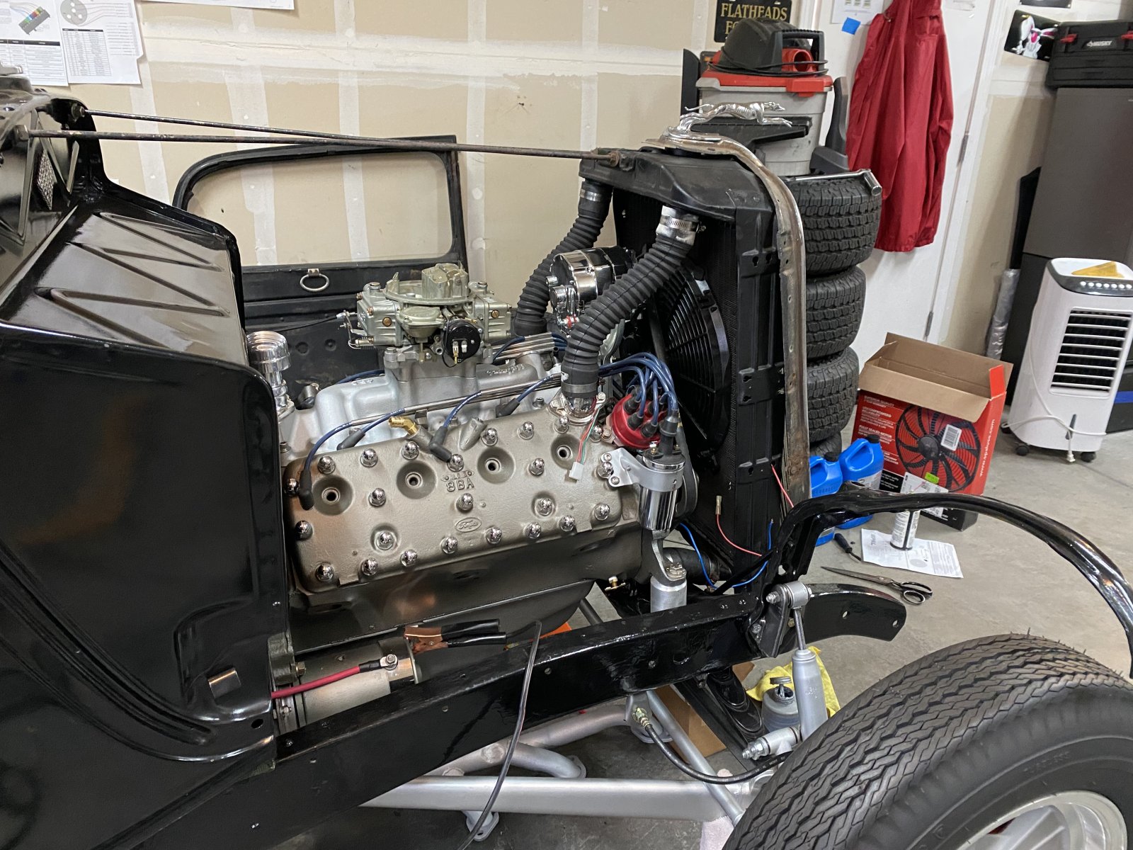

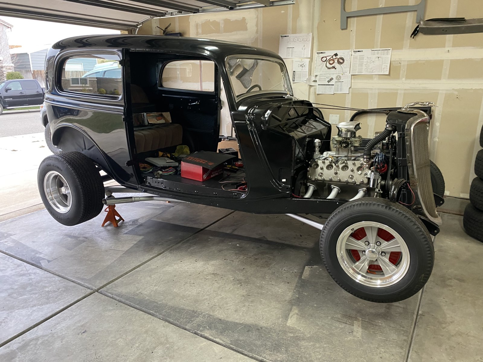

    7B3AB306-5DDC-4122-9274-86C830192E53.jpeg B276ACE5-3920-4364-9A91-C5A9584A91E5.jpeg 2EAB5B3E-C08B-49DF-AD24-9EC253257FE8.jpeg D7454A73-E8F1-4B00-B298-7E1FE981B1D0.jpeg 80D3AE1E-26A7-41EA-B551-0A389EA7D9E7.jpeg 542D377A-2774-46A9-9869-B14B6F681DCA.jpeg 65D36999-74FD-48C1-8B82-39DA47A36AD2.jpeg DF23E67B-1939-4D01-B640-0D5D99B3F8FF.jpeg 5C95B2BB-F40E-404E-8844-D3A1A8ADE9CD.jpeg 7ED040DE-0ED6-4639-AC3C-7F6EB4FCEE7A.jpeg 3AC0000F-06AE-457D-9ACA-77090643D20F.jpeg CF5C0653-B5E8-4F2D-881A-4609A9A80B03.jpeg F770B8E5-ECB9-417C-B562-F744B7F50FB4.jpeg 9CF01E07-6EB5-4C02-9FD8-172377D0C47A.jpeg 0187F104-CBF1-4280-A8FF-E6C0974EF159.jpeg

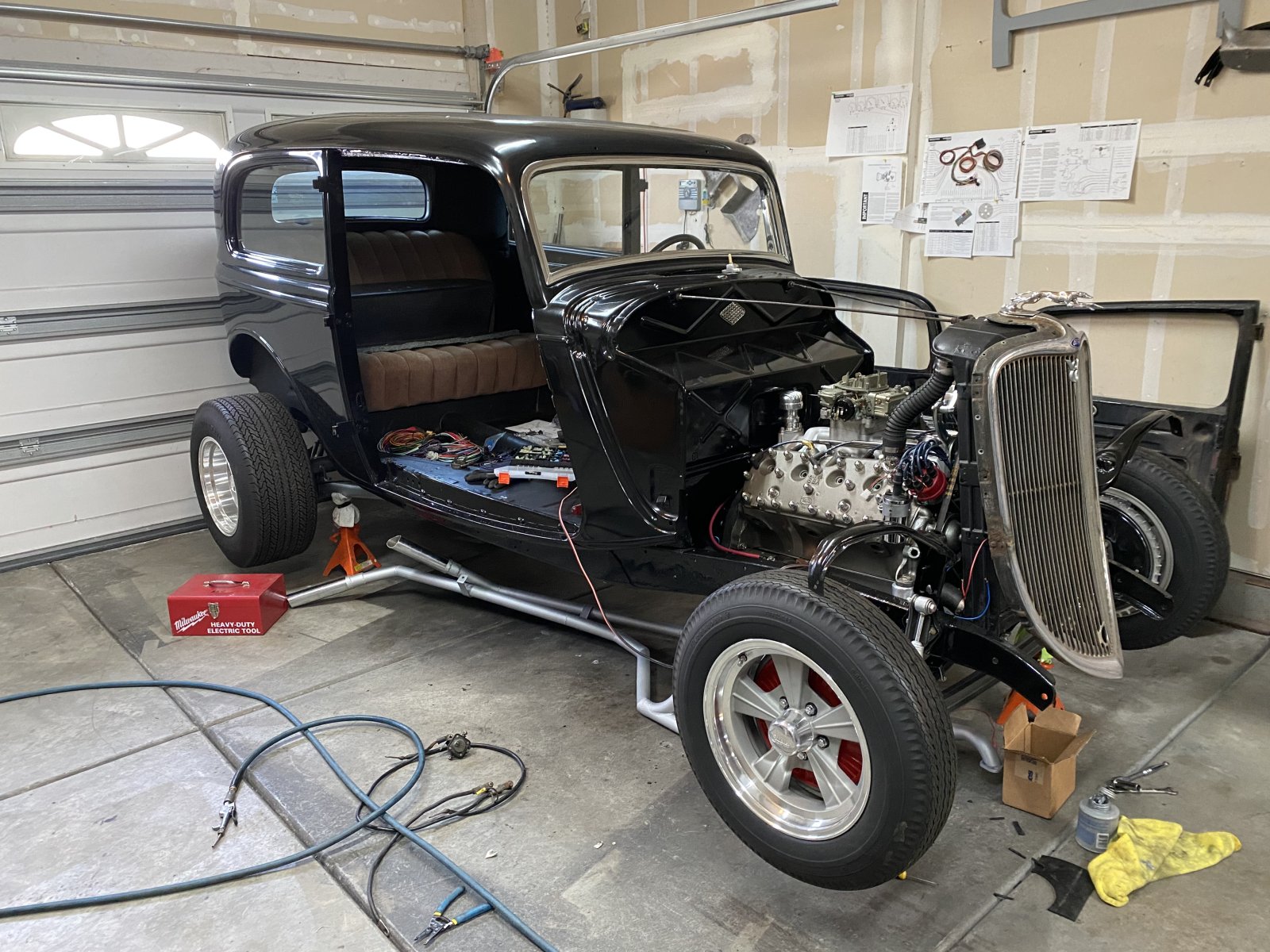

    I am flying on this car now!

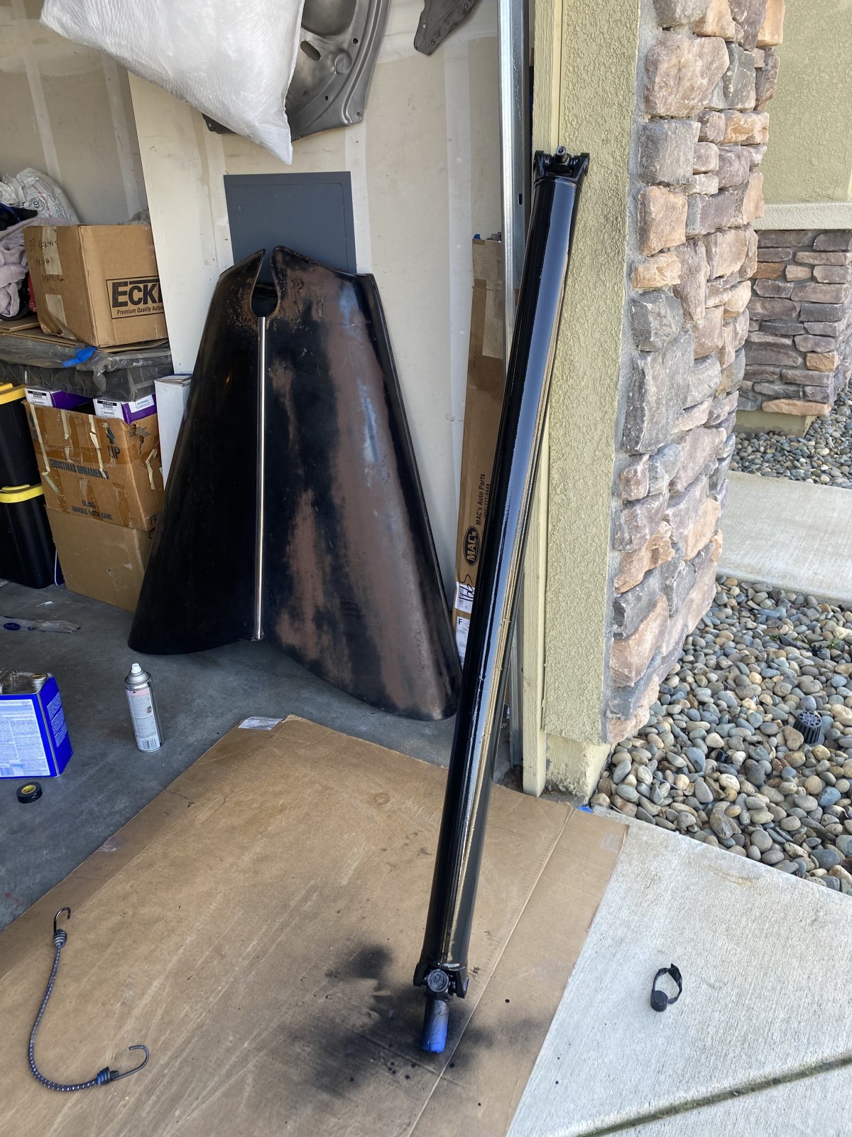

    I rebuilt, painted and installed the driveshaft! It clears everything and fits nice inside my drop down crossmember.
    Installed the fan, and radiator.
    Also bolted in the exhaust. Just need to finish tje fuel
    And PCV lines.
    Got my wiring staged, and all figured out.
    Also got the engine primed with oil.
    And the timing all figured out! Found the timing marks!
    I AM SO EXCITED TO GET THIS THING RUNNING!!!

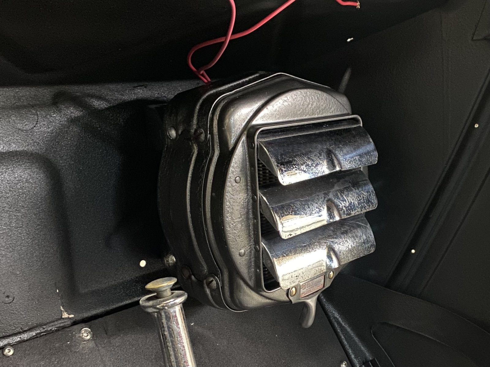

    25A6E9C7-FA71-4E0F-80AE-7A1C9136EA74.jpeg 432D52C6-5EFB-4299-9244-5BDAC5EA8A38.jpeg Next little small project!
    Need to get it hooked up before I put coolant in. Yeah yeah I know I could skip it for now, but I need to stay on track.
    It’s super easy though the core is perfect. I just need to clean it up and give it a quick coat of paint put it back together and install the 12 V motor.

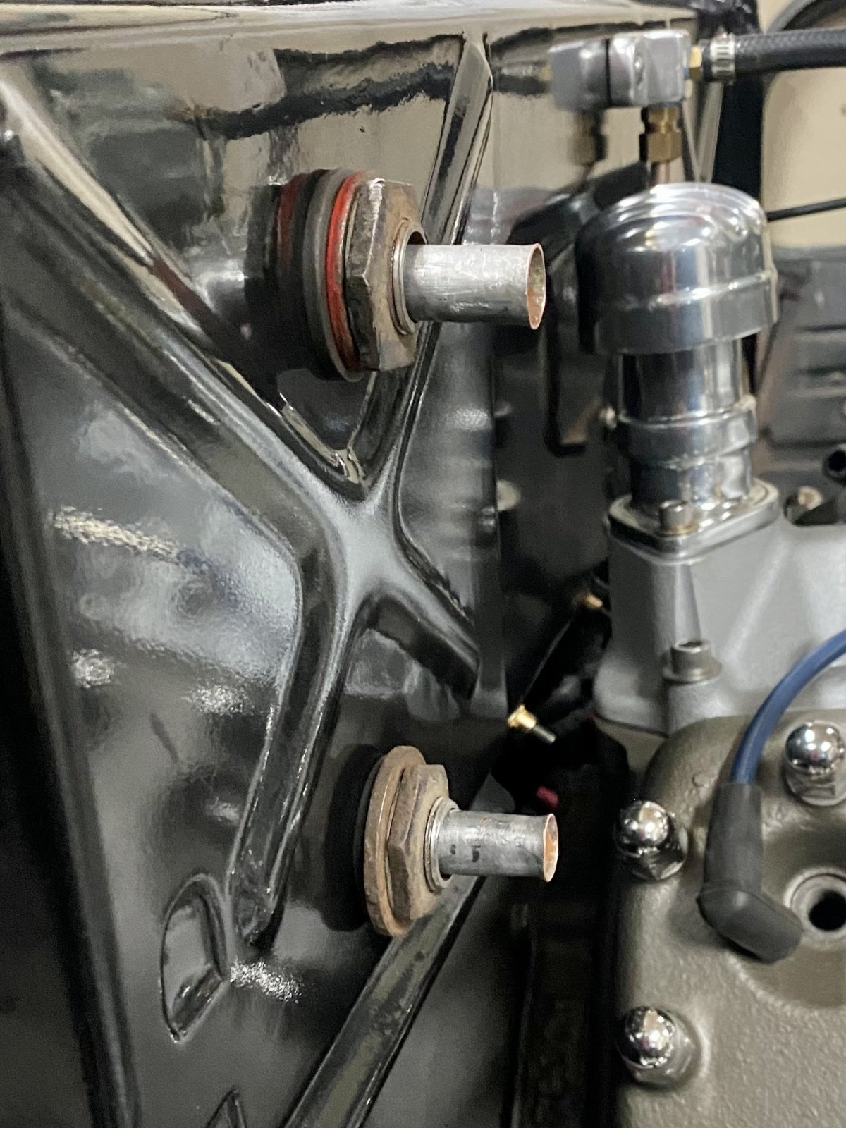

    BF75E846-EF91-48DA-A198-BFB20EE8745D.jpeg 0217A130-07CC-4FAE-B414-7AA9264FD18C.jpeg 06A2F42C-A45F-4627-A4E5-B27597E3DD82.jpeg F8A6BBD3-A4DD-4624-A9EF-90009B07D489.jpeg 1E687207-0E29-4DAC-84CA-5C8C8295B803.jpeg

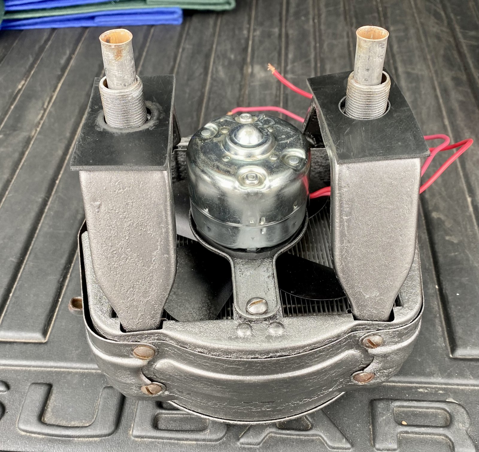

    More Done…got some tweaking do do on the heater mounts, fan…fuel line, and carb linkage mods… everything take 3 times longer than you think…. Every-time!

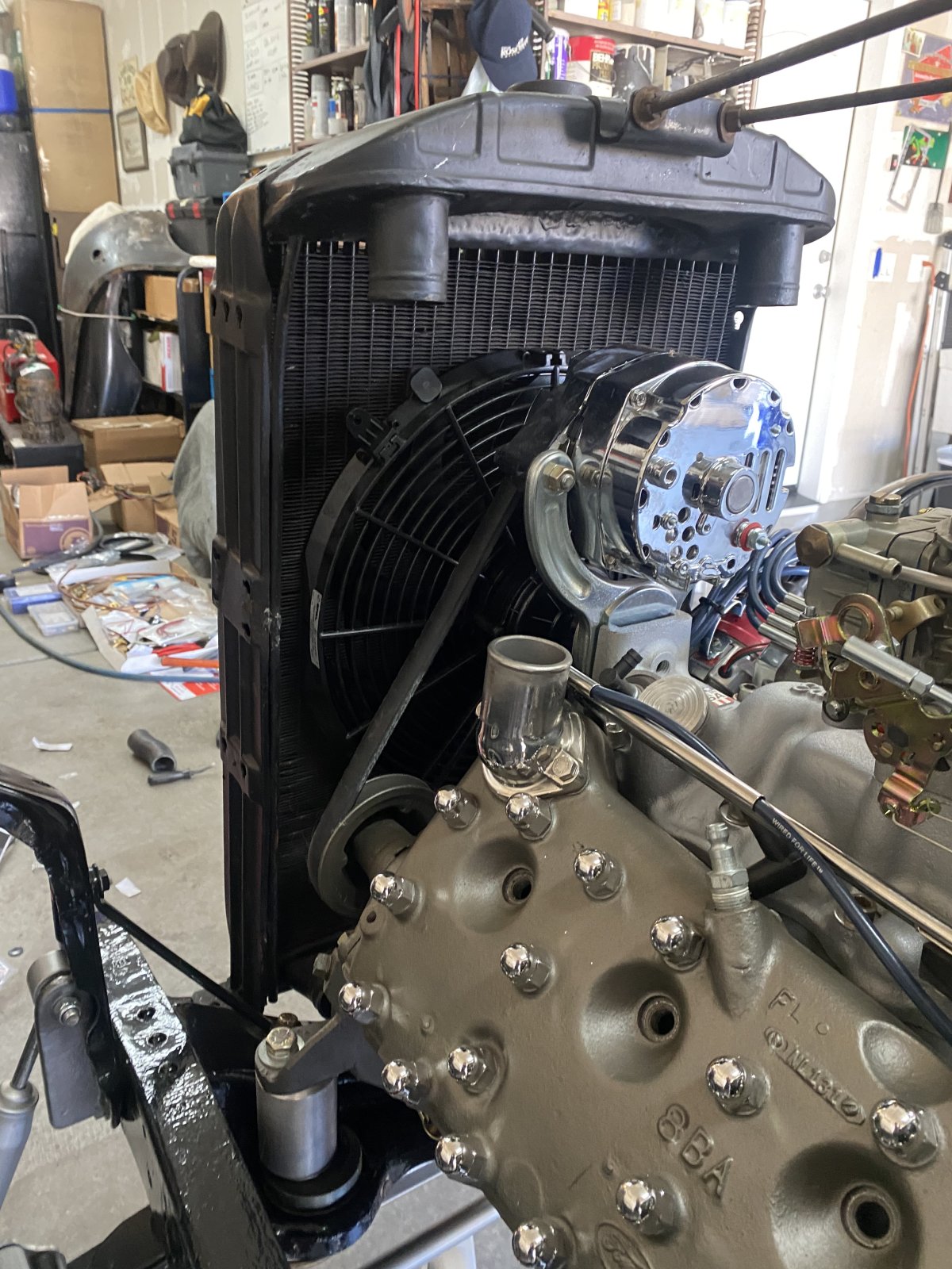

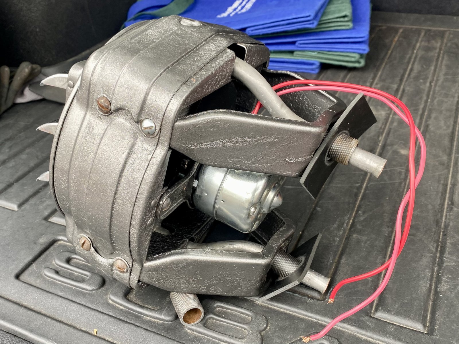

    179964C2-450F-4572-83A5-5A1B033C25C5.jpeg 85DFE8EB-B73C-4B7C-A37C-8CD7A3894CF2.jpeg FA92EEEA-C3C7-4458-86E3-A962EBA168B8.jpeg 48083CEB-A819-41CA-BFDD-5E98CCB9D965.jpeg A3522FE6-14B1-40F1-B352-E64C1BB12278.jpeg Soo…got tired, and cranky yesterday

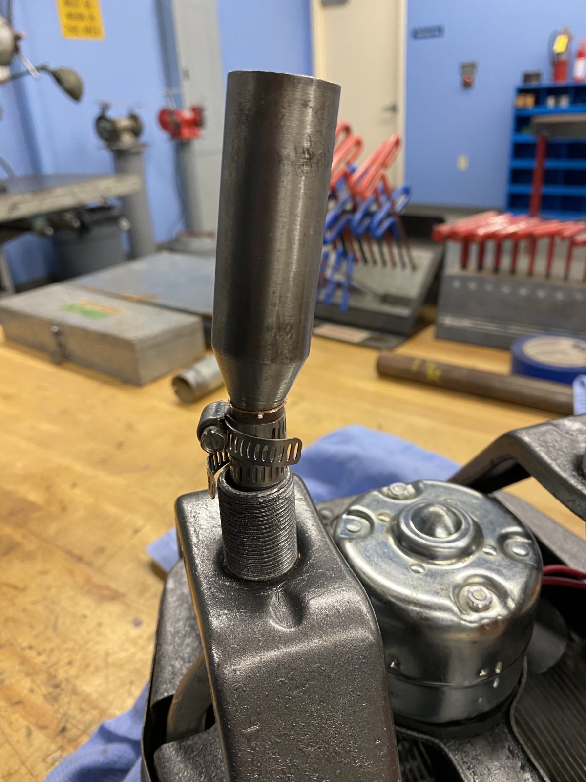

    Trying to get further along.. so instead of breaking things, I waited until today to rethink my heater situation..
    1. The 12v motor was CCWise..
    Luckily the other fan I have, is 6v CCW!
    (Hello Luck)
    but the hub was a little tight…so I drilled it out and then made it to loose!
    So then set screw stripped on me, and the fan was gonna hit the one-off only good core in the entire world!!! (Just kidding) but maybe.
    so….finally, I just stopped…so I would Not destroy everything in a fit of rage!

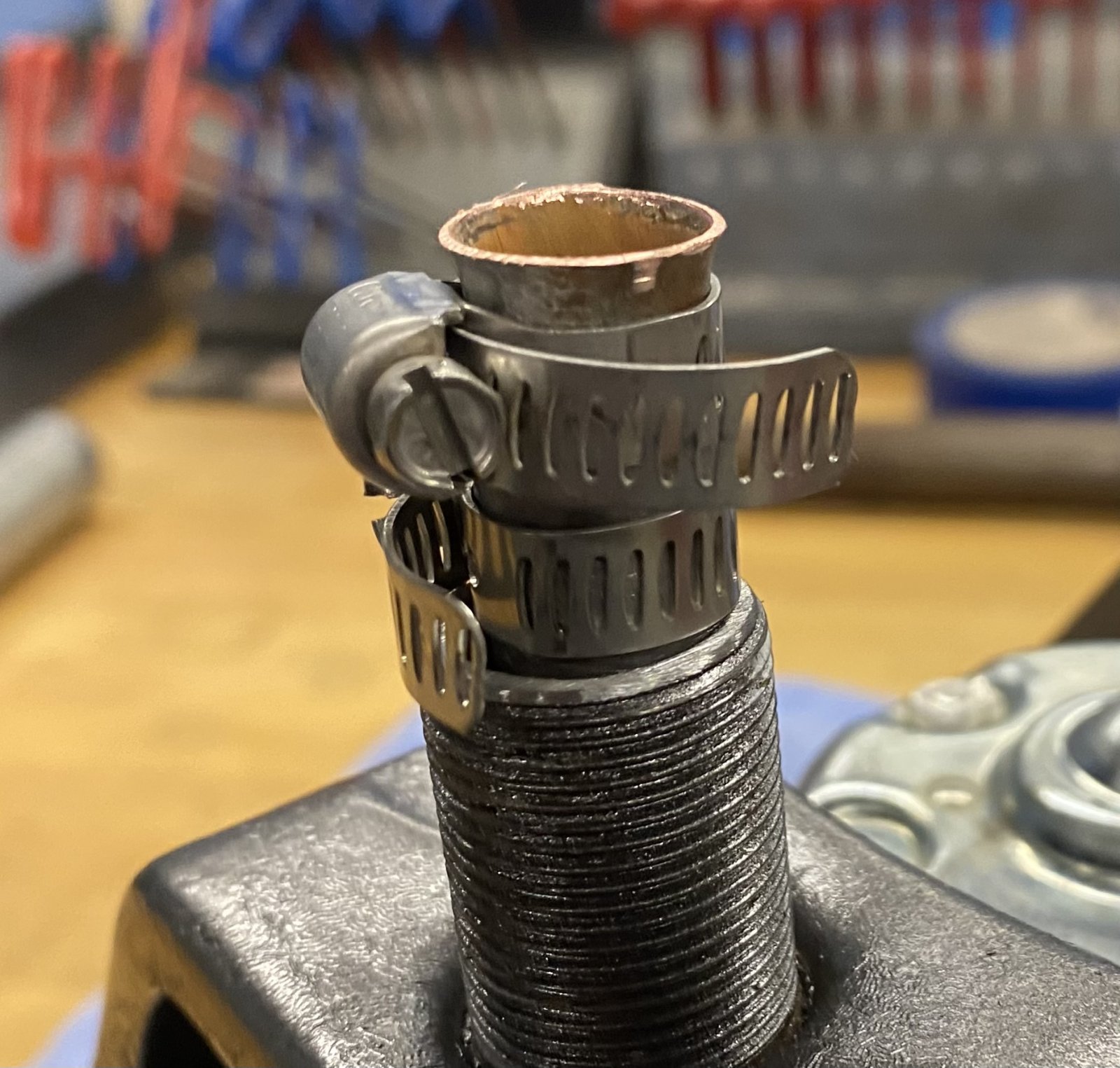

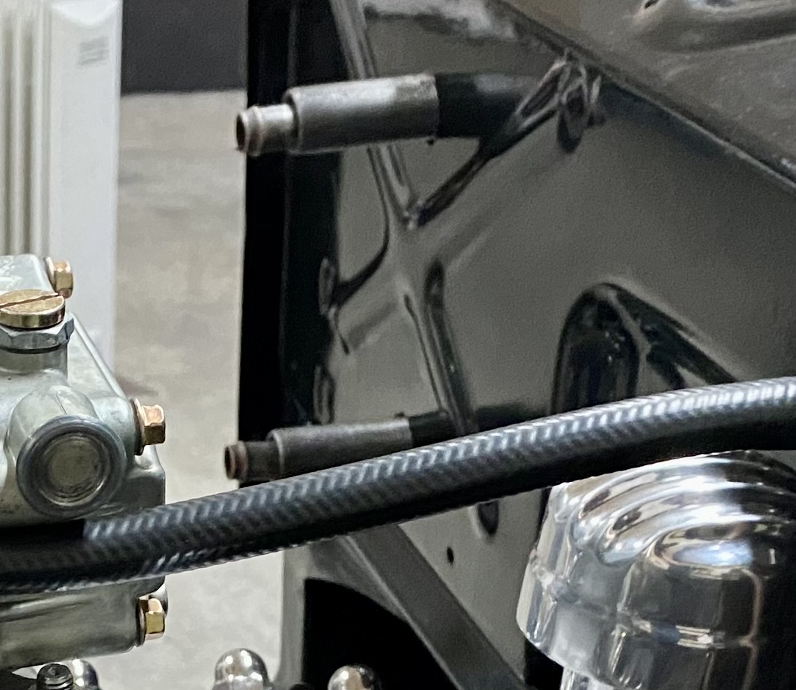

    2. The other issue was the bracket threads are way too long, also the core tubes, but I didn’t wanna cut them because of that flared end.
    So, today I came up with this redneck Idee-ur’ with flaring the ends. One hose clamp to hold it against the thread, and one clamp to hold it at the end. Then wack it with a tapered piece of metal.
    By-Golly! it worked!!’
    Re-tapped the hub, and used some blue Loc***e…so now the fan is set!!
    Amazing what a night sleep will do!!

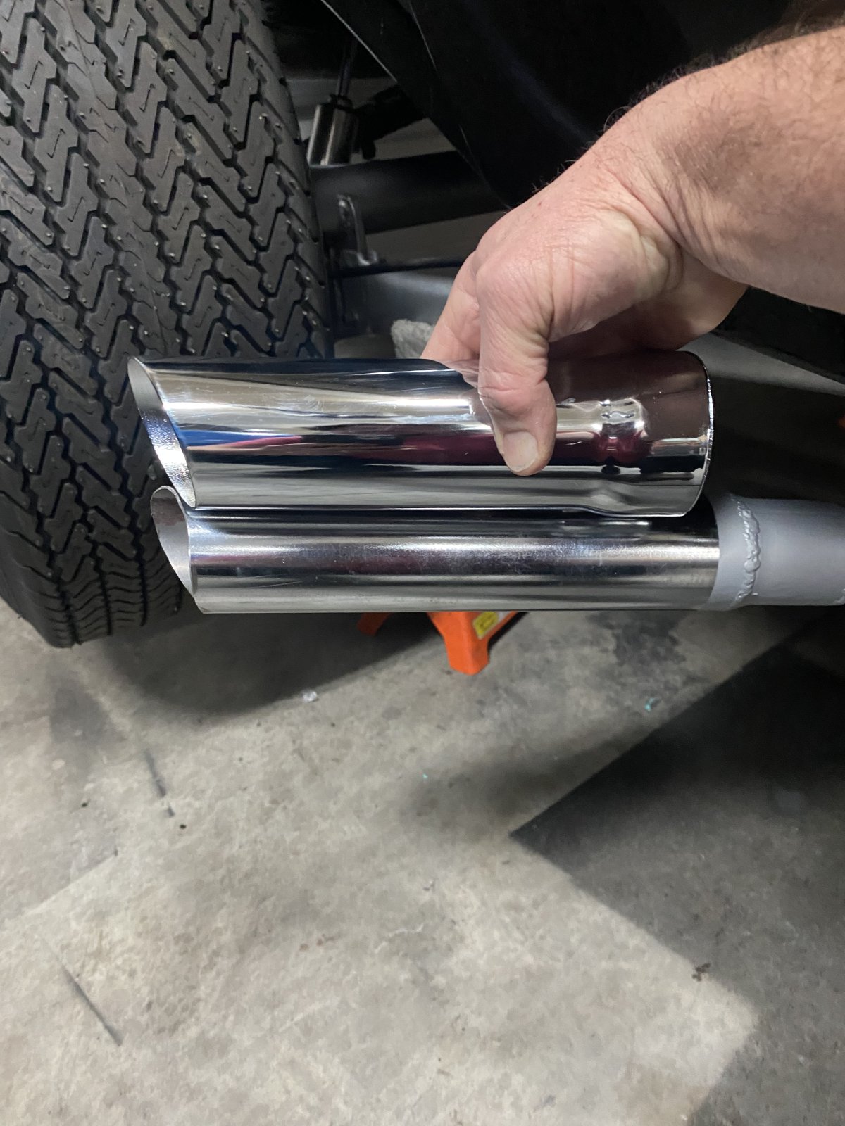

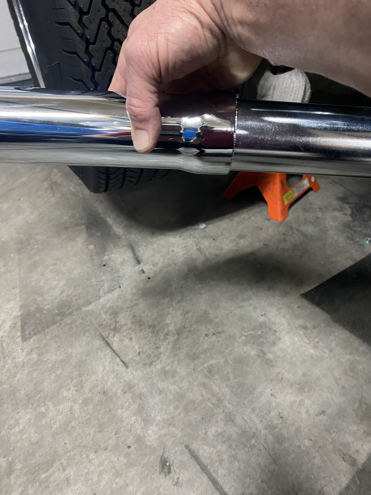

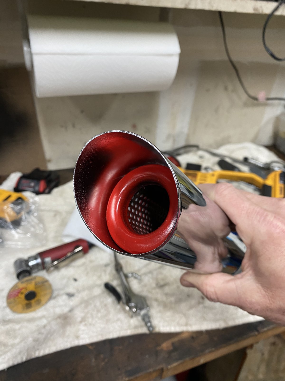

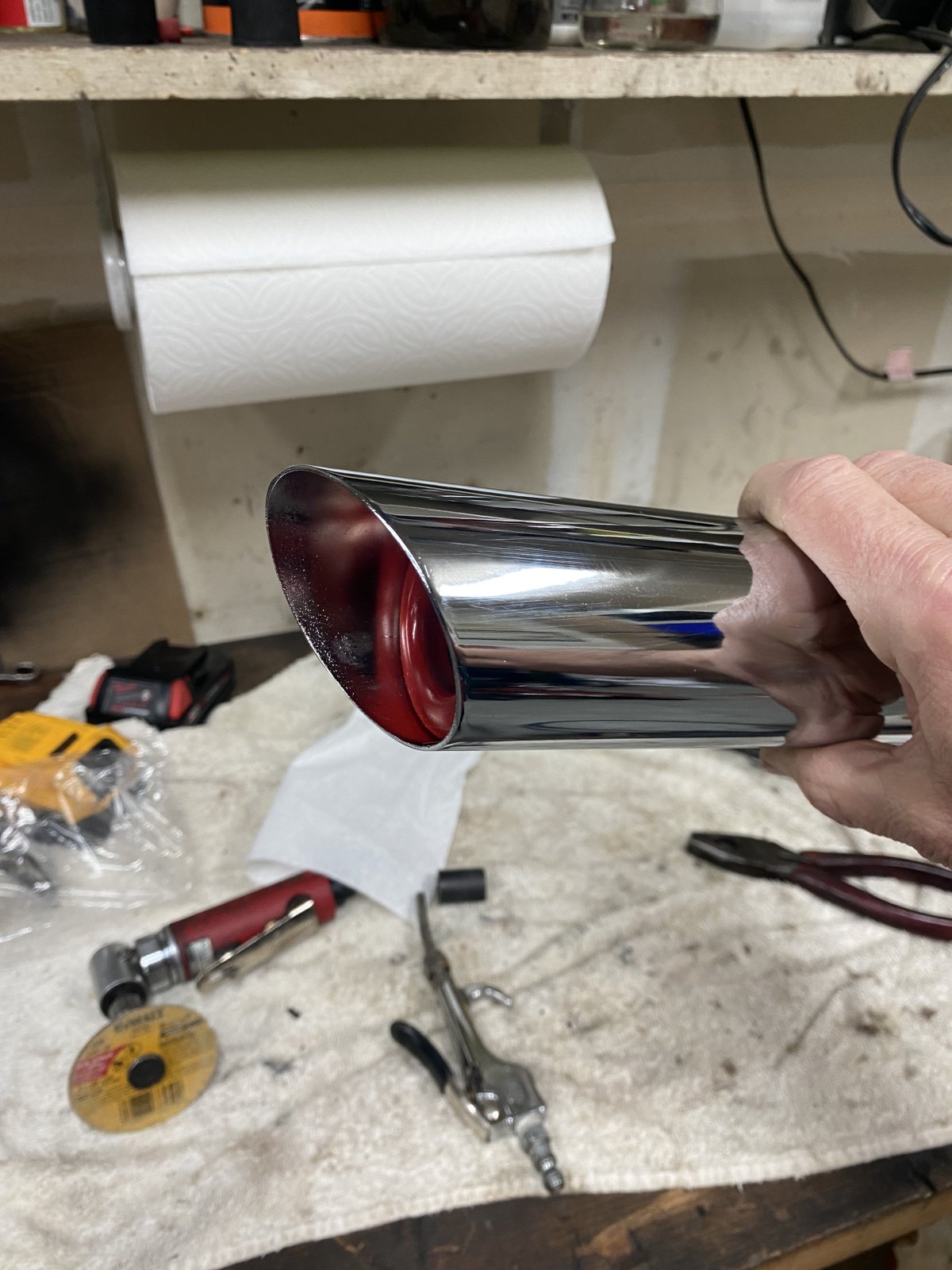

    7B15CCE7-923C-43C4-B53C-A50B382EC4E3.jpeg 6996576B-1CB4-4866-8B83-F6D3DEB268F7.jpeg 66F8DBFE-46A6-4839-A52F-F97F94202806.jpeg 3D720C35-1C22-42A1-92DE-5712C10A78AD.jpeg Boy! Did I get Lucky!
    I couldn’t believe I found these baffled Tips like I use to run on my mini-trucks back in the 80’s!
    And they are the exact same size as my open tips! So if the flatty is to loud, I can slip them on the ends to see the difference, and if they sound better I just chop the old ones and slip on the ends. And weld them!
    My V8 Open pipe Harley!
    Nyuck-Nyuck!
