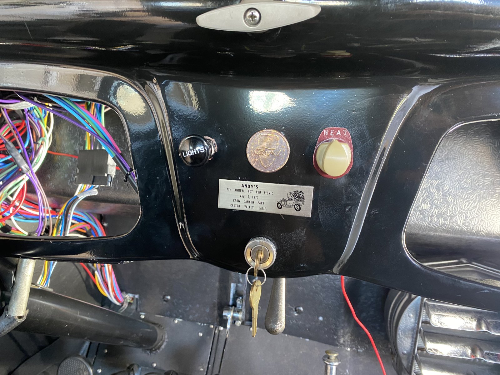

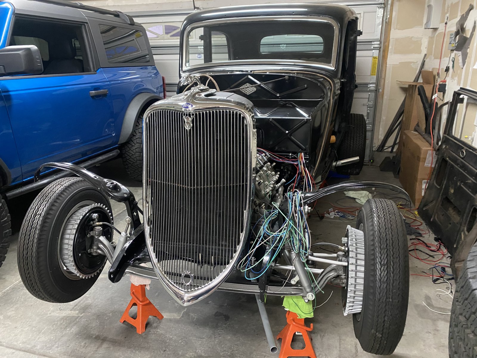

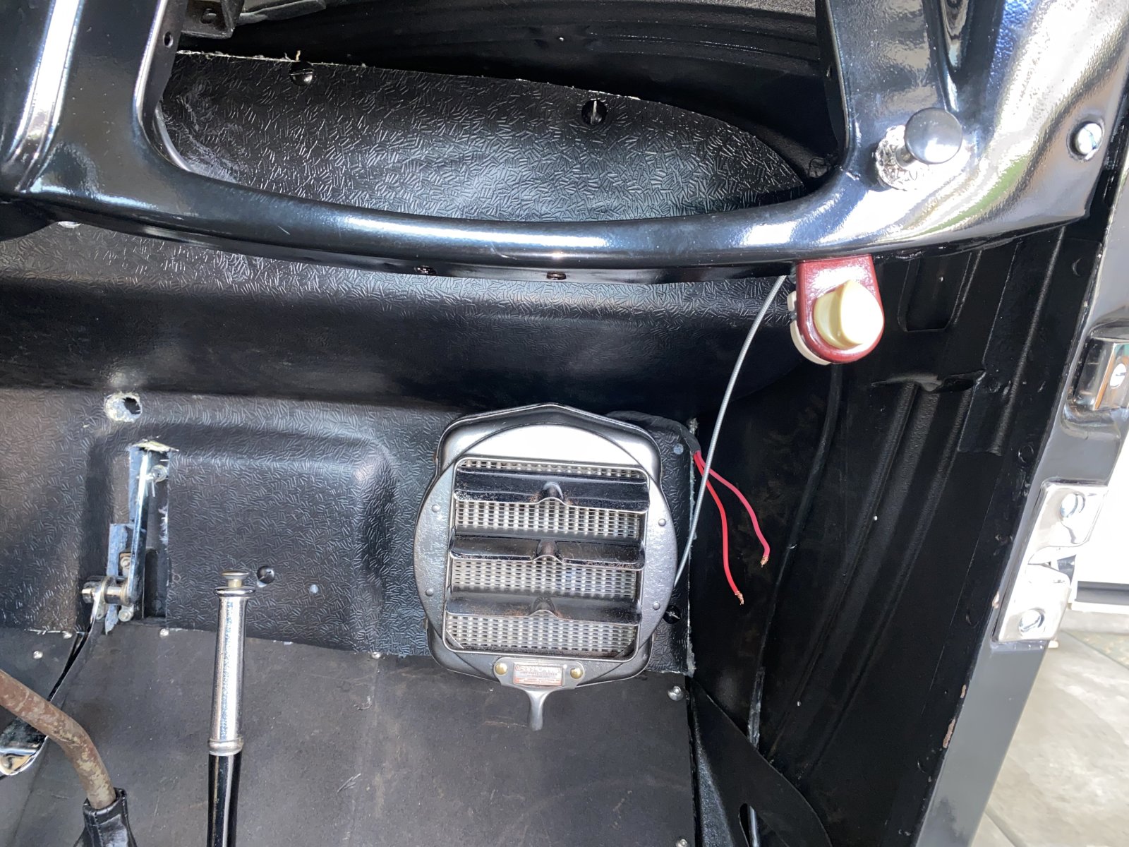

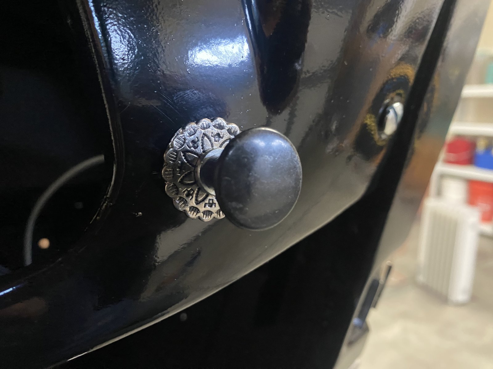

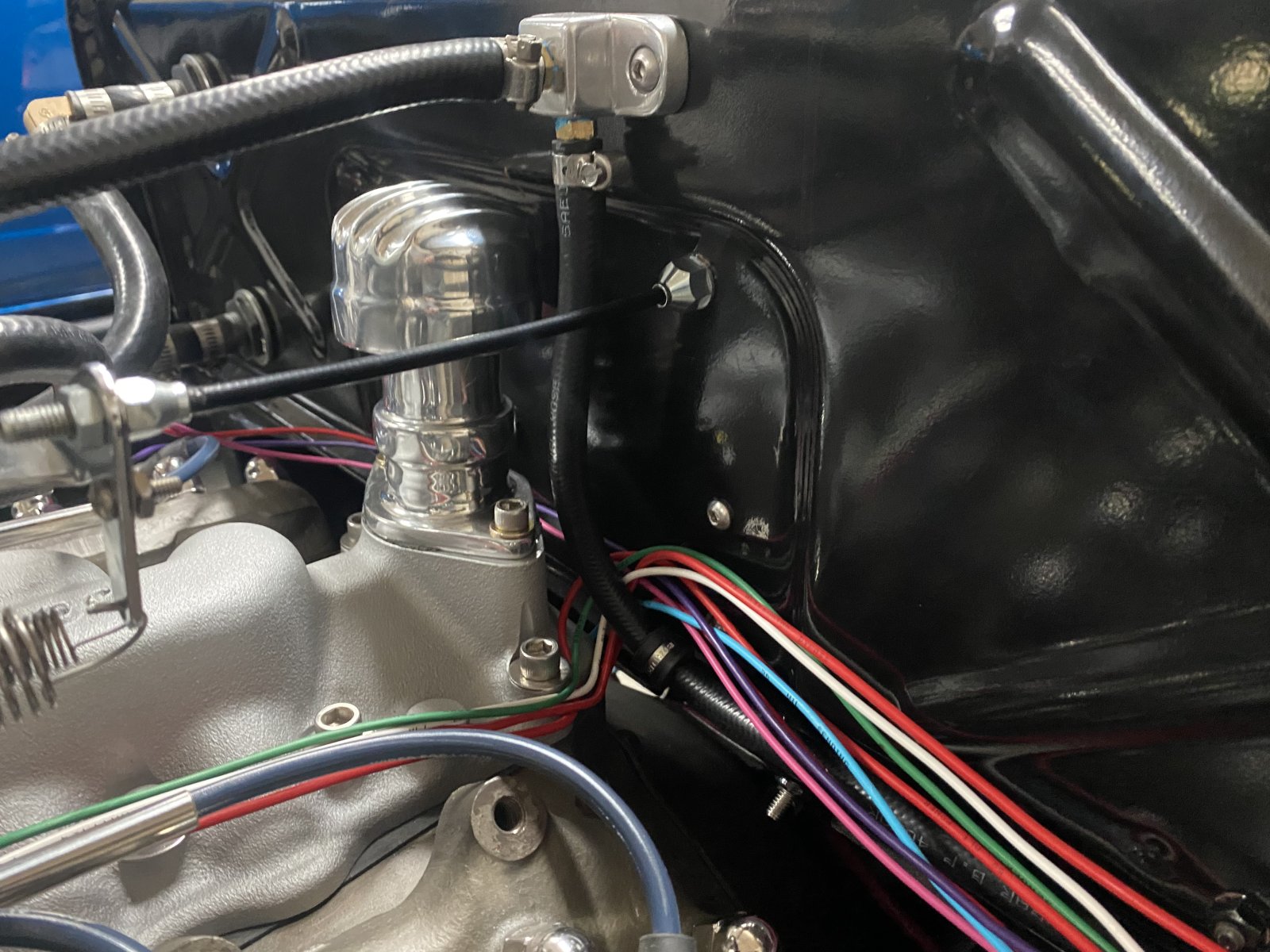

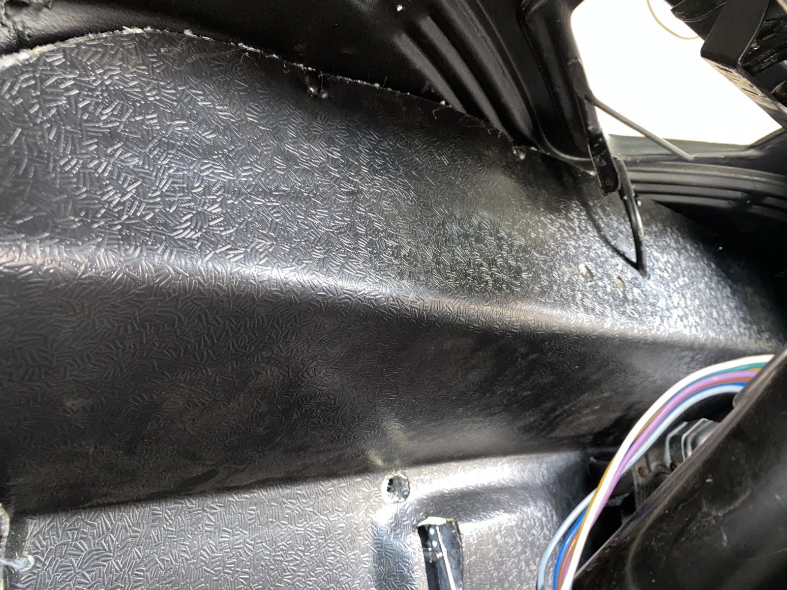

    Fire wall insulation, heater hooked up, and Plumbed, Early Bronco Manual Heat Shut off valve.With my old cowboy hat band trim bezel!
    (new I would dig that out of my junk drawer someday!
    Lets see…
    Dimmer Switch in, PCV Plumbed! Cowl-vent drain line…All this little stuff takes forever! Few More Little things, and
    THEN the wiring!!
    Patience is a virtue…. They say…
    BULLSHAVIK!!! I Say!!! Yaw!

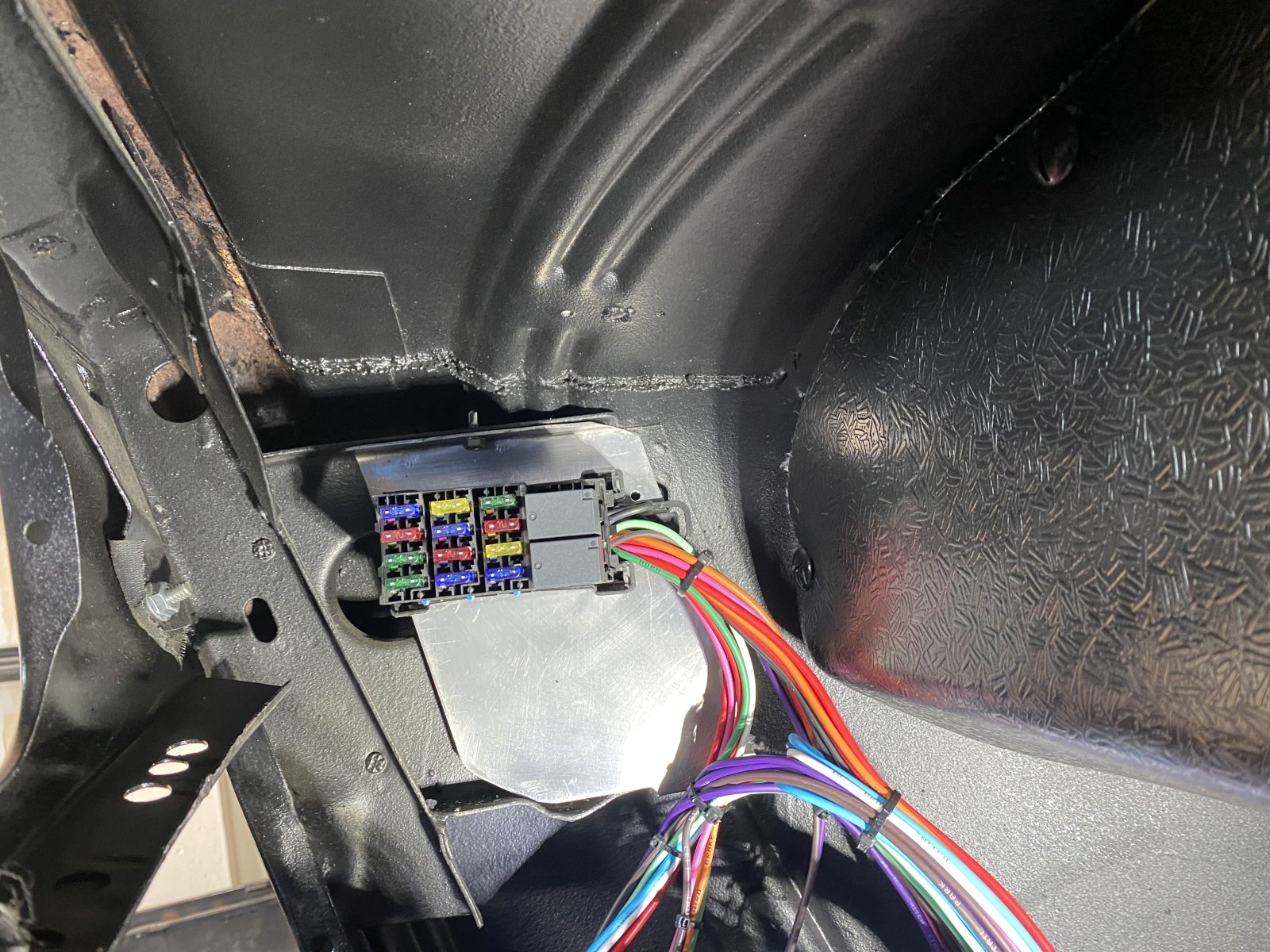

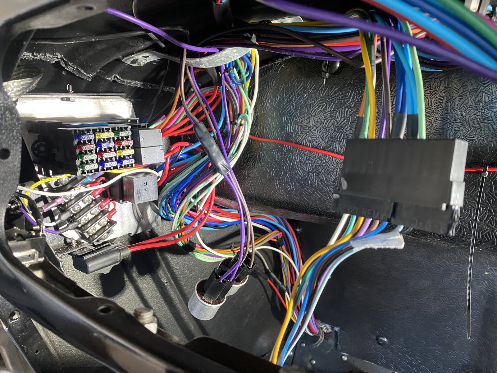

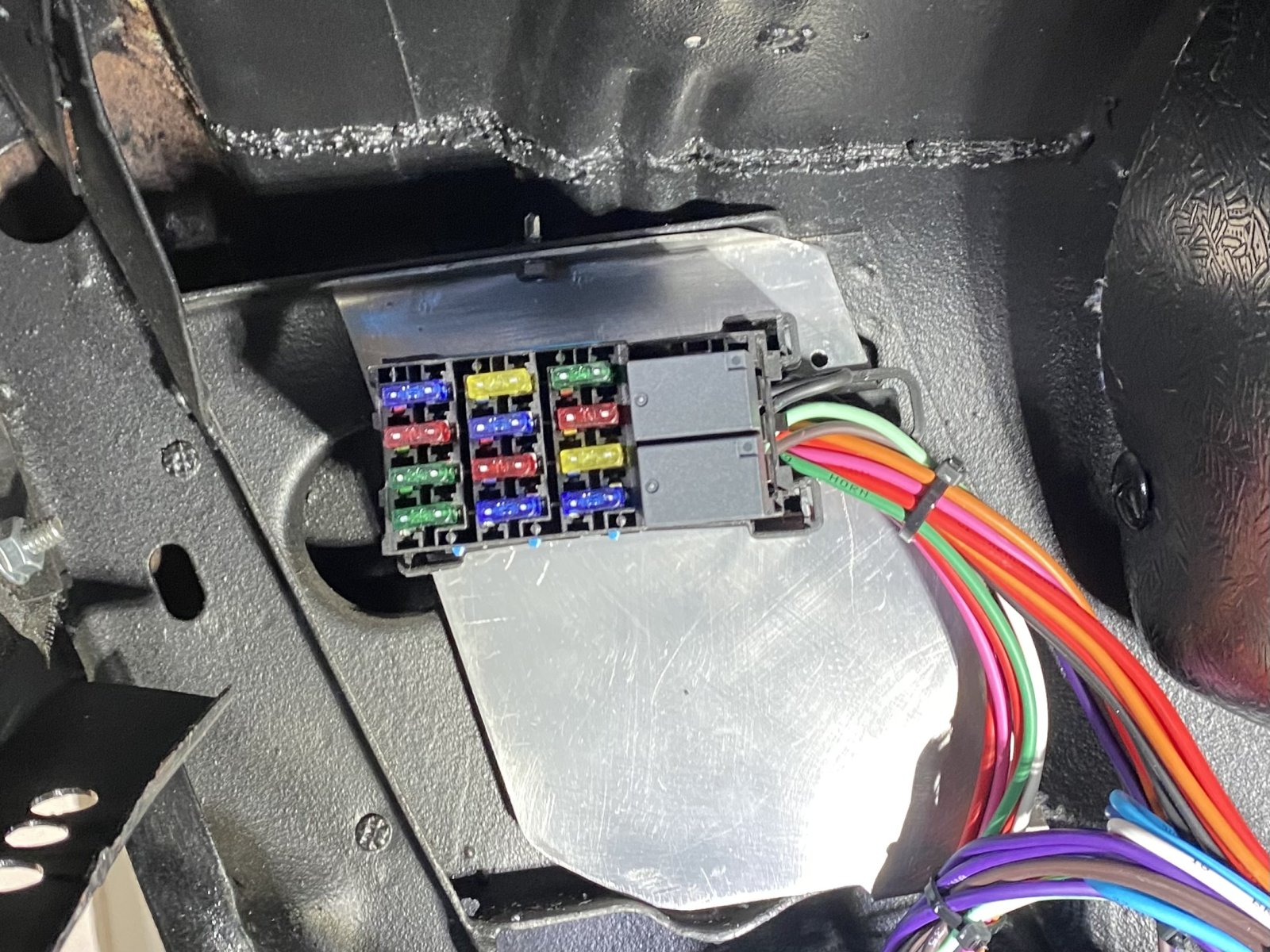

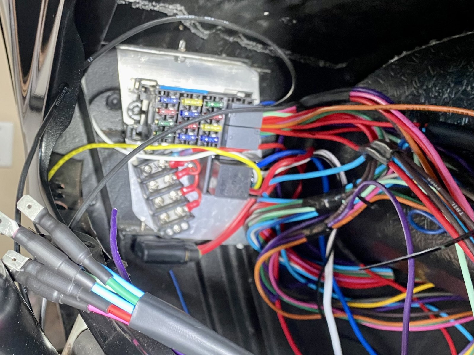

    More done than I thought today!
    Went to make the mount for the Fuse box, when I went trial fit the fuse box, it accidentally snapped back into the holder, so I left it, and just started separating the bundles, thought to myself, it looks relatively easy…and then started routing them!
    E802E0FE-8E67-4CC2-A1DC-83744C0BB96F.jpeg 5755B52E-148B-4552-BC43-3E4176D87B11.jpeg 7A24A8EC-CAD1-4AA8-A0C8-1E34B0C83B2F.jpeg 96D5D69E-D7C2-4F50-ABBA-67ED07A0B65A.jpeg 2CB40FCC-AE19-47ED-8C94-622D6F41081A.jpeg A3DBCF87-F525-4369-BD10-011A4CD79763.jpeg E378CB2C-90CD-434F-9C4F-A022AE936AAA.jpeg 197AD3E8-C79F-4C78-B784-0A62982AAFC6.jpeg 72D91692-05DF-404C-8DAC-5401E0782386.jpeg 434B47E8-71E6-4685-B8E8-D82B3A94A3DE.jpeg 19DEFB7E-A4AB-43D4-B2A8-39005CF6A776.jpeg FCF4189F-3673-44E0-A5C0-B66C9FCA739C.jpeg

    Just be careful you don't let the smoke out of the wires.......

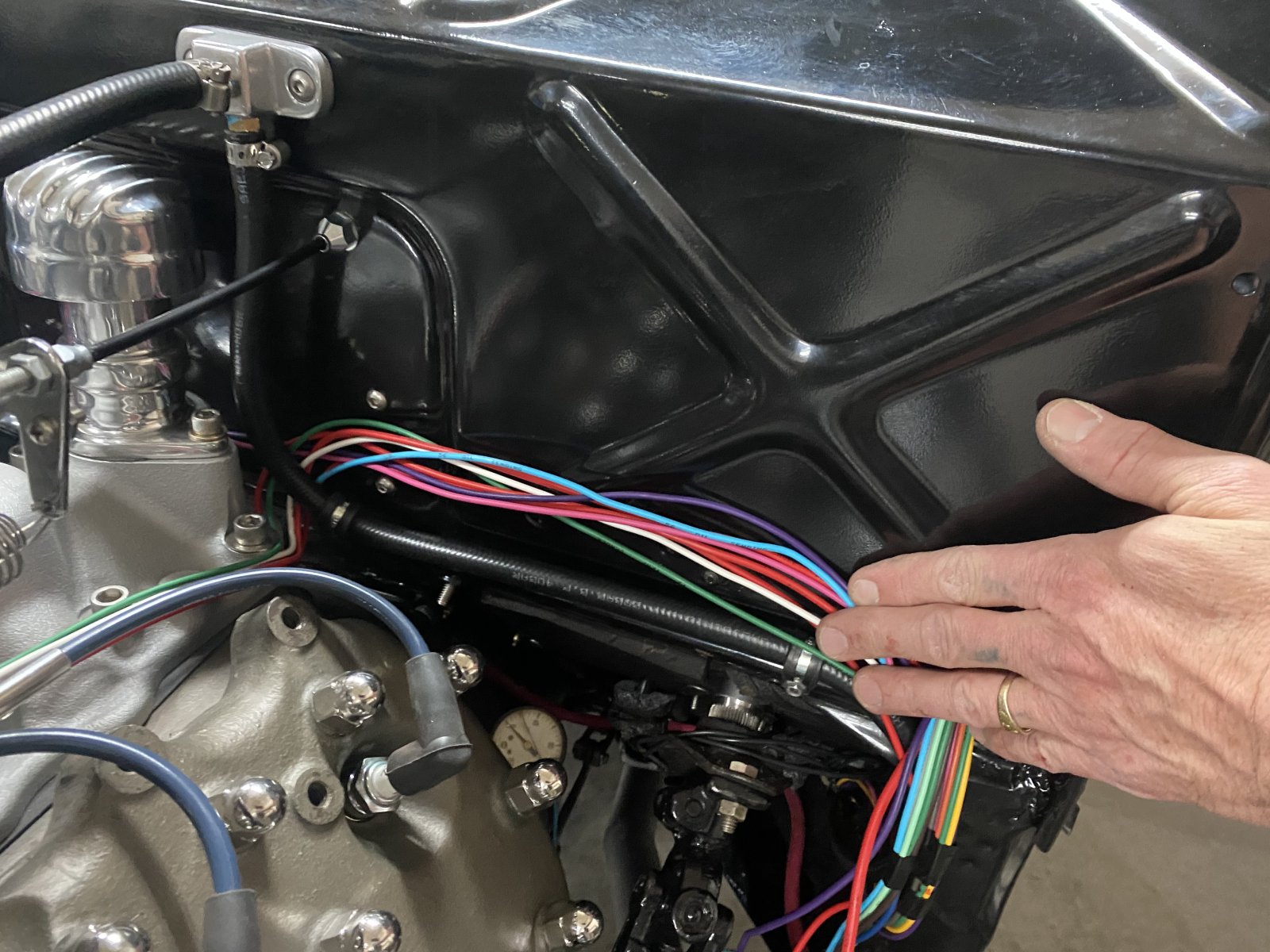

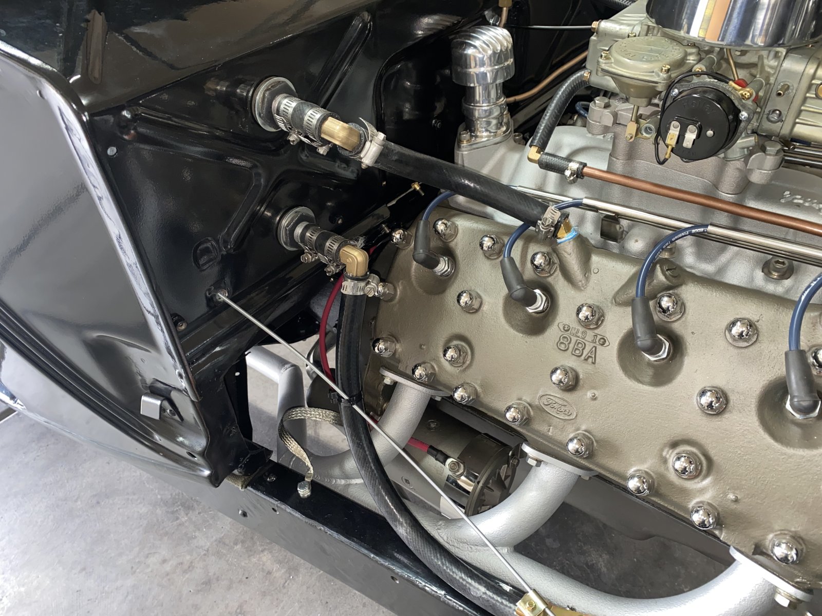

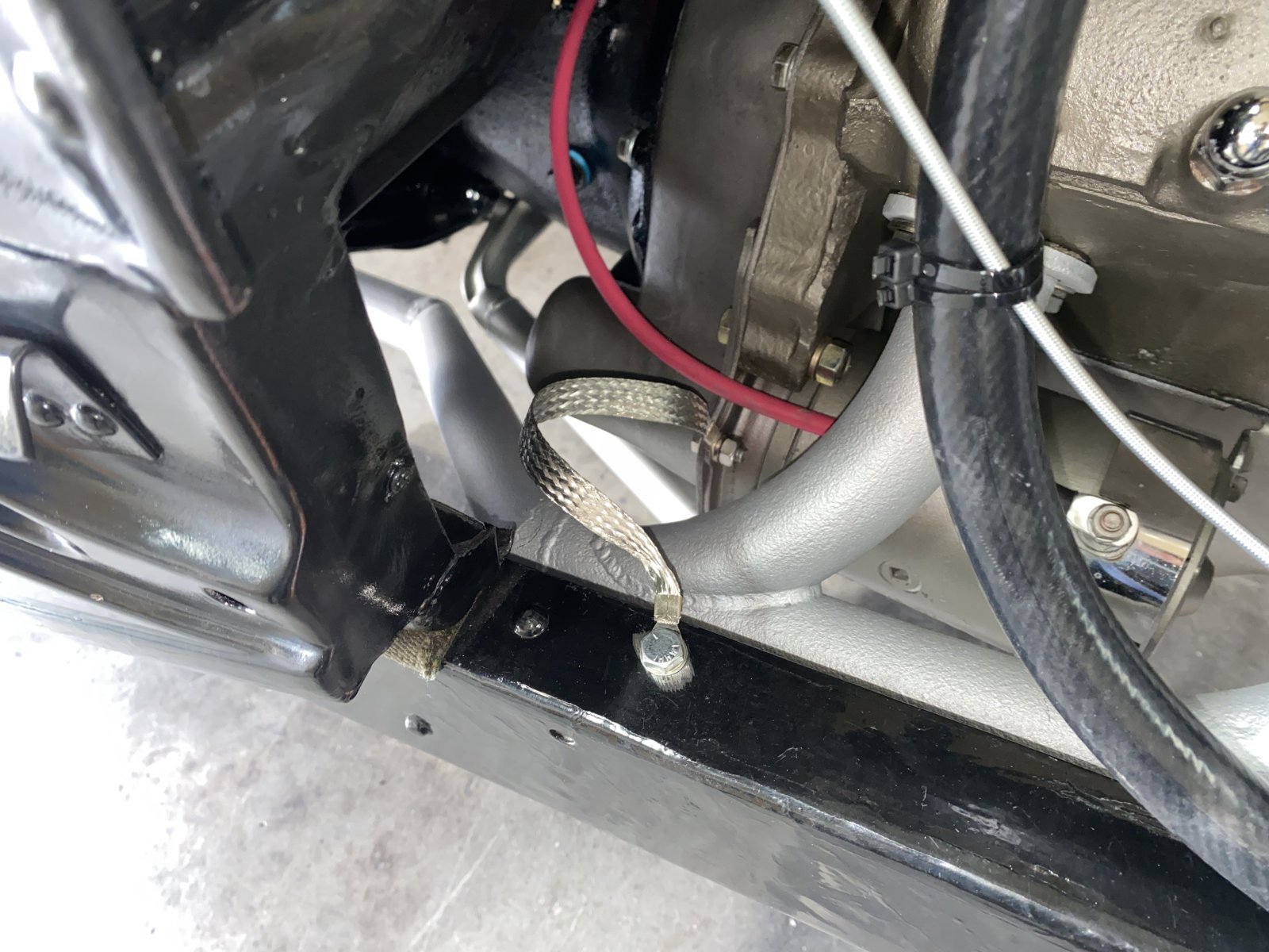

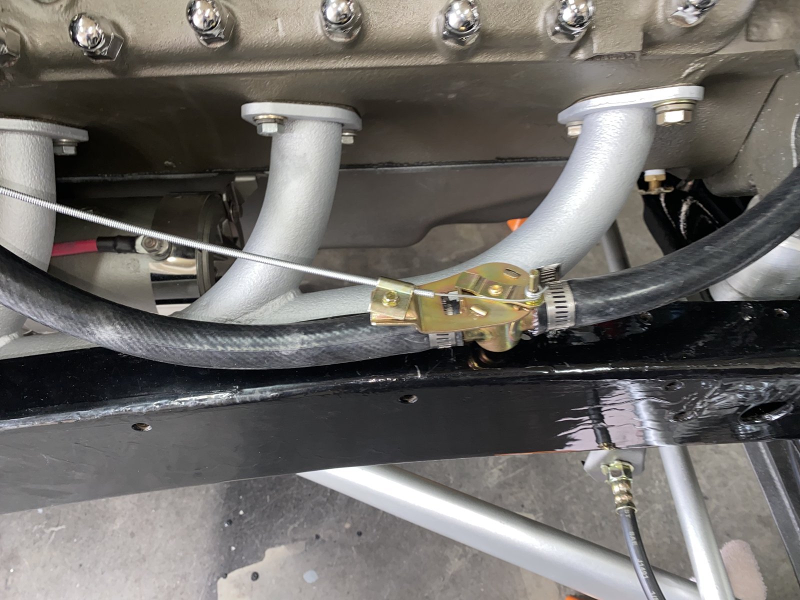

    B2877857-E452-41C9-86A8-0BEEA84942EA.jpeg D7A5F0B4-BBD5-4B28-B9FD-8B3B9145FA8B.jpeg F01F2CAE-7299-4399-9D7D-E2873CA056C1.jpeg 0D74FBA9-DC3F-4F39-A120-160A0547B305.jpeg 85560A49-7D11-415E-AADB-6A02BAD64795.jpeg E0623480-9E7A-4F16-A9AE-357FA831C1E1.jpeg A06E8581-1DBE-4A37-821A-7A0CEF6367A6.jpeg 674E664E-AAF4-4D68-9DBB-9D4A867999BA.jpeg Not so much “voodoo” but more like Spaghetti, and Sticky snakes! But slowly routing to all the right places.

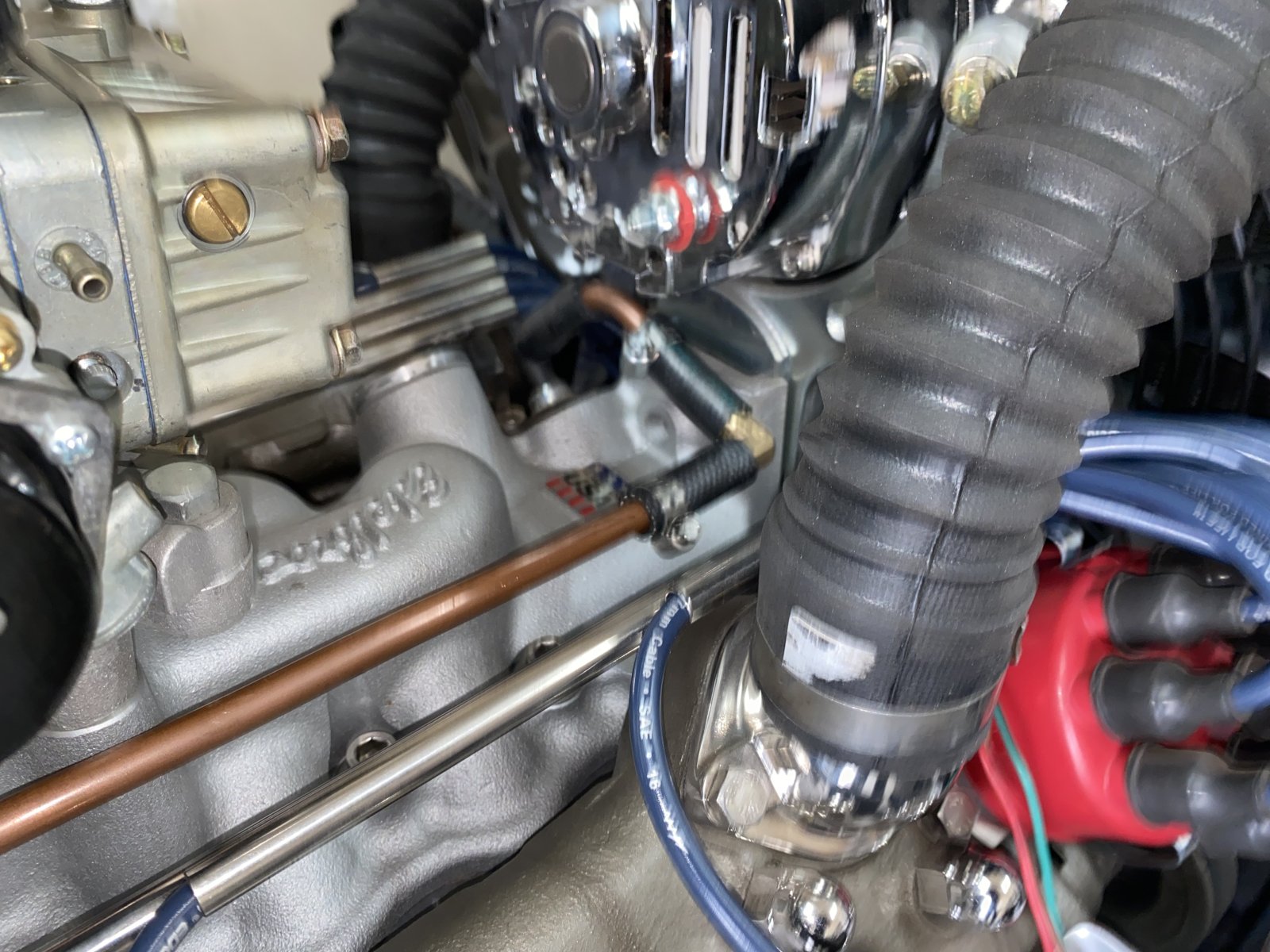

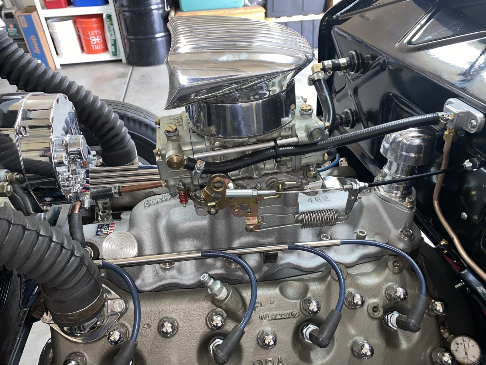

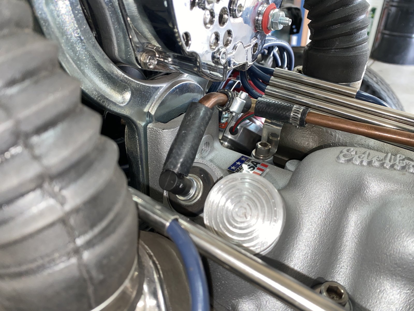

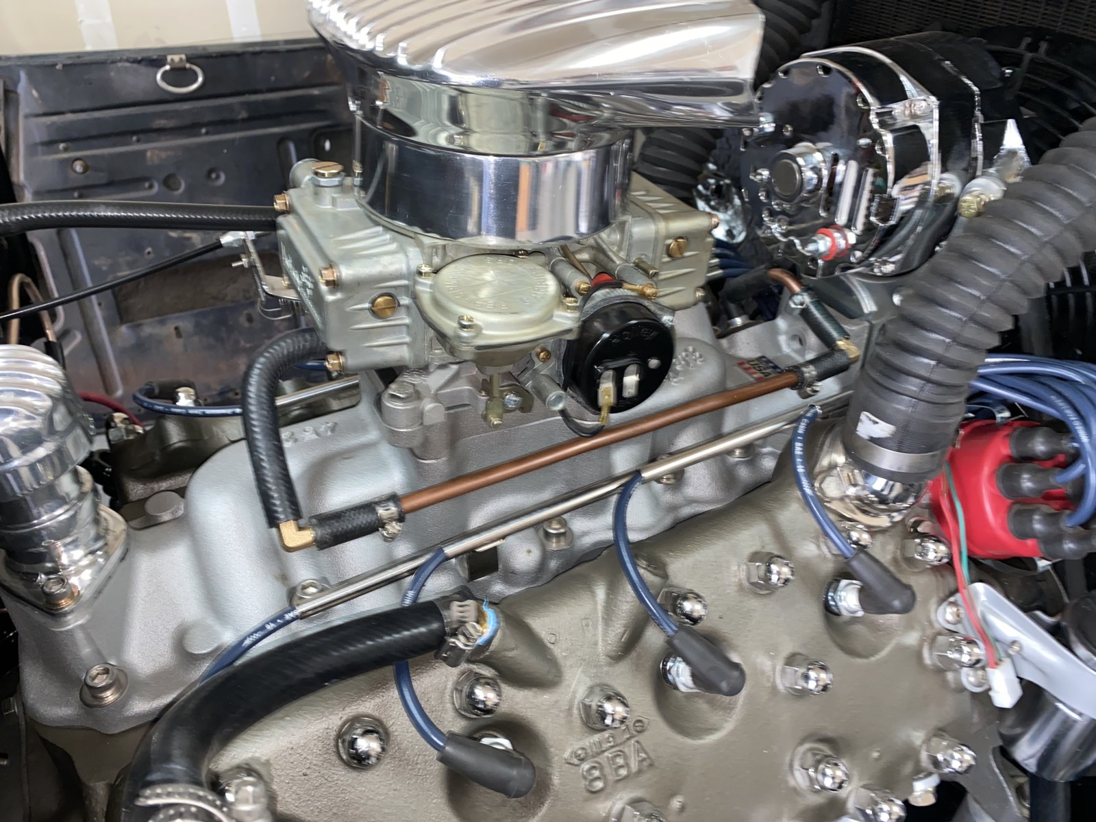

    I also cut the the ugly Ni-Copp line on the firewall, down to the frame rail, squished a coupling farrell on there, and then cut the fitting off in order to have a flare, but didn’t really need it
    The Braided hose is tight and looks alot better on the firewall, cant see it really.
    You guys are probably sick of pictures every day! I’ll back off a little bit,
    I am sure Wiring is boring to alot of people!
  6. Johnboy34
    Joined: Jul 12, 2011
    Posts: 1,664
    Johnboy34
    from Seattle,Wa
    It'll be running real soon now!
    33Doll likes this.
  7. RICH B
    Joined: Feb 7, 2007
    Posts: 6,133
    RICH B
    Replacing that section of line with hose looks much nicer.
    33Doll likes this.

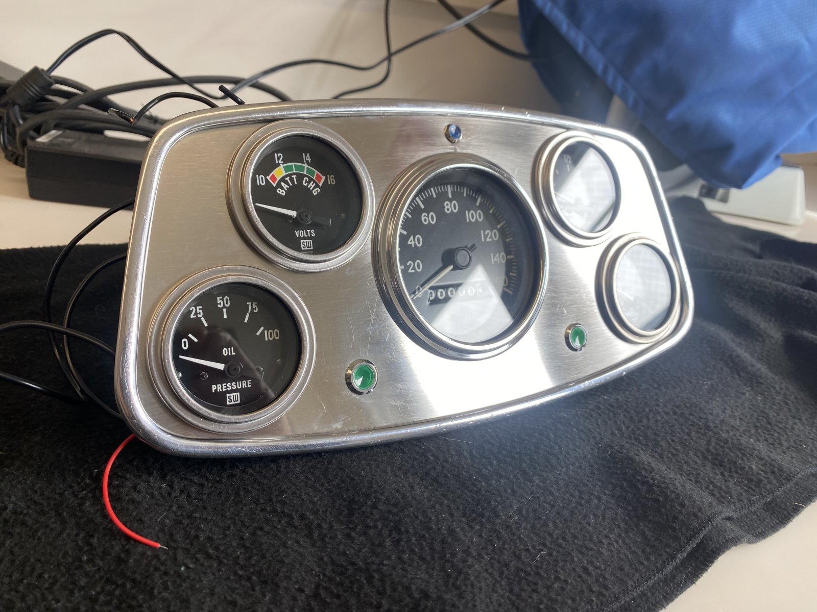

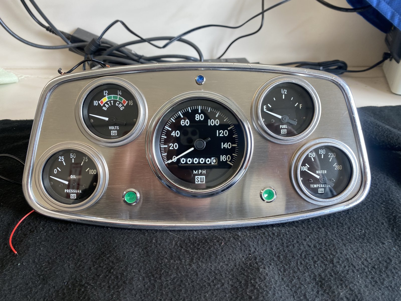

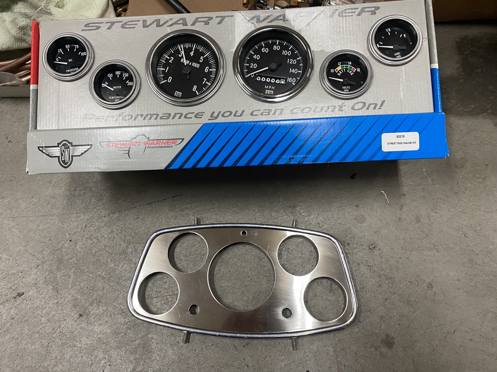

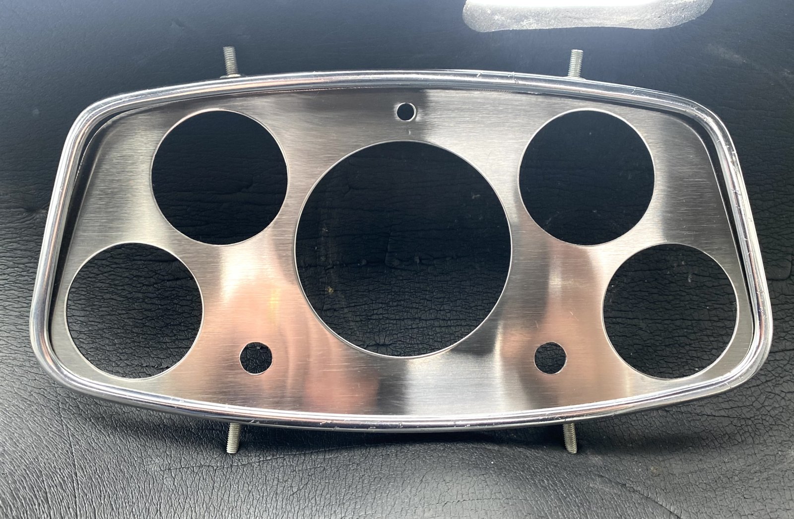

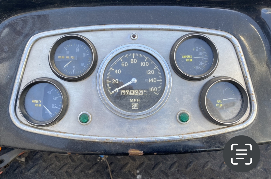

    E6C24E62-DBC0-4BFF-848E-2E3648087990.jpeg Heres My New SW Gauges
    Just Gary, mad mikey, Outback and 2 others like this.

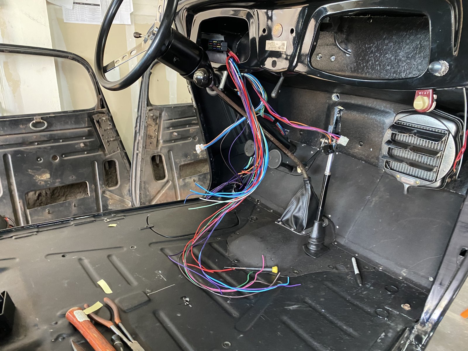

  12. 33Doll
    Joined: Sep 27, 2019
    Posts: 1,589
    33Doll

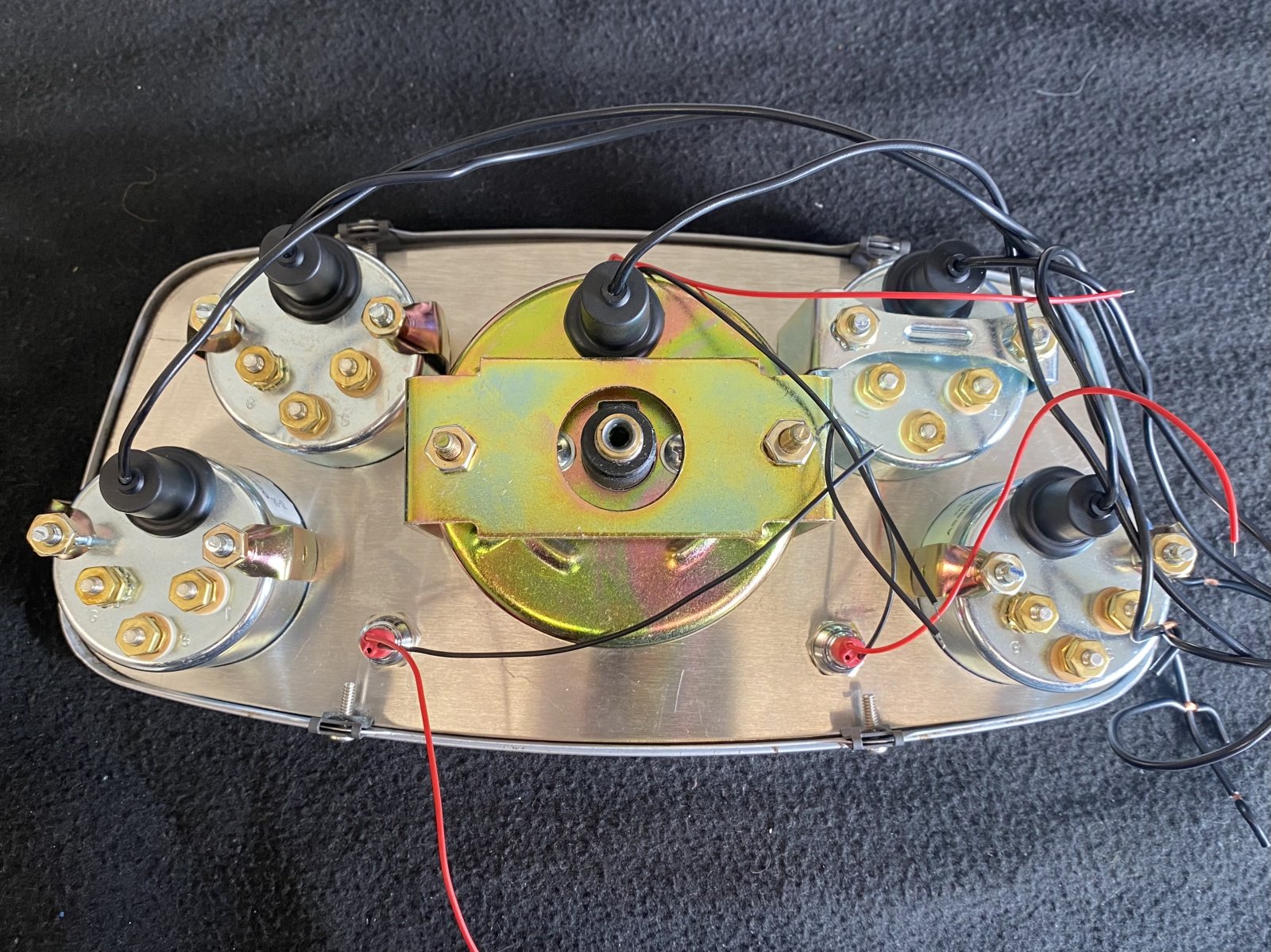

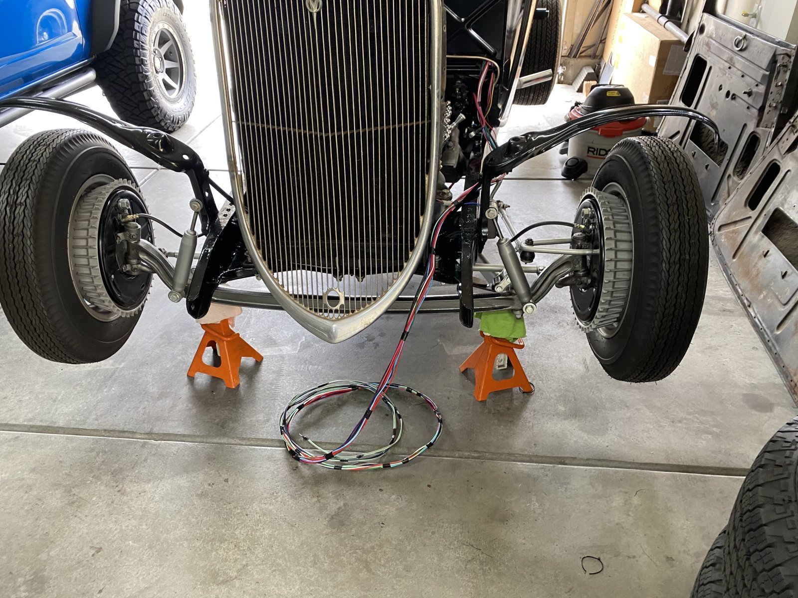

    Gauge Cluster ***embled!
    Going to make one harness, and Put a plug on it,feeding it from the left side towards the fuse box, so everything is tucked up and clean and easy to work on, or just unplug and remove the whole Cluster/Bezel!
    E6372F57-BAA9-4BBE-AF98-356B5705B37C.jpeg F46DDB9B-DE6B-40D8-BE46-1CF87DD8718E.jpeg D29F37C4-FB3F-43D0-AE2C-C04CDC852703.jpeg

    Instrument Panel Is Done and Working!
    Should make this Wiring job alot Easier!
    Check My Tuber-Channel!
    mad mikey, Dave Mc, Outback and 3 others like this.

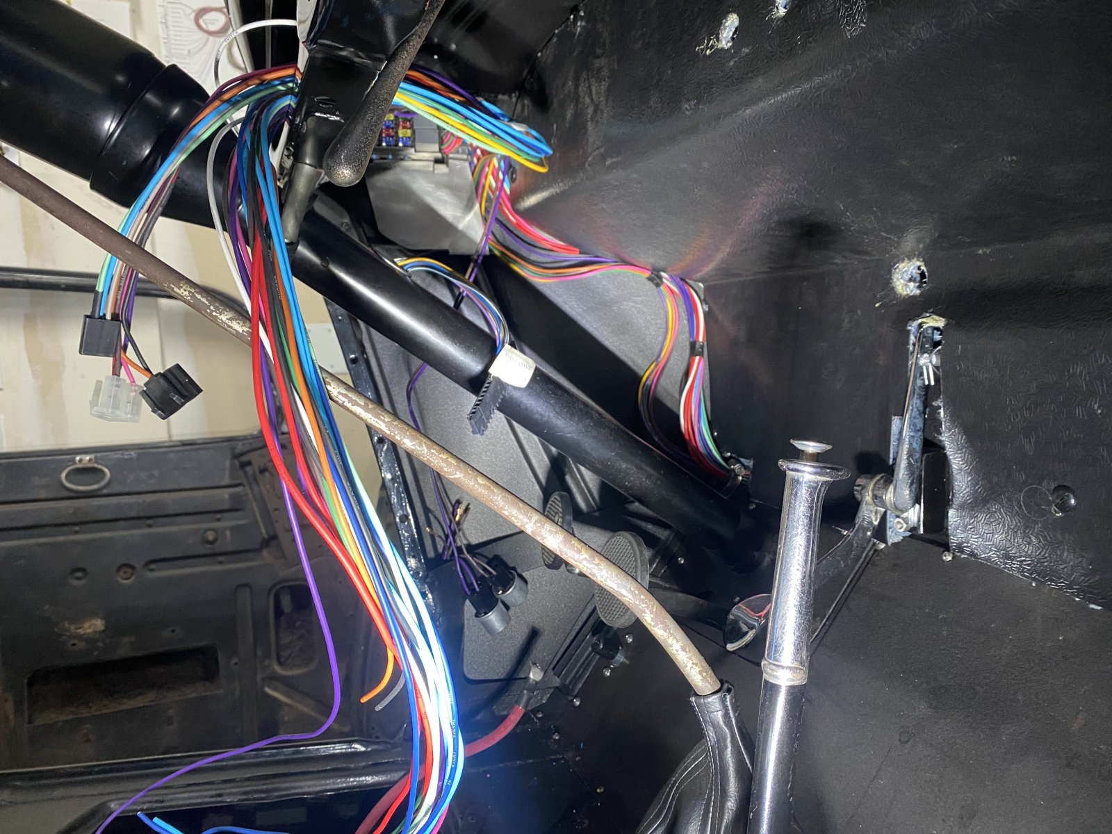

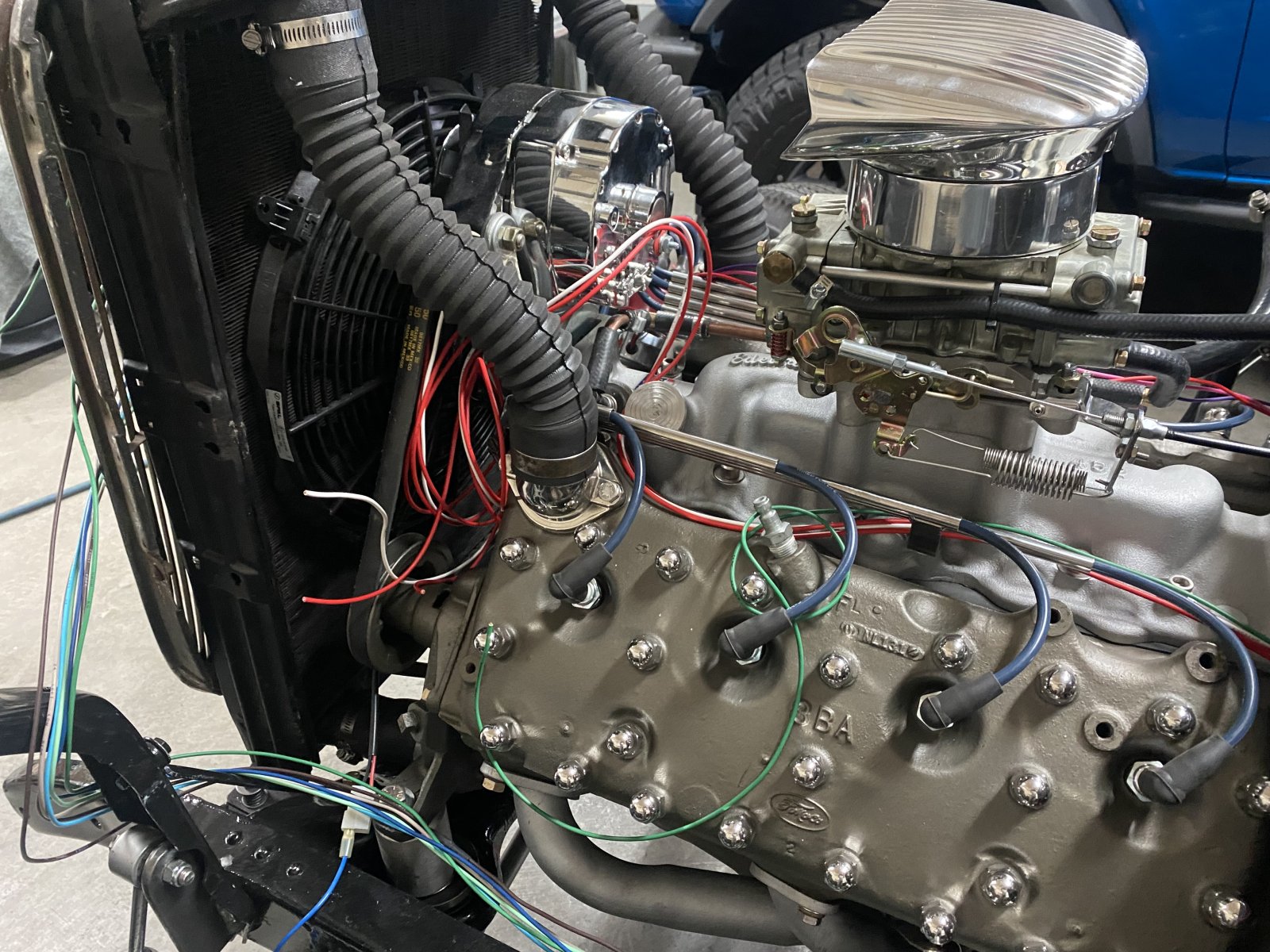

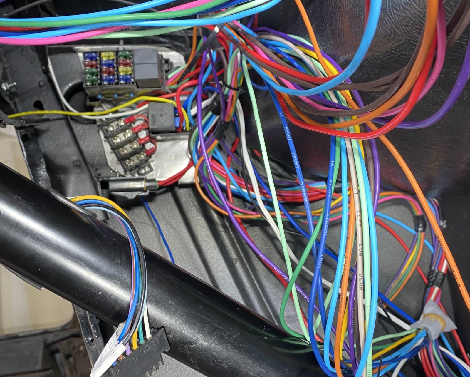

    Boy! This wiring os about a thrill a minute!!!

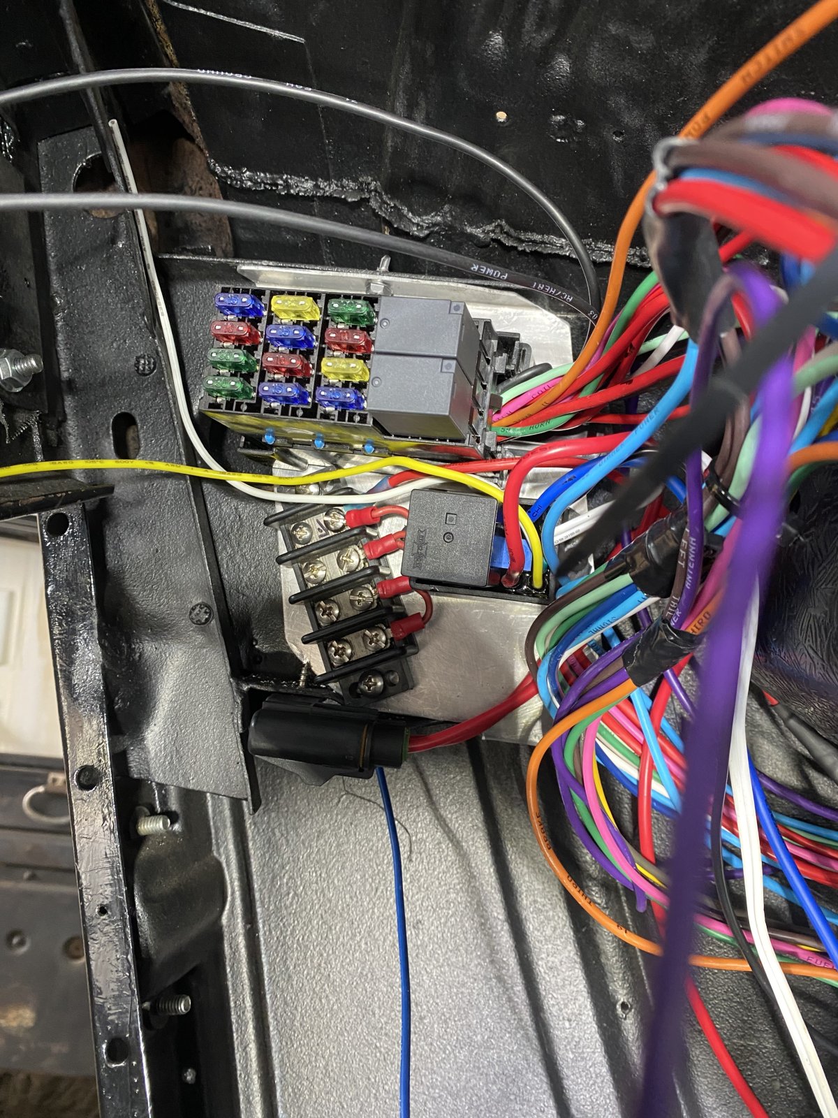

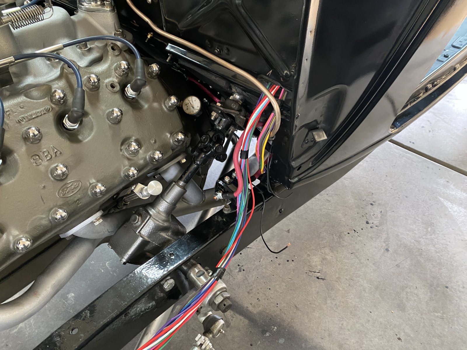

    Got the Fan relay, and Fuse 450B346D-BF84-4F39-8703-3DA255907DB5.jpeg F7EBAA98-6429-4092-9FFD-4D593947099F.jpeg C2B91FC5-4C7D-4D34-9618-208C9C85C33A.jpeg Mounted inside
    (No where really in the engine bay on these 30’s cars!)
    Put a battery Hot Junction block down to the battery with a 30 amp Inline Fuse. That way if I want some things direct, I can Just hook up there.
    Just Gary, mad mikey, Dave Mc and 5 others like this.

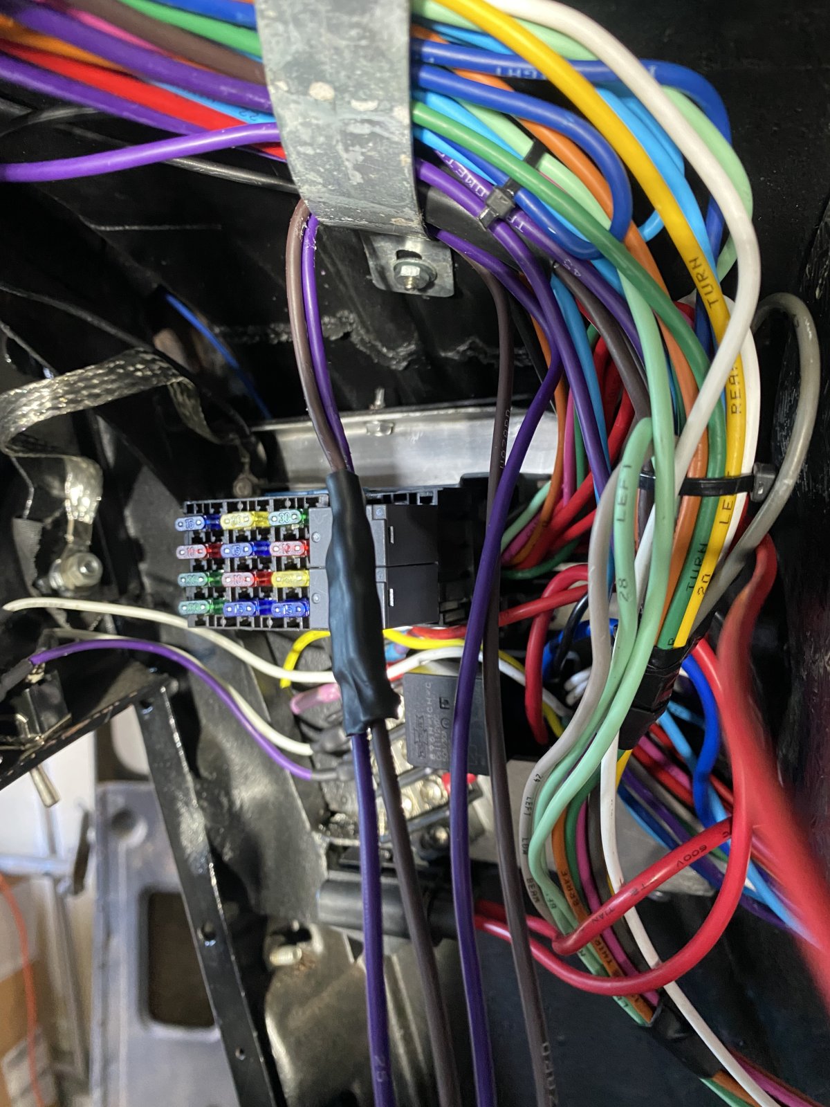

  15. 33Doll
    Posts: 1,589
    33Doll

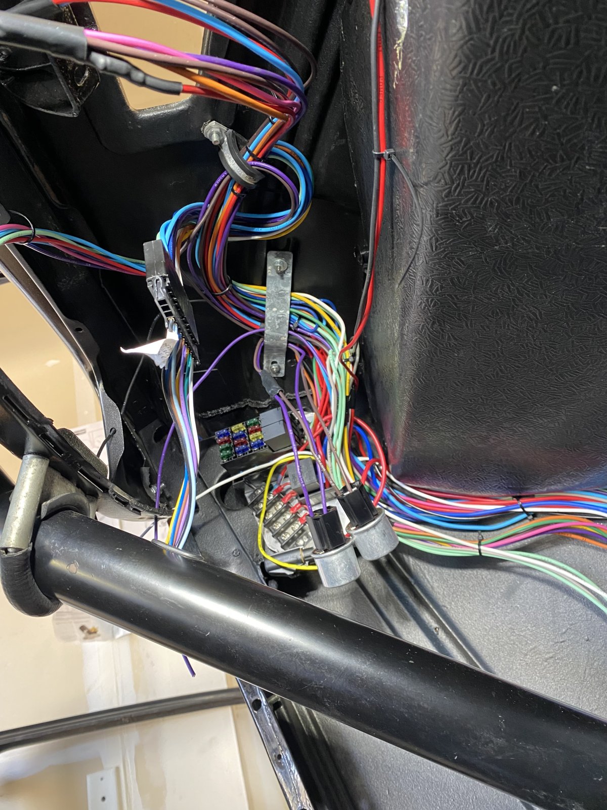

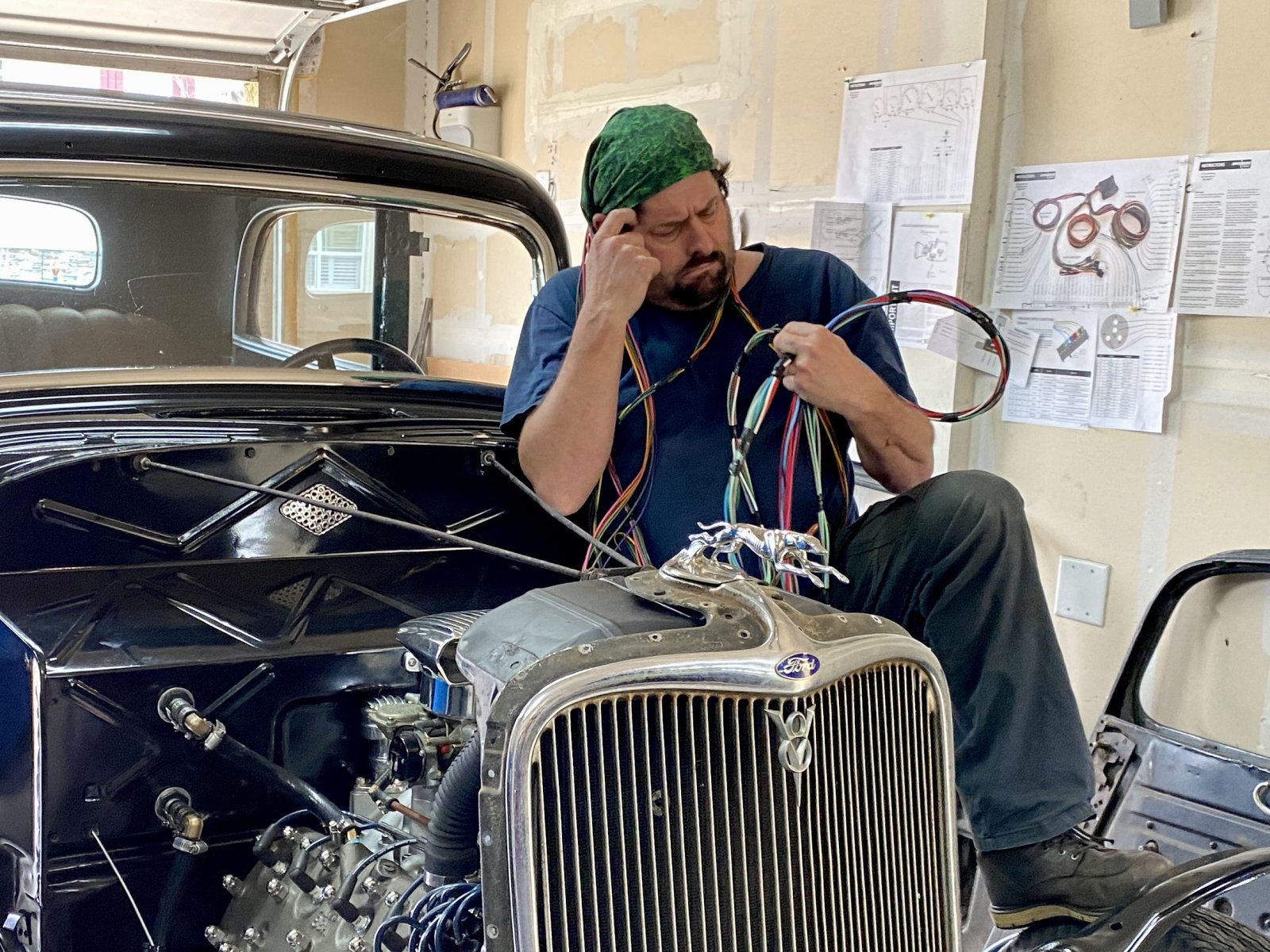

    Please don’t judge the “Spaghetti”
    Just Yet! It “Will” look betterer soon!
    Me Promise’ss!

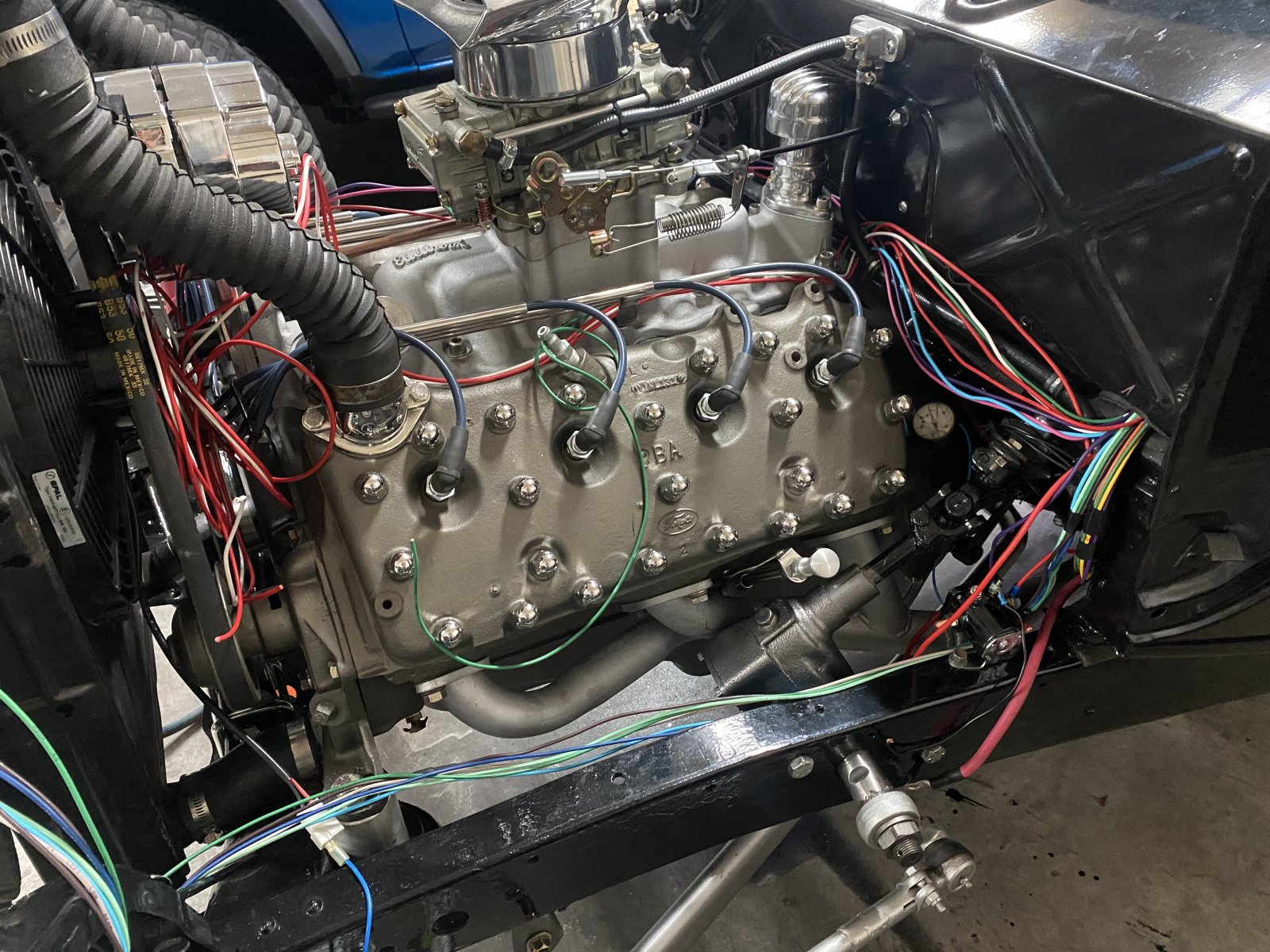

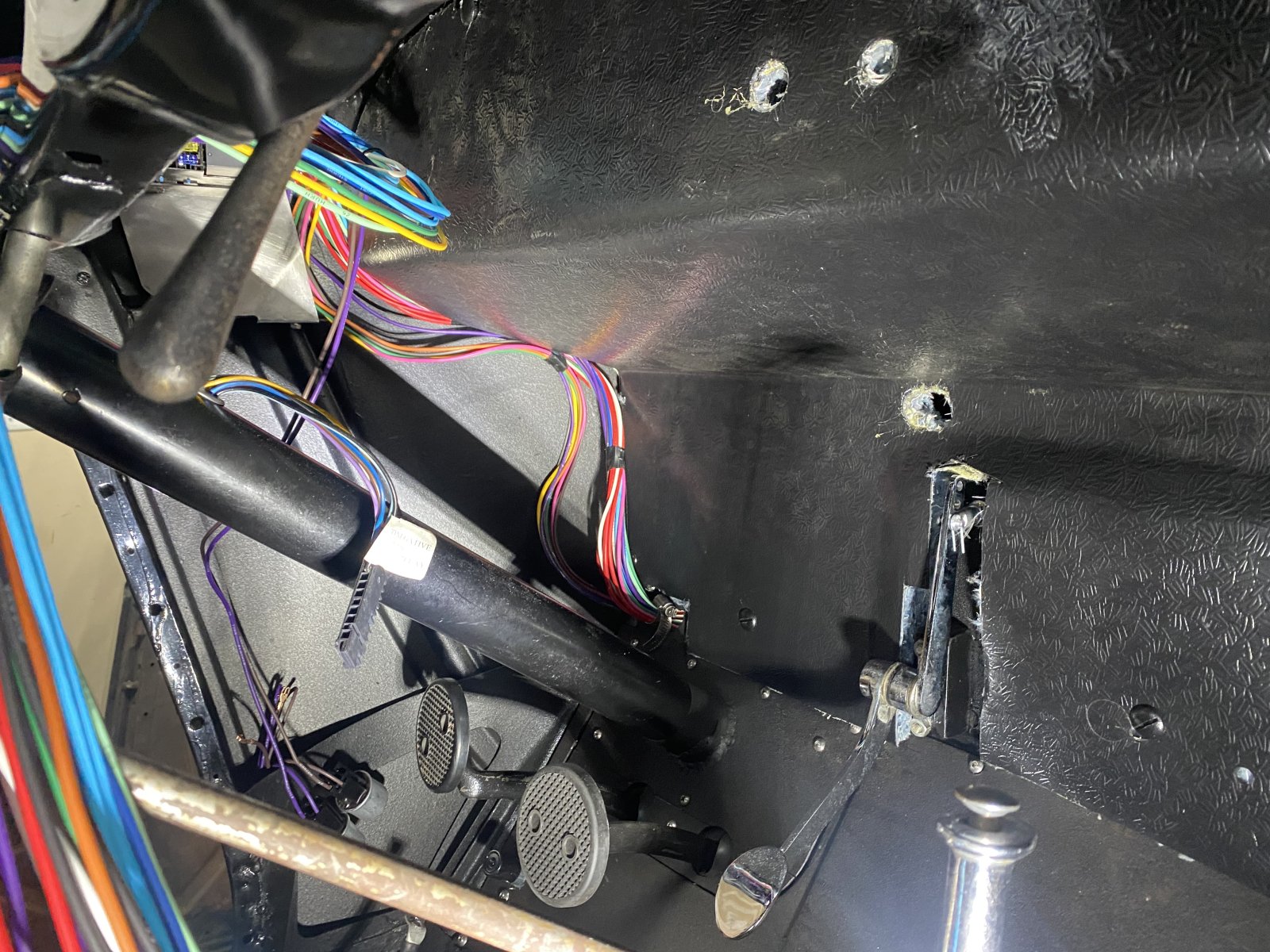

    99F36055-D169-462F-8032-65F4058DEAA3.jpeg 8F30C678-570A-4934-A96E-53F77441643A.jpeg 5013FF66-21EE-4B3E-9516-142CDCC3F008.jpeg 014EF548-AB8C-48CE-91A3-A6B68DDF91B0.jpeg Not much to report lately!

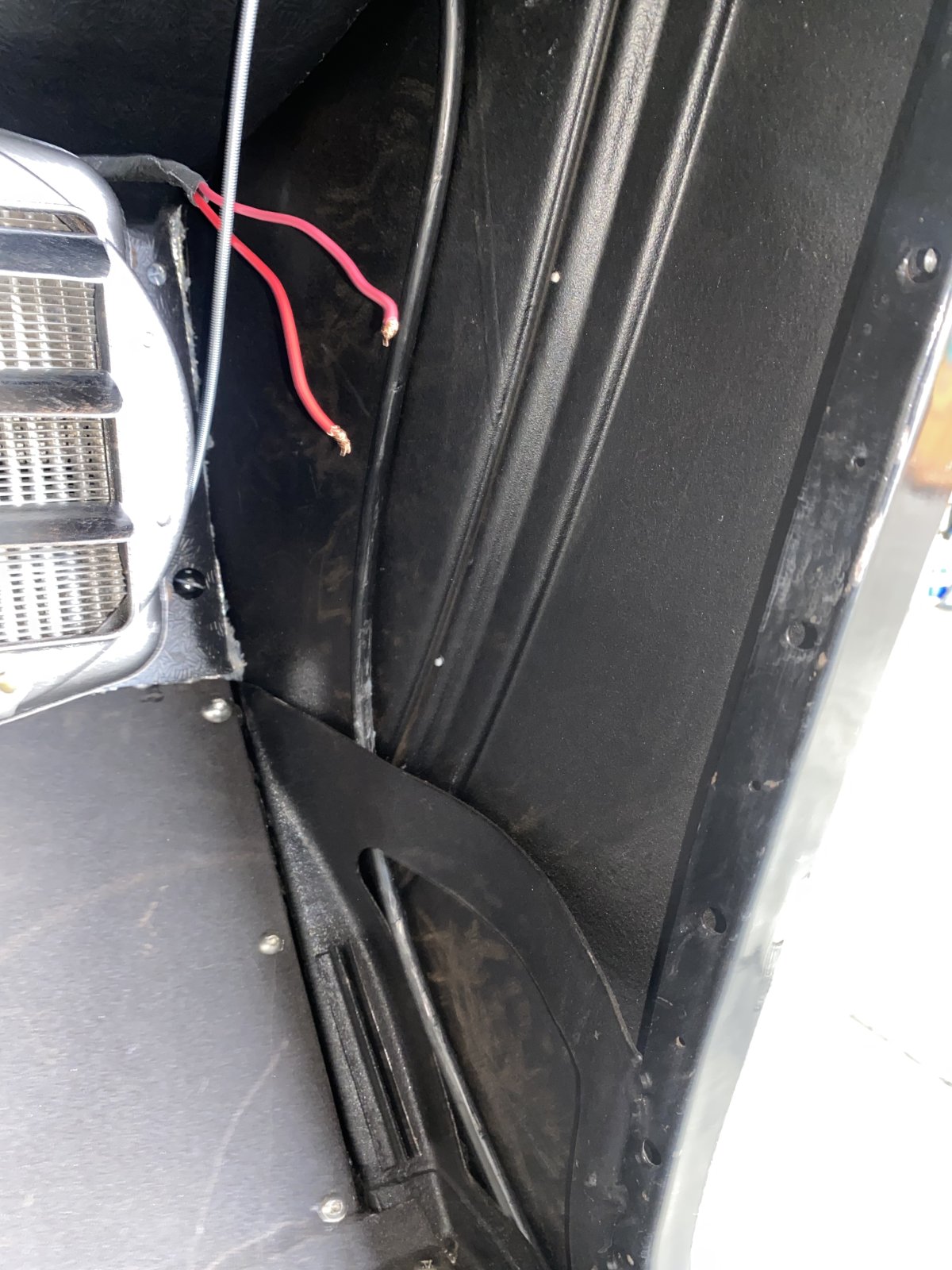

    Wife is restricting Garage Time for me
    Due to Honey-Do’s and House and Yard Neglect. Whatta ya gonna do??
    You need them Gals too.

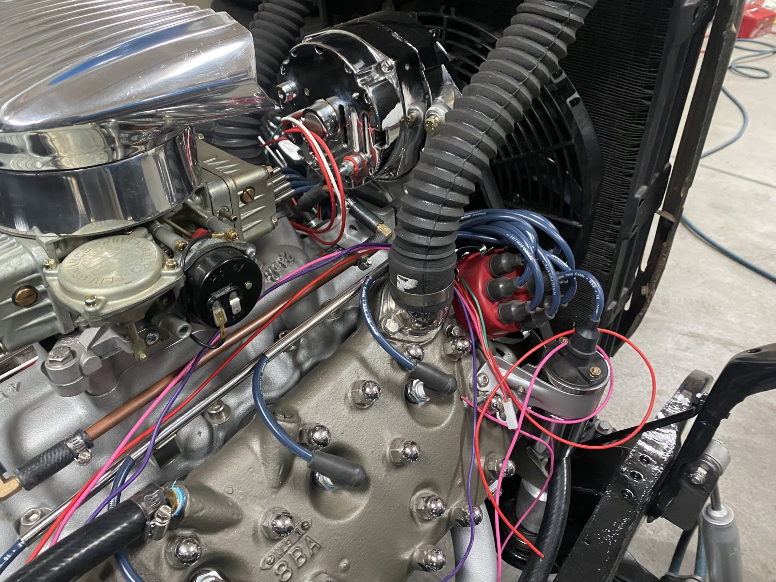

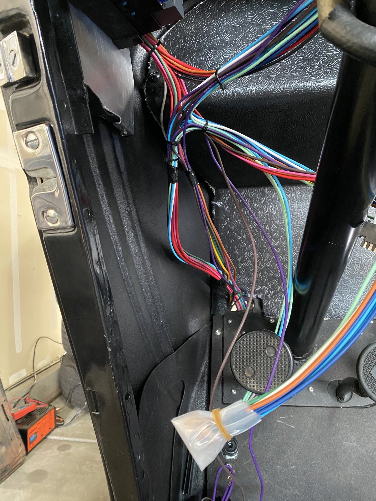

    Heres a few pics… almost done with the inside wiring (Heater motor, and dome light left) I will make it prettier later after I know everything works…soon I can start hooking up the other ends to the components. And Might get somewhere!!!
    mad mikey, Tman, Outback and 3 others like this.

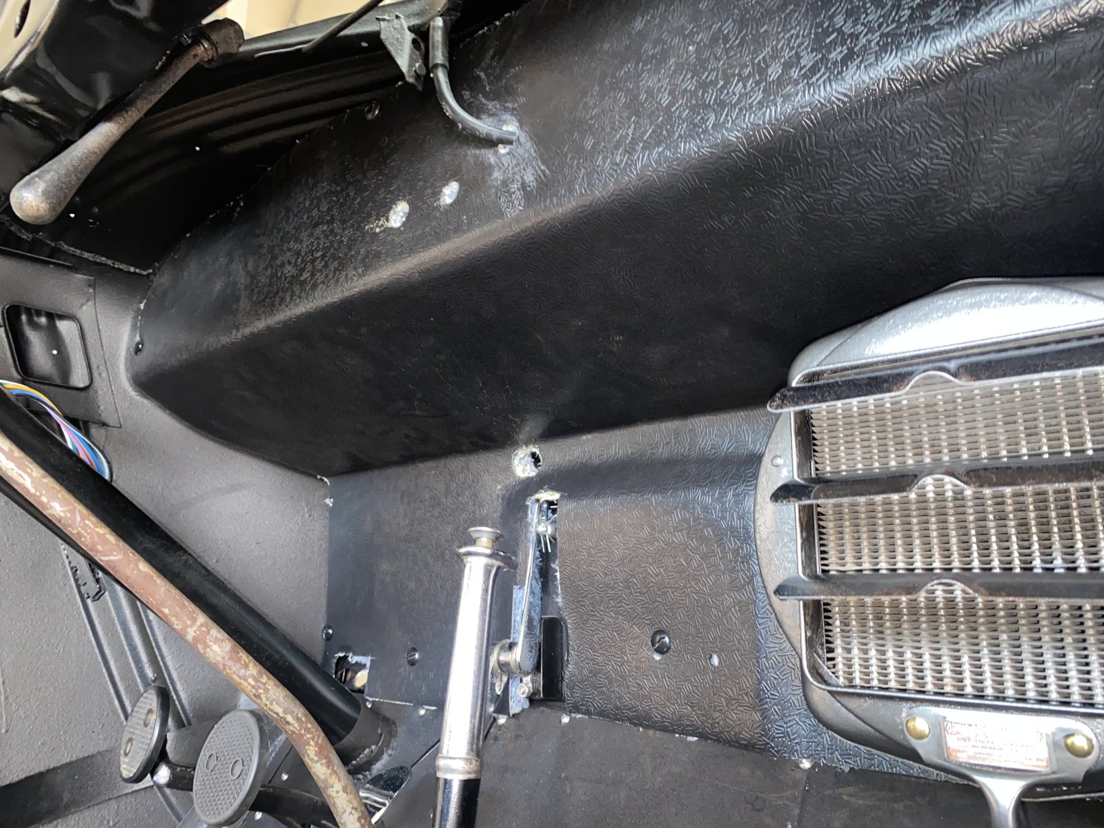

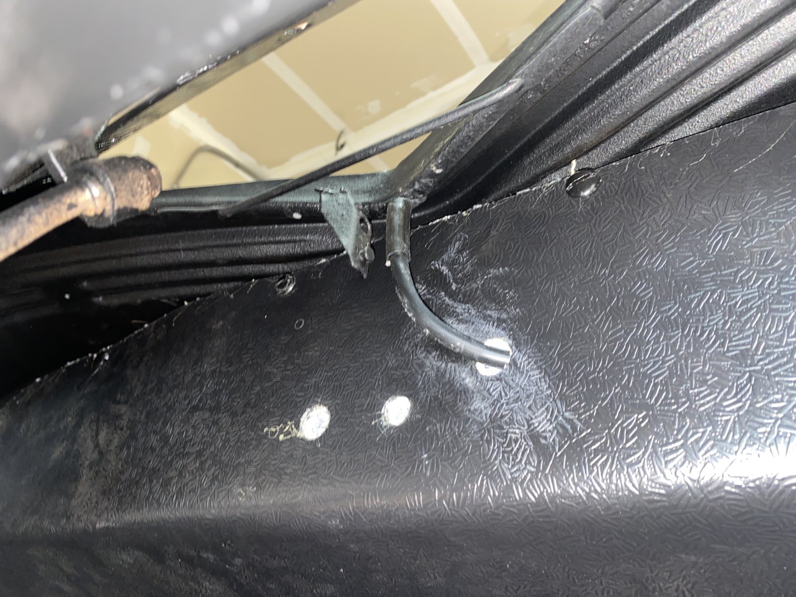

  19. loudbang
    Posts: 40,348
    I think I would pad the brown and purple wires where they meet that bracket and go downwards at a 90 degree angle. Just driving will produce vibration that could result in insulation being chaffed away resulting in a short.
    mad mikey and 33Doll like this.
  20. 33Doll
    Posts: 1,589
    33Doll
    Thanks
    I am gonna wrap the wires, and pad all the areas where they touch. just wanna make sure everything works first and in case I have to reroute a few things, which I’ve already been doing a bunch of times! so it’s taking forever.
    I was trying to secure the wiring somehow underneath the cowl without drilling into the body so I use the little tiny holes where the Cowl lace padding screws to. To hide any attachment points from the outside seems to work just need to fine-tune it.
    mad mikey and loudbang like this.

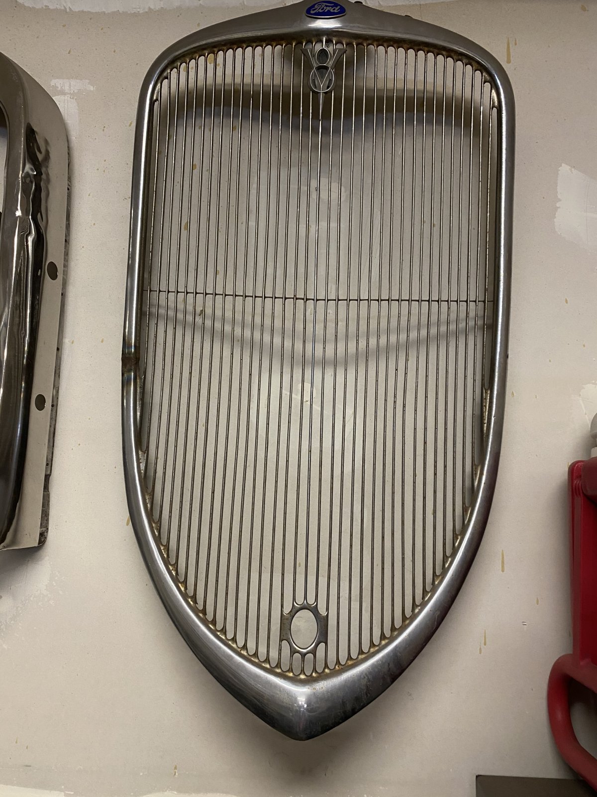

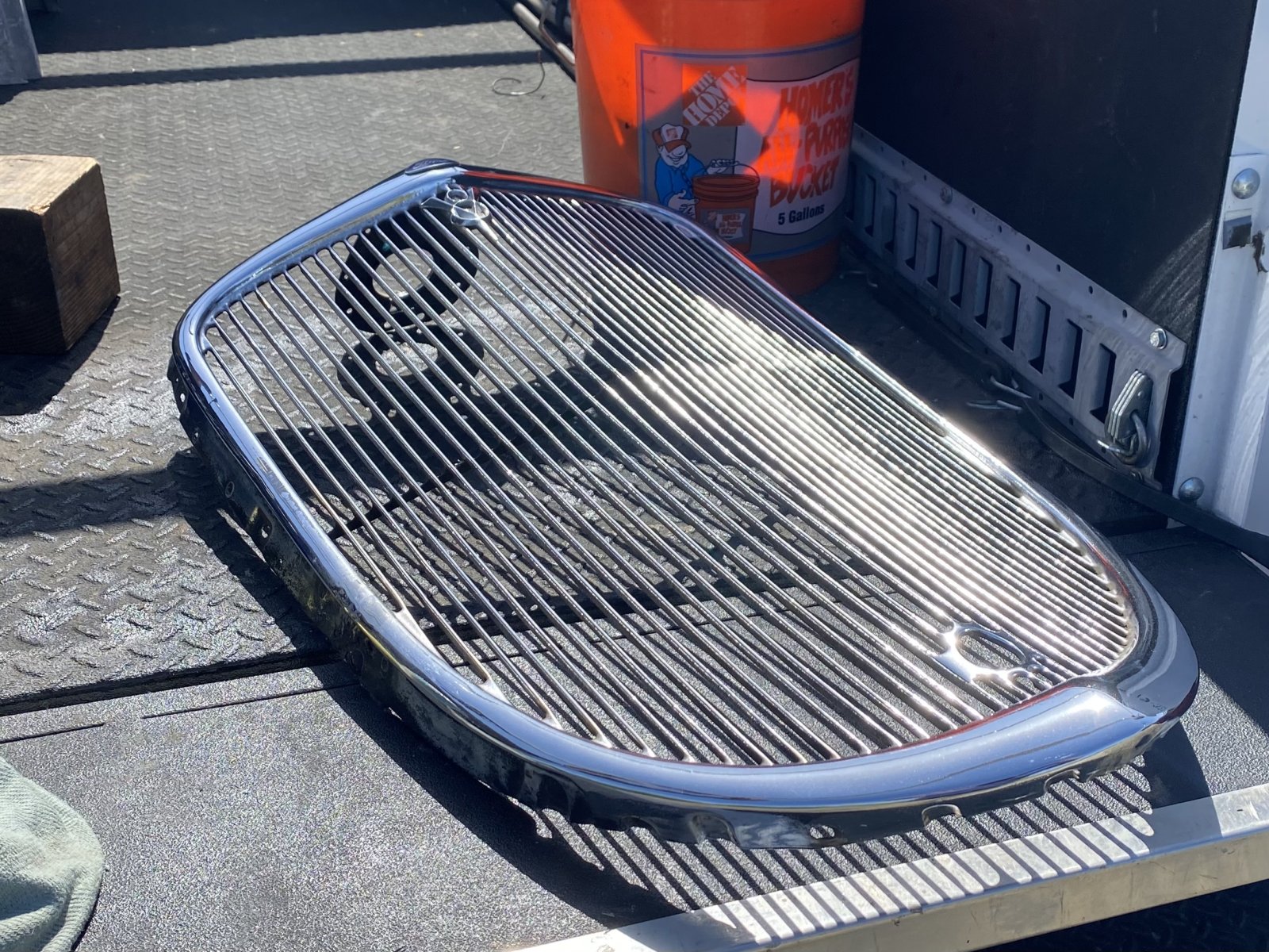

  21. 33Doll
    Posts: 1,589
    33Doll

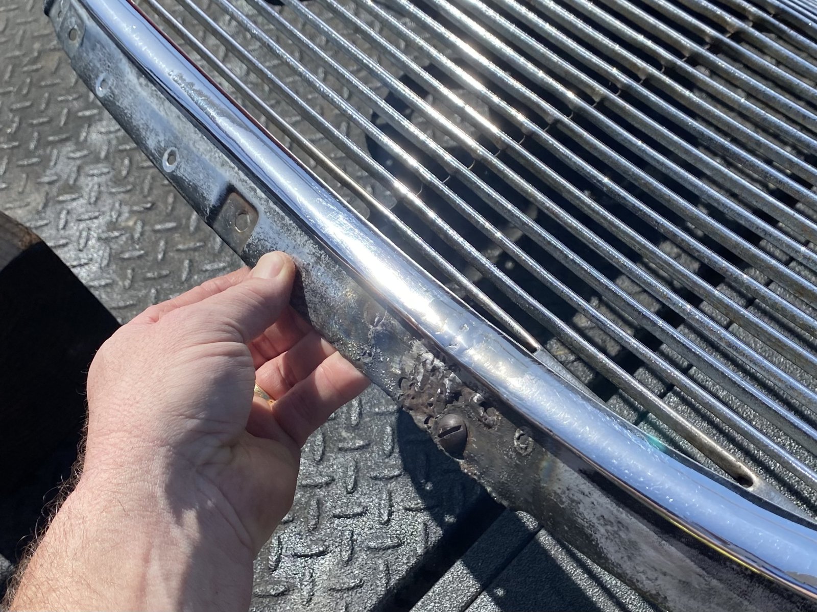

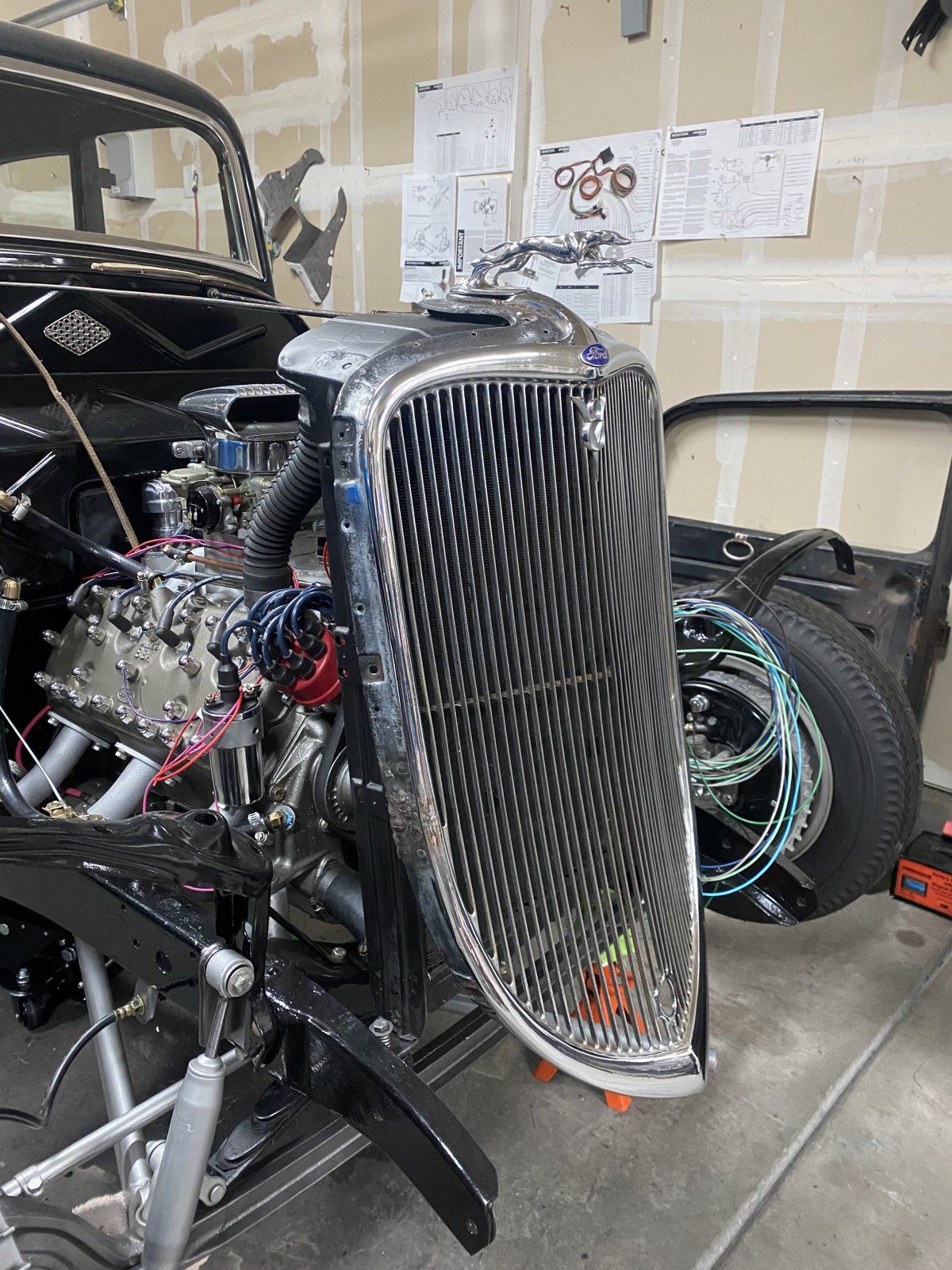

    747C06D9-C4F6-42FA-BB7F-976551DDDADC.jpeg 0824053E-61D3-4E7D-AEA7-0406E453C88A.jpeg 59FAE8E6-AF7F-431F-8C0C-408F23E12BEF.jpeg 5686D9DB-1EBA-49C3-8D9D-5F85D370922A.jpeg 5AE1228F-93FC-4A7C-B097-8B242A5DE961.jpeg 328526F0-8ADE-414B-BB3B-6E31D6DC512E.jpeg EEBB99E6-8785-434D-BEFB-19F6BA730C4B.jpeg DB5865AA-68FE-4135-90B3-16342C97AF22.jpeg 4B161140-8E64-493B-9C80-6DF6FB4D37B6.jpeg Got bored, waiting for the oil to drain on the the big gear boxes at work. Did a little polishing while I’m waiting for the bucket fill up.

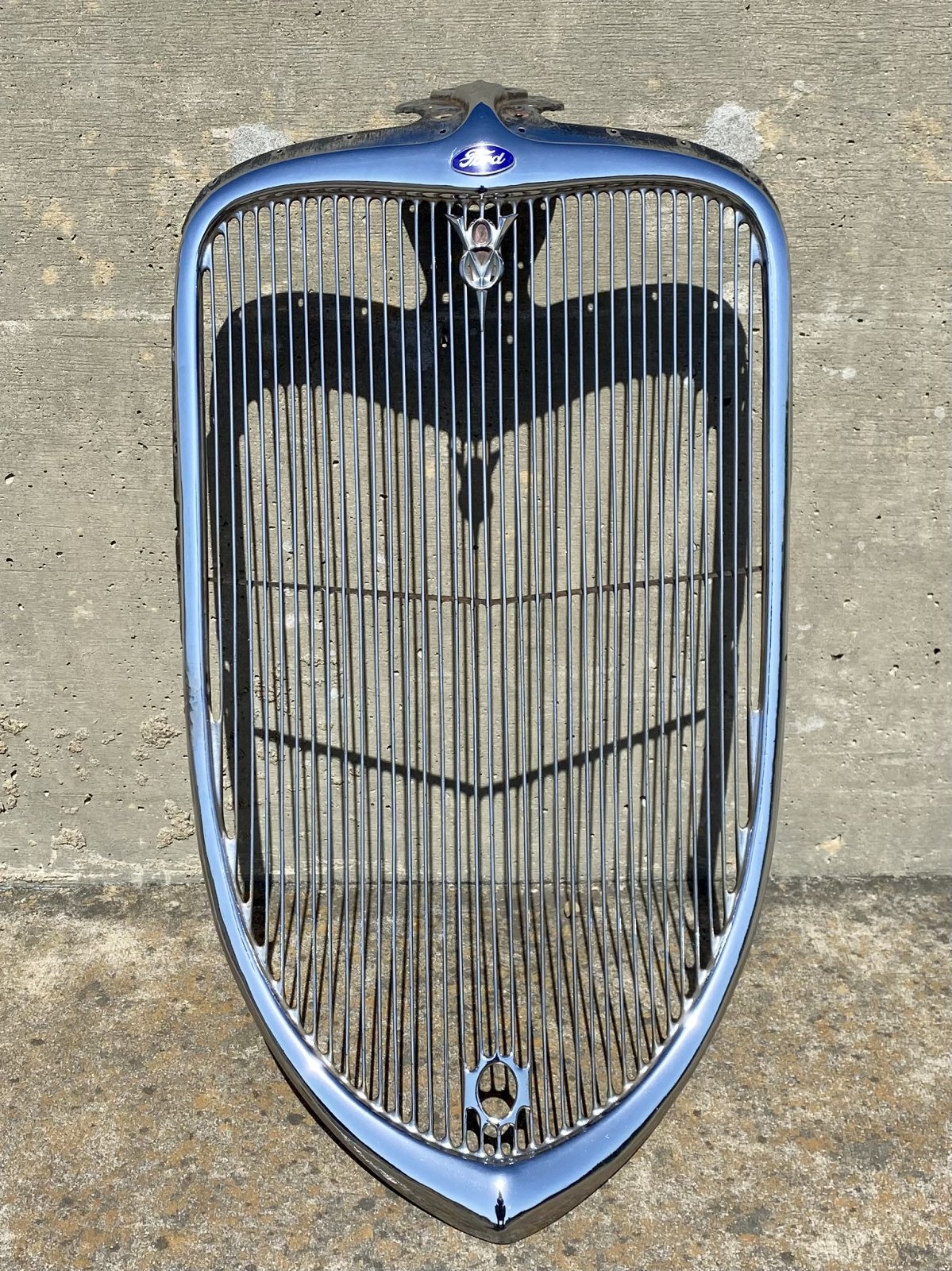

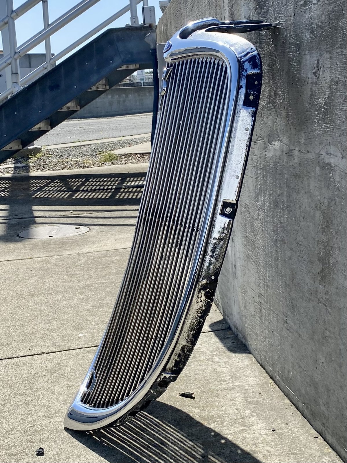

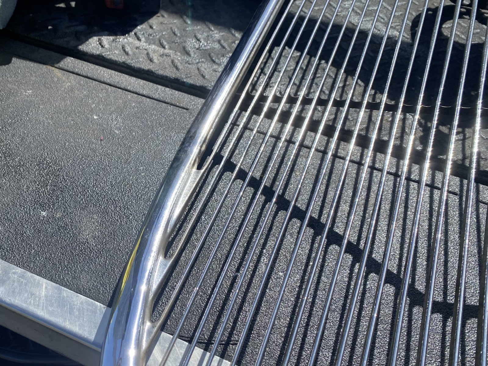

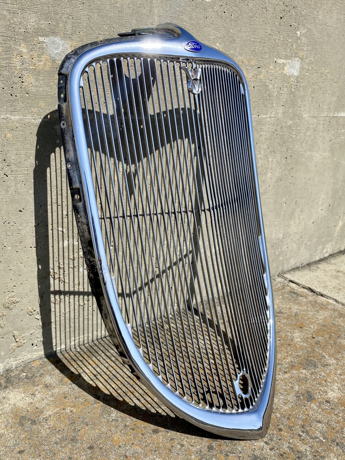

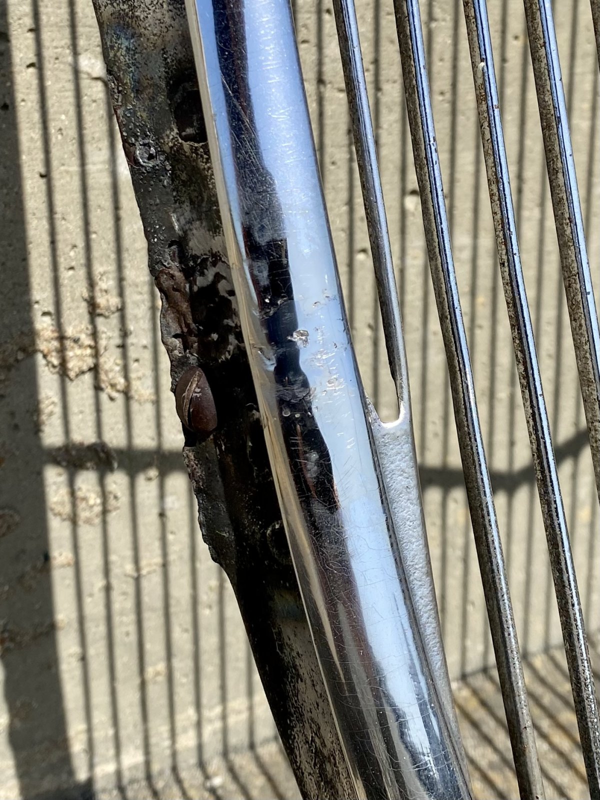

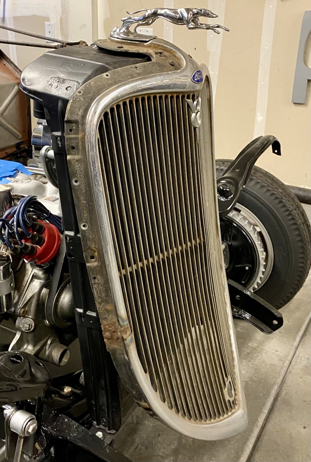

    A little before and after and working that repair my dad did. This is good as it’s gonna get! not gonna spend $2500 to get the damn thing chromed!!
    Before And after!
    Looks a 100 times better.
    Love that Meguiars Ww cleaner and flitz polish!
    The polished steel is shinier then the chrome itself!
    Worked that repair as best I could!
    Realllllyyy thin metal !
    I think it turned out awesome though hard to tell that it’s the same grill
    brEad, rod1, mad mikey and 4 others like this.
  22. flamedabone
    Joined: Aug 3, 2001
    Posts: 5,800
    flamedabone
    That grille came out fantastic!! Keep it up, you are on the downhill slide.
    -Abone.

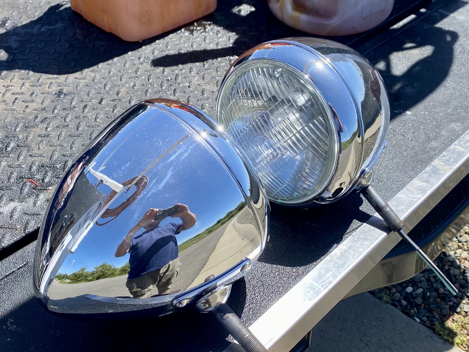

  27. 33Doll
    Posts: 1,589
    33Doll

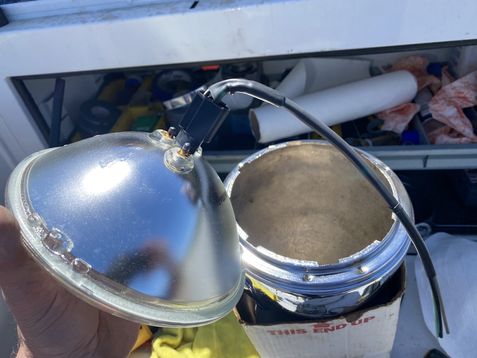

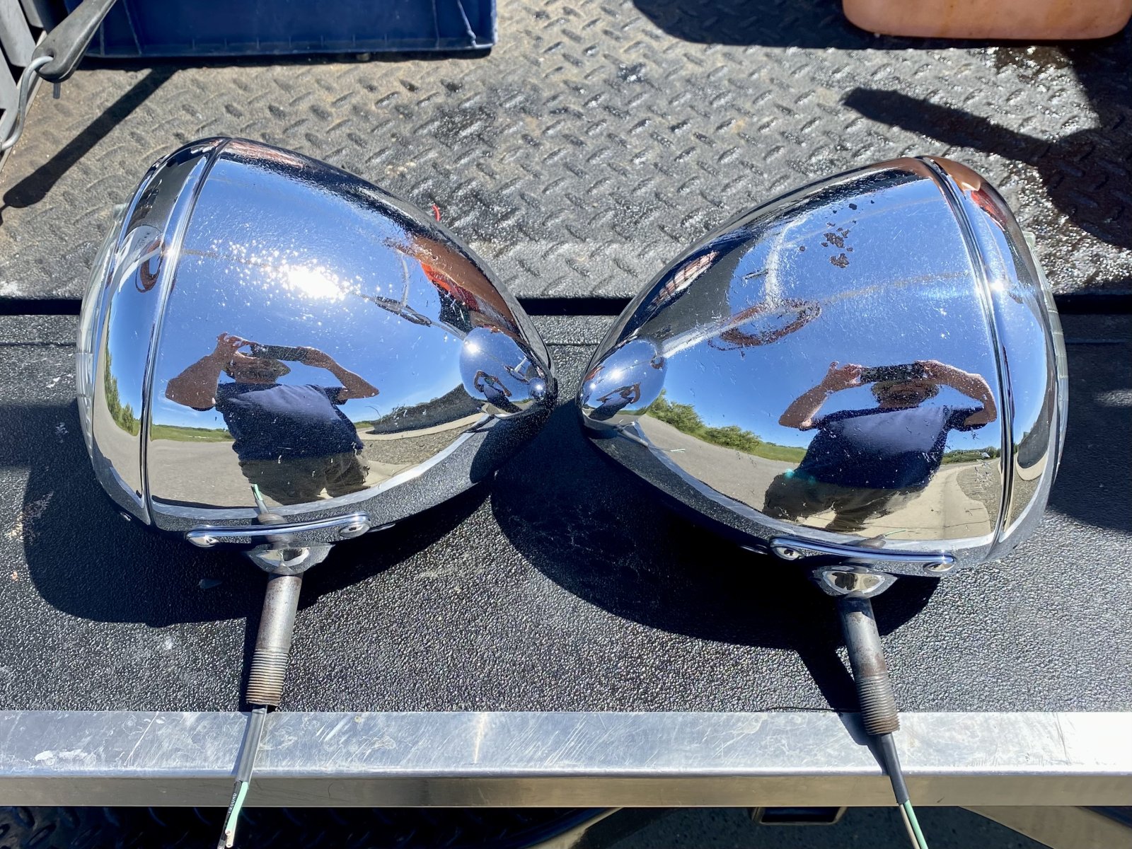

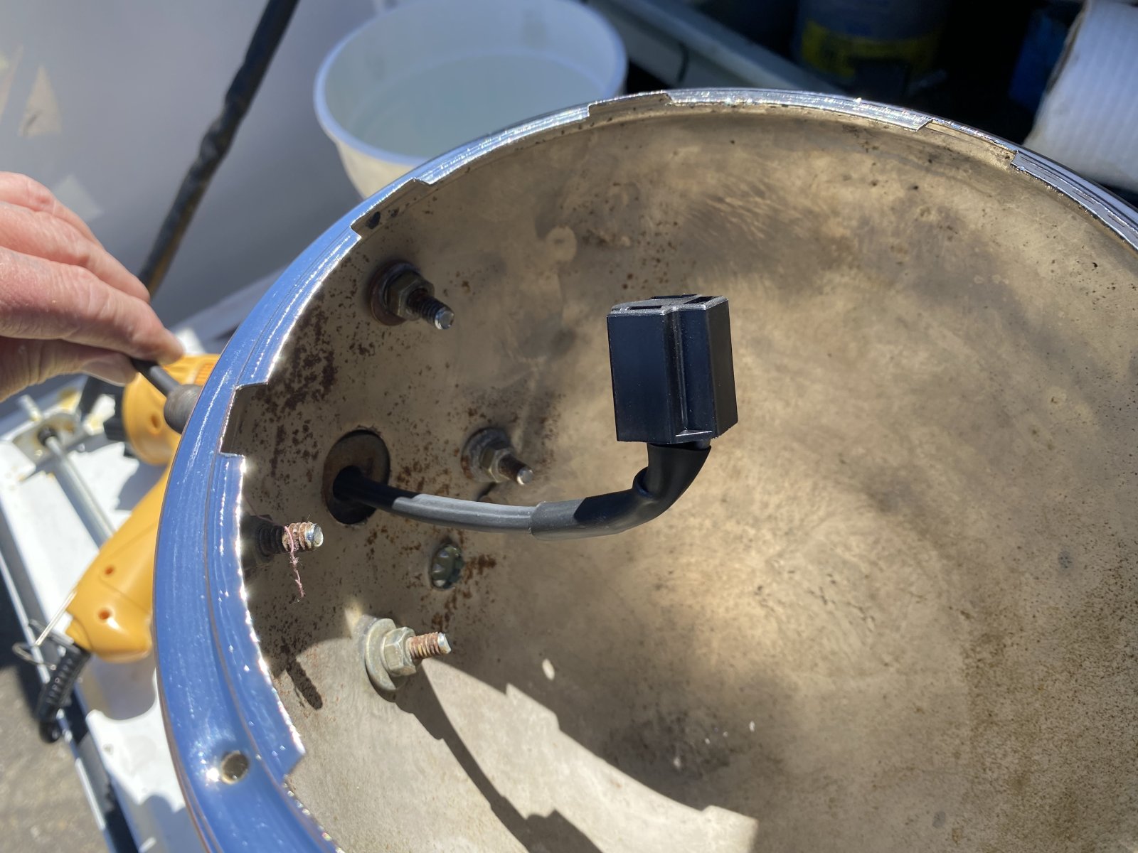

    55AA1DDC-86B9-4283-8D6E-444AB70BC1DE.jpeg D3F73BFA-6D43-4752-B1B4-754AF3030C0F.jpeg C2E77622-4CE9-49EC-876A-E40876424BFF.jpeg 3296BA30-3C91-46C7-94A8-B65FED336140.jpeg 91E345C5-C48D-4EAD-B7A7-7B9EF110F157.jpeg 56E7E35B-E2A2-4FF0-A8F2-8C7EF70B5C9A.jpeg 8D0DCAEF-15E1-4DB3-A6BD-216ADB821210.jpeg E17E90DD-D69F-49C6-92E2-BCE0DCD443E8.jpeg DBA83A8C-3034-4115-B973-58595725A05D.jpeg 14139E9C-6DAD-4609-843A-C81AD156FC64.jpeg 4D4C1658-22D8-479C-A475-5A1B790657AD.jpeg Waiting for more oil to drain out of gear boxes at work!!!

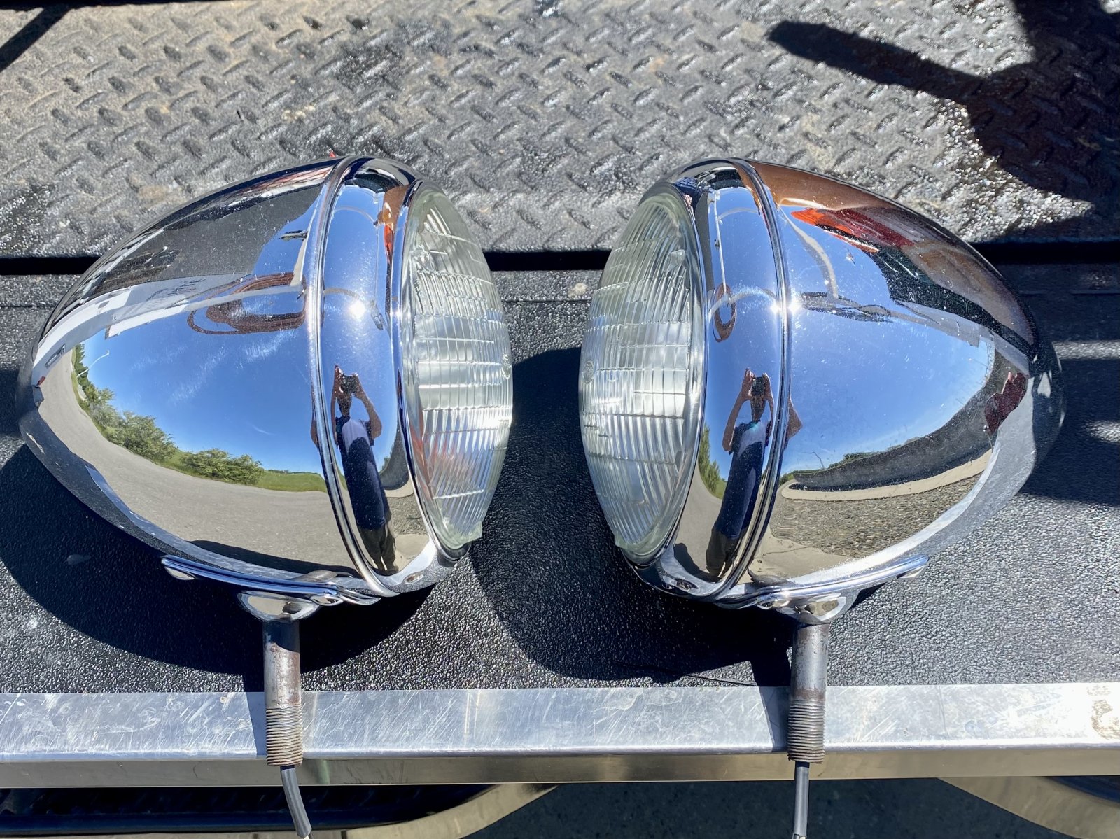

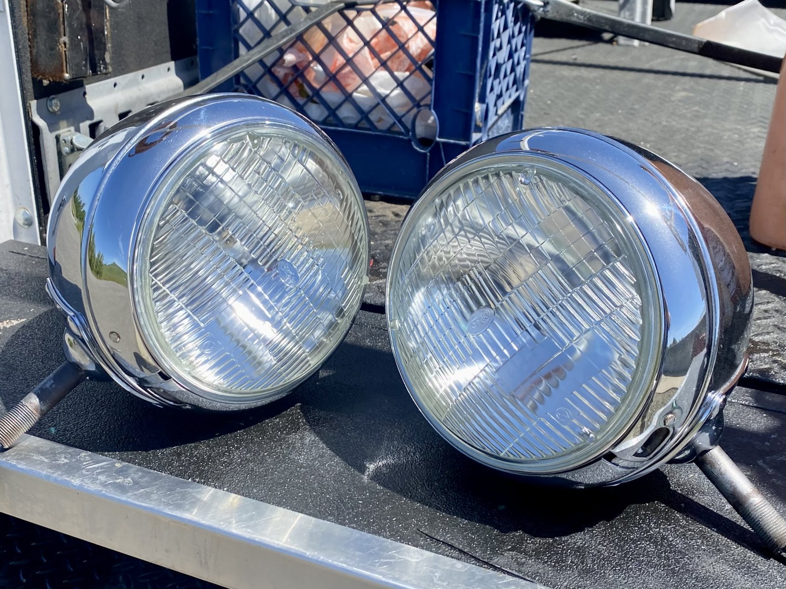

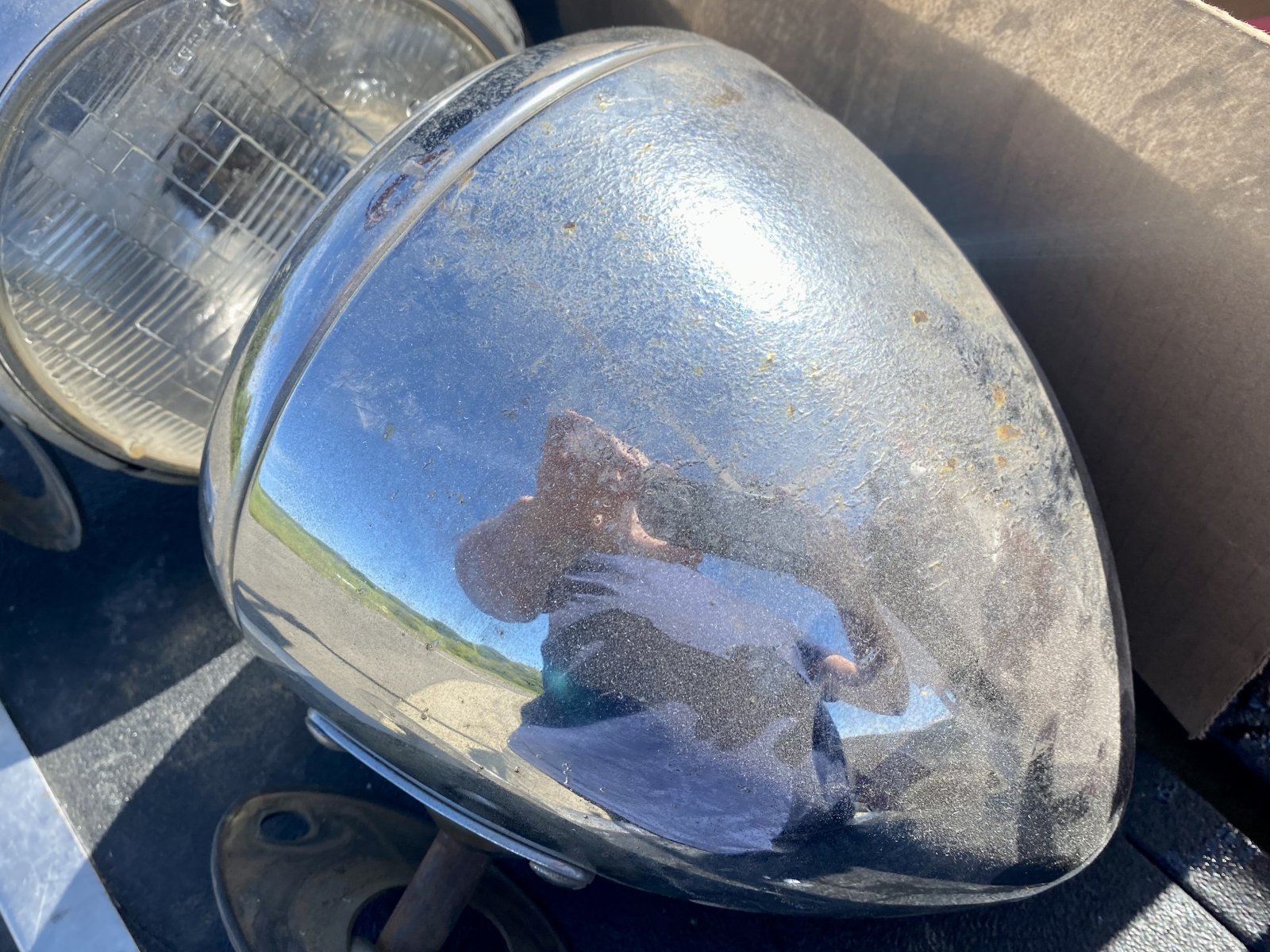

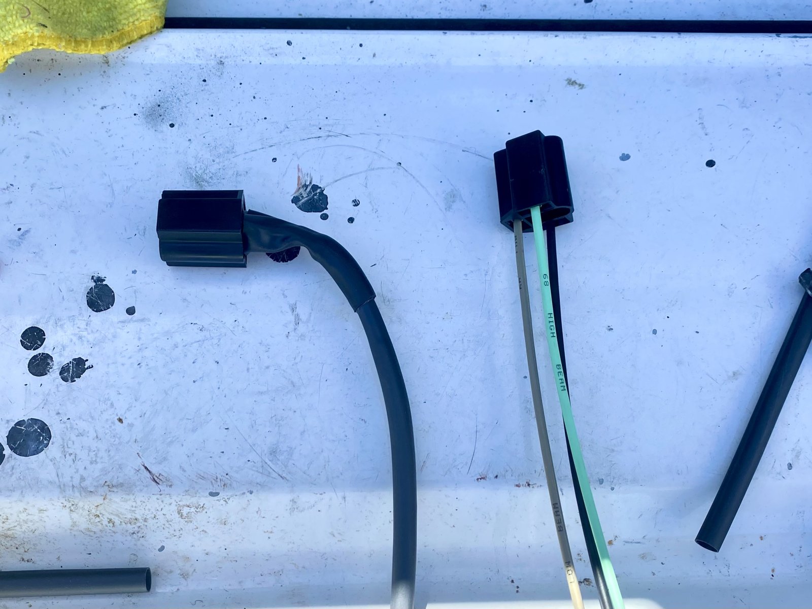

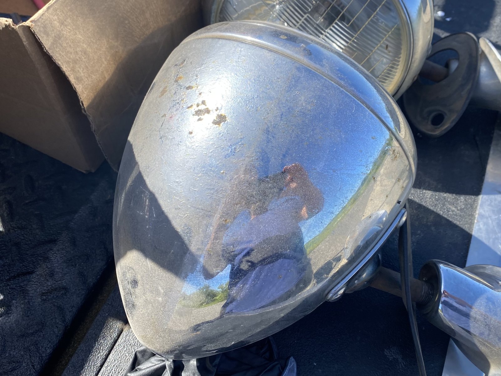

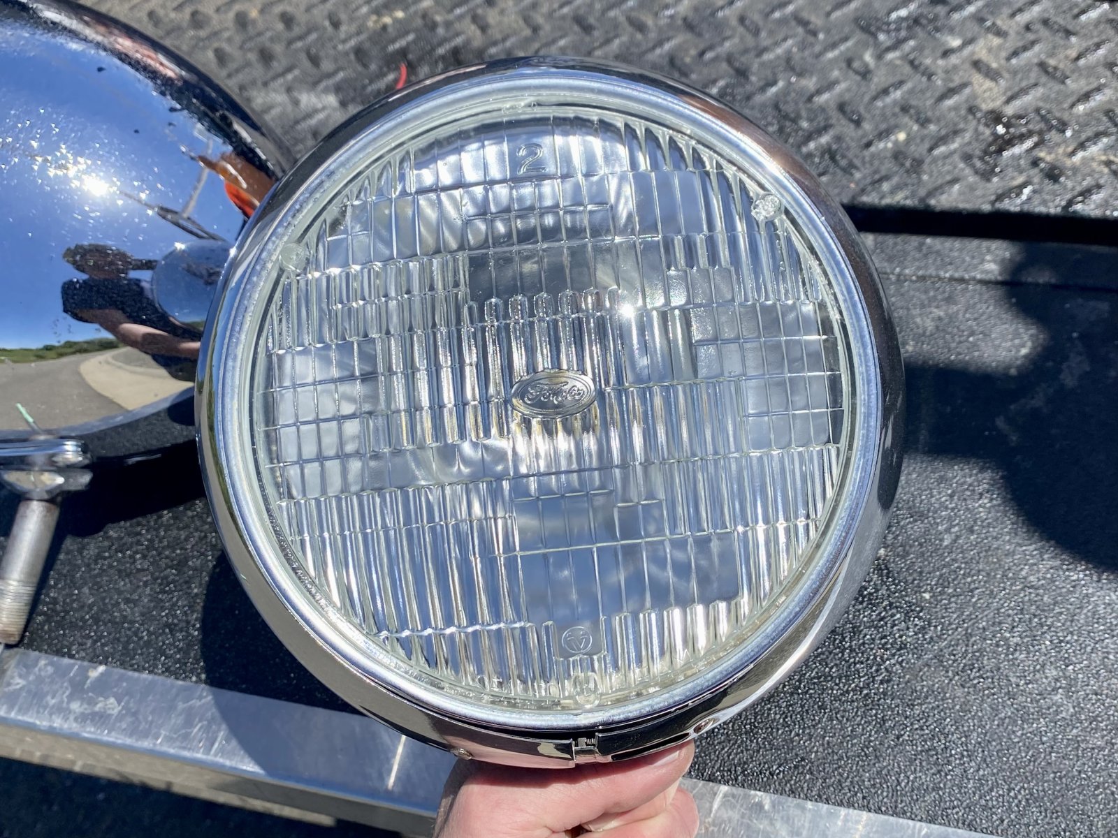

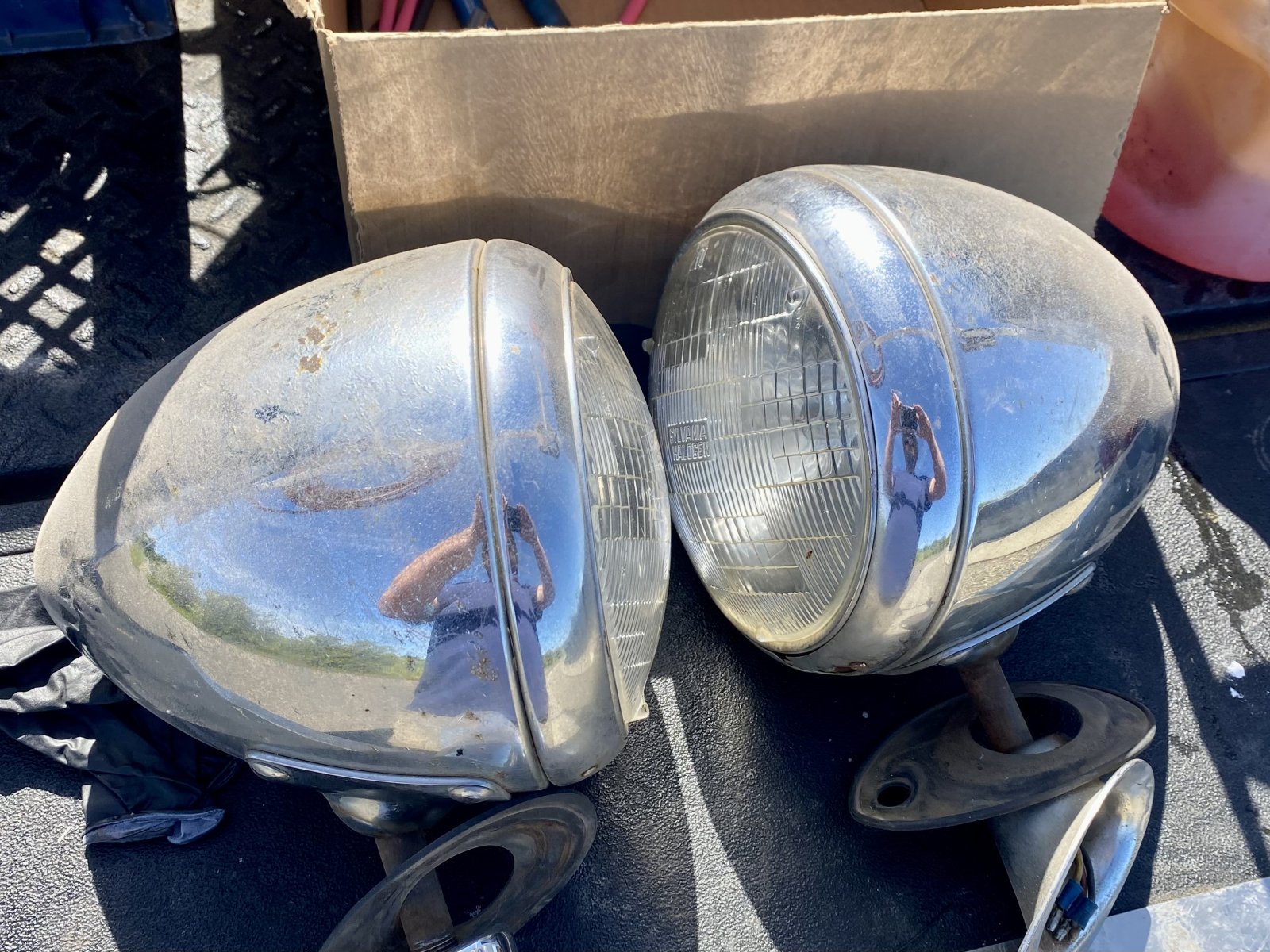

    Well… That’s about as good as those lights are gonna get!
    At least I can put the bad part of the rust towards the grill. I got some of those Scott Drake Ford script headlights to look a little bit more old school.
    And shrink tube and made the harness is really nice!

  30. 33Doll
    Posts: 1,589
    33Doll
    Thanks!
    Do you think I should just leave them alone even though the chrome isn’t that great, at least they’re shiny?
    My wife says quit worrying about all the small things. Once the car is all together in one piece, know one will notice all that stuff! They are looking at how cool it is!
