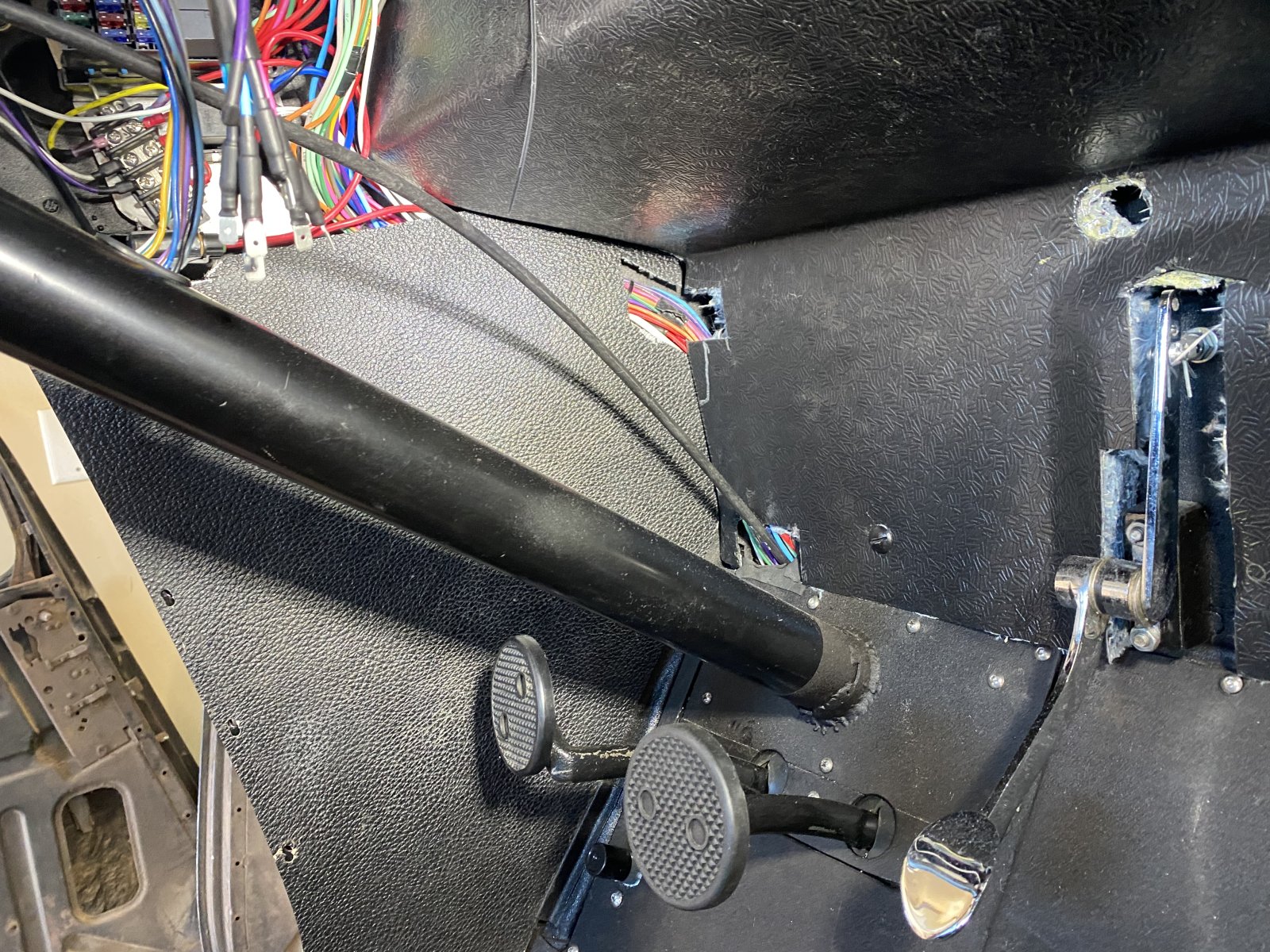

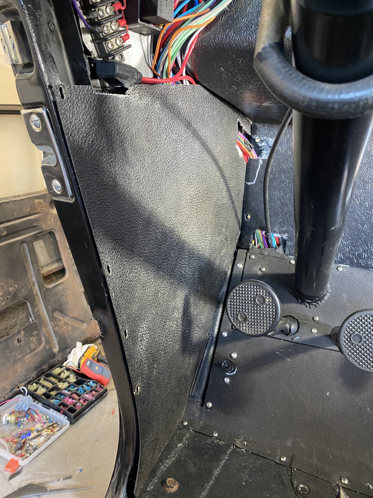

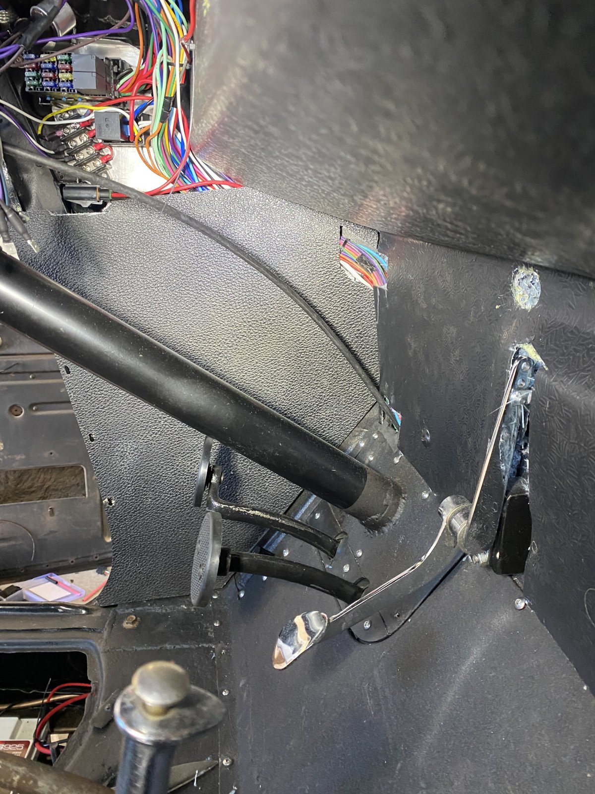

    04733BBB-A844-444D-A037-A8D7C012FE06.jpeg 646550A6-0EDF-4928-8E68-40D5A6792B05.jpeg 14D475C0-6D51-4EE2-92F9-711D1ED08B14.jpeg Got alot more done. All wires are run to the right places. Just need to finish hooking up the components.
    Got the Fan All hooked up and wired
    The fuel pump, fuel sender, brake, switch, floor dimmer, wires run to where all the lights go. I also modified the kick panel so I should be able to hide the wires pretty good make some kind of cover for the cut out areas. I have two sets of panels, so maybe I can use the heat gun to tweak some pieces.
    I think what I’ll do….when I make sure everything works, is cut the zip ties on the harness and try to flatten it into more of a ribbon style then it might fit better behind the panel.
    Engine is next, baby!!!
    Did I mention…” THIS WIRING BUSINESS TAKES FOR-EVER”!!!!!

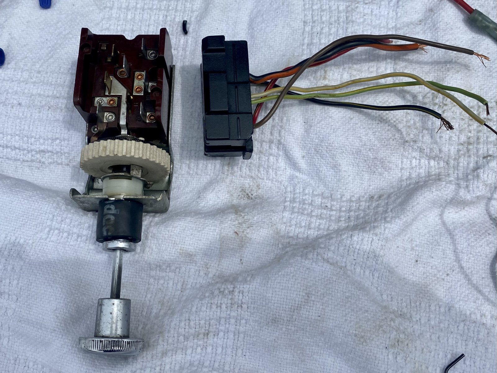

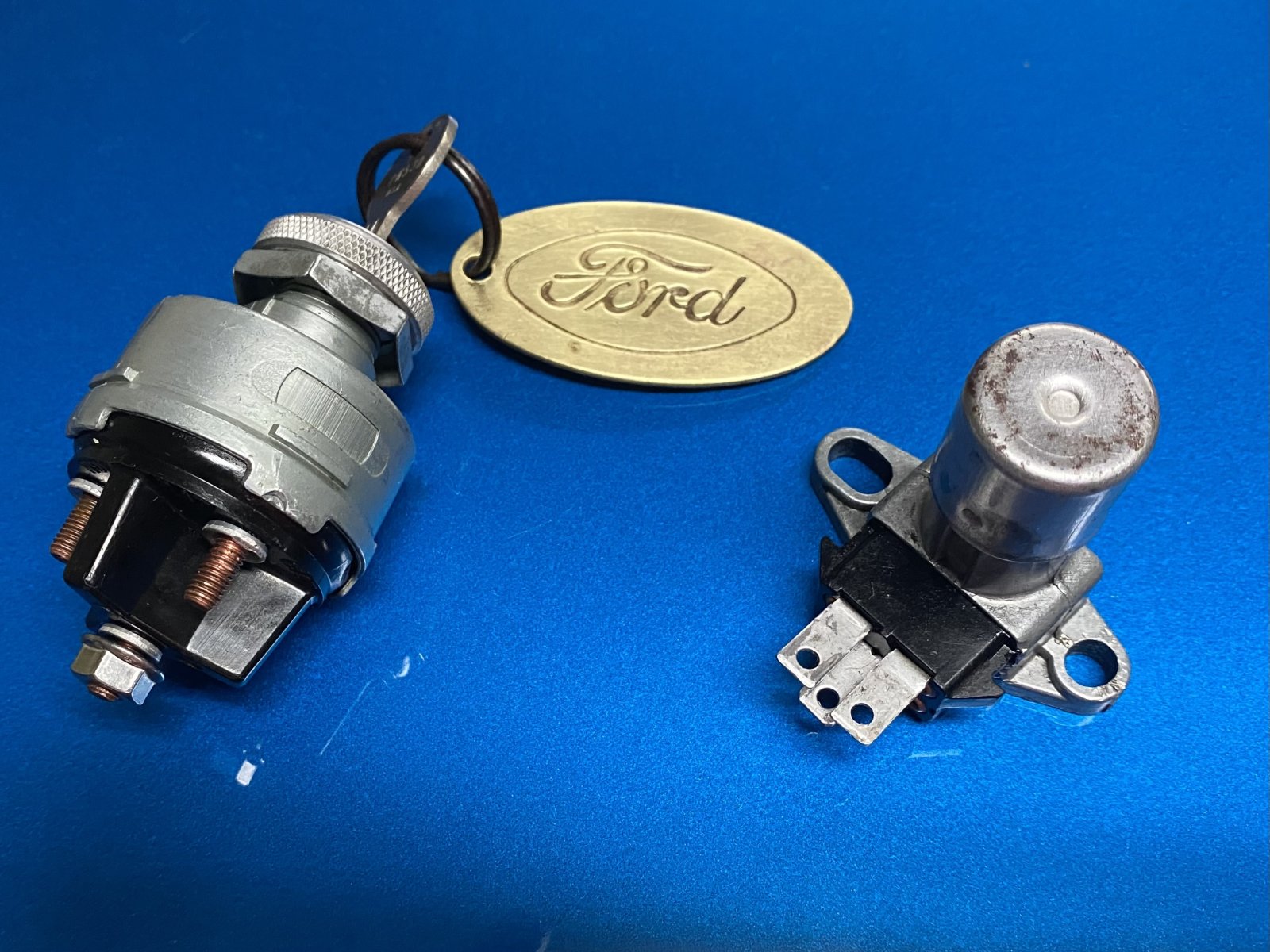

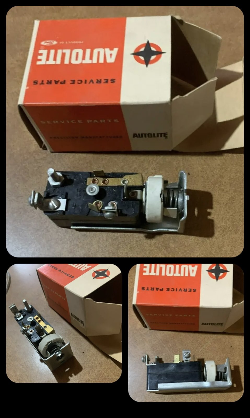

    F4412E6F-885C-4C1E-B05E-96B256D643F2.jpeg 61738D8E-41D2-4FBF-A82E-2E67E35C833A.jpeg C64B15BA-94B1-4267-8386-021B9CE166EA.jpeg D842C136-DF82-429B-8187-1851810EF60A.jpeg So I like speedways parts for the most part, but they’re Chinese knock off ignition, headlight, floor dimmer switches of any kind are pieces of ****!!! The key falls out of the ignition switch and hangs up when you try to put it in positions! The floor dimmer switch plug came completely out of the body cause it wasn’t crimped properly. Tried to fix it but it that pot metal likes to break.!
    So I refurbish the original ones that were in the 33 and tested them. They work fine and I also bought some new old stock parts from the 50s 60s and 70s they were American made new in the box for back up.
    The headlight switch is a 57 mercury. It’s got five contacts on it which is what I need for my speedway wiring kit.

    So… I “refurbished” the 71 Ford Headlight switch that was in the 33.
    It works fine. Pulled each pin out of the plug and hooked them up to proper posts. Checked each post in there positions with my tiny computer fan and battery. So maybe it’ll last another 50 years who knows??? I ordered another switch just in case, although it was from the 57 mercury, but it should work for a backup.
    Now I have a working floor switch, ignition switch, and the light switch all original US made stuff!!! 11C2CEA8-986D-44B5-B2F8-80362B1067EE.jpeg E37AE2B5-E833-42EA-80A3-C116B570C713.jpeg EECEB1E7-680F-44D7-8075-C83AE3E63123.jpeg
    No more
    “China” Bill switches!!! The wiring harness, at least, seems like a good quality part???
    Just hope that looks aren’t deceiving!!

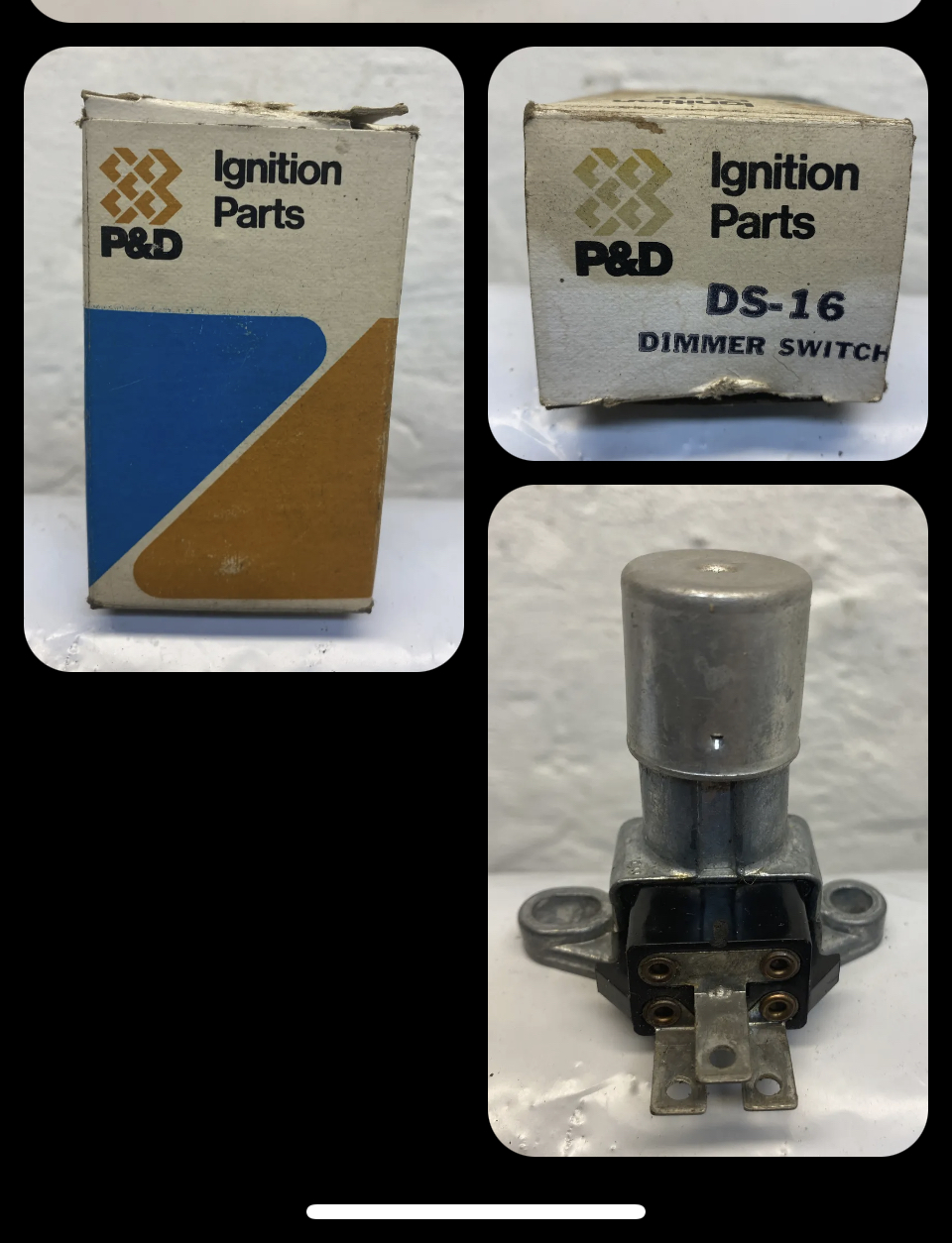

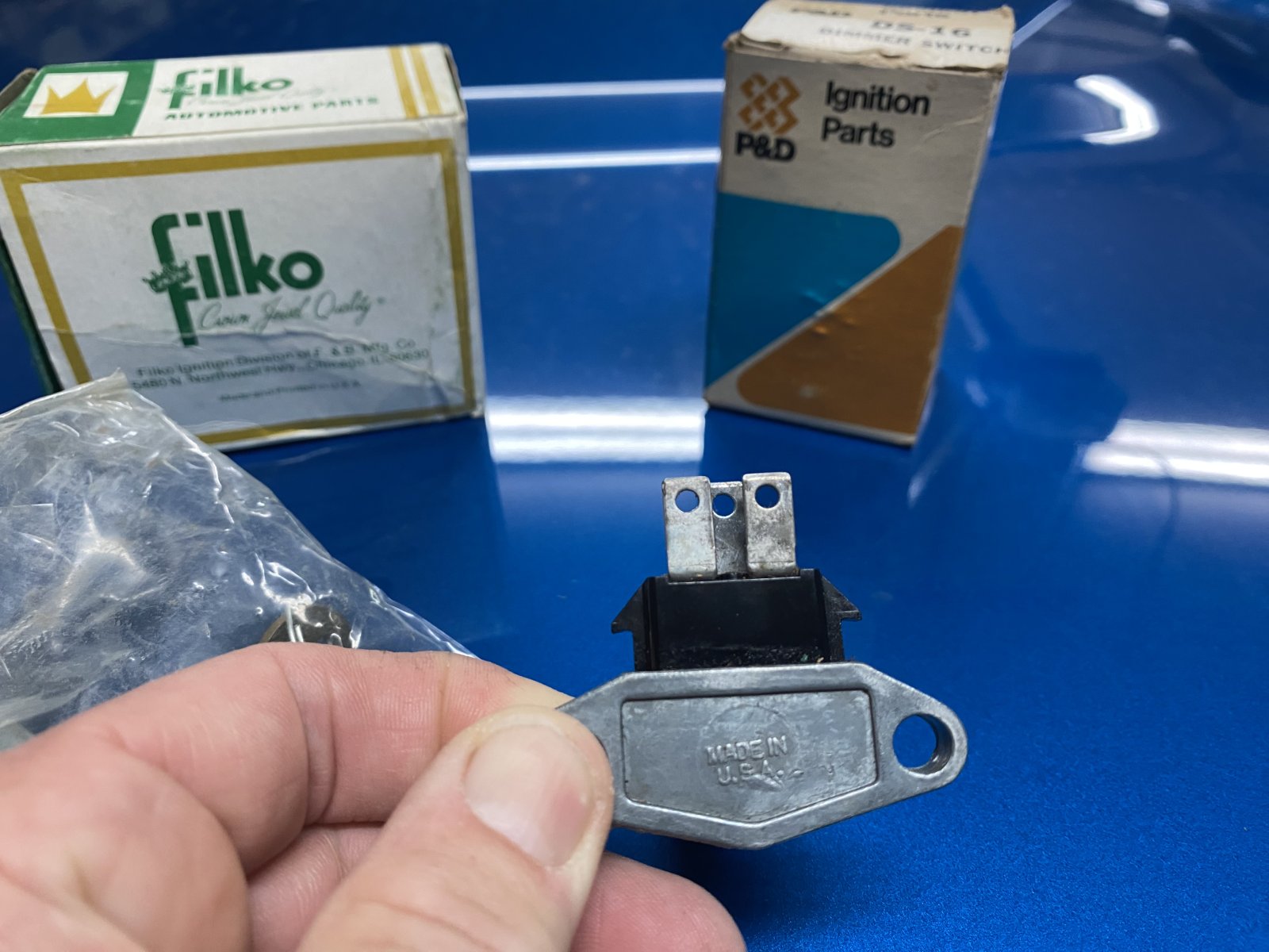

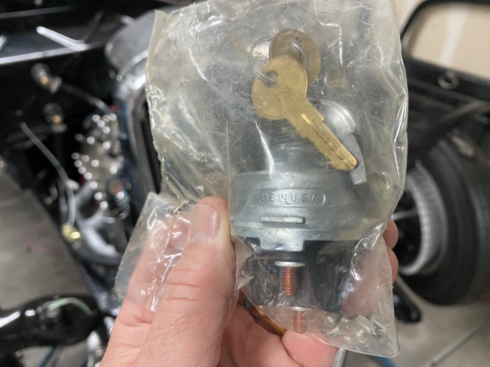

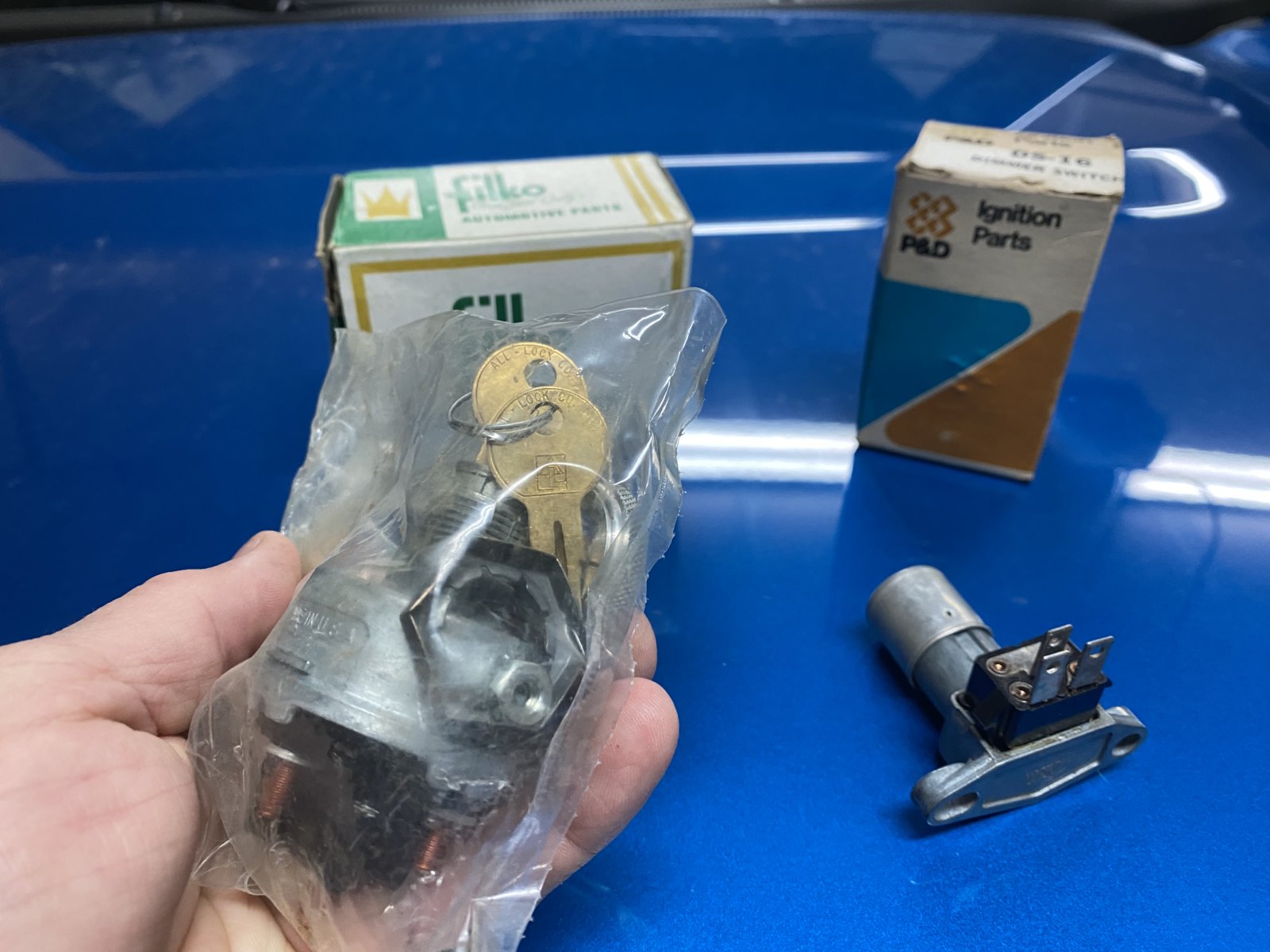

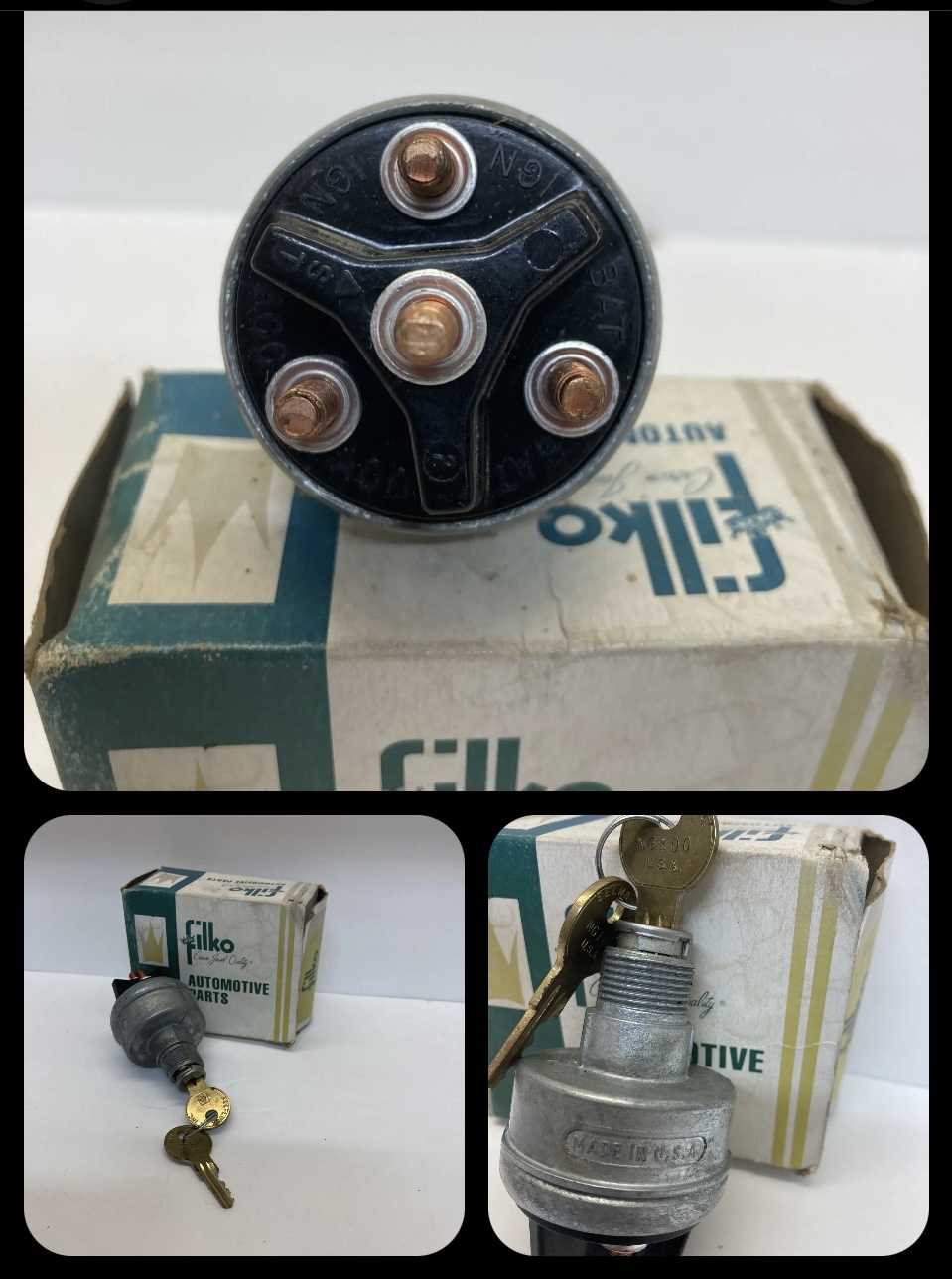

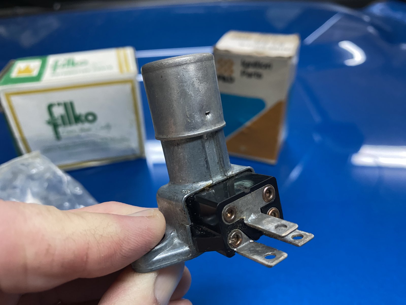

    249B4592-6688-4A24-93A2-33F1ECDB3151.jpeg 75456448-7E0A-4EDB-8A2E-C85B58F009C6.jpeg 2AA279E9-1F2F-4320-96D8-DED05C737ECC.jpeg F4AC018B-3325-4075-93B9-FC9354B676A0.jpeg I’m such a goober!!!
    I get these new NOS parts because I’m tired of Chinese stuff…. But now it’s like opening an ancient tomb…and I don’t wanna use them….but… that’s the whole reason I bought them!!!
    It’s like opening a time capsule back to when things were good!!! Instead of this ****y, post Covid world!!!
    Dang!! I actually feel a little guilty.
    I don’t know why I get so emotionally attached to these nostalgia things!
    It feels like when I separated the 33 Dolls body from the frame for the first time in its life! Sad, but exciting at the same time…

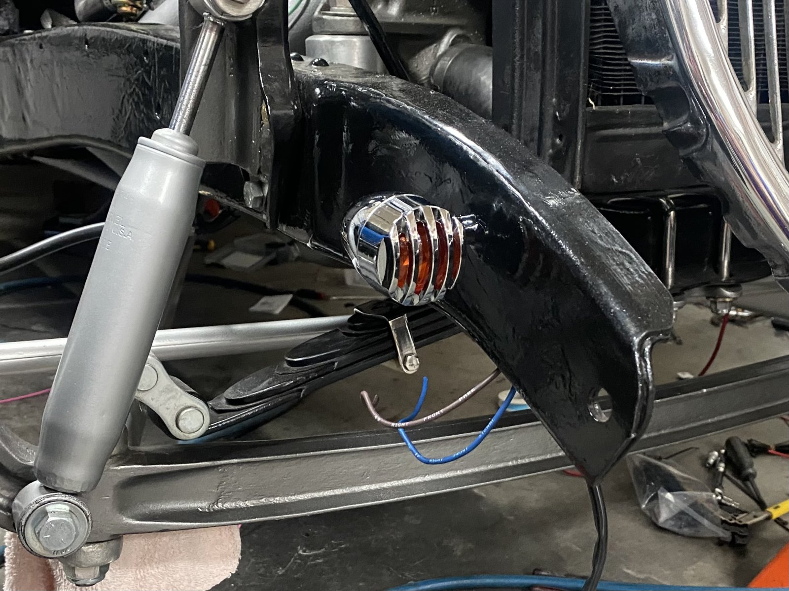

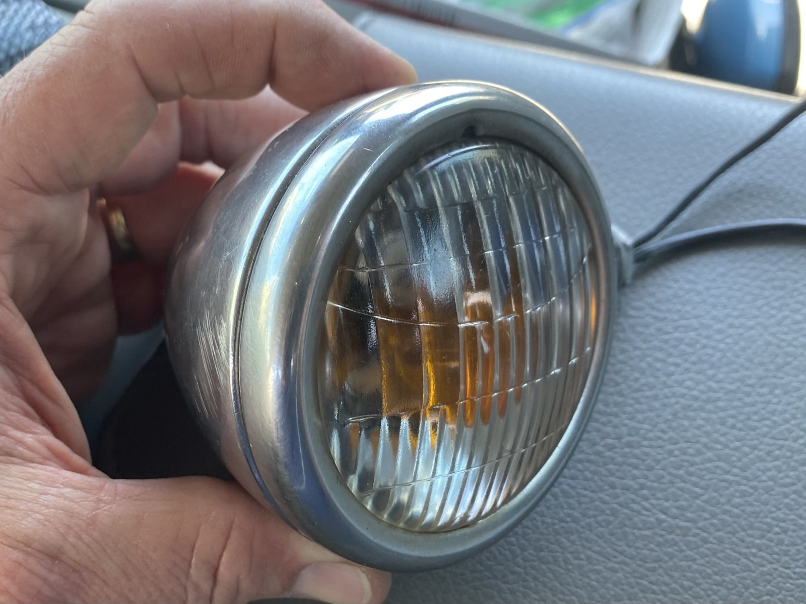

    ADC027EA-85A7-4A40-9589-40D2B804CCA5.jpeg 8582393C-BEB2-46D7-9841-D6107D4CA1E5.jpeg B3793AC3-9964-44F3-A6BE-83D15314F4B5.jpeg 234E5D54-CFAC-4108-BA66-6554B226AE74.jpeg 16778964-F0C7-4419-A57A-E496031A14AE.jpeg A3294506-7C27-449E-B3C3-3C182EDEF20F.jpeg 5B7651BE-ABD8-401B-8C84-9AAF0E4F9932.jpeg Welp!
    Got surgery on my foot Monday.
    Big toe joint locks up due to arthritis…
    So they will shave down the knob, and clean the joint up, radius the edges etc.
    Got my right foot done about 12 years ago, and it is still working pretty good so I have some relief. Will be couch, bound for two weeks and then light duty for two weeks at work so….
    won’t be touching the 33 for 2-3 weeks.

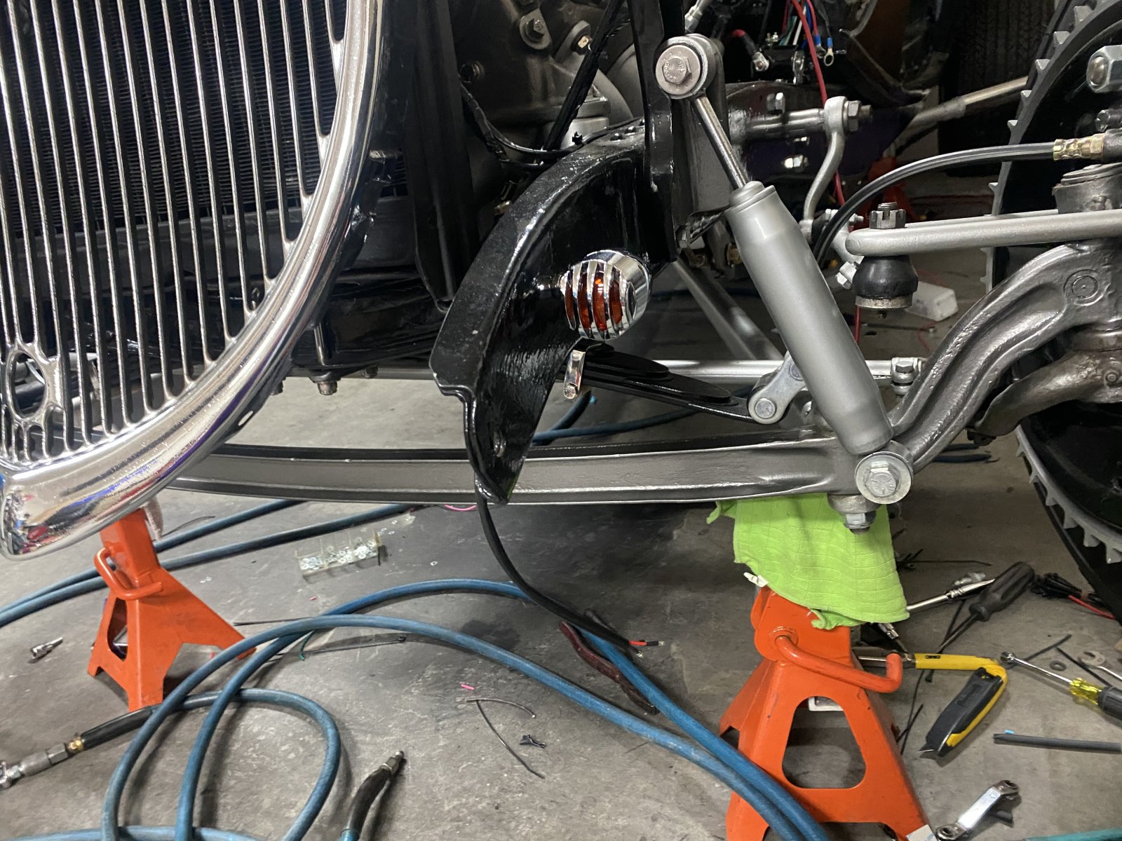

    But I’m getting prepared to put lights on temporarily so I can finish the wiring and make the plugs so when I put the fenders back on…I can plug them back in.

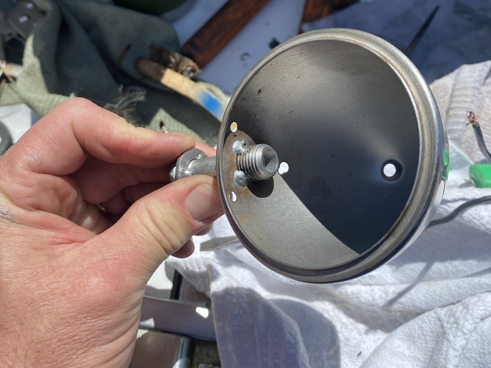

    I found a way to re-purposed the old Cowl lights I’m turning them into back up lights I will change the amber to a clear bulb, and I will put them on the side of the frame somewhere under the rear apron.
    I got these cool motorcycle turn signals for the front where the fender’s swoop up.
    I am making Nerf bars out of 37 Ford bumperettes, front and rear, so there is no bumpers to block them from being hidden underneath. It’ll look cool trust me!!!

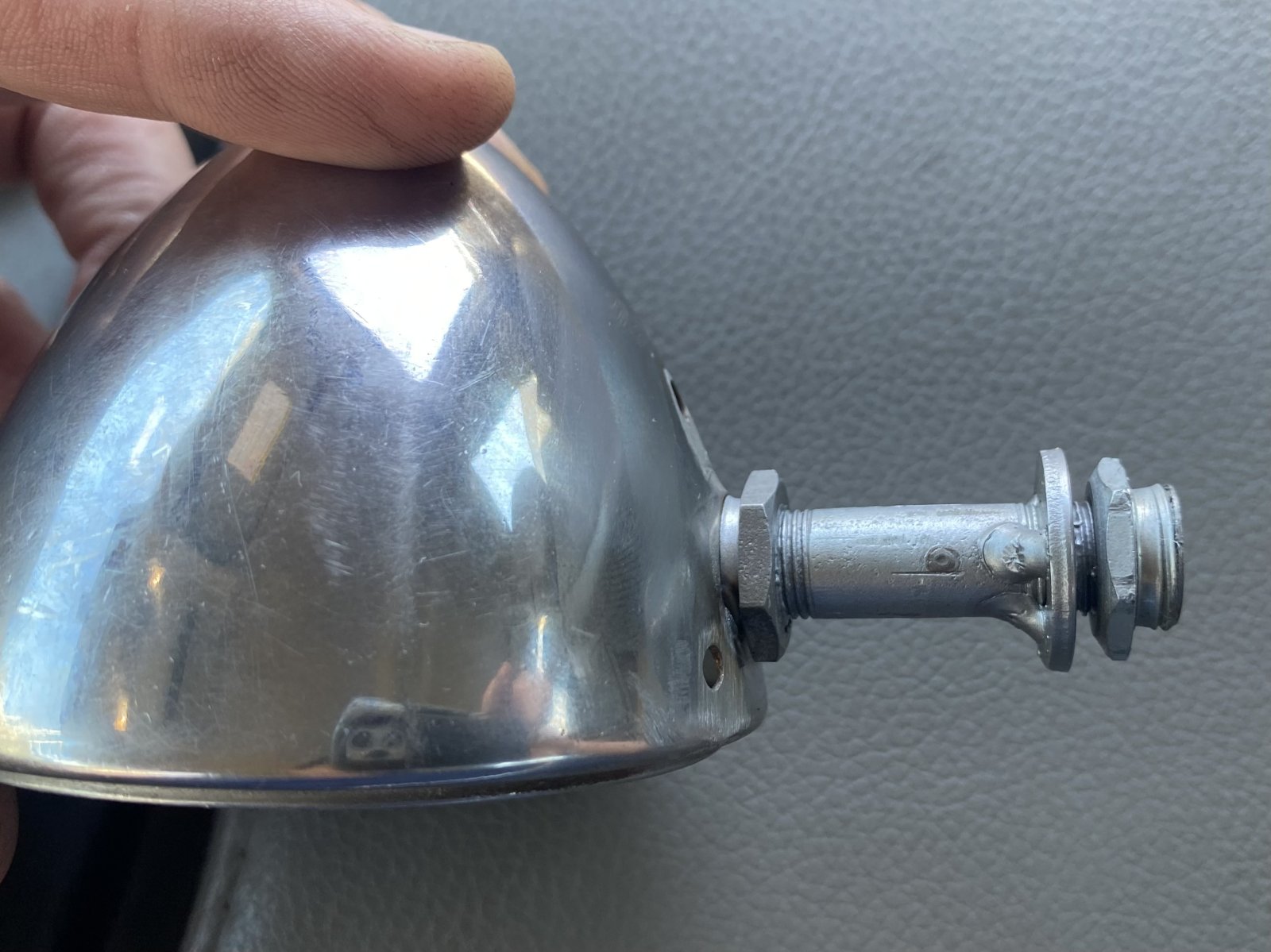

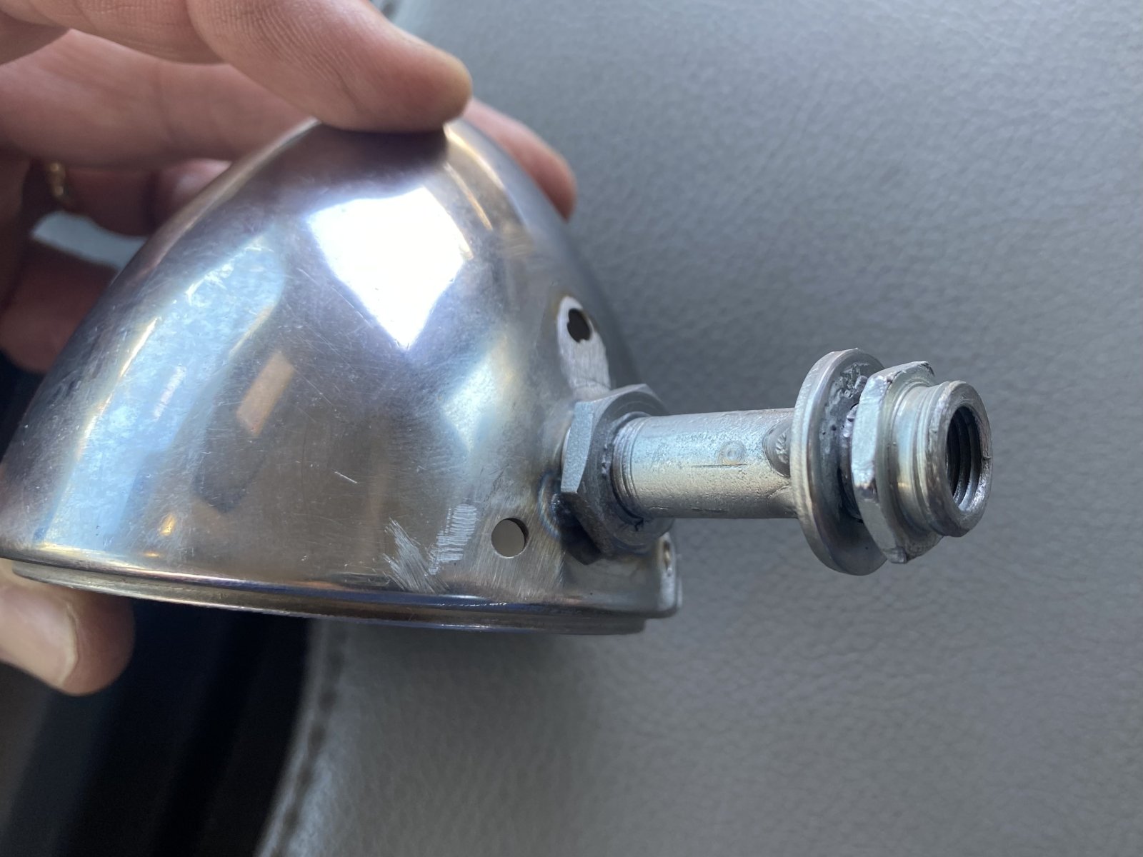

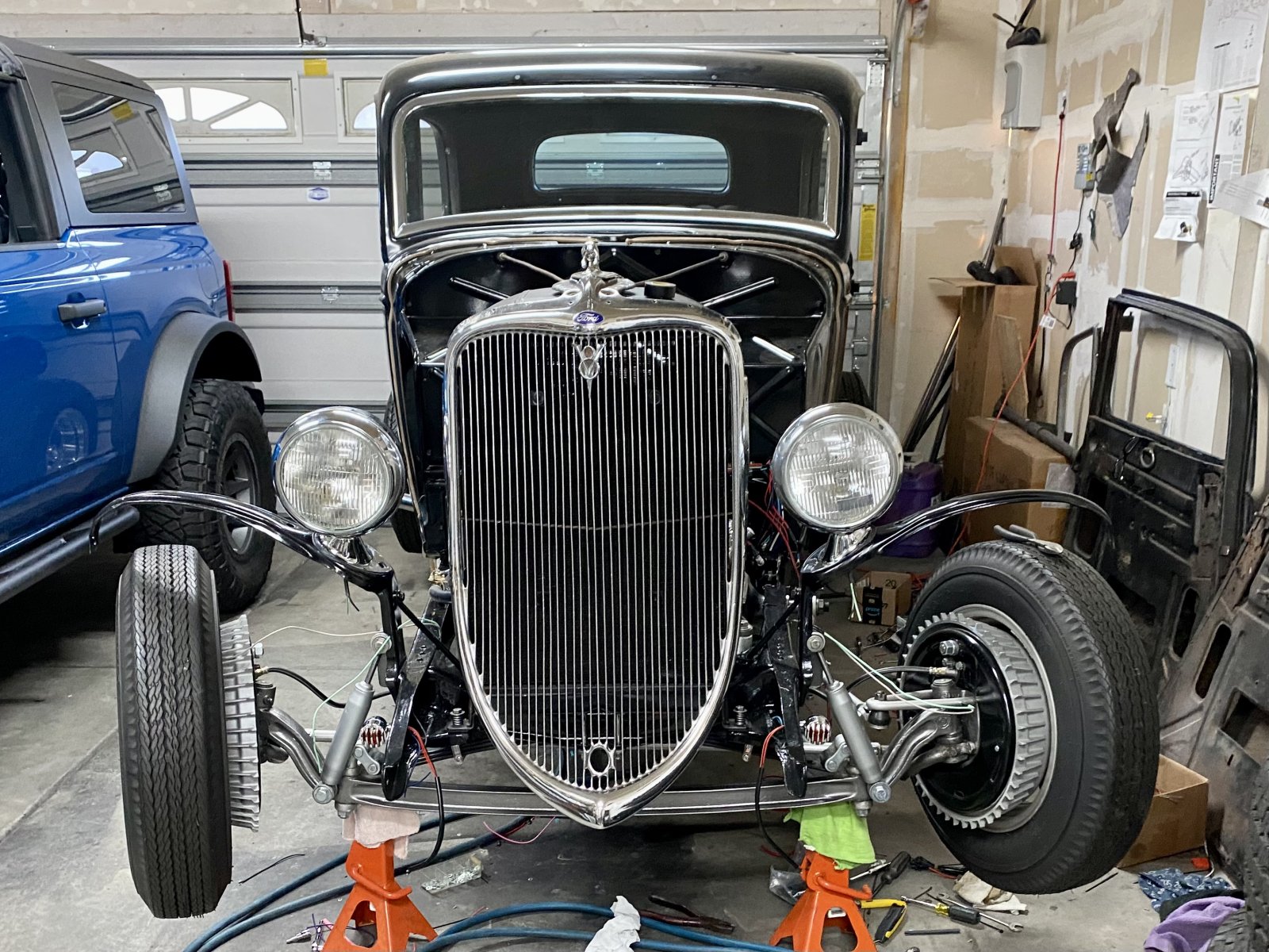

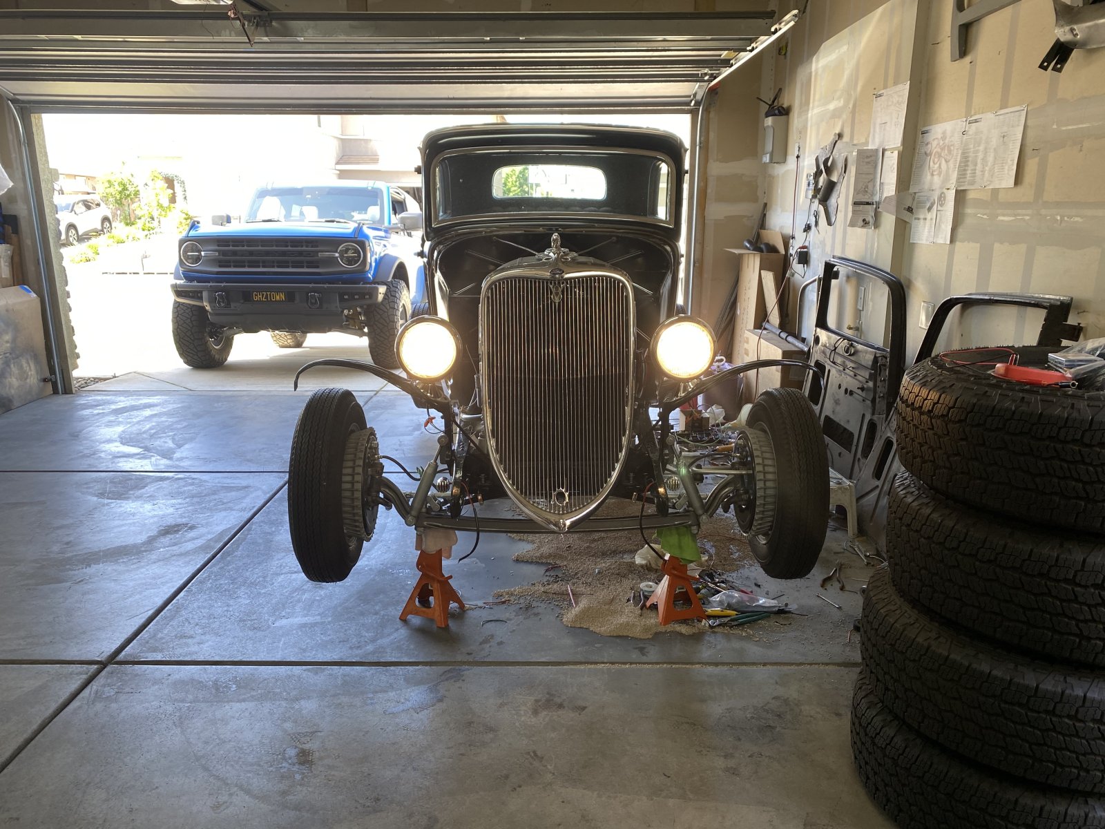

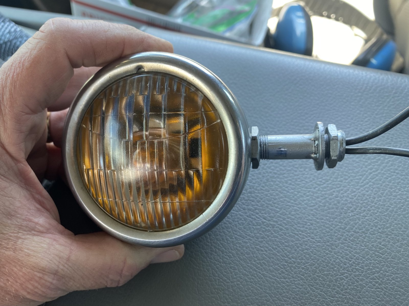

    4A67DDA9-A983-4AE3-A5A8-CC3702370ACF.jpeg 3EB69ECF-1AAC-4948-BF39-4F77131FB22D.jpeg Looks a little done-ur!
    Mocking the lights up for wiring, and plugs for quick connections.
    Some reason the chopped stands make them lean in, gonna have to modify the buckets, so I can clock the bulbs and rings straight!
    brEad, guthriesmith, Tim and 2 others like this.

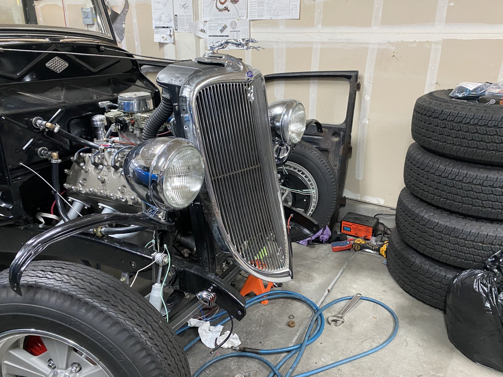

    3E2C391F-903F-4DB9-813C-41613A03D0C4.jpeg Thanks!! I dumped a qt of oil the first start! Forgot to put the extra oil sending plug in!!! But it started with a single bump of the starter! Gotta love electric ignition, and Fuel pump!
    ( sorry TROG guys! Lol!)

    The wife went to Starbucks and while she was gone, I was supposed to put the T tops on the bronco and I decided to dial in the fan on the 33.
    She came home and caught me rowing through the gears on the jackstands revving the motor lol.!!
    At least I know the clutch works the driveshaft not rubbing on anything rear end is working, brakes are working!
    And the fan holds it at 160*
    It’s 92 here today so that’s a good sign!!
    I was supposed to be doing honey-dews, and chores before my surgery tomorrow!!
    I guess I just have to stare at it for two weeks. I want to put it on the ground and drive it around the block but just don’t have the time right now.
