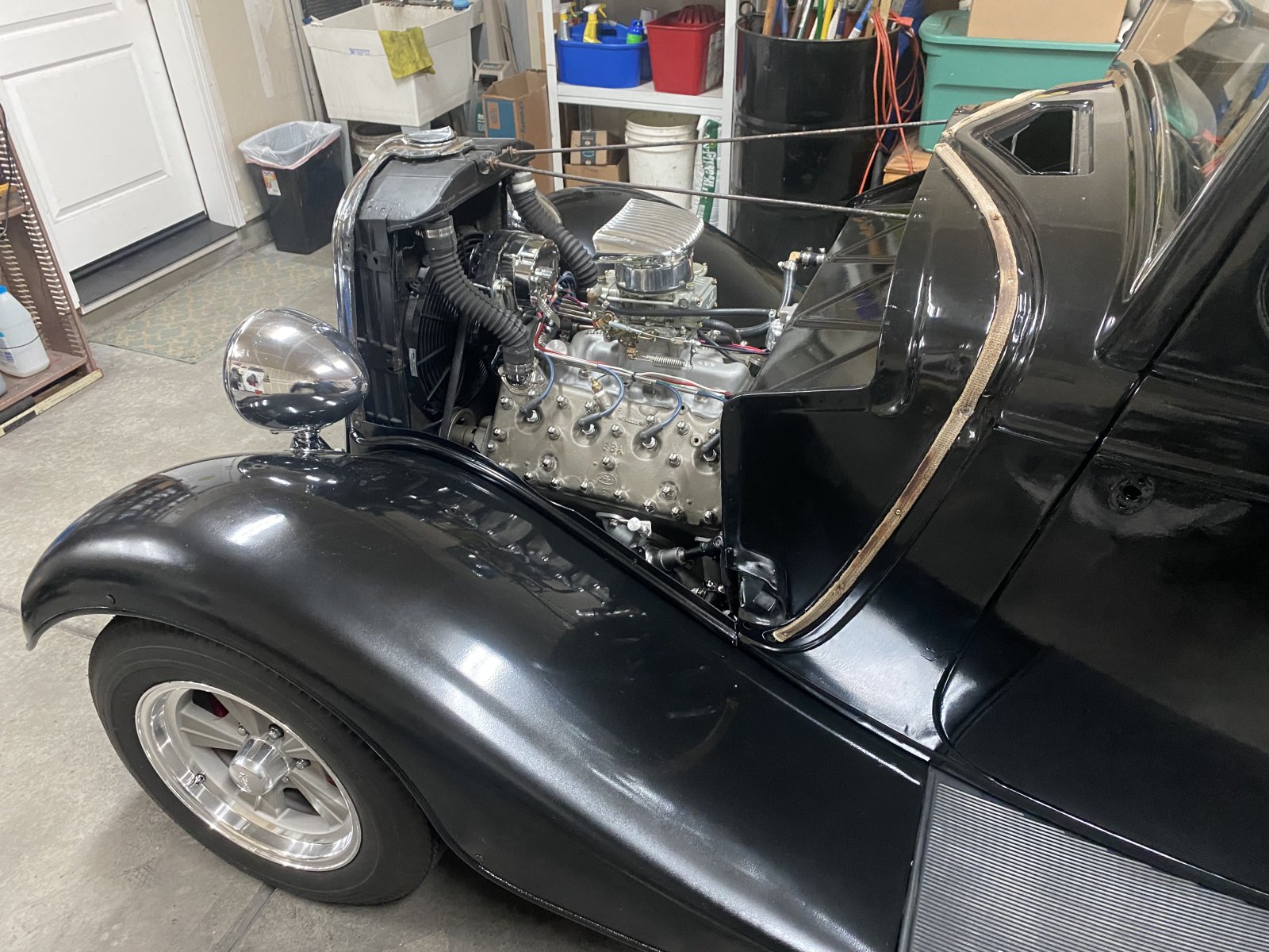

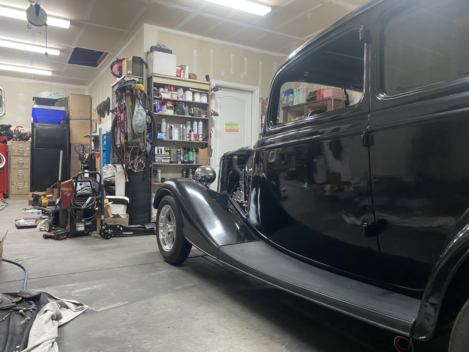

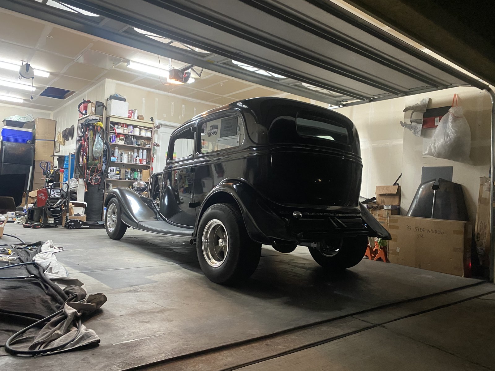

    5B4962F6-B809-4292-80A3-45890A51F4B6.jpeg 4E8BFC49-361E-4955-9BF8-480DDB50237D.jpeg 8778812B-23AE-4DB5-9827-D0B07D03B9FD.jpeg E512DA03-A12A-4027-994E-06497C0AE3BE.jpeg NAILED IT!
    perfect late 60’s Stance!
    Hello Munsters, Speedracer, and Batman!
    Barris would be Proud!
    Maybe I should just paint the fenders silver!!
    rear Poke is perfect!
    I’m almost proud…

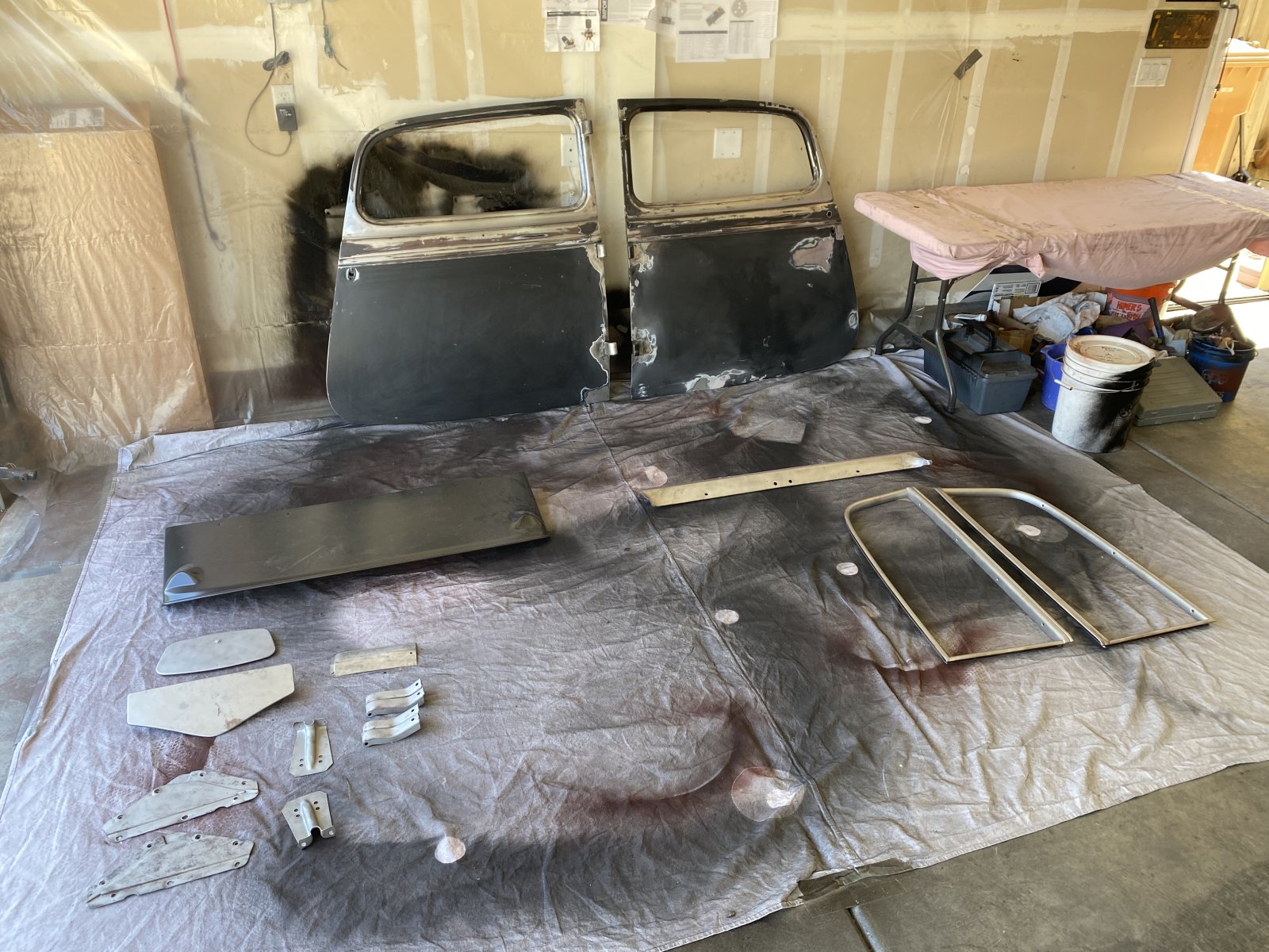

  5. 33Doll
    Joined: Sep 27, 2019
    Posts: 1,602
    33Doll

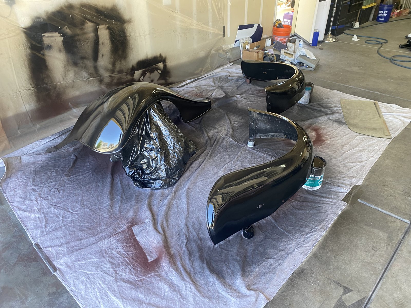

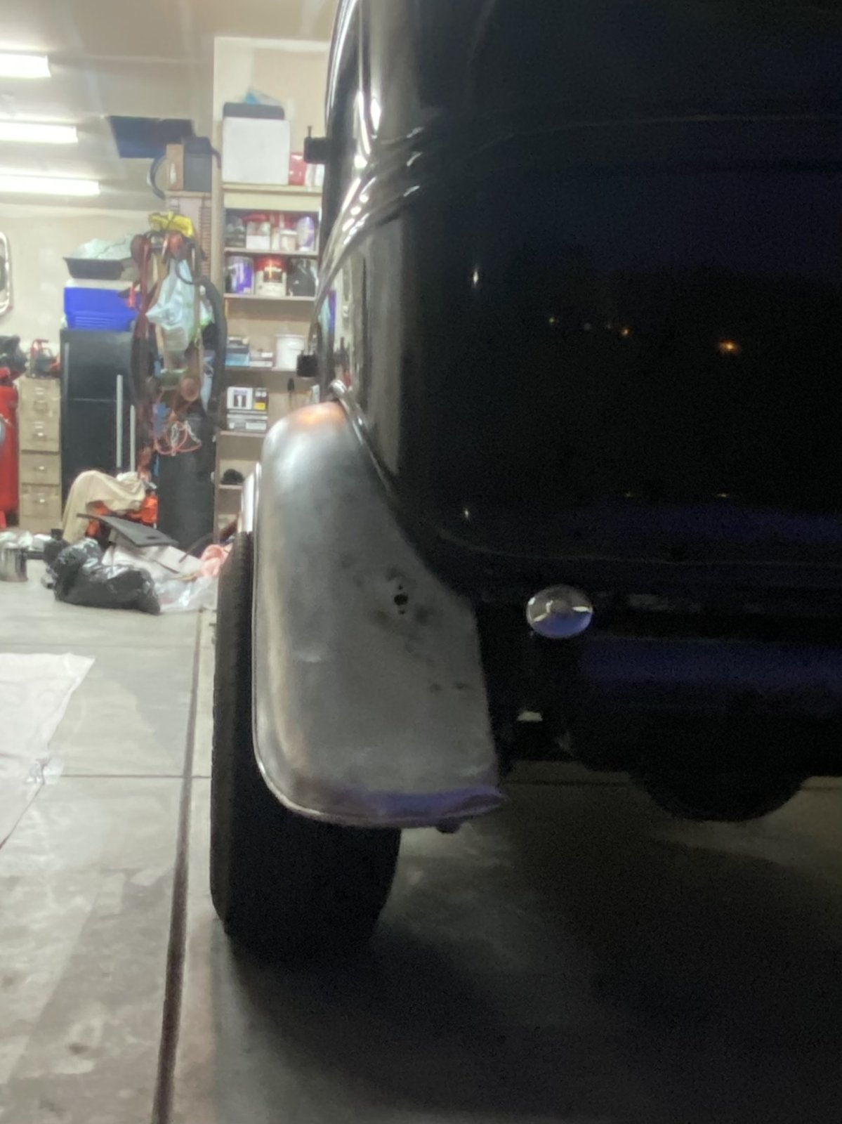

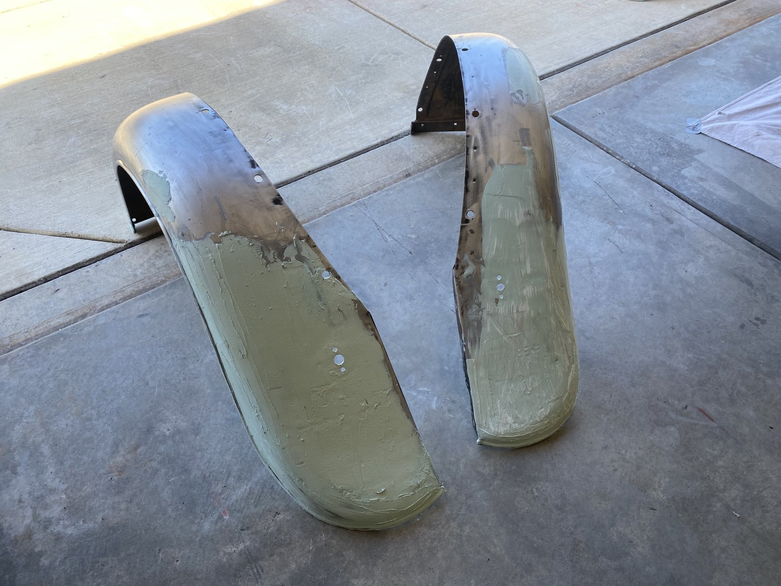

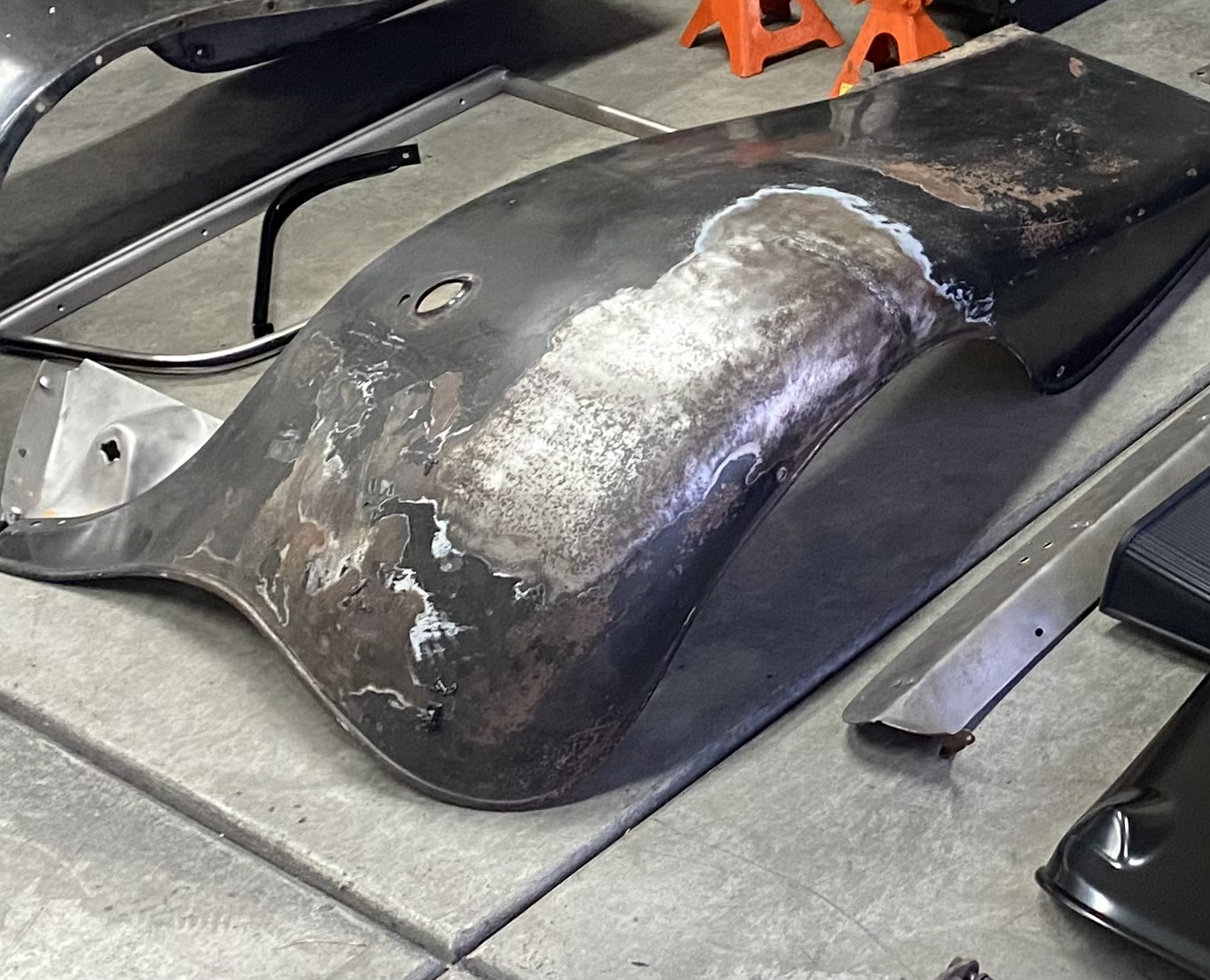

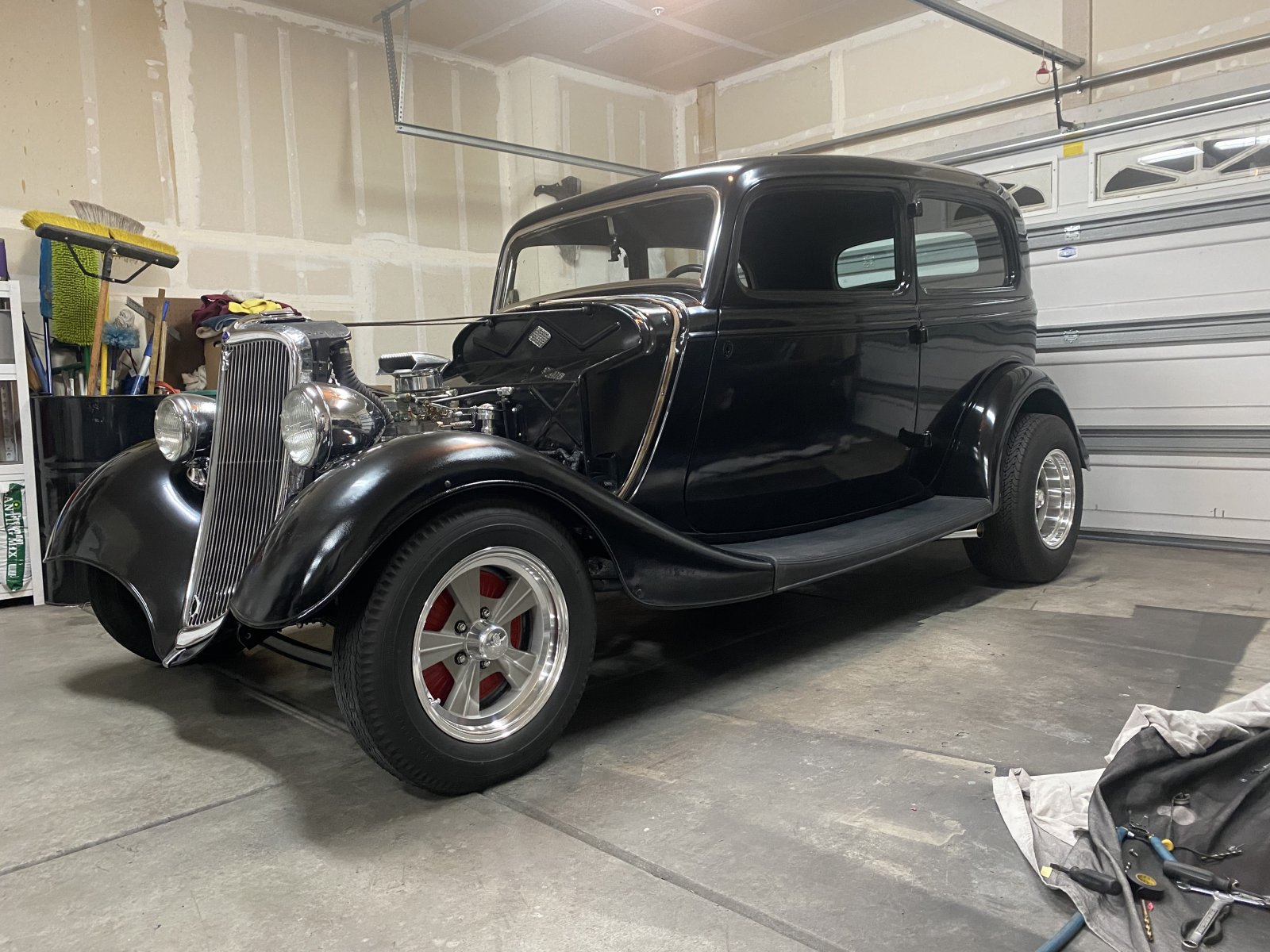

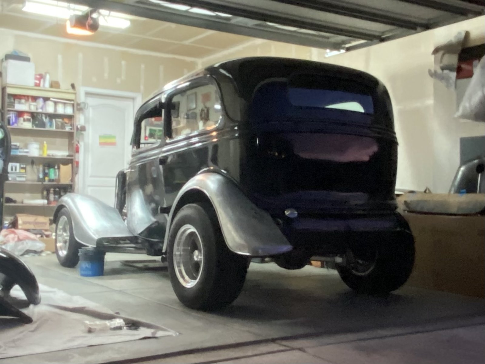

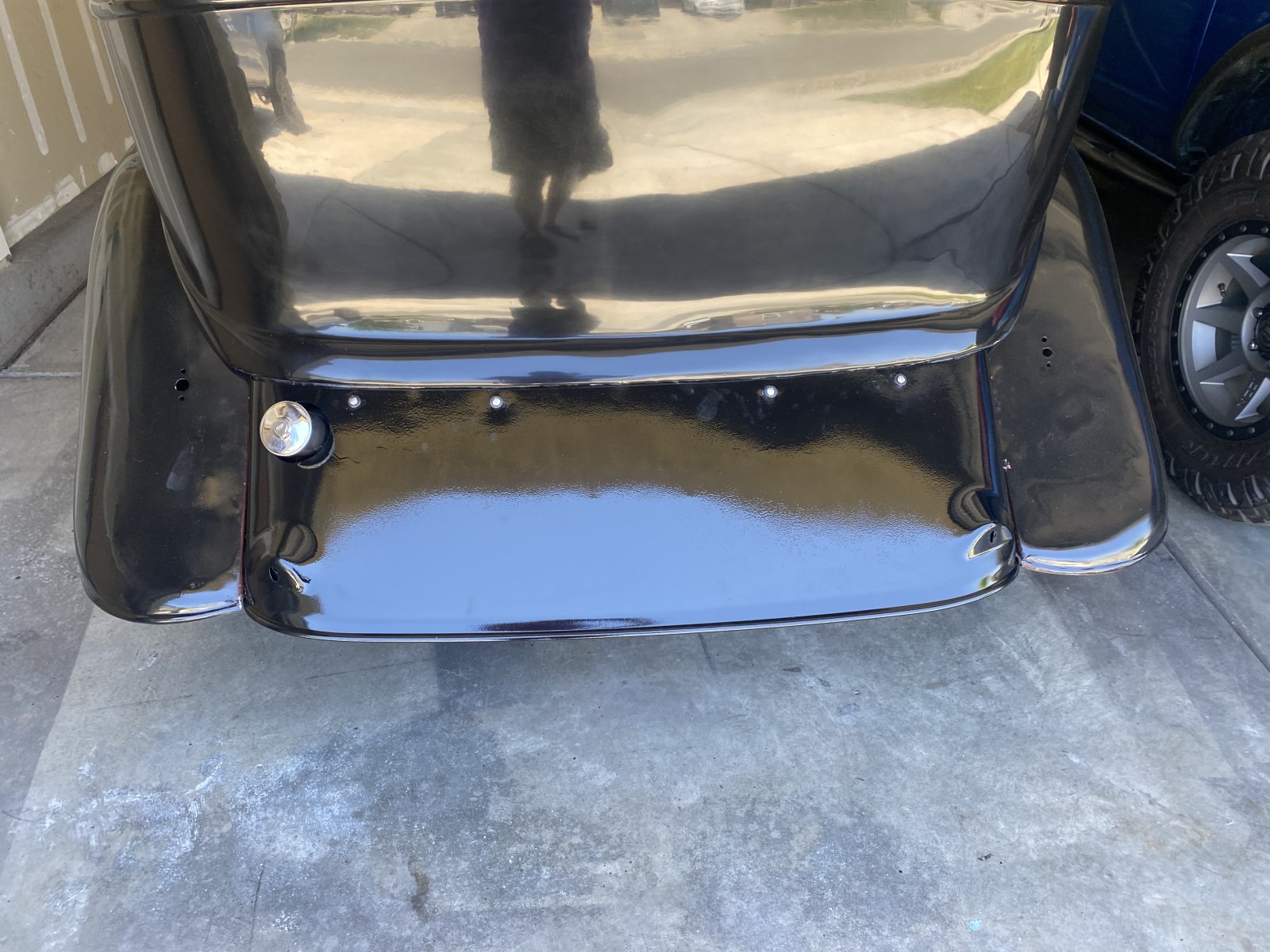

    4ADC6C9A-48EF-44D6-8830-0248C45B5CF2.jpeg E7030337-C8D4-43EC-8CDA-051D04CD6917.jpeg 03C8EBC3-0C3F-47FC-8F9E-CA8F6BAAE52B.jpeg D4F7F4BC-3512-4F27-88EB-61823C69222A.jpeg 4313A6C7-953E-48D7-8393-FD9F209D6104.jpeg 1B588A5B-01BE-46CA-AA7A-D97957CB9223.jpeg 5AB06F8D-1DE7-4EB1-AF3B-8EAABAC54DB4.jpeg Stayed up late last night trying to get to the point. I am right now boy that was a tough one I hate Bondo!
    The front fender turned out great, the rear fenders…. A lot better than they were…but you know it’s a driver.
    Wet sand, paint those while they’re dry and going to start on the doors!!

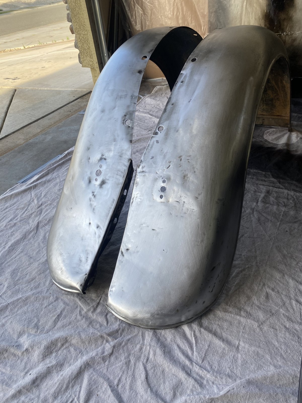

  7. NealinCA
    Joined: Dec 12, 2001
    Posts: 3,590
    NealinCA

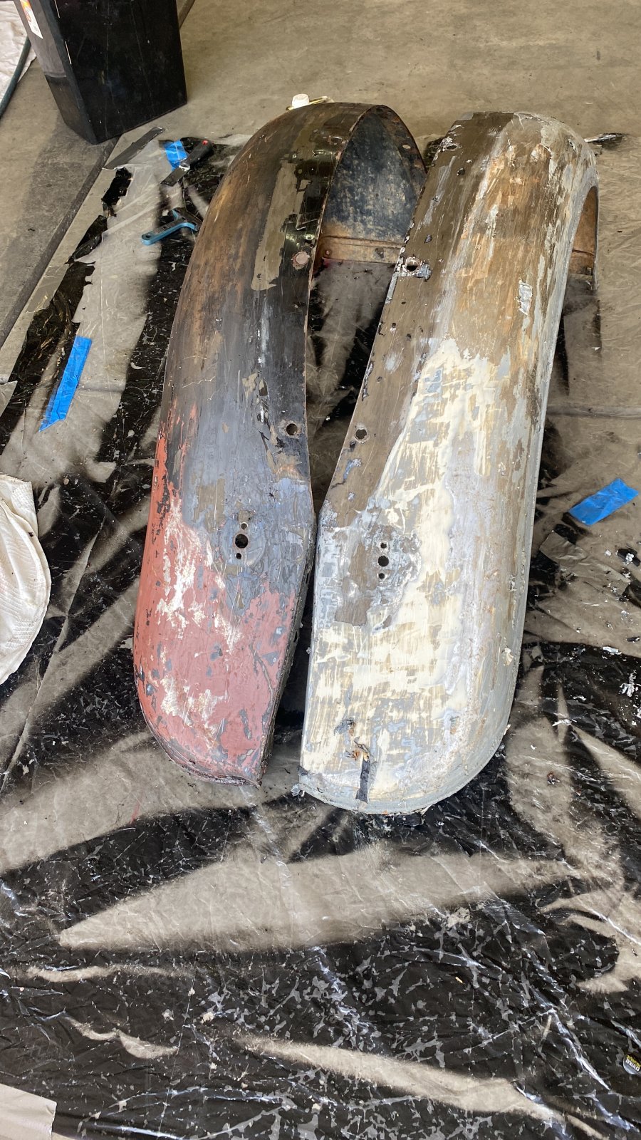

    What did you use to strip the fenders to bare metal?
    Stogy and 33Doll like this.
  8. 33Doll
    Posts: 1,602
    33Doll
    Jasco, razor blades and My arms, sand sand sand sand sand……
    Vinegar and a toothbrush in the little crevices on the welds. I’m sore.
    Stogy, Outback and brEad like this.

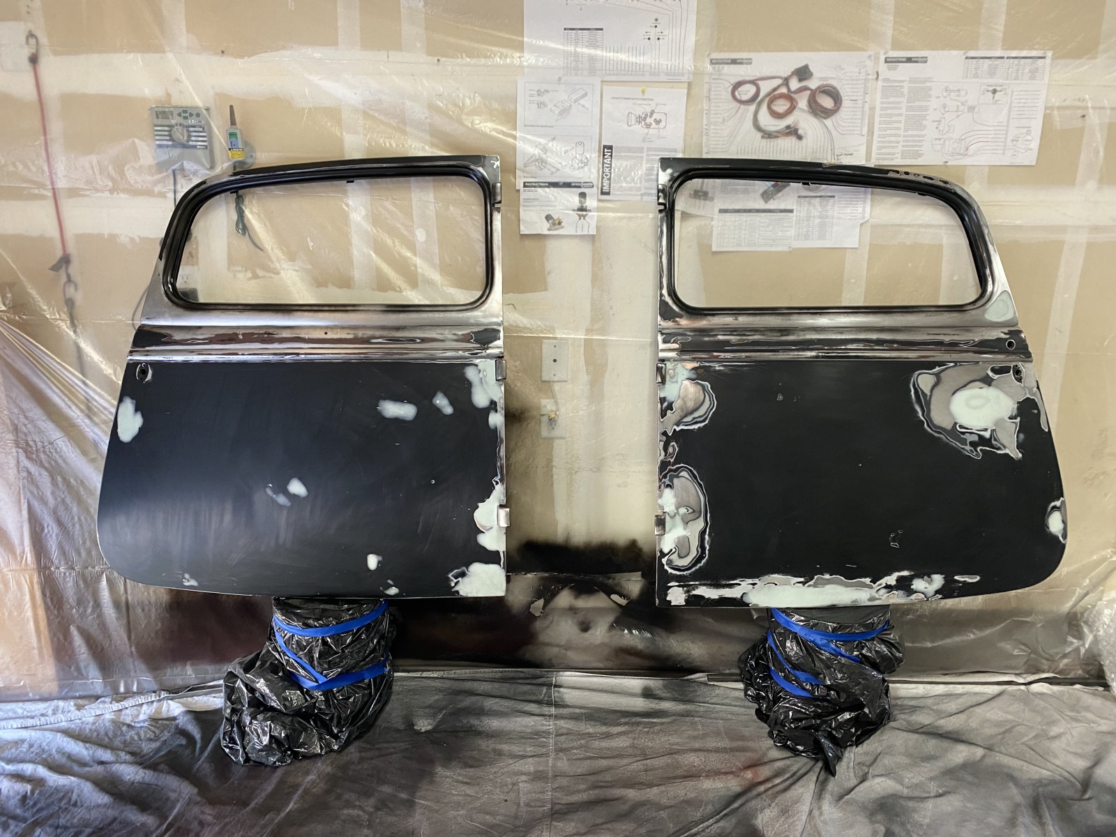

  9. 33Doll
    Posts: 1,602
    33Doll

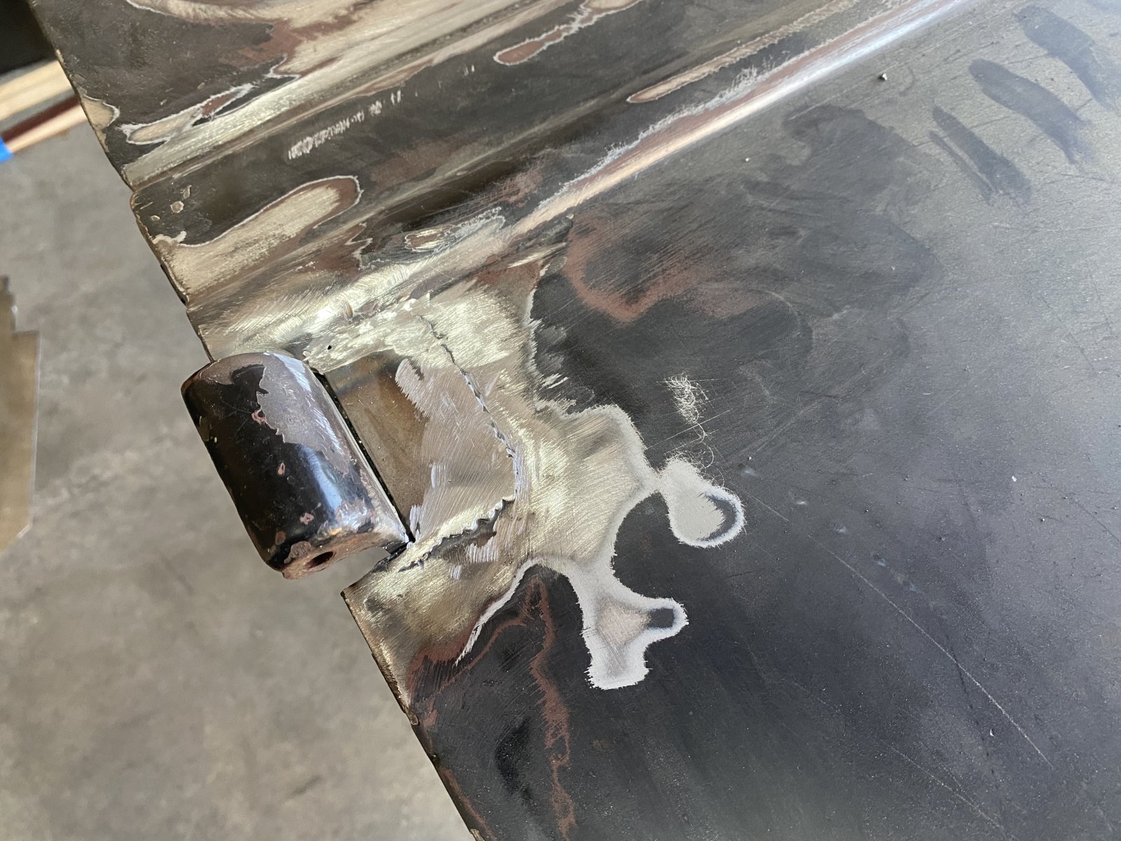

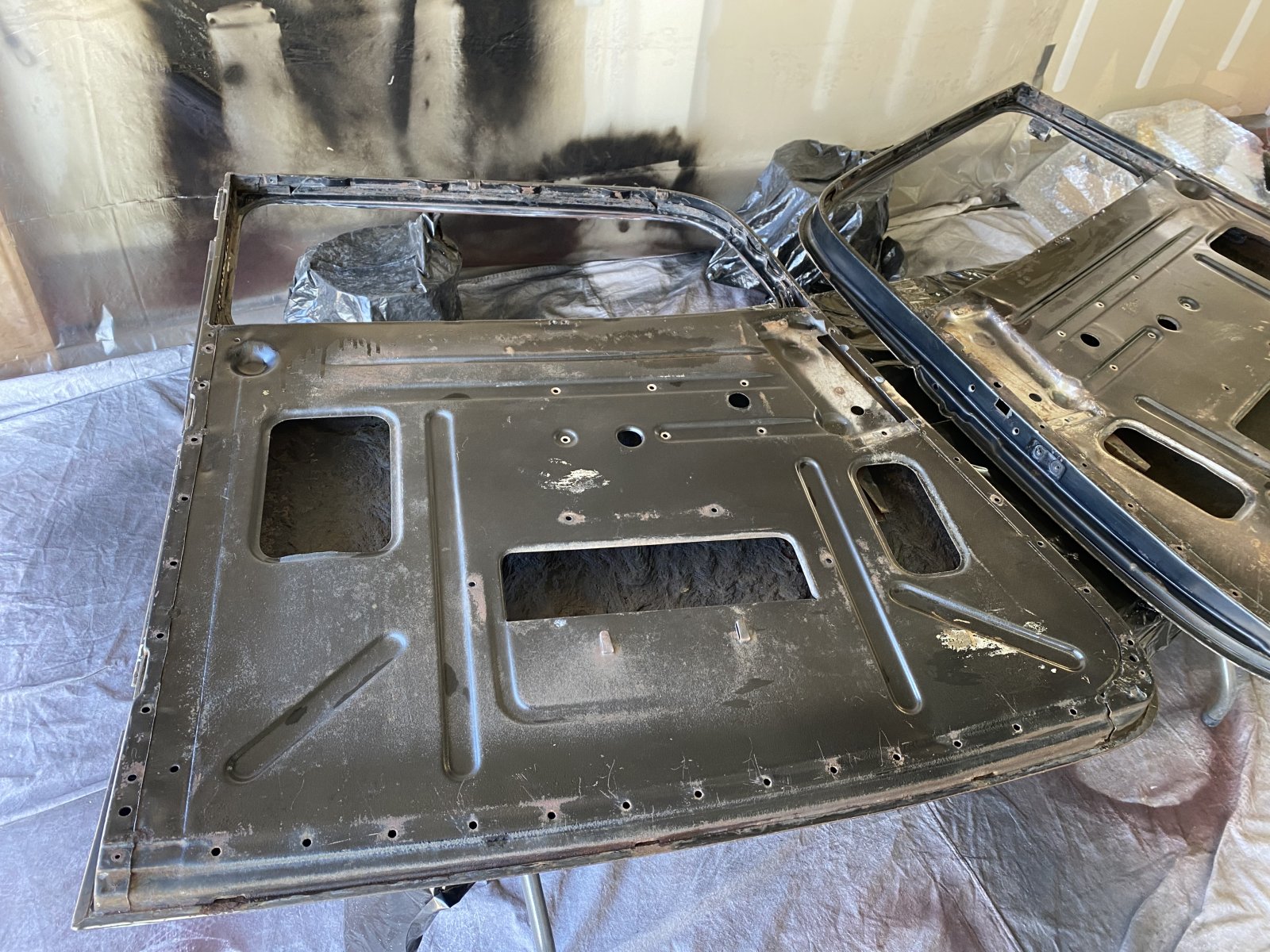

    Today so far….
    Stripping the door guts and everything right now while I’m waiting for the paint to tack- up so I can move them.
    Away from sanding dust.
    Then I’ll start on the doors.

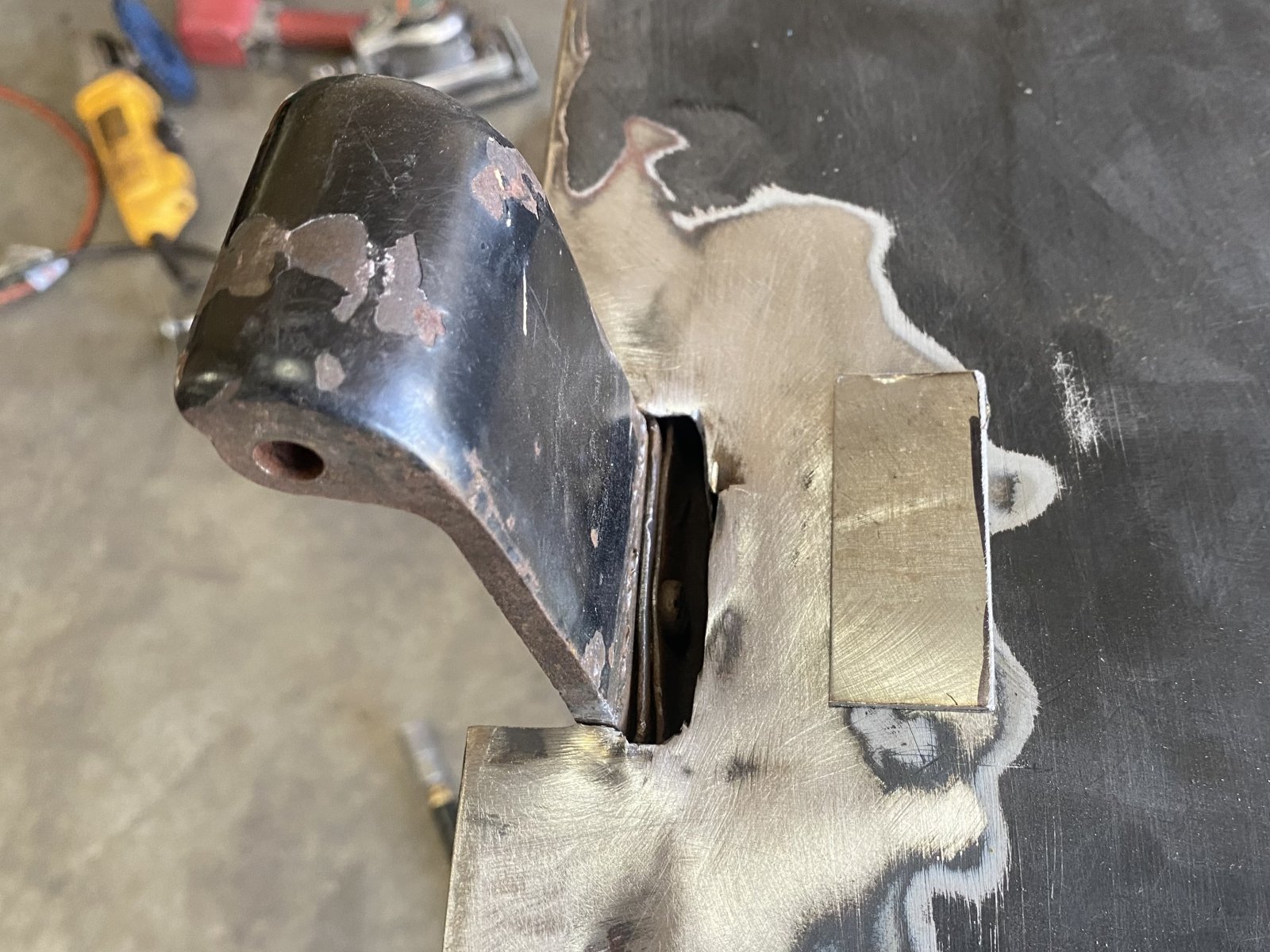

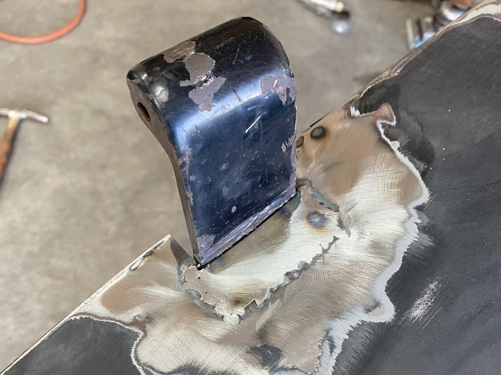

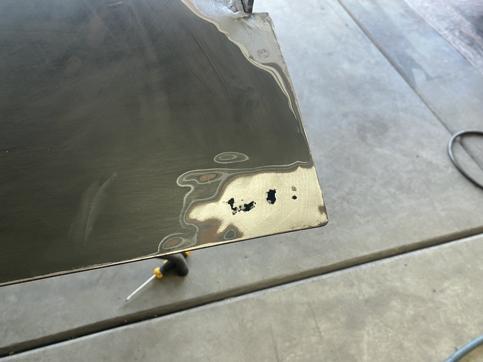

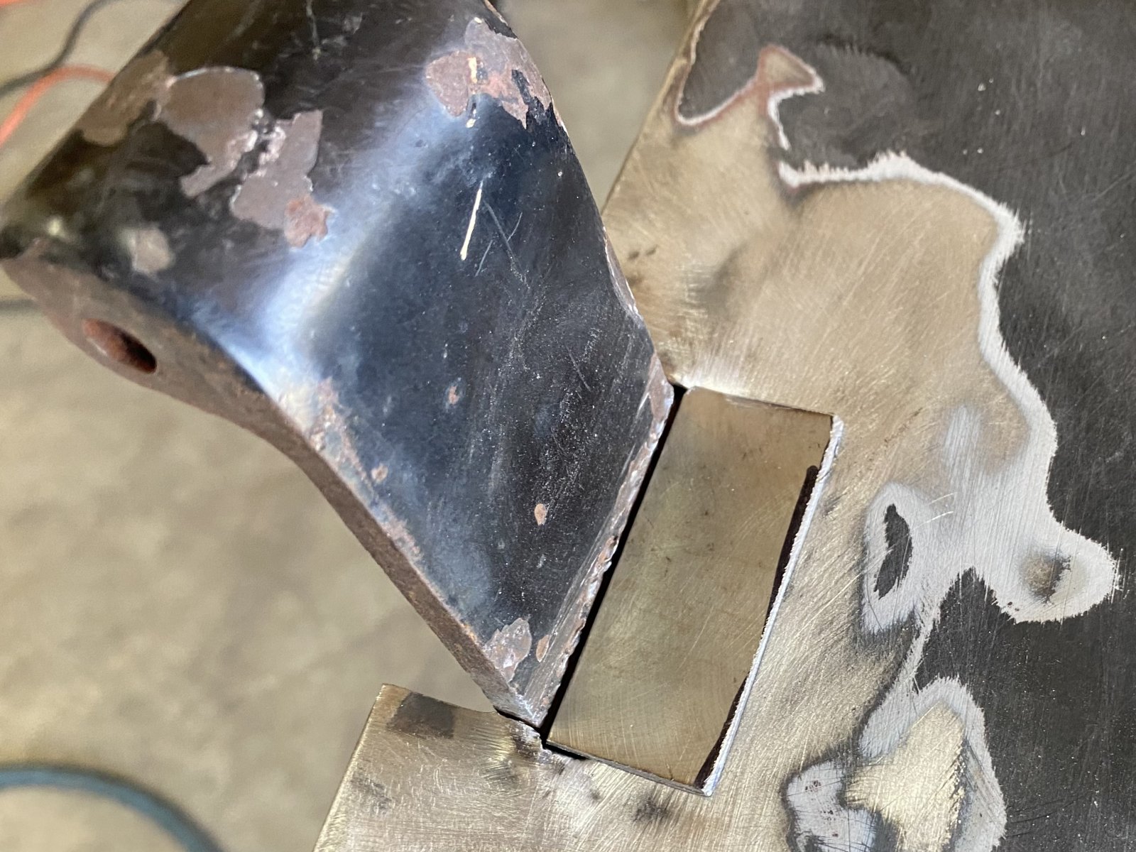

    I’m just gonna strip the paint to the beltline, and then sand and blend the rest. And weld cracks around the hinges may, be fill
    with a piece of metal here and there well see. 15633447-9903-4849-ABA4-C2B98CA670D2.jpeg 8A66821C-9A90-470F-A69C-38F79B17ABD1.jpeg

  10. NealinCA
    Posts: 3,590
    NealinCA
    Thanks for the response. I need to strip the fenders for my 32 5w.
    Your fenders look great painted.

  14. 33Doll
    Posts: 1,602
    33Doll
    9B5F2B5E-D388-4097-A2D9-B757C1560F50.jpeg 95741DD2-93B7-4945-9AA3-E03542242333.jpeg 390A90B5-03C9-401F-86C0-A1142BE8DECF.jpeg 64990C44-72C7-4786-89A7-4DEDD87E34BB.jpeg
    Thanks!
    The Jasco is messy as hell but as long as you try to s****e it to one side of the drop sheet and then sweep it up as it dries a little bit. It’s when you step all over it you get it everywhere. Beats sanding it though. I tried to sand it on the other fender and turned out terrible. Just be careful if you hit some filler underneath your paint instead of worrying about gouging it. Just fill the gouges later . I ended up sanding it all off which, as a result, you can see all screwed up the fenders are. Should’ve just left as much filler on there as they could’ve. It just bothered me that they filled over every little thing but after playing with it myself, I see why you can’t get all the little hammer Marks out.

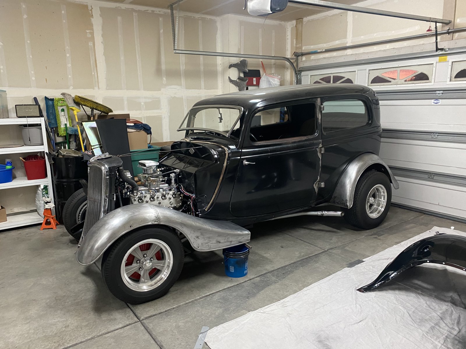

    7CE200CC-4C51-471D-98B0-E1499FE56A2D.jpeg Getting closer to the finish line it looks like this is the rest of the parts. I have to paint at least black, except for the window frames. Metallic gray.

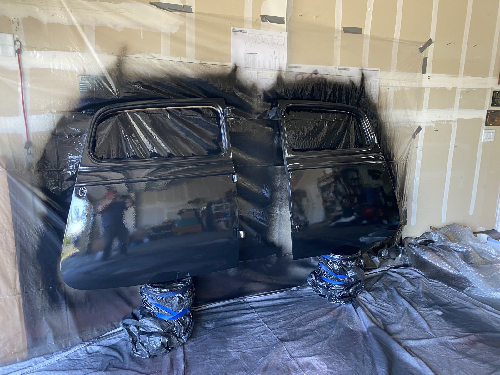

  16. 33Doll
    Posts: 1,602
    33Doll

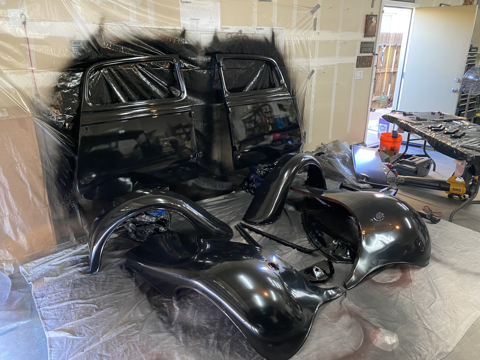

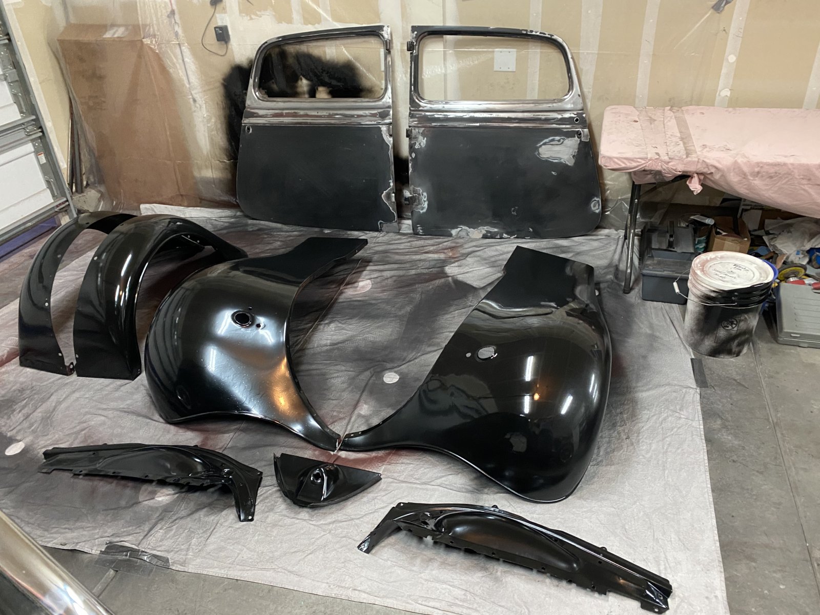

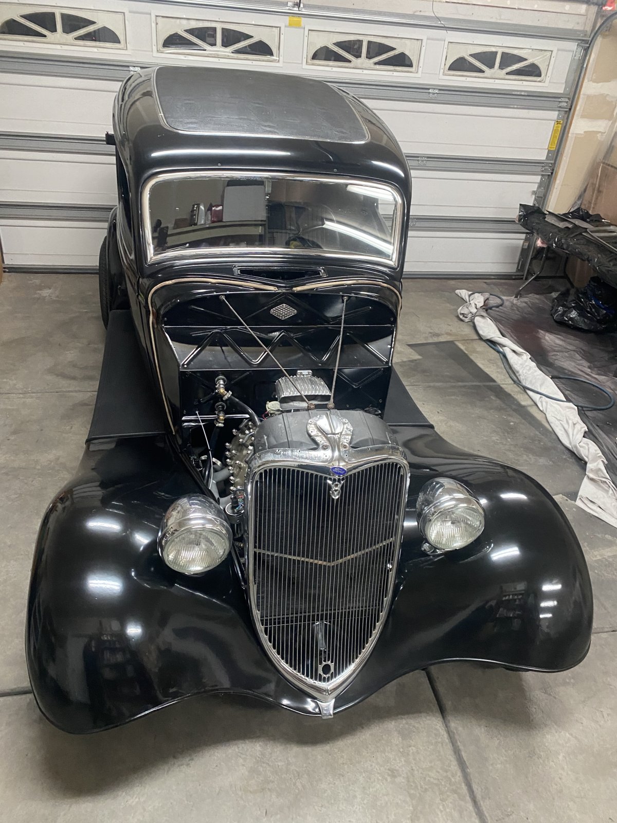

    F7A1296C-2022-4E96-8EFC-B8B4385653CA.jpeg 406E59CE-F546-48F9-9DD7-E03C4ED58049.jpeg 751C2DB8-5EC3-4787-B4A2-EC28D043BB24.jpeg 700462C2-E861-40BE-BF07-A76675F158D0.jpeg B6E50C19-EC10-4036-B15F-E4F20F3B9572.jpeg 8666E9AC-3067-46E5-A8F3-3C725472622A.jpeg Welp!
    Everything’s black! Just need to do the tale pan tomorrow after I cut out the gas tank hole! I think “Earl Scheib”
    might laugh at me if he was still alive, but hey, it’s black!!!!
    “ I’ll paint any car for $99.95
    Well…didn’t I say…I was going for that building-on-the side-of -the house-garage kind of thing in the 60s? So….I did achieve that! And it’s definitely not a rat rod!
    Gonna start putting it together tomorrow. I don’t really care what it looks like at this point
    I’m worn out!

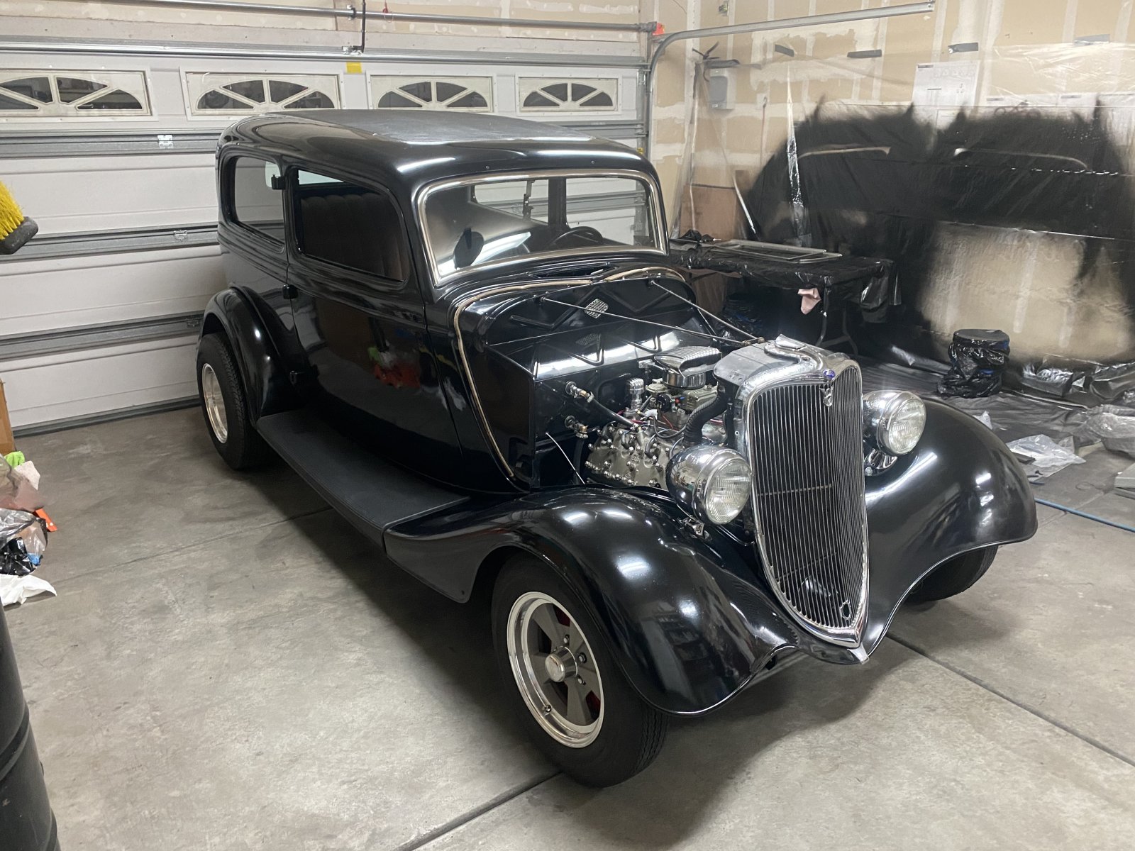

    D895B6D1-0F6C-4055-BFDC-E0E34A490D12.jpeg Yup! He’s better!

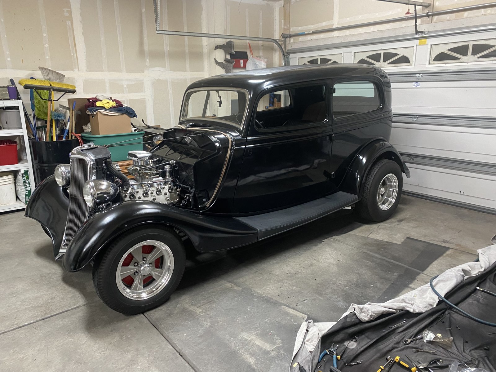

  21. 33Doll
    Posts: 1,602
    33Doll

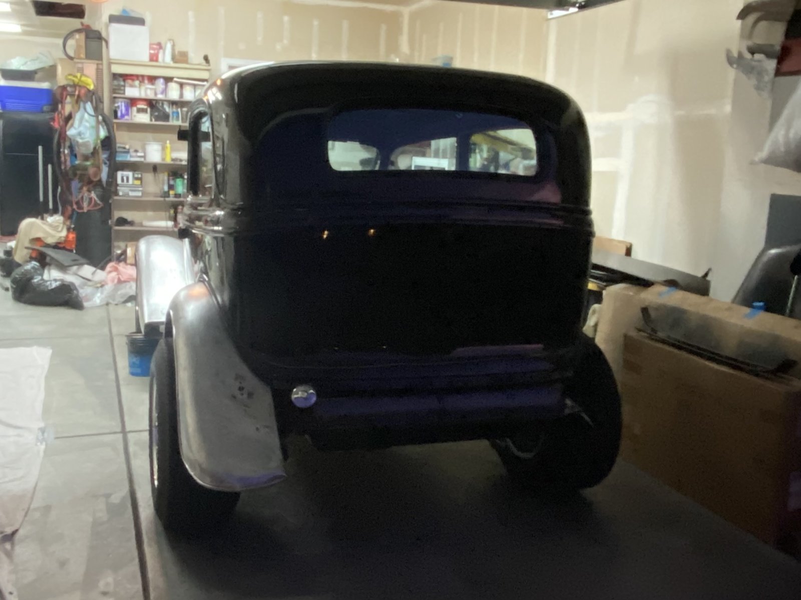

    6EAB73BE-404B-45D3-9CAE-36CE8C6B2F21.jpeg 3D16A2E3-2A51-490F-9E11-23BEB4648B6E.jpeg 213B29A0-AA8E-4B61-8338-A1800BC4E154.jpeg 53F9E28C-7B68-4FE4-A5A7-F6AC00BB88BA.jpeg 3421A9BB-093A-4C1C-9075-2C8960C7B07C.jpeg ACD20B38-ECA3-4C3A-AC1E-965EFC02CFD4.jpeg 91BD20A3-53B4-4192-8EA2-80D763D6A645.jpeg 5B20A179-26BD-4848-9E27-DEFB9C32547E.jpeg 10AB74BD-55B1-410B-9152-2456C285776B.jpeg Welp!
    I Purt-Near made it! I had to quit at half past midnight!!!
    All the big stuff is done anyway.
    Going to try to cut the hole and paint the tail tan tomorrow in between cleaning the house for the Mrs. I got a lot to do!!!!
    I need to do a door latch repair and then put those on hopefully
    If I can get the tail lights and headlights hooked up, I should be able to drive it to work. Maybe??? 6EAB73BE-404B-45D3-9CAE-36CE8C6B2F21.jpeg

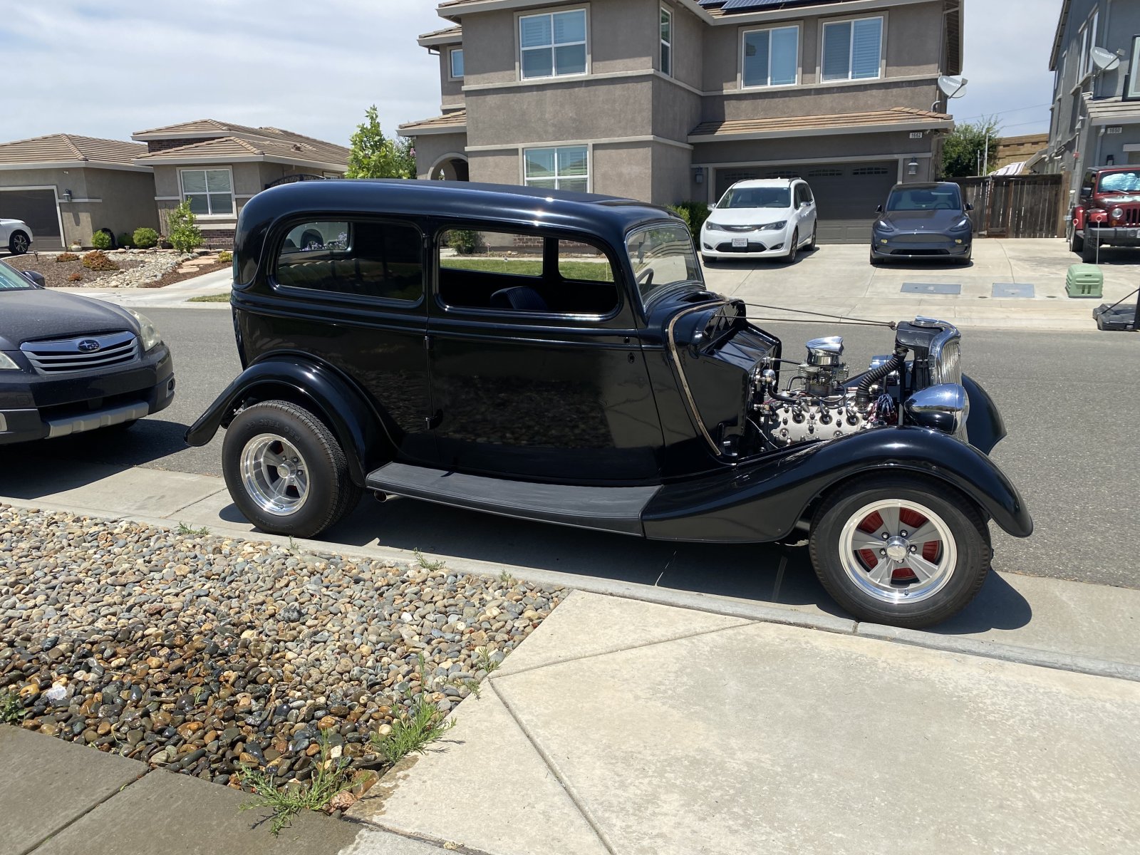

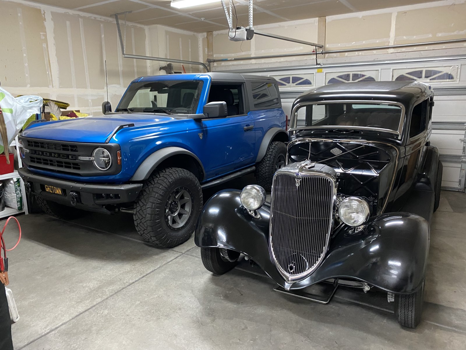

  23. 33Doll
    Posts: 1,602
    33Doll
    9F99F4E9-1EBE-48FF-AA47-1D6DF02CDFA8.jpeg 16843C36-C328-481A-8208-0FB36B6A379D.jpeg 95D81687-6CCD-4691-8A82-4EB7A893CE08.jpeg BCE0EA86-3901-4778-8845-905476C0213D.jpeg FDBEEDB8-AB0F-42A6-9493-F7CDC68F20B2.jpeg House is all clean… Wife is happy!
    Made in cleaner then when she left!
    Garage is all clean, and a little more roomy now!
    and Her Stable mate is back inside!
    (Get it?)
    Stogy, JalopyJimbo, -Brent- and 7 others like this.
