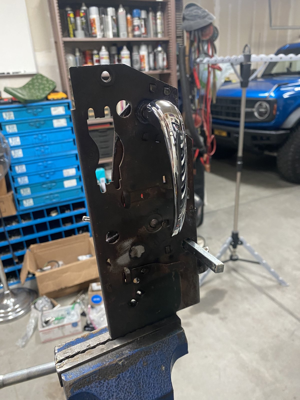

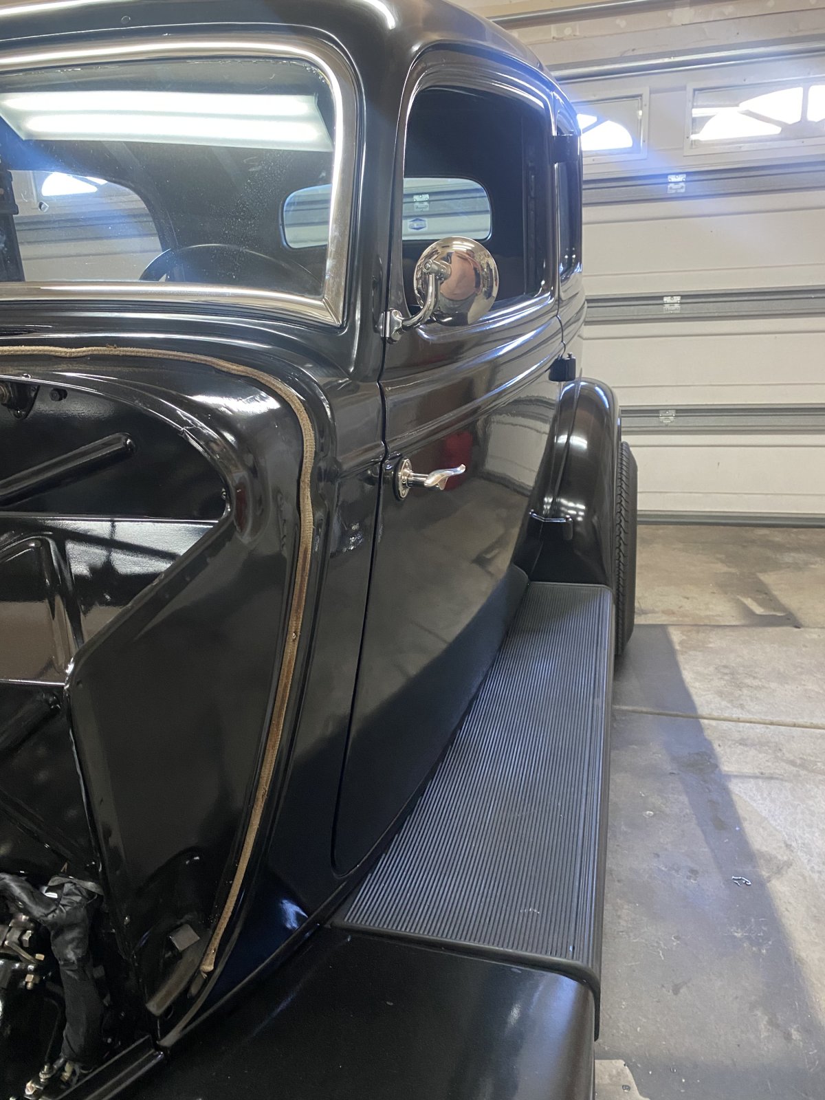

  7. 33Doll
    Joined: Sep 27, 2019
    Posts: 1,602
    33Doll

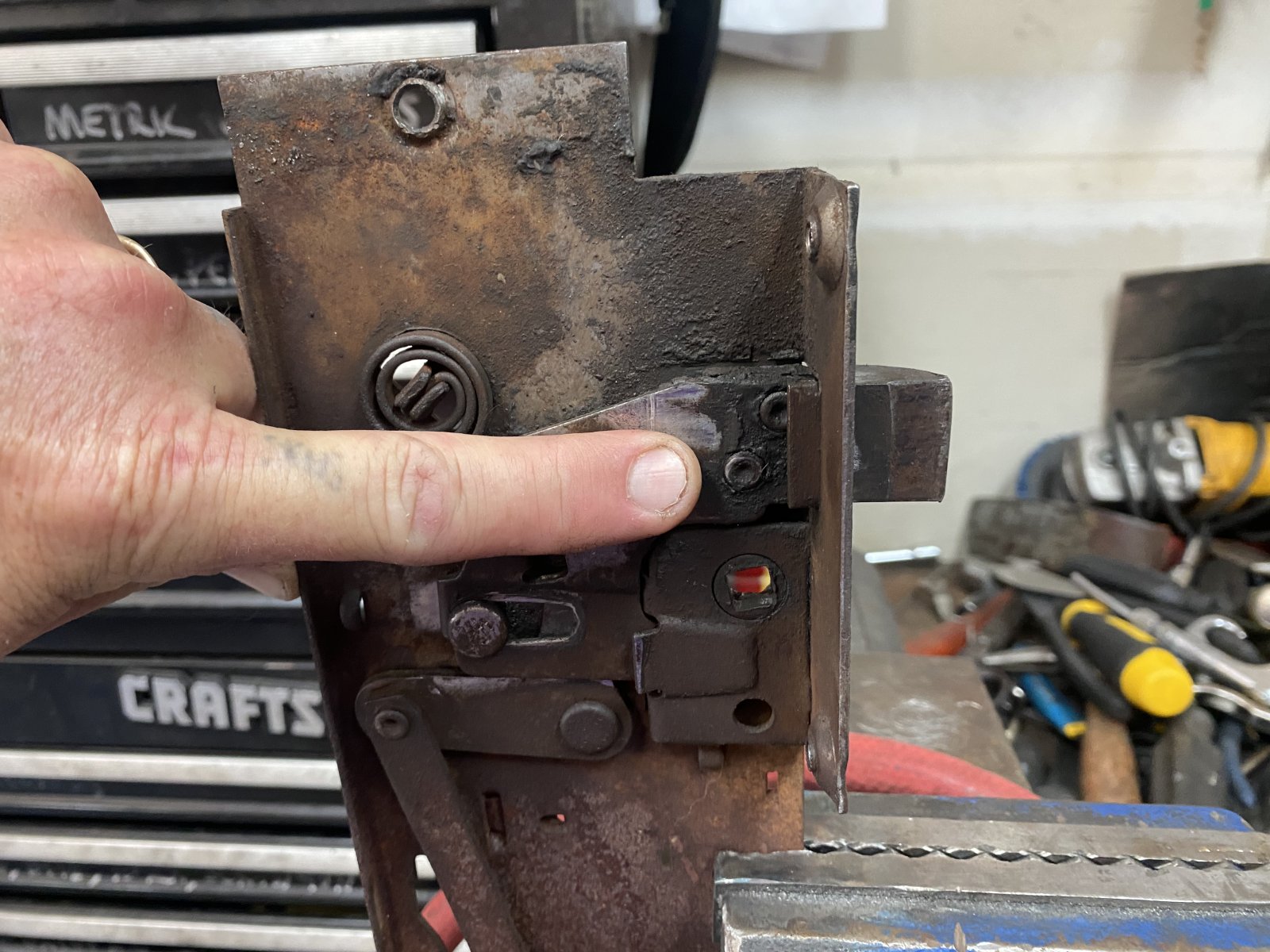

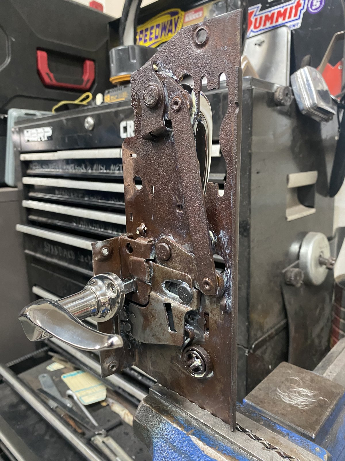

    70BD4549-160F-4F55-B703-2F27B4C0417C.jpeg 38A4371E-5D30-4E44-924B-87D178DFB693.jpeg 55149B1B-106A-419B-9745-022277427146.jpeg F086CA2F-C3BD-4FBD-B3C4-F6DC4D50A526.jpeg 74A46A8A-8FEC-4EB6-BF9B-630EB2DE23E8.jpeg Multi-tasking…
    In between equipment maintenance.

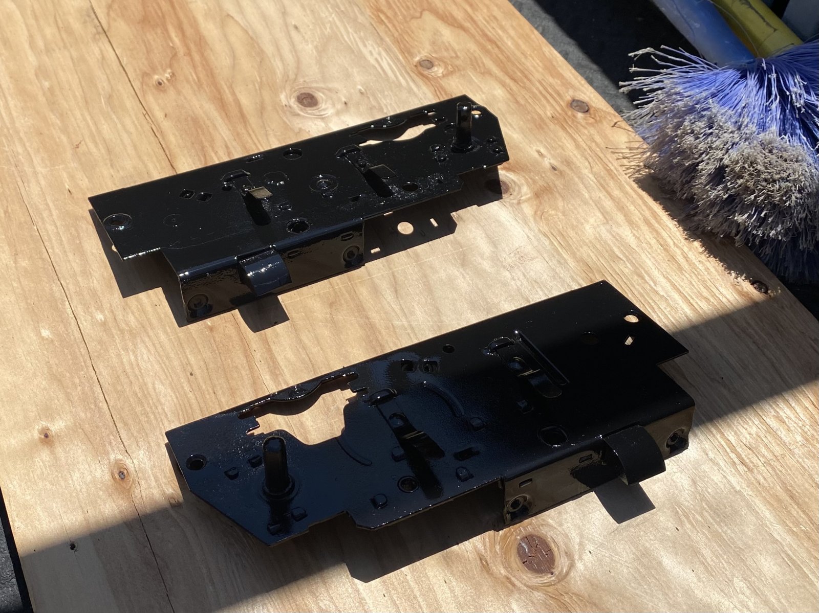

    Shhhh.

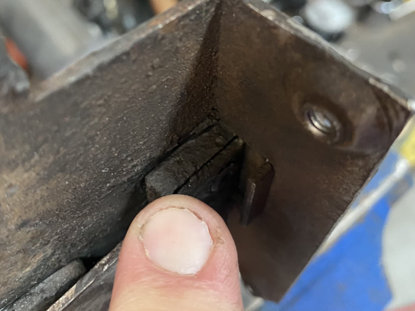

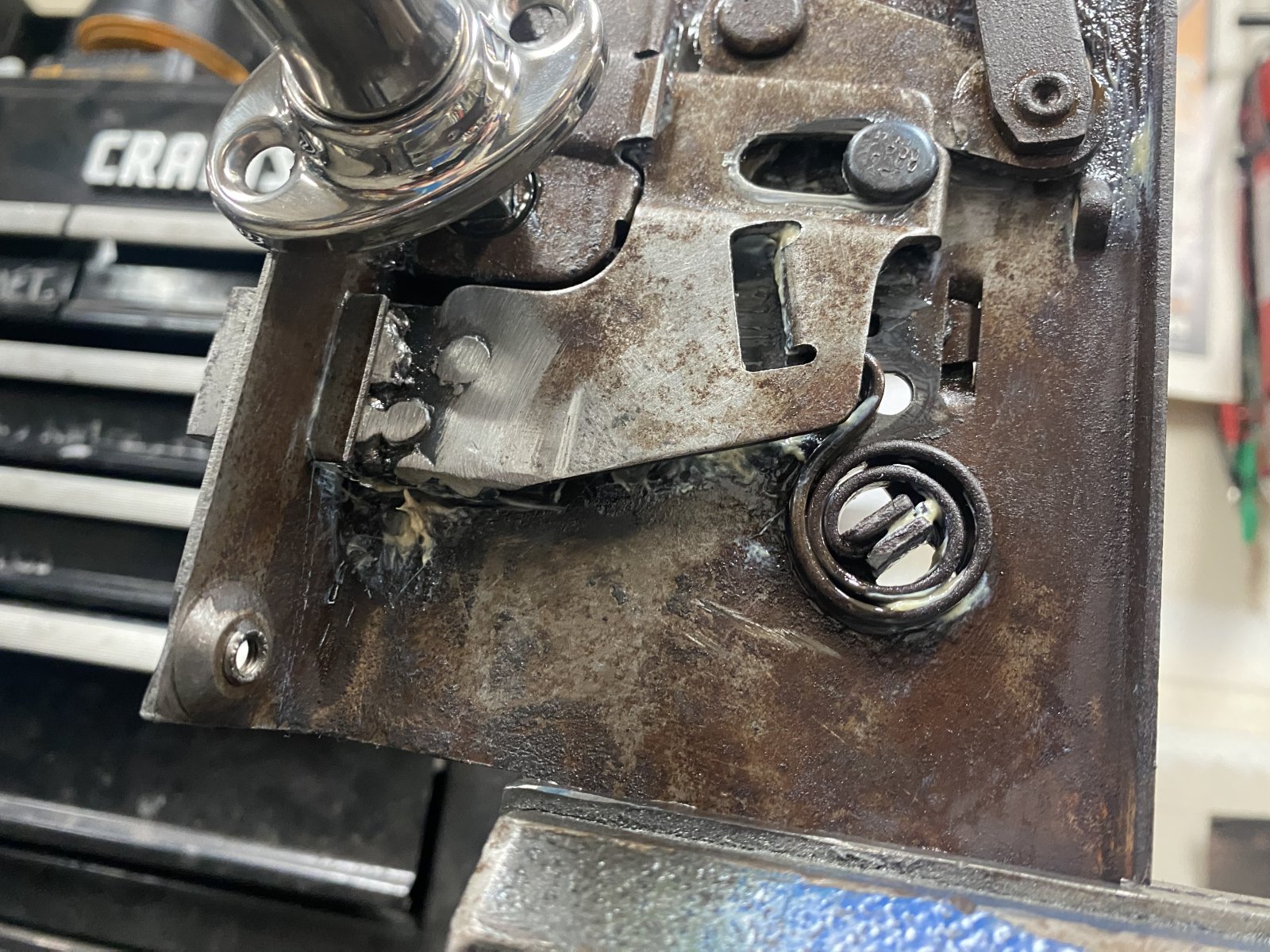

    Put the driver door latch on last night with a new handle, painted and lubed and reworked the latch welded the old rivets to the door latch/striker.
    It worked good, it just seems like those Springs naturally are really stiff, which I guess is good to keep it from opening but I’m going to put on a safety latch anyway. so if anybody needs to fix the slop from the striker to the mechanism, it seems to work out well. If that makes sense?
    I also welded it on the edge too for back up.
    Stogy, dwollam and Jim Bouchard like this.

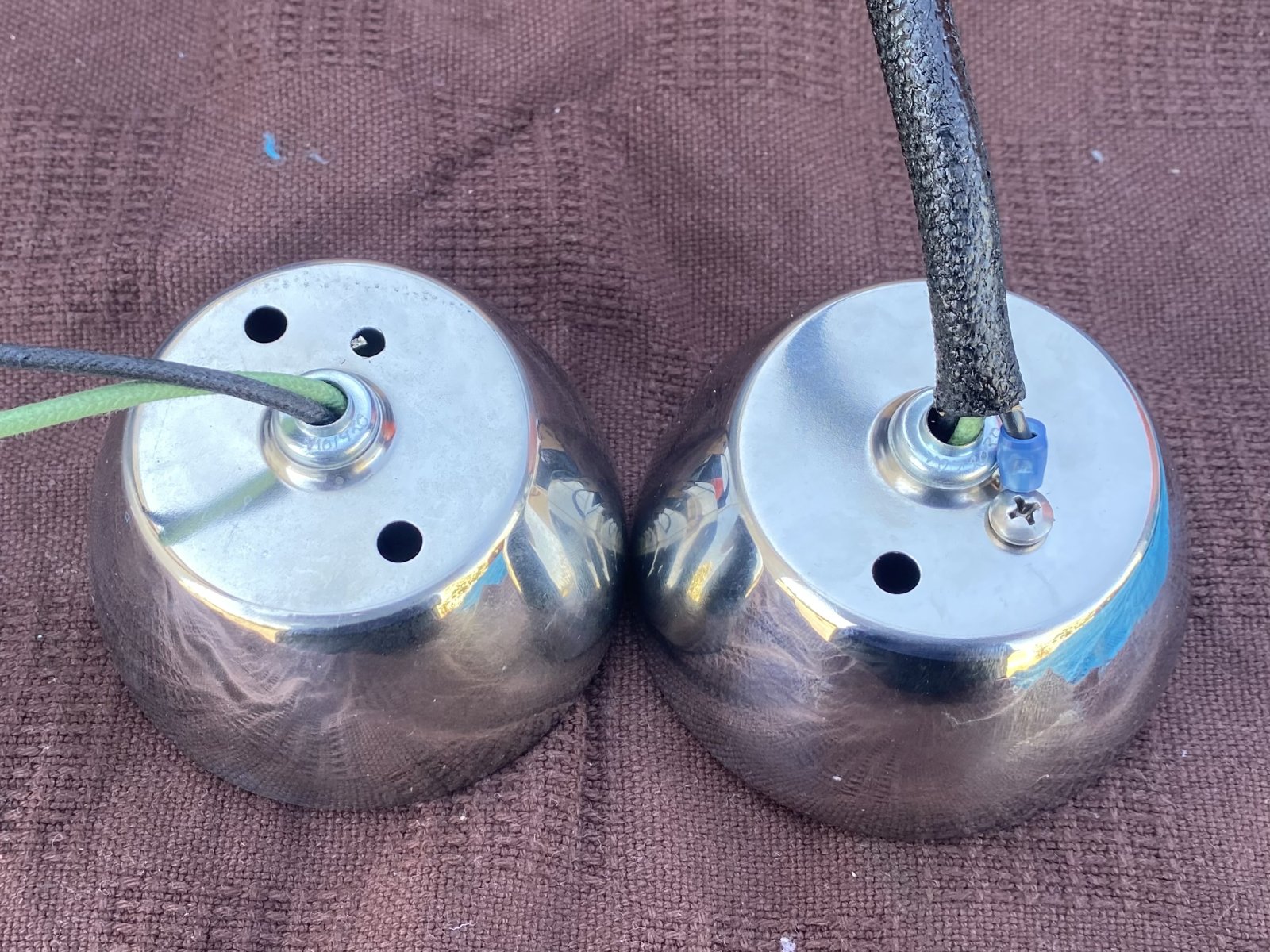

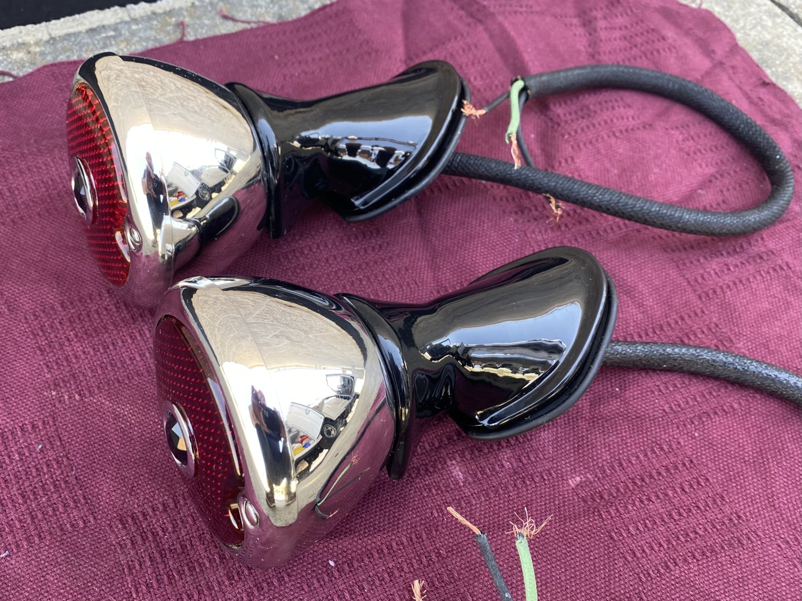

    70935229-422A-48EA-89A8-FA9528DF1420.jpeg 15E9CA57-23DA-4734-B40A-AE17B7011BBC.jpeg 10A321ED-1B1C-4C66-A721-D6E33C40DBA4.jpeg 295DFB52-19D5-4BB2-AD80-A900E1D6EF17.jpeg Hey, question for you, Sparky types out there??

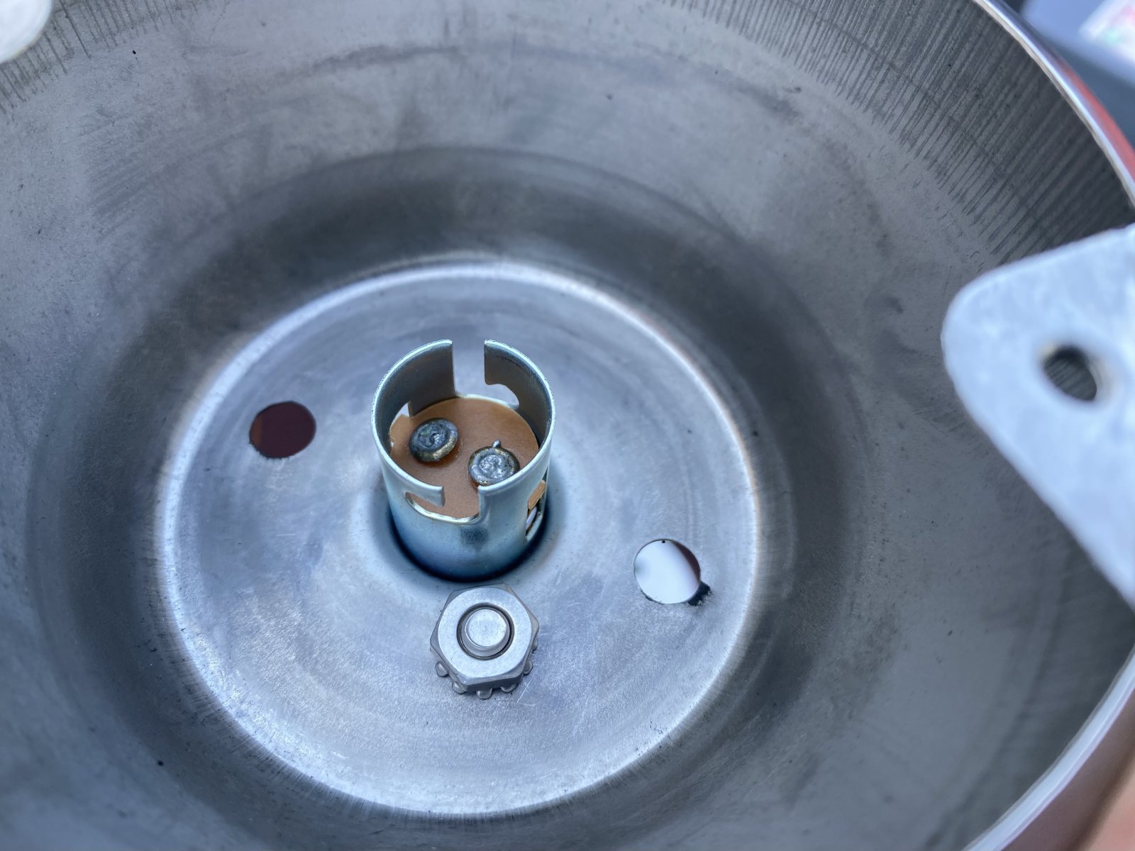

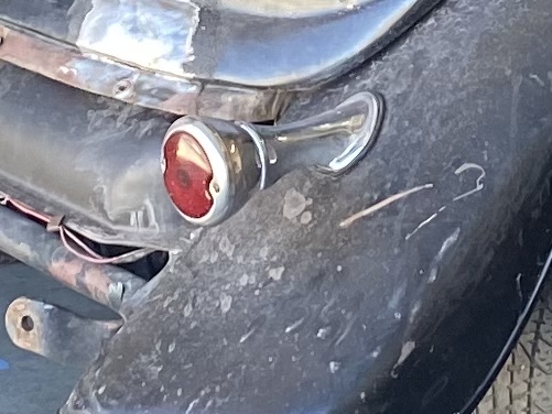

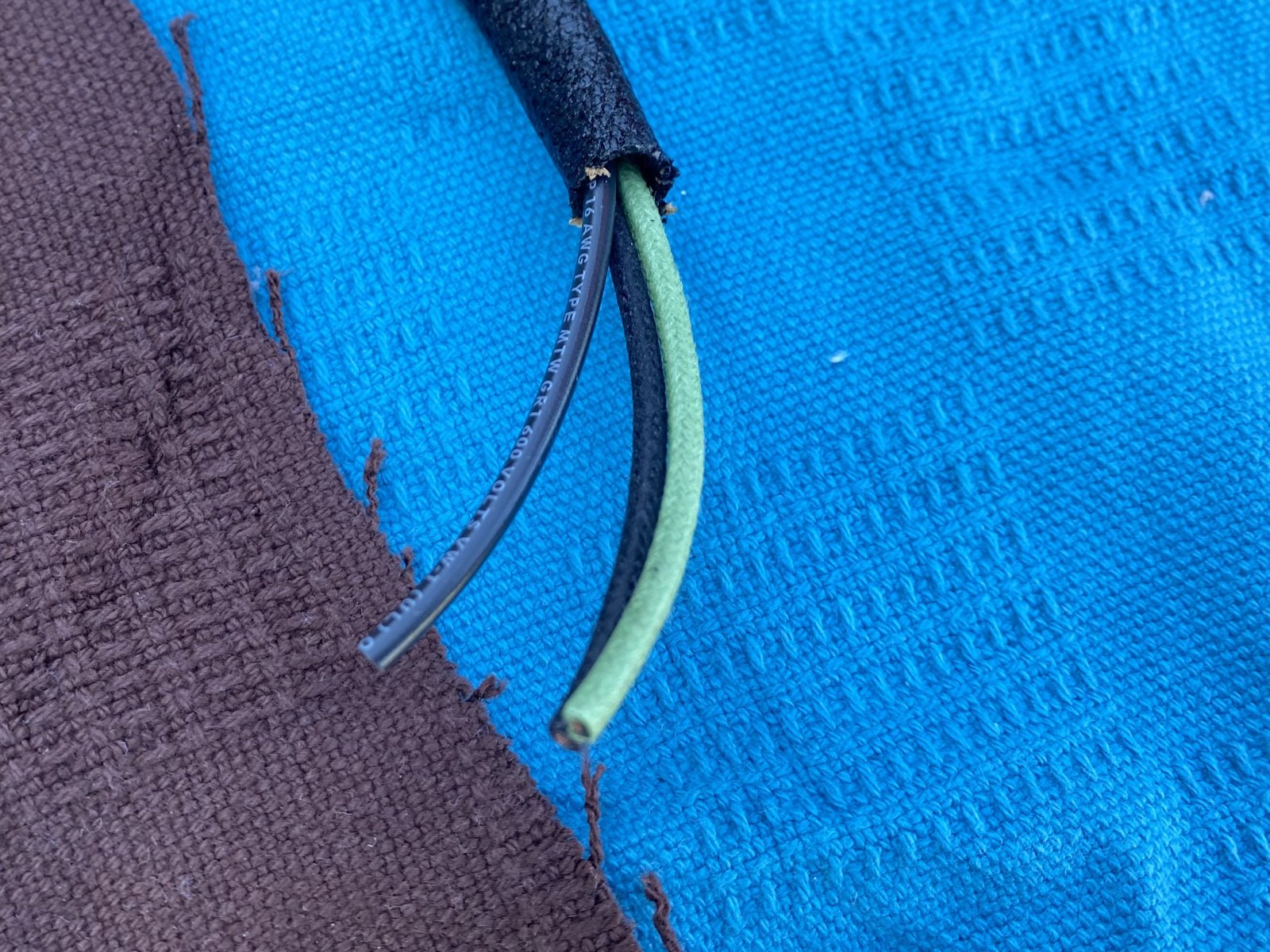

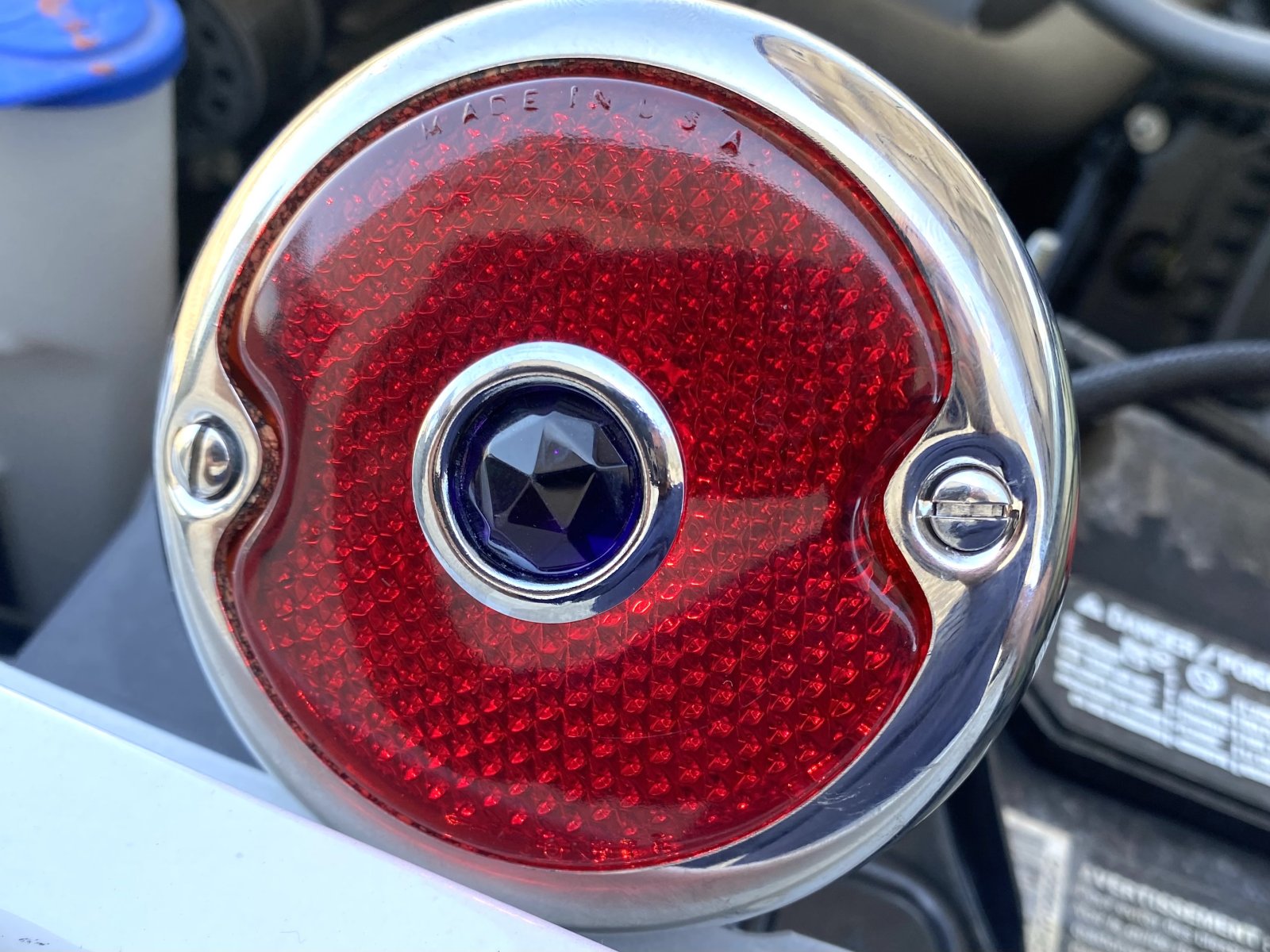

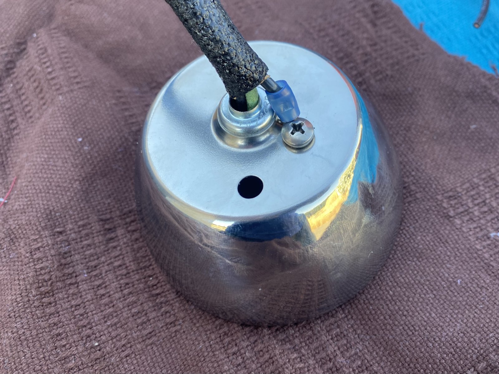

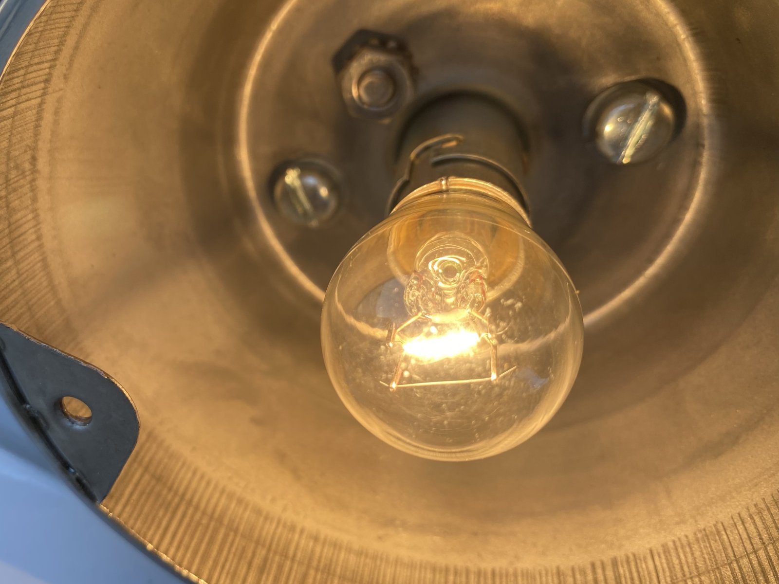

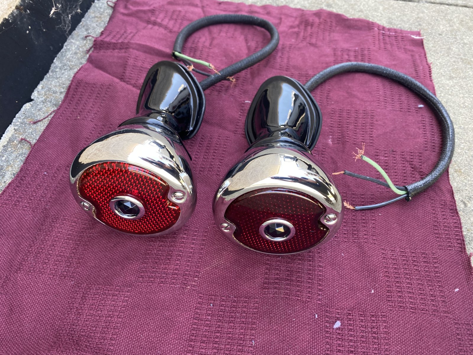

    My new tail lamps only came with two wires one for the high filament and one for the low filament (just need to figure out which one is which, before I hook it up)
    also came with a 12 V bulb and a 6 V bulb. Obviously I’m running the 12v
    So if I want a “really good” ground, is this a good idea? I just grounded it straight to the bucket, run it through the loom and then ground straight to the frame. My engine is grounded to the frame. My body is grounded to the frame, and the Dash is grounded to the body so it should give me a really good ground I would imagine?
    I’m just making sure that I’m understanding all this lighting wiring.
    Thanks.
    Stogy and brEad like this.
  9. 37 caddy
    Joined: Mar 4, 2010
    Posts: 533
    37 caddy
    from PEI Canada
    I normally solder the wire to the tube that the bulb fits into,with the new housing the solder should be easy to stick.It is the tube the pigtail fits into that you want a real good ground on.The car looks really good,wish i could get mine to that state. harvey
    Stogy, Outback, brEad and 1 other person like this.

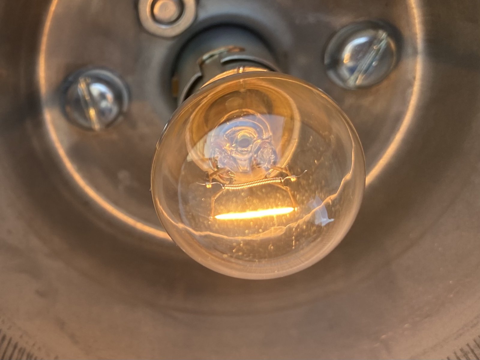

  10. 33Doll
    Posts: 1,602
    33Doll

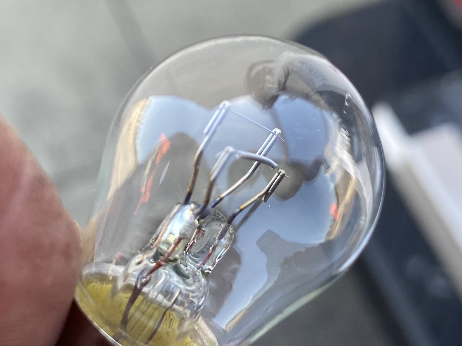

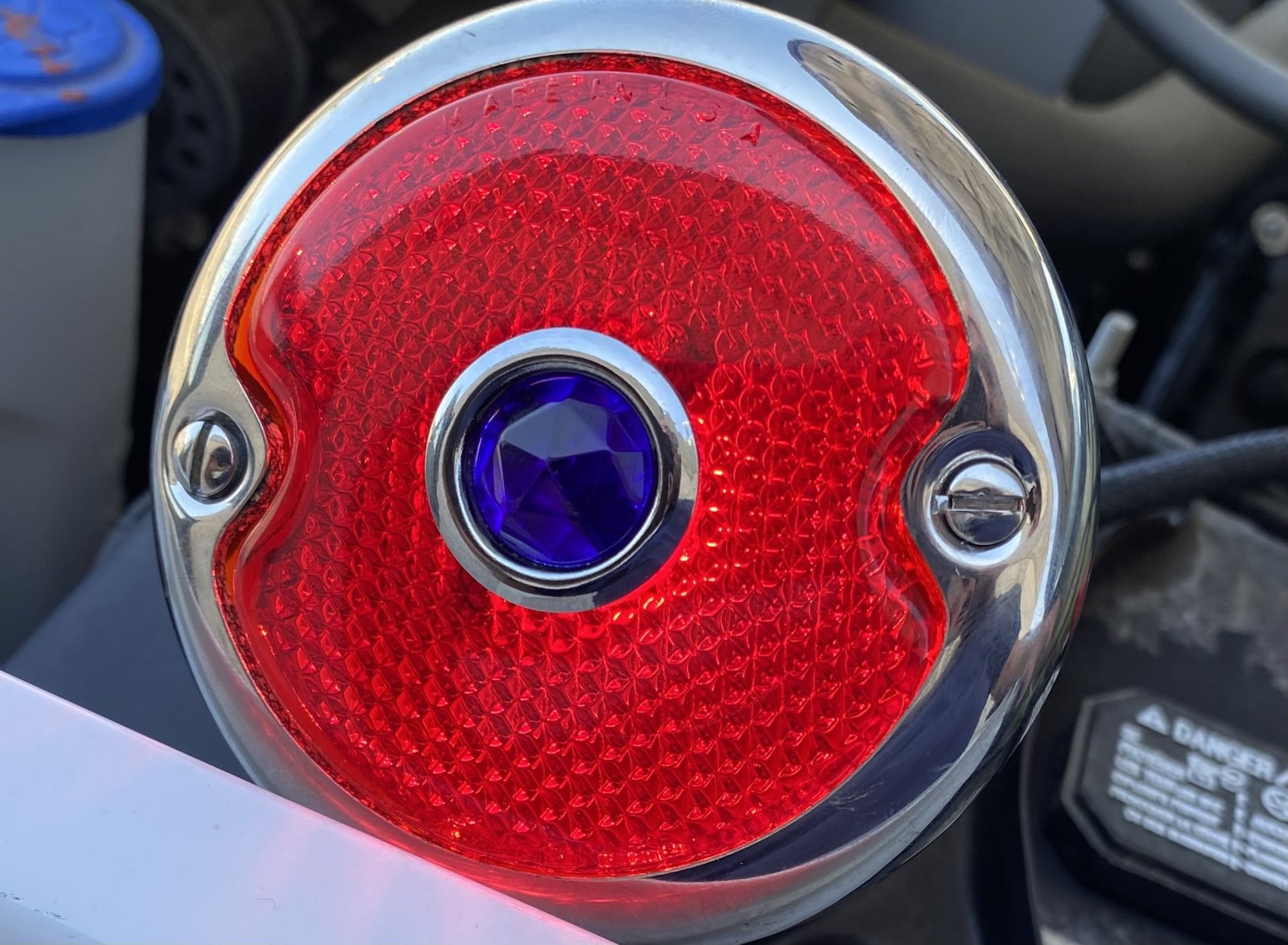

    1387D257-FD2D-4F08-91CF-E5BC8D9F649D.jpeg 70697814-472A-47F7-9716-D6BBE297F858.jpeg 9753735D-E17F-4149-B957-D69C1699A5A2.jpeg D212A2BC-A18C-40BD-A80F-98D10F2B6D7C.jpeg 56926C4B-9B2D-4C02-9396-23950139959C.jpeg
    Thanks!
    I tried it on the battery and it works!
    Also, I learned something about the low element versus high element
    I thought that the articles I read literally meant the high filament was the high beams/turn/brake lights, and the little one was the tail light park lamp
    But when I tested it that shorter one was actually the brighter one and then I realized that is the one with the bigger spring/element that’s the brighter one!
    That’s how you learn right??
    Hard to see in the picture, but the taller one is the less bright one!
    Me thinks I gots it!!!

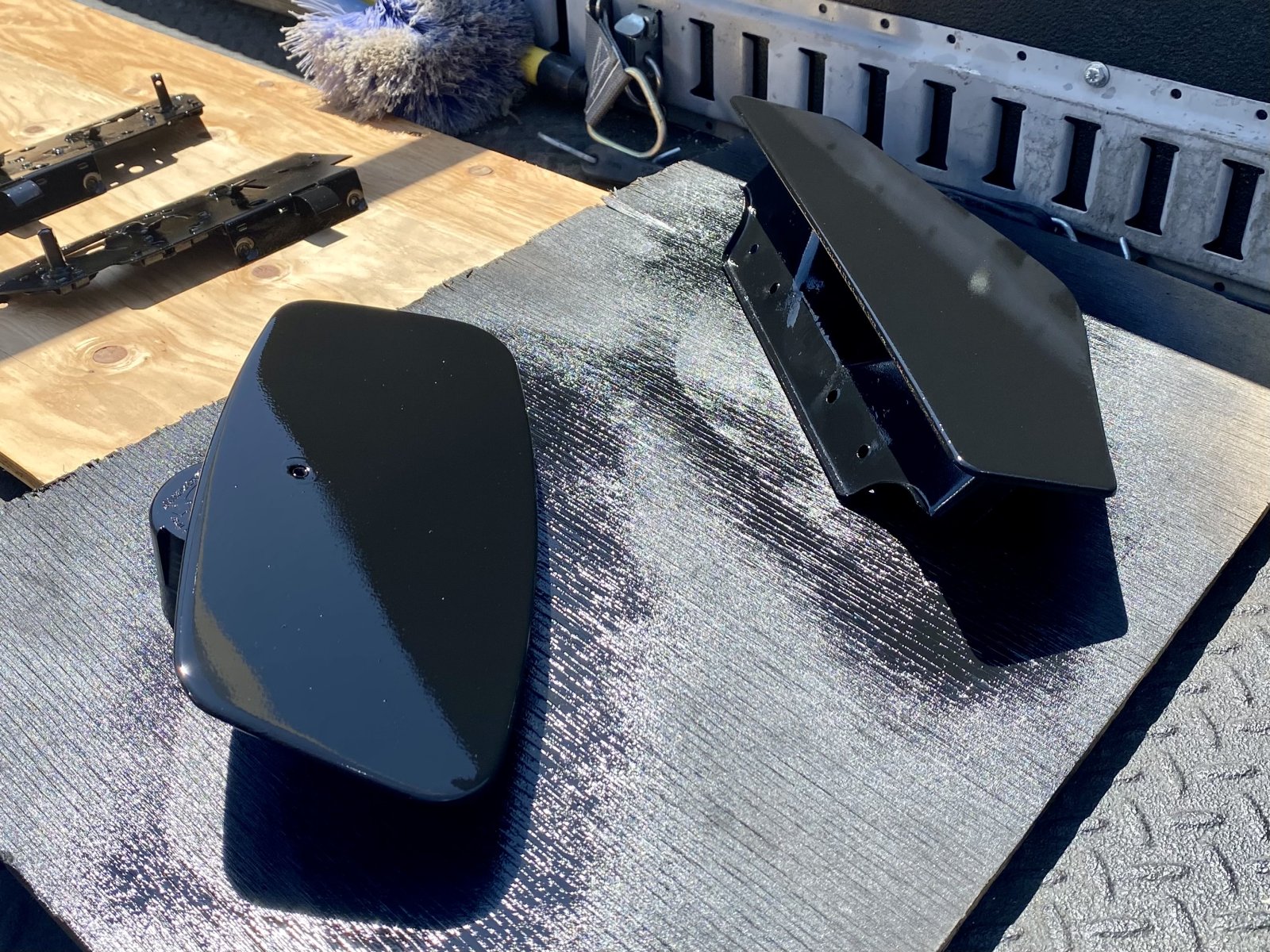

    1460ECD9-252A-4767-9D3B-7113A6FCFD38.jpeg 5C0BF143-EC90-4534-9B38-C6FA381BF80D.jpeg 1EF8D09A-B4D2-480D-B86D-9EAD1D127AAC.jpeg Well… I think They are ready to go!
    I Like my new Chopped Powder coated
    Stalks way better than the original Long Chrome ones!

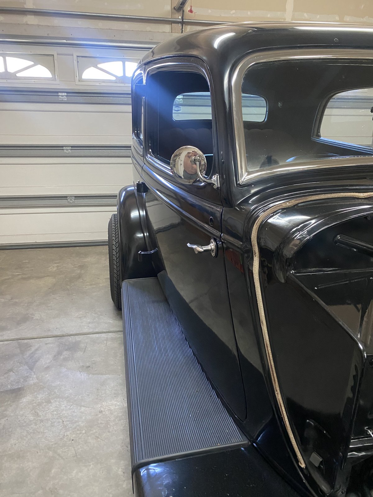

    33Doll

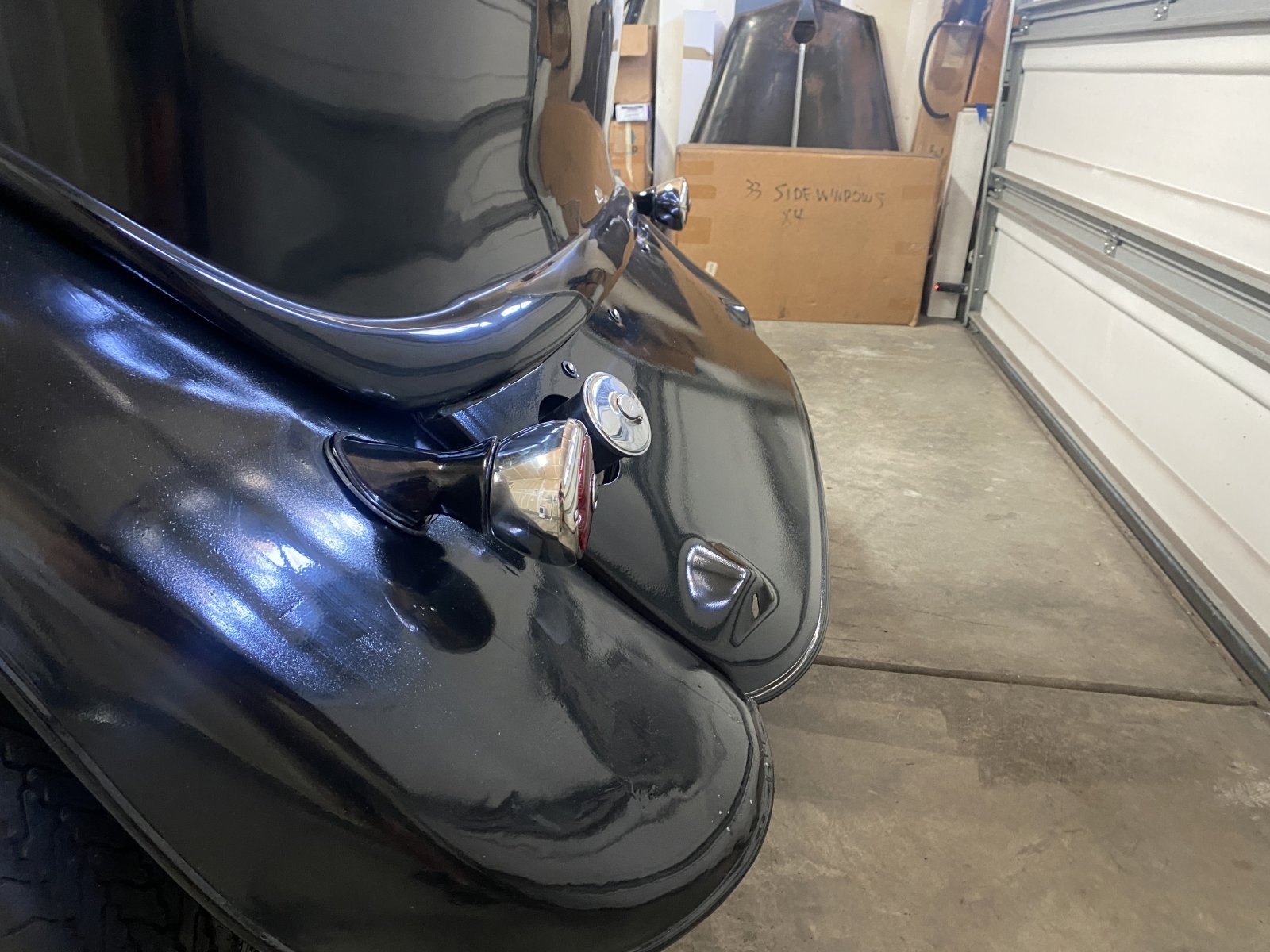

    06ABB5FA-C5A6-4945-977D-87BE3DFA9336.jpeg FB0EFB7C-A6D6-45BF-97C2-6C20AD1DF7B7.jpeg 6ECCB61A-21BB-45CD-8ED6-786EE527ED67.jpeg D4CBBF0C-0F56-4F87-A4D3-9AFA9A4C3961.jpeg 5A90D84F-27B1-43CE-948B-FA952B942C7D.jpeg B8342618-B849-4383-B03B-A9AFEEC3A05A.jpeg 2A27690C-FBD2-4FE6-92E5-EB448059BE19.jpeg Got some stuff done!
    Doors shut like ****er!

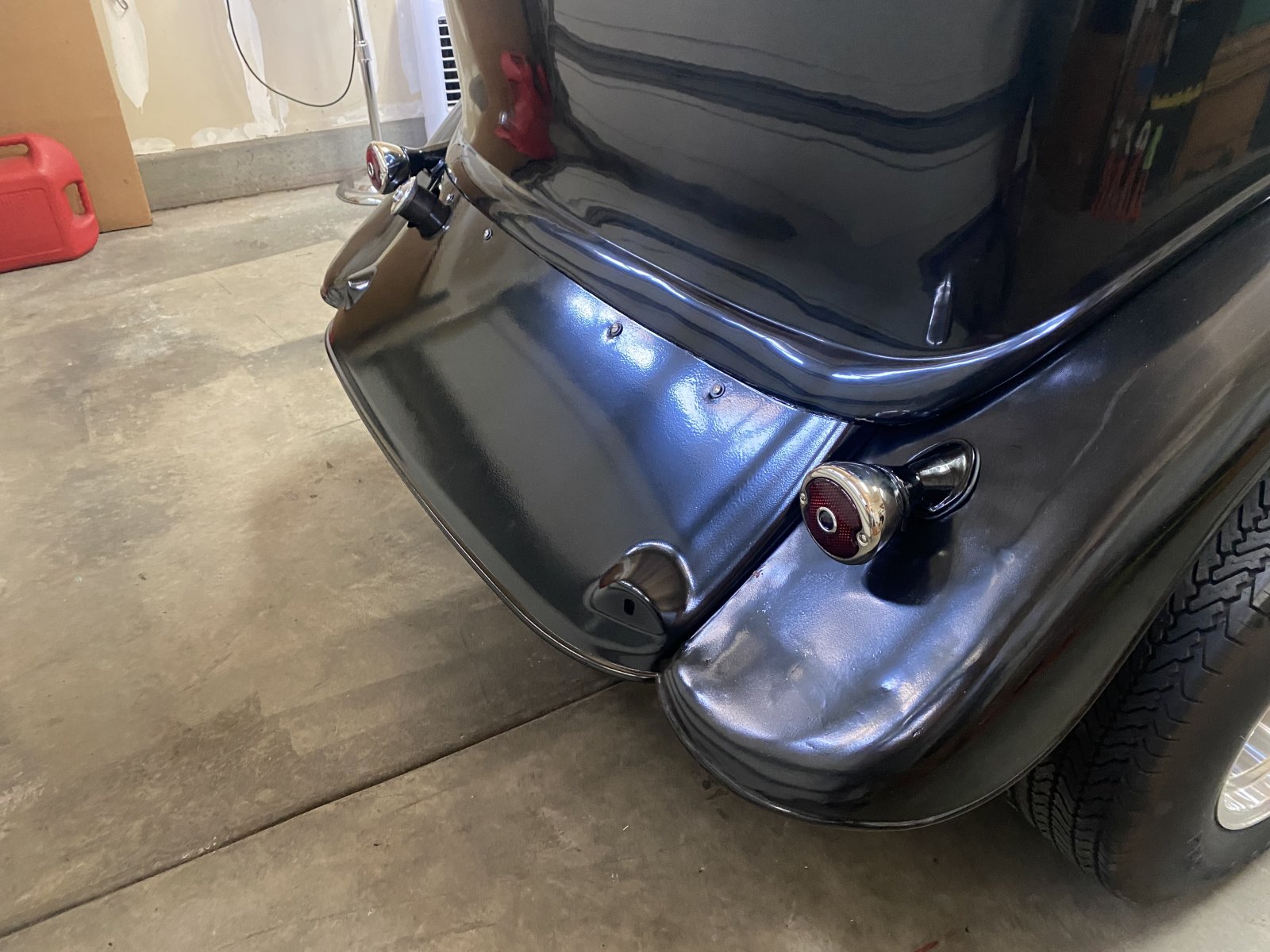

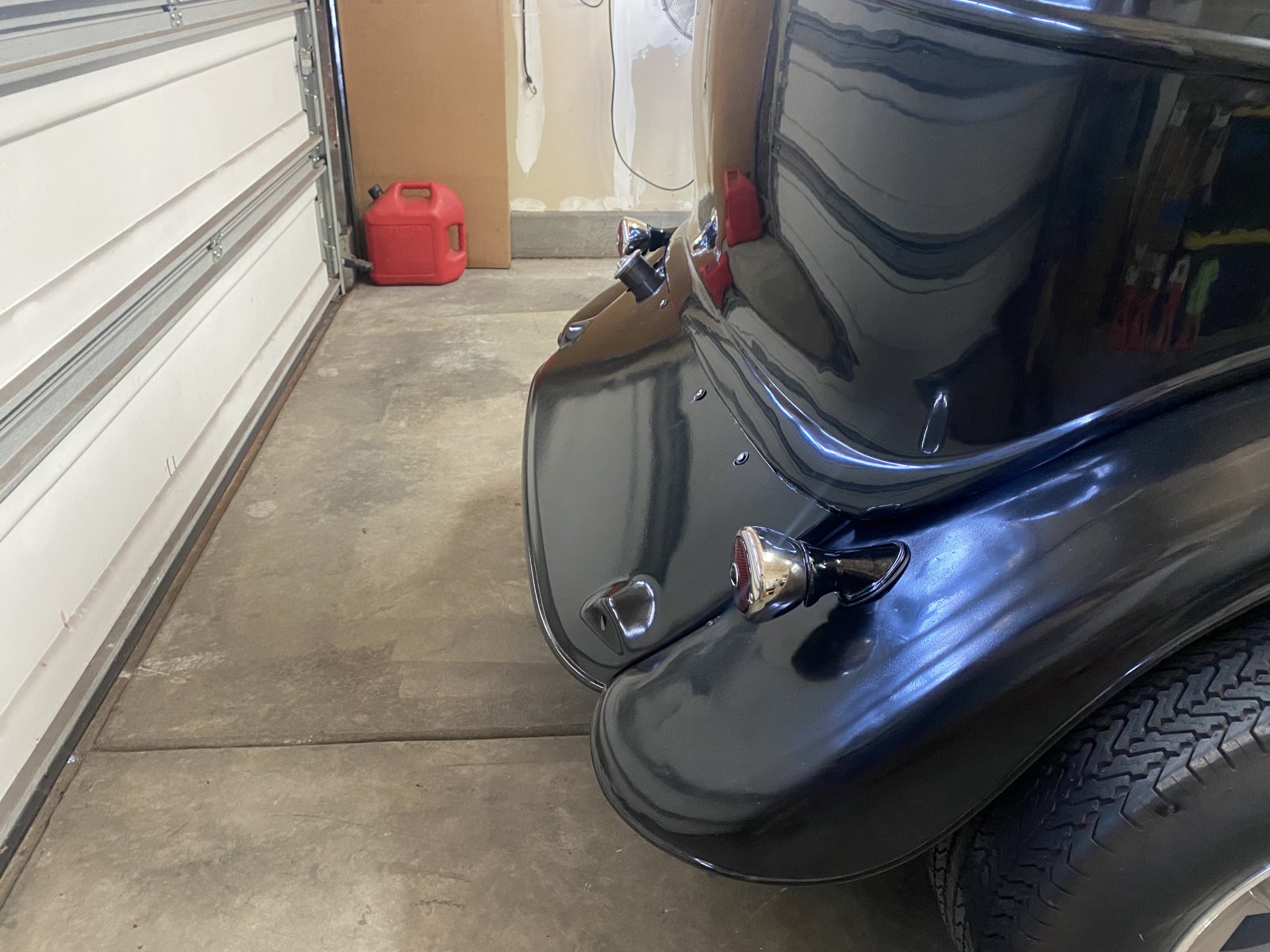

    Mirrors on, park lamps, tail lamps.
    Just need to connect all lights up.
    Stogy, JalopyJimbo, brEad and 7 others like this.

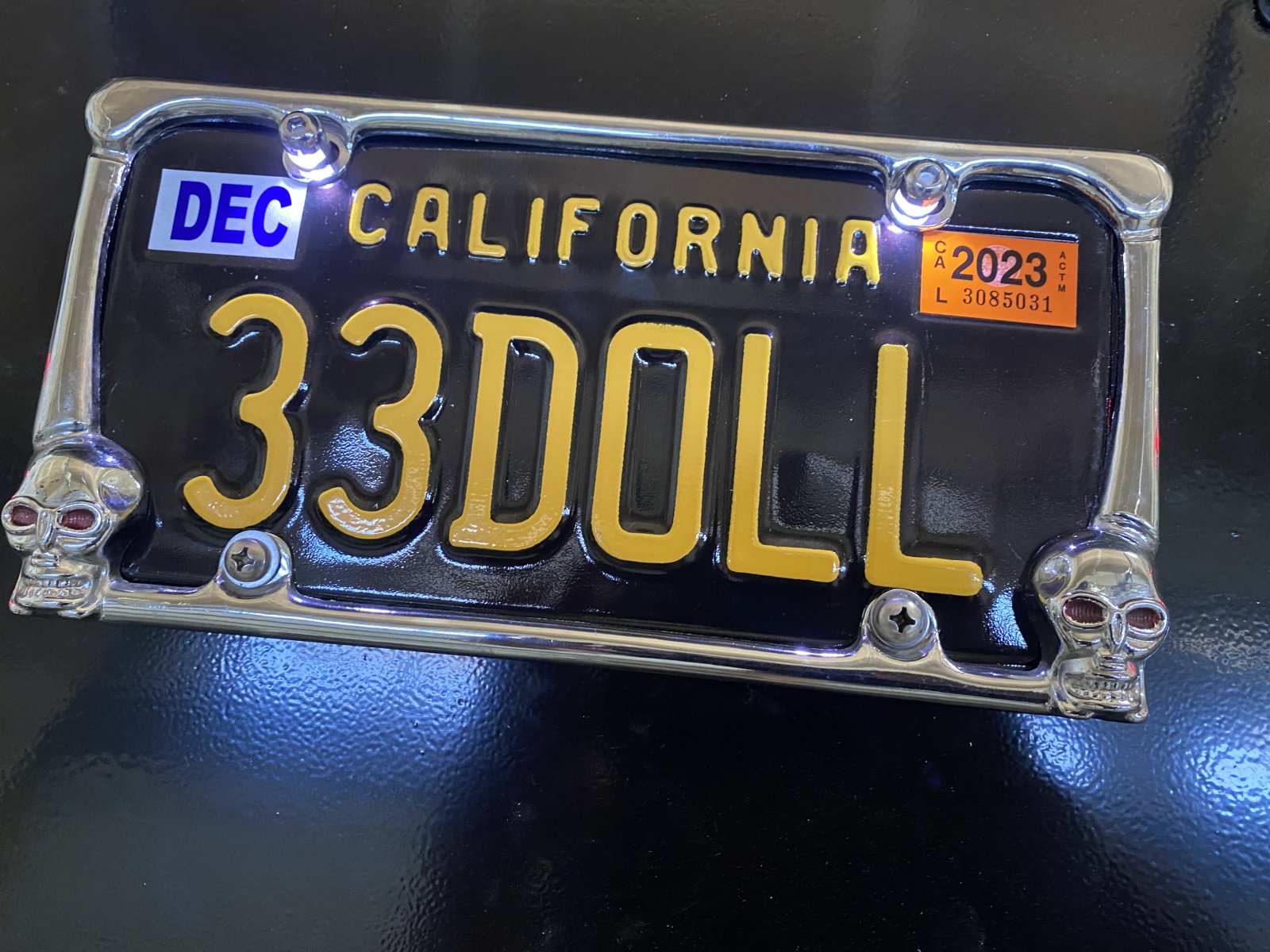

  14. 33Doll
    Posts: 1,602

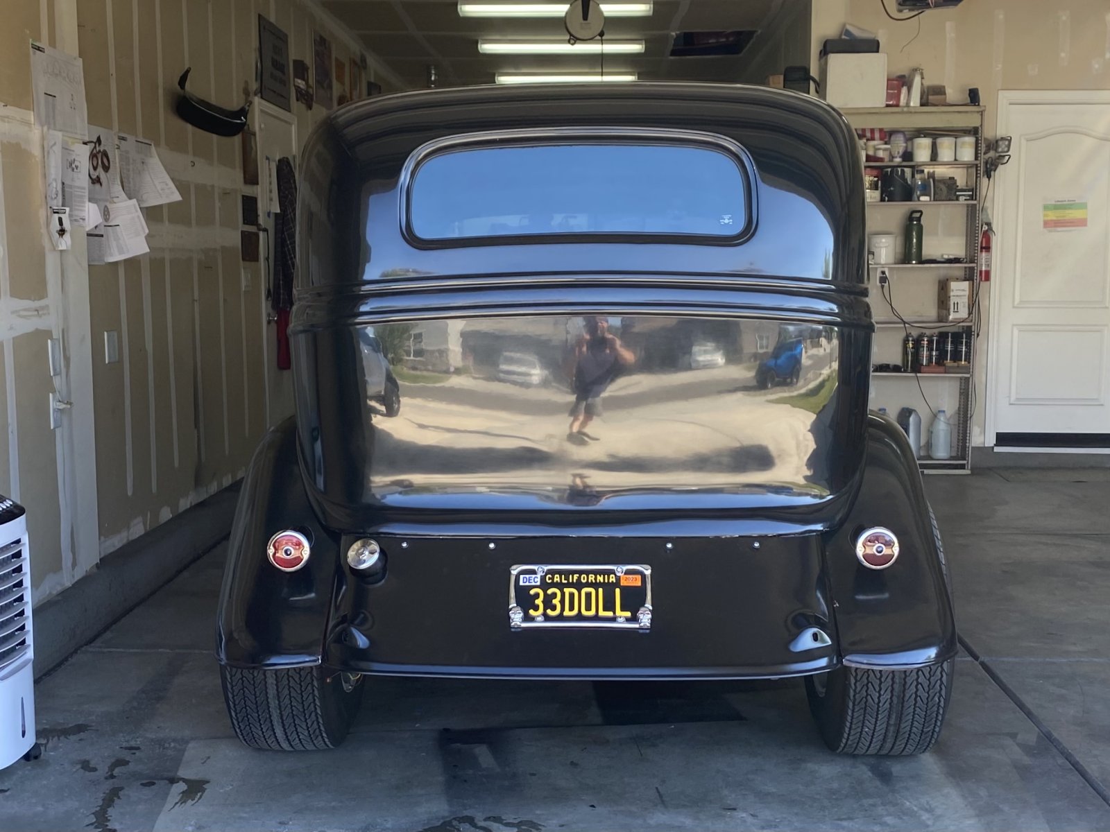

    33Doll

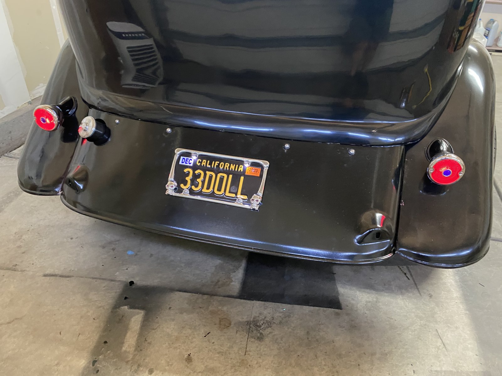

    Got the rear lights temporarily hooked up! So I know they work.
    got the Doll Plate on, and these cool “lightning Bug”LED fasteners!
    They make it super easy to have license plate lights. I think later I might drill out the skull eyes and put red LEDs.
    I think that would be kind of cool!
    787B31D4-9C55-4BCA-9E3F-C97D071E4266.jpeg AFD6260E-6DD8-41A2-8BAC-2DC8C9FEA848.jpeg 6EA35C1B-0F35-44FB-A4A5-B27136E5A53C.jpeg

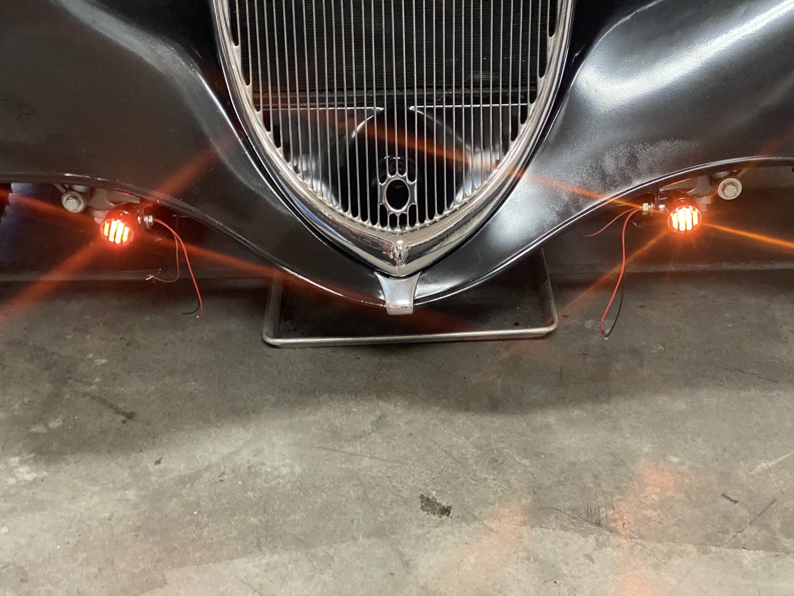

  19. 33Doll
    Posts: 1,602
    33Doll
    5E01CCD2-223D-41D5-A00E-0FA8B31DACE6.jpeg 764D8512-094A-4AA3-97EC-953599185CA4.jpeg Thanks For the Kudos!
    Appreciate it!

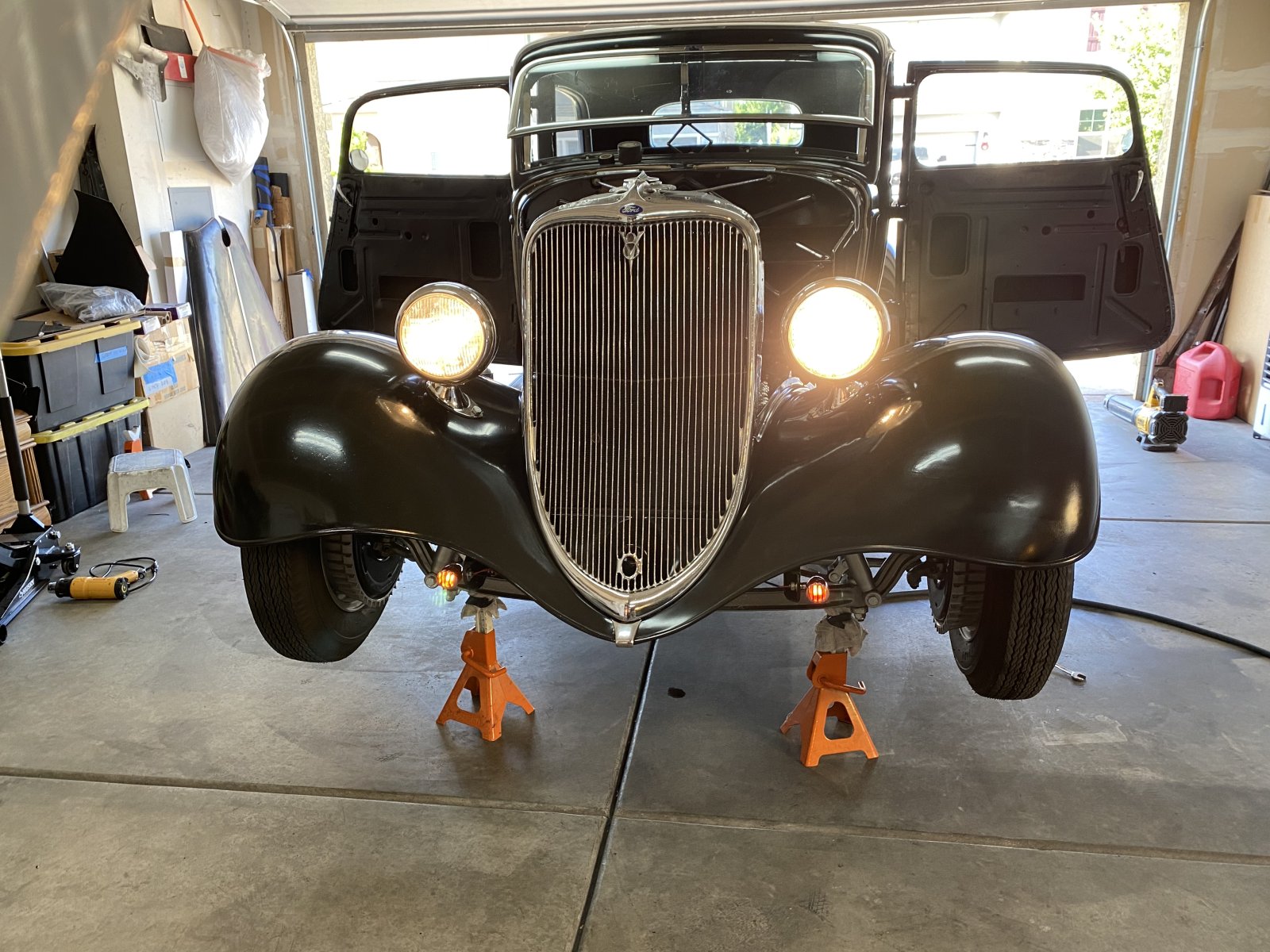

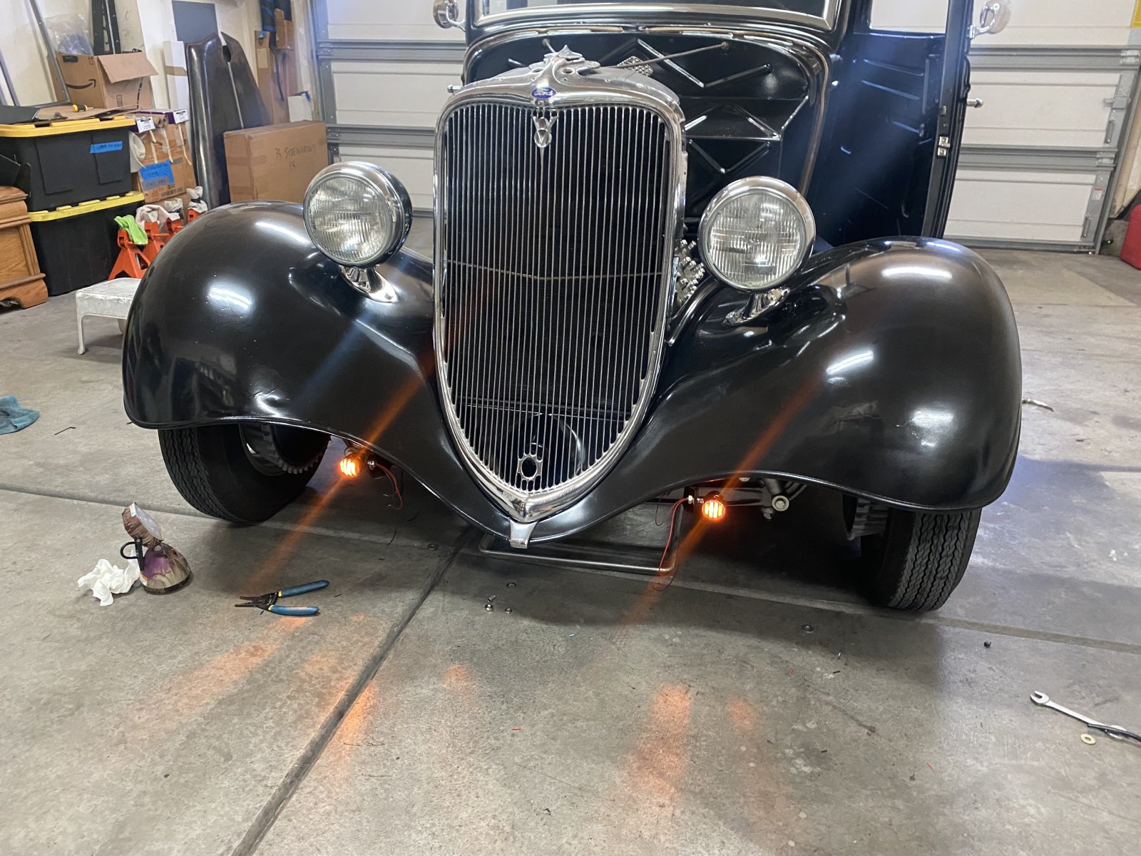

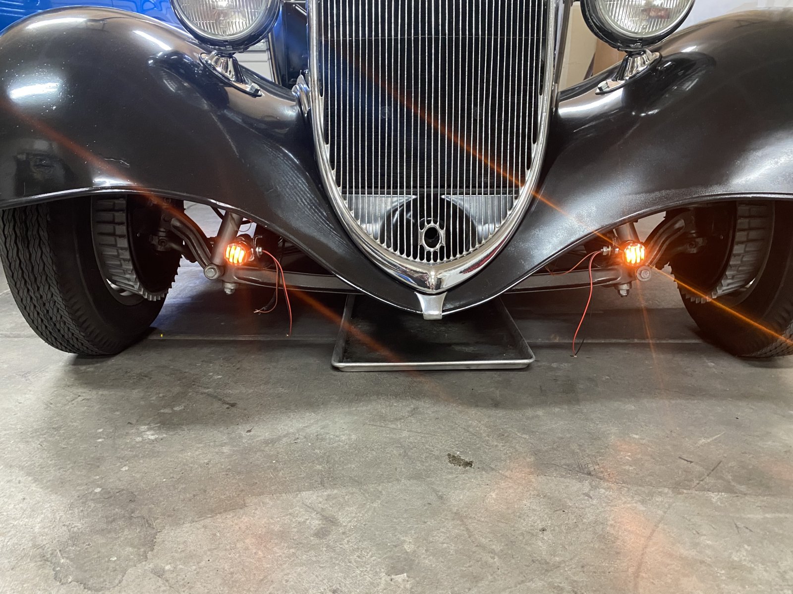

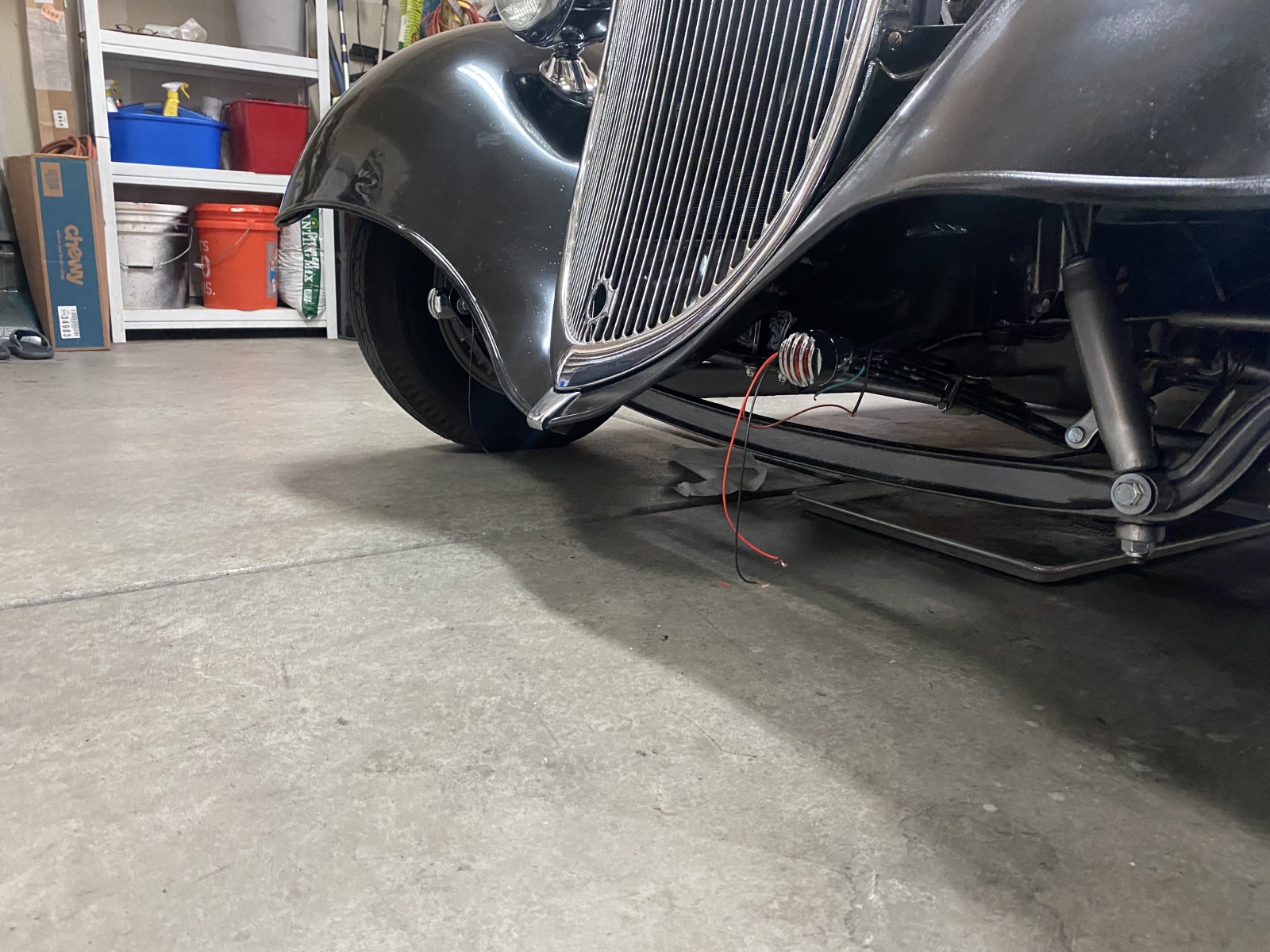

    So… I’m trying to keep this thing at least 90%, 95% traditional but with all these LED bulbs nowadays and incandescent bulb being ****py!!
    I broke down and bought some LED Shortys for these front lights!
    Of course they were so bright one was yellow instead of orange or Amber!
    So what I did is, I took some red spray paint, mixed a little lacquer thinner in it and painted the white LED Cap translucent red! Can you tell which one is incandescent, and which one is LED?
    They Both Oran-ge! Now!
    Stogy, Jim Bouchard and guthriesmith like this.
  20. dana barlow
    Joined: May 30, 2006
    Posts: 5,513

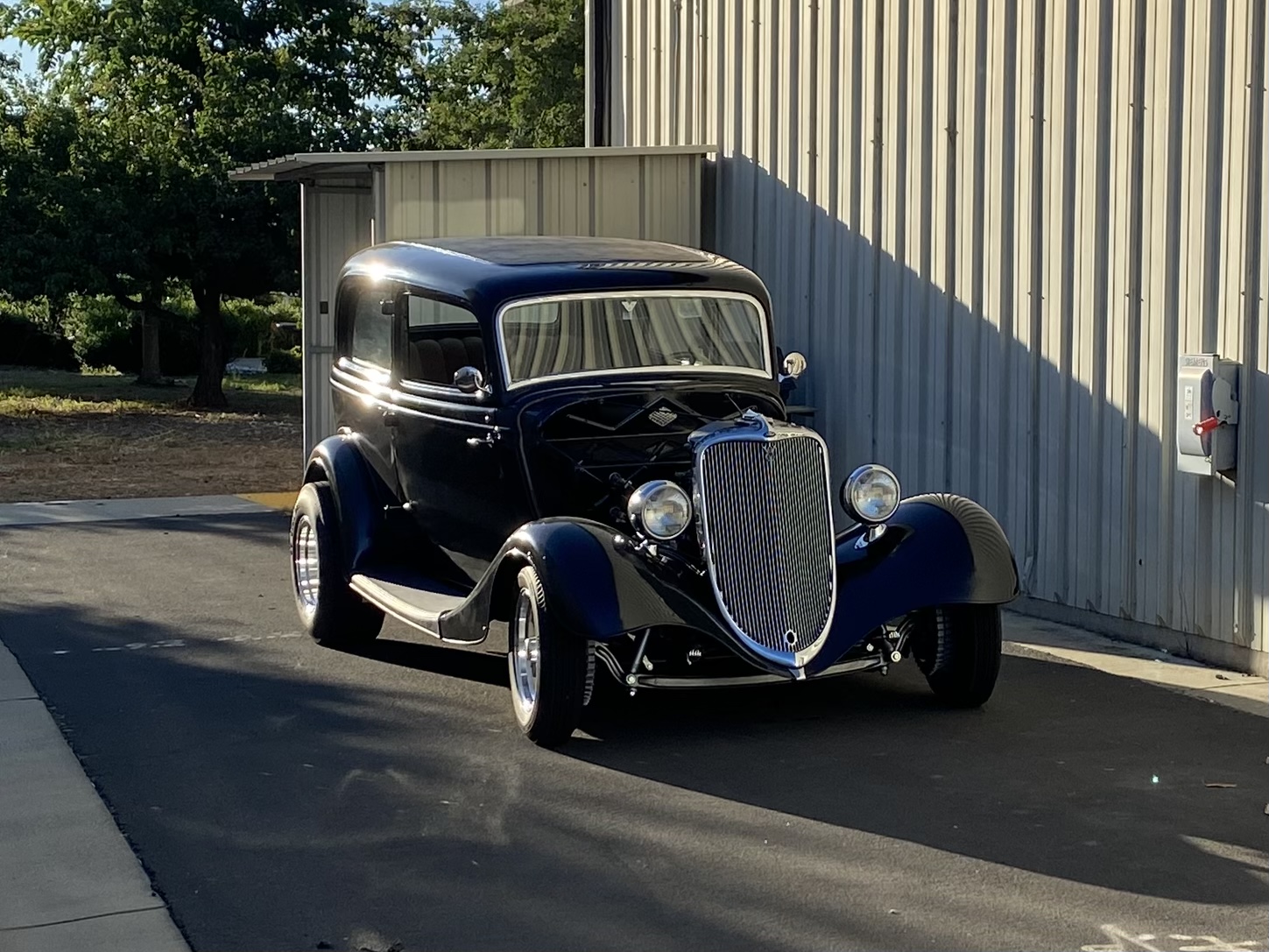

    dana barlow
    from Miami Fla.
    Leds are cute down there,but seems hard to see from a number of angles? Still far better then none. So good safety.
    The only thing in photo that dose look very off,is front rims are very far out side of were they should be= big scrub.* But someone may of talked about that already? I didn't look at all 41 pages.
  21. 33Doll
    Posts: 1,602
    33Doll
    The Wheels and drums are supposed to look like that. Its a late 60’s theme
    Munster-Barris era. They are only 4 1/2 inches wide
    I didn’t want the Cowl lamps on there.
    Looked to Resto-Roddish for me.
    But I wanted some turn signals up front so people coming towards me could see Which way I was turning.
    That is a REAL expensive Original Grille. Want to Make Sure There is no excuse for pulling out in front of me!

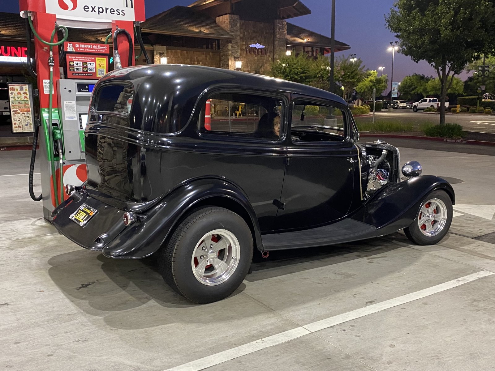

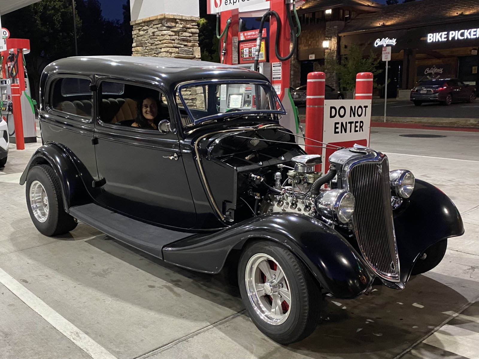

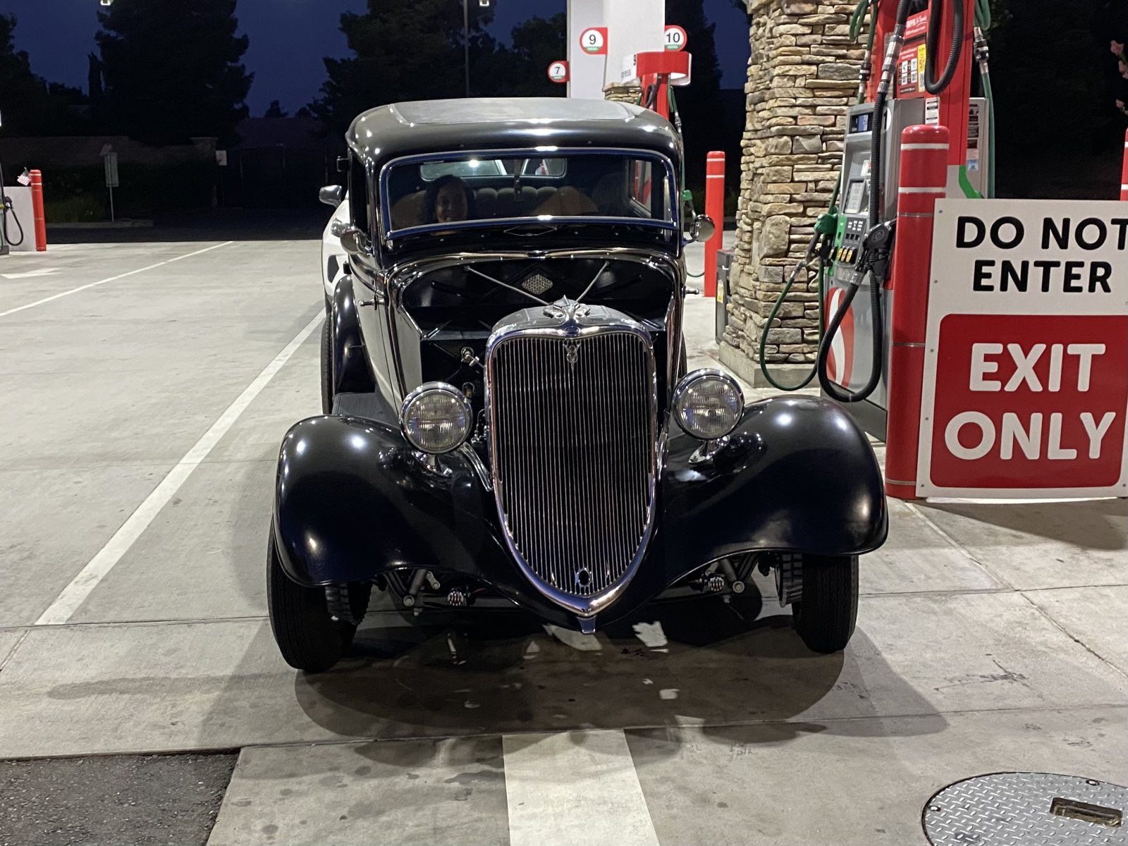

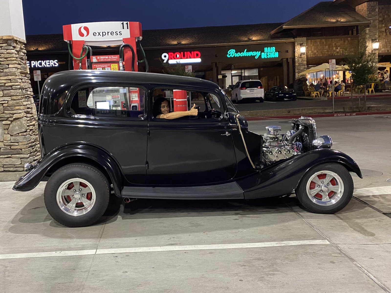

    Made it to Work! No issues!
    Supposed to be in the 90’s today
    We will see how the old flatty is on the way home!
    Stogy, dumprat, Outback and 8 others like this.
  28. brEad
    Joined: Dec 23, 2016
    Posts: 2,039
    brEad
    Looks good out in the wild! Just the right amount of tire poke.
    Stogy and 33Doll like this.

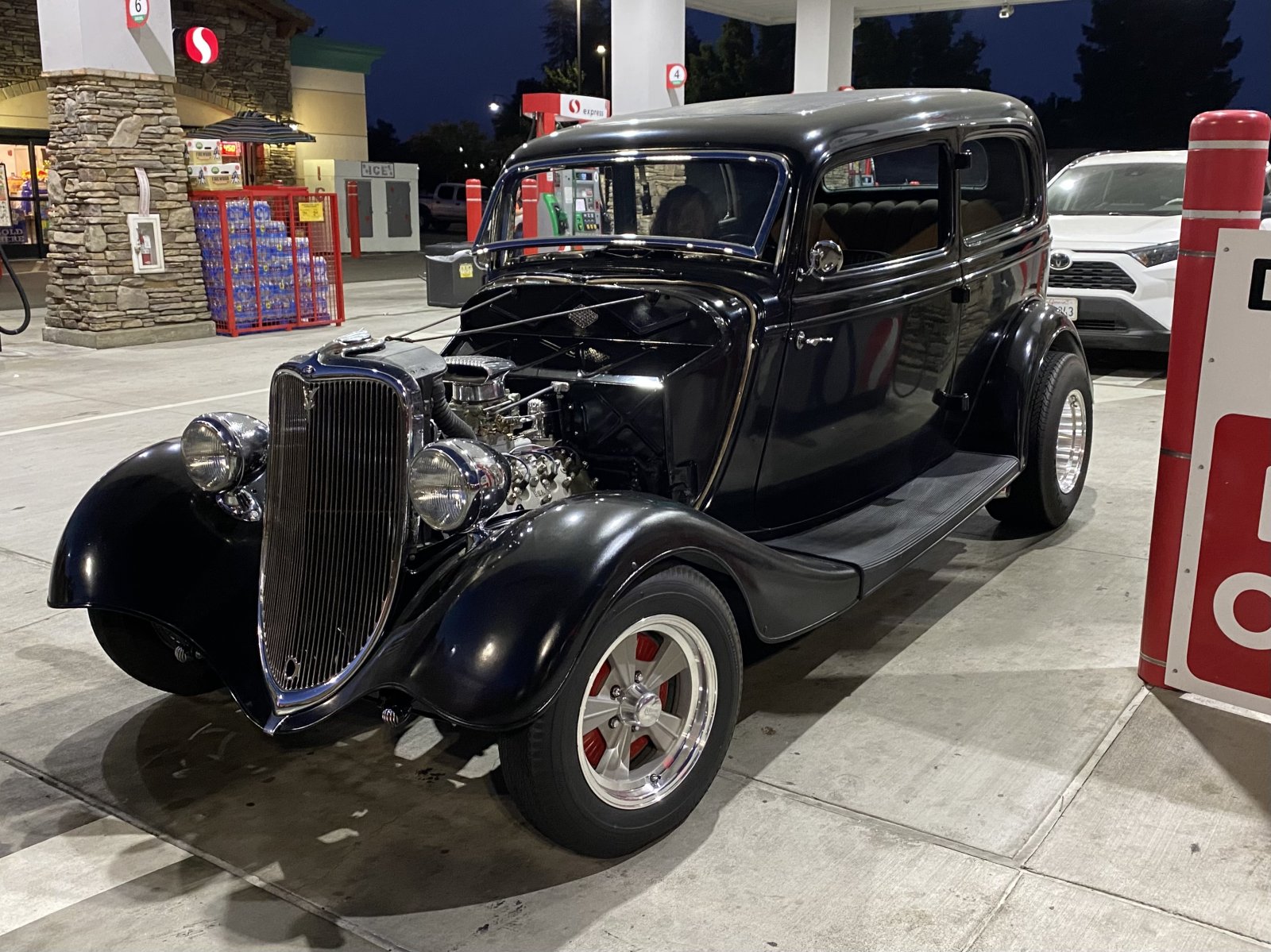

  29. 33Doll
    Posts: 1,602
    33Doll
    Well made it home!
    No real issues.
    -Gas cap leaks around corners
    -little grind between 2-3rd
    Probably need to adjust the clutch a bit
    -Ran 150 in the morning 180 in afternoon at 90 outside
    -And 190 on the freeway at 60mph
    For 8 miles Flat Road
    Not sure about 100 + weather yet
    Stogy, brEad, dumprat and 3 others like this.
