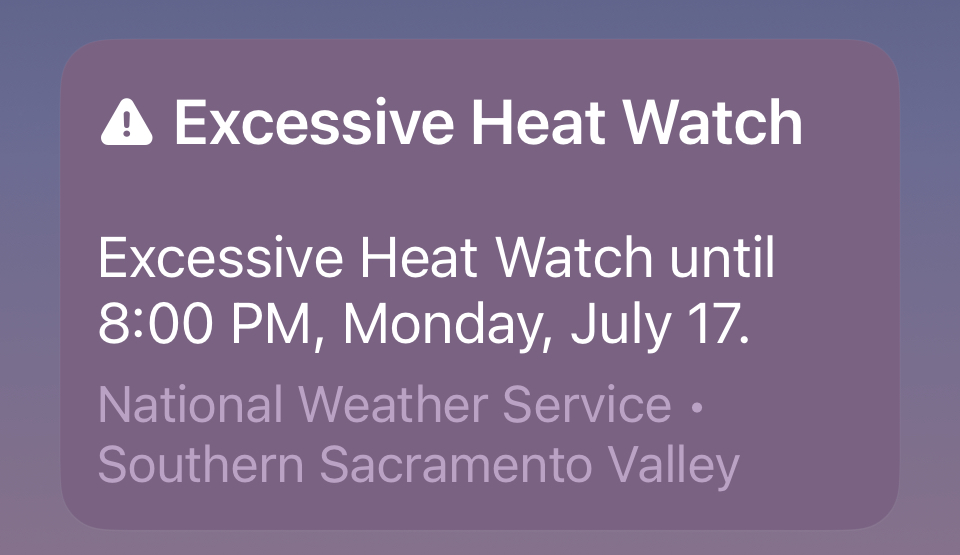

    Well, I don’t think I’m gonna go to the car show on Friday! BUMMER!
    It wouldn’t be any fun anyway with it being that hot!
    Man! It was in the 70s all this last two weeks!!!

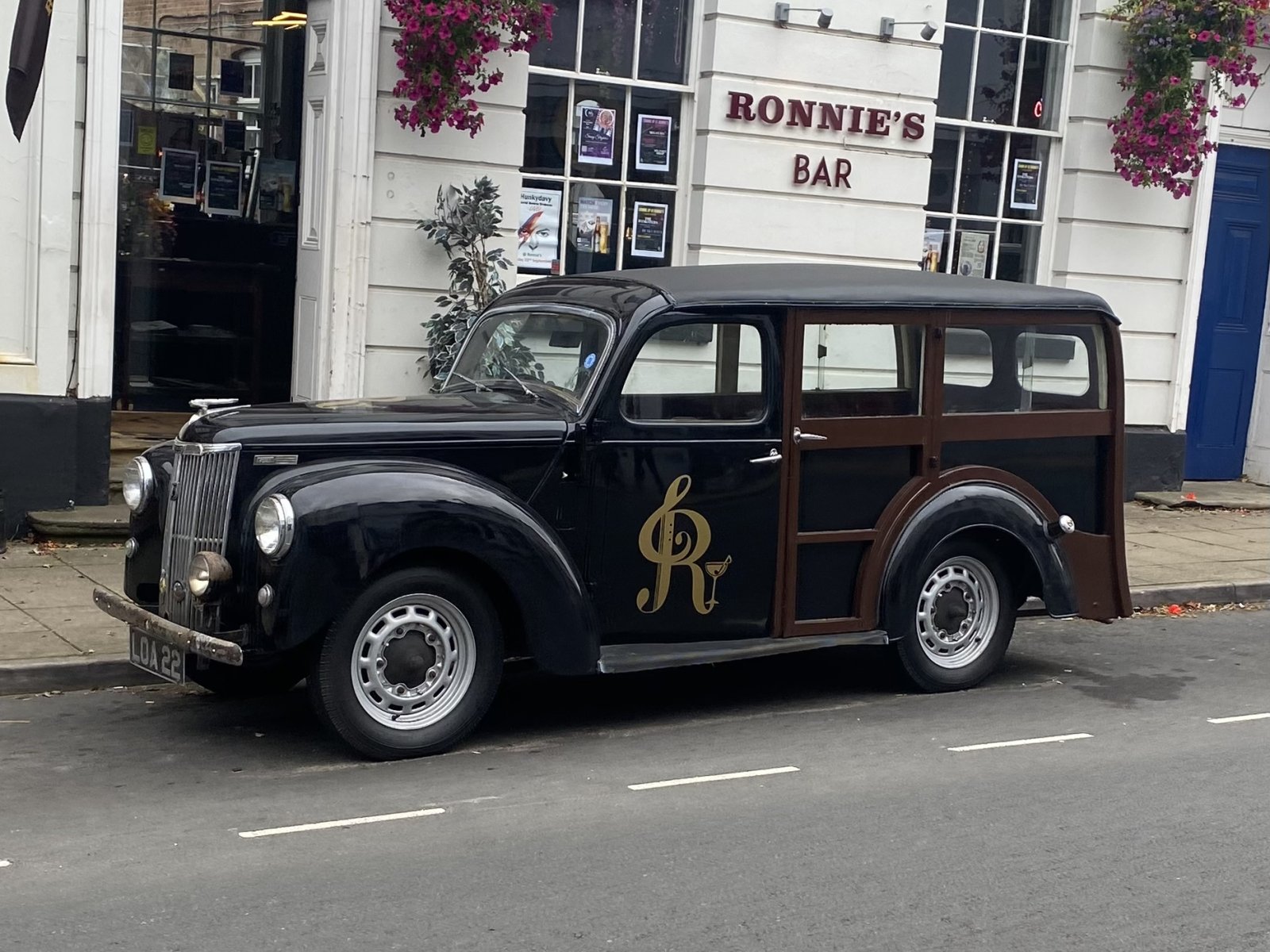

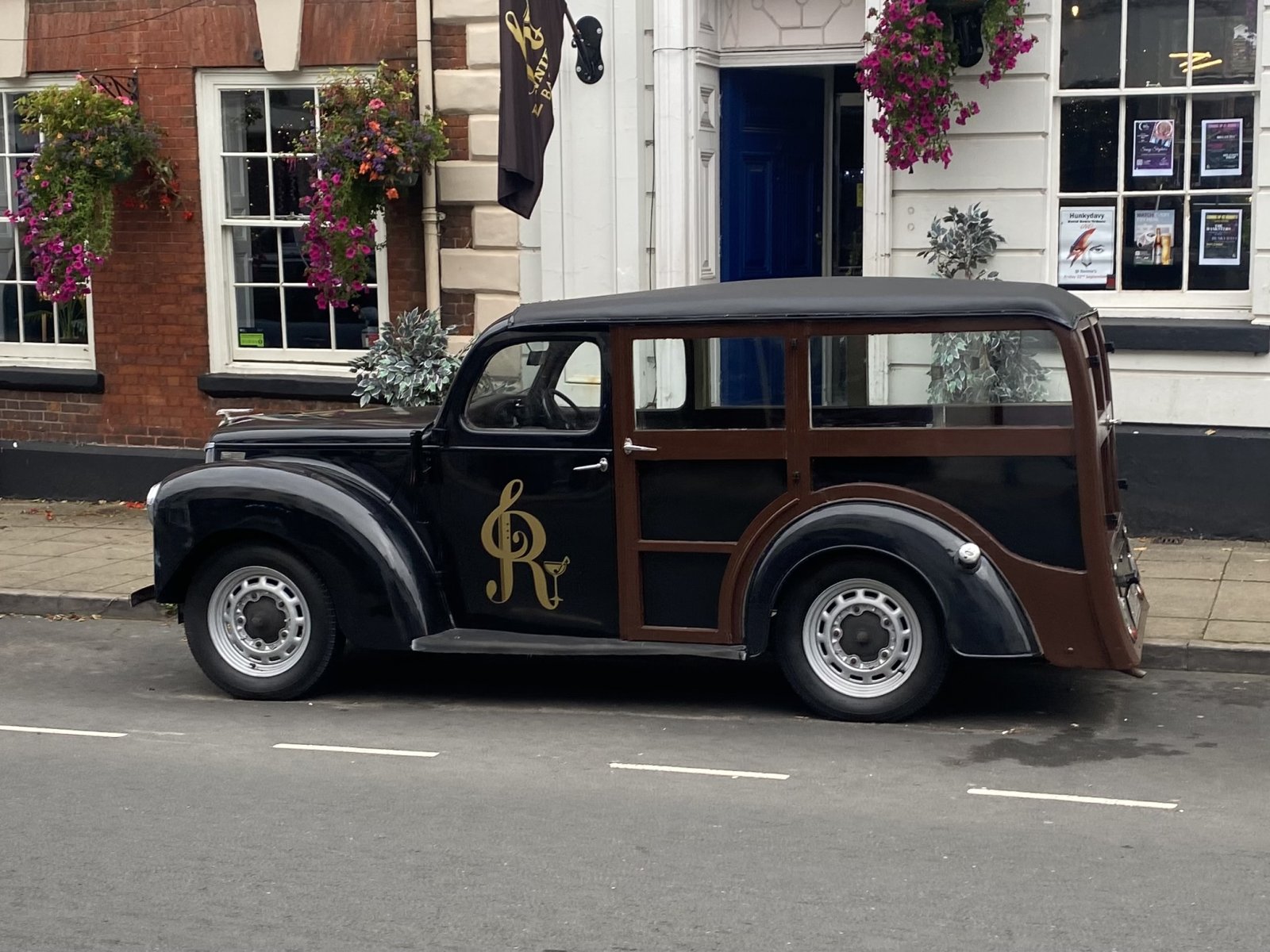

    EE4F9D99-21FA-45AA-9347-6CD1CC26CE02.jpeg 16DDEC01-DC57-4542-AA25-083294767E1E.jpeg 1448B4FC-5CAC-4259-8AF3-7B5C82845B80.jpeg 8D0D87BC-4C88-4A73-9191-27F4DBFD71D8.jpeg 00681454-9AAA-4140-9B4B-FED210C6C405.jpeg D1591CAD-14B1-4488-8936-E82D4C43E169.jpeg AA9B1E27-3C15-4BB7-851D-A974EBA9A6A5.jpeg F3A7E2BD-7CB8-491D-AB88-5D037545B779.jpeg 1559EC82-9190-4A49-BD17-E3FCF045C55B.jpeg 6096386D-EEC9-466A-9A87-5BFF72F8B69A.jpeg 4F97A793-0BC7-4B52-A390-30F9E0656113.jpeg Last Night in London!
    Fun…. But Homesick!!!
    Just when we figured out the “tube”
    Here’s a few pics to wrap it up! And a car that I came across that I can’t figure out what it is but it’s cool!
