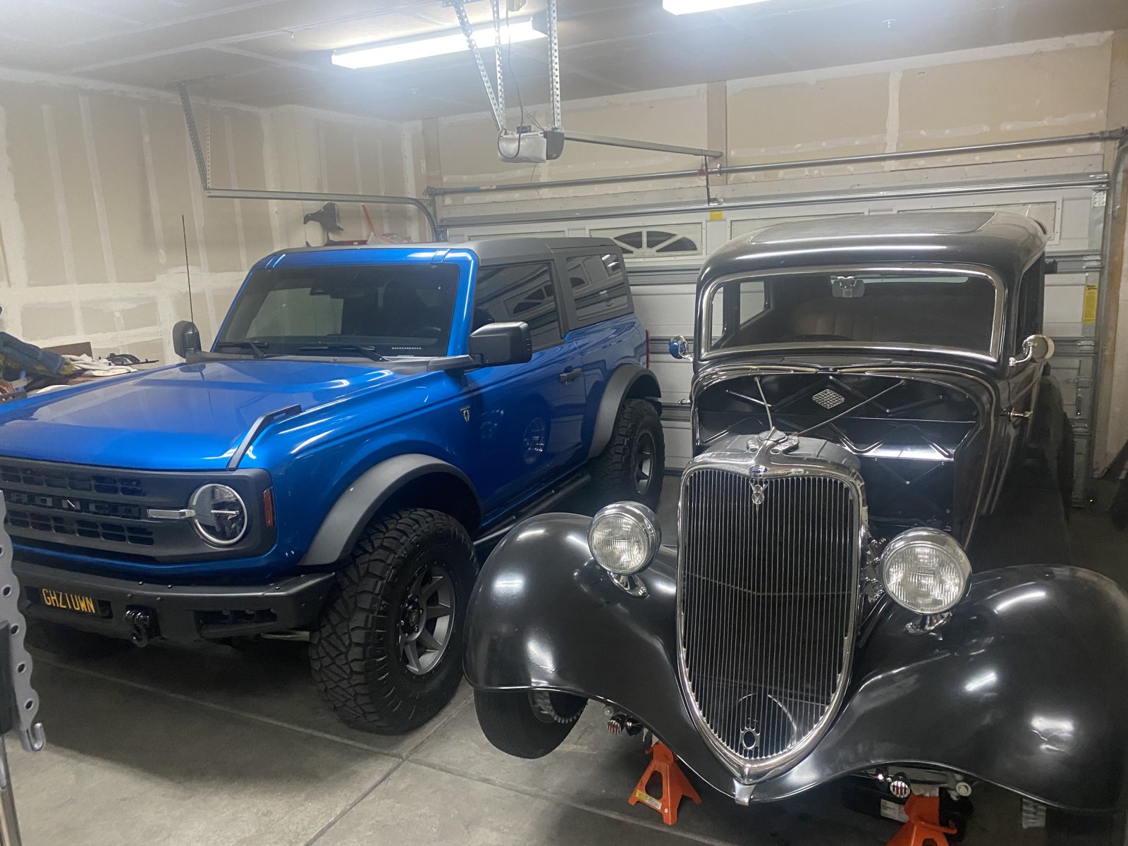

    8348476A-06A3-4A58-A3CA-3F76F67F3718.jpeg Home At last!
    There’s my Babies!
    Stogy, brEad, loudbang and 2 others like this.

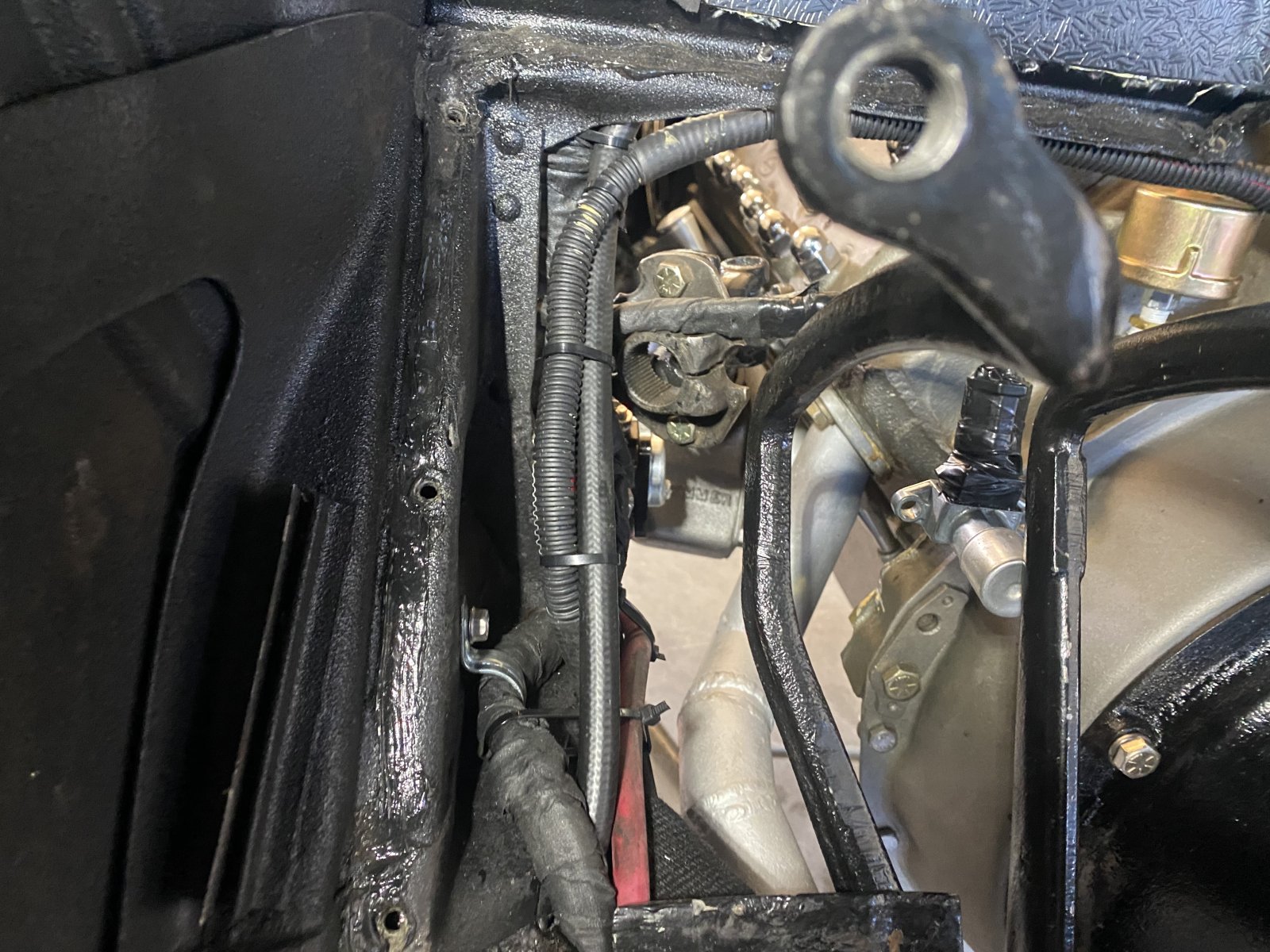

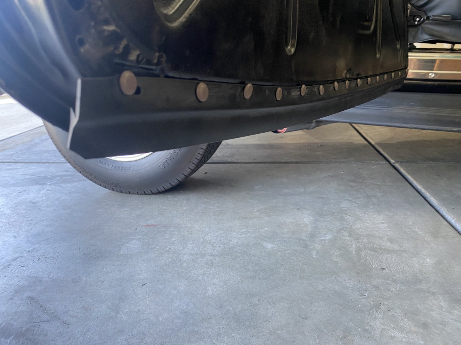

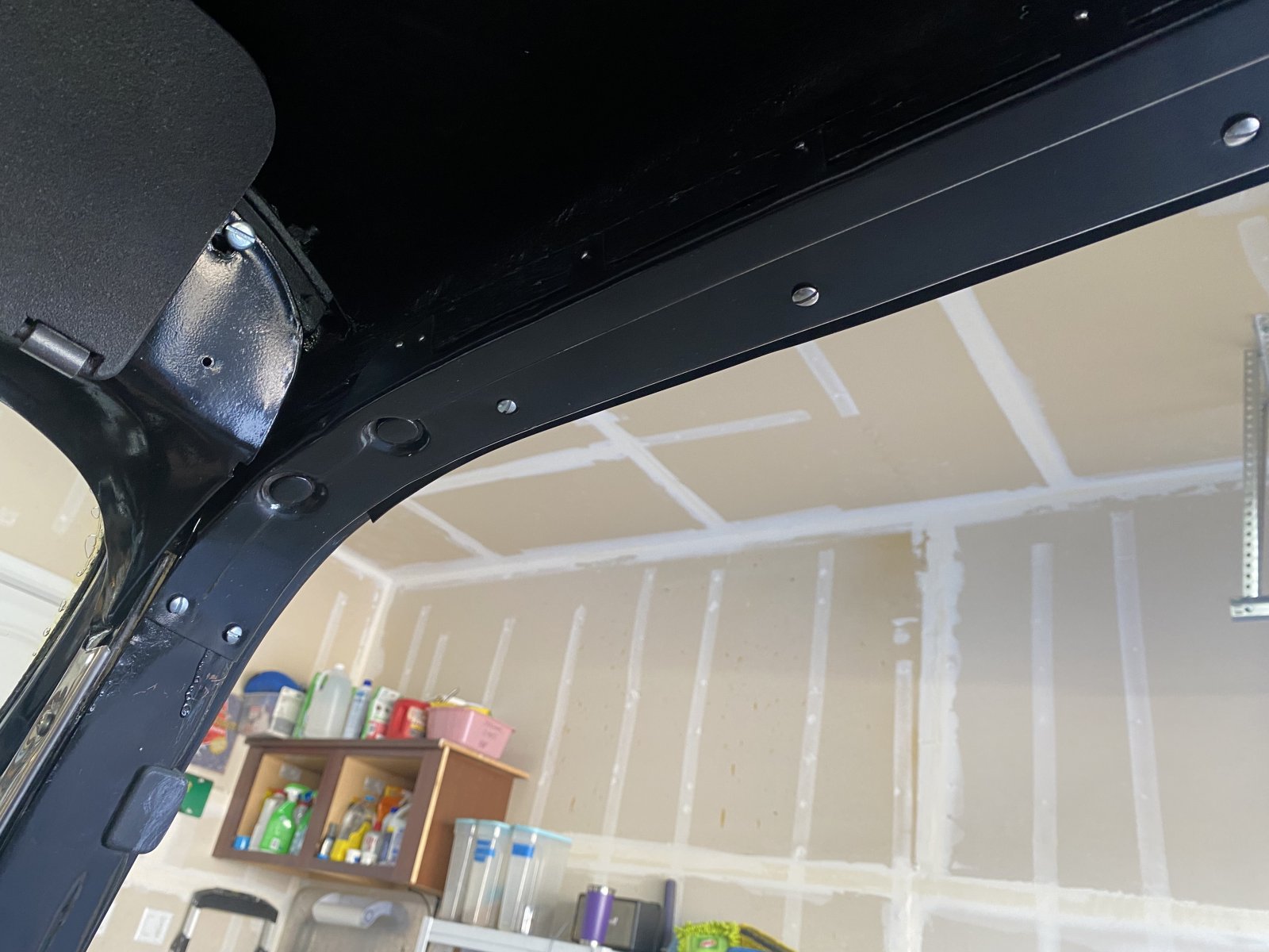

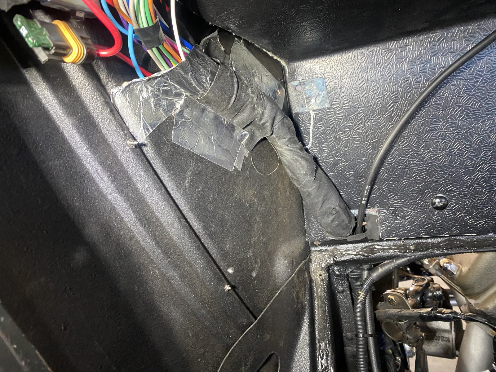

    IMG_0759.jpeg IMG_0761.jpeg IMG_0765.jpeg Some more done today.
    Decided to tuck and secure the wires better, whilst I had the Floorboard out.
    Probably regret it later when I can’t get my fat hands in there!
    Kind of miffed my nut inserts aren’t working out as well and I thought!
    Some of them are just spinning around because the threads are kind of screwy.
    So back to sheet metal screws here in there. Oh well, I’m gonna rubberize it all when I’m done playing around.
    Stogy, Jim Bouchard and loudbang like this.
  9. dumprat
    Joined: Dec 27, 2006
    Posts: 3,572
    dumprat
    from b.c.
    Tack the nutserts solid and run a tap through them?

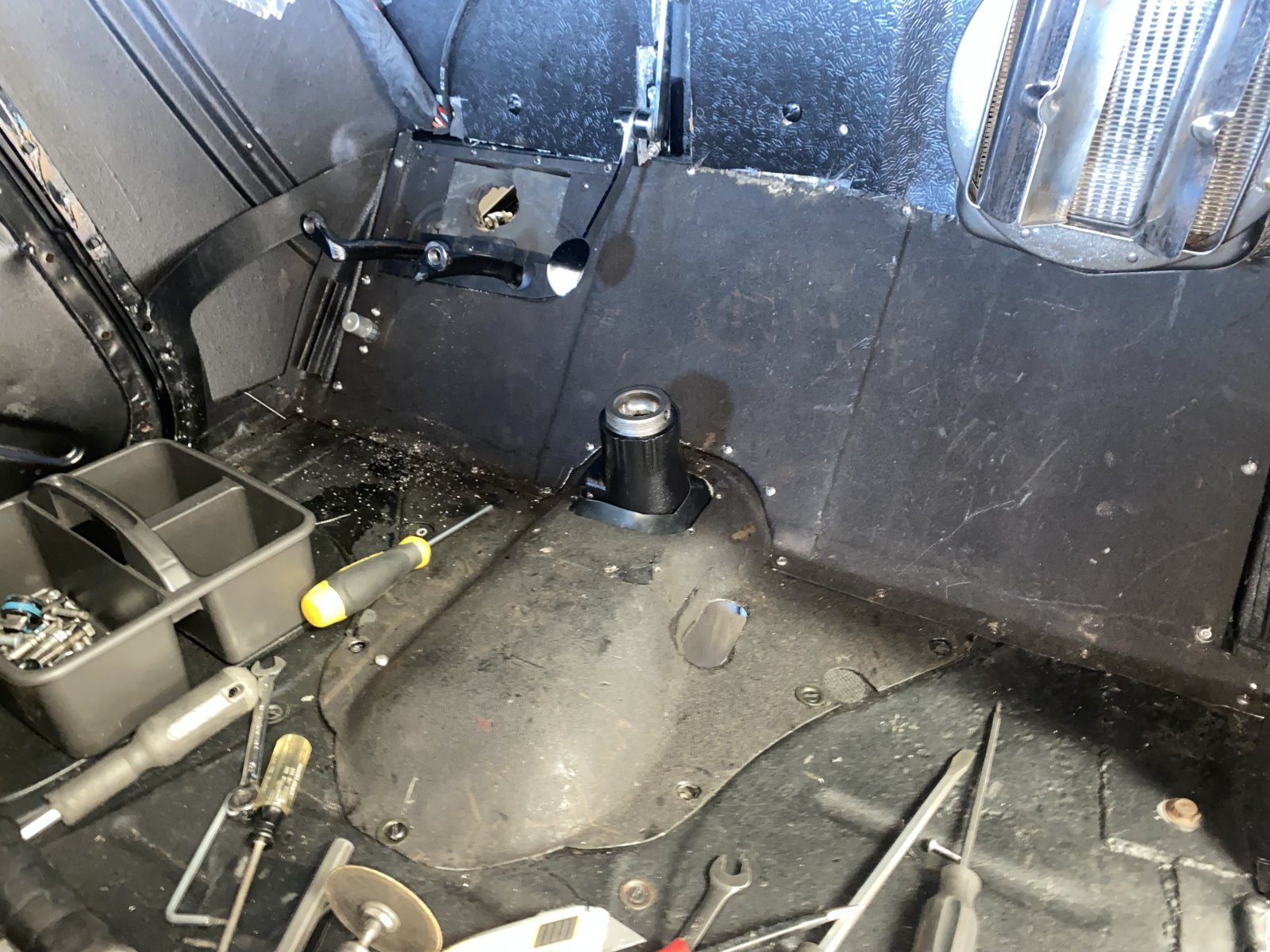

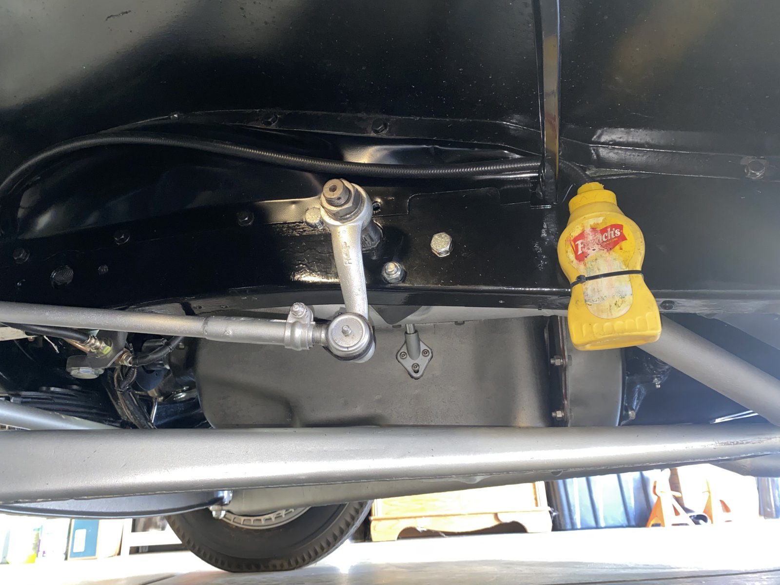

    IMG_0768.jpeg IMG_0769.jpeg Got her back together!
    Shifts good, but stiff, and now it pops out of second on the way down, up is fine. I think it’s the shifter. I tweaked the concaved washer that’s on top underneath the little pivot, cap and I think it’s hanging up a little bit.
    I flatten it a little bit in the vice to tighten it up around the base of the shifter itself because it was sloppy, but I think it’s too tight. I hope that’s it but I don’t care anymore. I’m just driving the son of a *****!
    Shifts good now anyway !

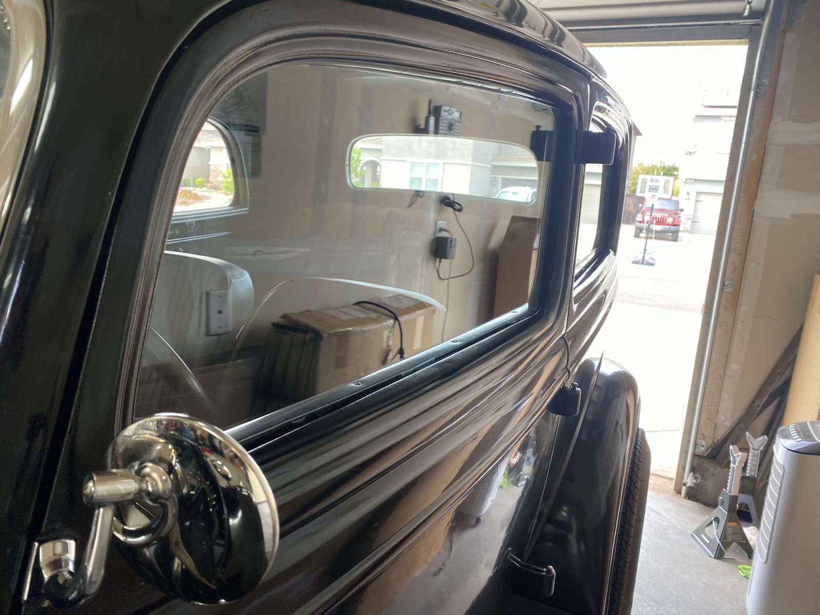

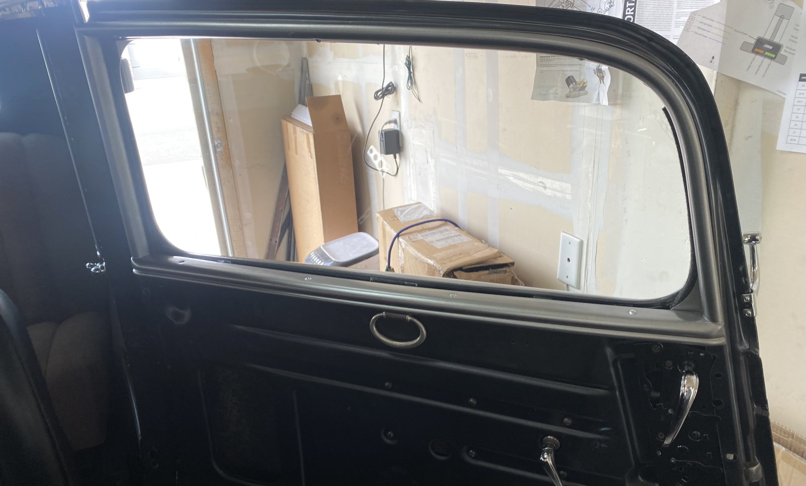

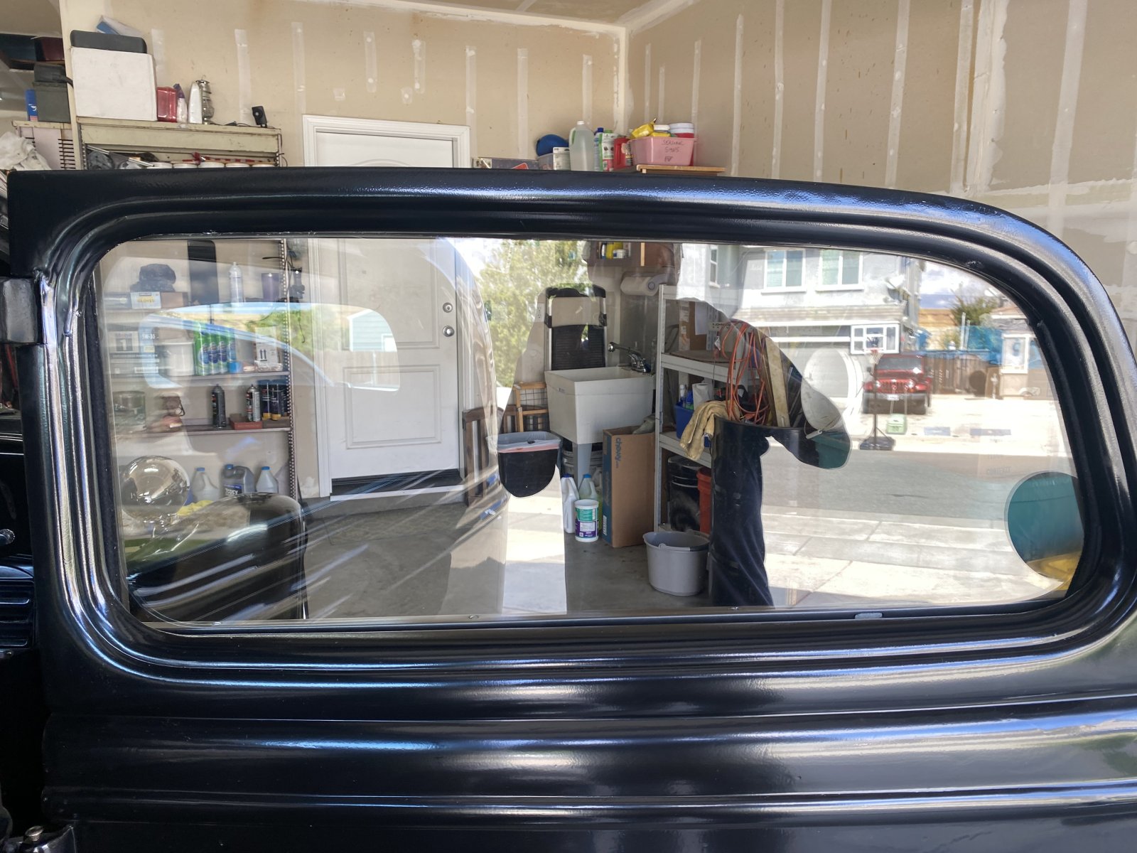

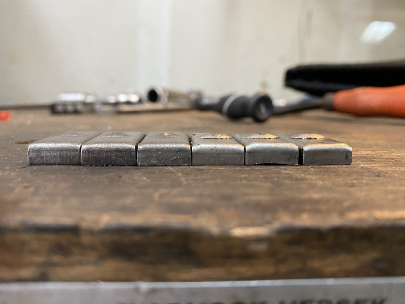

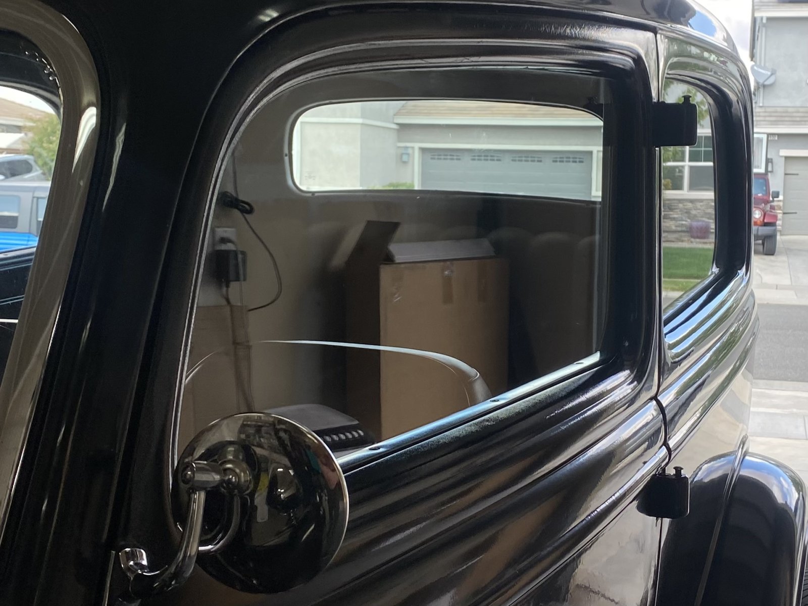

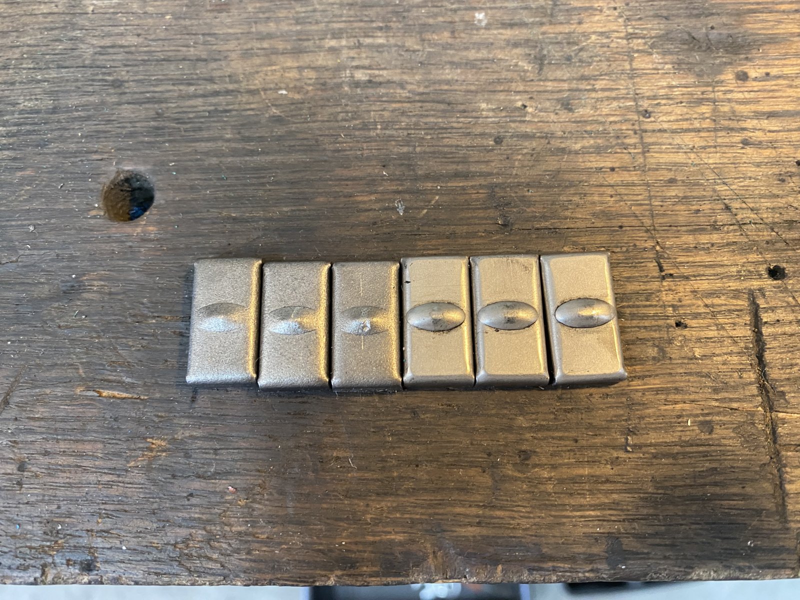

    IMG_0773.jpeg IMG_0772.jpeg IMG_0774.jpeg IMG_0776.jpeg IMG_0775.jpeg Well, I think I figured out why the ****** pops out of second gear!
    I had read, or heard something very briefly in one of the videos I saw about the after market D-tents being not as good as the old ones… sure enough when I was putting stuff away, I found the extra ones, and the old ones and sure enough huge difference, but I’m not gonna take it apart. I’m just gonna hold it in second gear for now, and hopefully will break-in eventually.
    I got one of the driver windows in, boy that was a *****!!!
    It’s not perfect, but it rolls up now!

    That's a good solution if they're steel...
    They really have to be installed with a serious crimp and even with that they are a pretty light duty solution especially on thin gauge material...
    Does adding a washer over the nutsert in the back to increase the grip length make sense on thin gauge material if accessible?
    The tap really makes sense as any interference increases the chance of failure...

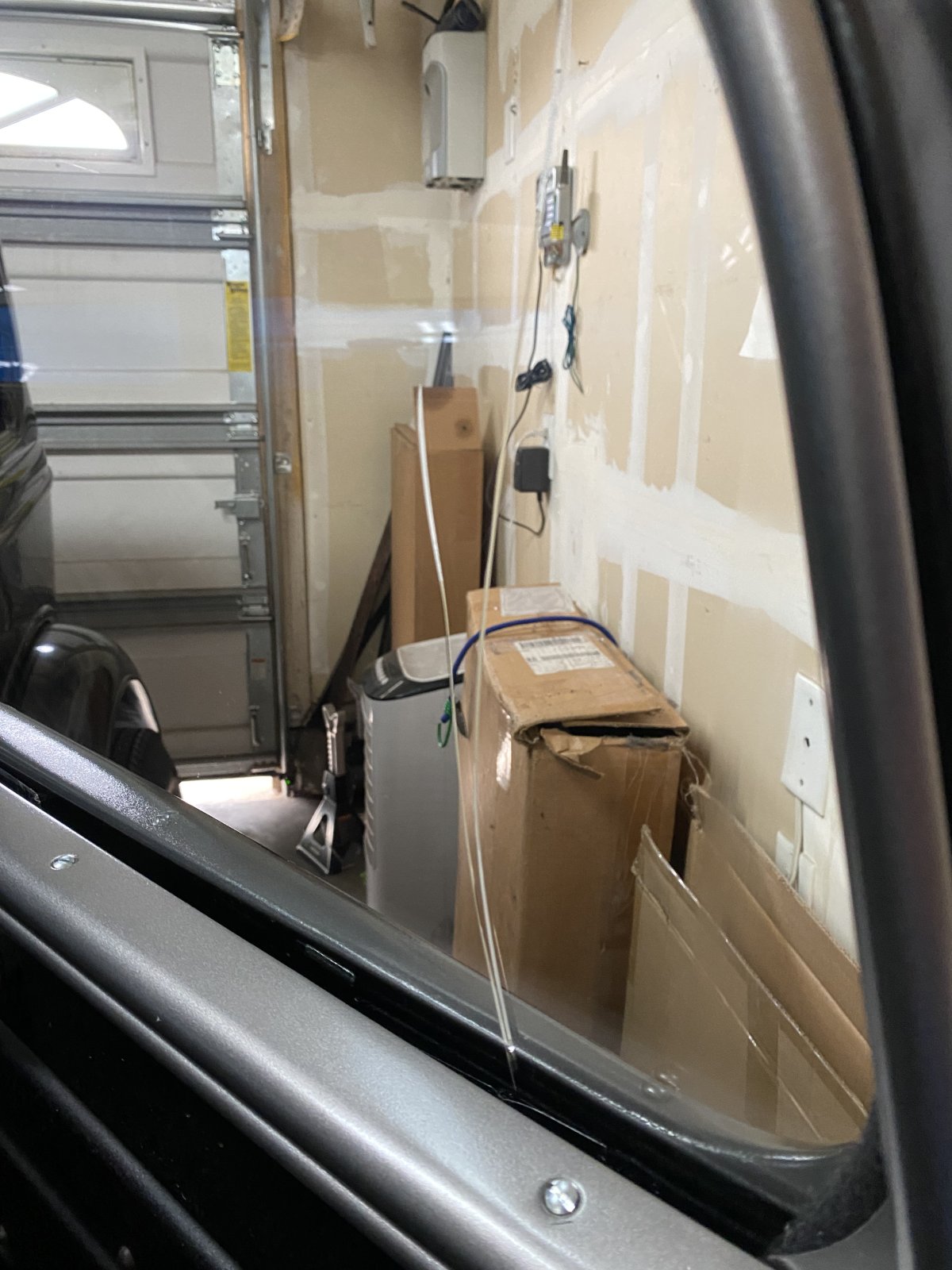

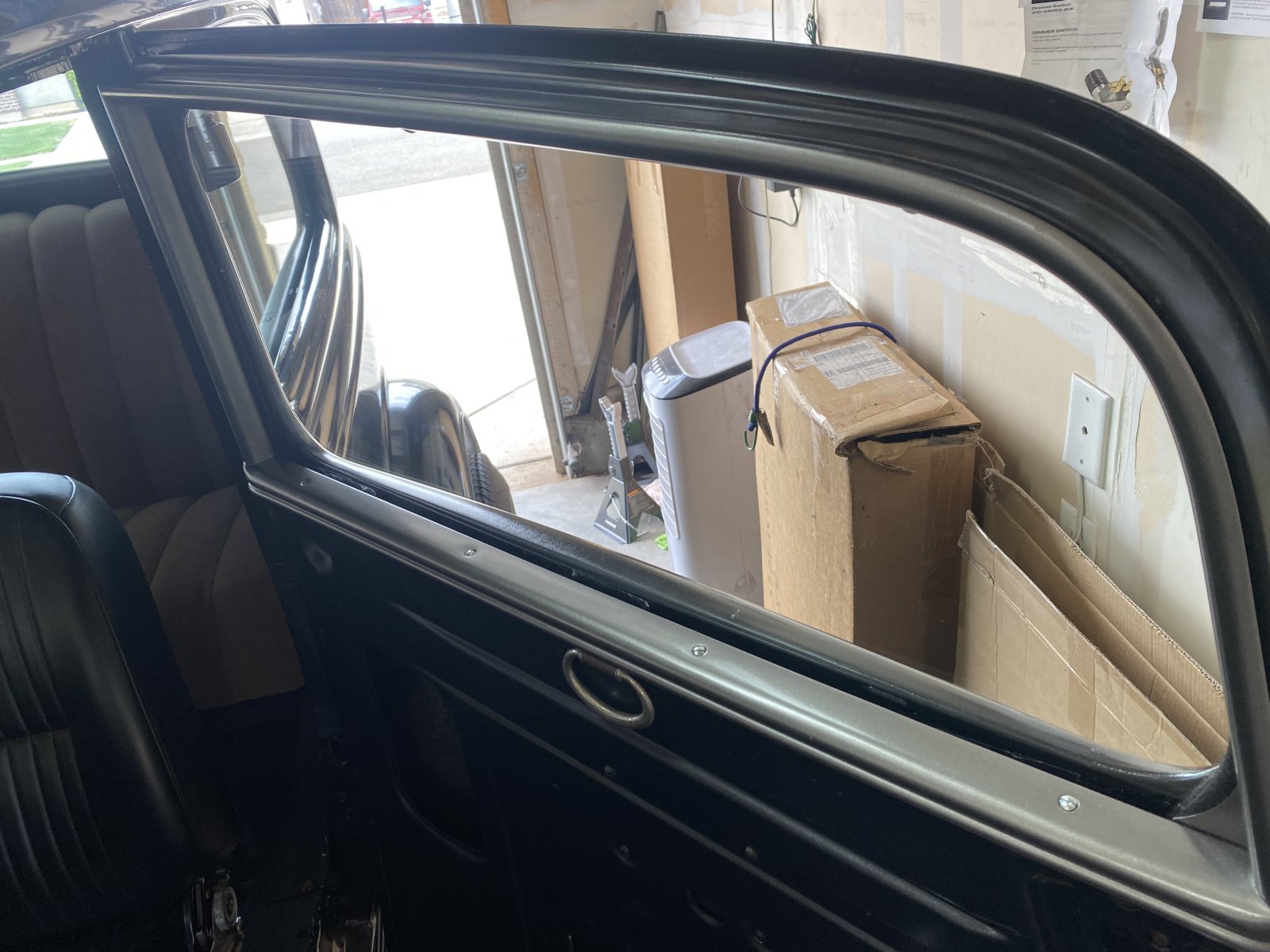

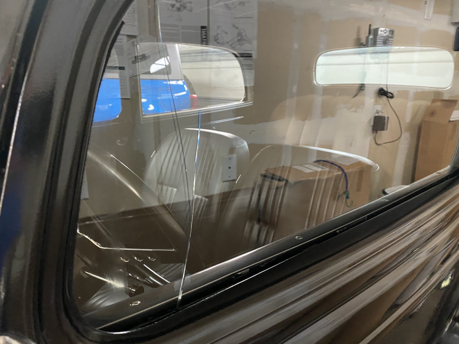

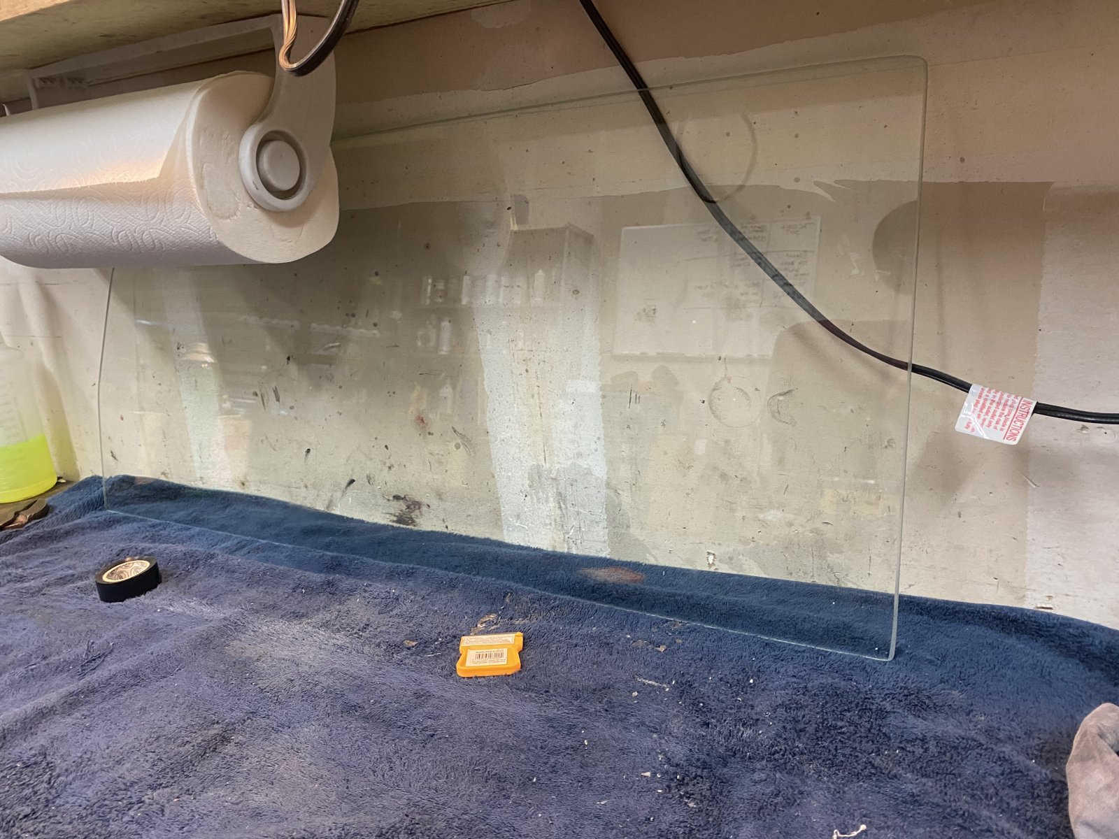

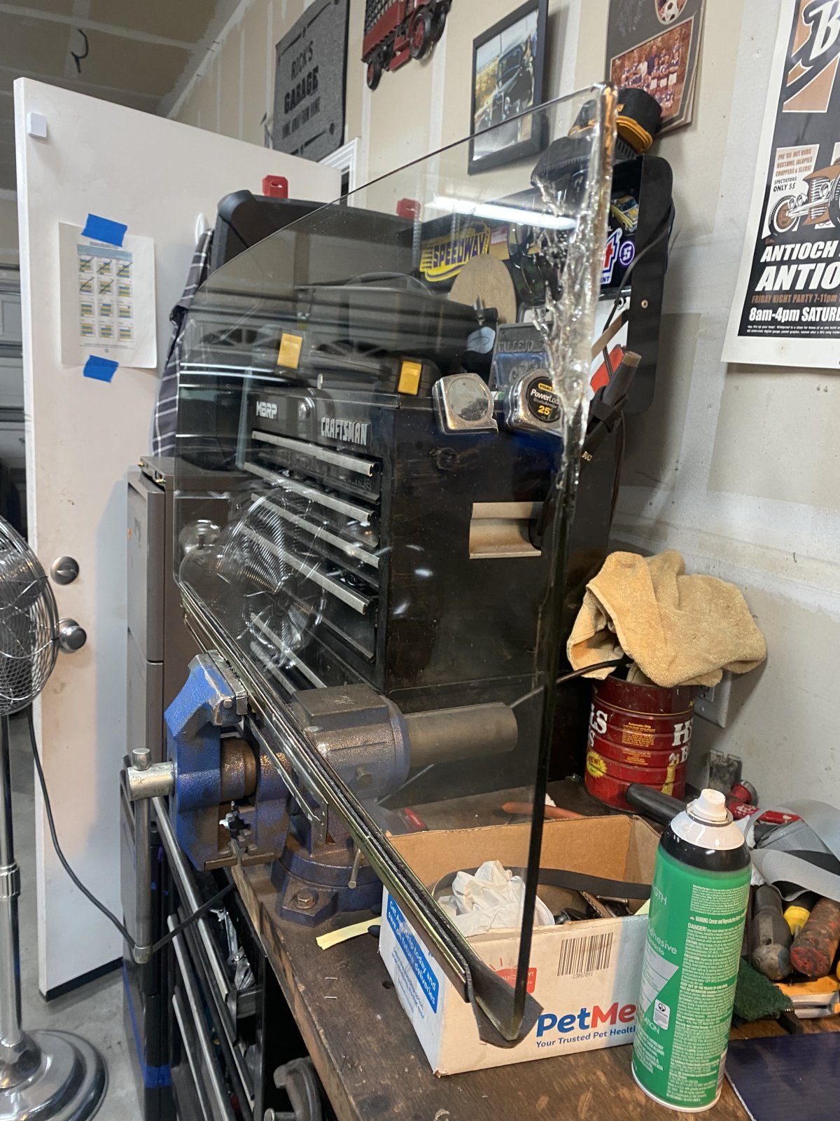

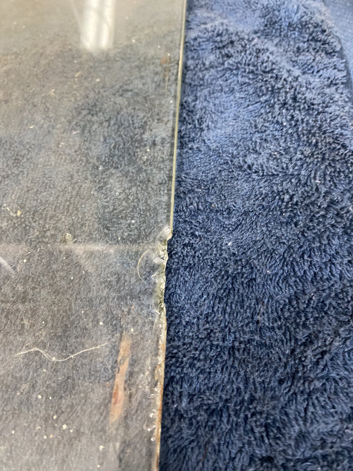

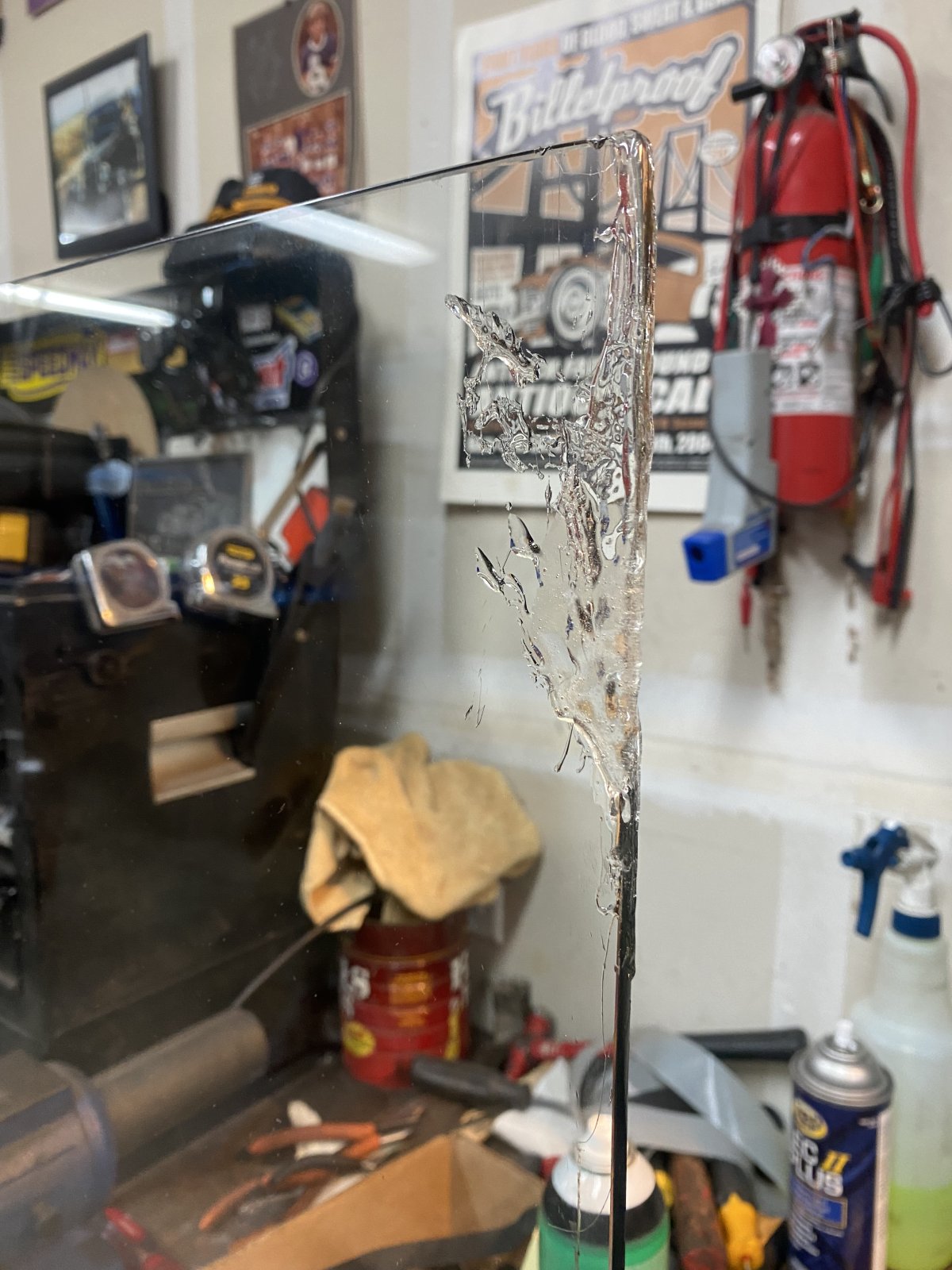

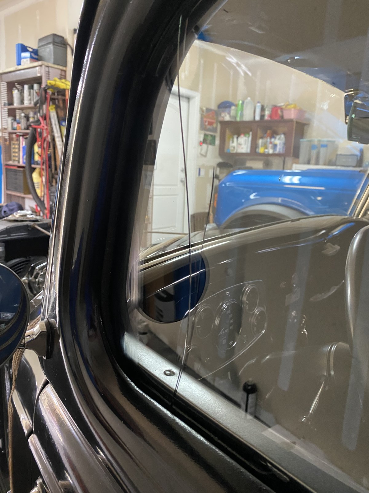

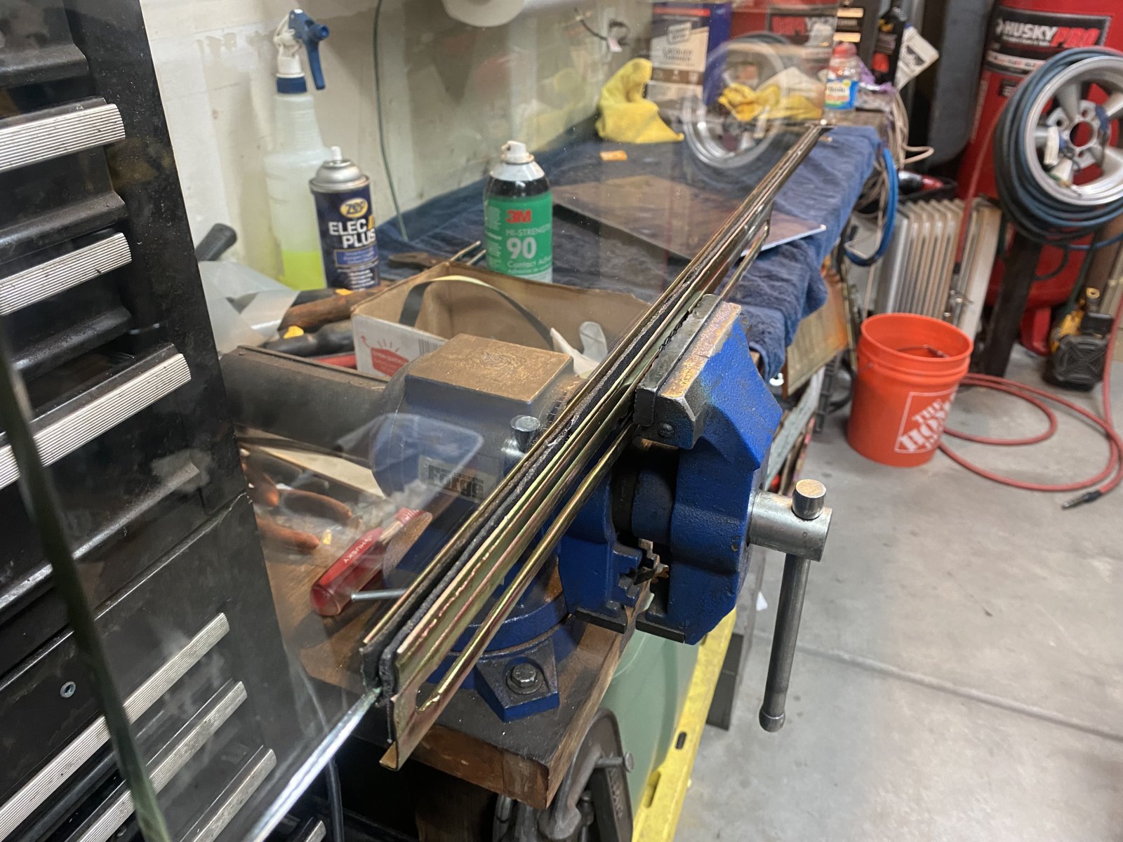

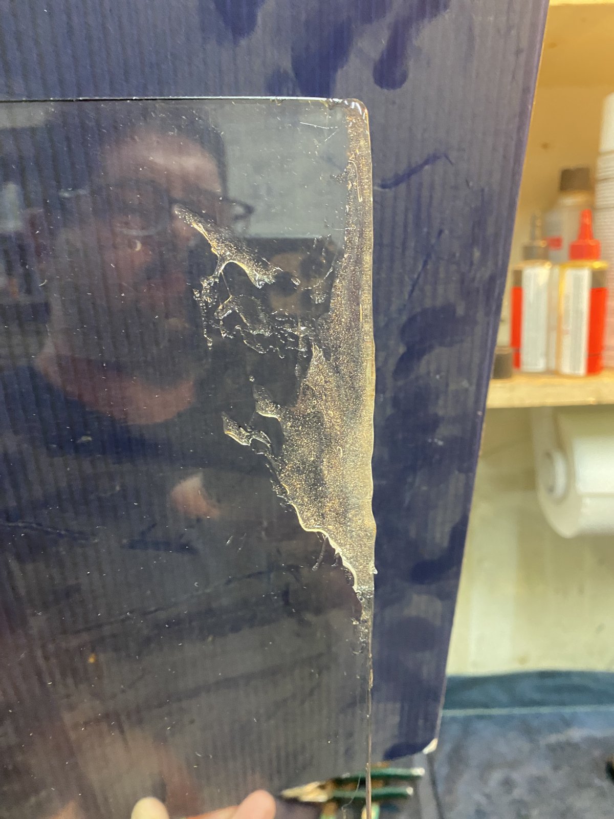

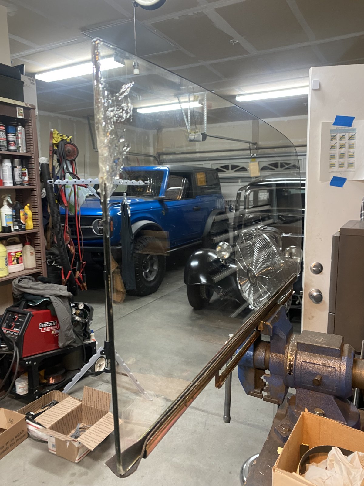

    IMG_0779.jpeg IMG_0780.jpeg IMG_0781.jpeg IMG_0777.jpeg IMG_0778.jpeg FUUUUUU..CCGGGGGGGEEEEE!!!!
    I’m really disappointed in the quality of gl*** !
    Come out this morning and now the side window cracked first it was just about an inch and a half.
    So I googled how to stop cracks from spreading, then I go outside and the Farging windowi cracked all the way to the top!!!! The car was just sitting there in the garage not doing anything !!!
    So all the windows in the 33 are the original gl*** so far! ( The new windshield broke about 9 months ago installing in the New frame)
    So now I’m gonna fix the original 1 door window that wasn’t broken in the door. Apoxsee, the chipped spot like I did on the quarter windows.and
    Hope the one aftermarket door window left doesn’t break!!!
    Then I am going to
    Call up the gl*** shop, and see if I can’t get some windows but it’s been 2 1/2 years .
    Jim Bouchard likes this.
  14. Stogy
    Joined: Feb 10, 2007
    Posts: 27,406
    Stogy
    :rolleyes:...not gonna like that...:oops:
    original as in 33 original or 70s safety gl*** original? lots of stuff has a little give but gl*** isn't one of them...I guess it could be any minor impact causing a chip even if microscopic could take off like that...you are walking a mile in so many shoes here and now its the gl*** installers...I feel the pain...

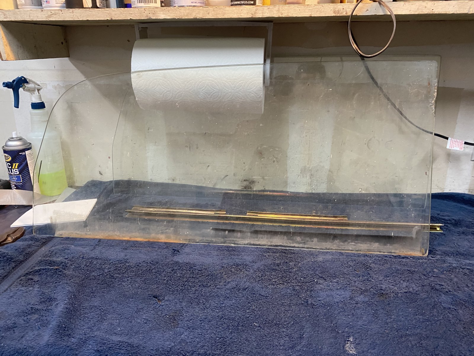

  15. 33Doll
    Joined: Sep 27, 2019
    Posts: 1,602
    33Doll

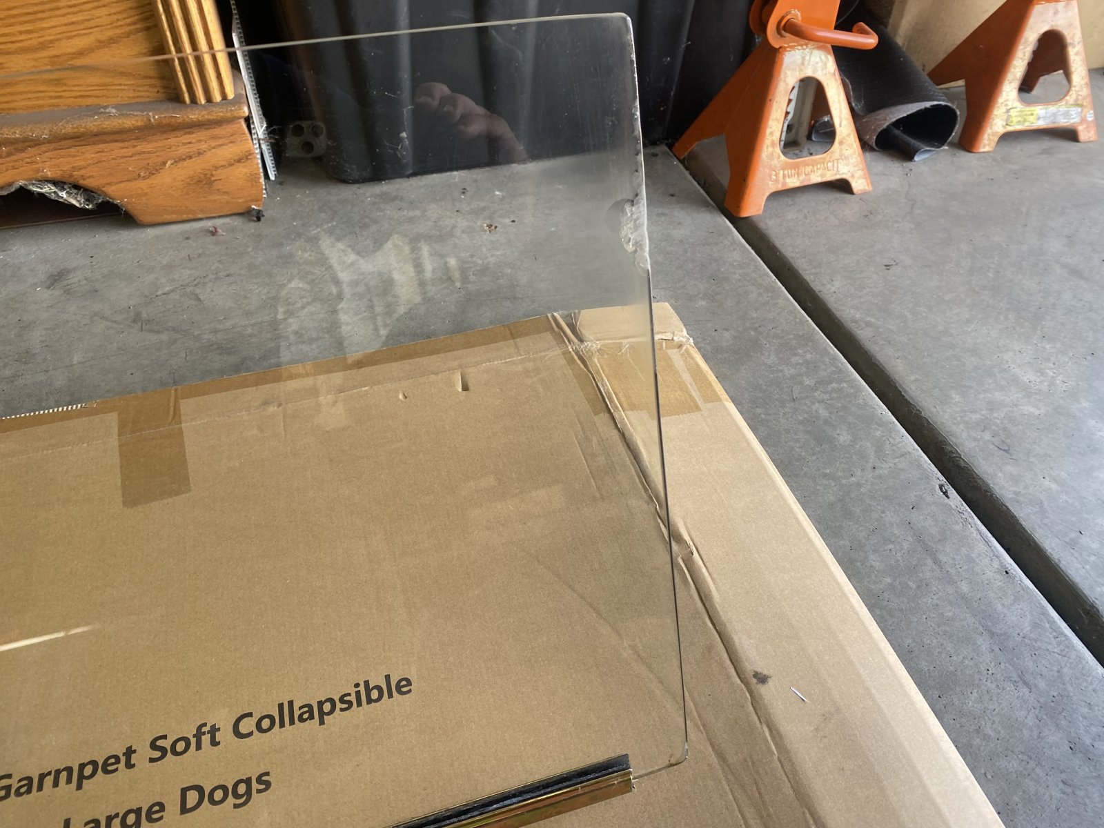

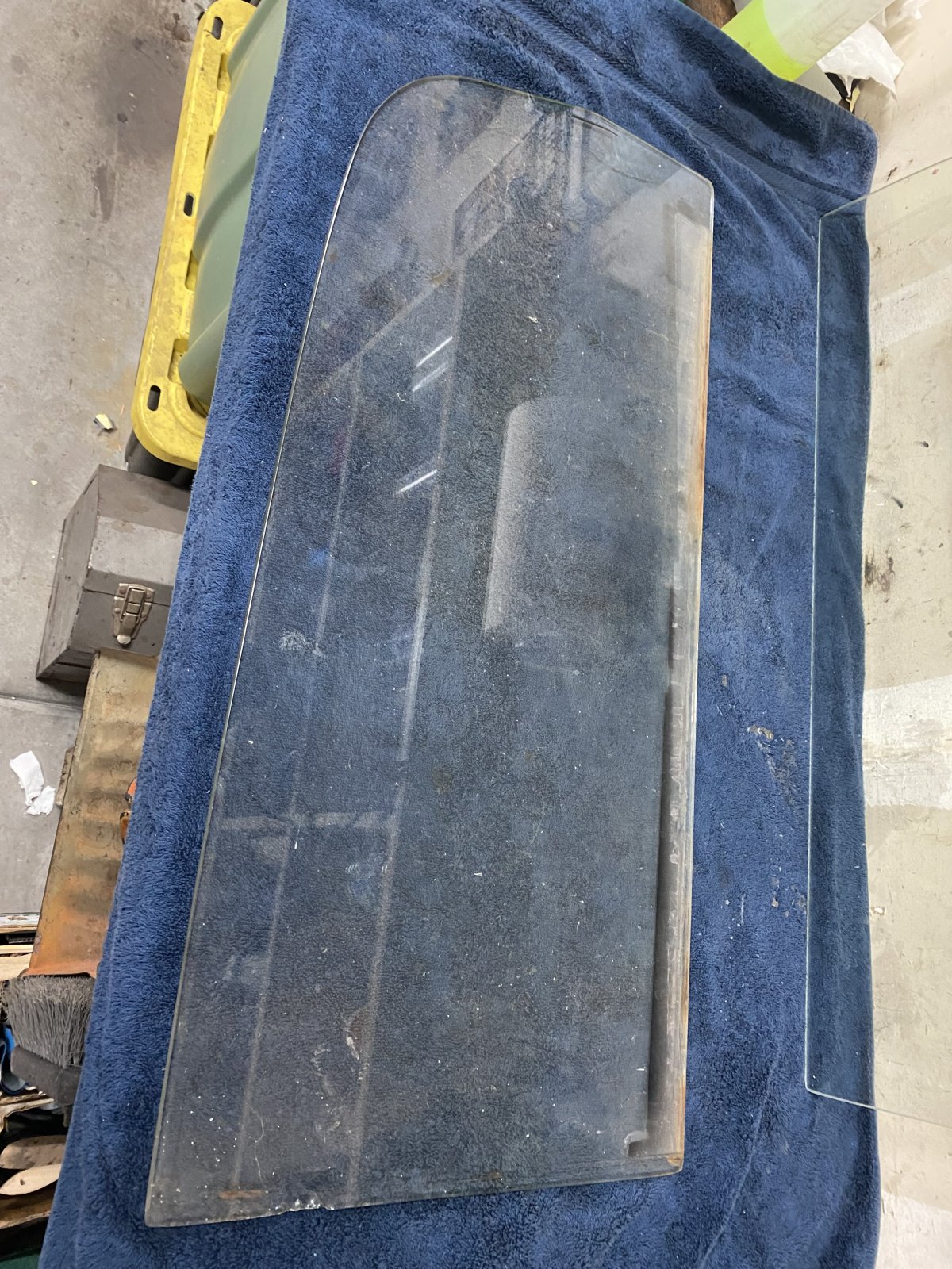

    IMG_0780.jpeg IMG_0782.jpeg IMG_0784.jpeg IMG_0785.jpeg IMG_0786.jpeg IMG_0787.jpeg IMG_0788.jpeg IMG_0789.jpeg IMG_0790.jpeg Well, I cleaned up and polished and Apoxsee, the chips on the edge of the old original window that was flopping
    In the p***enger door without any felt left in it and it didn’t break!!!
    I have one good one left wish me luck.
    You won’t see the mess once I clean it up because it sits inside the channel!
    Woogeroo, Jim Bouchard and Stogy like this.

    I think they were from the 70s but it seems to be some kind of tempered heavy duty gl*** like you’d see you in a muscle cars back then…it’s one piece.
    The new ones have the laminated stuff like the original windows back in the day. I ***ume because that’s what all that bubbling was right?

    Any little chip or irregularity in the gl***, especially as long as those are, will end up causing a crack if put under any kind of stress. The guy that supplied the gl*** for a 48 Ford half ton I built was polished on every edge (it was laminated) and rounded the corners at the bottom of the gl*** where it mounted into the channel. He also used a narrow rubber strip in the bottom of the channel then used urethane gl*** setting stuff to seat the gl*** into the channel. His comments were that this eliminated any "preloaded stress" on the gl***. Have no idea if all of that was the truth but the gl*** that went into the doors with no vent windows never broke or cracked. Just my thoughts.
    Stogy, Jim Bouchard and 33Doll like this.

    All I know is, that my patience is so thin right now, I feel like taking a rock all the windows! That’s a good idea though. I was thinking about heating up the rubber in the track I did Apoxsee it this time so it has a little give, but hopefully wont come out. but that’s the original 70s window that’s hard as hell!!!
    Now that I think about it when I was putting the window in the track it came off, maybe it got a piece of dirt in there when I put it back on?
    Stogy and Jim Bouchard like this.

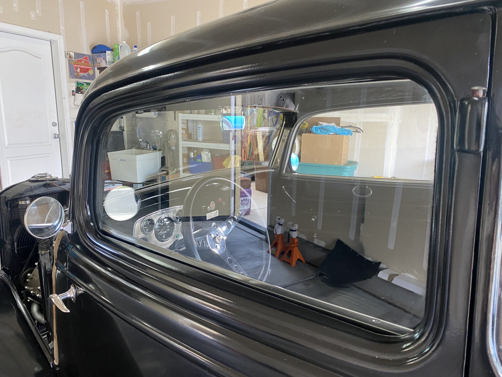

  20. 33Doll
    Posts: 1,602
    33Doll

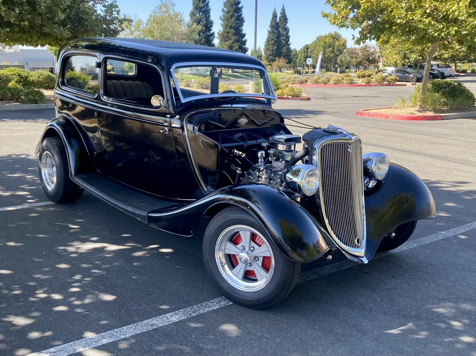

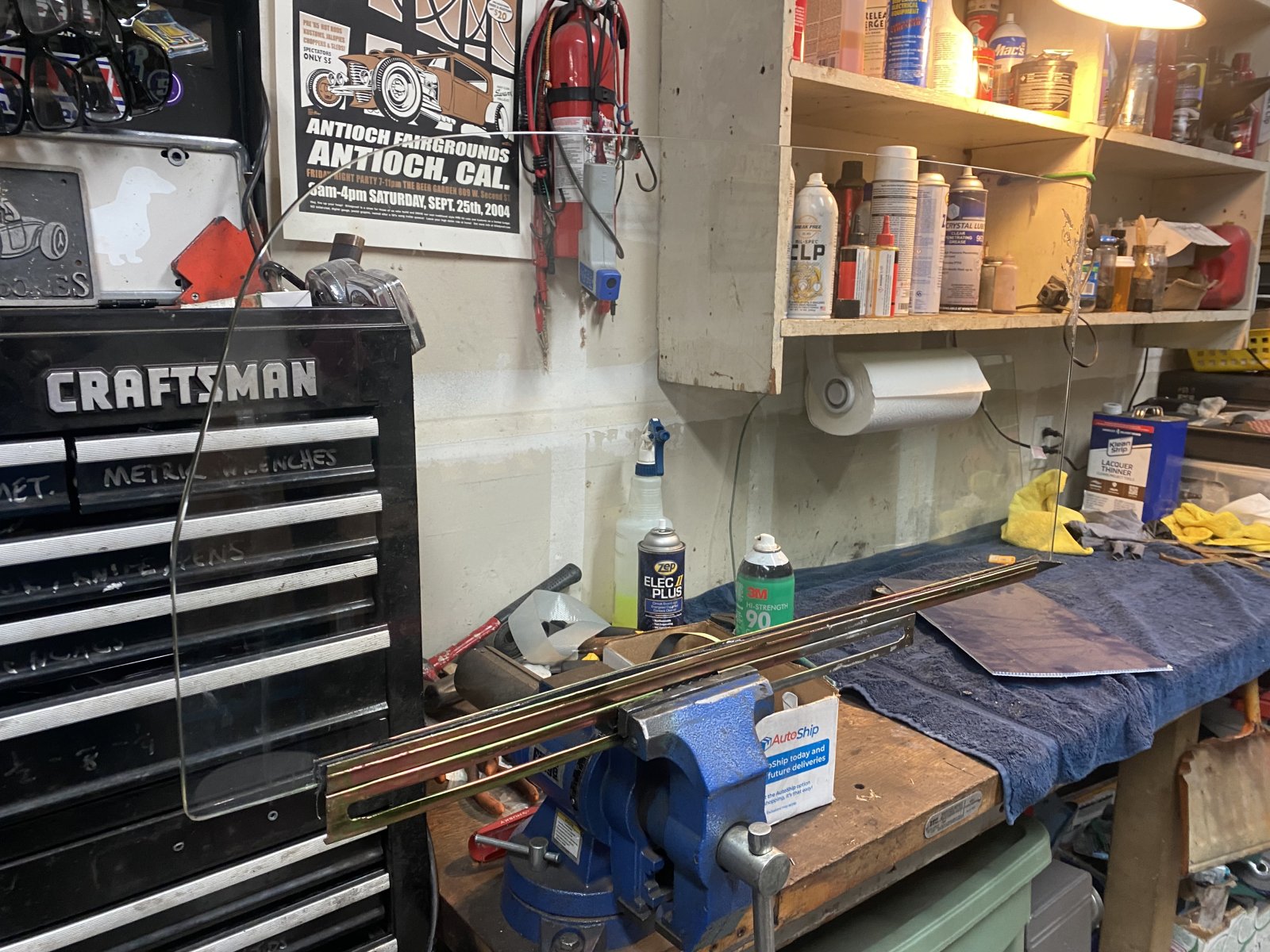

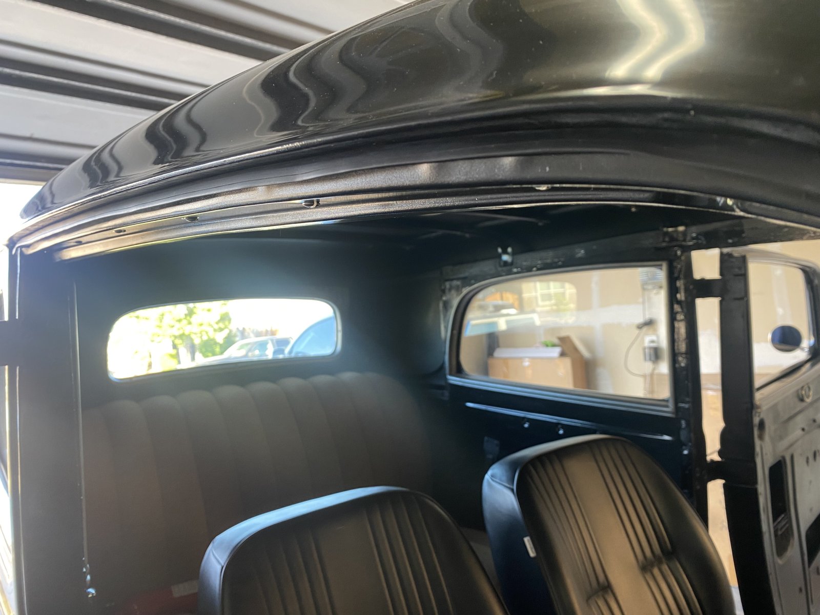

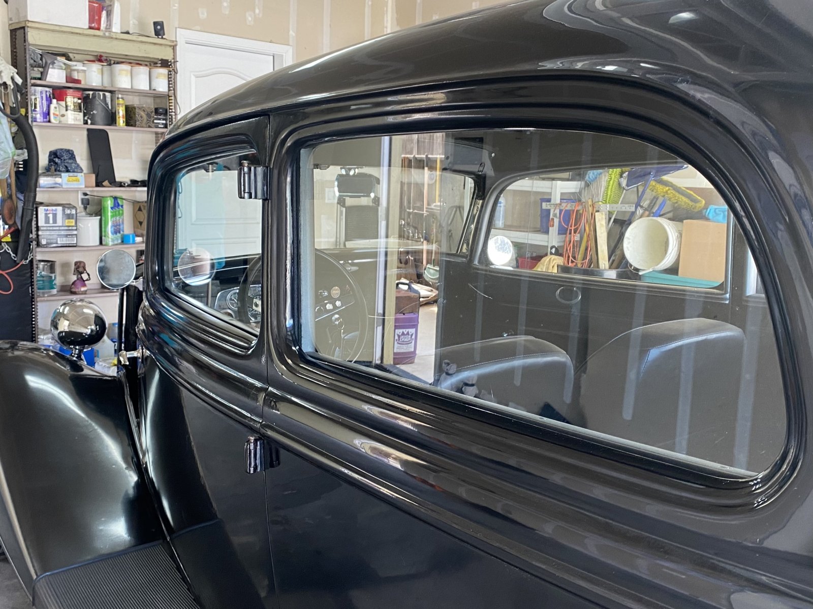

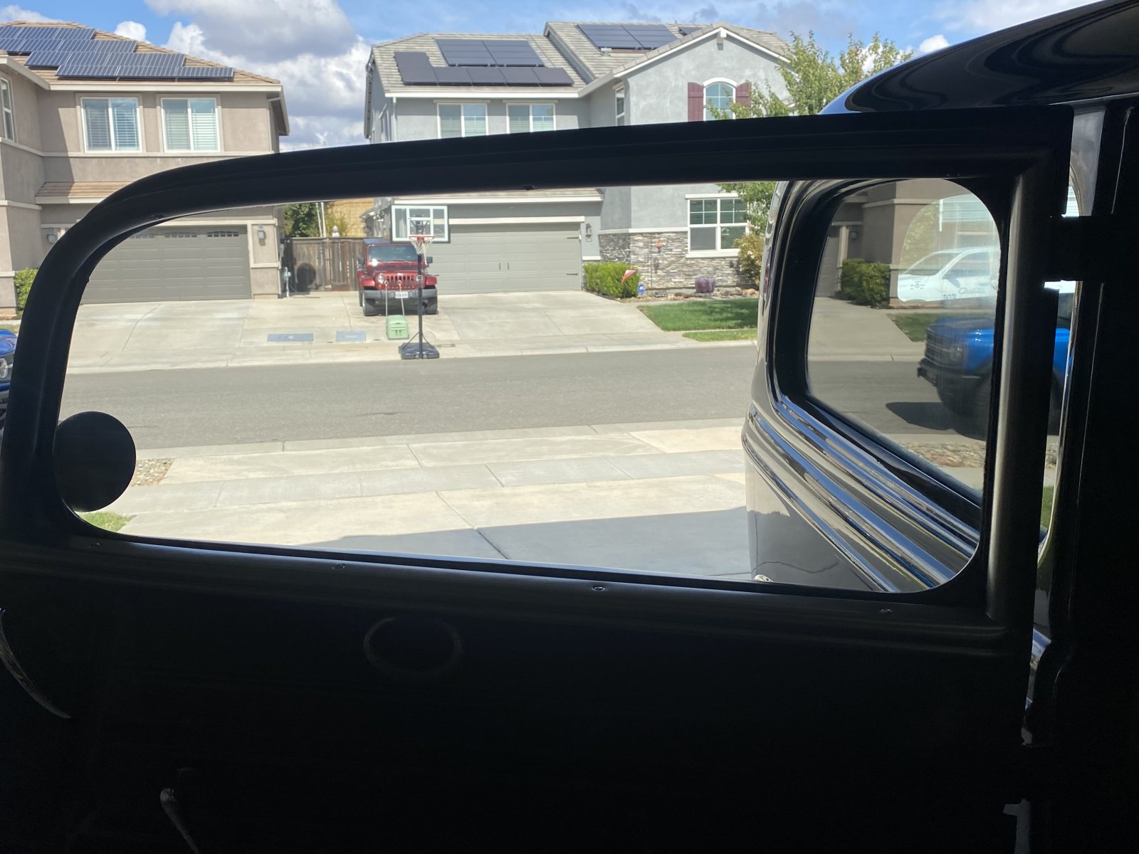

    IMG_0796.jpeg IMG_0797.jpeg IMG_0798.jpeg IMG_0801.jpeg IMG_0804.jpeg IMG_0817.jpeg IMG_0803.jpeg IMG_0795.jpeg So far so Good!!!
    Fixed the chip on the old one, and didn’t break the last new one!!!
    I sanded the window on all edges, rounded corners, and then I epoxyied the edge of the gl*** on the bottom and then I glued the window into the channel so there’s no way it’s gonna crack unless somebody beats this time!!!
    If it does crack… I’m gonna take my pistol, and I’m gonna go full Bonnie and Clyde on all the windows!!
    Dammit!!!

    Well, test drove it on the freeway with all the windows shut and it’s actually pretty darn airtight….. for a 90 year old
    Anyway! My Arvin heater Should make up the difference no Problem!
    Still have to hold the shifter in Second gear, but the ****** seems fine otherwise.

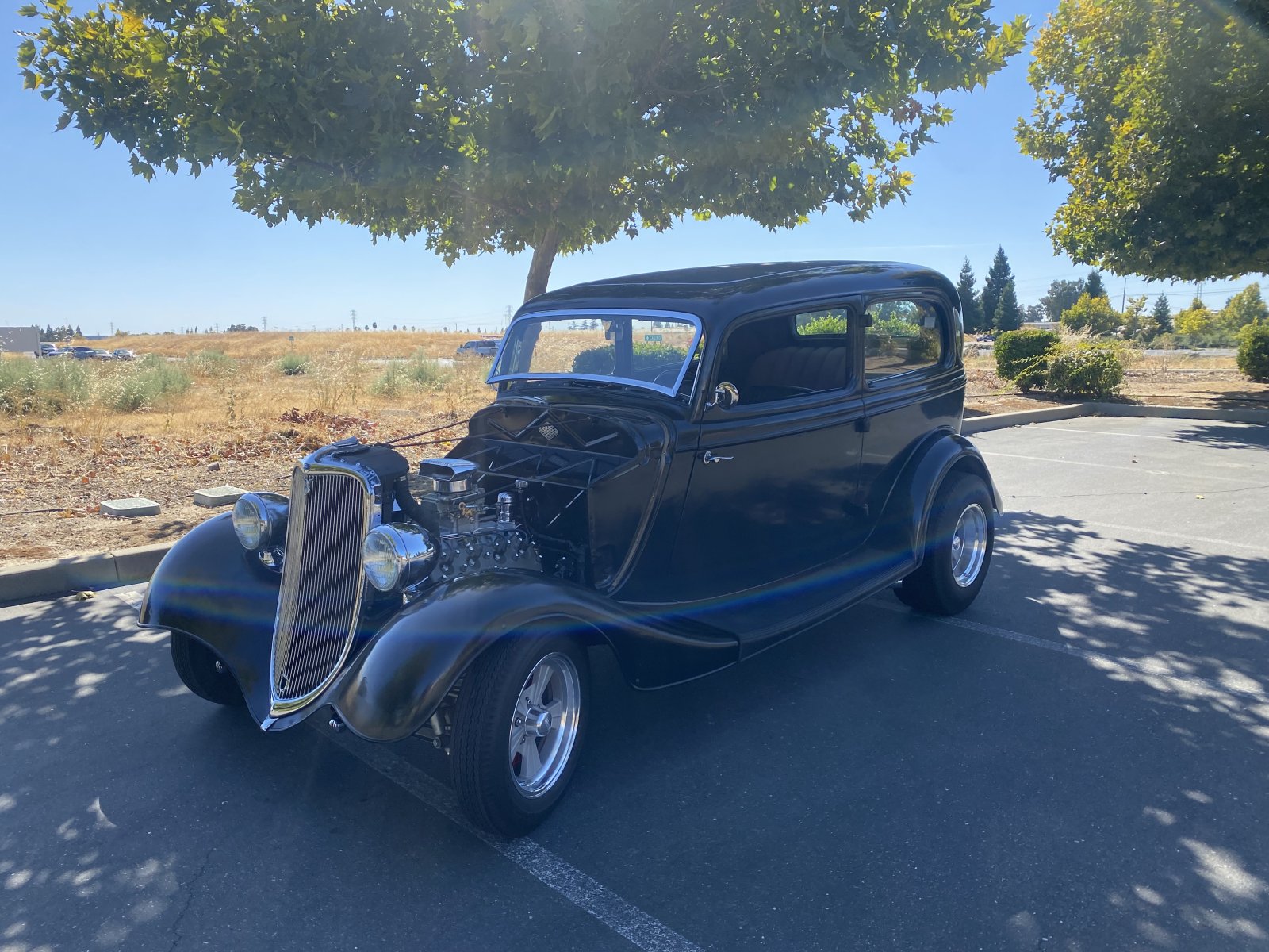

    IMG_0819.jpeg IMG_0820.jpeg It was nice cruising to work this morning with the windows in it, and the heater! Although the heater doesn’t get real hot cause the engine only runs 150 when it’s cool.
    It was only in the 50s this morning, so not real cold yet.

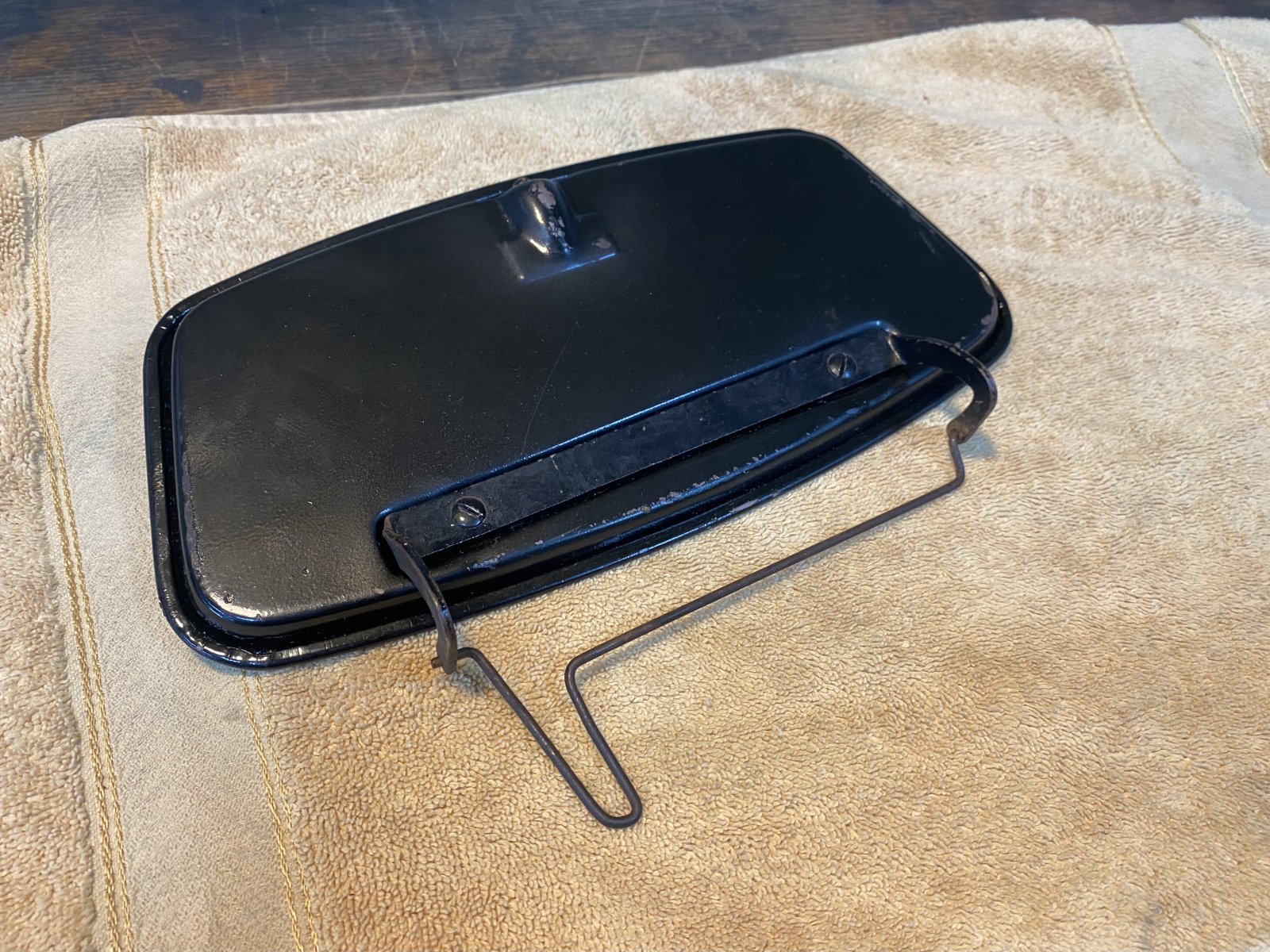

  29. 33Doll
    Posts: 1,602
    33Doll

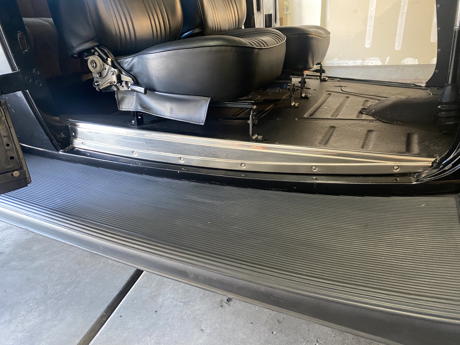

    IMG_0856.jpeg IMG_0857.jpeg IMG_0858.jpeg IMG_0860.jpeg IMG_0859.jpeg IMG_0862.jpeg IMG_0869.jpeg IMG_0868.jpeg IMG_0866.jpeg IMG_0867.jpeg Got a few more things done on the 33 today! The visors are functioning,and installed. Also the upper door rubber and metal door “Tin”
    The lower door rubber, and scuff plate on the p***enger side. the new glove box in.

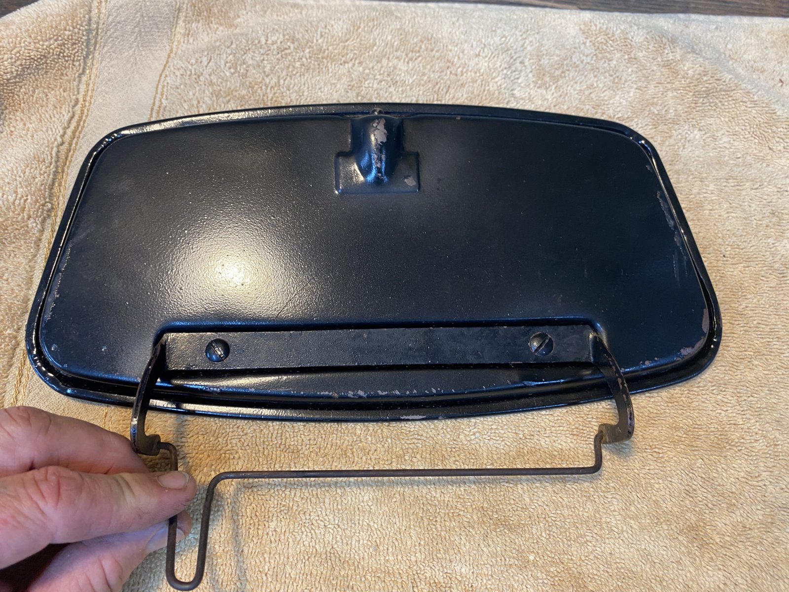

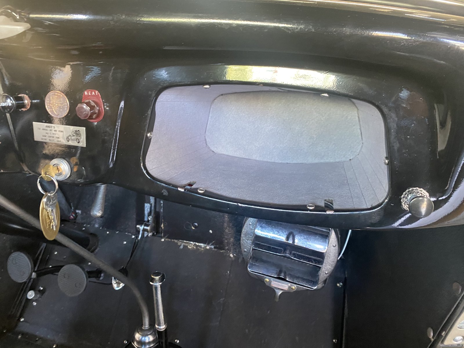

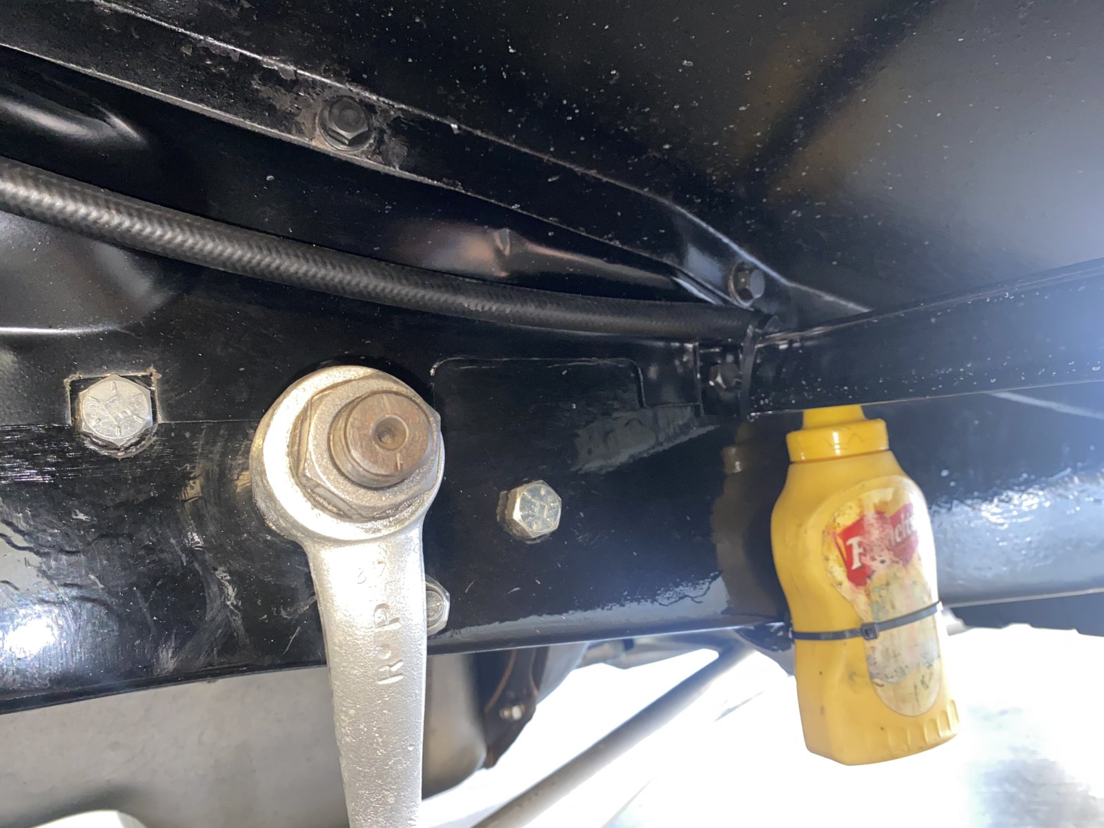

    but for the life of me, I cannot remember how the spring for the hinge gets shoved under for the door to work properly. I know the spring tab rests against the bottom? Does anybody have a picture or drawing or something of how it goes cause I just can’t remember or figure it out?
    PS. Hopefully my redneck coolant catch will keep all the spray off of everything.
    Thanks
