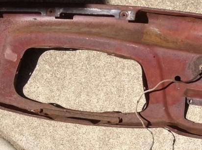

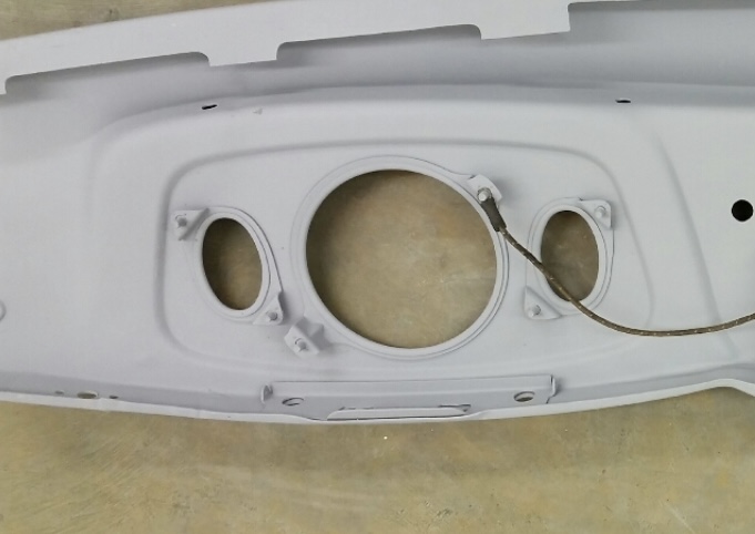

    I think I might have found the problem…
    I think the little bracket the spring pops into might be missing or I just didn’t see it? Because it worked fine before and I know I didn’t cut anything off the dash.
    I found some pictures of the backside and I think that that little ears might be missing or I just didn’t see them?

  5. 31aford
    Joined: Dec 20, 2006
    Posts: 123
    31aford
    from az
    The bracket is on the bottom of the door opening in the picture you posted. The spring also acts as the door hinge pin. You might need to take ou the glove box liner to get the door on and the spring/hinge connected. The tail that sticks out gets positioned under the glove box liner.
    33Doll, Stogy and Jim Bouchard like this.
  6. 33Doll
    Joined: Sep 27, 2019
    Posts: 1,602
    33Doll
    I found a little tabs with my finger, so they are there. I just need to take the liner back out.

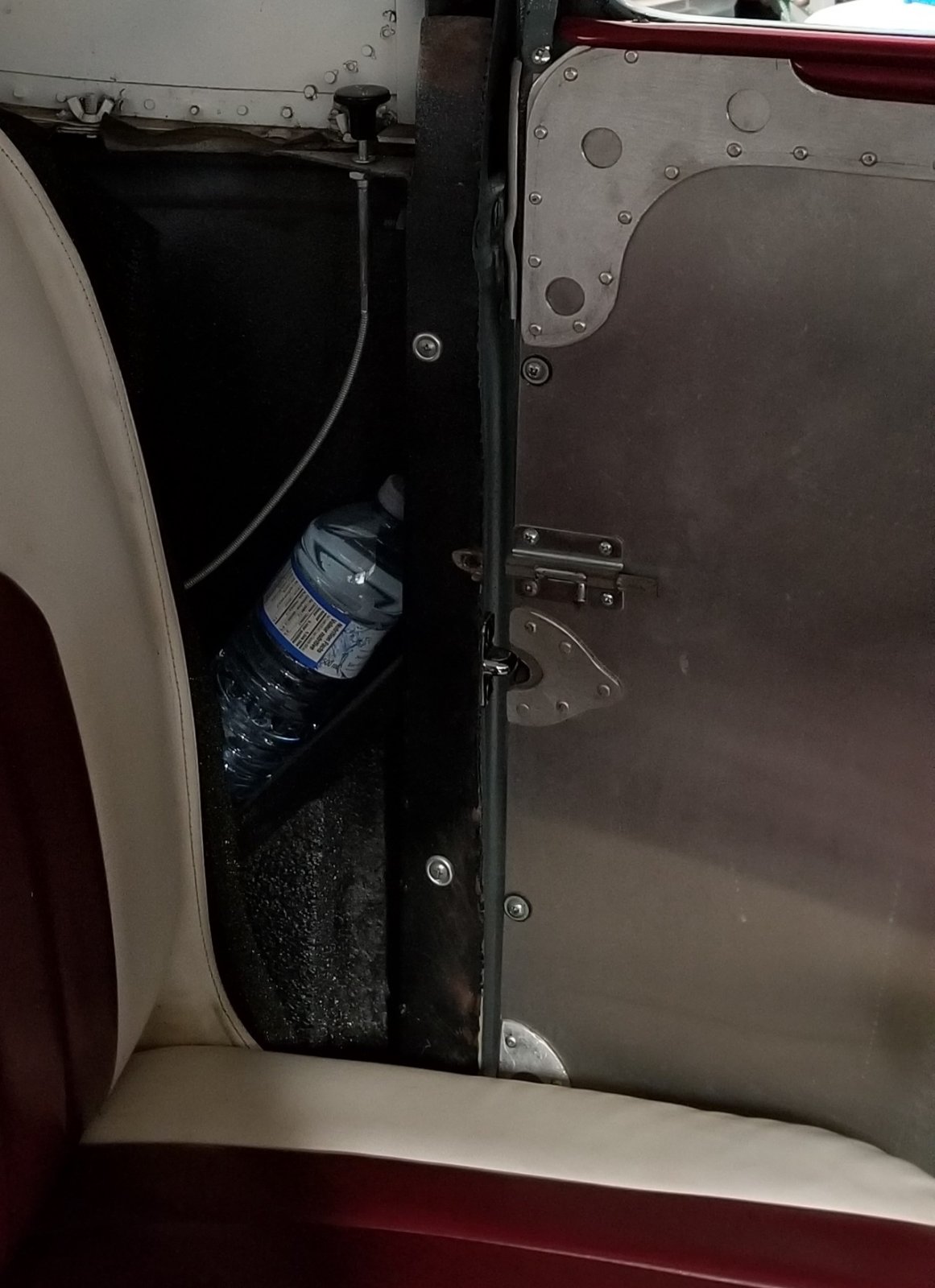

    IMG_0905.jpeg IMG_0907.jpeg IMG_0908.jpeg IMG_0912.jpeg IMG_5793.jpeg IMG_5791.jpeg IMG_5789.jpeg IMG_5788.jpeg IMG_5787.jpeg IMG_5786.jpeg IMG_5782.jpeg IMG_5779.jpeg IMG_5778.jpeg IMG_5798.jpeg IMG_0897.jpeg IMG_0899.jpeg IMG_0890.jpeg IMG_0893.jpeg IMG_0891.jpeg Did A Few Safety Things Before the Dolls’ first “Car Outing”At the local Burger Cruize! So the Mrs. Would Feel Safer in a 90 Year old Sharp-Edges, no Crash zone old School Metal Car!
    (and yes, the old school gate latches work awesome!) no suicide doors flying open on this rig!!

  9. Stogy
    Joined: Feb 10, 2007
    Posts: 27,406
    Stogy
    :rolleyes:...I have the deluxe model locks...:p
    My car was delivered with the note to use them to as the doors on occasion popped open...However I adjusted the door latch and that doesn't happen anymore. I do use the p***enger side bolt to lock it when I'm out and about...The handle locks on the driverside though so bolt is not needed...
    My doors aren't suicide though...but if they pop open on a curve or turn it can be a little alarming especially without the belts...
    Glad you are getting out and smiling...Hotrod looks fantastic...;)

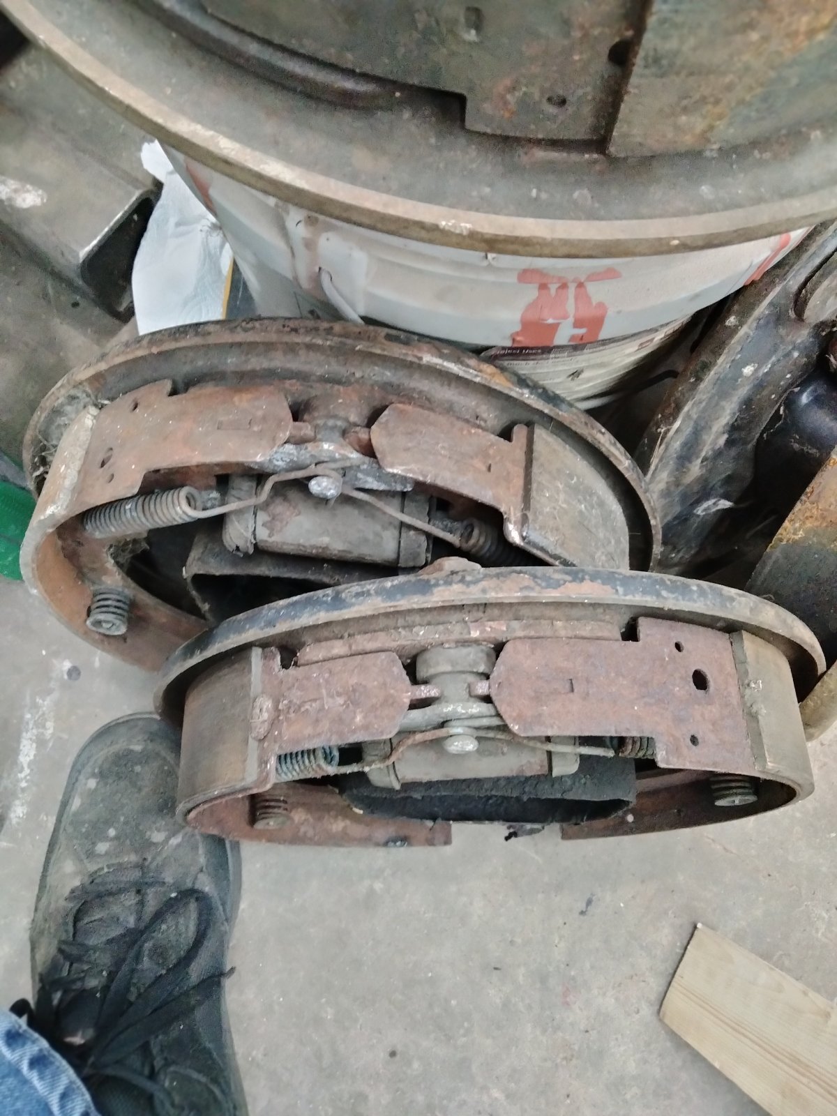

    IMG_0941.jpeg IMG_0942.jpeg IMG_0943.jpeg IMG_0946.jpeg IMG_0945.jpeg IMG_0944.jpeg Found the Brake issue.
    Can’t figure out why
    It is doing that, getting stuck on the anchor pin Plate

  16. Stogy
    Posts: 27,406
    Stogy
    :rolleyes:...Is there a chance only one piston is pushing out and one is seized?
    Another maybe...If the spring top/on spring top was reversed would it perhaps anchor the retainer better?
    ...Or is there a chance it's so far out of adjustment it is pushing the shoe out way to far and there's still barely any contact to the drum...a false impression when pre adjusting that it was near where it should be...
    I'm not a mechanic, I just have some minimal knowledge from doing them over the years...and you remind me, I must do mine as they are well overdue for maintenance...
    brady1929 and 33Doll like this.
  17. RICH B
    Joined: Feb 7, 2007
    Posts: 6,165
    RICH B
    The retract springs should be strongly pulling the shoes back onto the anchor pins.
    Can you push on the shoes retracting the wheel cyls and get them back into place?
    If the sharp edges of the shoe are digging into the support plate and causing the hang-up; maybe smooth off the edges and add a little lube like on the other shoe supports.

  18. dumprat
    Joined: Dec 27, 2006
    Posts: 3,572
    dumprat
    from b.c.
    Another common problem I see grooves in the backing plate and no lube. The shoes get stuck in the grooves.
    Algoma56, Stogy and 33Doll like this.
  19. 33Doll
    Posts: 1,602
    33Doll
    I think it’s a combination different things….
    One the anchor plate is way thicker than a lot of other ones,
    Two… the shoes are a little wide in that section.
    I think if I just trim the metal on the shoes and 45 the top of the support plate it should be fine.
    I pushed the shoes flat against the backing plate wear-strips, and 1 shoe clears by a mm, and it will clear better if I cut them a little bit, around that flat
    Plate!

  20. 33Doll
    Posts: 1,602
    33Doll
    IMG_0944.jpeg IMG_0946.jpeg IMG_0983.jpeg IMG_0982.jpeg IMG_0986.jpeg IMG_0987.jpeg
    Well, I’m at a loss. I trim the shoe around the anchor pin plate, a radius, the top of the anchor pin plate, so it was smooth. I also put a little bit of brake grease. I readjusted the brakes sanded the shoes, smooth again long shoes in the back and Soon as I went down the street It did it again.
    It got hung up on top of the anchor pin plate or something because it would grind, and then Pop spring sound returning. and I saw where it was grinding when I pulled the drums off. It’s like the self energizing action is making it twist and then its landing on top of the pin plate. Never had this issue before. I’m so disappointed but I think I’m gonna just take apart my 40 Ford brakes and clean them up and redo them cause I know they work. And the Buick drums fit on them as far as I remember when I tried it out.
    Outback and Stogy like this.
  21. RICH B
    Joined: Feb 7, 2007
    Posts: 6,165
    RICH B
    Did you center the shoes with the anchor pin adjustment?
    33Doll and Stogy like this.
  22. dumprat
    Posts: 3,572
    dumprat
    from b.c.
    It's the gap between the shoe centers and the weird little plate. They should almost be touching it. Otherwise the shoes can twist.
  23. 33Doll
    Posts: 1,602
    33Doll
    Put a washer between the anchor pin a and the plate to space it out is the next thing I was gonna try
    or….swap shoes from the other side to see if maybe the one shoe is twisted a little?
    Stogy likes this.
  24. Stogy
    Posts: 27,406
    Stogy
    Are the rods that push the shoes out the right ones...are wheel cylinders correct...are the springs correct or to weak, I'm no brake spe******t so I'll ask the dumb questions...:D
    Outback likes this.
  25. 33Doll
    Posts: 1,602
    33Doll
    Yes..
    It only moves up and down though
    About an 1/8 inch. It is at bottom now.
    Maybe I will try it up?
    It was in the middle when I installed them the first time
    Stogy likes this.

  28. RICH B
    Joined: Feb 7, 2007
    Posts: 6,165
    RICH B
    Try this method of adjusting the anchor pin.
    When the everything is together; loosen the anchor pin nut just enough it can move, adjust the starwheel as tight as you can, tap on the anchor pin nut to just to make sure it moved, tighten the anchor pin down securely, back off the adjuster until the wheel turns with a light drag, and the shoes should be centered.
    I was tearing down some brake cores yesterday and I made note that the top of the shoes were not held tight by the shoe retainer, so guessing that may not be part of your problem.
    Looking at your pictures; the hold down springs do not look as compressed as I'm used to seeing. Is there a number on the head of the retainer pin? Usually #4 for 2" shoes; can't think of the number for 1-3/4 shoes right now. I think I would add a washer between the inside spring and shoe to tighten them up.
    Unusual problem; but should be curable.
    Stogy likes this.
  29. 33Doll
    Posts: 1,602
    33Doll
    It was a kit via Speedway made by Boling brothers
    Stogy likes this.
  30. 33Doll
    Posts: 1,602
    33Doll
    Maybe I need to put the Spring facing up on the inside to straighten that Shoe alignment washer behind it?
    Yours seem like they’re straighter with the spring inside.
    maybe that’s why if you look at my picture that washers leaning at the top outwardly?
    Jim Bouchard and Stogy like this.
