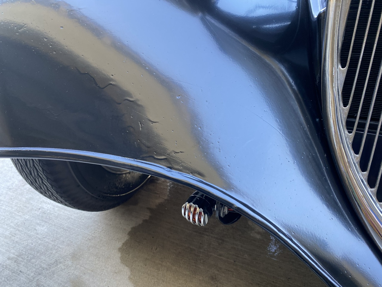

  4. 33Doll
    Joined: Sep 27, 2019
    Posts: 1,676
    33Doll
    IMG_1047.jpeg Well… Partially Fixed…Jerry Rigged!
    The Spacer works great on top, and t******* the end of the spring to clear the shoe….fixed the hang up on top issue, However the one Slightly warped drum, still likes to feed the Bottom of the front shoe into the drum Face. So I swapped the shoes, and drums, from side to side
    That helped! ( reversing the direction?)
    I then came up with another idea.
    I installed 2 extra Shoe Springs at the bottom with the # 8 shorter pins, and that seems to work a-lot better. So I
    am gonna replace the other 2 Lincoln springs with the shorter pins, so its even all around. And stronger.
    I really feel that the shoe/backing plate springs are really weak on these reproduction Lincoln brakes. They move every which way.. they barely hold the shoes on the backing plate. So far each little improvement seems to help, and I don’t see it causing an issue since it still rotates and energizes. It just won’t go out from the plate now, towards the drum face, the spring Will bottom out way before that. What’s the worst that could happen? Maybe…. Wear-out the backing plate flat spots quicker?
    oh well, it still will be a lot safer.
    I think it was hyper extending the wheel cylinder pins when it was twisting because I lose all pedal when I was rolling, but when I stop, I would have a full pedal.
    I forgot to take a picture before I put the wheel back on, but where my fingers pointing is where I put the new ones I just drilled holes through the backing plate.
    It’s just ridiculous that you have to spend all this extra time and energy on expensive parts that you buy!
    I think I have like $1200 into these stupid brakes and Drums!

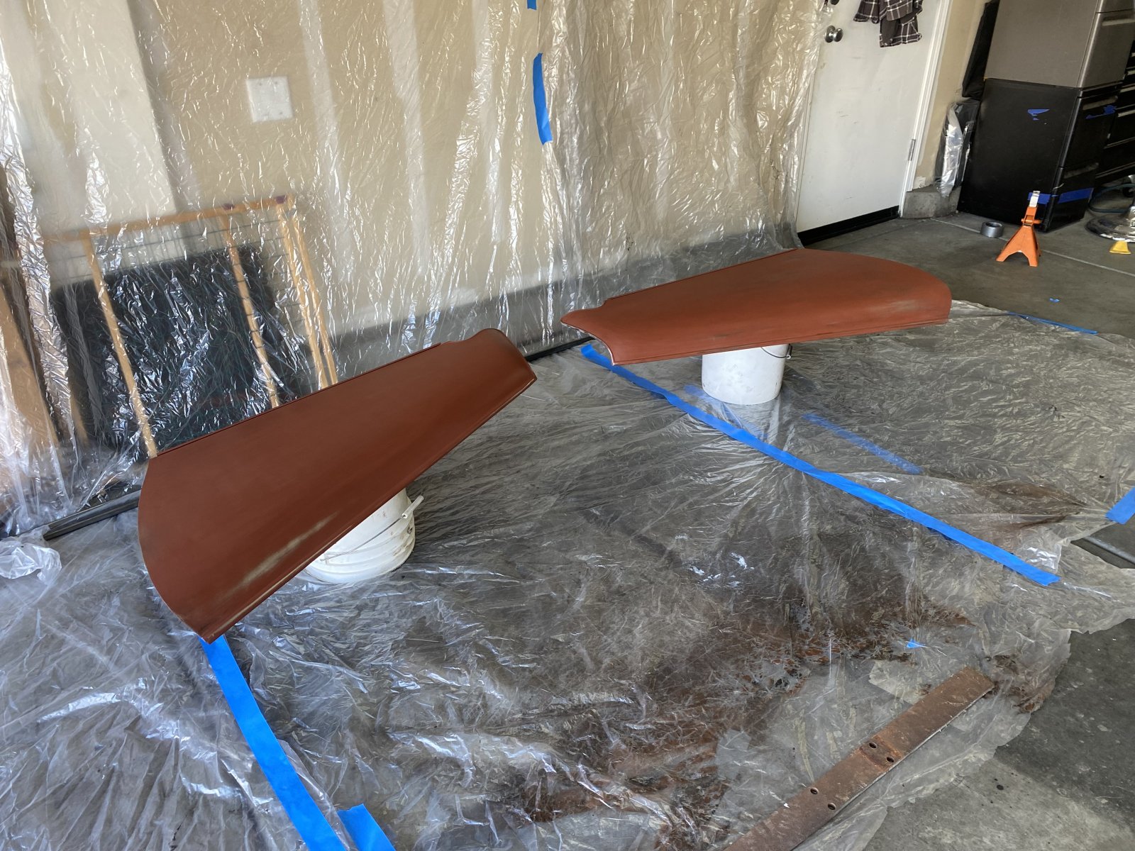

  6. 33Doll
    Posts: 1,676
    33Doll

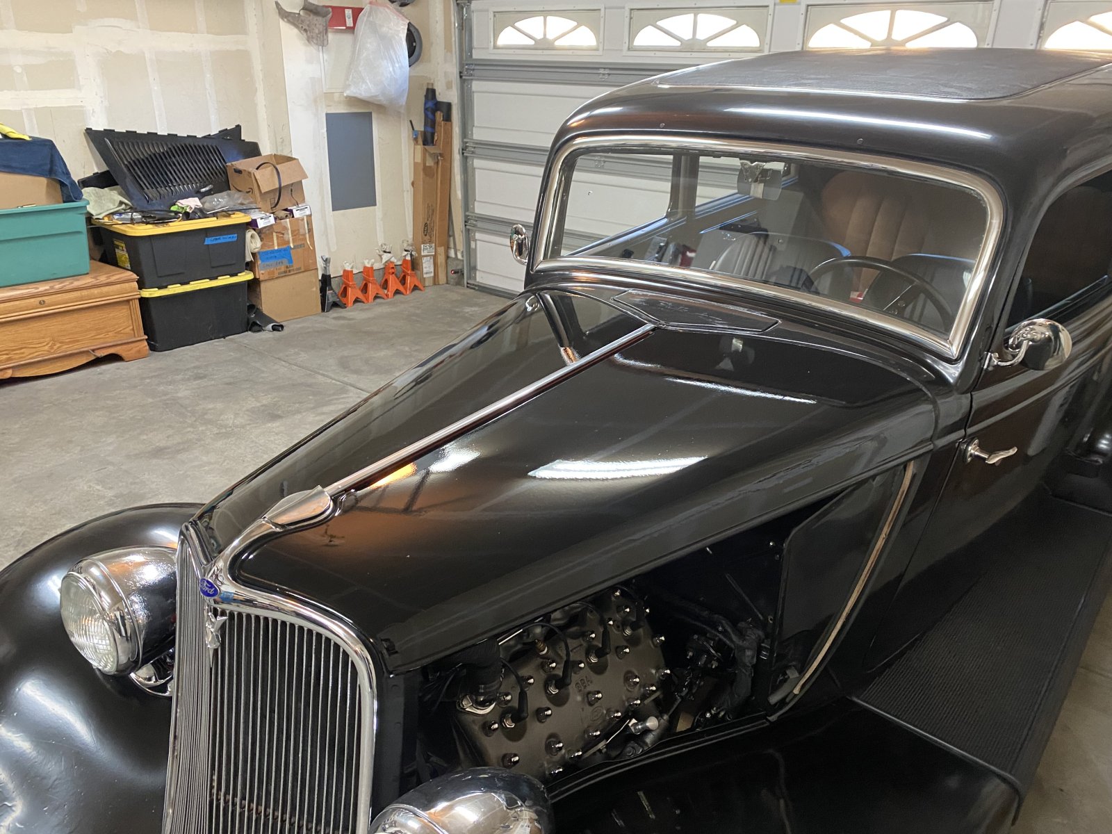

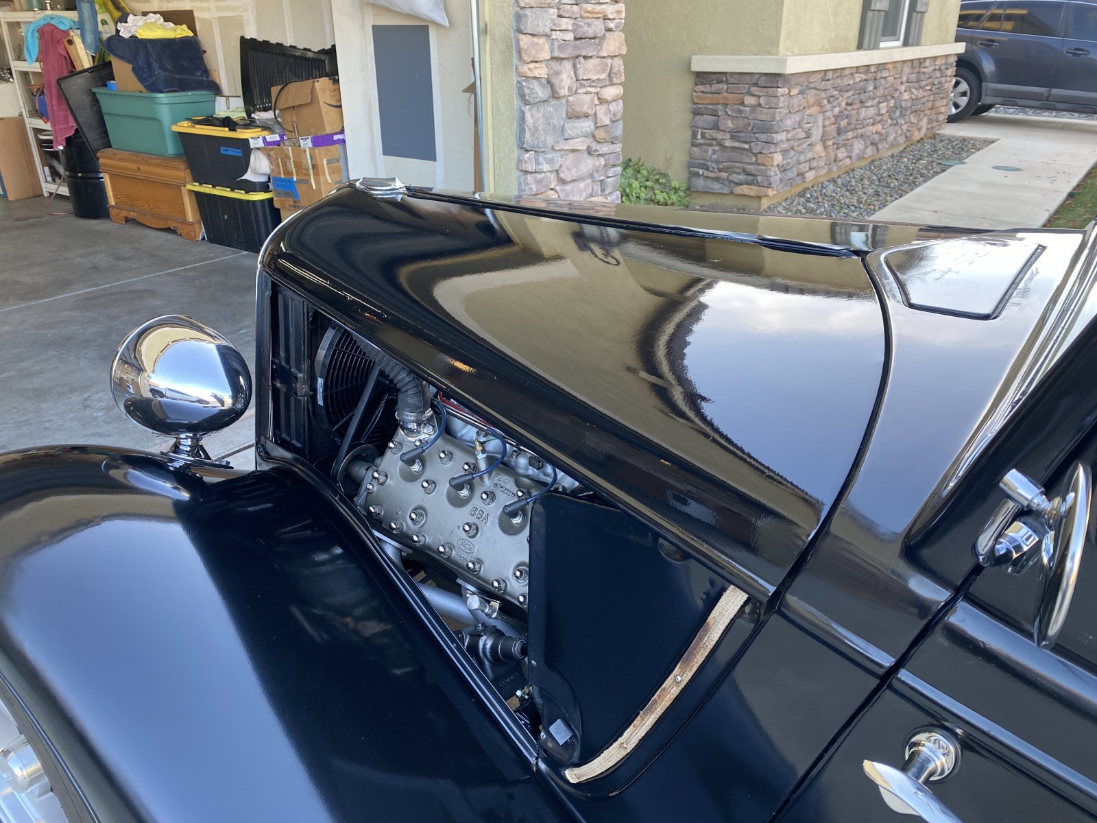

    IMG_1066.jpeg IMG_1062.jpeg IMG_1063.jpeg Remember, way back when I wanted to do the Patina thing??
    Well, I forgot that the hood was that way! But now it looks like **** compared to the rest of the car lol!!!
    I’ll fix it eventually with my magical rest oleum turbo paint!!!

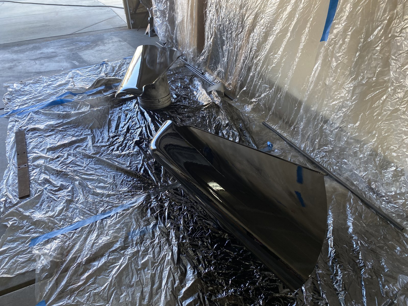

  8. 33Doll
    Posts: 1,676
    33Doll

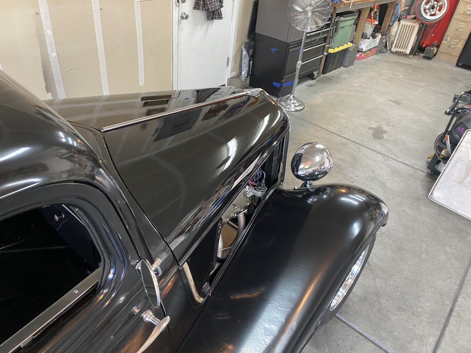

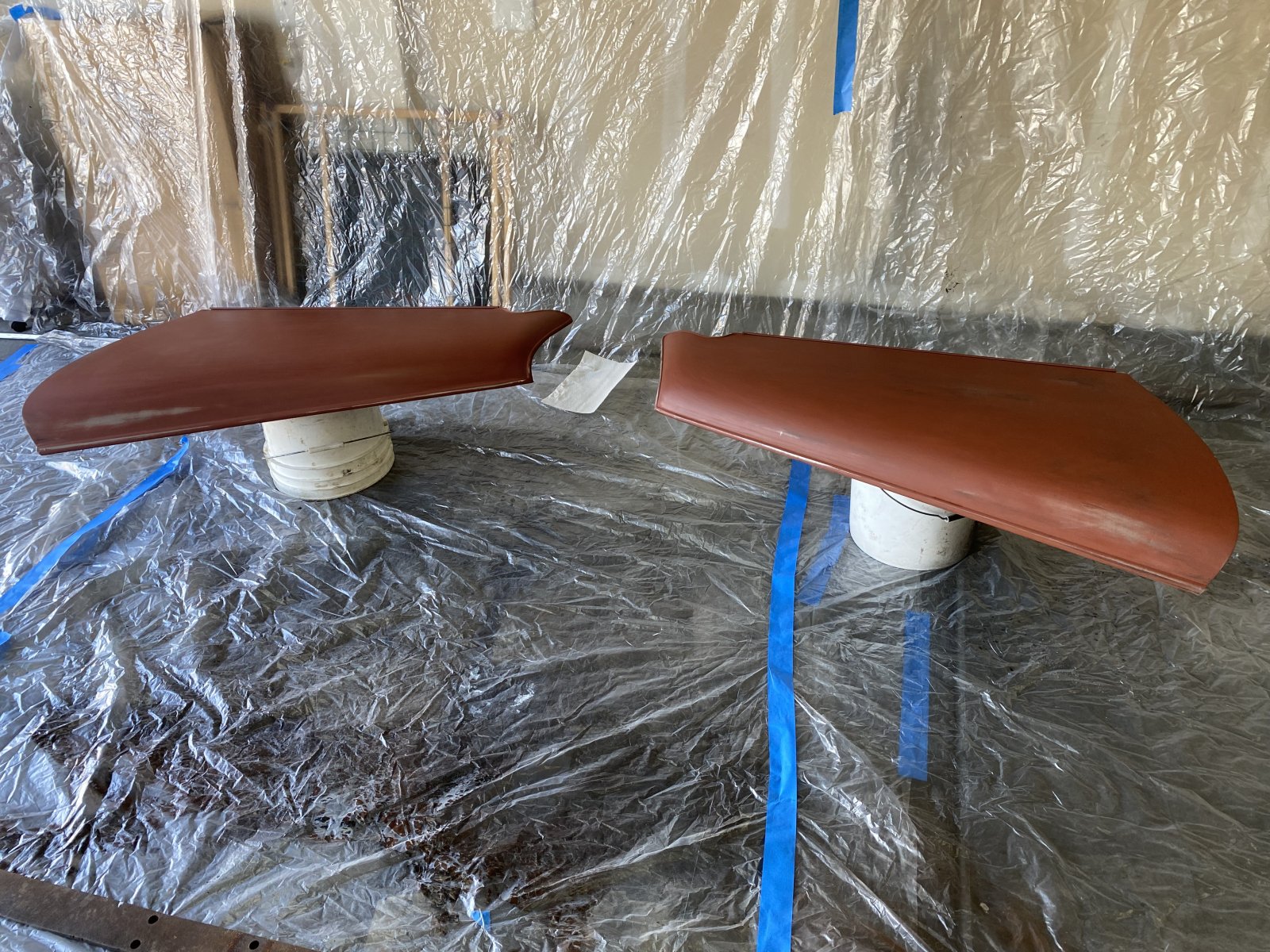

    IMG_1066.jpeg IMG_1072.jpeg IMG_1073.jpeg IMG_1074.jpeg IMG_1075.jpeg Working on the hood today!
    I can’t believe the hood has no body filler in it. No dents after 90 years crazy!!!

    Hood looks great.

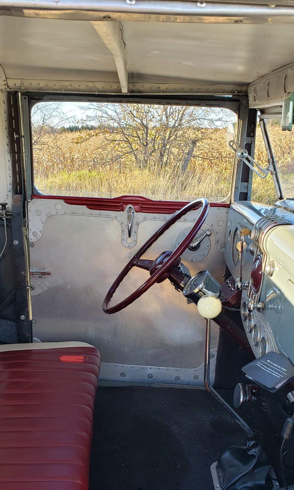

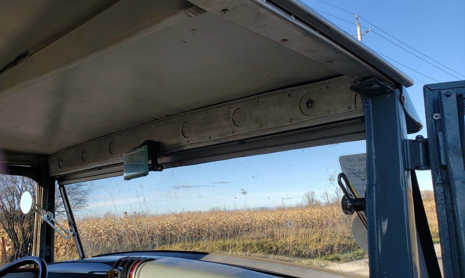

  12. Stogy
    Joined: Feb 10, 2007
    Posts: 27,523
    Stogy

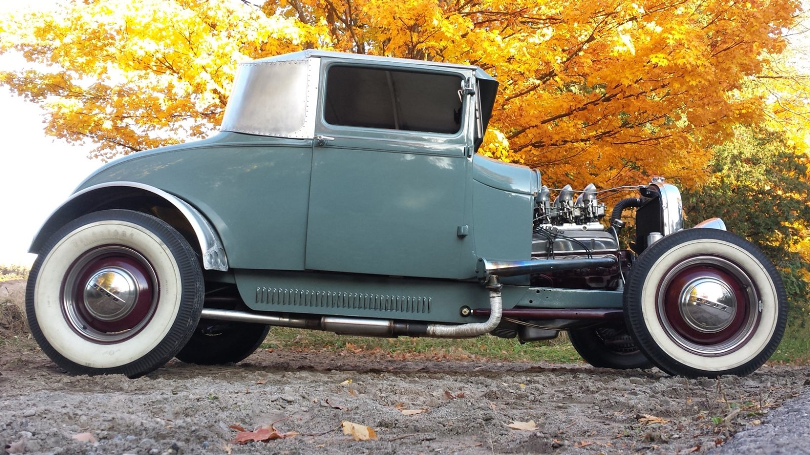

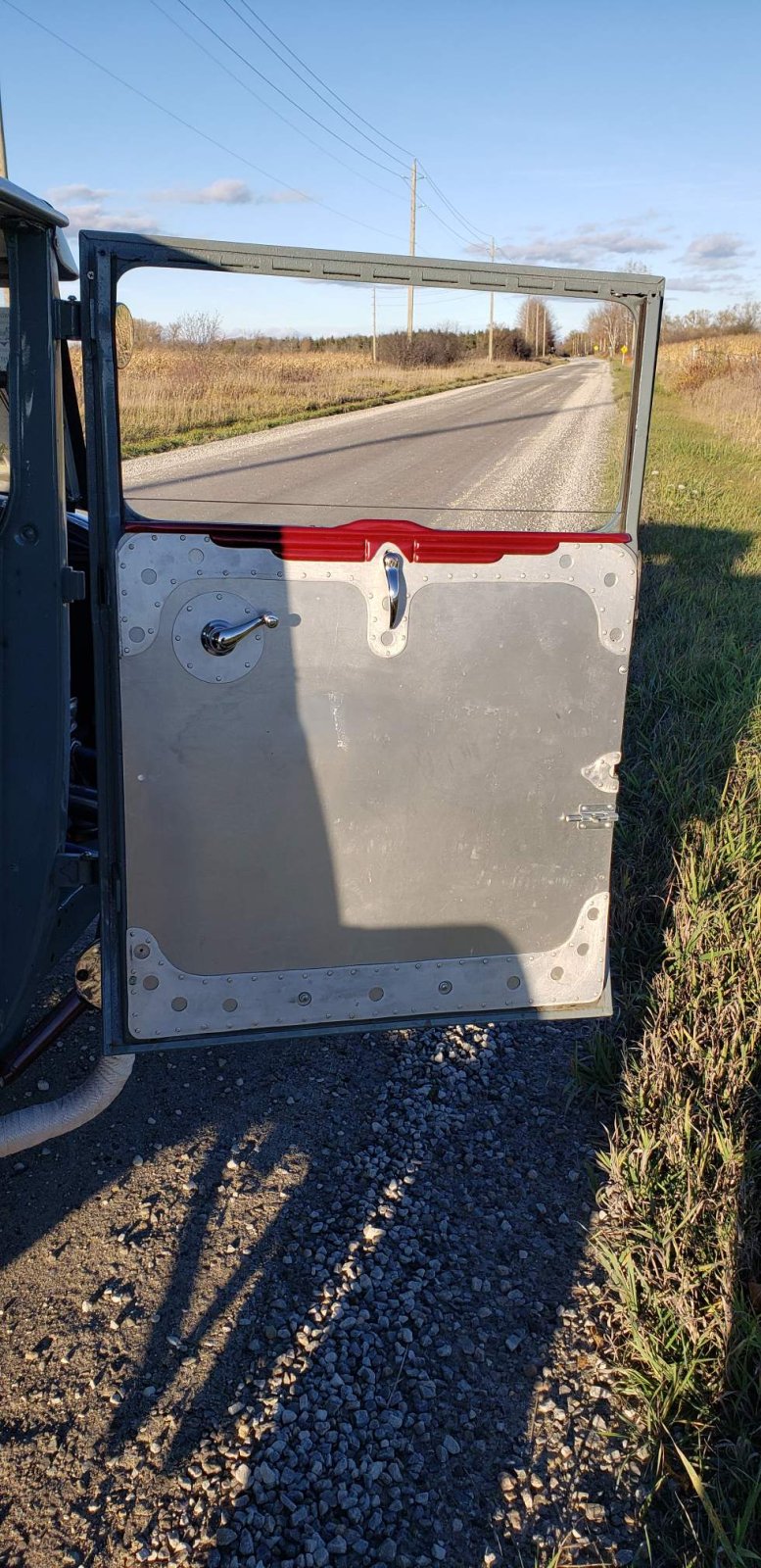

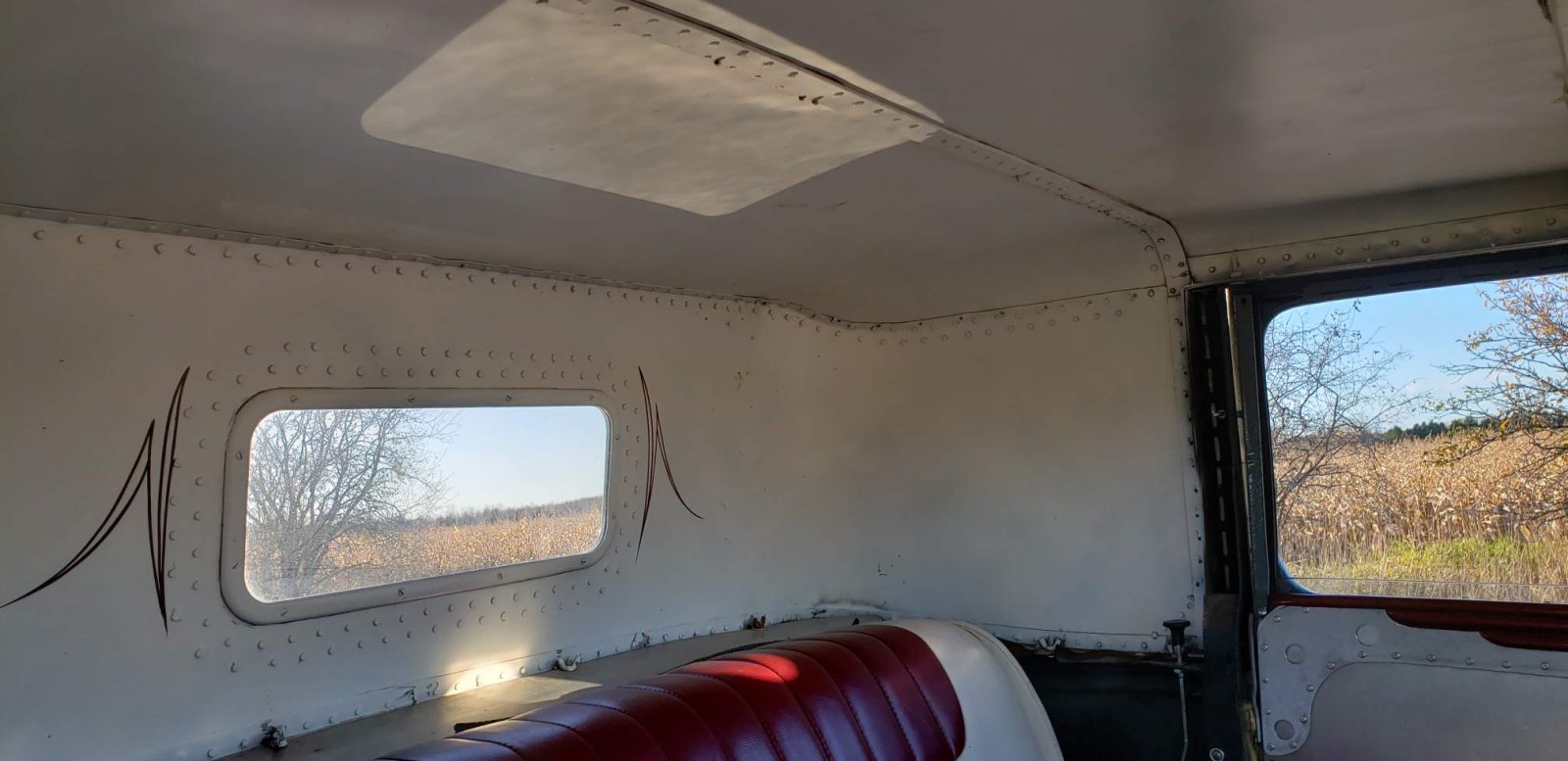

    :rolleyes:...Raw, unpolished, unfinished, I shared a bit more so you can see the aviation theme around the riveted aluminum with flows from outside to inside...bit of leg rubbing on the driver side...:D...glad you got the brakes fixed...they are really critical accessories...
    brEad, 33Doll, Outback and 4 others like this.
  13. 33Doll
    Posts: 1,676
    33Doll
    That is way cool!!!
    Is that a sports coupe?
    How’s the rattles with all those rivets? Or Is it pretty tight?
    Do you know what you should do is have the top lightly coated, in a flat white bedliner. Just tell them to do it thin so you could still see the rivets.
    I always love that aircraft look. I’m kind of fascinated with World War II planes World War II in general because all those brave young boys and men and women! building the planes!!! Back when it was man and machine as one together to kick ***.

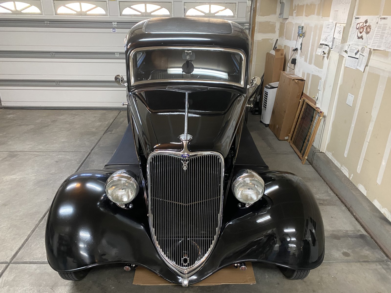

  14. 33Doll
    Posts: 1,676
    33Doll

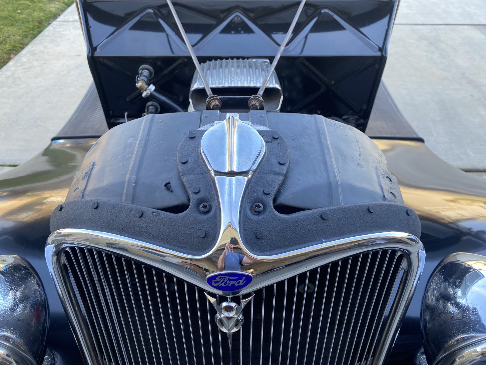

    IMG_1089.jpeg IMG_1092.jpeg IMG_1093.jpeg IMG_1094.jpeg IMG_1097.jpeg IMG_1099.jpeg IMG_1100.jpeg IMG_1101.jpeg IMG_1102.jpeg IMG_1079.jpeg IMG_1078.jpeg
    Well, happy to report that the brakes are working good, and getting better as they wear-in. Those lower springs I added really helped a lot, specially, with those repo Buick drums, cause they’re an inch wider on the inside then the shoes.
    I drove her to work yesterday it was 39° and my Arvin heater is working awesome especially since I added the Bronco Manual water control valve. That way I can throttle the heat, instead of turning the pet**** off turning the pet**** on like the old Tap-in type. I just throttle the cable just like you would an old bronco or truck from the 60s.
    I also feel a lot better with lap belts, and door safety latches.
    Going to try and paint the hood top this weekend. Just got a wet sand it.
    Already rubberized the bottom!
    That’s it for now. Hope you guys have a great Veterans Day weekend. The wife is already planned out a bunch of free meals for the next two days since she’s the vet!

  18. Stogy
    Posts: 27,523
    Stogy

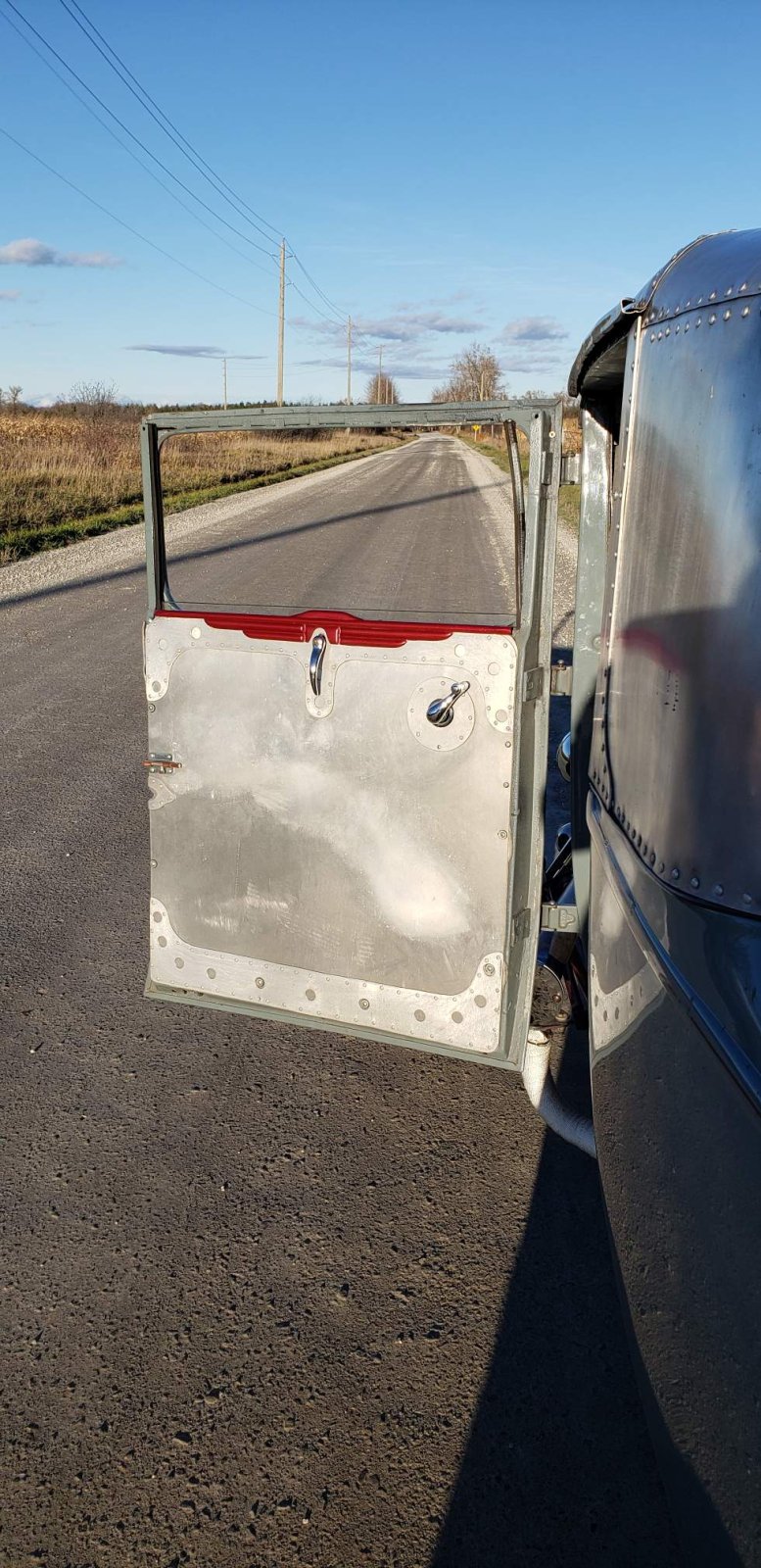

    Thanks 33...pretty good timing on this discussion...with the story on this Sport Coupe being an Aircraft Serviceman came back after WWII and bought an old car and made a Hotrod...move forward to 63 and here we have it...not my creation but I like it too...You are right that in Wartime those skins were painted so the suggestion to paint it is very valid but I like it unpainted too as after the war the bigger Birds were repurposed for civilian use with polished skins. On the exterior the bare Top matches the rear fenders which are also bare... I have cycle style fronts (vintage spare tire ring) I'm fabbing for the front and they're steel but stripped and fine sanded they look like the bare aluminum...Bonus!
    Noise, the coupe is raw...so no insulation really so it has rattles, squeeks and is pretty noisy...90+ decibels but truly it's not the riveted structures...The roof does oil can a bit with the wind, cooler temps and speed but I always say Hotrods weren't built for luxury...
    So that takes me to your discussion of Aircraft...I worked for 27 years at MDC in Malton, ON, a subsidiary of the former McDonnell Douglas Corporation your way and the plant I worked in was a former Canadian Wartime plant that produced WWII Lancaster Bombers, 433 of them in fact along with Britain that produced the bulk of the around 4333 total built for that hell that was WWII... I have two connections to those Lanc's...Grandma worked at the Plant in 1942 for three years working on them and in 1999 to 2014 I worked on removal and restoration of a Memorial Lanc on a plinth in Toronto as it was rotting up there...that's another roundabout connection to this postwar inspired Hotrod...It was built in Penna by Jerry here at the Hamb who has a wartime family connection so it really could have happened either side or our great nations really...Allied enough or what eh! I'm still having fun with this thing...glad you are too...;)

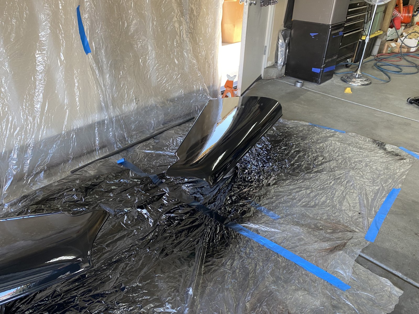

    IMG_1109.jpeg IMG_1110.jpeg IMG_1108.jpeg IMG_1107.jpeg IMG_1127.jpeg IMG_1131.jpeg IMG_1135.jpeg IMG_1133.jpeg IMG_1136.jpeg IMG_1134.jpeg IMG_1115.jpeg IMG_1116.jpeg IMG_1137.jpeg IMG_1122.jpeg IMG_1121.jpeg IMG_1120.jpeg IMG_1117.jpeg IMG_1119.jpeg Well, got the hood painted! So…while I was waiting for it to dry. I was playing around with rubbing, out the fender that had overspray on it from when I hit it with the paint twice, back when I painted it. so you can see what it looked like before, and what the rest of the fender looks like as I work my way back. it’ll start to look better and better. The hood, I’ll let Dry for a month or so and then it should be pretty easy to Sand and
    Buff!

    Yeah! And he said you can’t do enamel!
    Well it does burn up with a buffer,
    But slow by hand a little at a time
    Works.
